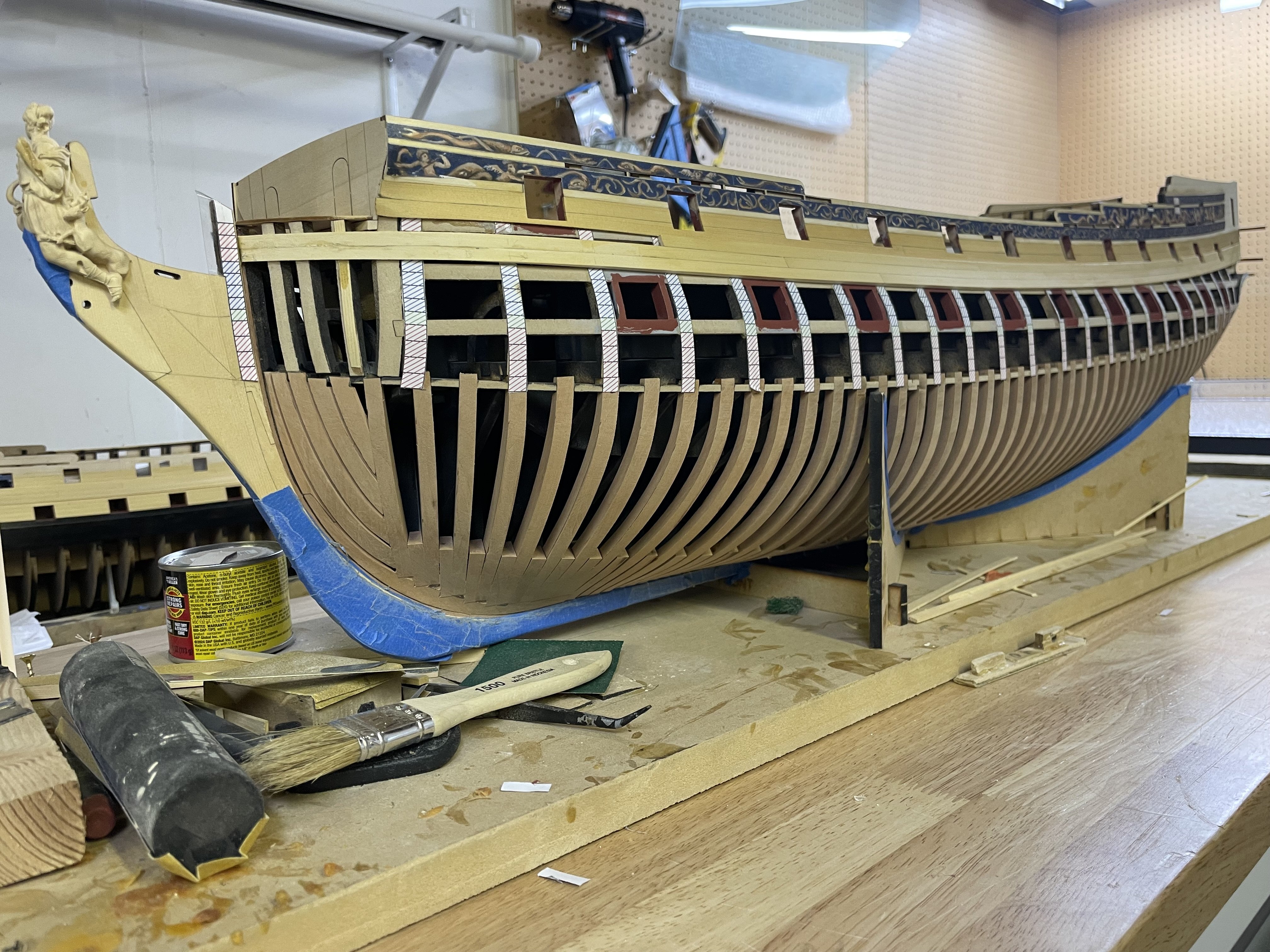

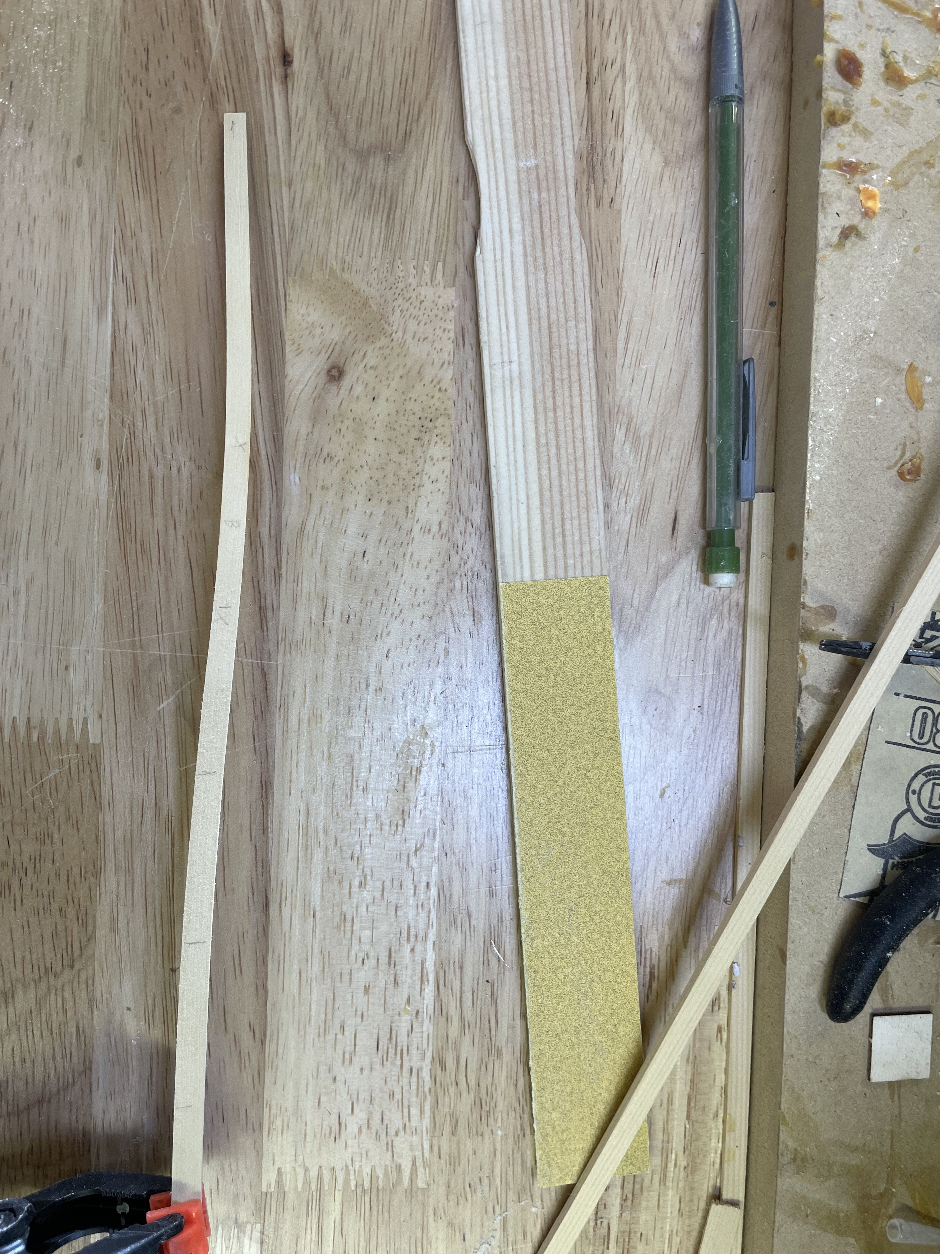

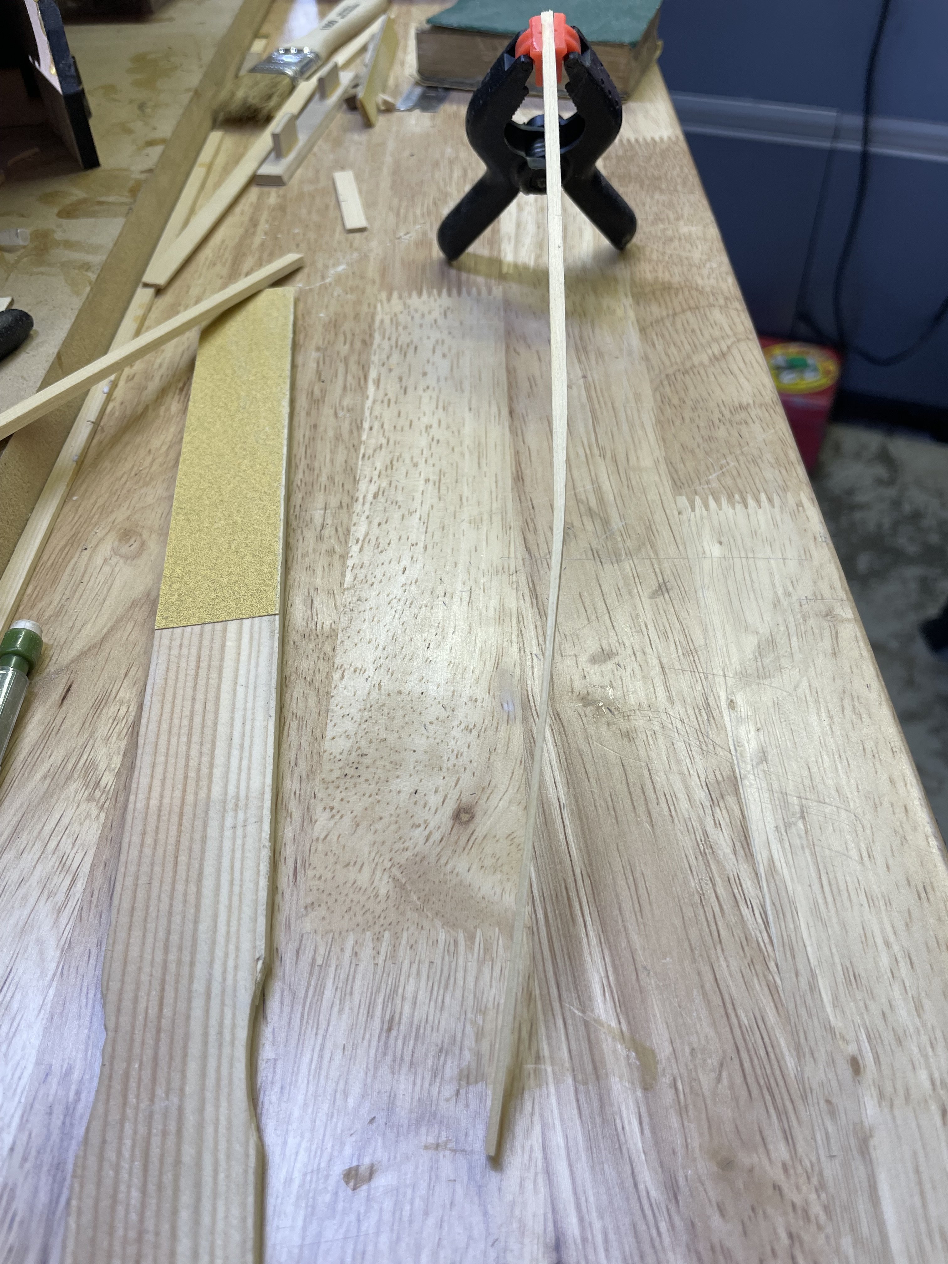

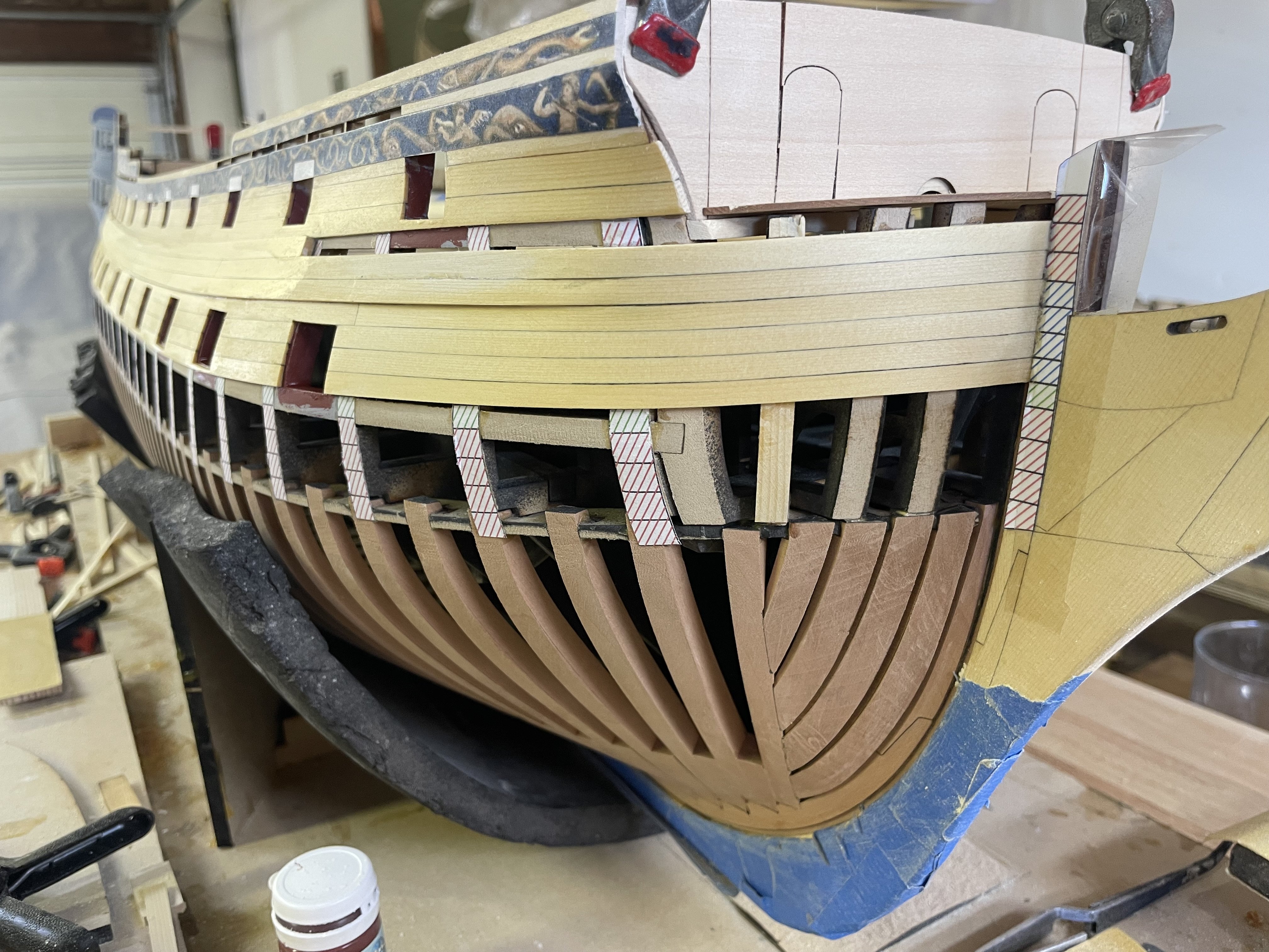

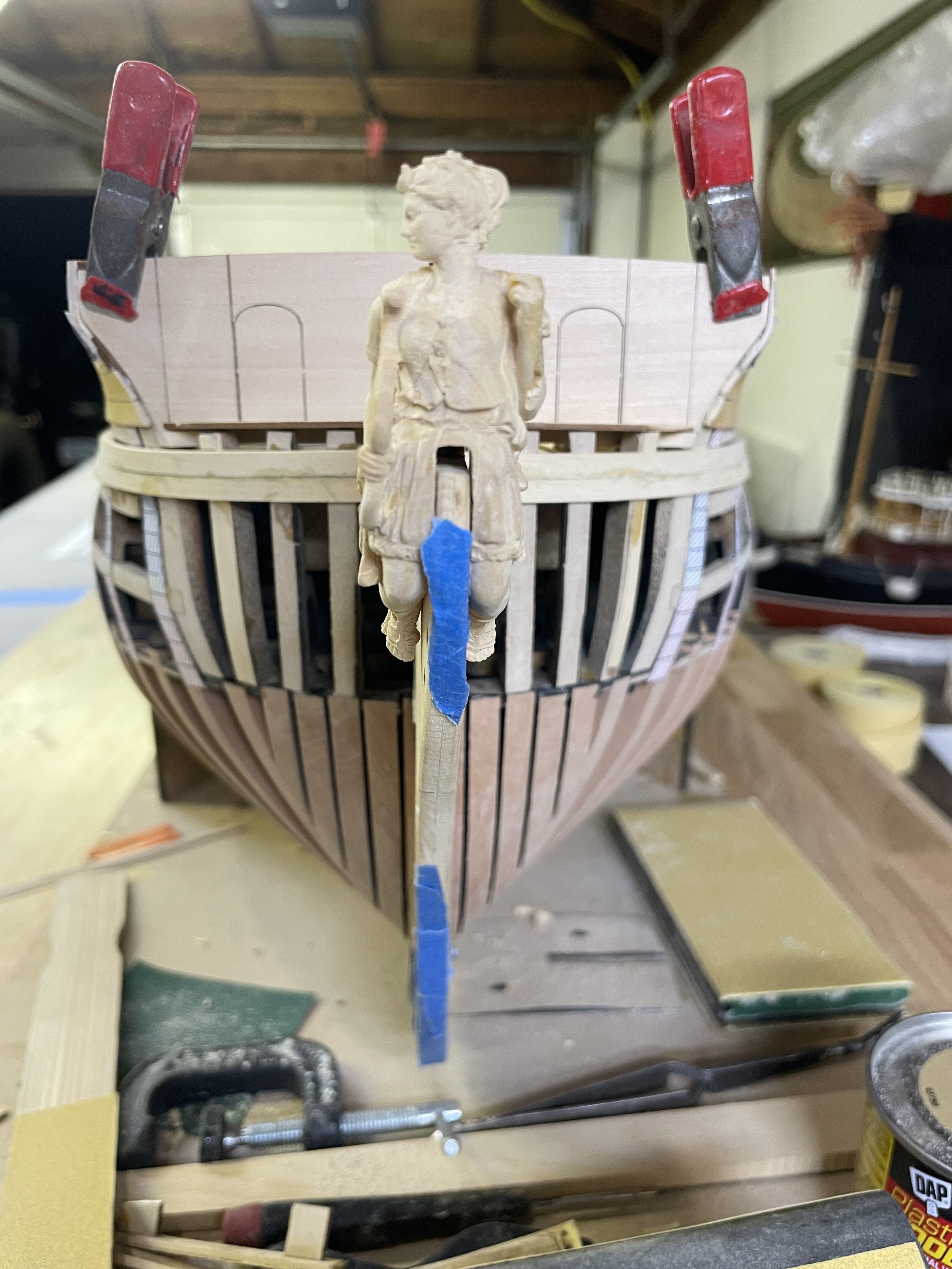

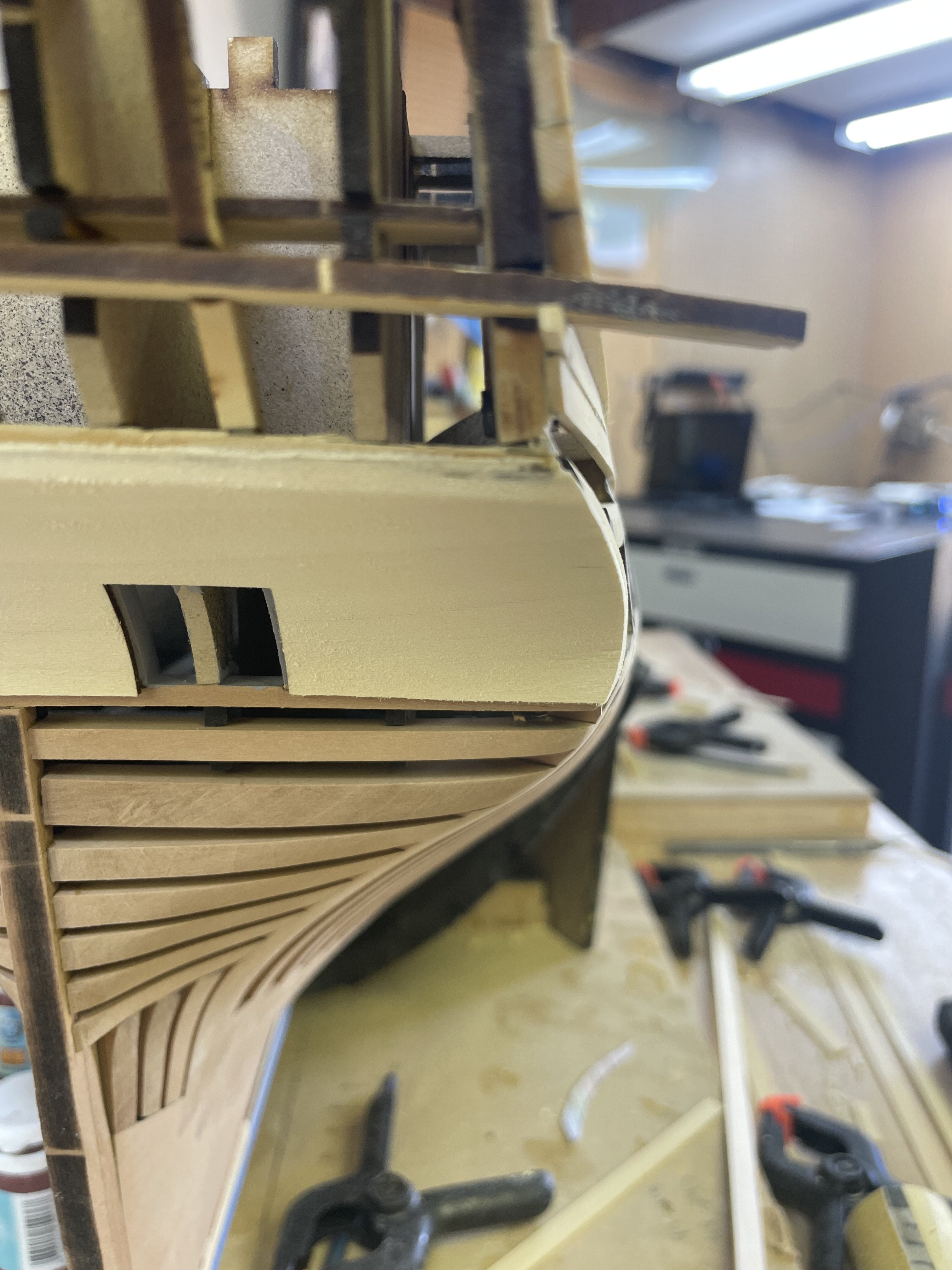

Today I got the channel wale on, the planks are just under 1/8” thick so there’s plenty to work with when you’re finished. These are very tricky at the front and take quite a lot of bends and tapers, they end up looking like an “S”, if that Isn’t enough they also need to be tapered down to .050” at the stem. You could sand them when they are in place but making all those bends in a 1/8” thick planks is a nightmare!
a lot of eyeball testing took place as well as some adjusting once they were in place but I think I got them with a decent run.

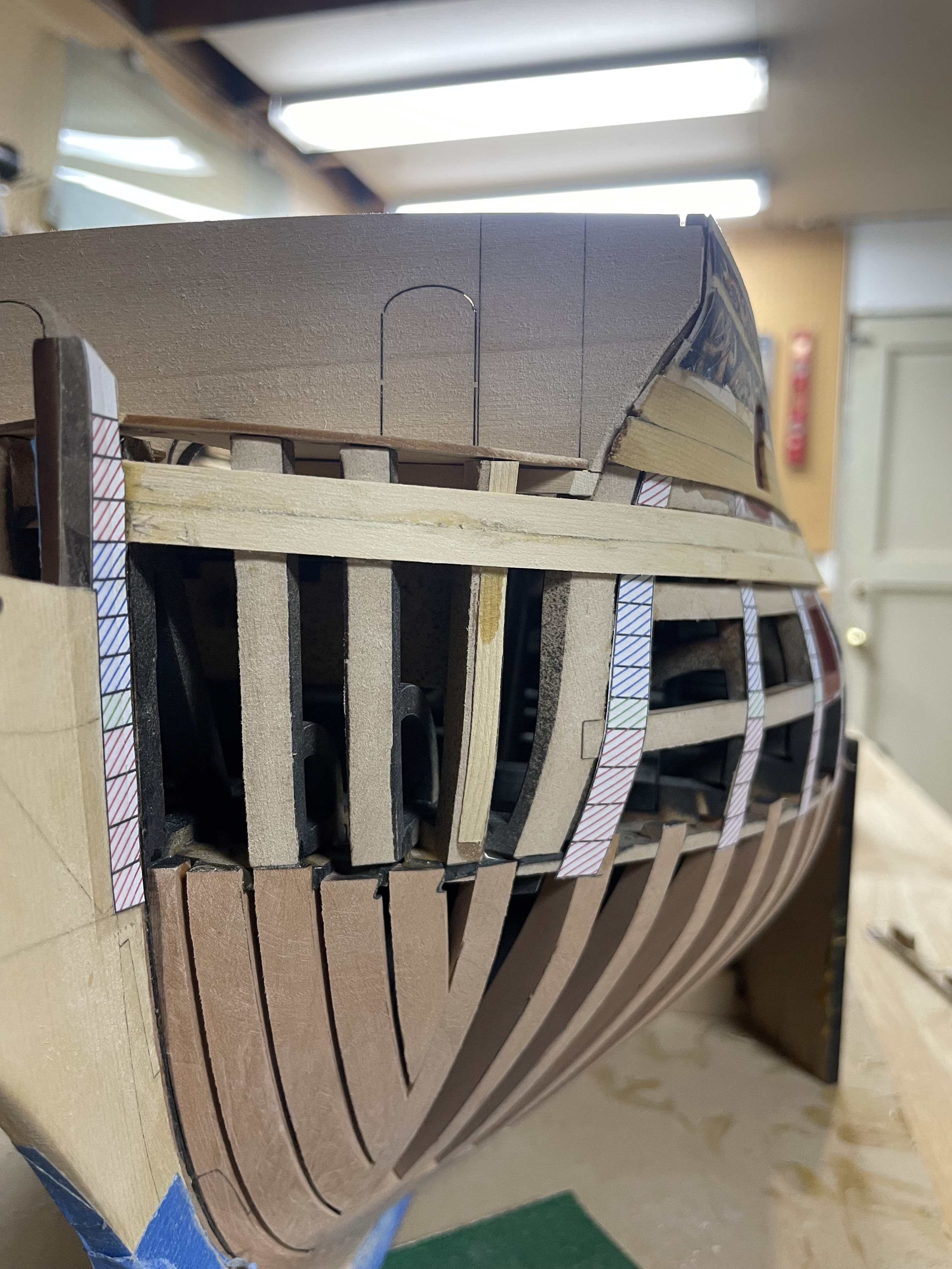

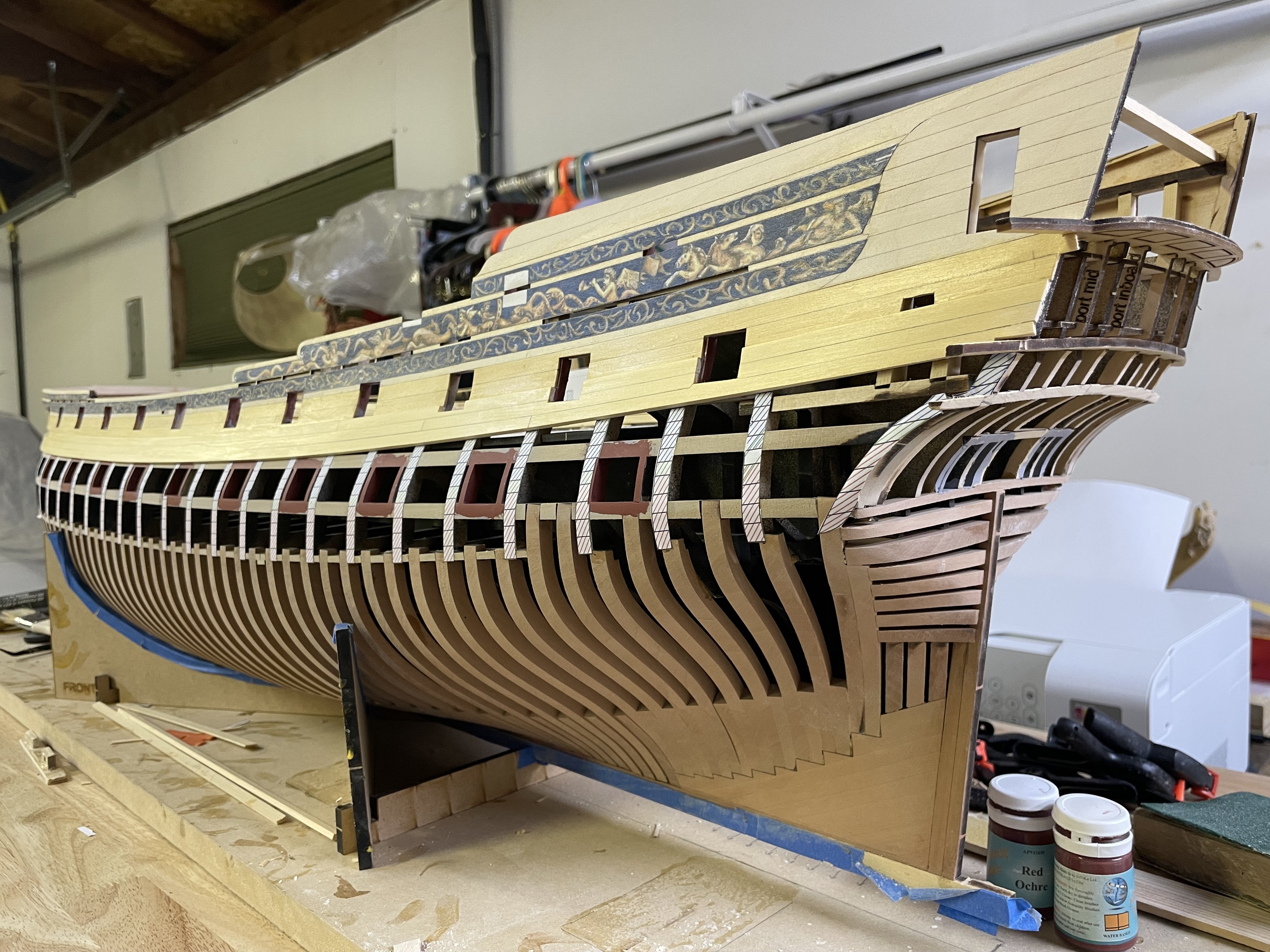

The upper plank is missing, there’s a reason for it and it involves removing the beak head bulkhead support beam one last time to remove the jig pieces to fair up in the inside of the Hawes pieces. By the time the last planking belt is on it will be safe to remove the inner jigs, nothing will move at that point. So I will just fair that inner forward area and permanently install the beam afterwards. More to come.

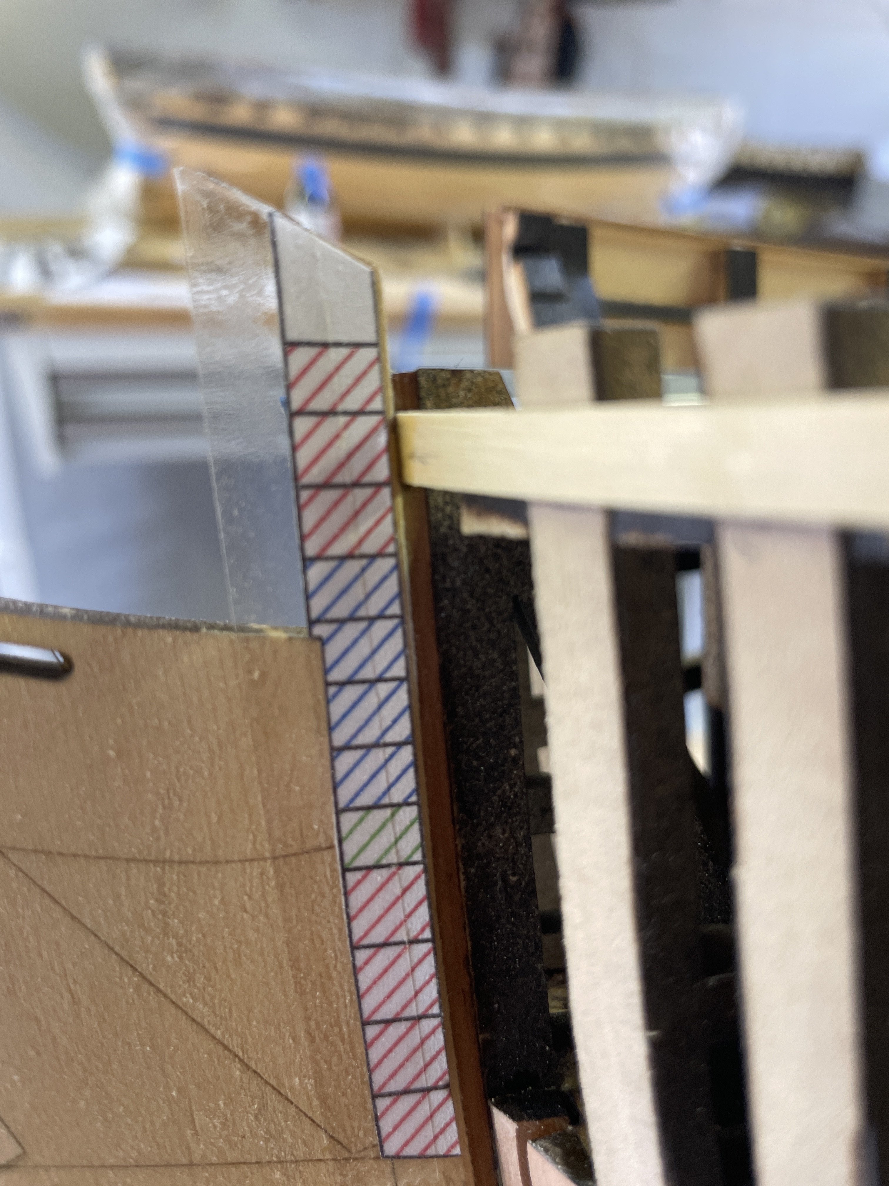

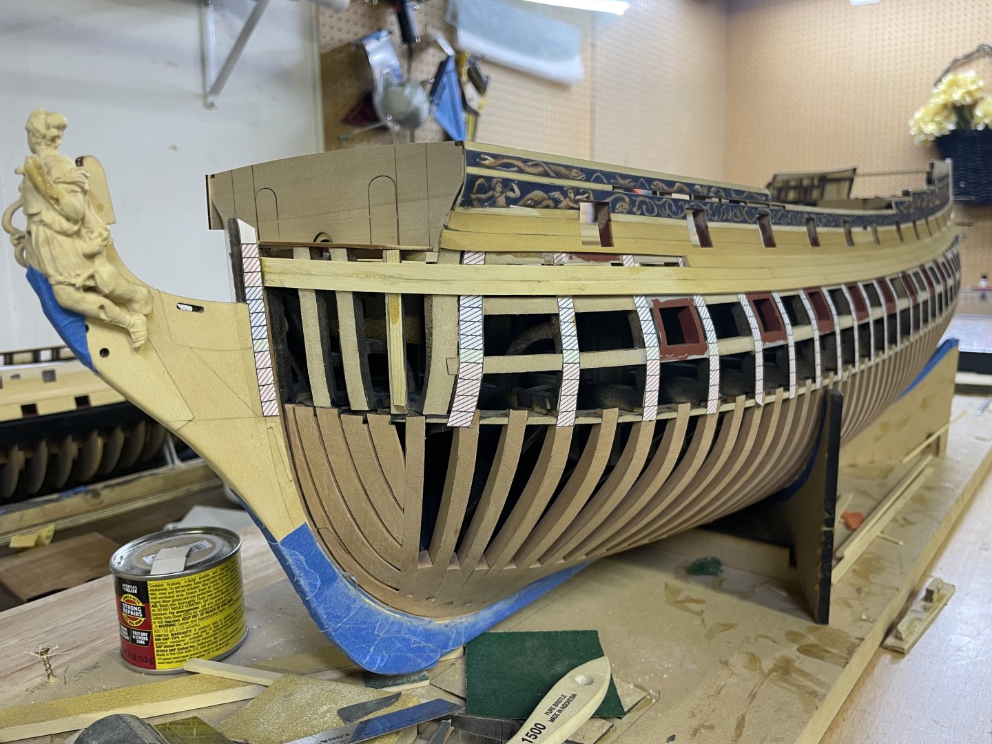

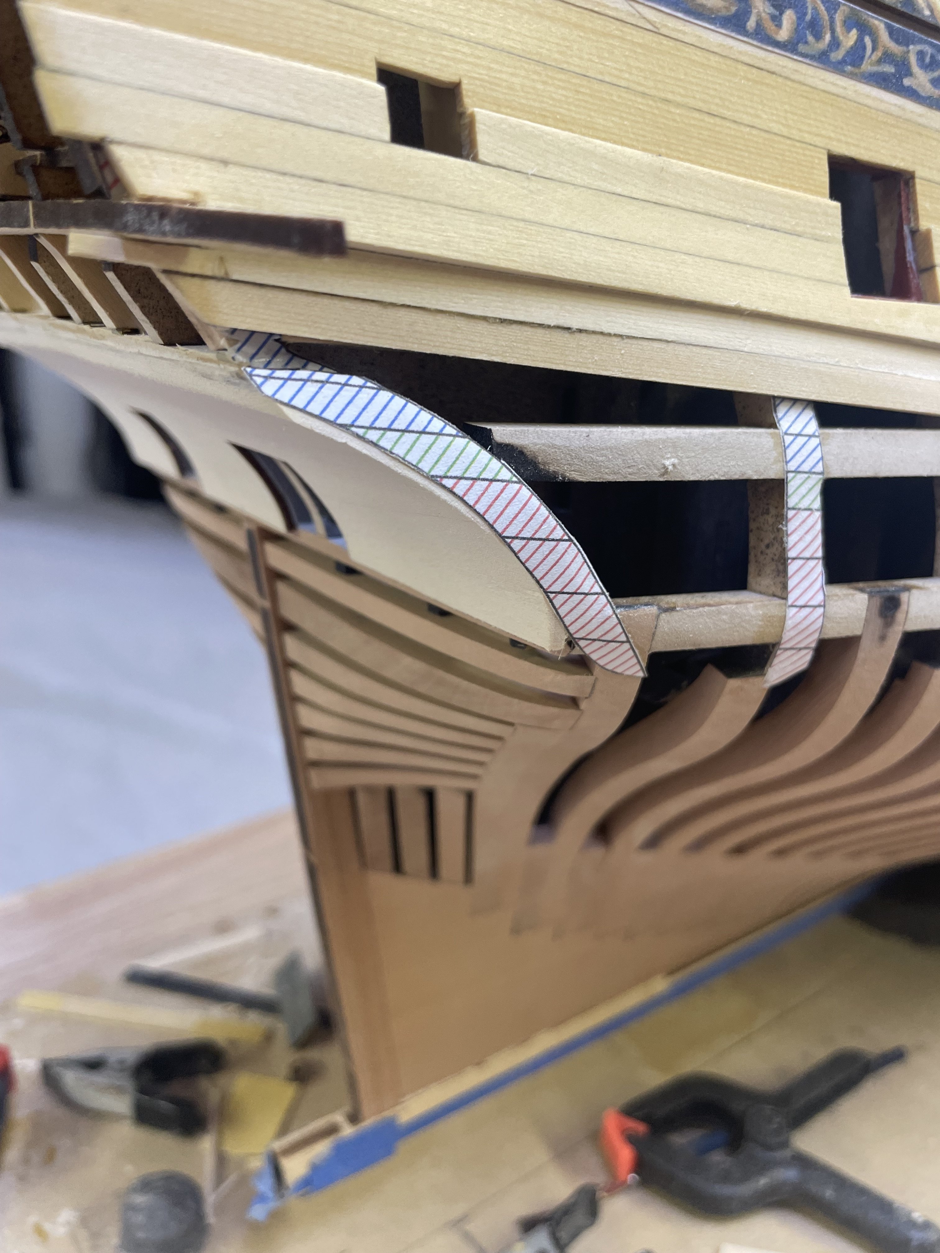

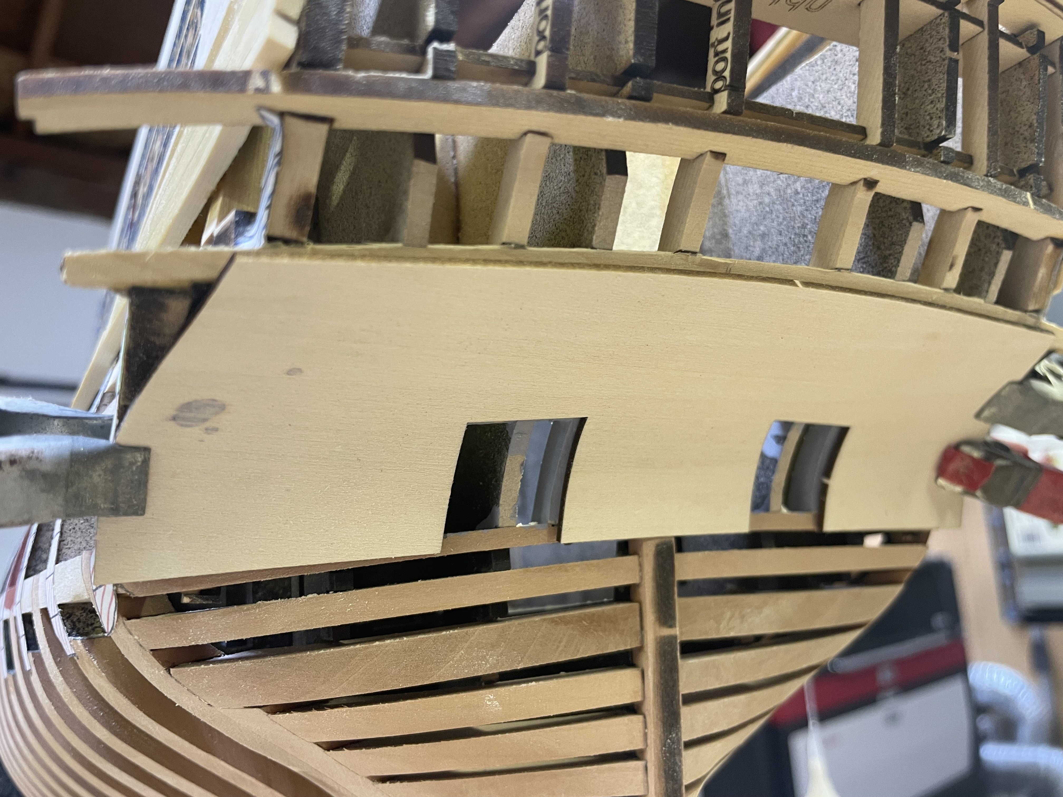

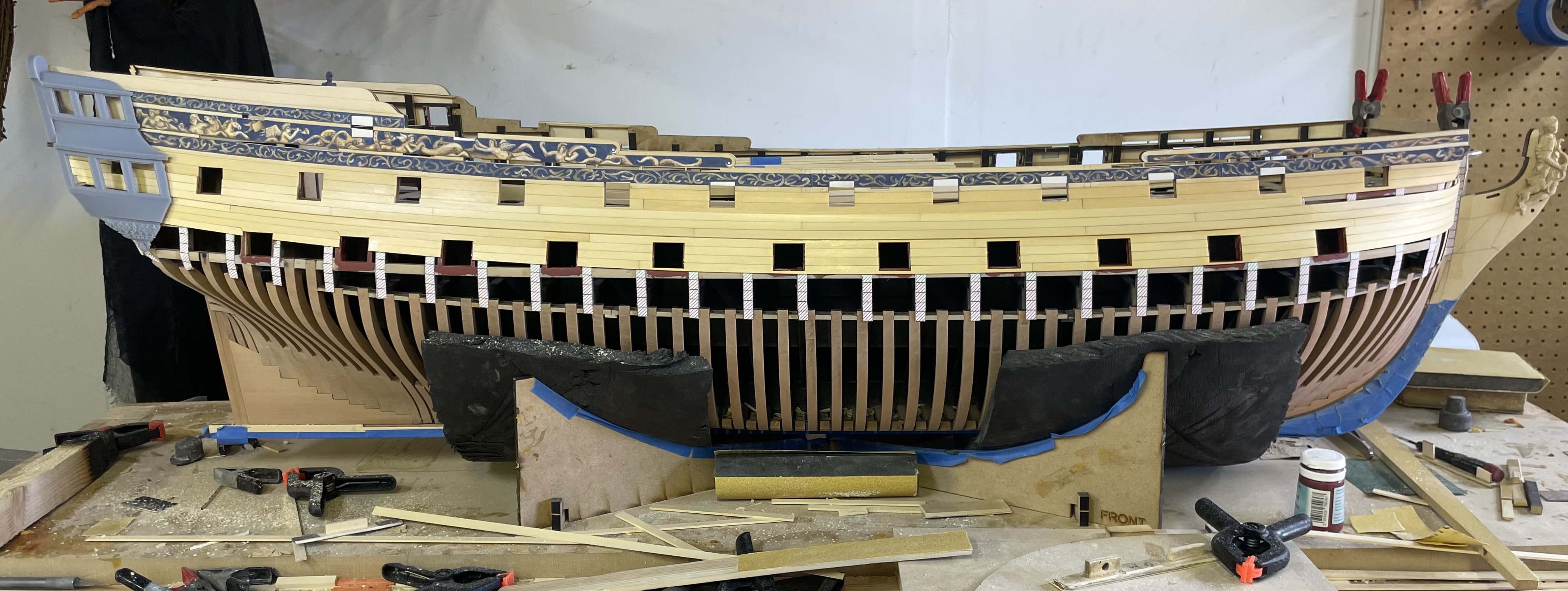

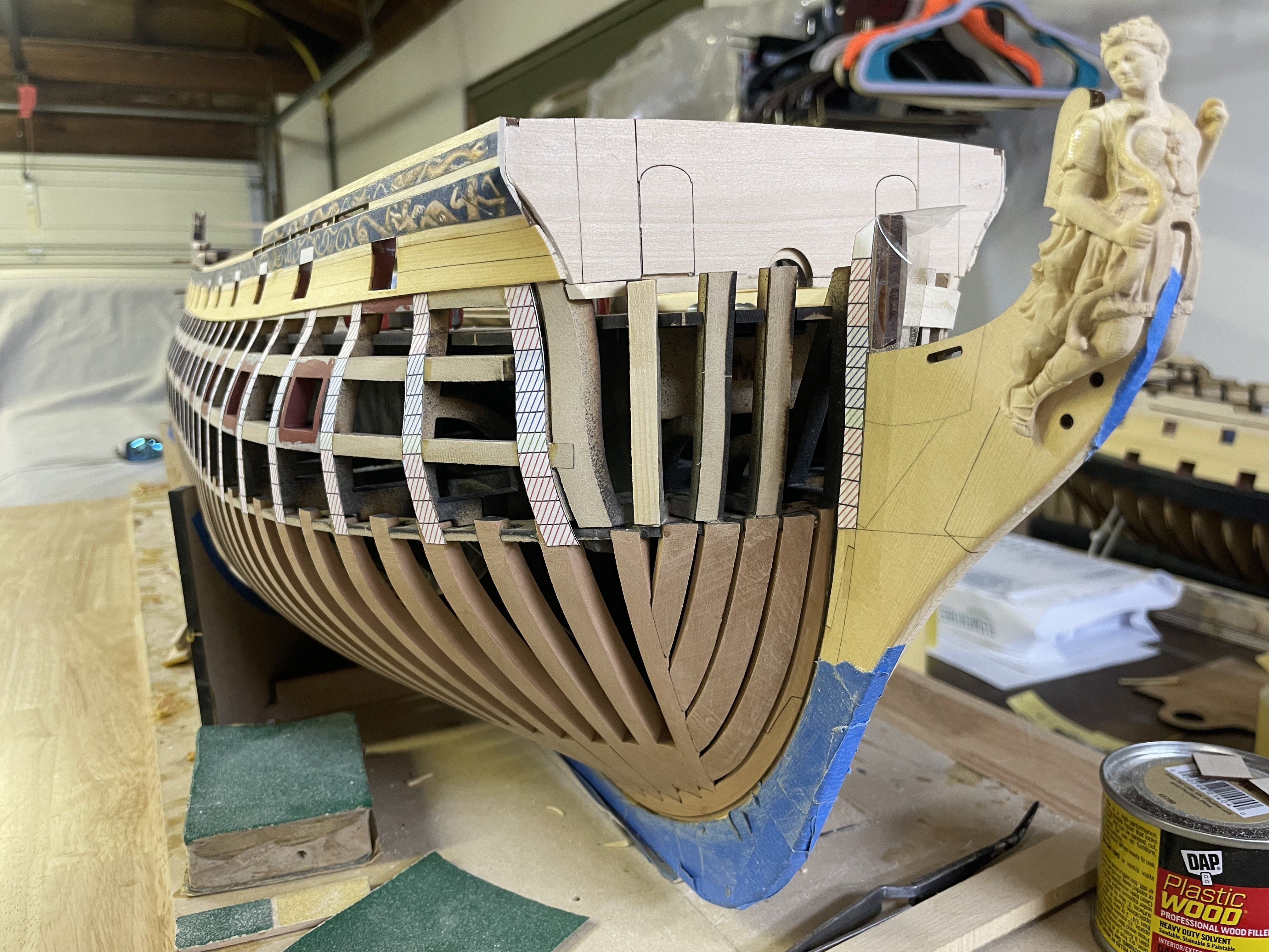

I tapered the planks to fit the guides and made sure there was a nice curve to them, from there I would mark where they need to be cut for the gunports, this keeps a nice continuity in the taper once the plank is cut up and allows the next plank below to fit nice. IMG_9392.thumb.jpeg.f6a0ba868947bacc630dee98d0222935.jpeg

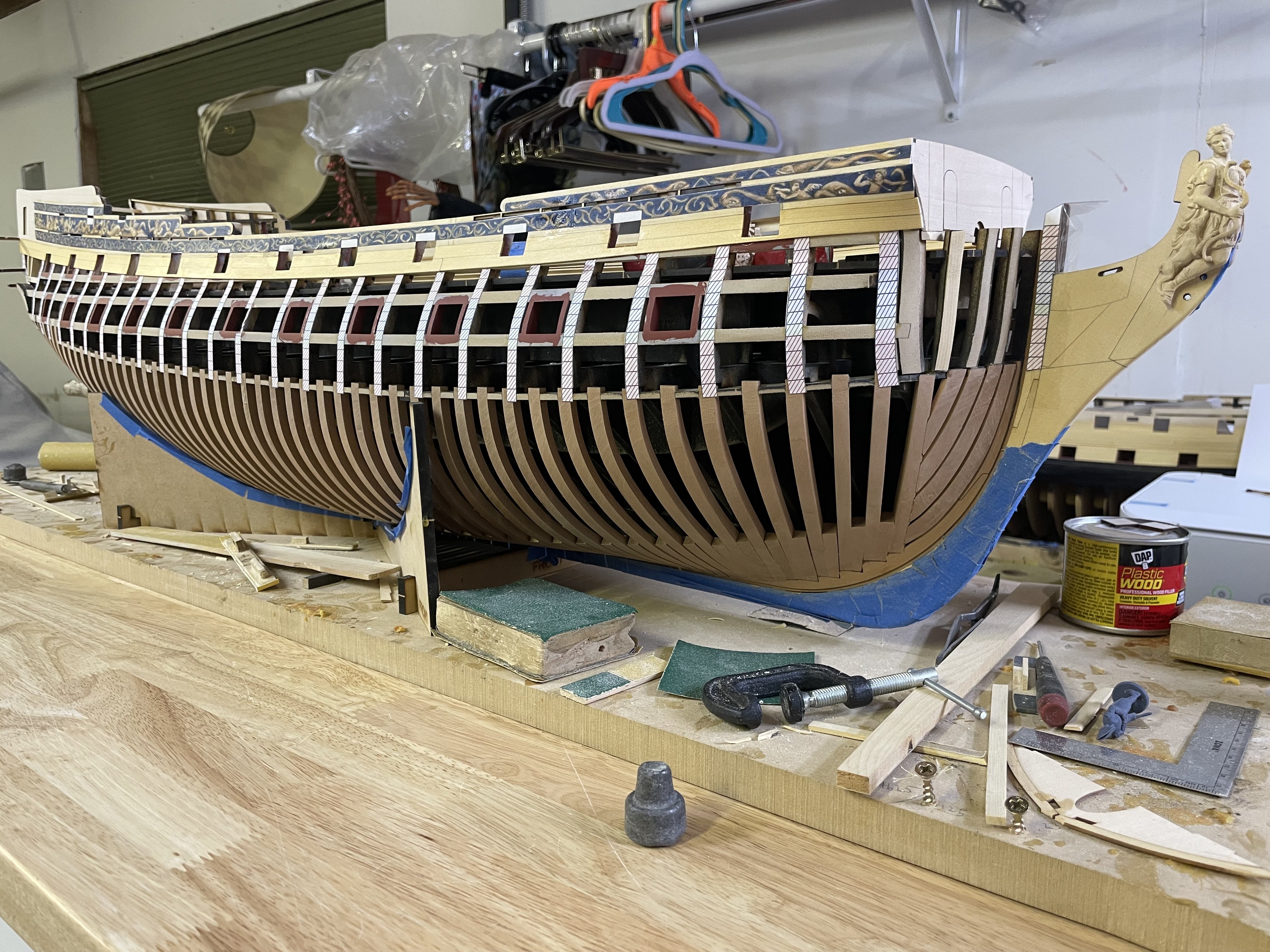

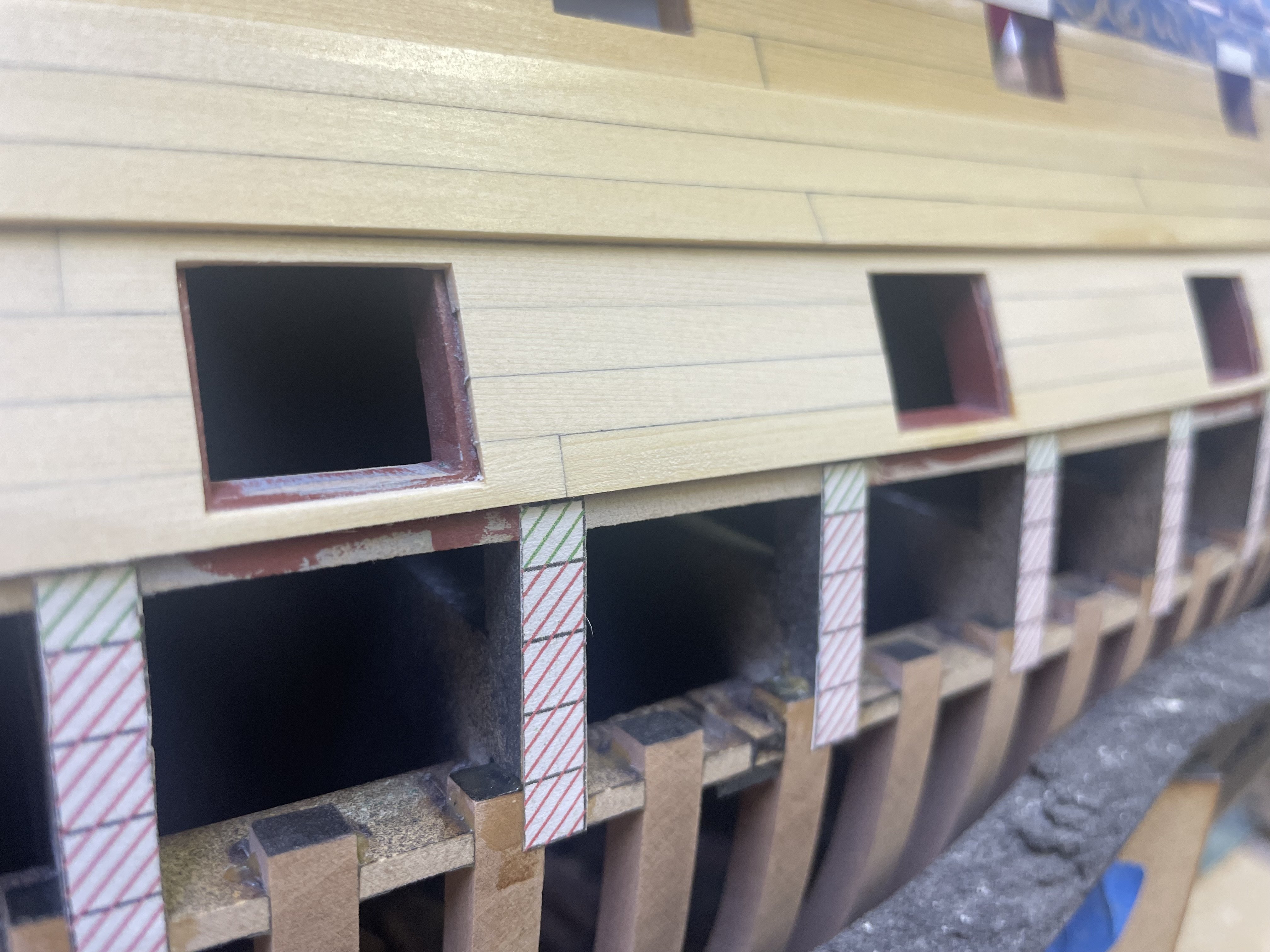

Once I got all the planks down I block sanded them out with 150/220 and applied WOP to protect them. Tomorrow the poly will be dry and I can clean up
and repaint the gunports on the upper deck.
Tomorrow I’m going to turn the model around and repeat on the stbd side.

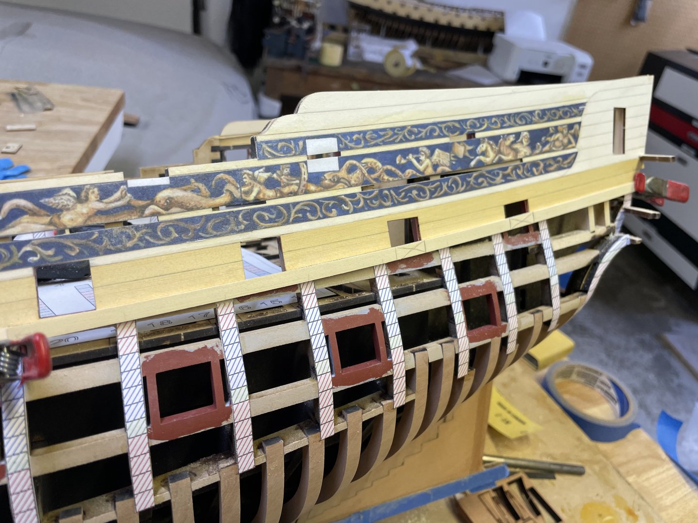

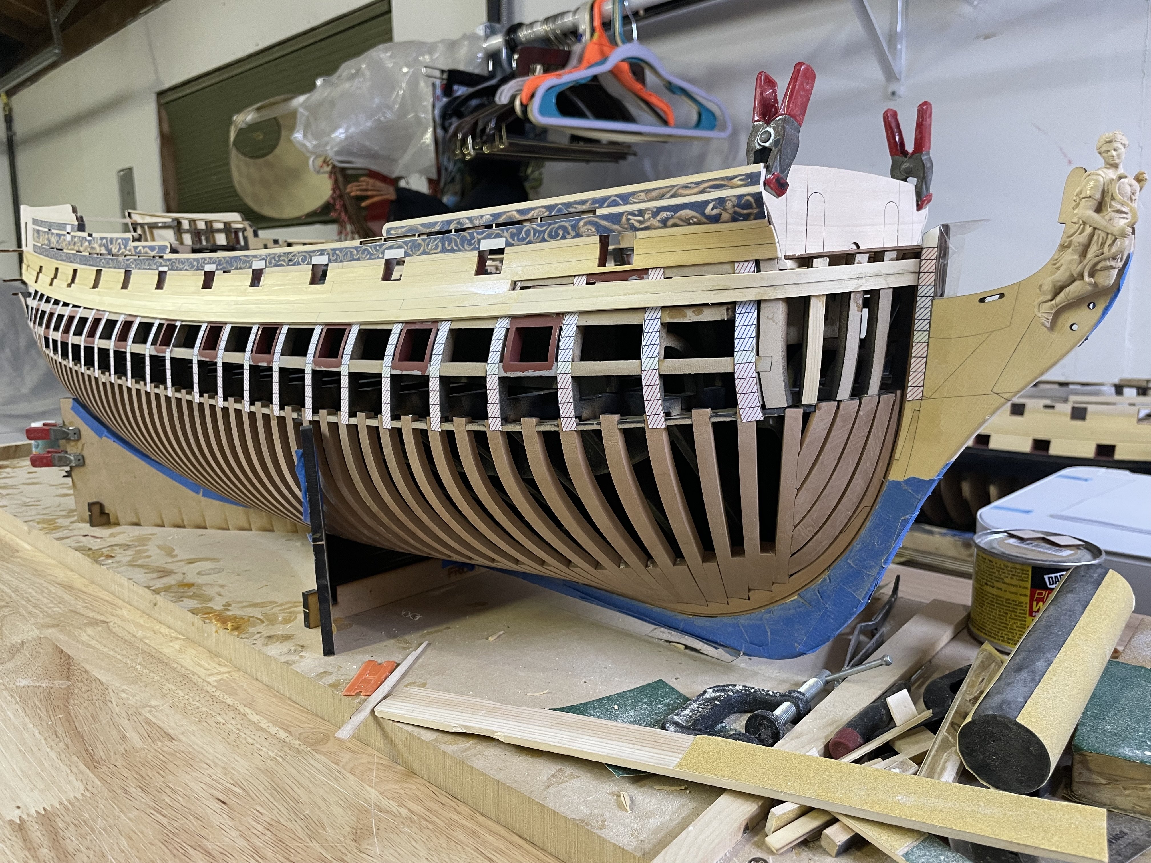

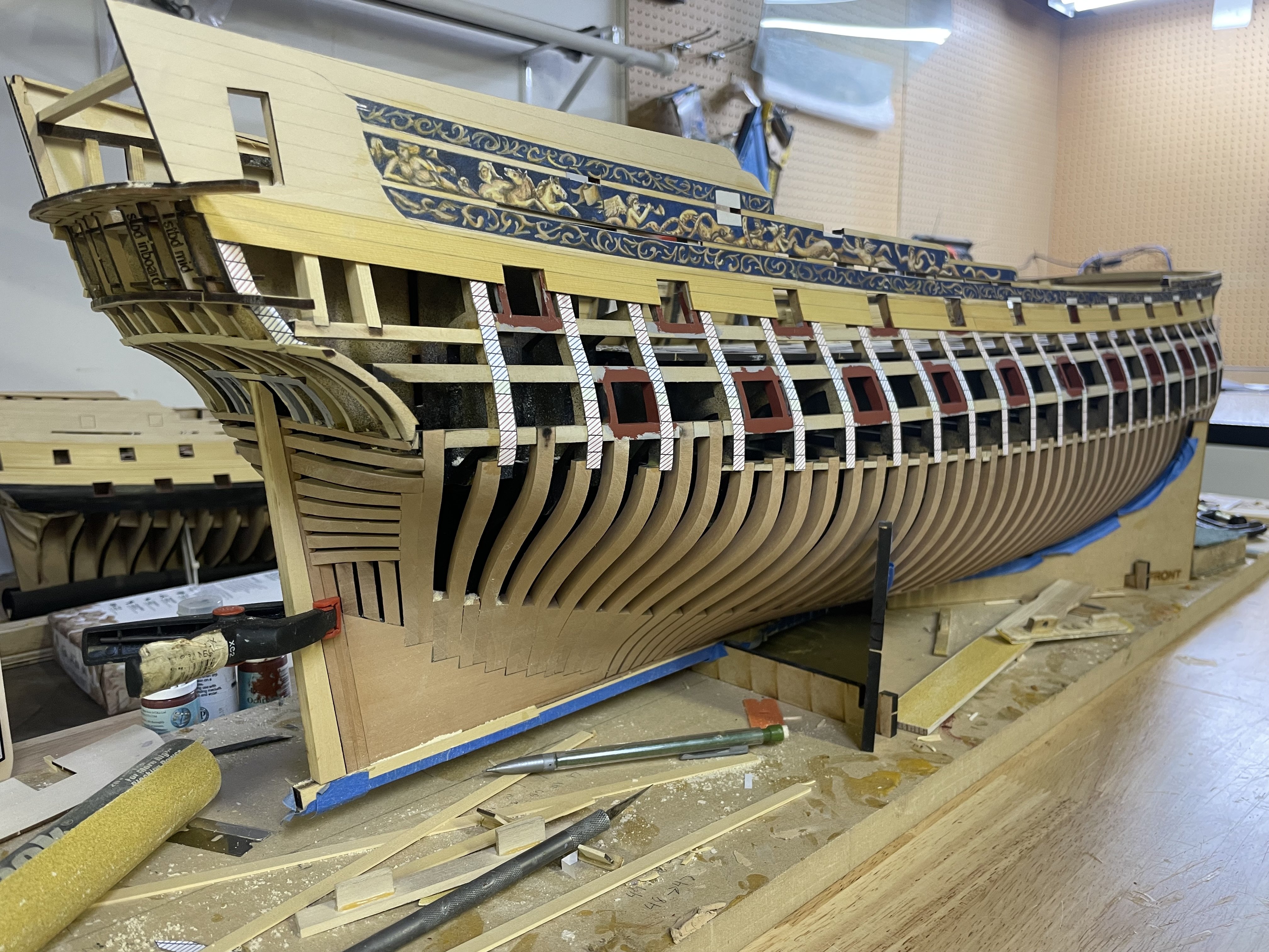

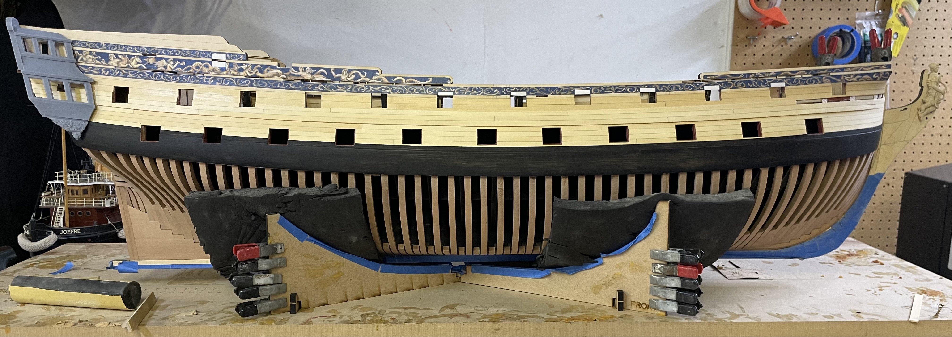

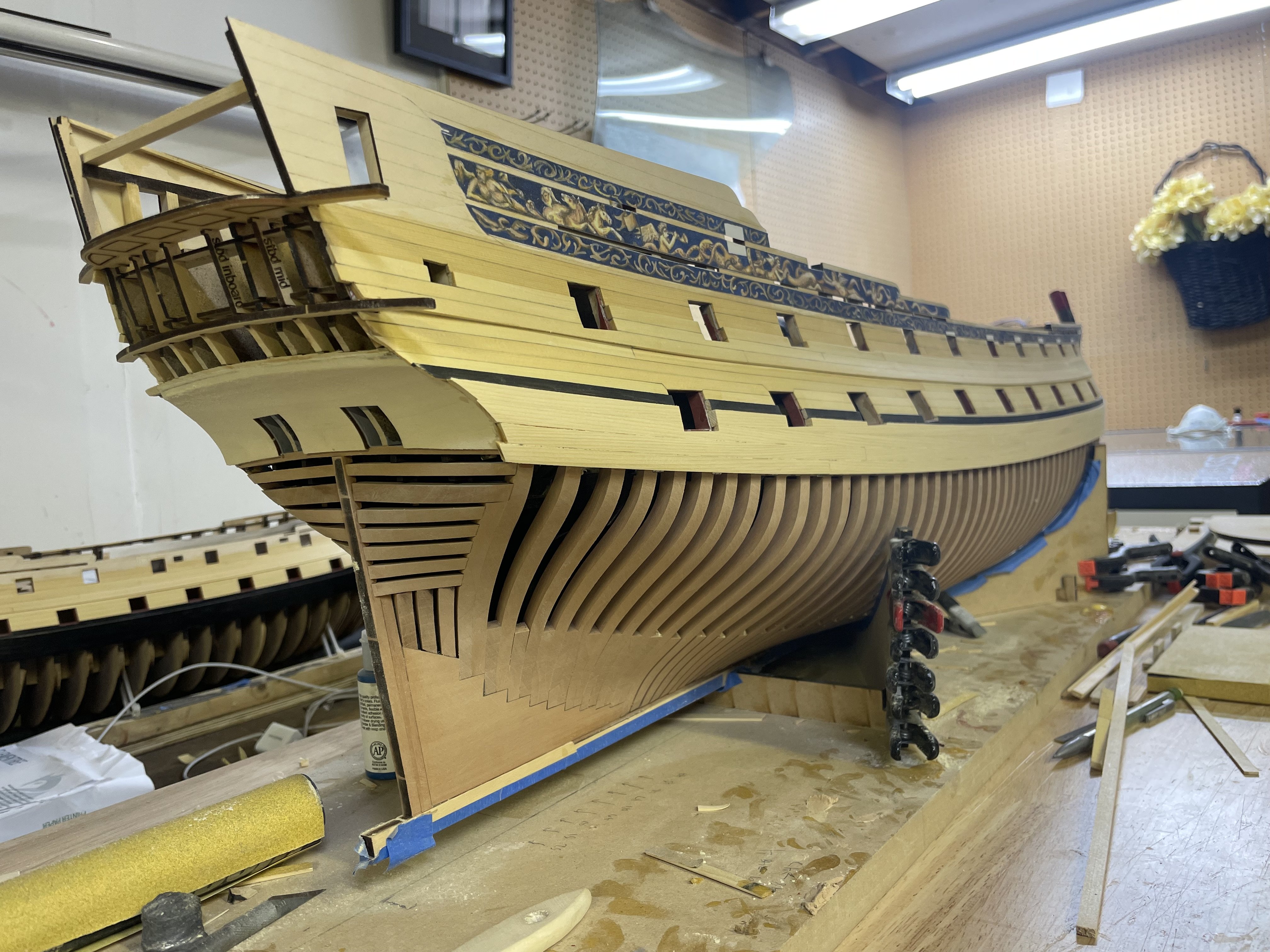

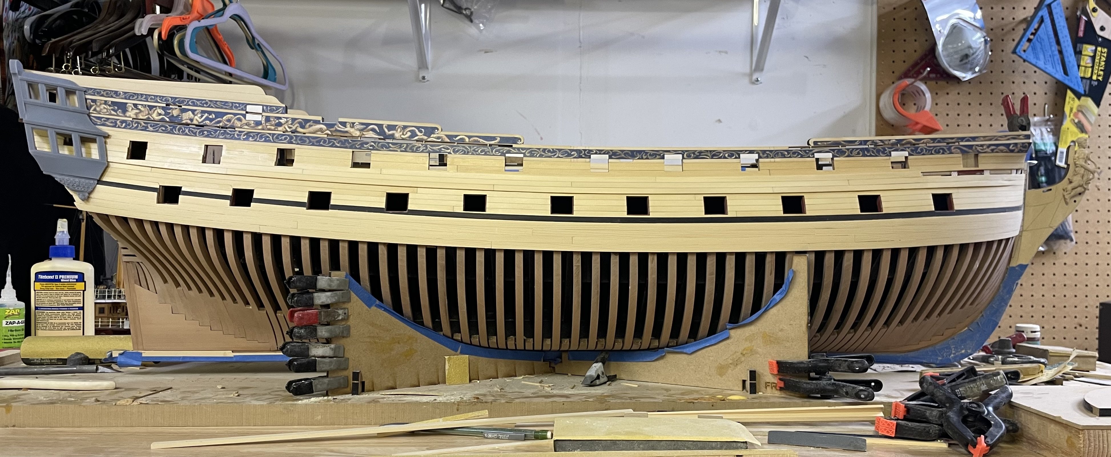

Today’s  progress on Portland. I got the first belt completed on the stbd side and the friezes on and sealed with WOP.  Think the planks may have turned out better on this side, especially the bow. Overall I’m happy with it. On to the channel wales tomorrow!

I couldn’t bear to look at those massive empty etched basswood panels any longer! They had to go on.
Once attached I actually drown the friezes in WOP a couple times. It adds Some depth to the printing as well as protects them. Now when I go to touch up the gunports with red I can be semi messy and the paint will just wipe off. I did this with Winnie too and was happy with the results.

I have had good luck with the printed Friezes by doing this as well, but I first spray them after they come off the printer with a matt fixative, when they have been glued on the model I then give them a couple of coats of Testors Dullcoat.
Is the fixative like a light adhesive? Or does it stabilize the printed part?
It’s an ink stabilizer and UV protector that helps stop fading. spray on until wet and then allow to dry, I use the Krylon brand stuff.
The dullcoat is a varnish lacquer that will do the final seal and give a tougher finish.

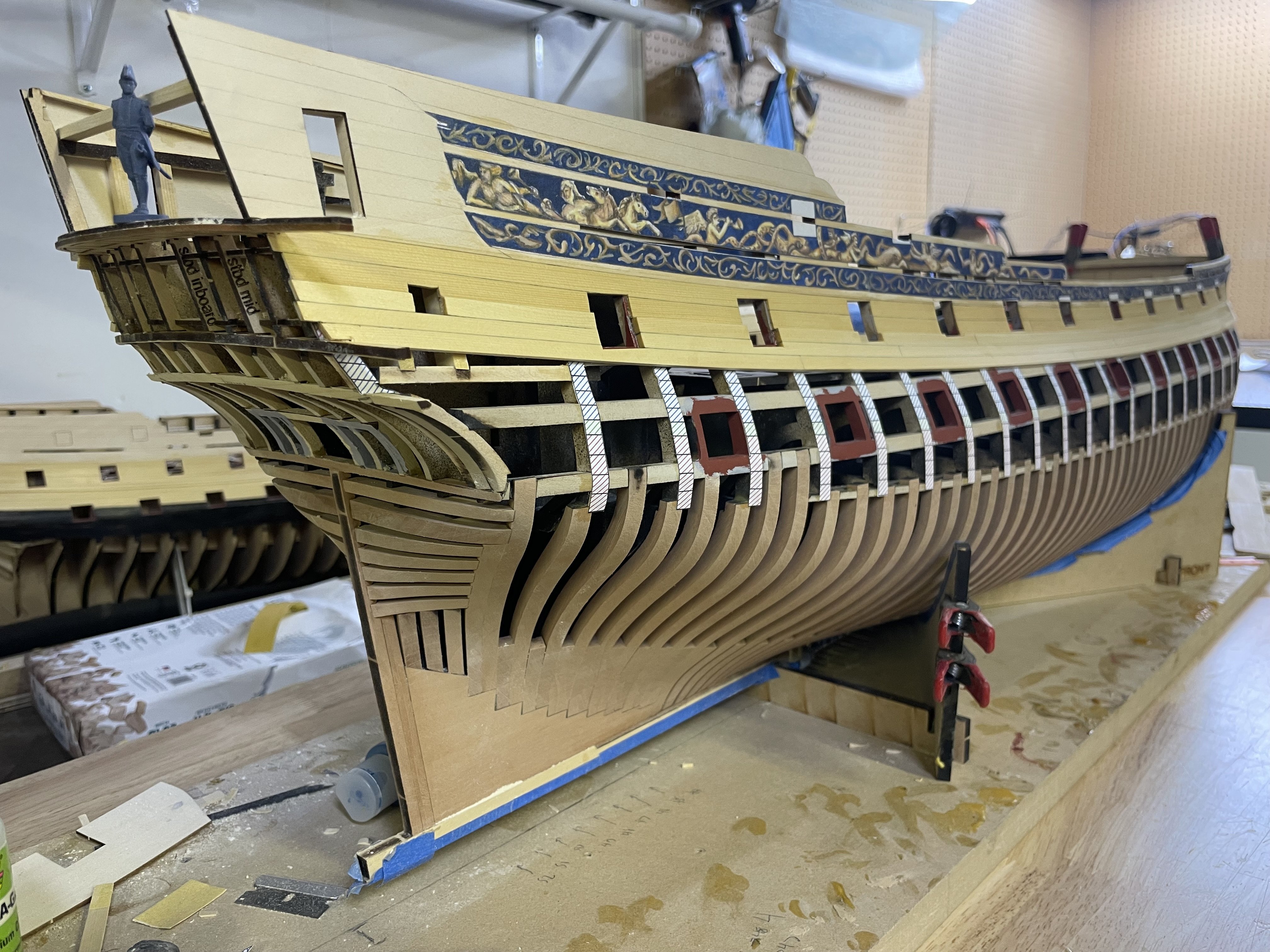

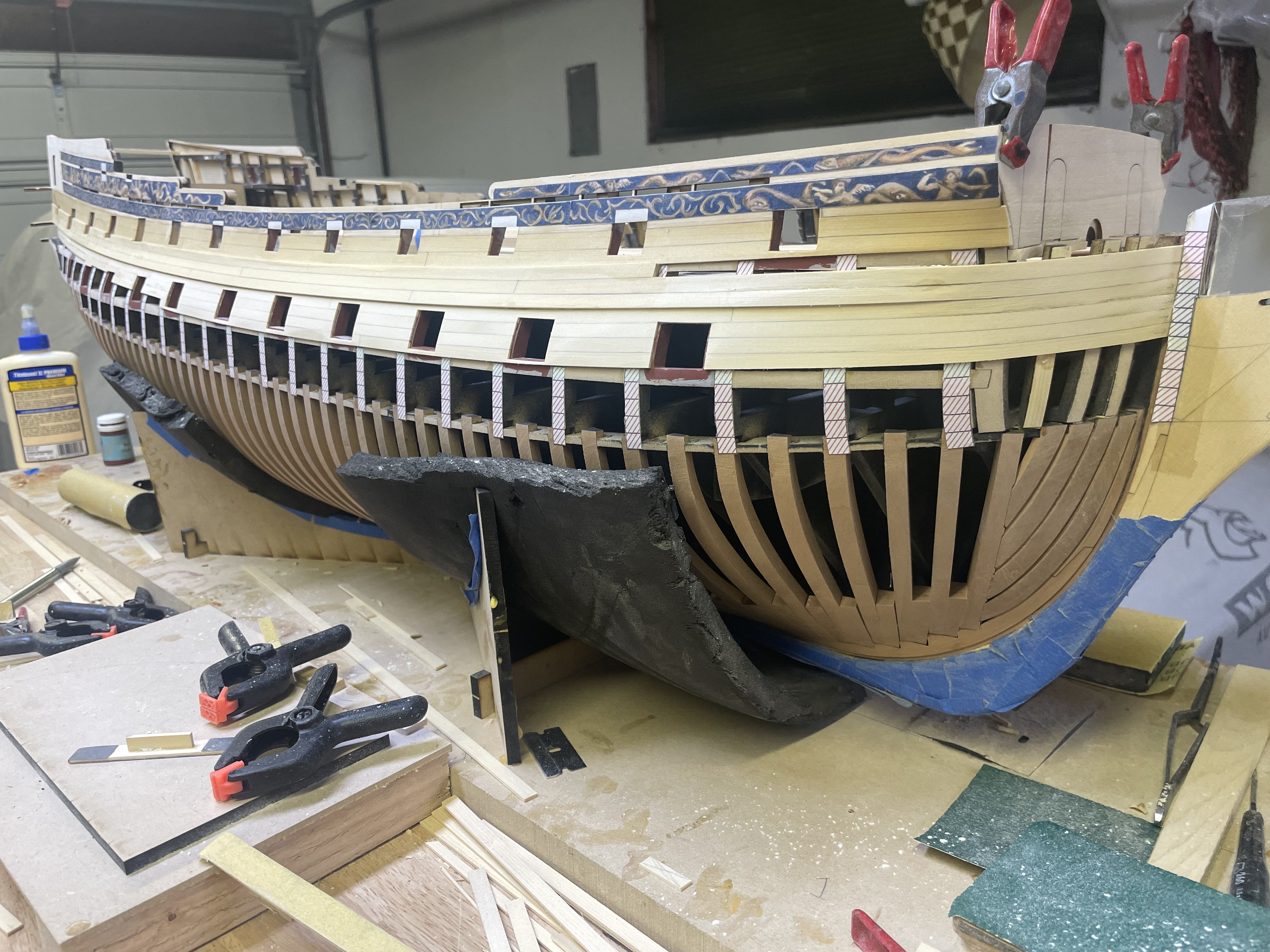

Stbd side channel wales done today, except for the forward upper plank. After I get a few more planks attached to the front I will pull the forward jigs and fair out the forward portion of the inner hull and then permanently install the beam and finish the last two planks.

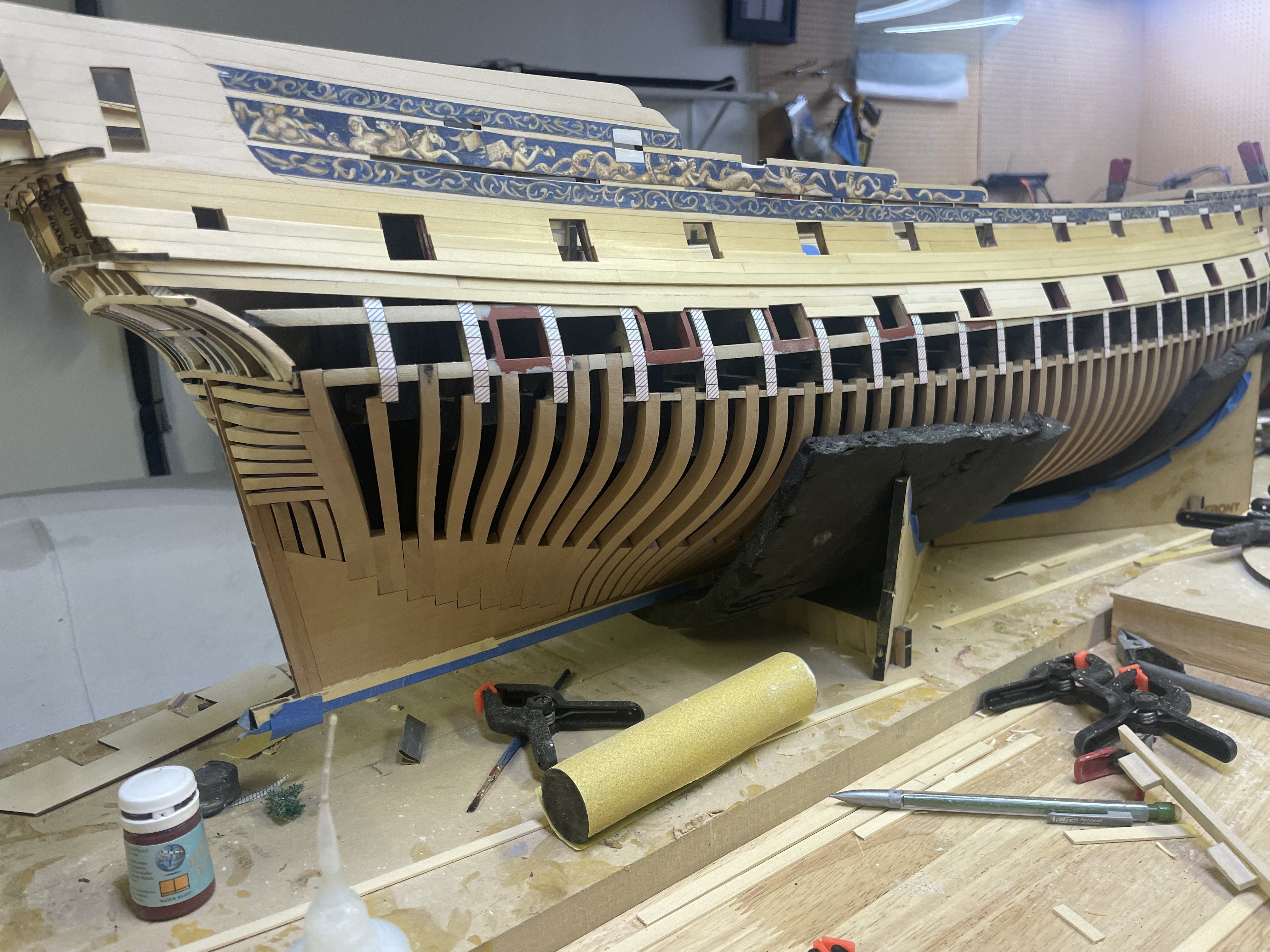

Today’s progress, moving at a glacial pace but I have some of the lower planking belt in place. I need to install the counter tomorrow and fair down the filler pieces on the side to define stern before I can progress any further with planking.
Once the planking fully blocked down and is sealed with WOP I can then proceed with painting the gunports and the edges of the planking as I did on the POB version.

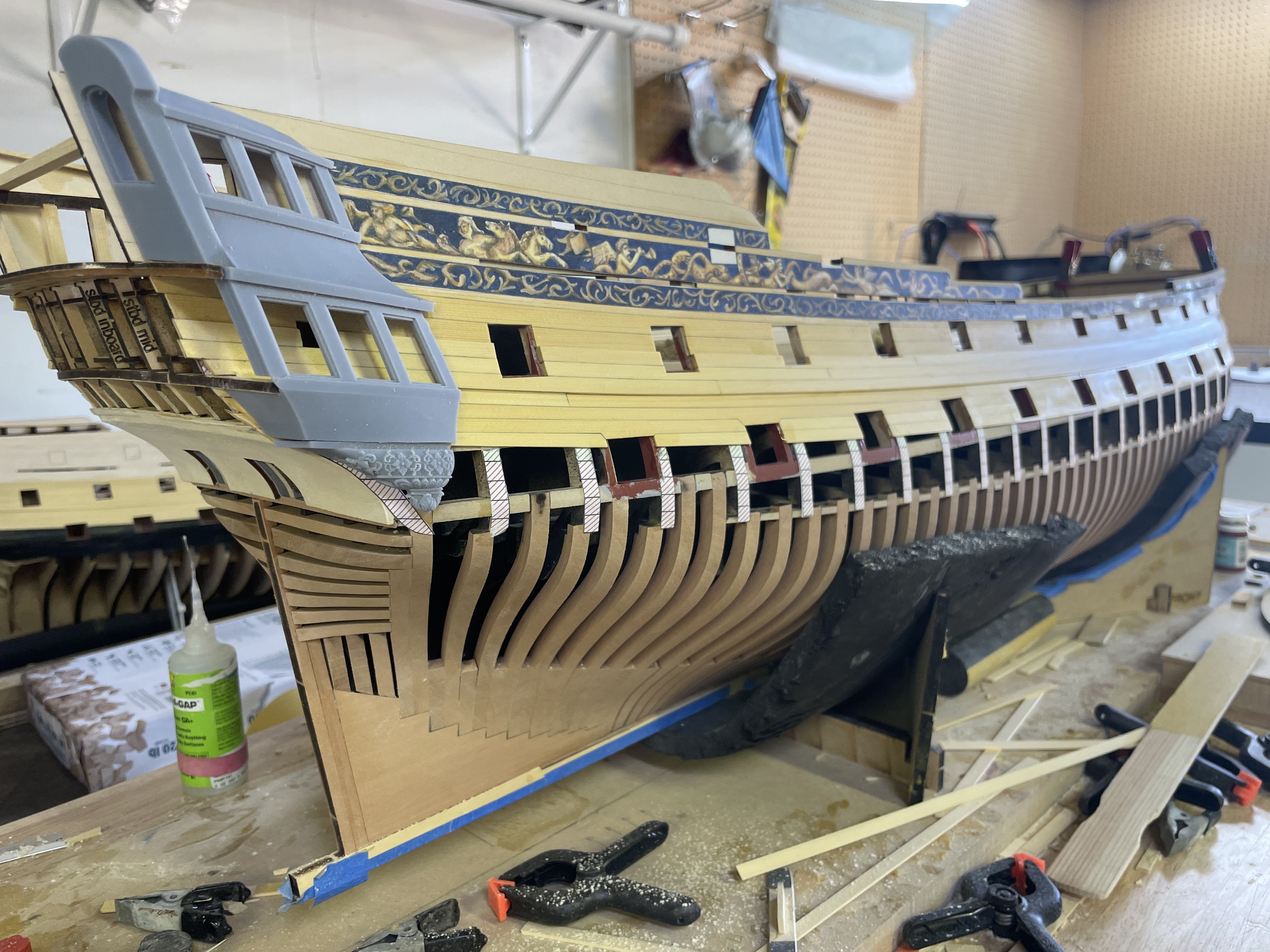

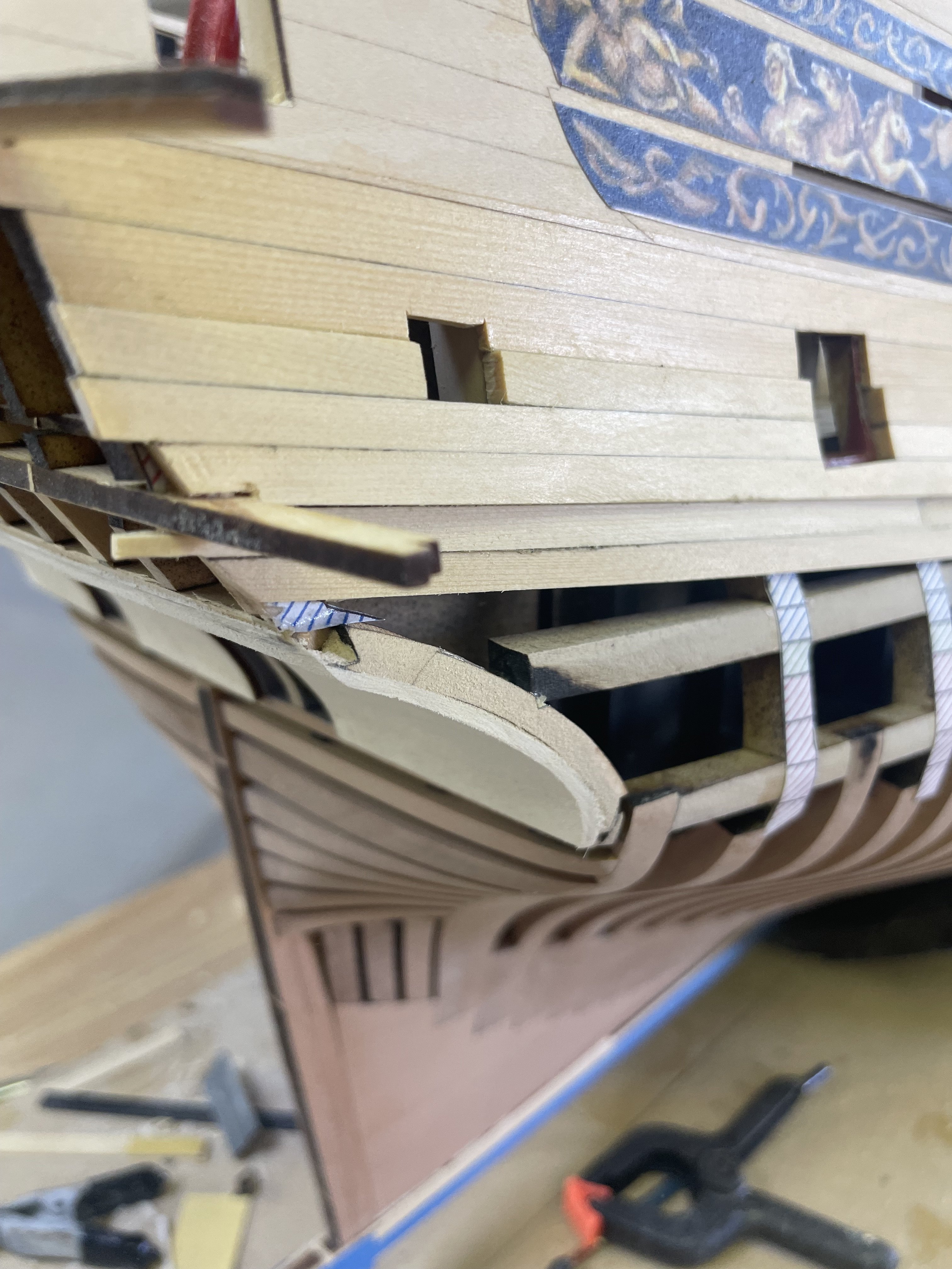

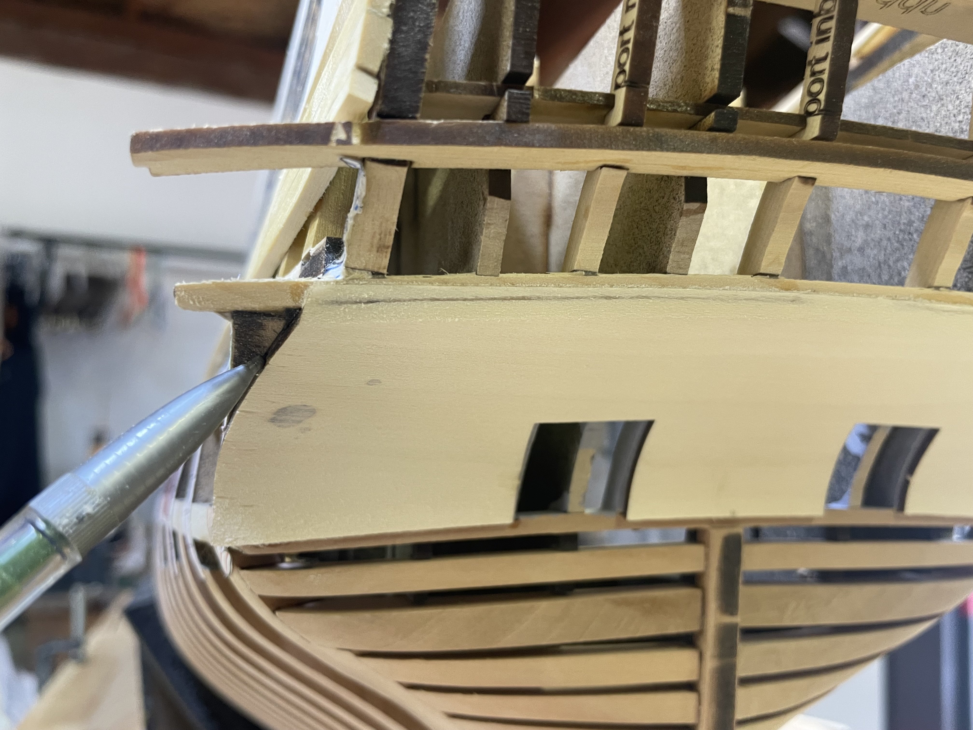

Progress continues and today I got the lower counter glued on and faired in so I could finish the planking belt on the stbd side. The lower counter is laser cut with some extra material on it. I centered it over the gunports and positioned it so that it was sitting level on each side then clamped it down
once it’s in place it can be glued from
The Backside with CA, just don’t glue to the jig pieces! I also wetted the inside face of it so that it wanted to curl in the right direction.
Once it’s in place you can see where things need to be sanded. I also trimmed the lower part of the counter about halfway up The wing transom, I’m going to take an additional 1/32-3/64th off so the mounding can rest there.
Once completed the counter should have a nice curve into the outboard stern framing and the aft cant frames
once this is done the last planking strip can be added and work can resume on the last few belts.

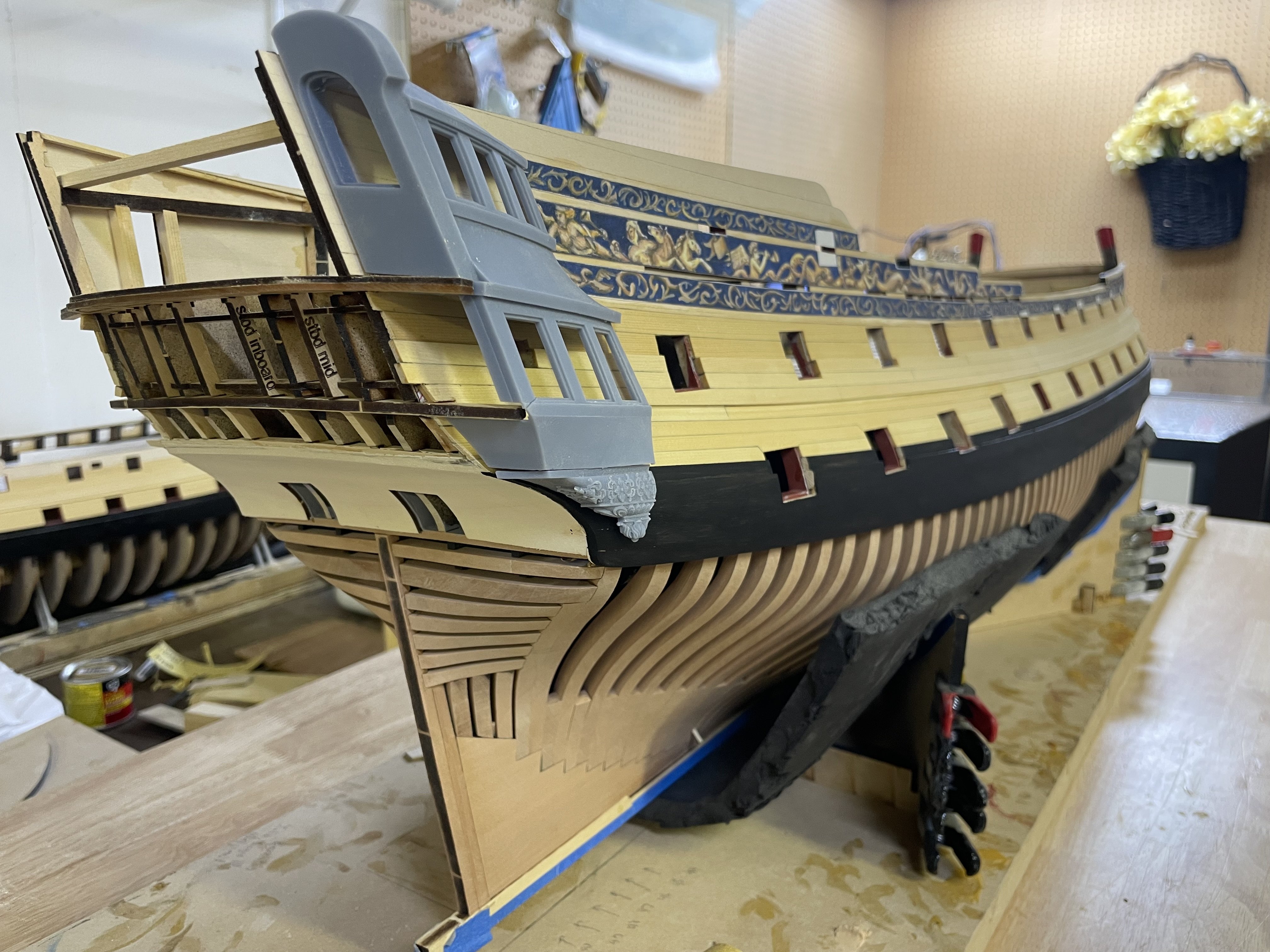

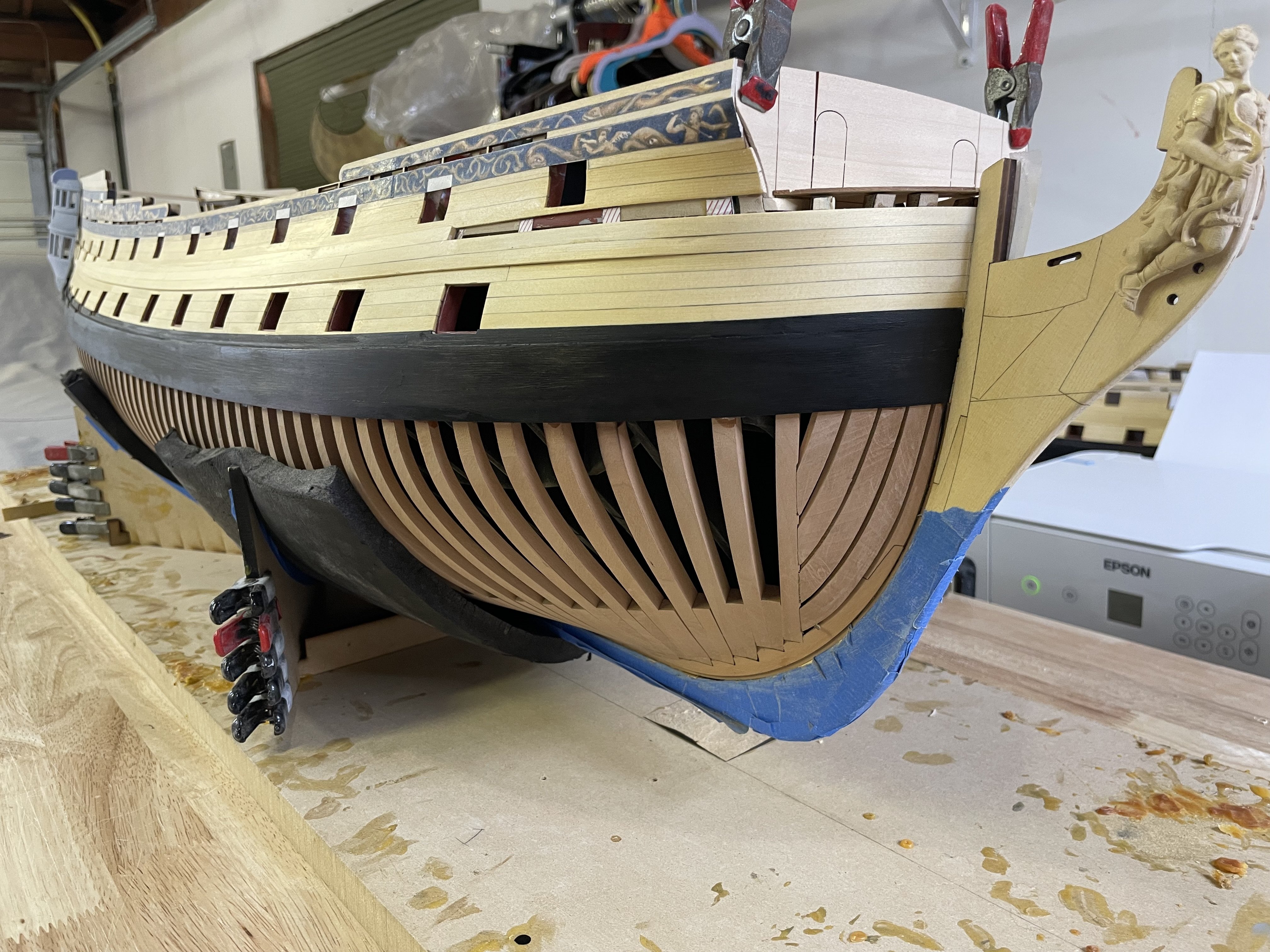

I finished up the last remaining lower planking belt before the main wale. I will start on the black strake tomorrow and finish with the main wale and 1-2 planks  below that.
Also testing one of the QG’s and the printed drop, which is actually going to be boxwood.
13 hours ago, Ronald-V said:
It looks already quite good with the 3d printed QG! Curious how it would look with the boxwood one
Thanks Ronald. So the QG itself will actually be 3D printed but you won’t be able to tell once it’s dressed up with all the exterior and interior goodies. The drop however is going to be boxwood. I should have all the stern carvings soon.

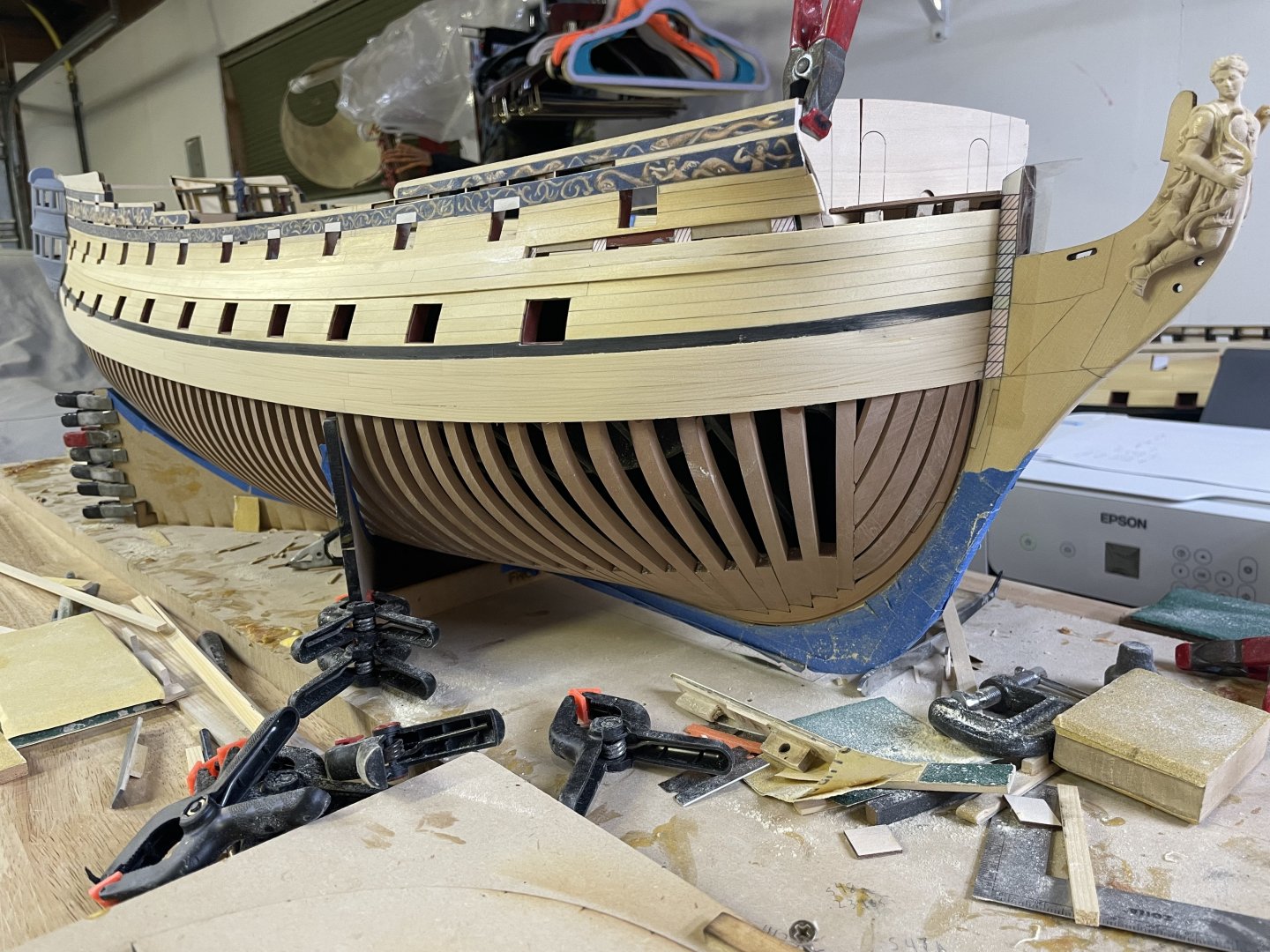

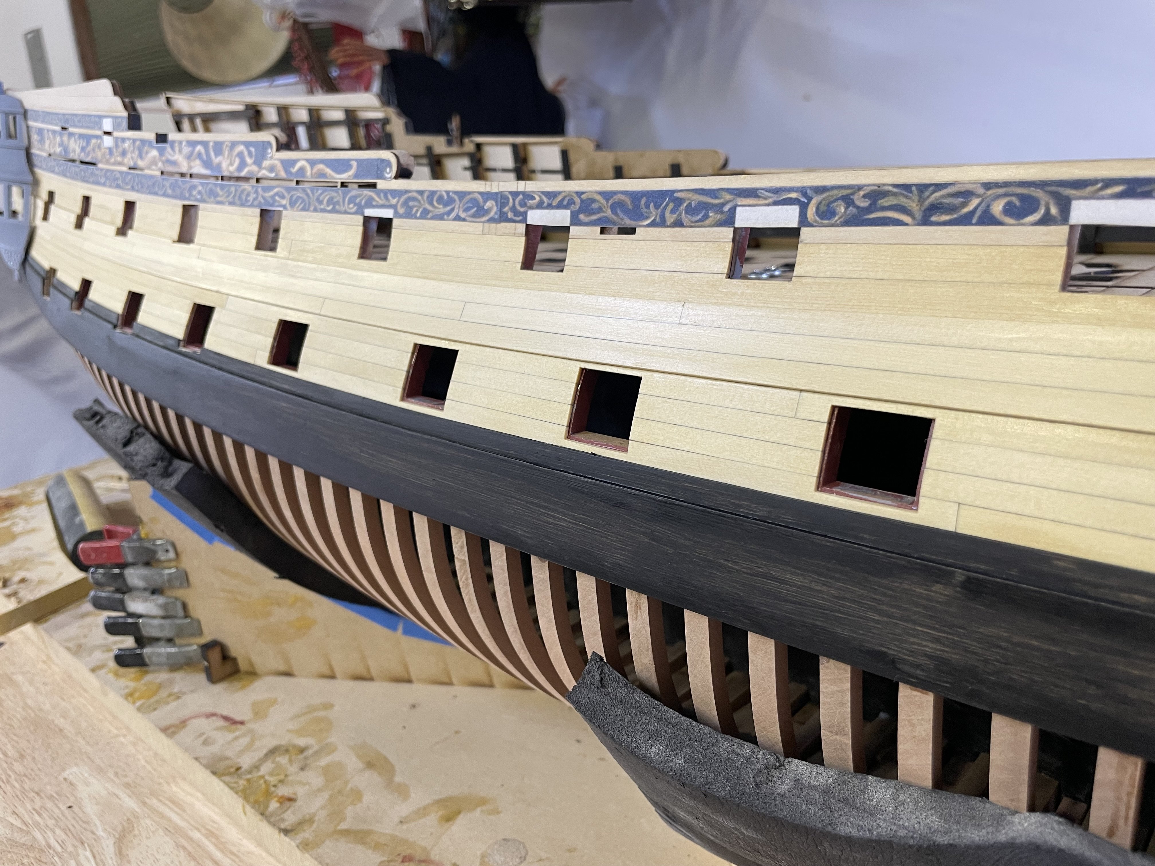

Today I finished the main wale, a huge milestone after 10 days of a nonstop planking party. Just half of the other side to go now. Once both wales are complete I can move onto finishing out the gunports with some fine tuning and another nice coat of red. I need to figure out the width of 1-2 planks below the main wale and probably 1-3 planks up from the keel, then I can finally protect all those pear frames and move onto the QG’s.
