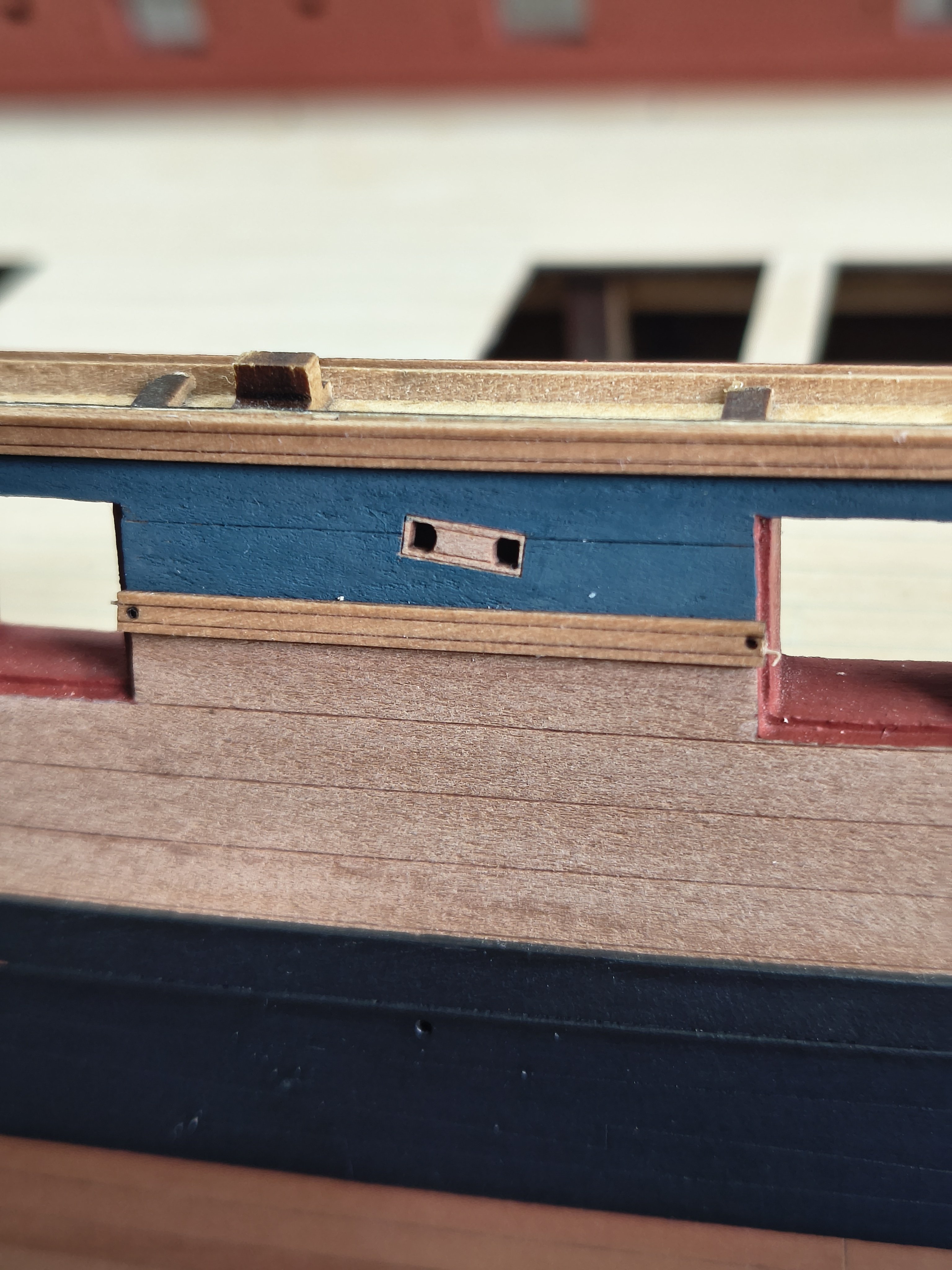

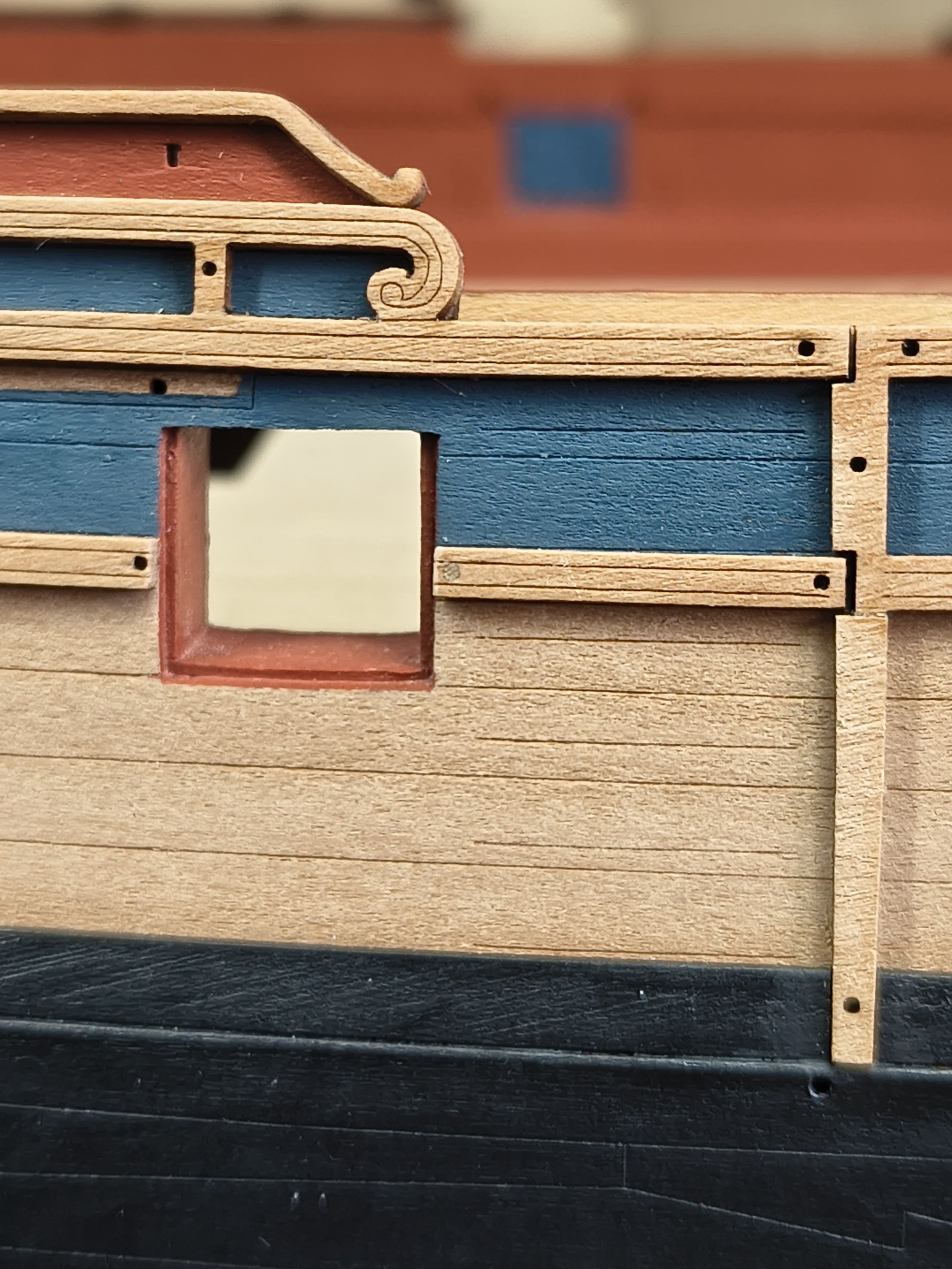

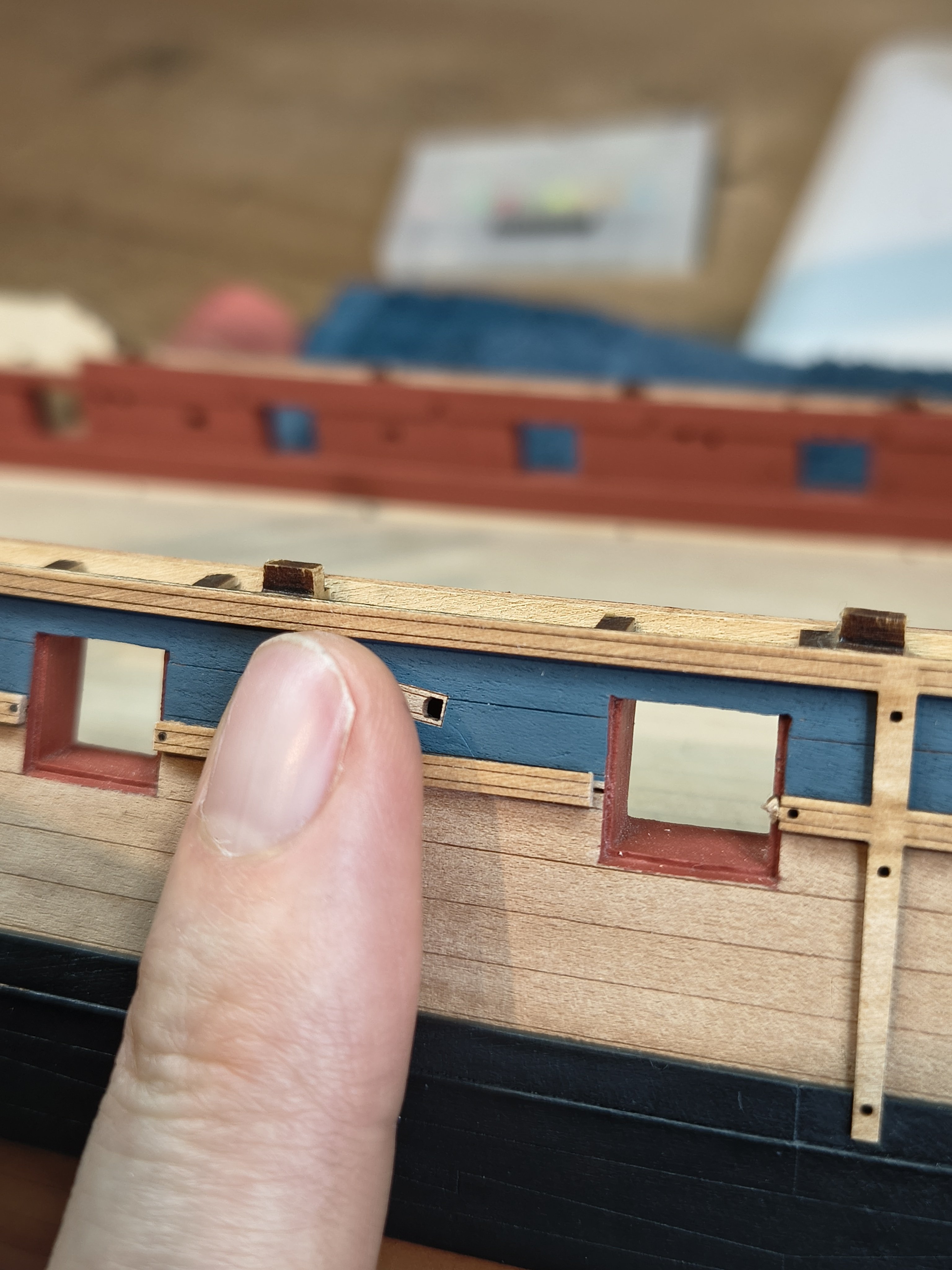

The problem I now encountered was that the holes (to center the rails) sometimes ended up exactly on the edge of the gun port as in the example below. If I were to cut that away, a half moon would remain, which is of course not so nice.

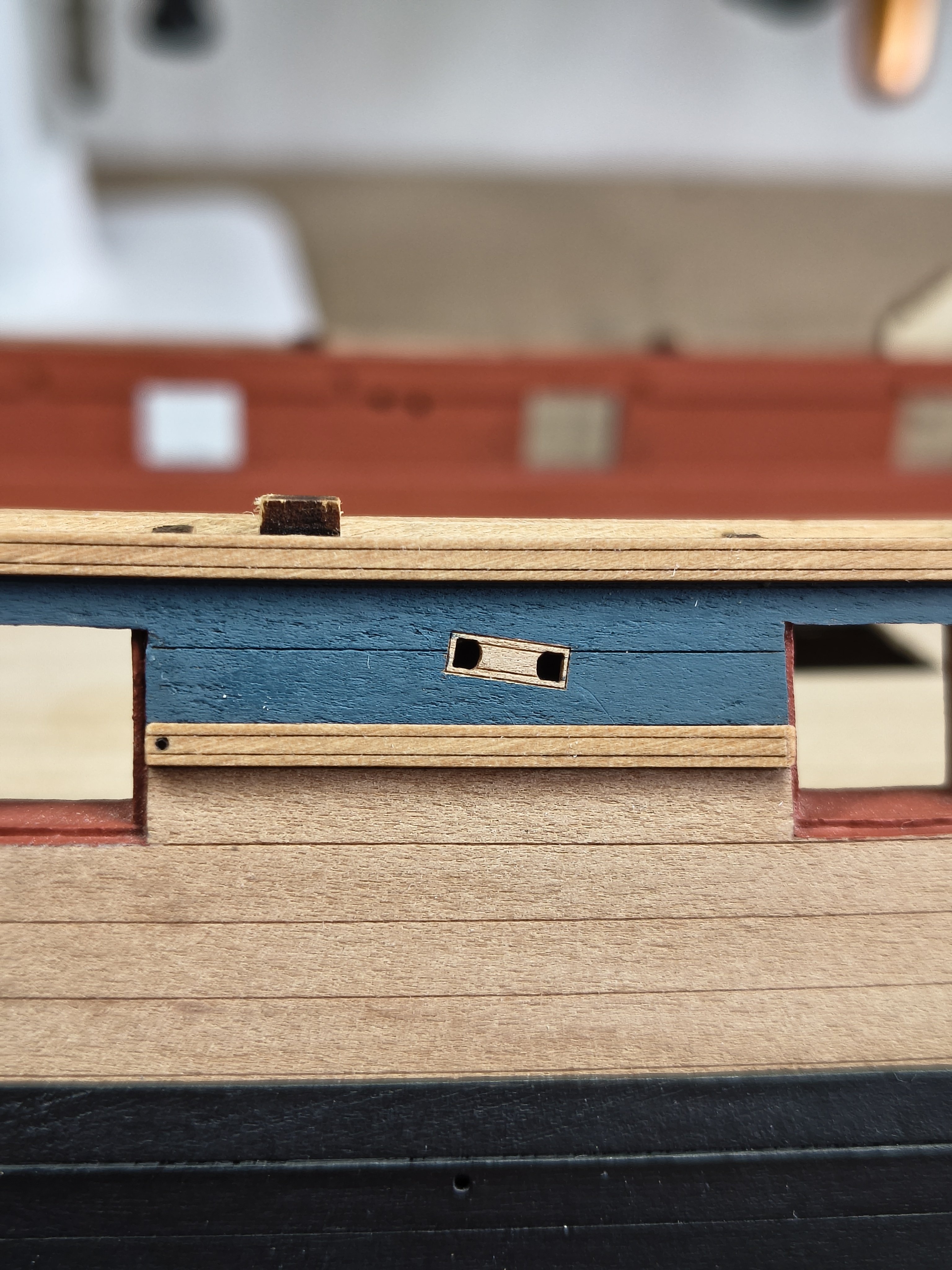

Anyway, I noticed that certain parts of the rails didn't "come out" nicely this way. So I carefully removed all the rails around the gun ports with some alcohol and adjusted them in the following order.
First sanded away the piece with the hole that would not fit well with the gun port edge.
Then glued a piece of scrap wood on top.

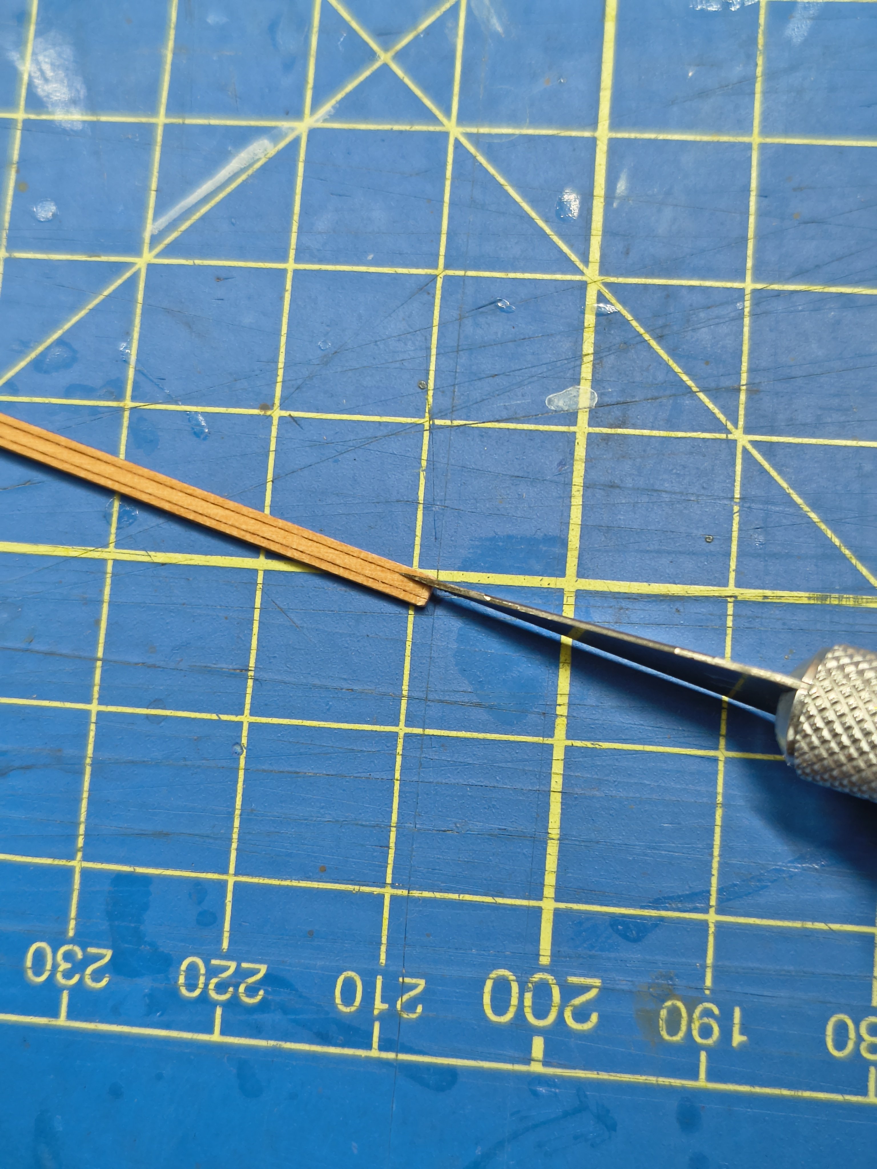

Sand it to size and score the decorative lines with a knife.
And of course a little WOP over it so that it is protected and the difference is minimal.
The decorative lines on the applied piece are not that visible in this photo, but you can see them in real life.

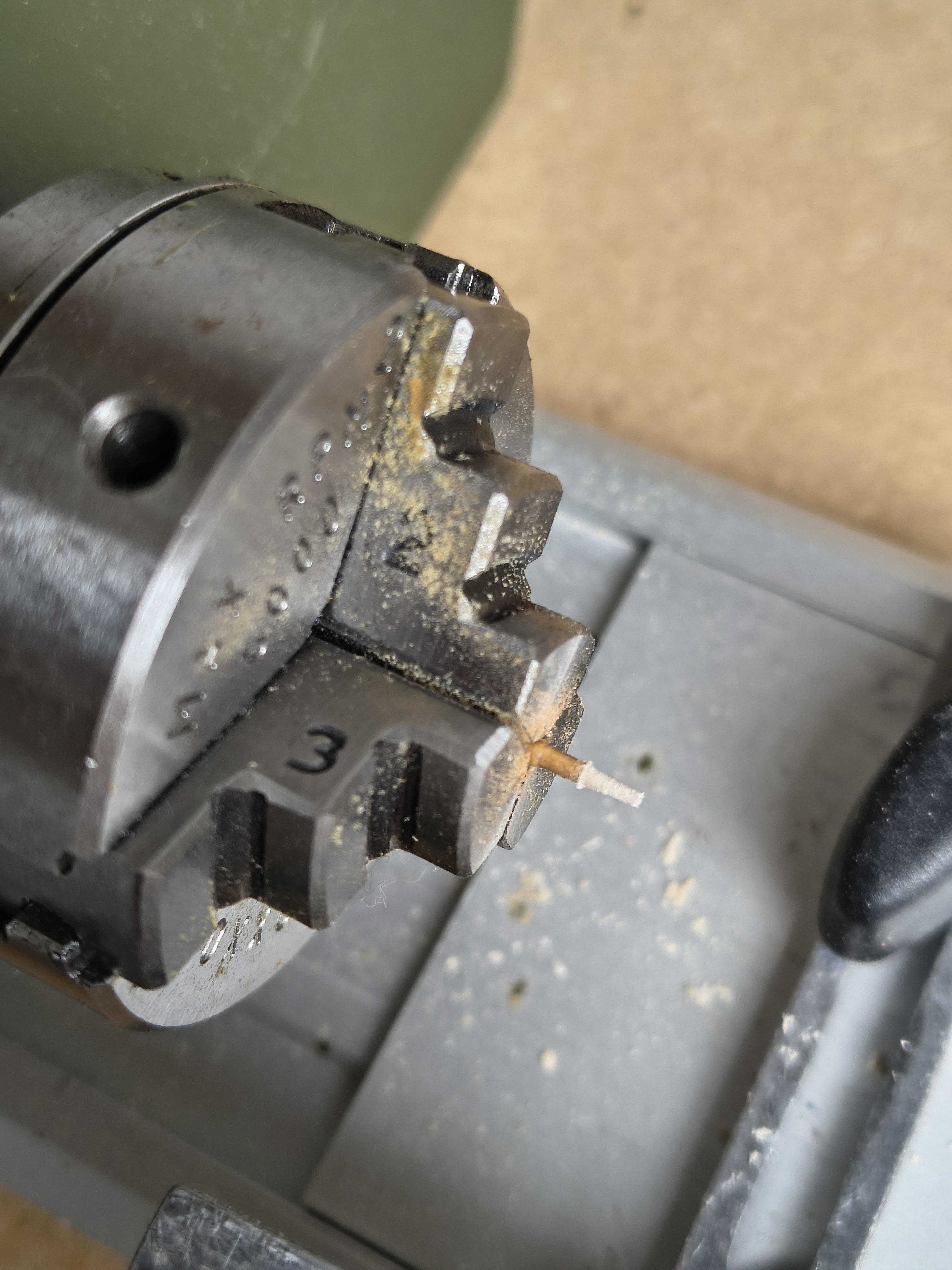

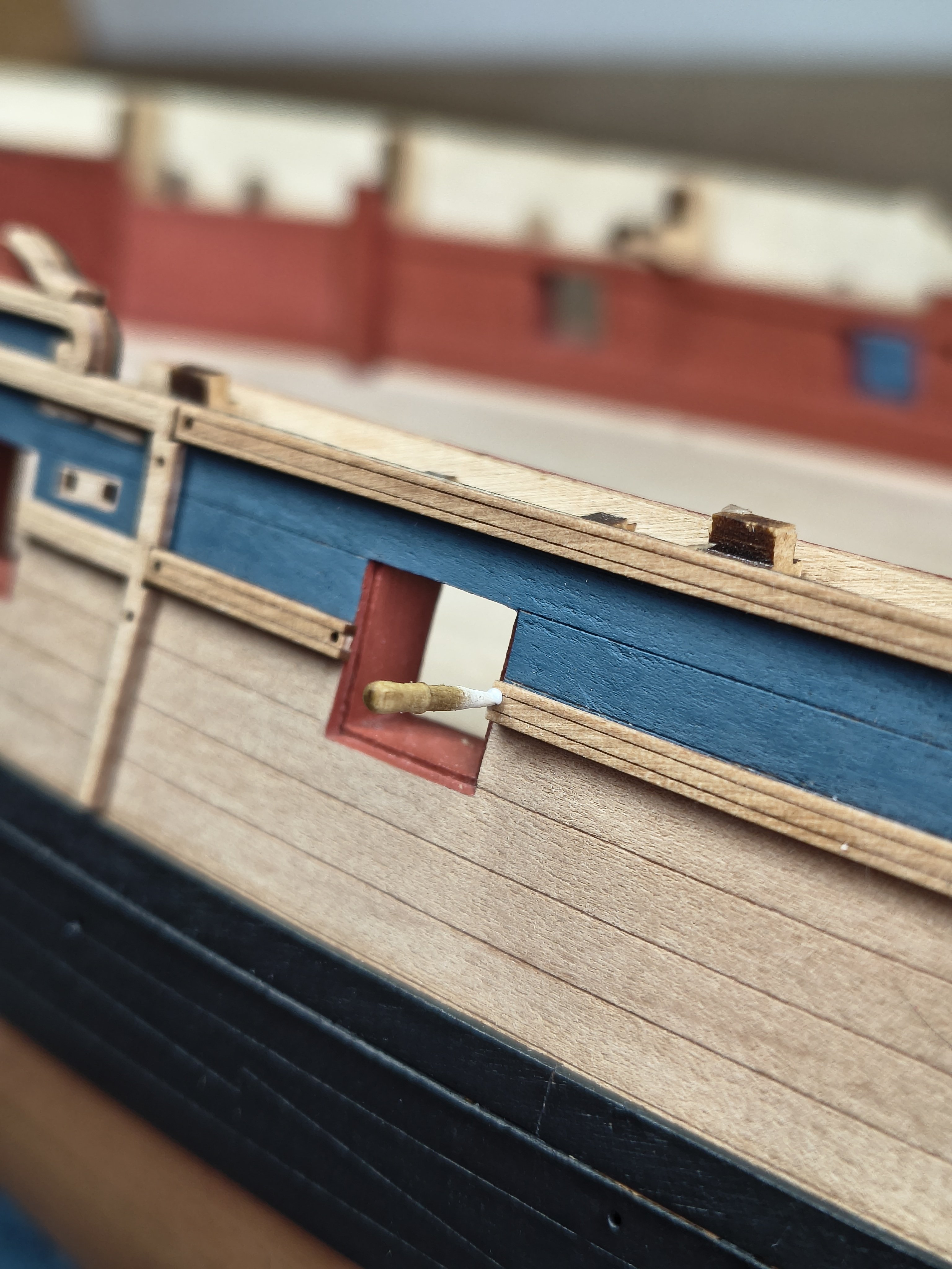

The second thing I am currently working on are all the center holes. I have to say they were great for positioning all the rails, but I personally want them to be hidden so you get a nice clean look.

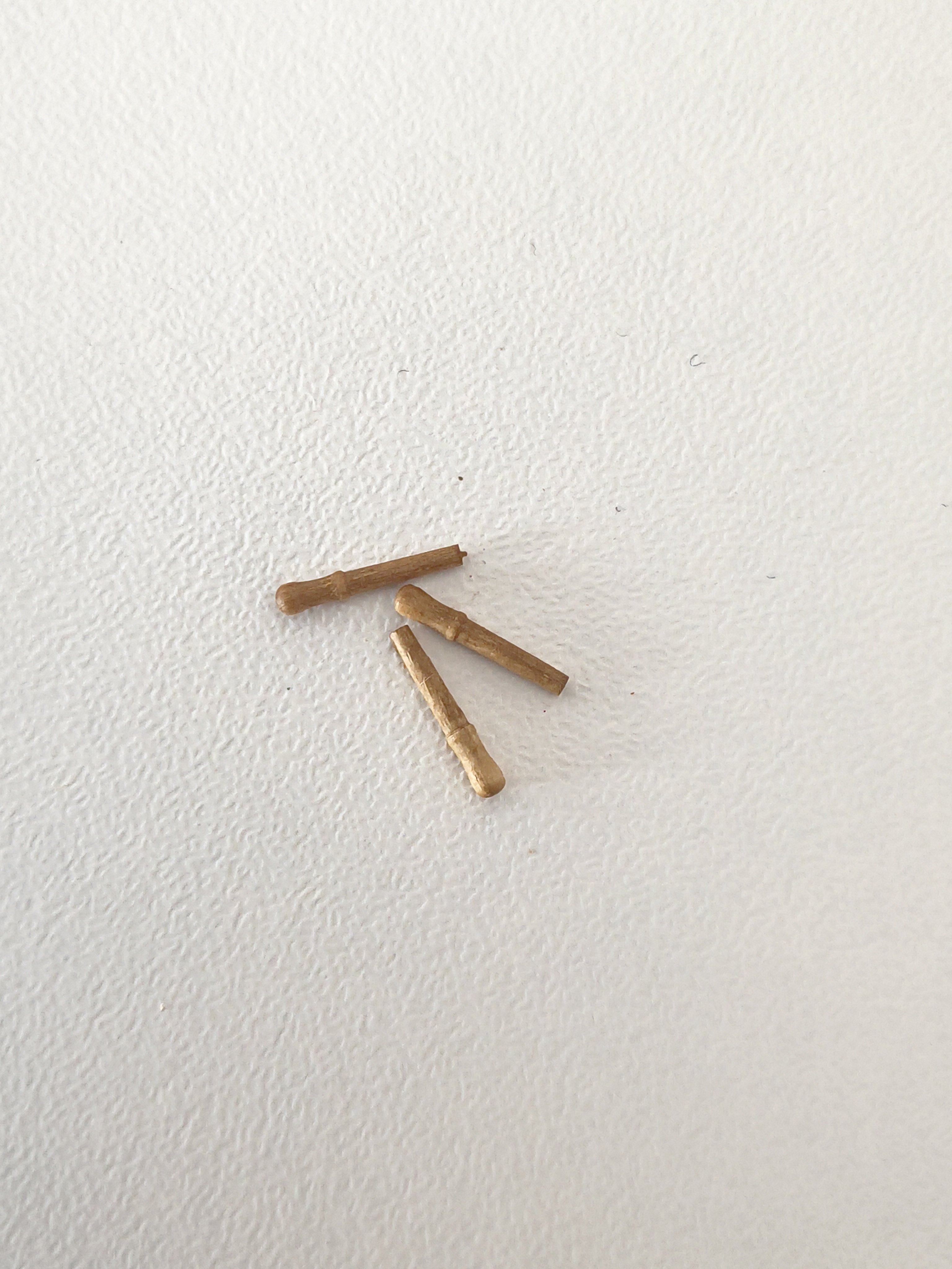

For that I am sanding down a few belaying pins on the lathe (left over from my HMS Pickle build)
I glue them into the holes with a dab of glue.
And when the glue is dry, cut it off with a knife and of course finish it with a little bit of WOP. The end result is at normal viewing distance very fine in my eyes. But still have to fill a lot of holes this way, so I'm still busy for a while. ;) :D
All in all some extra work...which of course is not necessary, because you can just leave it as it is of course. But I myself think it adds something if everything looks nice and tight and neat...plus you have even more fun with such a kit :D

Nice fix, Roland. I have found that in situations like this a wooden tooth pick works well also. Yes, they may need to be stained a little to match the wood but, as they are tapered at the ends anyway, I found them very useful for plugging holes.
Good tip! I can try that too.  I just have to see if I can get the color right with a layer of WOP, since toothpicks are a bit lighter in color I think

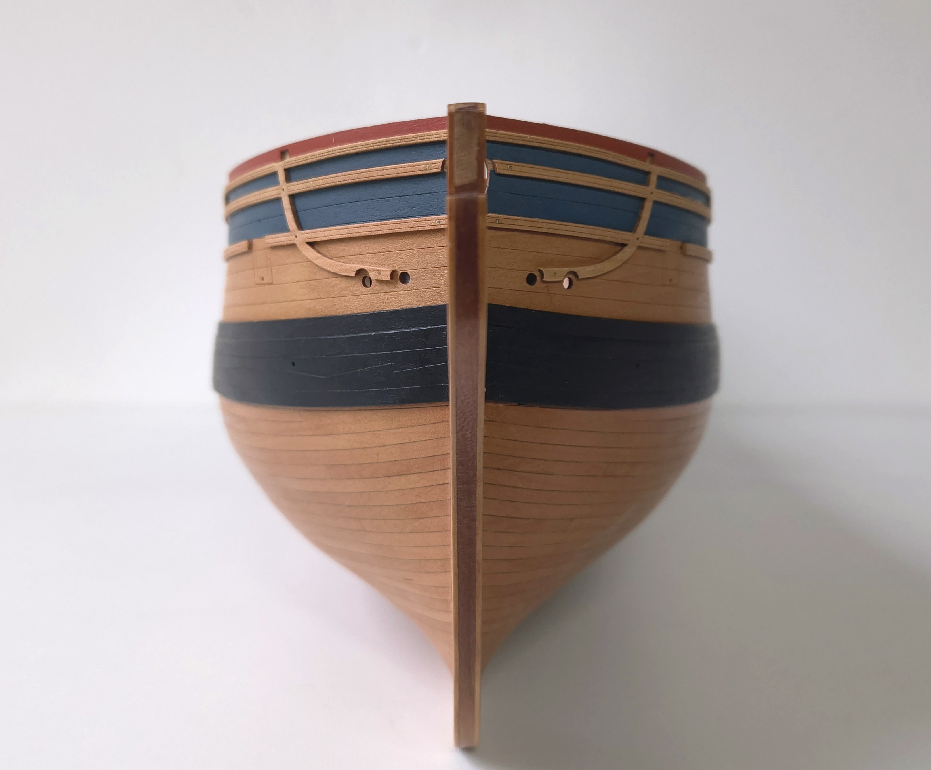

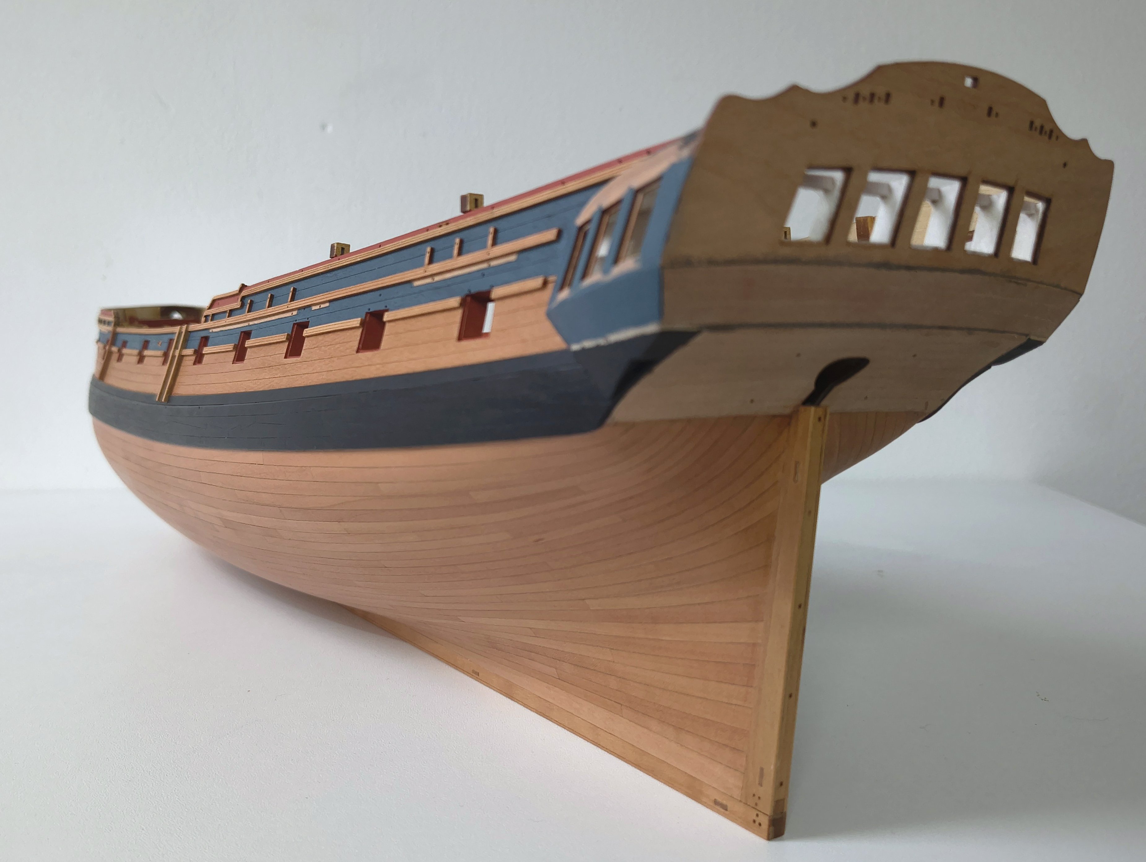

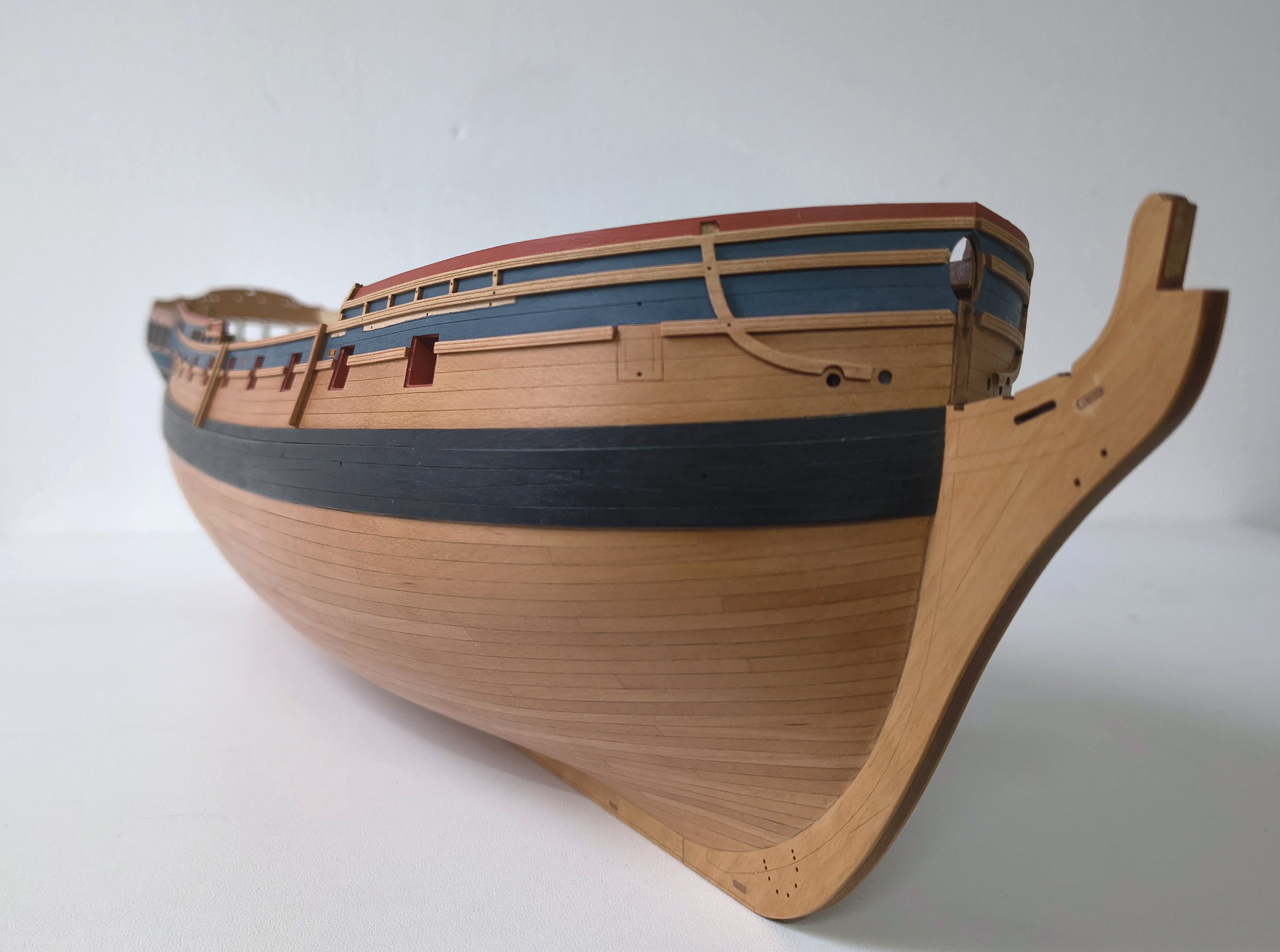

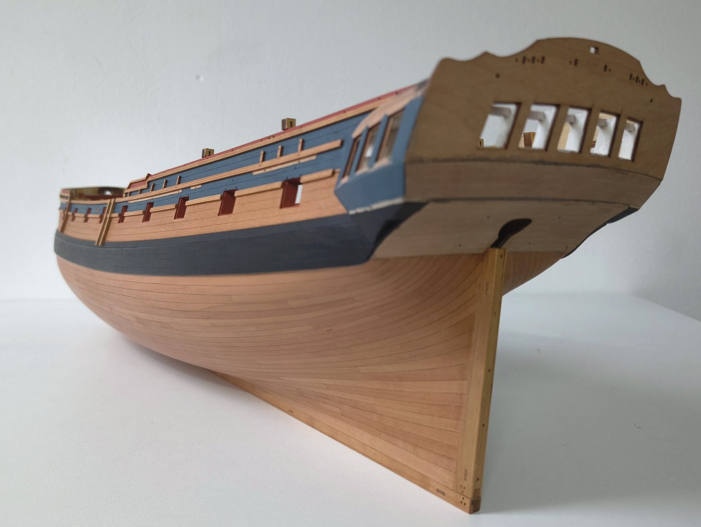

Update:
Finally all rails attached and also the top of the hull given a few layers of WOP. Now that the top and bottom are finally in the oil it looks like a nice whole.
Long awaited to put the top in the oil, so happy to reached this stage. Also filled all the holes that were in the rails, so that it looks nice and uniform.
Next job seems to be the rudder :)

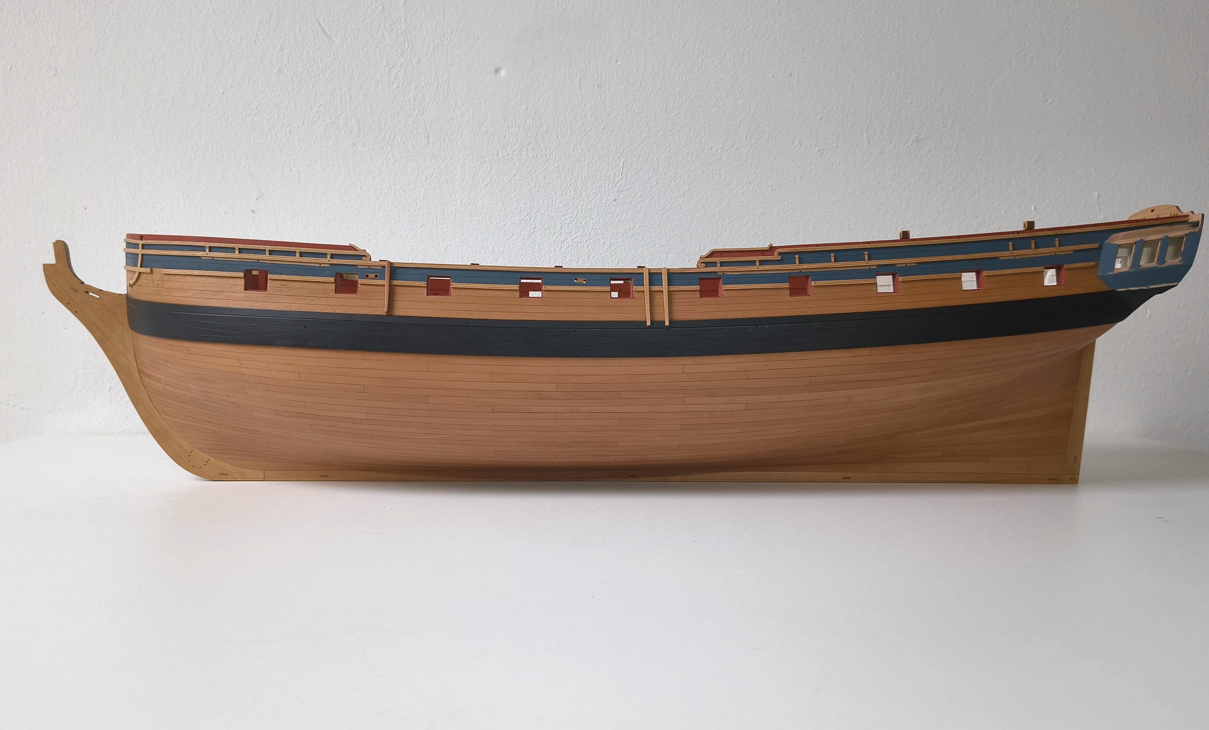

I replaced the Chess tree patterns with my own, probably sanded the originals down a bit too much when removing the char. This made them a bit too narrow
This is how the Sphinx looks now:

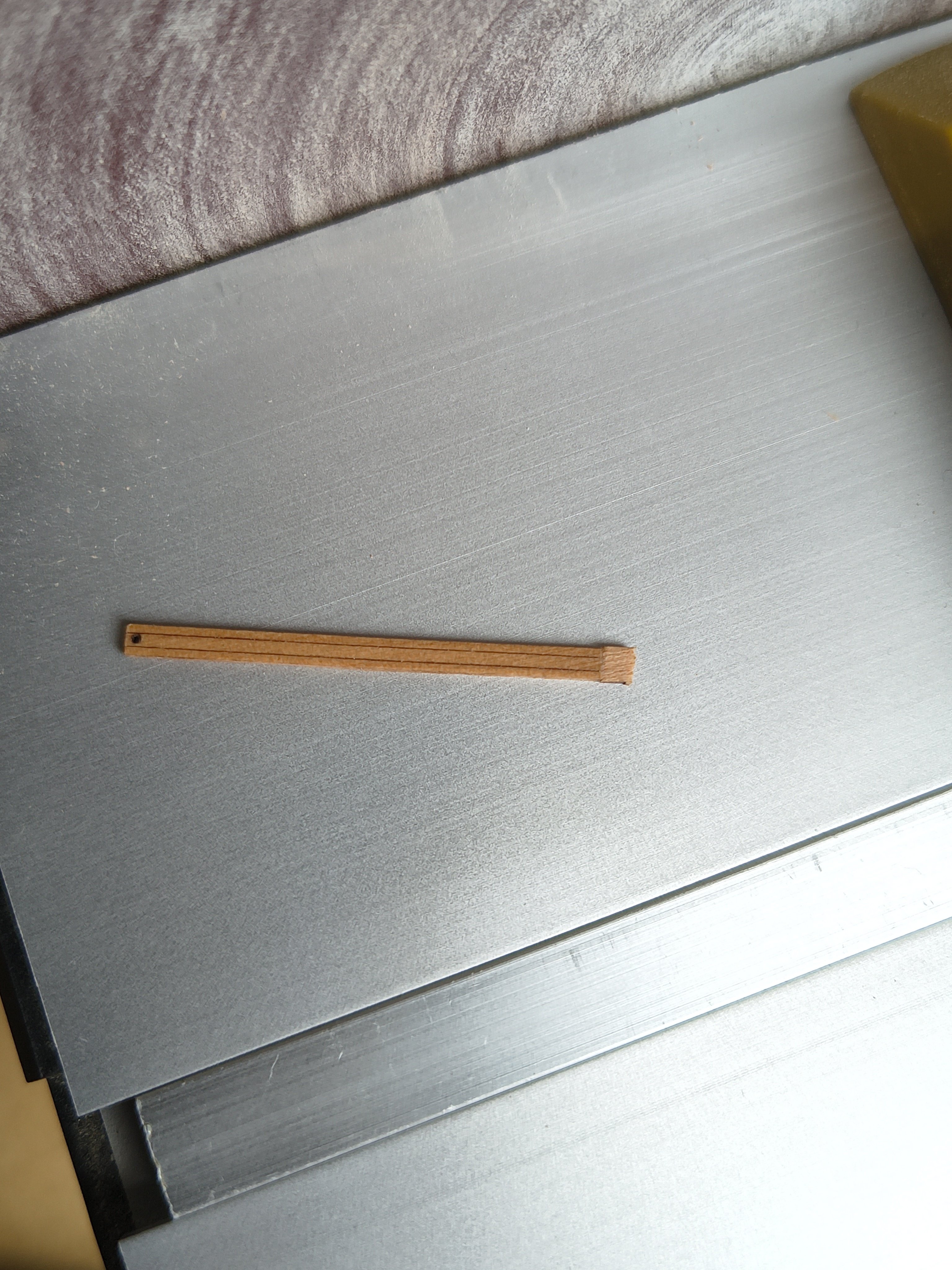

Update:
I've been working on the rudder these last few days. Below are some photos of the process.

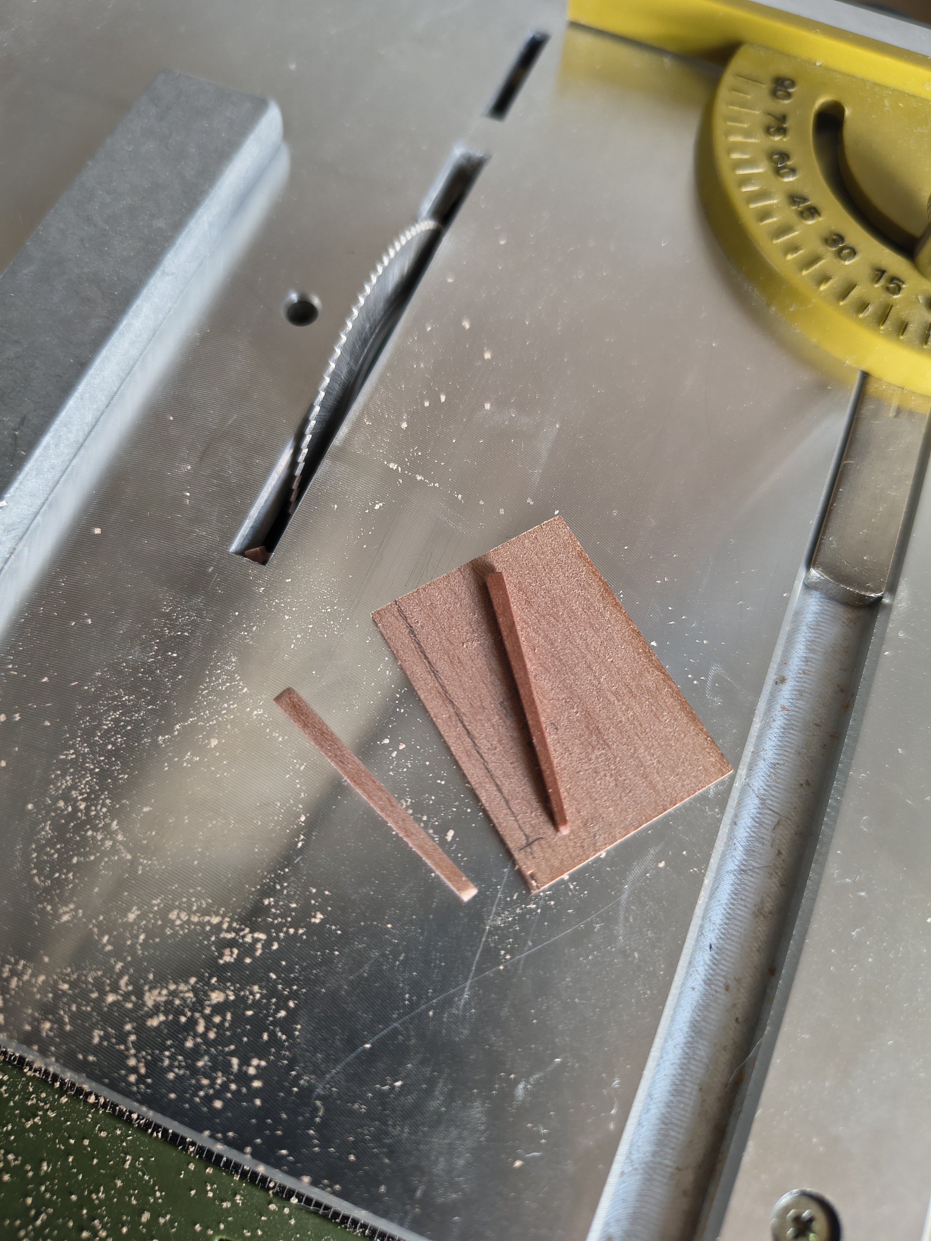

First, I lightly tapered the rudder. This was optional according to the instructions. However, the visible effect is very minimal, and you really have to look closely to see the difference. That said, it only took me 15-20 minutes to sand it that way.
The drawing of the tapered rudder, so it was quite easy to indentify what was nessecary to sand:

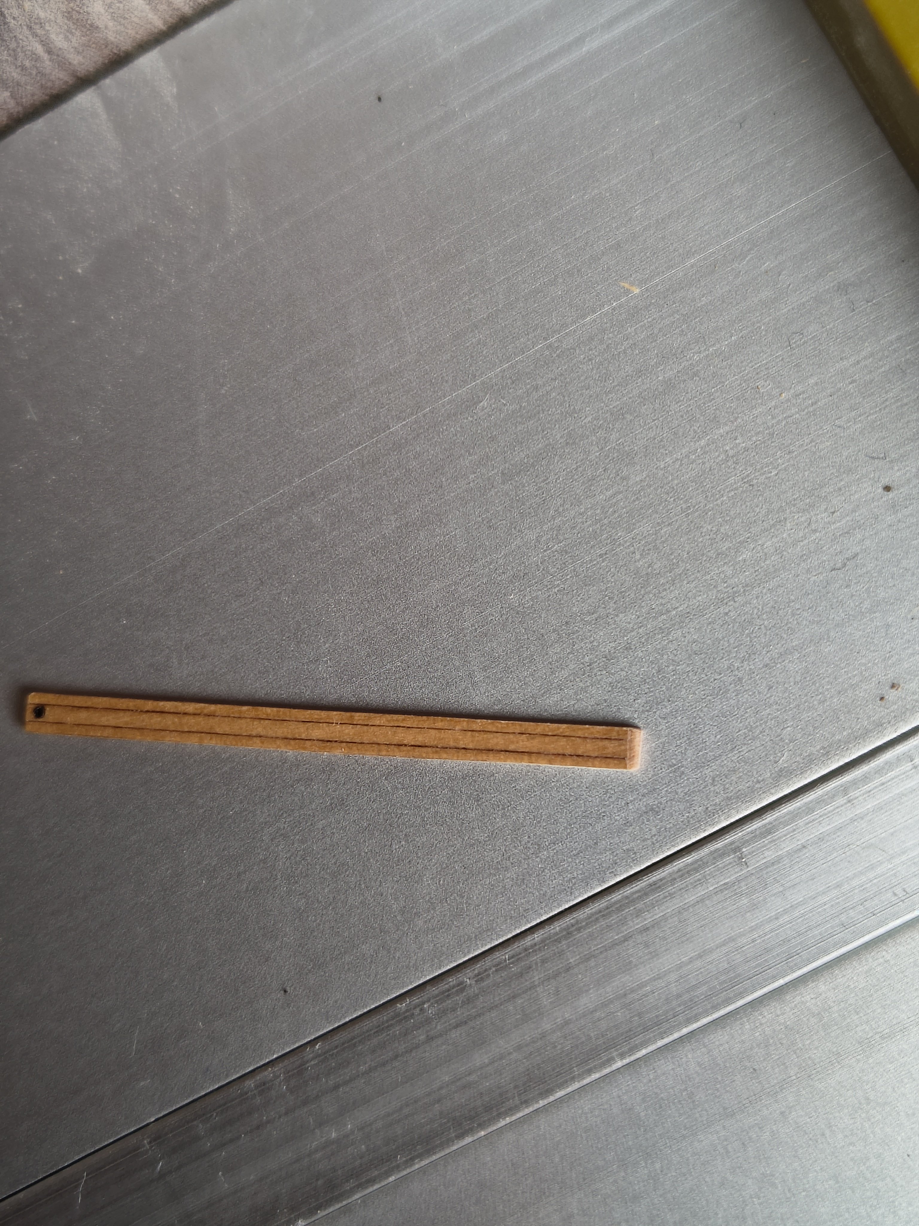

Sanding of the "inner piece"
After that I glued the two outer patterns to the inner piece so that you can see the nice engraved lines on top of it.
