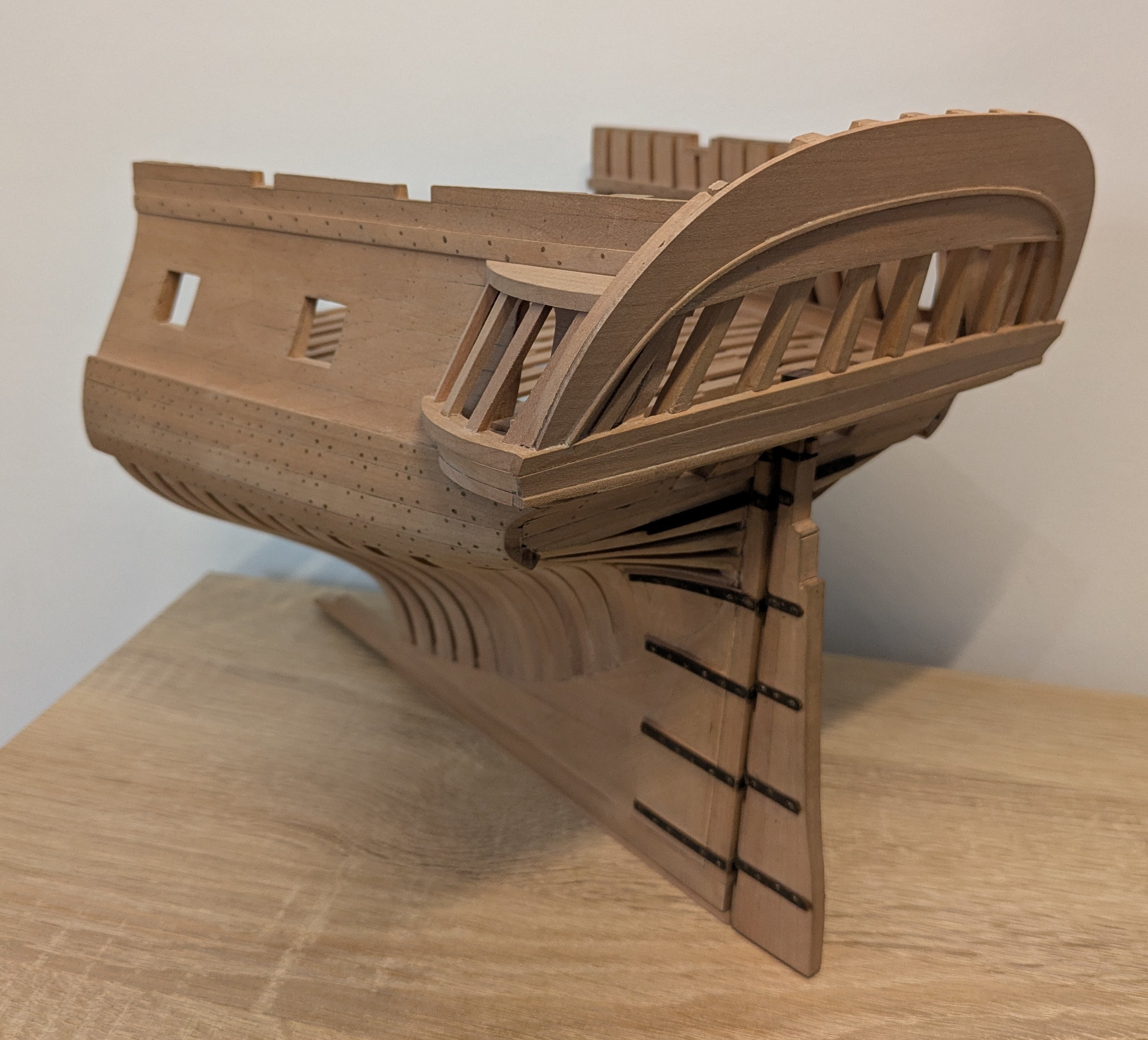

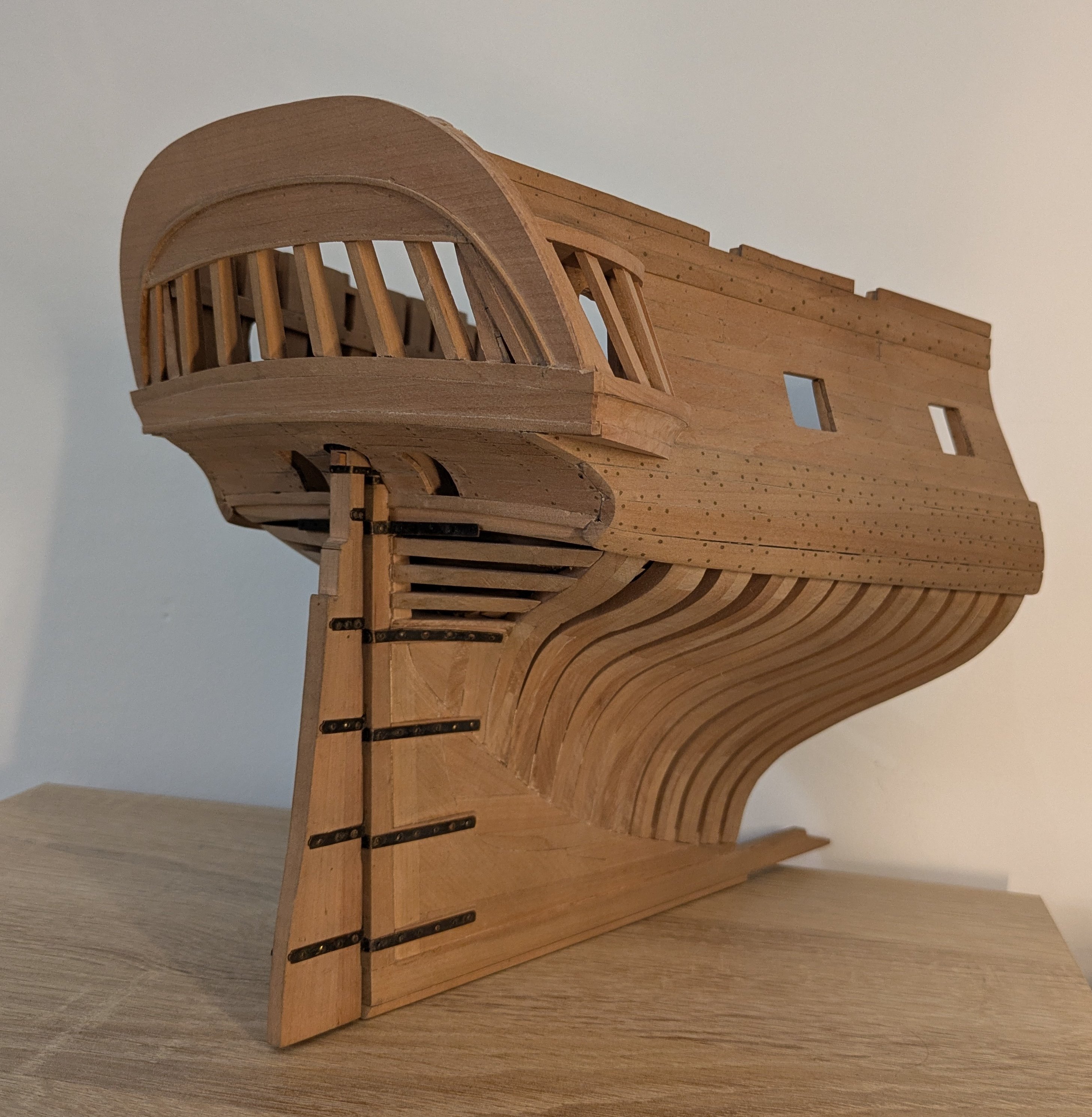

I finally got around to working on the rudder. Metalwork is something I'm very bad at, and I've been struggling a lot with the rudder hinges. In the end they turned out fine and I think the solder is strong enough so the pinion won't break off. 🤞
During the last couple of weeks I finished all the rudder hinges, they weren't easy to make but I'm happy with the result. I haven't decided what to do with the upper hinge on the stern, the rest have a piece of planking beneath them but this one has a lot of curvature so I'm not sure if it'll look good. Also, keeping in mind that the planks would go across the hinge, not along it.
By the way, the rudder turns just fine on the hinges. 😄
I've also been working on the main deck, much of what you see is only loosely attached until I install the rudder and the tiller (I'll need access below in order to seize the rigging).
After finishing the tiller I'll most likely start working on the stern and side galleries, I'm getting a bit tired of making decks so the stern deck will have to wait.

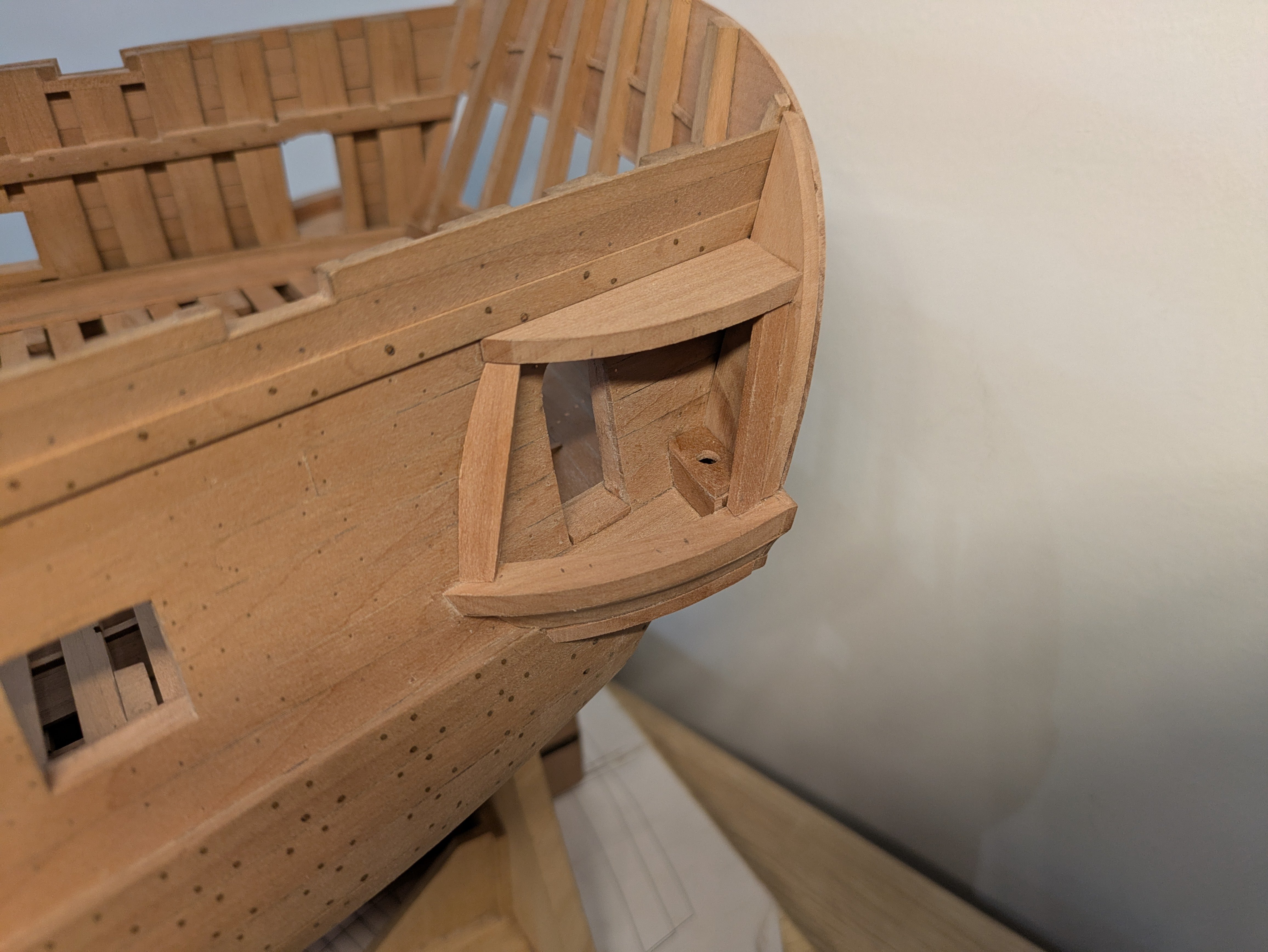

I'm continuing with the stern and side galleries. I decided to make the stern piece out of one piece only, even though on the real ship it would probably have been planked. The sheet I used has a lot of grain so it's not easy to see that it's just one piece. I just think it looks better this way.
For the side galleries, the plans are not very specific. There are only side and top views, and no indication of how it's built up. I'm building it the way I imagine it was built originally, more or less.
Almost everything will be covered by moulding strips, which I'll make much later out of boxwood.
