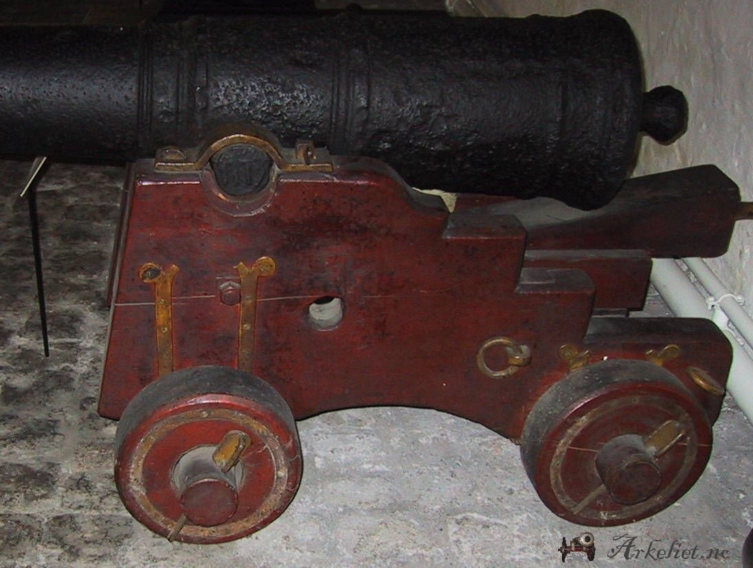

One significant difference from the English gun carriages is the arrangement of the aiming wedges, another is the color scheme.
First, the gun carriage:
There are different drawings in the archives showing an older and a newer design.
I assume that the TRE KRONER already had the newer gun carriages and that the older ones belong more to the 17th century. I cannot prove this exactly, but the transition was probably a smooth one.
Examples of both types have been preserved, which I find very helpful.

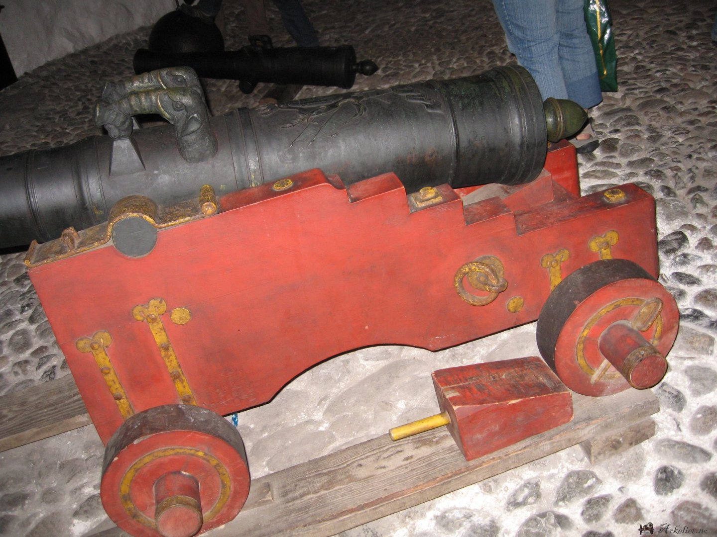

The aiming wedge on the more modern gun carriages was apparently pushed under the end of the barrel from the side in the normal setting and rested on a kind of crossbar, as can be seen in the drawings and the illustration of the cannon. Apparently, the crossbar could also be removed for particularly high settings and the wedge could be placed directly underneath from behind. The first two images in this article illustrate this nicely. From the early 17th century until around the 1820s to 1830s, the colors were largely fixed: red iron oxide for the wood and yellow to light orange munium (a mixed lead oxide) to protect the wrought iron parts from rust.

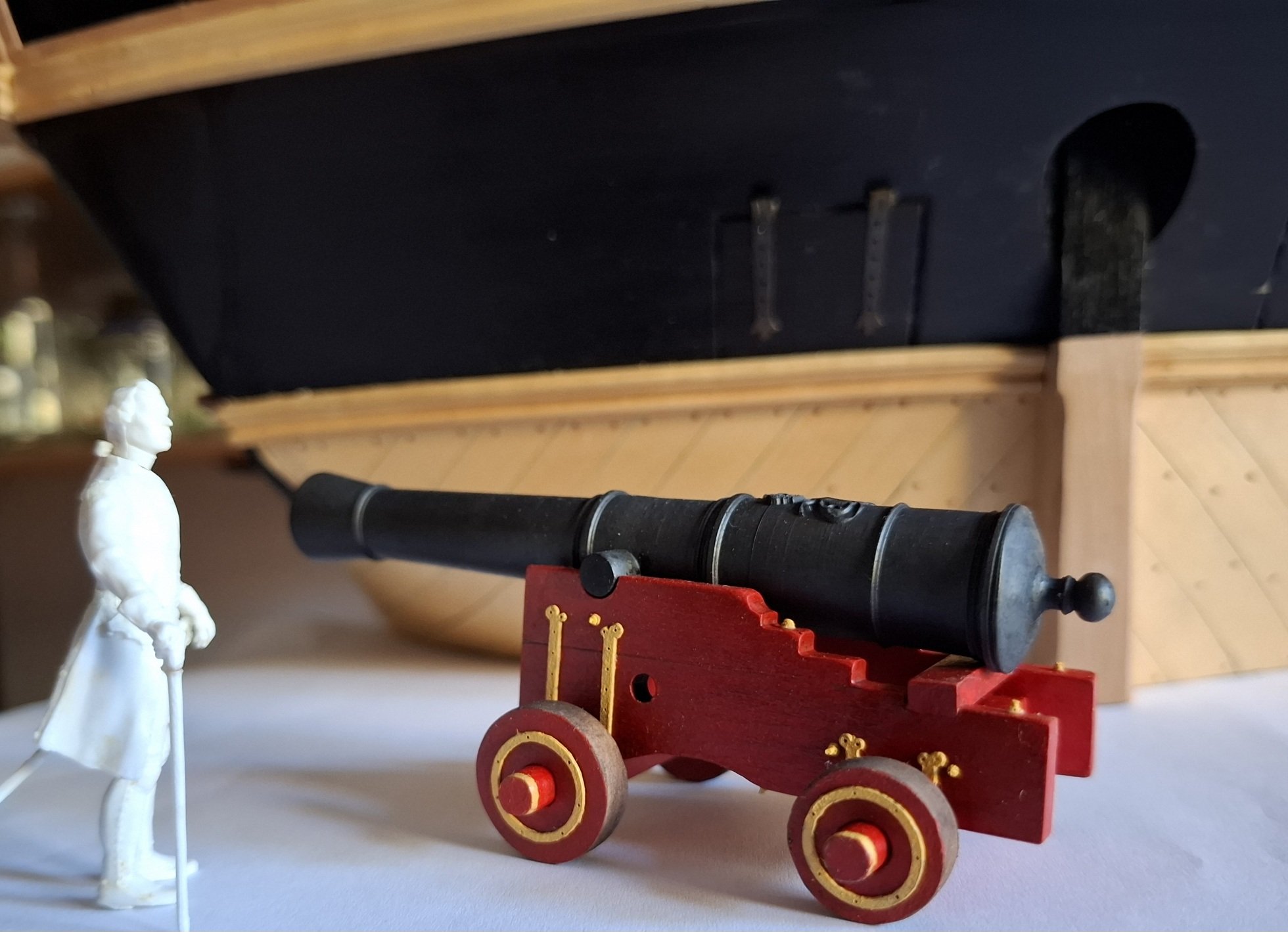

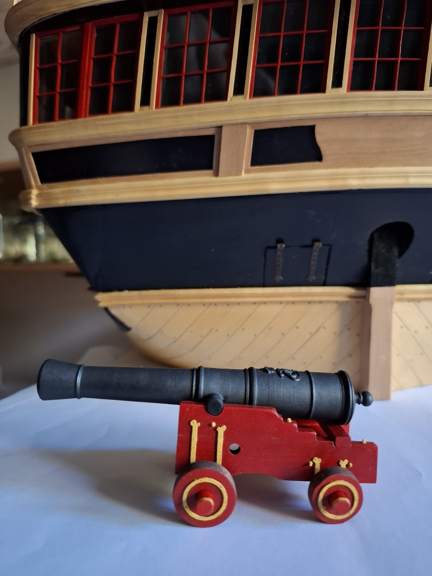

Here is a depiction of the 36-pounder gun barrel.
The TRE KRONER had 36-pounders on the lower battery deck, 18-pounders on the upper battery deck, and 8-pounders on the quarterdeck and certainly also on the forecastle.

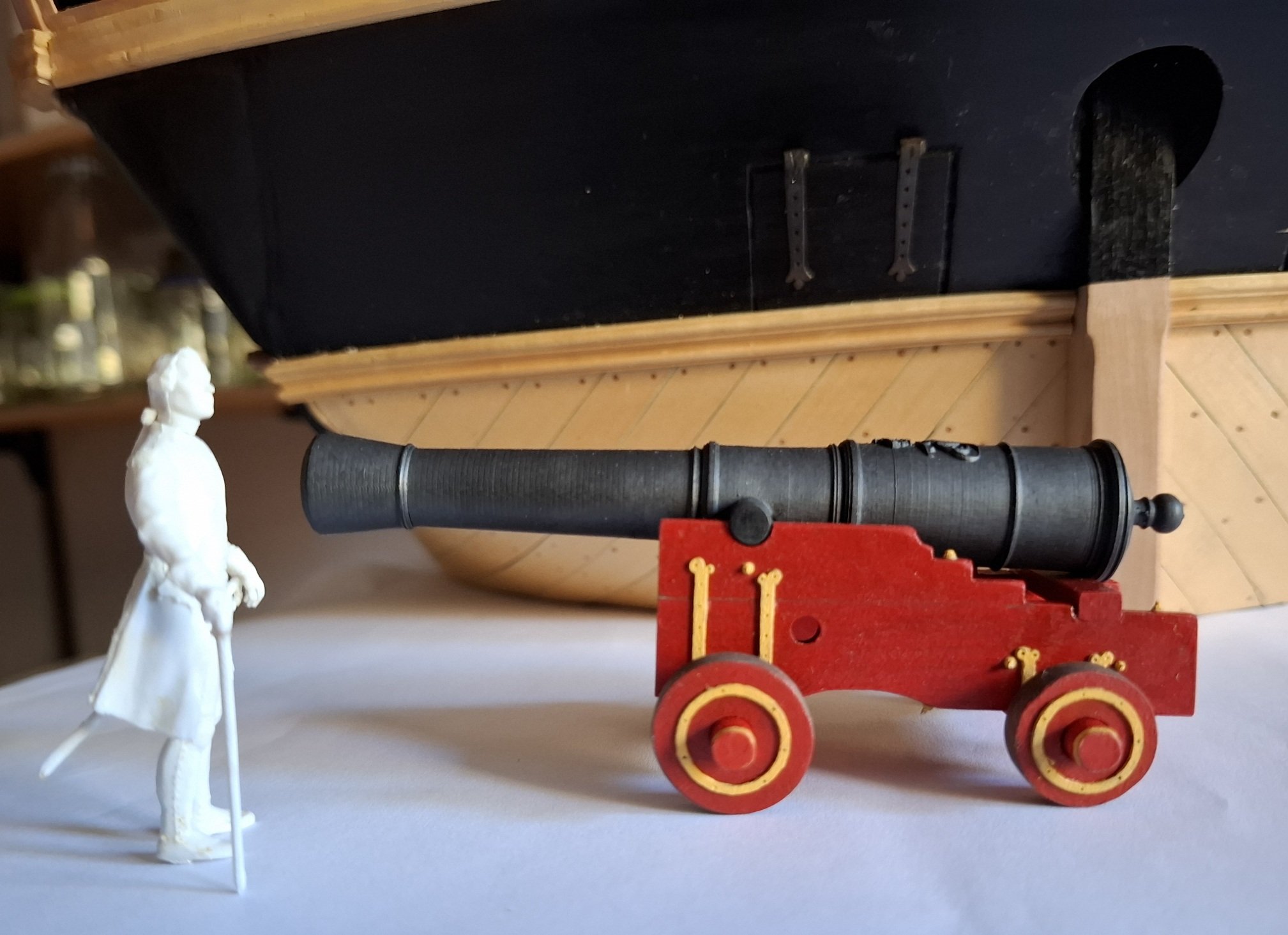

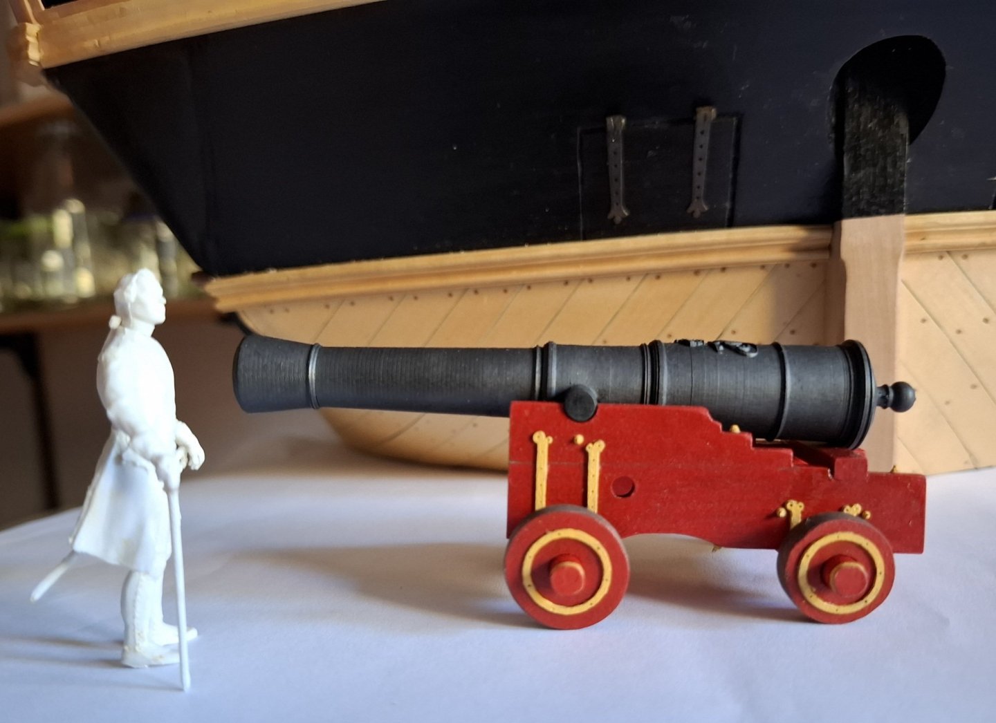

A model-building colleague from Copenhagen (TJM), who has the necessary technology, kindly printed out the artillery for me and added the monogram of Christian VI.
I drew the gun carriages accordingly and had them laser-cut from pear wood.
In addition to the installation in the stern model, I plan to build a section of the battery deck showing the arrangement of the artillery. There is a model at the NMM in Greenwich that serves as my model here.
Finally, here is a picture of the unpainted gun mounts with the gun barrels, still without fittings and wedges, which are next on the list.
I painted the gun barrels black and finished them with Tamiya aging powder (soot color).

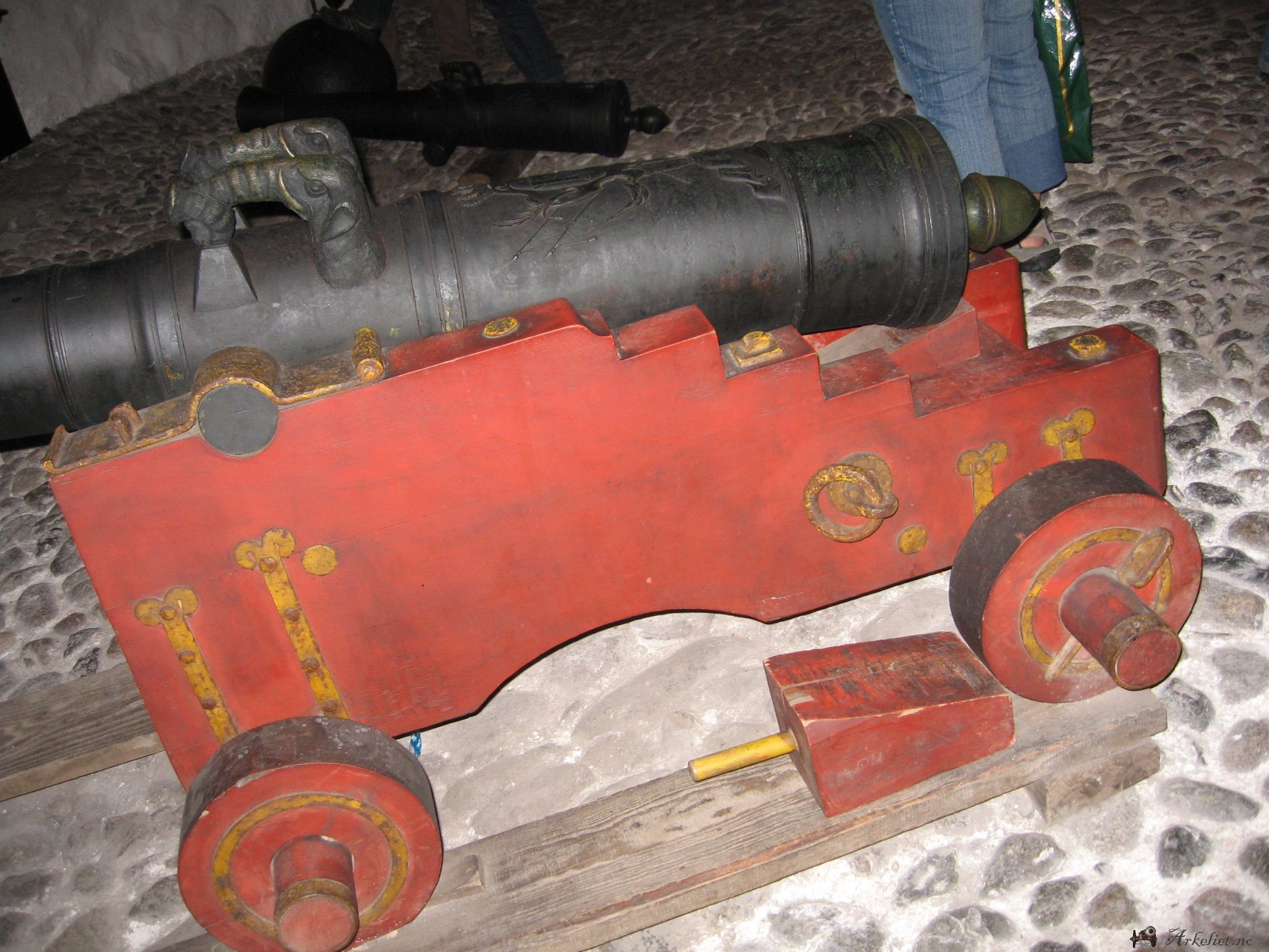

Dear fellow model builders,

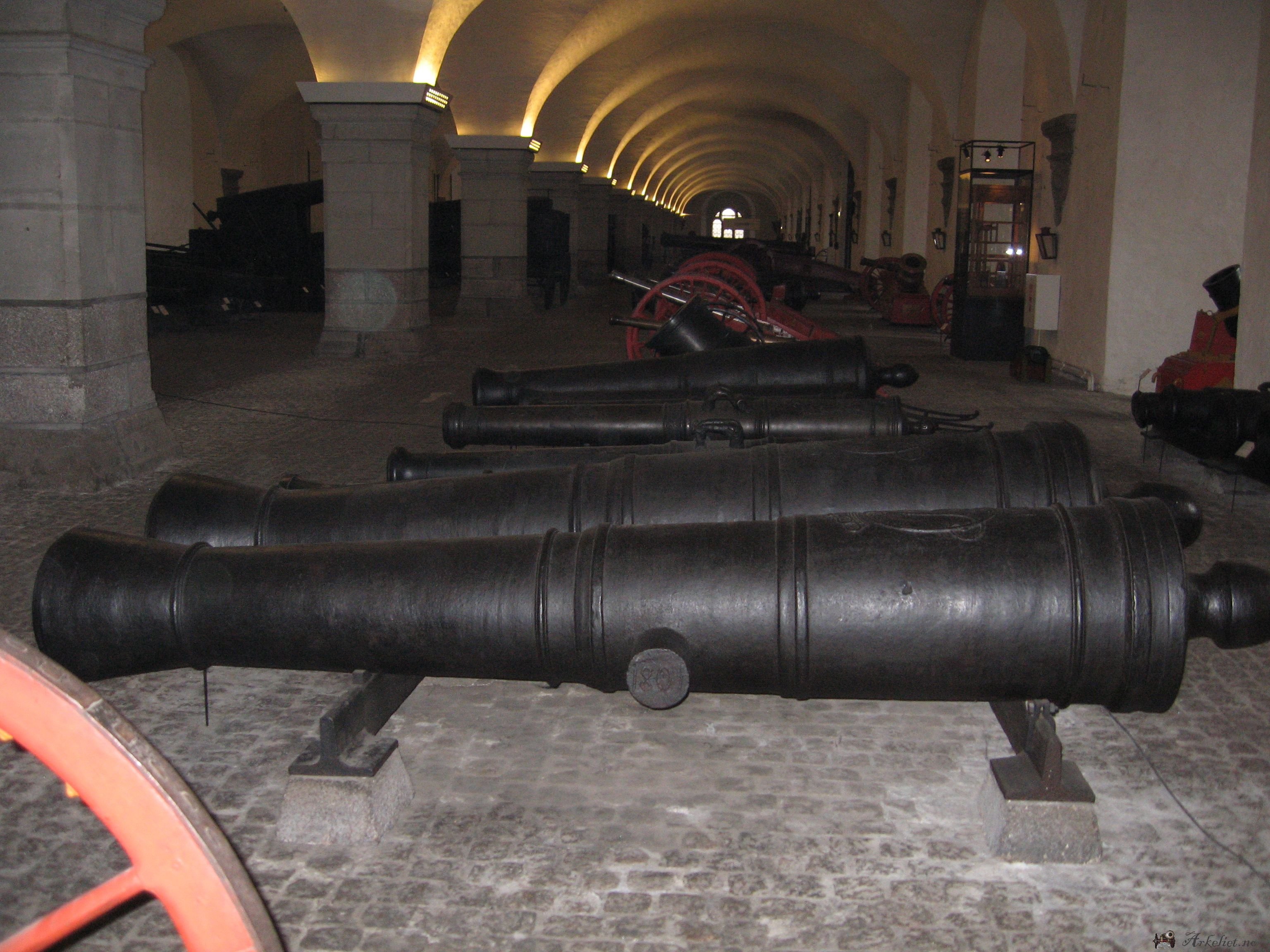

Today, just a quick update on the construction of the gun mounts, along with some more pictures of original naval guns that are now kept in Copenhagen.
And finally, a look at preserved gun barrels with, if I interpret correctly, the monogram C6. Christan VI Was Kinc of Denmark when TRE KRONER was built. Perhaps they were once on board the TRE KRONER.

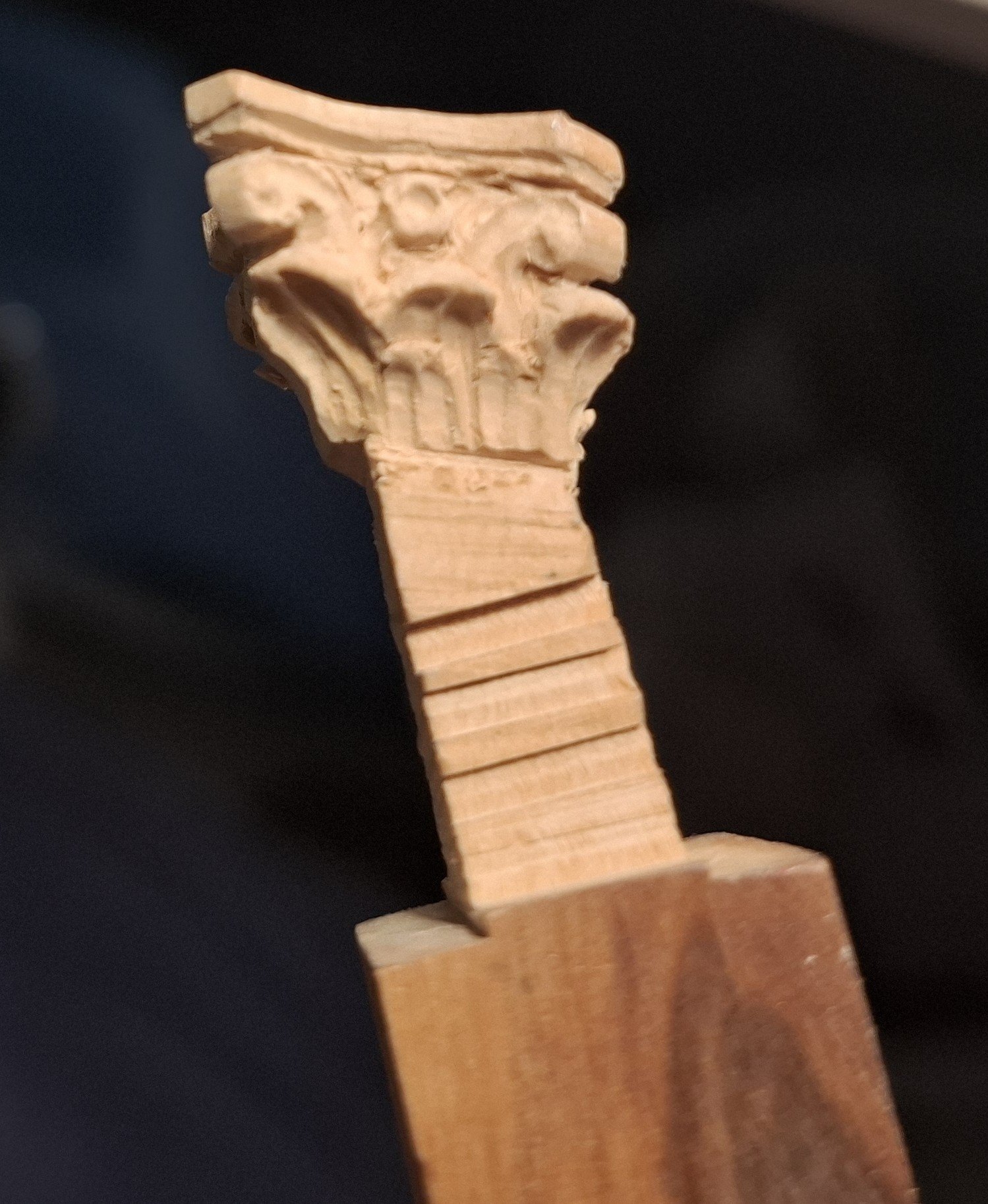

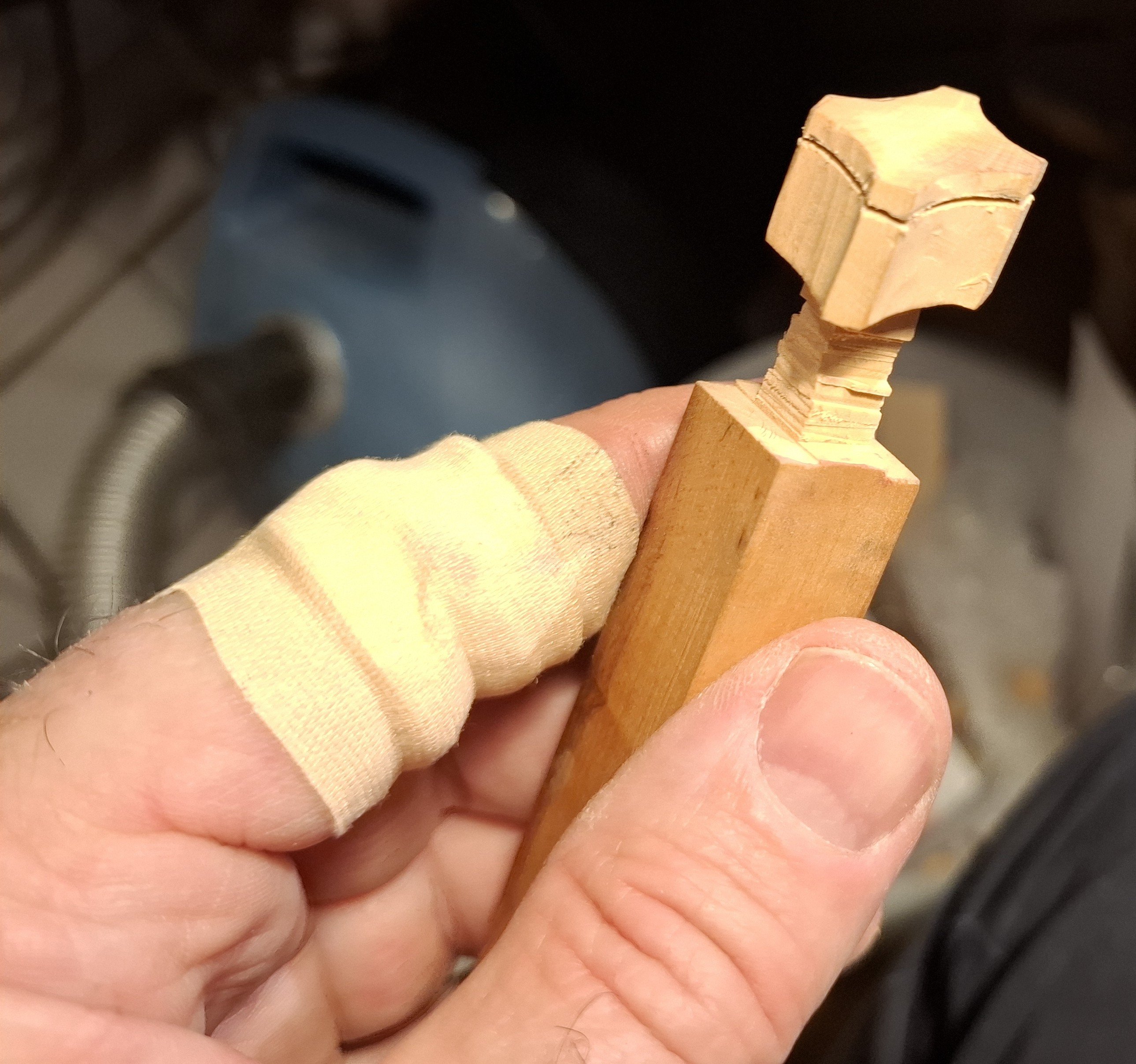

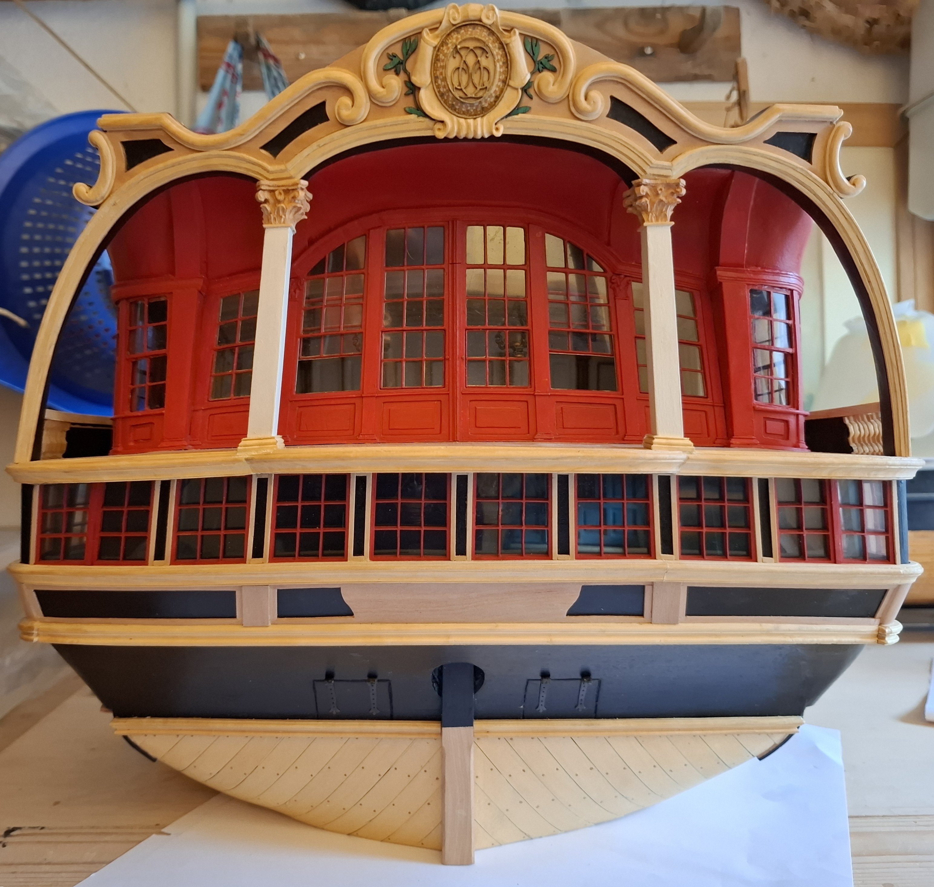

Hello everybody,
Small progress has been made; the columns supporting the transom arch, are now in place.

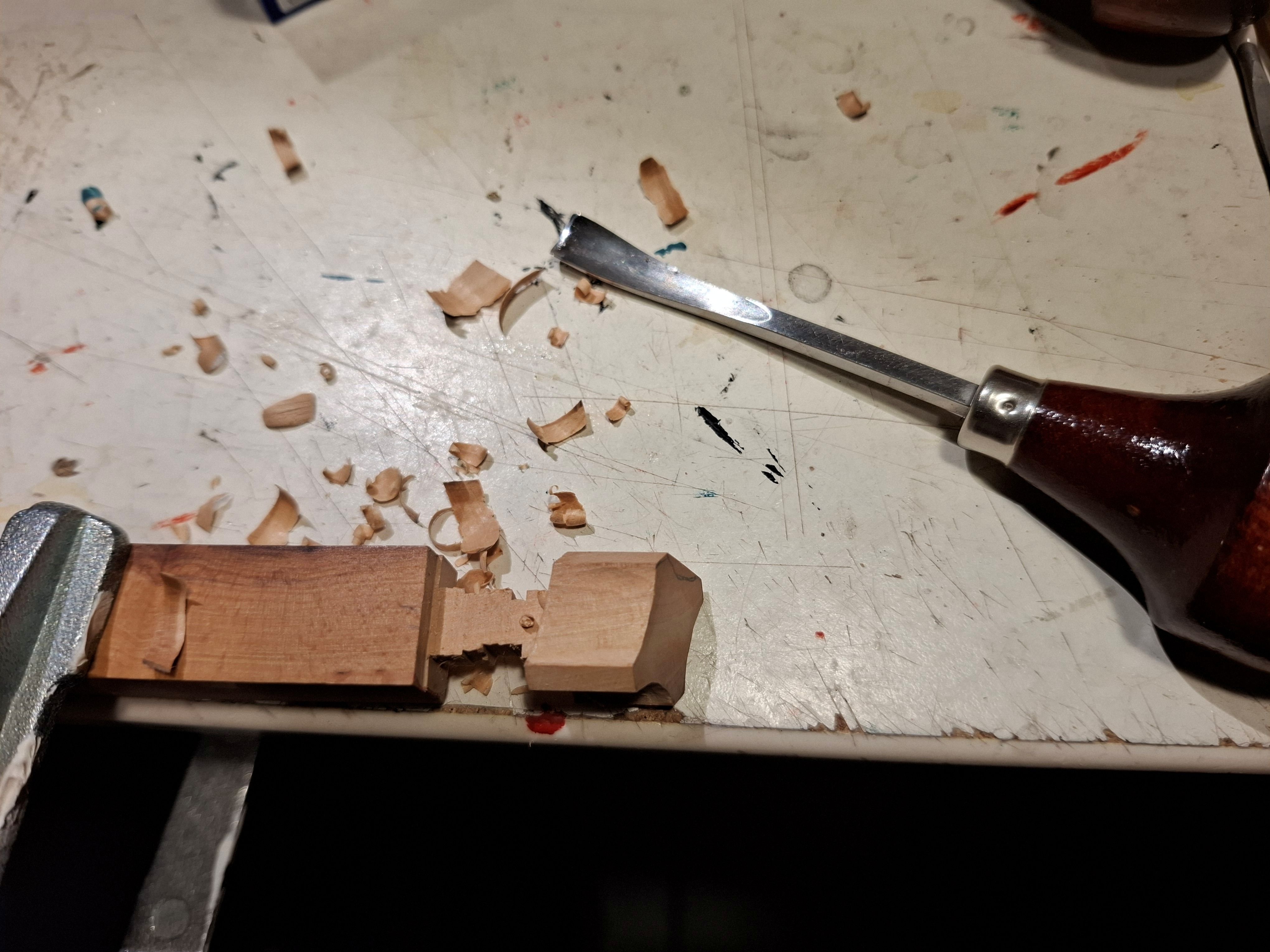

Attached are a few pictures of the corinthian capitals being made and the finished columns on the model.
The corinthian capitals are difficult; apart from the scale (they are 7x7 mm at the base), they are tilted outwards and forwards.
I'm trying to manage without the 3D specialists and their milling machines for this model. Of course, they can do this kind of thing better, but somehow you want to try it yourself. Let's see if I can keep it up until I get to the figures...

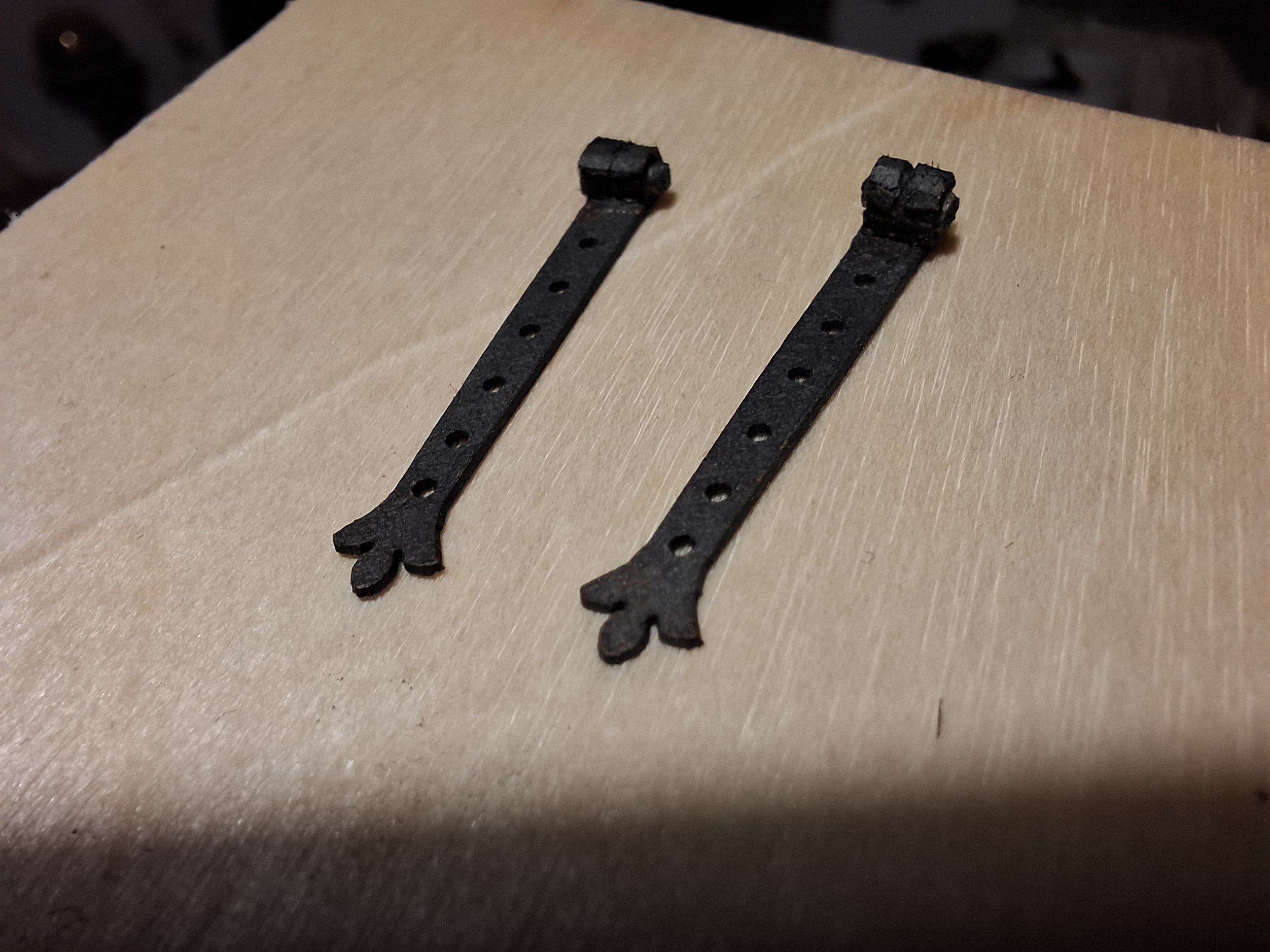

Here are my cardboard laser-cut strips for the gun port hinges. The parts were dabbed with Tamiya aging powder, color: soot.

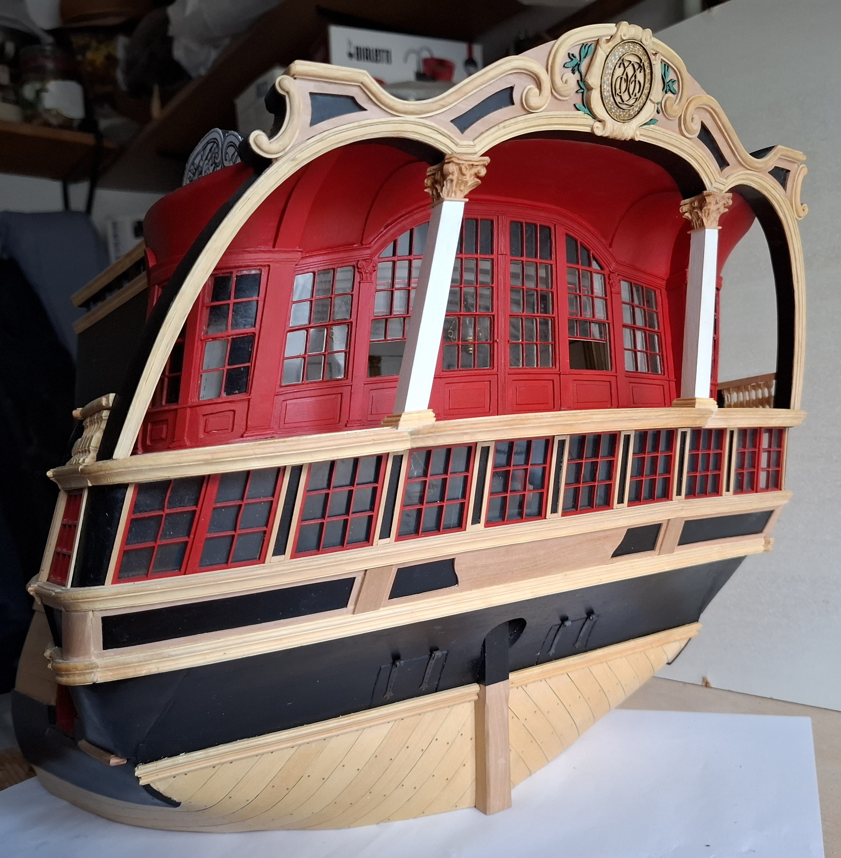

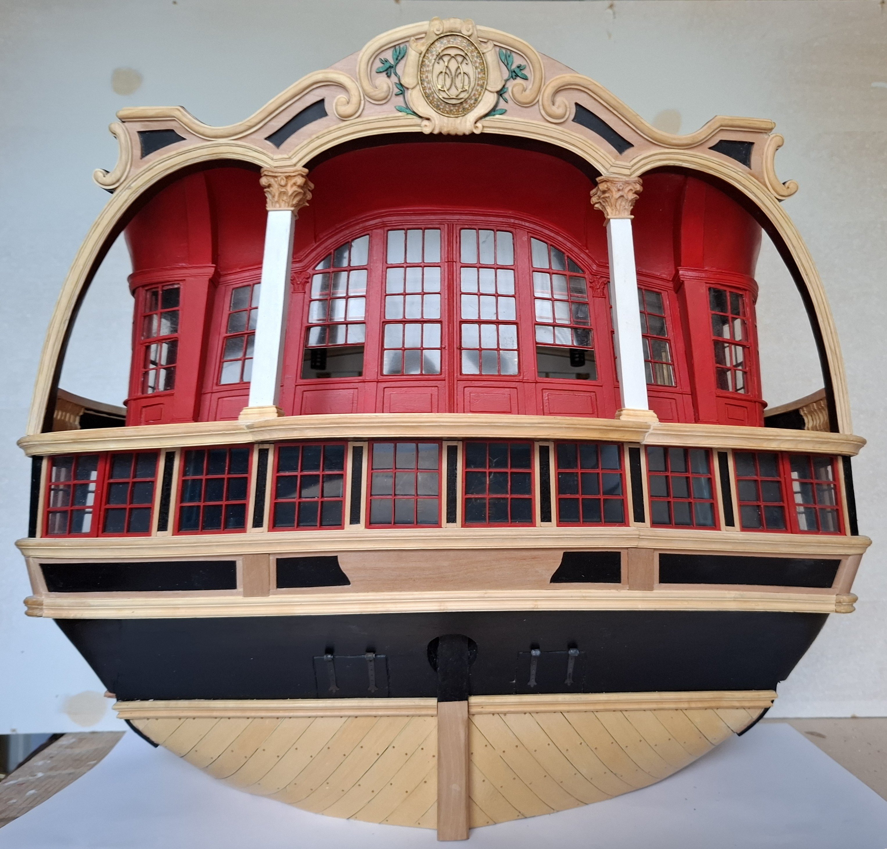

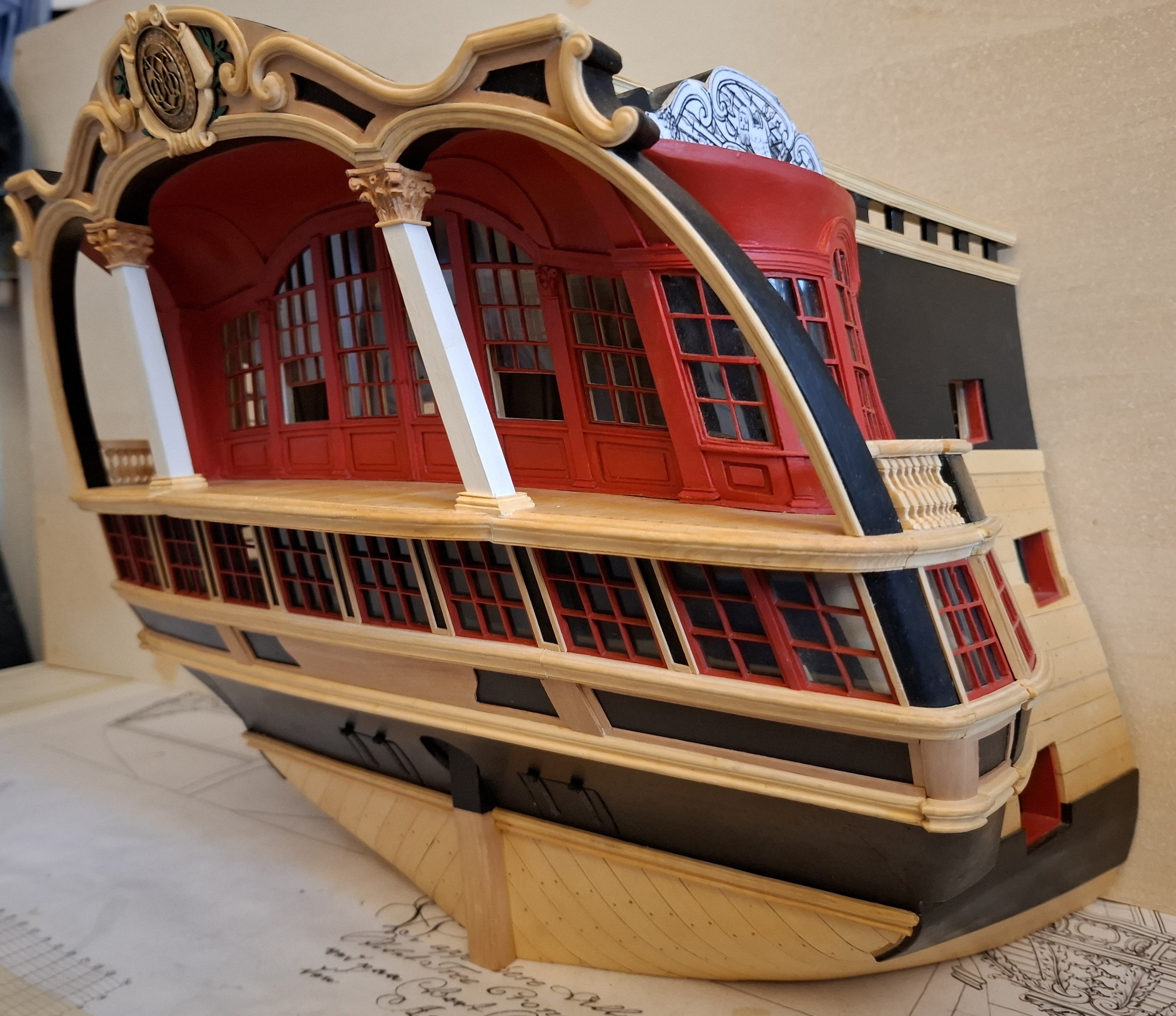

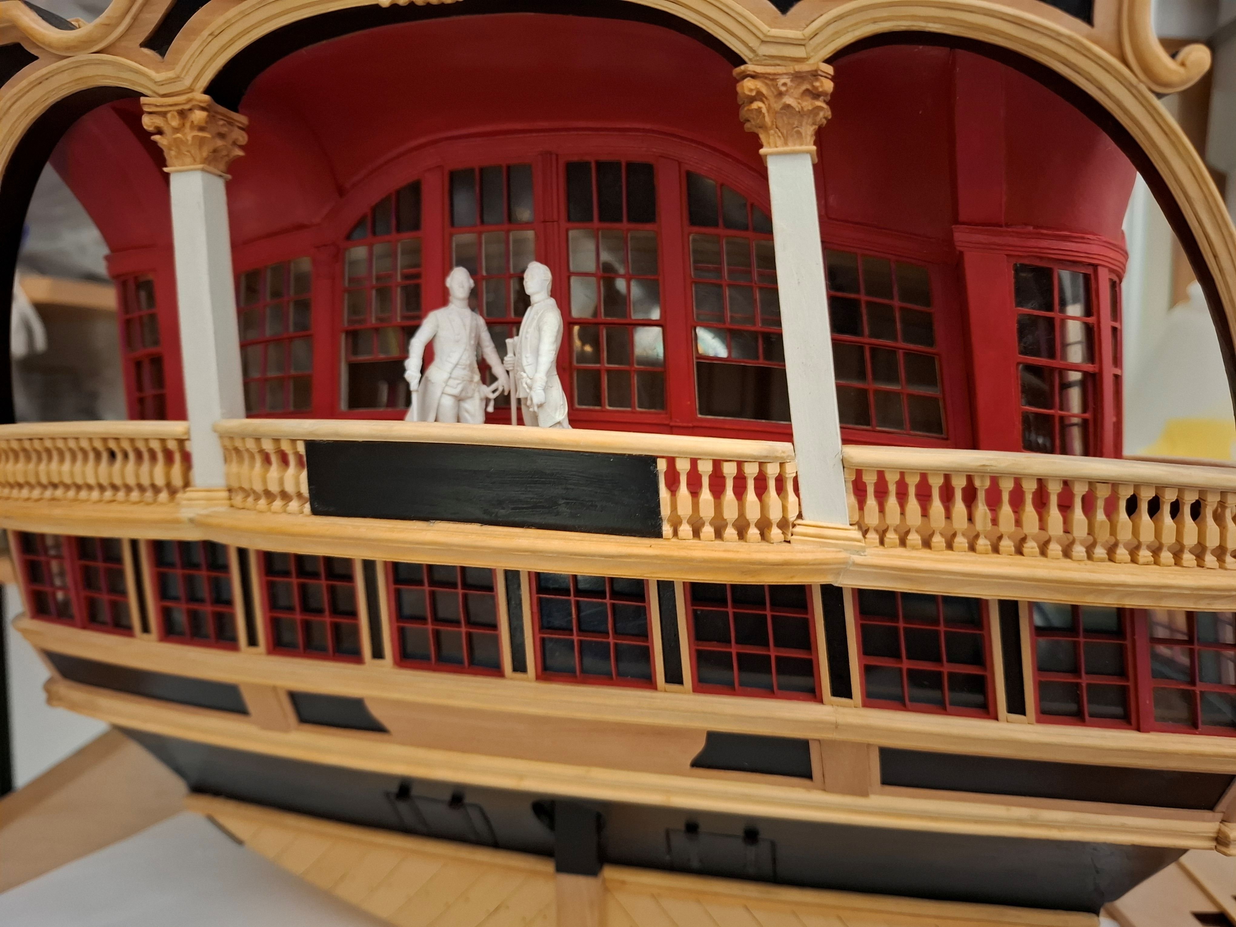

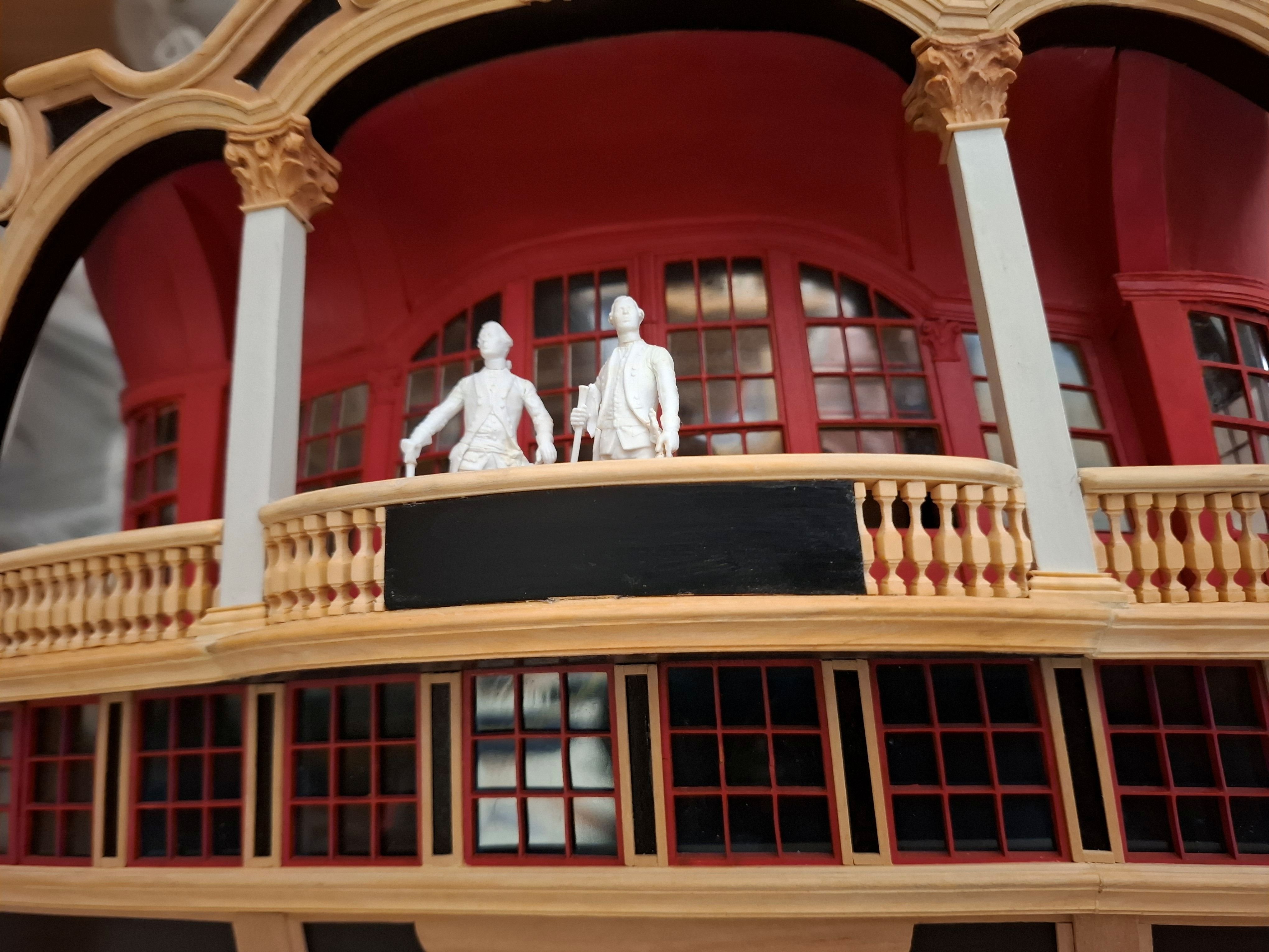

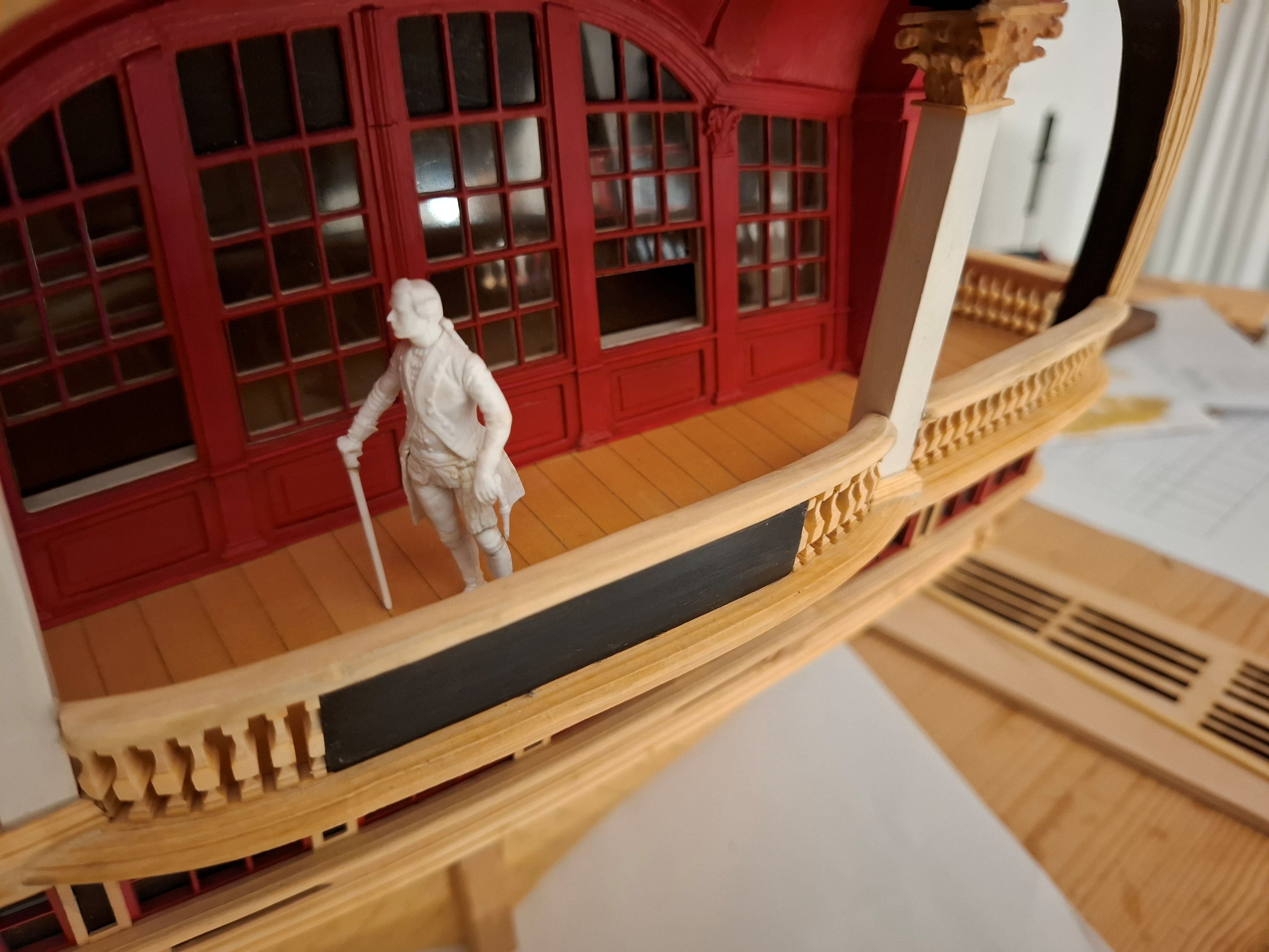

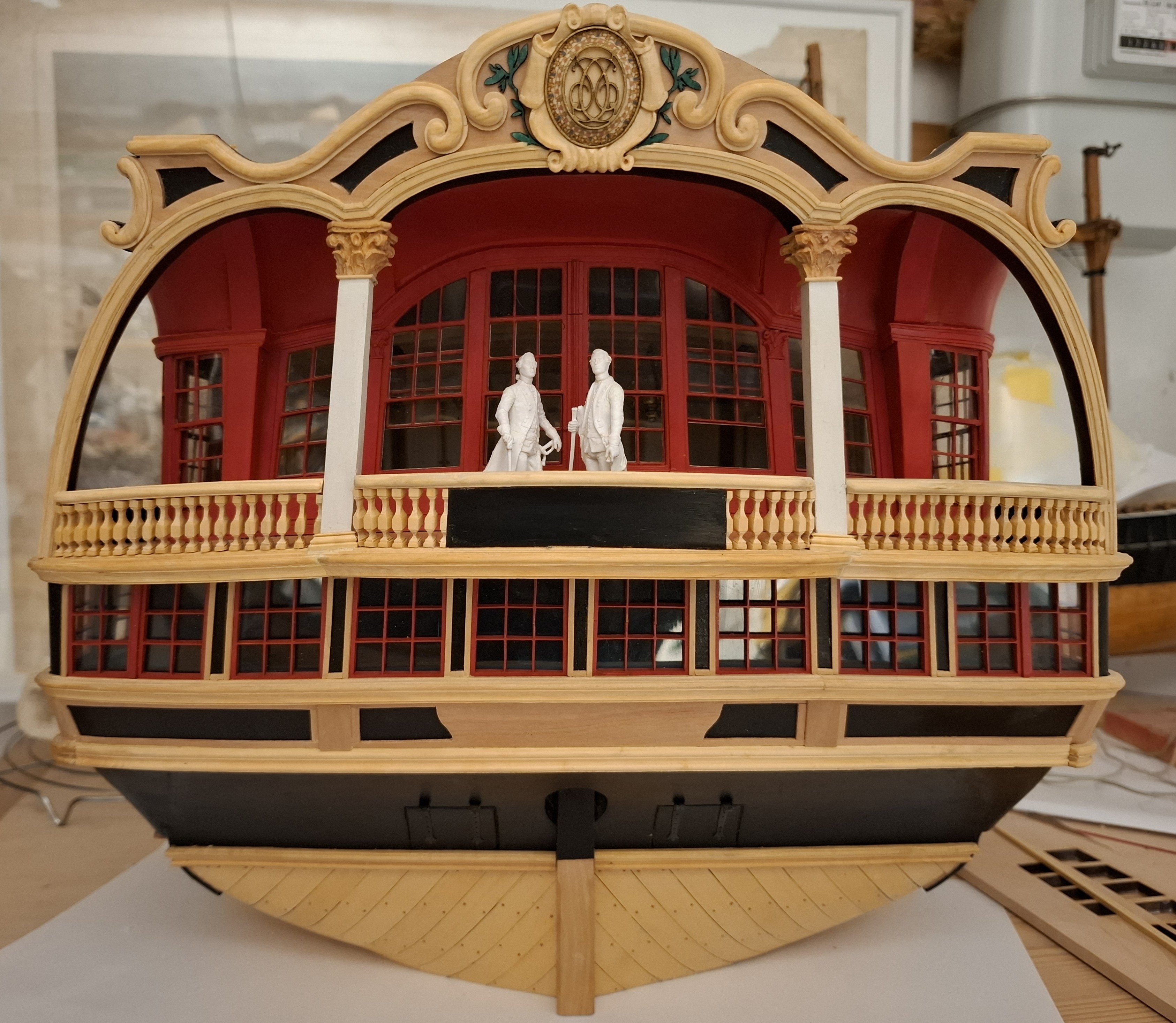

Hello everyone,
After installing the columns, I was able to finish the railing for the rear gallery. It still needs some touch-ups and the surface treatment is still missing, but otherwise it fits perfectly.
The balustrade is tilted inward and backward here. No two columns are exactly alike, so if you look closely, you'll see a few inaccuracies, but overall they're not particularly noticeable.
The design of the stern is clearly inspired by baroque palace architecture. The central section between the columns is referred to in the architecture of the building facade as the “balcony of appearance,” where the Sovereign or Duke appeared before the people. At that time, representing one's own position had a relevance that is hardly comprehensible to us today.
Best regards,
Matthias
Impeccable work Matthias! It's really coming together and showing the full shape snd design intricacies now. All those individual, subtly different balustrade columns are so well done!
Thank you all,

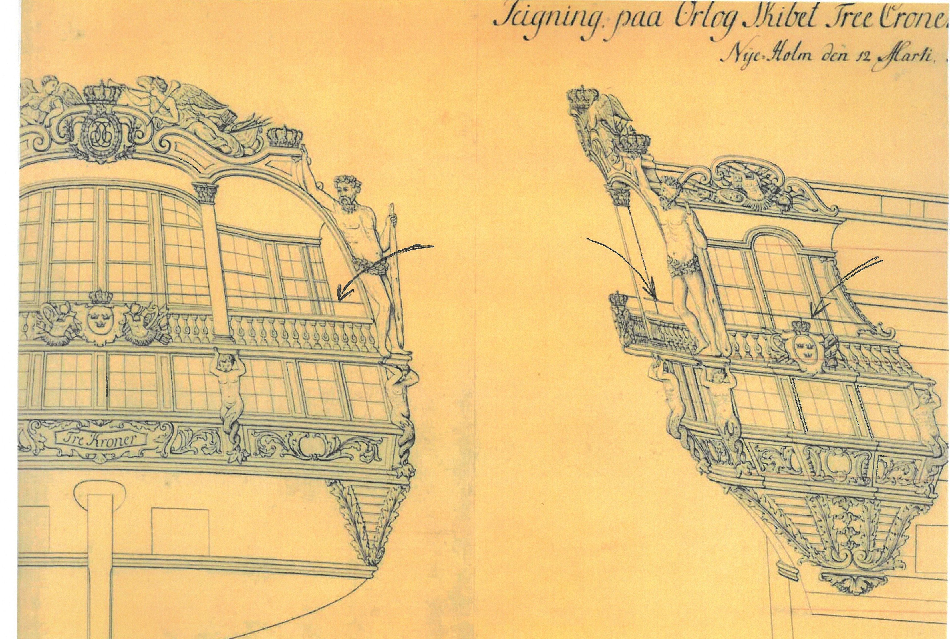

Druxey, the low balcony rail was so by design. The drawing shows a kind of sea fence above the balustrade, which provided the necessary safety here. However, I want to leave that out because it was also omitted from the original model.
Best regards,
Matthias

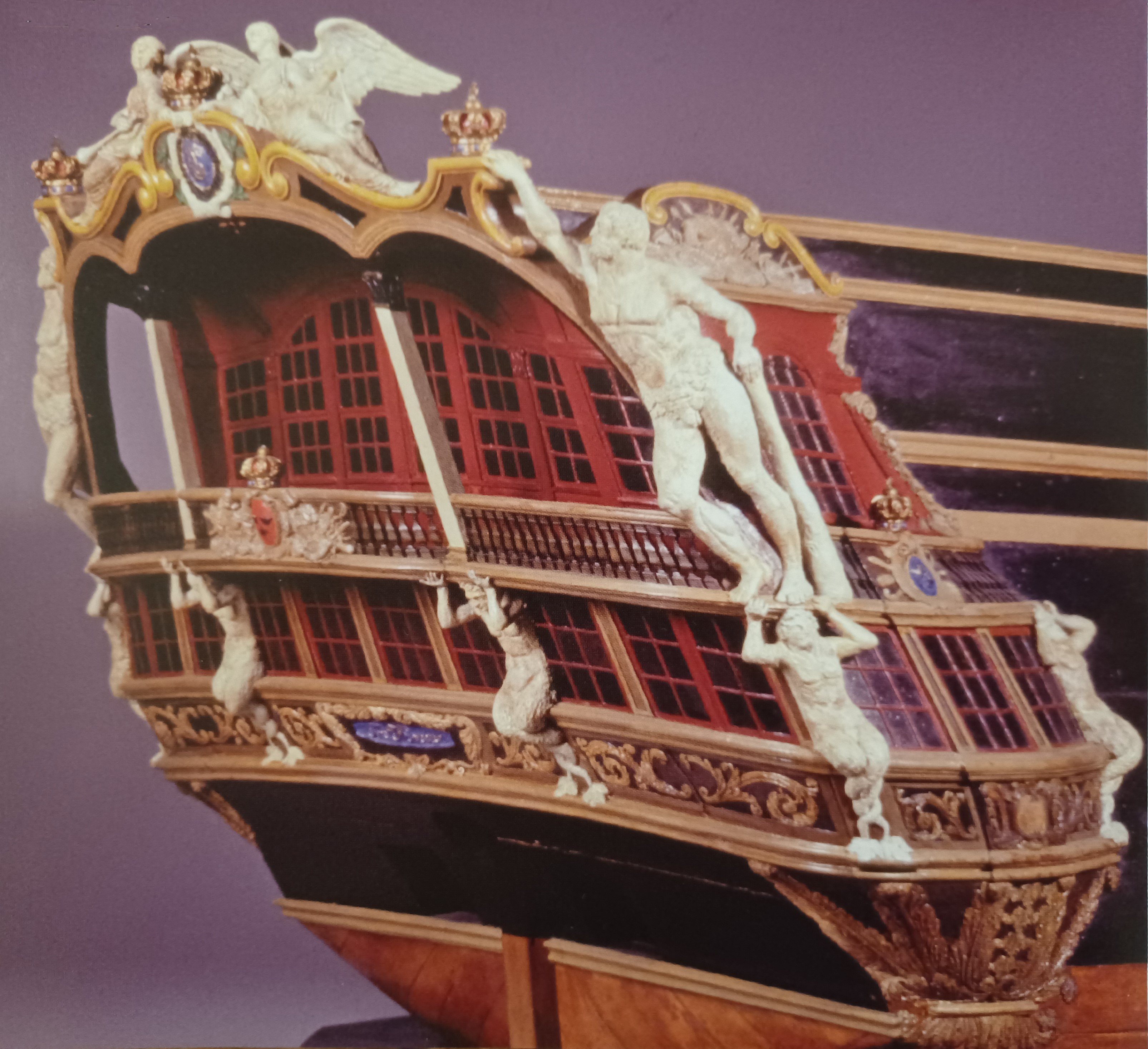

I've read through your topic, and some questions in regards to sources came to mind. You mentioned 'Danske Orlogsskibe 1690-1860', how good is the book?? Is it aimed on the general public, or does it go in depth about specific danish shipbuilding practices? Does it present sources outside what is available on the Danish Archives or otherwise online? Are there other titles you'd point to that discuss danish practices of the period?
You've presented some great photos of the Tre Kroner model and others, some taken by @TJM. I am having a hard time finding Krigsmuseet's model's references online, would you guys mind sharing some more of those? Maybe on the gallery of contemporary models of MSW? I'm messing with some Danish ships myself, specially Wildmanden, that I'm the furthest along with, and taking a look at those models would really help clarify some details the plans often omit, such as anchor linings, oar ports, fenders, rails, cheek fillers, etc.

I recently posted some of my photos on our german homepage, where I am  member of. https://www.arbeitskreis-historischer-schiffbau.de/mitglieder/ontour/schiffsmodelle-in-daenischen-museen/
Have a look at these and please tell me, if you have a more specific interest in certain models.
The book danske orlogskibe is a 'must have'. There are two huge books, one with informations about the development of the danish navy and the important men behind this, and one with plans. These plans are available online as well. There exists a list of ship names and the plan-signatures, to find the right plans for specific ships. You need this list, otherwise you are get mad finding what you need. There are a few other publications, often written by a guy with name Ole Feldbaek. He has an immense knowledge about danish shipbuilding and navy.
Matthias
Edited by Beckmann
@Arthur Goulart, as the drawings of artillery in the Danish Archive are rarely dated or directly connected to specific ships, there is unfortunately no nice way to find anything specific. So I do what you do and plow through the drawings.
Have a look at F278-F360, there are quite a few artillery drawings in that range.
A Norwegian site has scans of a Kadet book on Danish artillery. It was likely compiled in the 1720's-1750's: https://www.arkeliet.no/sources/kadett_fm_1700/kadettbok1700t.htm
These are 'metal' canons, meaning bronze, as opposed to iron.
