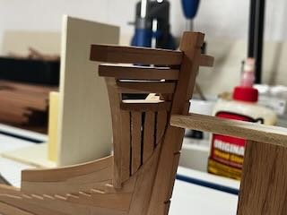

Un-stuck and back to building.  I had to do bit of re-drafting on my plans before I was finally sure I more or less have the stern assembly right.  Tricky to get the waterlines right around the transoms.  Lots of foam board mockups before I was convinced.
I have the transoms made and the stern deadwood and stern post assembly glued up.  There is a pesky little gap in the front of the sternpost where I cut a mortise I shouldn't have in the front part of the post.  I will fill it in later, but it will be covered up anyway.  Still some cleaning up to do, but overall I am happy so far.

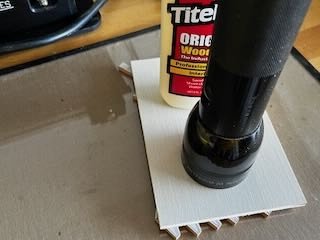

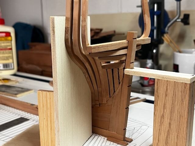

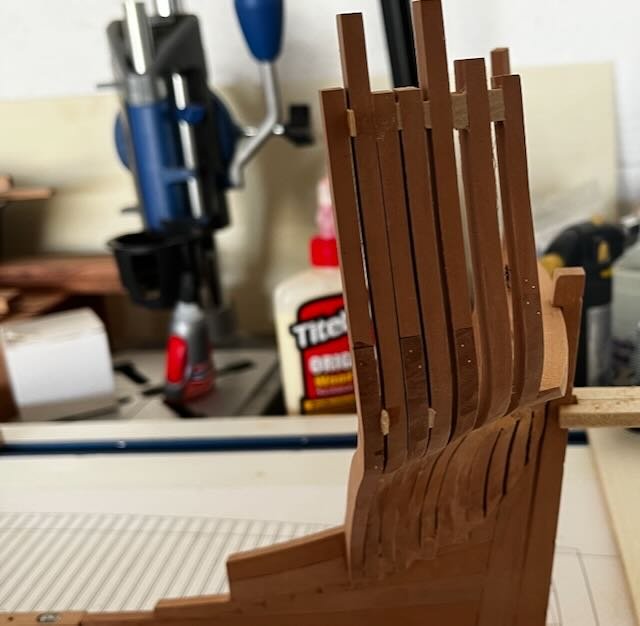

I made a slightly larger building board to provide a bit more room to install the frames at the ends of the model.  Long story short, when I setup the new build board I found some issues with the alignment of the transoms and aft fashion piece.  I have known for a while that something wasn't right with the alignment, and happy to figure it out before doing a ton more work.  I envisioned this would be a problem that would follow me through the whole build, so got out the isopropyl and re-built the transoms and aft fashion pieces.  I also used the opportunity to add a 4th filling frame which looks much better to my eyes.

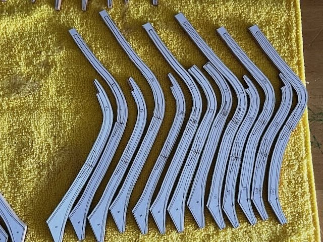

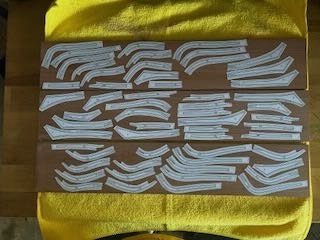

With the transom shenanigans out of the way I am finally ready to start making frames.  Here I have marked out the blanks for the aft cant frames.  The black lines are the actual lines for the frames.  I added the green lines to make sure I have plenty of wood for fairing the cant frames as well as to make sure the frames are sufficiently tall.  Experience tells me that I just can't help myself when it comes to leaving enough wood otherwise.
Familiar sight for anyone who has built POF.
Adam

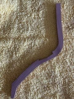

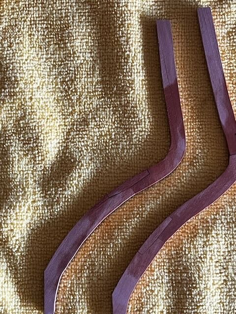

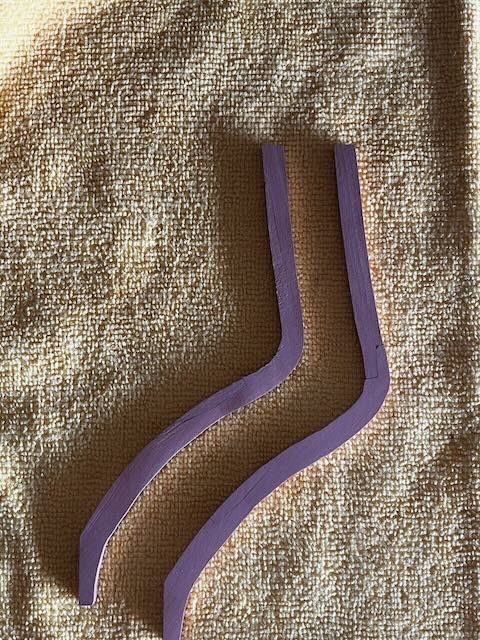

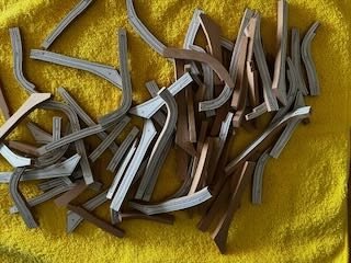

Cutting of frames for the chocks.  I cut these using the Sherline mill.  I simplified the chocks a bit by not beveling them.  I only cut to the depth of what would be the shallower side so as to not expose the nose of the chock when the frames are faired.  The chocks are a bit funny looking now due to the excess wood outside the actual frame lines.  One side of the chock will be a bit off after fairing, but I don't think they will be especially visible when the frames are glued up anyway.  I used regular scarph joints for the top timbers.  I will pin them later with copper wire to simulate bolts.
Here are two sample frames.
With a bit of alcohol just to highlight the joints.  I'm pretty happy with the look so far.

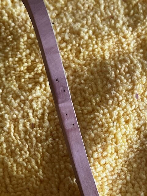

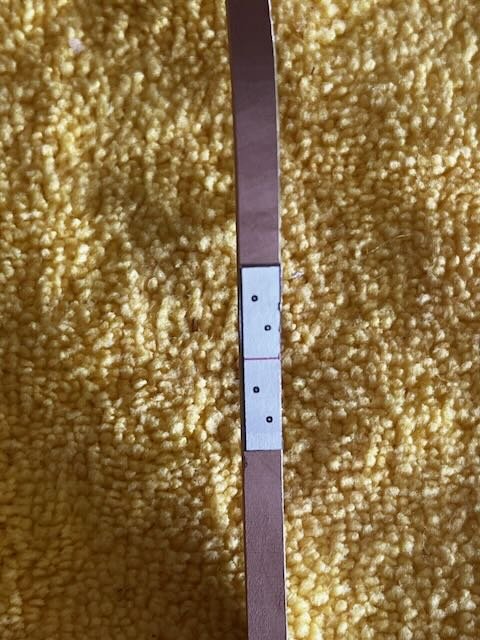

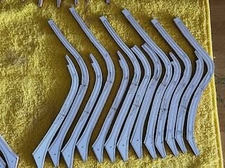

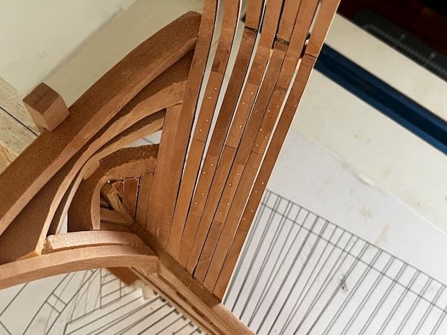

I finished gluing up the aft cant frames.  My plan is to simulate the frame bolts with copper wire and blacken any exposed bolts on the model with liver of sulfur after fairing.  I used wire labeled 0.019" diameter to simulate scale bolts 7/8" diameter.  There are 2 types of joints on the cant frames.  One type uses chocks and the other a simple scarph joint.  I wanted to save some time laying out the bolt patterns on the frames, so I printed up some guides on label paper.  I found that to work great.  I drilled the holes using a micro drilling accessory on the Sherline lathe.  I broke my last drill bit, so no more holes until I find some more.IMG_7896.jpeg.255906b7cc448d23f0a65317d35bdd1e.jpeg
