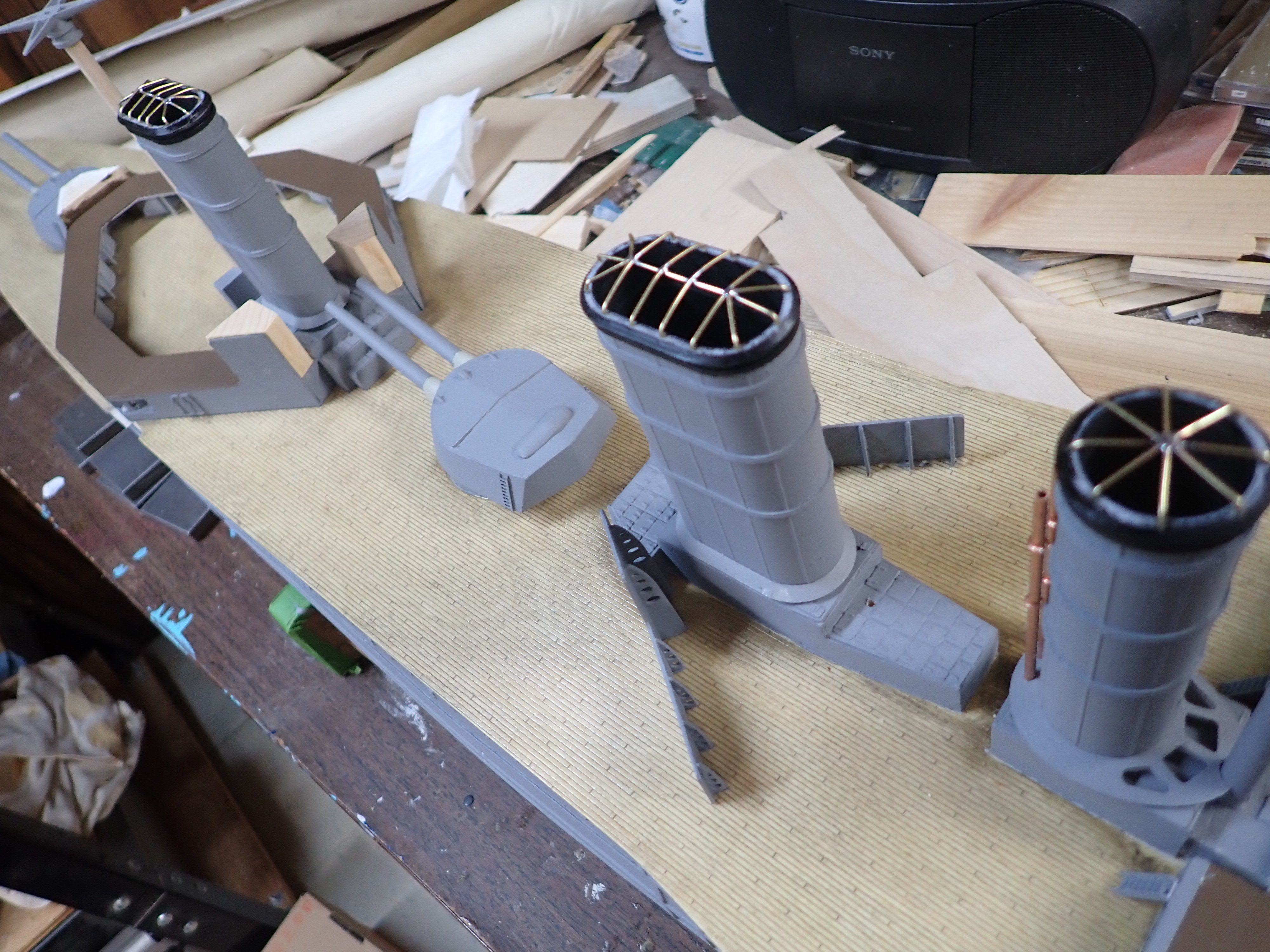

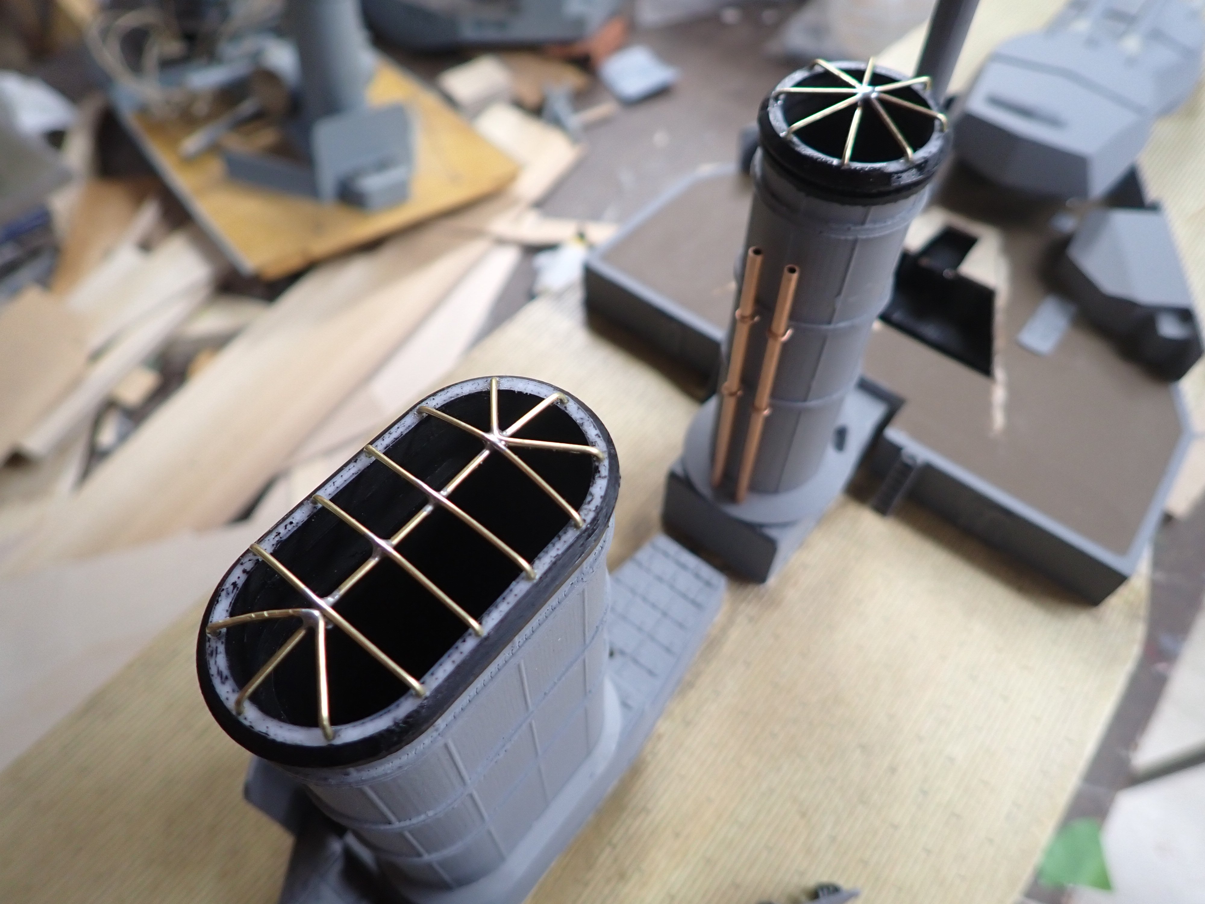

Here are some pics of the funnels with the "cages" on top, made from 1/32" brass rod, which support canvas covers when boilers are drawn. I printed some jigs to bend them consistently but even so it was a bit of a pain. Cages will be painted black.
Also added two copper steam pipes at the fore funnel. These are the simplest; no bends. The other six steam pipes on the main/after funnels require bending for which I will print some jigs. These will be painted grey.

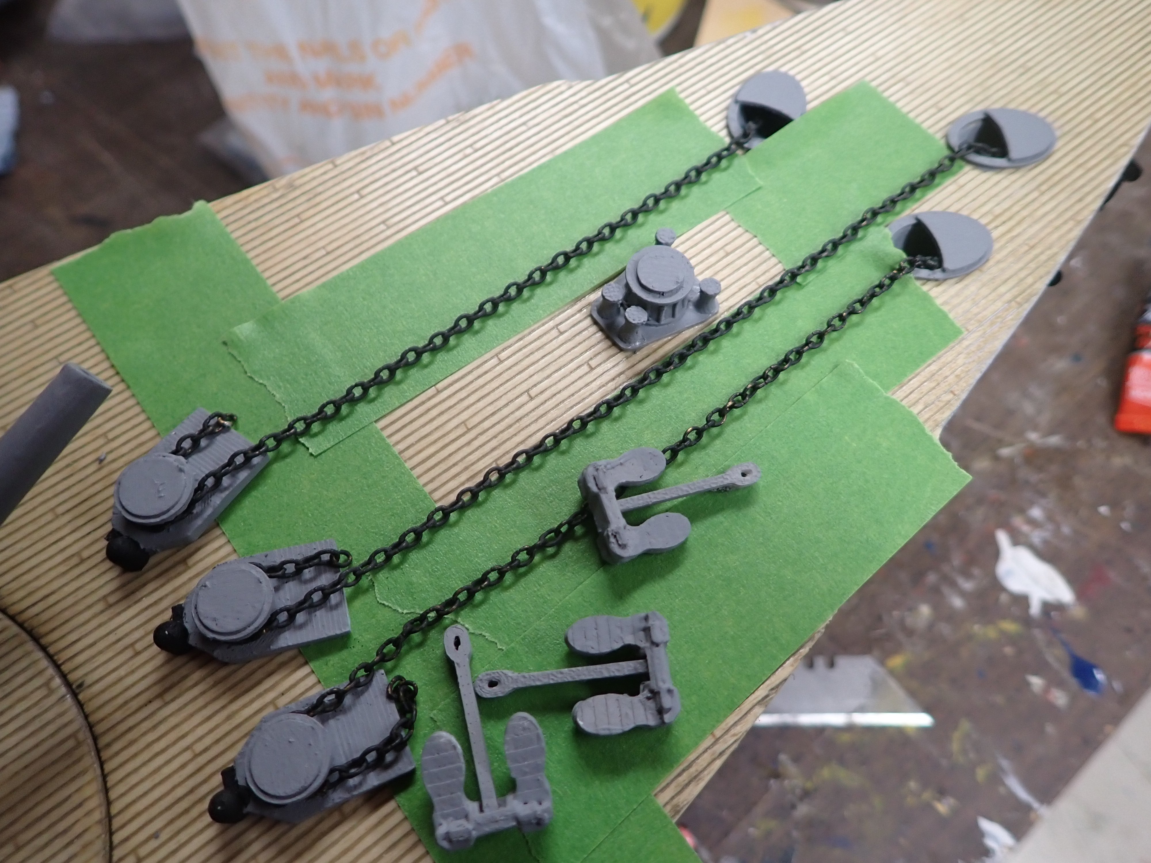

Also printed hawsehole covers, main windlass, anchors (with pivoting shafts), and anchor winches. Started to plan how to place them but it's been days since I looked at this aspect of the build. Looking at the pic, I see I will have to sand the little ridges off the flukes to improve their appearance. Also, I noticed during this that teenage Ian made a mistake on the hawseholes - there should be a pair up front then a single behind the starboard one, i.e. the port hawsehole should have been even with the forward starboard one. Too bad I didn't notice this before I added the laser-etched deck. I am not going to attempt to correct this now.

 The funnels turned out fantastic, Ian.

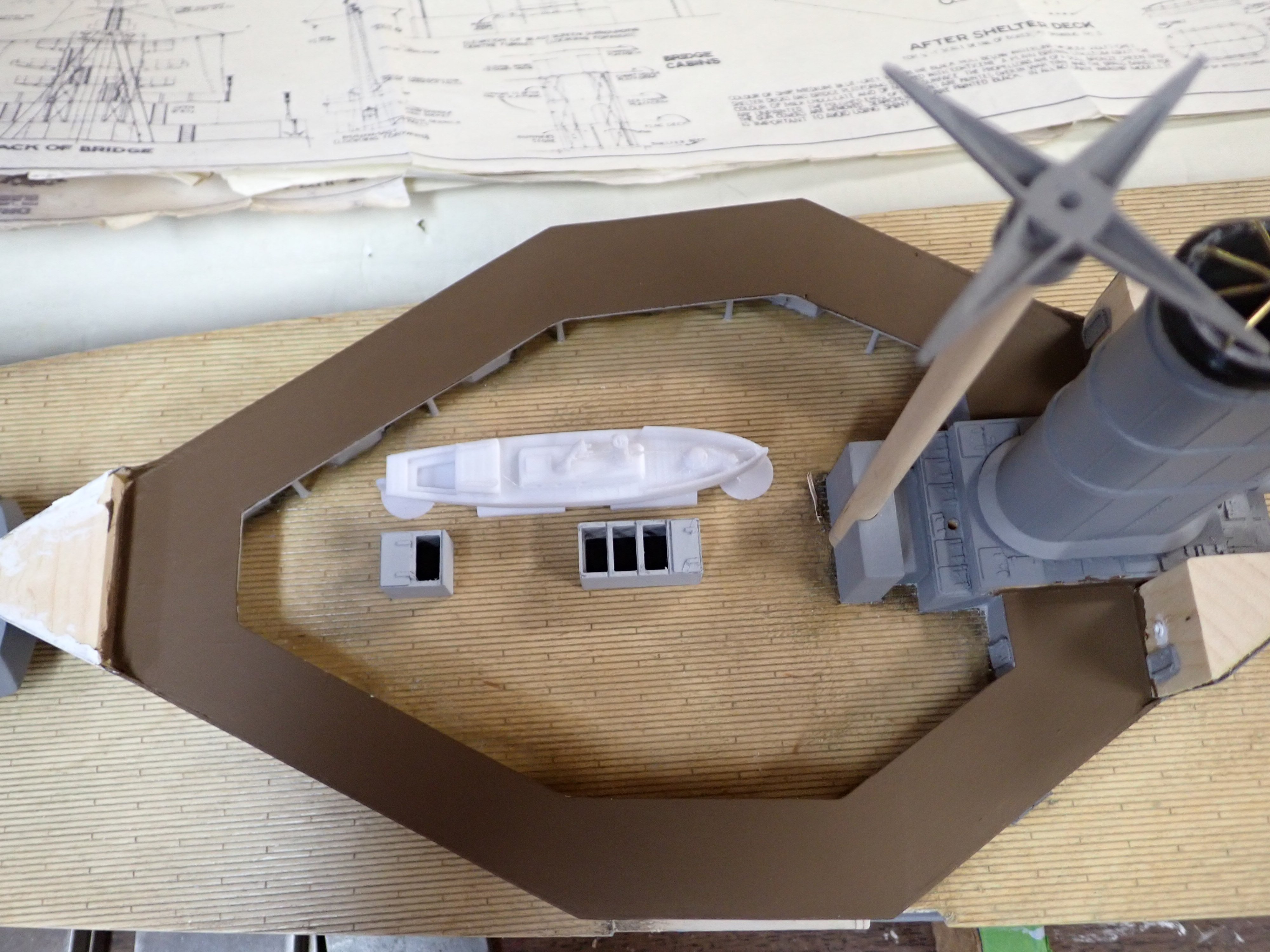

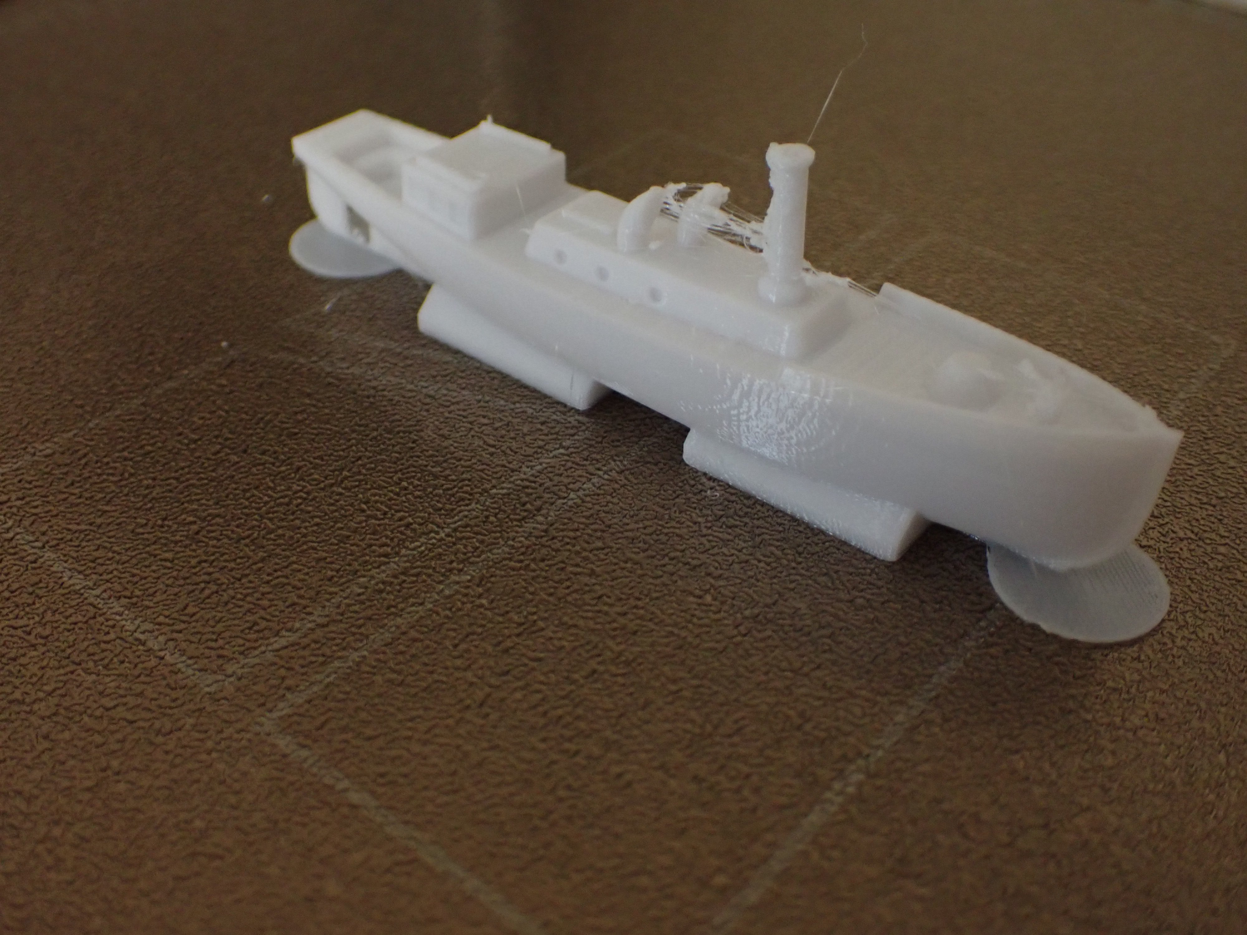

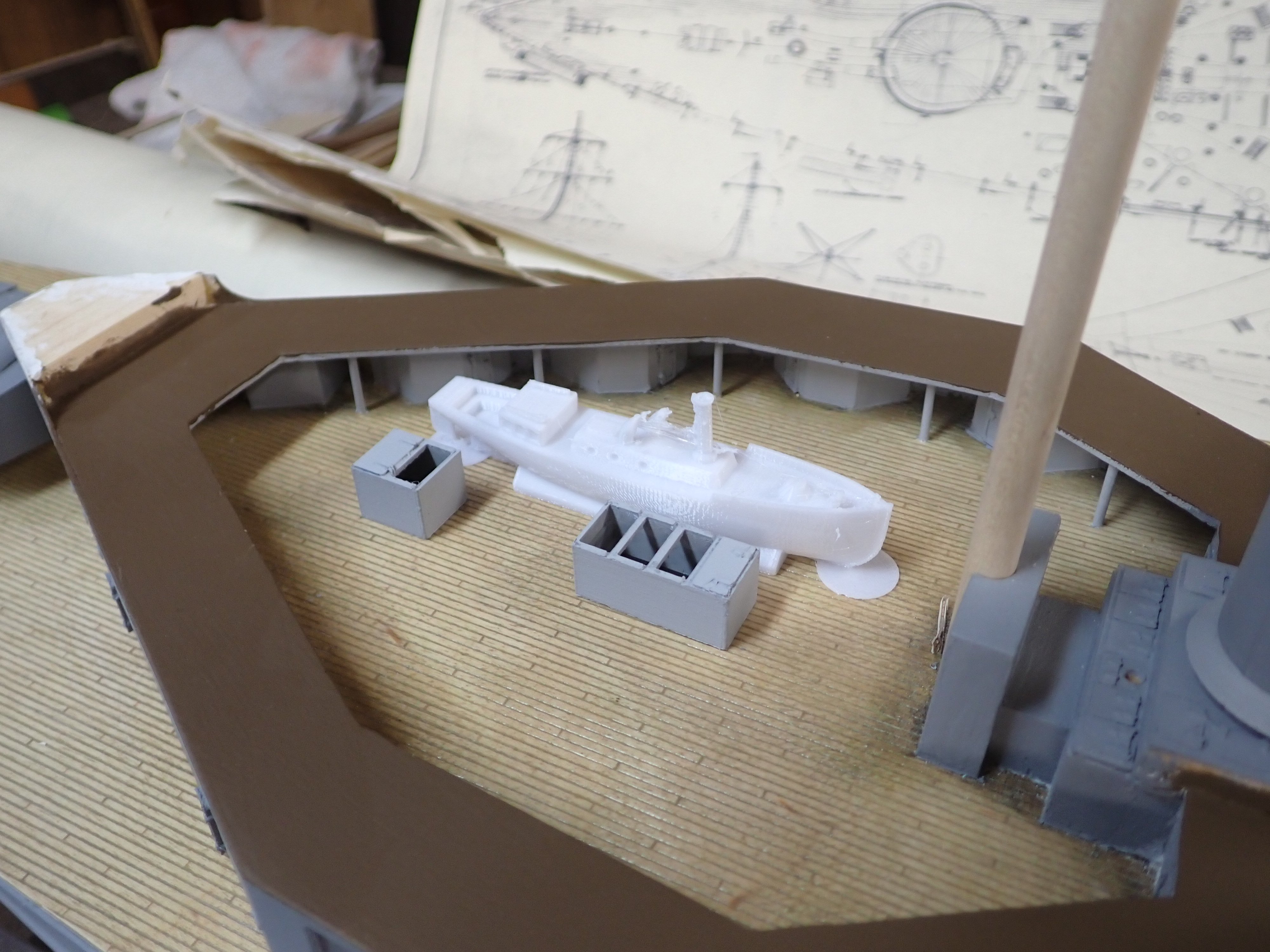

Wow!! Thanks for the great tip! They have three designs for the steam launches; 40ft, 45ft, 51ft. I picked the 45ft because I think it's the prettiest plus I only needed to scale it down by 7% (to 3-3/4" long) to be the size needed. Incidentally, I see my drawing calls them "Steam Picket Launches".
Here are pics of one sitting on the build plate, and in situ. The funnel and vents didn't come out too well but I can replace them. I'll need to cut off the circular pads at bow and stern; stern might be tricky as the rudder looks pretty fragile. Need I gimp up a prop somehow.....??
There will be another on the opposite side of the engine room vent hatches. There will also be a pair of large launches outboard of the steam pickets.
That's really not bad at all for FDM printing, is it. I'd also chop off the funnels and do them separately - you can probably do that in the slicer.
