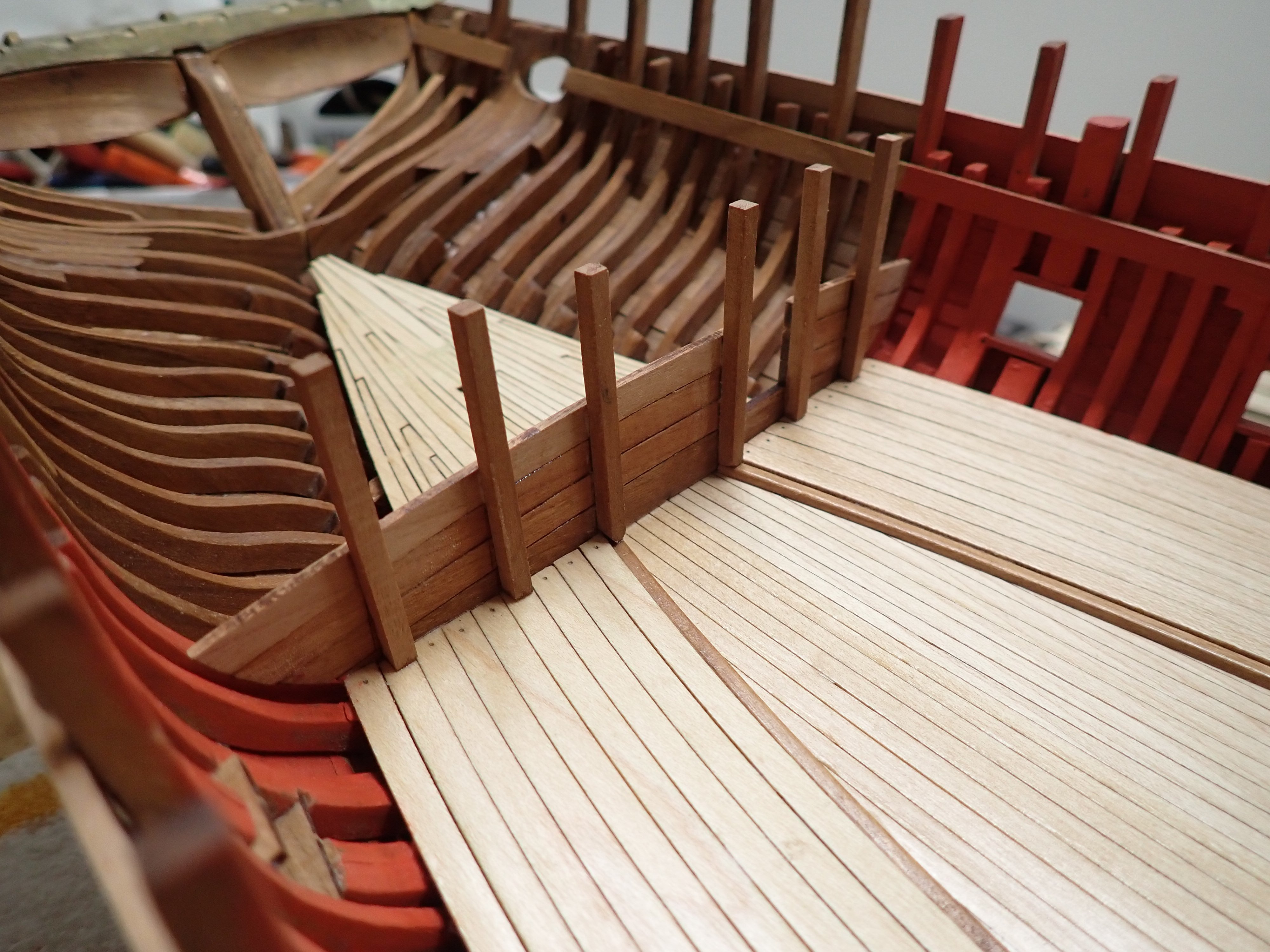

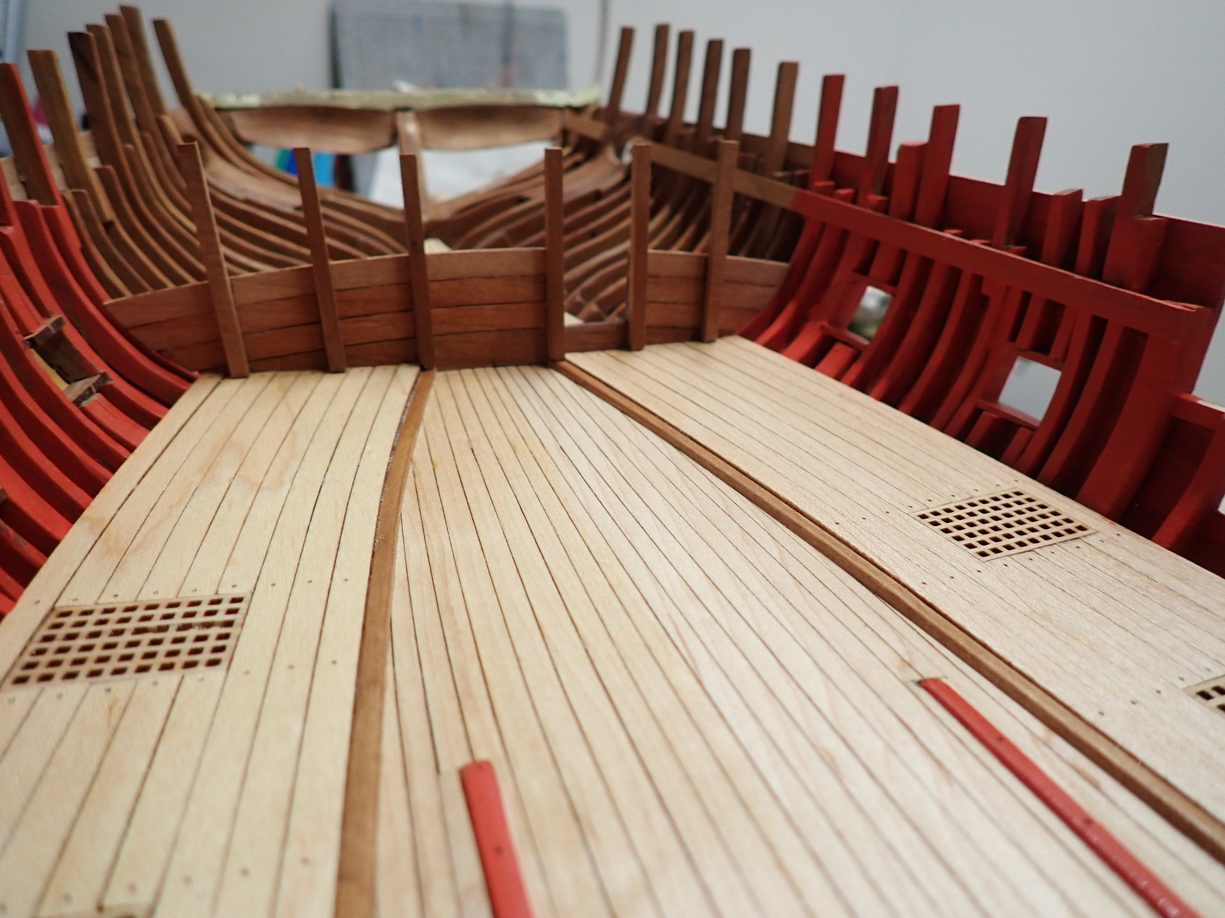

Next is the construction of the gun deck:

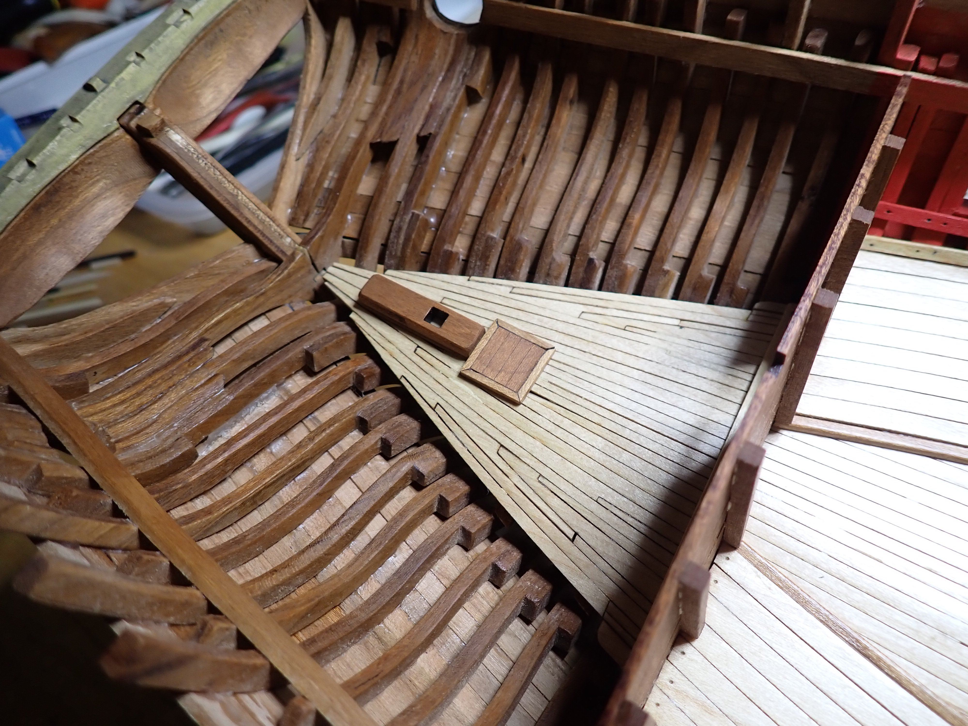

Again, for sturdiness and longevity, the supports are pinned on the main deck. Below, the grates are installed and the delicate planking of the gun deck can start.
Starting from the rear and slowly moving to the bow:
Once the gun deck is fully planked and we are happy, we can complete the planking of the side of the hull, all the way to the railings:

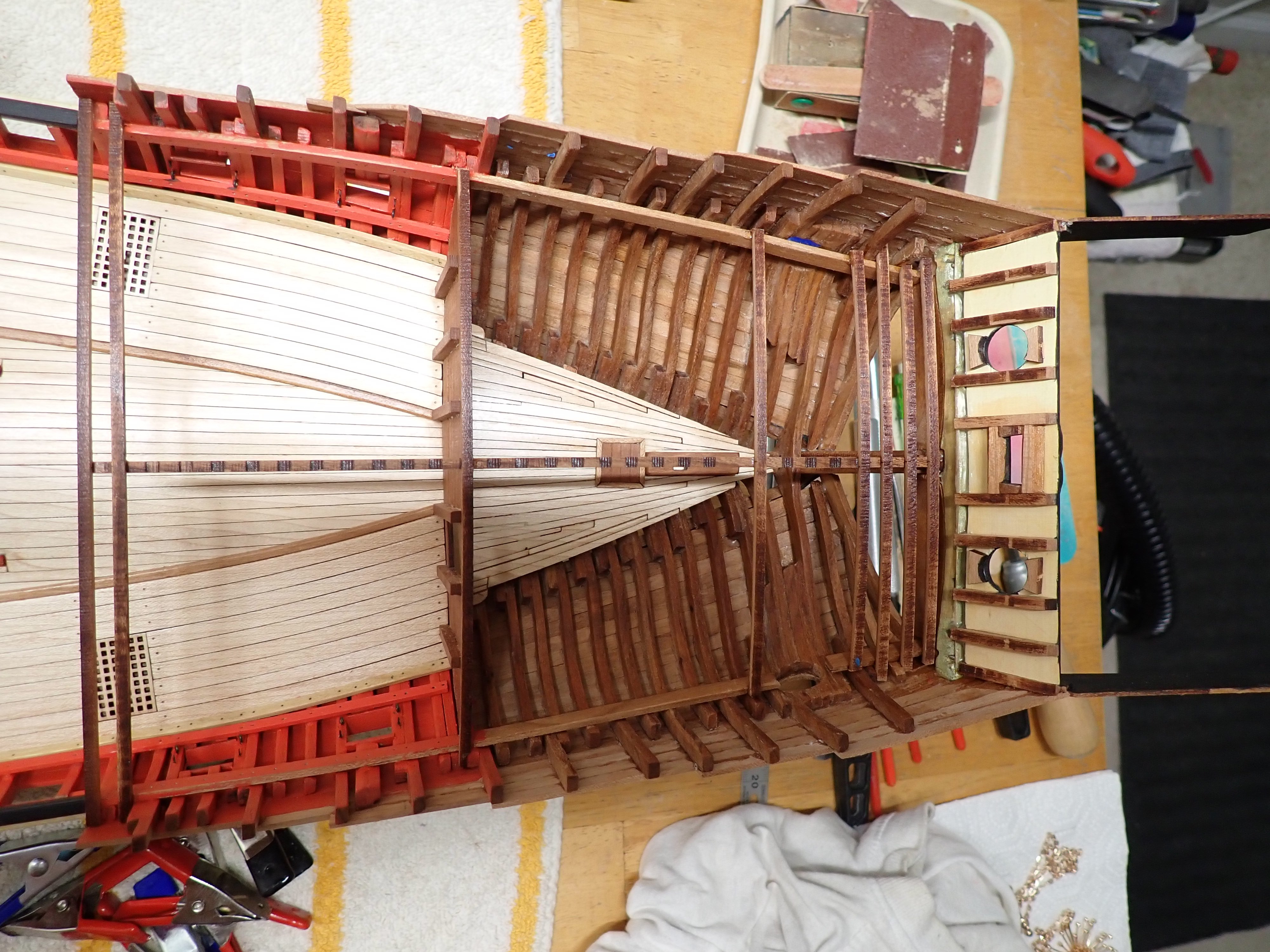

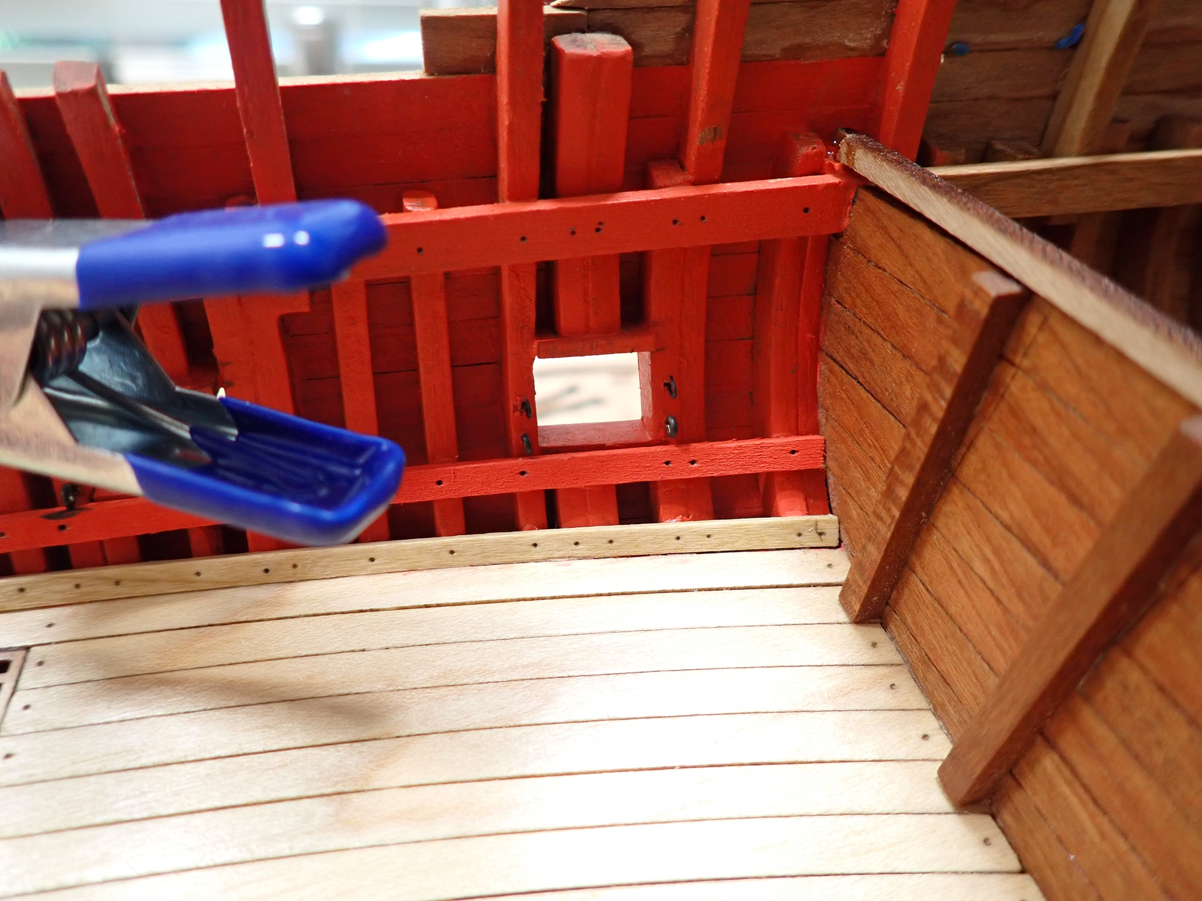

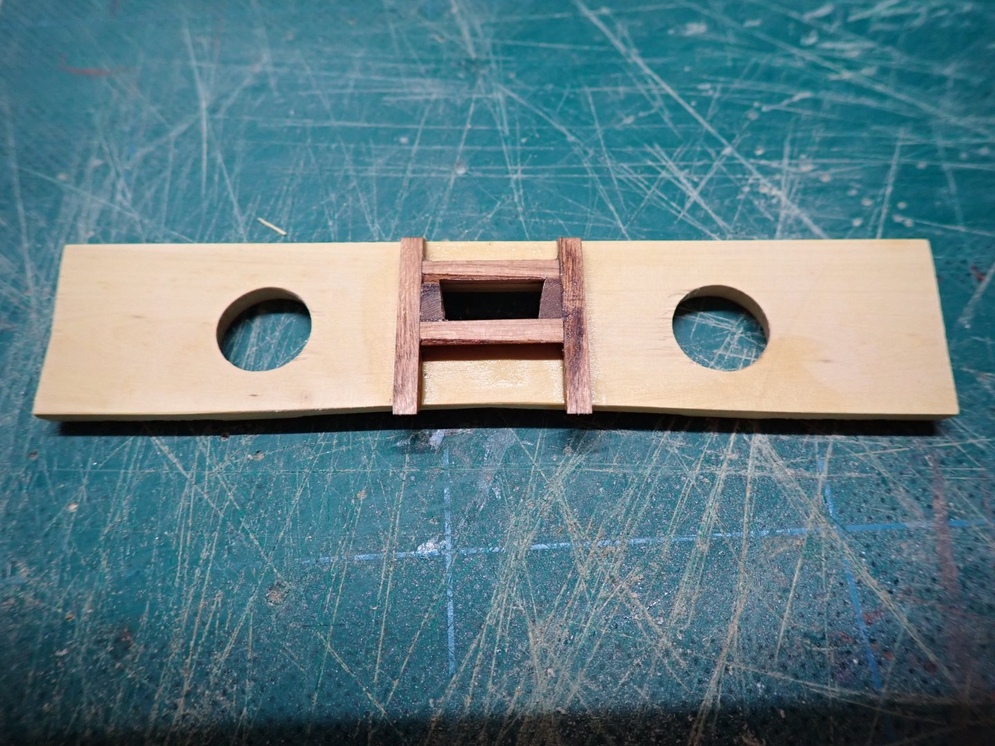

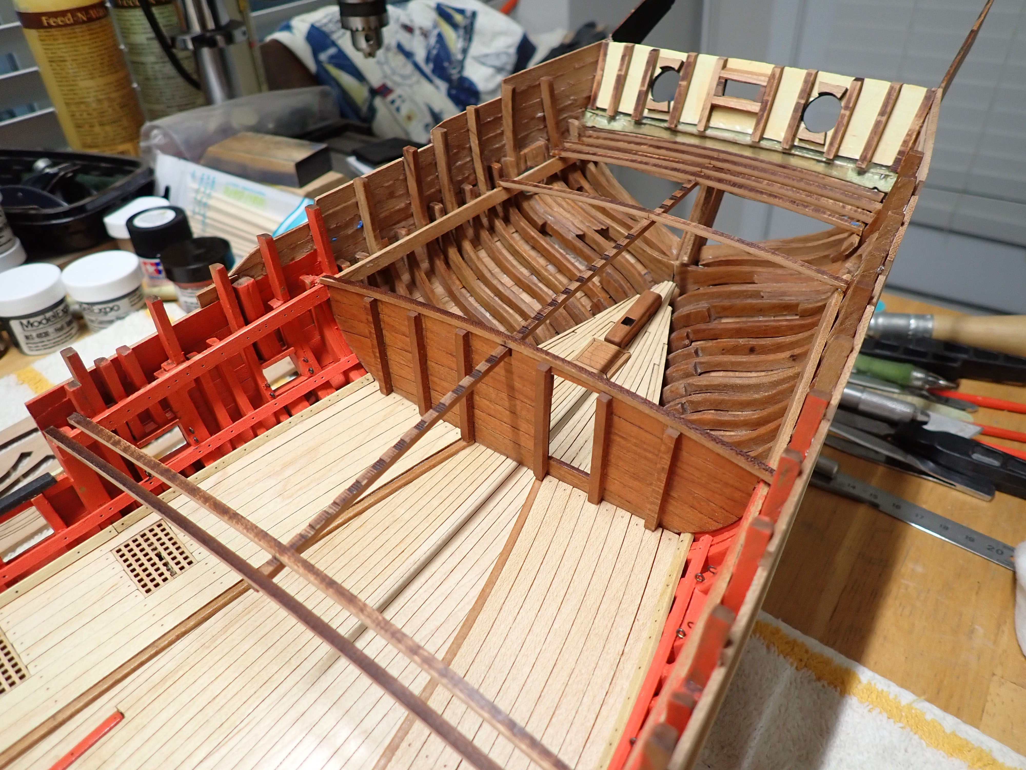

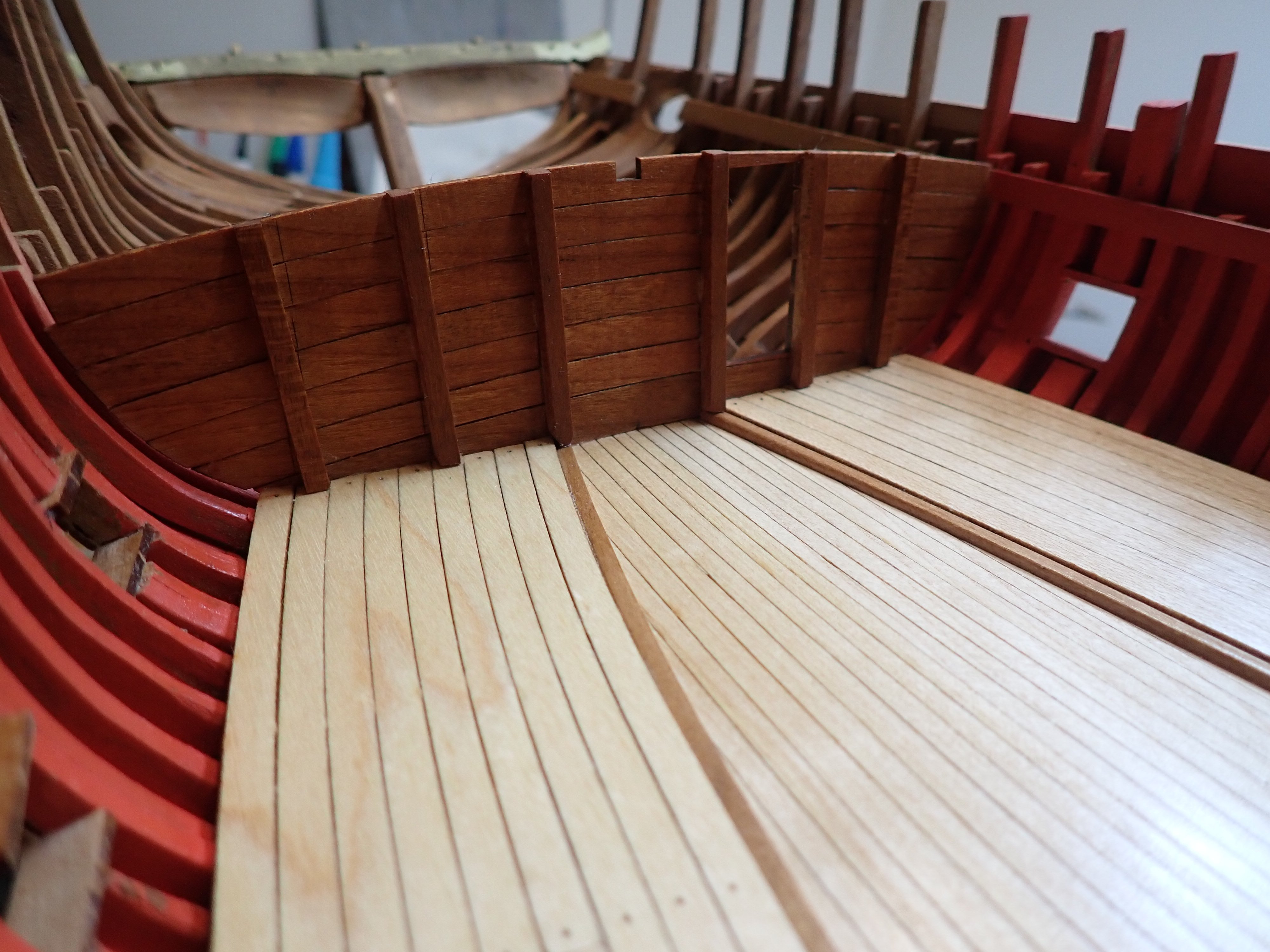

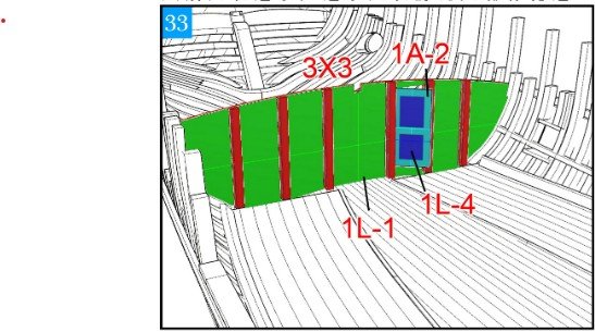

I am now concentrating on the stern as I need to make some progress there, to place the mizzen mast and the rear deck extension. Also, and not surprisingly, I am not following exactly the order of the instructions as suggested but moving along to what makes the most sense to me.
Interestingly, the door is missing from the parts provided with the kit and as such, I will have to build it myself. It should not be too difficult.
A few pictures of the construction of the cabin wall:
It is now time to build the two large joists, which are supporting all the framing of the quarterdeck:
After careful measurements, we come to this:
I started assembling some of the quarterdeck framing, but nothing will be glued until I finish all the trims on the hull. It is way too fragile and will impede the correct installation of the guns and other details located on the main deck:

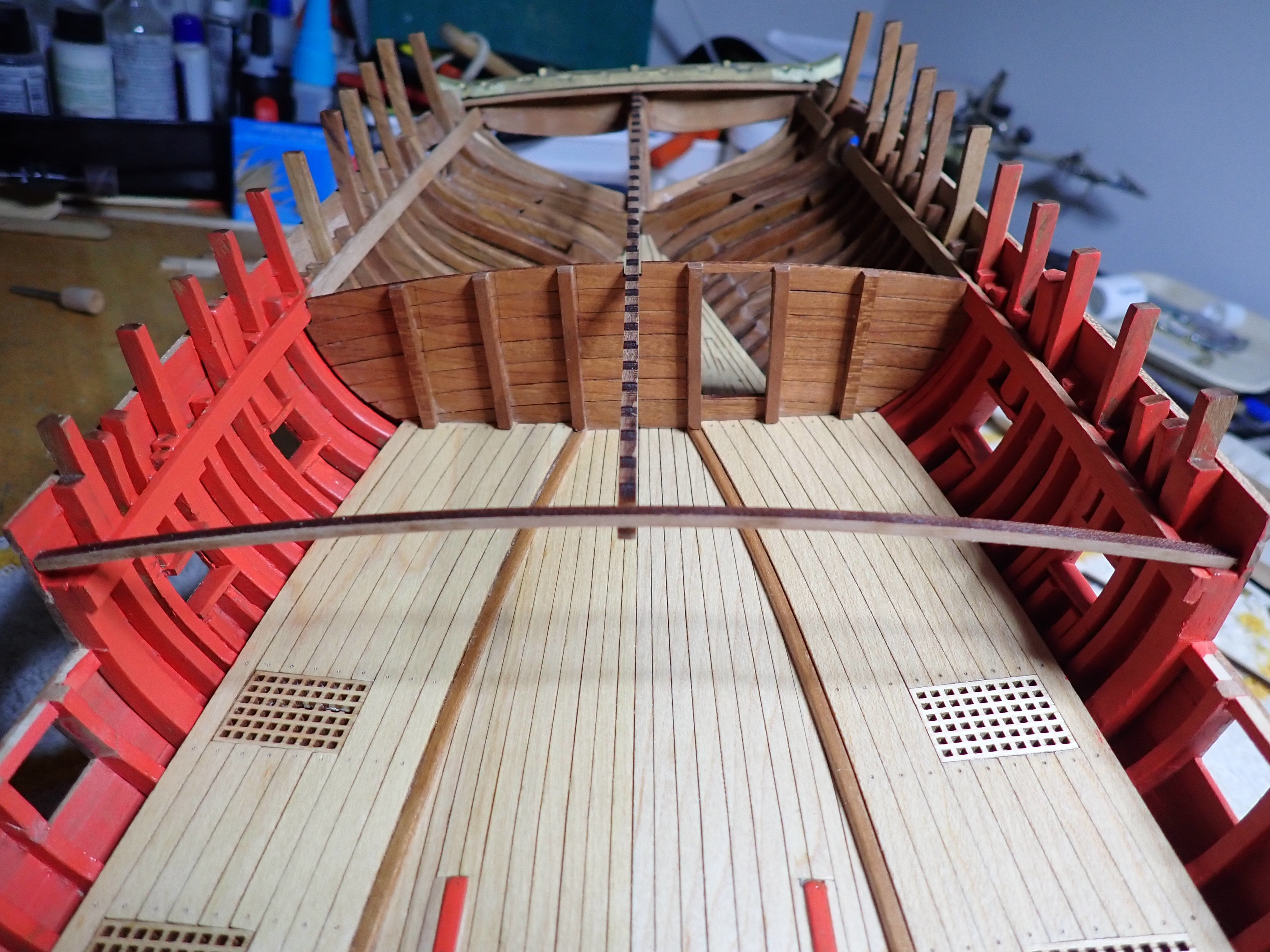

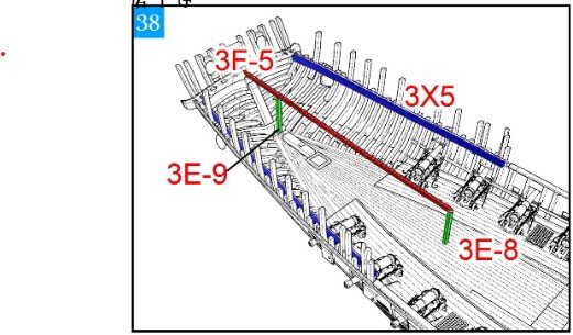

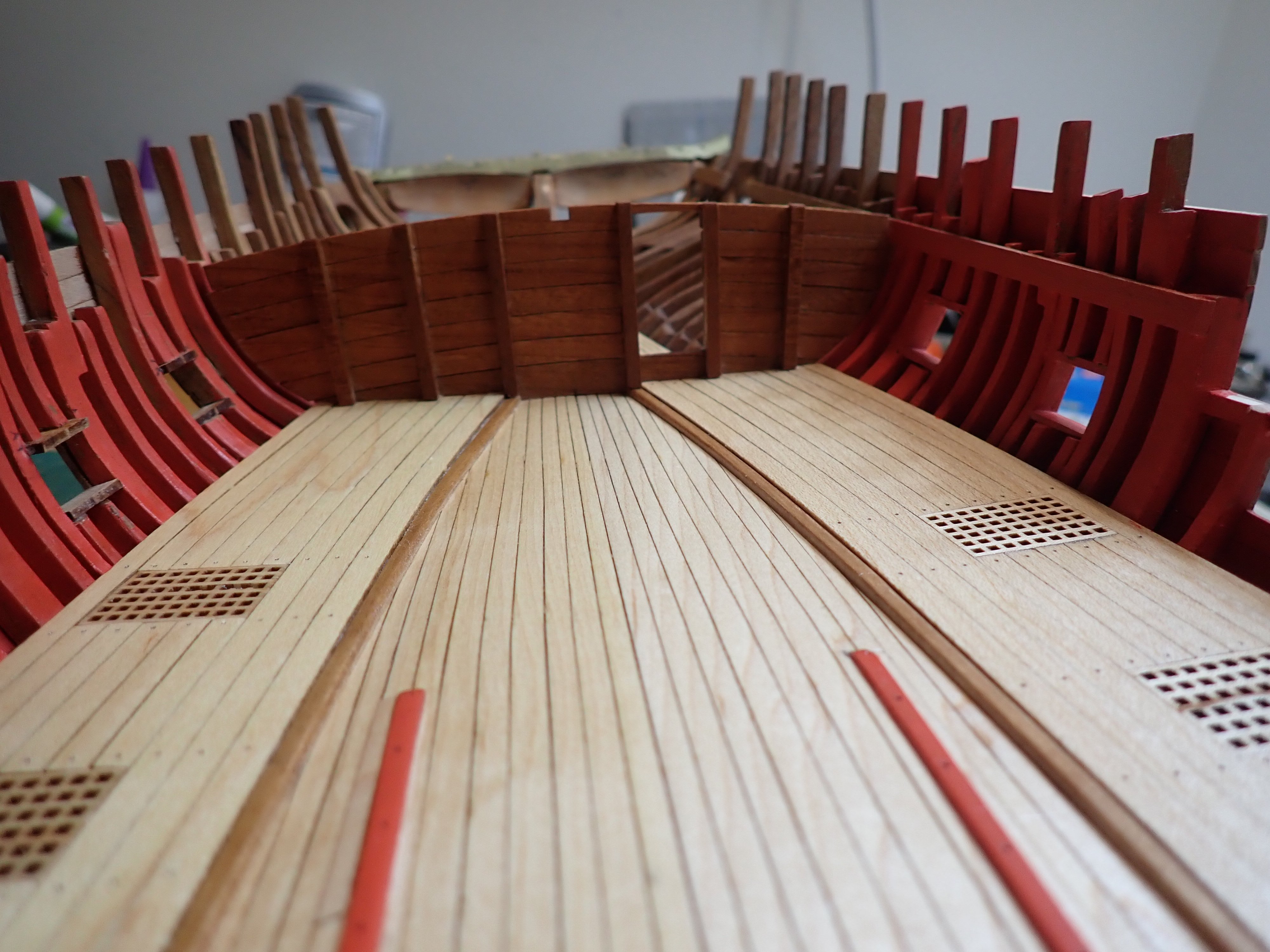

Moving along (slowly) with some delicate assembly. The kit calls for a 3x4 mm strips all along the handrail.
Unfortunately, I do not have the exact molding profile and thus decided to go with a semi-round, instead.
It goes in one piece from the stern to the tip of the railing.
It will stay with the color of the wood for now. I may tone it down a little bit later....
Next is the assembly of the railing
and the various strips going on the deck and bulkheads:
Again, the kit calls for a dark strip of 4x4 mm which is enormous on that little deck. Instead I went with a strip of 2x3 mm matching the color of the deck:
This provides a barrier when rolling the guns on the deck and potentially funnel the waters through the grates. I think its smaller size looks a lot better.

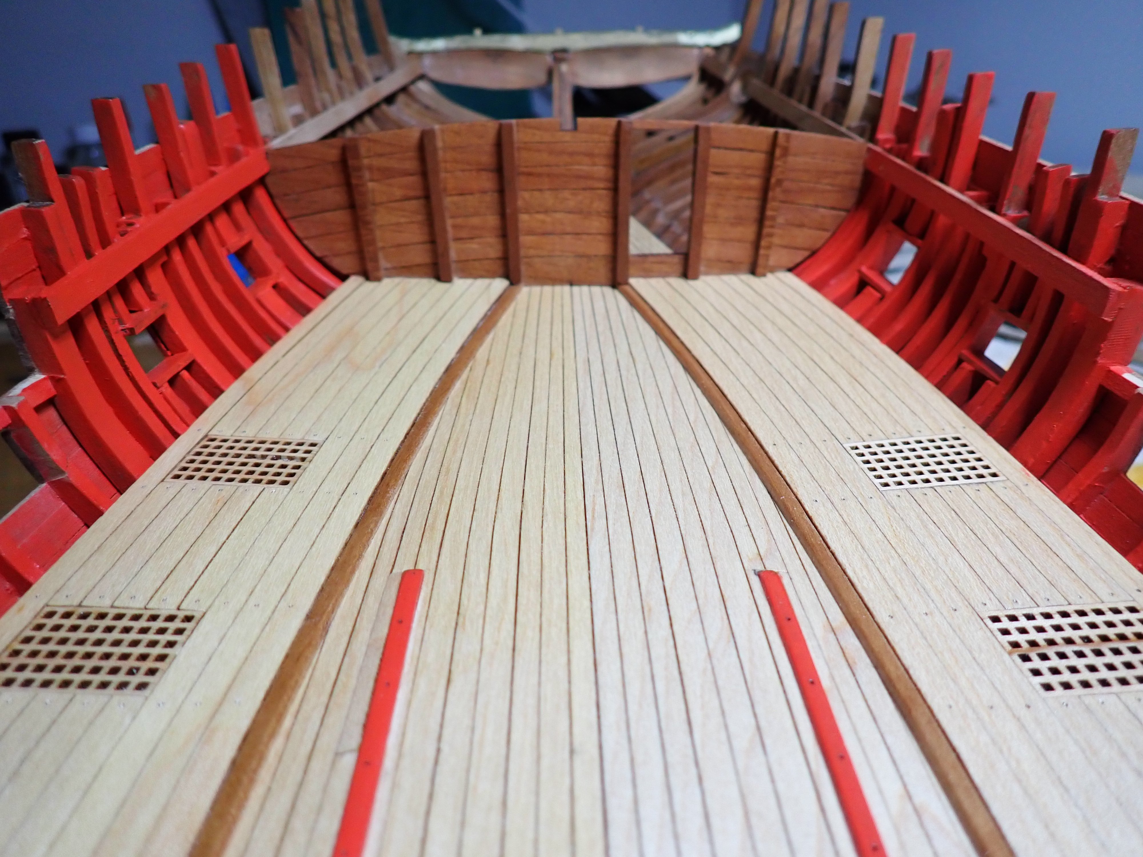

Finally, that long piece of wood used to anchor the guns and attach various things can finally be installed at the right location and height:
Now, to do the same on the other side.... Of course, all the parts (railings and strips) are painted before being assembled.

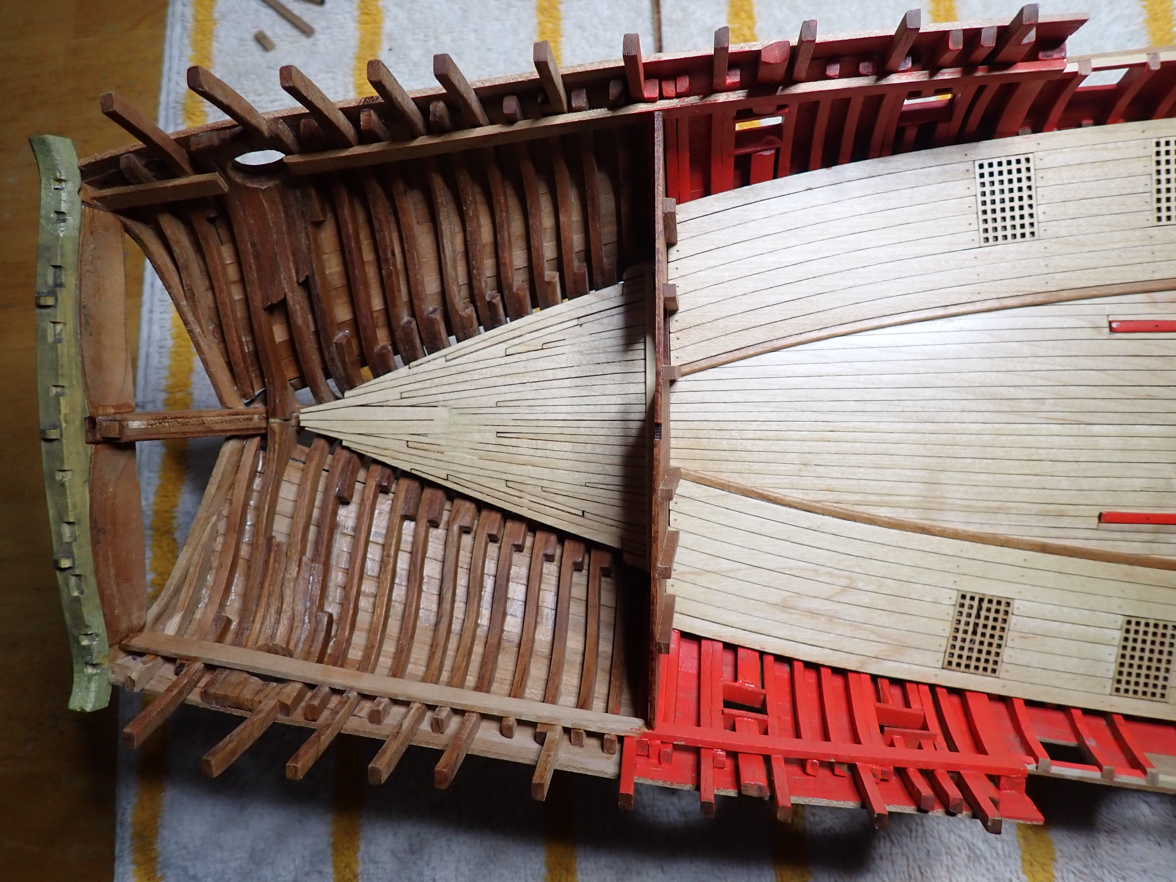

The main deck is pretty much completed, at the exception of the hooks required to rig the guns.
The support of the front mast has been completed on both sides: a rather unusual piece of equipment on a period ship...
I am not attaching the front shield yet, as I think it is too fragile and prone to breaking. This is what it will look like:

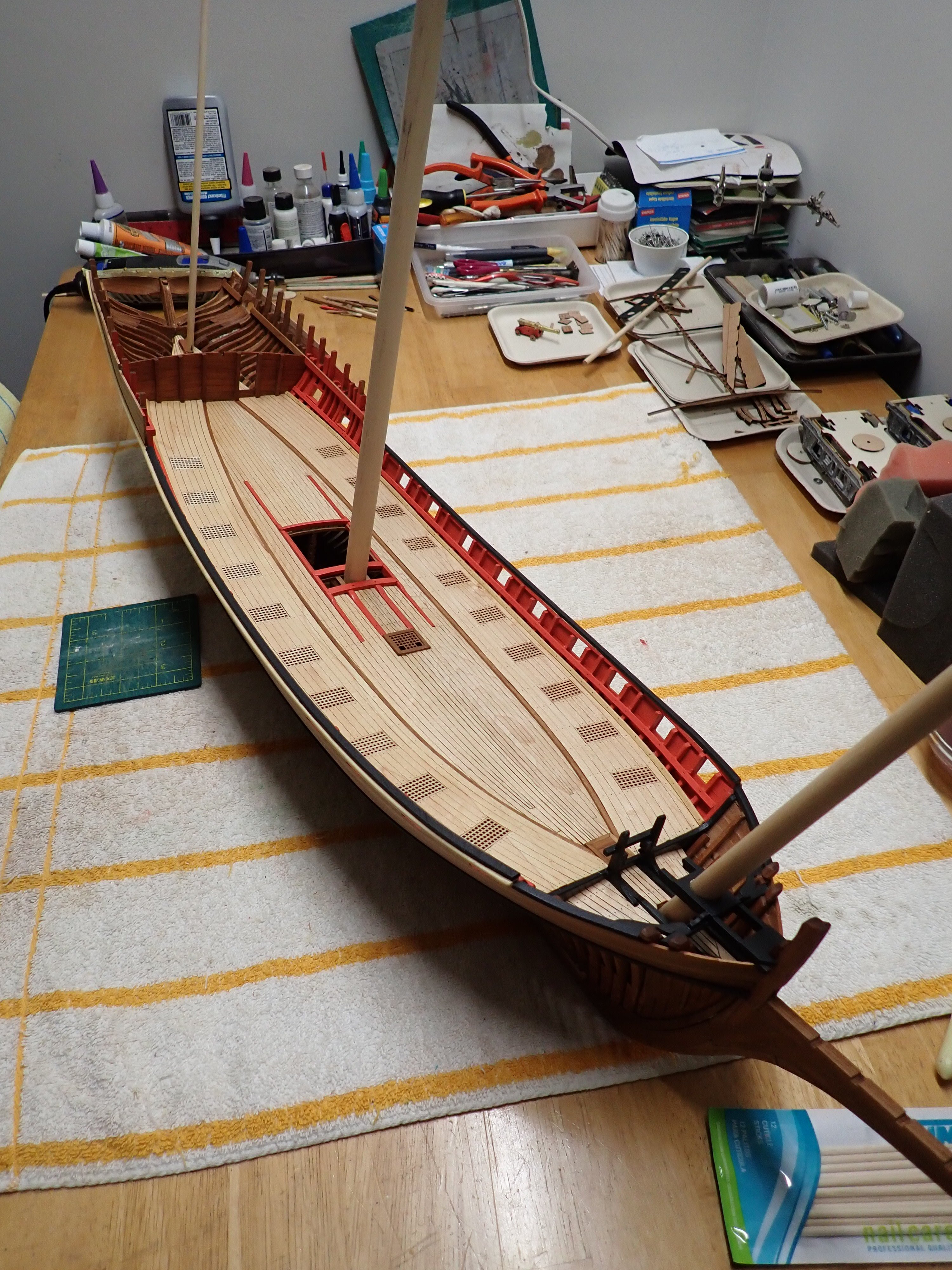

I really need to concentrate on the stern at this stage. I have been procrastinating it, but the mizzen mast and the stern extension are calling for my attention:
An overall view of the model, as it stands today:

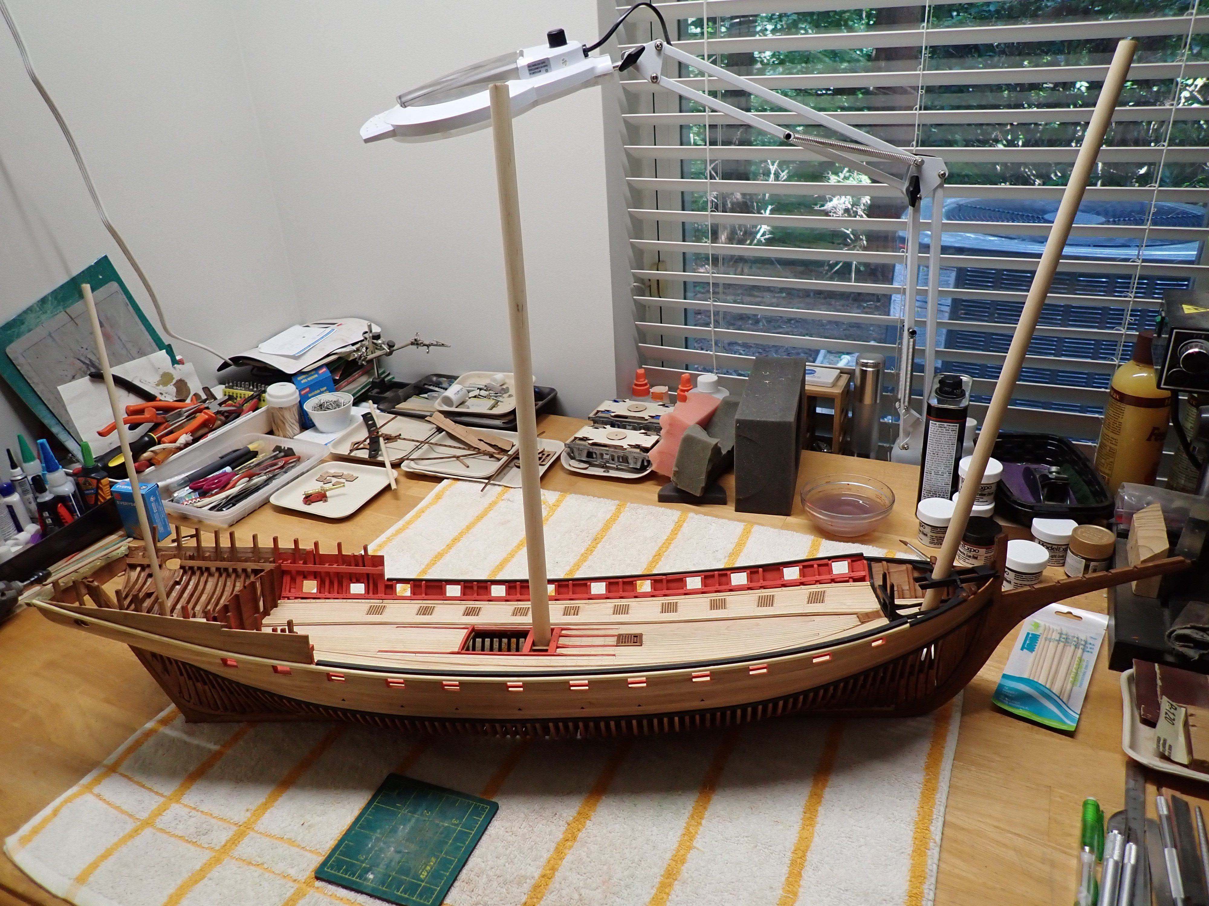

Not much to show but big progress in term of advancement for the rest of the build, with the correct placement and inclination of the mizzen mast. The mast stands at 10 degrees behind the vertical.
I will try to post a picture of all three masts erected to give a sense of that "latina" rigging.

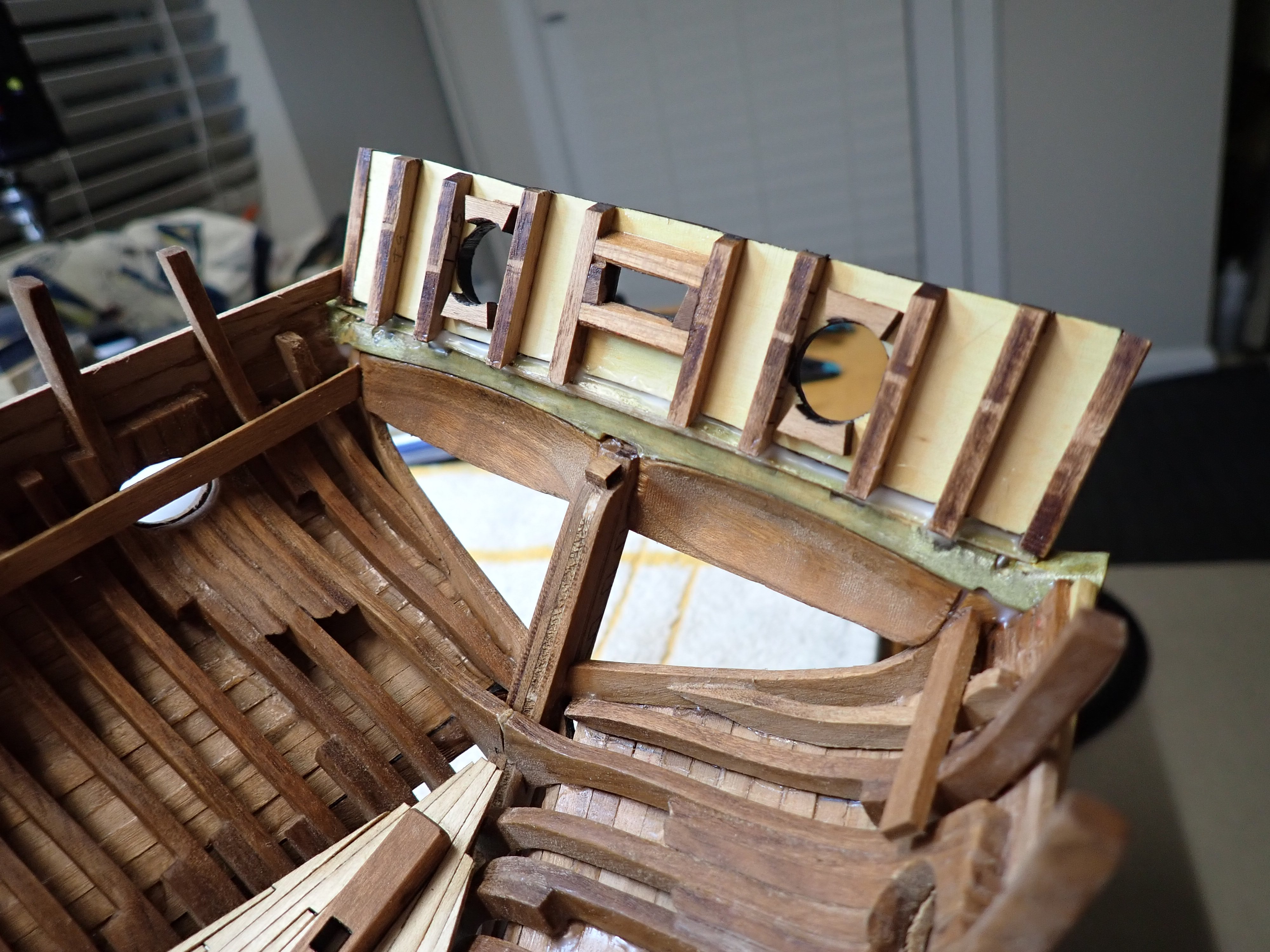

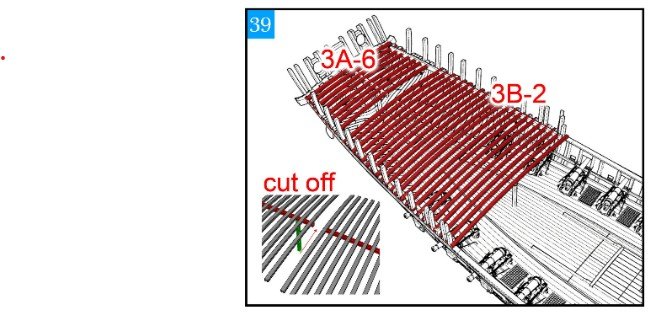

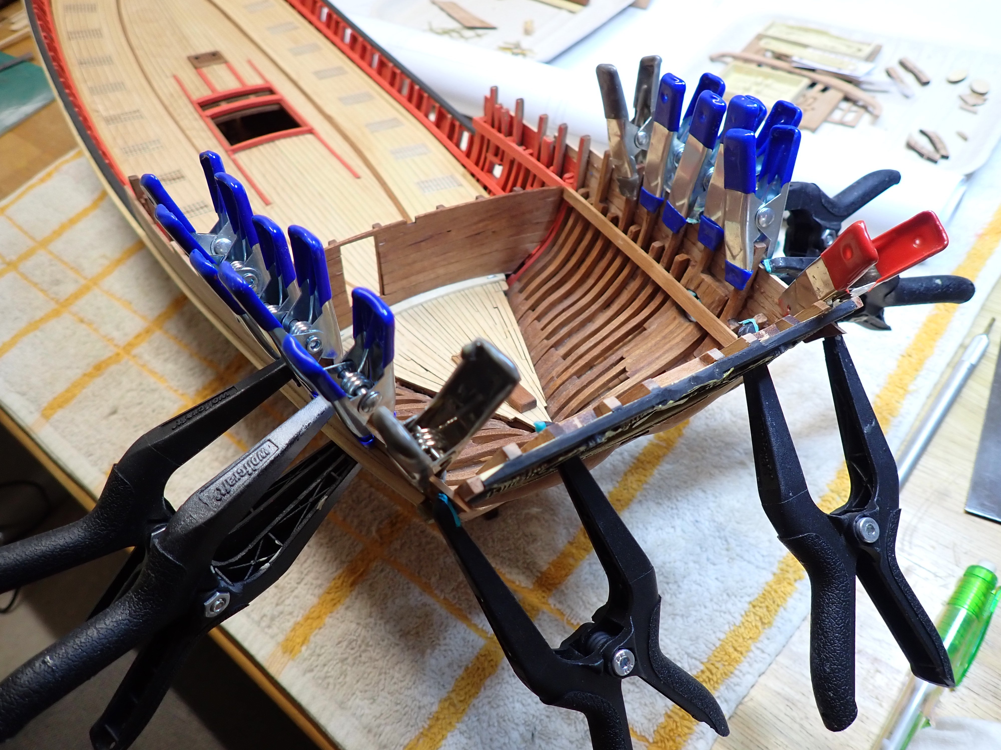

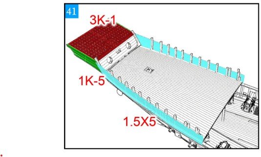

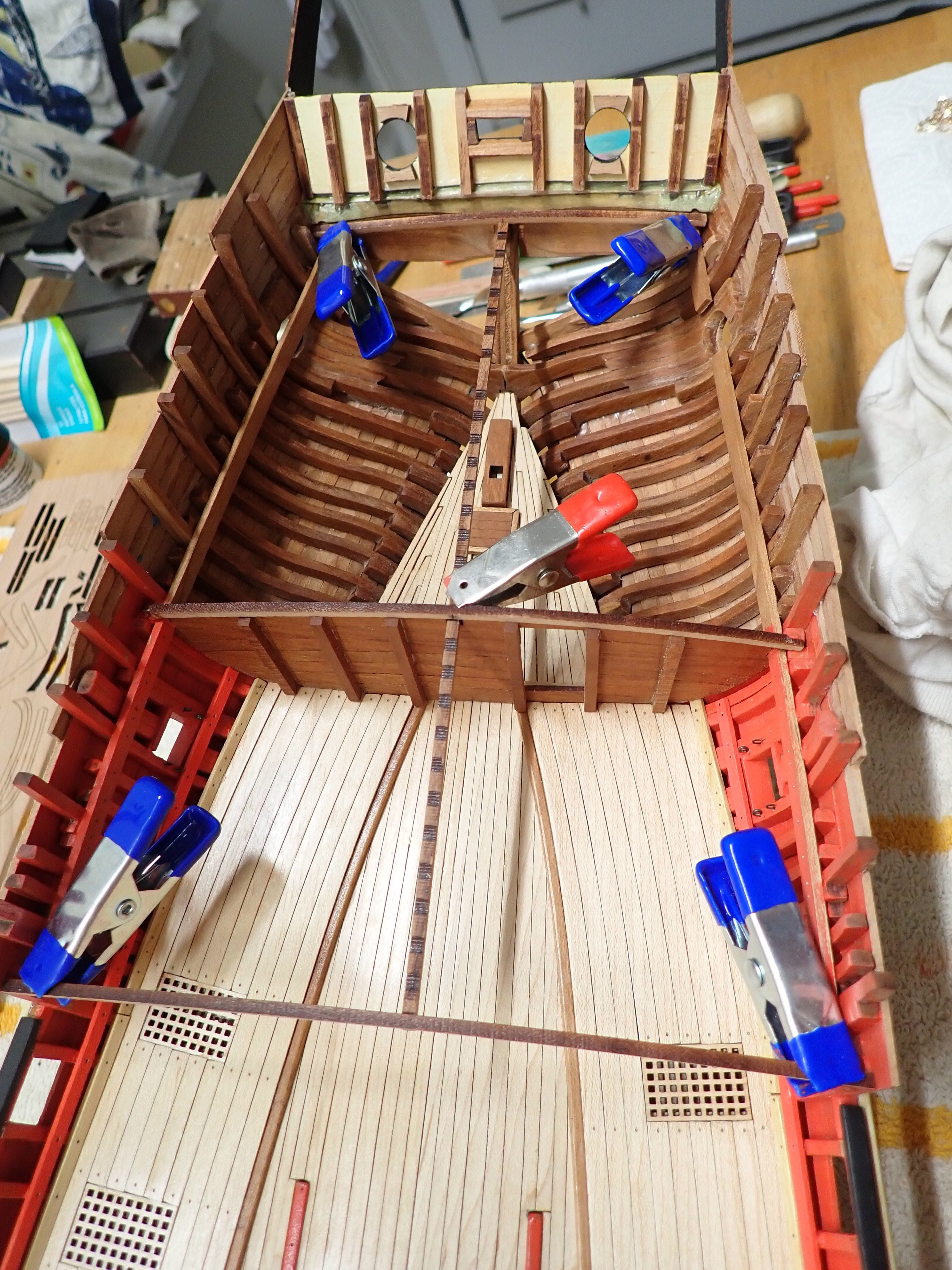

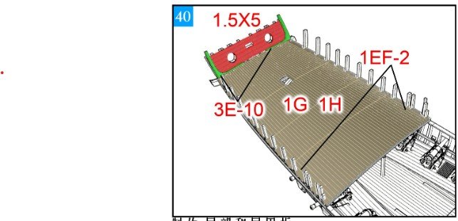

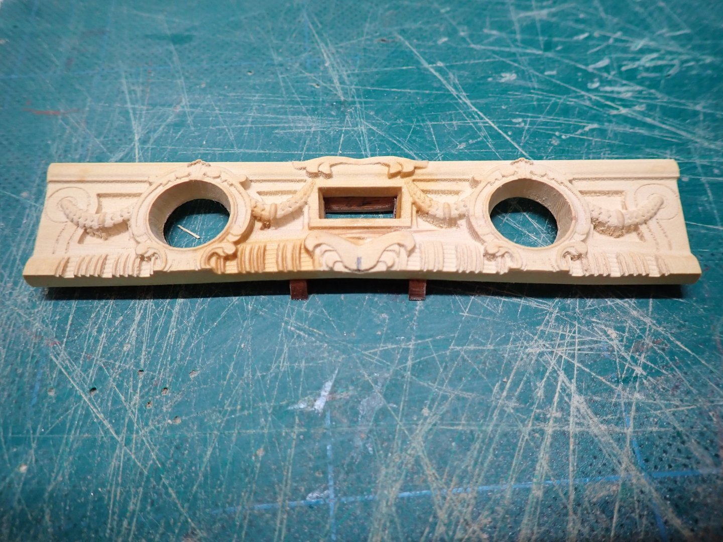

The following is not properly described in the User/Assembly manual and as such, I am not posting any pictures of the CAF Models instructions.
It is a very delicate (in my opinion) phase as the parts are really not fitting well together.

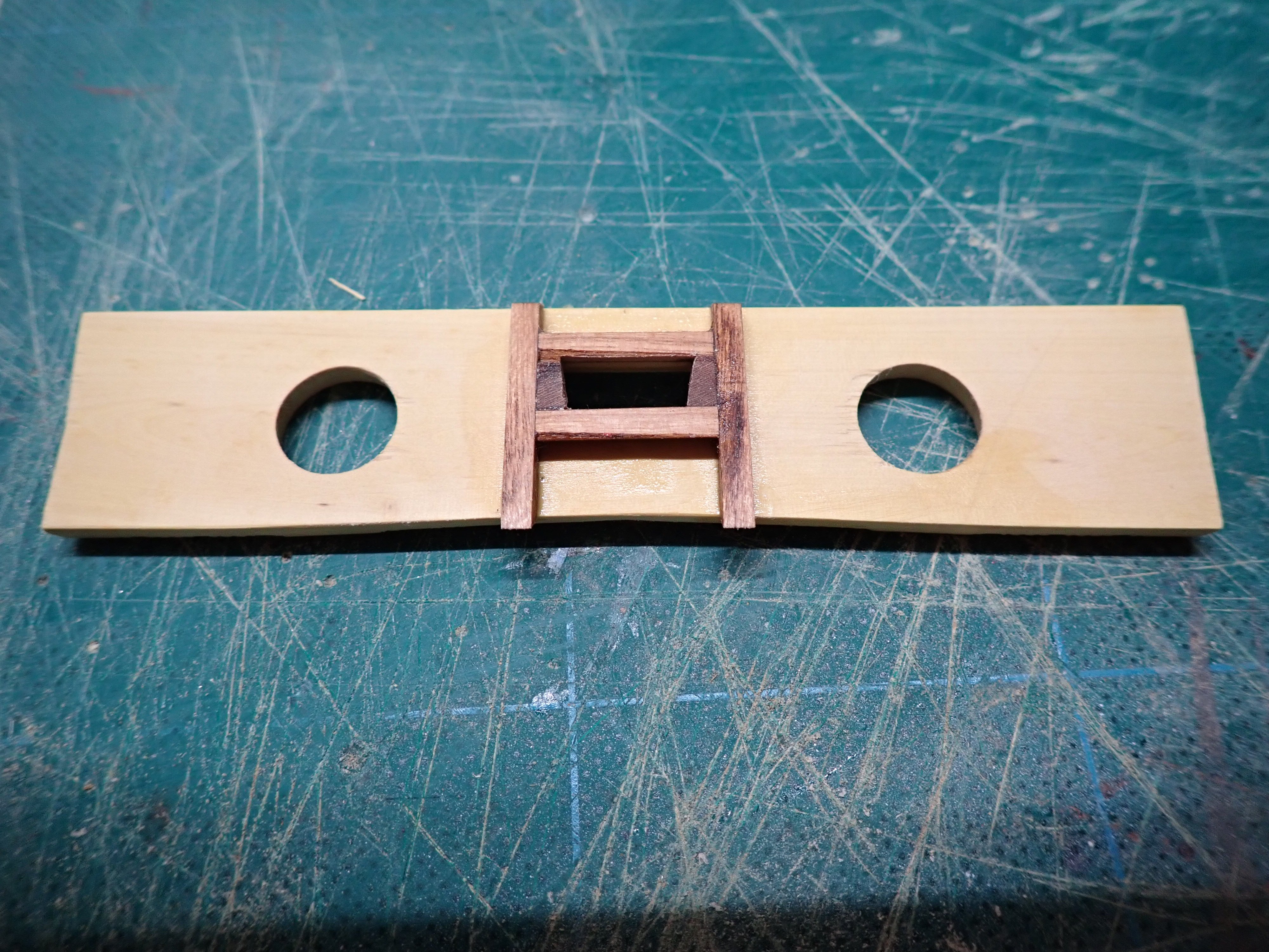

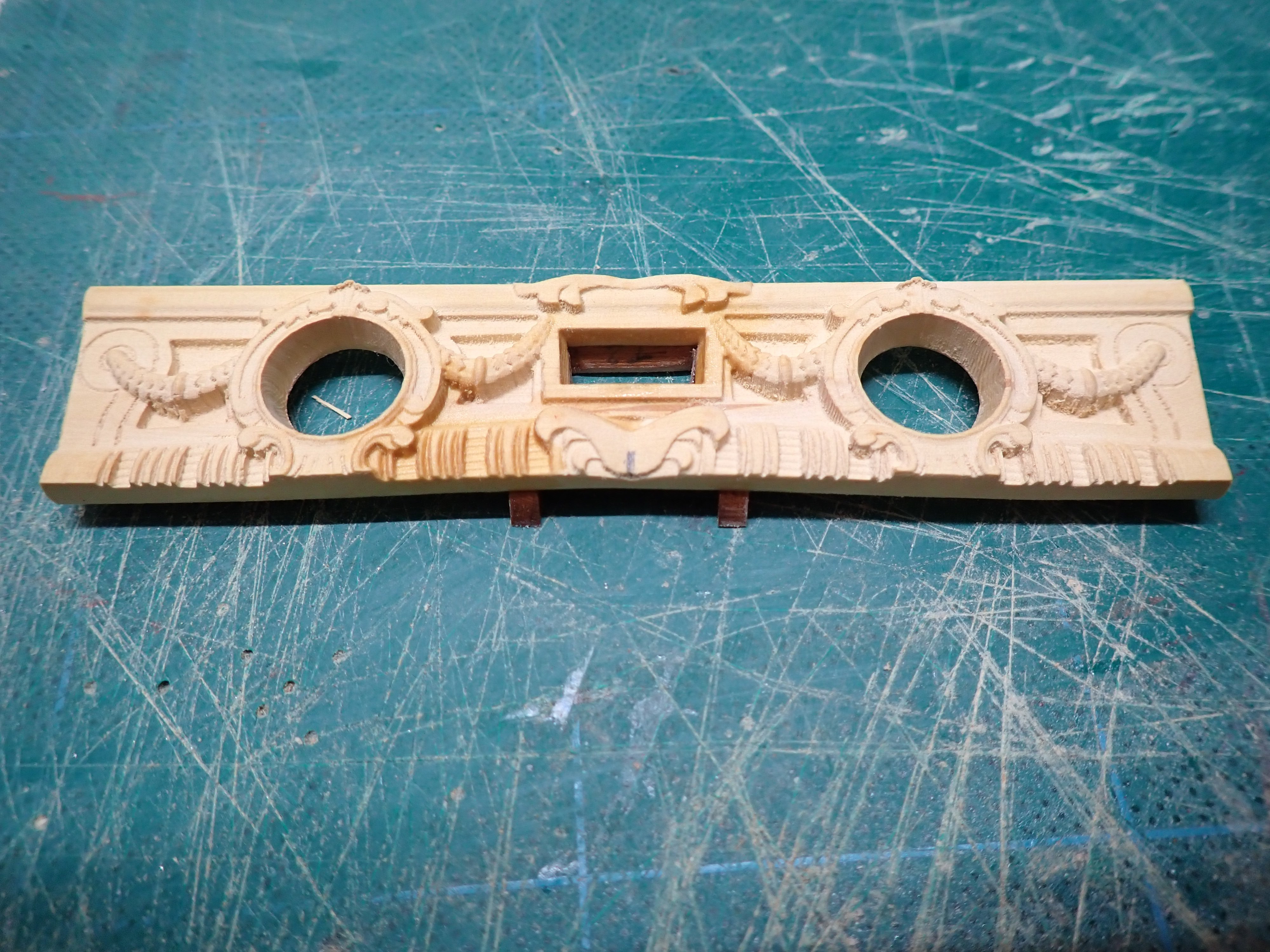

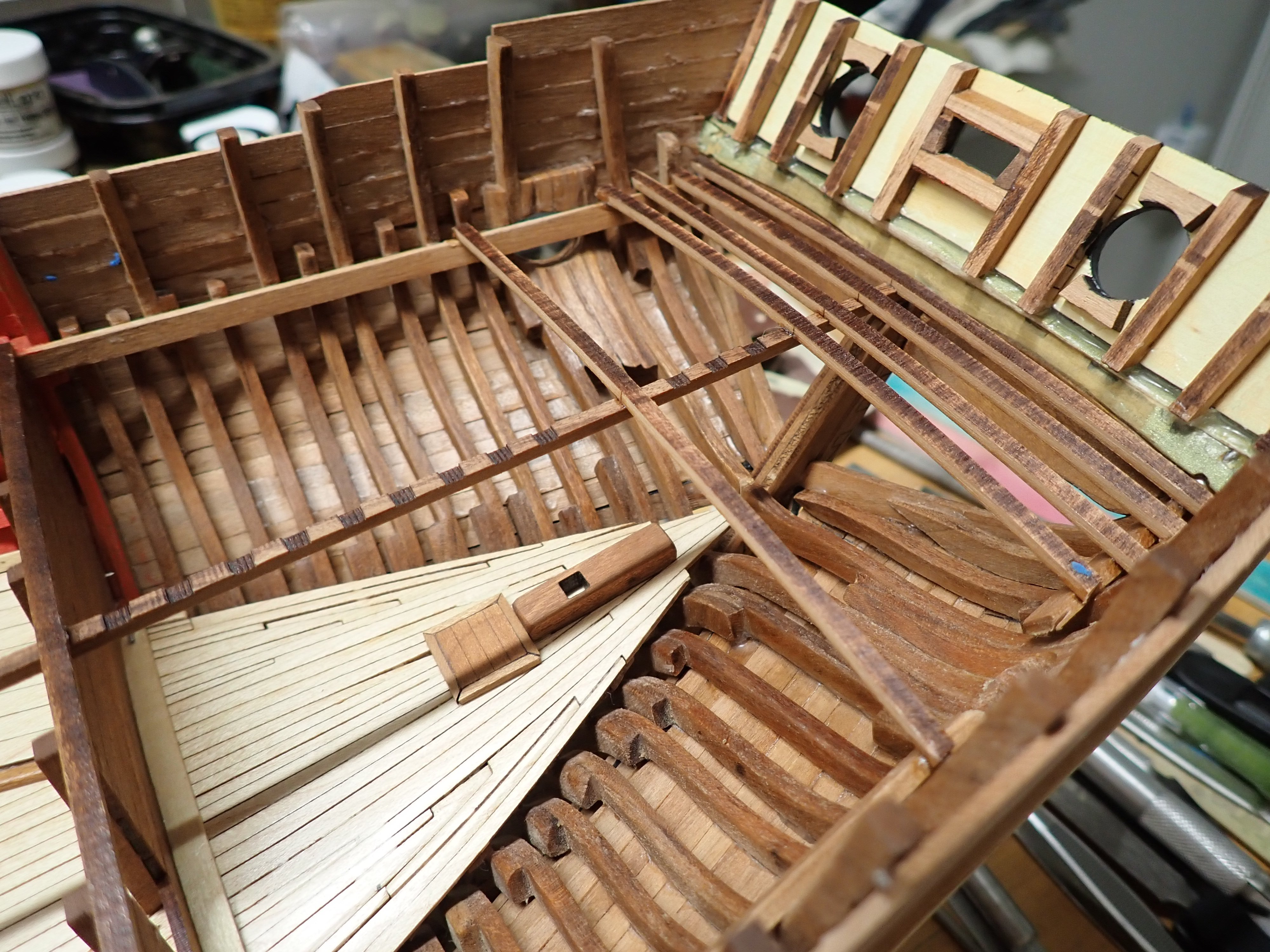

The first thing I did was to build some kind of support for the stern bulkhead:
This was done with multiple layers of 0.8 mm planks, I had left from the Bellona. Some curvature is done to accommodate the stern panel. Despite all this preparation work, it still does not fit precisely. The stern panel is made of boxwood (I think...) carved with a CNC machine. The carving is delicate and actually well done.

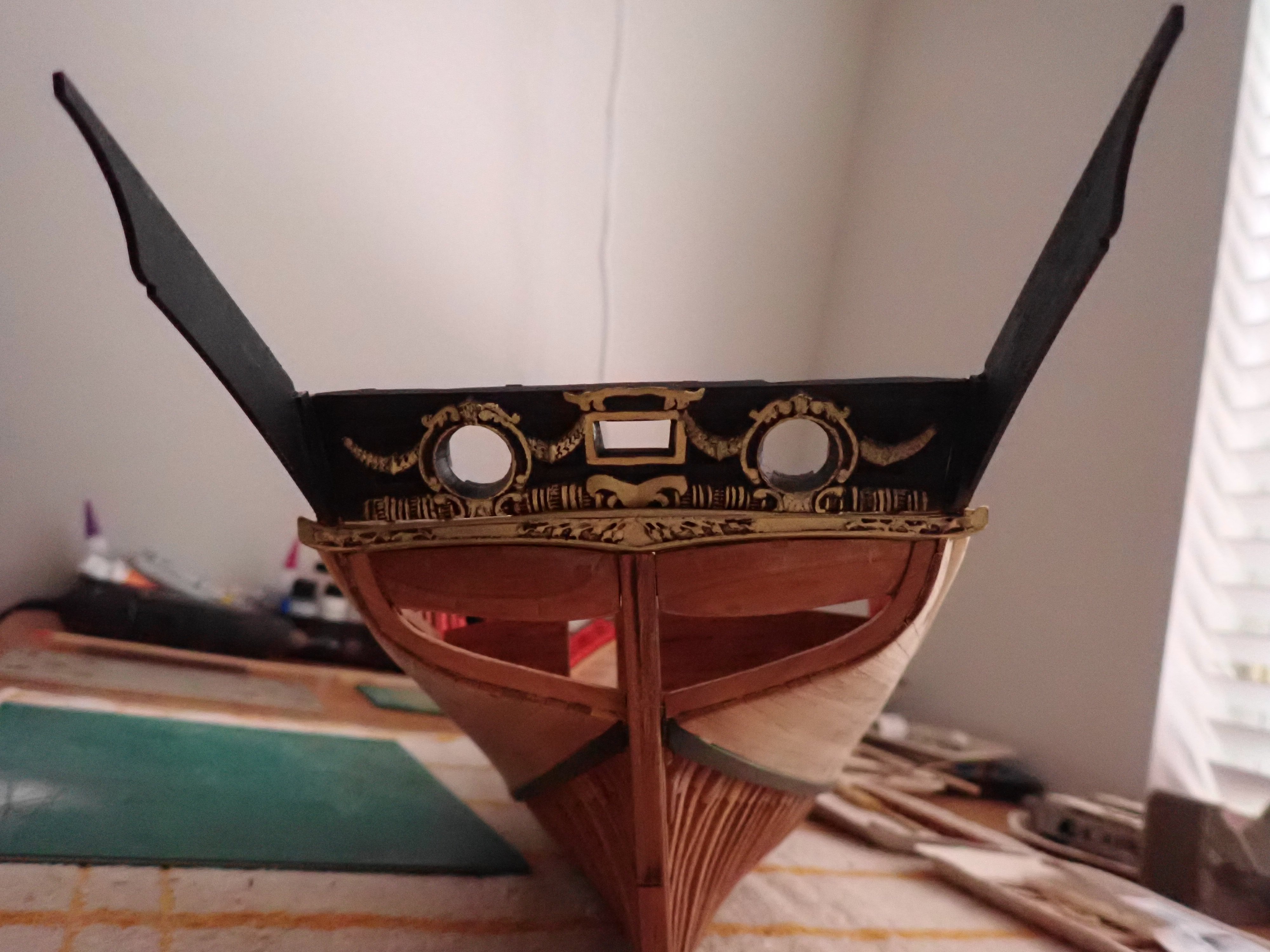

The next steps consist in gluing the various parts that will define and stabilize that panel on the stern. Again, this is my way of approaching that task and there may be better and more intelligent way of doing it.

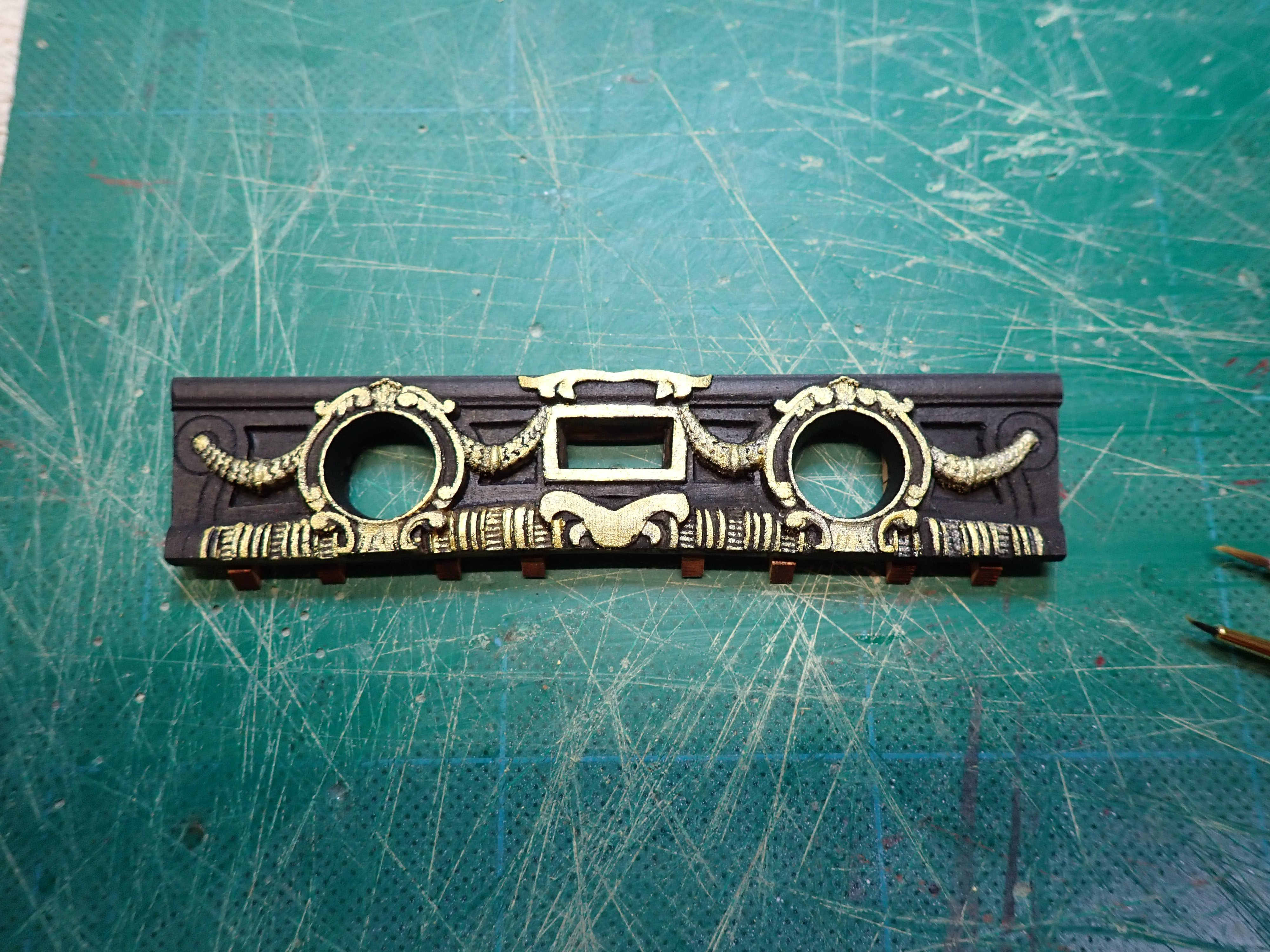

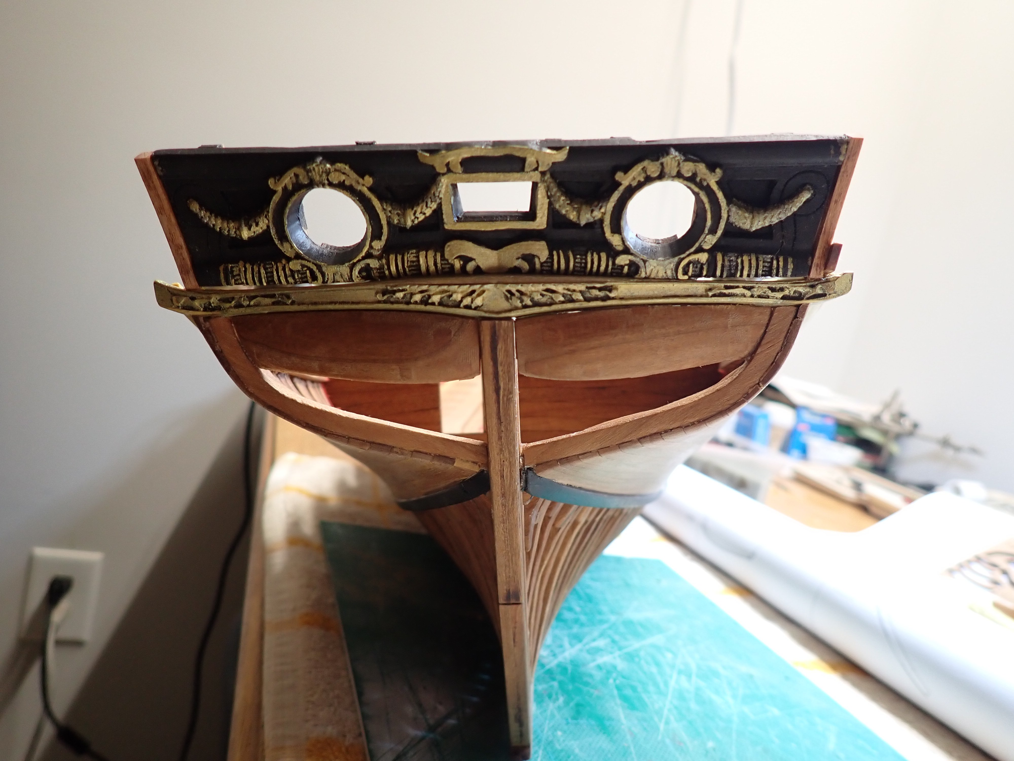

Above, you can see the rectangular opening, used for the tiller. Below, the stern panel is painted in black and dry brushed (delicately) with Tamiya gold leaf color:
The panel is then glued as well as possible, keeping the alignment of the rudder and keel. I have to say that the Monograph by Boudriot came handy as the CAF instructions and plans are very quiet on this subject. You can see on the left and right side, some light peeking through. Once the quarter deck and the rear veranda are in place, not much will be visible.
This assembly is still very fragile and it is important to continue building the planking of the upper part of the hull:
I have been agonizing before that task for a while, and even though it is not perfect, I am glad it is behind. There are more challenges coming, so stay tuned.

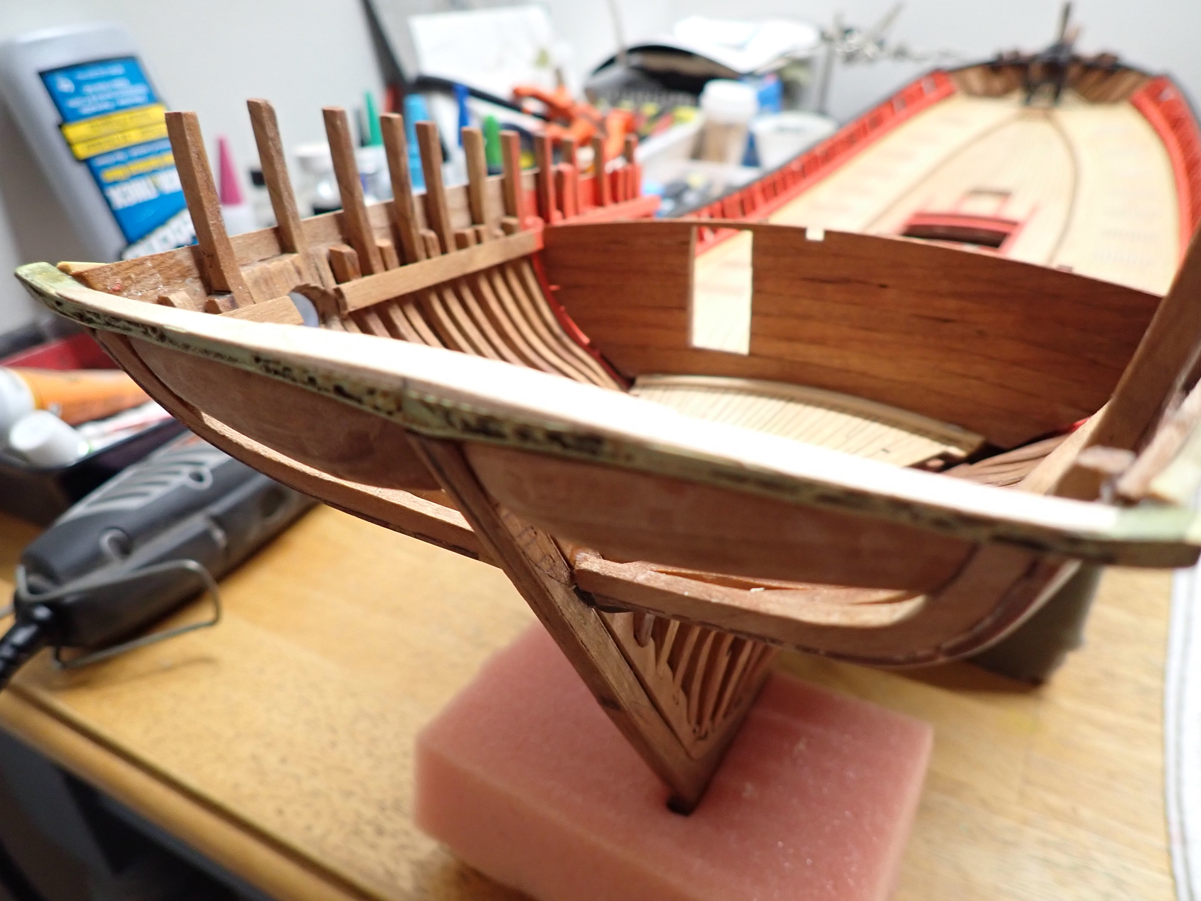

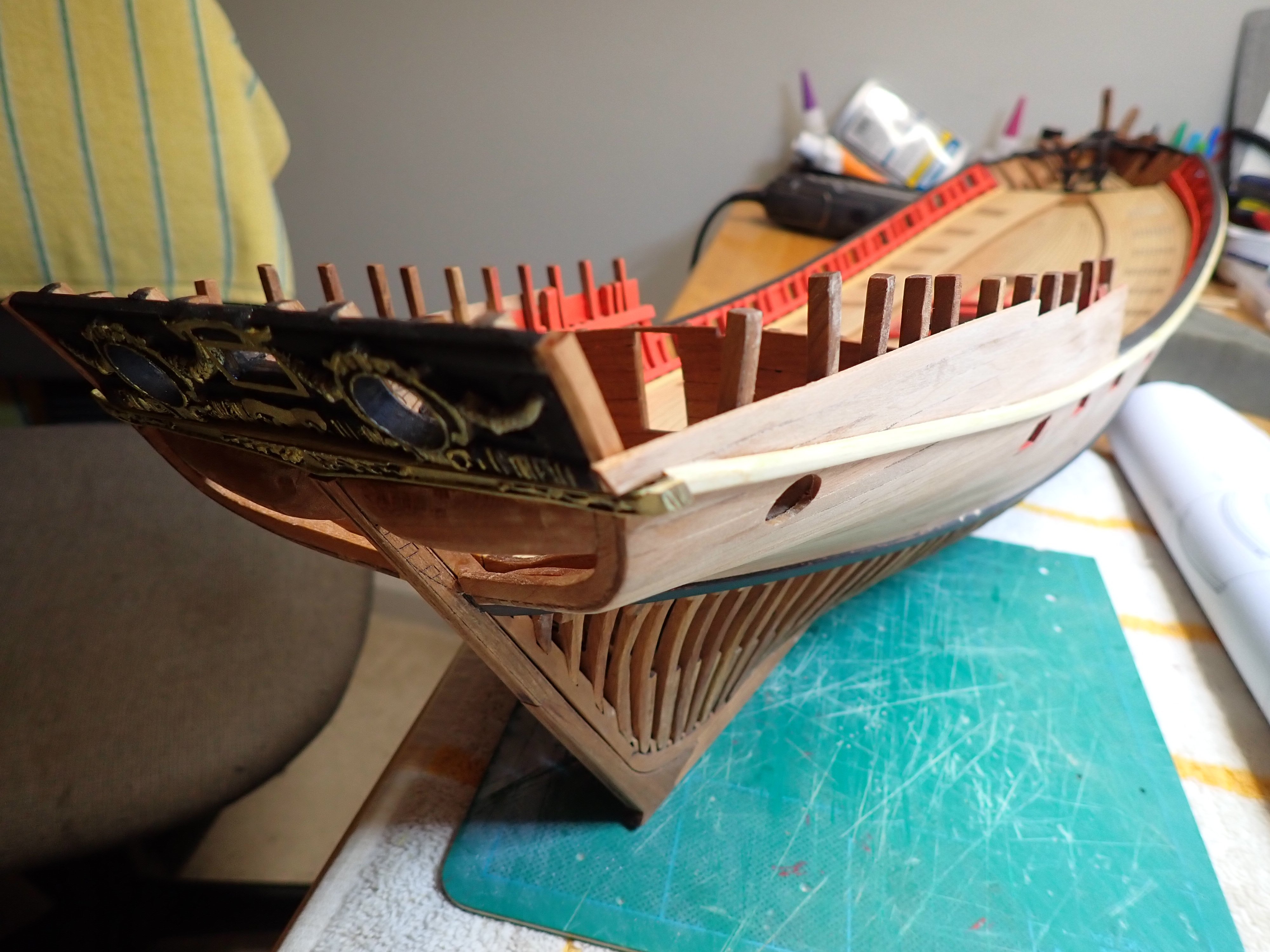

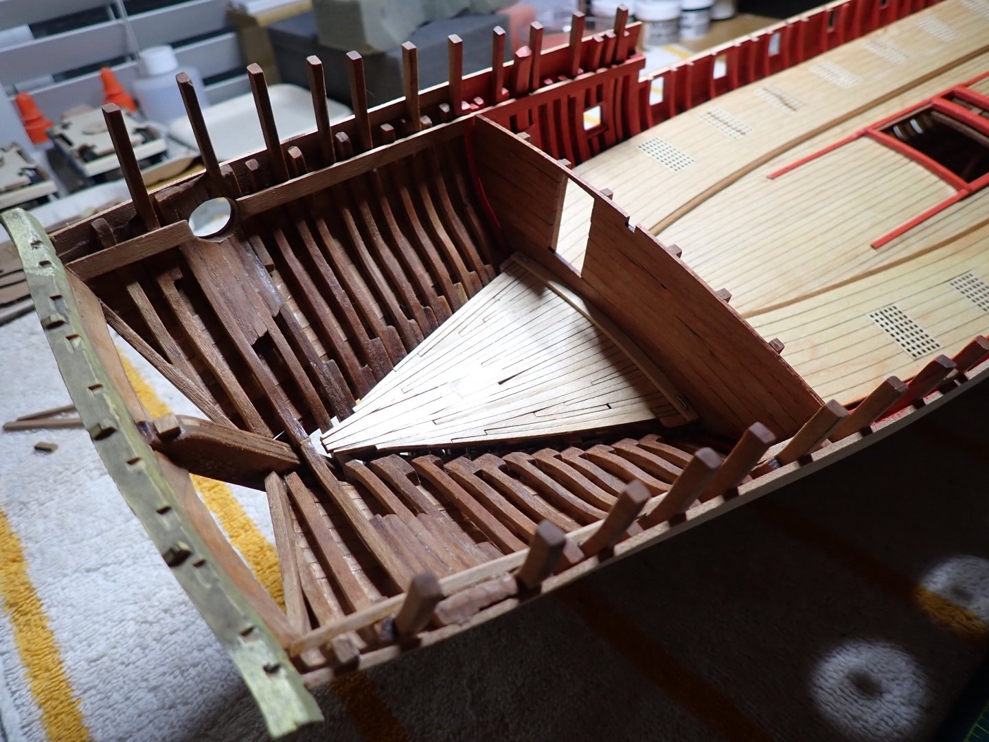

I am still progressing without following the official instructions, just going along with what makes the most sense for me.
After installing the stern panel, I managed to glue the side extensions of the hull:
All this is still very fragile and will require a lot of care to avoid breaking them. The large wooden grid on top will help re-enforce but cannot be installed until I built the planking on the stern from the inside deck. And before doing that, I have to build the quarter deck and its planking. The following drawings will give you a better idea of what I am trying to do and how it needs to happen:
Of course, before completing the quarter deck planking the door of the cabin and the guns must be installed, on the gun deck. Therefore, the various hooks are set in the frames:
