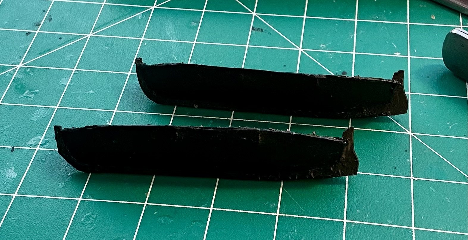

The railings and other small pieces are made and installed on the mine launches:
The rudder structure shown in the instructions/plans won’t fit on the boat in the cradle.
I cut that structure off once I realized.
Once the boats dry I will paint and seal them.

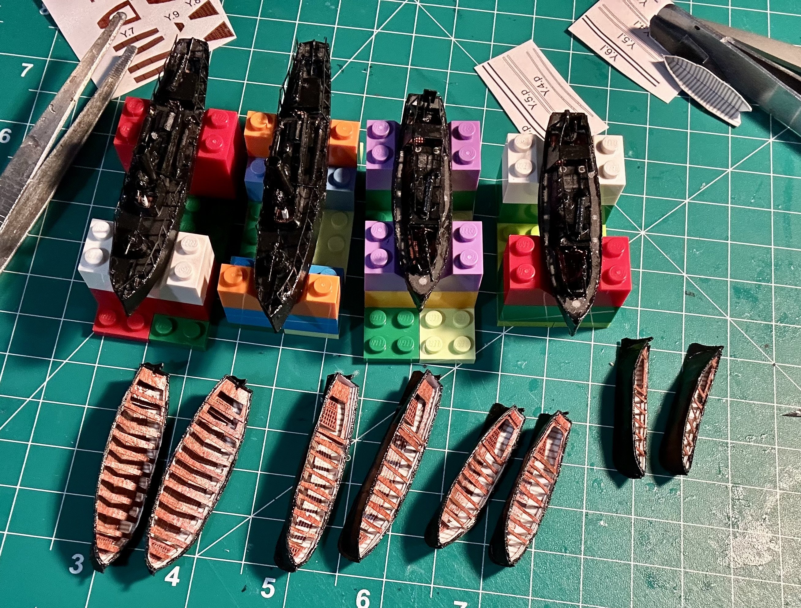

15 hours ago, Glen McGuire said:
Nice use of Legos, Phil!
Glen,
  Thank you very much!  I found out about that trick on this forum.  Legos make excellent quick customizable jigs and temporary cradles.  I bought a box of 1000 bricks and then a couple of those small suitcase type starter sets from Walmart when they went on various pre-Christmas/Easter sales.  They have been immensely useful on several different projects.
Also, they make a great square for traditional POB construction.  They are 90 degrees, especially when built into a block and can be clamped into place, thus ensuring square construction of a POB hull.

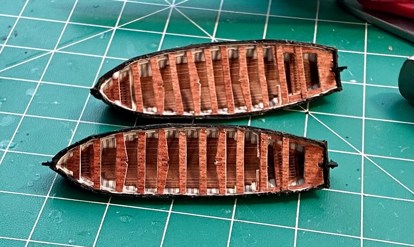

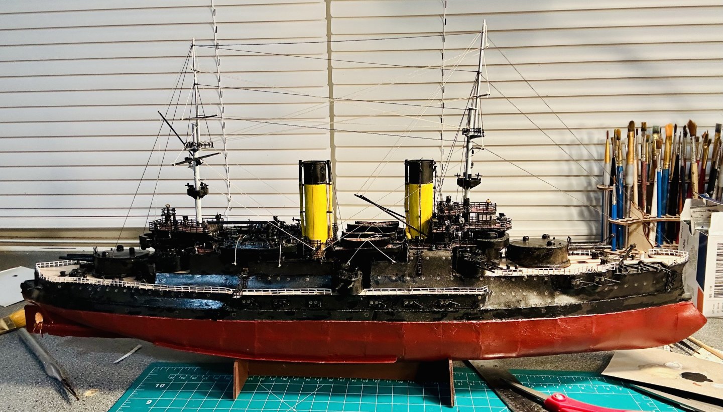

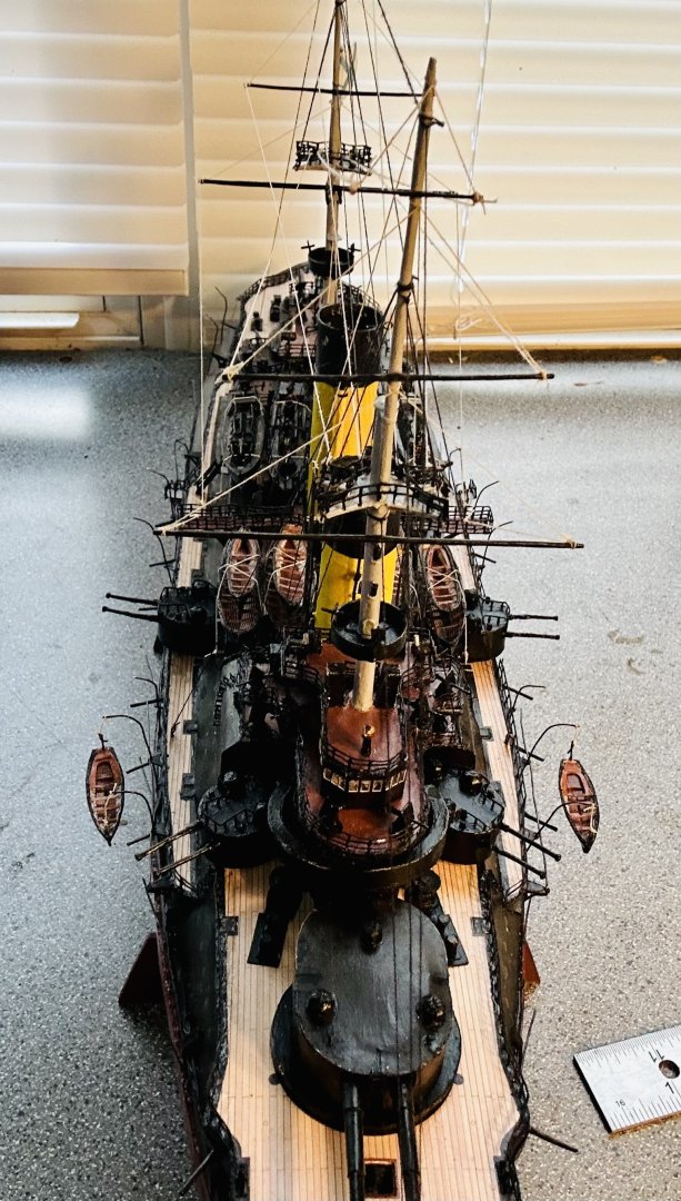

The first set of the rowed ship’s boats are done:
I was able to use them to ensure alignment of the cradles, which are now painted and mostly sealed:
Here is the overall ship:
Now to finish the ship’s boats because they are started and then to make some yards and run some running rigging!

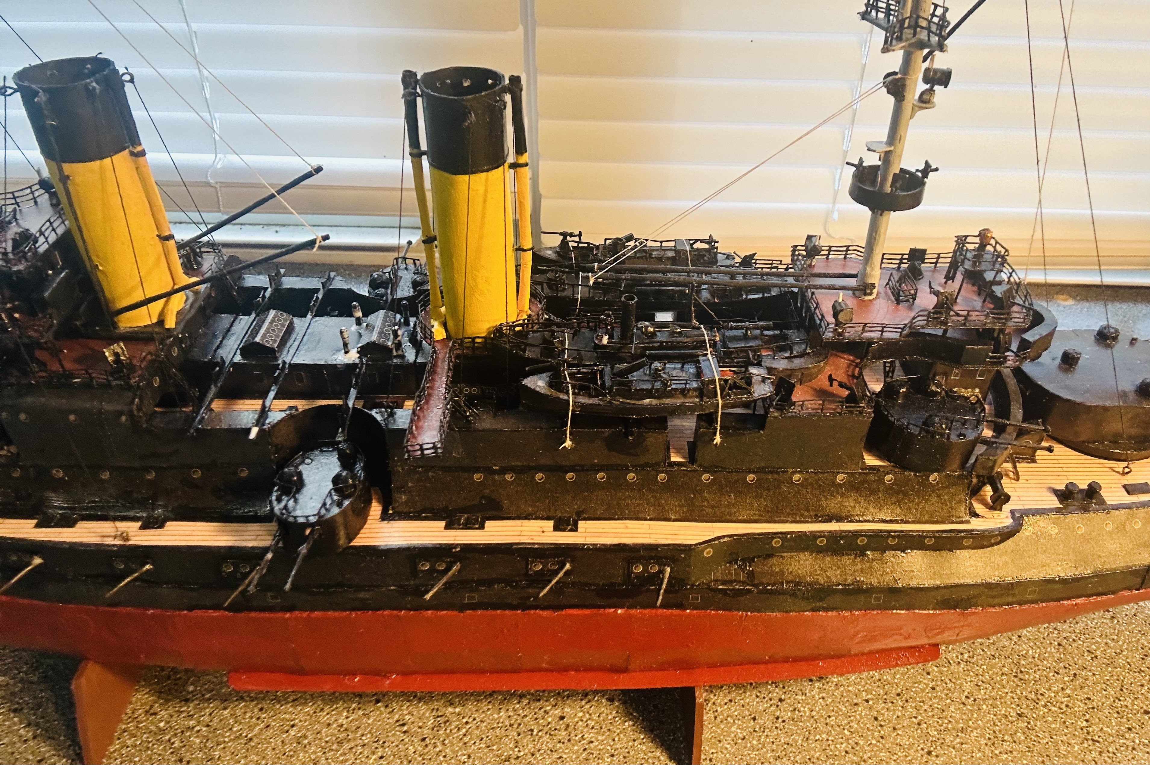

So, I installed the two sets of steam boats:
Definitely making progress!

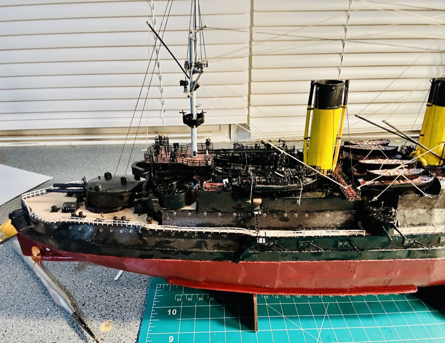

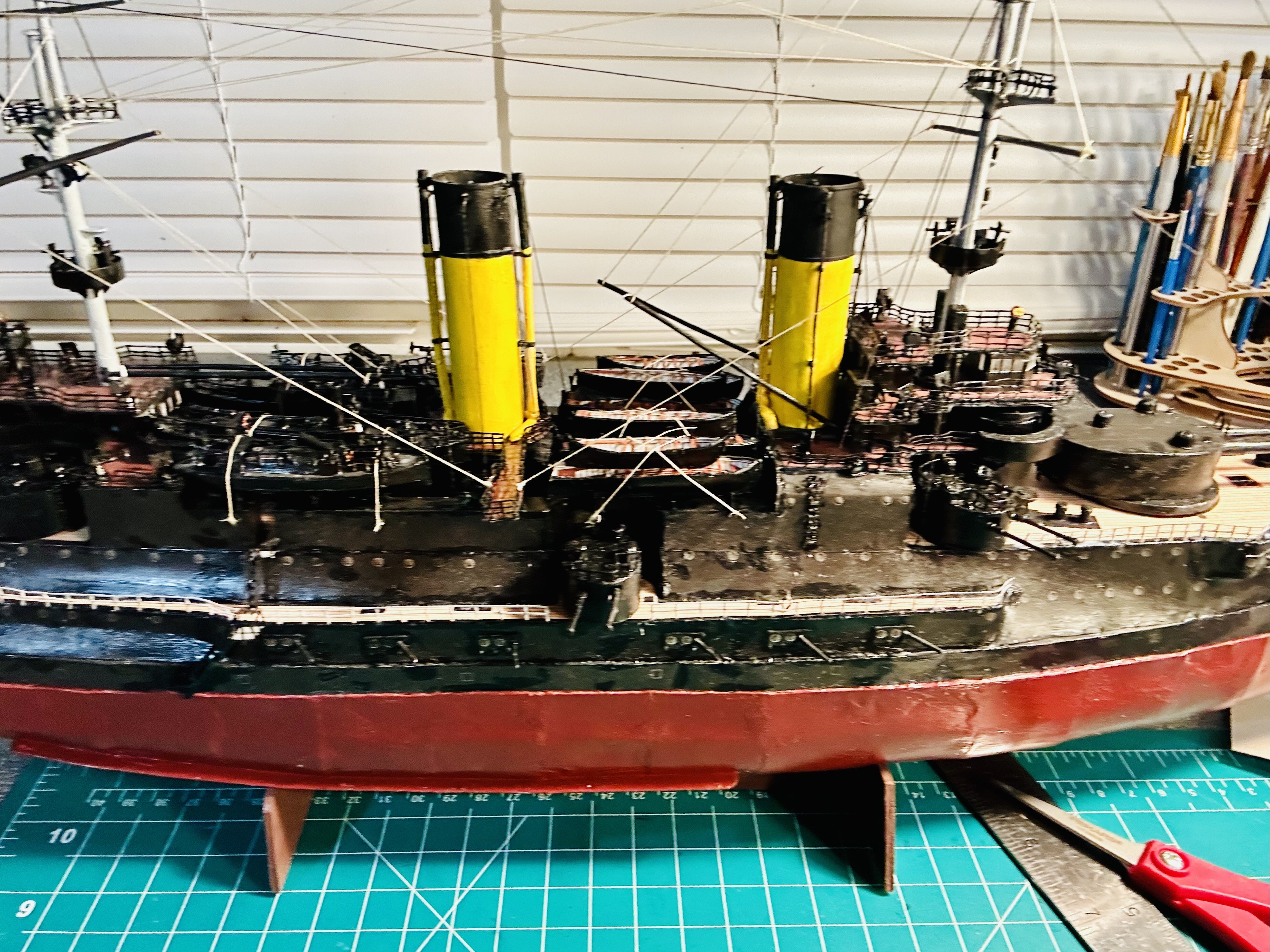

The rest of the cradle stored ship’s boats are installed:
Next up, I will be making/installing the yard arms and finishing the running rigging.

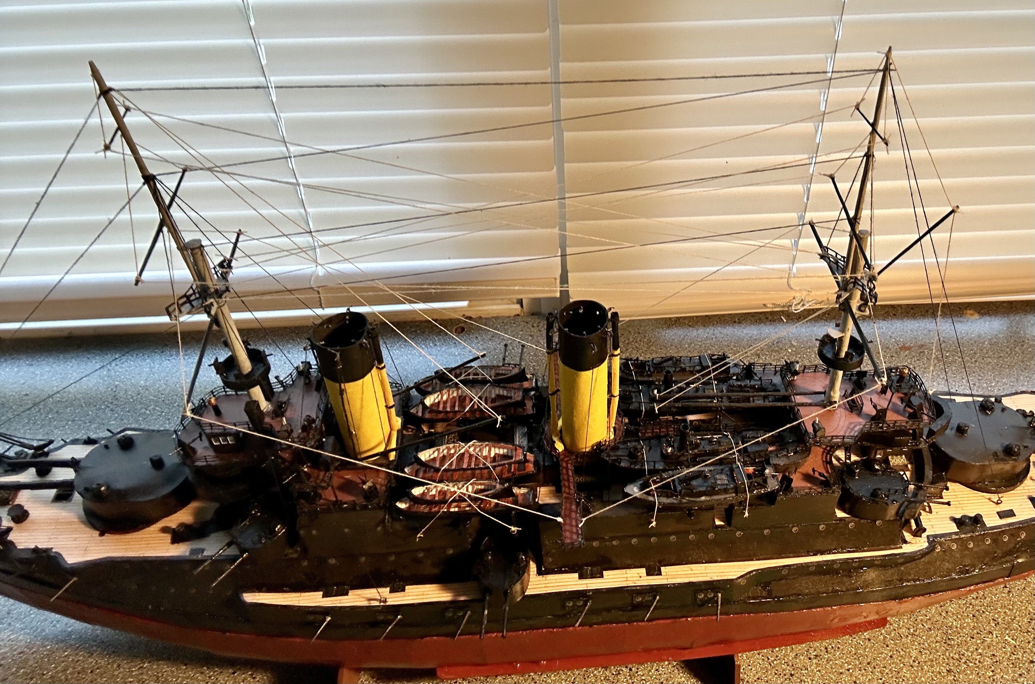

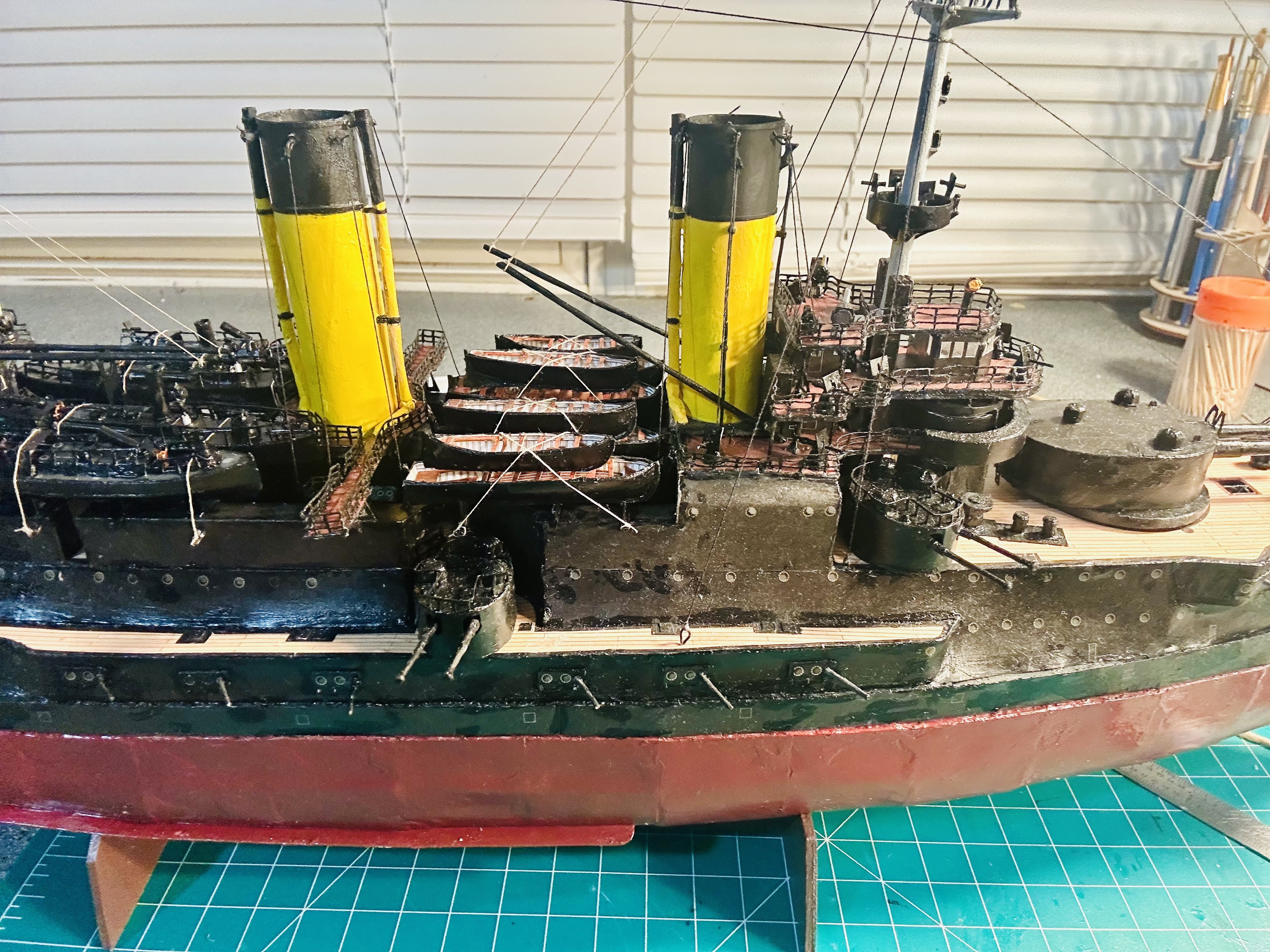

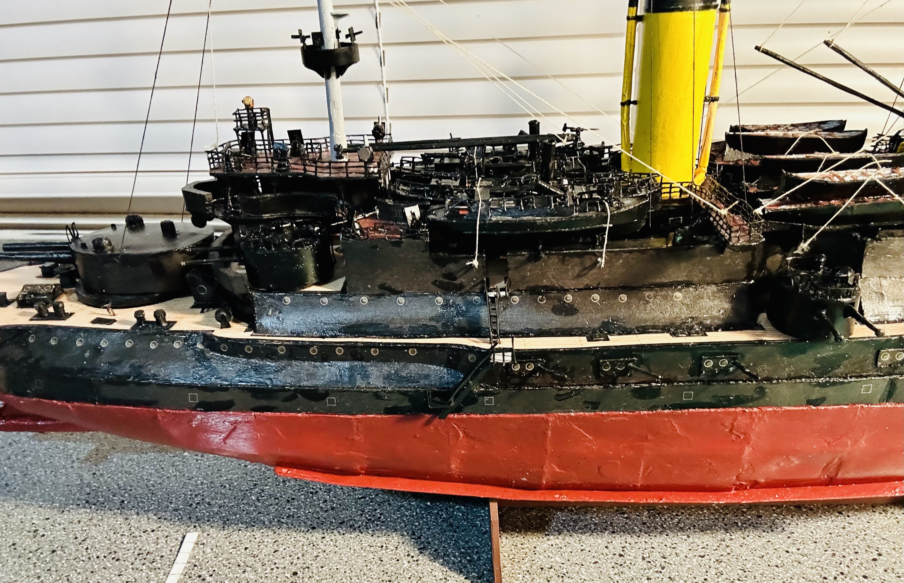

The yards and running rigging are now made and installed:
That closes out the inner structure!
Now on to the outside of the inner bulwarks!

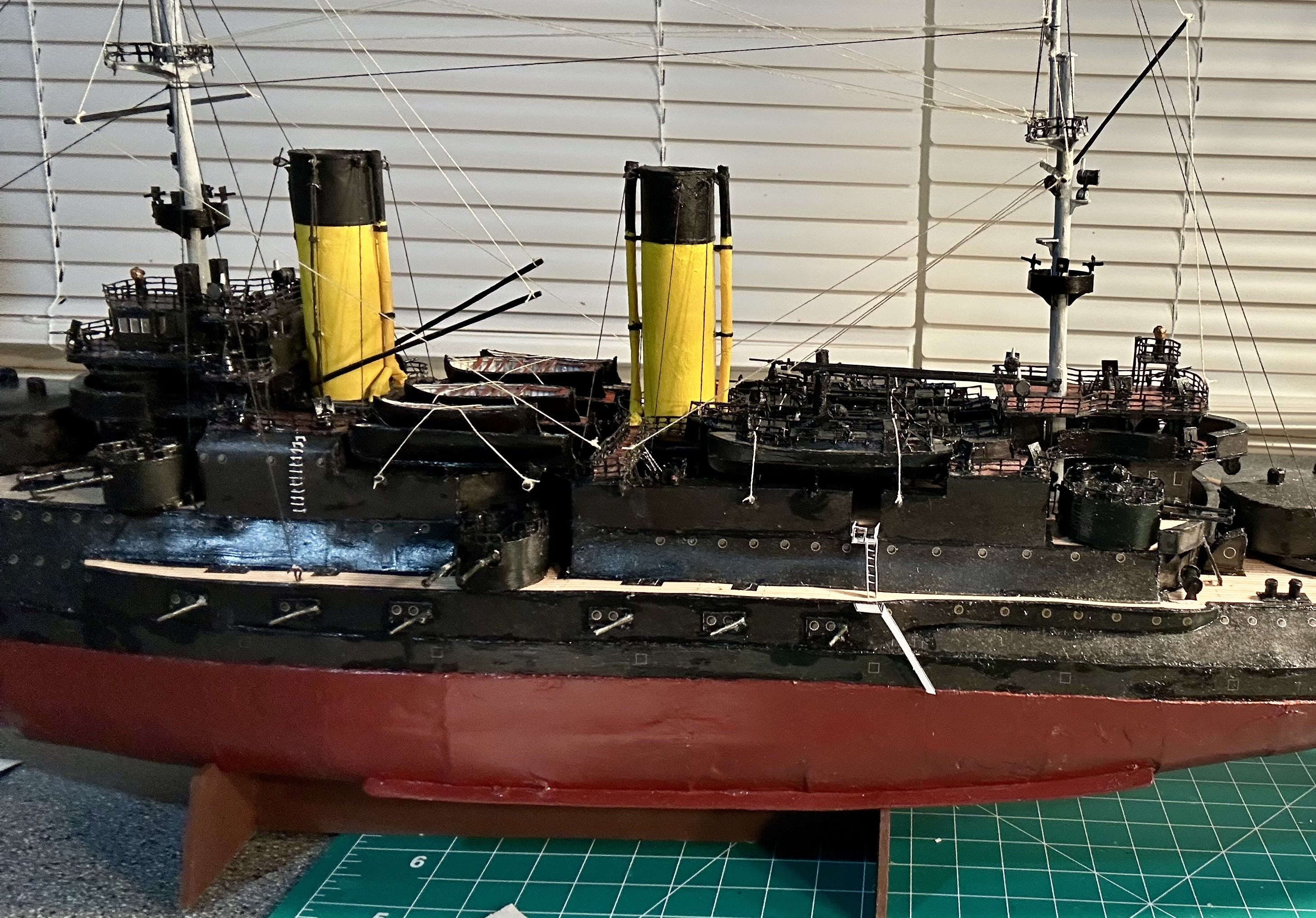

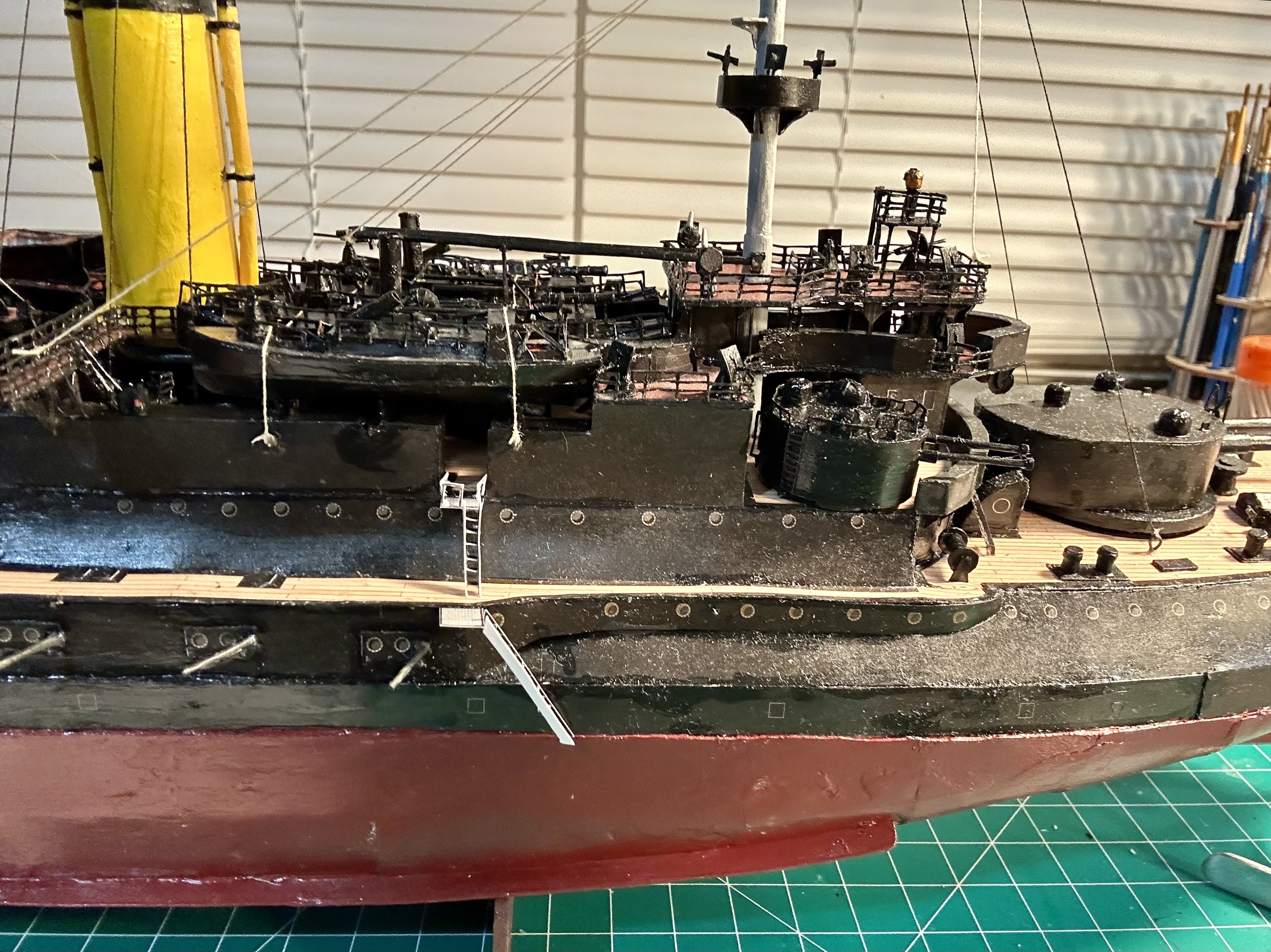

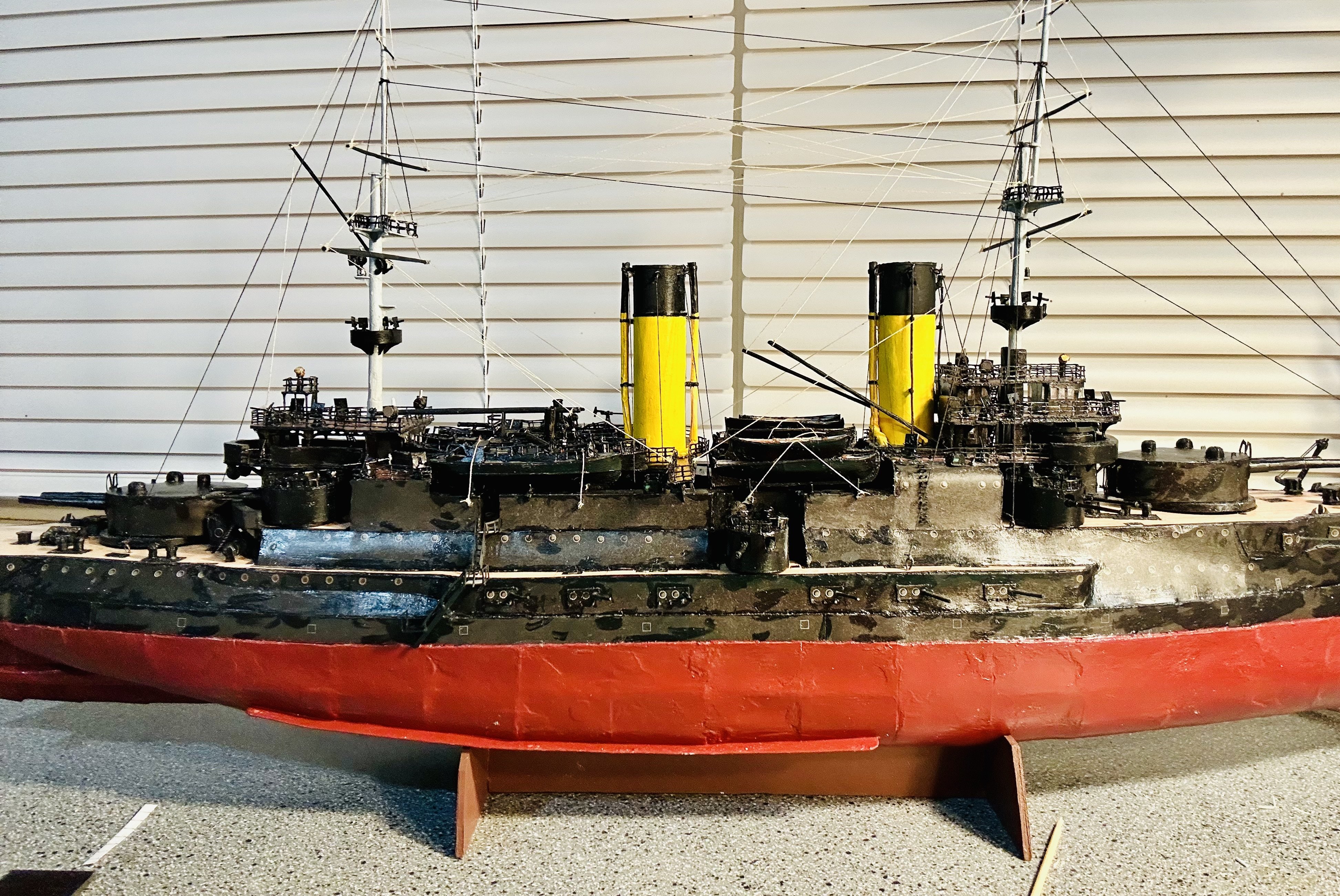

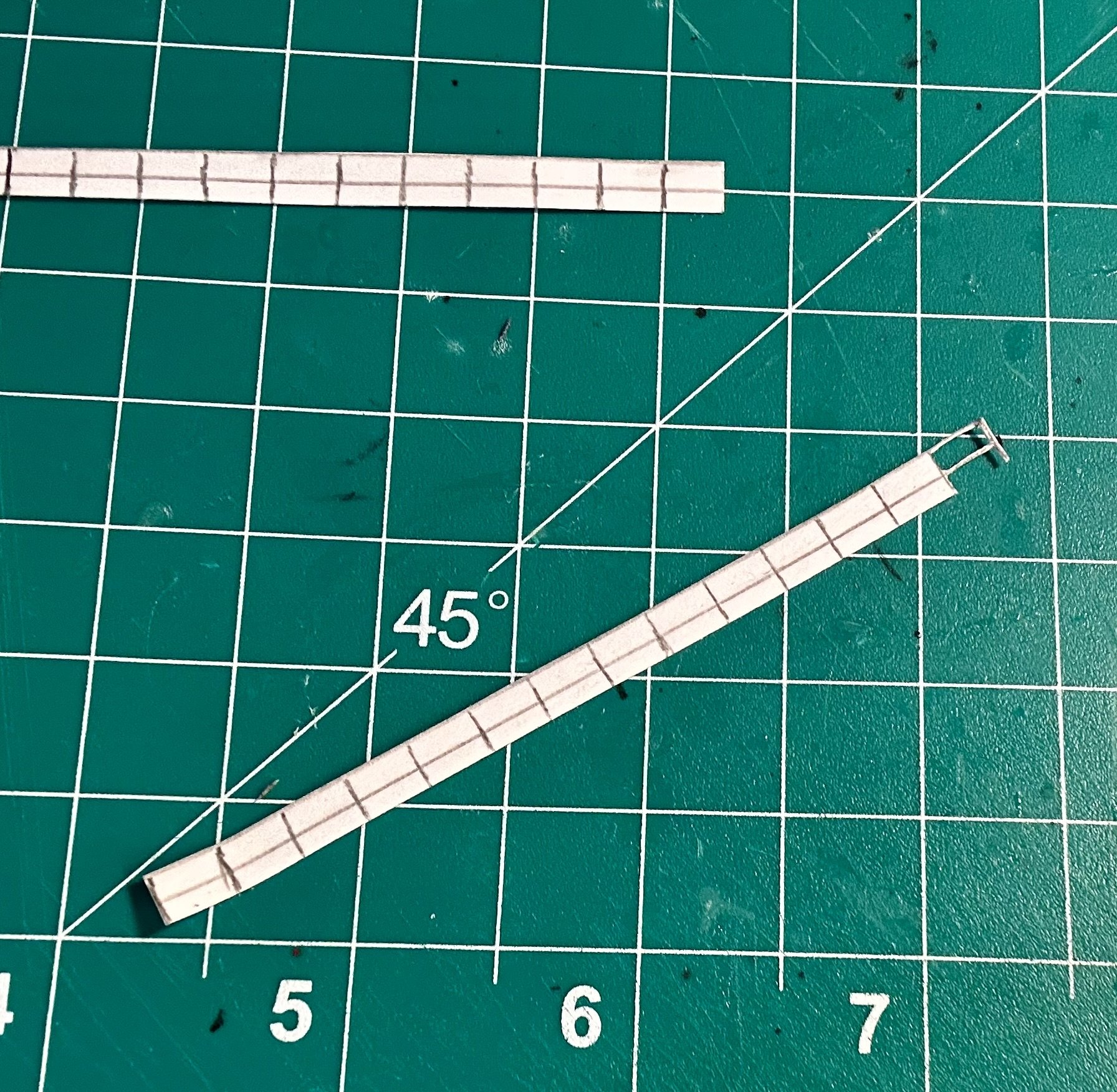

I have the boarding ladders completed:
Some parts still need sealed, but the entire superstructure is now completed.

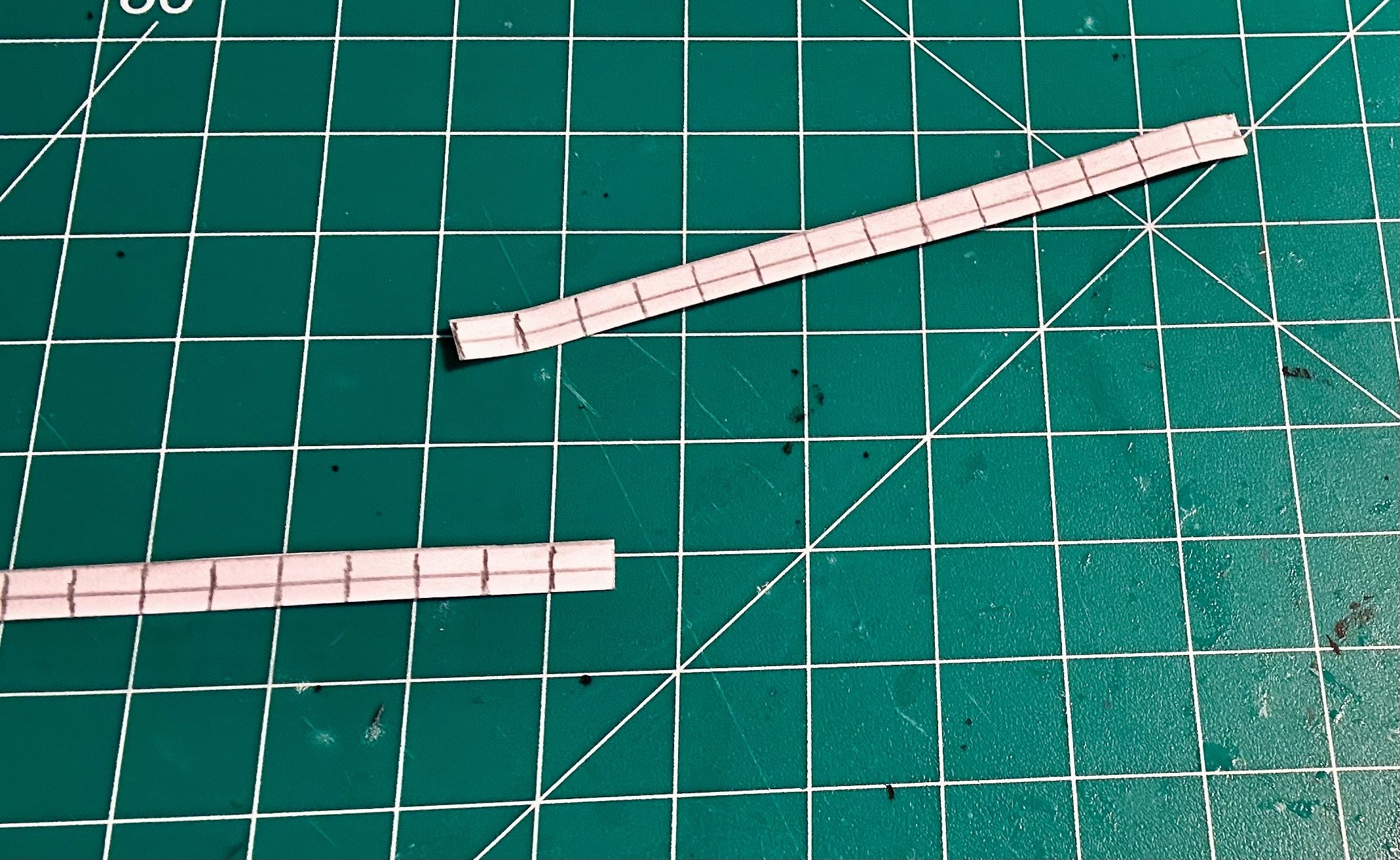

I am currently working on the railings around the main deck:
My method, which is modified from a method that I learned from Digital Navy’s how-to section before their website went down, is to draw out a bunch of railings.  I usually go down the long side of a sheet of cardstock for bulk railings.  Then, I seal both sides with my Folk Art brush-on clear primer.  Then, I cut that out.  Then, I cut to size and preshape/score the railings.  Lastly, I cut out the empty area of the railings.
It takes some practice and a lot of care and patience to avoid cutting the frames.  But if that happens you can glue them back together with PVA.  It’s not really any big deal.
I usually paint them after gluing them in place.
I like how they turn out and they avoid me having to mess with brass or string.  Neither one usually works out well for me.

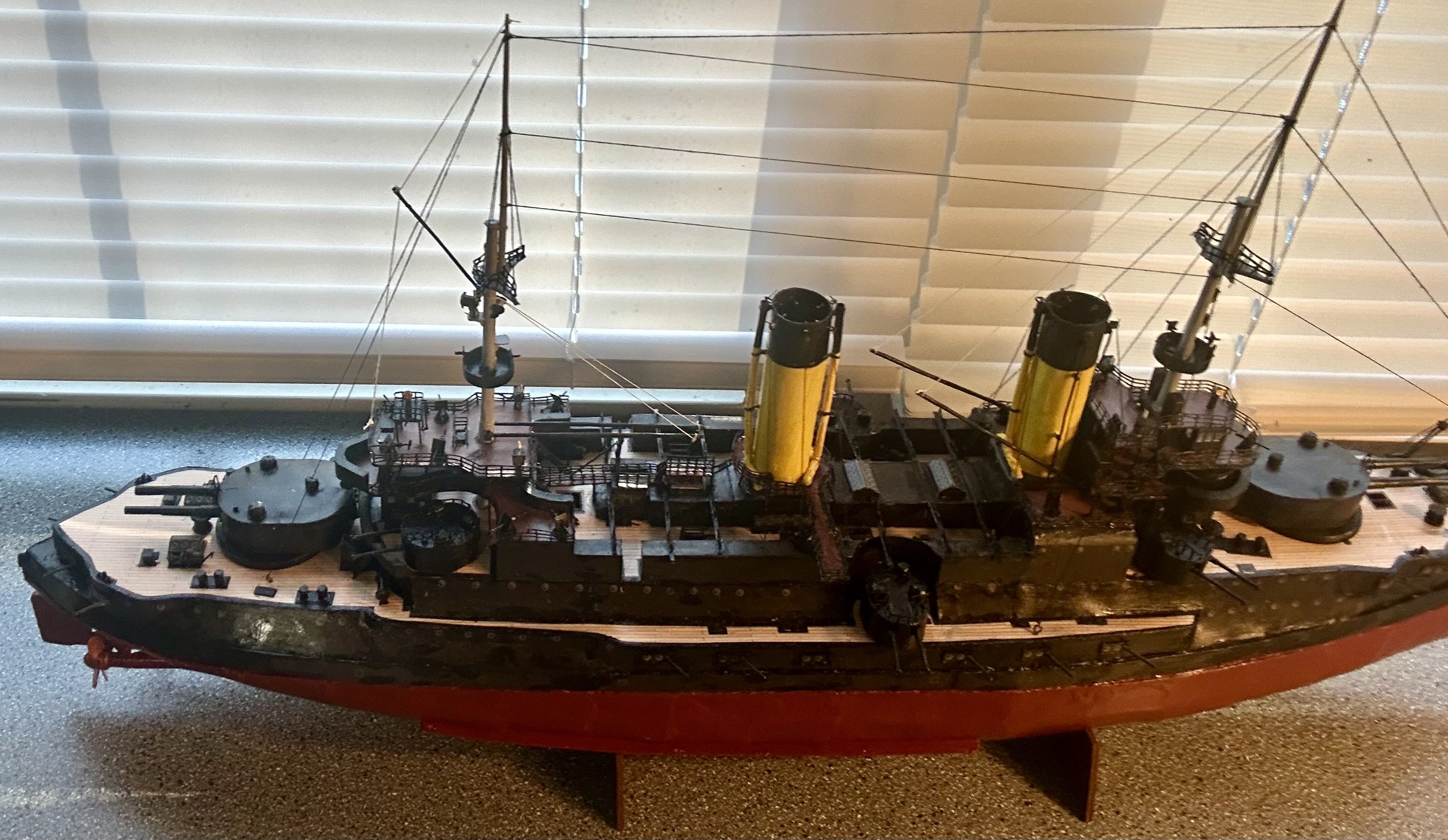

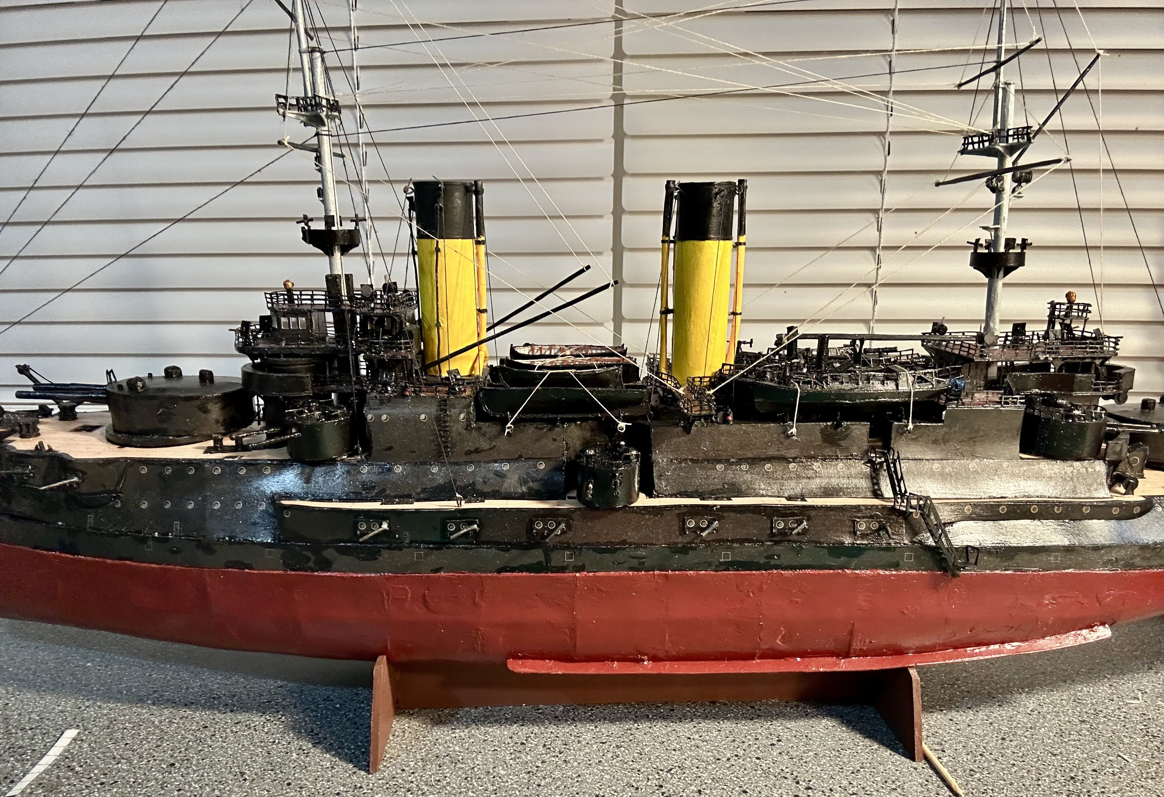

The amidships railings are installed:
Time for the aft deck railings!

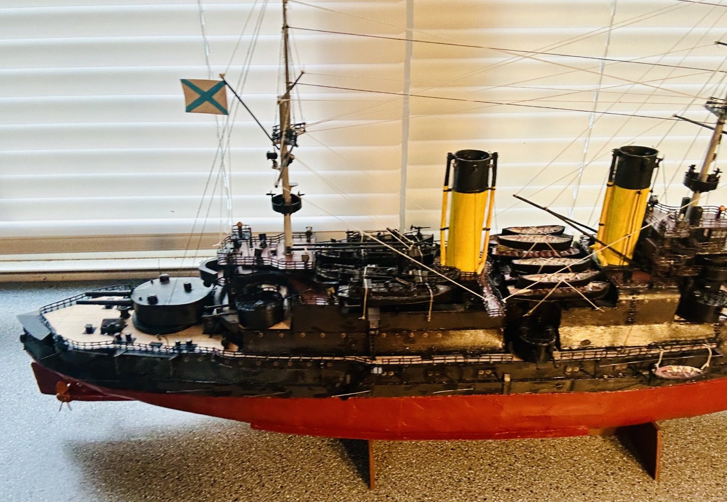

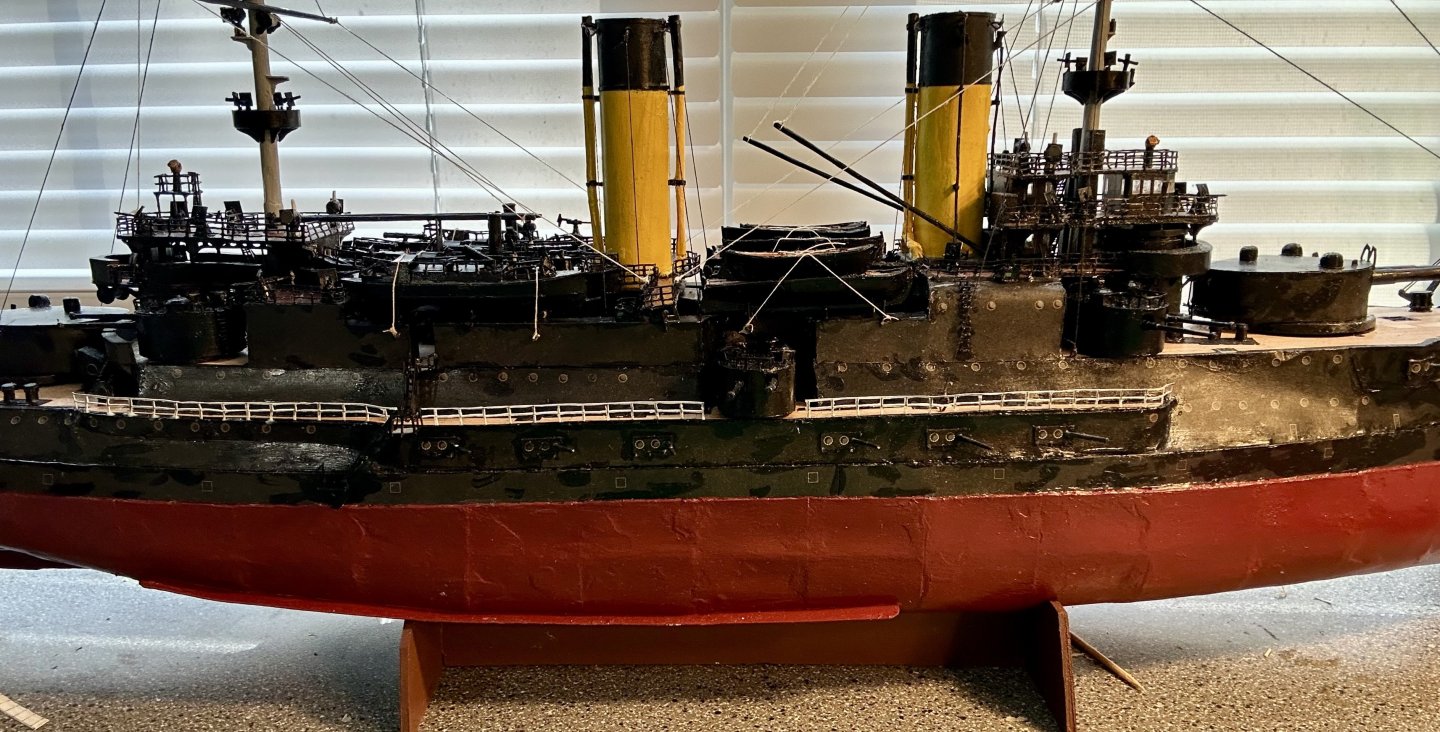

The main deck railings are made and installed:
They still need painted.
The last railing on this model is the decorative railing on the Admiral’s Walk.
Edited by GrandpaPhil

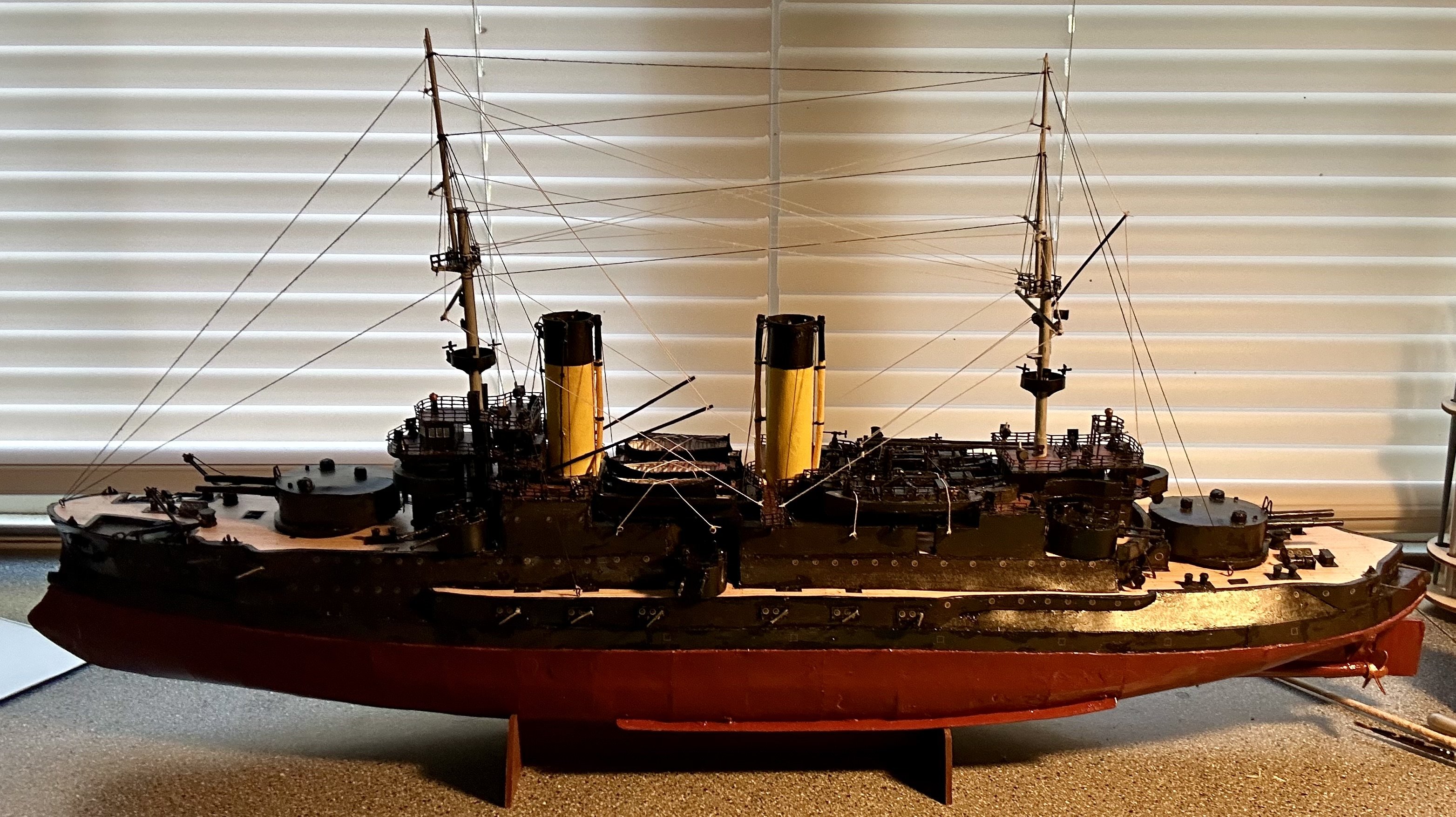

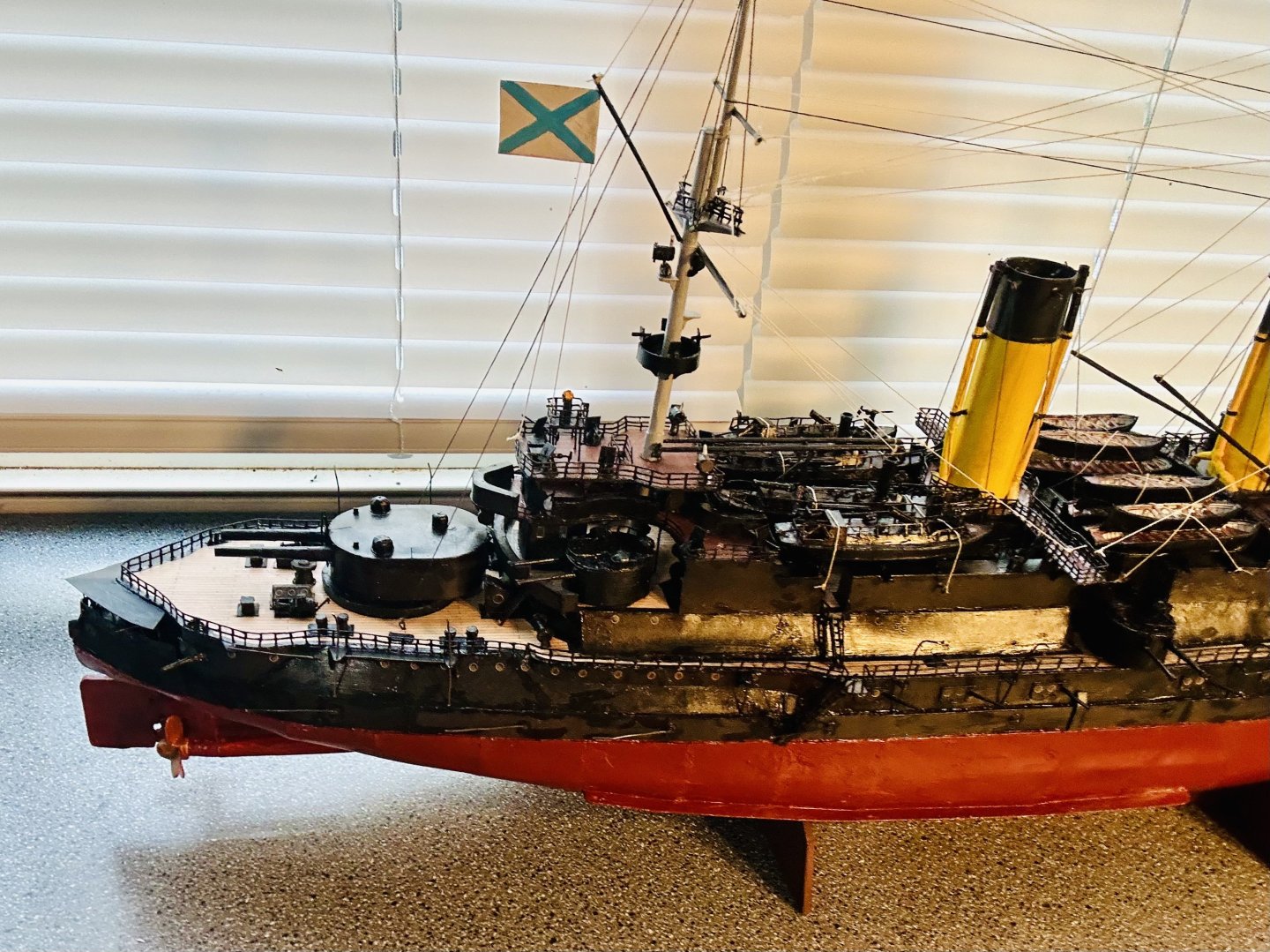

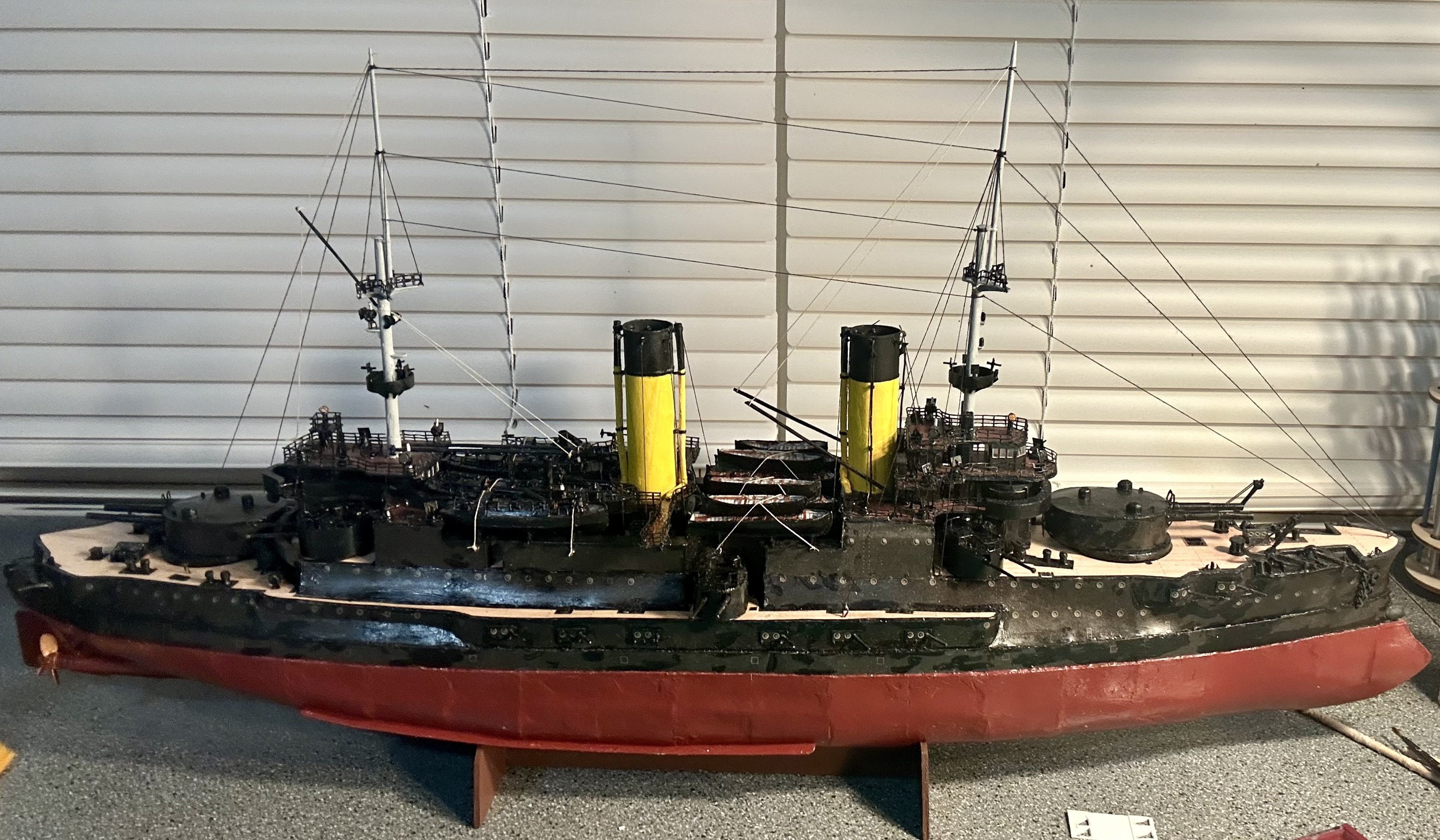

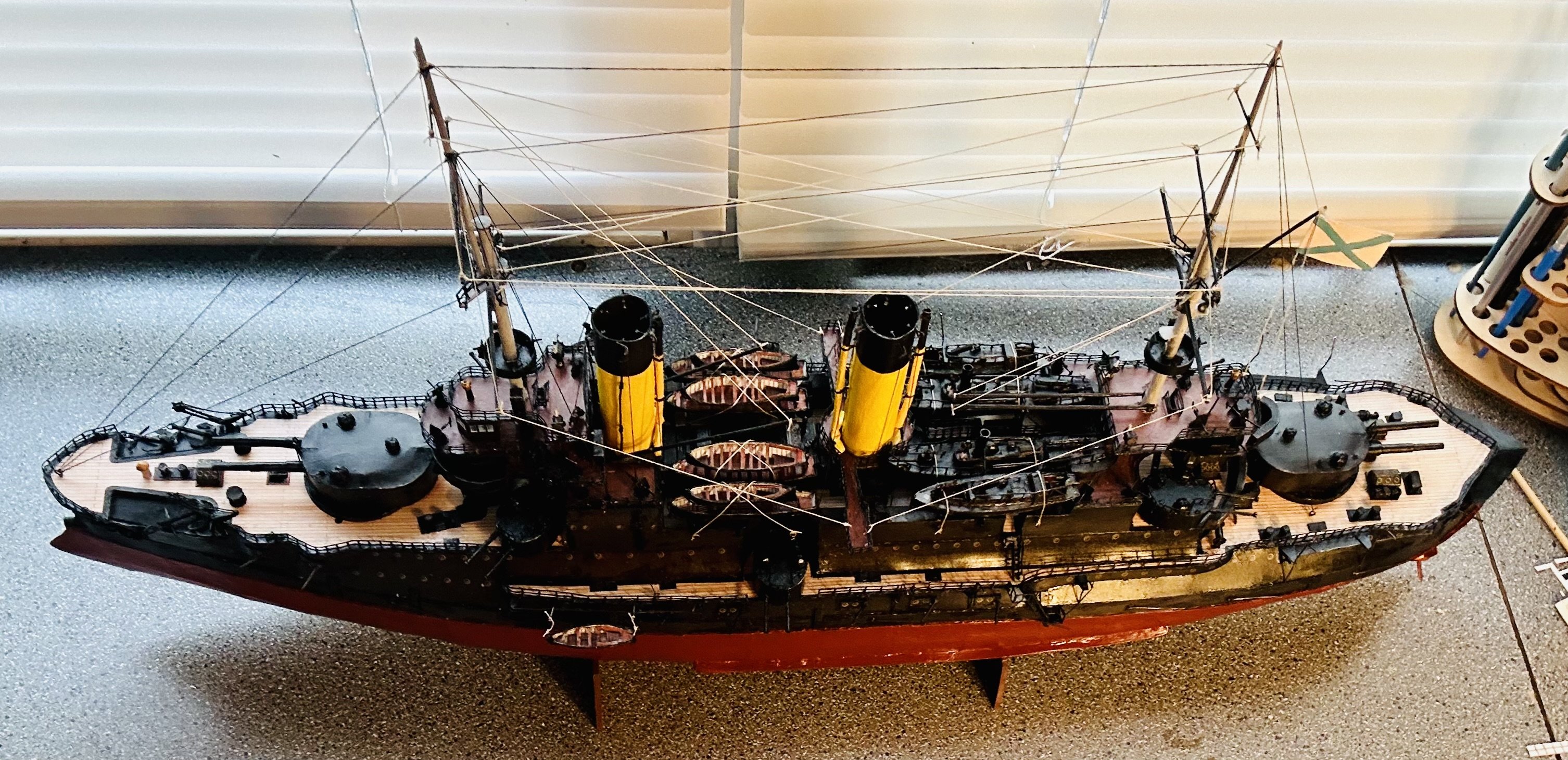

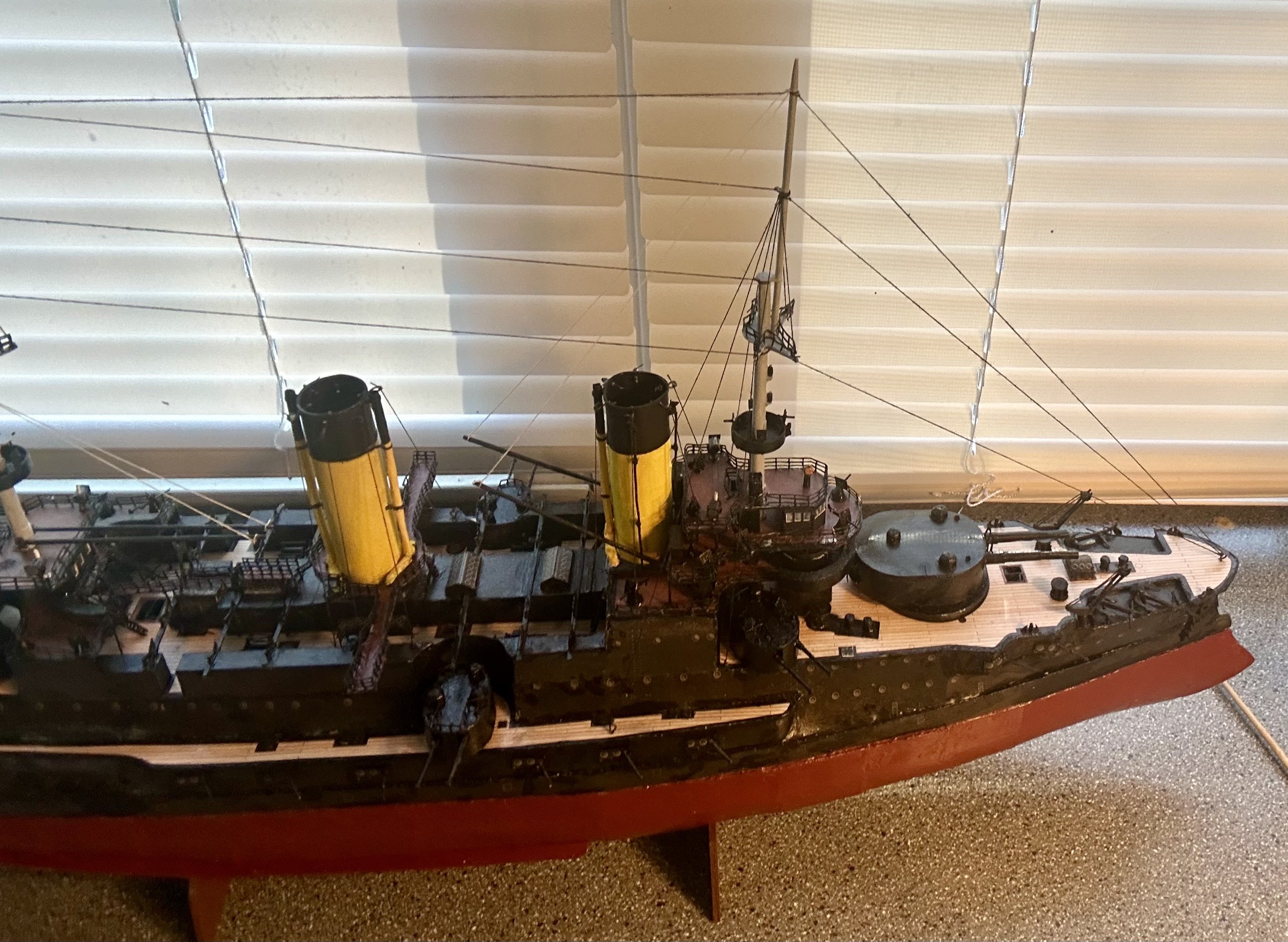

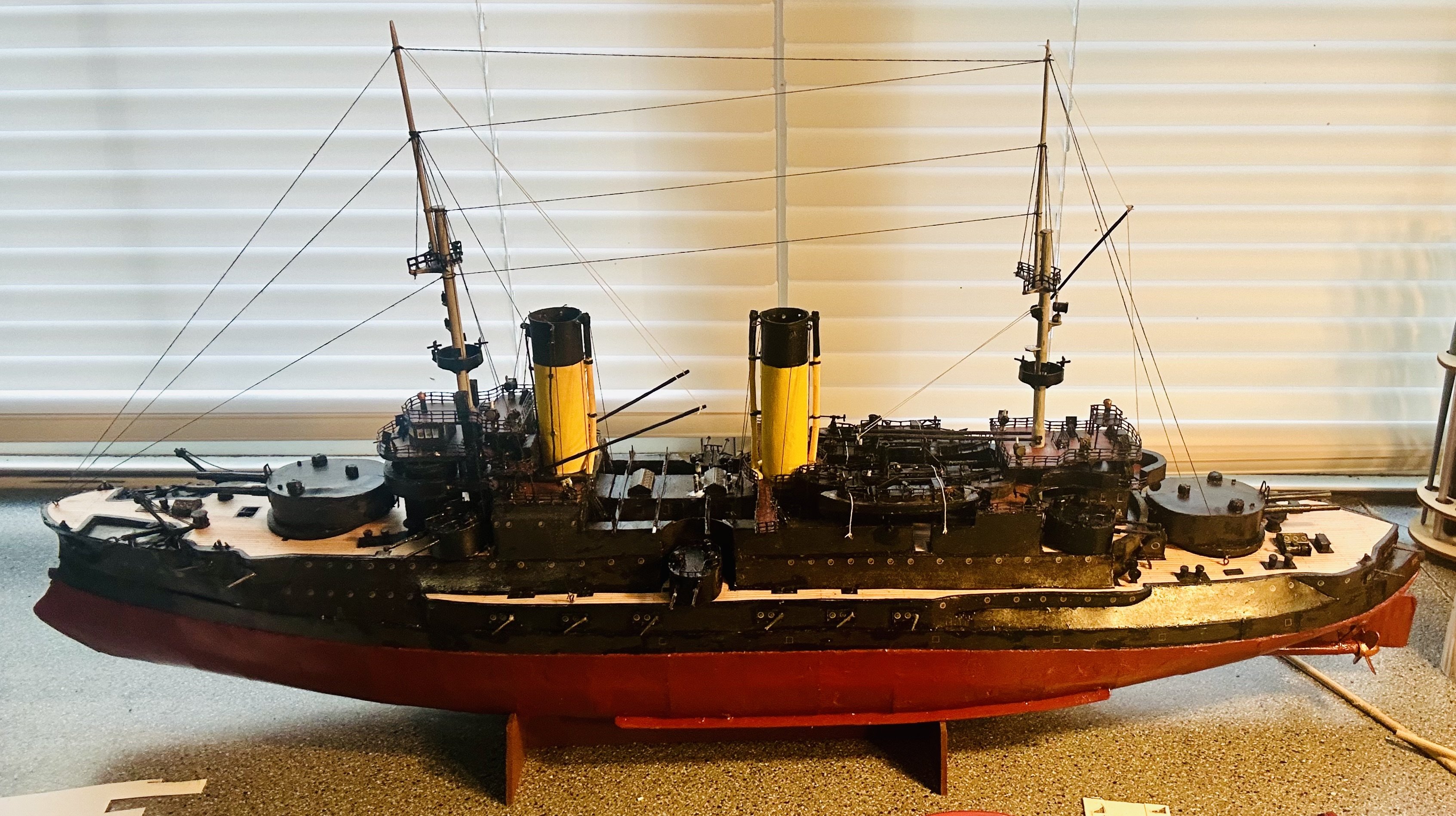

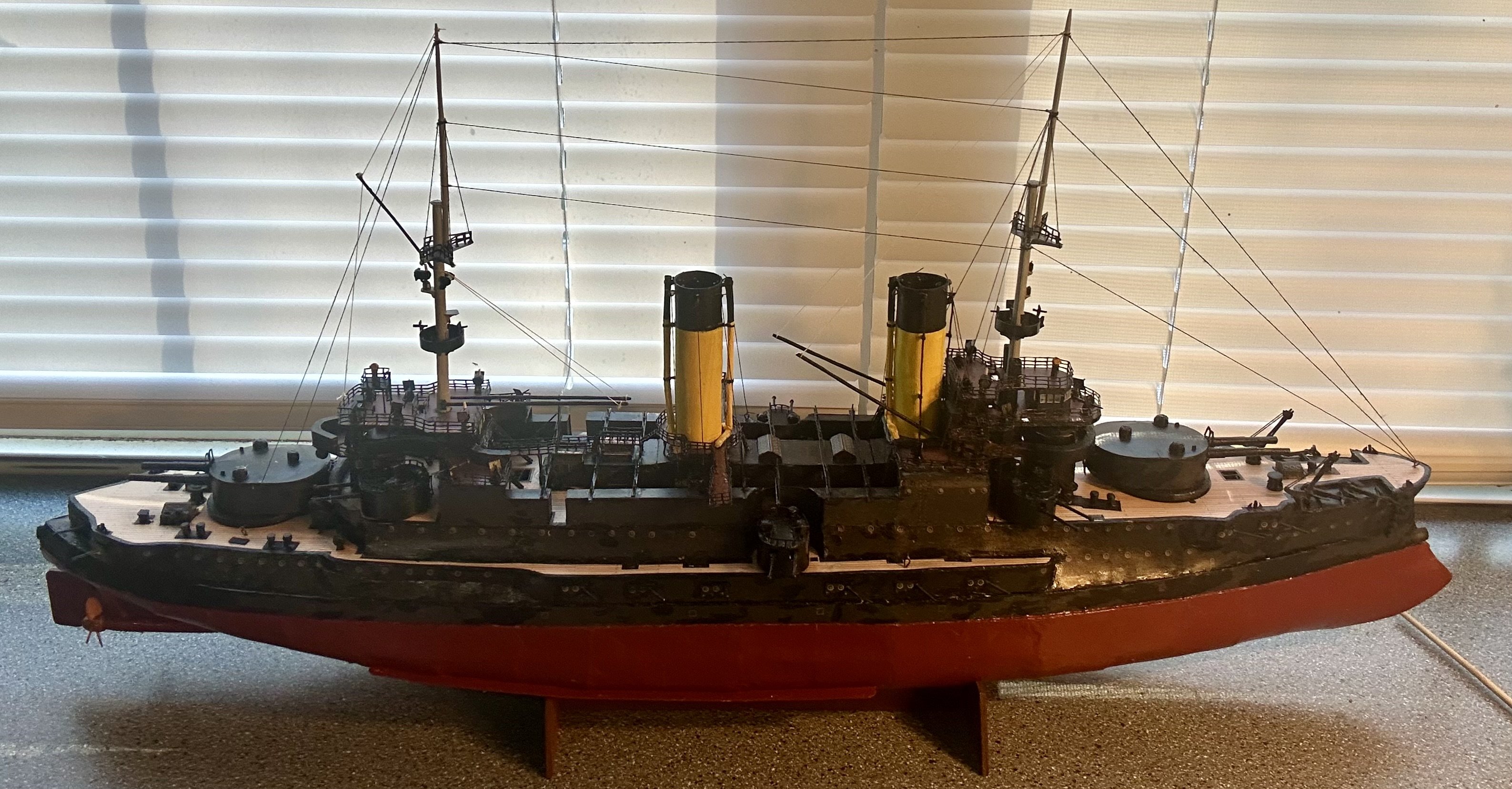

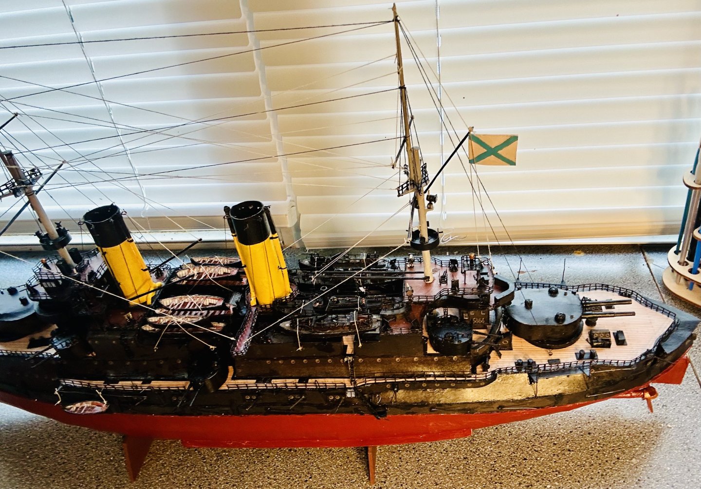

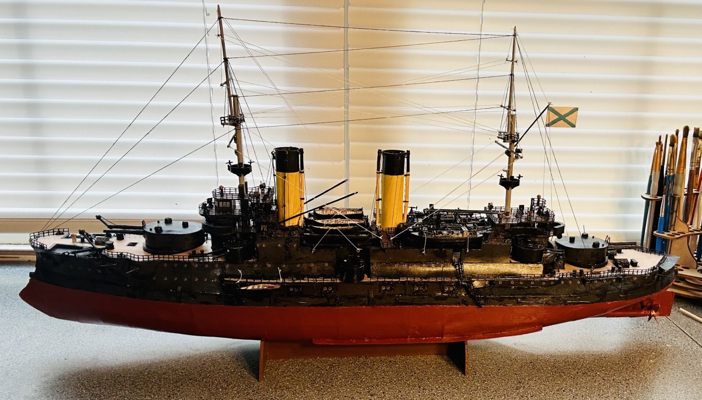

And the Oryol is finished!
This build was a really good challenge and learning experience!
I quite enjoyed it!
This was my first ever pre-dreadnought battleship!
I have 600+ hours in the Oryol over a period of nearly 12 months!
Thank you very much to everyone who followed along and provided support!
