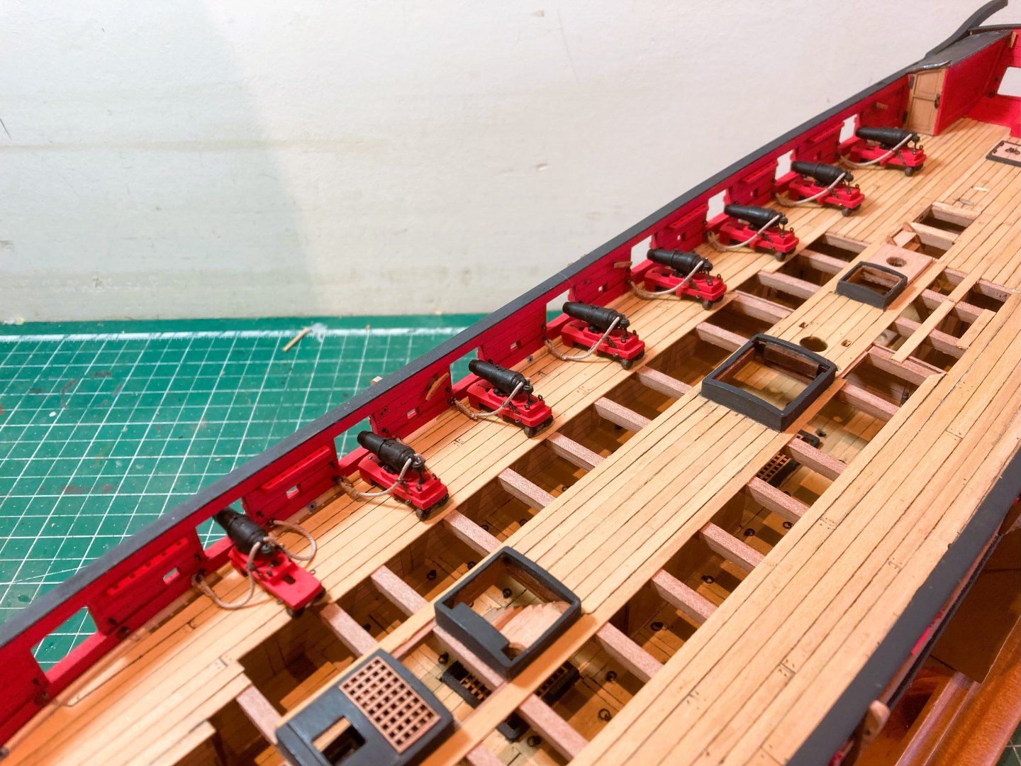

Harpy carried a complement of  (16) 32 pounder carronades.
3661a
I like to set up a sort of production line for carronade assembly, all the constituent parts in separate containers.
Before I get to that part I need to decide what position I prefer the carronades to be set.
3664a
There are three options, run-out, inboard (run-in), and  mid-way.
3665a
3662a
0070
I quite like the Run-in position which I think I will use for most of the guns, with a couple of examples of the other settings.
I am thinking I could modify the slides to allow  movement of the carriages.
3667a
At this early stage I have noticed that the elevating screws are subject to breaking when removing the supporting fret.
I had three break but they are easily drilled and fitted with a blackened pin.
I used a No11 scalpel blade for the cutting and found that  cutting the elevation screw first worked best for me.

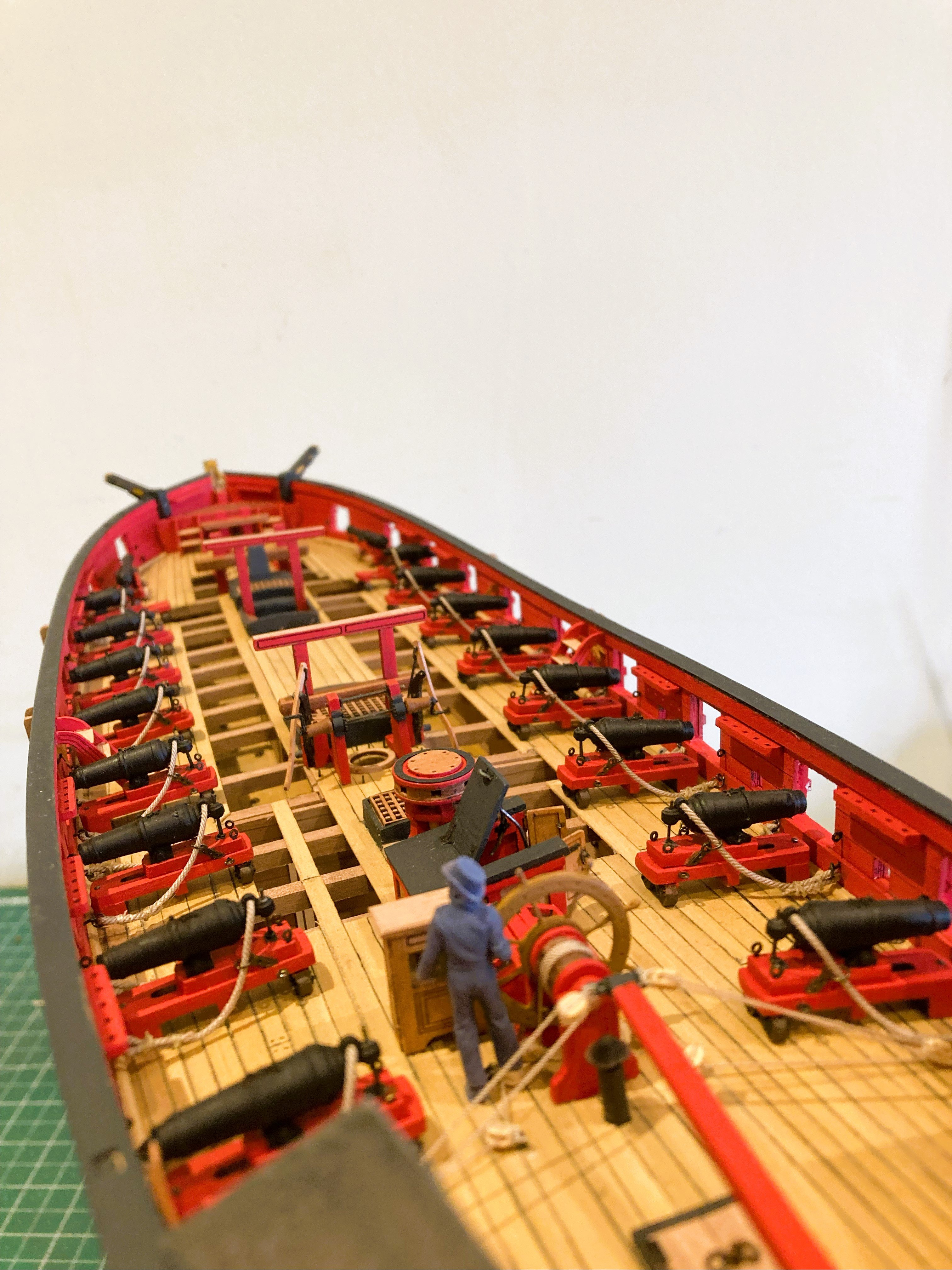

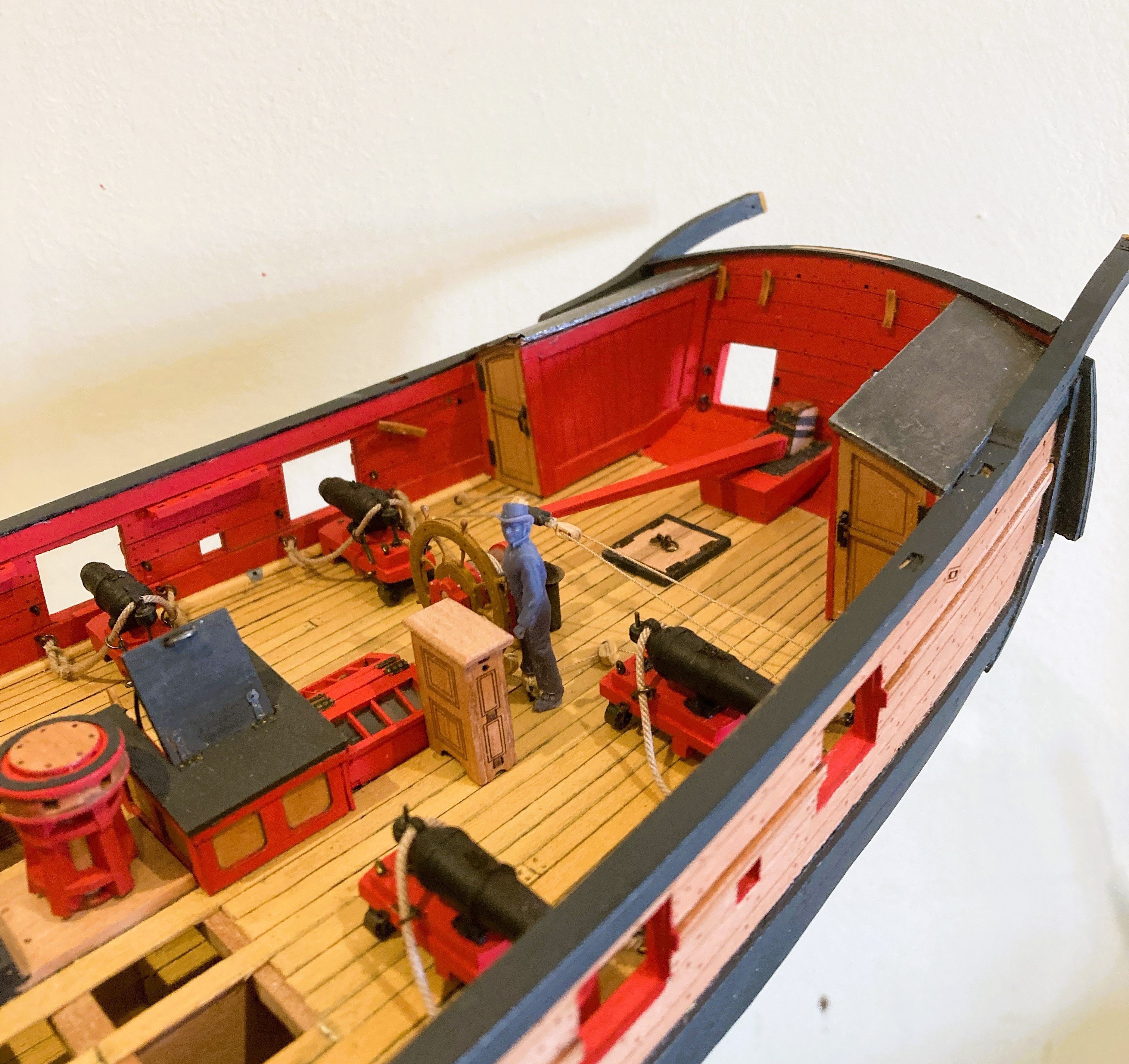

Carronades Part 2

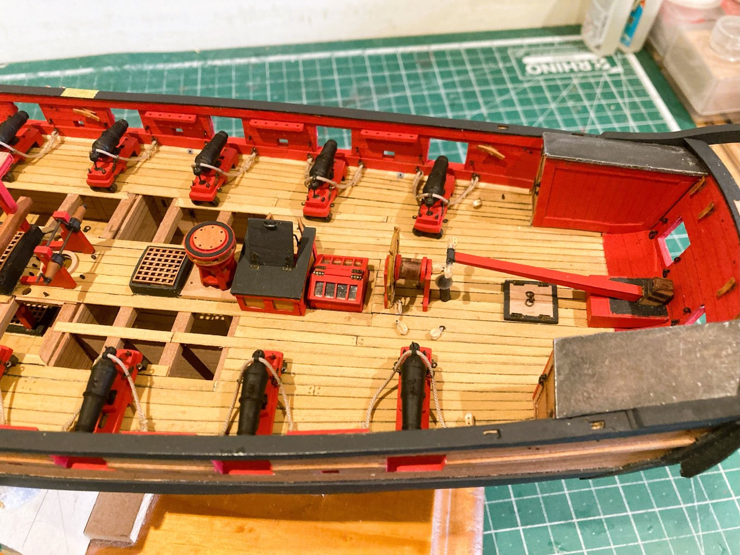

For the past three days I have been  playing around with the guns.
There are 16  multi-part units  to assemble and each one is a time consuming mini project.
The Pearwood bases initially need a good cleaning up, Vallejo Red paint does not easily cover char.
Base modification.
I have looked at modifying the slide and carriage so that the carriage actually slides. It would basically involve using a longer bar thro’ the carriage, removing the support bracket from beneath the slide, and adding brackets to the carriage bar beneath the slide, avoiding gluing the slide and carriage together.
On reflection I decided it wasn’t worth my effort so I just glued the carriage behind the slide bracket to give the run-in position.
3678a
I kept two carronades in the run-out position to demonstrate the use of the slide.
3679a
3680a
3683a
Before gluing the carriage to the slides I had one last check .
3684a
Content with my choice.

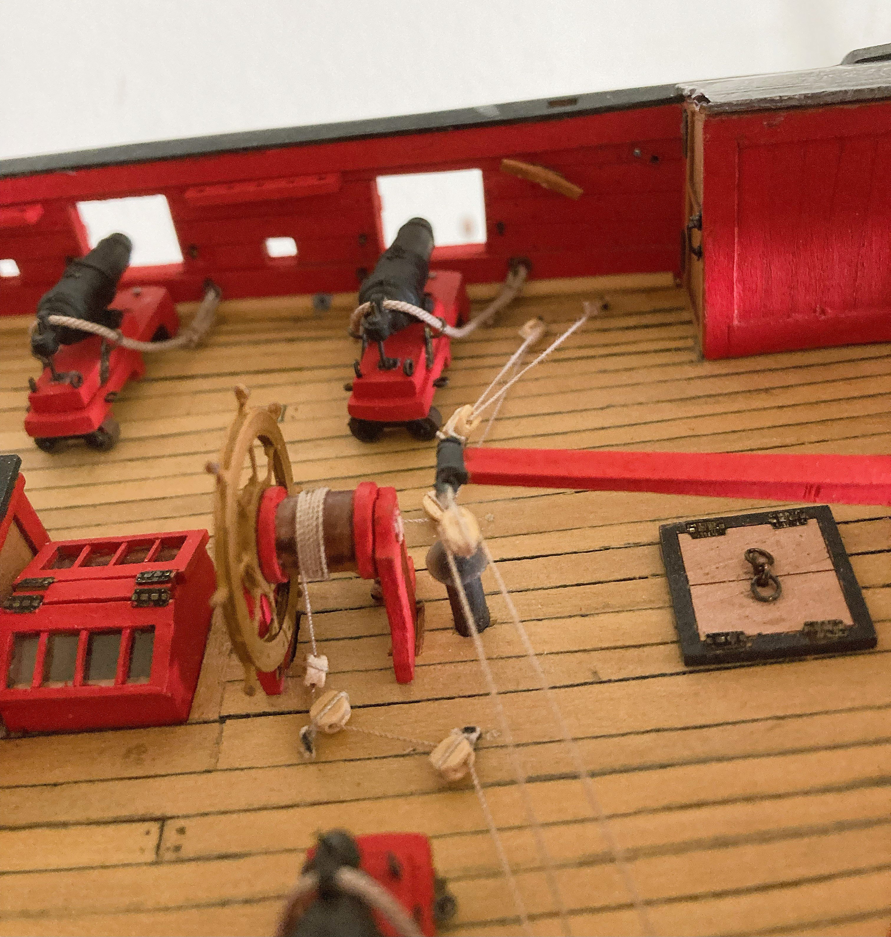

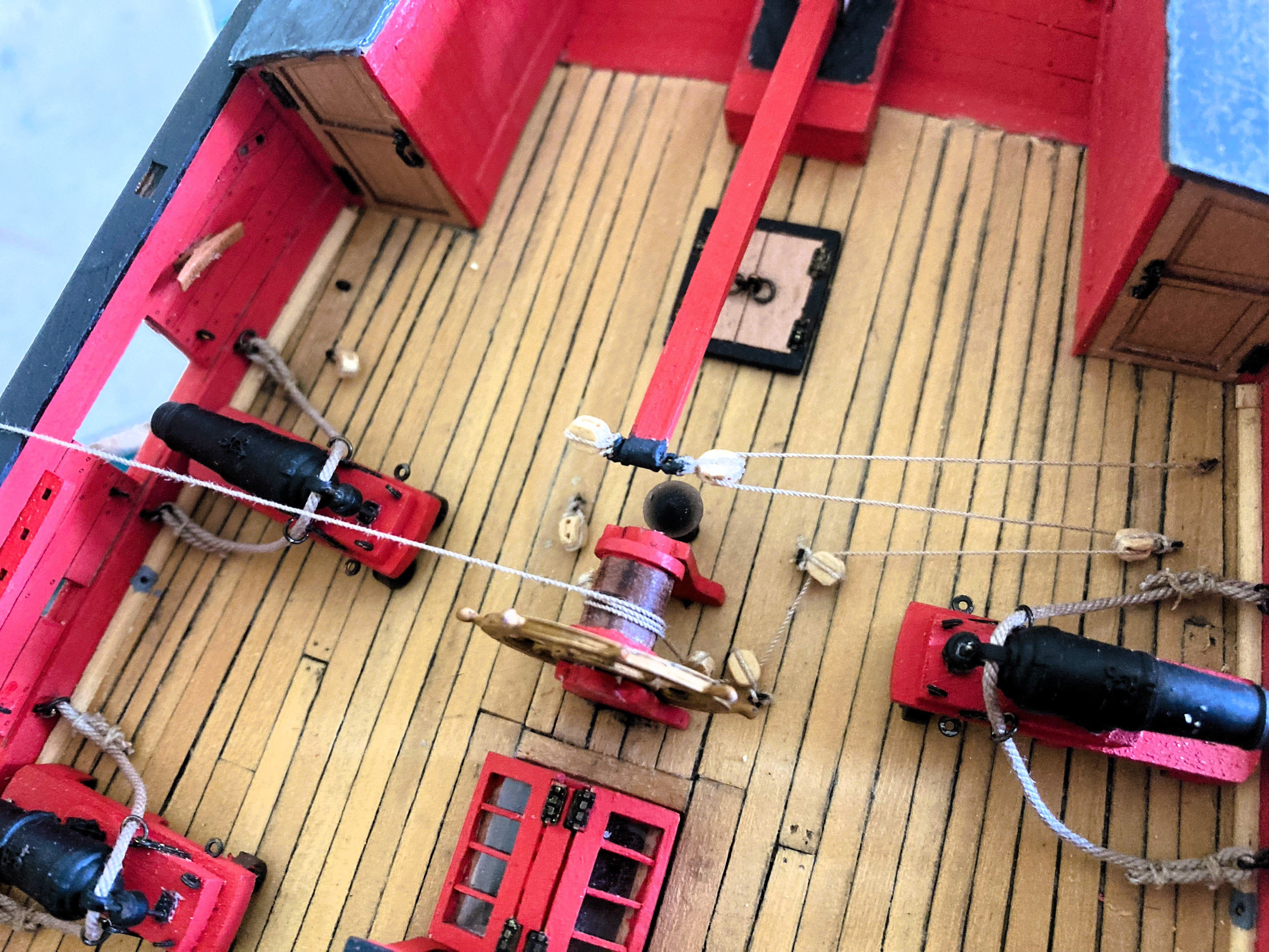

Carronades (Part 3)
3692a
As with Indy I added Syren Monograms which were applied before priming and painting.
They were then treated with dark brown weathering powder after painting.
3755a
When it comes to the ironwork placement on the carronade base, my go to references is the AotS  books The Frigate Diana which also carried 32 pounders and  was contemporary with Harpy.
In accordance with the 1:24 scale drawings  I have placed the bracket for the Breeching ring angled forwards on the carriage.
3758a
I added a ‘metal’ plate beneath the elevation screw.
3756a
The pe elements require blackening before use
This part of the assembly is by far the most fiddly and tiresome of the assembly process. Several of the brackets pinged off into the ether during fitting, lost forever, but fortunately there are a few spares.
There is also a lot of re-touching of paintwork.
3765a
I replaced the kit breeching rings with Amati 2mm rings.
I decided to replace the elevation screws with blackened pins, I will look to add the turn handles if I can find the right makings.

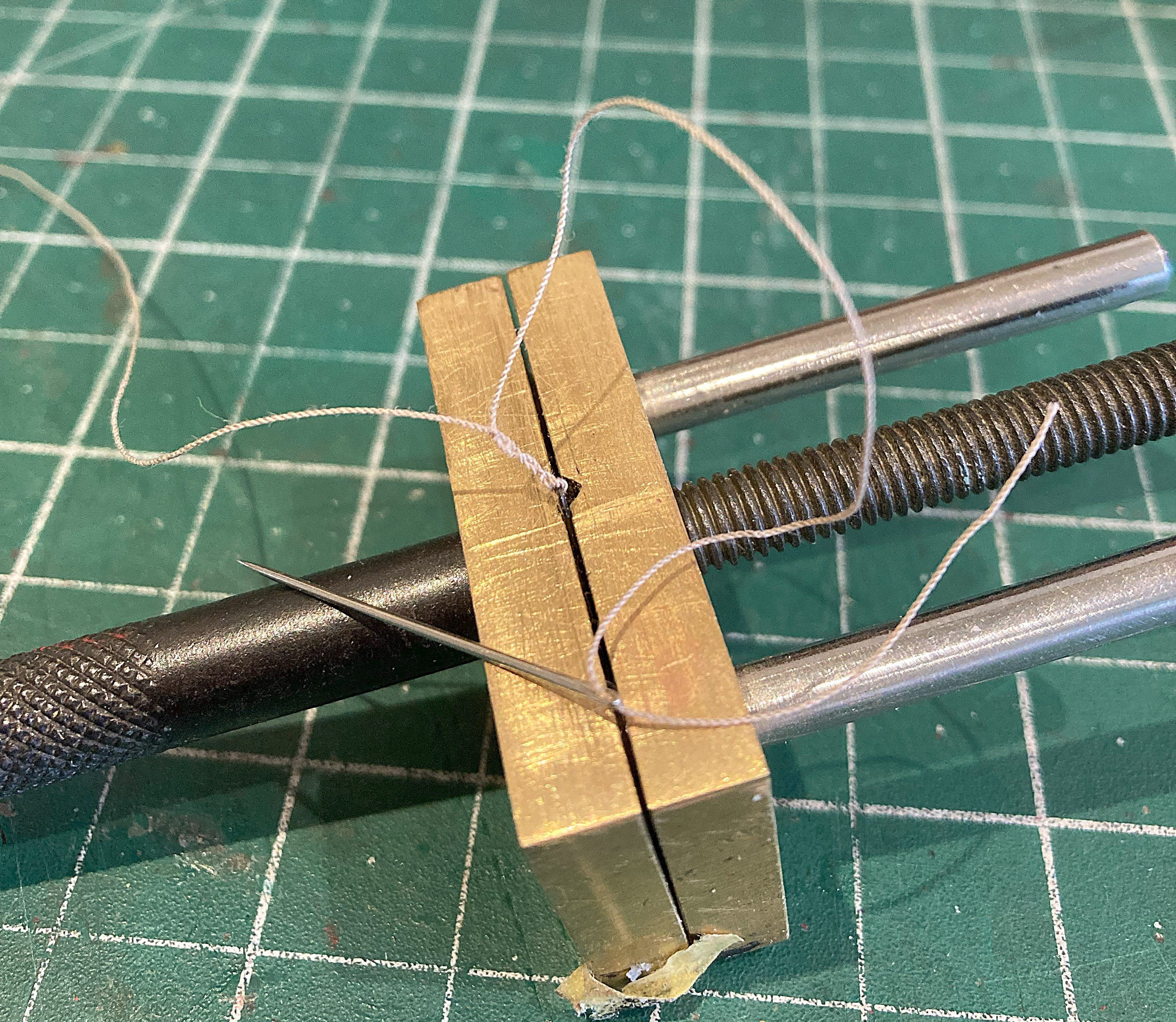

I have decided with Harpy that I will add at least the breeching ropes.
It is not clear from the kit blurb the actual line sizes, but my sources indicate lines of 8” circ equating to 1mm ø at scale.
However, true scale is not everything with scale models.
1mm line looks far too heavy with the provided carronades, and there is also the issue of damaging the breeching ring in drilling it out to suit.
3769a
3773a
I found that 0.8mm line ( in this case polyester line)  gave a look I was happy with.
For the side tackles 2” circ lines are indicated for the side tackles. these equate  to 0.25mm ø line.
With side tackle lines I have found that a smaller line is often a better fit and more visually appealing.
3771a

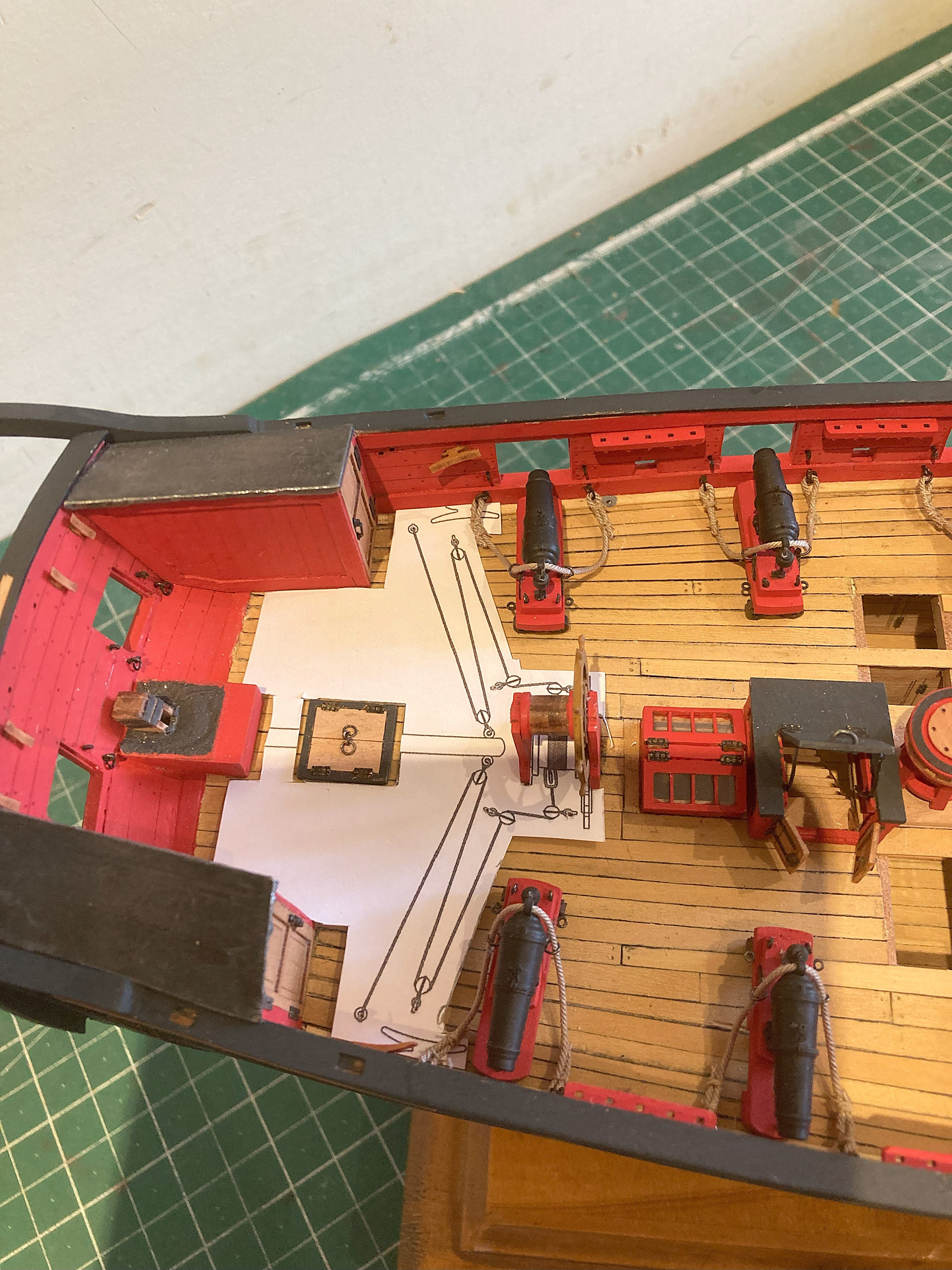

Still a way to go before I’m happy with the guns, but meanwhile…
More random thoughts about Harpy
Those two large stern ports, what is their purpose?
They are rigged for guns, but the absence of carronade slide fixings looks problematical. Apart from that the barrels wouldn’t extend beyond the counter.
3674a
Moving the the 12 pounder bow chasers aft is a possibility but clearance of the counter issues would still apply.
This design as seen on other vessels has always puzzled me, why not fit port lids to keep out some of the weather in a following sea?

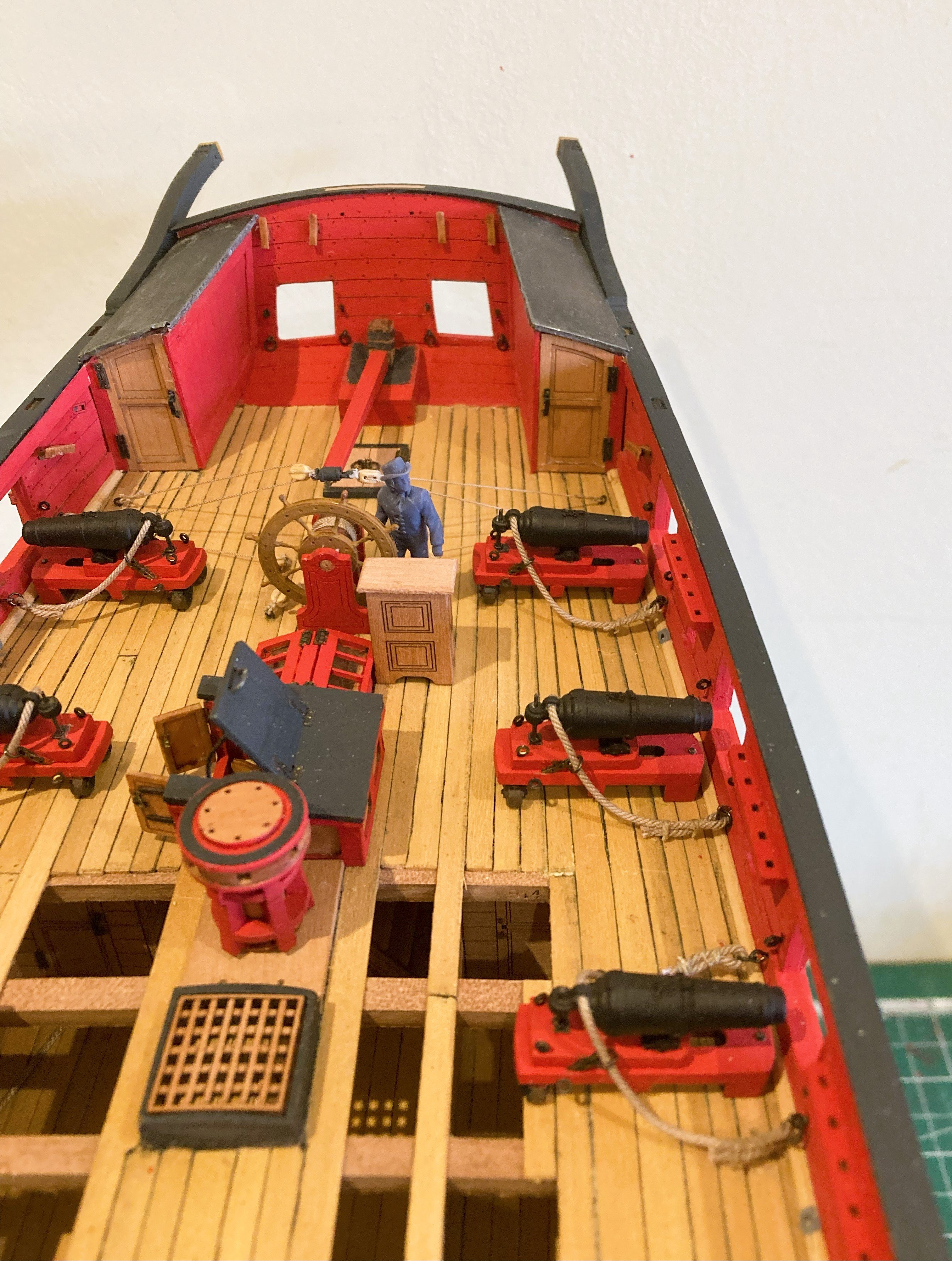

Post 61

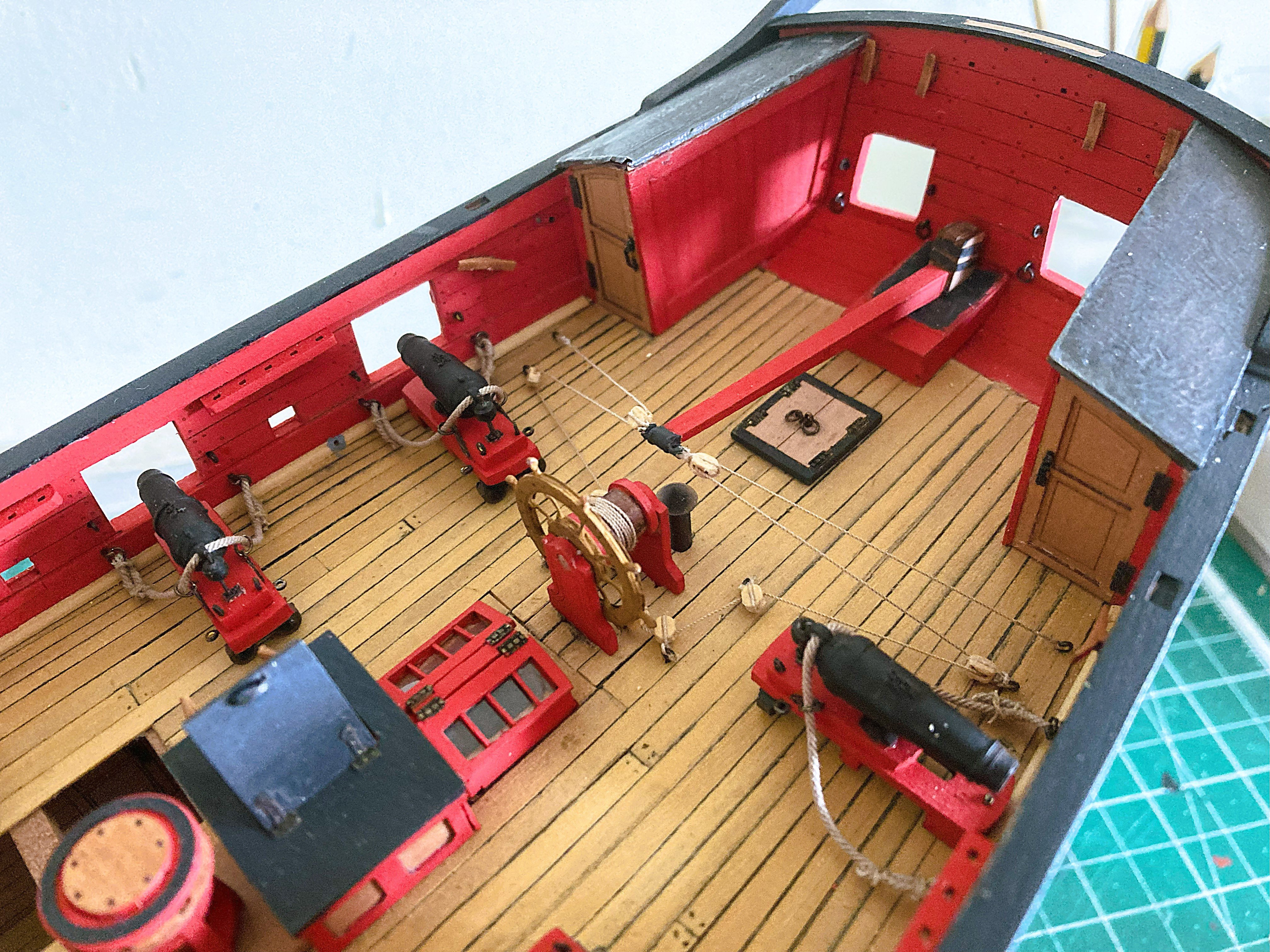

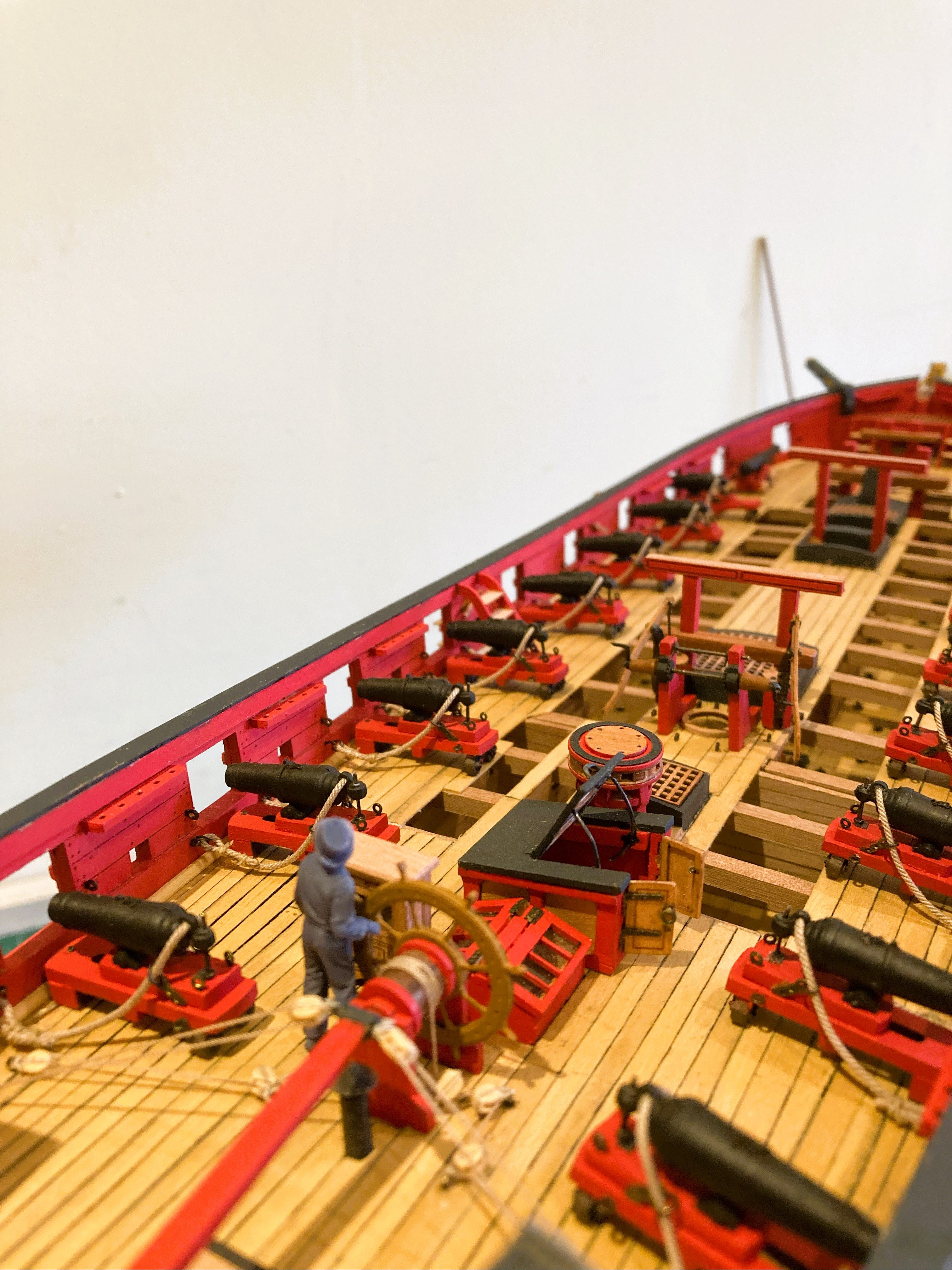

Carronades completion.
I seem to have spent forever messing around with the Carronades, but they are an important feature on the model.
I tried various methods to represent the turning bars on the elevation screws, but nothing looked right, or was overscale.
3251
I did manage it on the 42 pounders on Indy,(above) but they are slightly bigger, it makes all the difference.
3790a
The  carronade  slides are simply secured with pins through the deck, they are a reasonably tight fit, and for me glue is not necessary.

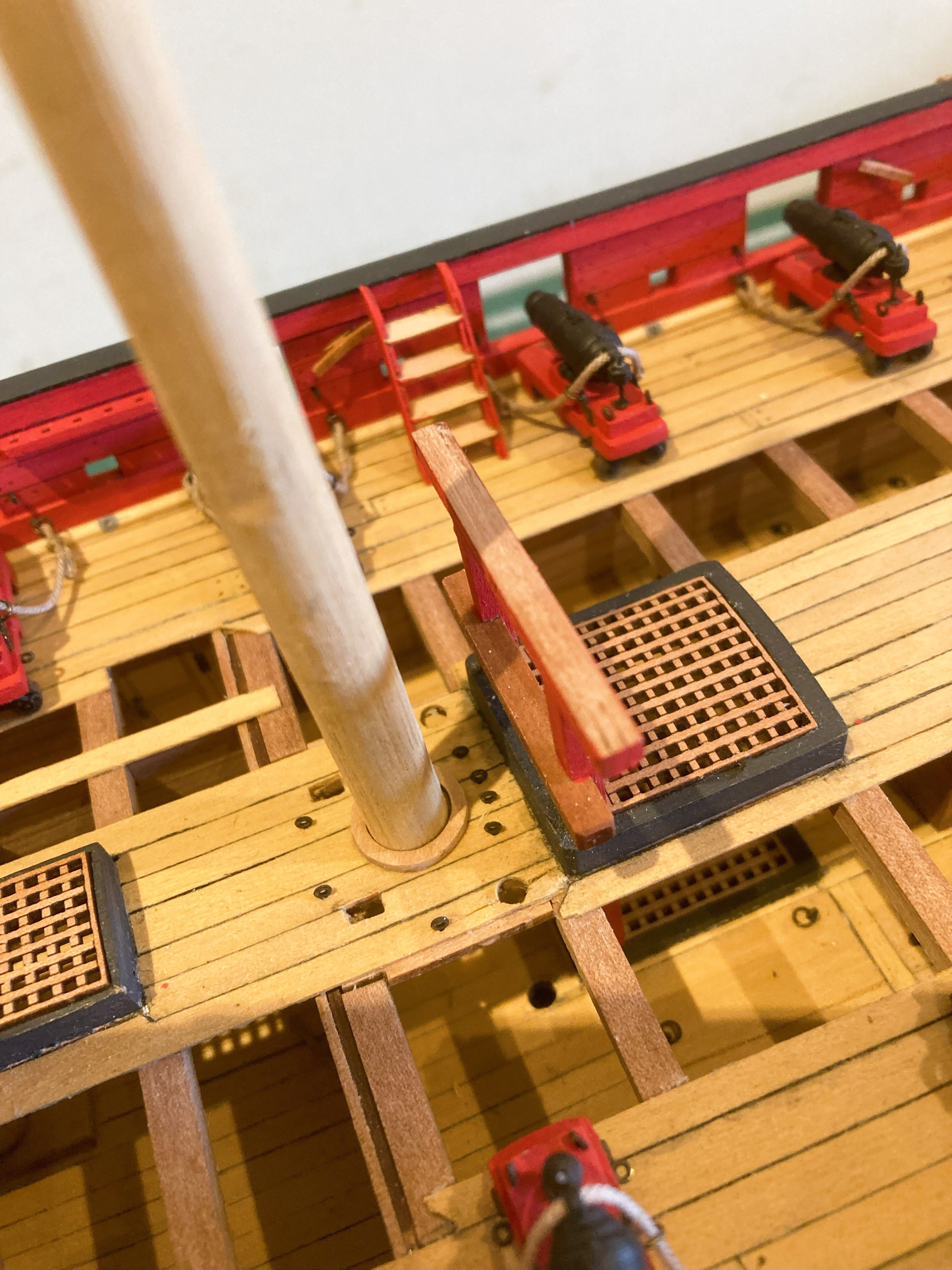

Bow chasers.
There are two six pounder long guns  provided in the kit.
They are of the current Vanguard design with integral cap squares.
This does mean that the guns have to be fitted at the same time as the carriage assembly but it does save all that faffing around separately fitting Capsquares.
I quite like them.
Manual photo.
There is a little oddness about the indicated placing of part 227 (sections 389 -392 of the manual) described as a quoin. It makes more sense to me representing the stool bed, which more properly ends short of the bracket ends.
Not a major issue, just re-position the piece when fitting.
Quoins, wedge shaped blocks used to raise the elevation of long guns, sit atop the stool bed.

Two days work to fit the starboard guns, onto the Port side.
That’s my Easter weekend sorted.

Jigs are an excellent way to reduce the pain of gun rigging.
As used on the Cutter Alert. - also used to rig the side tackles.

Carronade installation completed.
3946a
The port side installations went a little quicker than the starboard, but still took a full day.
3949a
An impressive set of teeth has Harpy.
Note the extra slackness of breeching line on the forward run-out carronades. It is a common error to show the lines too tight, which would not allow for recoil.
3954a

I am a bit undecided how to display the long guns aboard Harpy.
3957a
With the guns run-out, those long barrels protruding rather destroys the otherwise symmetry of the broadside.
The effect would be reduced somewhat once the Channels are in place.
3958a
I could angle the bow chasers but that doesn’t hold a great appeal to me.
3959a
An alternative would be to secure alongside. This keeps the guns inboard and does have symmetry that appeals.
3963a
This arrangement, frees up space around the crowded area of the Foremast, Riding bitts, and Bowsprit step, as well as showing a different way to secure the guns.
I’ll ponder a while before deciding but I now have the pleasure of  installing all those deck fittings made earlier.

Before the wheel is glued into place I considered  the complicated arrangement of  pulleys that run between tiller and wheel barrel.
3986a
I used a pattern from the plans to check the location of the  deck blocks, those using the pre-made deck will have those positions already marked.
The last time I rigged one of these was on Pegasus a ship built some 20 years previous to Harpy. The only difference in the rig seems to be that foot blocks are used to direct the line from the barrel downwards directly to the deck. The tackles still run across the deck which must have created a serious inconvenience.
3990a
I think it is  probably best to attach the deck blocks before installing the wheel to give the best chance of making a neat job of seizing the blocks to the deck eyes.
I am using Syren 3mm Boxwood blocks  in preference to the basic kit version.
The blocks are seized to the rings before fitting.
3988a
3995a
3992a
The tiller lines will be rigged later, still more things to do on the deck.

Internal Bulwark ladders.
These don’t receive a mention until very late in the manual (Section 491) but they are made up as per the other ladders using parts 70 -73 from the 0.6mm  laser sheet.
4007a
4008a
4017a

Nice work. I do not plan to install the bulwark ladders until the end as there is a cleat that will be hard to reach right underneath during rigging. Also careful with those pump handles. They are in the way for some off the rigging and I have broken the starboard one twice now.
Ditto, I had also noted the belaying of those "hidden" cleats so I have not fitted the ladders
Glenn (UK)
Those particular cleats will be for belaying the Fore sheets  which enter thro' the fixed blocks on the side. Best not to fit those ladders until that is done, it would be difficult to make a nice finish to the belay and  line ends with the ladders in place.
The pump handles are a snag point, but I don't glue the pumps in place, no need with the  elmtree extensions into the lower deck. I tend to glue as little as possible on my models for ease of removal if required, this includes the masts and yards.

Rigging the Wheel
Steel indicates 3” circ line for the tiller lines which equates to a scale diameter of 0.37mm.
The kit plans suggest a 0.25mm line, but I am using 0.3mm Syren line.
I start on the Port side where the line meets the wheel drum on its forward end.
Sufficient line is required to complete the entire process.
4021a
I firstly secure the line to the aft deck eyebolt off-model. A false splice is used for neatness.
4023a
The line then runs to the tiller and back thro’ the deck blocks (in the correct sequence) and up to the wheel drum on the forward end.
Care needs to be taken to ensure the line is fed thro’ the correct hole in the blocks.
Three turns of the line around the drum, with a spot of ca at the centre of the third turn atop the drum.
Before this is done  the lines are checked for tautness  throughout the Port side set-up.
Given the length of the line care is also required when feeding it thro’, there are many snag points  on the surrounding fittings which may be dislodged if  caught when the line is pulled thro’.
4030a
I have used six turns  of line in total around the drum  because this best matched the block arrangement. It is a common novice mistake to wrap the line around the drum as many turns as it will take.
Five or six turns would be appropriate on smaller vessels, Victory had nine.
4029a
Must have been very annoying stepping over the tiller lines to gain access to the stern.
I last looked at the Binnacle in Post 54, but I’m no closer to a decision where or whether to place it.
It makes no sense to me to have a Binnacle where the Helmsman can’t see the compass, and a unit with a chimney without a lamp compartment.
I tried the double cabinet but the unit seems too close to the wheel and the viewing of the compasses is still obscured by the wheel.
My inclination is still that the small cabinet slightly offset to the side of the wheel is the practical option.
Being an important piece of kit it would be removed below deck in the event of an approaching action.
4033a
Small single Binnacles do feature in ships of the first quarter of the 19thc often one each side of the wheel, but I can’t find any examples of this cabinet style (above) positioned as it is.
4035a
Historical museum ships and some  contemporary models all show a centrally placed cabinet  before the wheel, but there is more space between the wheel and the cabinet; with Harpy the binnacle is hard against the wheel stanchion.
4036a
4039a
The Helmsman looks quite comfortable with the arrangement, but my dithering continues.....
