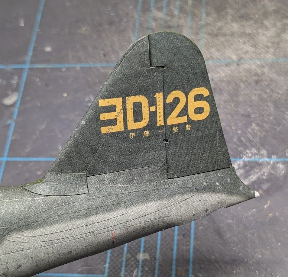

Completed the vertical stabilizer and rudder. Here we have the rudder framing and cladding. I added a joiner strip from scrap card.
And here's the finished assembly.
And, just for fun, here's the same shot of the rudder after being massaged with "magic erase". 🤫
Stabilizer fillets and elevators added.
A curious factoid: the diagrams show a trim tab on the rudder which the kit parts lacked. I did some web searching to see which was correct -- turns out the A6M2 had a rudder trim tab, but the A6M5 did not.

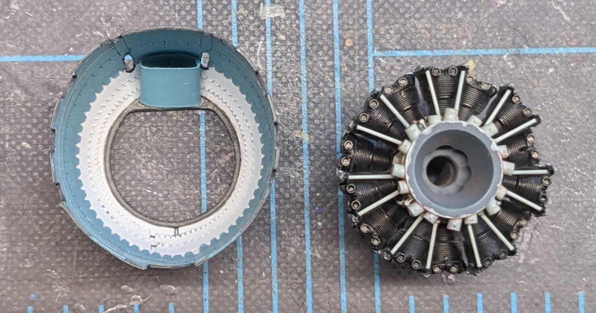

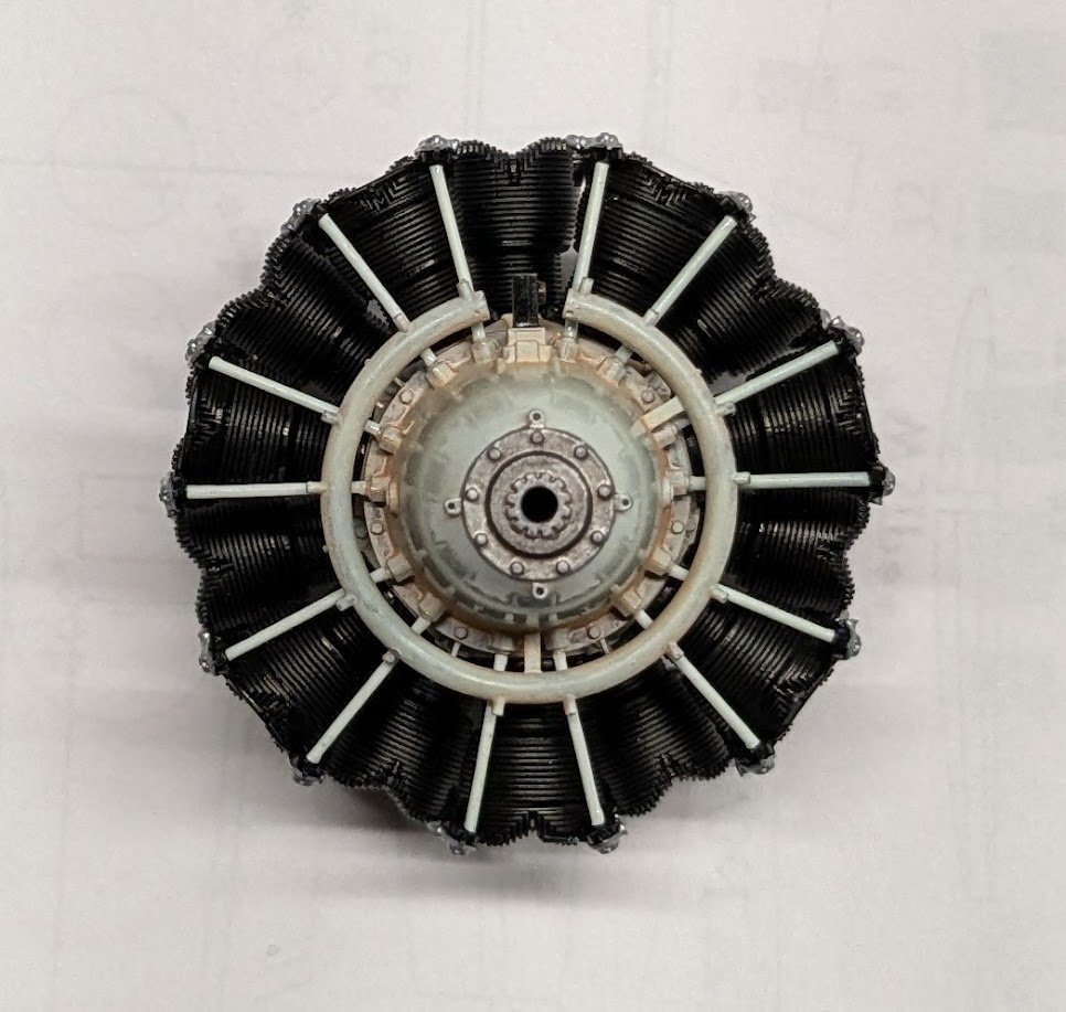

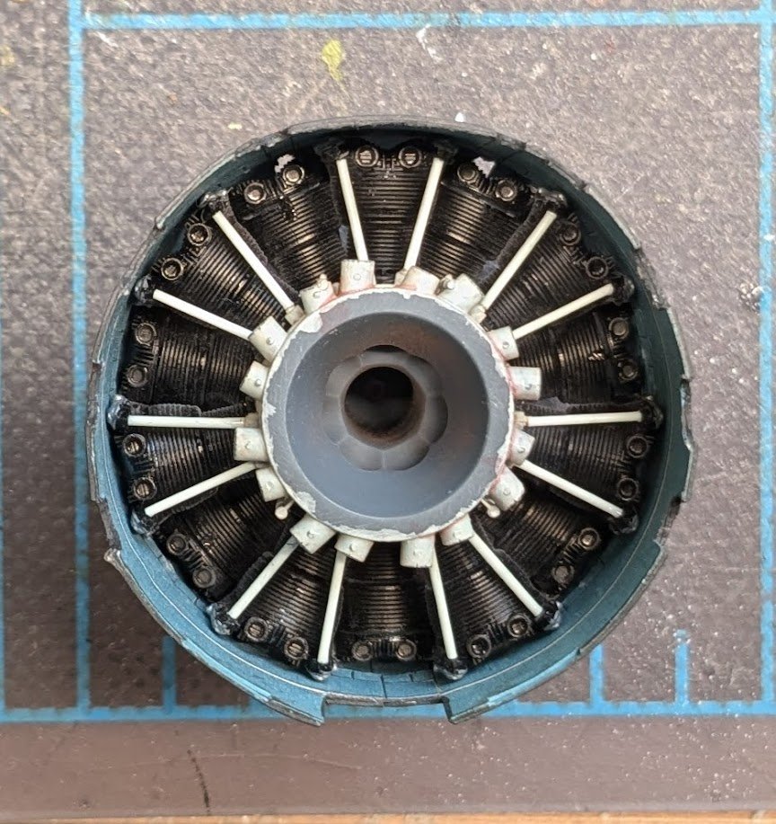

The parts are now separated from their sprues. Most online pictures show black cylinder heads with aluminum valve covers. Blocks and gear boxes are shown in varying shades of bluish-gray, from light to dark. I have settled on a light blue shade and have grunged it up with weathering chalk. I have tried several different washes and chalks to try and highlight the cooling fins, but nothing has been satisfactory so far.
The engine block and cylinder heads are now together -- still have push rods and wiring left to do. As i mentioned earlier, there are no intake pipes for the engine. Those would potentially be visible on the finished motor, but they would be a huge pain to make from scratch, so I probably will not add them. With the help of a fellow card modeler from Poland I was able to solve the riddle of how the first pair of inner and outer cowling rings went together. The eventual mating of the cowl and engine required removing the entire center portion of the cowl bulkhead, as shown. The engine will have to go into the cowl and then the bulkhead added afterward, but that is down the road a bit.

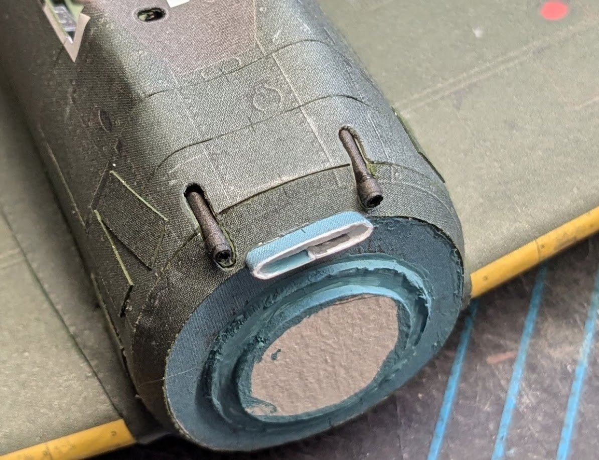

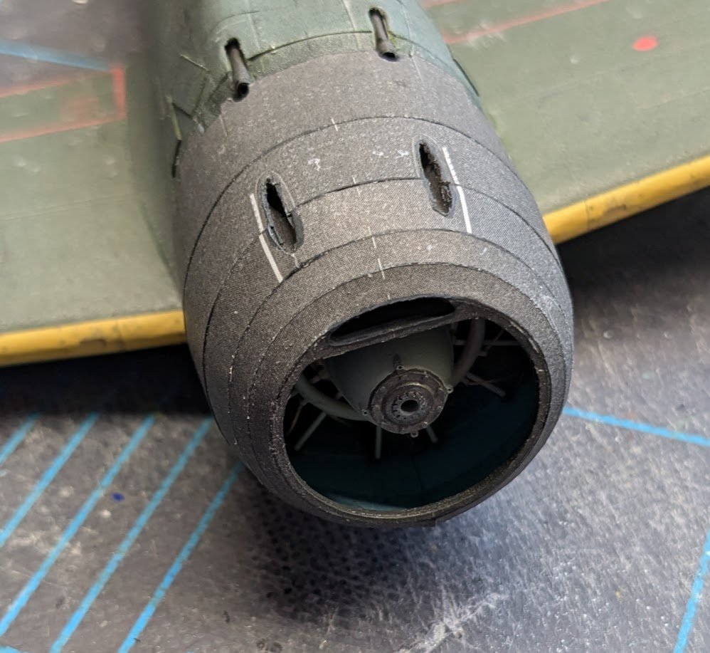

First off, the resin engine is a very, very tight fit. This fact is made worse by the fact that the cowl's diameter decreases as successive rings are added. To get the engine to fit into the first three rings, I had to file off the top halves of the front cylinders' valve covers.
But it gets worse . . .

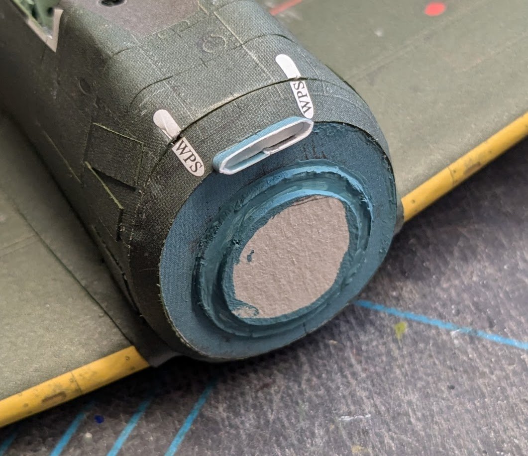

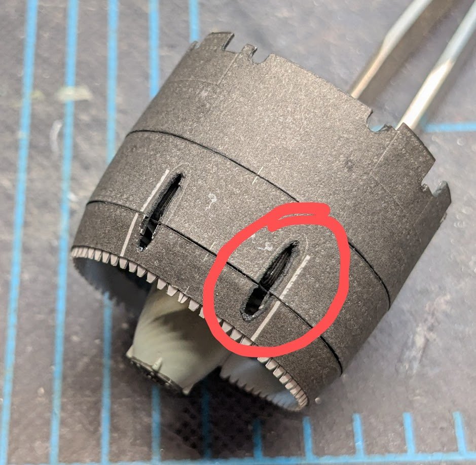

The engine itself is not the only thing that has to fit into the cowling. There's also the machine gun channels, and as you can see in that first picture, there's no room for them. In this next photo, you can see that cylinder heads more or less completely block the front openings for the guns -- and that's without the channels being installed.
There's also an air duct that needs to fit in there as well -- don't ask me how.

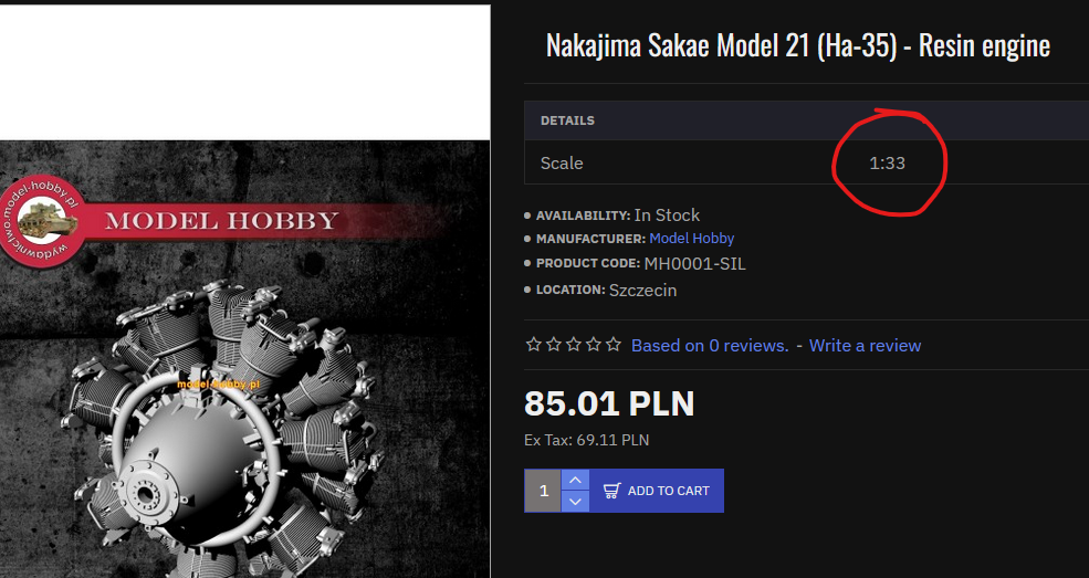

I'm quietly wondering whether this engine isn't actually a 1/32 scale engine rather than 1/33. It's not out of the realm of possibility.
1 hour ago, ccoyle said:
I'd be a little annoyed if that were to prove to be the case, since the part is marketed as being 1/33 scale.

So, the outer structure of the cowl is done. The front of the crankcase should be flush with the cowl opening, so that will help me determine how to fit the rear part of the engine to the fuselage.
Speaking of which . . .

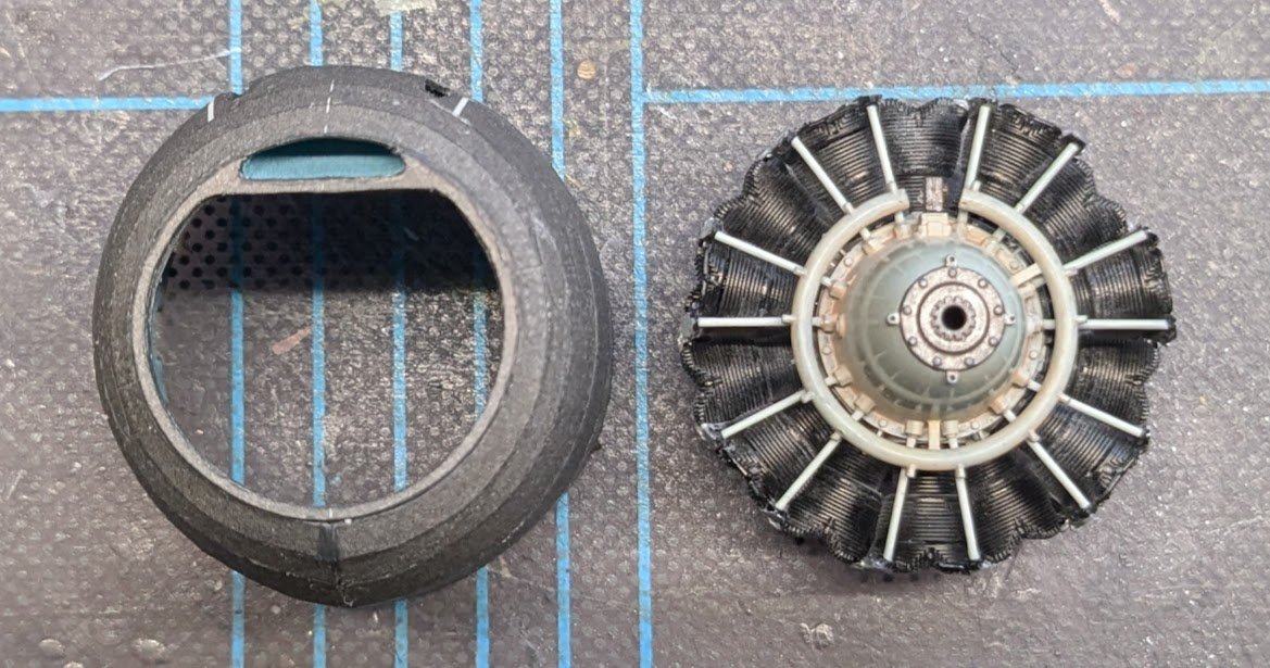

. . . it's a good thing I didn't fit any air intake pipes, because my initial measurements suggest that the entire portion of the molded block that includes the pipe stubs will need to be removed in order to allow the engine to fit properly. Fun!

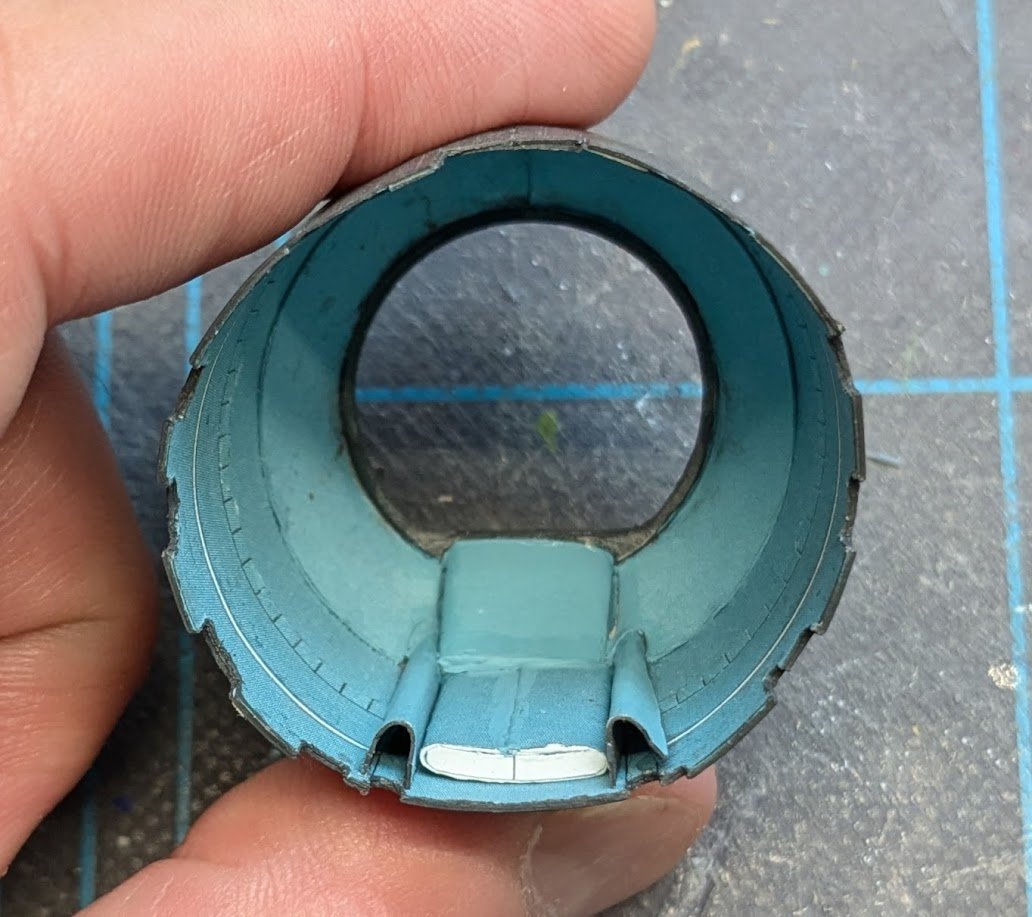

Most of the cowl interior is done now. Some sloppy fitting here and there -- my fault, since much of the work could only be done while viewing with one eye, which ruins depth perception of course. I also installed the two tiny spacers inside the middle section of duct work upside down, meaning the ugly seam shows, which shouldn't be too visible on the final assembly. Next step will be the necessary modifications to the engine cylinders to get that darn thing to fit inside the cowl.

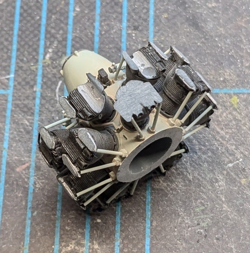

Finished the surgery on the engine. I used a cutting ball with my Dremel tool for the rough work and finished it off with files. You can see that in addition to cutting the grooves for the machine gun channels and removing the rear of the block, I also had to file the top of one rear cylinder completely flat, as well as file off the tops of all of the rear cylinder valve covers. 😩
Now, if only the engine would have fit inside the cowling after all that work! It did -- but the engine, and thus the cowl along with it, still sits too far forward when test fitted to the front fuselage. Still more work to do!

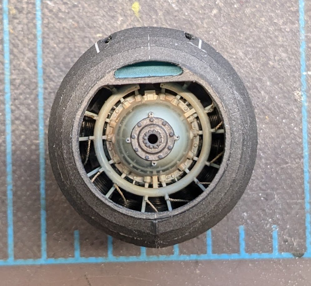

The saga continues -- probably would have been easier to just build the card engine! First we had to carefully remove the original engine mount and rebuild it to the desired thickness.

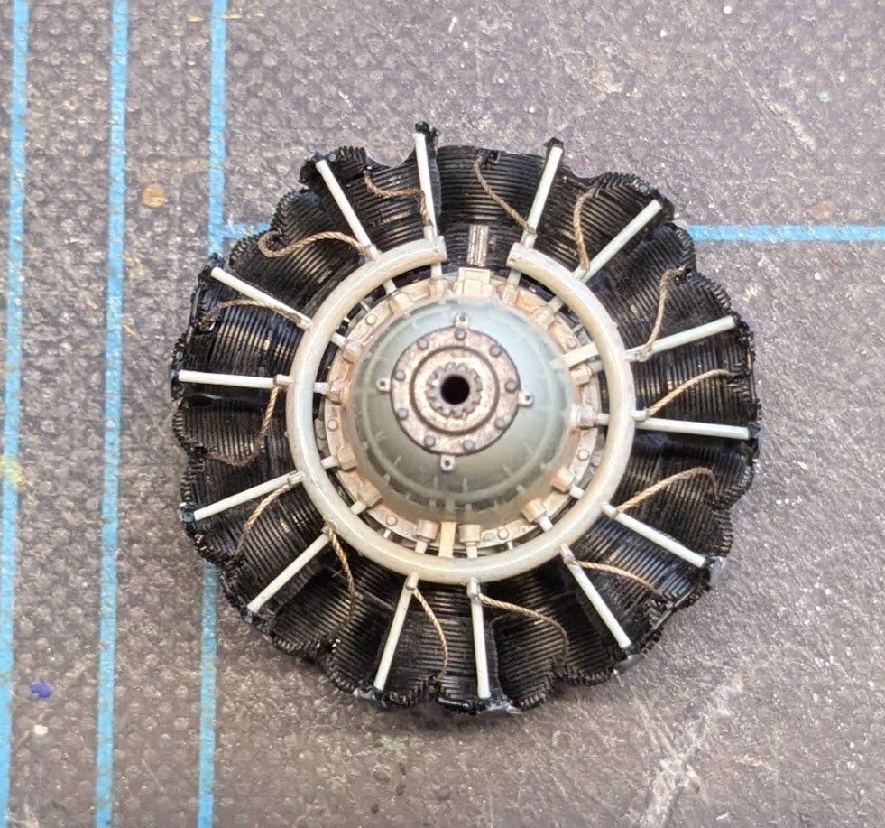

Next we wired the cylinders. I only added half of the spark plug wires -- I'm just hinting at their existence, not replicating them in all of their glorious detail.
After all, little of them will actually be visible.
Fuselage guns added.

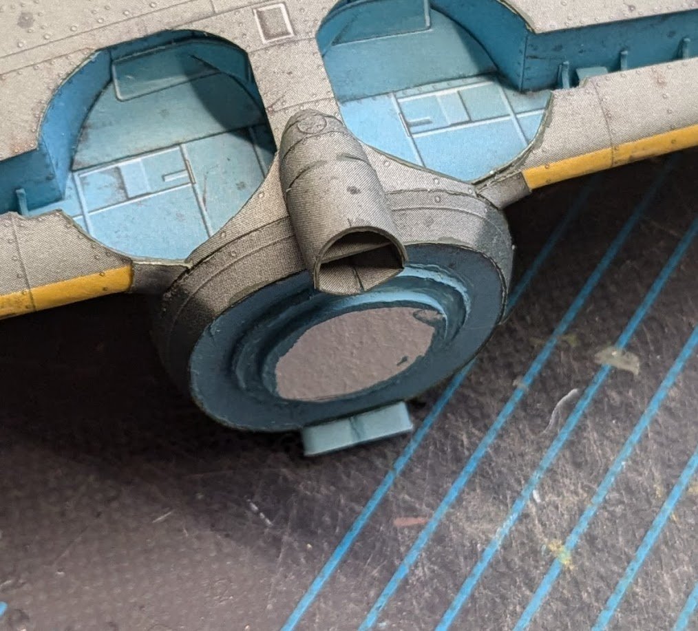

And lastly, the oil cooler intake is added -- this will help position the cowling.
I think I'm more or less ready to mount the engine now, but I need all my wits about me when I attempt the job.
Engine mounted. I wasn't happy with the placement of the machine guns. Since they're made of paper, removing them understandably made a hash of them, so I ended up replacing them with styrene rod.

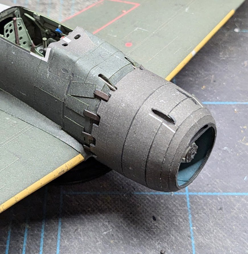

And cowling on.
I can't believe I've only been working on the engine and cowl for thirteen days -- it feels like ages. The next task will be to sort out the exhaust stubs.
