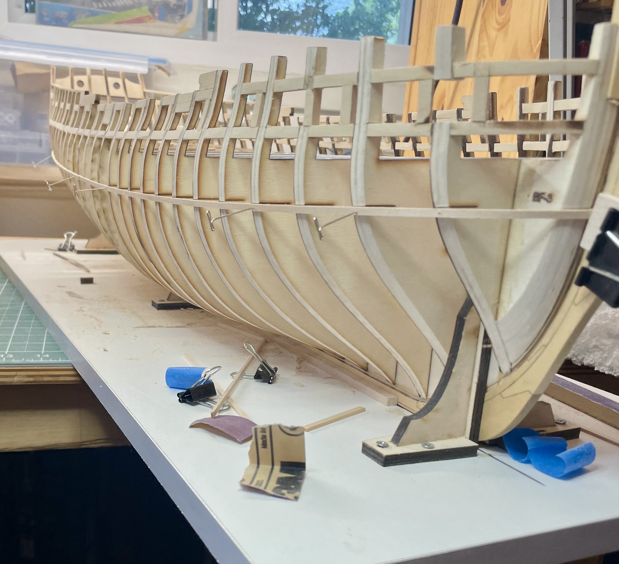

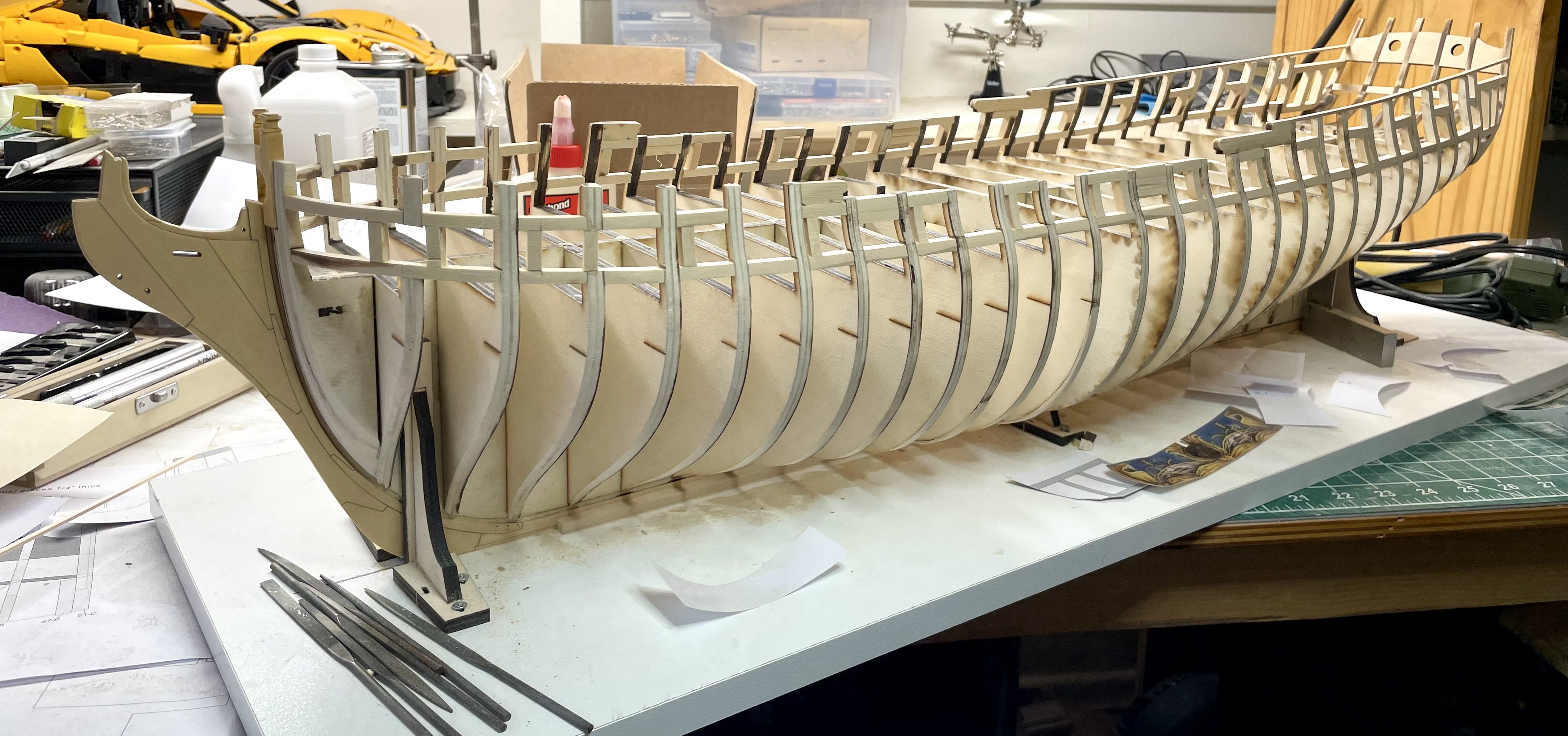

Here's on update on the first stage of the gun port framing.
Spent a few hours comparing the run of the batten on port vs. starboard and got the two sides as equal as possible.
I got the best results (smoothest run) by using the least number of pins possible and allowing the batten to do the work.  In most cases it wanted to follow the marks on the bulkheads in a fair curve.
The image above shows the largest mismatch I have with the mark on the second to last bulkhead.  Not sure where this came from.

Working on adding the port sills.  I've found that small spring clips make good temporary supports for the sills.  I can take my time getting the height exactly where I want it and then rely on the clips to control the position when gluing.  Looks like I have at least a week of work remaining to complete the gun port framing.

Progress made over the past week.
I completed the upper sills to the gun ports and added the sides per the instructions.
Cutting out the required bulkheads went well using a fine tooth saw and some careful sanding / filing.  Only incident was when I wasn't paying attention to where I was resting my hand and snapped off the upper sill around frame 'S'.  Just had to glue it back on and all was well.  Need to learn to be more careful.
Forward gun port side location transferred from plans.
Completed fairing the upper portion of the outer hull.  Took 2-3 days of working on it for a couple hours and then coming back the next day to see what I missed.  I'm pretty happy with the results.  Only defects that bug me are a couple areas on each side up at the bow.  I over-faired the bulkheads 'W', 'U', and 'S' and there are a few small shallow spots around the joints of the sills.  The run of the sills is fair but you can see the shadows around the joints in the pictures below.  I think these will plank over just fine, but I can always fill them if that proves to not be the case.

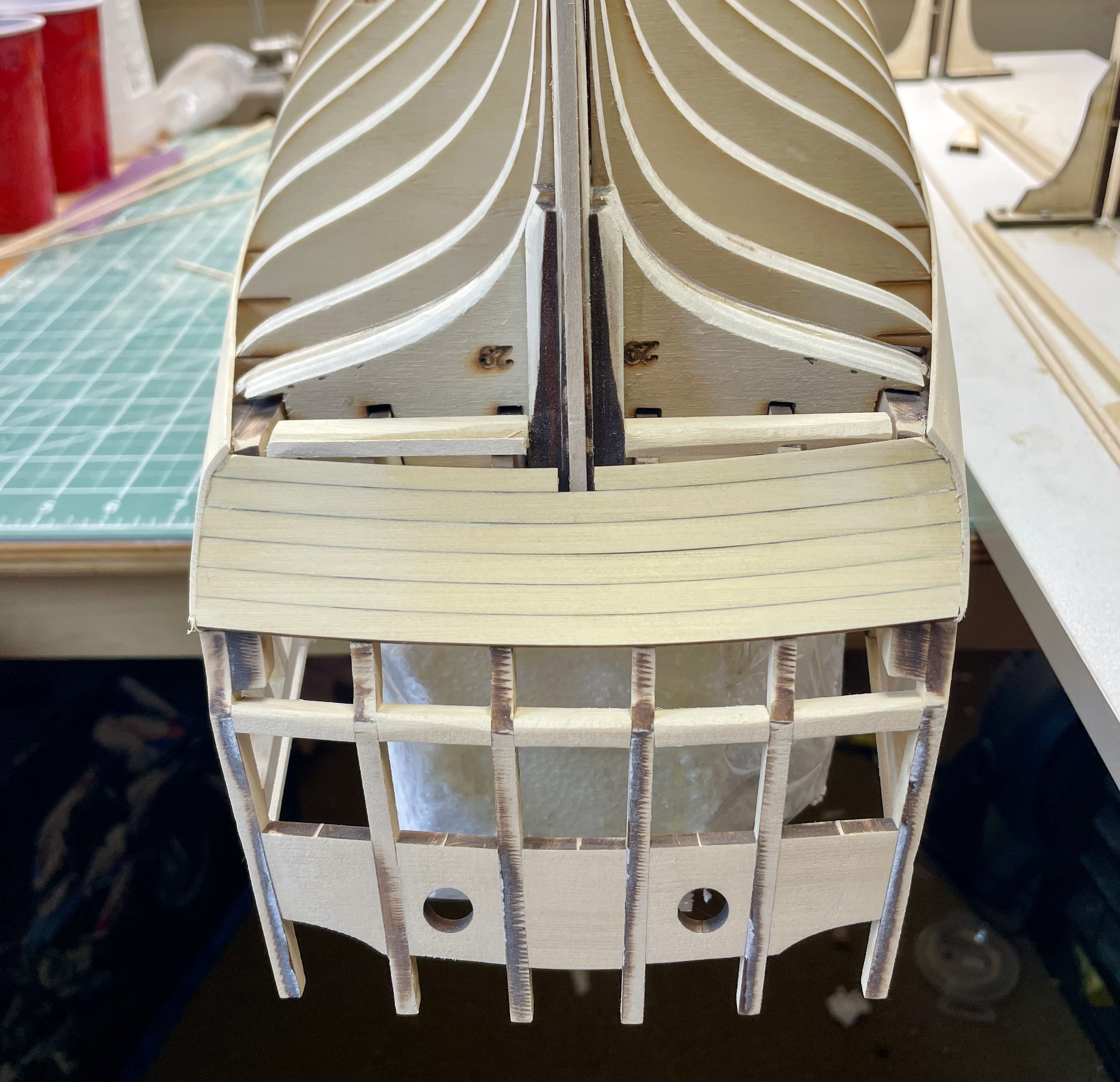

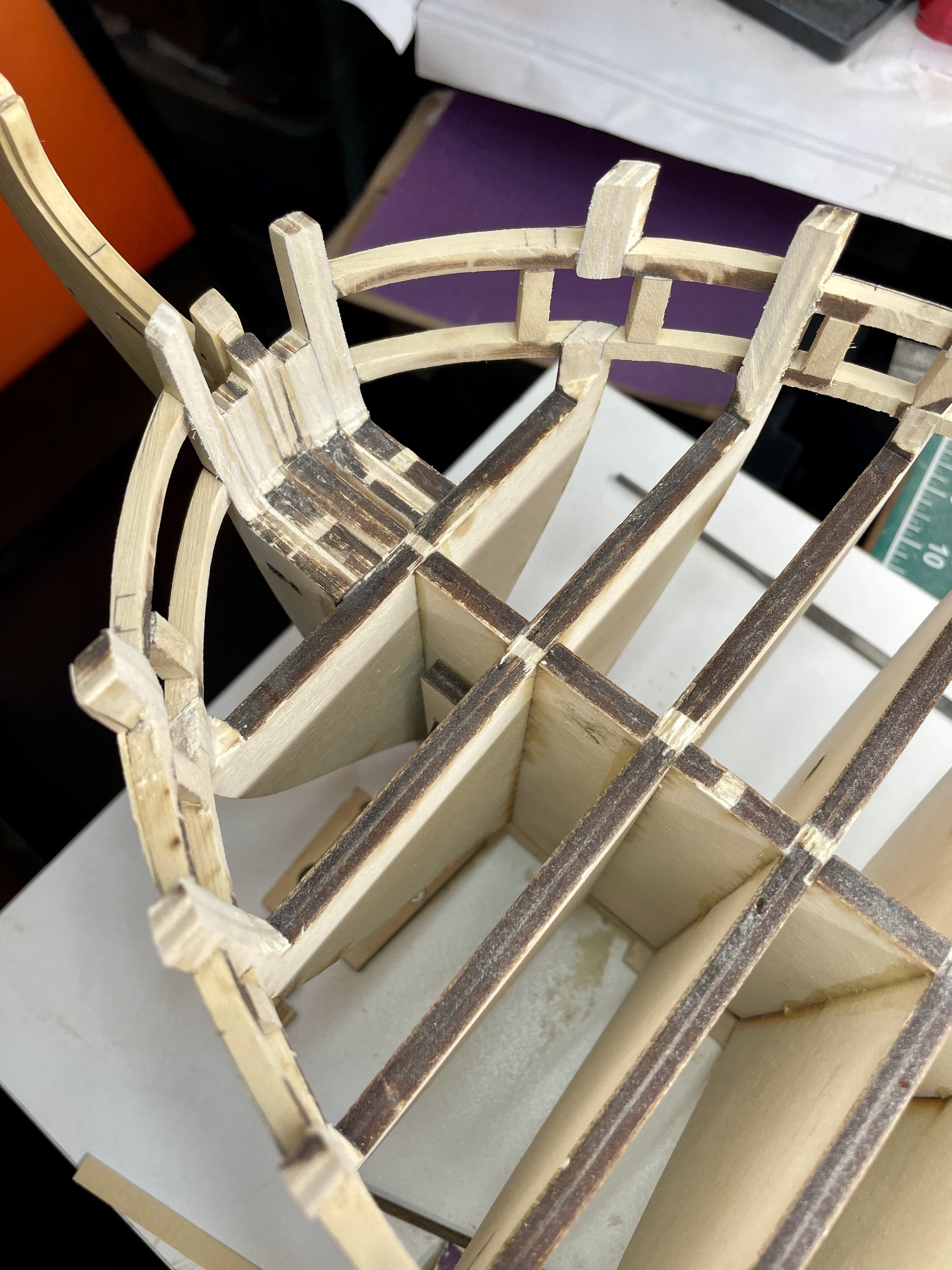

Started installing the stern frames.
Picked up the angle of the stern from the drawing.
It took a little filing and adjusting to get the frames to fully seat into the slots, Here I have all 6 frames dry fit with the window guides held in place with just the force of the frames squeezing them.  At this point I realized I made a small error when installing the starboard bulkhead 29 which is a little low.  It does not appear to affect the position of the stern frames which are still controlled by the other two forward bulkheads.
Checking the angle of the outer two stern frames before gluing them into position.  Still need to fine tune the position of the inner 4 frames and get them glued into position.
Hoping to get the sills installed this weekend.

Been a fairly productive weekend.  Have nearly completed the Quarter Gallery framing and mostly faired.
Completed installing the upper and lower sills.
Did some rough fairing of the sills and sanded the stern frames down to the dashed line.
Then fabricated the Quarter Gallery framing per the instructions, checking that each piece lined up with the template I created.
I used the laser cut planks for the Lower Counter provided in kit2 as a template to get the shape correct when fairing the frames and ensuring I did not over-fair the stern.
Picture showing the curve of the transom.
Placed the transom piece on the framing to check alignment.
Question - how much space should there be between the outer edge of the stern frame and the window opening in the transom piece?  I have 1/8 inch on each side.  I think this is correct from looking at the drawings but would like to double check if I need to add another 1/32 inch or so?

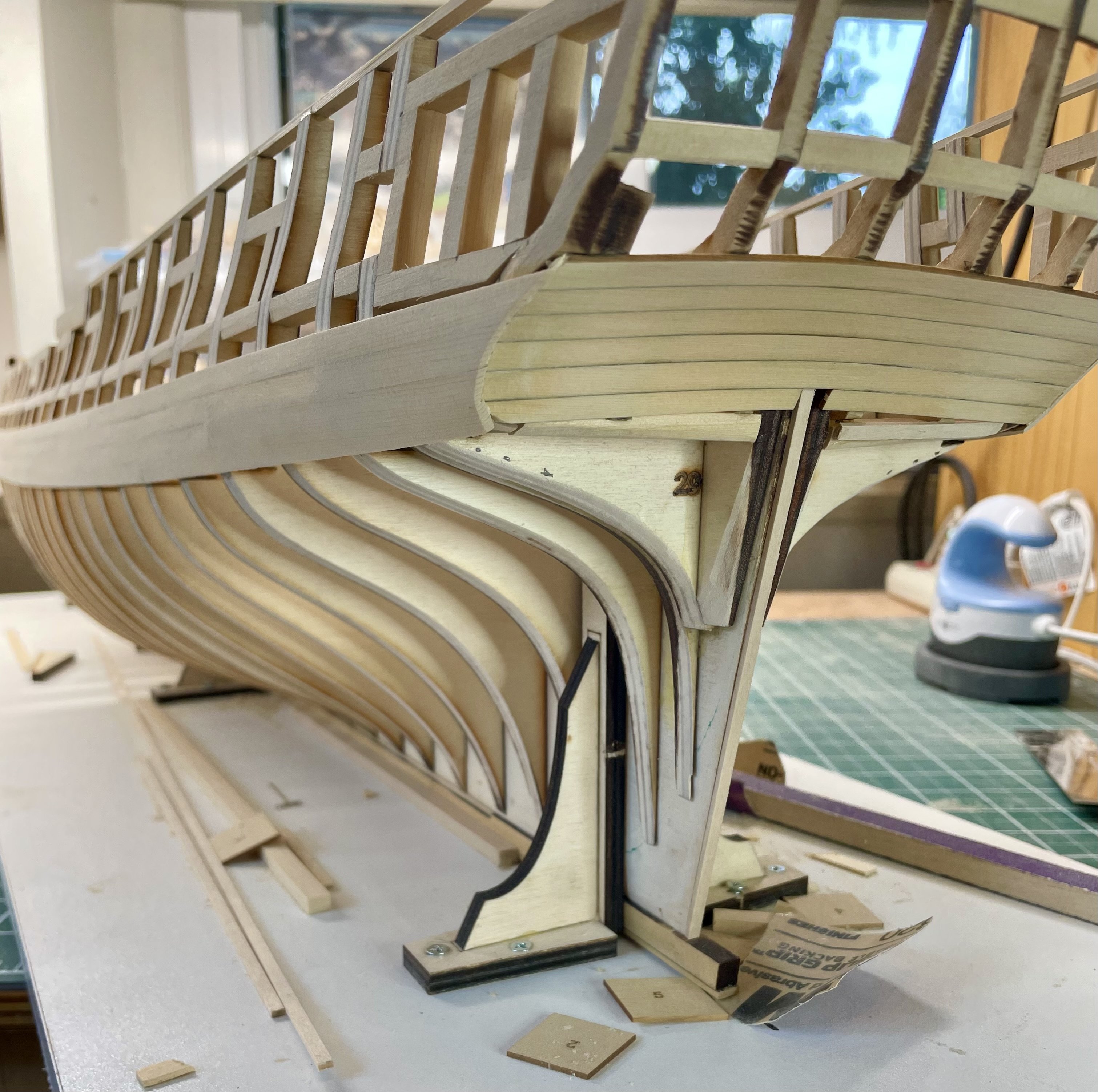

All assembly / fabrication for chapter 1 is now complete.  Still need to finish fairing the lower hull, especially in the stern.
I added the 1/8 x 1/16 inch strip along the top of the quarter deck bulkheads and the hance pieces.  To assist me with maintaining the correct shape while fairing the tops of the bulkheads I created some paper templates of the upper portions of the bulkheads to hold up to the model while removing material on the outside of the upper bulkheads.  You can see some of the paper templates on the build board.
The bollard timbers were an interesting little project.  Chuck did a nice job breaking down the process into simple steps.
First I faired the stem and forward bulwarks to 5/32 and removed the majority of material from the inboard bulwarks at the bow.  I still have a decent amount of fairing to do as you can see.
Bollard timbers test fit prior to shaping them, you can see the marks I made to guide the tapering of the forward face.
View after tapering front and rear faces.
And the completed assembly installed in the model.  Didn't take any additional progress shots.  Just worked slowly with my set of miniature files to add the features to the timbers.
It's amazing how a close-up photo does such a nice job showing all the little imperfections.  :)
I put on a coat of poly to seal the wood.  I'll be coming back with my files for some minor adjustments at some point to even out the width and spacing of the features.
Now time to flip this thing over and clean up the stern prior to moving into chapter 2.

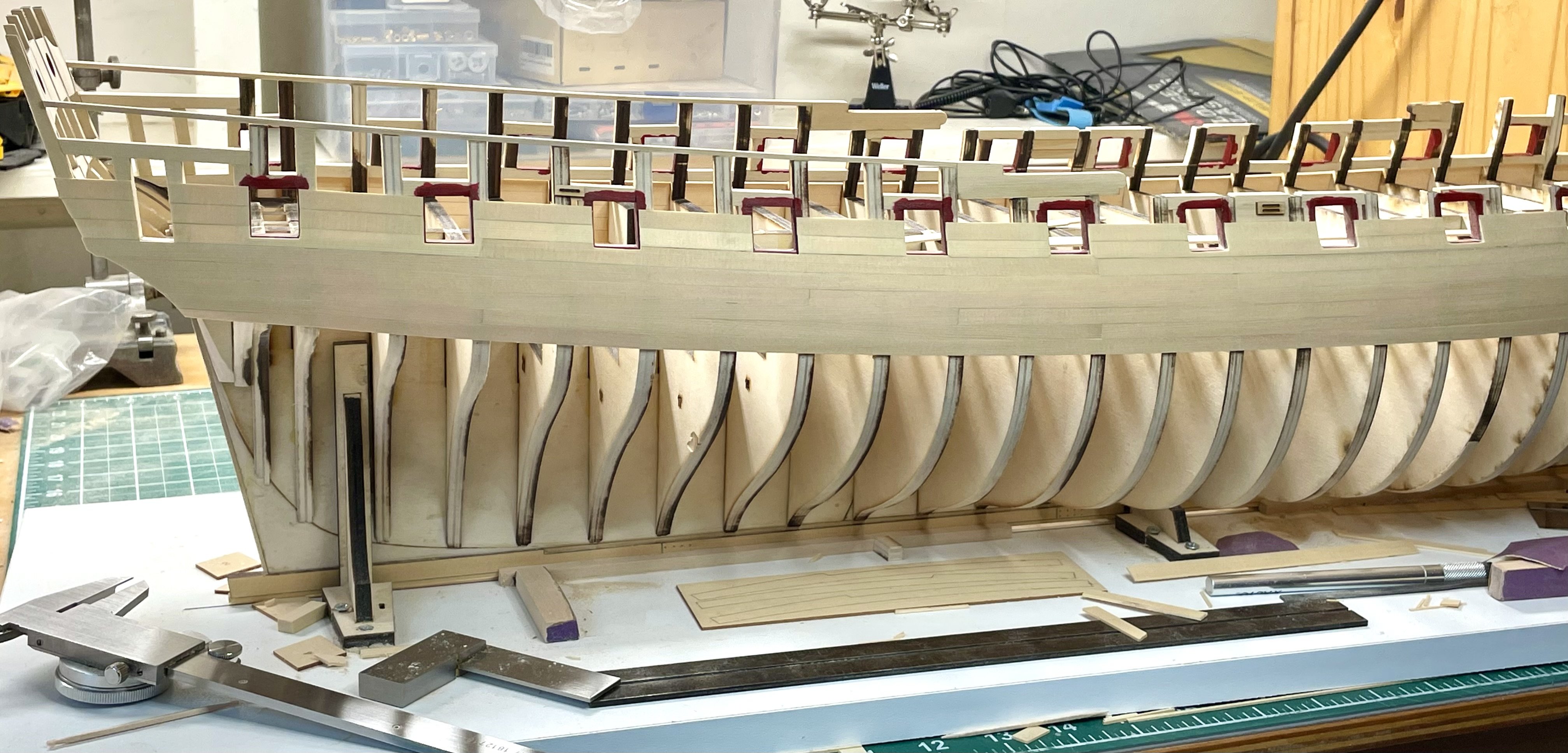

Planked the lower counter last night.  The laser cut planks made this really easy.  As usual, still have some fairing to complete.  Wanted to see where the lower plank on the counter landed before finishing the fairing in this area.  The line for the Wales lands right at the lower corners of this planking.
Quick test fit of the frieze for the lower counter to see if I removed too much material.  This is just a template made from a printout of the frieze with some clear packing tape used to laminate it.  Looks like I'll get it to fit.
Now onto replacing the battens to double check the lower line of the Wales especially at the bow and then onto installing them.
Steve

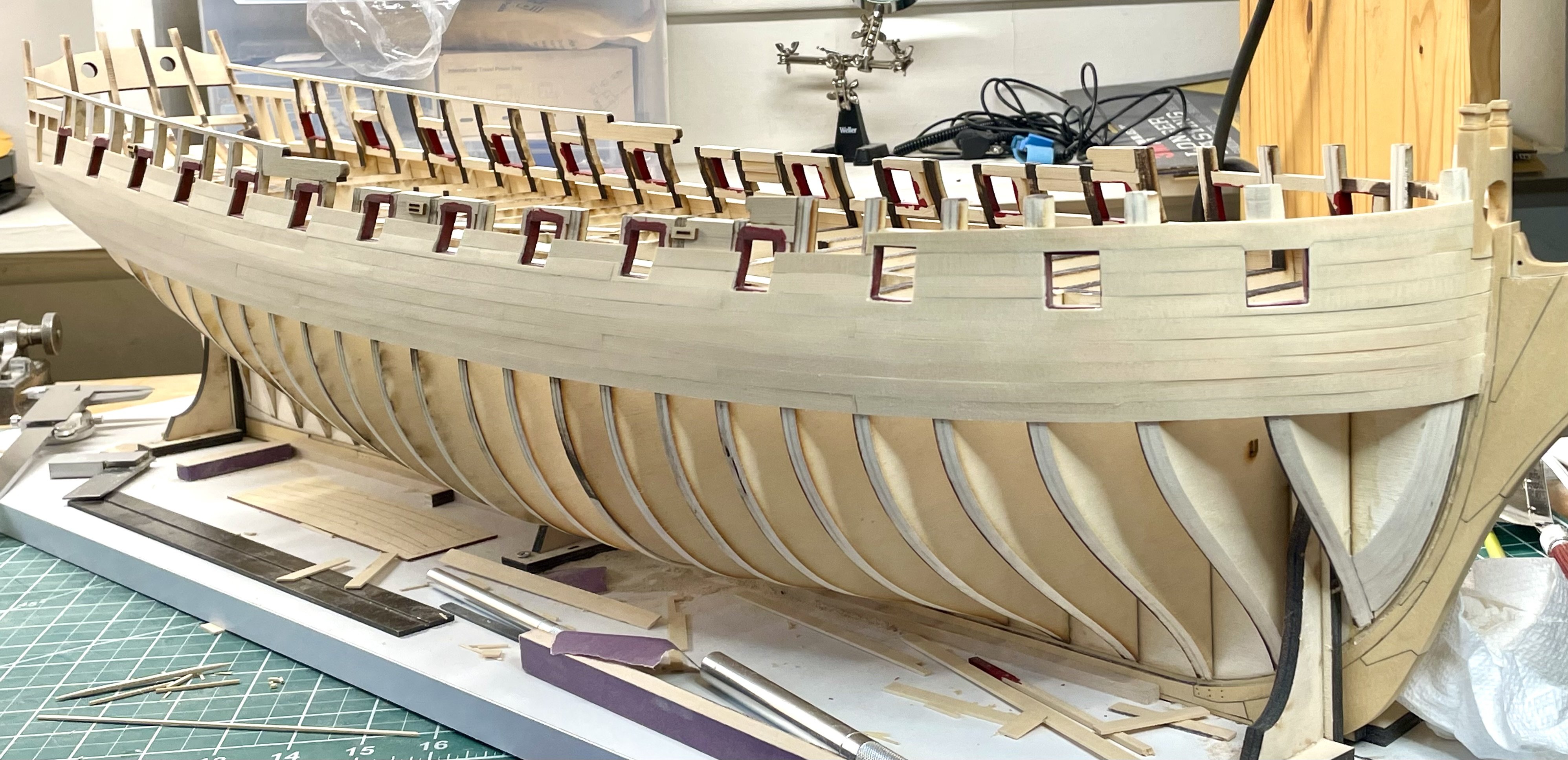

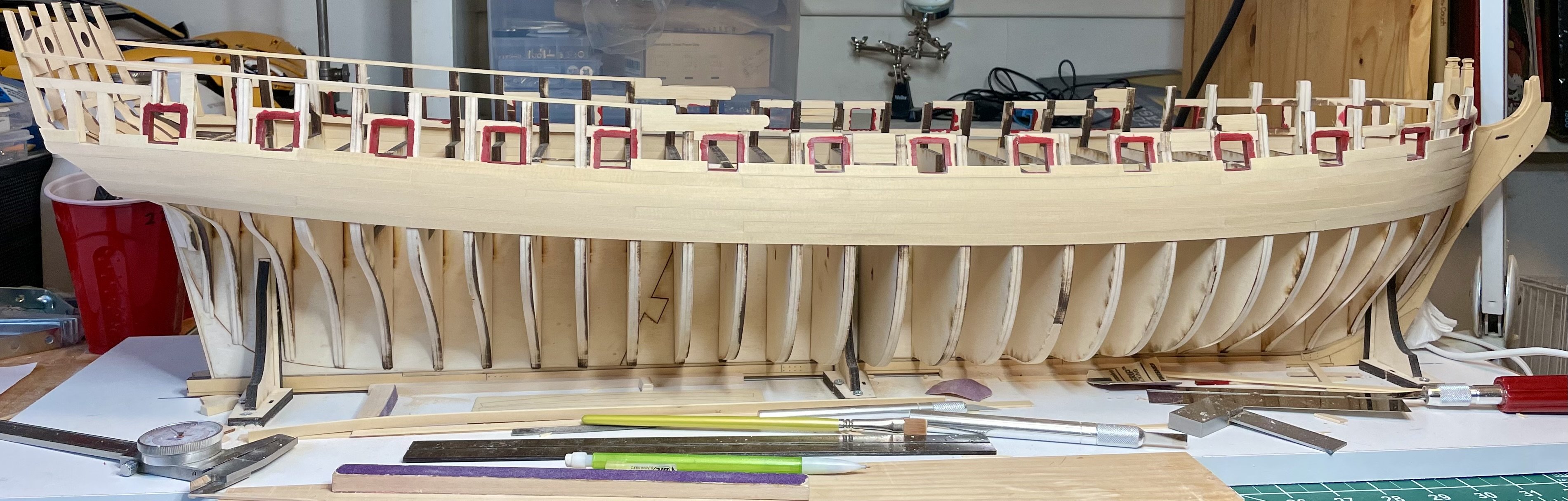

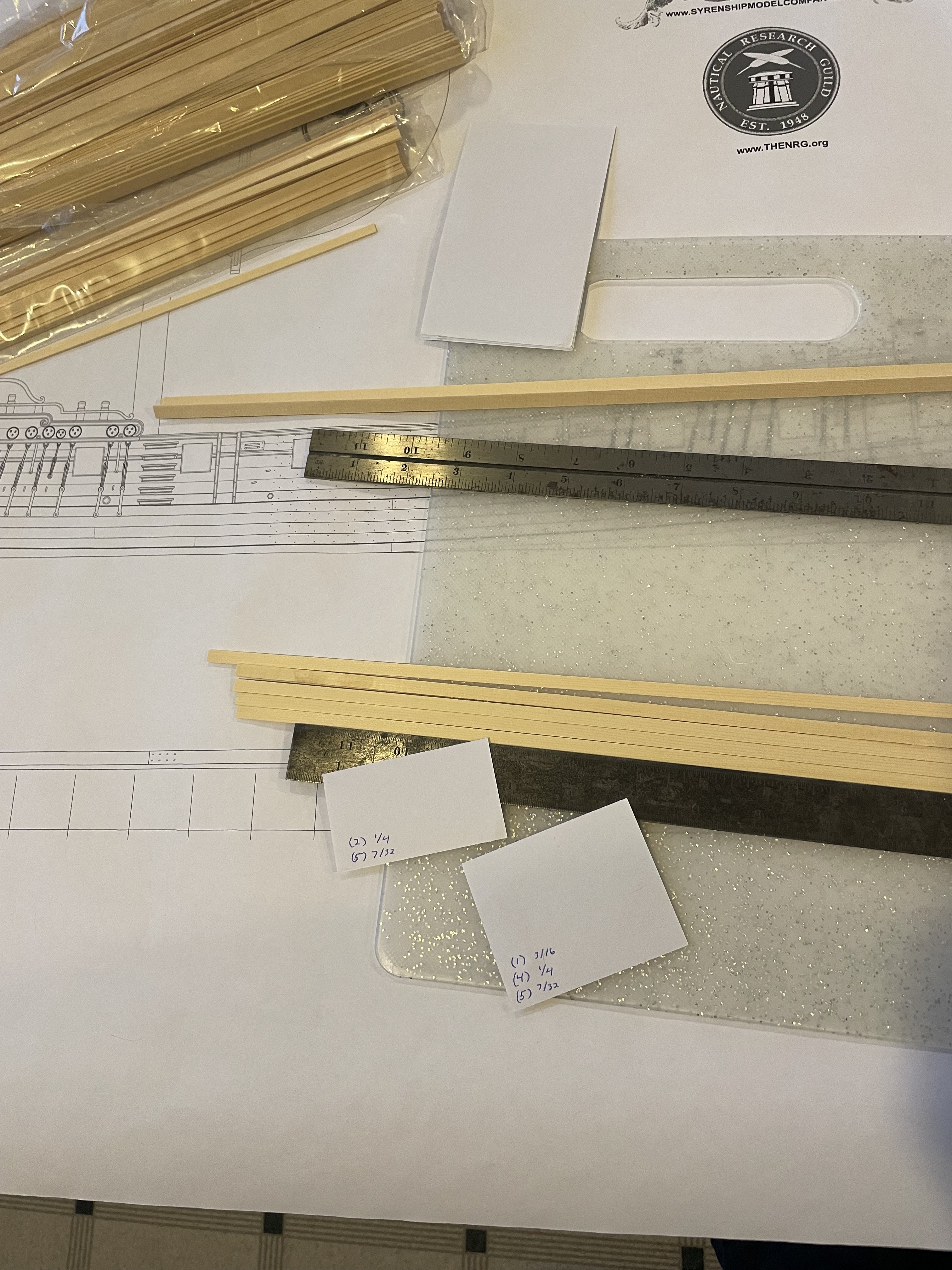

Update for the past week is that I completed the first layer of the Wales on both sides.  I'm pretty satisfied with how they turned out.  I started with the port side and made some mistakes especially up by the bow.  Starboard side turned out better but not perfect, I'm happy the instructions had me start with the Wales and that they are double-layered to allow me to make some small mistakes that I'll be able to cover up.  :)
I started off placing the battens again to double check the line,  I also created some gauges out of card stock to represent the total width of all the strakes at various points along the hull so I could see if the run of the battens was even from side to side.
Again, I found that using the least number of pins produced a nice smooth run for the batten.

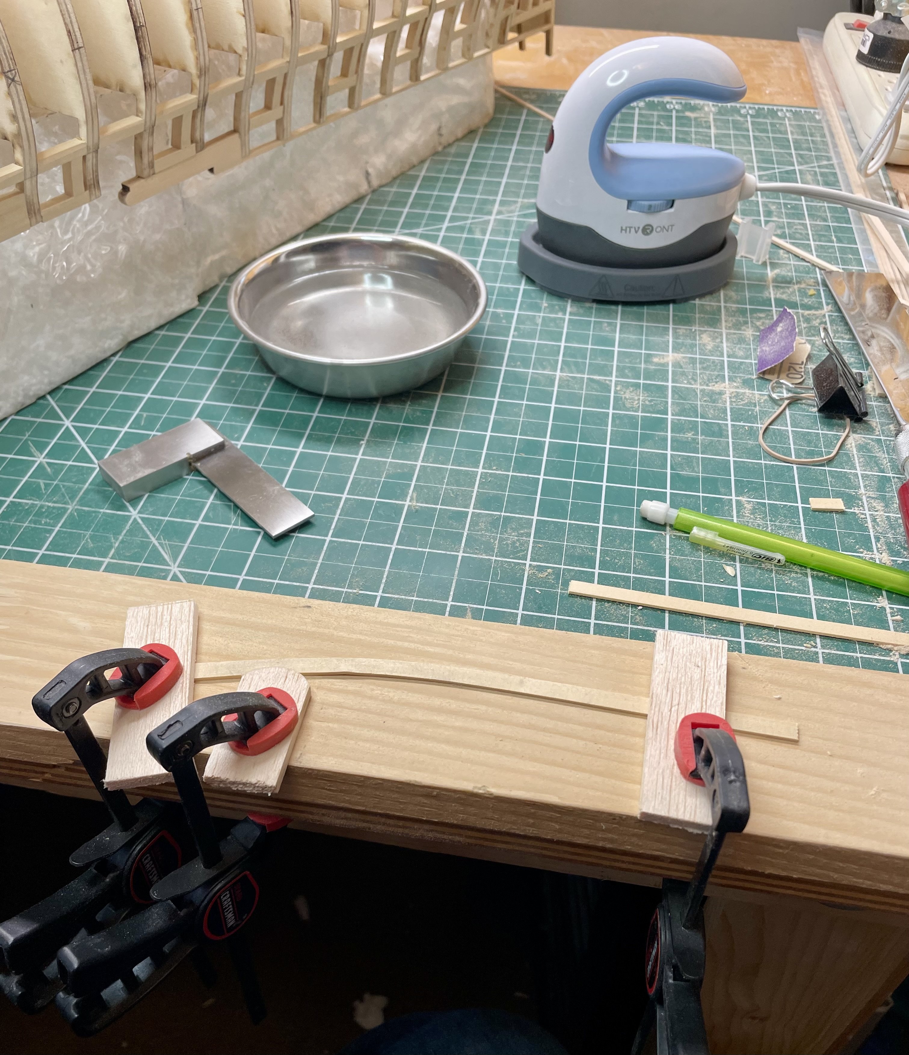

I'm following Chuck's method of planking for this model based on the video he did including the way that he deals with shaping the planks for an edge set.  I picked up a little hobby iron that's only about 2" x 3" and tried it out on a scrap piece before starting with the lowest strake of the Wales.
I used this technique to edge-set the lower strake around the bow and it worked well.  The first mistake I made was doing the same thing for the 2nd and 3rd strakes on the port side and over-compensated for the needed curve.  This caused some problems in getting these strakes to fit.  On the starboard side, I used the lower strake to act as a guide and used a little water and heat from the iron while holding the strake in place on the hull.  This seems to work better for less aggressive curves.
Port side, the light showing through the strakes at the bow is in fact a very thin spot after sanding.  The changes in levels of the strakes is now no more than 1/64 of an inch and I stopped sanding before I completely broke through the strake.  I'll likely back up these areas with some scrap on the inboard side and the second layer of the Wales will cover it up.
Starboard side turned out a little better.  On average, got the stakes about 1/64 inch closer to fair prior to sanding.
I'm pleased with where the run of the Wales landed against the lower counter.  I over-faired the lower corners of the lowest strake of the counter.  Pretty sure this will be covered later on.
I'm going to paint the gun ports prior to adding the 5th 7/32 strake (black stake) above the Wales.
I'm really loving working with the yellow cedar.  All my past experience has been using basswood for planking, the yellow cedar is much easier to work with.  It's just a little more durable but still very forgiving.

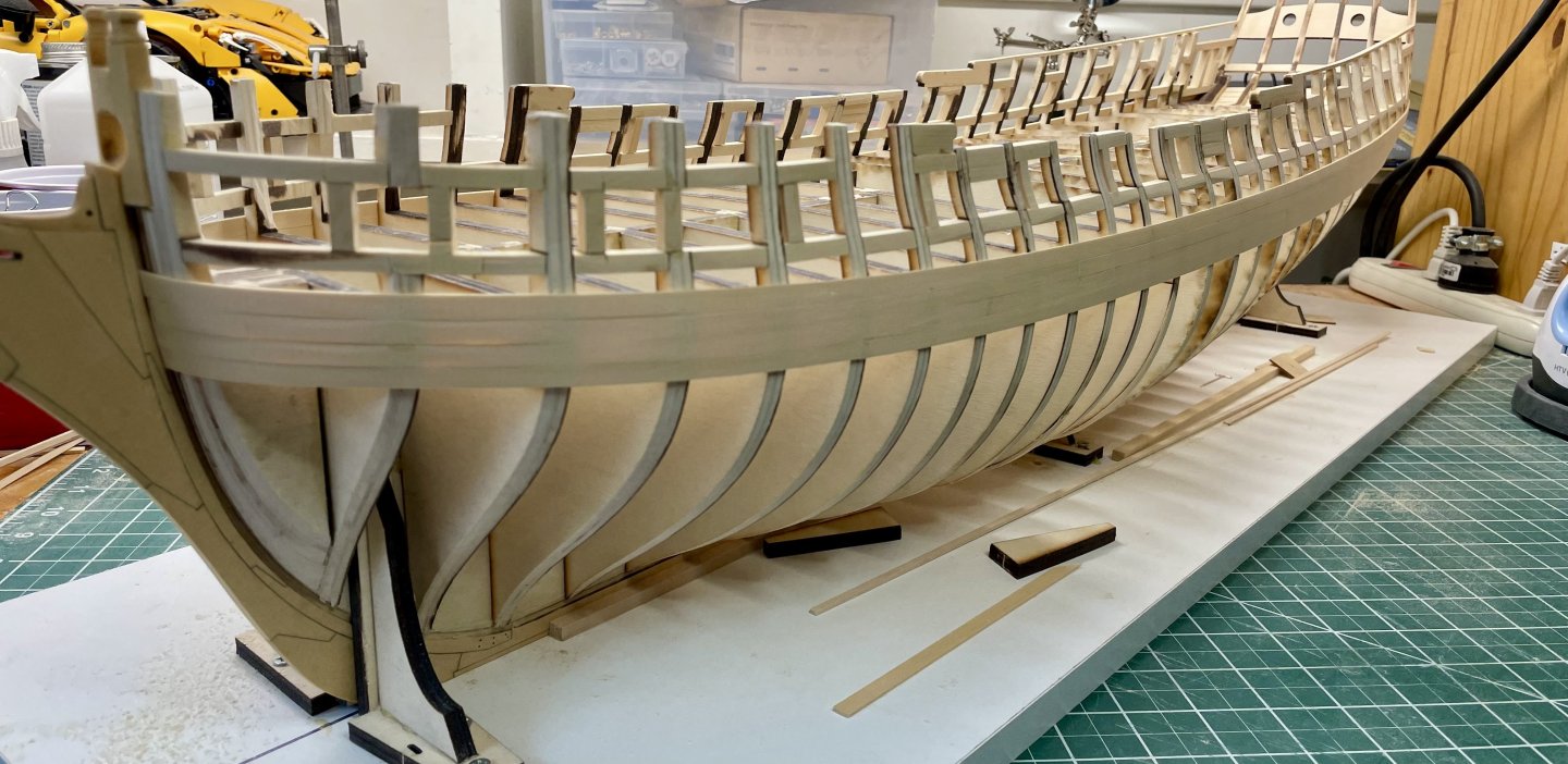

Current Project:  HMS Winchelsea
Thank you Frank for the comment and everyone else for the likes.
It's been a couple weeks and progress slowed a bit with moving my youngest daughter back home from college and other family obligations.

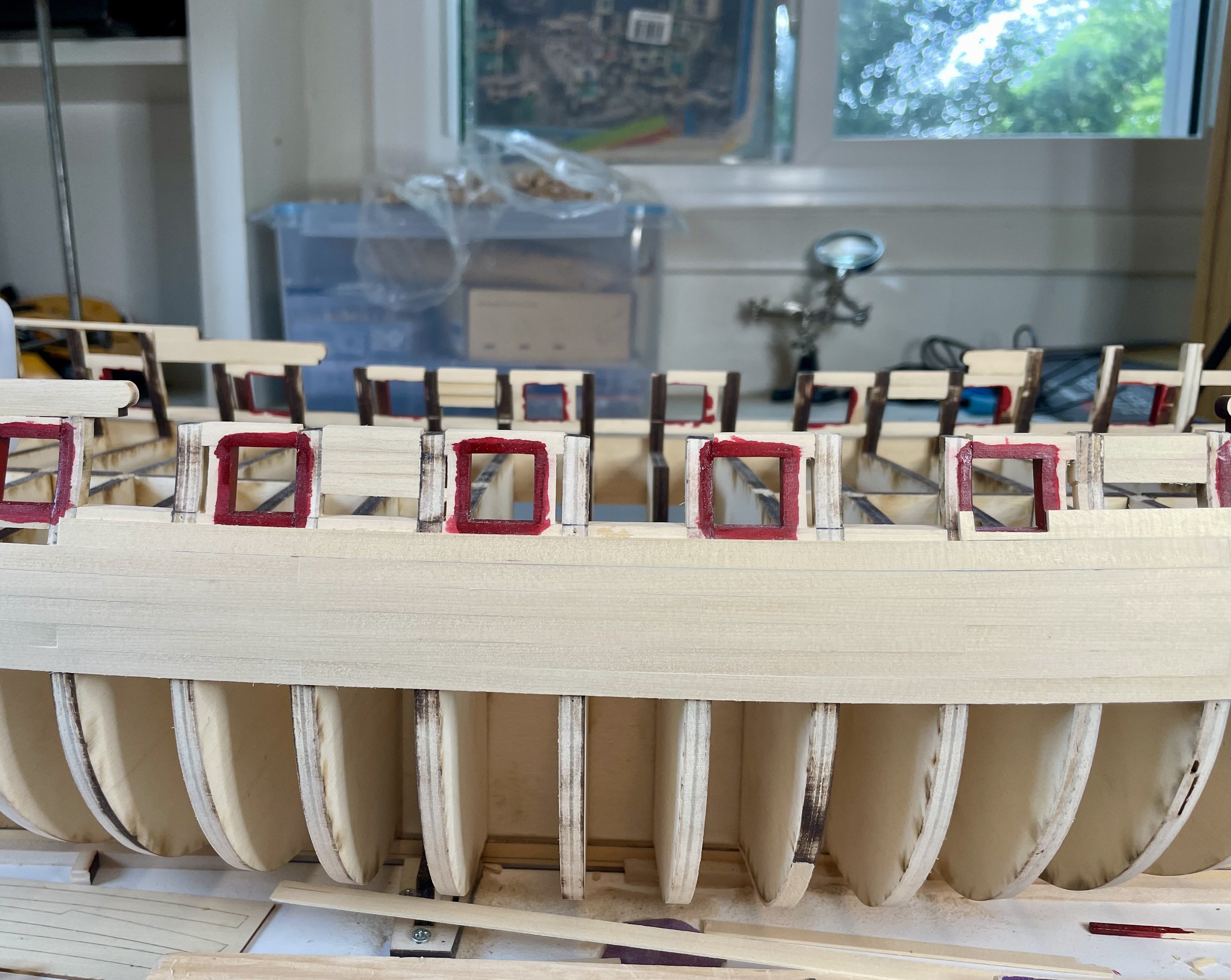

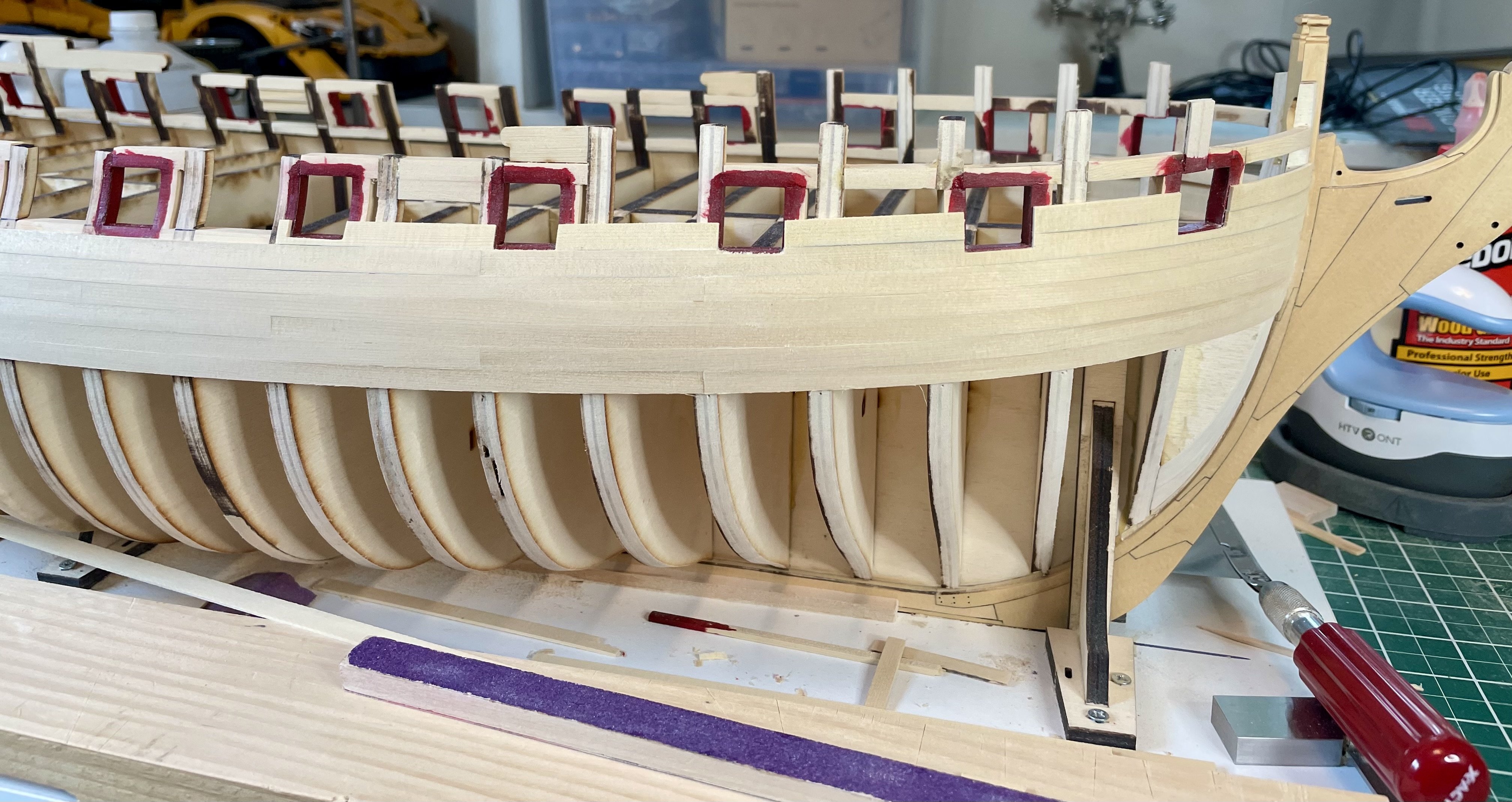

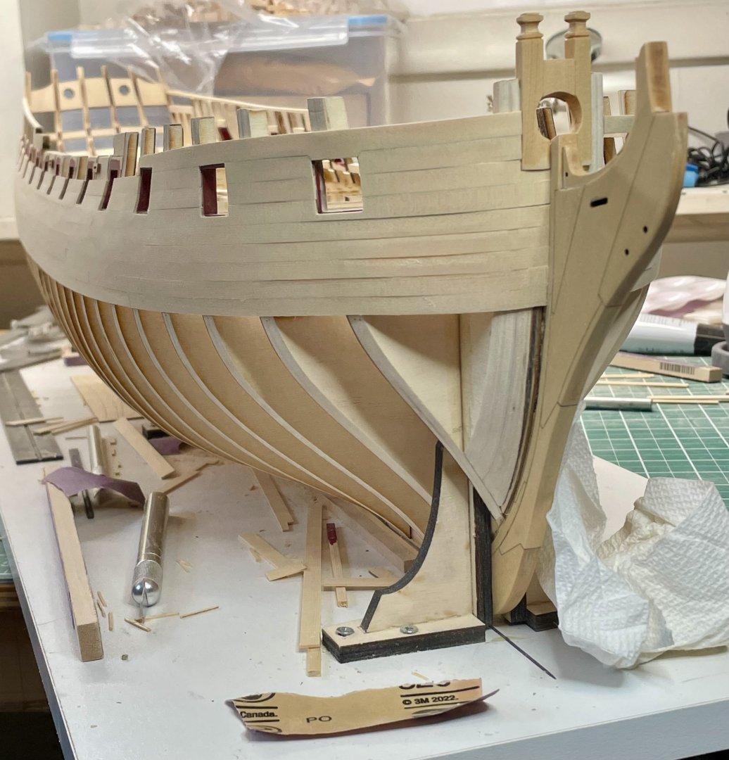

I painted the gun ports and started planking above the Wales on the starboard side.  As you would expect, the pace of things has slowed down considerably with the number of pieces that need to be cut and fit.  I started out with about 1/3 of my planks around the gun ports being scrapped for one reason or another.  I'm improving and only about 1 out of 4 is now junk.  :)
Forcing myself to go slow and check the fit twice as often as I think I should has helped.  I've also learned that making light cuts with a saw is better than cutting with a knife in many cases where you are cutting close to the edge of a plank to prevent splitting.
A couple pictures from earlier this weekend
And one from this evening with some additional progress

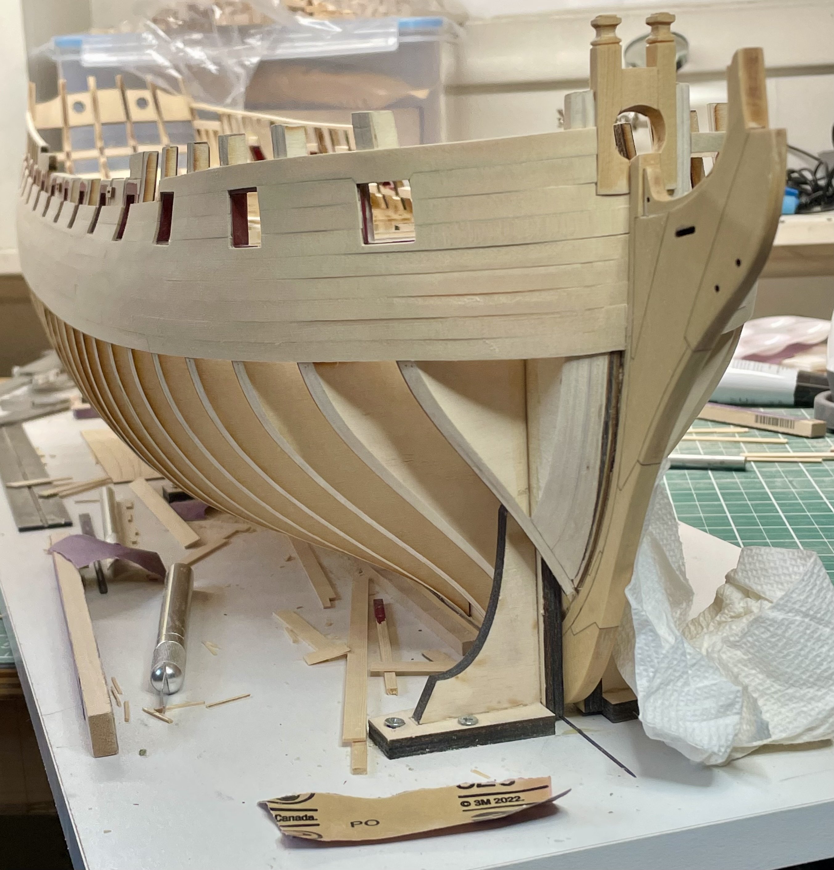

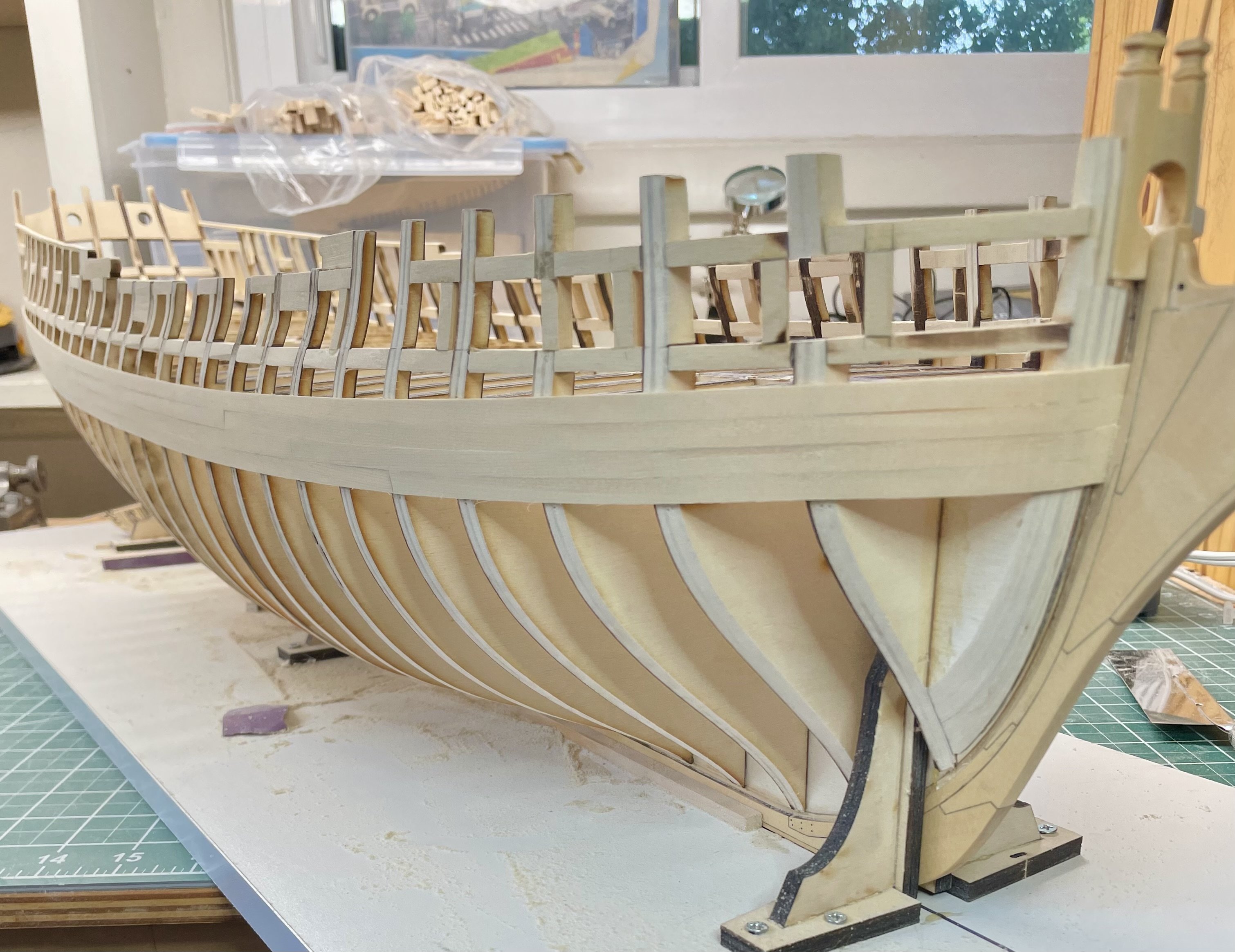

Just a few progress shots of work around the Starboard gun ports.
I have the gun ports fully planked around at the bow, I really like the shape and lines of the hull that are becoming apparent as I complete this area.  Still have some more sanding to do, but the lower 5 strakes will all be planked over so I'm not worrying much more about those, just the strakes above the Wales.  Looks like I'm consistently not sanding the plank edges where the upper plank overhangs the lower, may need to flip the hull over and try again.
Finally added the fixed blocks now that I could be sure of where the planks were laying.  Started to fit the next plank and messed up the cut for clearing the fixed block so called it a day.
And one last shot of the stern.  Still need to trim the planks at the transom.
