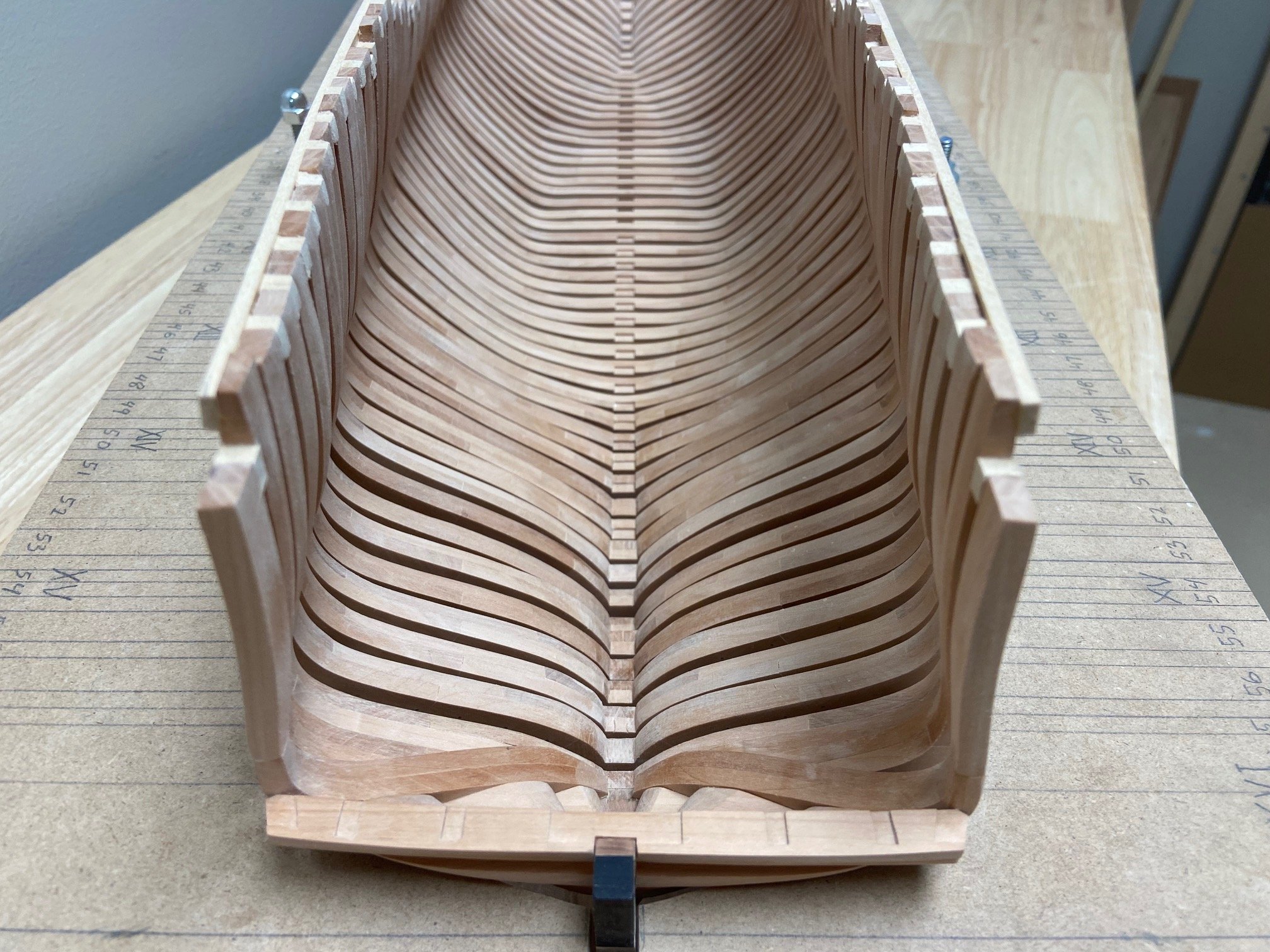

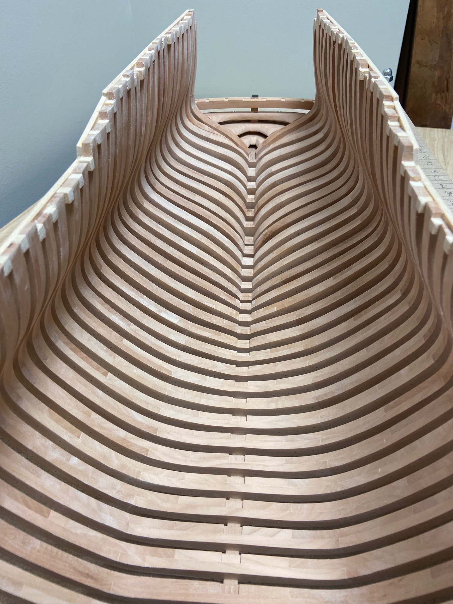

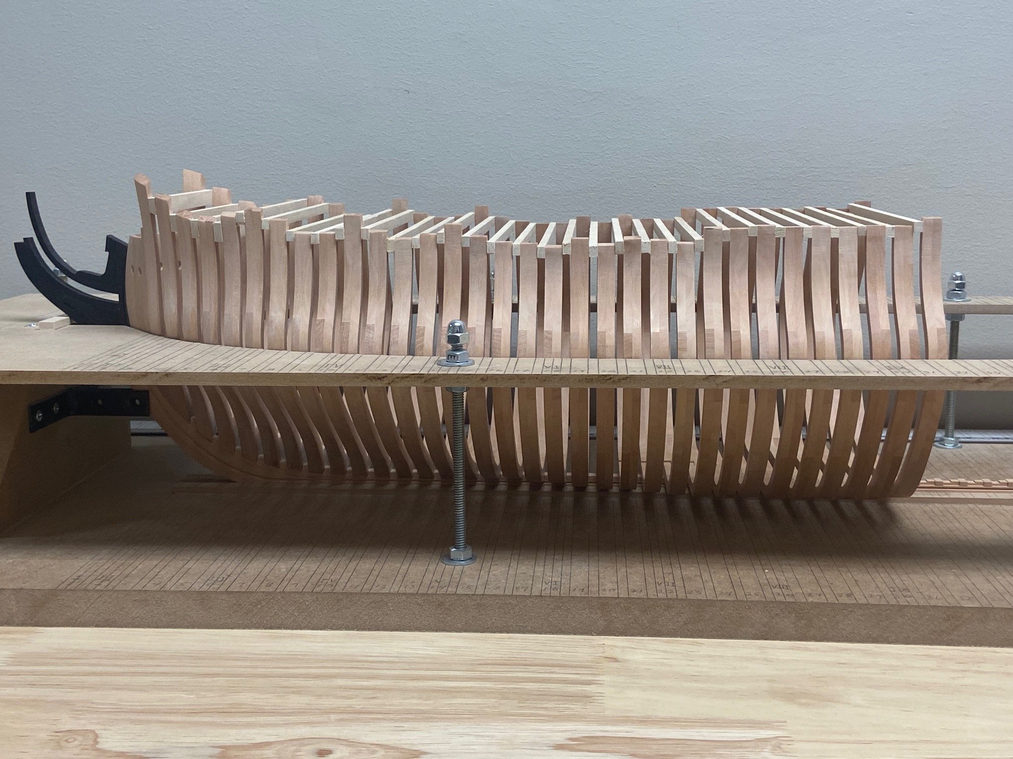

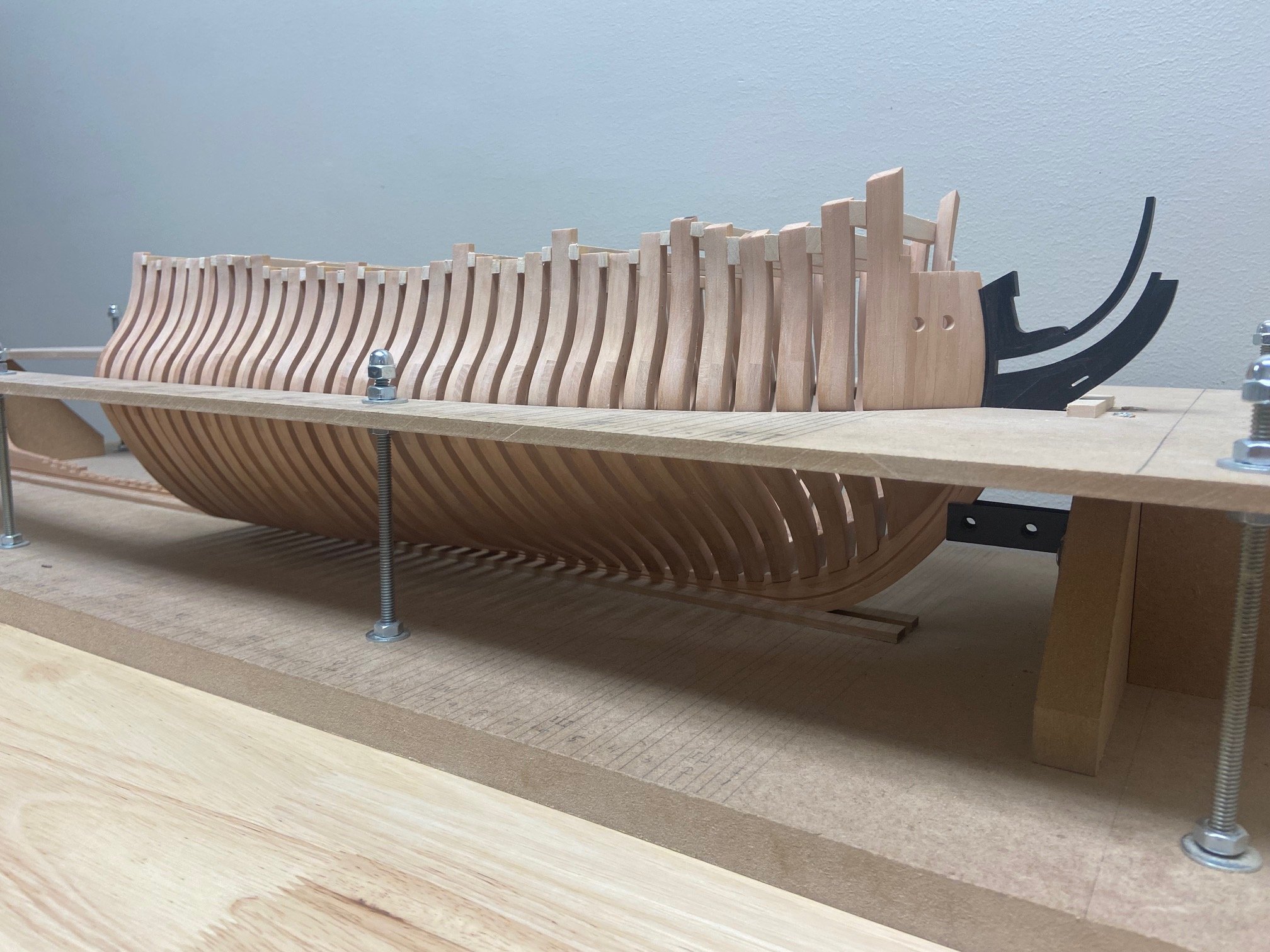

I have no idea of french shipbuilding. But it‘s looking strange, that the hawse pieces do not end at the rabbet. How should the planks fit then there?
Regards Christian
Exactly Chris: A smooth transition without any angle for the planks to seat against.

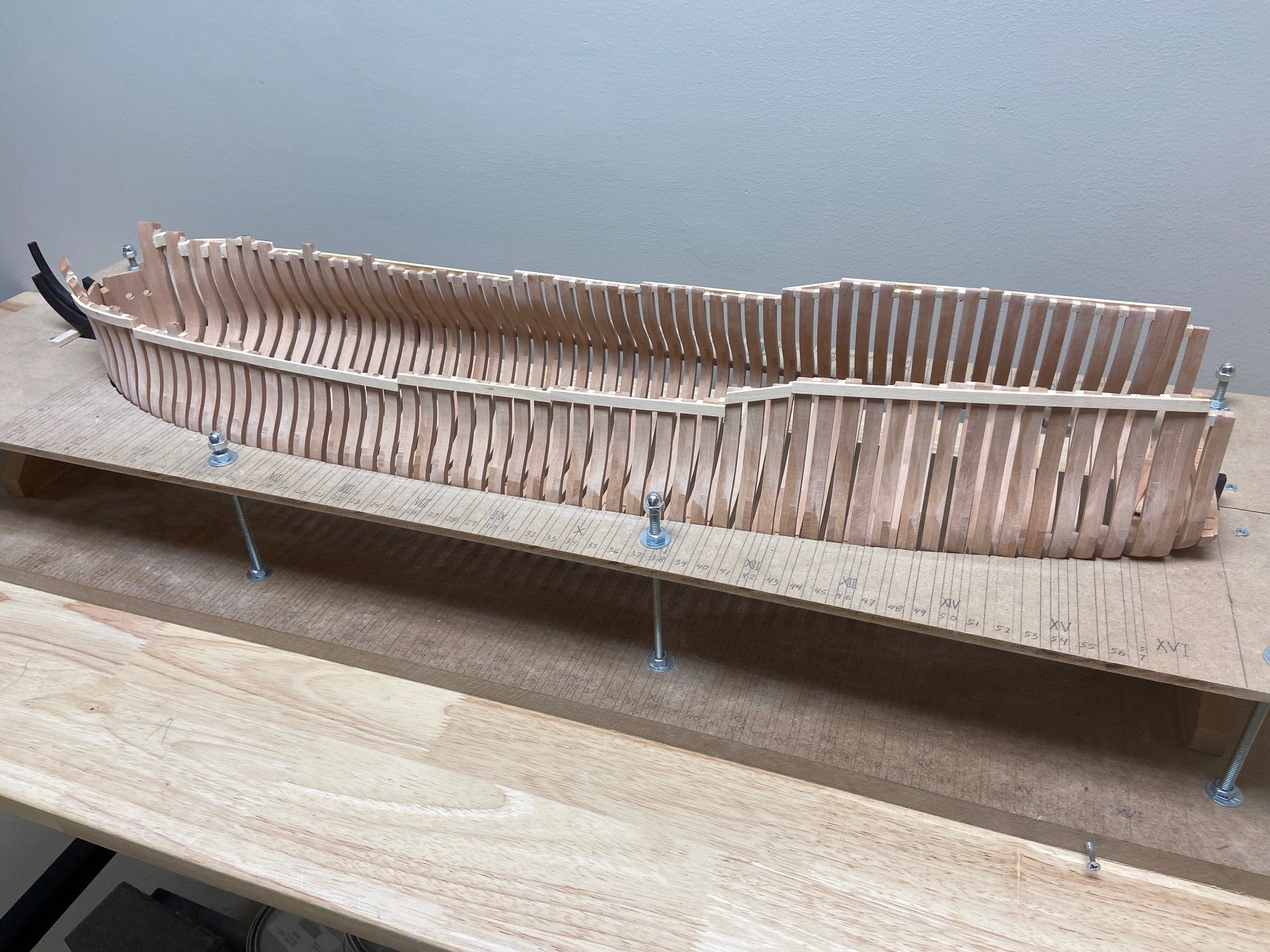

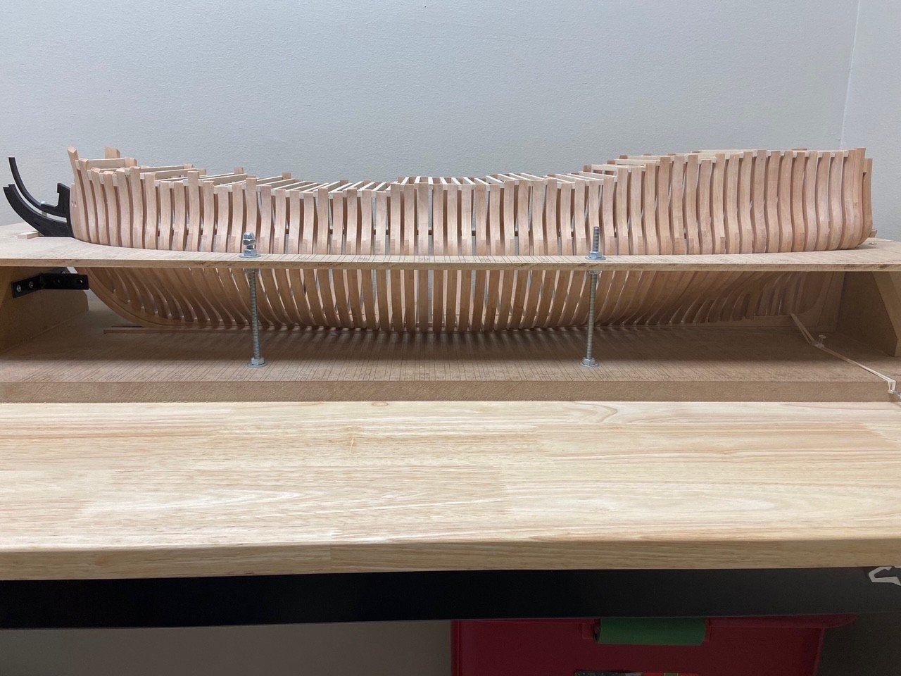

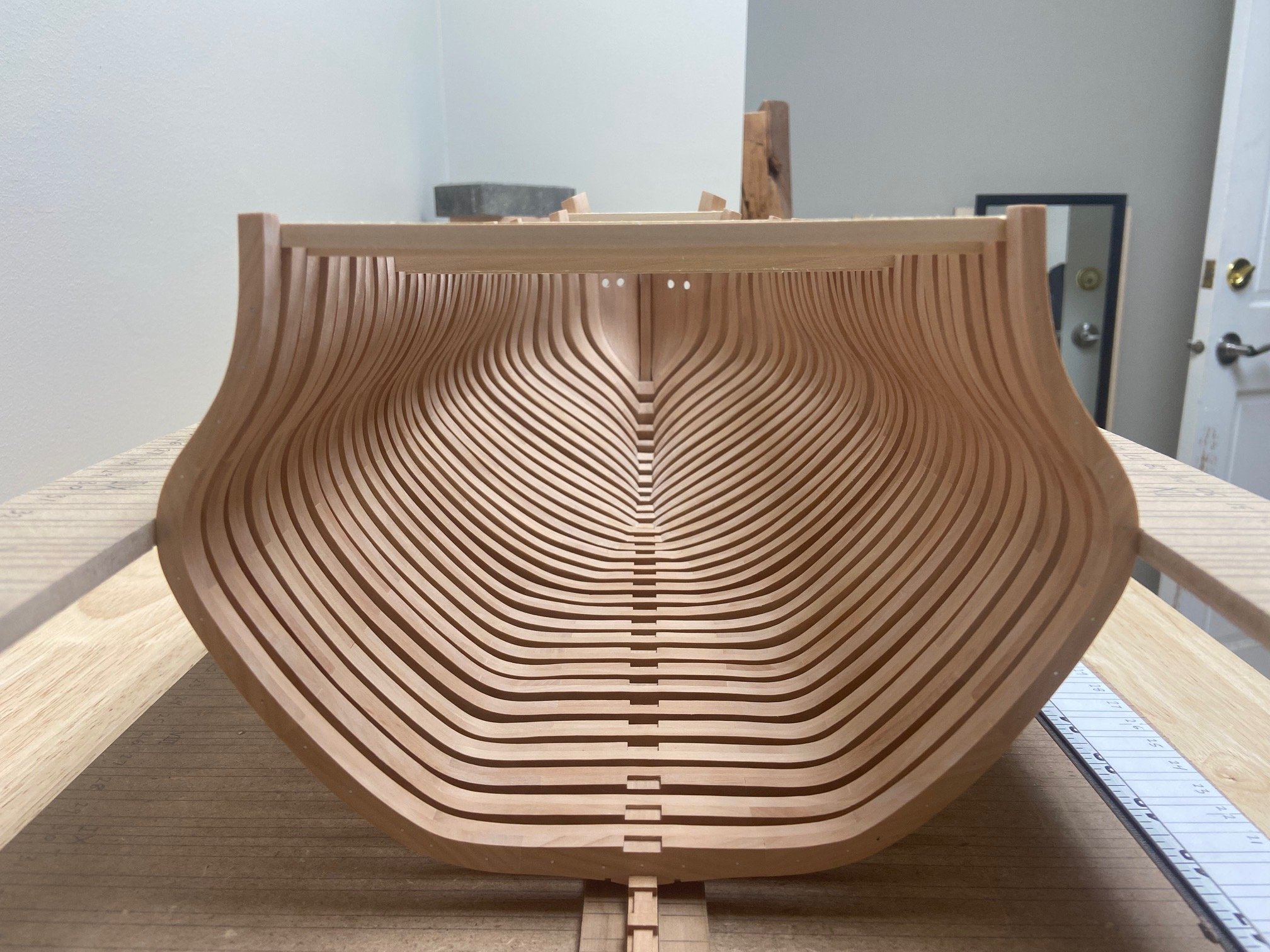

Thanks guys - this one truly is a labor of love as I have been enamored of this frigate and her lines for quite awhile.  This is also my first fully framed build that has progressed this far.
As far as frame construction I simply cut the patterns, glue them onto a pear blank in this case 4.65mm thick and cut out the parts with a margin of 1mm with the exception of the joint line which is right on it using my disc sander.  I place one of the patterns on a glass sheet and glue the first layer of parts at the joints and follow it by the laminating the second layer on top paying close attention that the joint lines are perfect and aligned.  Then another plate of glass is placed on top for 24 hours while it dries.
The finished frame is then cleaned up with an oscillating sander.
As I continue to install frames I am getting a reject here or there so I will take photos next time I have to remake one.

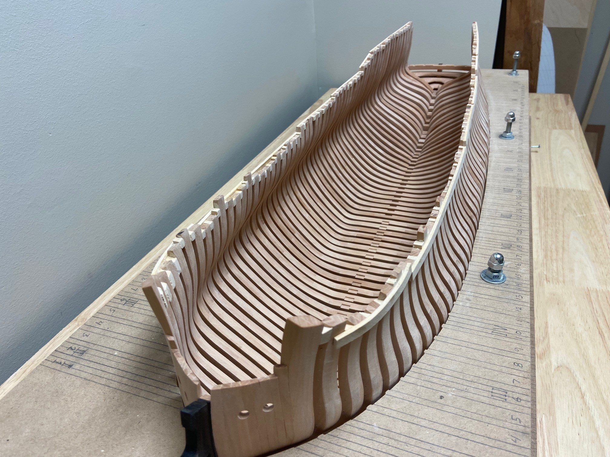

Thanks for the likes gentlemen !  And appreciate your comments Chuck and Druxey - as you both know from past posts this has been a goal of mine for quite some time to build scratch build a fully framed model.  There's still a ton of work ahead of me including next up -  fairing the hull, interior first - which is always a "pleasure"
They are some great pictures Chris - I found that when I faired the interior of my build my knuckles and fingers took a right beating 😂
Looking very good, Chris.
My solution is a bit late now: In order to avoid barked knuckles when fairing the inside of the hull, I fair the fore and aft frames before adding the midship ones. This gives lots of access and elbow room.  Ah well, next time, perhaps....
