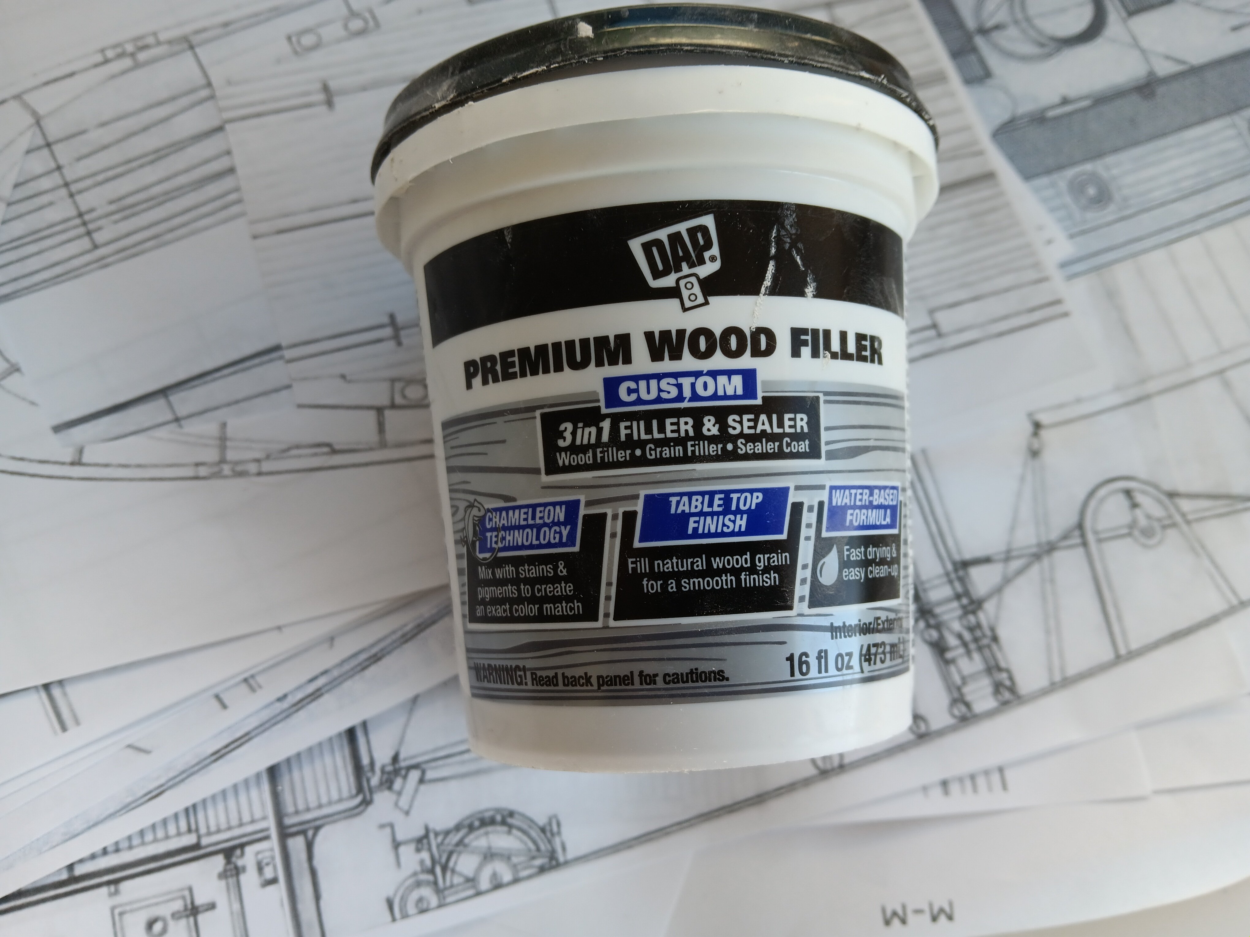

For wood filler, I have had good recent success with DAP Plastic Wood-X.  If the container dries out fast, the DAP folks told me to add a drop or so of water to soften it up.  🤷‍♂️👍
