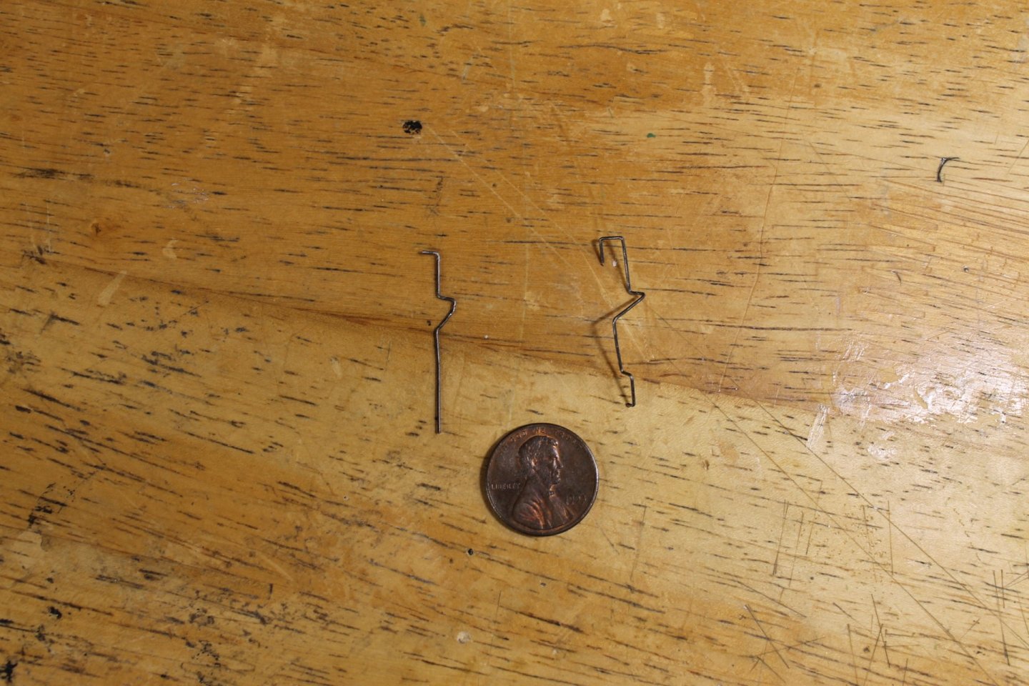

 Not much to report this evening. I've been working with 24 GA annealed wire trying to create the river to pump, pump to water tank, and tank overflow water lines.
Making these little lines is about to drive me batty. "How hard can it be" you ask, well, pretty dang tough! The home run piece between the pump and tank has been the most difficult. I'll think I'm almost there, I make a slight adjustment and then I'm back to square one. The challenge is not only connecting the two point but also making the line square while following the roof angle.
 I'm still not 100% satisfied with the pump to tank line. Once the engine room is attached I may start over using what I have as a pattern.
 The overflow and river to pump lines are acceptable.

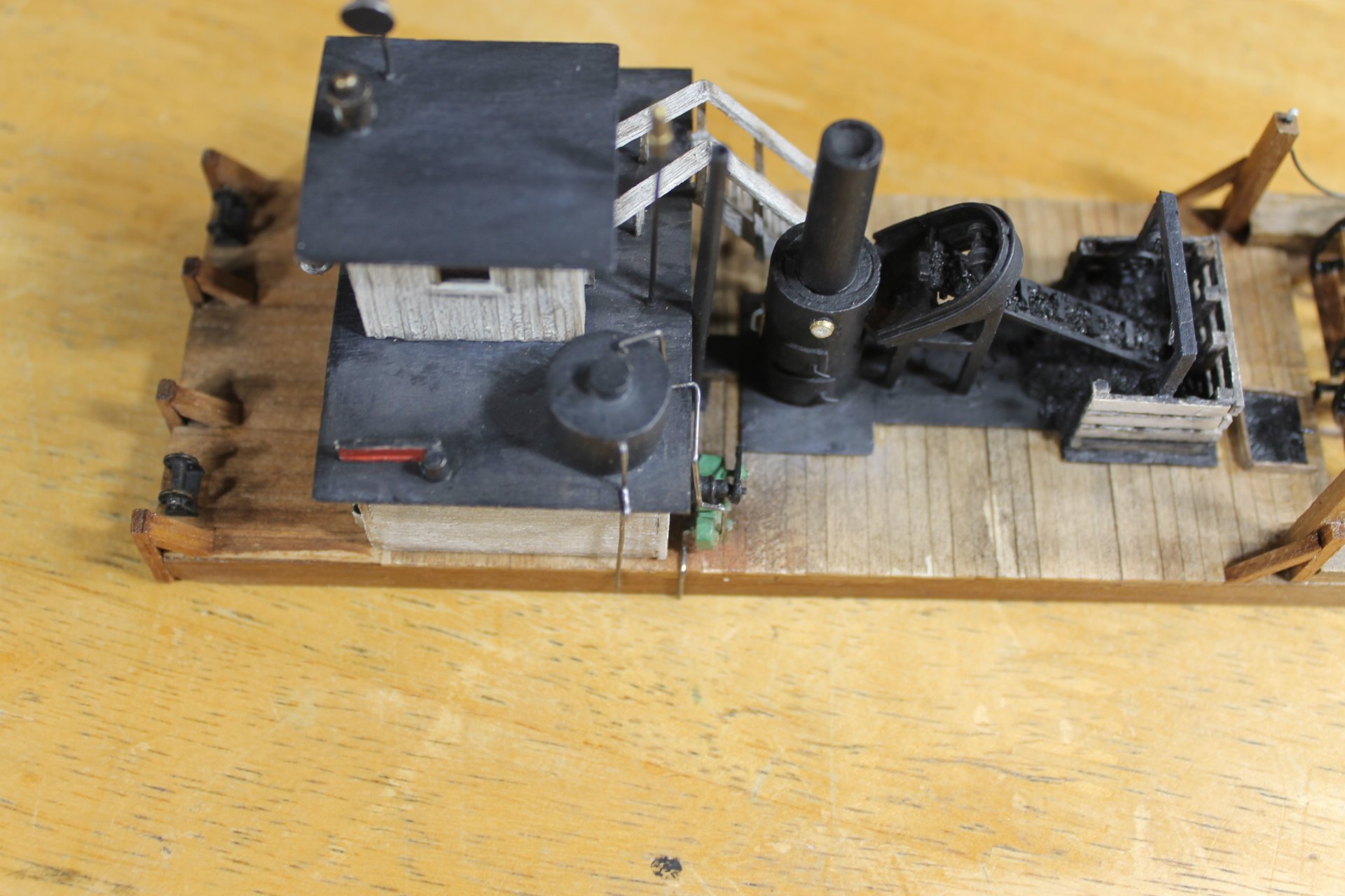

 i did manage to get a steam pressure gauge and water level sight gauge made and attached.
 I still have the tank to boiler water line, two exhaust and three steam lines to run before I can permanently attach the engine room.

What material is your 'annealed 24 GA' wire? Is it still too springy? Many modellers use solder wire for such applications, where 'compliance' is required. Solder wire is readily available in 0.5 mm diameter, which is equivalent to 24 GA.

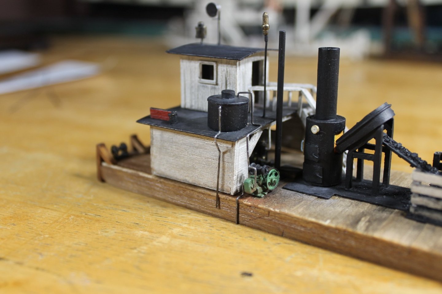

Are you going to protect those outboard pipes somehow? Bare like this they could be easily ripped off by the coal-barges etc. A couple of wooden clamps around them would solve this problem.

 Thank you, Eberhard. the annealed wire I use is soft without any spring. Making bends in the wire isn't the issue, it's making the correct size length between bends. i use jewelry pliers but some of the lengths between bends are too small even for the needle nose.
 Your question is very valid and i would normally say yes, that I need to add some sort of protection for those exposed water lines along the side of the hull except, the hog chains are exposed along the outside of the hull and there is no protection for them. There aren't even any fenders unless they've been worn off and haven't been replaced due to neglect. I don't know how they weren't rubbed off, it's a bit baffling. Every workboat I've seen photos of, the sides of the hull are scraped to a fare thee well. If the skipper managed not to scrape off the hog chains then I guess he was able to not scrape off the water lines.
 The short answer to your question is, no, I'm not going to add any protection for the outboard pipes.

At such short distances, bending is indeed difficult. From time to time I use a piece of styrene with a hole of the same diameter as the wire near its edge instead of pliers. I then put the wire through the hole and bend by twisting the styrene piece or bend the wire while holding the styrene piece, depending on what I need.
If the distance between bends is too small, you can still cut the styrene to remove the wire. It takes some practice, but once you get the hang of it...

As to protections etc. they may have used portable fenders made of pieces of wood, hung overboard with a rope or even fenders made of old mooring ropes. Even today these methods are used on small workboats, apart from of course more professionally made inflated fenders or car/truck tyres.
 Thank you, Roel. Great ides for bending wire and fenders.
 It's countless, countless I tell ya, times when the plier jaws and wire have met that I haven't thought of you and wished you were sitting next to me to offer advice.

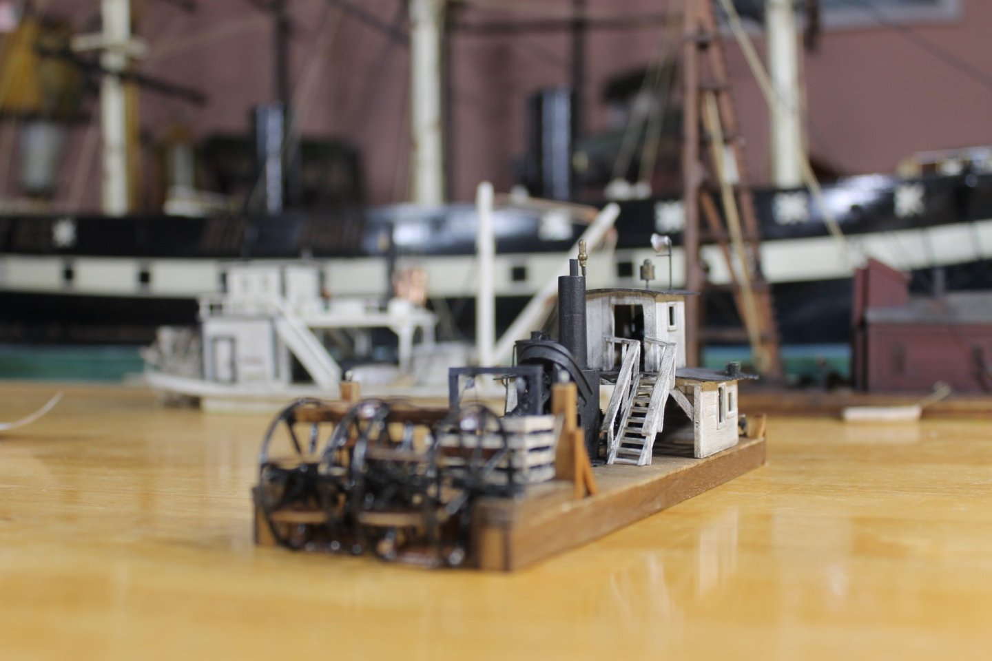

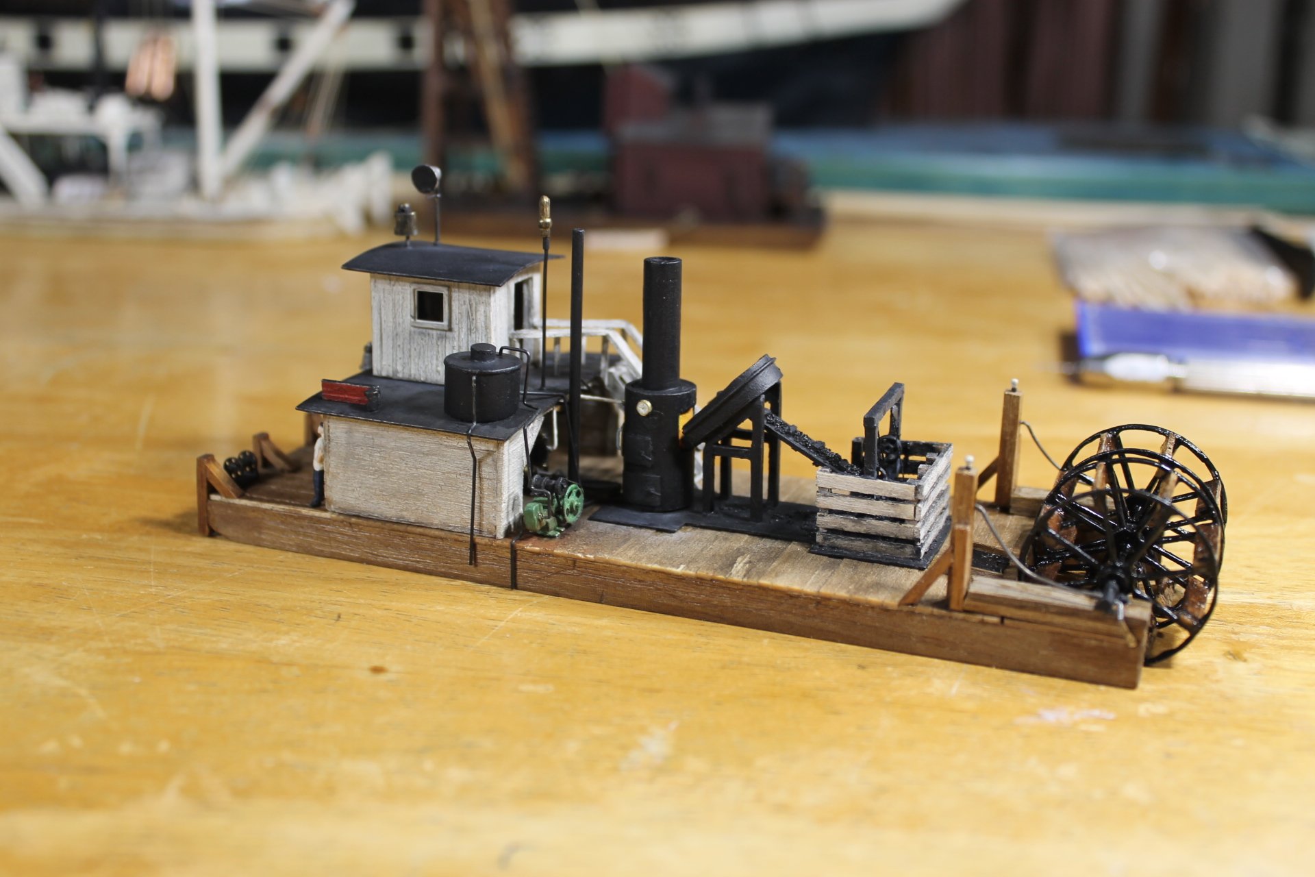

 We reached a milestone today, the engine room is attached! It seems like this has been a long time coming.
 I finally got the bow work light (lightbulb) made and attached to top center of the front windows. I want to attach the deckhand so bad but I know if I do while there's still work to do I'm gonna pull a Bob (Knocklouder) and snap him right off!
 I haven't posted this view in awhile. It was neat to have the engine room attached as I could finally hold, twist, and turn to view through the windows and doors with out the engine room falling to the floor.
 All the water, exhaust, and steam lines have been added and attached, it's quite the maze but NOTHING like Roel's masterpiece.
 The end is in sight for the push boat part of this build. I figure I've got about two weeks left if I don't dawdle about enjoying the moment. All that's left is the railing, chintzy hog chain support system, final weathering, poly wet down, and deckhand.
