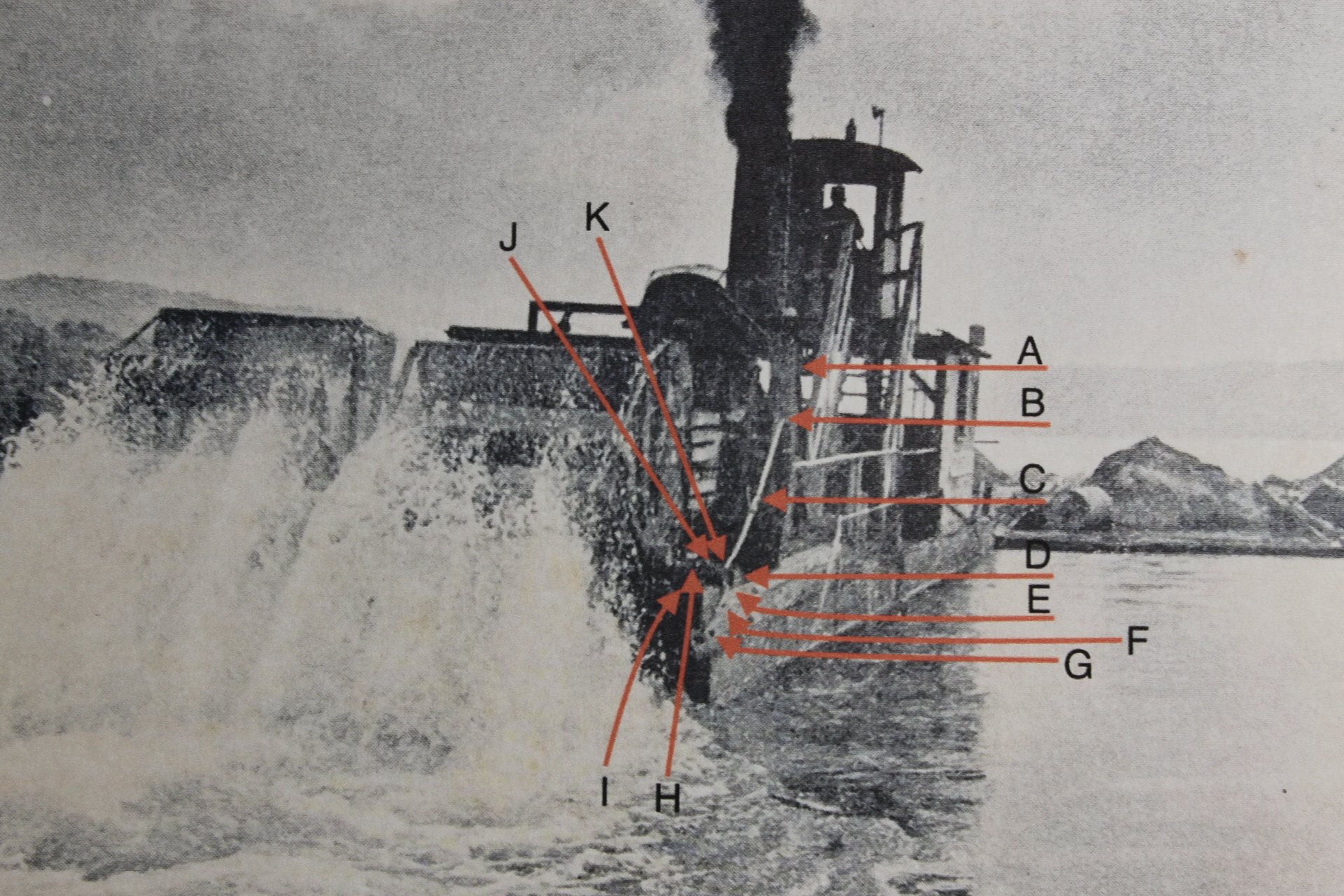

 Because of photographic evidence in the below photo I've determined that this Susquehanna sternwheeler was gear driven. See if you can find Waldo. :)
 I've got to mark up the below photo with arrows and do a write up on my reasoning which I'll hopefully have done by tomorrow.

 It's going to be a late night waiting up for breaking news so I figured I'd go ahead and go into the reason I think this sternwheeler is gear driven.
 All the arrows are in the way of clear viewing so reference the photo in the post above for an unobstructed view.
 Pitman arm driven shafts end right after going through bearing housing as there's no necessity for a shaft collar.
 Chain driven shafts are held in the center of the hull because the chain runs over the drive sprocket and then over the idler sprocket mounted on the hull. The chain holds the drive sprocket connected to the wheel shaft in a centered position.
 On gear driven shafts, the wheel gear must be held steady in absolute alignment with the drive gear. If the wheel shaft has any lateral movement there's either too much distance apart from one another resulting in no power to the wheels or too close and the gears were out quickly or even break. The shaft can not have any lateral movement whatsoever.
 The below image components started making sense a couple of weeks ago and I thought I knew what I was seeing but the why of it didn't make sense until today. My reasoning for thinking this is a gear driven system below.
 A. Vertical support timber.
 B. Steel (?) rod anchored to the vertical support timber that holds D secularly in place.
 C. Tension adjustment?
 D. Rube Goldberg shaft collar penetrated by rod. It would appear this slips over the end of the wheel shaft with an internal shaft end bearing keeping the
      wheel shaft from making any lateral movement.
 E. Rod exiting D.
 F. Through Bolt.
 G. Through Bolt.
 H. Grease cup?
 I. Wheel Shaft bearing.
 J. Grease cup or grease nipple?
 K. Rod entering D.
 For lack of a better explanation of the above components, the above makes sense to me. If it doesn't make sense to any of you please explain what you think the purpose of the above components are.

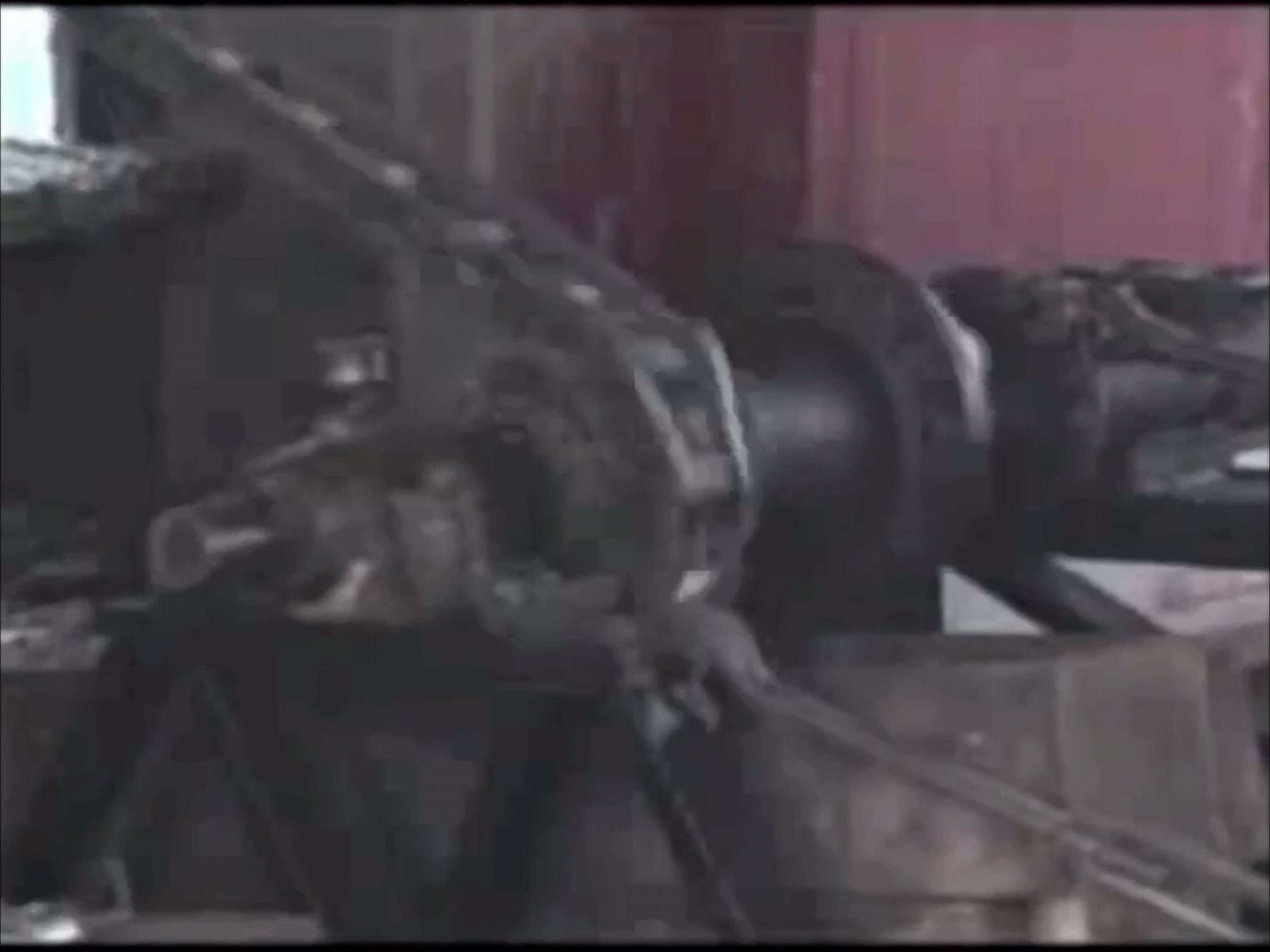

Hi Keith, in the 2nd video that you posted in Post 17, it shows a chain driven boat. It doesn't look as heavy duty as the one you are modeling. Maybe the drive depends on the towing capacity.
 Thank you, Paul. The chain driven Millersburg ferry is kinda heavy duty? I fight the desire to make it a chain driven shaft because it's such an easy alternative but that doesn't account for the components listed in my last post. I don't know, maybe I go with chain drive and turn a blind eye though that doesn't seem right. I did read where they reduced the shock to chain driven wheels by offsetting the two wheel halves so the buckets are a tad bit staggered when hitting the water.

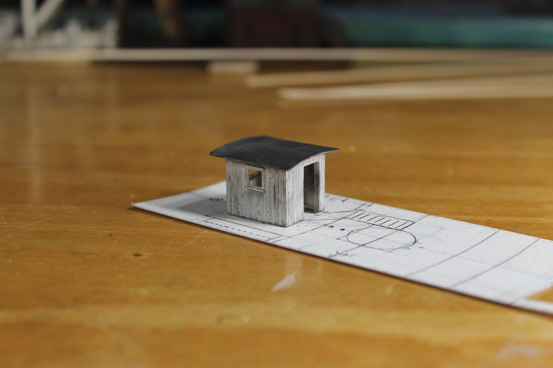

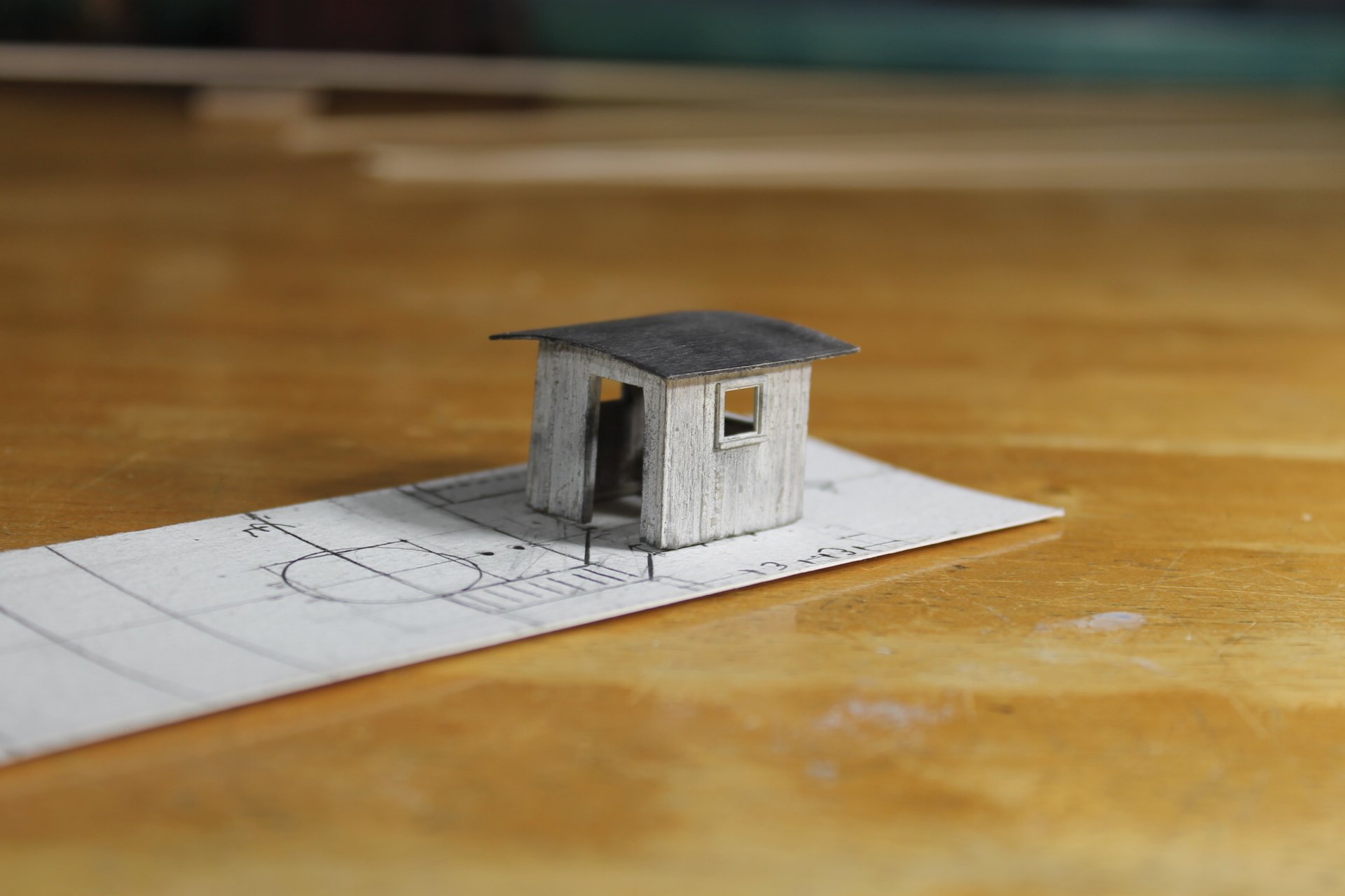

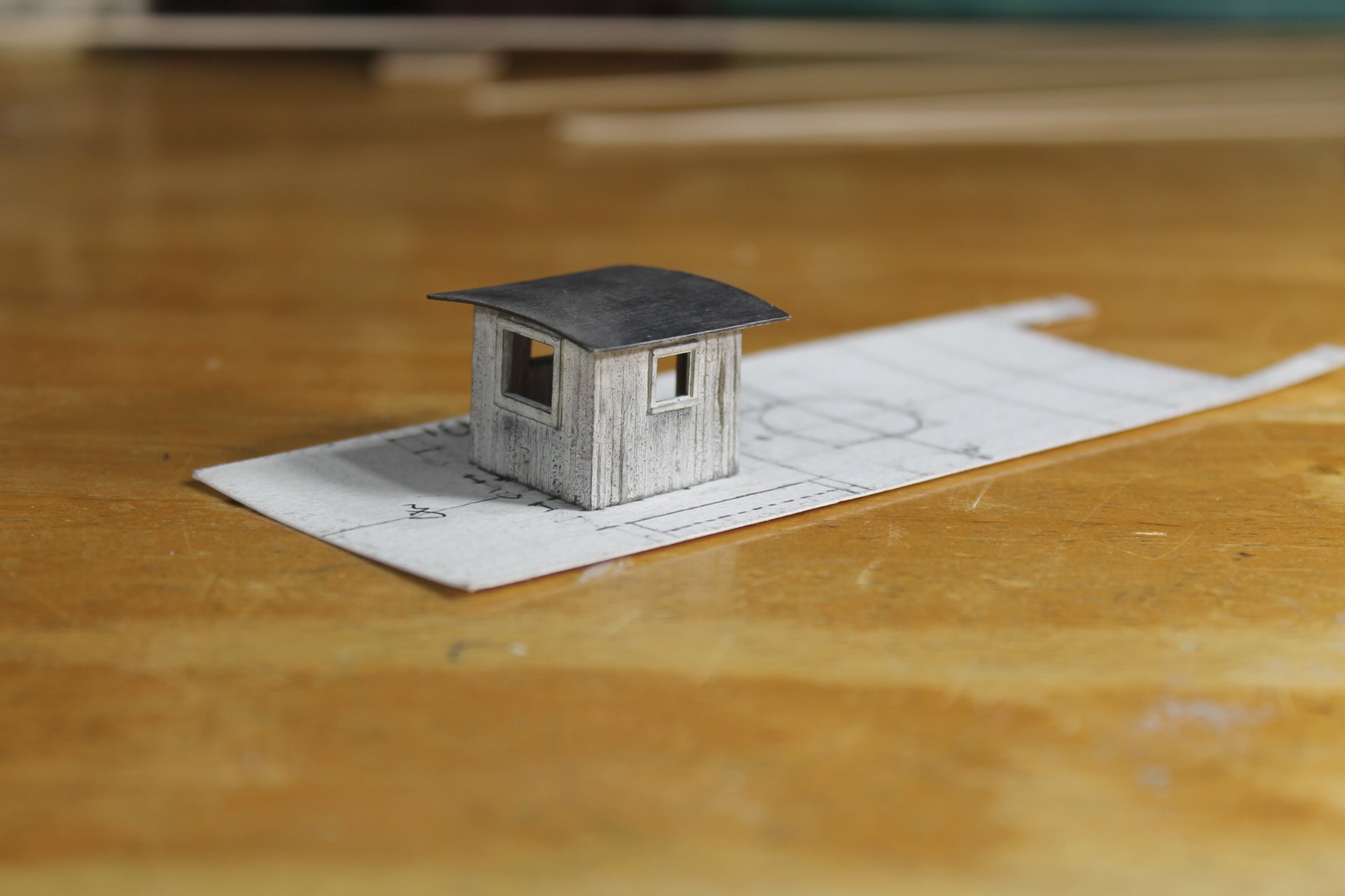

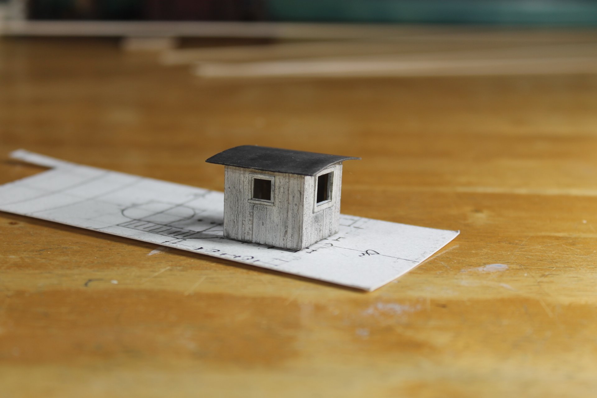

 Well, finally something that resembles a build log. Research is a necessity but there comes a point when ya just gotta make something!
 I've completed the pilothouse. Who say's you can't start at the top and work your way down? :) The vertical siding is 1/32" x 1/32" basswood glued together using CA. 7E18547D-8161-43D5-8AF6-C795C0C57010.thumb.jpeg.76d0f4c10562a7ac5a259c2bca35bf9f.jpeg
 I believe this was only a two man crew, the pilot would have been responsible for making forward and reverse changes requiring him to race up and down the stairs to the twin cylinder vertical steam engine which leads me to believe there wasn't a PH door. I also think the boiler had an automatic coal feeder, more about that later. C7B243F8-89C1-42DF-BFBC-DDCC76586AC3.thumb.jpeg.efed79d50a717cce7d69165e186cefb3.jpeg
 The sternwheeler I'm trying to replicate is so rough that I didn't do any sanding and I didn't try to correct the basswood pieces if they didn't line up exactly. This is going to be pretty much the theme of this build though it's hard to not try and make things all nicely aligned and ship shape.
 There didn't appear to be any glazing in the PH windows, these are open window frames from Itchy Train.
 I don't know how one weathers the color black so I tried to show wear by not making the roofing a deep black and leaving light patches here and there. The PH is 0.8" W x 0.9" L x 0.8" H.  The roof is 0.11" x 0.12". A penny is 0.7" D.
 Next up is the what I'm call the engine room which isn't exactly what that room is but.. I wanted to get the ER and PH done where I'd have a better idea on how long and wide I need to make the hull.
Keith, Nice natural weathering. Off to a really good start. 😎
 Thank you, John.
2 hours ago, Jim Lad said:
A nice start, Keith. Just make sure the hull planking lines up nicely so she'll float!
 Thank you, John. Pretty hard to mess up the planking on this shoebox. :)

on my armour and railway kits i never use black - i use black primer and then use thinned coats of humbrol matt 67 tank grey and lighter shades of grey if more aging wanted- your wheel house (oops pilothouse across the pond) roof looks the part.
Keith
I would have said the same as Other Keith; black makes a good undertone but the way to weather it is with shades of grey that tone down its ability to soak up light, and reveal some of the surface texture. Another reason I like pastels, because they inherently leave some texture on any surface that scatters light just a bit.
 Thank you, Keith and Eric. I'll remember your suggestions for the "next" time when I have a black surface. For this roof I made a very thin black wash and applied till I was happy with the look knowing a dark black would be problematic. Thank you both again.
Current Builds: Sternwheeler from the Susquehanna River's Hard Coal Navy
How did you weather/whitewash the PH? Maybe you can still do the same for the roof using not so bright colors... and a bit of dry brushing.
Use the black for undertones and build up layers of grunge on top, kinda like this. (Take note of the image file name)
Edited by tmj
