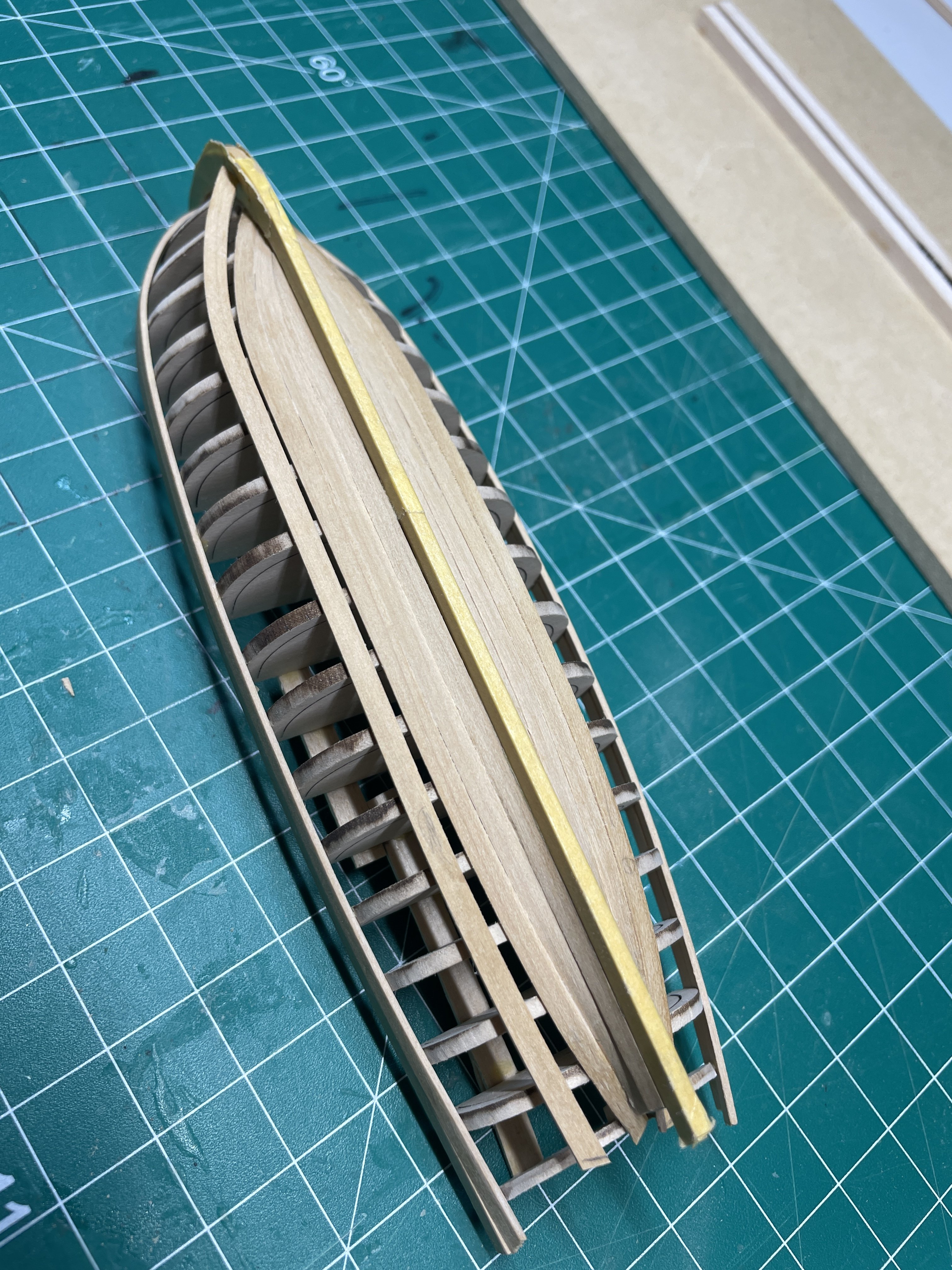

In this picture you see the plank edge bent to match the curve. Next I’ll curve it along the length and it should lay very nice. That plank is boxwood.

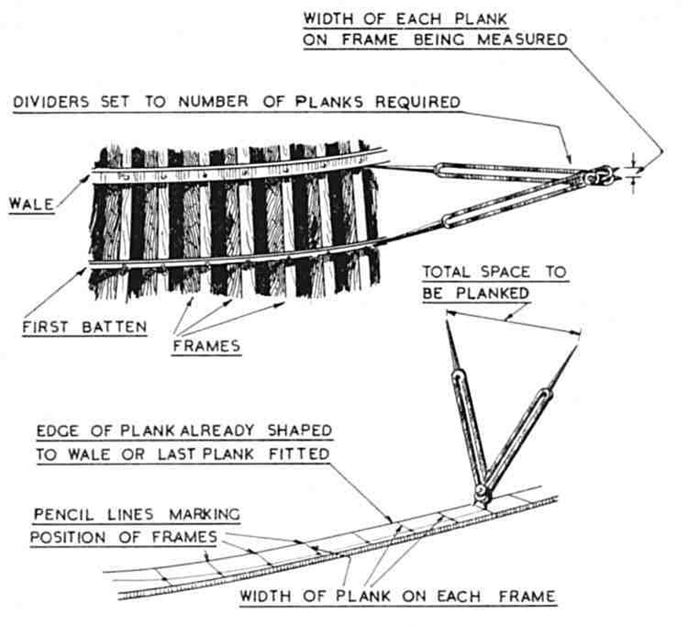

Proportional dividers, use plank belts, span 3-4 bulkheads at a time, measure at each bulkhead, mark plank at each bulkhead, remove waste with a plane, lightly sand.  Be willing to discard plank, and start over if it doesn’t work out.

Do you have any more infomration about the next picture, i mean the marking tool in the picture following the video.
Is there a way to build it or find it?

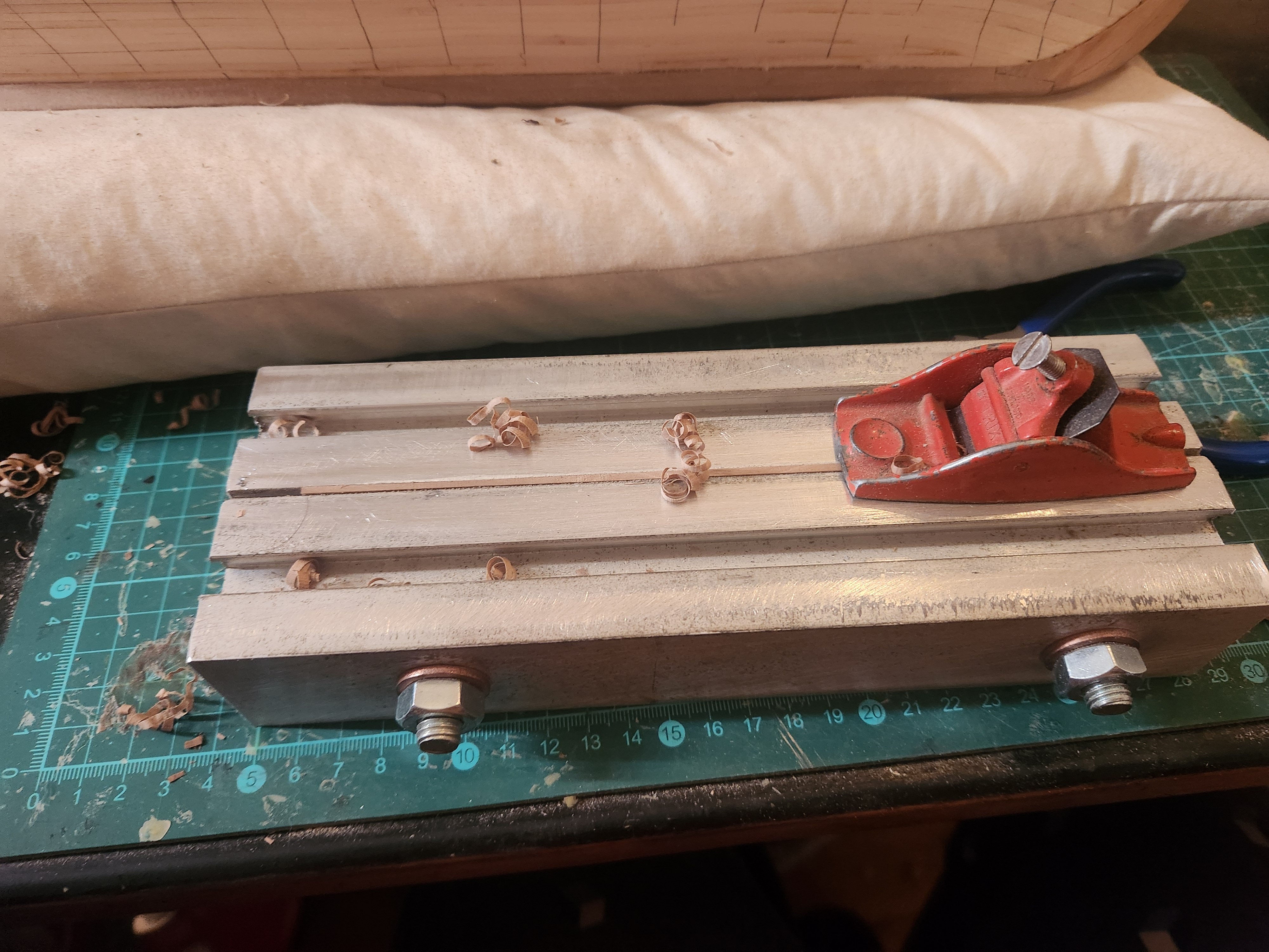

This is not massively explanatory but hopefully a picture is worth a thousand words. I plan to do a full video on how I turn a tree into a plank but this is the last stage. After having marked the correct plank width at either end I simply clamp the plank in this home made jig and use a small cheap hand plane to cut back to the mark.
It is made from 2 pieces of aluminium channel with 2 bolts holding them together. I have a socket with a cross bar on it that I use as a key to lock and unlock the jig and with a little bit of careful placement I can produce an acceptable plank in good time. I hope this makes sense, keep an eye on my build for an update on how I do this in the next few days.
