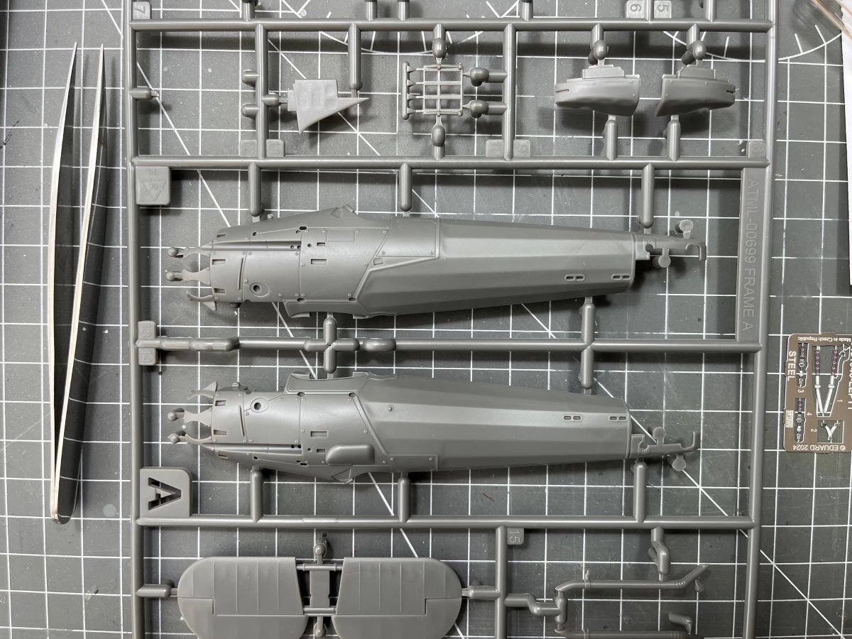

This is a little kit which is quite known by now and this is its box with its rather nice box art:

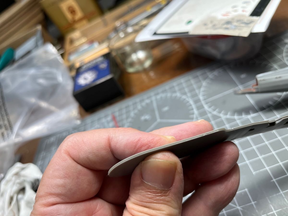

You might find reviews on the web concluding that this is a nice kit and indeed the level of surface details is very nice:
However, in my opinion, one drawback is the quality of the plastic which is a bit rubber-like, hence difficult to cut and sand cleanly. I started with the cockpit which renders the internal truss structure and few other details rather nicely. I replaced the seat with an Eduard resin, not because the one of the kit is not good, but because I wanted to buy their p.e. harness which came with a resin seat.

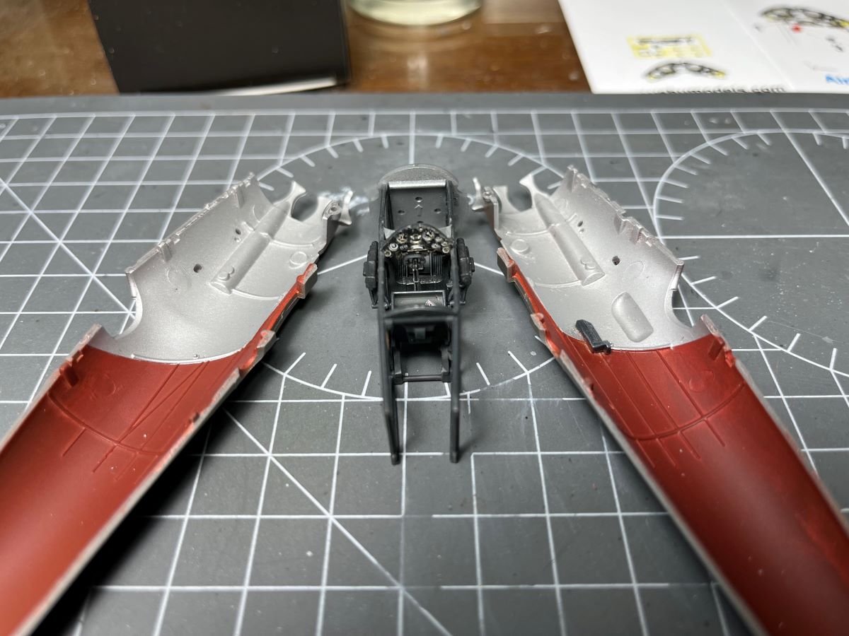

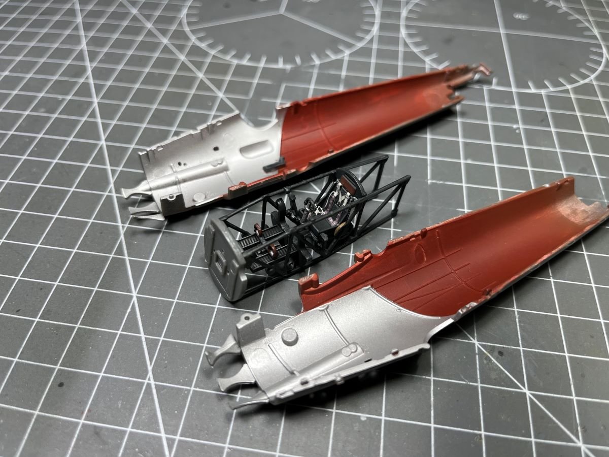

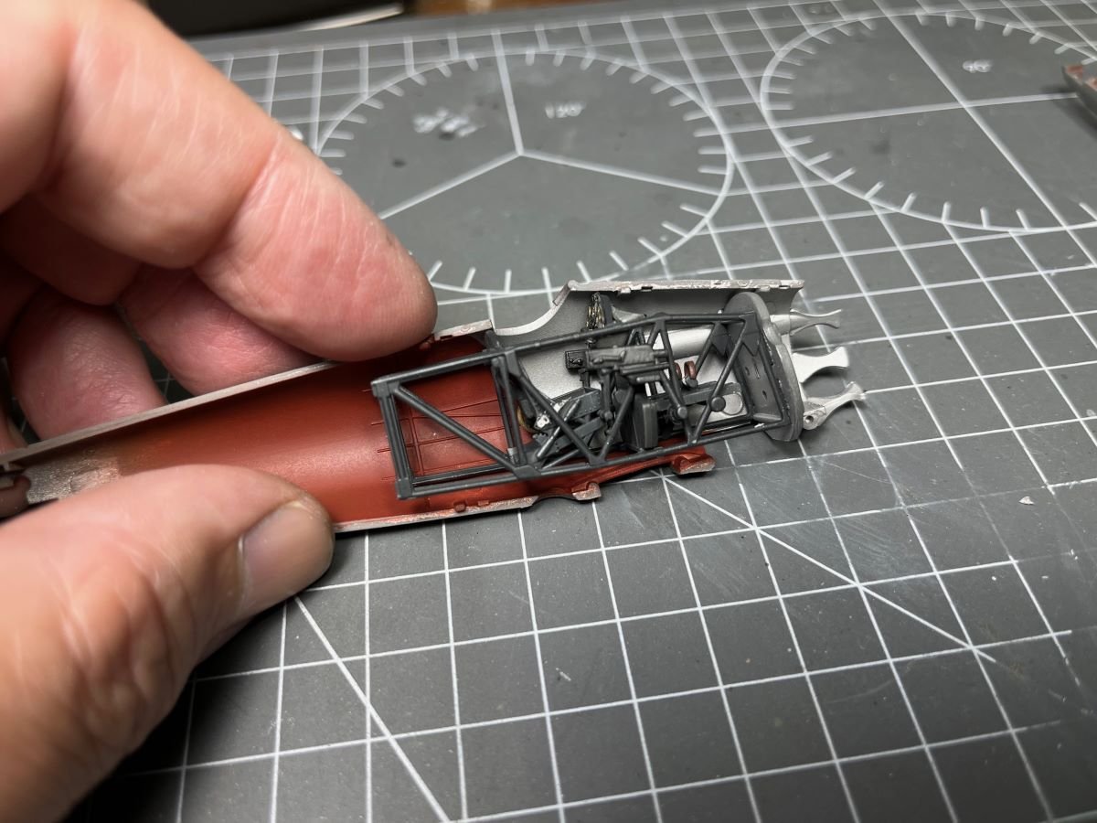

The cockpit assembly had to be painted black and once included in the closed fuselage, very little can be seen from the cockpit opening. I also painted the inner sidewalls of the fuselage with two colors to represent the metallic panels and the fabric covered part:

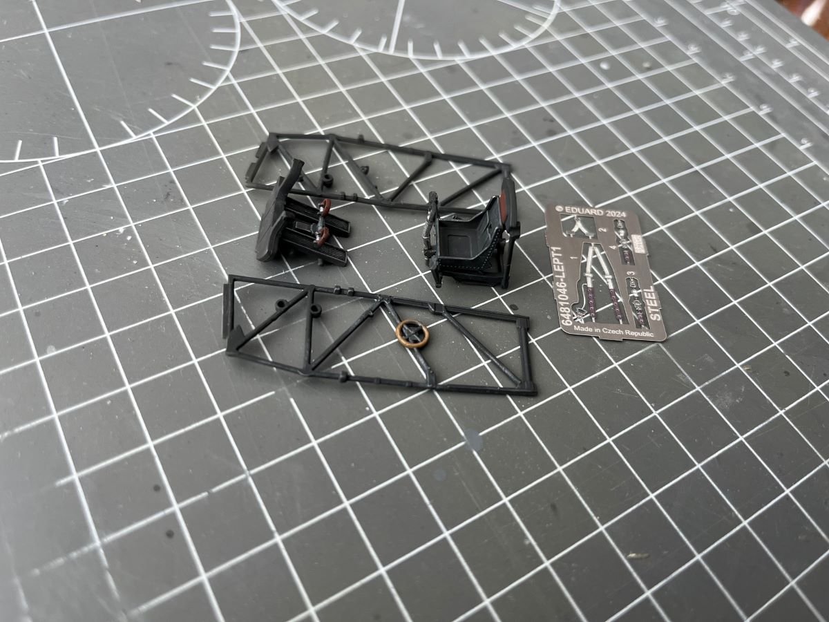

I replaced the instrument panel of the kit with a Yahu one which is quite nice:

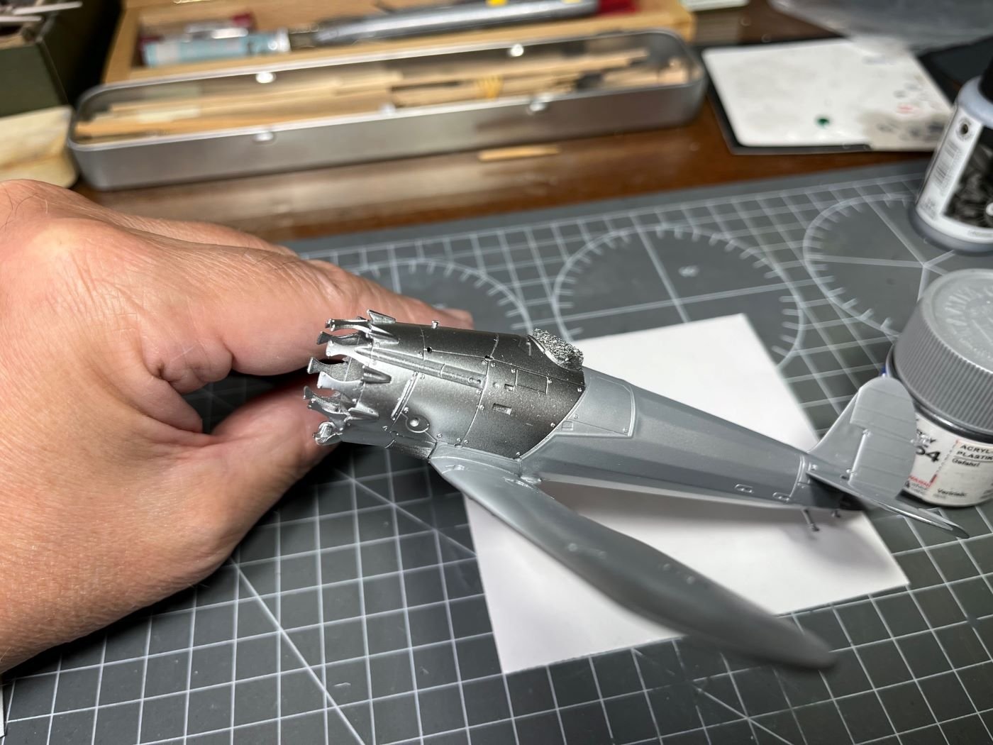

Finally, the complete assembled cockpit is placed inside the fuselage. From the dimension of my fingers you can see that this is really a tiny model:

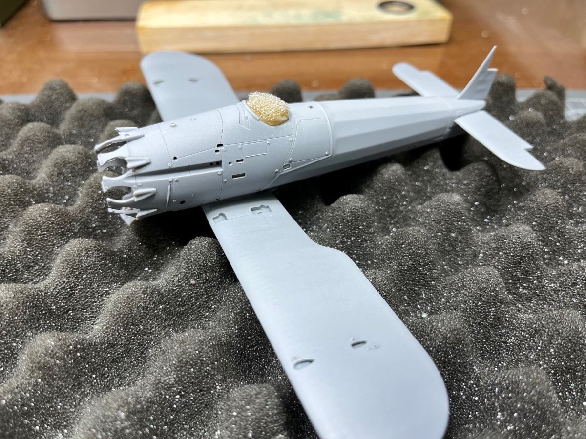

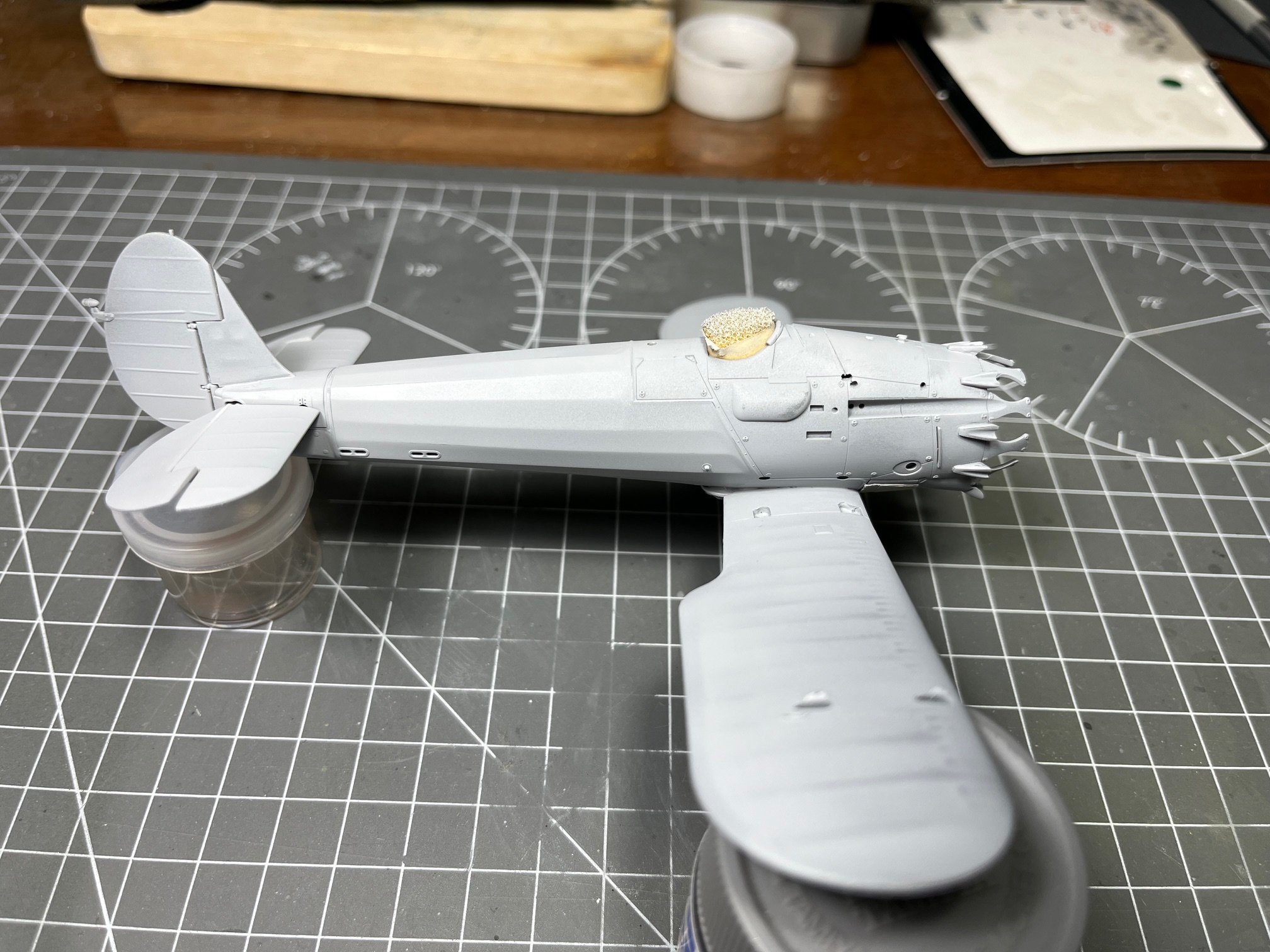

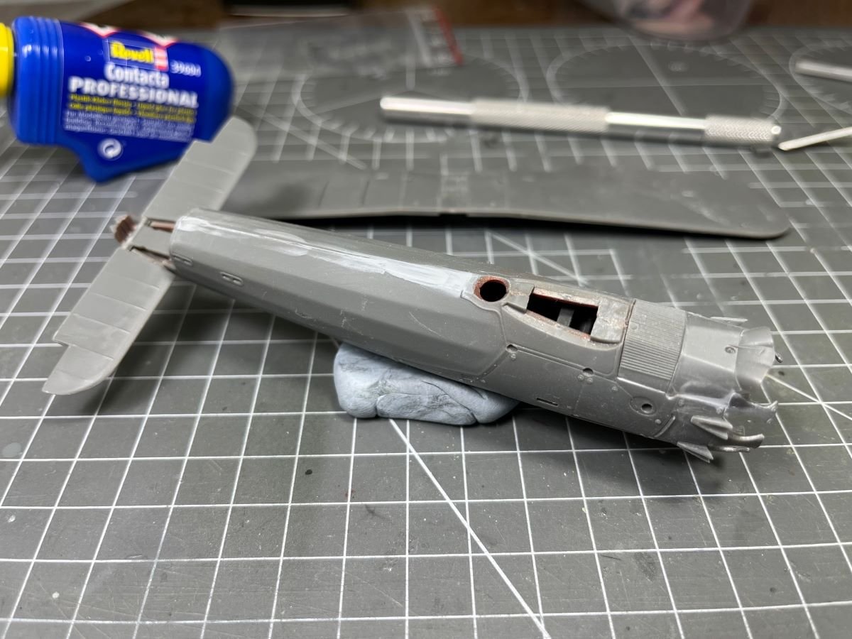

Once the fuselage was closed, the distinctive fairings of the cylinder heads were also glued on.

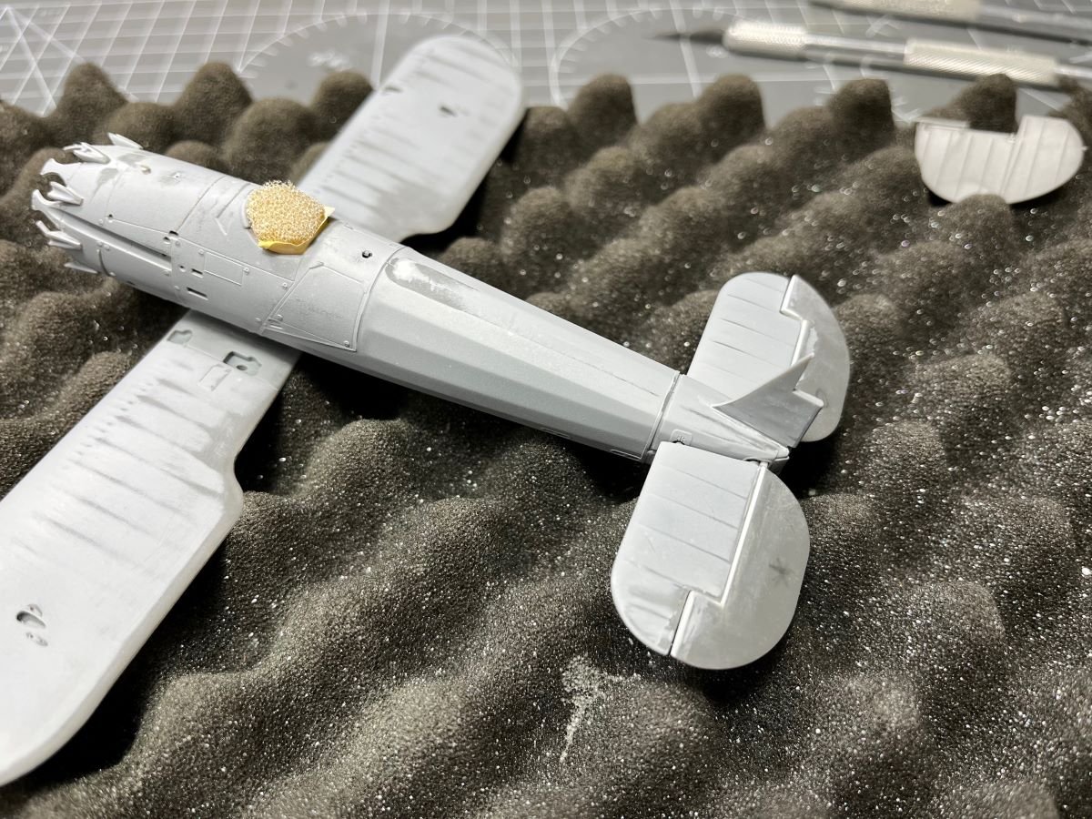

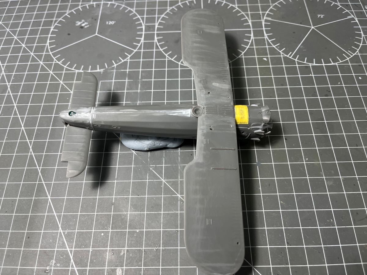

Several points on the junctions had to be addressed on the upper and on the lower side. As said, the plastic gets crazed when sliced or sanded and this makes for me difficult to judge when a seam is finally ok. Several applications of Mr. Surfacer were necessary to fill small gaps.
I also separated the elevators from the tailplanes before gluing them on the fuselage. The trailing edge of the wings are too thick for this scale and some extending sanding is necessary.

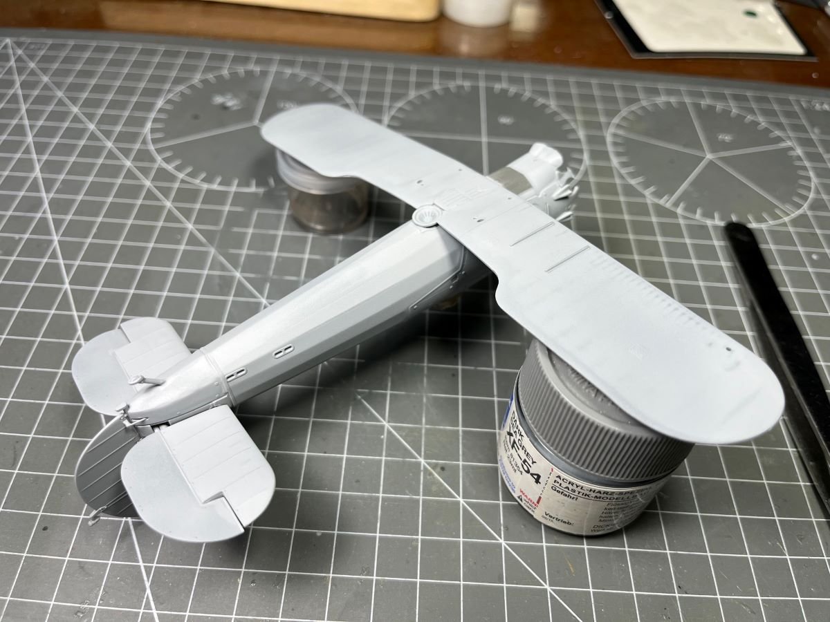

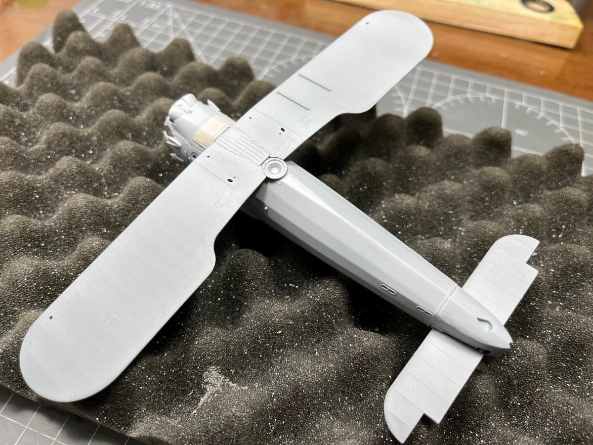

Finally, the lower wing is sanded and glued in place. Now everything is ready for a preliminary coat of Mr. Surfacer 1500 that will allow to check the work done so far.
The result is not bad, with only few blemishes requiring further work. I am going also to wet sand everything with a very fine grit to insure a smooth surface in view of the silver finish.

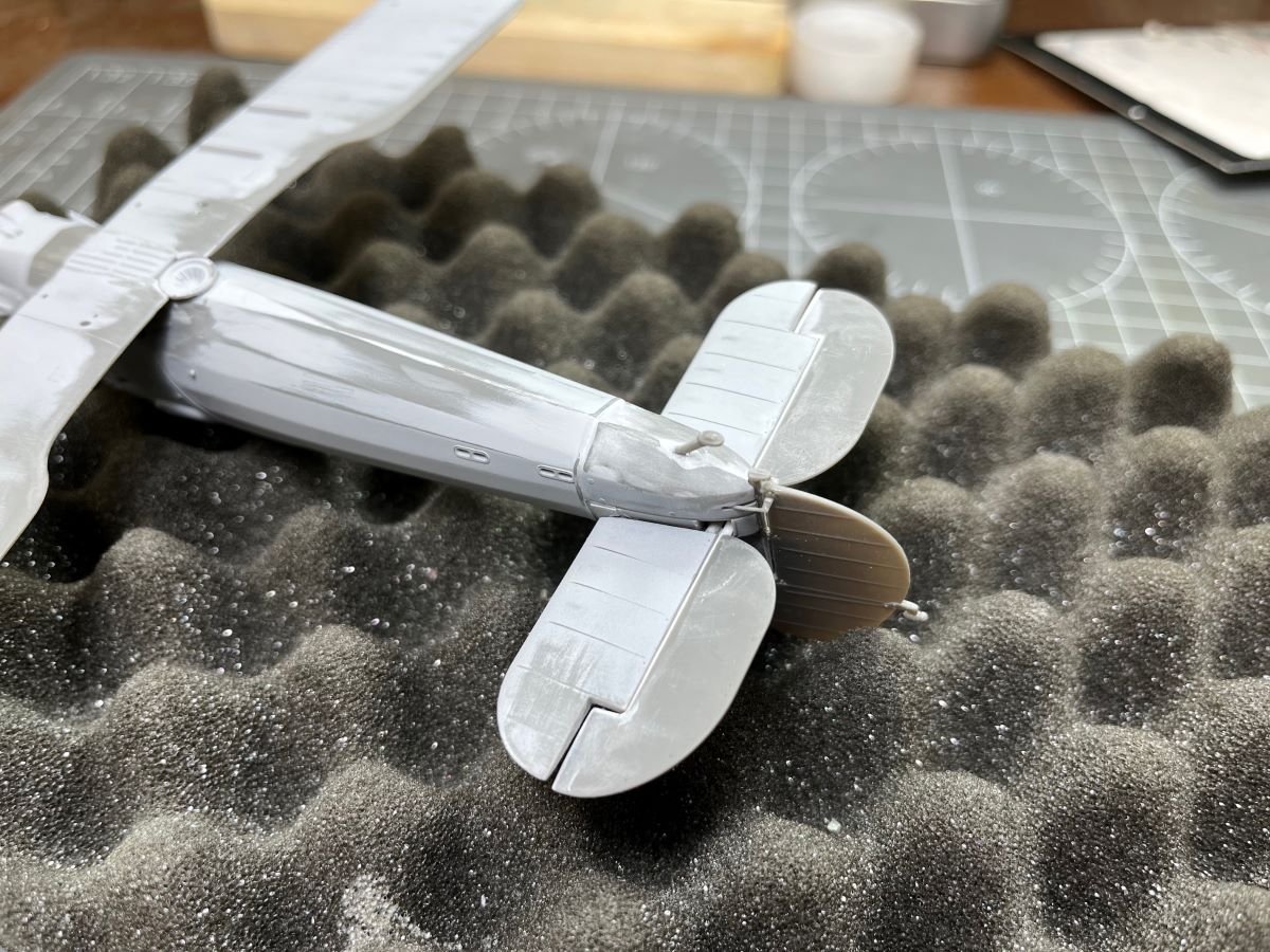

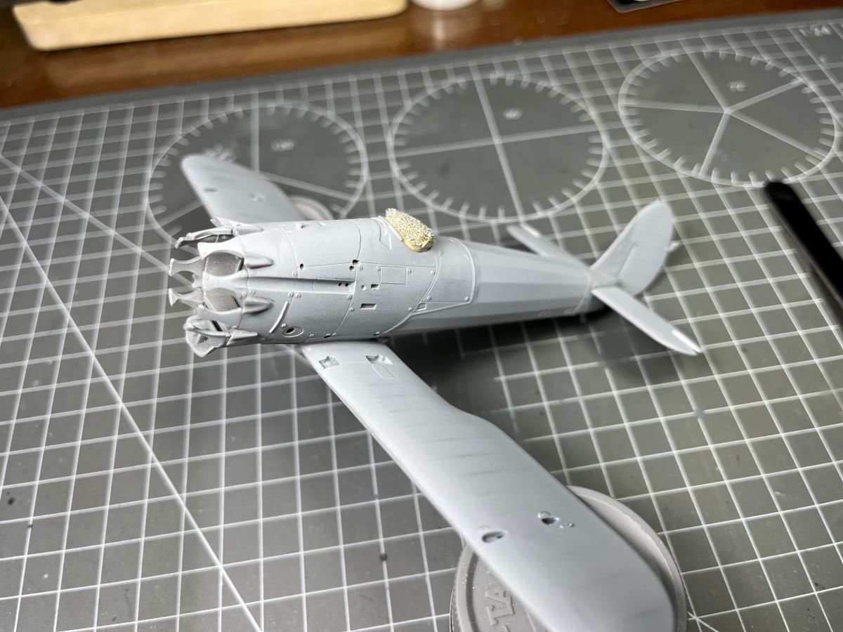

I went on and after some little repairs and a wet sanding session, I put back the tail feathers on the plane.
The elevators were positioned slightly drooped and also the rudder was slightly off neutral to add some movement.
Probably the rudder cables, which are made of stretched sprue, are a bit out of scale, but I couldn't handle thinner ones.
Another light coat of Mr. Surfacer 1500 followed to reveal remaining blemishes.

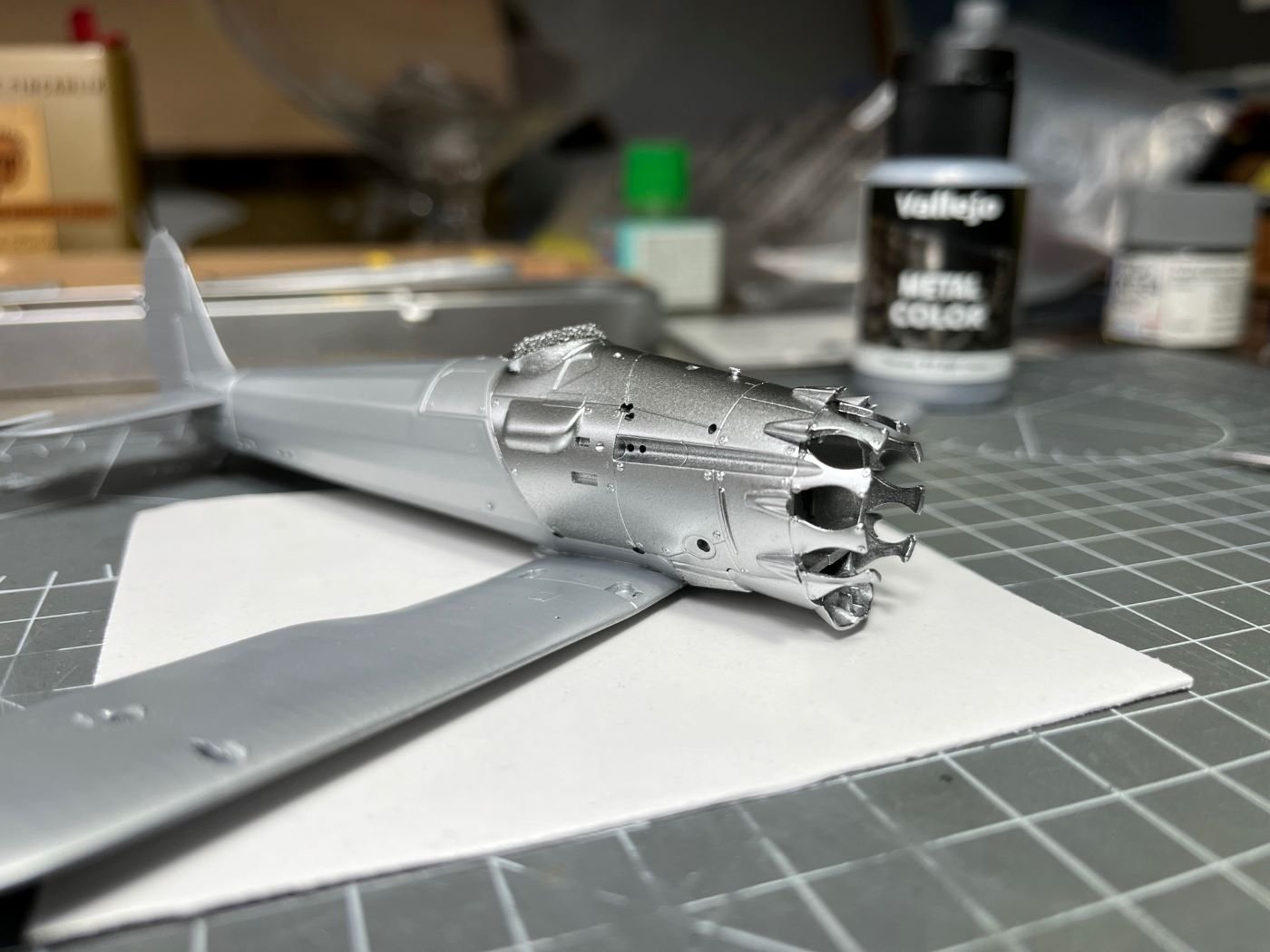

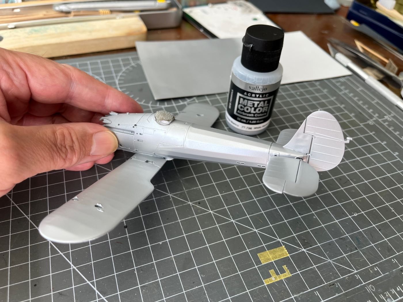

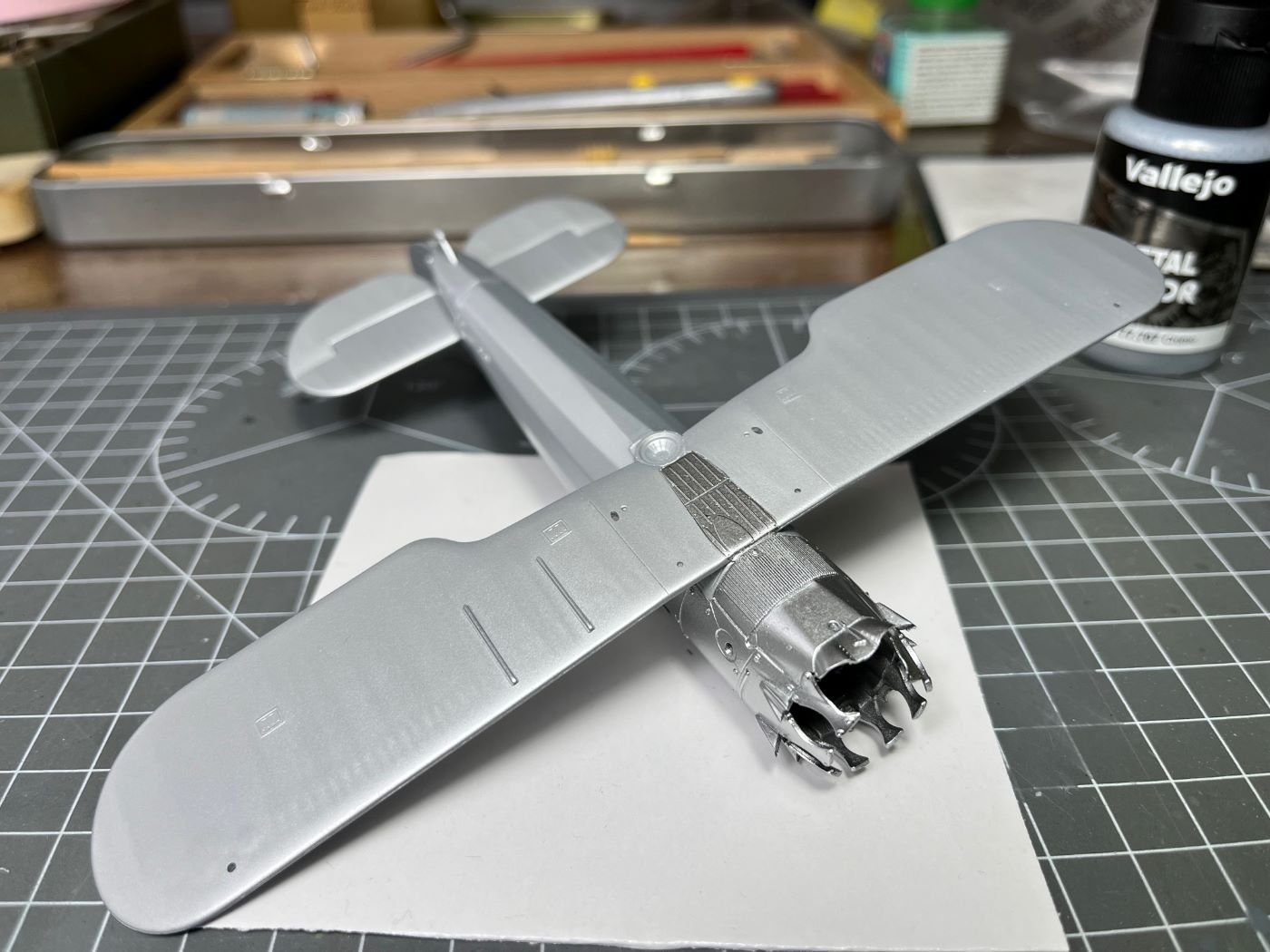

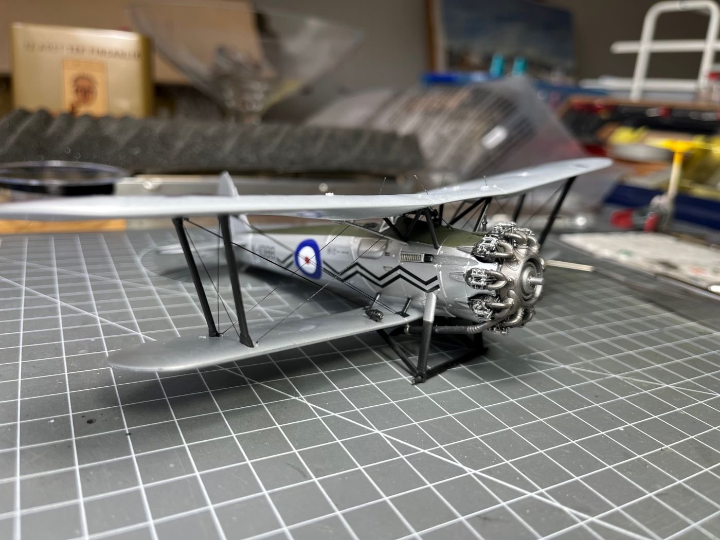

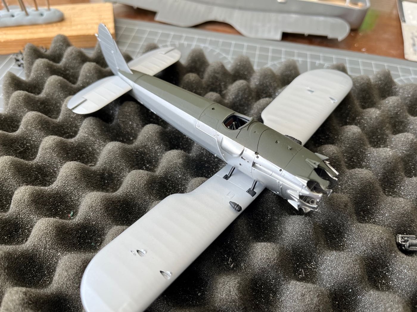

Back to my Bulldog, I sprayed its fabric covered parts with a Vallejo Metal color 'white aluminum' following a careful wet sanding with ultra fine grits:
Before proceeding with the masking, I waited two days for the paint to fully cure and then I coated it with a Tamiya gloss clear (X-22) for providing additional protection. When I was really sure that everything was cured, I masked off the fabric surfaces and sprayed the uncovered cowl panels with a Tamiya gloss black (X-1) in preparation for the required shinier metallic parts:
For these latter parts, I used a Vallejo Metal 'chrome' obtaining a nice metallic reflective finish:
I tried to keep all the applied paint layers as thin as possible so not to obliterate the nice surface details.

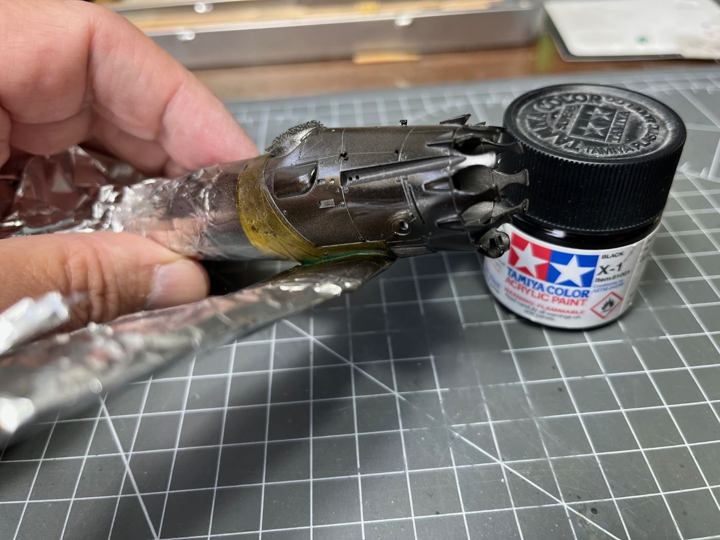

Now the build is getting more and more difficult because there is the risk of scratching or marring the metallic finished while adding the remaining numerous details.
I will let the chrome paint to cure for at least a day and then I will protect it with a layer of X-22 which I hope will not mute dramatically the reflectivity of the finish.

I already managed to scratch the chrome finish once and I had to reapply the metallic paint and the clear varnish. From now on, I must remember to protect the metallic paints with a piece of low tack tape close to the area where I am working.
The other side had the same treatment:

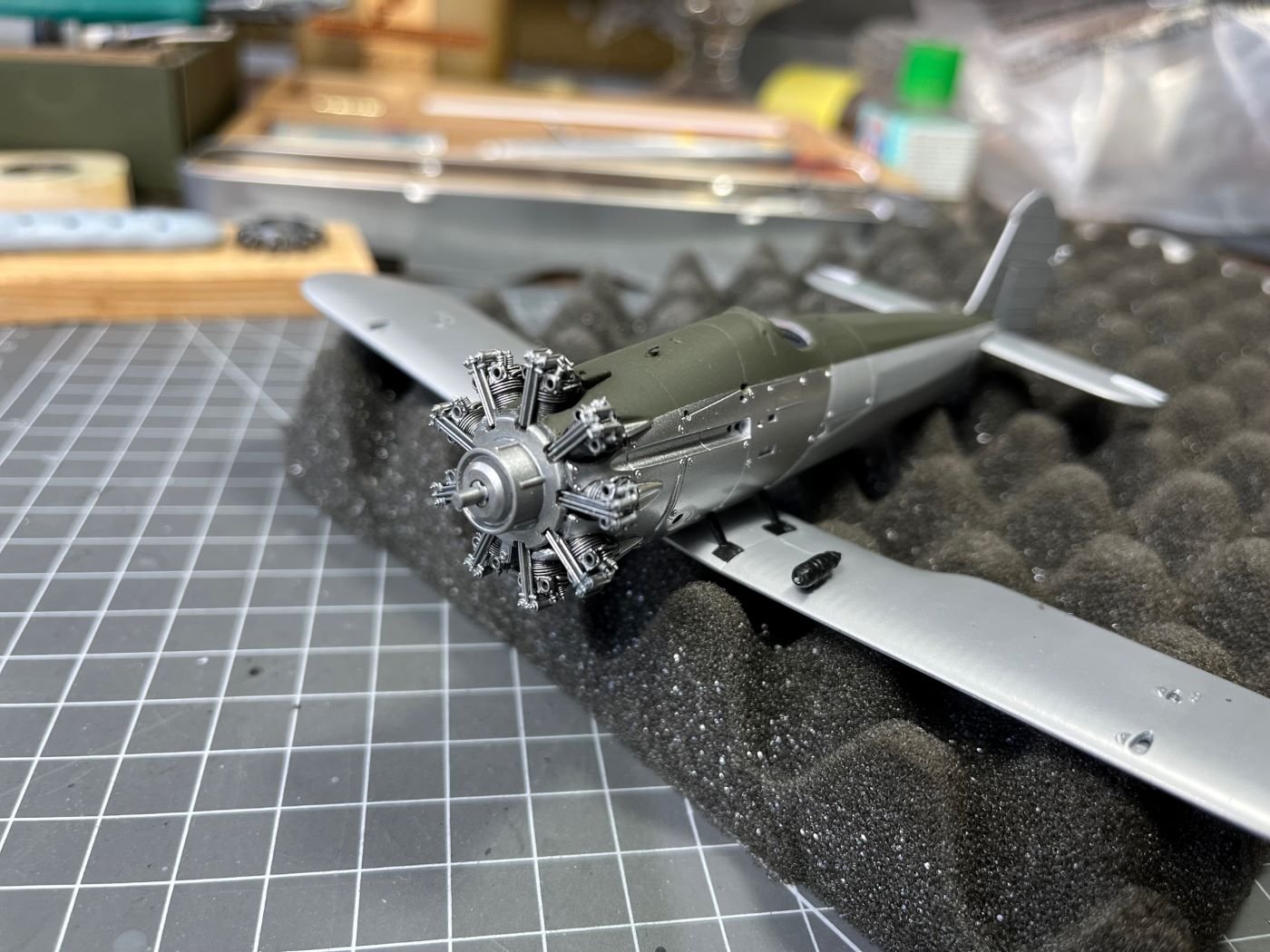

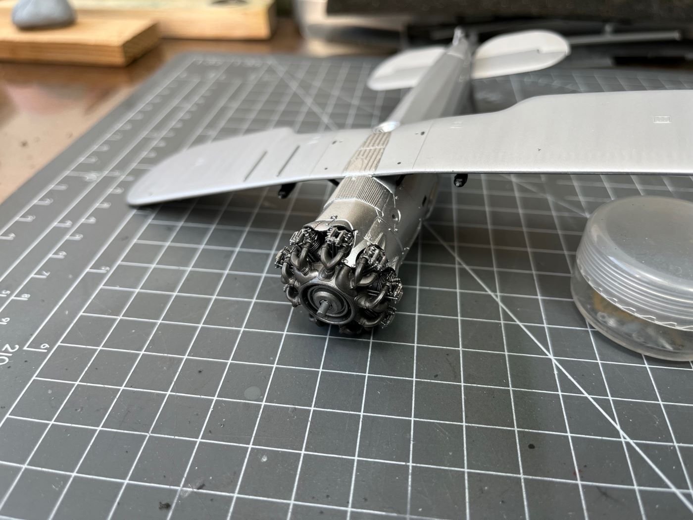

Next, I will paint the anti glare matt green on the spine of the fuselage. In parallel, I started to work on the engine. This is surely a focal point of the Bulldog fuselage and needs some care. I bought the nice replacements 3D printed by SBS that represent the cylinder heads without the rocker covers as seen in period pictures.
The SBS parts are very accurate and they come with a gas collector ring which is slightly more detailed than the kit part. Actually, the replacement of these parts is absolutely not necessary, nevertheless, I was pleased with the purchase.

That last photo is one of those that makes me jealous of plastic modelers from time to time. That cowl structure would be a nightmare to replicate in card, and sadly(?) I have a few kits in the stash that have similarly intimidating cowlings!
Hi,
thanks for your comments and 'like's. Indeed, the metallic paints are a bit fragile, but they deliver nice results if treated with care. Here it is the green anti-glare spine freshly painted (dark green XF-61):

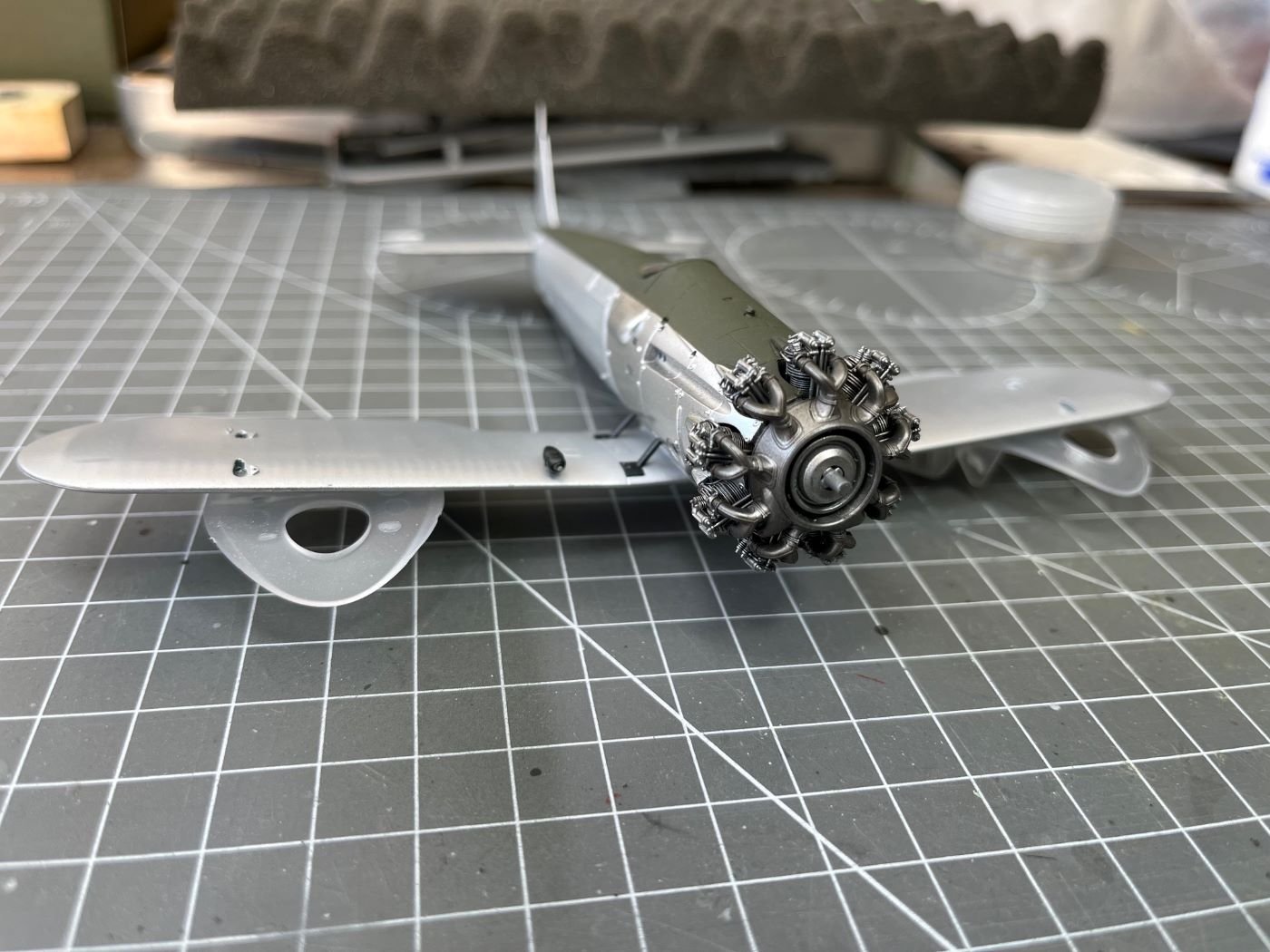

Then, the SBS cylinders were dry fitted:
I didn't use any glue for them, because I wanted to leave them some play to allow some adjustments for when the gas collector ring is mounted. Finally, the Bristol Jupiter is complete, the gas collector ring is glued on and it is keeping the cylinders in place (I hope):
Also in this case, all the parts were finished with different shades of Vallejo Metal paints. In particular, the collector was first sprayed with 'steel', then the shine was a bit muted with a matt brown diluted mist and finally, some 'dark aluminum' dry brushing was applied on selected areas.
I tried to keep everything rather dark, as seen on pictures of the real aircraft.

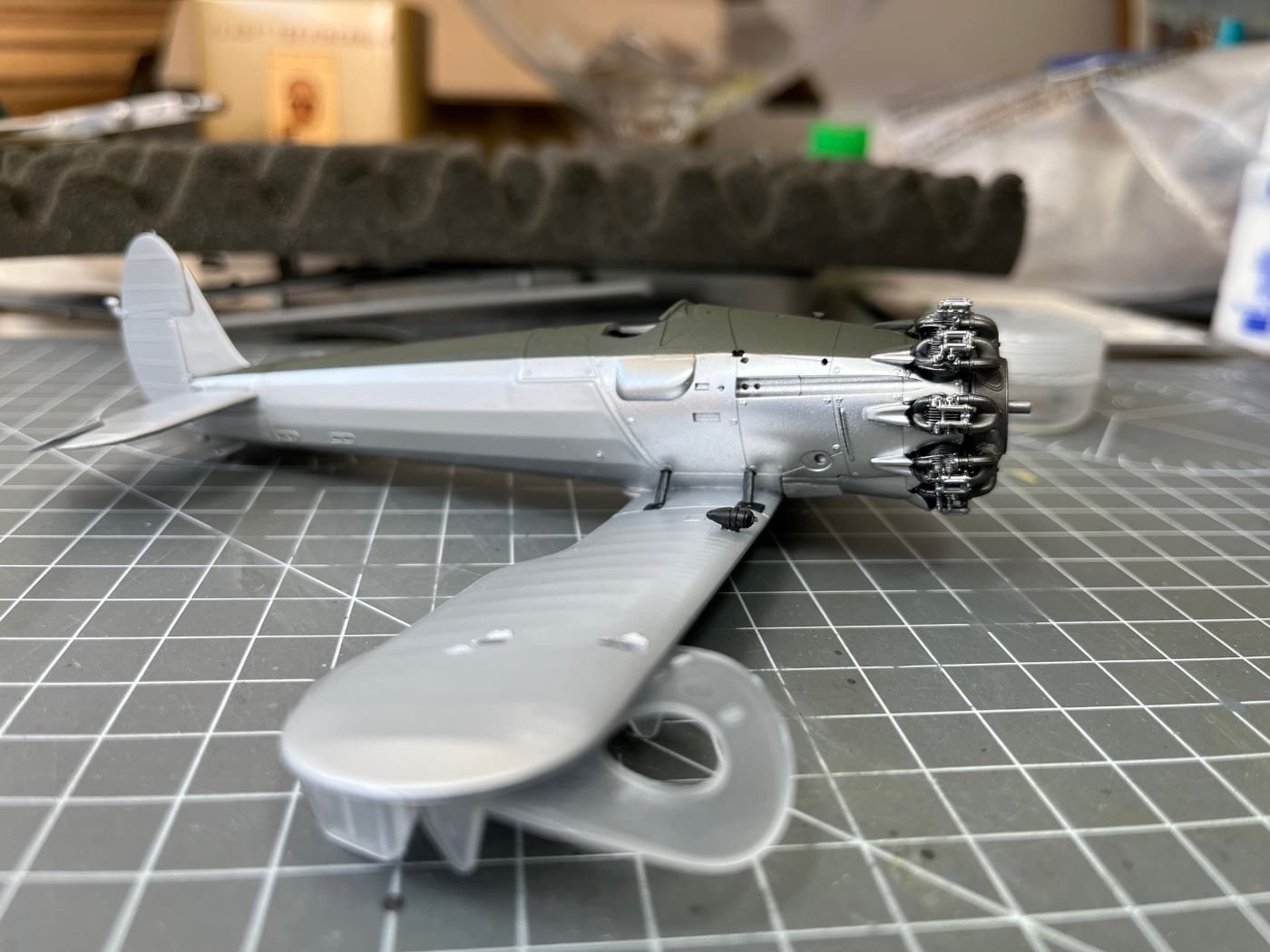

I started to prepare all those small items that are going to be placed on the top of the fuselage. Because of their small dimensions, this revealed to be a non trivial job.
Some details are a bit soft, like the crosshair reticle, f.i., but this is to be expected for such small parts. I am going to replace the reticle piece with some spare P.E. that I happened to have while the mounting brackets will be remade with small brass tube. The new parts are here posed in place:
I glued them in place and painted them black. Again, I spoiled the green and aluminum several times and I had to repaint them accordingly. At the end, this is how they look like:
Eventually, I was pleased with the new parts. Now I urge to put in place the cabane struts as soon as possible so that they can somehow protect these delicate items from being accidentally knocked off.

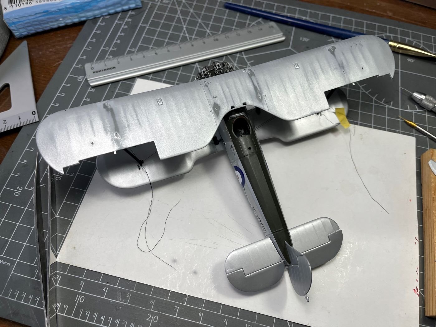

I am proceeding slowly ahead and I finished in all details the lower side of the upper wing:
The upper wing is then installed on the cabane struts and the wires are passed through the wing and tensioned. Now we have finally a proper biplane:
Actually, the fishing line that I used here to make the rigging wires, contributes to the stiffness of the assembly. For the other rigging wires, though, I am considering using an elastic thread.

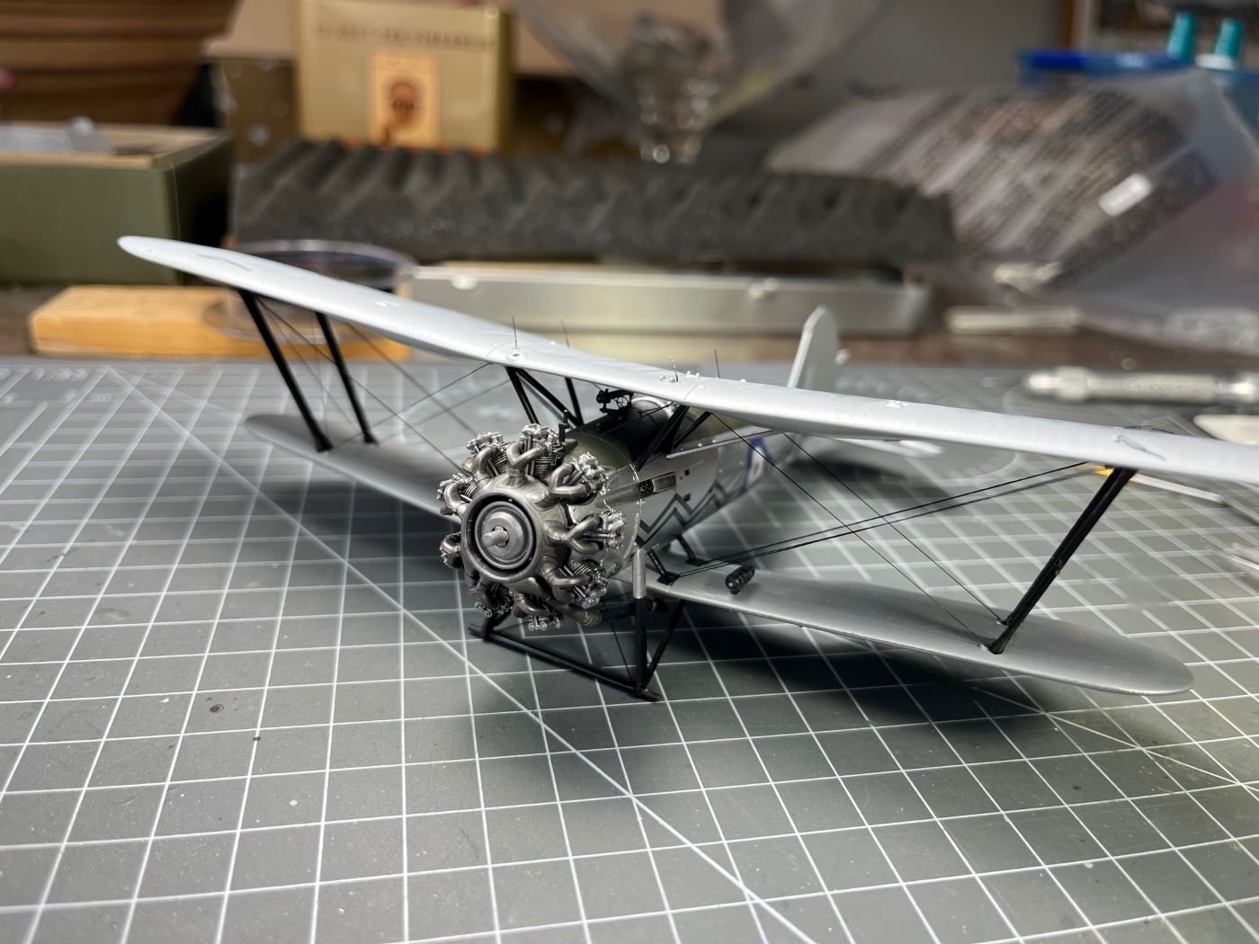

Then, also the other interplane struts are installed:
Thanks to the precision of the kit parts, the biplane assembly was trouble free and seems quite sturdy and well aligned.

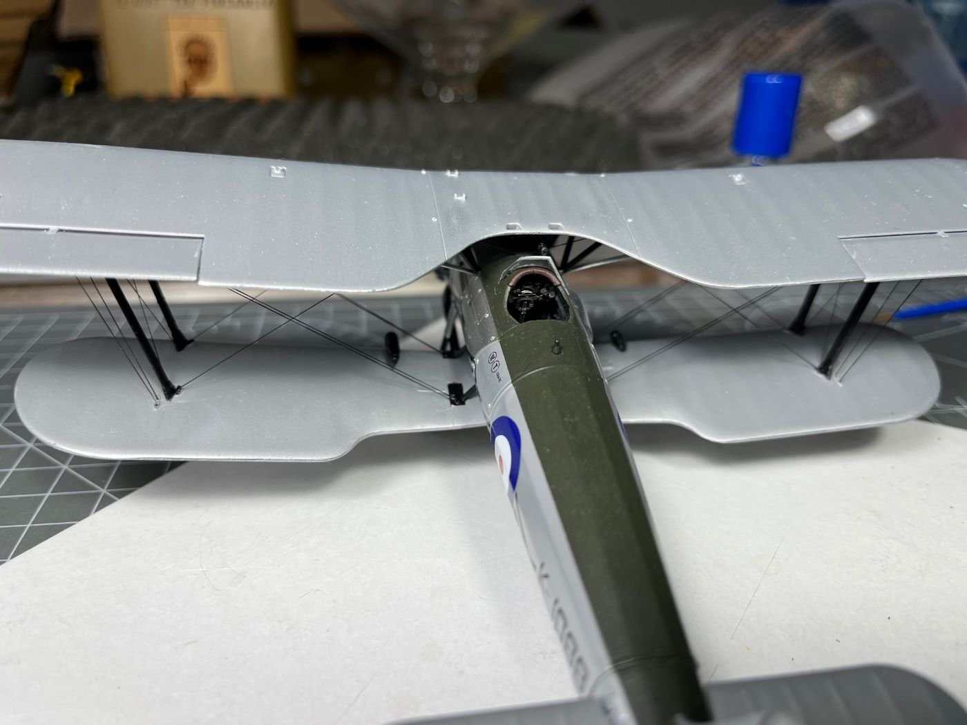

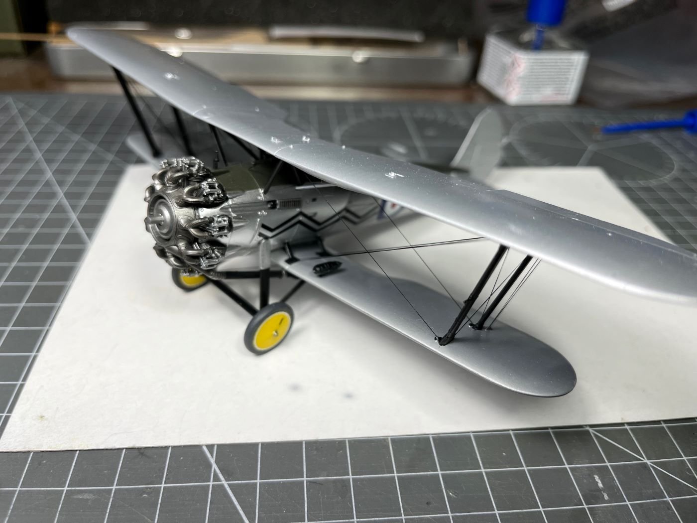

I went on with rigging my biplane after having decided to use an elastic thread for that. This was a first for me and I went through a learning curve with the application of this stuff.
Practically, that means that the last wires are more cleanly glued that the former ones. I will have to live with that. Some of them are going through the top wing, as shown below.
After some fights, the rigging is completed and the top wing is sanded and eventually painted:
And now, this is how my Bulldog is resting on its own wheels:
