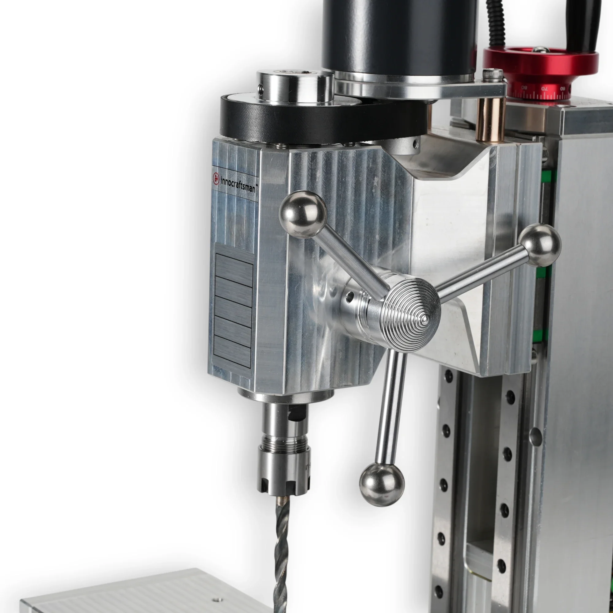

Has anyone used any of the Innocraftsman tools?  I am looking at replacing my dremel drill press with a mill and the only mini mill I seen that has a "hand crank" like a drill press is from Innocraftsman.  The only part that I'm a little concerned about is the table they are using.  No T slots.  Wonder why.
Seems all others you have to turn the top wheel for the Z axis.  Which for milling is fine but for drilling a hole, would take forever.  Bridgeport mills have a hand crank for moving the Z axis (which is a full size machine) I question why the smaller machines don't offer that.
Anyway, if anyone has used or even has seen one in person, what's your thoughts on the Innocraftsman products.  Good? Bad? Stay Away?
Here is a picture of what I'm looking at buying.  Thoughts?

45 minutes ago, ChrisLBren said:
Looks like a toy to me - thats one of the reasons I exchanged the Proxxon MF70 for the TAIG Mill.  I wanted something sturdy and accurate.  I supposed it depends on what sort of work you will be doing on it
I'm with Chris on this but everyone has a budget and maybe you could make it work for you.  I have a couple of Innocraftmans products and the vice I have is very nicely made.  However it's not that strong and like the other item I have its a little rough around the edges.  I knew this when I bought them and they do exactly what I require them to do.  I would search wider on the net for reviews but if you want a serious mill my instincts are to stay away and save for something better.

It looks like a beefier vertical drill press to me, rather than a mill, otherwise how do you attach your workpiece to the flat table, to mill it?

To me it actually looks like a reasonably well-engineered piece with a design based on stock-material and -parts.
However, looking at the technical specs, I think a spindle speed of only 2000 rpm is a bit on the low side. I would rather like to have something in the order of 5000 or for wood even higher.
Obviously, I don't know the thinking of manufacturer behind not providing a T-slotted table. However, in modern manufacturing such tables are typically replaced by 'tool-plates', i.e. slabs of steel or aluminium with patterns of threaded holes for various types of fasteners. Such plates are also useful for use with excentric low-profile clamping kits (such as the 'mitee-bites').
One could drill holes at suitable locations into the table, thread them and then clamp a toolmakers vice onto it. For larger parts, two-part vices are useful.
I didn't compare the enveloppes, but I have the feeling the PROXXON MF70 might be a better choice as a mill, but it does not have the quill for drilling.

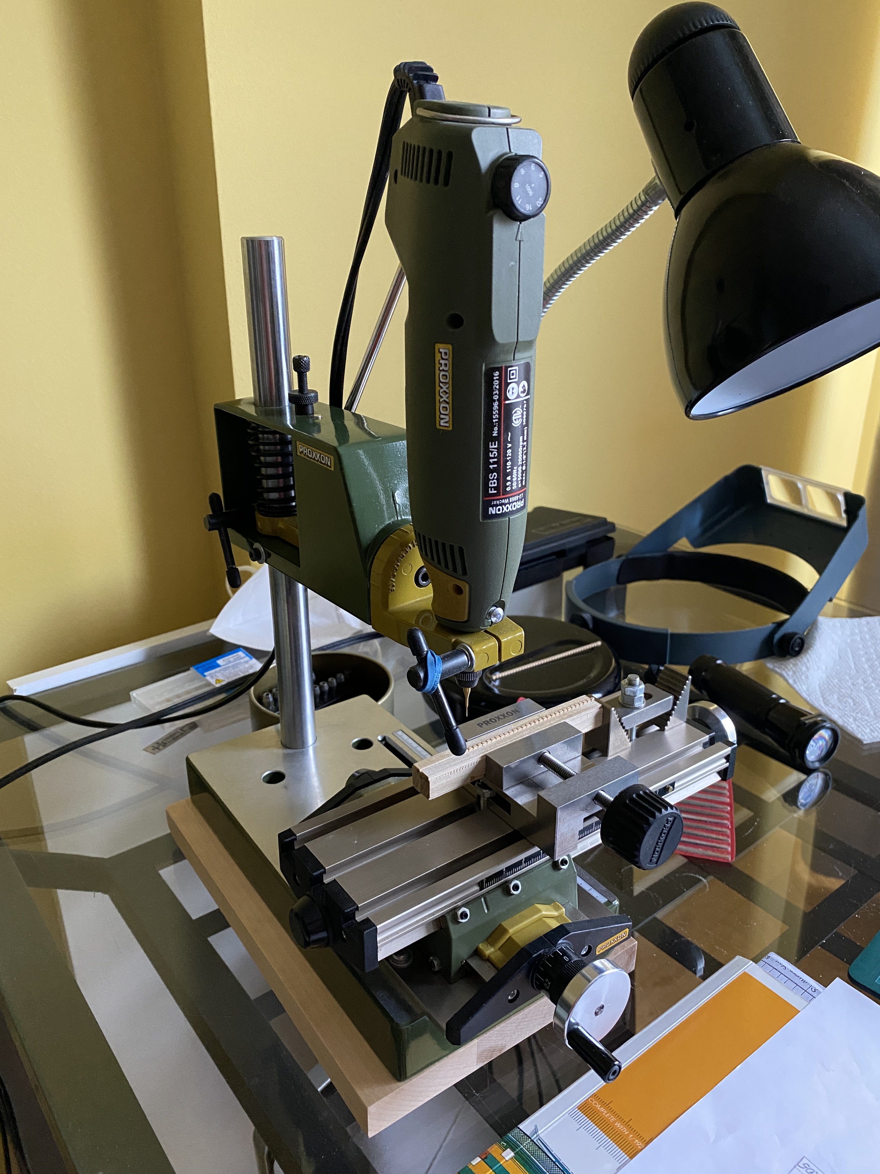

I use this arrangement for all my micro drilling and milling needs as making small rigging blocks as small as 2.25 mm. it has perfect speed for drilling wood with micro milling bits up to 20,000 RPM. I highly recommend it. I use drills and mill bits as small as 0.3 mm diameter.
By the way, what you see on this picture is a set up for making those rigging blocks 2.25 mm high.

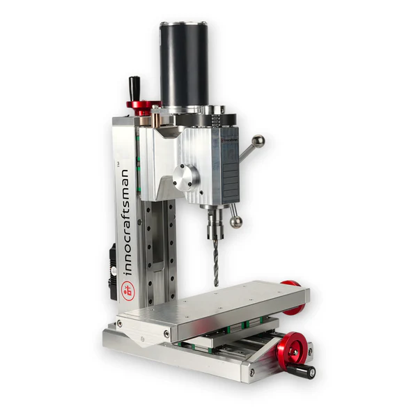

Innocraftsman appears to be a storefront for the various Chinese hobby tools that can be found at any number of outlets..  Their pricing seems to be a bit aggressive compared to some other outlets like Amazon.
For instance, this little press from Innocraftsman for $249 can be found on Amazon for about $80.
This little mill on Amazon  looks like it might be a good alternative to the one in your OP..
I thought of that idea too buying a proxxon Professional Rotary Tool IBS/E and the drill press attachment and also the X Y table.  But wasn't sure about the side pressure and I really didn't know who to micro adjust the Z axis.
How do you micro adjust the Z axis with your set up?
6 hours ago, Y.T. said:
There is an adjustable stopper bolt. Look at my picture.
On top towards the rear above the spring?  Looks like bolt with a locking nut.
 So you can turn that to adjust and lock the rotary tool at any vertical Z axis that you want?
