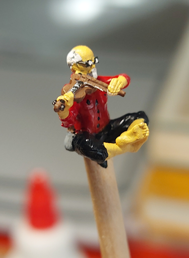

On August 21st this year, I had posted a couple 1:64 scale 3D figures that were made for my build.
Today I decided to paint one large figure to "get the hang of it".  A practice run if you will.
This figure is a larger version... of me with my fiddle. I had broken the bow off so had made a new replacement (wooden bow and hair from my shop brush).
The bow was removed for painting. Acrylic paints and brushes. Letting it dry for a day or two before I give it a protective spray matt sealer coating.
I was going to do my plaid shirt but that is too difficult to replicate.
I was also going to add a small tuft of hair on my dome but, what the heck, I'm certain I'll get there one day soon! 😉
Now having "mastered" that I feel I've learnt nothing when I put the 1:64 scale mini me next to it.
I'll give him a go tomorrow.

Alan,
There is loads of info on painting really tiny figures online especially from the wargaming guys. I am not especially good at it, but I have found some of the videos super helpful for painting pilots for plastic airplanes. Some of their tips aren’t always especially obvious to me especially when it comes to order of painting colors etc. I’m sure you will end up with a cool 1/64th version of yourself.
Adam
Use a extra good fine brush.
A dot of paint on the tip.
Spread a little on.
Wet the tip of the brush and dab it on a paper towel then brush what you applied to smooth it out. Let it dry before touchups.
I mounted the little fellas on a dowel using a drop from a hot glue gun and use the stick or a finger from my one hand to steady my other hand on.
Don't forget magnification and good lighting.

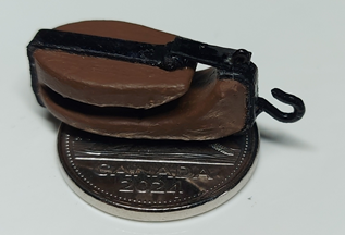

With a couple figures done and the three rows of 4" planking completed, it is time for a change before I go back to yet more planking.
I decided to complete the assembly of my 3D printed viol/vyol block. The strapping is blackened card stock. The hook is copper wire that has been twisted and filed to shape. The completed block is placed on a 5cent piece for scale.

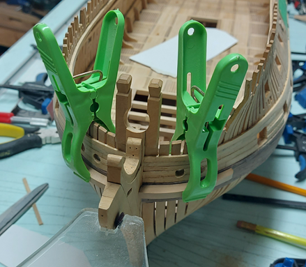

Having established the gap between the upper and lower cheeks, I made the hawse bollard and backing plate. I decided the clean white look of maple was a nice contrast. The backing plate was steamed and clamped. I couldn't get back to it for three days... it was quite dry and had no spring back!
I completed shaping the upper cheek pieces, scraped the grooves into them, then glued them into place. They just need to be drilled and pinned similarly to what I had done to the lower cheeks.
The paper template in the top photo is for my trail board. The contract reads as follows: To have a double trail board, and a lion or figure, as shall be directed. Handsomely carved; the rails and supporters handsomely wrought with mouldings.
I searched the internet for lion figures and found a few that might be suitable, but then thought the Chimera monster (that Bellerophon killed) which is mostly lion… or a Griffon (as seen on the crest of the last stone frigate) which is partly lion might be more interesting, but also these might be more difficult to carve, especially to fit a ½” tall x 1” long space.    Decisions!
I also have had two attempts at the third piece of the upper cheek that rises up the main bracket behind the figurehead. These have both been tossed in the scrap bin.  Third time is the charm!  These two above had been soaked in 90% Isopropyl Alcohol (cotton batten soaked, laid over the figures and wrapped in clear cling wrap aka Saran wrap) over night to allow me to peel them off the block of wood. They were glued on with drops of yellow wood glue. The block is clamped in a vise to allow me to carve away at them.

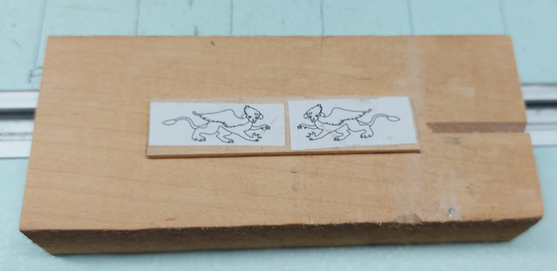

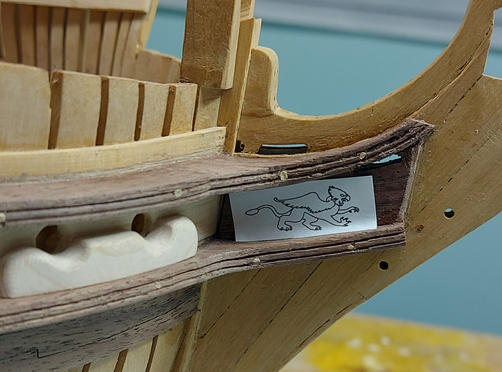

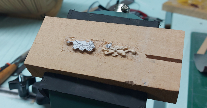

Well, I managed one of the two upper cheek finishing bits. It is presently soaking to be removed from the baseboard.
I also installed the trail boards and decided on the figure, a griffon or gryphon if you prefer. The drawing has been mounted to some bass wood (linden) and that glued to a baseboard in readiness for carving.

I think your choice of monster is spot on! I am in no way a historian, but can see the logic in the myth/saga about who killed who and the connection to the ships name.
Also, I think a griffon is more picturesque than the chimaira (lion+goat+snake) 🙂
