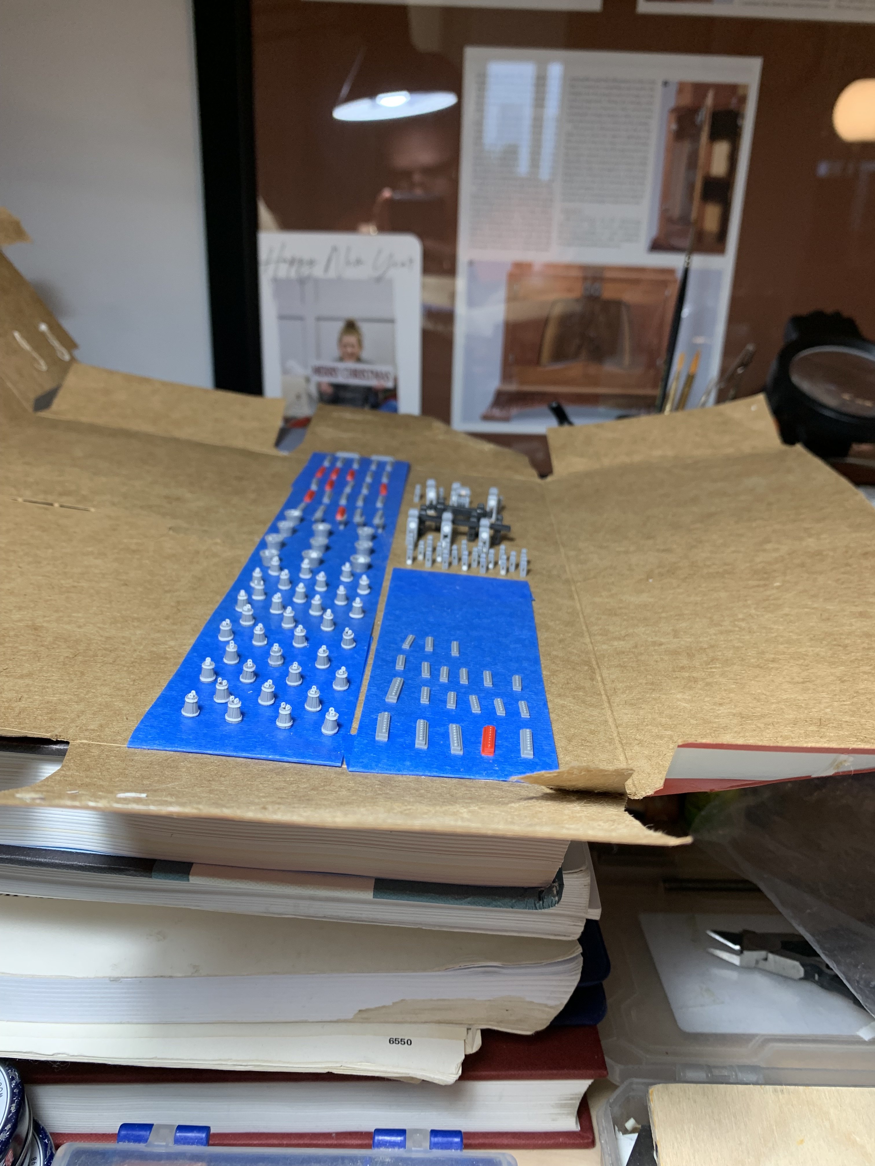

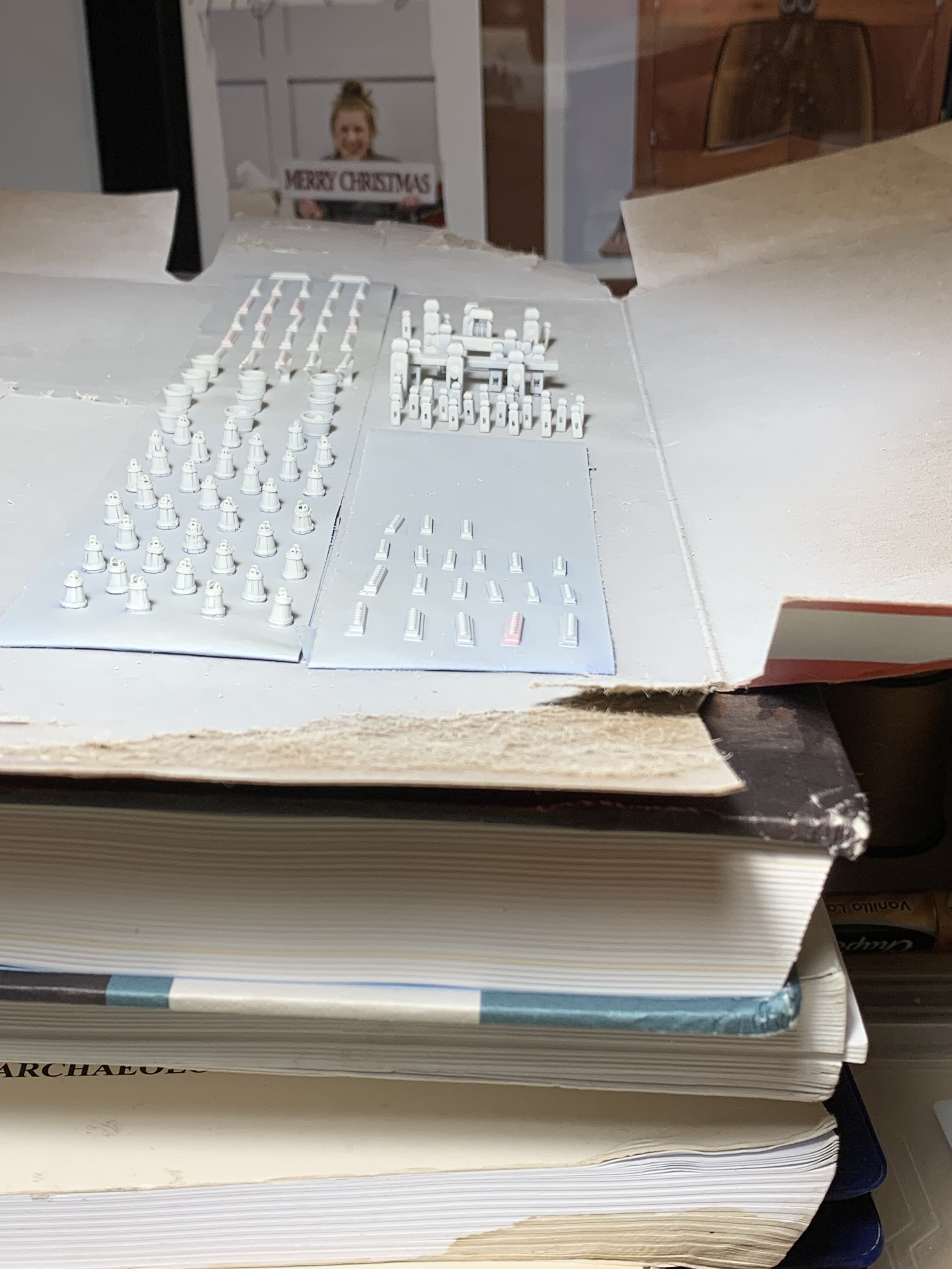

I thought I'd give 1.5mm a go again, as I'll probably want to try using these myself shortly. It's worth saying that a 1.5mm block is close to half the size of a 2mm, in terms of surface area, i.e. it's not just a tad smaller, it is a LOT smaller! As expected I had to ream out the through hole and still couldn't get 0.1mm thread through, so I used some 34g beading wire (0.2mm) as a proof-of-concept proxy. I fear thread of the same diameter might look a bit too large for the block and the thinnest possible might be the way to go. My takeaway conclusion is that 1.5 is bordering on insanely small, but still doable so long as you have a bottomless well of determination 🙂and I know, by putting it next to a victory 12lb-er, that it just looks more 'right' than the 2mm. Maybe the solution (for me at least) is a compromise, 1.7mm or 1.8mm.
image.png.20ce360c8fb174bef41bd5419572f747.png image.png.17bb6287c987e3b71015af8c134f6236.pngimage.png.509190401975522f2a6165bf9095fbbc.png

Wow! - you are absolutely right, what a scale difference it is to go down to 1.5mm.  I suspect that I could rig them with the same 100wt silk thread that Michael is using on his Sovereign.
