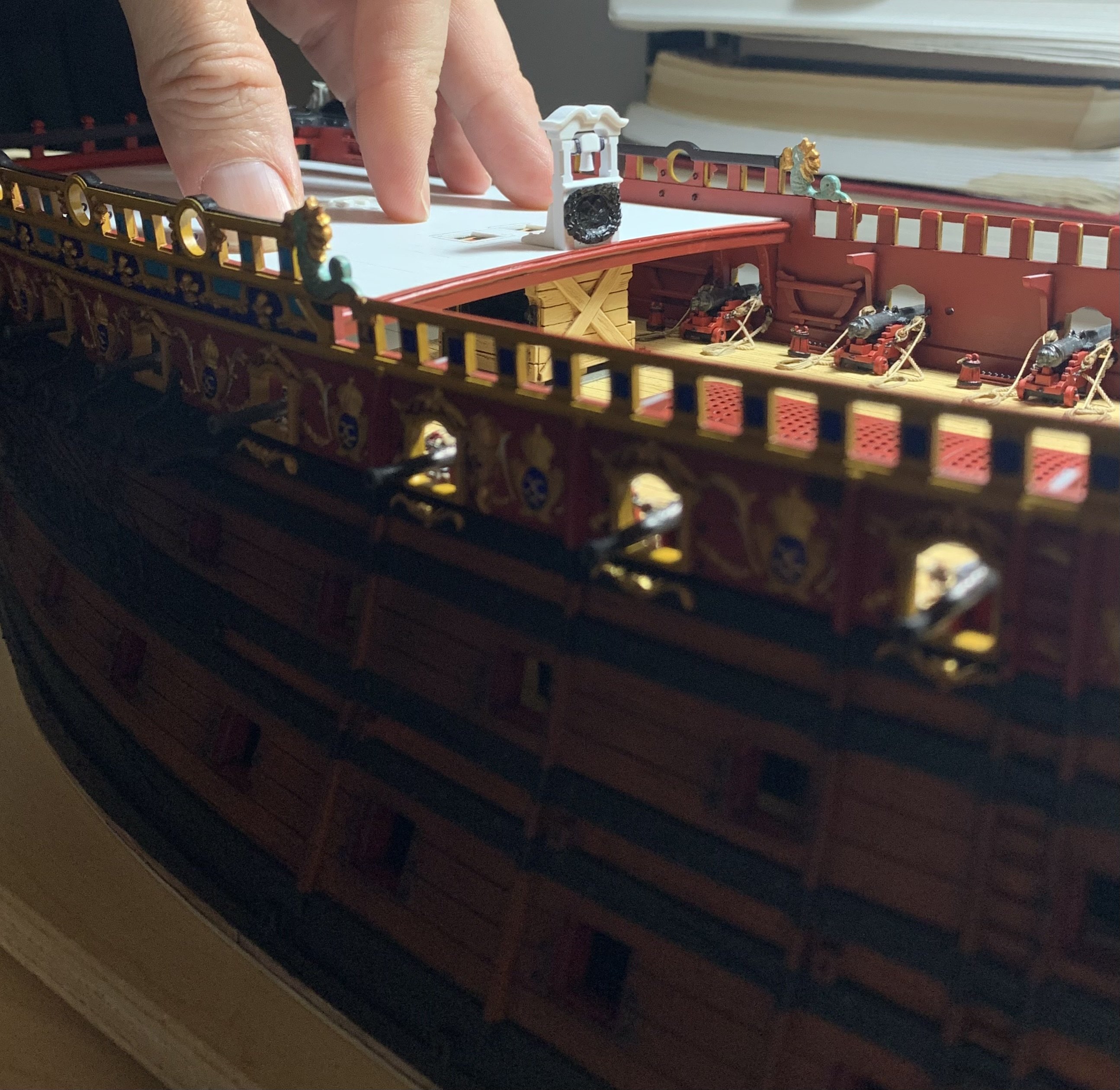

I have decided to keep my momentum going, and I am currently in the process of designing and making my QD breast rail.
In a moment of pre-install vanity, here is the f’ocsle belfry placed:
I wanted to be sure that the scale of the thing looked right, although I did mock-up the main stay during the design process and the top of the belfry is well below it.  With the Louis Quinz model as my reference, I think it looks just about right:
photos courtesy of Marc Yeu

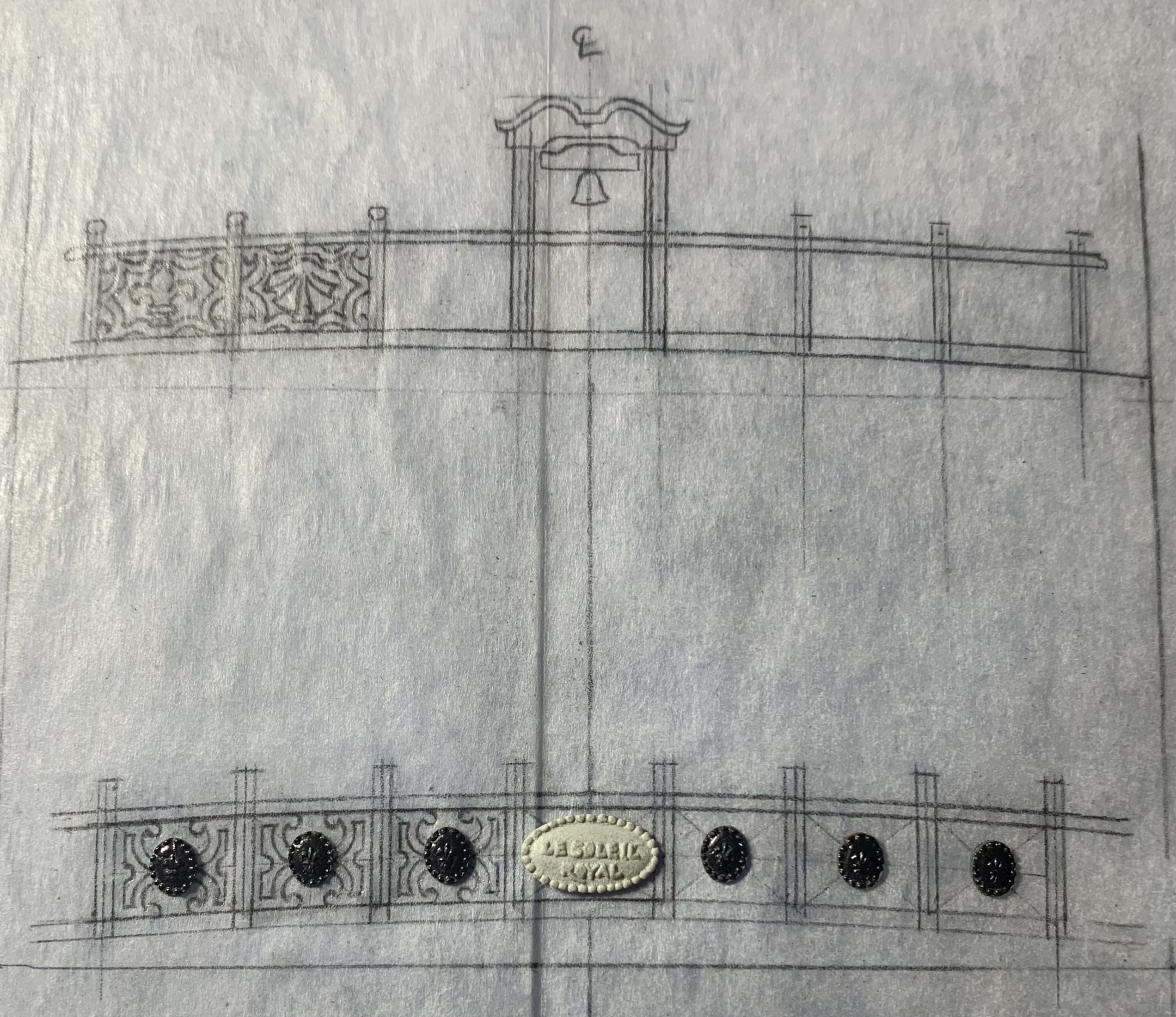

Small update.  They’re all small these days, but chipping away.
I will say that it is always remarkable to me that no matter how scrupulously I draw something, and use straight edges to scribe the lines into plastic, while also accounting for the half-width of the blade-to-point (and the half-width of the drawn line) - there are always WILD discrepancies from the drawings, in the cut parts.
It is essential, IMO,  to make the actual parts fit the initial drawing, because the pattern/drawing is based directly on the actual deck camber; minuscule discrepancies in angle-to-post will create gaps between panel and rail that are much more difficult to remedy, given my sub-assembly approach to building these breast rails.
Here are my panels laid as carefully over the drawing as I can, after they’ve been parted on the lines with a razor-sharp chisel:
One has to account for the shortcomings of phone-photography - which does not provide a truly flattened perspective in close range, however, it is evident in the picture above that there are overlaps, and angle-to-post inconsistencies that would make a final glue-up far less than ideal.
My advice to anyone that reads this will be to trust the quality of the initial pattern that you make.  Base all of your geometry on that.  Shape your parts as closely as you can.  You will have FEWER surprises on assembly.
Part of what is happening here is that I am paring to a line with a really sharp chisel through soft plastic that is less than 1/16” thick.  I am squaring that chisel intuitively by eye.  I am careful to always leave less than 1/32” for my final paring cut to the line.  And.  And, yet.  The chisel will still drift to an out-of-square cut.
I say all of this to say, that fitting these small panels to a drawing:
is a process of consolidation; of checking and re-checking against the drawing; a little from the lower left corner; a little from the top right.  Oh, and the central panel does require some actual camber along the top and bottom surfaces.  A very little here, and a very little there, and eventually I have arrived at a reasonable bet for sub-assembly:
I will note that the central “Soleil Royal” badge is, in actuality, 1/64” off center.  I point it out only to highlight that this is what the eye can perceive.  In this instance, it is a consequence of process and bonding.
I’m using C/A to bond BONDO to plastic.  The window for placement is limited.  I managed to get the top/bottom spacing right.  In the end, after all is said and painted, and posts are in-place - the discrepancy will hardly be noticeable.  There is too much else for the eye to focus on for it to matter.
Next, I will make the knee/post supports.

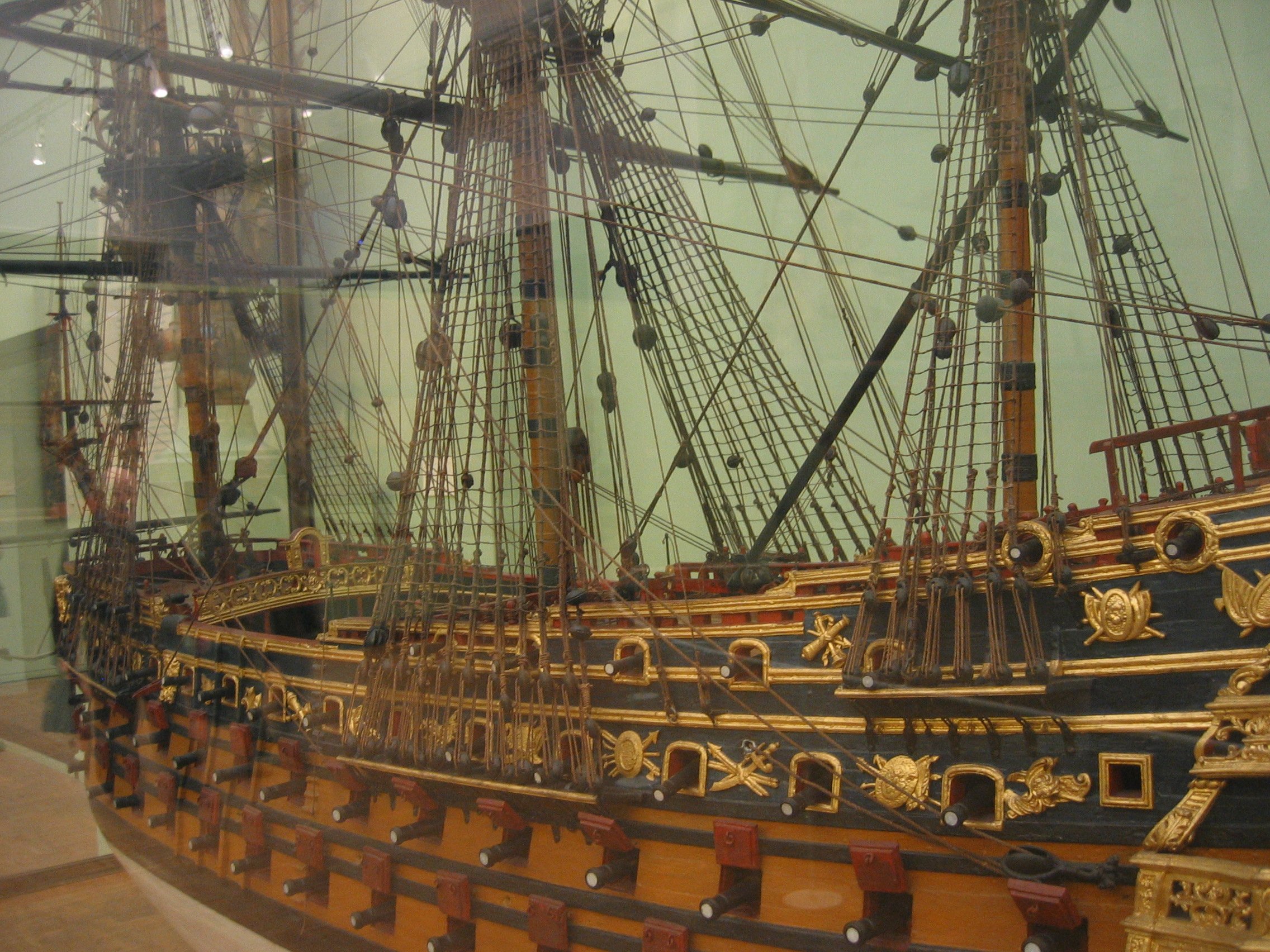

When I looked at the museum models, I couldn't help but notice that there were quite a few “crooked” details. But that doesn't prevent me from admiring the model.
When I was reproducing the carvings from the Vasa ship, I saw that there were also many asymmetrical and crooked elements there. What's so difficult about that? Well, no, one eye is higher, the other is lower.
The head of the sculpture looks as if it was made by different people from different sides, who didn't pay any attention to what their neighbors were doing.
But we still admire it and enjoy looking at it.
I hope this will reassure you at least a little. You are following in the footsteps of the builders who once built the ships we admire today.
