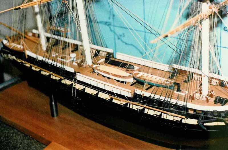

With regards to the gunport spacing, or any other dimensional detail, I always check the US Navy plans. As I read it, the spacing is close but not consistently the same. From a distance, the eye may not see the differences.
Jon
I just took my measurements right off the plans. I think the differences are virtually undetectable. I don't have other resources, so I've just assumed that there are similar differences on the real ship which are also undetectable. It didn't occur to me to do anything else. I don't think you will be disappointed with the result if you simply follow the plans. Some of the gunports are tight against bulkheads as it is, so it might be more trouble than it's worth trying to re-space them. For what it's worth, that's my thought on the subject.
David
