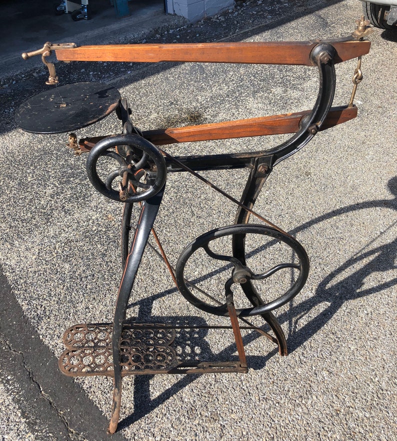

They had powered scroll saws, too!
Antique 1800's Treadle jig saw 36x14x29 Millers Falls image 0
https://www.etsy.com/listing/745428861/antique-1800s-treadle-jig-saw-36x14x29?gpla=1&gao=1&&utm_source=google&utm_medium=cpc&utm_campaign=shopping_us_ps-a-craft_supplies_and_tools-tools_and_equipment-tools-other&utm_custom1=_k_CjwKCAjwlYCHBhAQEiwA4K21myP675yEwWCgTQAQfy_o6Wot148Le0jyKTtecLdxM1UuuTYkidE9IxoCeHMQAvD_BwE_k_&utm_content=go_12565278184_123210950767_507187537626_pla-295604191622_c__745428861_111184285&utm_custom2=12565278184&gclid=CjwKCAjwlYCHBhAQEiwA4K21myP675yEwWCgTQAQfy_o6Wot148Le0jyKTtecLdxM1UuuTYkidE9IxoCeHMQAvD_BwE
