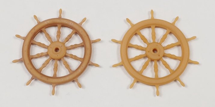

New fittings to be available soon.   Available in Boxwood color and a Swiss Pear.
Ships wheel...
I already have real Boxwood ship's wheel kits and will be keeping those in stock.   I love those. These are just an alternative.   Especially for those who really dont want to assemble 50 pieces and turn the spokes in a dremel.
The Darker is good to go right out of the package.  The Boxwood wheel is also great to use as is, but in this instance I wanted to show how it would actually look with a wet on wet wash to accentuate the grooves and details.   It literally took 5 minutes.   Too often I see folks just use this stuff straight away withought working on the appearance further.   It does make a big difference.  Wet down the wheel with your paint brush.  Then working about a third of the wheel at a time while its wet, I applied some acrylic burn umber paint.  The paint was also very very thin, wet, wet wet.  Just brush it on while the wheel is still wet and then switch to a clean brush before it dries.  Just touch the raised areas or the areas you want to remain lighter and it will soak up the very wet darker brown color.  For example all around the outer rim face and the thicker areas of the spokes.   The paint just erases away leaving the lighter color of the raw resin under it.
You can also use weathering powders depending on what makes you feel more comfortable using.  You can also use some wood stains....of your choice, I prefer Old Masters Fruitwood Gel stain.
I show this because on certain items the 3d printed objects looks so great right out of the package....blocks for example.  But others need some help so they dont look so perfect and clean making it hard to see the details.  The darker "Pear" color doesnt need any work at all...for whatever reason that finish always looks great right out of the package.   I went just a hair lighter on the darker pear finish for the wheels.   I just thought it needed to be lighter and this is the way they will be sold.
I am working on an eight spoke wheel now as well.   So these will be available in the same sizes as my all boxwood kits.   Basically a 1/4" and 3/16" scale wheel.  And hopefully in both 8 spoke and ten spoke.

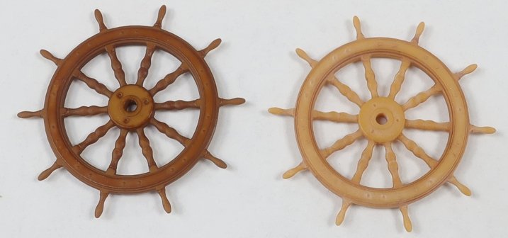

I forgot to add the photo showing what the unweathered 3D printed wheel that is Boxwood color will look like (on the right).   This is how it will look when you get it and you can see how easy it is to just kick it up a notch.    You guys should give it a try.  Just a wet on wet wash of brown or burnt umber changes the appearance quite a bit.  With my rigging blocks I do this for you in mass  (not with acrylic paint).  But because of the complex shape of a ship's wheel I cant really do that....it would just take too long.   So its up to you.

Chuck: I have been checking out paint shops here in the Yukon and we dont seem to have Old Masters in stock. Minwax seems to have gel stain on the shelf up here in abundance. Any recommendations on a match that would be close to your recommended Old Masters Fruitwood gel stain? I do like the look it gives

Oh thats great.  I havent tried the Minwax version.  Any warm
brown or will do according to your tastes.  You really have to experiment.

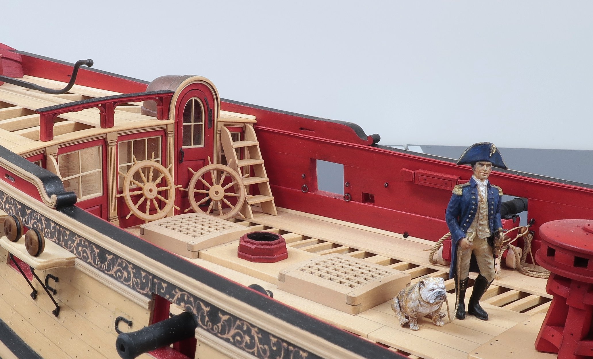

I was asked to show the color of the wheel on top of some boxwood.   This is an even better way to see it in its actual environment.   Dont look at the dust.  When you see dust build up on your model like this that means you really need to do more actual model building, LOL.   The wheel on the left is how you will get it and can use it straight out of the bag.  It looks great.  The one on the right has the wet on wet burnt umber wash.   I will have the ten spoke 1/4" scale boxwood version in stock today.  Its 1 1/4" in diameter.
Its a very subtle difference dont you think.  Too often I see folks over-do the application of a wash or weathering.  You really just want to give it some tone.

I am waiting for the day you start your 3D printer and a week later you pull out a HMS Victory in the 1/48 scale. Just kidding.
Chuck, I love the details that you produce since that was the first thing I noticed when I open my first kit. The small wooden parts don’t look very prototypical.
Thank You for saying...Its a labor of love.   I insist on not offering anything for sale that I wouldnt put on one of my own models.
