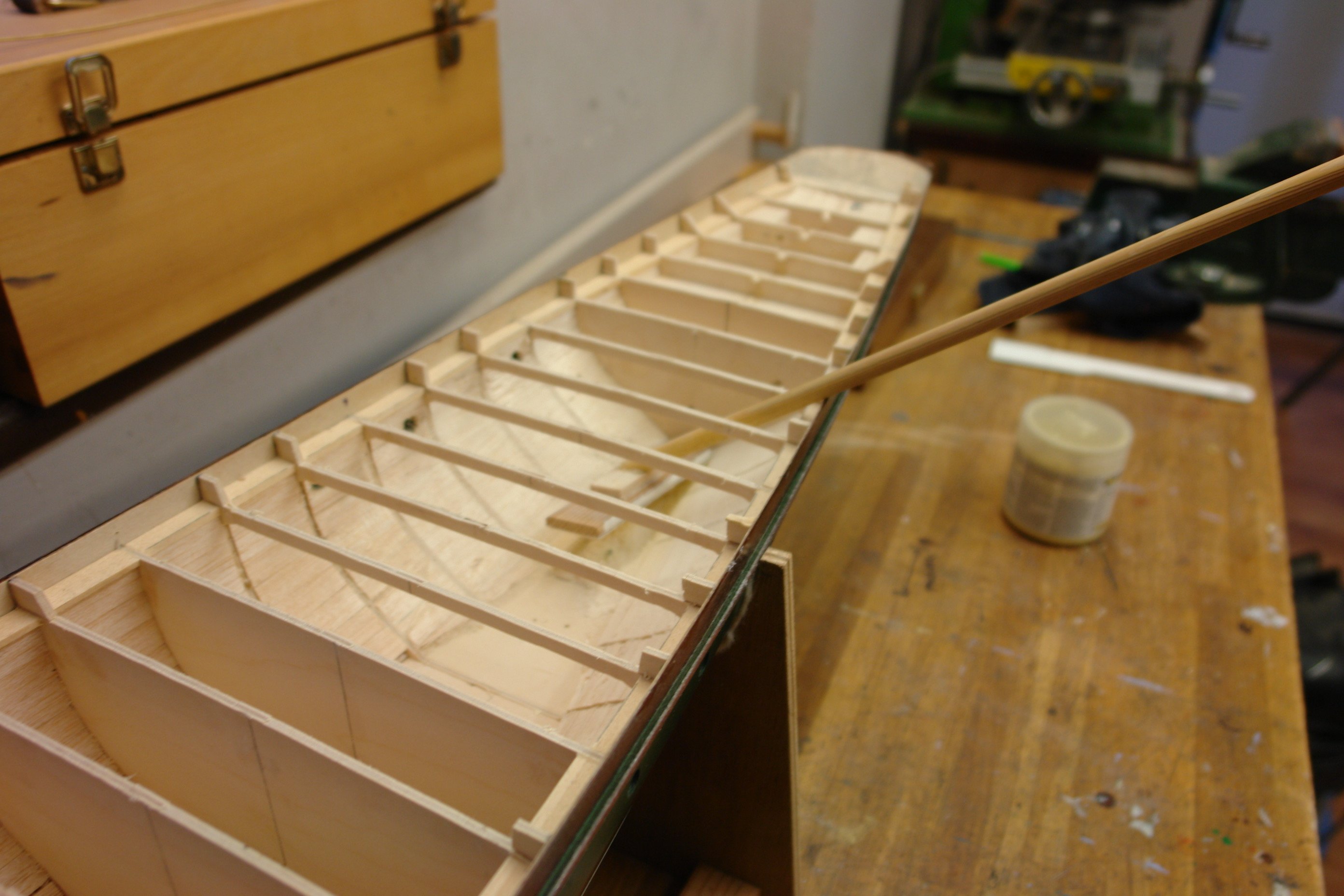

The first job however was to do a little internal preparation.

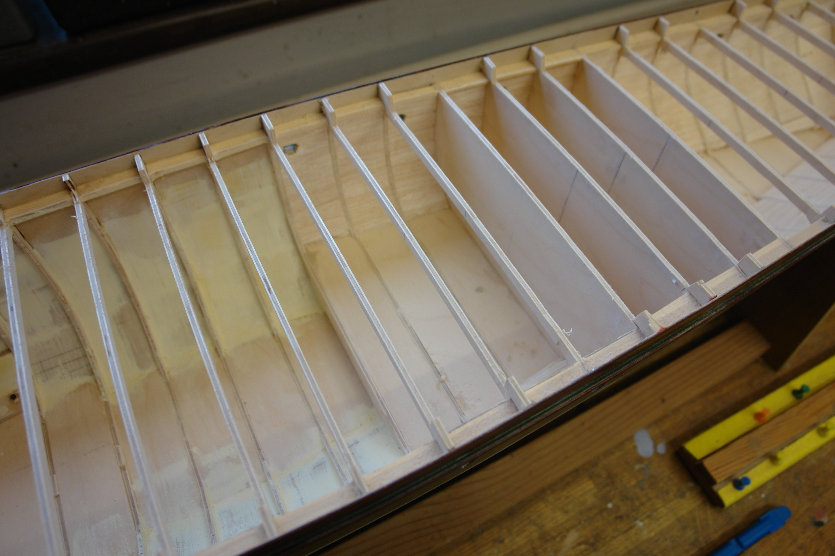

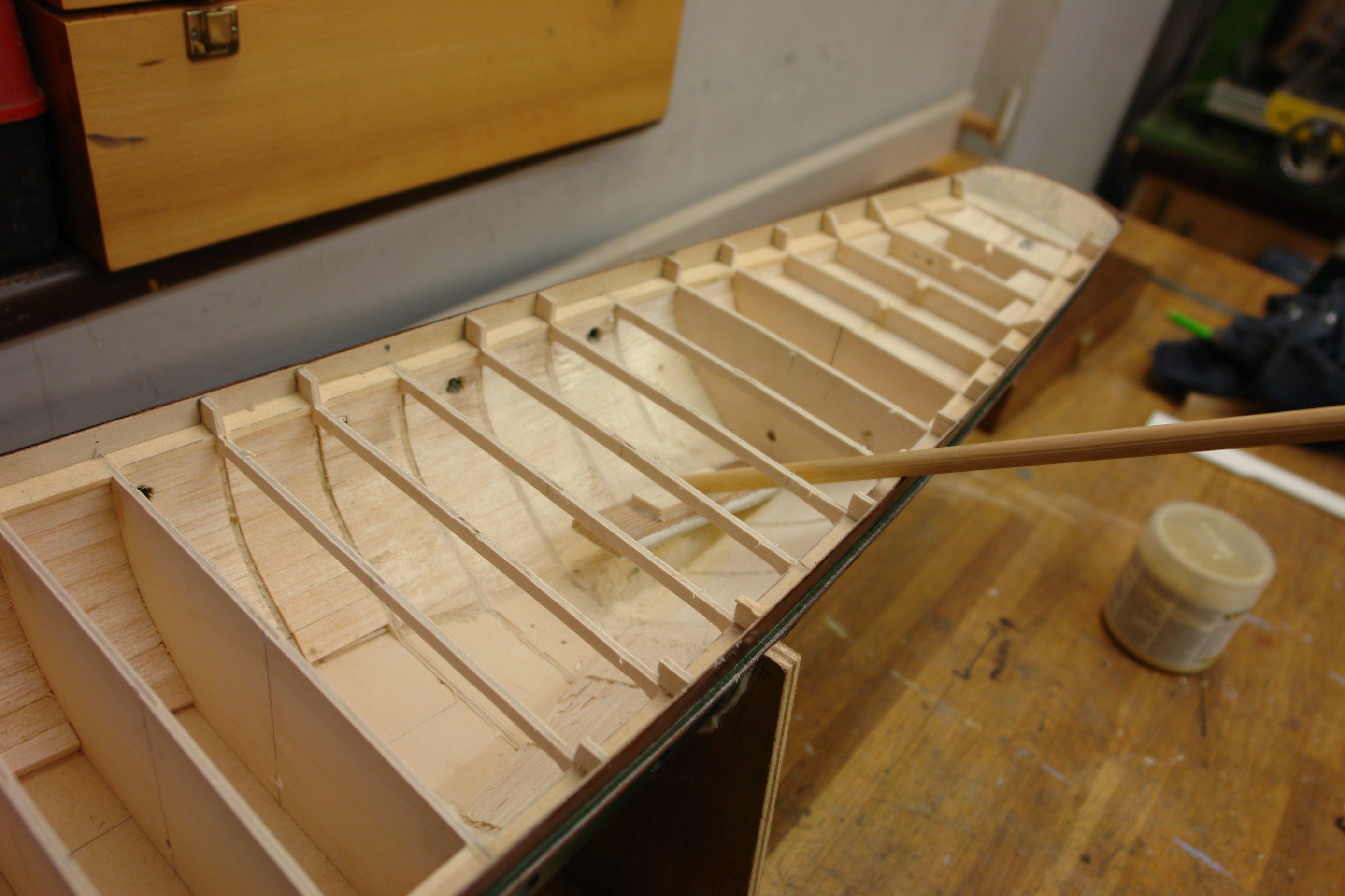

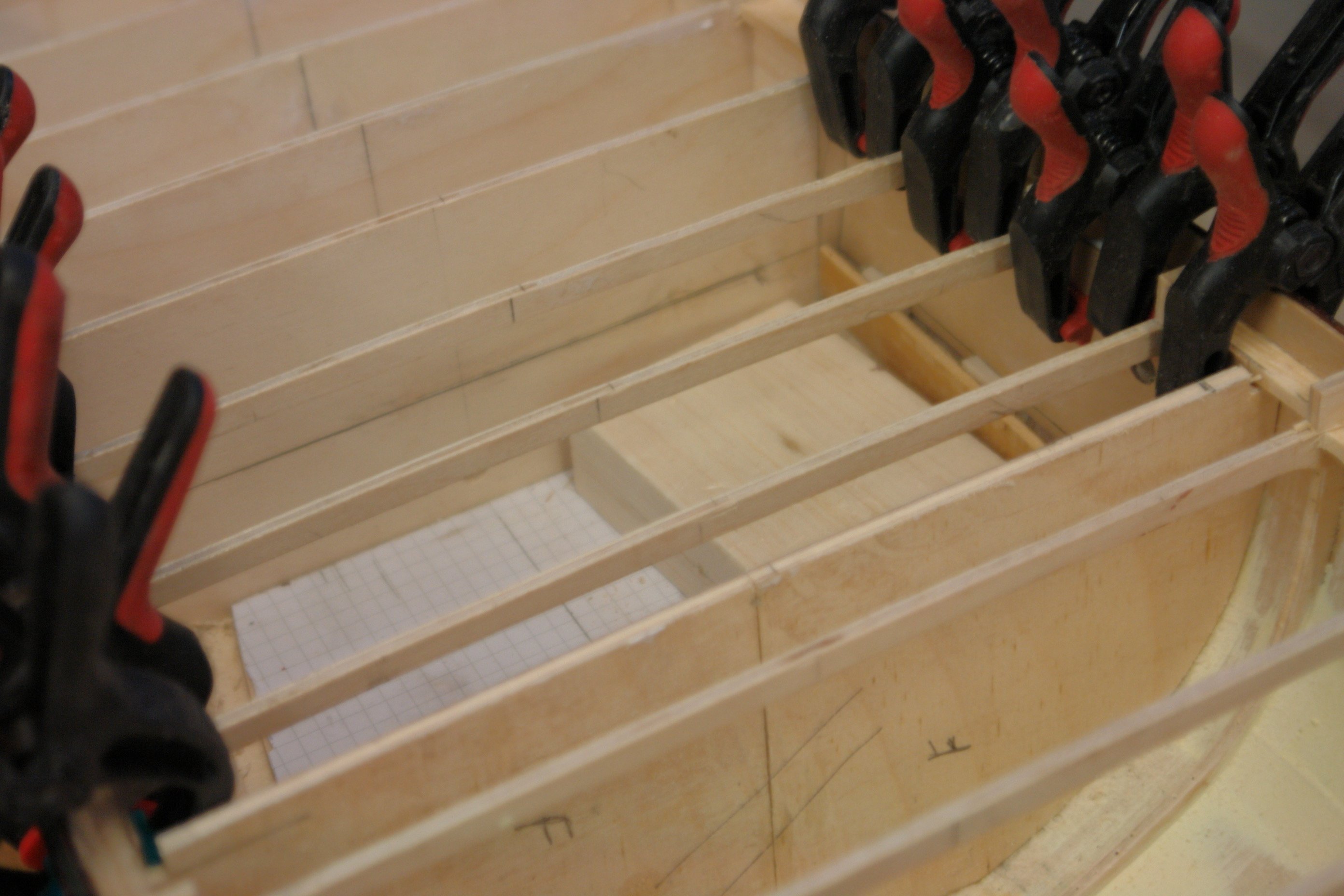

All the internal surfaces where the balsa backing had been installed were sanded to the profile of the  frames using my improvised sanding stick.

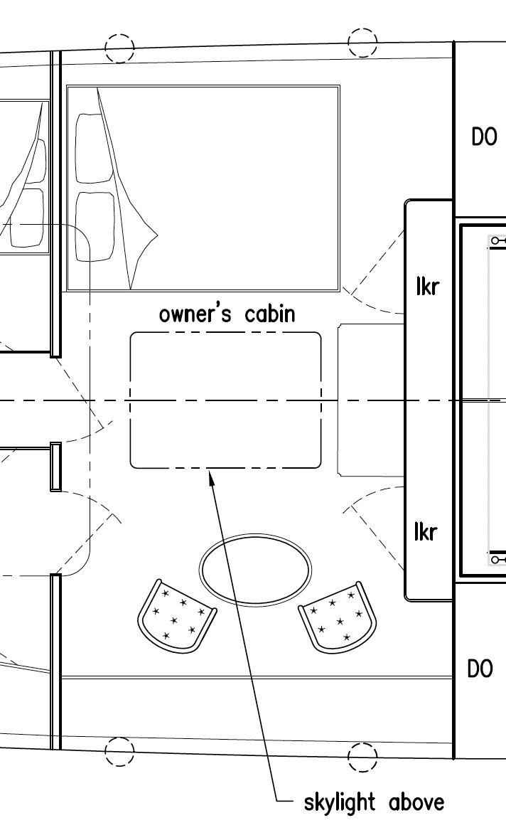

The owners quarters sit amidships with white panelled walls mahogany cupboards, lockers and a double berth. The arrangement is broadly detailed on one of the available plans. The plan isn't exactly correct but with the available photographs this isn't a problem.

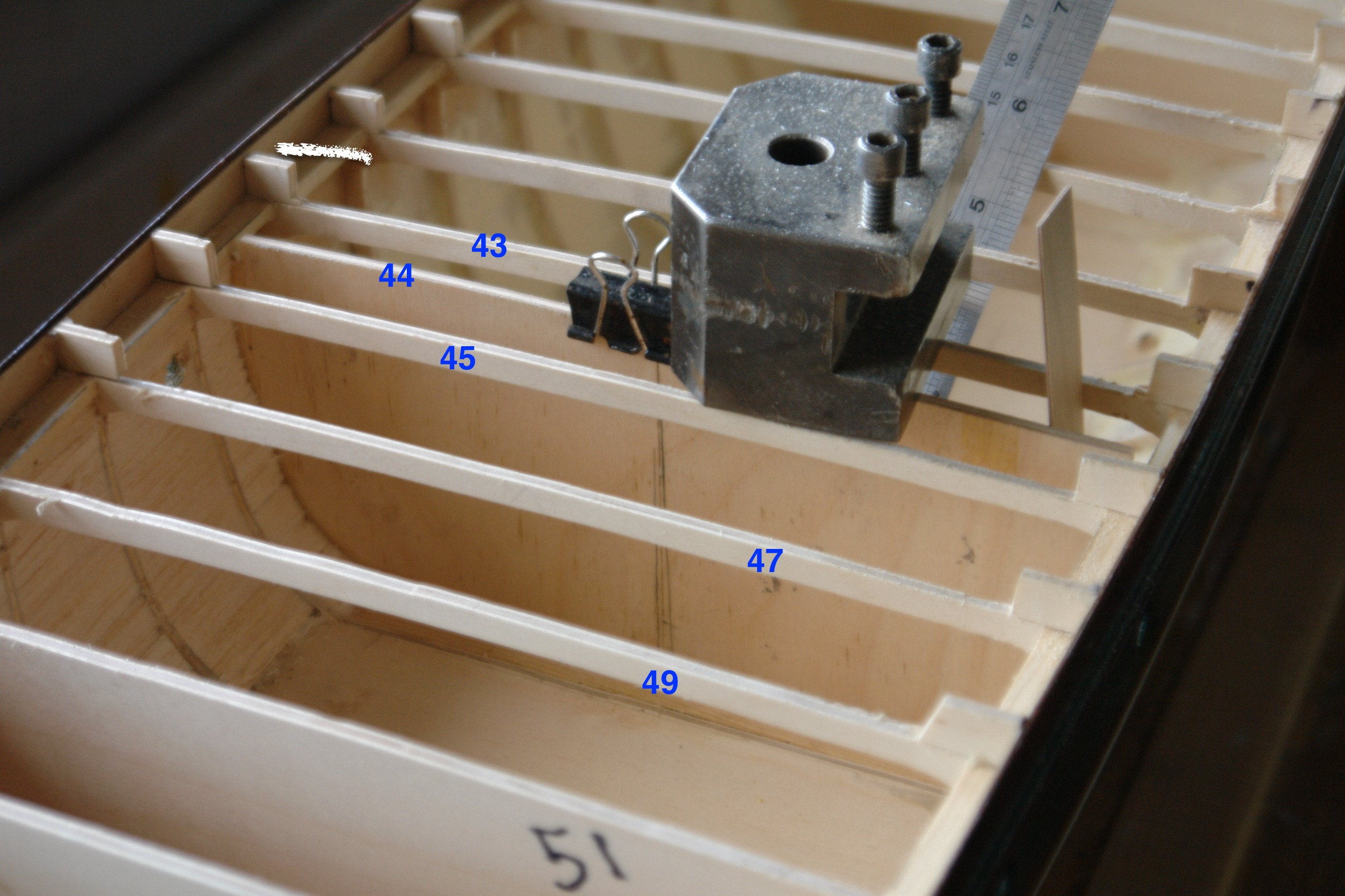

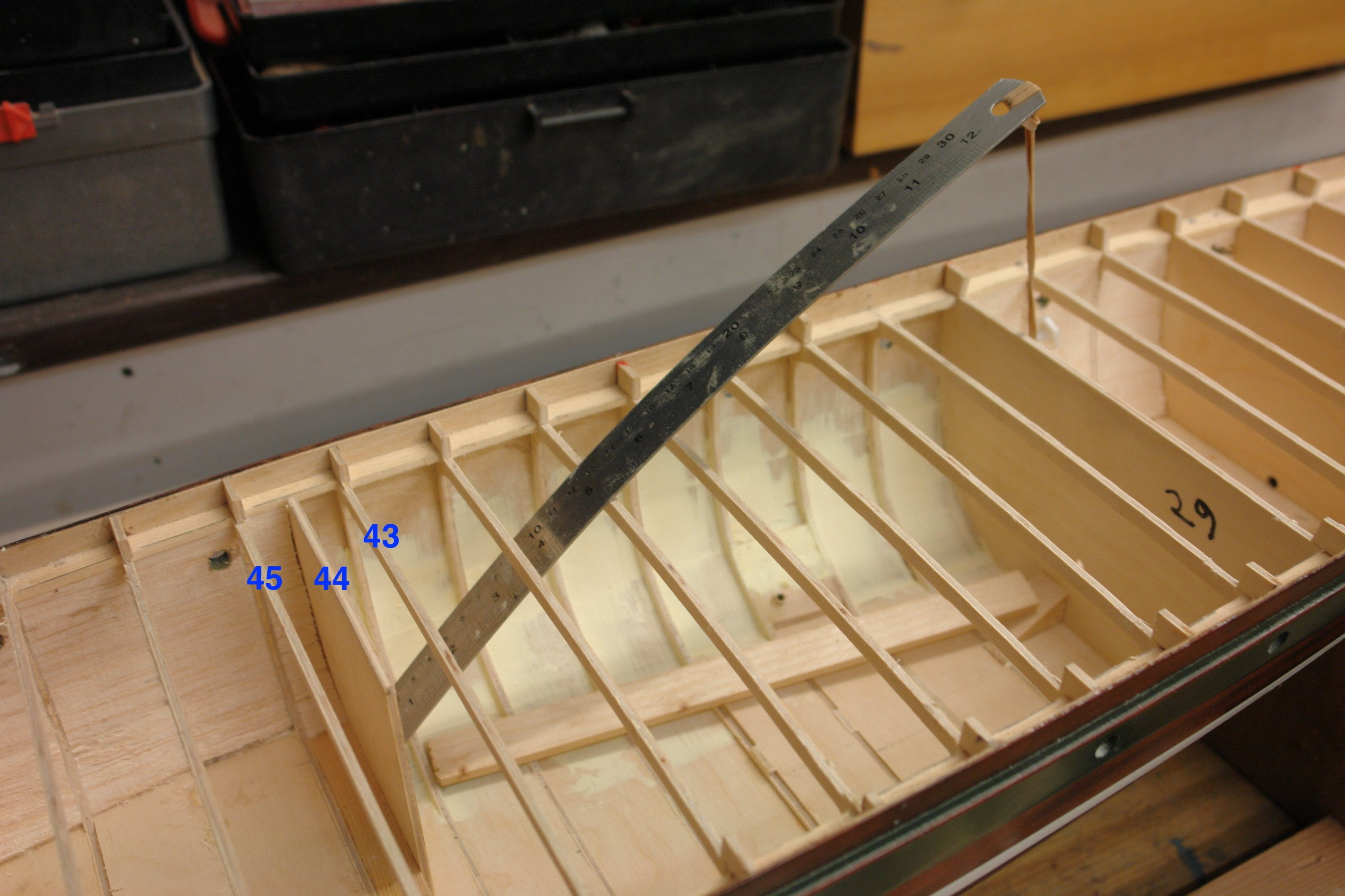

From earlier some of you might recall that I installed every second frame (actually all the odd numbered ones). The foremost bulkhed of the owners cabin actually starts at frame 44 so this had to be retrospectively installed. A lack of planning created unnecessarily rework. The rule and elastic band are holding the half frame in place while gluing. It wasn't possible to install the whole frame as on piece (I tried and failed).
DSC03313.thumb.JPG.833af2527b1ec5ebcdc213c624483928.JPGDSC03314.thumb.JPG.339ee43ca47775ec3b677ce9d5590dbb.JPG

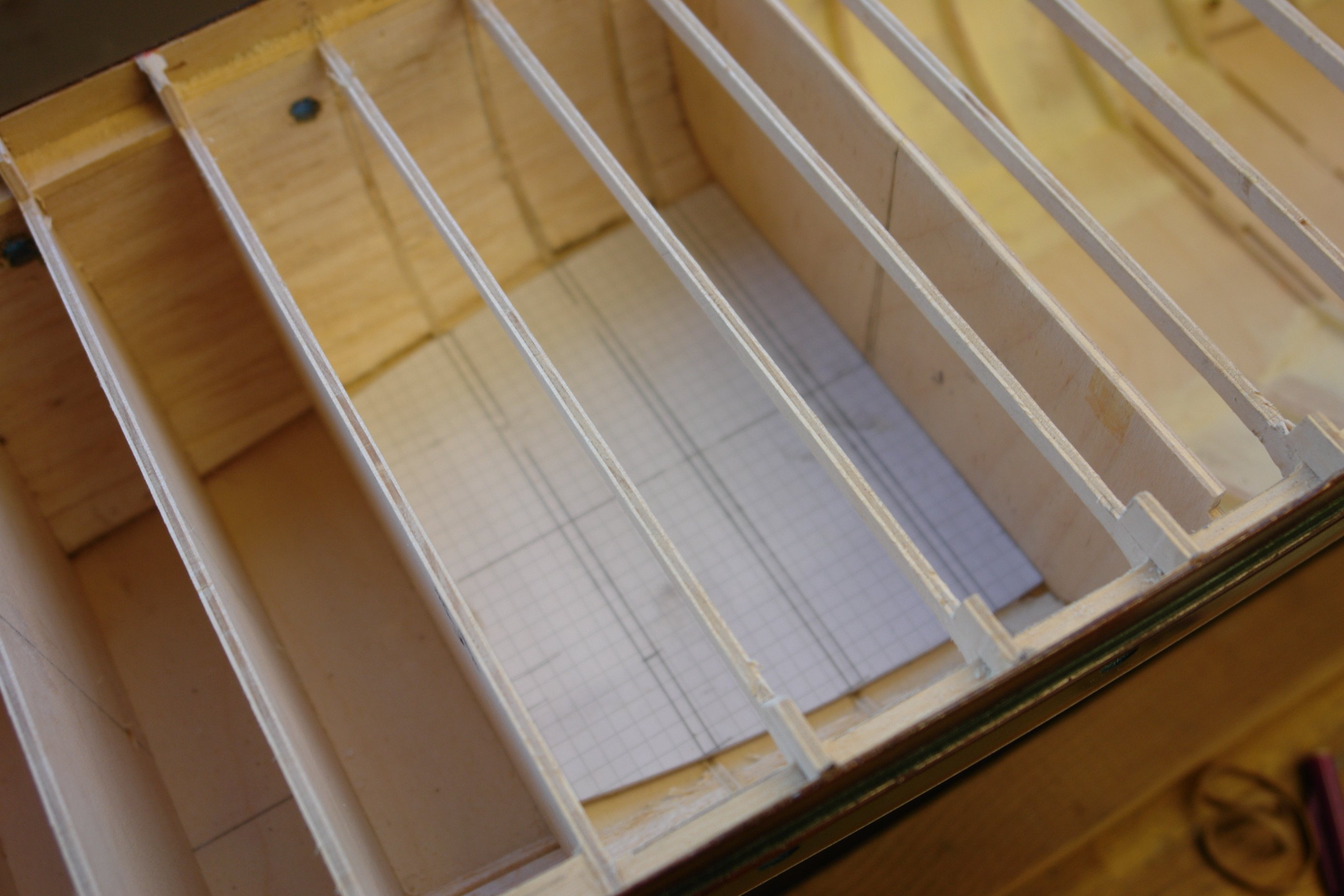

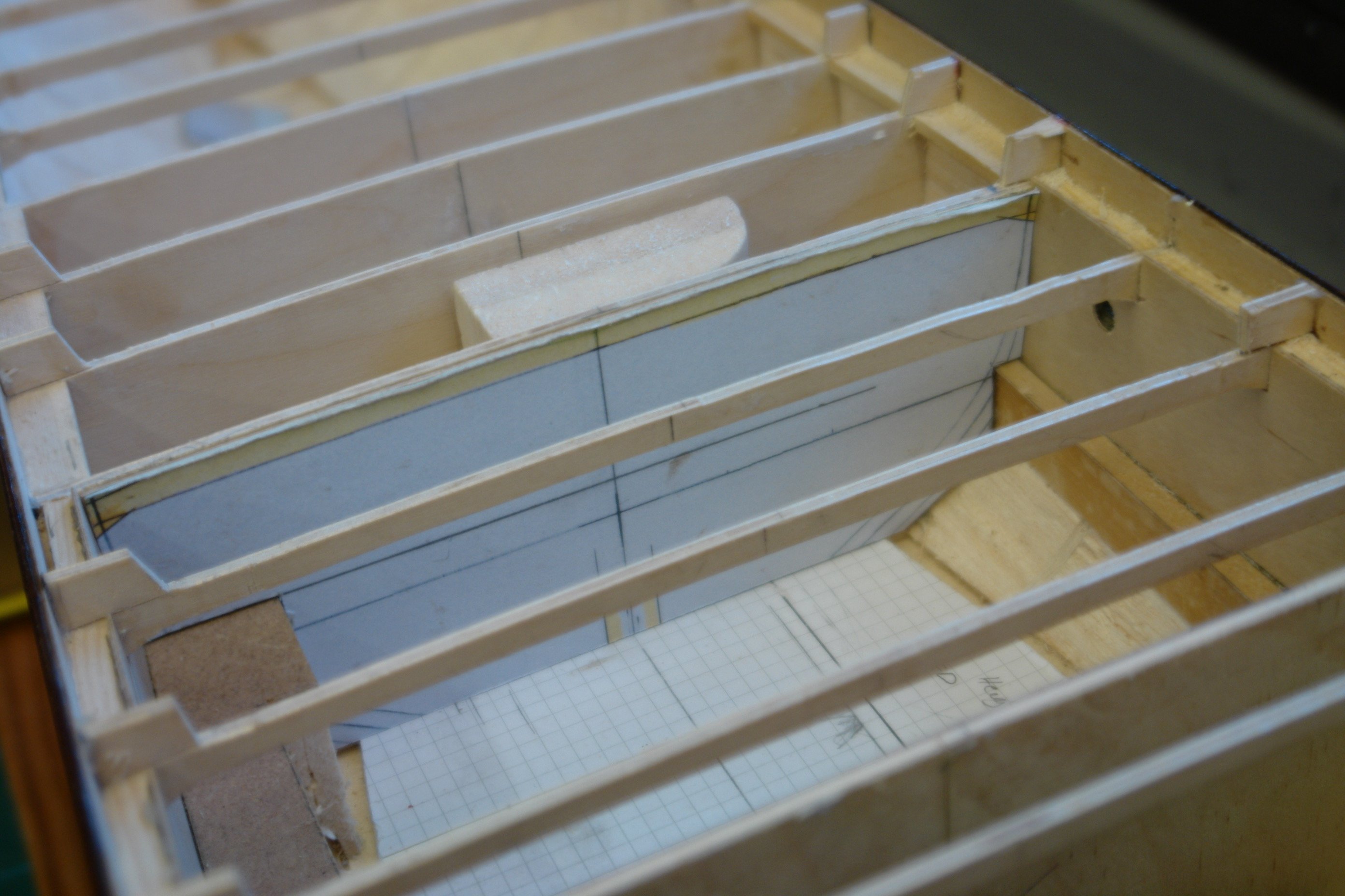

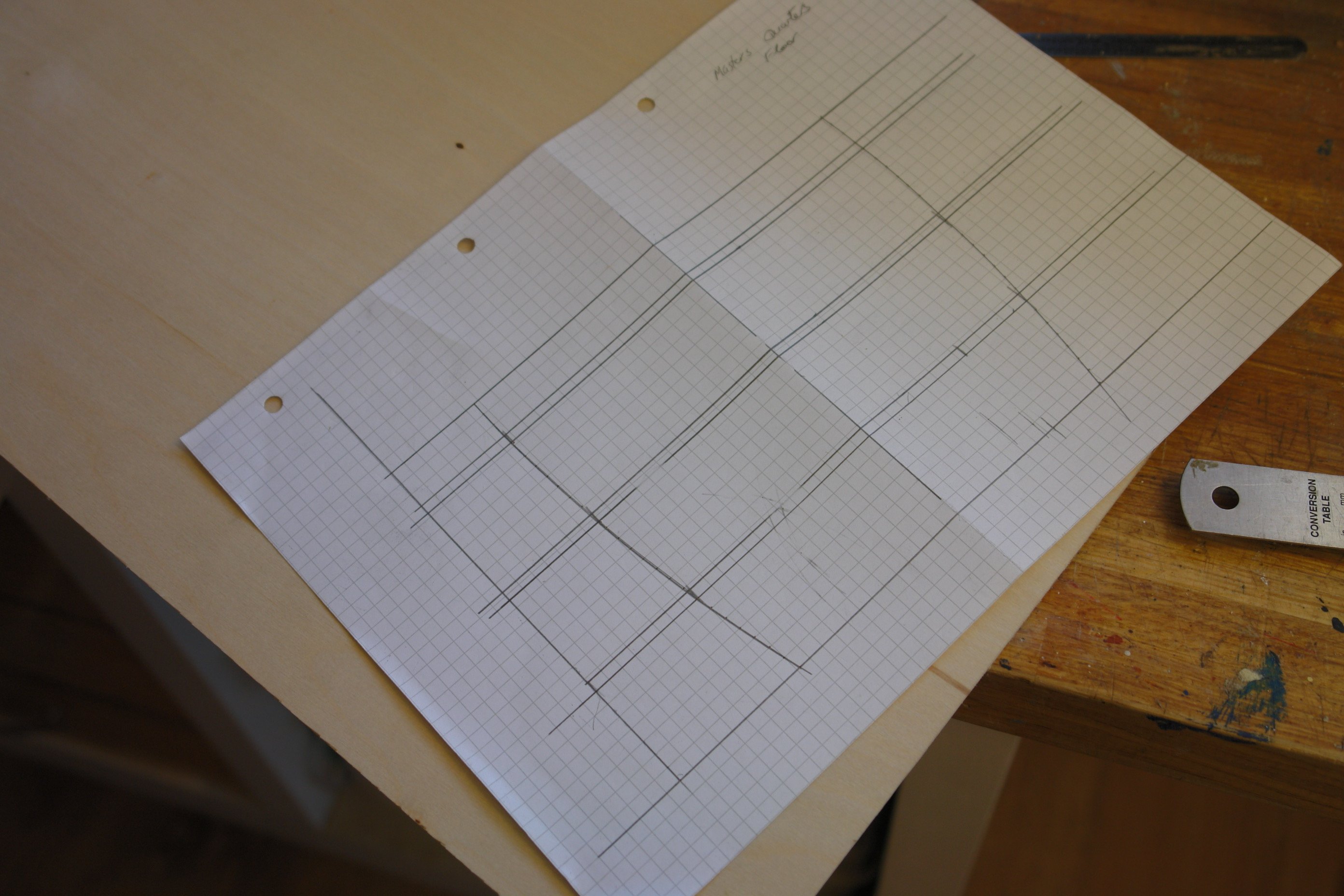

I needed to put the floor in (made from 1/32" ply). The dimensions were taken from the installed frames and drawn on a paper template. Installation through the deck frames was checked.
DSC03315.thumb.JPG.778051376b1c3094fb2763e933e70a0b.JPGDSC03316.thumb.JPG.4749c081cfa7c4737f4fe1ae07bae5bf.JPG

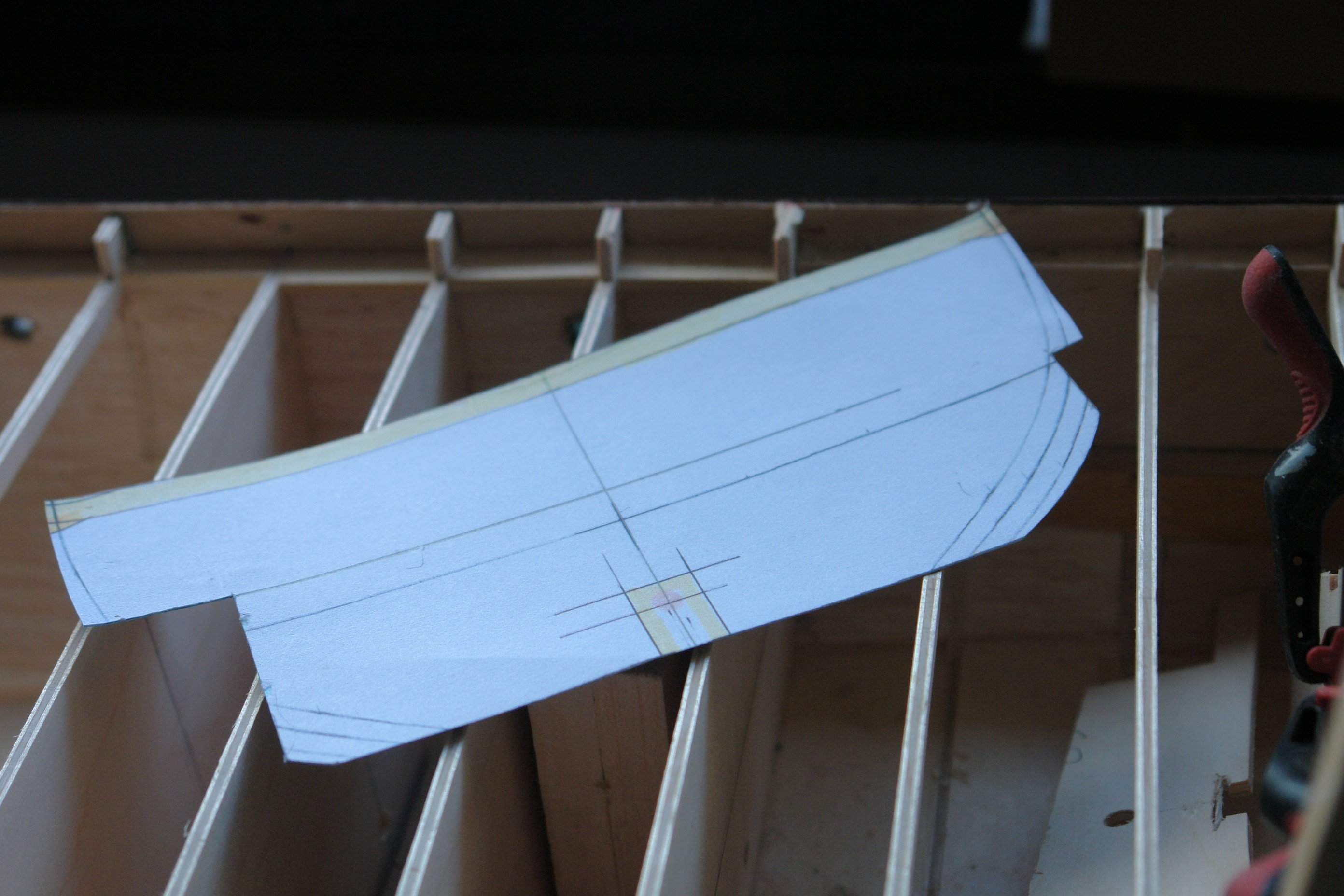

A template for the forward wall was shaped to fit at frame 44 with cut outs for the fitted cupboards on the starboard beam and shelf on the port beam. The template will enable me to make the white panneled walls.

When finished it should look something like this. The chairs are a bit worrying, I'll come back to those at a future date. if not succesful i can always leave them out.

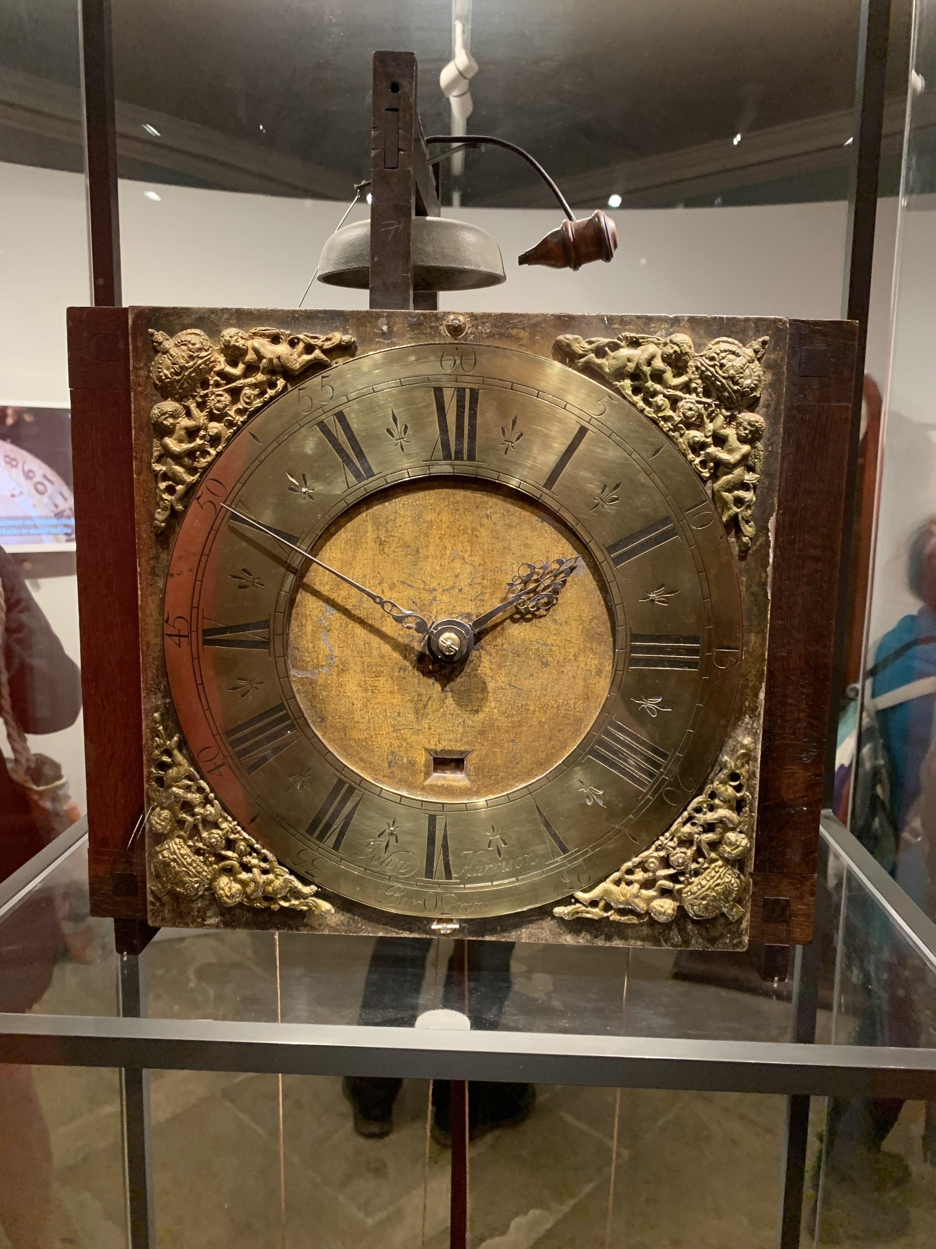

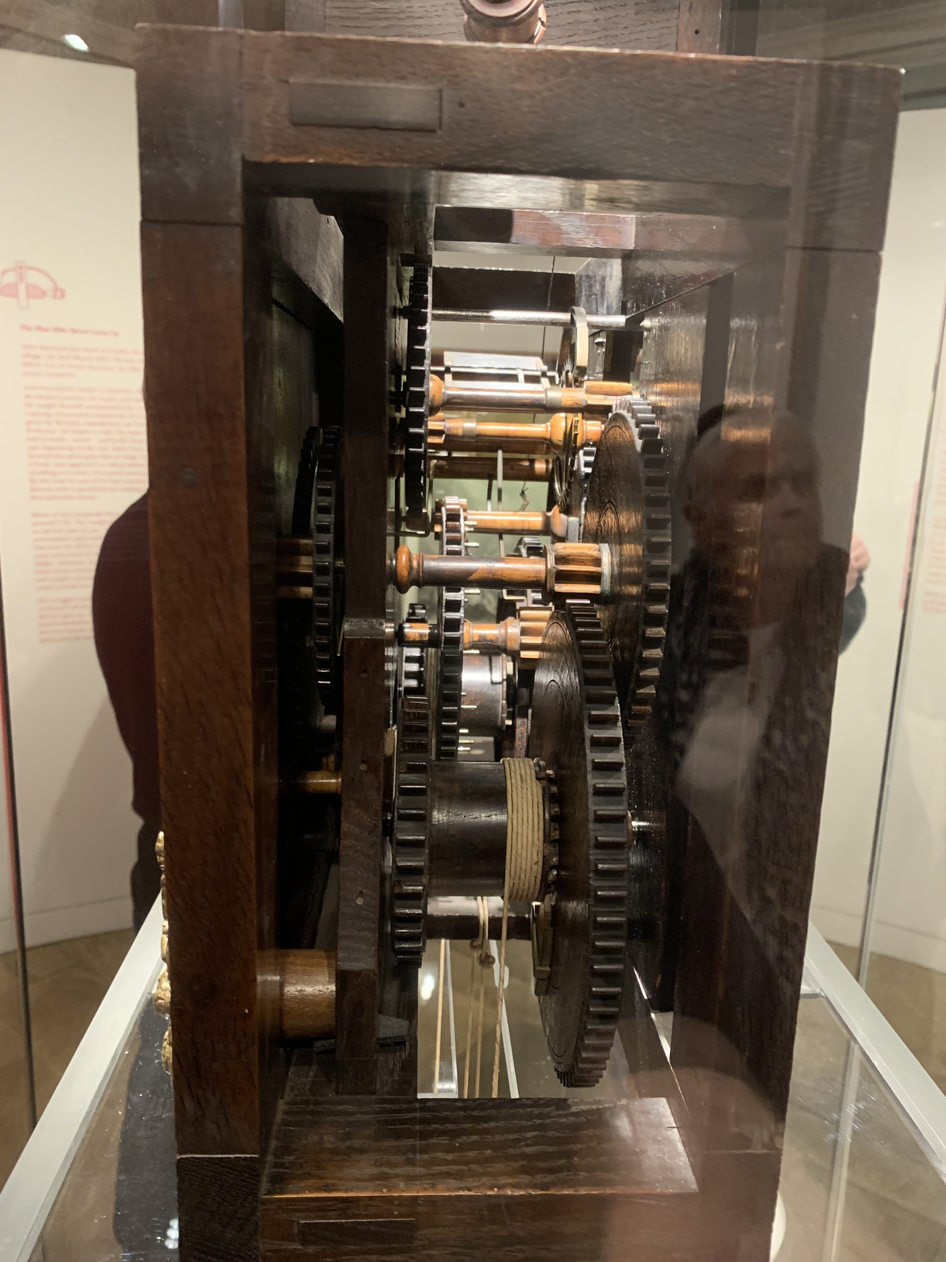

On a slightly different subject. I did take a few days off from contractor supervision over the summer. Here is a fine old clock which is a woodworking masterpiece - all the gears and spindles made of hardwood.IMG_5557.thumb.jpeg.c5f25b5db655ae10a21daac18ac19223.jpeg
It had run almost continuously for 300 years ( Made 1717) but alas recently it has been allowed to stop to preserve it. ~They don't make them like that any more! It is on display in Nostell Priory ( Yorkshire ) where John was the son of the estate carpenter.

 As much as I admire the desire to preserve that beautiful clock as original, I find it hard to believe that line is 300 years old and hasn't been replaced at some point. Did replacing the line make it non original? Not hardly.
Yes I assumed that had replaced the line at some time. I think they must treat the line as a consumable item and therefore not intrinsic to its authenticity ( a bit like my wrinkles ).
I think that specific clock was written about in the book "Precision" by Simon Winchester...... a fascinating tale of skill & engineering, that would appeal to any scale modeller.
Ian, yes, the same John Harrison. Three of his wooden clocks are still in existence.
As an aside, several years ago we had the Harrison chronometers on display at the National maritime Museum here in Sydney. A couple of older blokes approached me and asked if the clocks were really made in the early 18th century. When I confirmed that they were, they said, "So, all hand made"? "Yes", I replied. One of them then said, "Mate, we've been toolmakers all of our lives and we couldn't hope to do anything like that"!

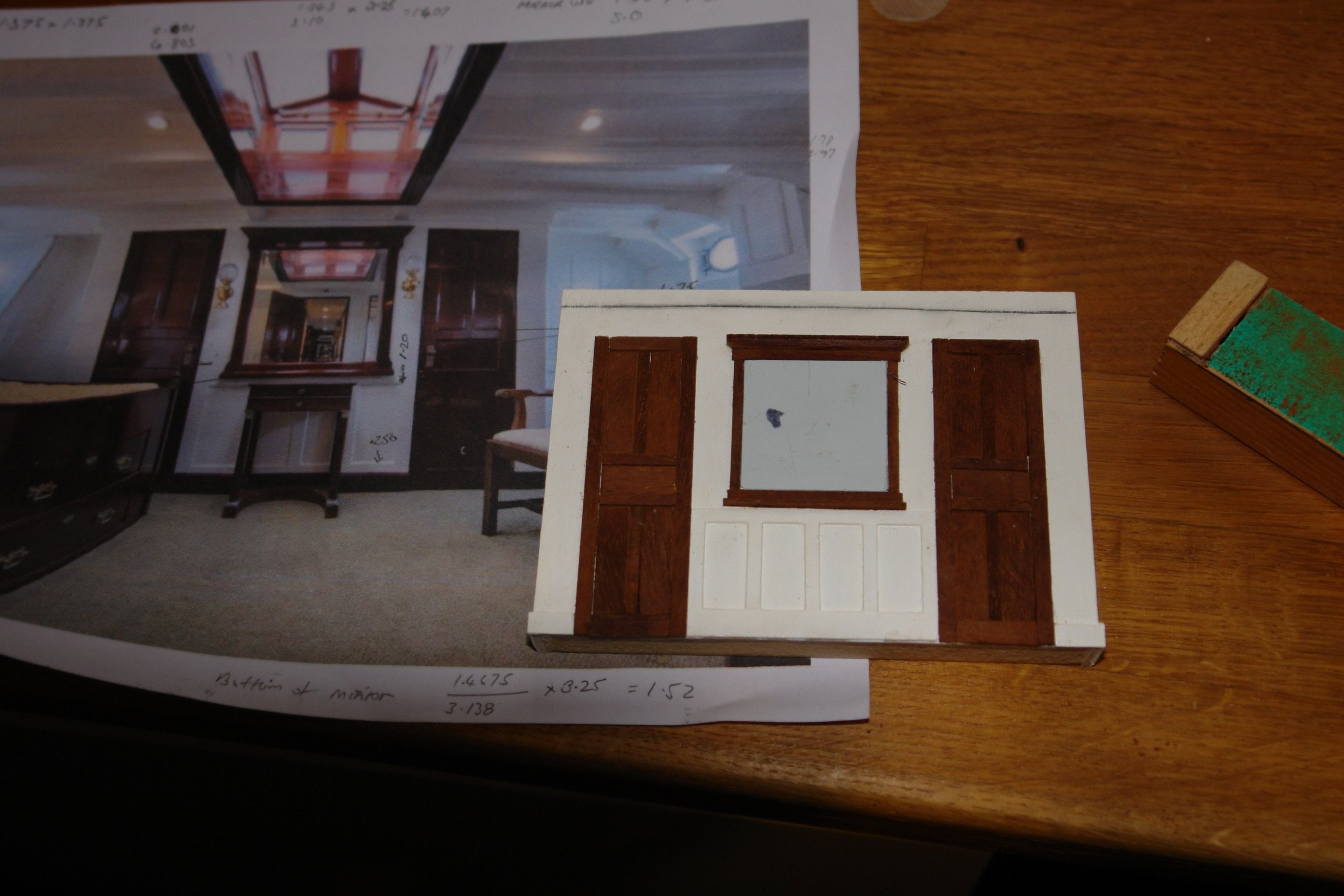

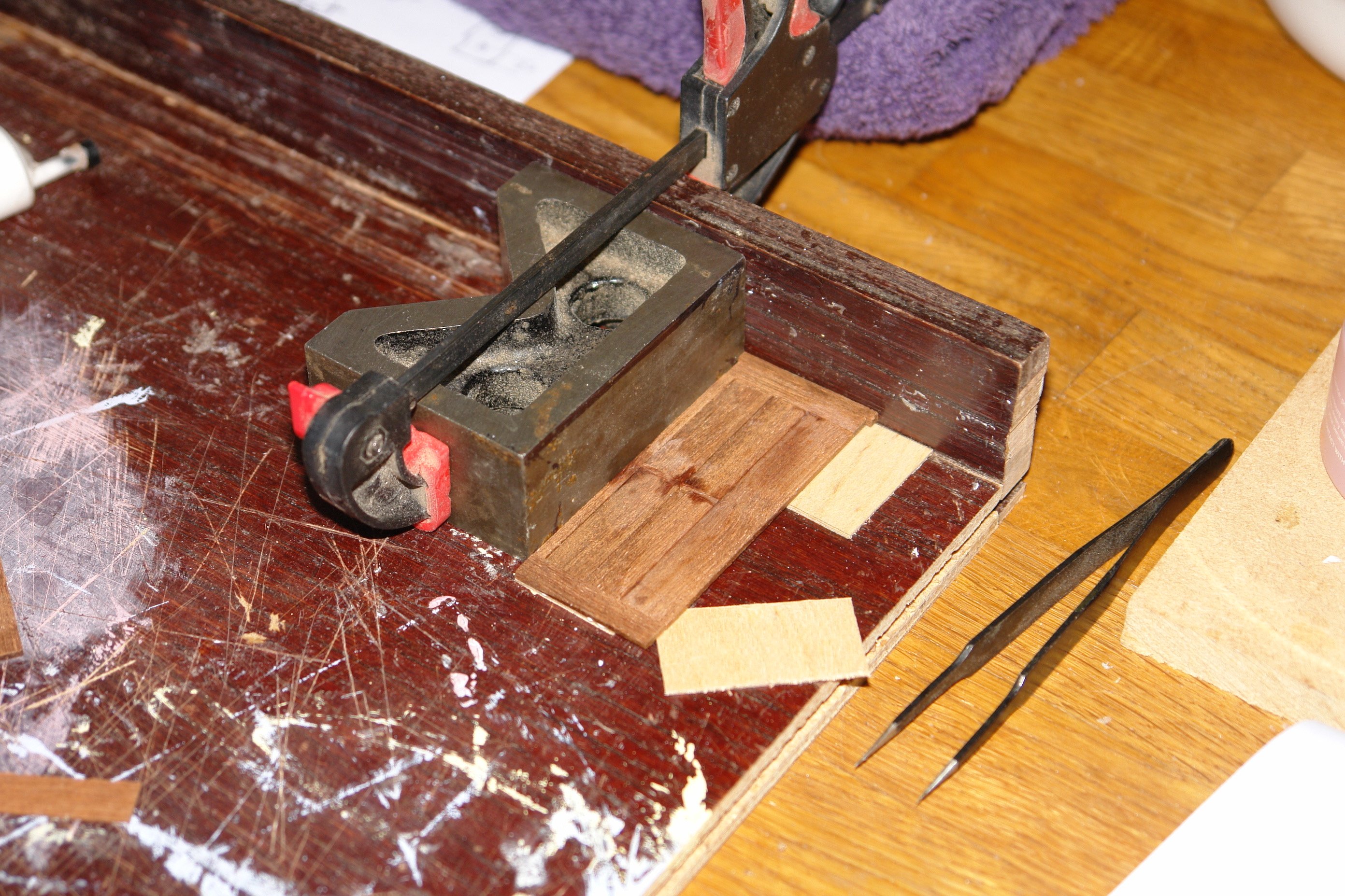

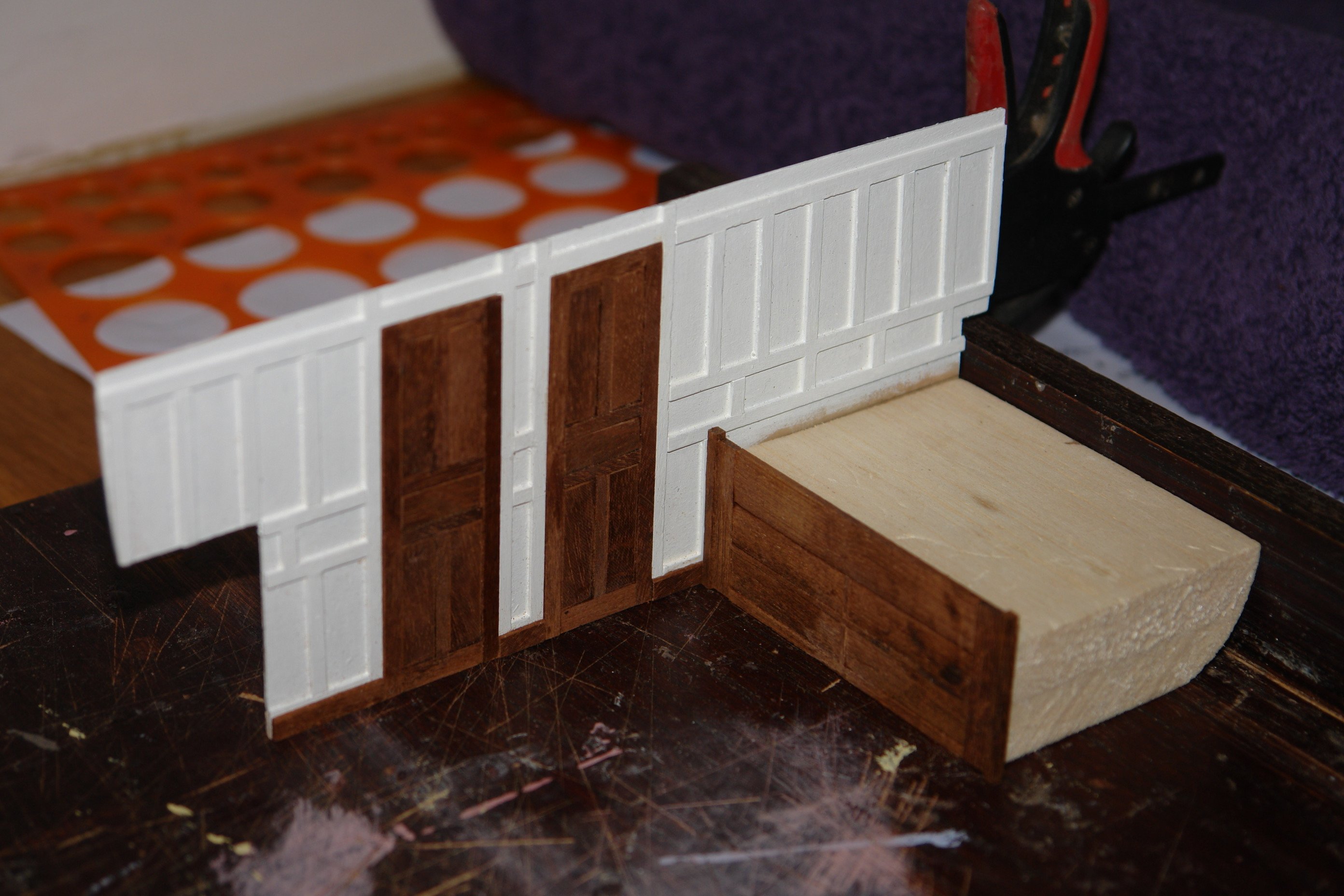

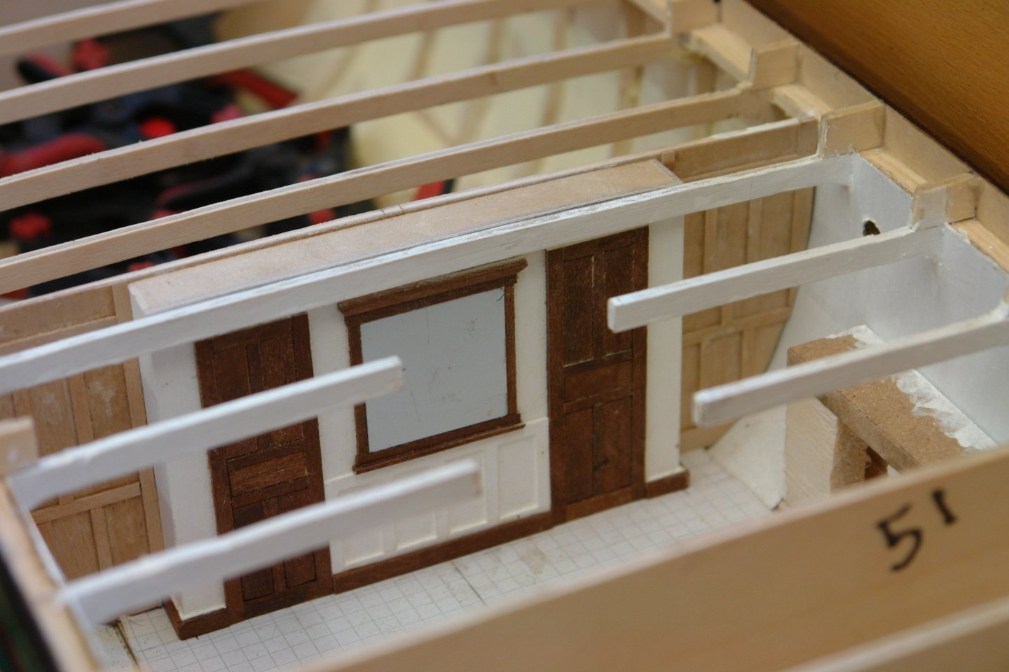

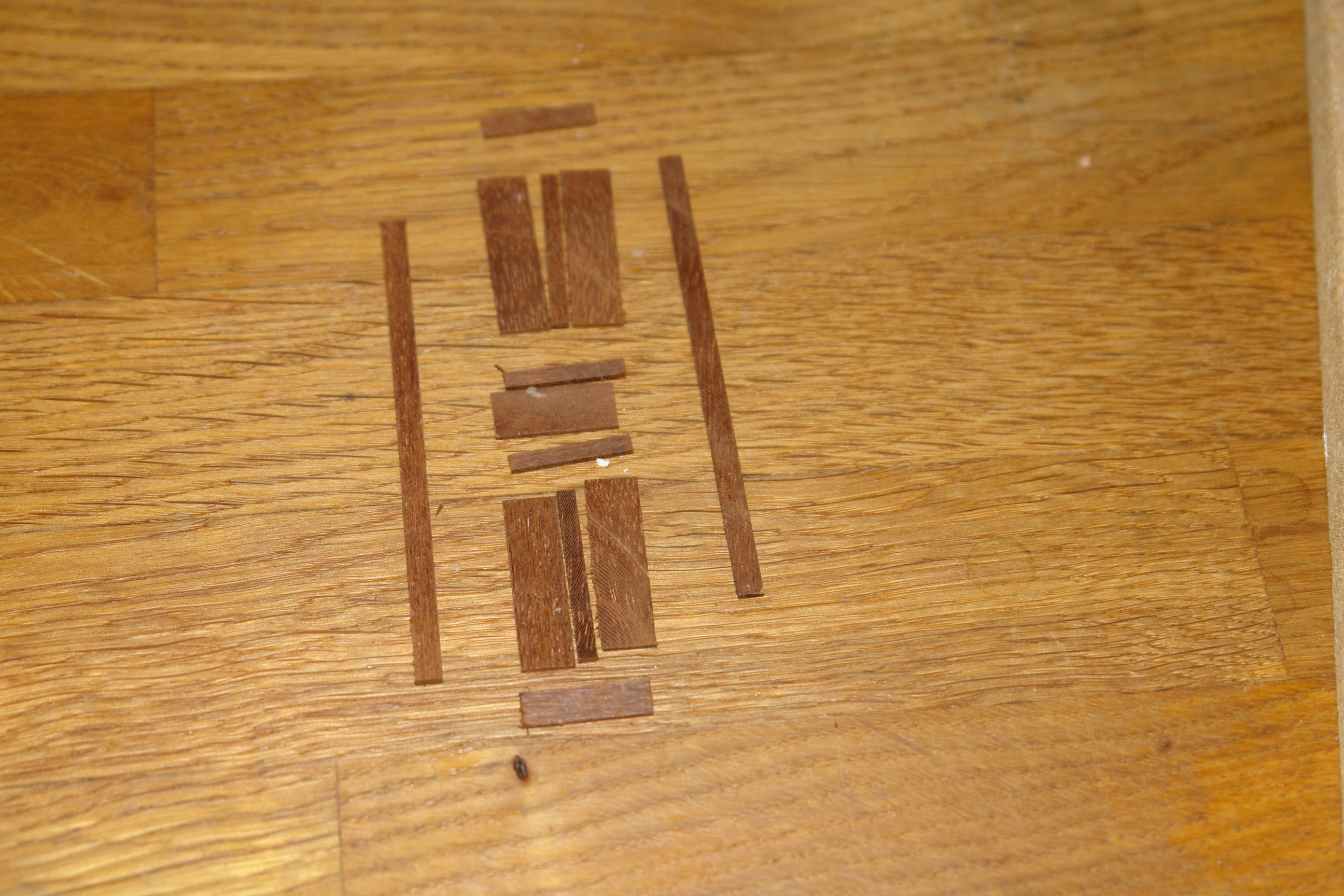

I started on the owners cabin by making the 4 doors 3" x 1" overall. The panels are .03" thick and the framing is .04"

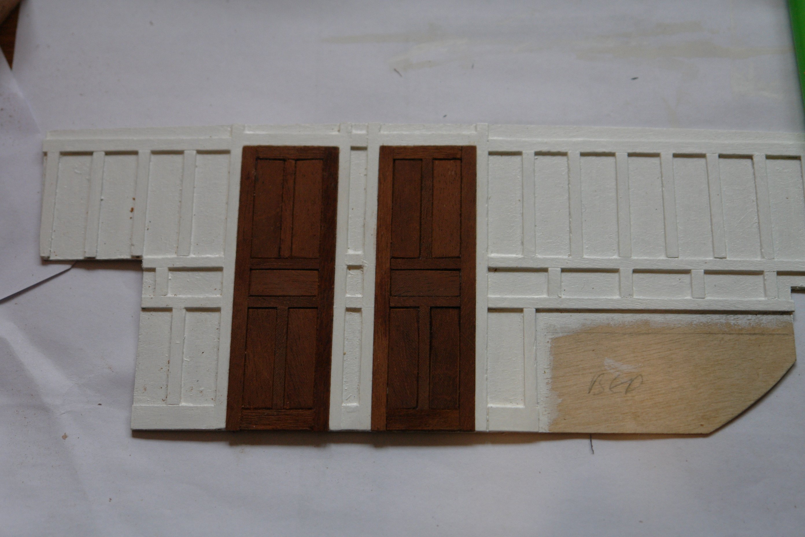

The full height locker wall was attempted first shown below with the wall paneling done and the doors and mirror mounted. The mirror itself is a piece of aluminium.
Next the aft wall of the cabin. The right hand door is the entry door and the left hand door accesses the en-suite facilities. The wall paneling is all made from 1/32" birch ply painted with acrylic.
Then a start was made on the double bed. I construct items like this against a right-angle corner to keep things square. The side panel is glued on to 1/32" ply.

Back to the front wall with the port and starboard section of wall paneling temporarily in place.

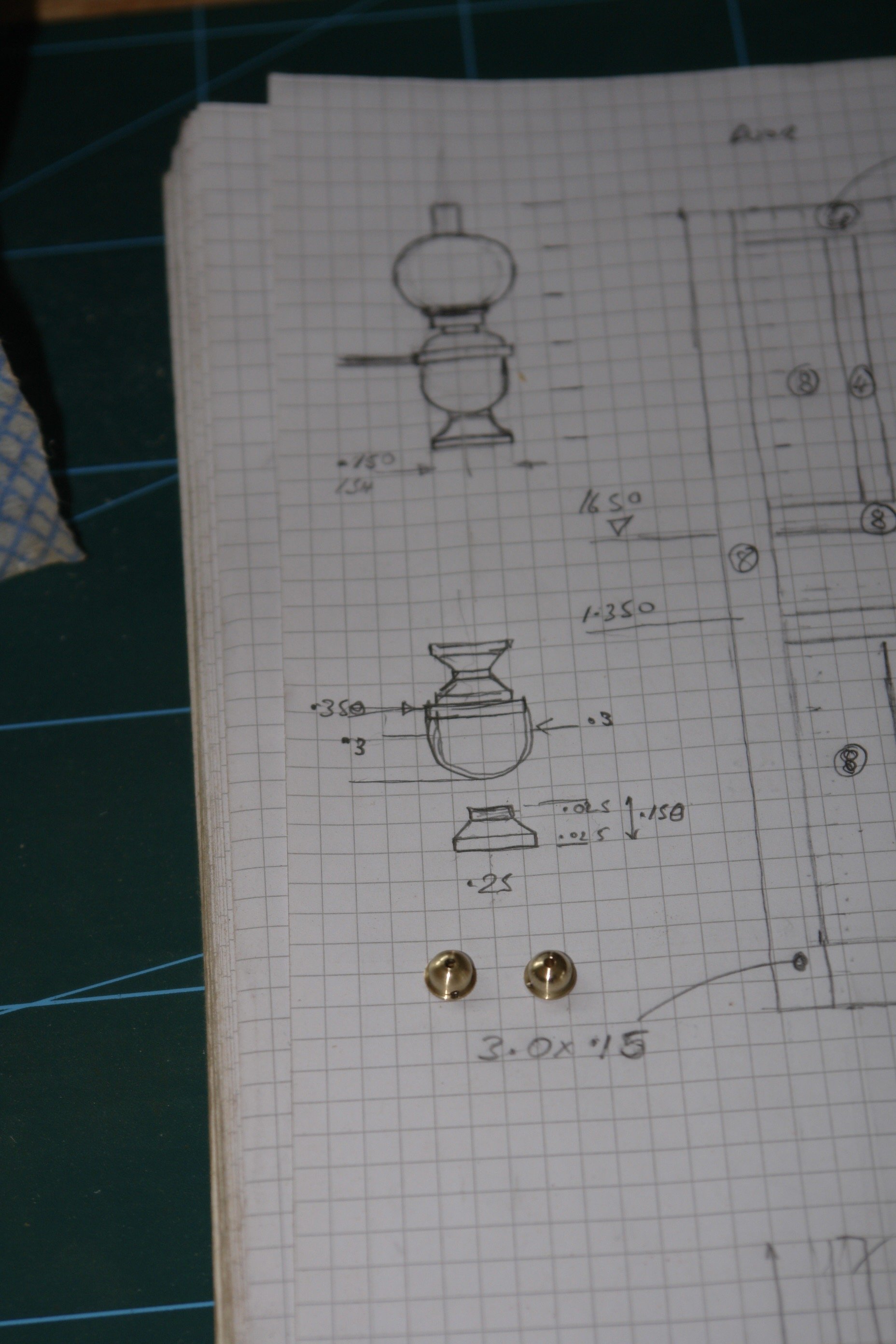

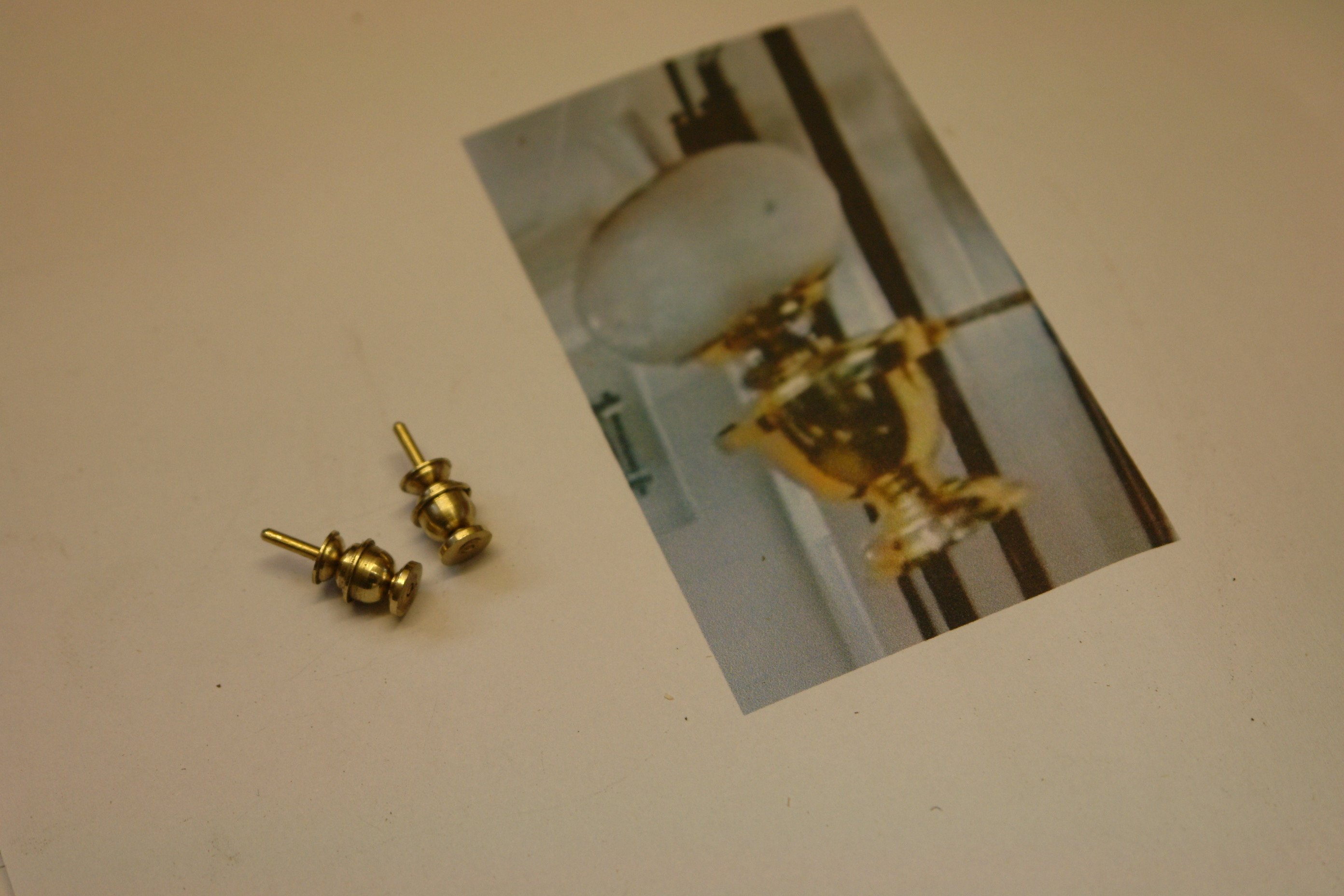

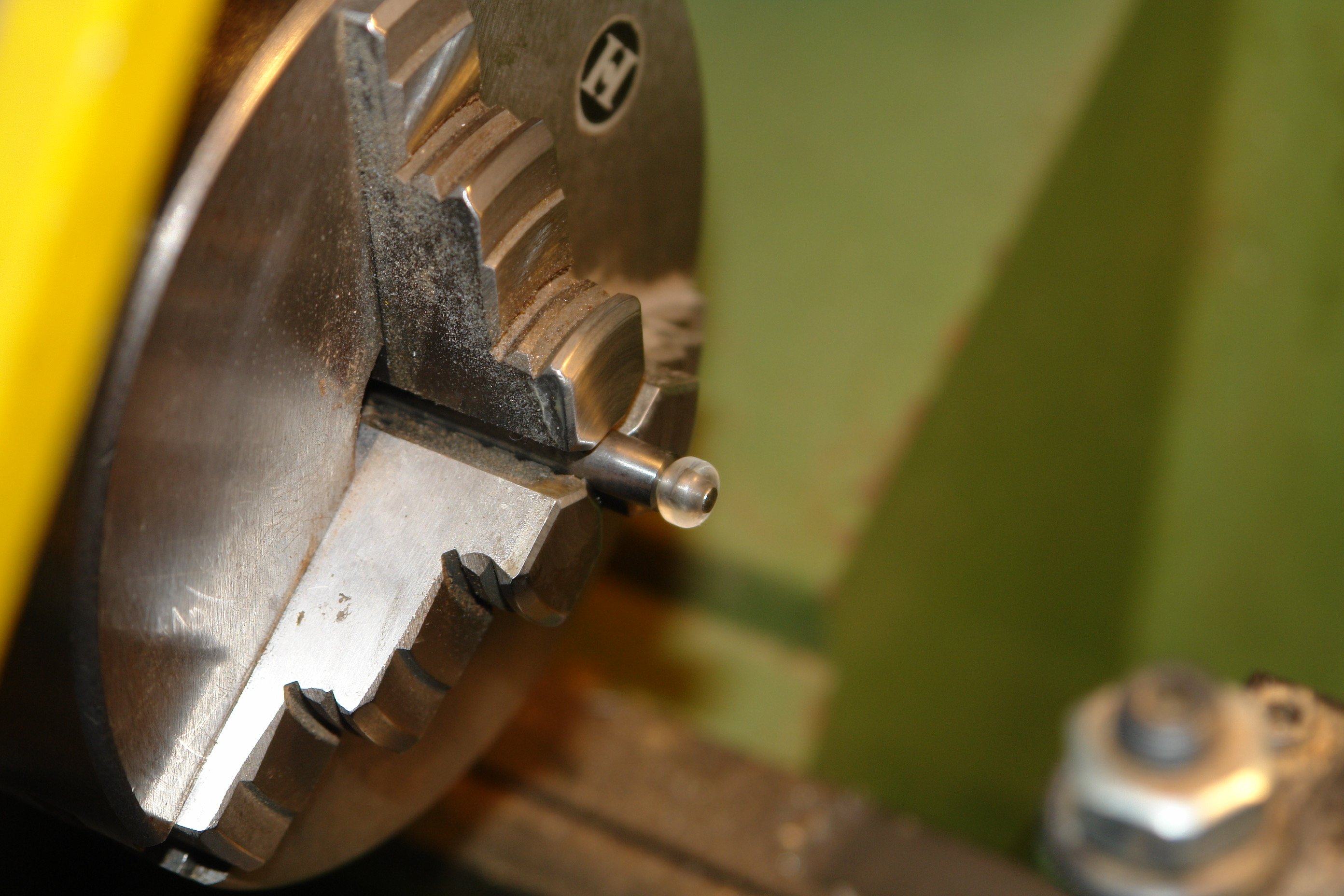

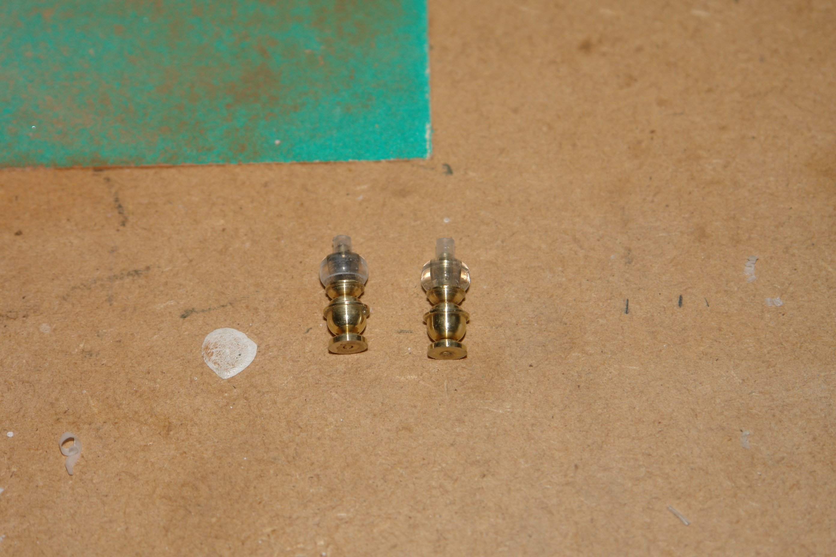

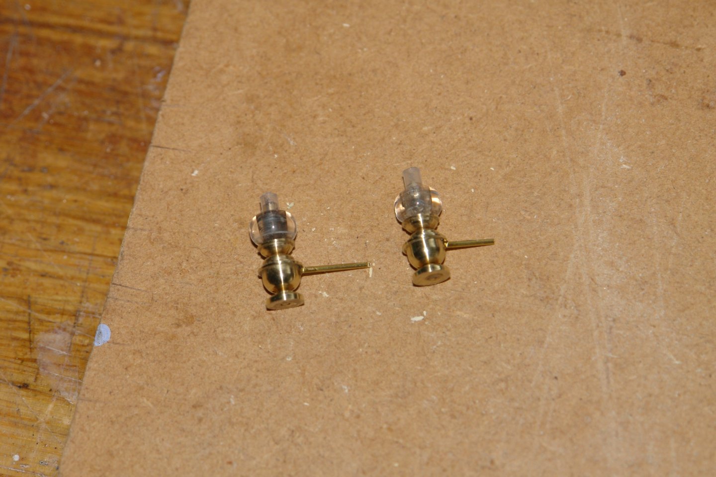

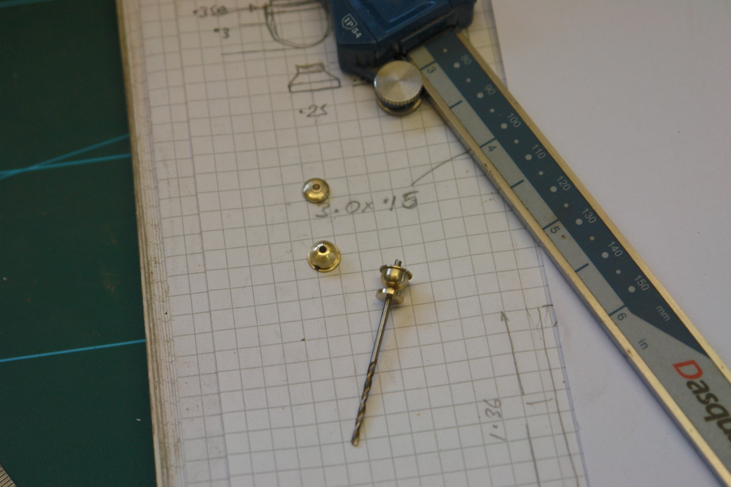

Two nice imitation brass oil lamps are mounted between the doors and the mirror - see earlier photo. The photos of lamps are a bit fuzzy so I have a done a bit of interpretation.
I decided it would be easier to make them as a series of discrete vertical sections. The drill in the next photo is .04"
The shades were turned from perspex and then polished.
DSC03342.thumb.JPG.cadab54f5e92df0ef3543762ad4b48b4.JPGDSC03343.thumb.JPG.0af2261a19fc25298496865e0cb7da10.JPG
