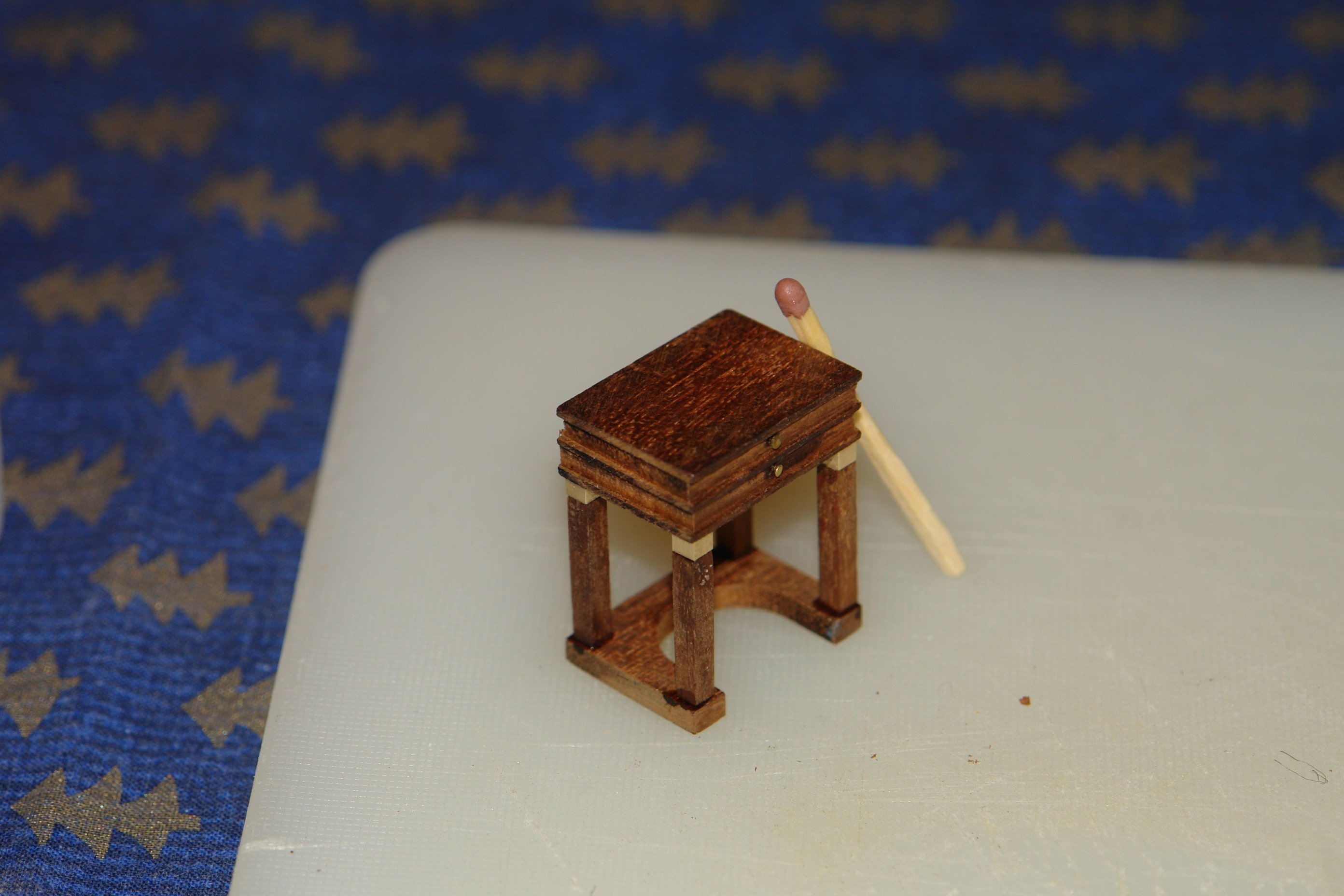

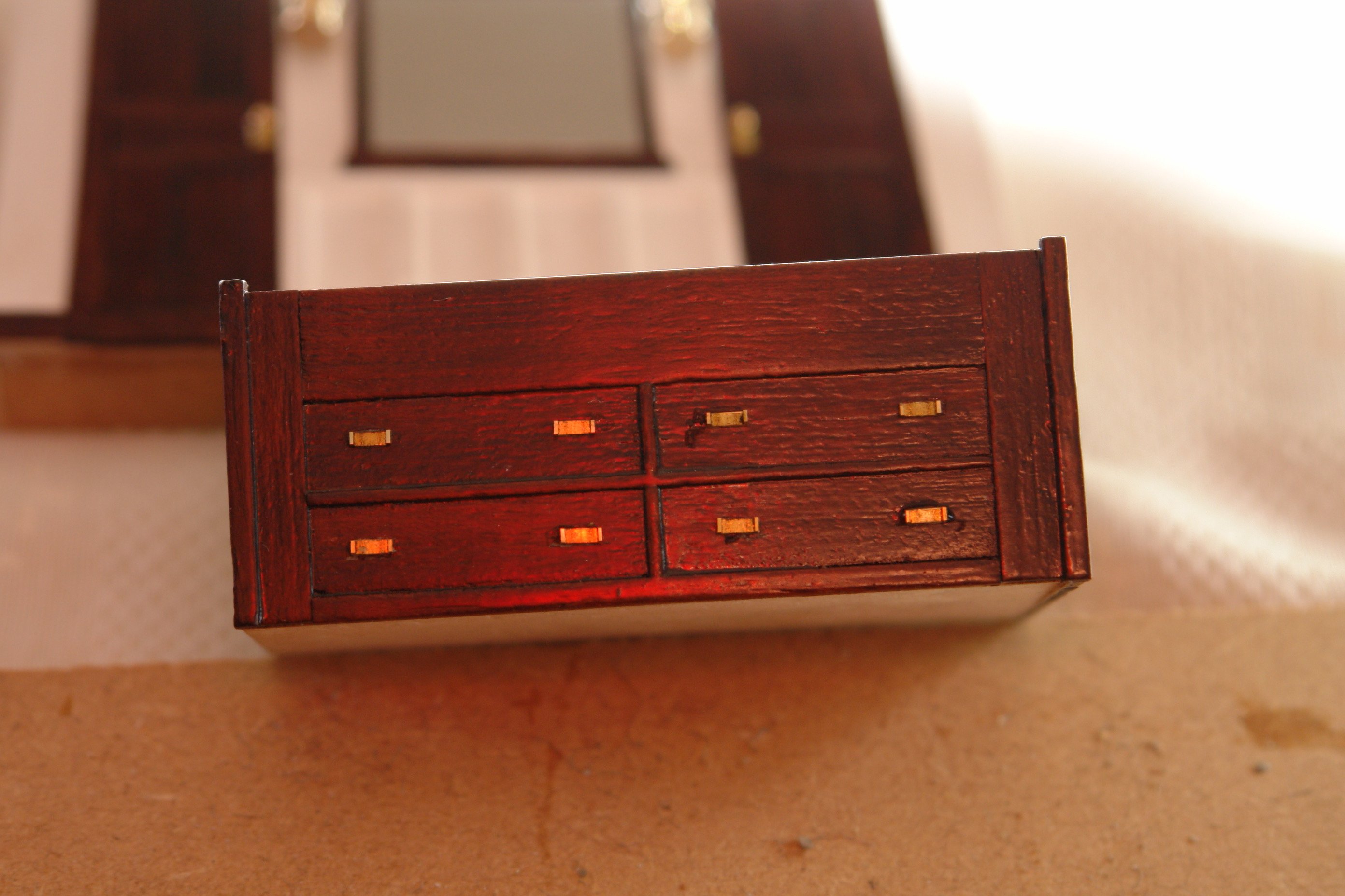

There is a nice little dressing table between the lockers on the forward bulkhead.

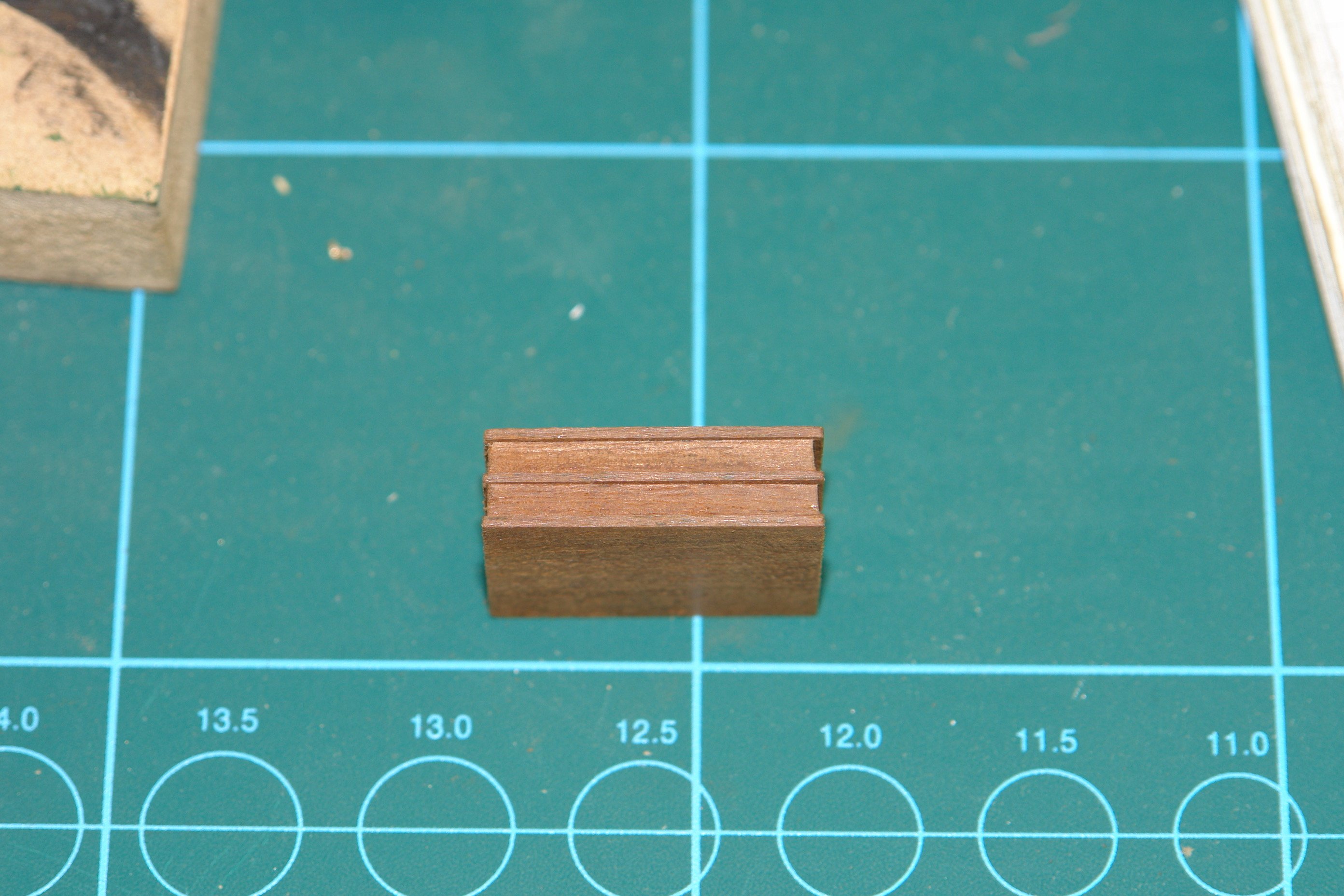

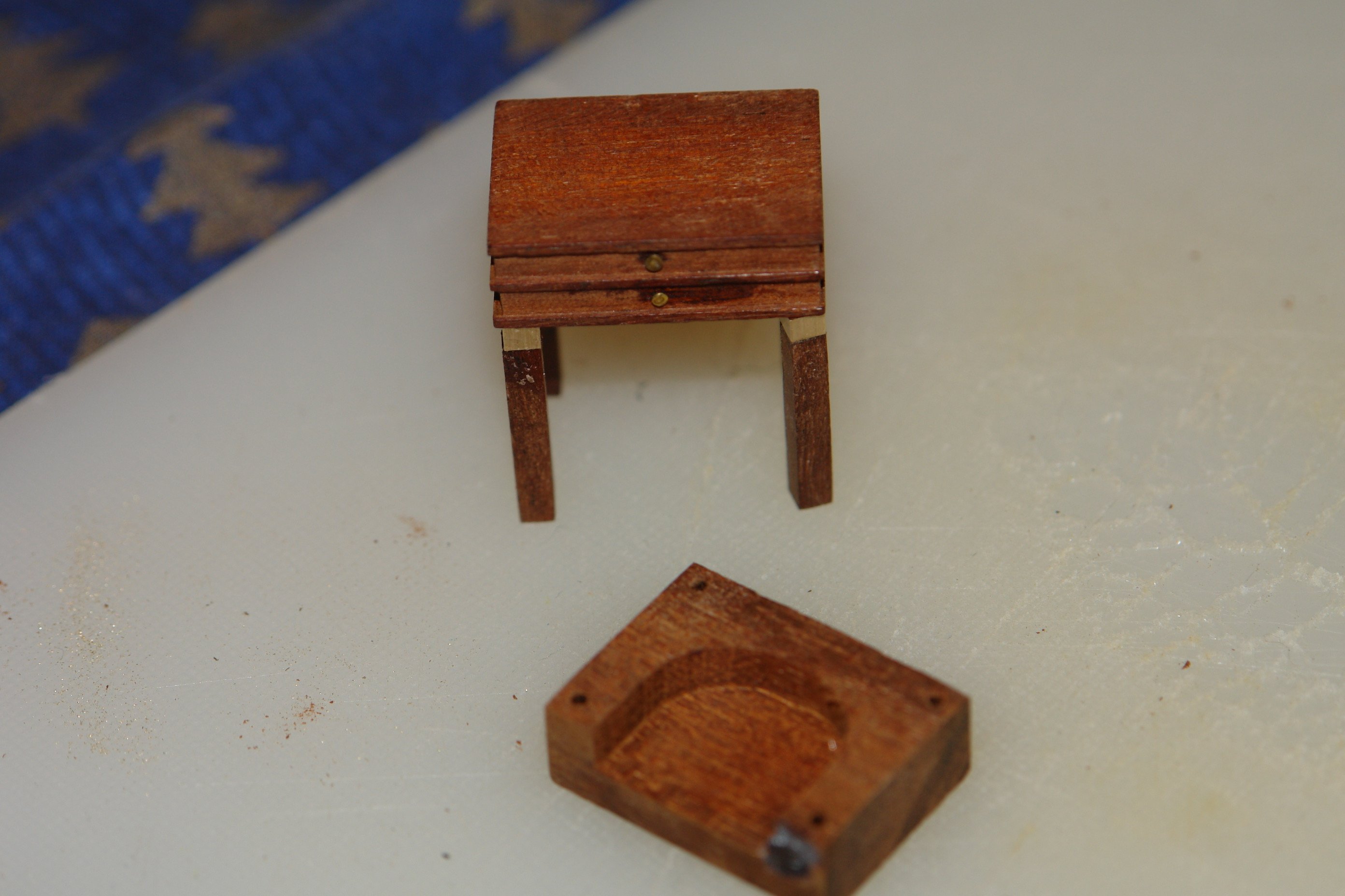

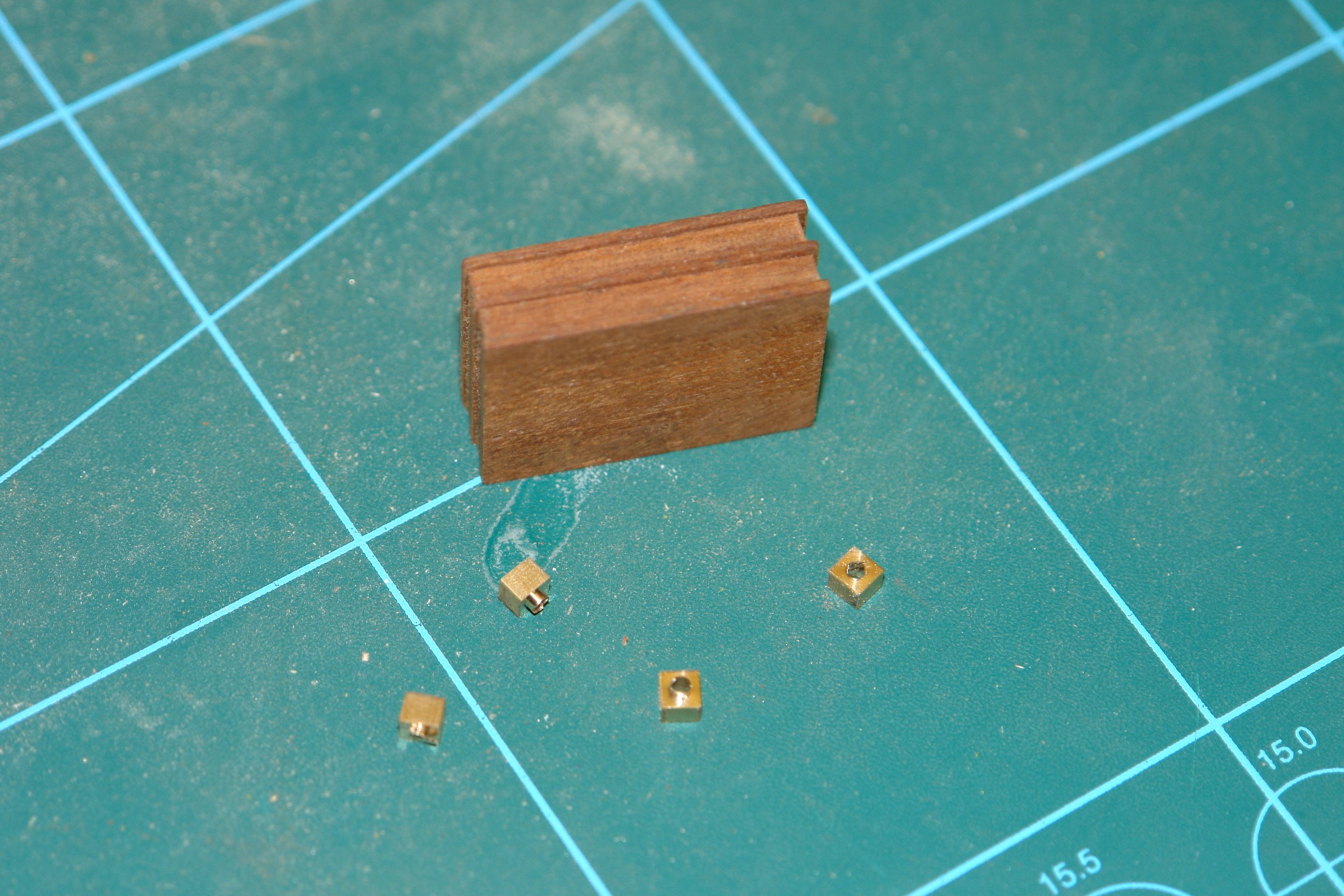

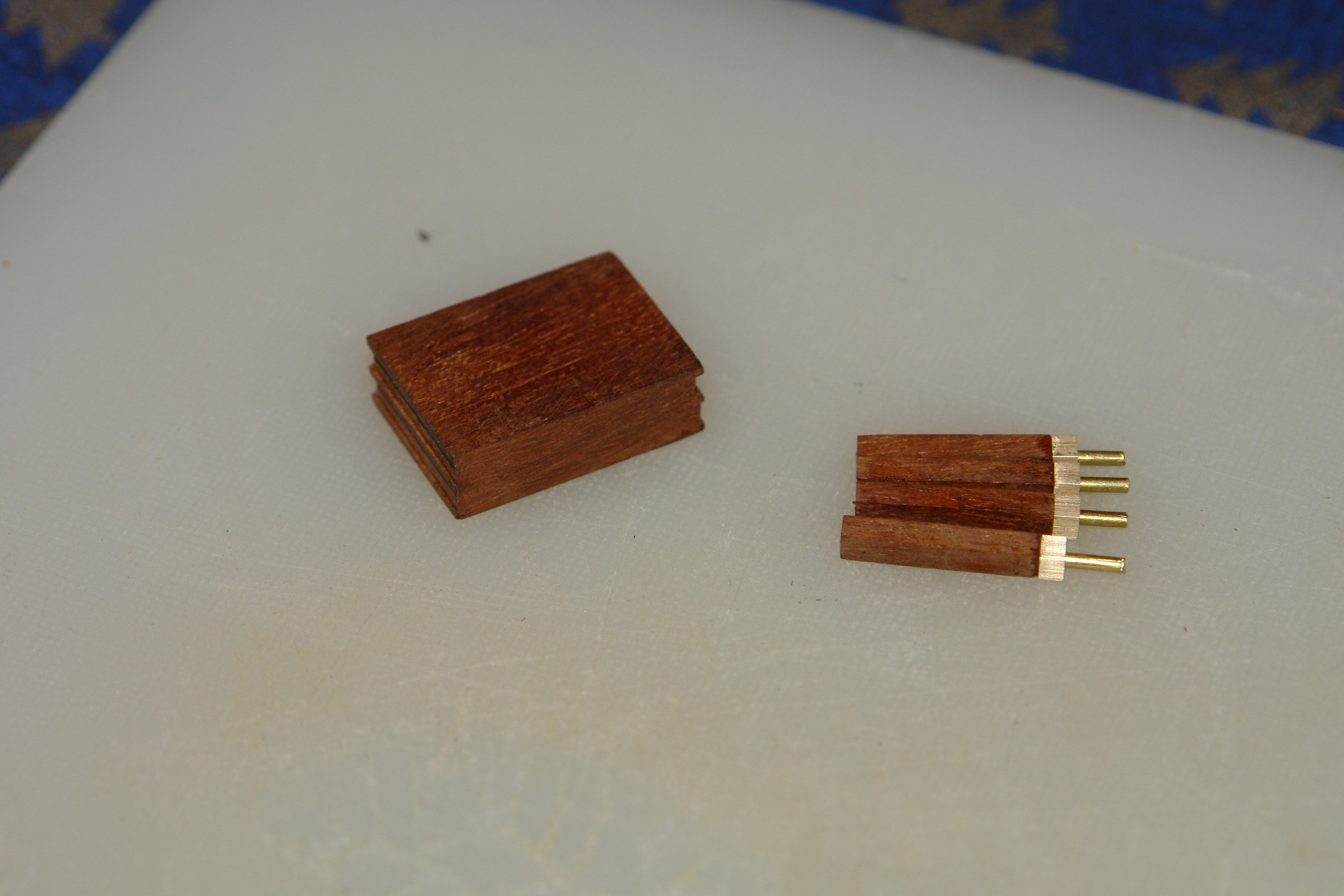

I started with the top / draws milled form a solid piece of mahogany.
The legs have a bit of brass work.
The base is likewise milled from solid.
the handles are brass pin heads.

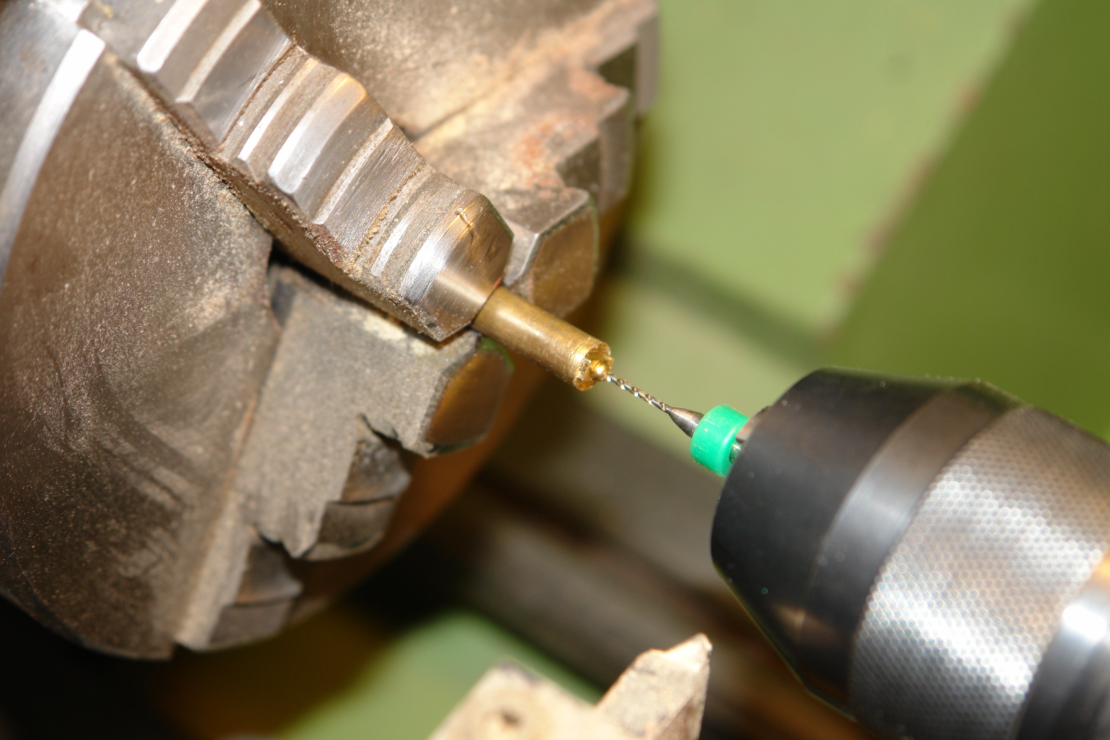

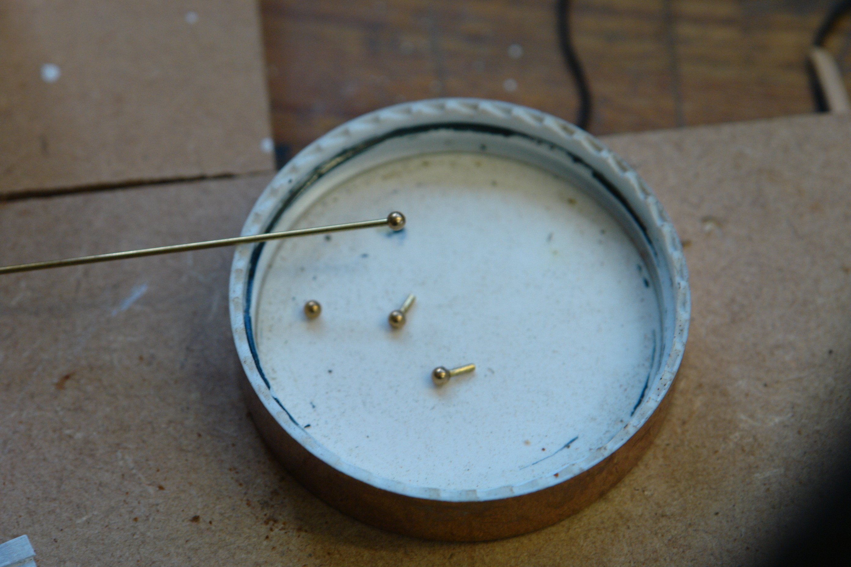

I needed door handles. I had some 0.1" brass balls but these need to be drilled to take a shaft. I put  piece of brass in the lathe and centre drilled it to form a cone. The balls were glued into the cone and then drilled with a .040" drill.

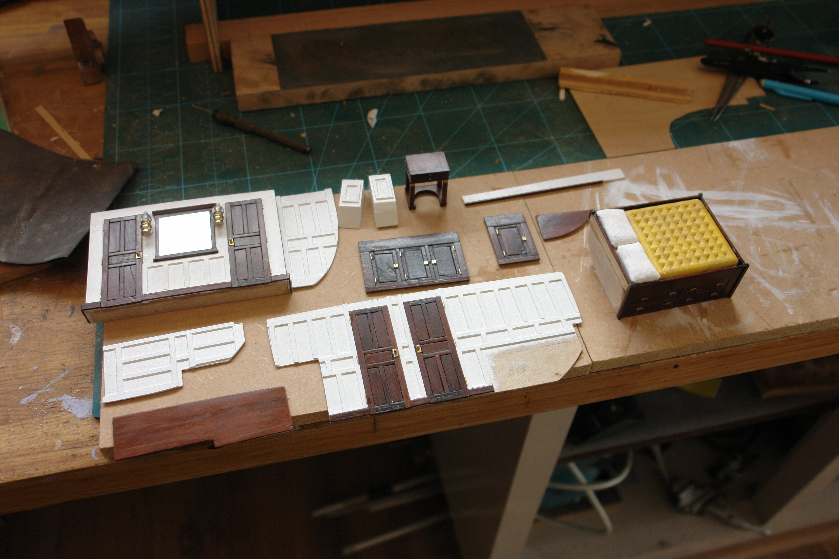

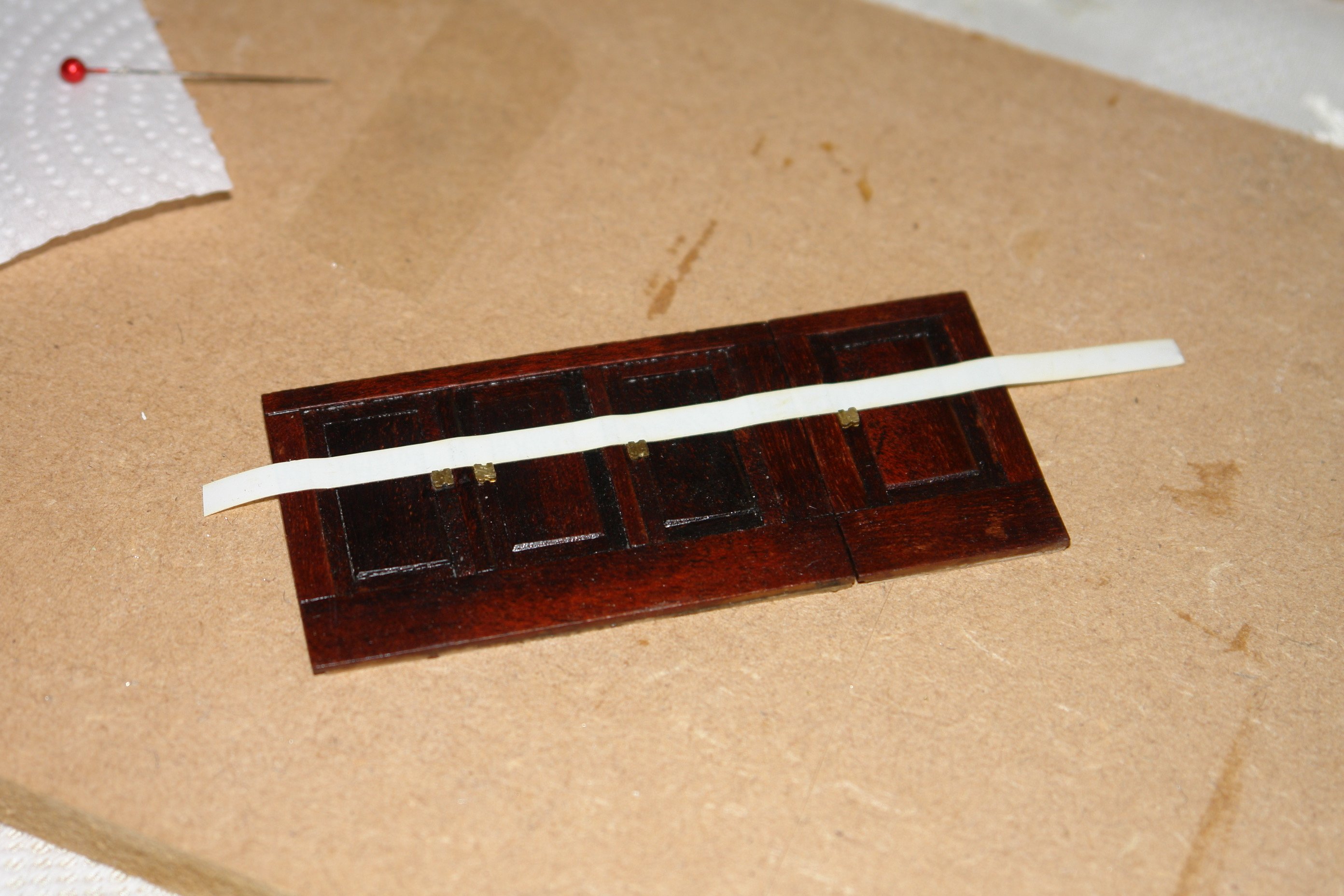

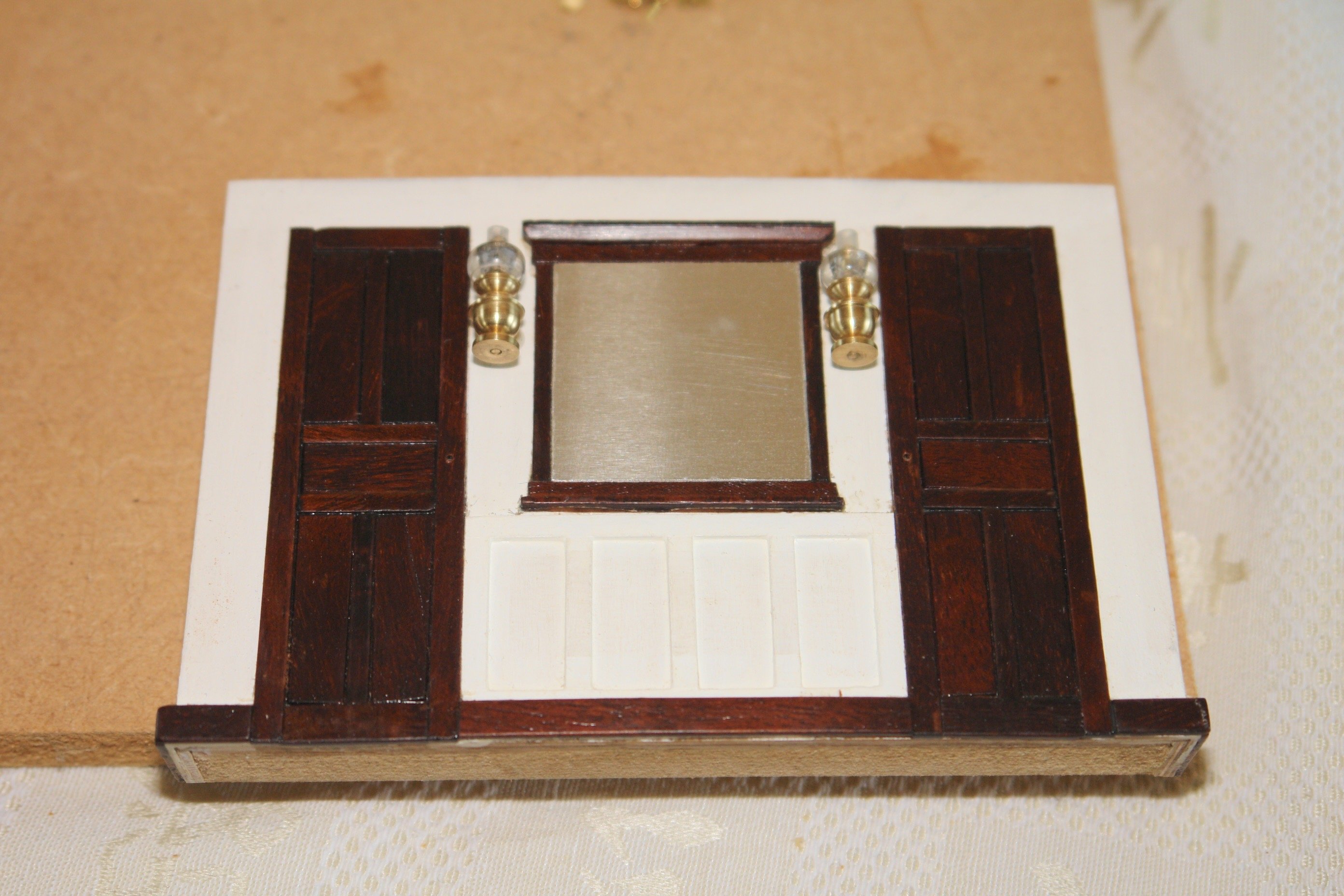

I then got on with the rest of the panels. The bed has various draws.
And there are cupboards on the starboard wall.

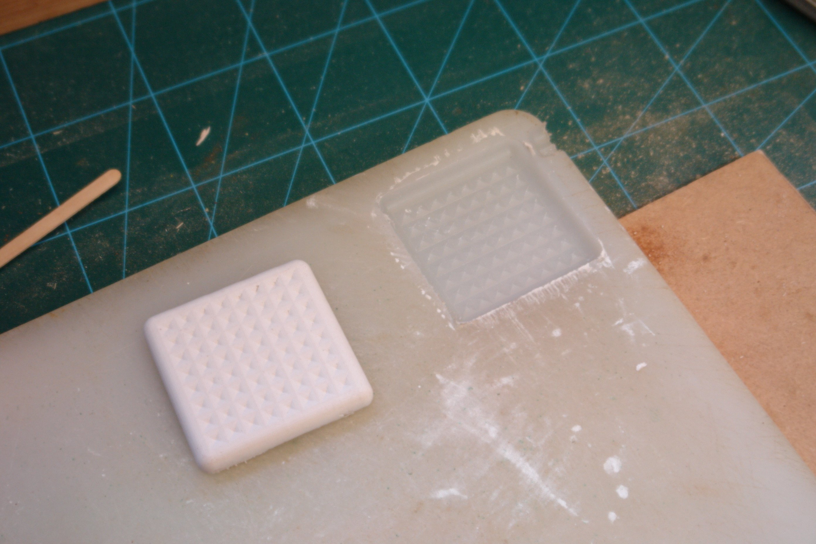

The bed has a quilt but I am simplifying it. I keep reminding myself that most to this will be hidden below deck with only a very small skylight for viewing. I made a mould and cast the quilt in plaster.
I now have most of the bits I need so assembly staring tomorrow.

Nice cabinet-maker's work 👍🏻
I gather you milled the mould from some plastic cutting-board? Gives me some ideas, as in a future project I would need some deep-buttoned cushions ...
Eberhard
Yes - an old kitchen cutting board, nice and flexible to ease extraction. Fabric mesh embedded in the paster to prevent breakage while extracting. The board was cut with a ball nose end mill.

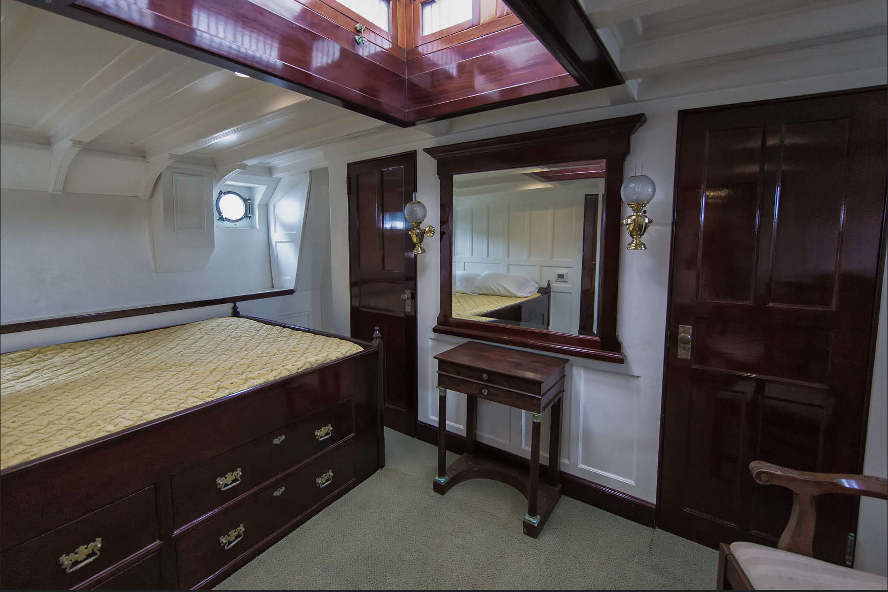

One of the things I needed to sort out was the carpet. The same carpet is used throughout the owner and guest accommodation.
The next picture is blown up from one of the accommodation photos.
The carpet is olive green. Fortunately I had a cunning plan.

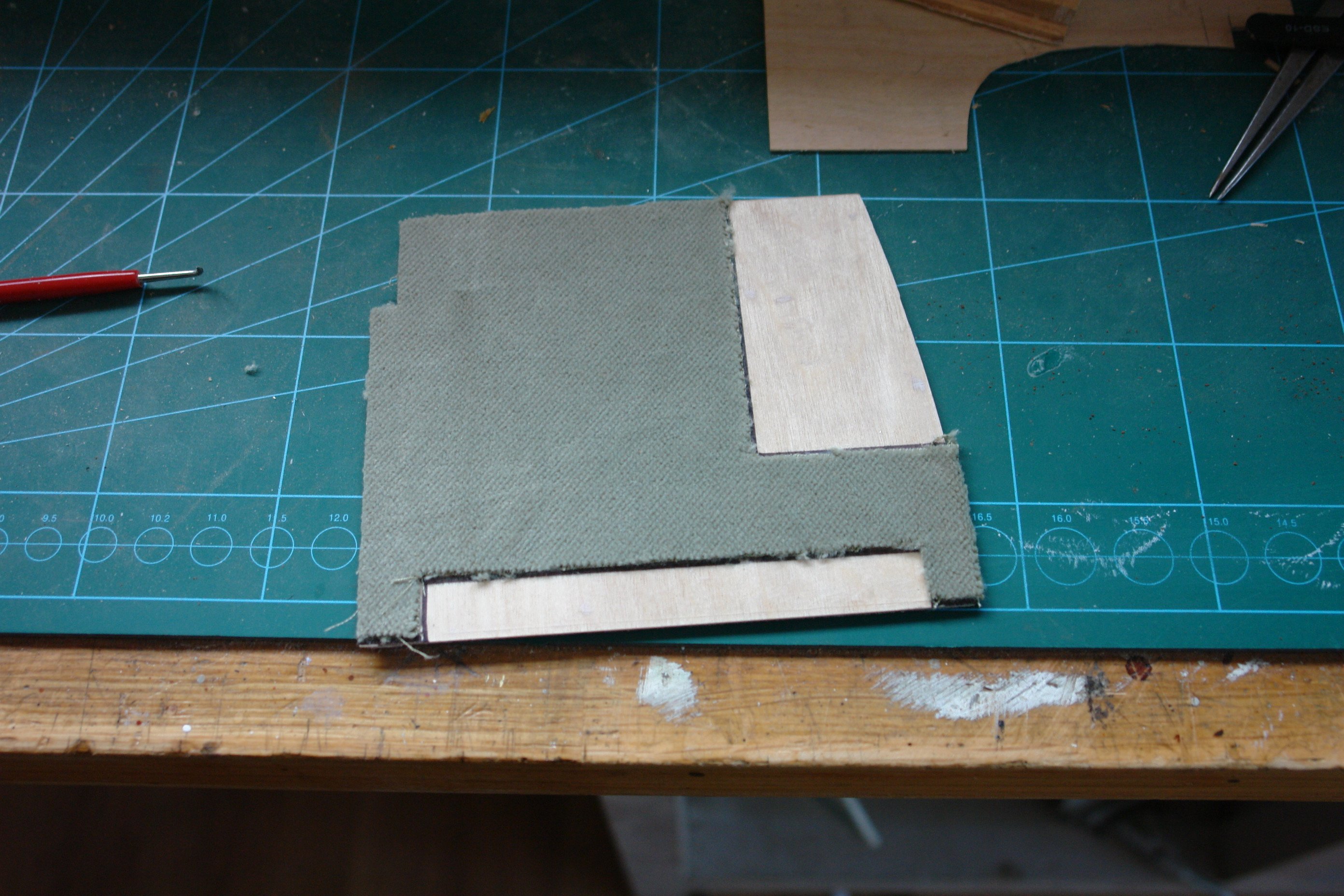

The next photo is of a family heirloom. The chair is part of a dinner table set which was owned by my wife's grandmother, my wife's mother, my wife and now my daughter. So it is on its 4th generation. It could be older but no one can remember that far back. It is looking pretty good, particularly as I last re-upholstered it over 40 years ago.
Now you might think that finding fabric from a job completed 40 years ago was going to be a bit problematic. Then again you don't know my wife. I went to her beautifully organised fabric box and there it was, second piece from the top. Locating it took about a minute. Sometimes I just get lucky (my wife claims it is called organisation).
I carpeted the owners floor. He was delighted with the colour match and texture. The fabric is Dralon, so it should be hard wearing. 😀
