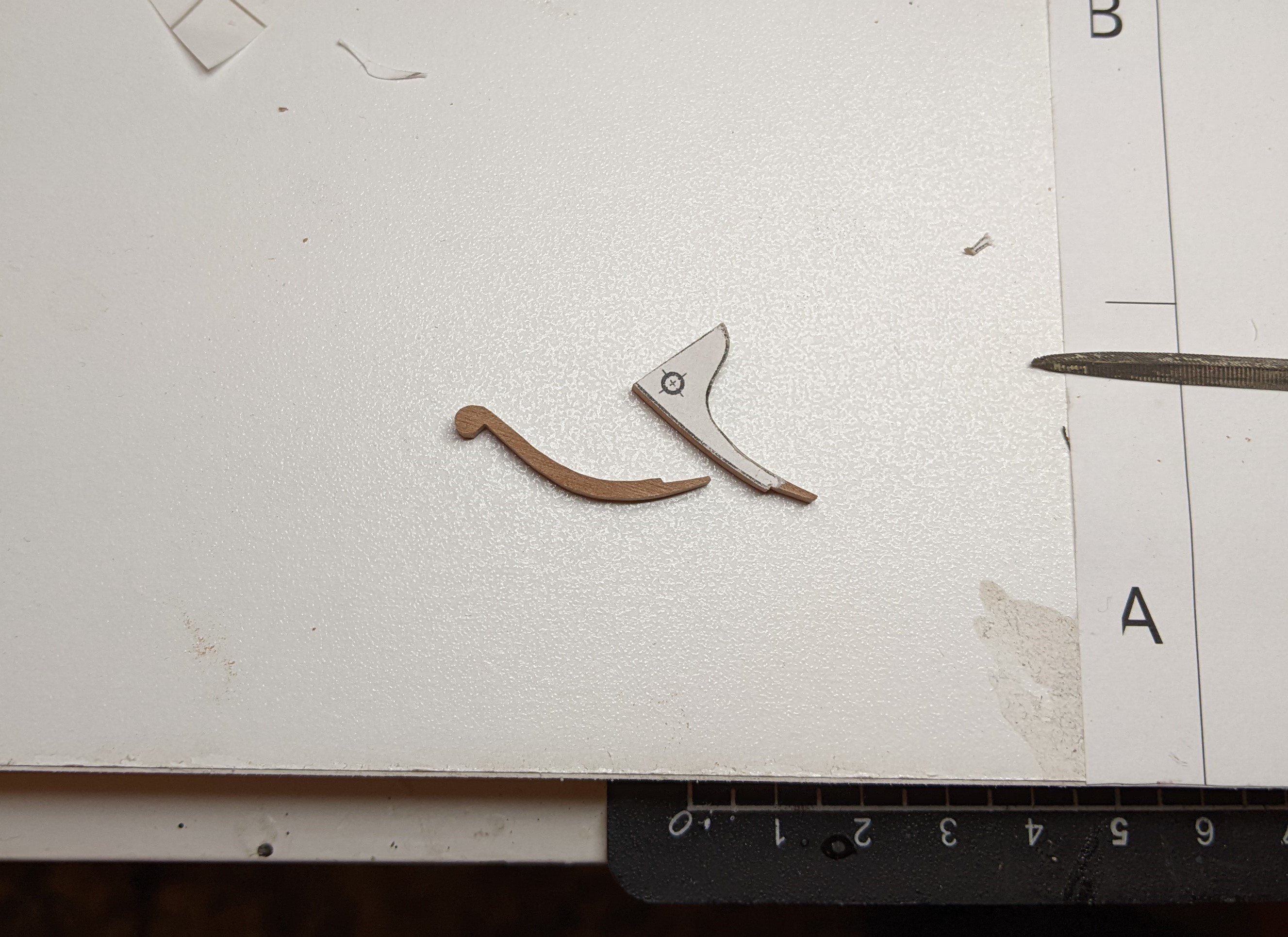

Another minor update as I actually have some progress to report (or at least in this case a relatively successful test).
On the scroll saw front I am getting more comfortable, and about half the time I get my cuts right on the line, but then all of a suddent I find myself wandering. In particular, certain types of curves I always seem to wander first to one side and then the other.
I have assembled my first completed iteration of the knee of the head and painted it. I discovered that to some degree firm clamping as you are assembling can mitigate some of my failures on the cutting of the joints. Also as a proof of concept my attempt to try and show the joints through black seems to have worked. I am not entirely happy with the effect, but for a first go I am pretty pleased.
I mixed the glue used in the joints with white ink so that when I painted over with thin layers of black, the lighter colour shon through. The effect I am aiming for is more the upper joints (the thin harder to see ones) than the lower joints, but that will be fixed by making sure my joints are tighter.
Note I did not bother with the cutwater and the waterline is only the approximate location. This was just a proof of concept test.
Now to see if I can do another one, this time with tighter joints.

I have also been doing more test work on my stem. You can see my fully constructed experiment here in place against the center bulkhead. Much like the upper parts of the knee of the head, I have been experimenting with using brown ink (as opposed to the white) to colour the glue. It seemed to mostly work well with two key caviats:
  1. My joints were still not good enough
  2. I need to seal end grain before gluing the joints as sometimes the colour bleeds up through it
I am going to do at least one more test head assembly using my scrap wood to see if my ideas for correcting the issues experienced in this version work.

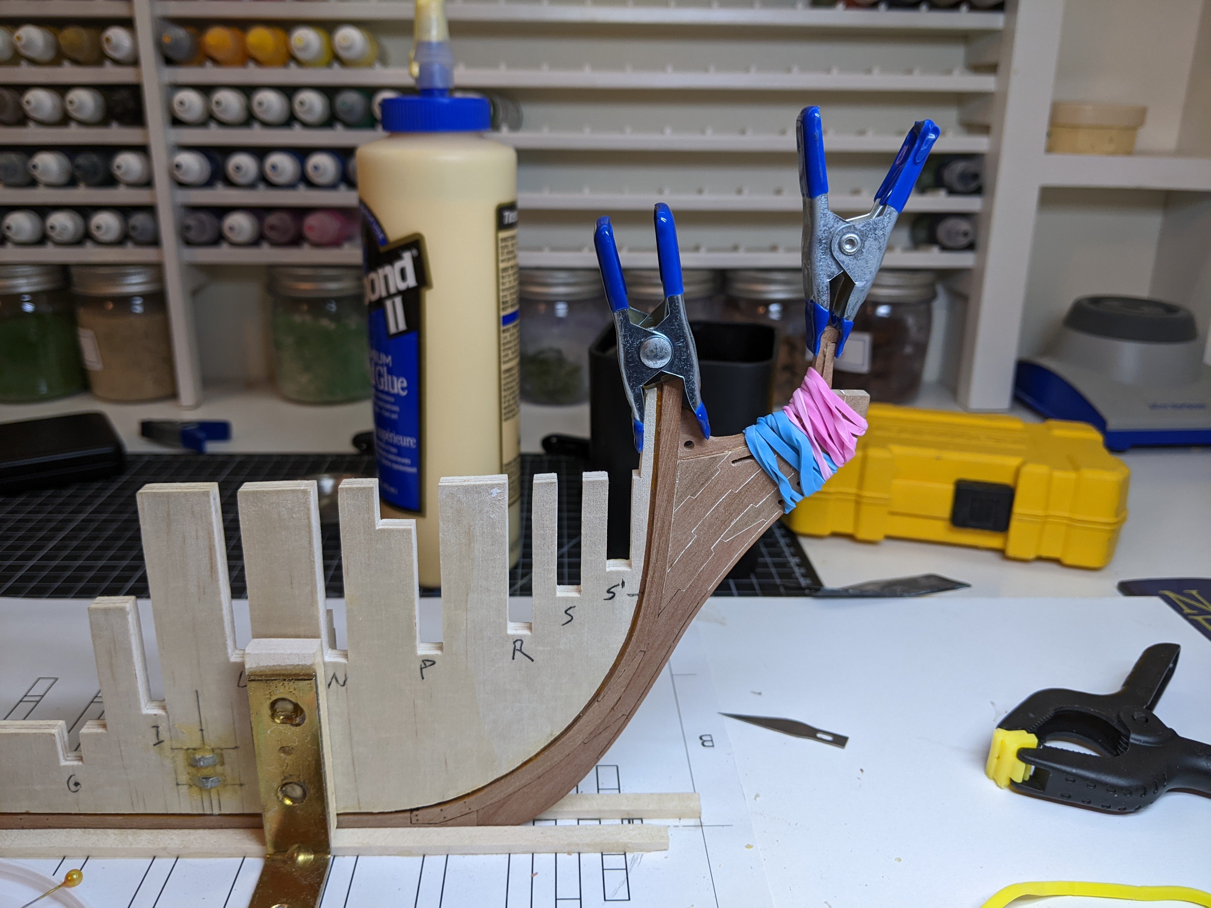

I figured I would give a small update as work continues in the background with more test pieces. I am starting to get better with the scroll saw so only minor cleaning up with the drum sander is now necessary.
I also continue to do more test joint for the knee of the head. With the below example I think I am finally starting to get close to a satisfactory result. This is test article #5 and hopefully the next knee of the head I show you will be the final thing. You can see I also have been experimenting with managing the transition from painted area to unpainted area. The painted areas need white joints to shine through the black paint, but the unpainted areas need the dark brown joints to simulate the caulking.
I have 14/28 bulkhead pieces done so we are at the half way point with the internal structure cutting.

Very nice job! I felt the light joints stood out a bit too much on the first attempt, but they look great on the latest version.

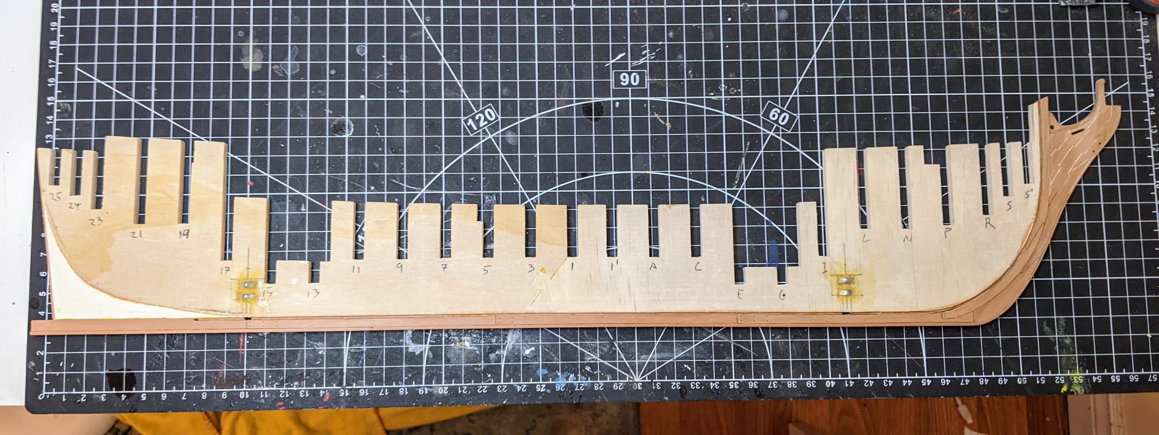

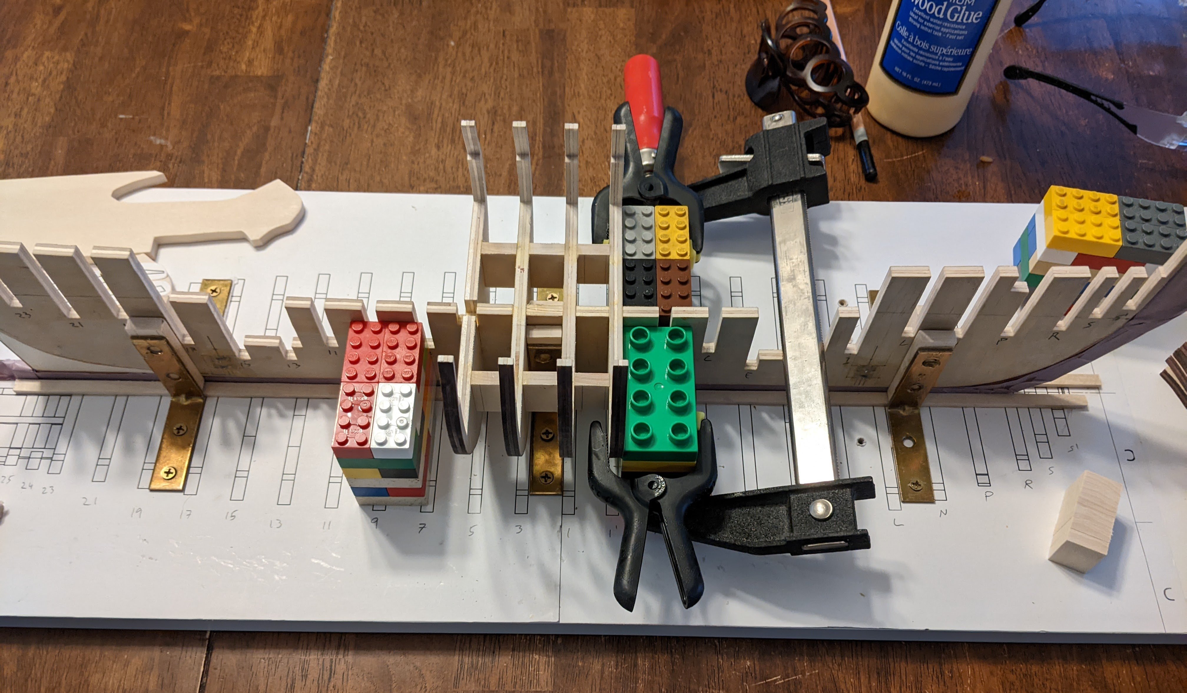

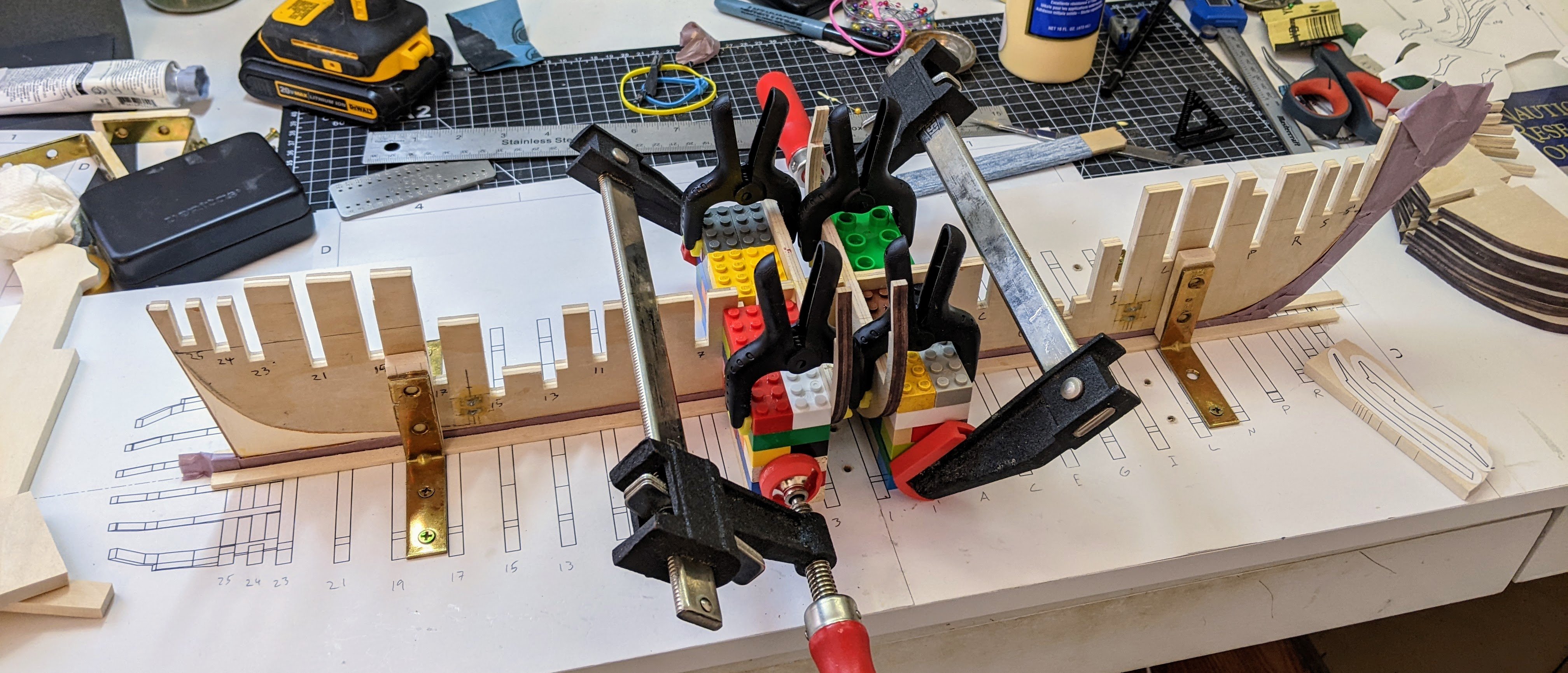

Log #16: The Build Board & Dry Fitting
I have finally finished cutting the all the bulkheads. I then had to remove the templates and rub off the rubber cement residue on them. This was actually one of those things which took a surprising amount of time to do.
Then came the rather lengthy process of checking the fit of all the pieces. I want them to be snug, but not too snug such that they exert too much pressure and cause things to warp. Also I need enough play to allow me to make small adjustments to make sure everything is square when it comes time to start gluing. I made some sanding sticks to help with the process and as luck would have it, the course one was just the right thickness such that if I could get it into the slots easily they were sized correctly with only minor adjustments with files and the finer grit stick.
Then it was time to make some brackets to hold the centre bulkhead straight while I am constructing the bulkheads to ensure there is no twisting till all my reinforcing pieces are in place. I just used off the shelf corner brackets and glued a piece of wood to them to allow them to reach over the keel clamp that runs along the build board.
And here below you can see the current status of affairs. Everything is now ready to start building, I just need to have enough confidence to start cutting the wood for the stem/knee of the head/keel. I also need to finalize how I am going to ultimately secure the ship to the base as the hardware for that will also need to be added to the centre bulkheads prior to the structure being built.
@JacquesCousteau Yes I also agree with you. It is mostly a matter of getting a tight joint. The tighter the joint, the less gap there is to be filled by the glue-paint mix and so the less visible the lines are. My goal with all of the planking etc. is to have the major structural joints only somewhat visible from 6 ft away and all the minor ones (such as the planking) to be invisible. But then when you get closer all of them can be seen. We will see how well I manage to achieve this, but that is the goal.
I am still undecided on what to do with bolt joints as convention is often to have them very visible, but in real practice they were covered with wooden plugs so would not have been that visible. Similarly I have not yet figured out what I want to do with the horseshoe and fish plates. As far as my reading has gone they appear to have been made of copper, but black is a much nicer colour to show them off.
So many decisions and we are getting closer to the point where I can’t put them off much longer…

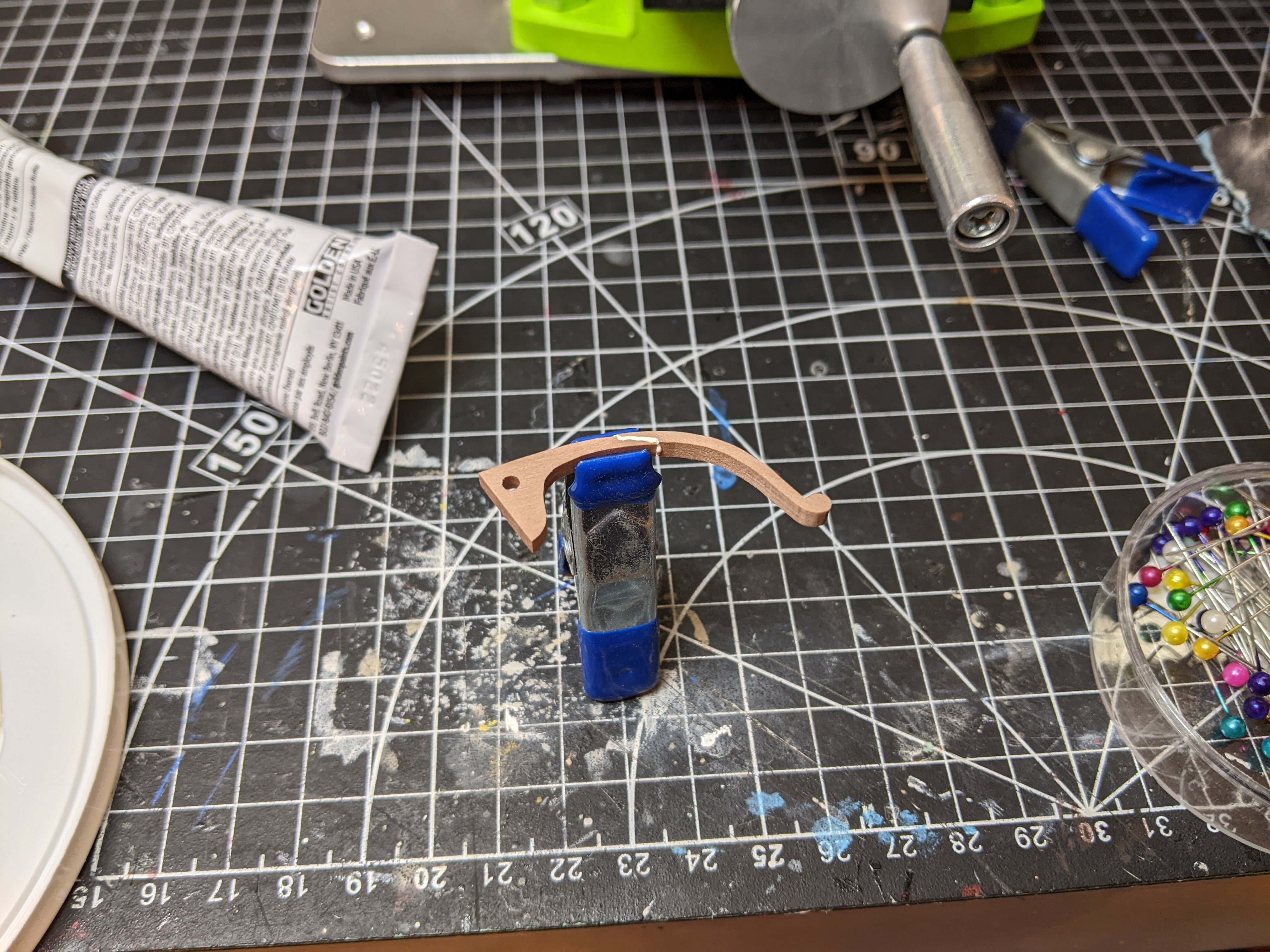

Despite my previous promises that I was done with test pieces, I continue to make more of them. The problem is that every one I do is just a little bit better than the last one. At some point I need to decide they are good enough, but knowing when to make that step is hard when you are a perfectionist. Below you can see my latest test piece on the left along with an earlier one on the right.
You can see how much thinner the lines are on the newer one. I am using my dark glue mixture so I can clearly see how big the gaps are on these tests. I have been focusing on just practicing this particular joint as it is the most complex one in the knee of the head construction with 2 scarfs and a number of curves.

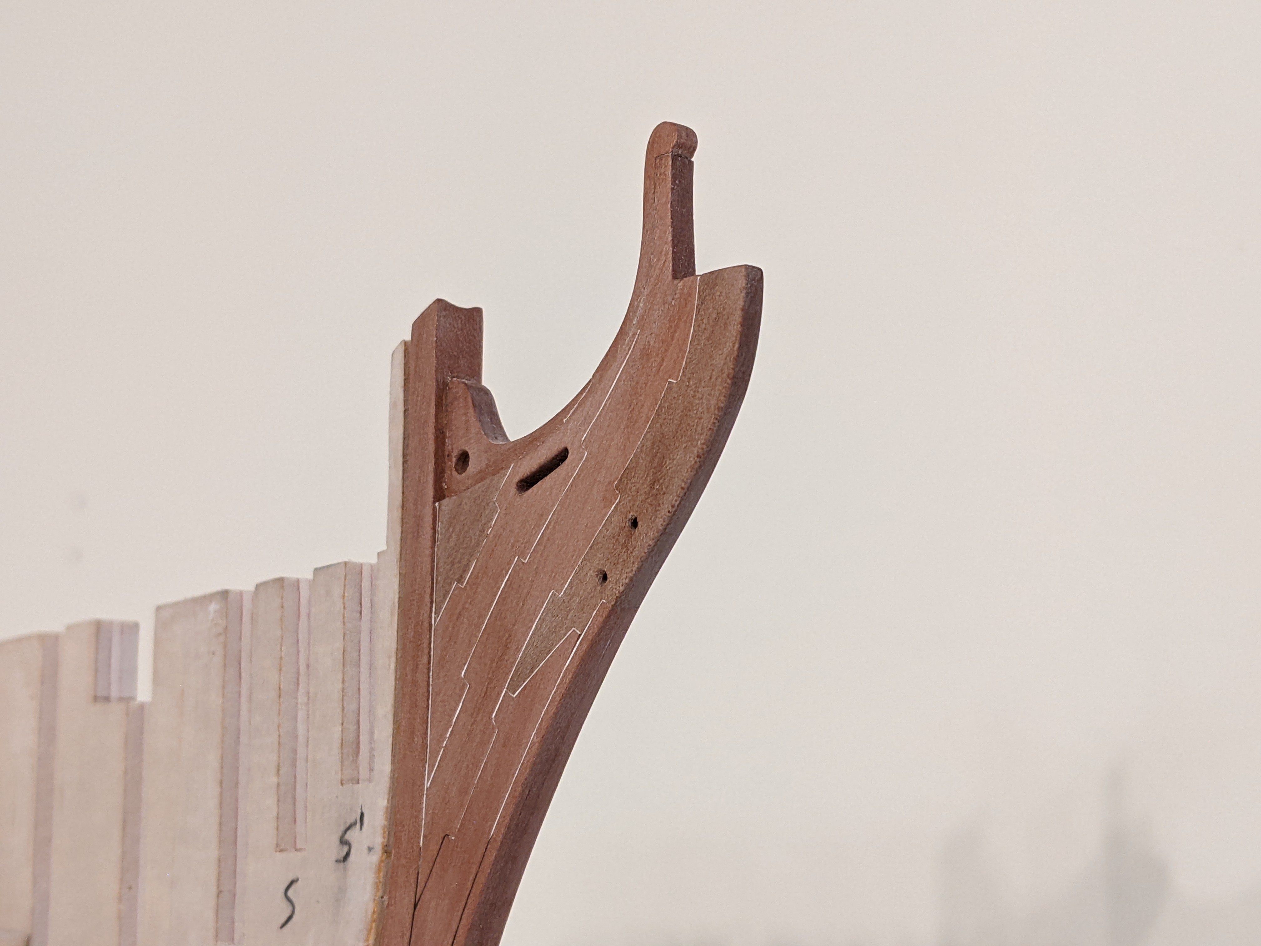

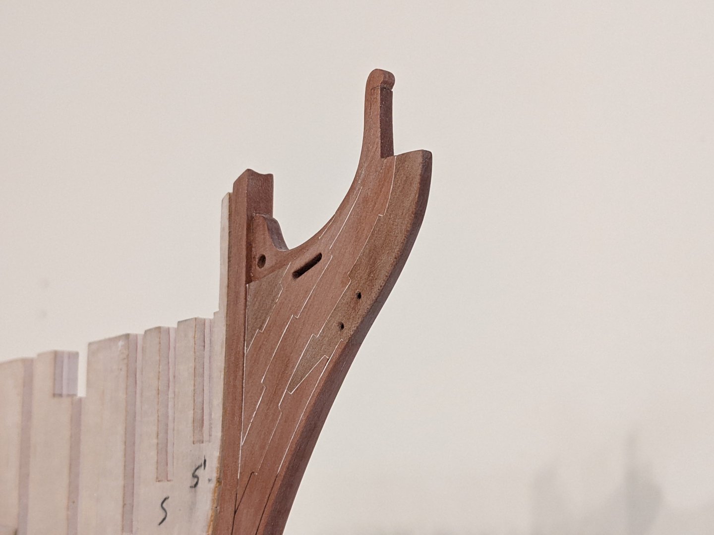

Log #19: Beginning the Knee of the Head, Stem and Keel
I have begun work on the knee of the head, stem and keel. Step one was to cut the parts out using my scroll saw which I have now found I can be pretty accurate with if I go very slow and use magnification.
I also discovered that it is best to glue the pieces as I go. This allows me to adjust the fit of every new piece to match what I had previously cut. As previously indicated, I am gluing the pieces together with a 50-50 mix of heavy body acrylic paint and glue. You can see in the below picture how the glue spills out, but due to it being so thick, it does not stain the surrounding wood. The lines still look a little rough, but that is just due to the fact that even very small discrepancies in the alignment when clamping can lead to the lines looking untidy. Once I start sanding they will look much more neat.
You can see how I have used darker glue up to the waterline and white above that. As it is impossible to be super precise with the glue placement, I erred on the side of having dark glue above the waterline as I can always paint in the white line if necessary.
I have also cut out most of the other pieces though many of them need final shaping. You can see the current state of affairs below:
Once I am done shaping and am sure everything fits properly I will drill the necessary holes. Then I can give thought to sanding and shaping.

Log #20: Bolts, Joints & Corrections
Thanks @AON for your suggestions. I have done a bunch more research on the subject of tapering the knee of the head and found some interesting things. I will post some of my findings next time.
As research is ongoing in the background, I have continued to work on the bow and the keel. When I last updated you all, I had almost finished assembling the knee of the head. The next step was to glue the last piece in place and then make corrections to the overall shape. Overall the process has been better than anticipated in terms of wastage. I have only had to remake around half of the pieces. Most of these remakes were due to silly errors (I didn't think before cutting) as opposed to improper fits.
I had purposely left some leeway on the outer edges to allow for corrections once everything was glued together. As I am clamping at high pressure to make the joints as tight as possible, I anticipated there might be some slight bending of the pieces and so stuck a template of the overall shape in place to make adjustments with my drum sander.
Once those adjustments were done, it was time to drill the gammoning and bobstay holes. I stuck templates of the individual pieces onto the finished piece to get the positioning right. Then I drilled the holes with my drill press. For the gammoning hole I simply drilled the two ends and then used a combination of min chisels, scalpel, files and sandpaper to open of the rest of the hole.
Using my mini chisels I cut out the various joints. For the keel joints I am not scarping them correctly as no-one will actually see any of those joints except the ends butting against each other. I considered simply just butting the ends together with no joints (where you can only ever see one side at once, but my OCD rejected that. You can see how I have written the part number and the direction that faces forward on the top of the pieces. Remember when I mentioned having to redo pieces because of silly mistakes?
As previously noted I glued pieces together using a 50-50 mix of heavy body acrylic paint and wood glue.
Then I glued the lower stem into the fore piece of the keel and then clamped and glued that assembly to the knee of the head.
The order here is important because I need a square surface for drilling holes and so as I add thicker pieces I need to be aware of what holes need to be drilled where.
For the bolts I discovered that the black 18lb fishing line that I had left from when I used it for bolts on alert was pretty much the exact right size for the 7/8 in bolts called for by the contract. So I drilled the holes with my drill press and glued the line in place using super glue. Note that I just drilled half way and then flipped the pieces over and drilled with a new template from the other side. Any small deviations could potentially be really noticeable so I figured safer to do it this way.
You can see below the line sticking out of the holes as the glue dries. Note that I have not completely cleaned up from the gluing process as there is lots of sanding to come which will fix any glue residue still on the outside.
The final thing to note is a realized something today that I am glad I caught this early (before it became a problem). The plans I bought seemed to indicate that the waterline on the model was parallel with the keel, but when I went back and checked the various sphinx class plans, I realized that all of them show the waterline as having a small keel drag. At first I thought this might be a distortion issue, but it is remarkably consistent and pronounced across all of the sphinx plans. This does create some future problems for attaching the model to the base as I made the screws perpendicular to the keel, but the slope of the waterline is only very slight and so I figure I can probably come up with a way to adjust for it.

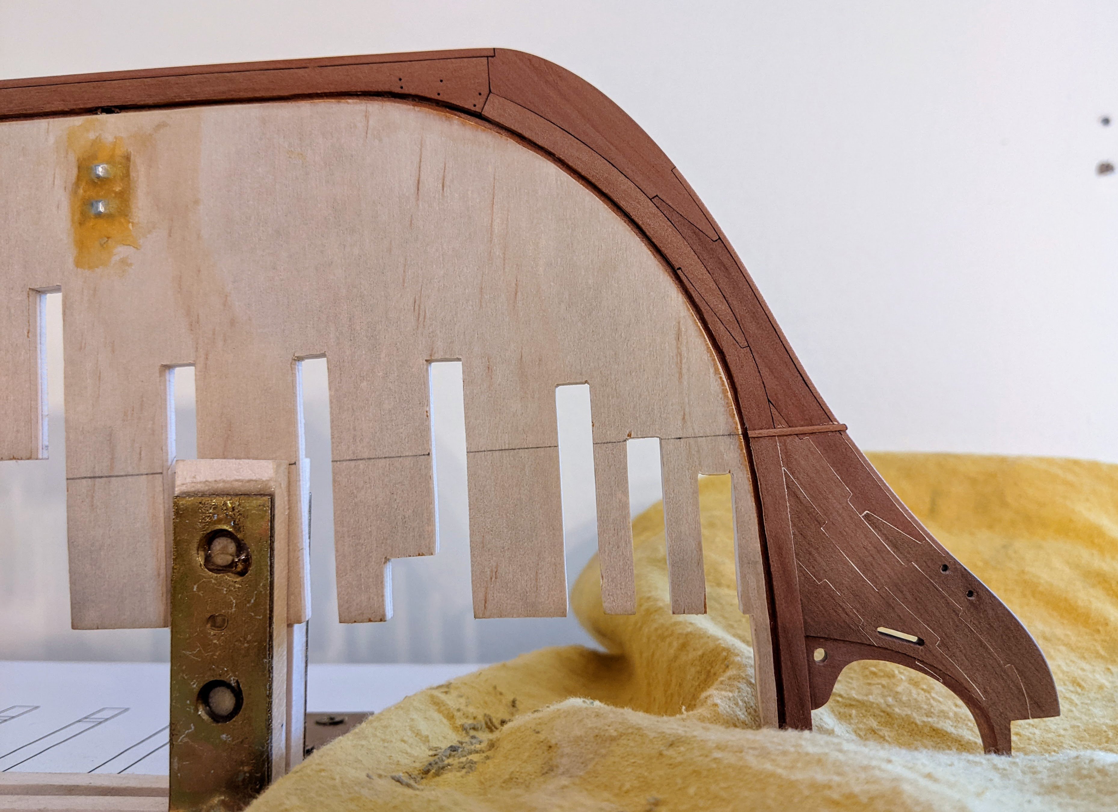

Log #22: Shaping the Head
Thanks for all your encouragement. I am much more motivated to get stuff done at the moment as progress is now starting to be visible on the model.
As alluded to in the previous post the next step was to get the standard in place. According to the contract this should be 7.5 inches wide and so I cut the tow pieces out using my scroll saw and used the disk sander for the outside curves as I was worried that the saw might break them (even so I had to remake one piece due to the saw tearing the end off of it).
Then it was time for small adjustments with files and chisels to get them to fit against each other and on the knee perfectly. Once happy with the dry fit, I glued the two pieces together. I used the white paint/glue mix for this joint as it will be painted black.
Then I clamped and glued the standard in place. I didn't use paint in my glue for this as these joints will be clear from the thickness differential between the standard and the knee.
Next came the process of deciding how to proceed with the thinning of the knee. As I discussed in a previous post, the main question in my mind was how thin to make the leading edge. My starting point for this was the Winchelsea instruction in which the knee of the head is 1/4 in thick and you are directed to thin the leading edge to 1/8 in (half the thickness). I then started to look at a number of contemporary models trying to see if I could see how much they were thinned.
Most of what I found was very much in the ballpark of thinning to about half the width, though it is hard to be sure given the pictures are not taken head on. I won't bore you with every example I found (there were many), but I did find a very interesting model which supports my decision to use the scarfs. The model in question is 74 gun third rate made around 1790, but it is notable in that it appears to have been used as a demonstration model and all the joints are done accurately (as opposed to the simplified versions on many model).
The model does show thinning to about half the width of the knee (though not as much as is visible on other models), but you can also see scarfed joints for the various pieces of the head. Interestingly they have also depicted the lead sheathing on the leading edge of the bow.
https://www.rmg.co.uk/collections/objects/rmgc-object-66519
So with those examples in hand I started working on thinning things. I still need to make some adjustments as I have decided to thin the stem down to the width of the knee of the head below the cheeks, but here is the current state of affairs. I am thinking I may round the upper part a little more and there is still some adjustments that need to be made to the upper stem, but overall I am pretty pleased with how it is turning out.
There is still time to make adjustments so if it looks off to you please let me know.
I also added the first coat of WOP which has really brough the joints on the keel to life.
Edited by Thukydides

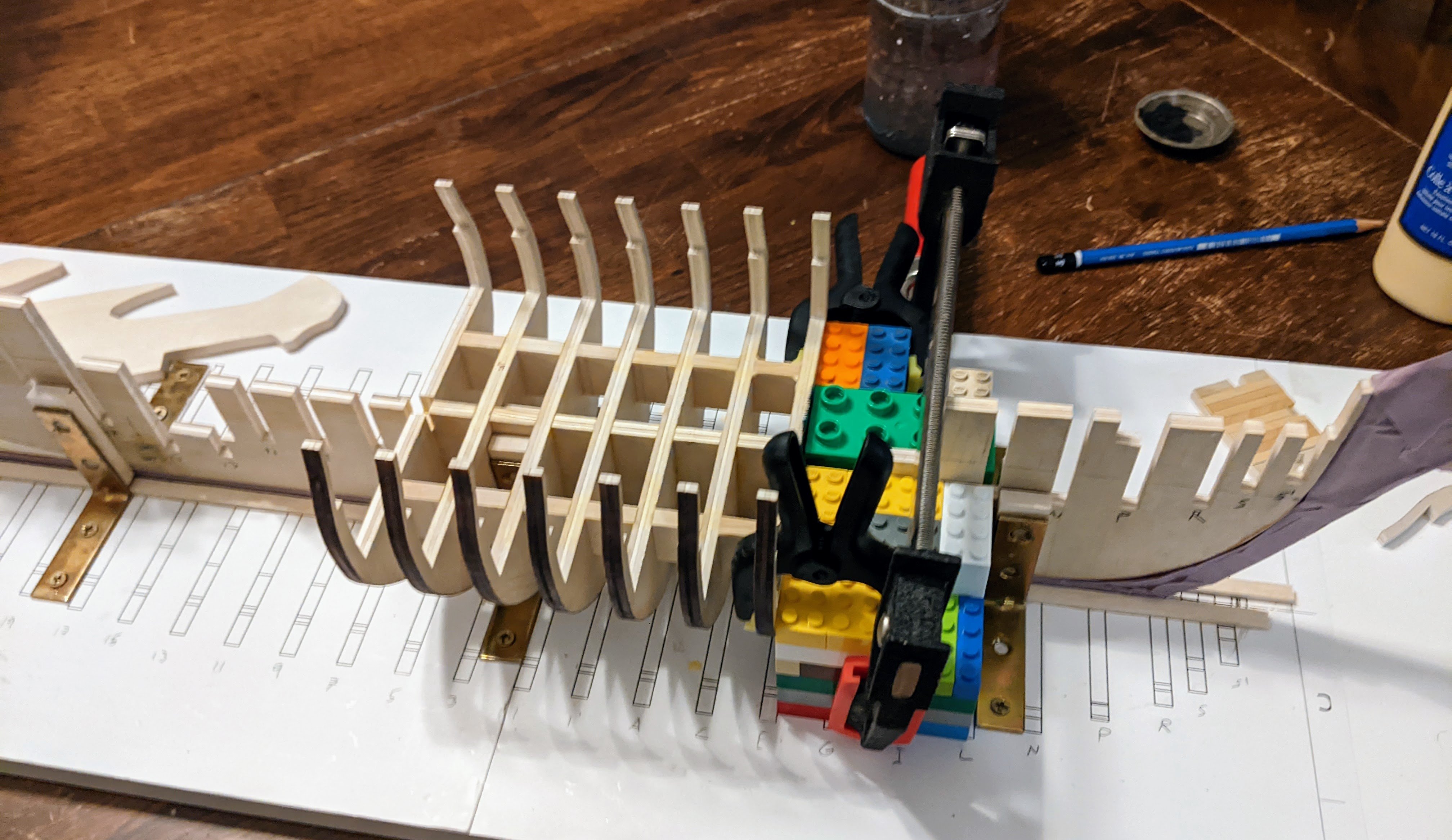

Log #23: The First Bulkheads
The final step before starting work on the bulkheads was I needed to mark the waterline. As previously mentioned I realized that the waterline on the Perseus is not actually parallel with the keel and so I wanted to mark the two ends of it while I could still lay the center bulkhead flat on a template.
Asthetically I am not planning on coppering Perseus, but I want to give a nod to the fact that she was coppered so I am planning on adding a batton along the waterline to mark it as if the coppering was there. This batton is prevalent on a number of coppered models, most notably the bellona model. However there is limited documentation on how big to make this so I went with a combination of what seemed reasonable, how big the batton in the bellona model looked and what looked nice on the model. In the end I used a 3/64 x 1/64 batton equating to a 1 inch by 3 inch strip at scale.
I also added a second coat of WOP below the waterline as this area won’t be painted and some extra protection couldn’t hurt.
Once the WOP was dried and sanded I covered up the keel and head with masking tape to protect it and secured the whole assembly to the build board with the brackets and screws.
Then I started adding the first of the bulkheads. I started by adding in the first two using lego to hold everything square. The lego was clamped to the center bulkhead and then the individual bulkheads clamped on both sides to the lego blocks. Lego is a convenient tool for this as it is readily available in my house and can be adjusted to a wide variety of shapes and sizes.
Then I worked backwards until I hit the last of the shorter bulkhead pieces. From this point on I worked forwards as I want to add the taller more fragile bulkhead pieces last to minimize the risk of.me accidentally breaking them.
As I approach the cut outs for the ladders from the lower deck down to the hold I needed to modify the lego shapes to make sure there was enough surface contact with the center bulkhead, but also to leave gaps to go around the nuts that screws securing the model to the base go into.
The process is not quick as I need to glue and clamp the bulkhead in place and then shape the spacer pieces such that they can slide into the gap smoothly. I then need to leave the whole thing clamped until it is dry (3-4 hours to be on the safe side). I am also being very careful as I want to make sure everything is square and good. Mistakes at this point could be a big problem later on if I don’t line everything up right.
This is a very encouraging part of the build as after a lot of prep work the shape of the ship is starting to take shape.
