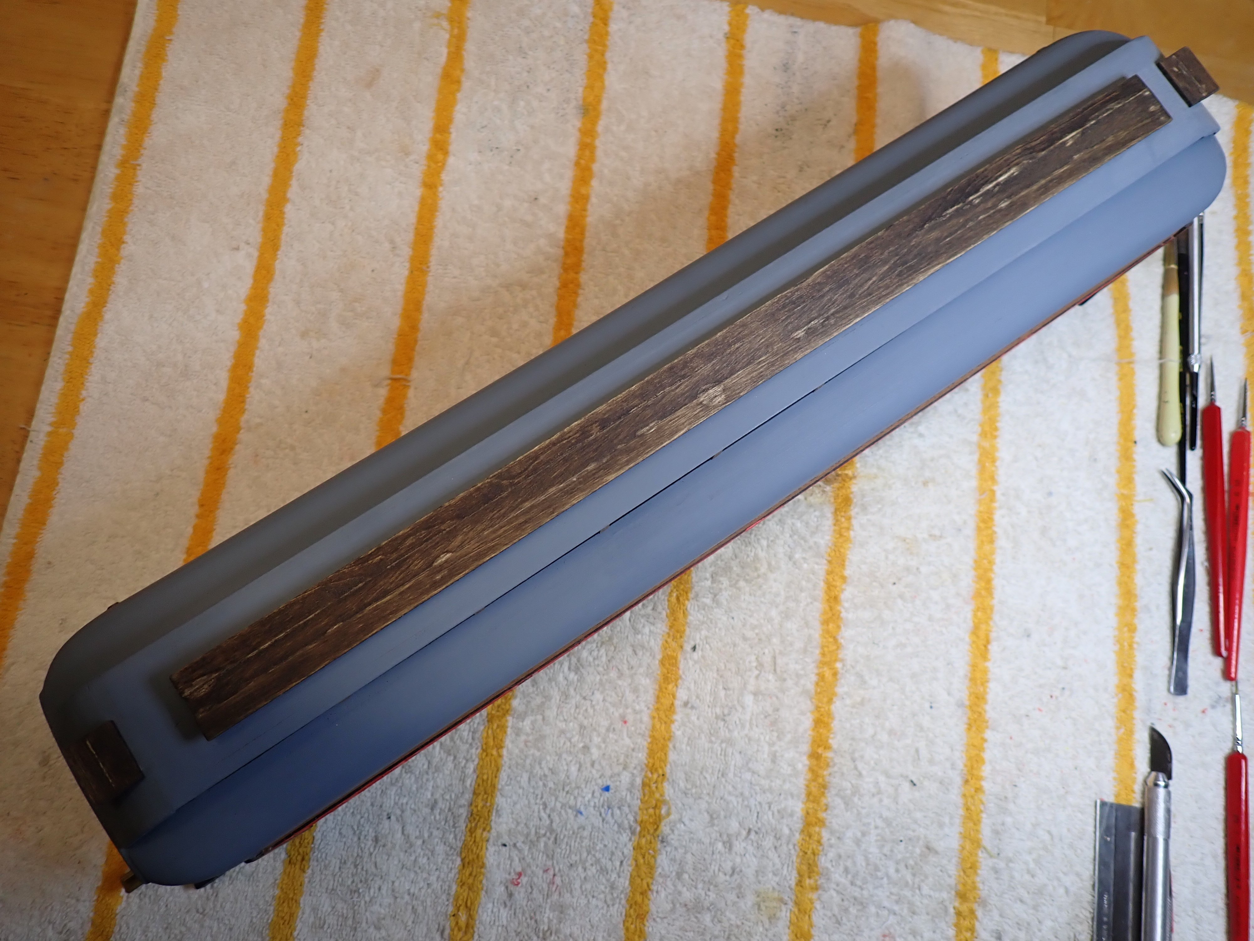

The roof is pretty much completed:
A few coats of Tamiya Light Grey and it will do:

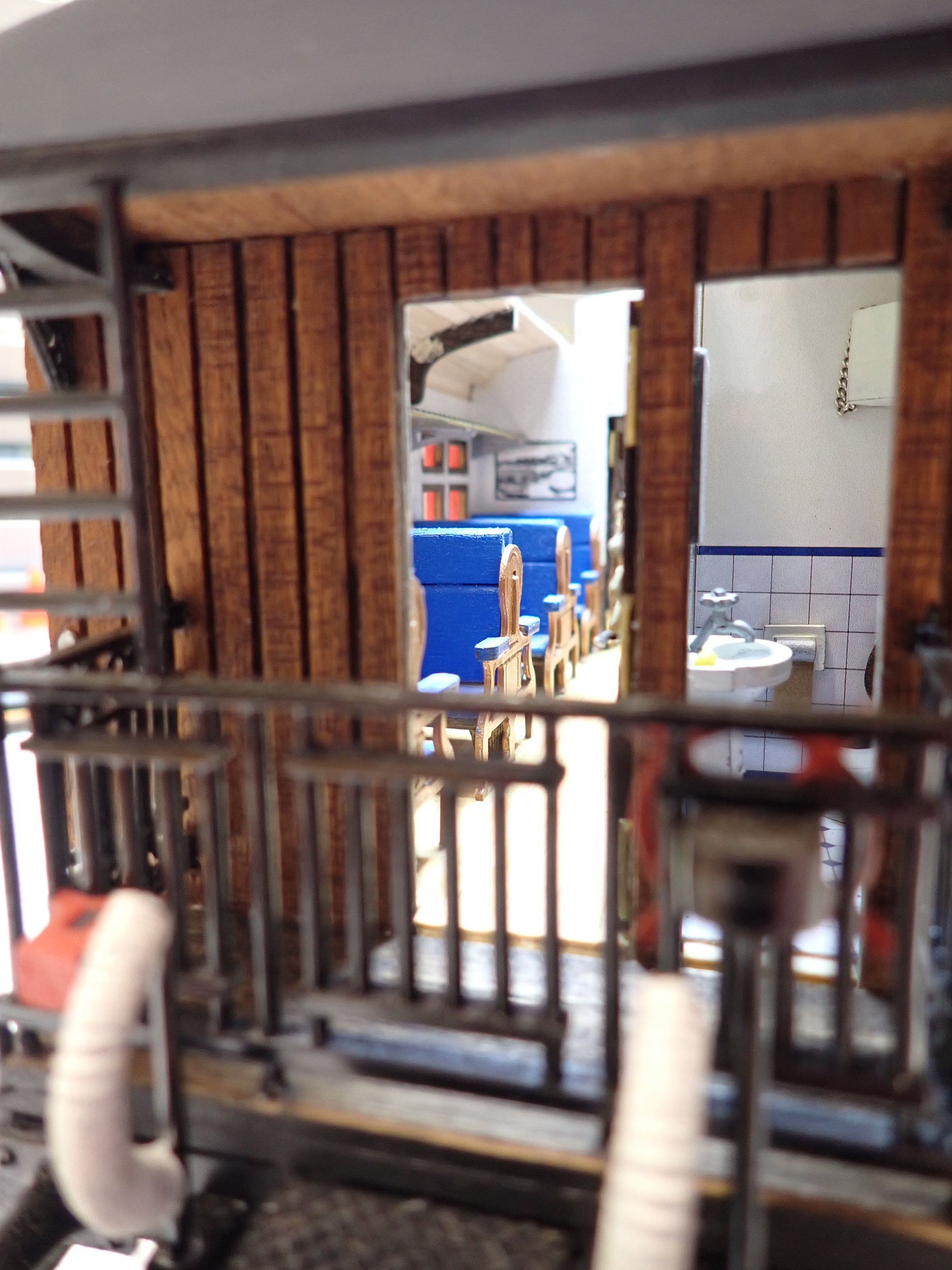

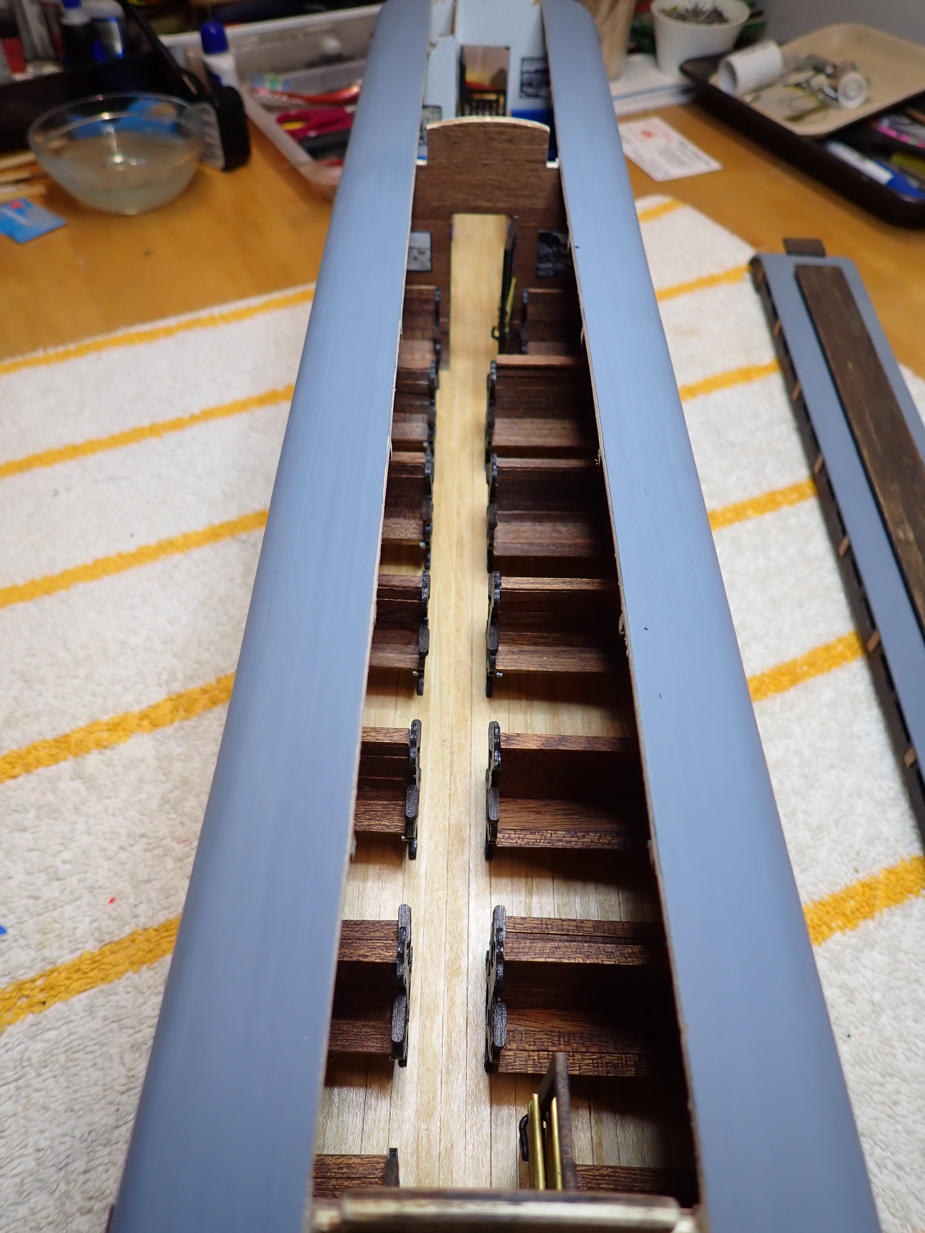

The most delicate is cleaning up the inside, using a small vacuum cleaner, a fine brush and a lot of blows (panting...). The top section can be removed to get a good glance inside:
It is top heavy for sure....

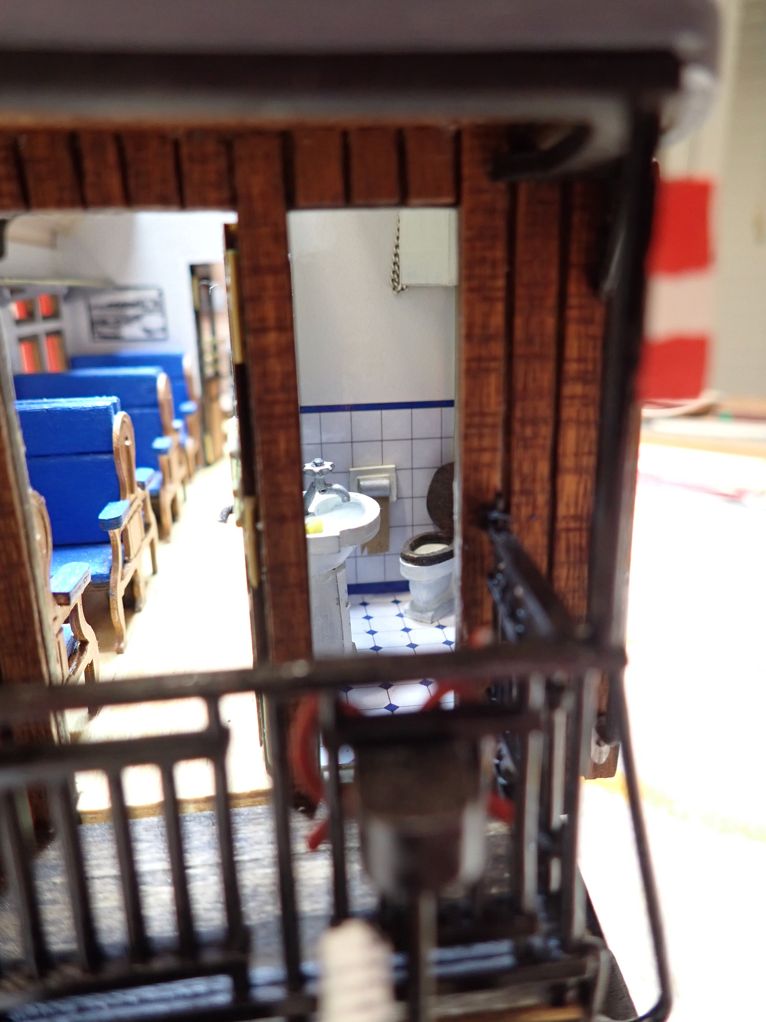

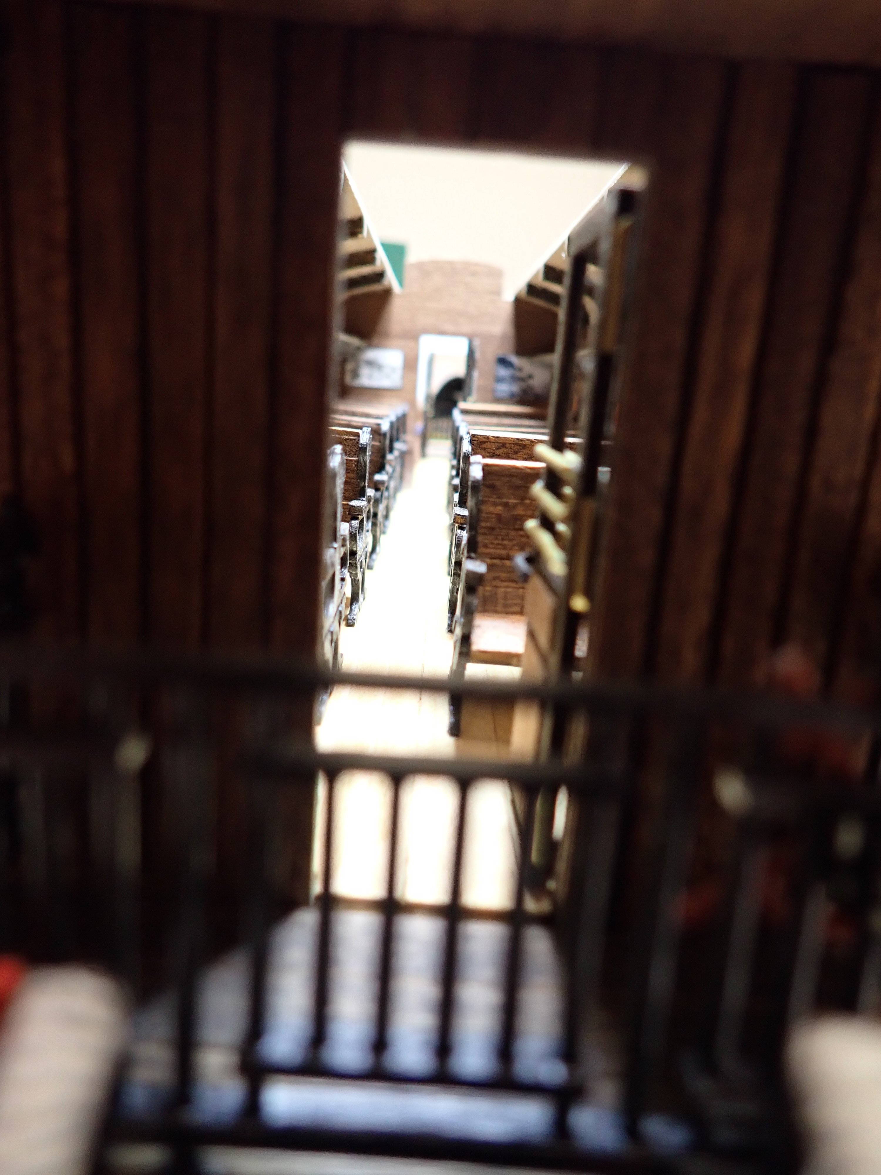

A quick peek inside: Third class....
Second Class....
And the bathroom:

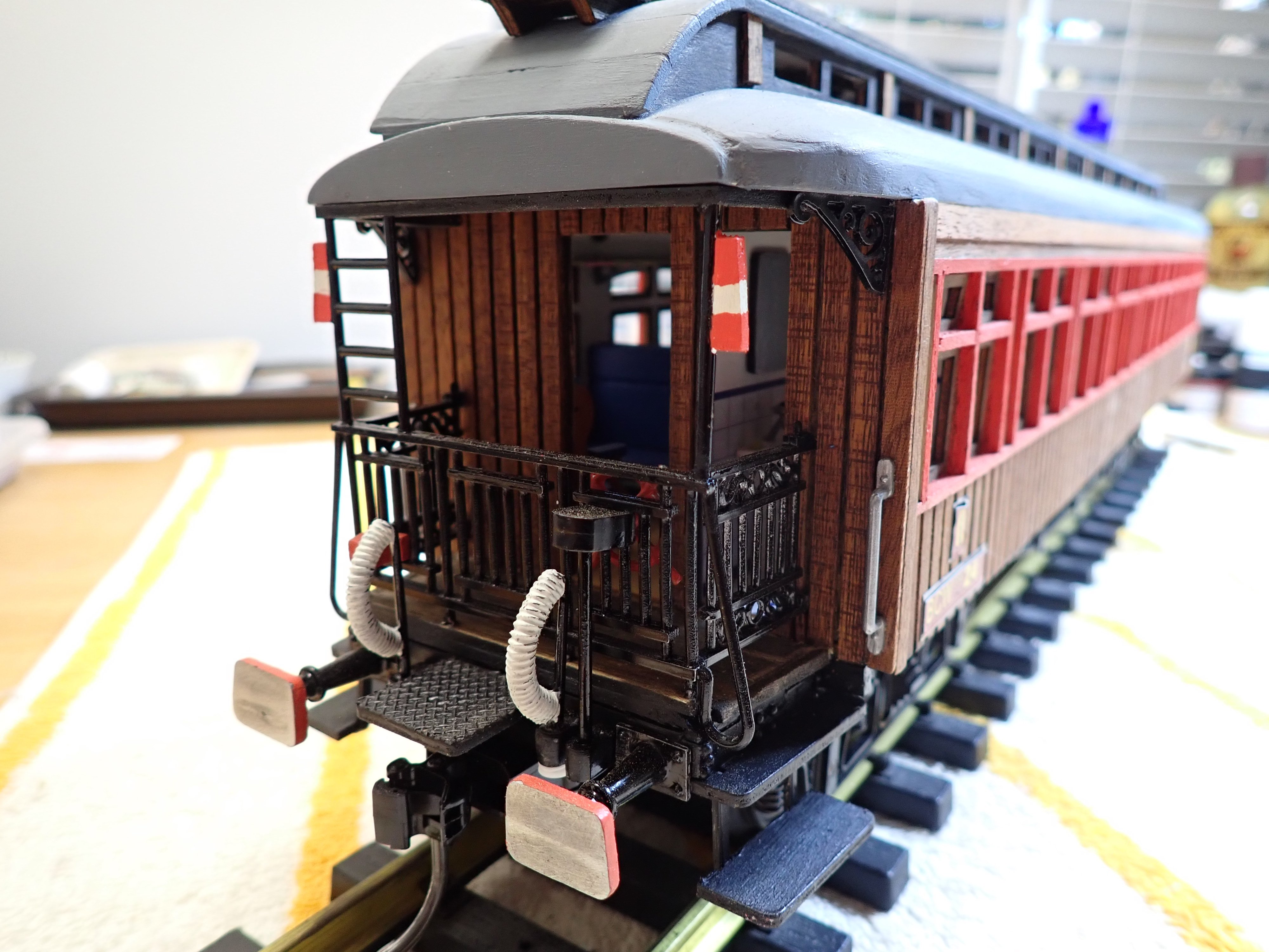

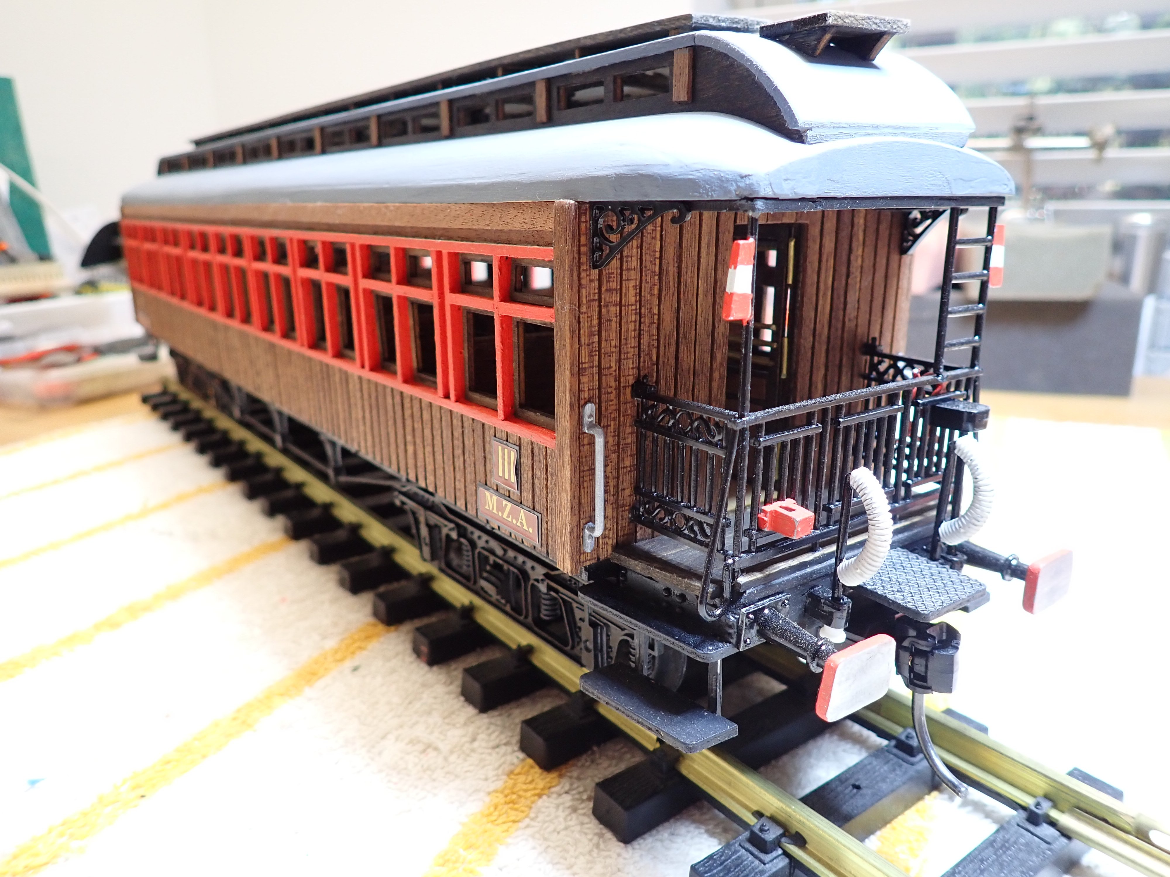

Both ends/vestibules have been assembled:
On this side (above), the metal part holding the right flag was missing from the kit. I replicated it from a 2 mm brass rod and a small piece of wood cut accordingly. Fortunately, this was the only missing part in the kit....
Overall views:
The next steps will be the building of the underneath of the car, with its braking system, battery boxes and various reservoirs. I also have to plan the support for KADEE couplers, in case this car ever runs on a layout.

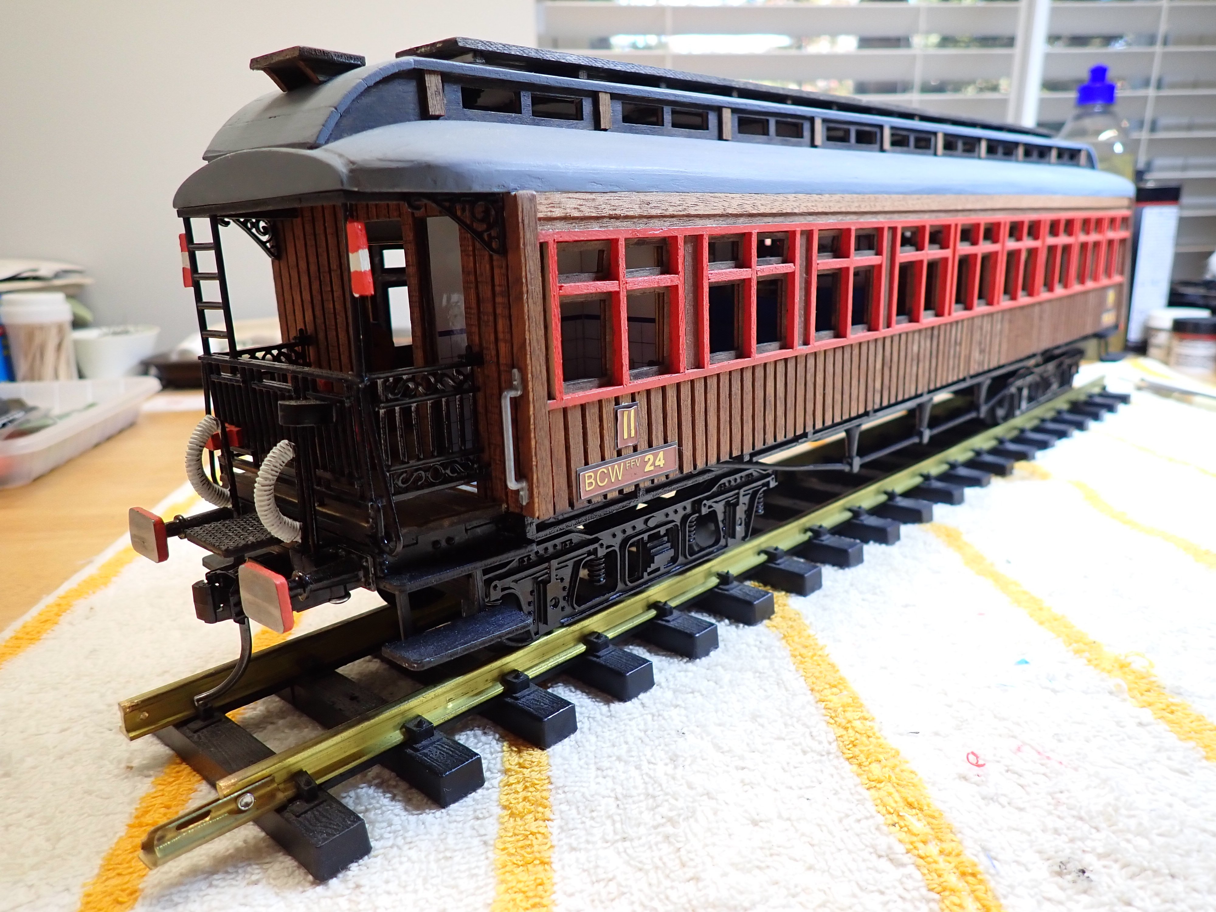

I am trying to finish the underside of the coach:
Another couple of parts missing from the OCCRE kit: the straight cables/bars, as you can see below.
I replaced them with 2 mm brass wire, but that is forcing me to paint them, instead of being able to keep the metal shine. This is the third part missing from this kit, all in the cast metal section..... Not good for Occre.
Installing the steps:
Alright, we are getting close to the end. I have the trucks and couplers to complete...
Yves

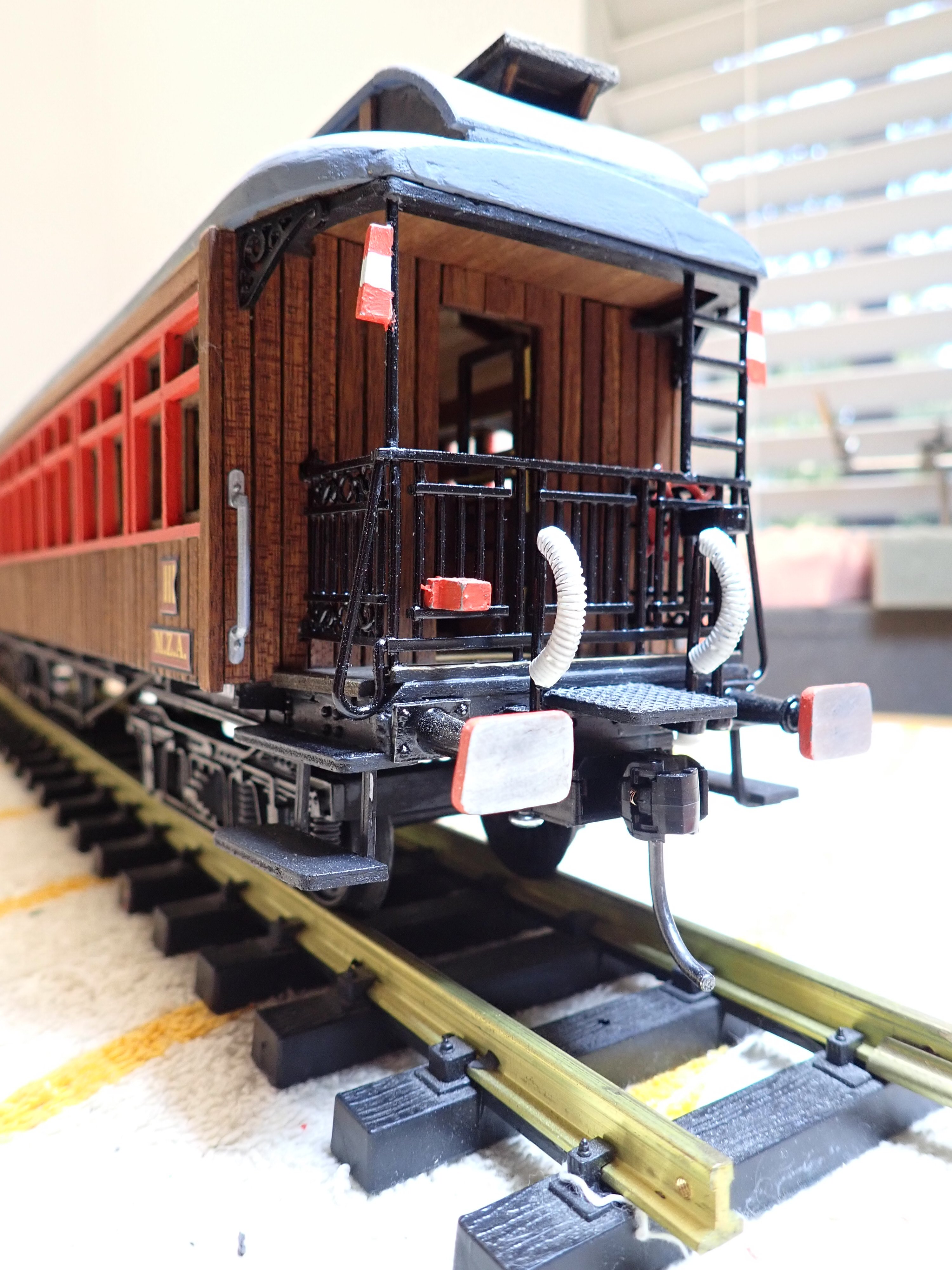

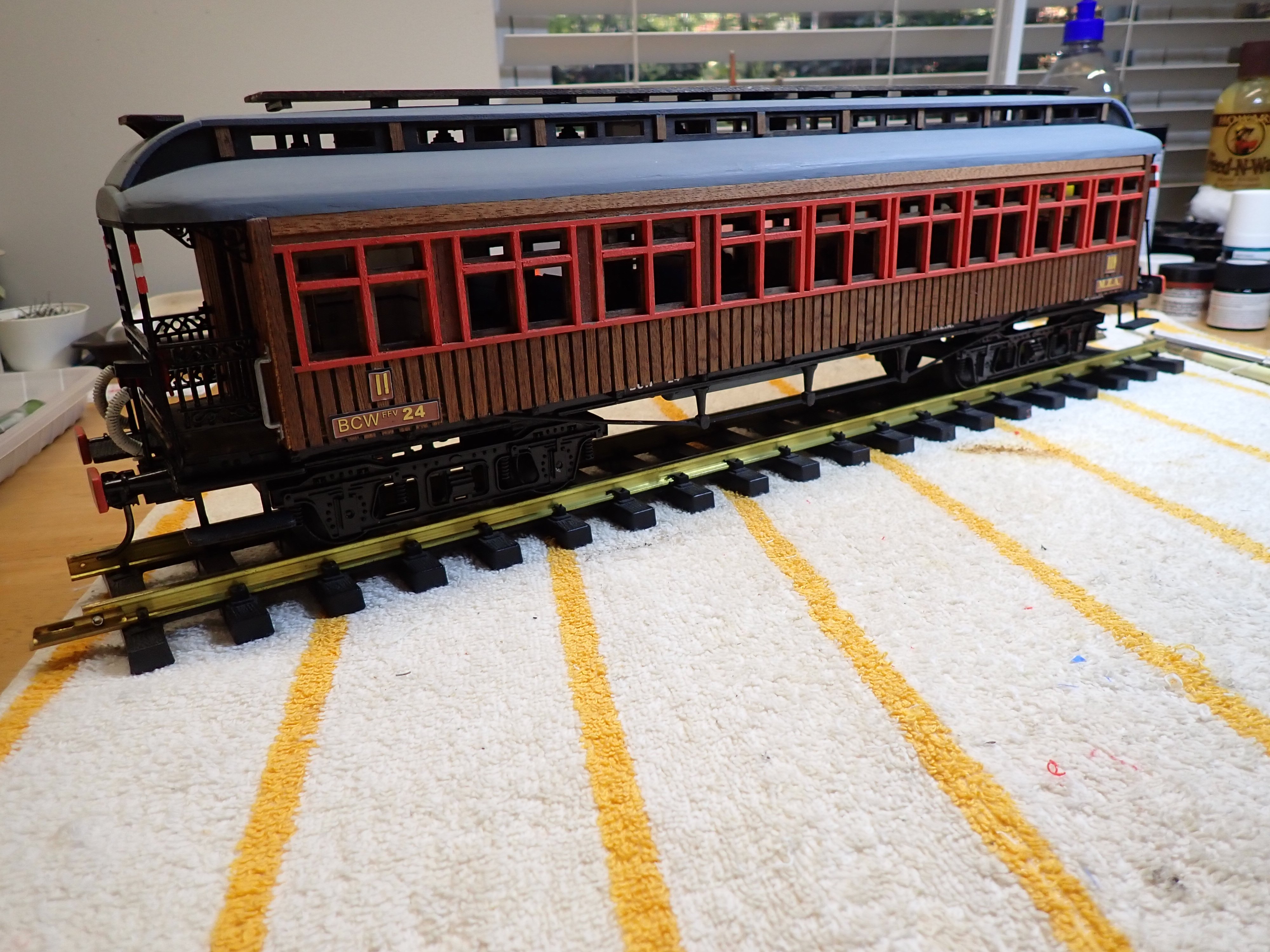

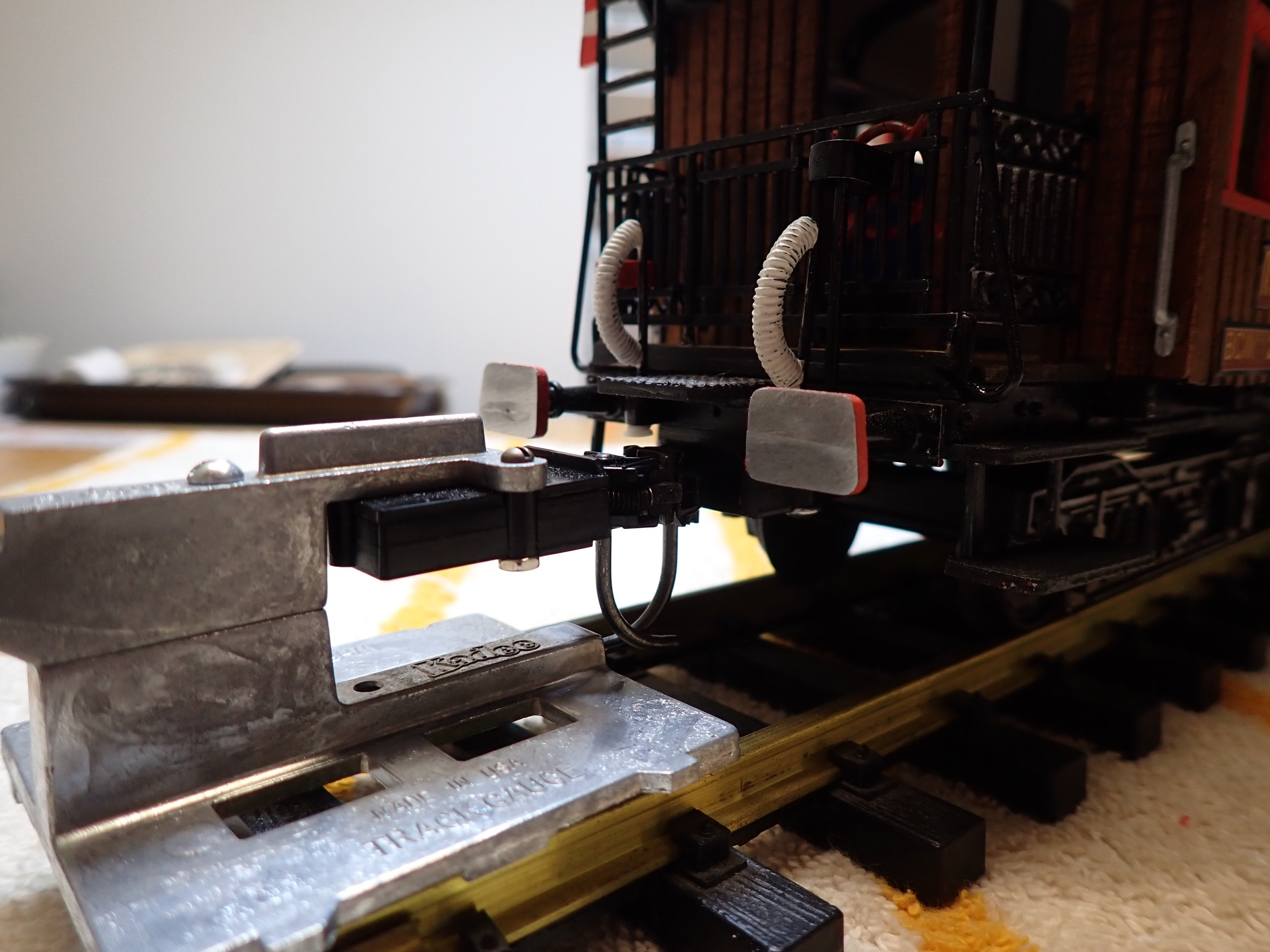

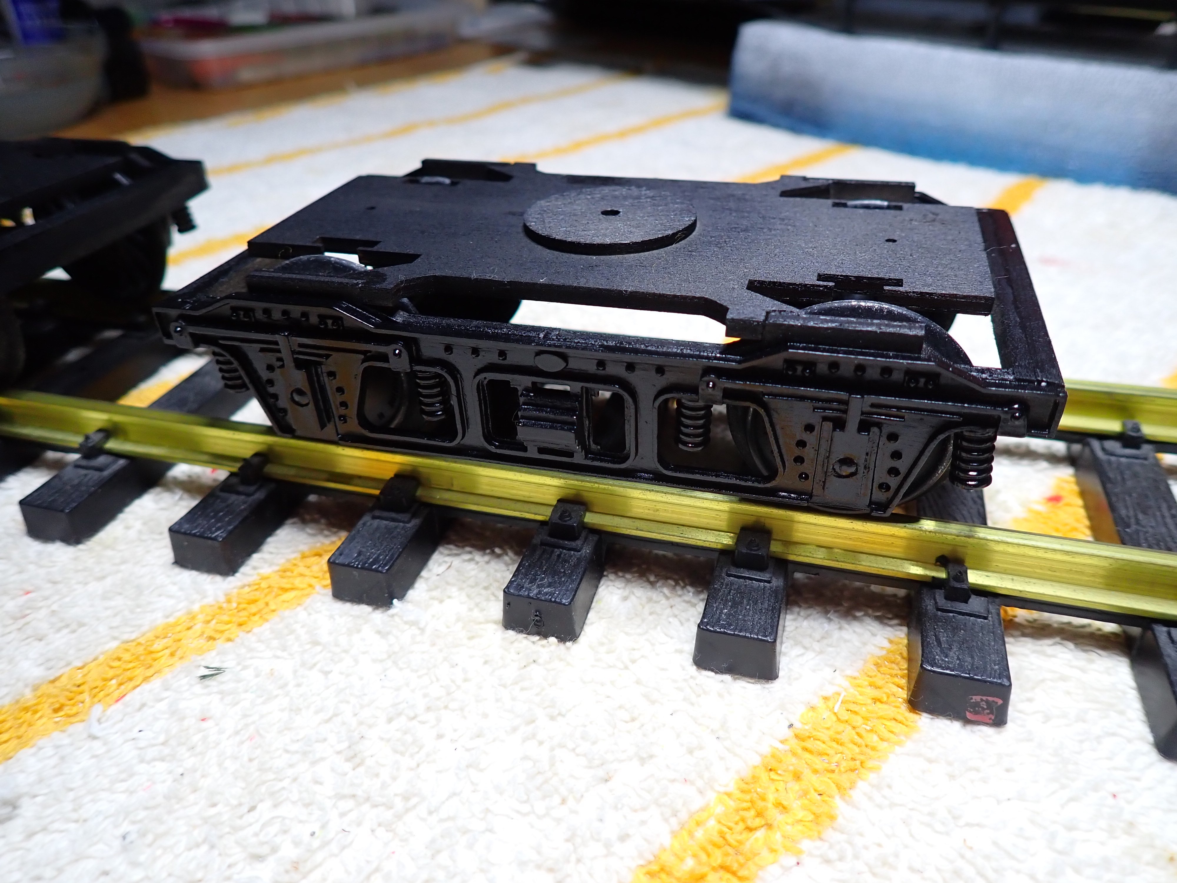

A few updates on this passenger car: I have just completed the ends. I gave up on the couplers provided by OCCRE, as they are not reliable, are not prototypical and makes no sense. Instead that Spanish car will be equipped with American knuckle couplers from Kadee. This way, I will be able to pull this car with an American engine and it will look better overall.

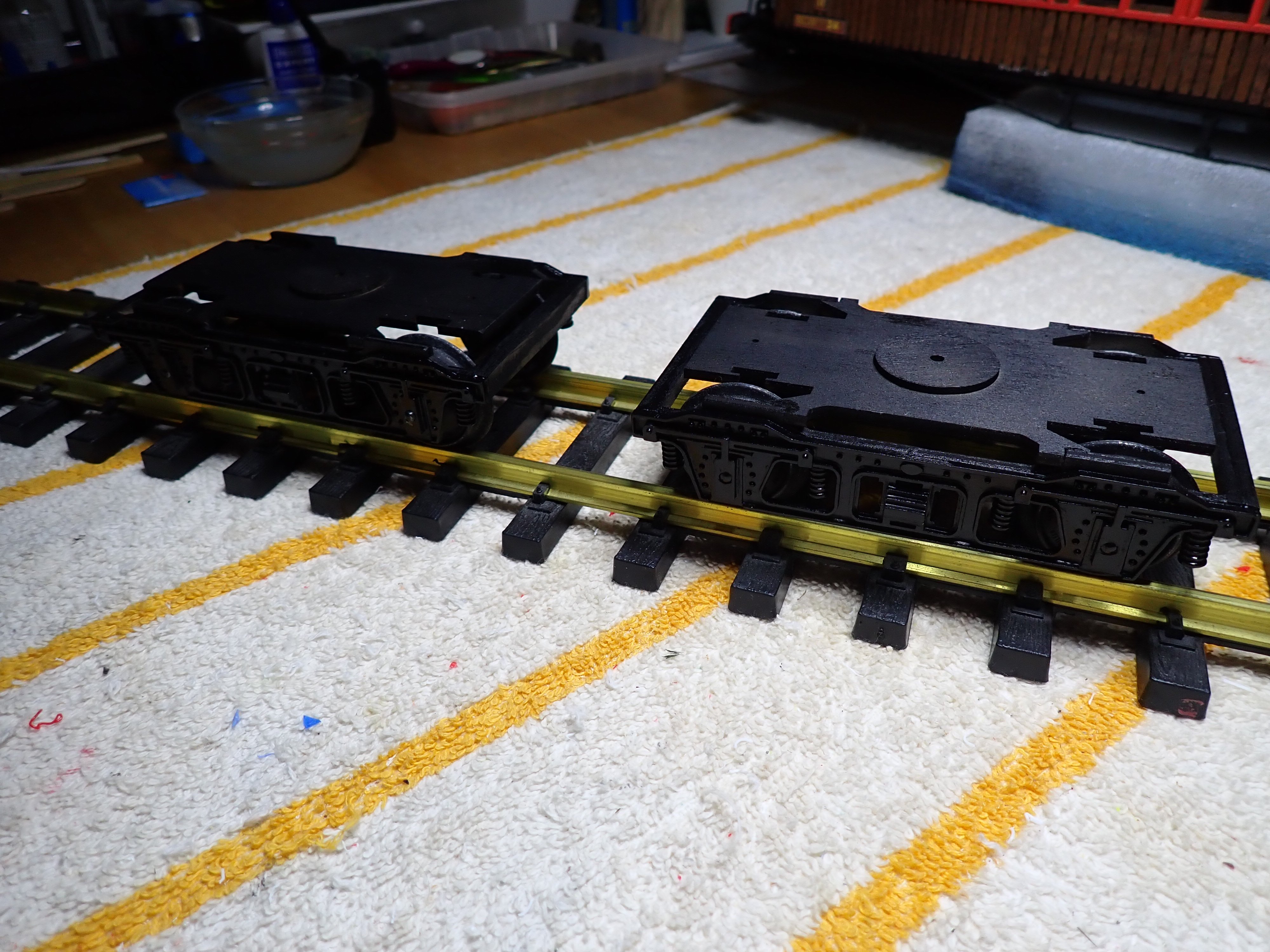

I still have to paint the trucks, which is not an easy task as the wheels have to be protected from the spray. We are coming to an end for this kit.
Yves
