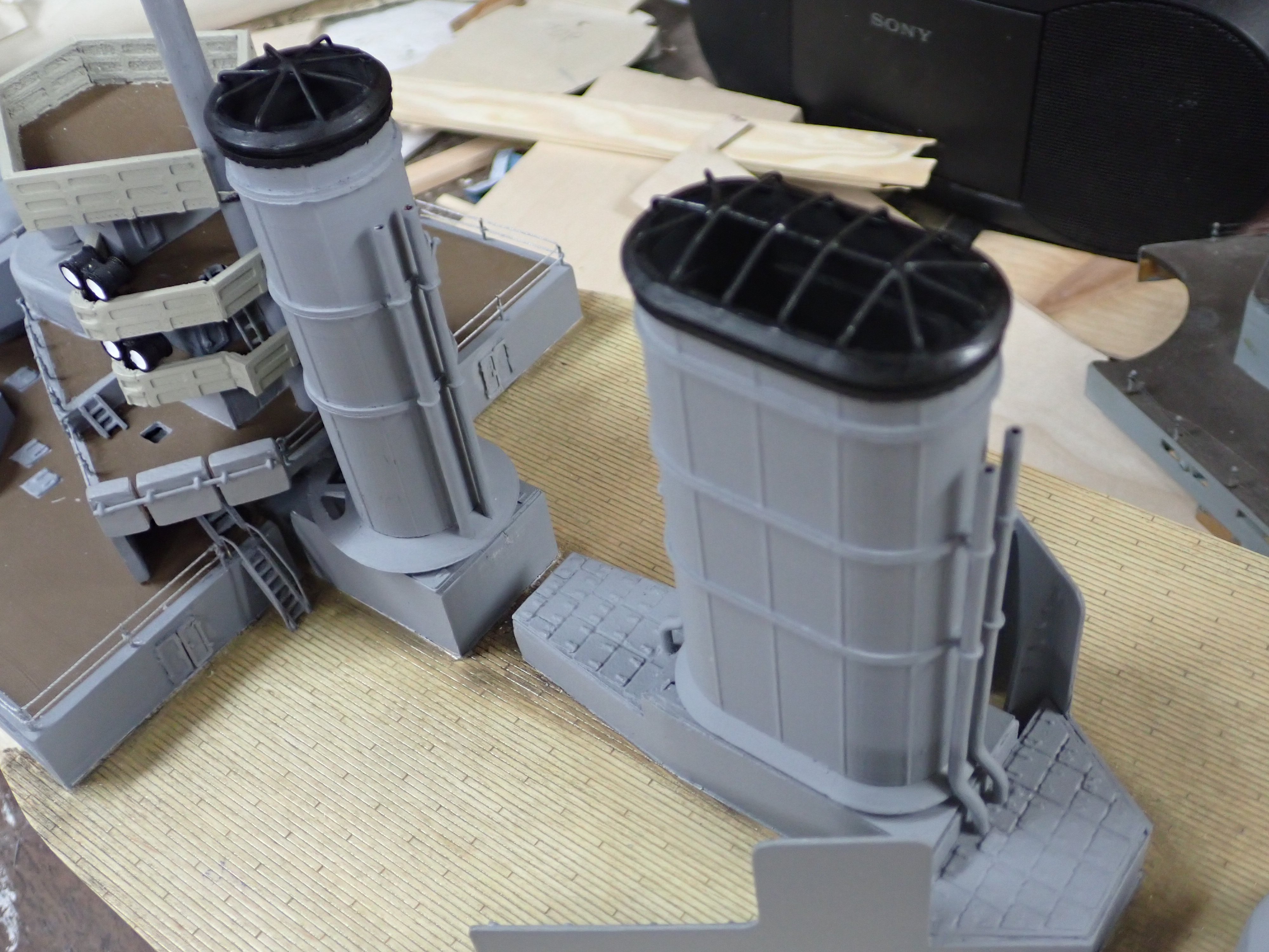

That's really not bad at all for FDM printing, is it. I'd also chop off the funnels and do them separately - you can probably do that in the slicer.

Actually on closer inspection the vents and funnel are pretty good, once you cut off the little "filament hairs" that the head spun between them while flitting around.

Looking at your results with those, I'll suggest trying a 0.25mm nozzle with your FDM and slow down your printing speed a bit - you'll end up with a finer bit of detail, and a nicer finish.  The funnel and vents may turn out OK!

I zap these with my soldering blowtorch, but that said, I can’t remember the last hairy print I had. I used to be plagued by that but think the filament heater solved that problem.

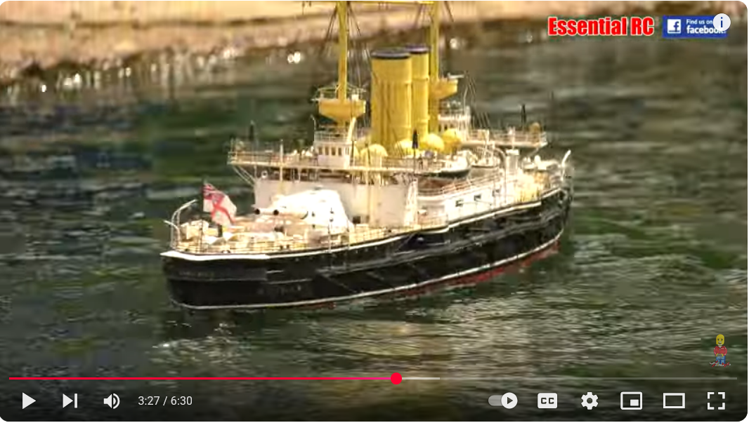

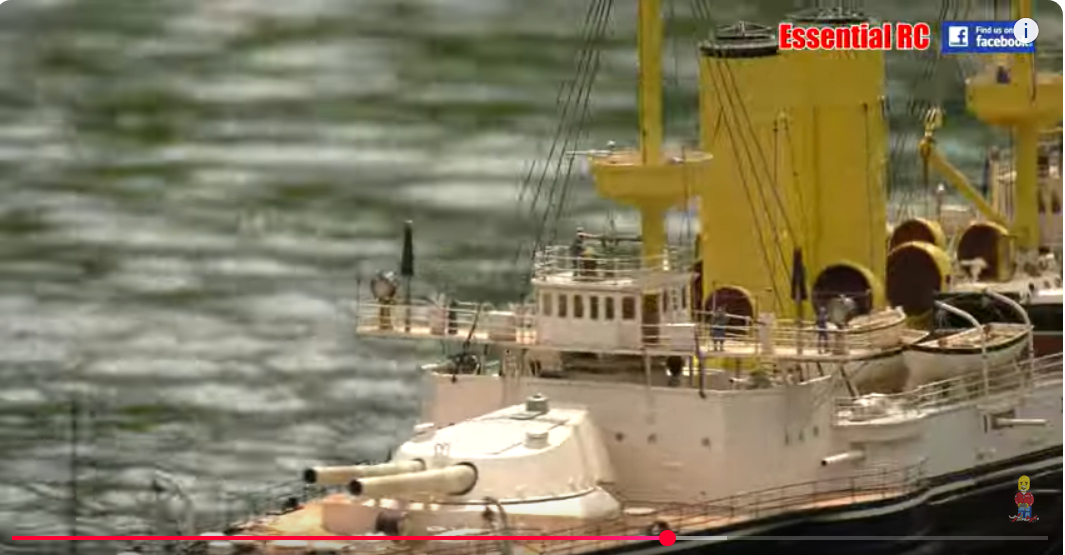

Browsing videos of RC boat models, I came across one of a beautiful steam-powered model of the pre-dreadnought HMS Canopus (1897).
Have a look at the snapshots below. See those black "umbrella"-looking things at the four corners of the upper decks?
I think I found the answer to my question earlier about the "semaphores" on Lion.
Those look like mechanical semaphores with arms drooping when not in use.
The front right one in the shot has a crew member standing at its foot, showing the scale of the thing.

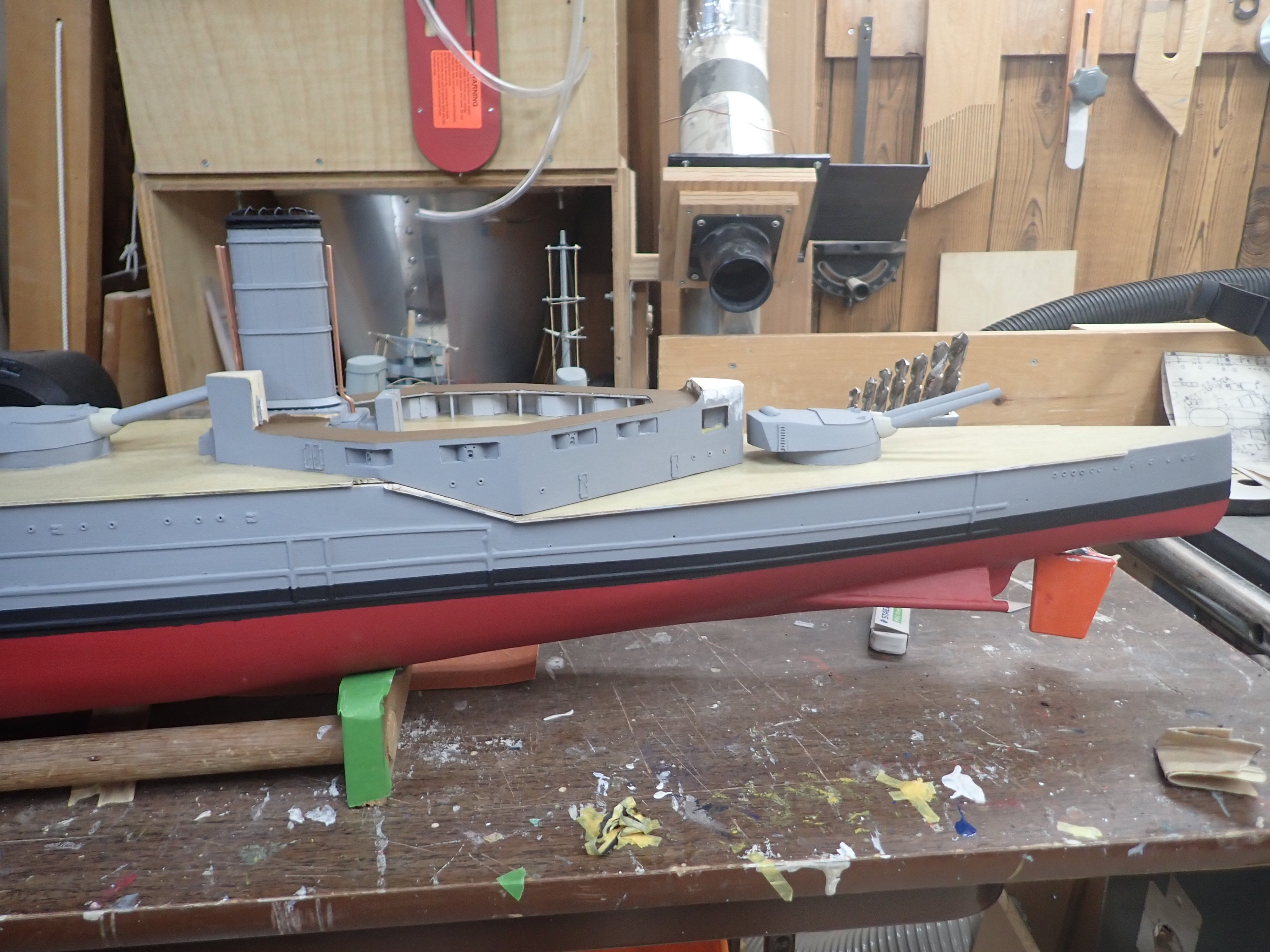

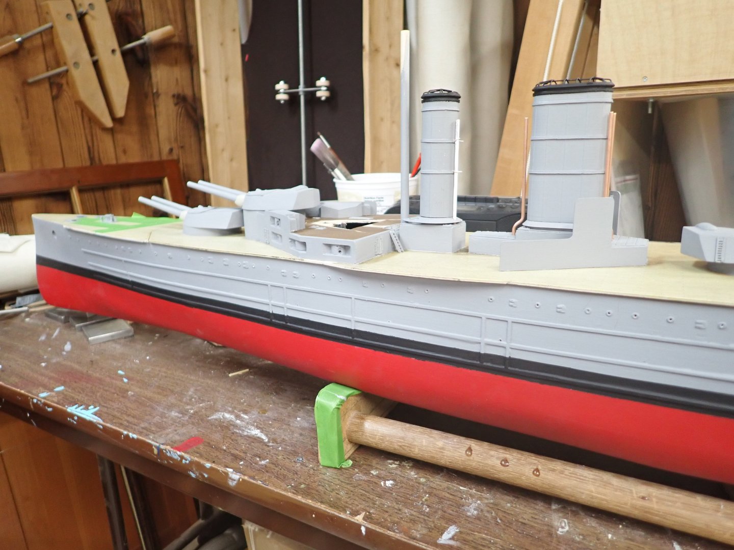

Finally got around to painting the bootstripe. It adds nicely to her appearance. I was out of "Frog Tape" masking tape so went to HD to discover they now sell Frog Tape only in really wide width; all others are "Painters Tape Ultra" which I know from past bitter experience is crap in terms of bleeding but I wanted to get the job done so I bought it anyway. Sometimes we are our own worst enemies. As you might expect the tape bled in many places along the upper edge even though I tried my best to burnish it down. Redid it with 1/4" Tamiya tape with the green masking tape overlapping to shield the grey paint and got nice clean edges.

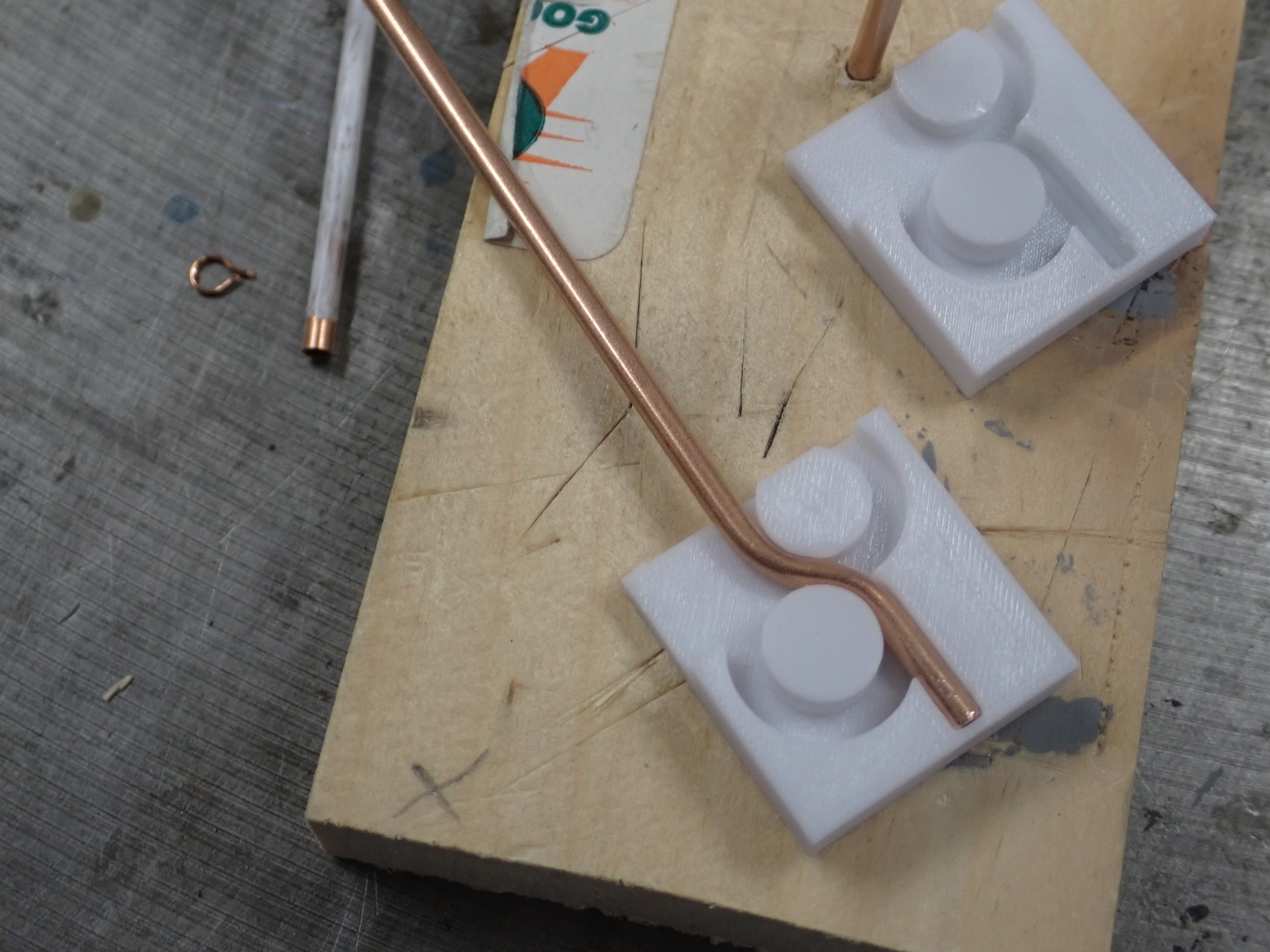

Printed two little jigs to help me bend the steam vent pipes consistently; needed two because there were two different offsets for the various pipe s-bends; 3/16" and 1/4".

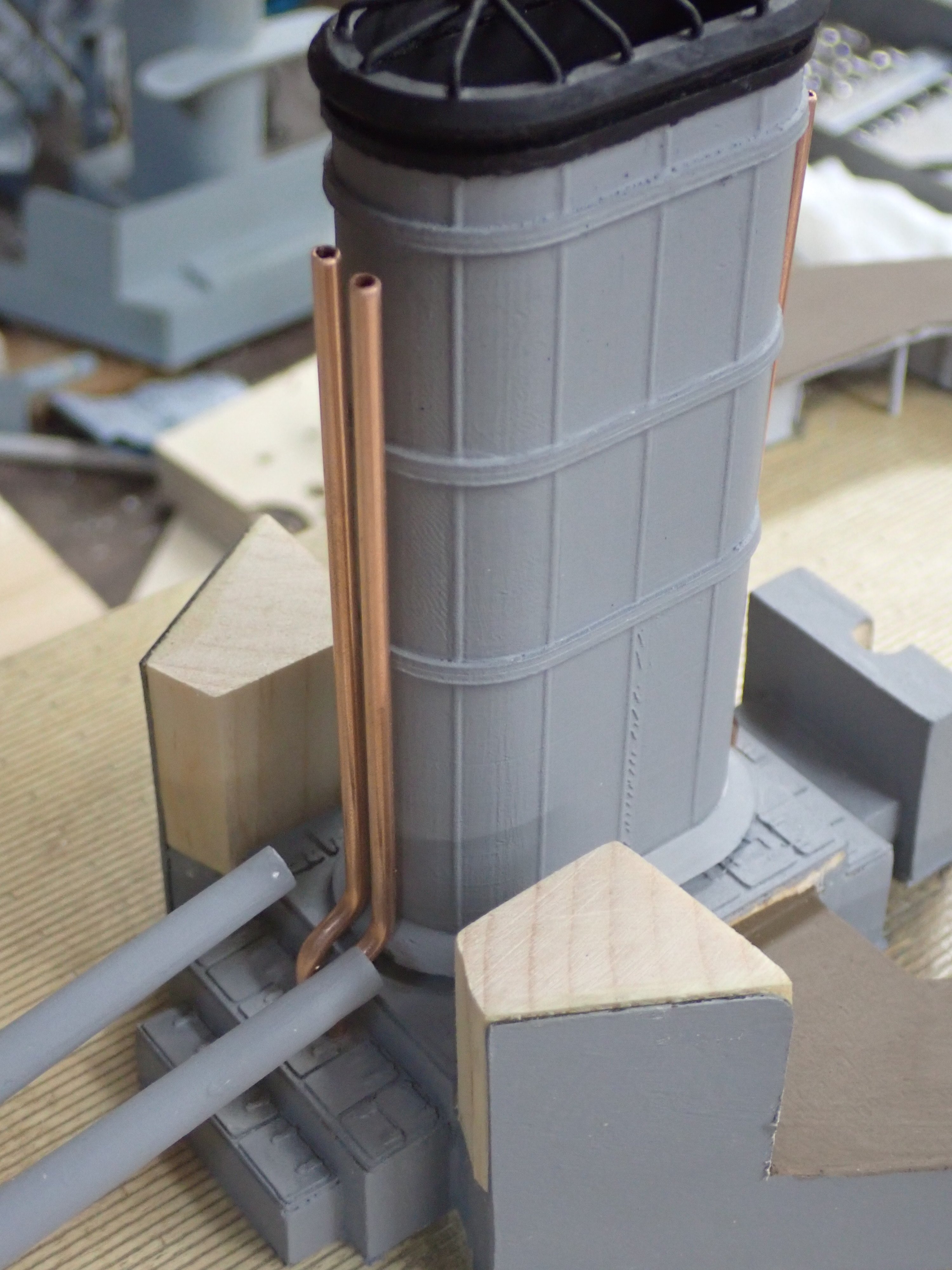

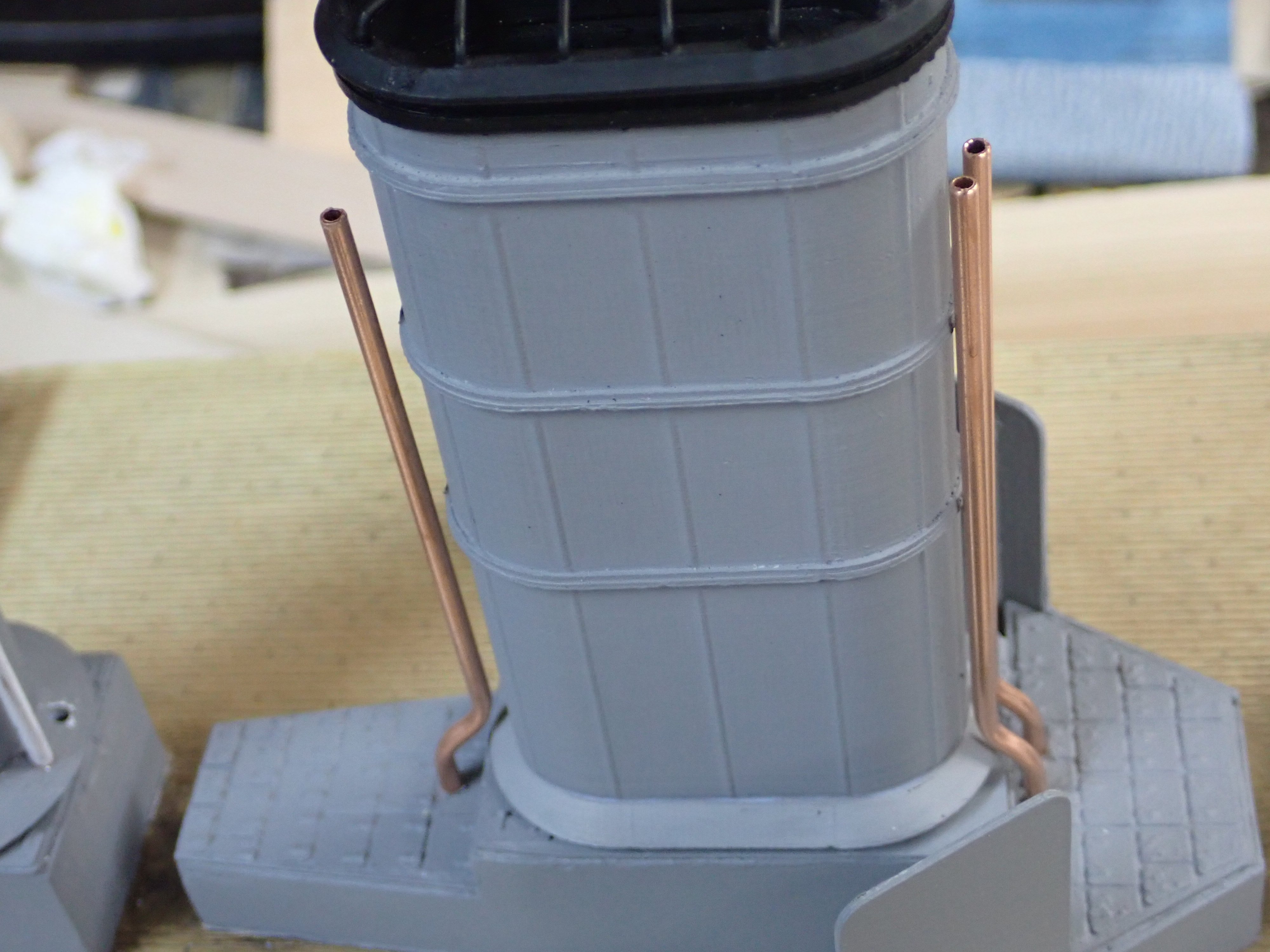

Pipes at the aft funnel; "Q" turret's gun barrels traverse perilously near them. 🤔 In fact there are a couple of cross-pieces to add across the gap between the blast shields which must be concave to provide clearance for these barrels.
Pipes at the main funnel:
The funnels are not glued on; pipes are not glued in; need to form the support eyes and drill into the funnels to attach them.

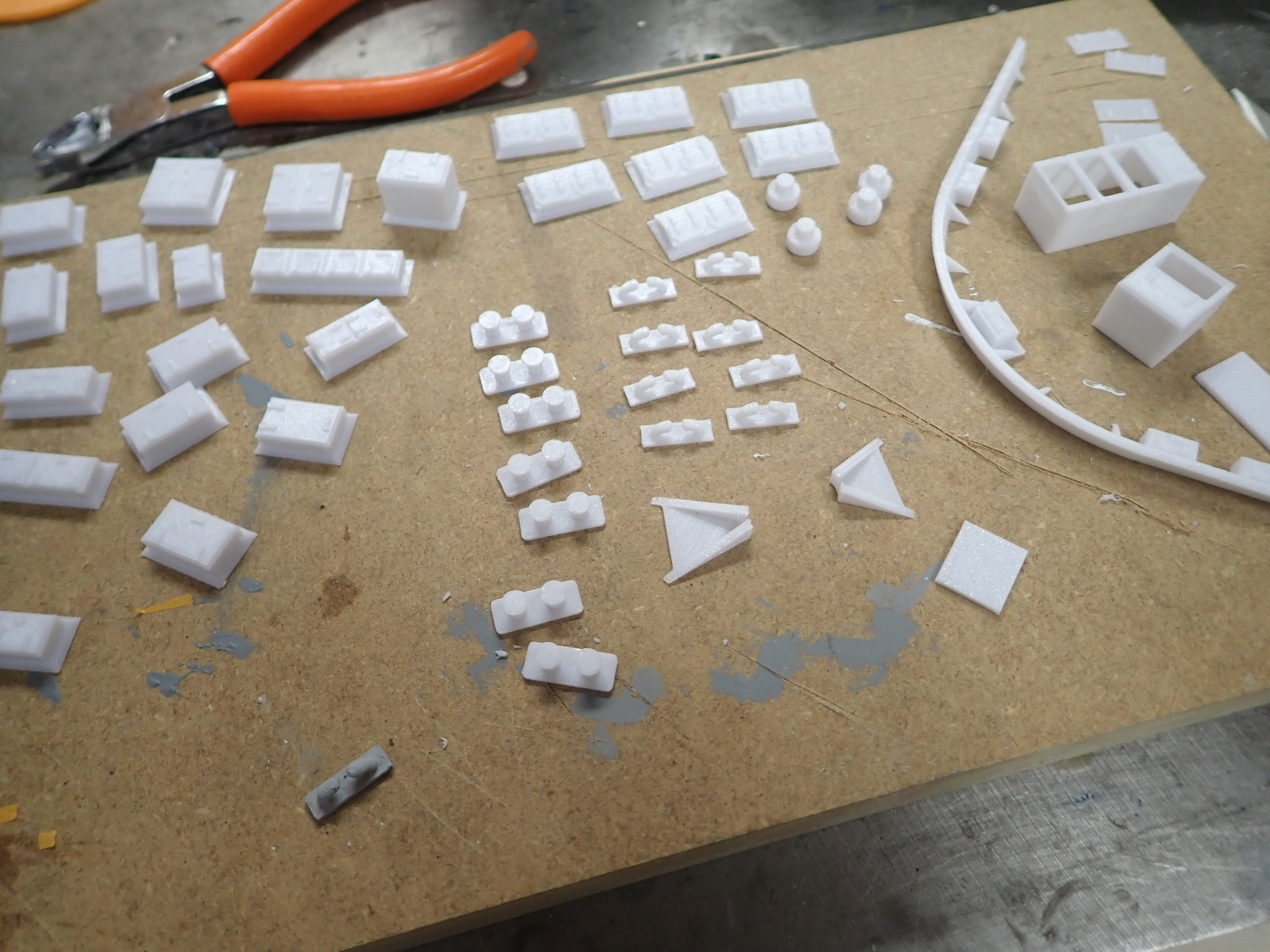

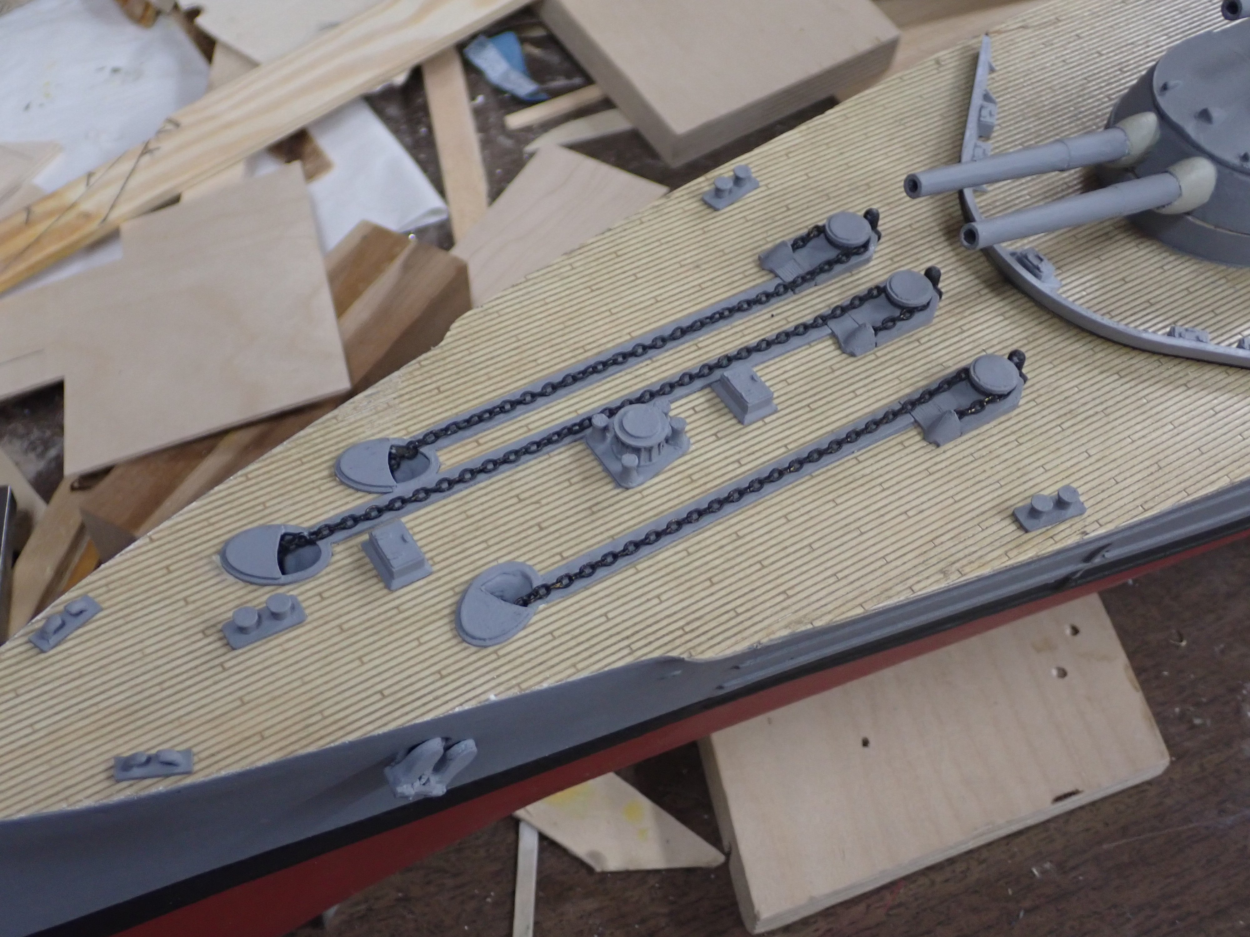

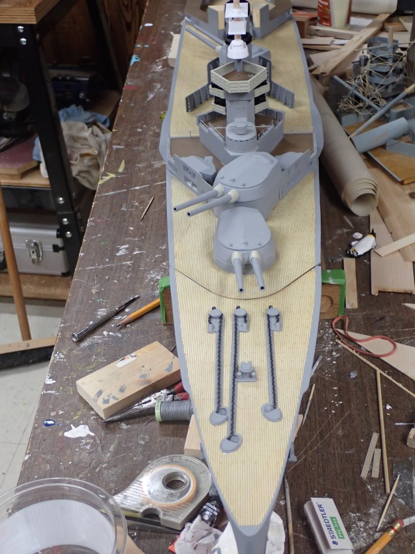

I spend far too much time on the computer and not enough working on this model. I have made some progress, but I am going to switch from adding detail to getting it functioning on the water and keep adding to it. I have enough of the topsides done now that it would be presentable "with explanations" to the club members. Smoke and sound will have to wait for now.
Here are a few shots.

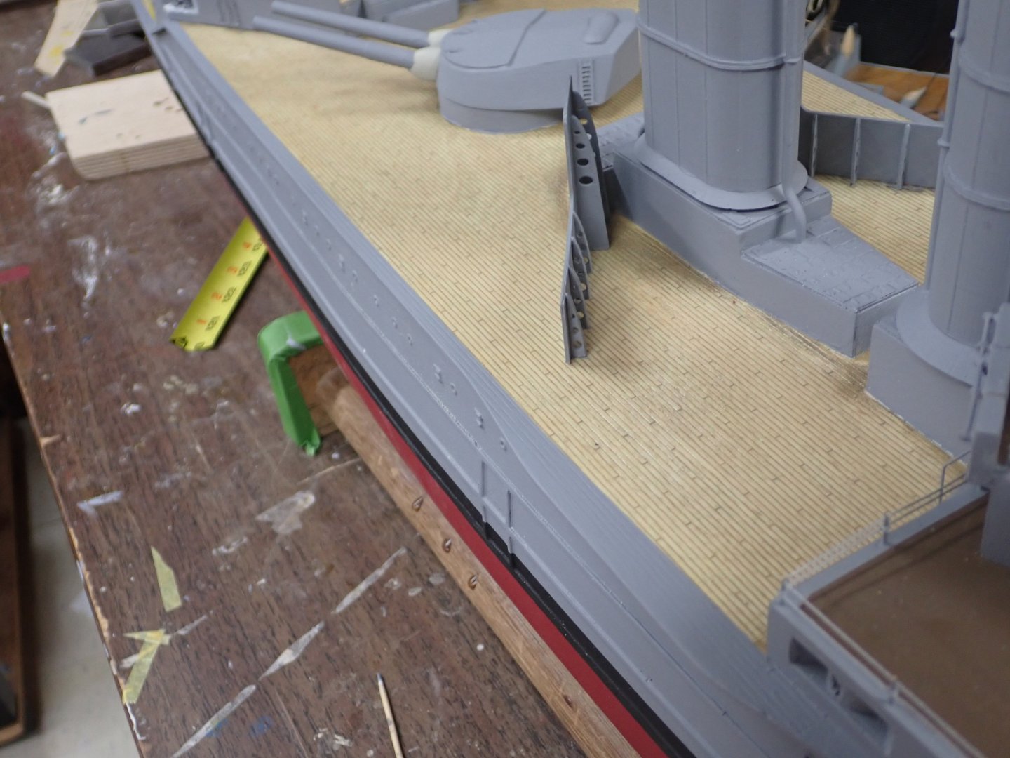

The foredeck: Looks great, but the only parts glued down are the main windlass and the anchor winches and chains. The rest of the parts are just placed for the shot, in fact I see I forgot to paint final grey on the breakwater which is still primer grey. Of course, it would only be the work of a few moments to CA the rest down, but only after I mask and paint the grey rim along the deck edges/torpedo net shelf.

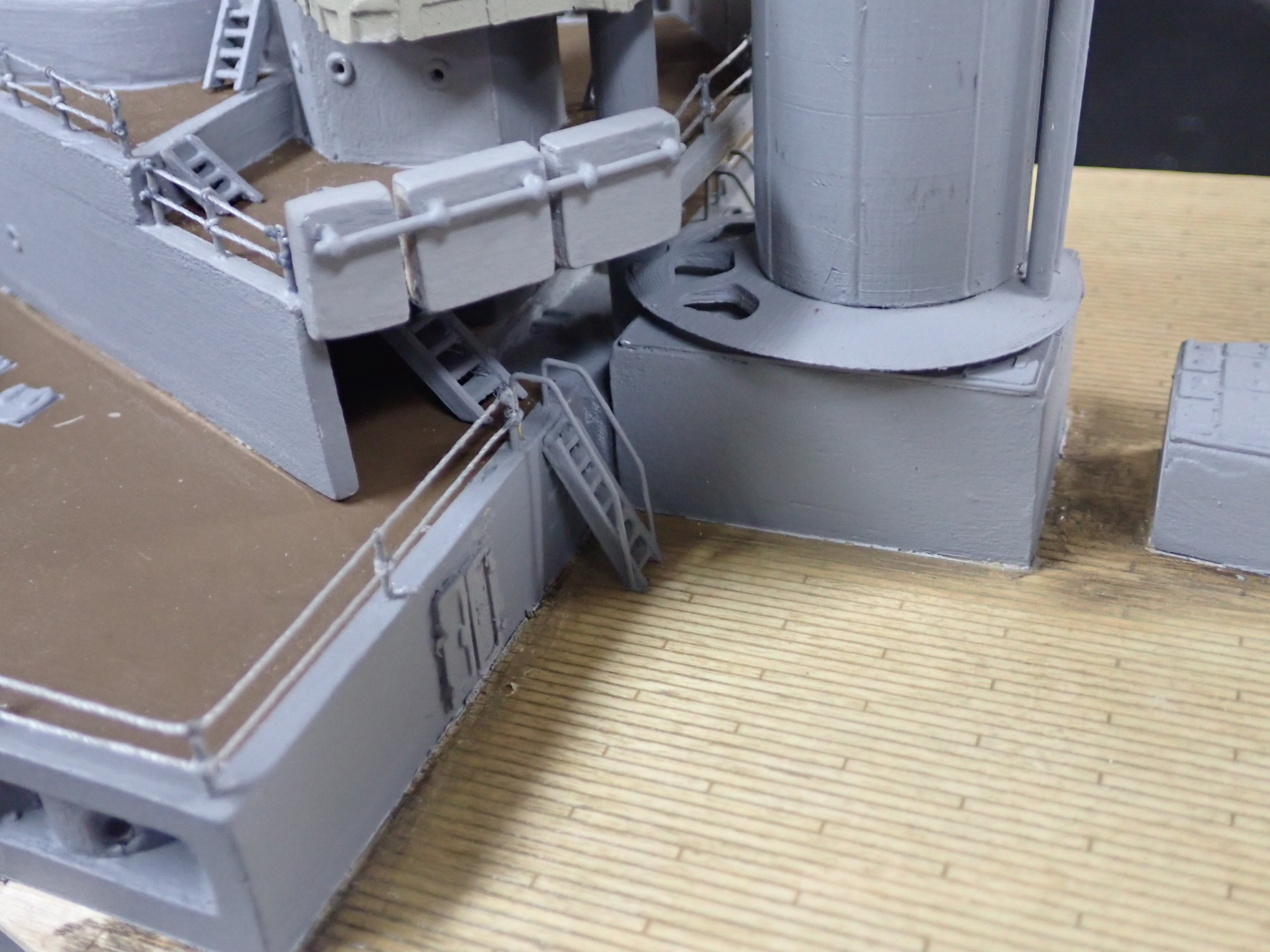

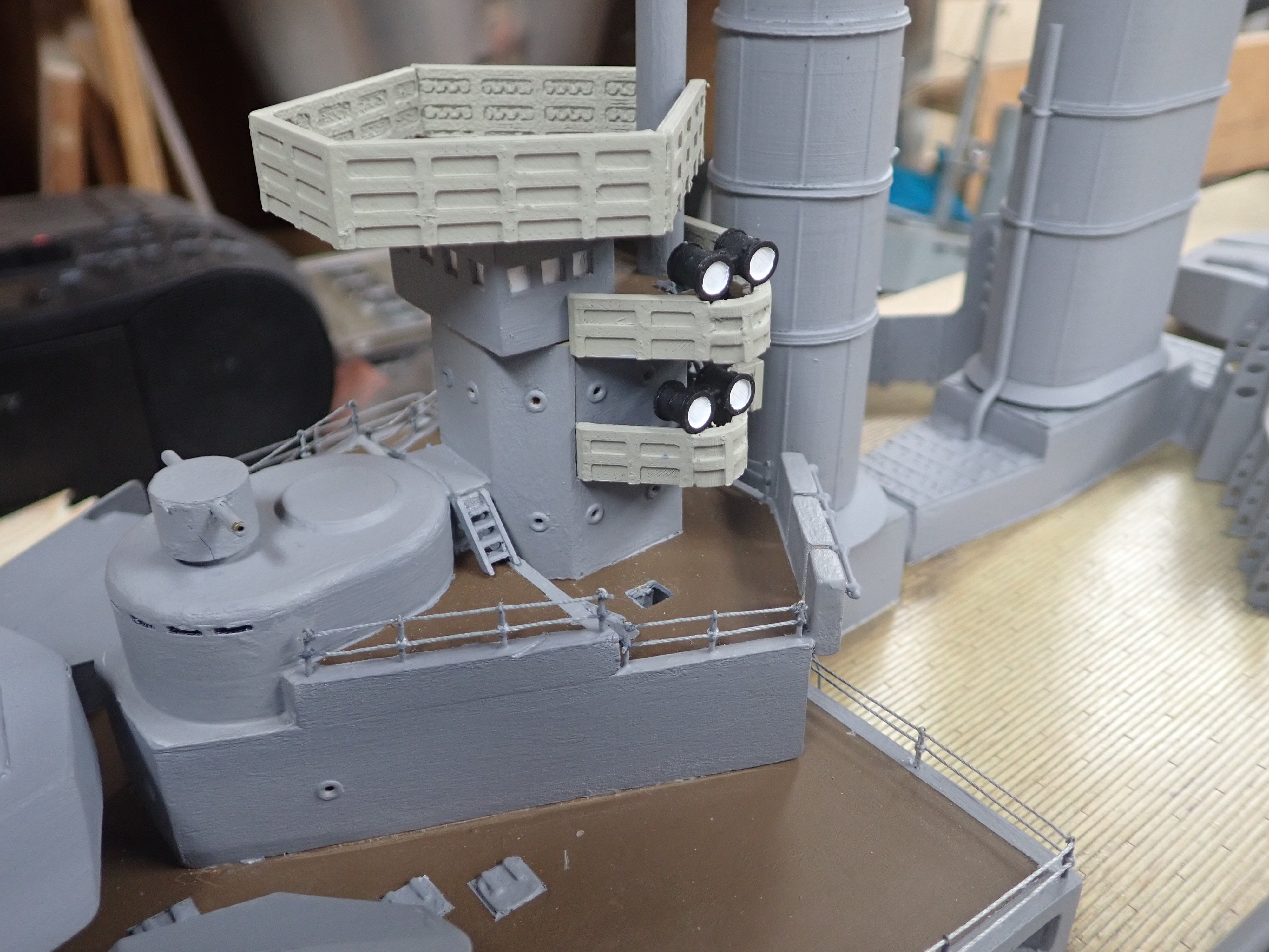

Forward tower FINALLY assembled with glue. I procrastinated for weeks due to needing to have forward shelter deck railings in place beforehand.
The camera is certainly a humbling tool.........need to add a jumble of bracing beneath the forward projection of the compass platform out ahead of the chart house.
Speaking of railings, for some reason I decided to try for handrails on the two ladders on the shelter deck's aft edge. Bent up from 0.5mm brass rod.I ended up making seven to end up with four; the other three pinged off my tweezers and I simply couldn't find them. I enjoyed the process so much I am not adding handrails on ladders to the captain's walk. 🙄  I will however have to add them to two ladders at the aft end of the aft superstructure since they're quite a climb from the upper deck; also the two ladders down into the aft well deck. Did not even contemplate handrails for the ladders between decks in the tower.

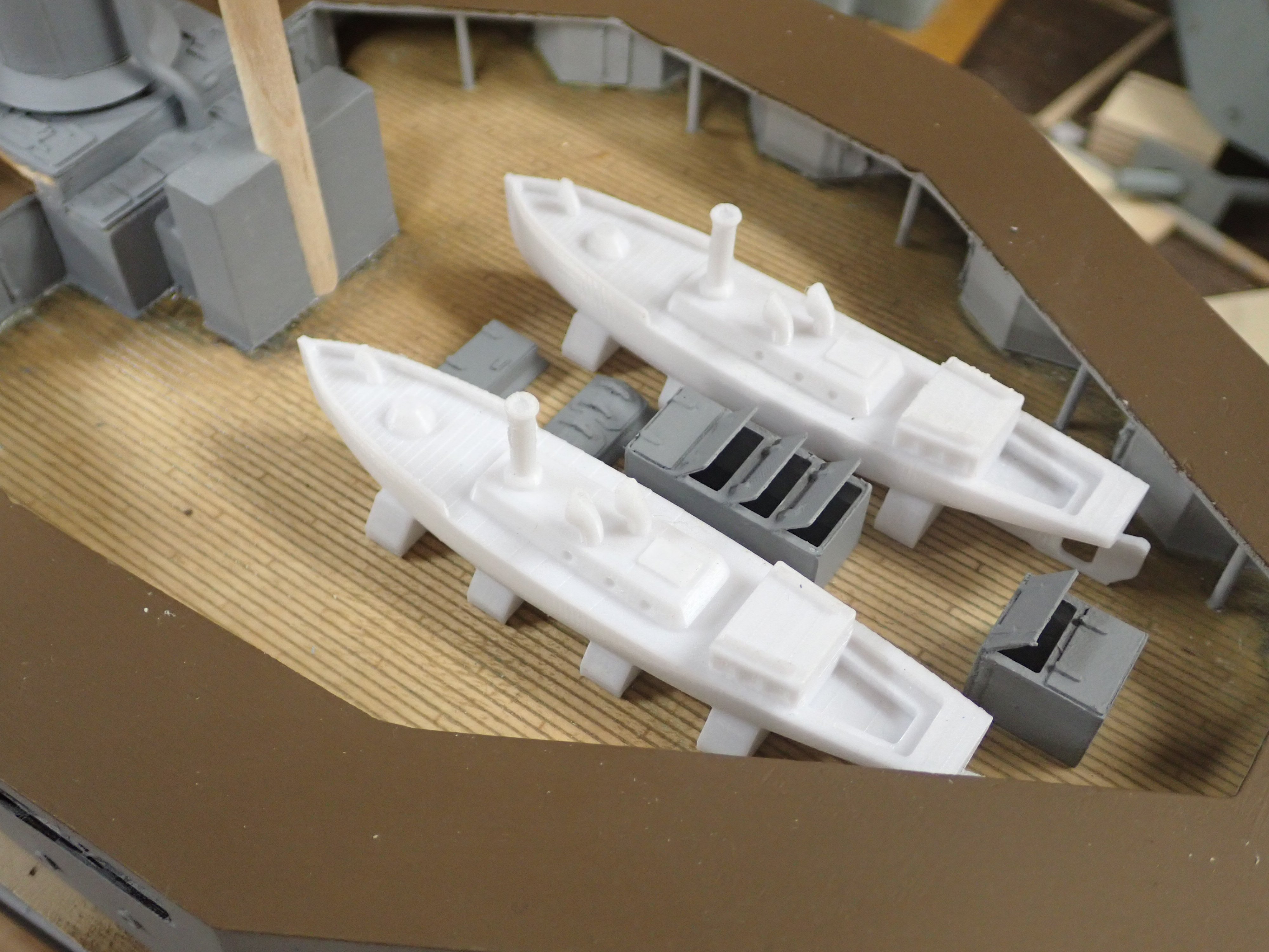

Aft well deck, with some open engine room vents, a closed skylight, a closed hatch, and the pair of steam launches as yet unpainted.
As I mentioned there will be a ladder with handrails on each side. Somehow other boats have to cram in outboard of the launches.
Final shot: the painted funnel grates and steam vent pipes at fore and main funnels. My flat black seems to have become satiny near the end of the bottle which has happened to me before. Will be touching up.

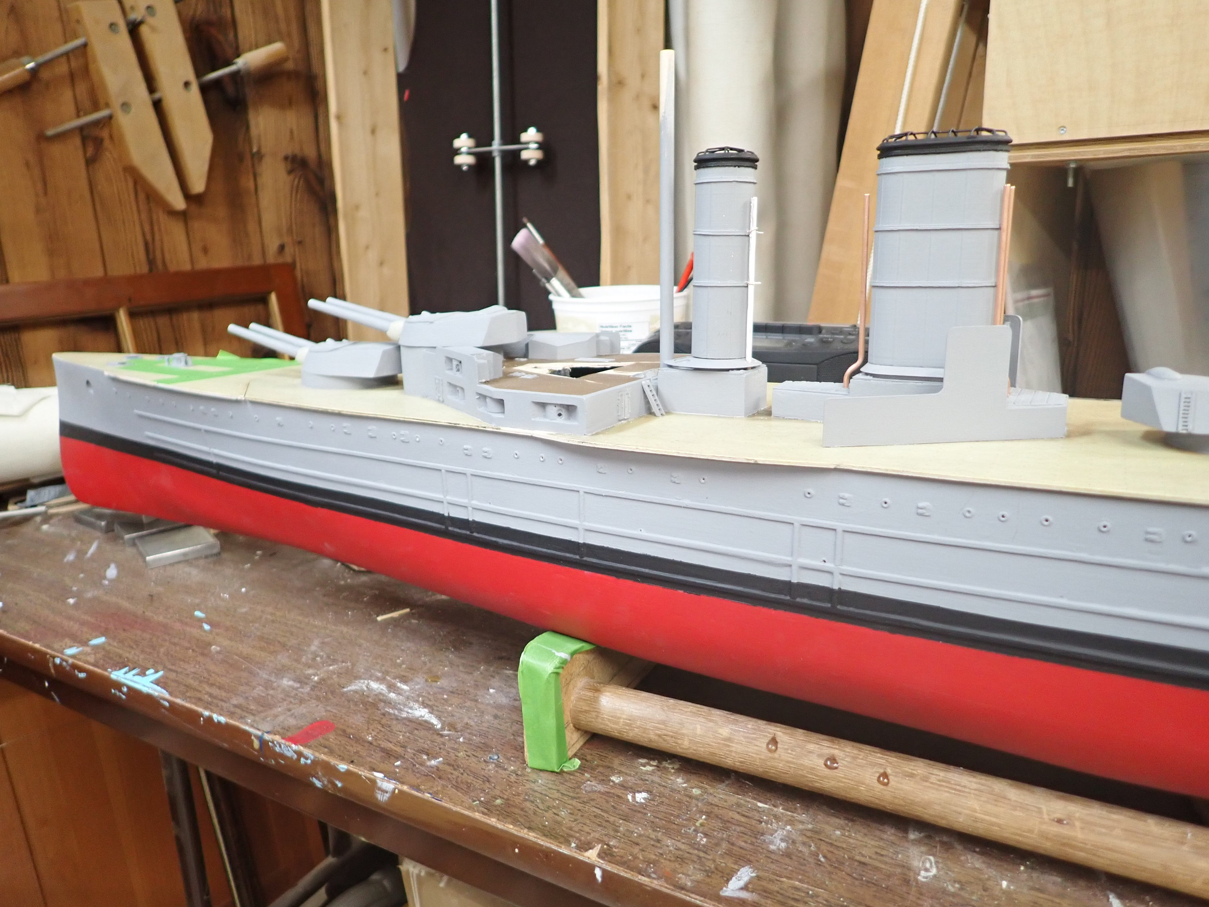

Rained today so no pool testing. I finished painting the grey around the deck periphery and on the torpedo net storage shelf. She has a much more finished appearance with that done. Also reprinted all my weather deck hatches, skylights, bollards, cleats, and breakwater with the smaller 0.2mm nozzle and everything came out nice and crisp. Drew the 13.5" director platform and "spotting top" in CAD and printed them too.
Reprinted parts.
Torpedo net shelf and deck perimeter painted.

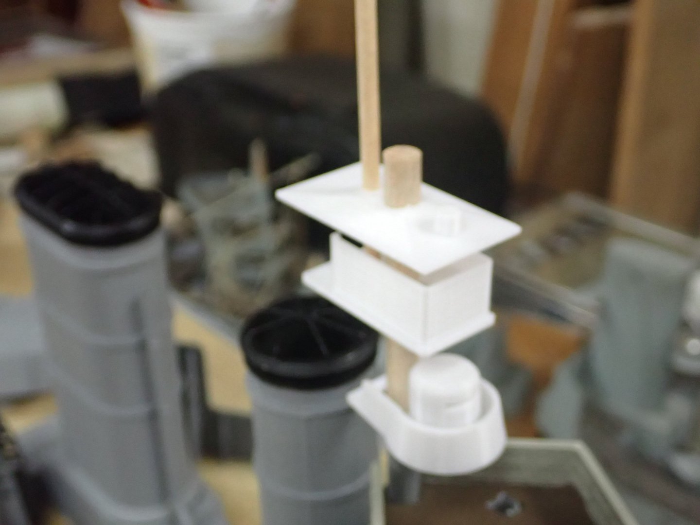

Director platform above compass platform; spotting top above that; fore topmast inserted but not trimmed to length yet. Sorry for the focus.
It turns out my foremast is a little closer to the funnel than drawn so I will have to make some adjustments to the spotting top and reprint.
