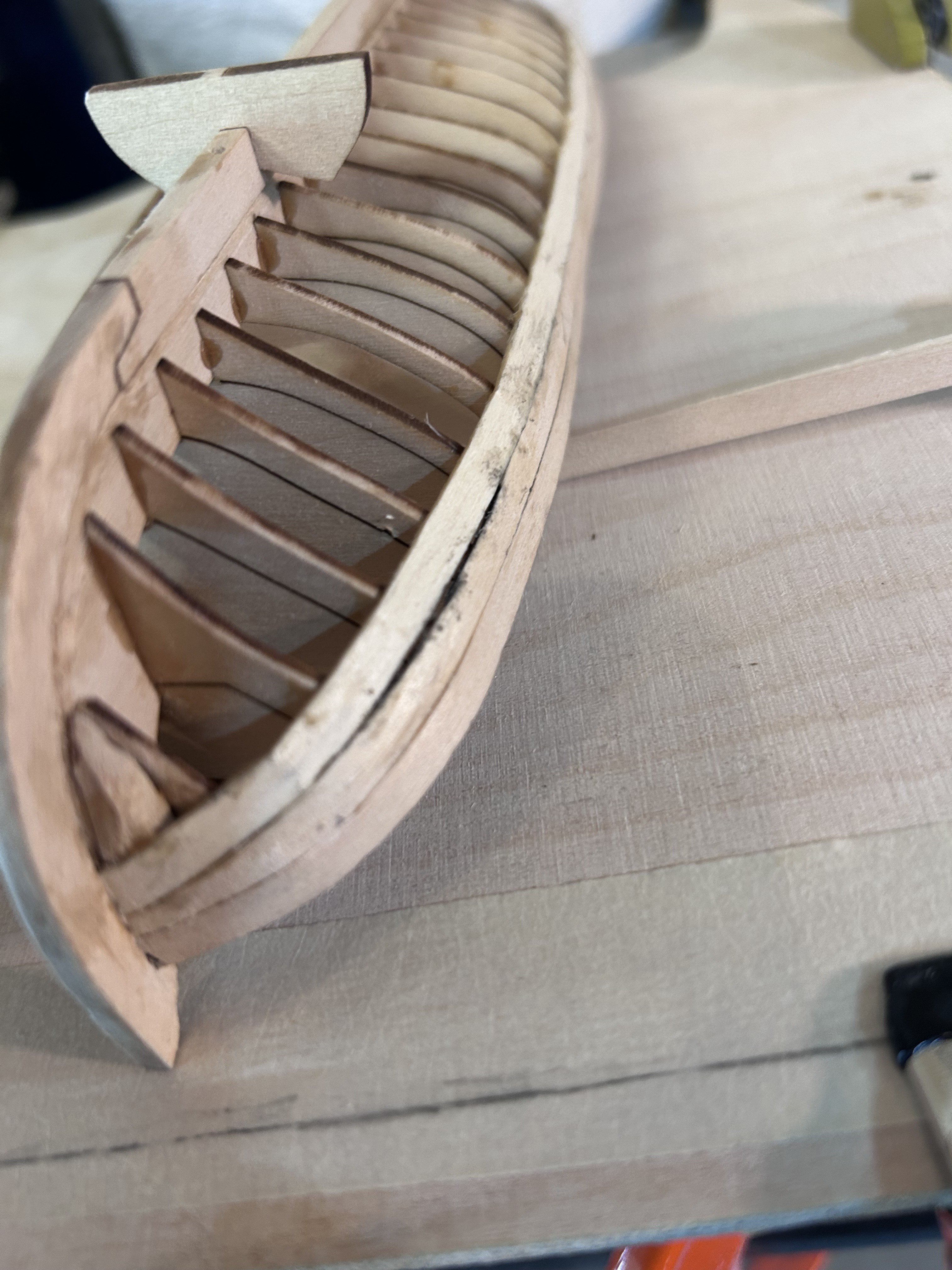

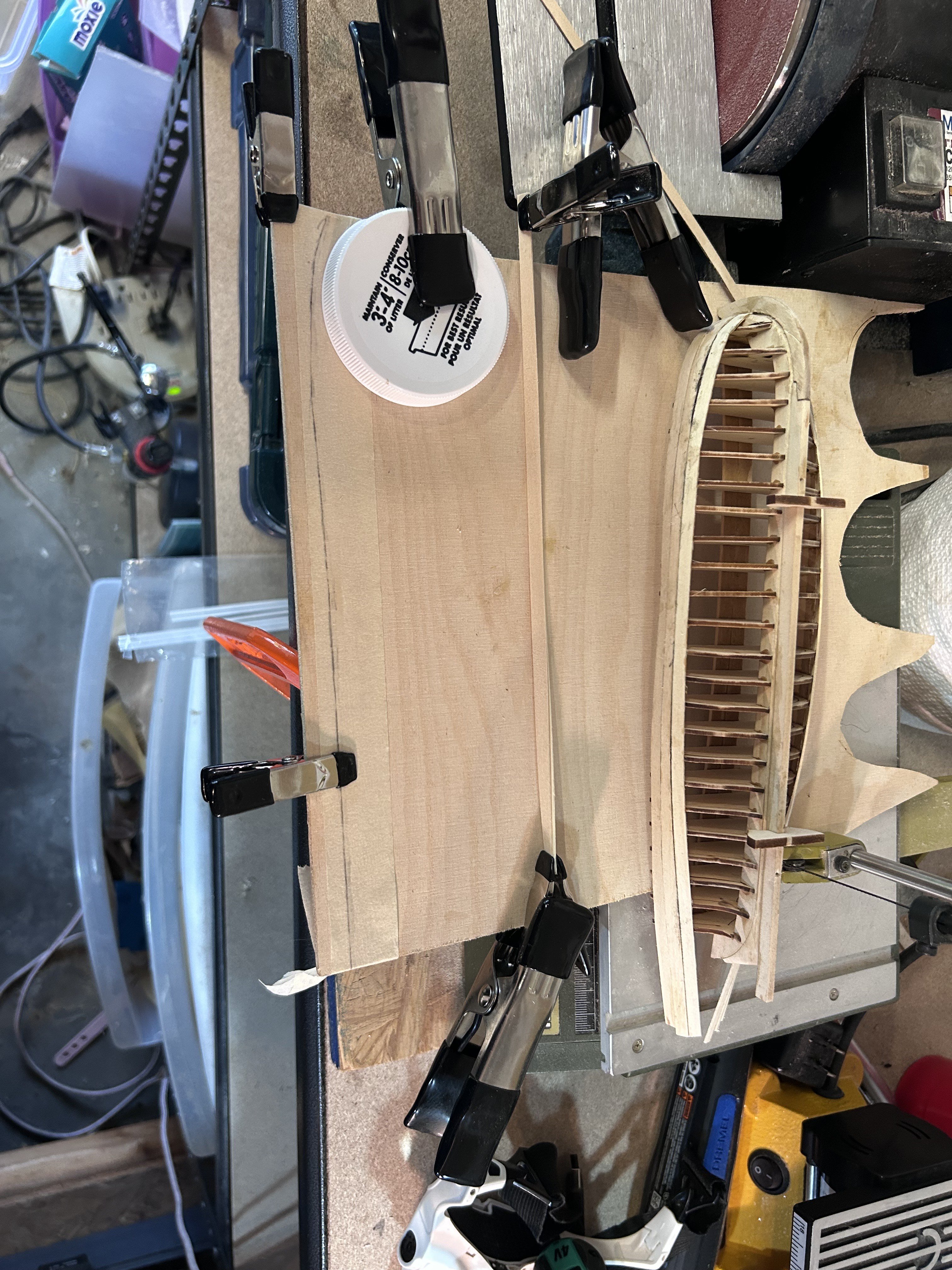

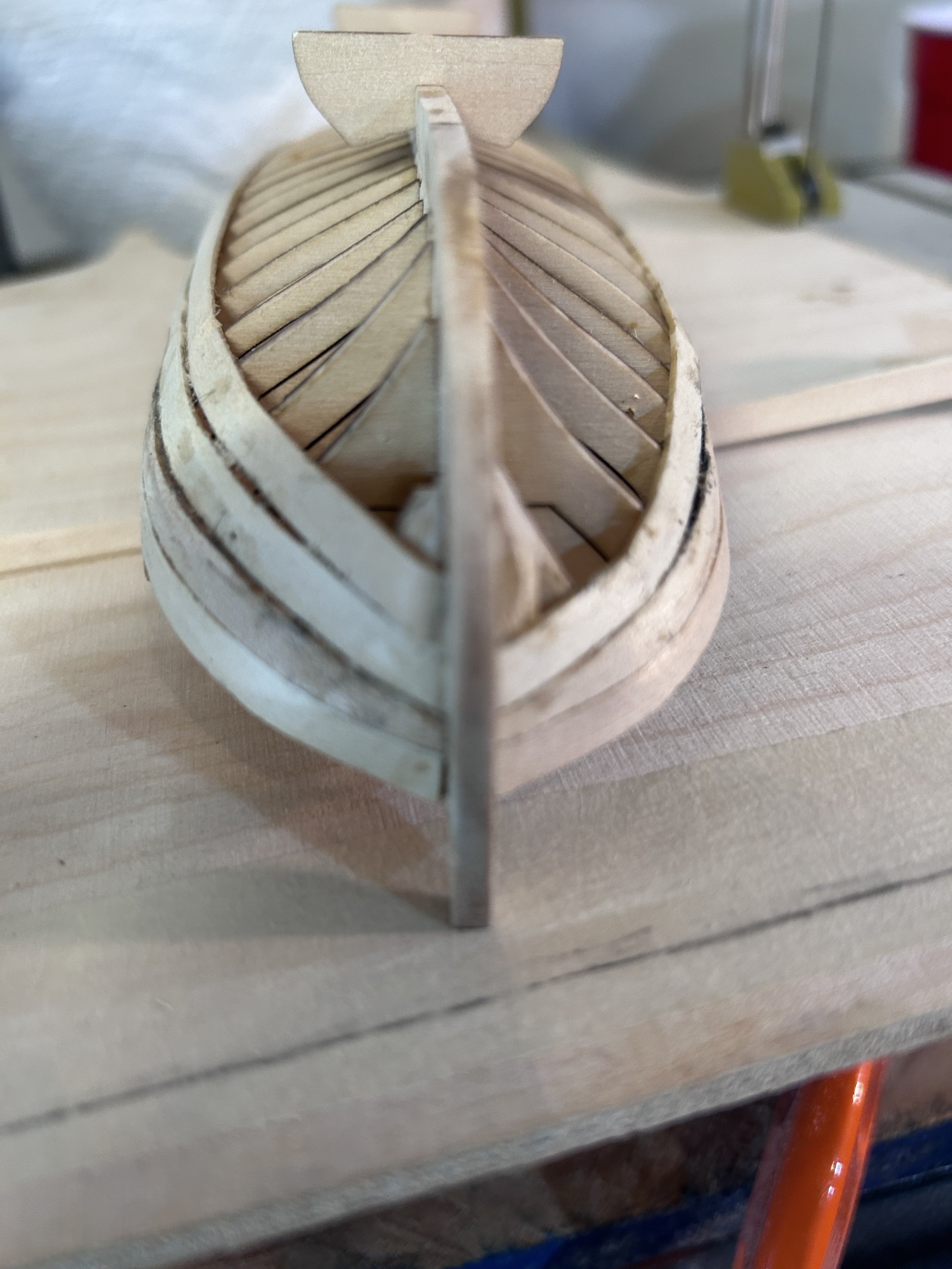

I need some help. I'm working on Model Shipways Pinnace and it is turning into a planking disaster. This is the 5th ship I've planked, but all others I've been able to hide my sins with heavy sanding and paint jobs. This one I cannot.
No matter what I do, I end up with the clinkered effect. I've tried a few different techniques, but I feel like I'm missing something fundamental.
At this point, I'm about ready to throw the Pinnace in the trash and stick with plastic models. ☹️
Try to start tapering your planks from the bulkhead that starts to reduce in size( length measured with a tape measure - if that makes sense) you really should be tapering planks to around 50% of their width by the time they reach the bow. Also try not to twist or bend planks unnatural or against the grain. Best of luck, don’t give up.

There are already some very good tips given above. What strikes me (at least it seems so in the pictures) is that the fairing of the bulkheads looks very minimal.
In addition of course the tapering of the planks and side bending will help really well with the clinkering effect.

  'Fairing' (sanding angles to) the bulkheads, especially in the fore and aft areas, will help - bending a springy wire over the frames will show both high and low spots needing fairing.  Prying off what is there and re-planking is recommended at this stage, which is not too far gone.
  Using thinner planks to begin with (so the ones supplied can be cut in half lengthwise, if even by using a steel ruler and multiple cuts with an X-acto knife), as well as tapering the planks toward the ends will help greatly.
  Soaking the planks in warm water until soft will also help.  Then before gluing, going over the plank with a warm to hot iron will increase flexibility and drive off excess water.  Use wood glue (like Titebond), and the glue will penetrate the mating surface of the damp plank and not affect the bond.
Edited by Snug Harbor Johnny
  • Solution

Hi rhephner, in the second and third photos it looks like you tapered the second strake that you installed on each side. Whatever you did with those planks continue doing that. Don’t move on to the next plank until you are happy with the one you are working on. Like everyone has stated, check out all the info and don’t give up. Good luck!
Best Regards……..Paul
My first plankings (first and second) on my Vanguard Sherbourne were absolutely terrible. It took watching several videos, reading a bunch of build logs, and reading some instructions to kind of get it. As @BurgundyModels said, you need to get the 3D right in your head and it’s not intuitive. I ended up buying some more easy Vanguard fishers (working on the Ranger now) and this second strip planked model was better, incrementally.
The model you’re working on seems small and has quite a pronounced bow, both of which I’d imagine would make planking even more challenging. Doing more faring of the bulkheads probably needs to be done, but I imagine part of the challenge is that you need to edge bend, taper, and add a curvature bend.

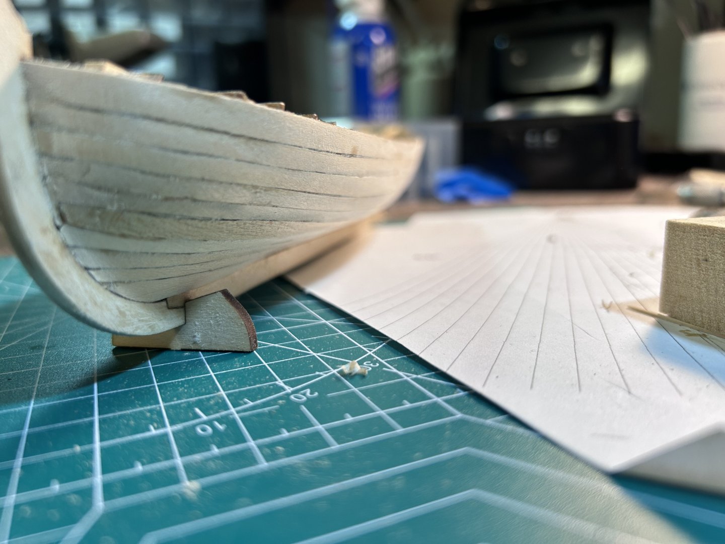

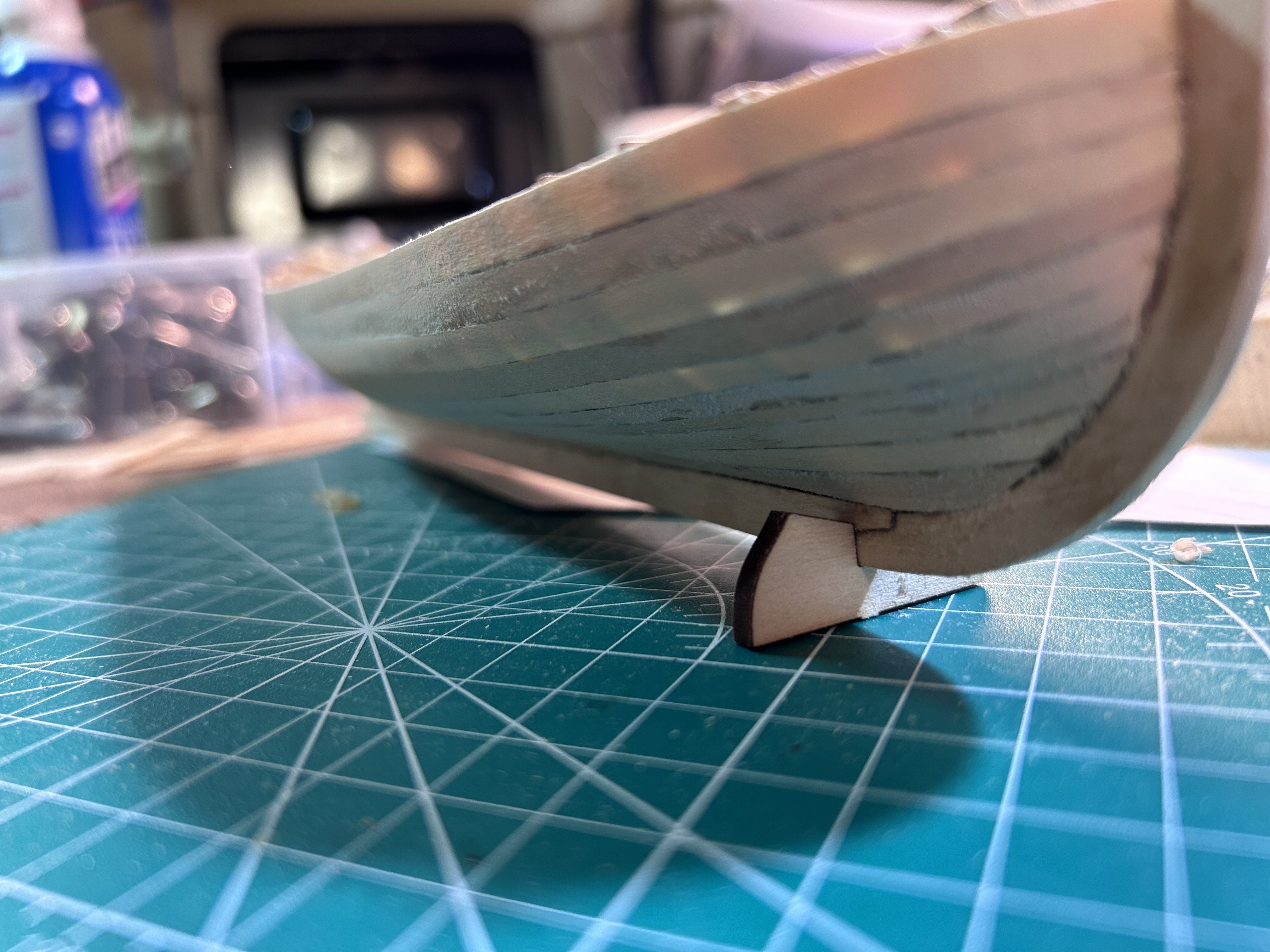

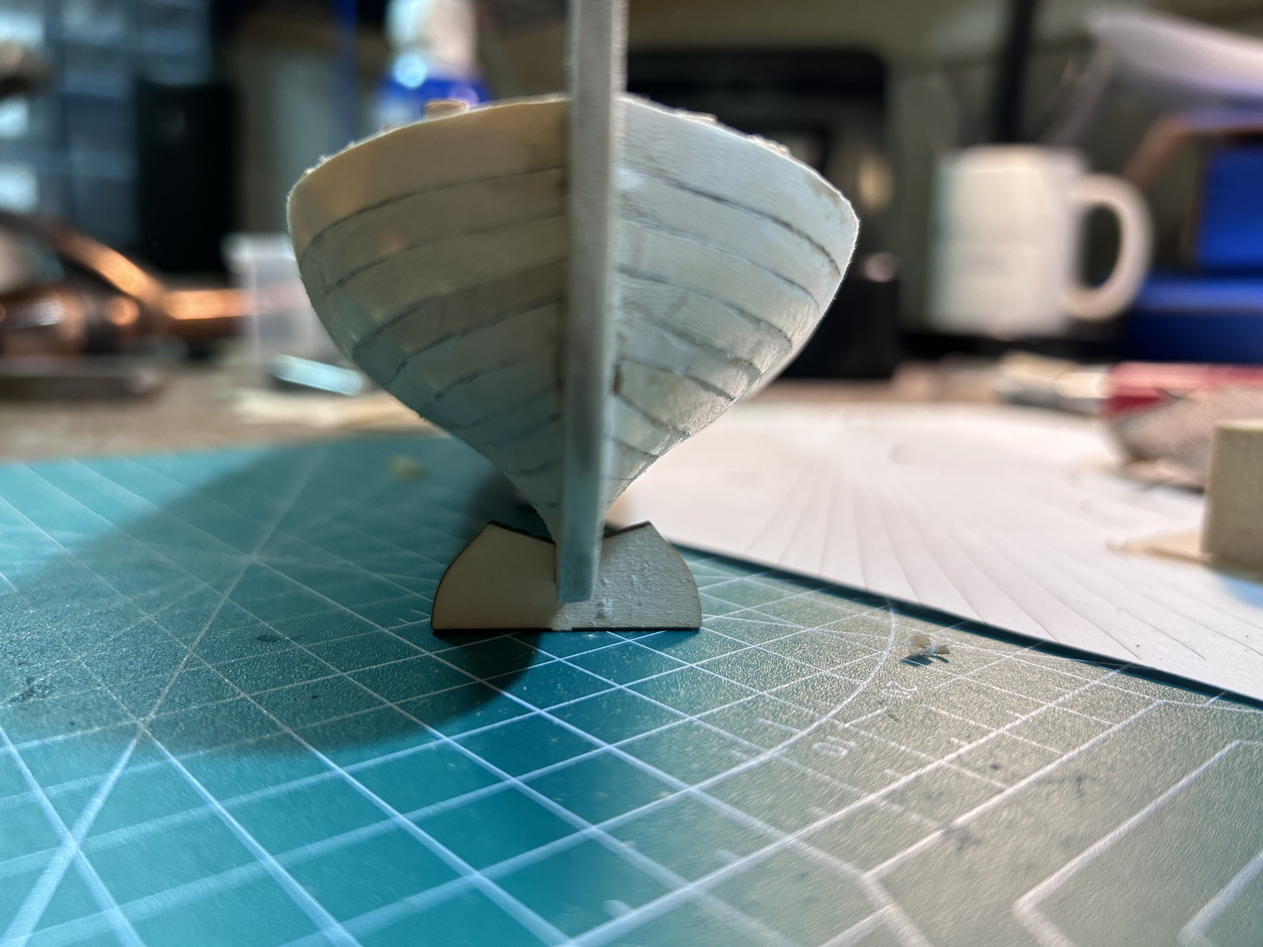

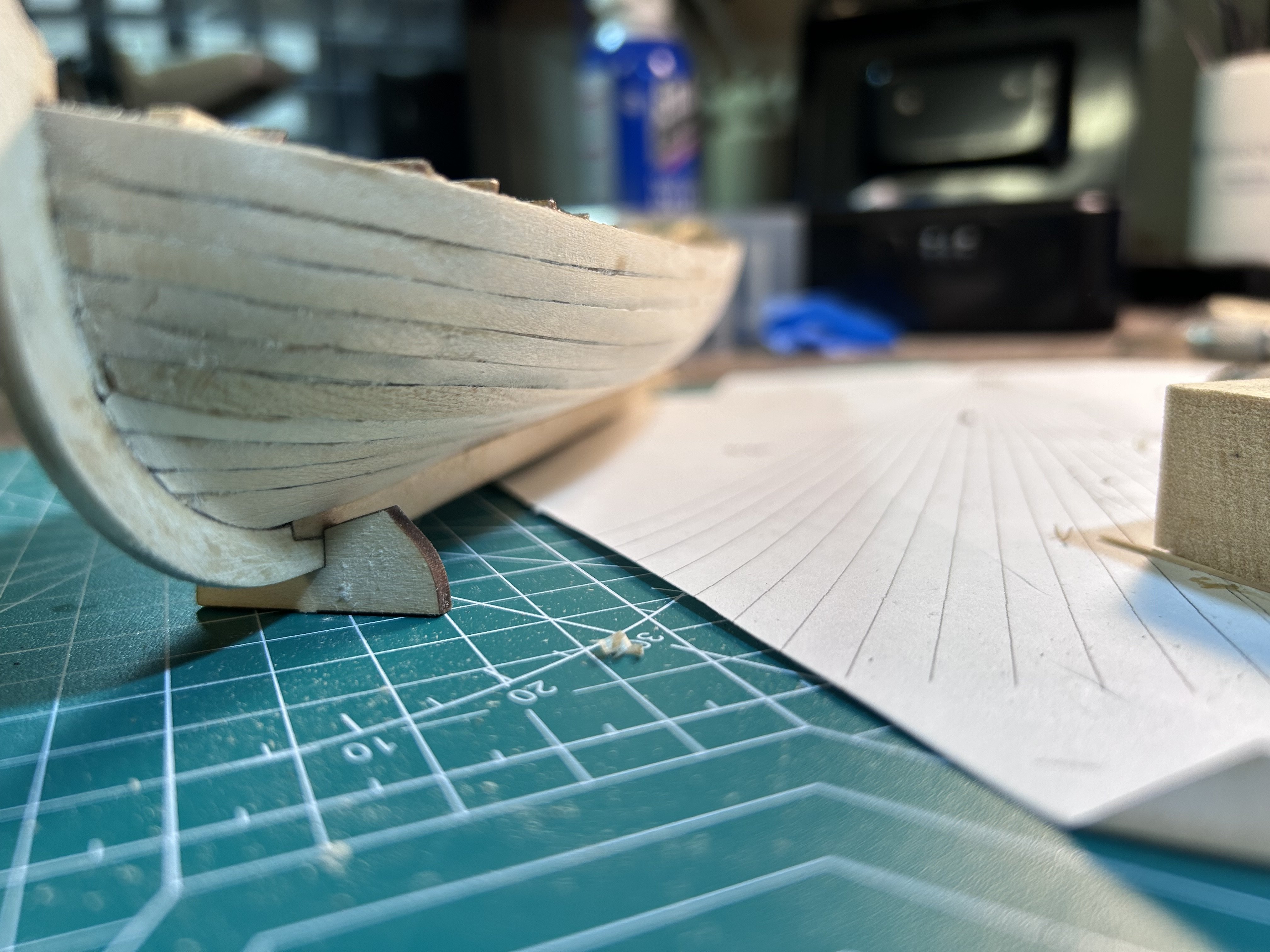

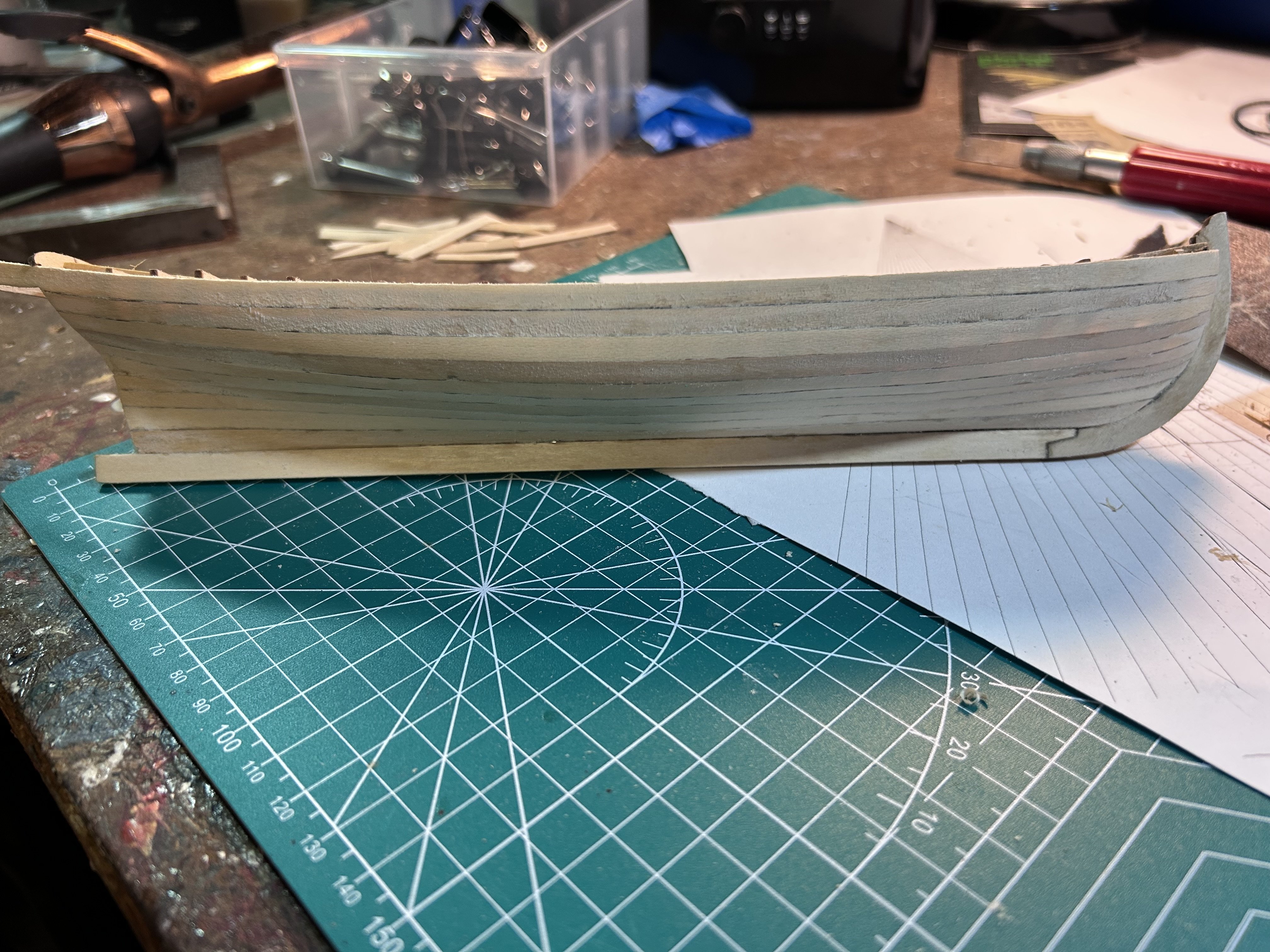

Following up on this post. This was the Model Shipways Pinnace kit. It went on sale again, so I decided to buy another kit and start over. The second time went much better than the first. I used a plank fan, measured the tapering of the planks, laid out bands, and used a curling iron for bending.
I still had some clinking and had to add to build up the frame nears the bow, but I at least managed to get all the planks laid. You can see from the pictures that one side didn't quite line up like the other so the final plank on the port side is a spiling plank. Overall, not perfect, but much better. From here, I'm going to put a light stain on it and a shellac.
Suggestions, comments, etc. welcome.
Thanks.
Rich

Looks like quite a respectable job to me.  You've made great strides from the first effort.  Well done!

It looks like you are beginning to conquer the hardest part of the hobby.    I don't have a single model that didn't end up being painted on the bottom; you can also add weathering to a painted hull to turn what you might have initially considered a liability into an asset. Some modelers also like to add a second layer of thin veneer planking of high-quality wood over the top of the hull.  P.S. You can also "save" your first model by strategically gluing thin strips of balsa or basswood, sanding smooth, painting, sanding, and then repeating as often as it takes.

The “clinkering” (bulges?) are caused by pulling the plank end down towards the keel to get it under the neighbor above.  Instead, mark where the plank overlays its neighbor above and taper the plank.
You can’t bend a plank down towards the keel.  You can only lay a plank straight down on a bulkhead, slide it up slightly to press against the installed plank above, or twist a plank to say run up the stern.  Very little force should be needed to install.
Make sure a plank is properly shaped before installing, then it will be easy to install.  Ideally if properly shaped there will be no gaps.
If a lot of gap filling and sanding is needed, something is wrong, look at the books and videos, study the techniques,  and find out what works for you.
Good luck!
