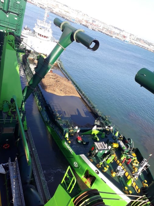

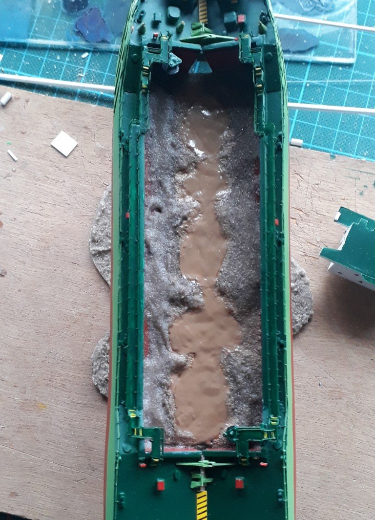

Hi Keith,
This is the inside of my split barge Bengel.
Might give you some inspiration.
The rougher side dredge material is a mixture of acrylic gel with beach sand, the glossy wet look is caused by the glossy acrylic gel. You can add more or less sand for a rougher or smoother result.
The watery inside is that same acrylic gel mixed with brown acrylic paint. You could add streaks anthracite paint in it as well.
Roel

And yes, that is what I am doing for simulating wet sand, to play with acrylic gel and gloss acrylic varnish on fine-grained sand.
I was too lazy to go back to the beginning of the building log to check and wonder, whether loaded the whole dredged material into the barges, or whether there has been some kind of sorting on the (bucket?) dredger? I wouldn't want to know about the impact on the river flora and fauna of the dreging and the release of the tailings though ... The water must have been turbid for miles down the river.

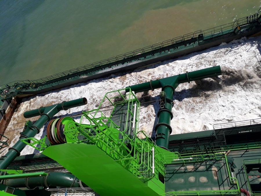

It does give an impact as Wefalck mentioned.
There is quite a lot of turbidity, depending on the material you are dredging. Some examples below. If you look on the right, you can see the brown cloud around the barge. Mostly from the dredging itself, but a lot of it from the water overflow of the barge as well.
And the condition of that barge has a sort of similarity to the dam. The heavy material sets down, while the water evacuates by an adjustable overflow. The water however is full of lighter sediment itself, flowing back to the environment.
So practically it will also pass any dam when dredging nearby that dam. (In case of Keith's barge however, the flowrates and velocities were obviously lower).
In this particular case the depth at which we dredged was reduced by 1 meter on a later survey. We did some testing and the sediment remained in suspension for up to 3 days. A period in which the life in that area is obviously disturbed.
Turbidity is an issue nowadays. In some cases they don't even allow an overflow and basically make a barge transport a lot of water with a small amount of dredged material back to sea on each trip. Creating a huge waste of fuel to transport water to the sea, just to avoid turbidity. Dredging will always have an influence on life on the river-/seabed, there's no avoiding it, however, I believe humanity sort of agrees it's necessary.
I do not judge, but saying it won't have an influence is certainly not correct. What scale this influence has, is up for discussion as the "original situation" is questionable (before or after the coal industry, before or after the construction of the dam and so on)
That said, @Keith Black, if you need more examples of a barge filled with dredge material, let me know.
Roel

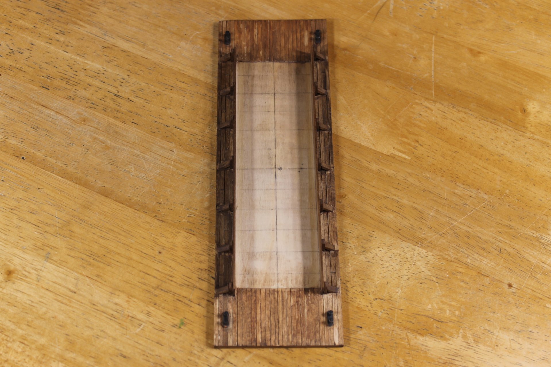

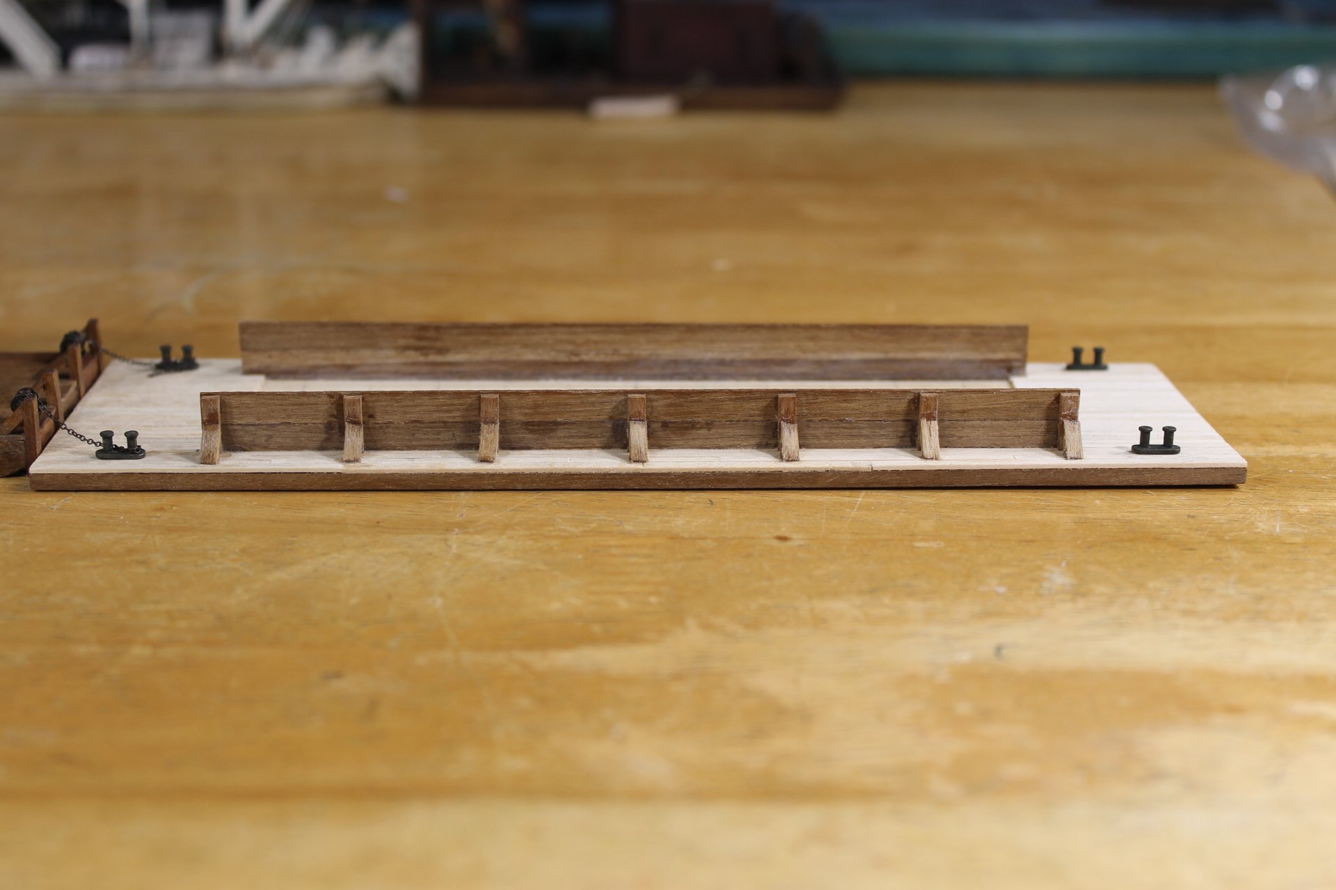

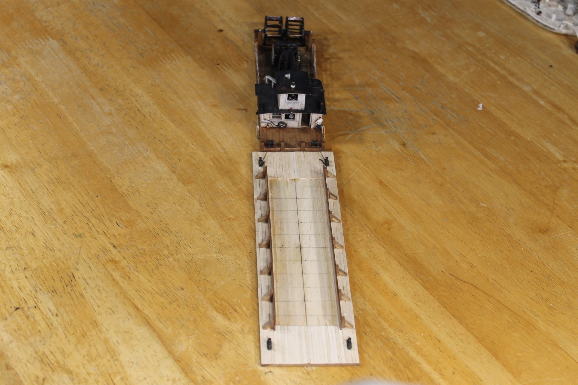

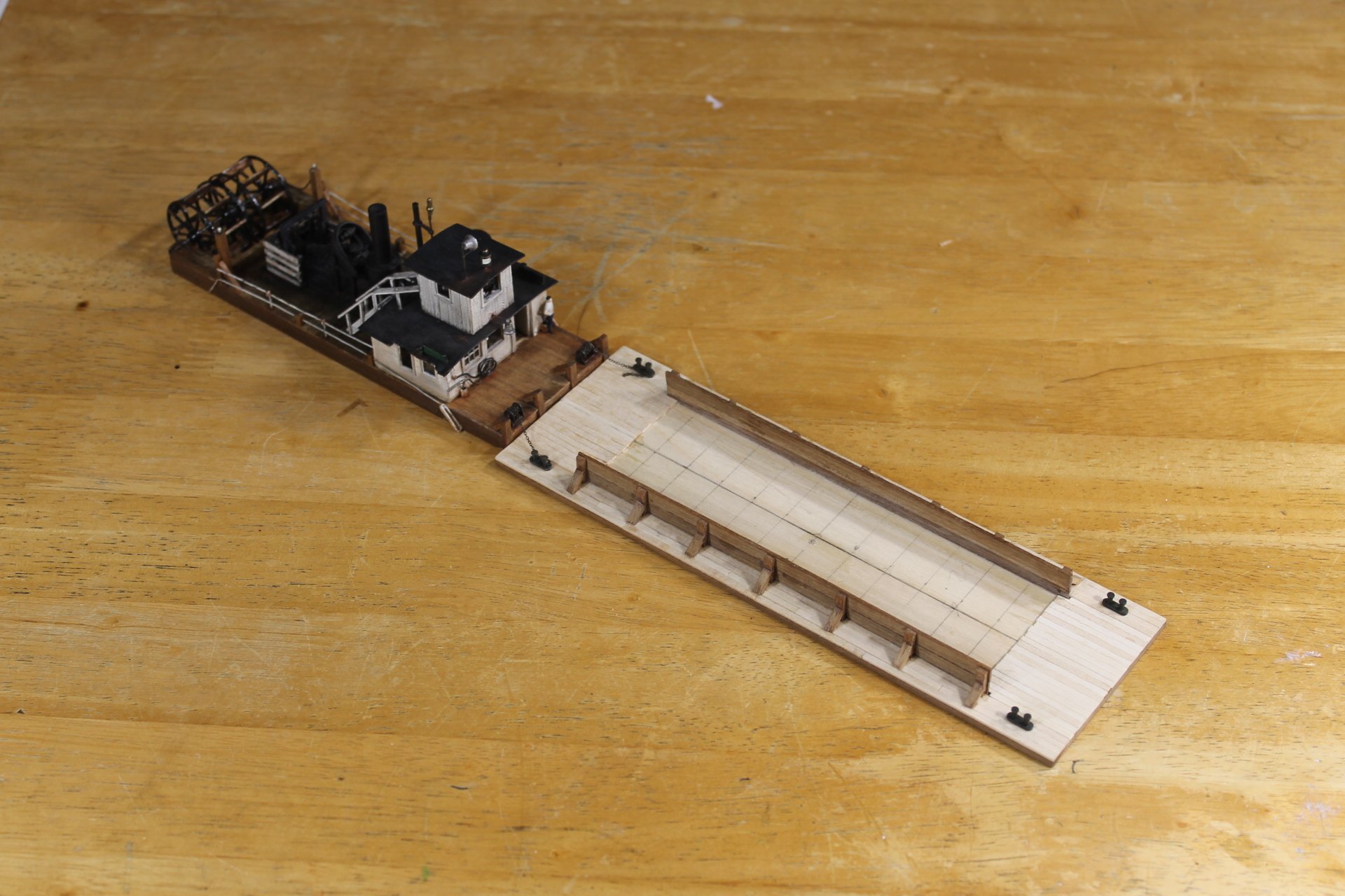

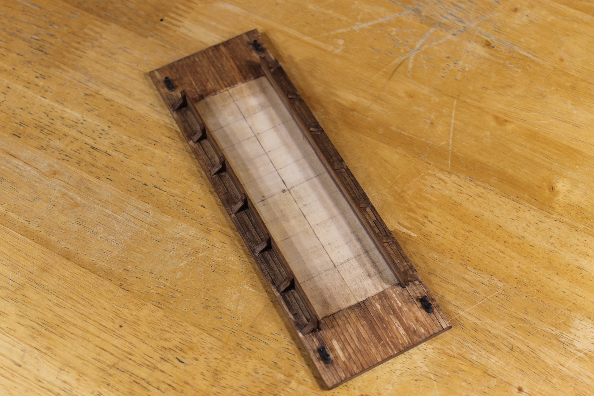

 The wood portion of barge is basically done. I still need to add layers of weathering.
 I didn't plank the deck where the dredge material is going to be as it didn't make sense to use wood supplies needlessly.
 I made the barge smaller, 26 ft x 80 ft rather than the 30 ft x 100 ft i had originally considered for two reasons. 1) the feel of the 30 x 100 footprint seemed to overpower the towboat and 2) this is the same length as Lula and the pile driver and would make displaying the two side by side much easier.
 I'm leaning towards leaving the ends of the barge open.
 Thank you to all for following along.

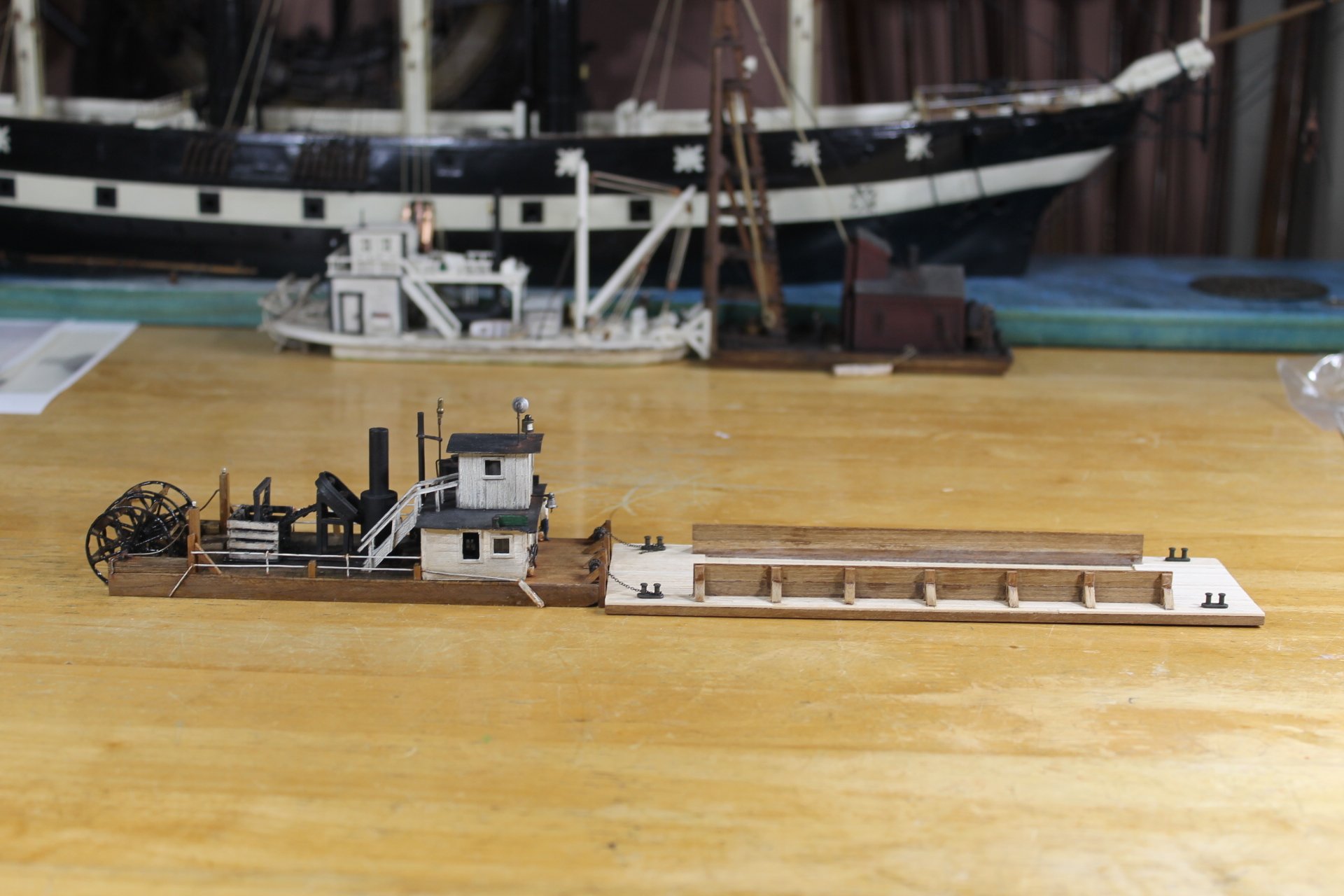

Keith, displaying them beside Lula will be awesome!
Best Regards……..Paul
 Thank you, Paul. When I line them up on my worktable they look as if they would display well together.
 Thank you to all for the kind comments and likes.

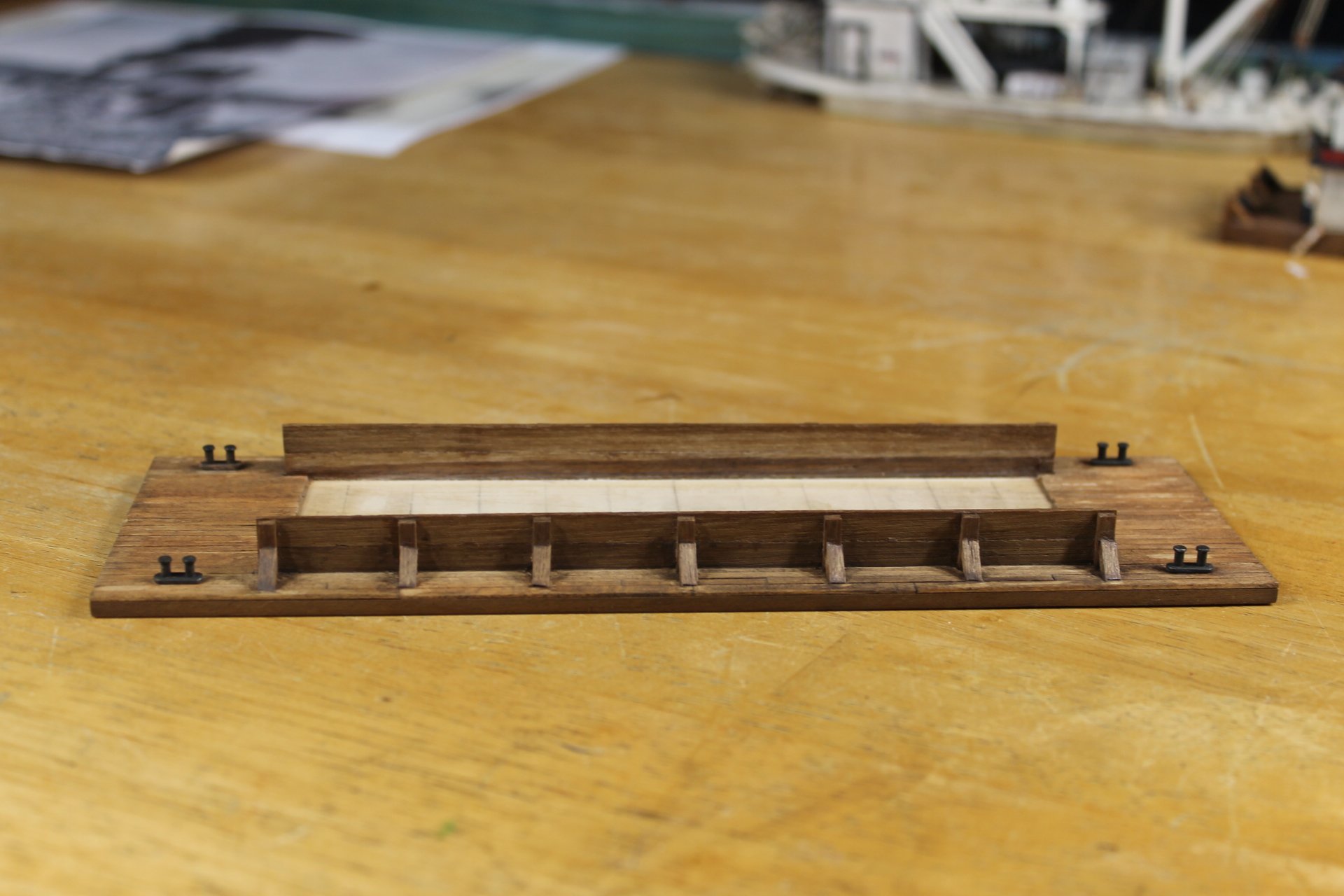

 My camera didn't wanna take good pictures tonight for whatever reason, stupid camera. But that's okay because it's just photos of the barge with it's first layer of pastels.
 I don't want to add aymore color till the barge is filled. Hopefully tomorrow I can do material testing.
