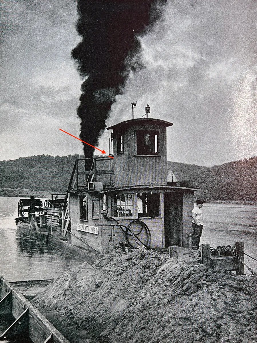

 Speaking of steam whistle line brace....
 This photo shows the brace. The angle suggest (to me at least) that the brace carries past the steam line and anchors into the pilot house wall. Do my colleagues agree?
Something like this? You guys realize this is going to cause project delays and cost overruns. :)

That would work - with the attachment point on the pilothouse high enough so the crew don't bump their heads.  I realize you just randomly terminated the red line at the pilothouse.

 Thank you again, Kurt for keeping me honest. In my #303 post I was laughing at myself because I was trying to skate on making the brace thinking, will anyone really notice? And sure enough, I was caught red handed and I find it a laughable (at me) situation.
 As far as the pilot house attachment point.....1) It could work out where I'm only able the brace between the exhaust stack and the steam whistle line. 2) If I am able to attach to the pilot house it's probably going to be a arbitrary point. I'm not too worried about the height as that attachment point would be on the port side of the railing and resins for crew access to that side of the railing would have been minimal.

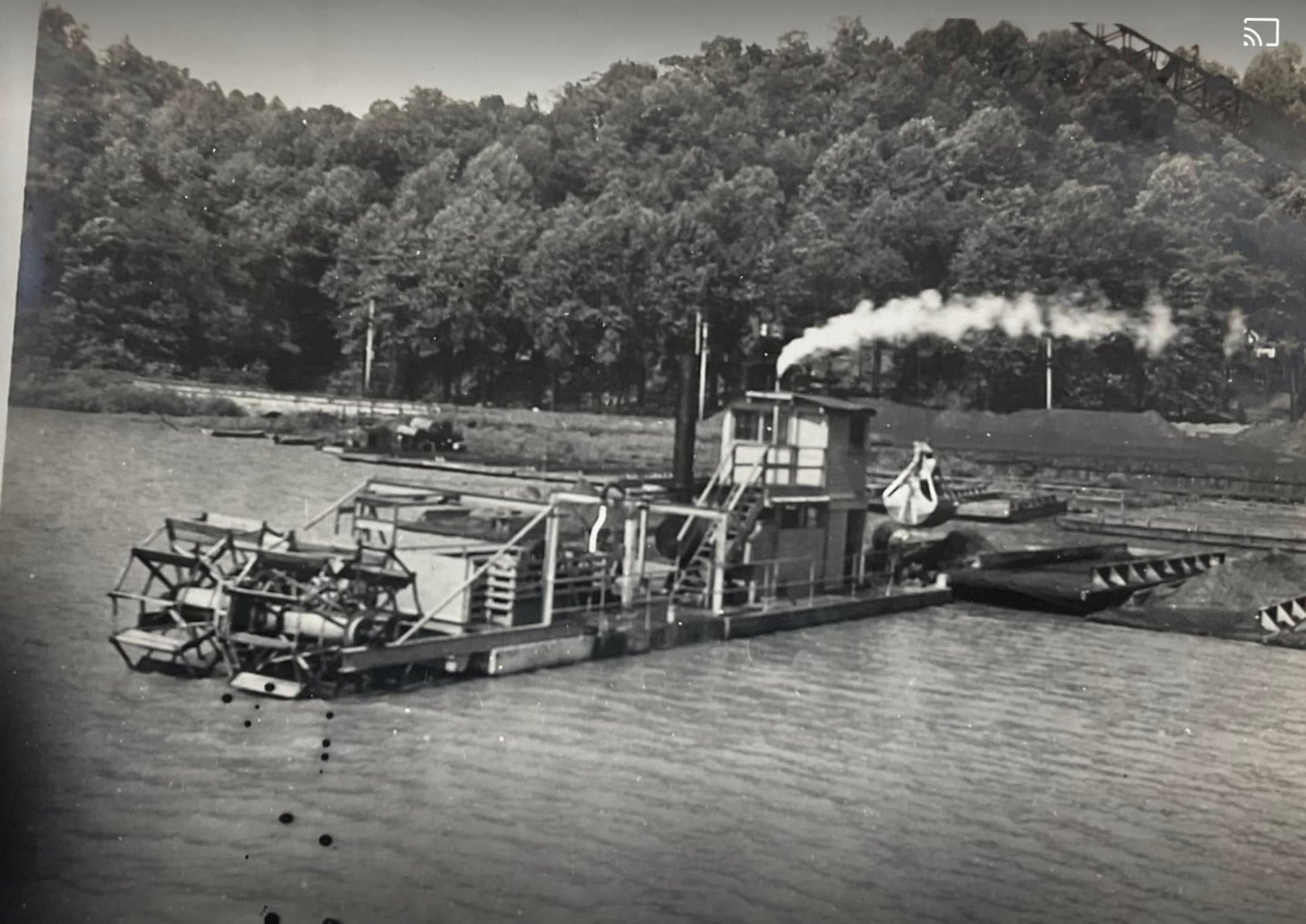

While we're on the subject of leaving things off.......
 I can't confidently determine what this is.
At the start of this build, Eric (Cathead) thought it was a ship's boat/skiff. I don't think that's what it is for two reasons.
1) If one enlarges the below photo till it pixelates one sees something like what I've drawn. The black object I took to be the water tank and it made sense for it to be there because that would have been adjacent to a pump.
 2) if in fact the black object is a water tank, once added there's insufficient room for a ship's boat/skiff.
 I think what we're seeing (the white object) is a poly tank added when the water pump was upgraded requiring additional tank capacity. Poly tanks didn't come about till the 1960's. These photos could have easily been taken in the 60's not 50's as I had originally thought.
 Whatever it is I'm leaving it off due to uncertainty and making the push boat as it would have been before a possible water pump upgrade.   image.jpeg.85886639676091de6d6121095e6b05e0.jpeg
 The below is a more modern, larger, and better designed Susquehanna towboat and for the life of me, I don't see a ship's boat/skiff. In the limited number of Hard Coal Navy photos I don't see a ship's boat/skiff on any of the vessels.

For the life of me I can't NOT see that as the bow of a small upturned boat with the stem and keel arcing over the top. The strongest argument I can think of for it NOT being that is that it looks rather deep, more like a maritime boat, especially when it can't be all that long. It would seem far more likely that this vessel would use a simple shallow squared-off jonboat.
Otherwise could it be some kind of stern-facing vent hood? But there isn't much room under it for any sort of equipment that would need such a large vent, and I can't even think of what that would be. Presumably they didn't have a restaurant-grade commercial fryer in there...
 Thank you for your input, Eric. I value your thoughts including "Presumably they didn't have a restaurant-grade commercial fryer in there."  LOL, that's funny I don't care who you are.
3 hours ago, clearway said:
it could be a barn or other building on the shoreline perhaps Keith?
 Keith, It does kinda look like a barn there on the shoreline..............you been standing too close to the tracks again haven't you?

Well, pretty much every modern river towboat has a grill/smoker out on deck somewhere, so maybe these guys were just foodies ahead of their time.
I can't make head nor tail of your 'thing', Keith.
When you clean up the image and zoom in it doesn't look like a tank to me, but I can't think of what else it could be.  Given the type of craft it's on, it certainly wouldn't be anything complex or sophisticated.
John
image.thumb.png.ef6b9ab055b127d3e6a0366a49c4882b-DeNoiseAI-severe-noise-SharpenAI-Focus.gif.29cb62ce8016b7d30b4a8ca9e9050fa7.gif
Just for the fun of taking part in this discussion, this last image teases my boat design thoughts enough to offer the idea that it looks to me to be the stem and forefoot of a (possibly) lapstrake craft, quite full in the bow, in order to be able to carry weight (See the size of the arms on that crew member) and perhaps it was simply some small craft which was scooped up inexpensively to be useful if needed. I have no more knowledge than anyone else though as to whether that was the case. Back to you, Keith.
 Susquehanna sausage on the barbie.  Yea, that's the ticket. :)
 It's a bloomin' mystery, John.
 Craig, there's only five feet from the water tank to the point where you see whatever it is. Not even close to the room needed for even a small skiff.
 I think it's a poly tank designed to go into the hull of a ship or boat. For whatever reason the tank wan't used for it's original intent (deal feel through?) and this ugly duck bought it because they needed a tank and could have cared less what it looked like, they just needed a light weight tank. They were able to get a deal on the tank and adapted it to their need by flipping it upside down and making it work.
 That's my story and I'm stickin' to it. :)

The more I look at it, the more I'm thinking we're actually looking at 2 things, with the darker object looking like a davit/ handrail or pipe and simply a white looking object behind it... By the angle of the picture their edges seem to coincide, but perhaps they aren't just object.
The forward pipe? seems glossy, it seems to have a lighter spot on the forward upper edge, which seems like a reflection...
Just saying...🧐
Just saying...🧐
To me it looks like copper tubing coming out the top of that black pipe going into the pilothouse to maybe a pressure gauge?

 I got the steam whistle line brace made and attached to the exhaust line. I couldn't connect the brace to the pilothouse wall as there just isn't enough room in that space to work and make a successful connection to the wall and lines. The distance between the steam whistle line and the exhaust line is 0.20 inches. I had to keep the brace higher than I wanted because I needed to get the jewelry plier jaws between the lines to work making the brace. It was fiddly delicate work, hopefully I learned a lesson and won't get ahead of myself in the future.
 The brace is made from a single piece of PE brass 0.011 inches thick and 0.042 inches wide looped around the lines with the ends meeting in the middle between the two lines and held together with CA.
 It looks okayish and I'm happy it's done. Back on schedule.

 I'm inching ever closer to the finish as I got the hog chains (such as they are) made and attached.
 Added some weathering
 The post that the hog chain rod passes through are 0.20 inches high and the hole is 0.15 inches high from the deck. The post are a little wider than I wanted but I needed the extra gluing surface,
That is one mighty turnbuckle but looking at the original photo below the arrow points to the turnbuckle end level with the water line.
