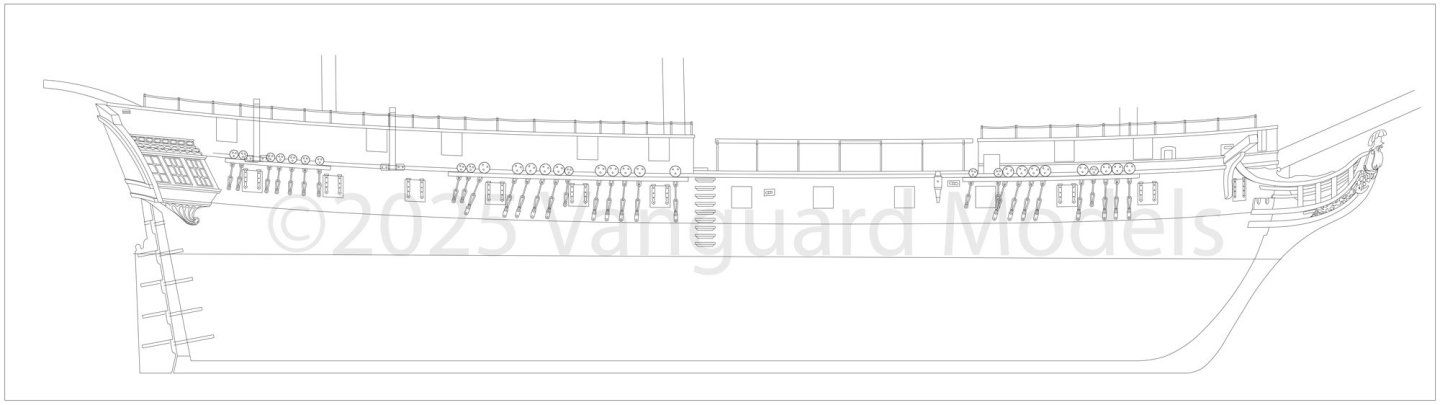

Here's an in-progress profile that Chris is currently working on, of Surprise. This will feature in the plans, along with a whole ton of extra folding paper for you to study.

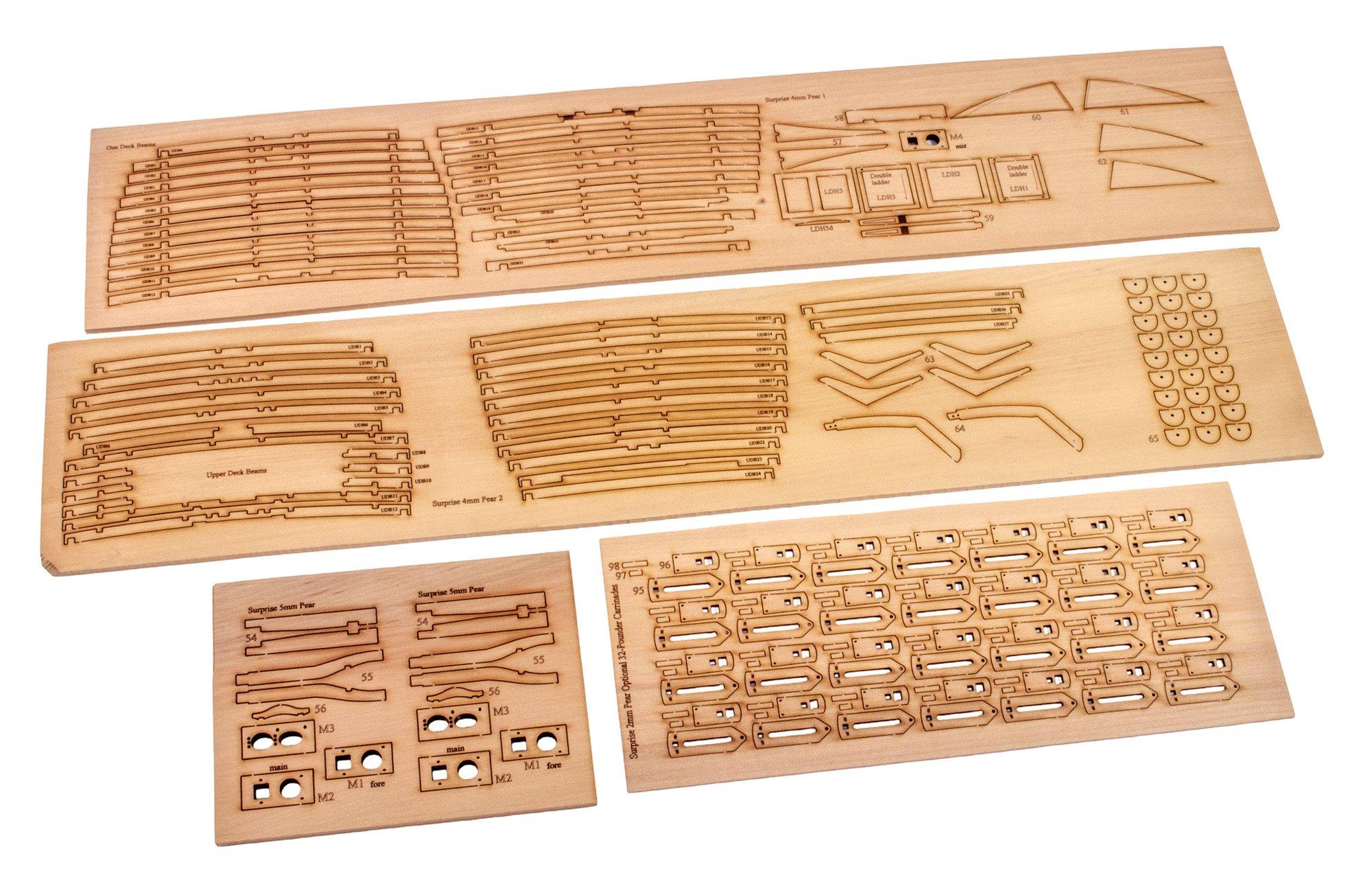

Surprise will be just beautiful. The etched gun deck gives a good idea of relatively narrow she was.

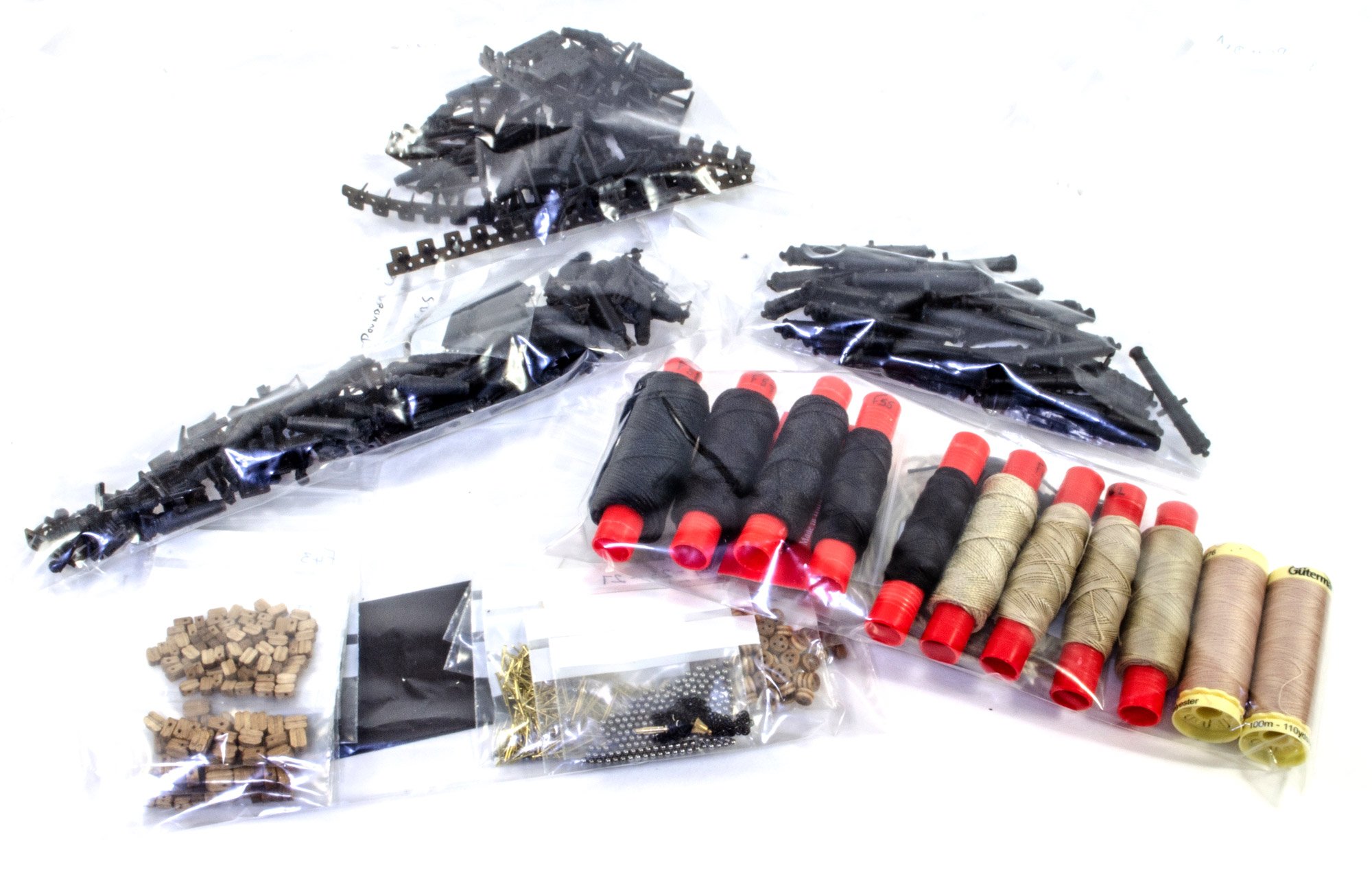

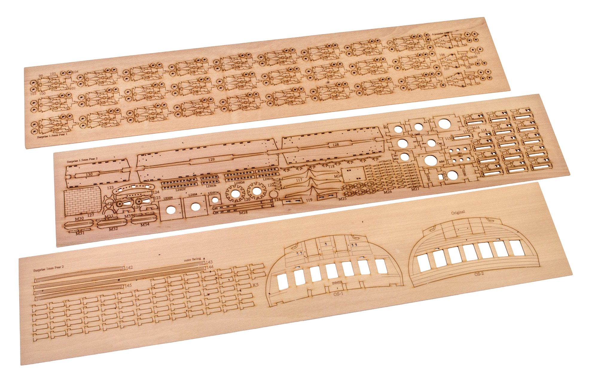

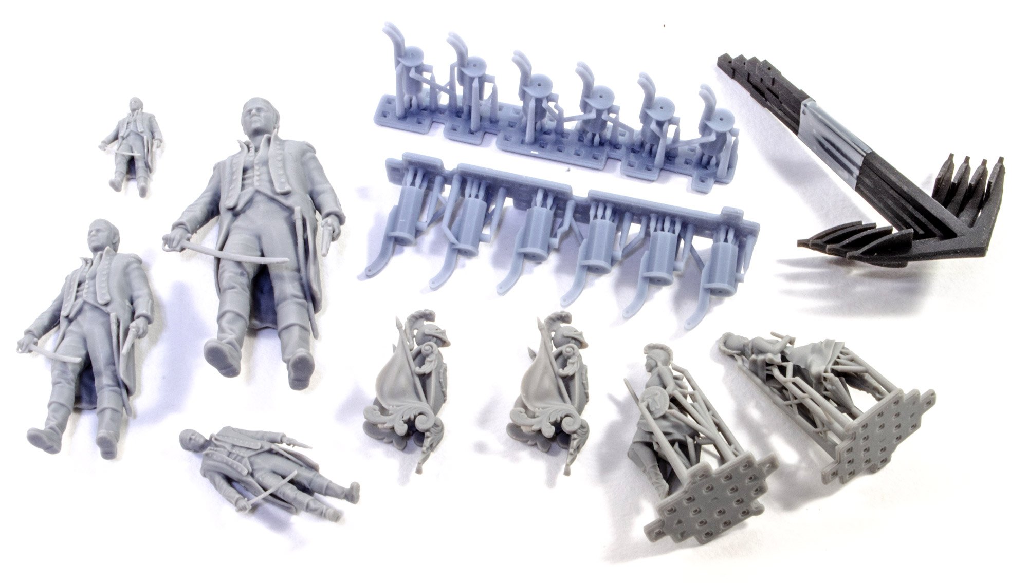

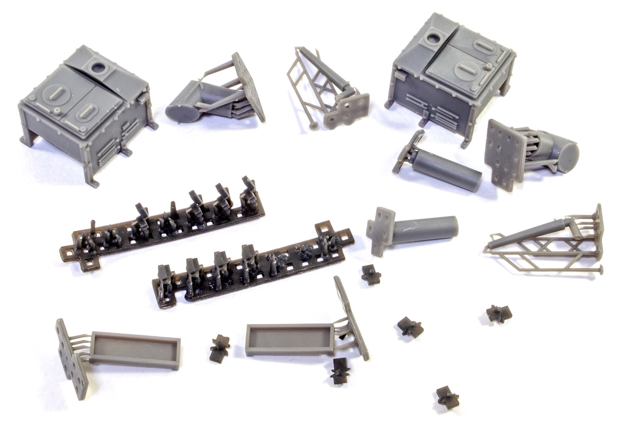

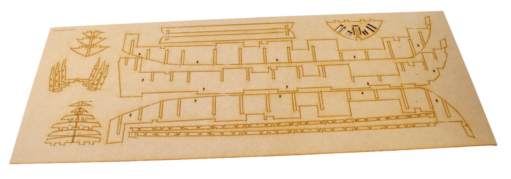

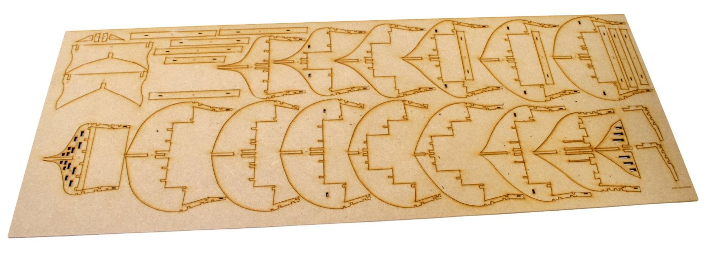

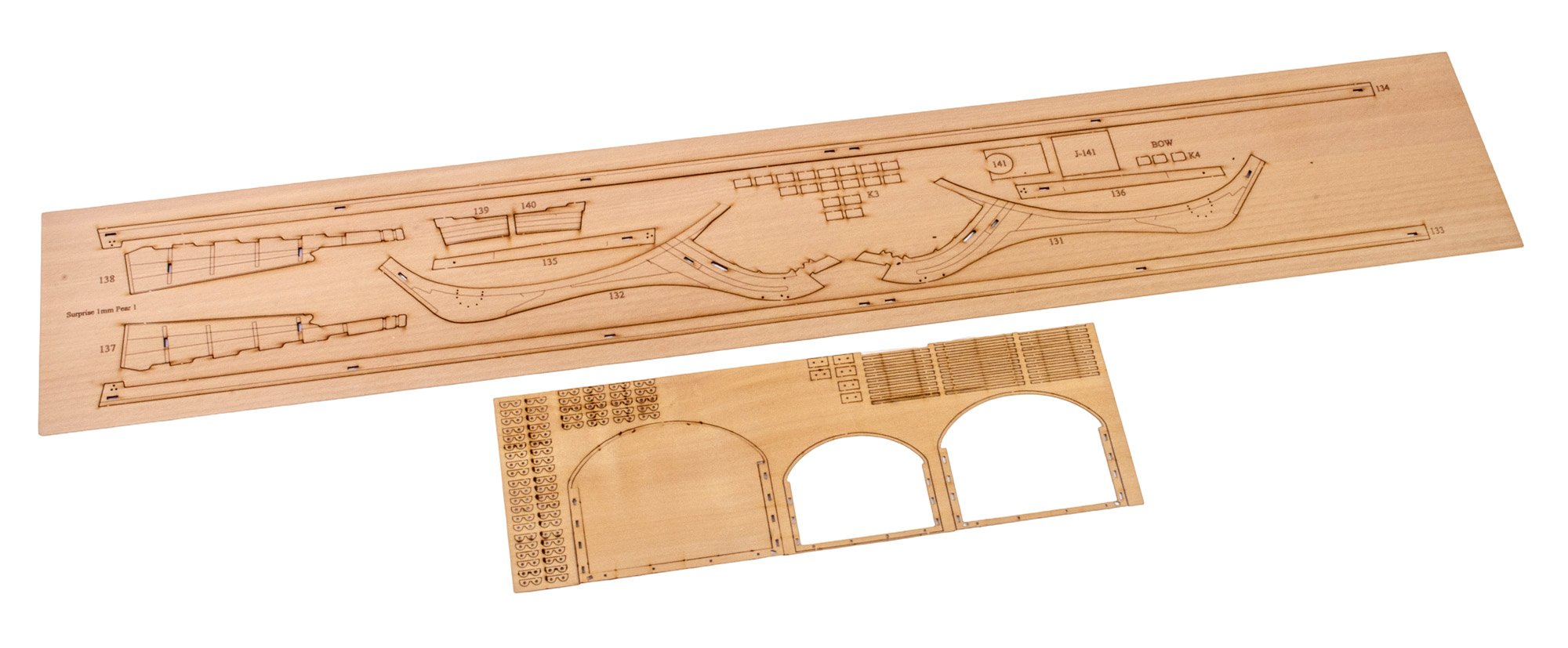

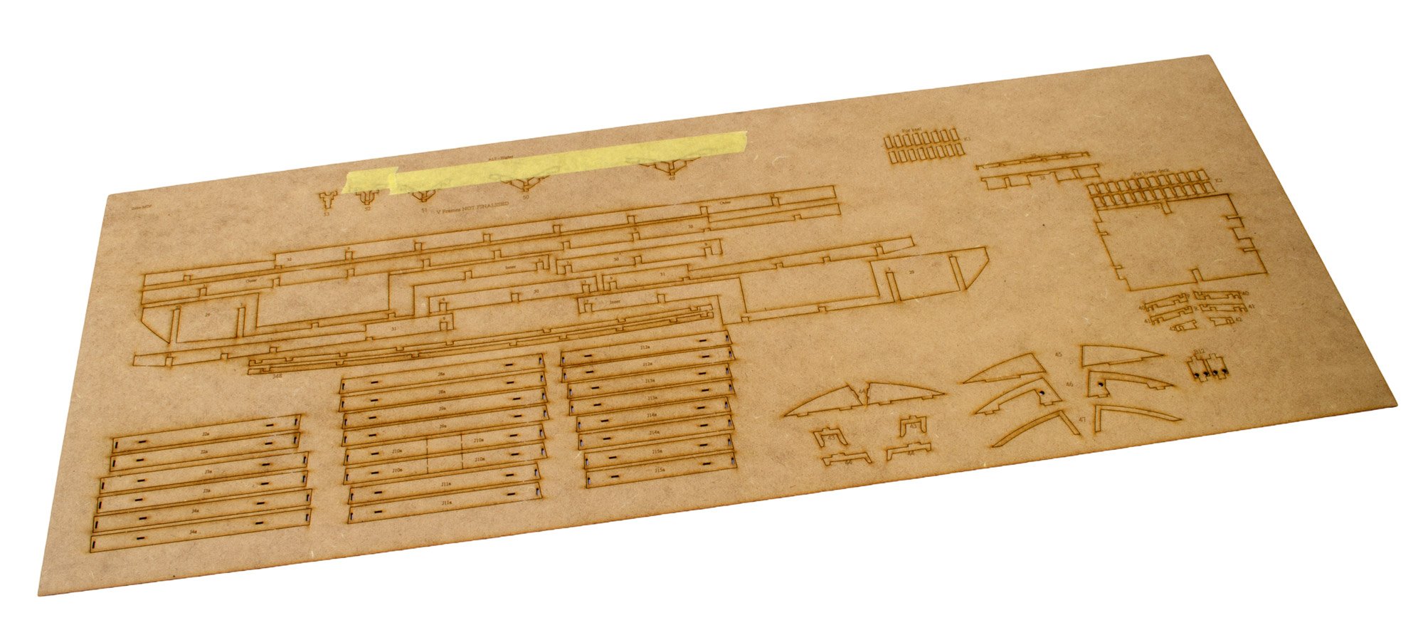

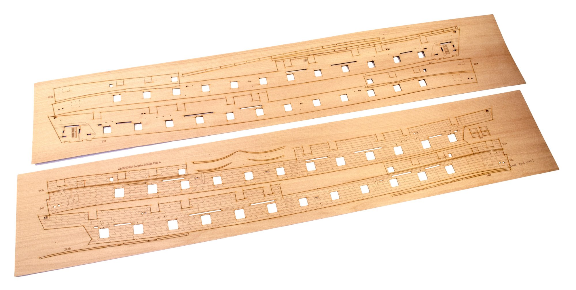

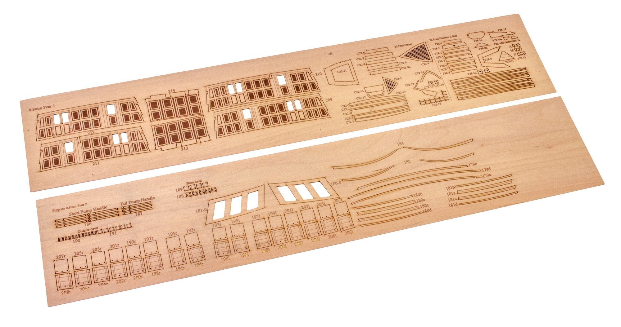

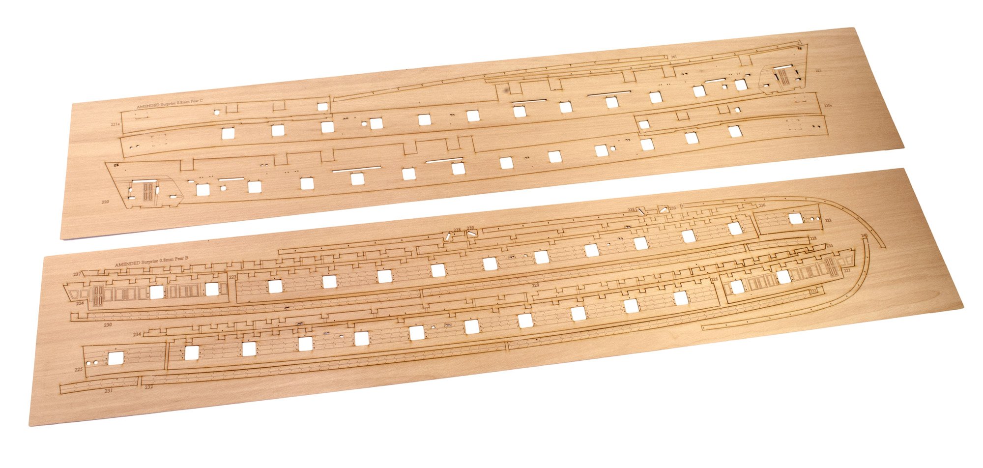

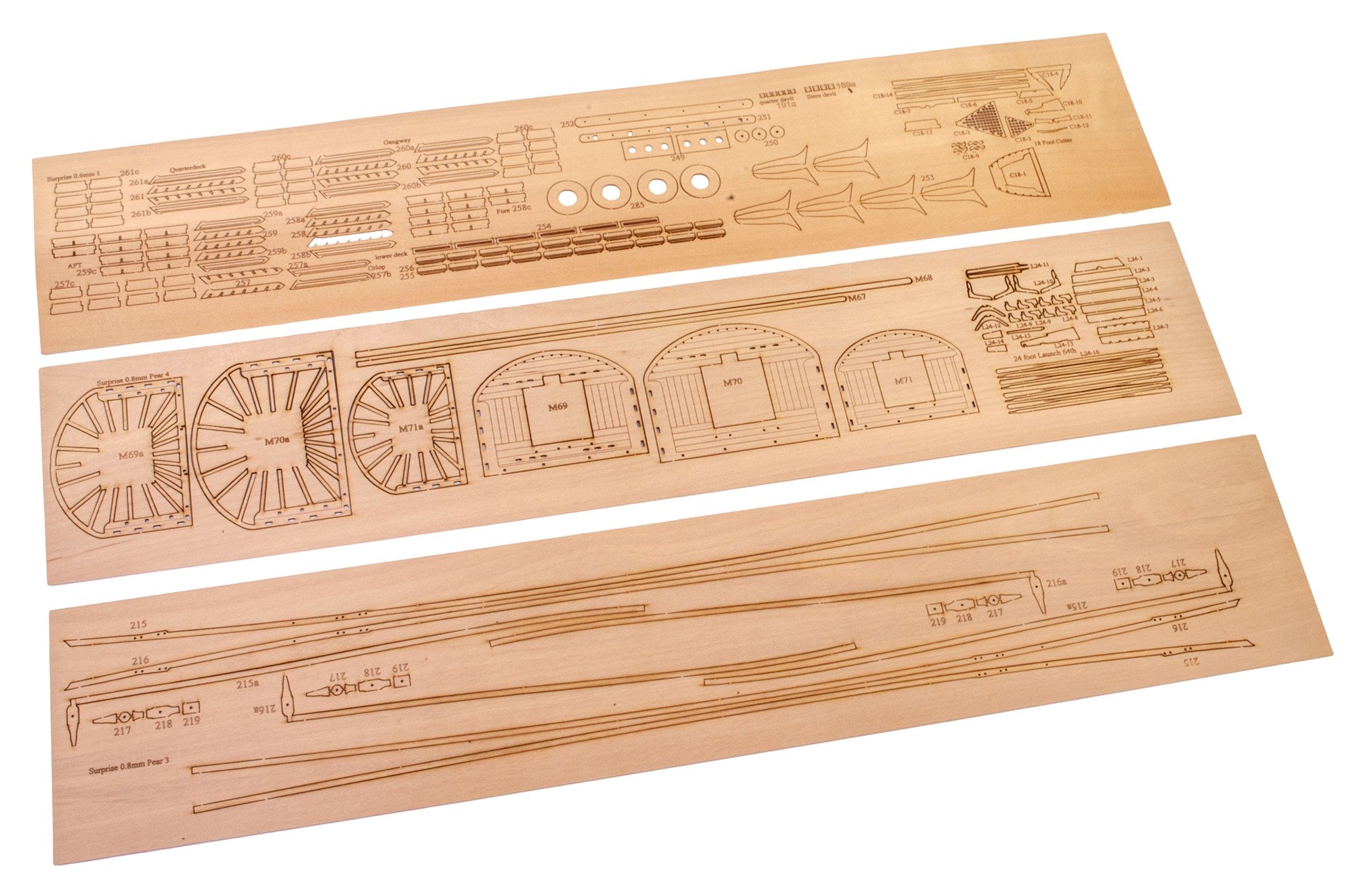

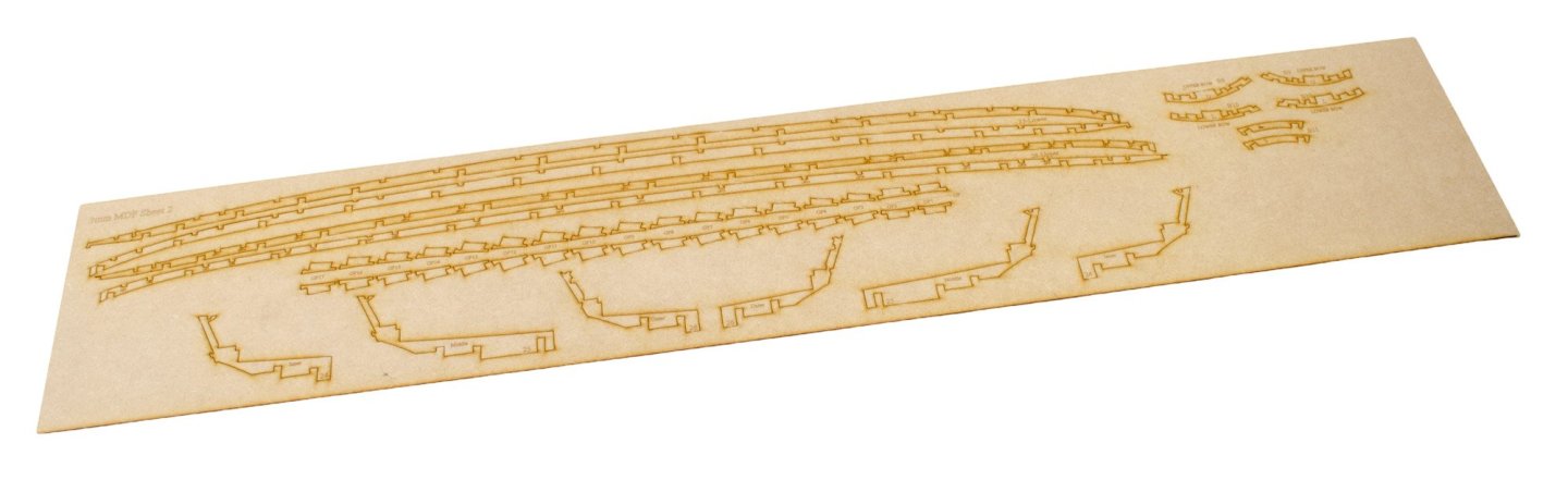

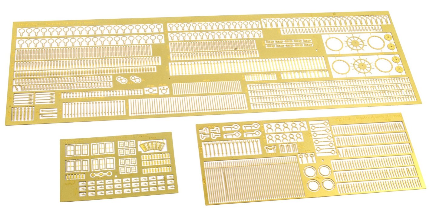

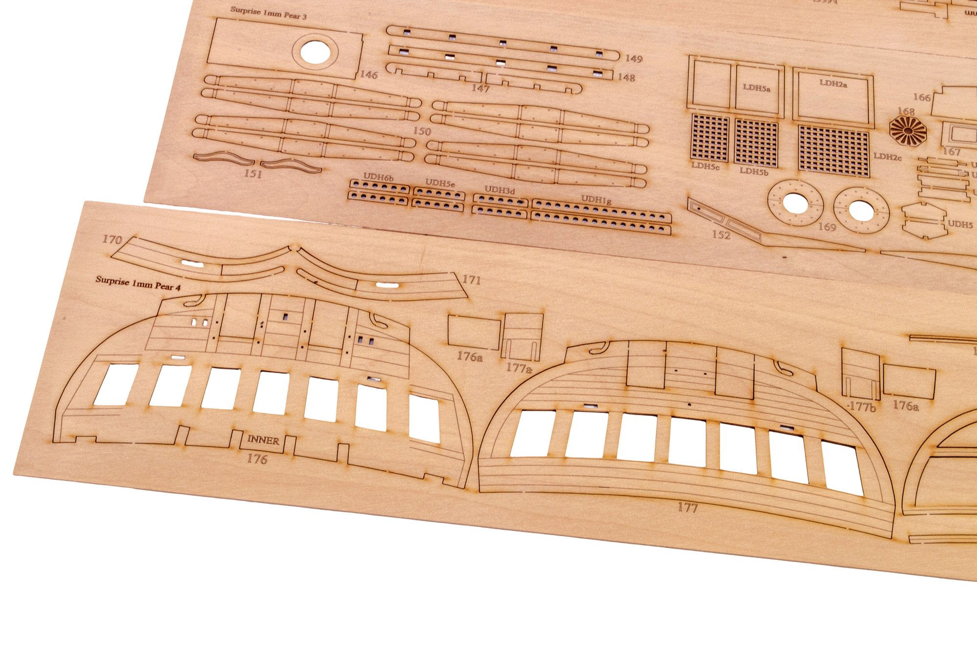

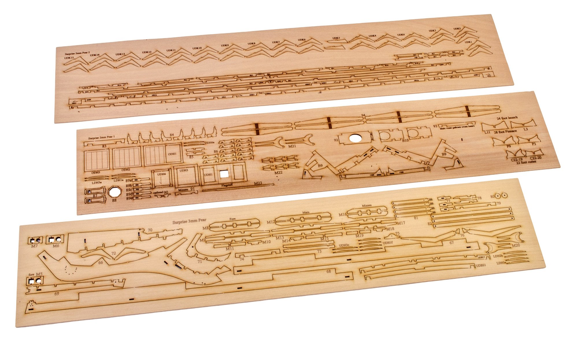

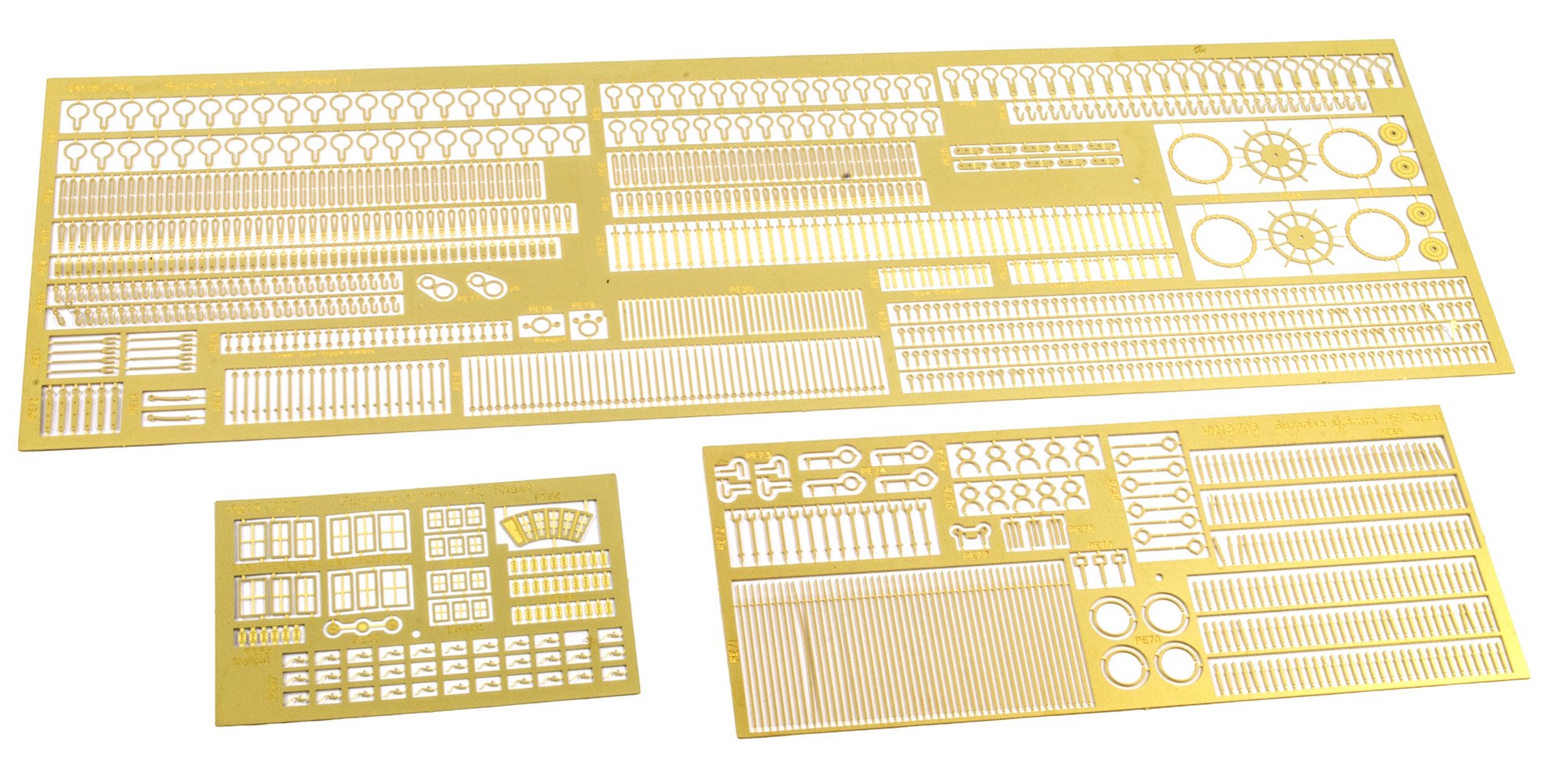

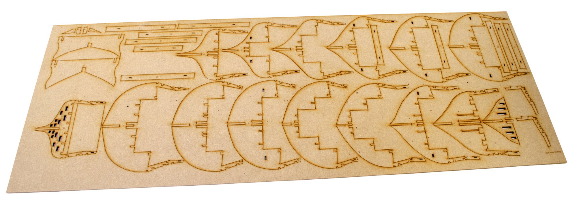

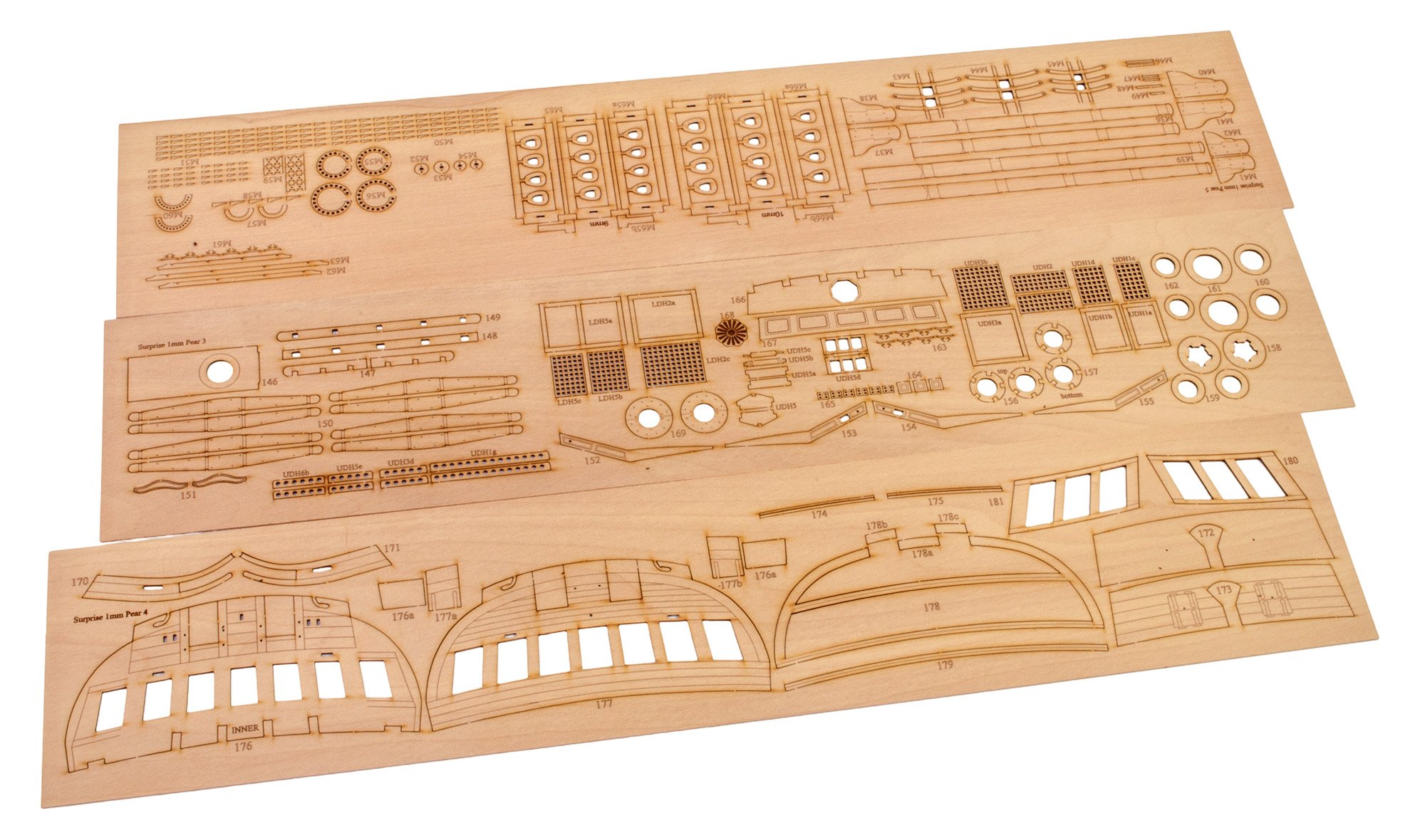

Ok, here are the parts sheets. I've not gone to town on these too much as they won't be used in the manual. These are just to satisfy everyone's curiosity.
Ongoing:
I've not photographed the planks or dowels. You'll all know what those will look like. 😉

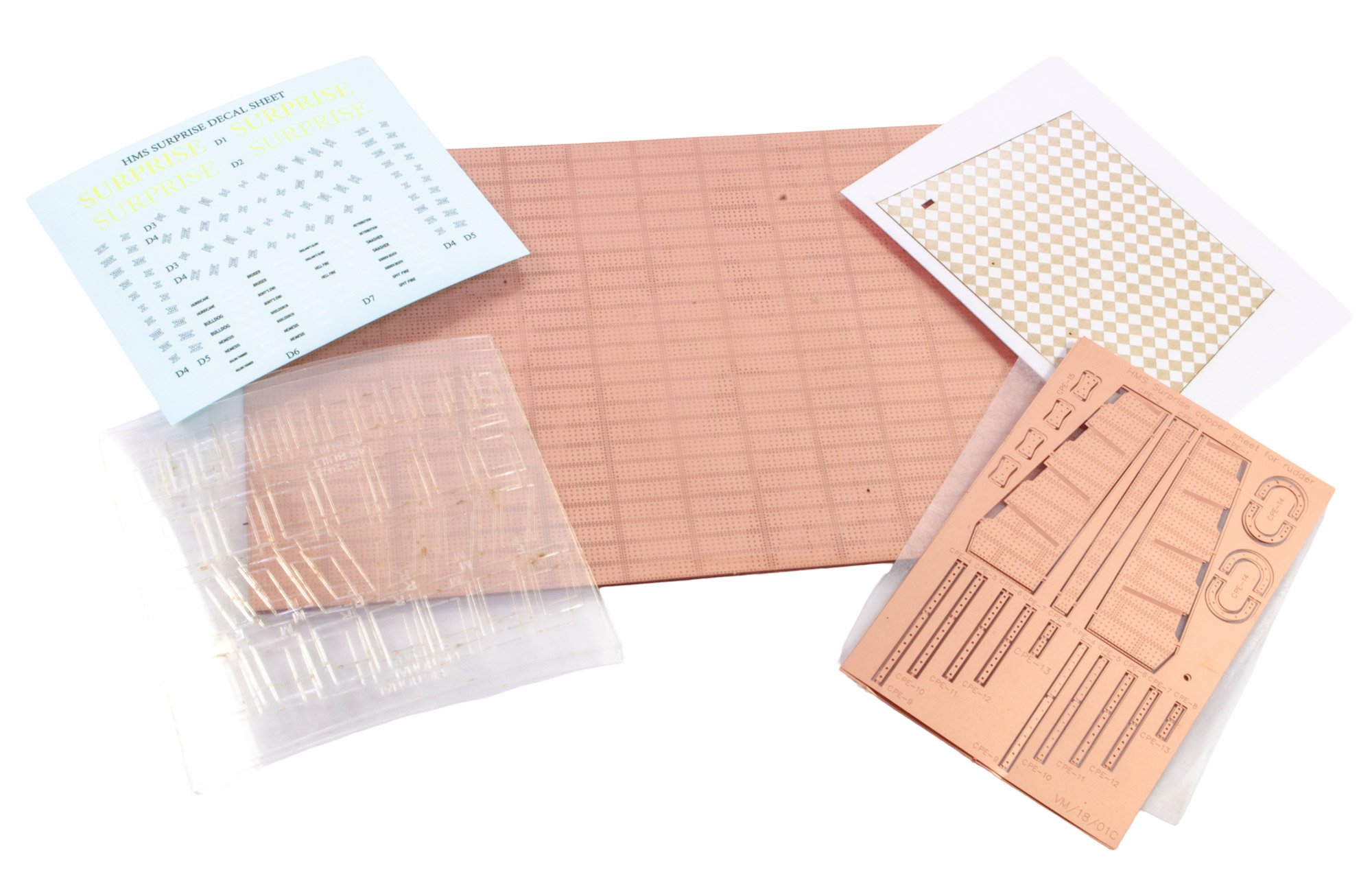

You might notice that there are two sterns included in the kit, depicting the real Surprise and the one from the books/movie. I'm sure @chris watton will be able to explain better. The parts also show BOTH cannon and carronade options, but I believe the cannon is the one to be included in the kit, and the carronade will be an option to purchase separately.

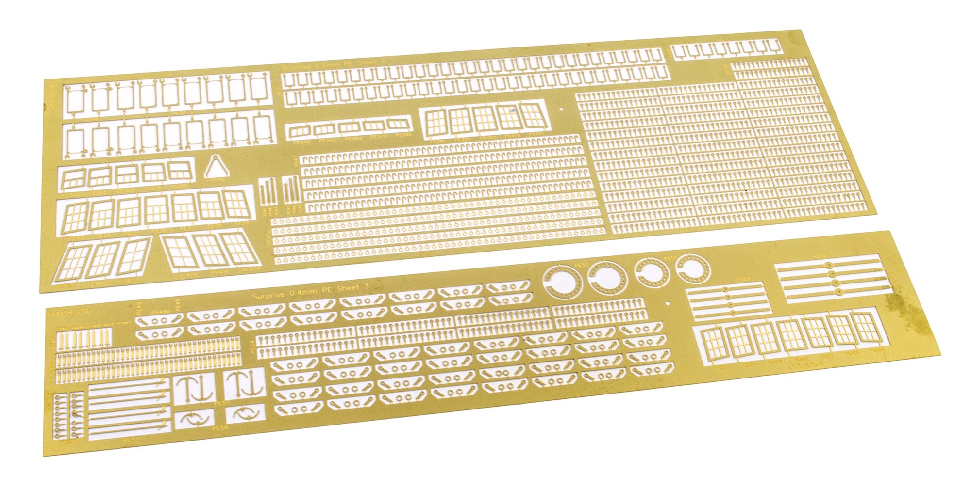

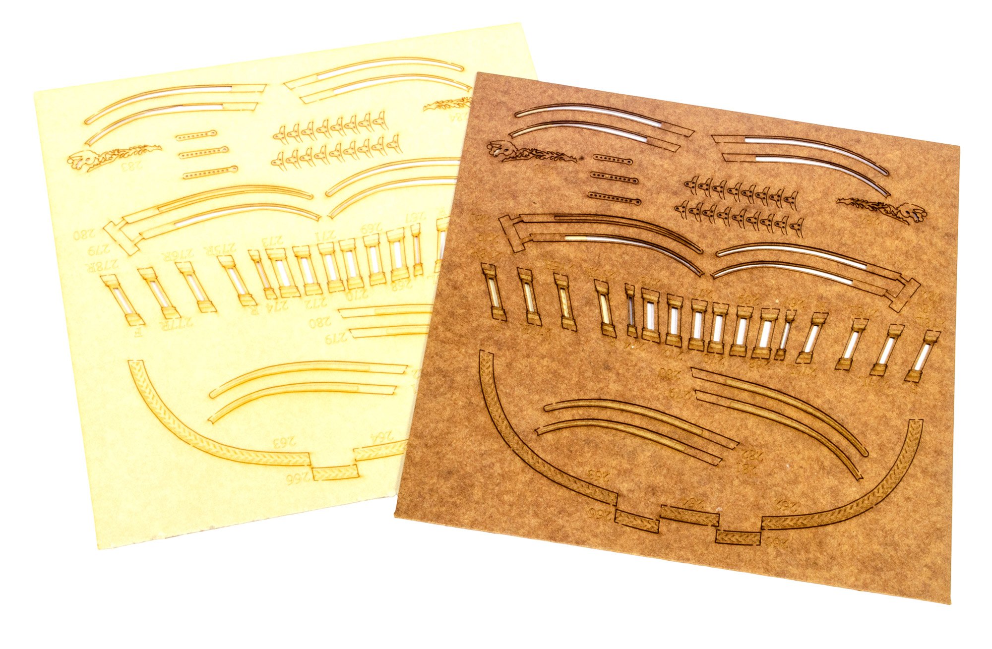

Thin copper PE can be contentious at the moment, but the supply of it seems to be getting a little easier. You'll see that I have a PE plating set for the hull, with shaped parts for the rudder. Note the copper rudder hinges and horseshoe and fishplate parts, instead of these being in brass. Decals are included for the name and depth marks, plus names for the gun carts too ;)

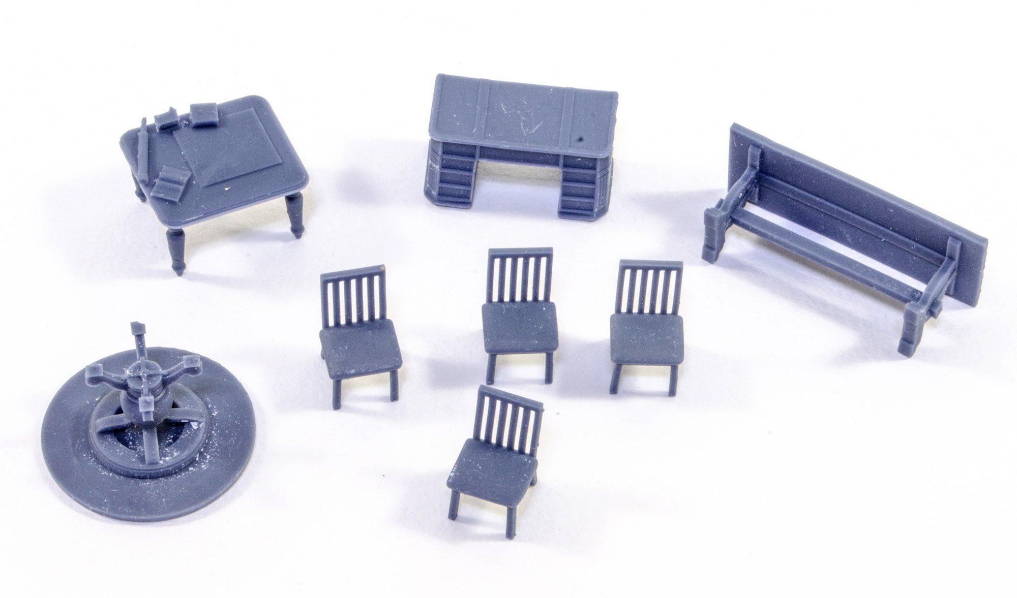

I have a nice choice of furniture for the cabin. I'll choose what looks best on layout, along with what Chris may supply in wooden form too. I might see if I can sneak a glimpse of that area from the film and base the layout on that.
Two sets of polybak parts are supplied to me for the stern and bow rail details. One is in ivory and one in natural. This is so I can work out which is most suitable and looks best for the model. The real difference is a slight thickness in the sheets. the colour is irrelevant as they'll be painted anyway. You'll also see the euphroe parts on there too instead of PE.

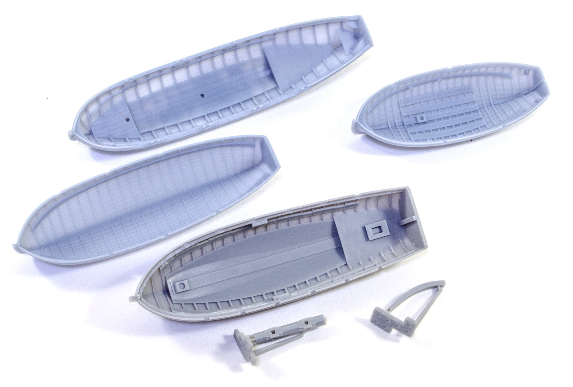

Other differences in this kit are the gorgeous little 3D printed hand pumps, and 0.2mm windows for the bulkhead screens and stern/quarters, so the windows and PE sandwiches will nicely fit into the timber. They also have a much more realistic clarity than the thicker acrylic sheets.
On this kit, the mast tops are made in three layers, adding a little extra realism to the completed assemblies. There will also be toggle detail for the connecting rigging blocks on the underside.

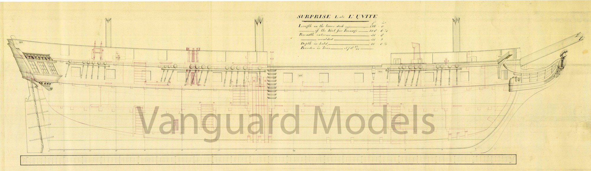

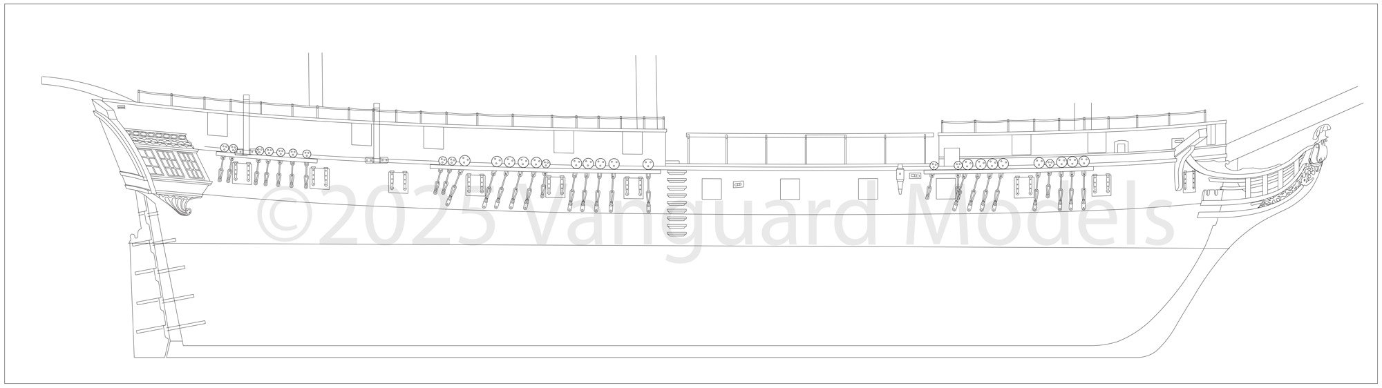

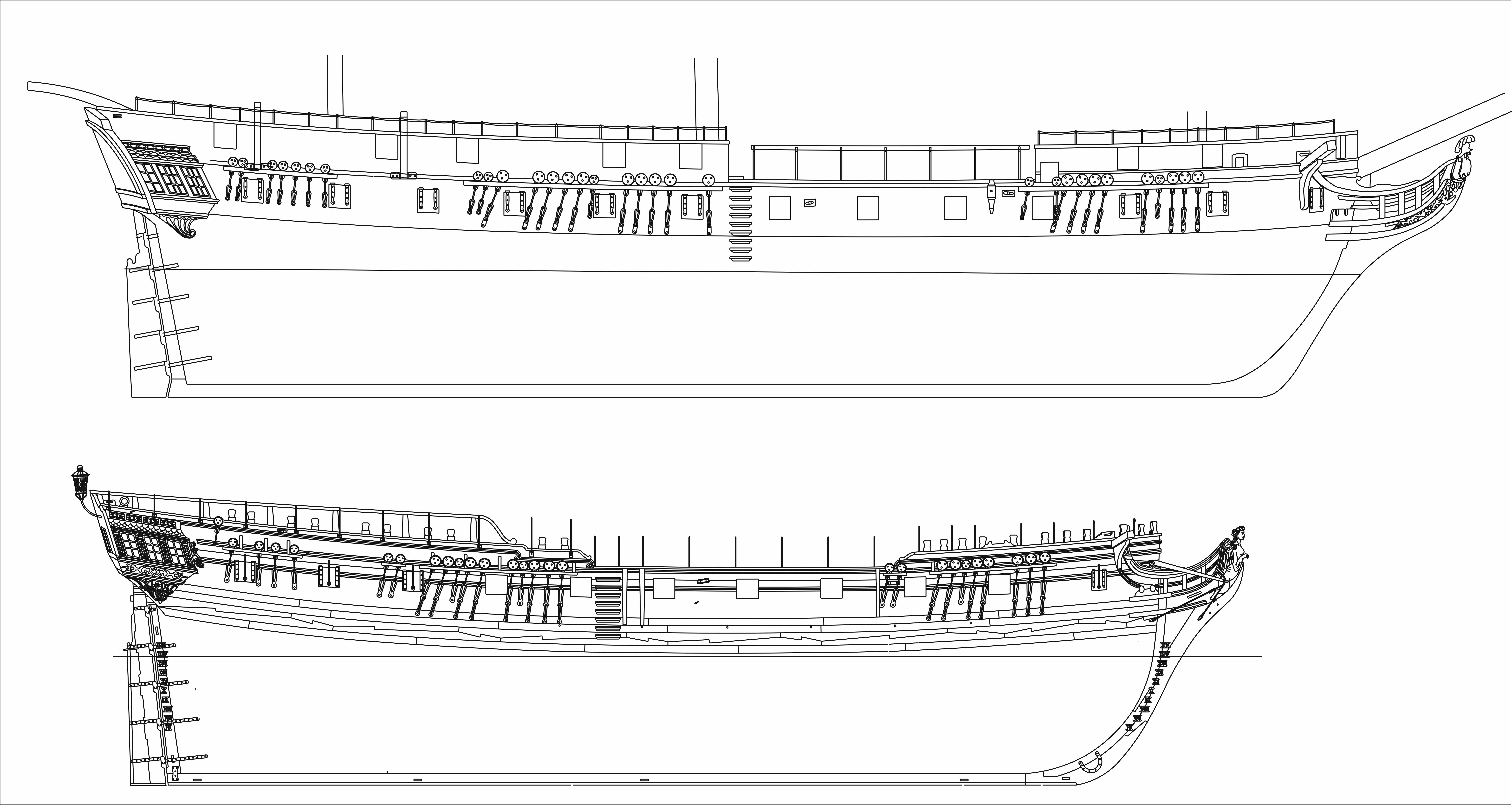

Here are the profiles for Sphinx and Surprise. The Sphinx would look more like the film Surprise (which is based on HMS Rose, a 20 gun mid-18th Century ship, and exactly the same size as Sphinx). You can see the real Surprise was quite a bit longer, being 126 feet along the main deck.

Decals for the cannon names?  Intresting Chris has gone for Decals for depth markers also.  It will be nice if the long table fits the cabin for those wanting to emulate the film.  Looking forward to getting my hands on this, following the prototype build with intrests.

Decals were used for the depth markers on Indy too. They are nice and easy to apply to the copper when it's been sealed with some gloss varnish. The same applies to the stern for the ship's name.

If decals are used in a kit, I will always put the depth markings on that. You will also have double the amount required, so if you make a mistake, you can try again - and you have 4 stern names, with one required, so you can use a couple to practise on.

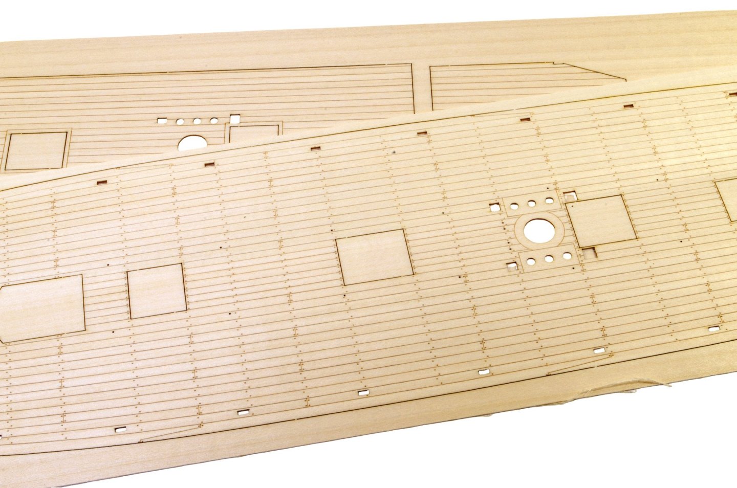

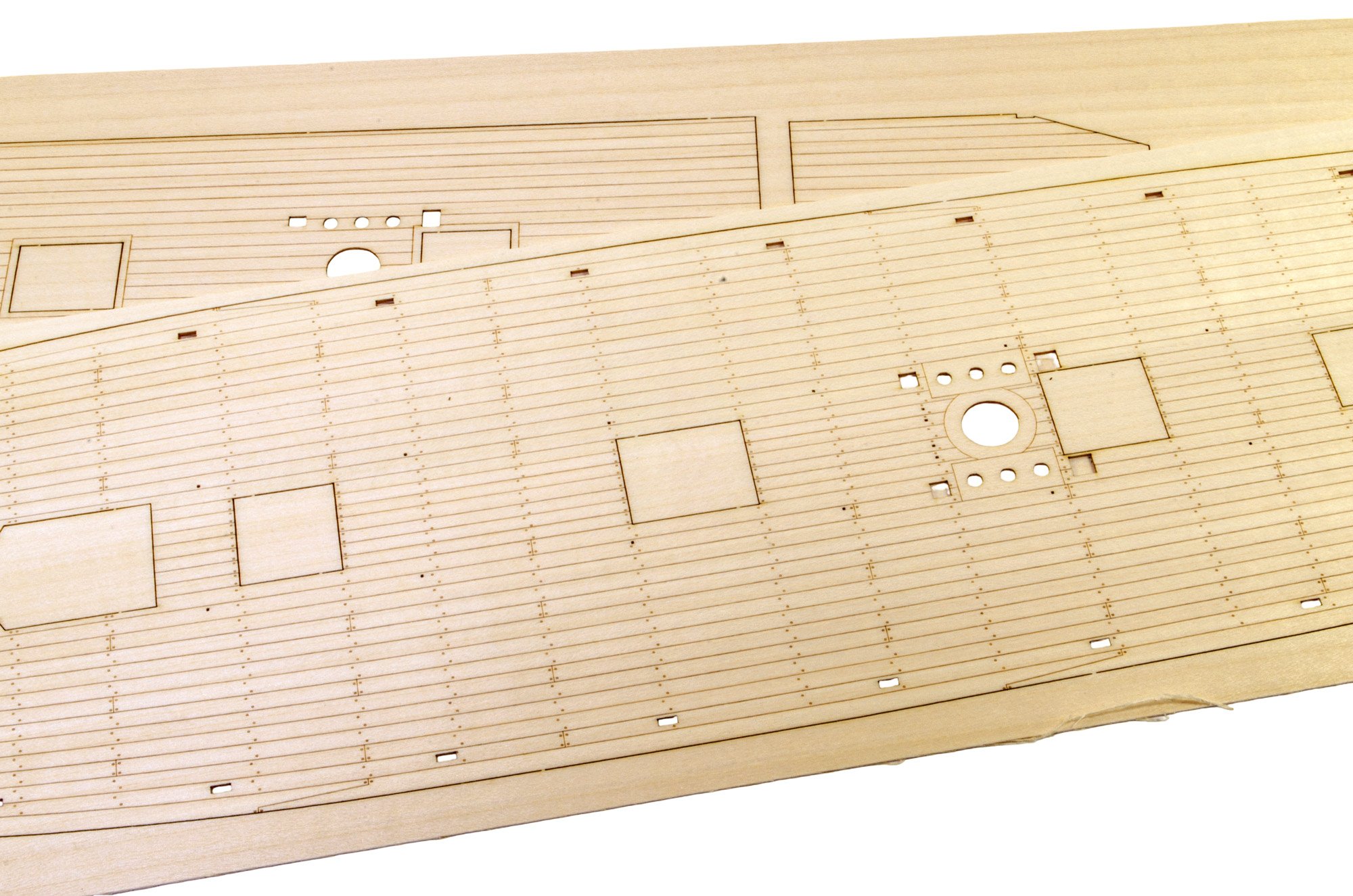

No 0.8mm ply for the decks in this kit design for the first time ever!
Vanguard Models on Facebook
As you'll see, the lack of the ply under-deck and the subsequent fitting of the actual deck, will be a breeze.

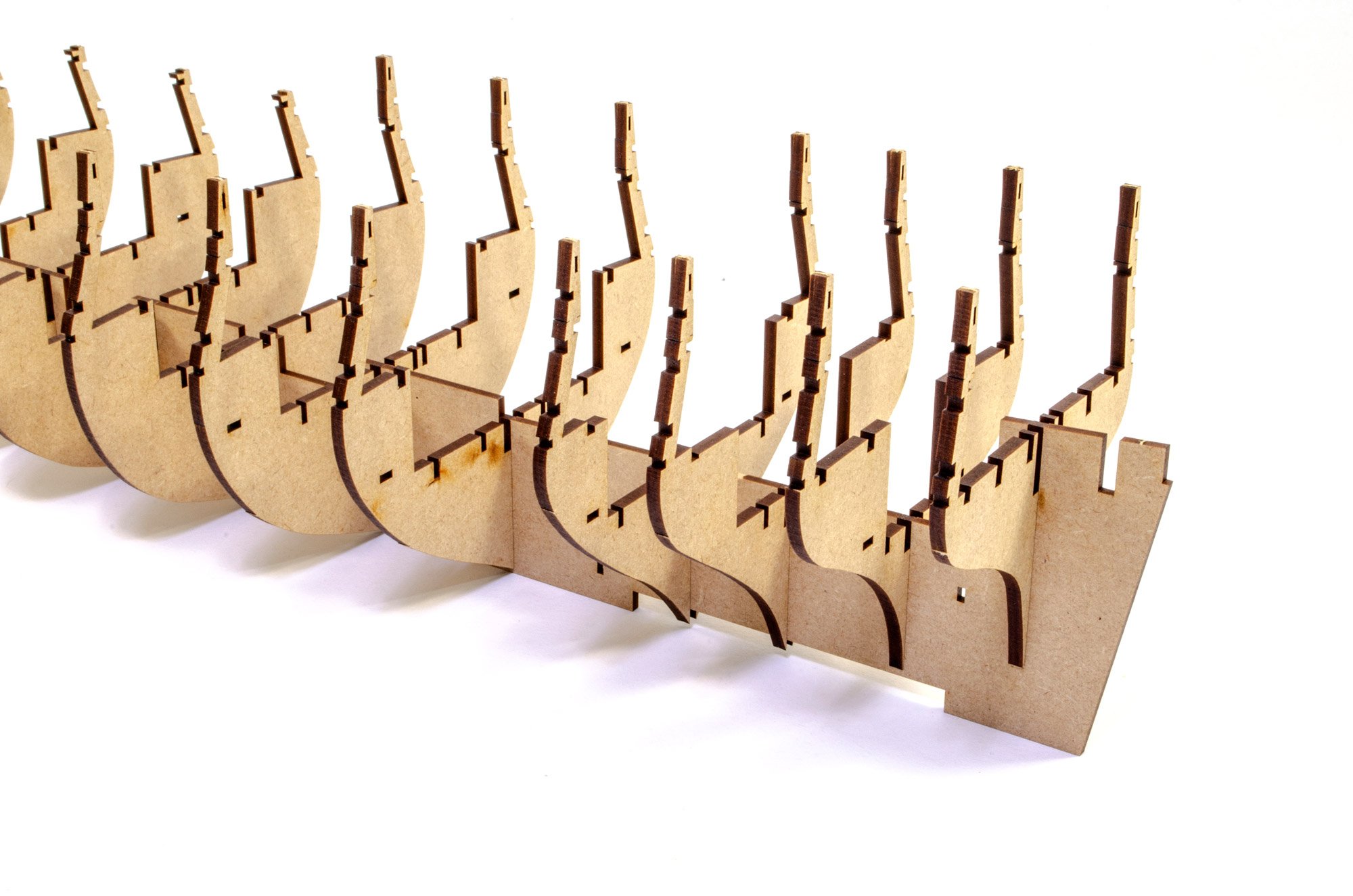

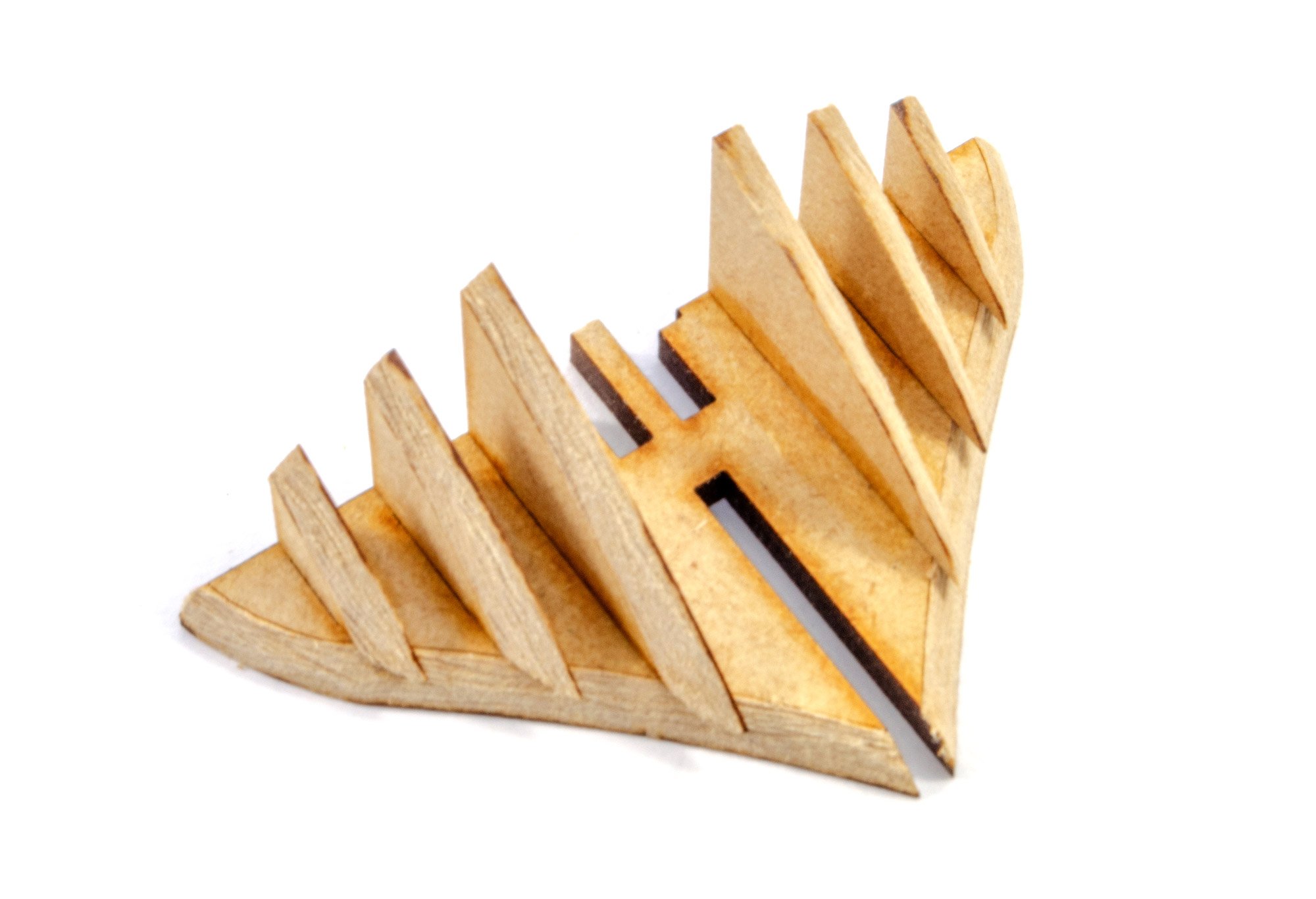

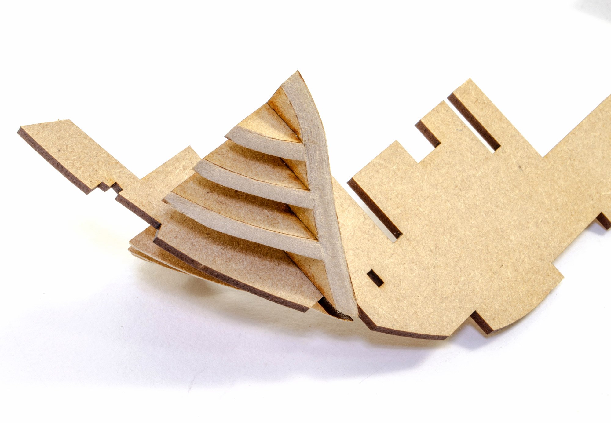

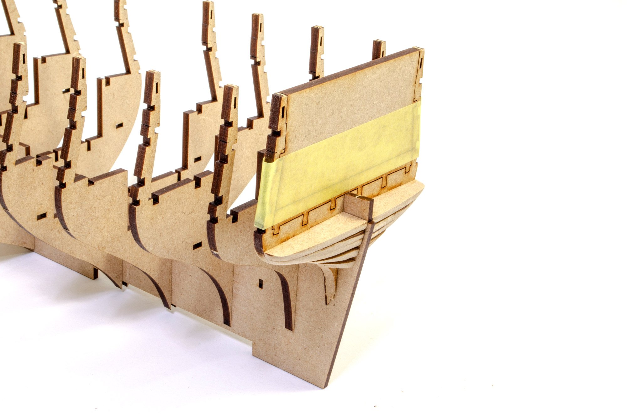

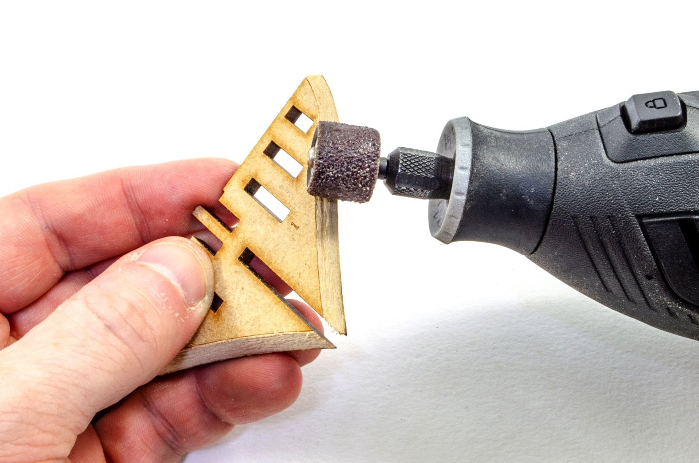

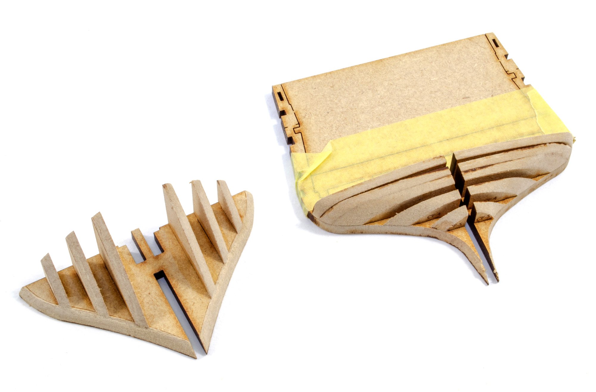

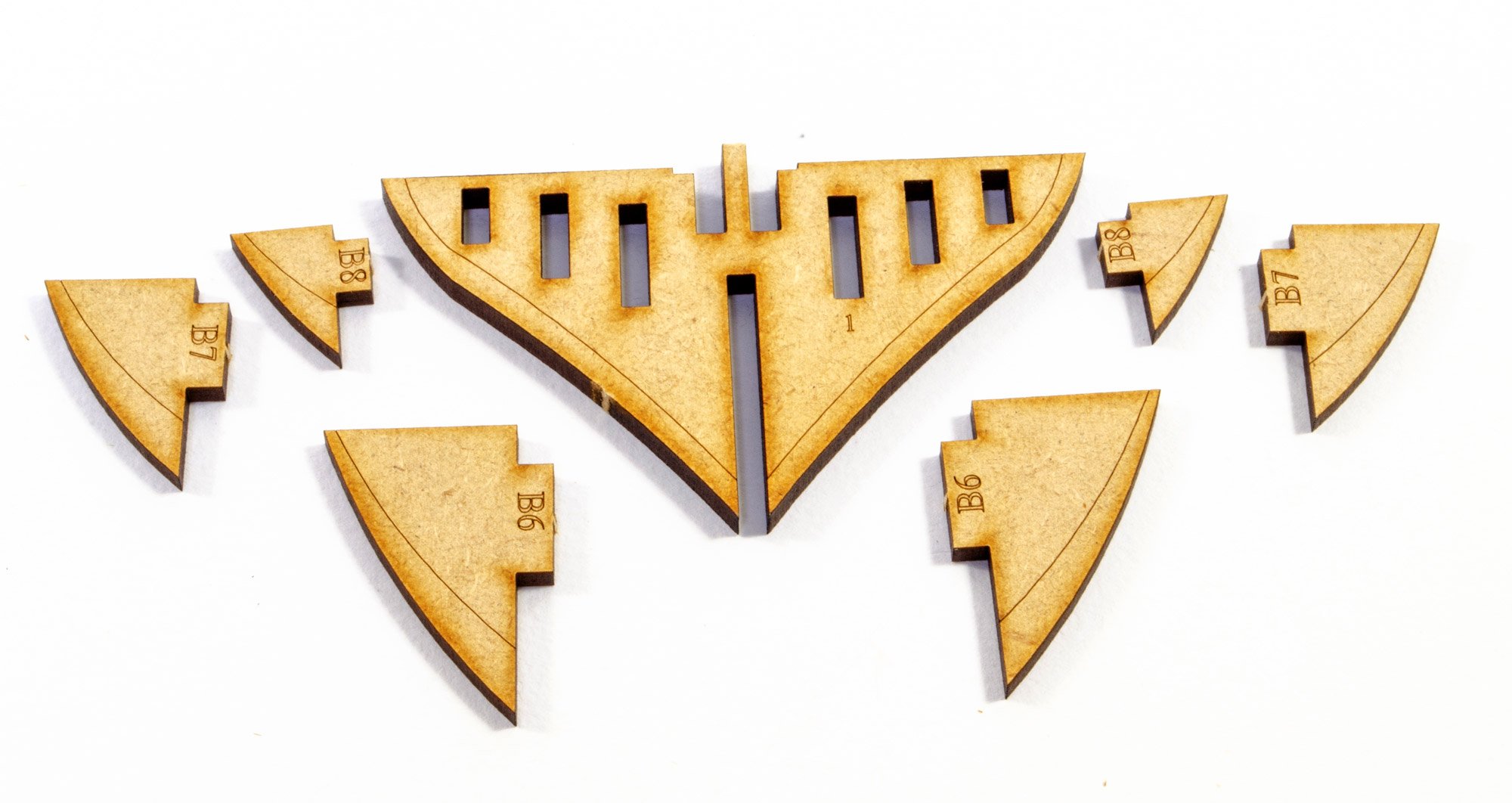

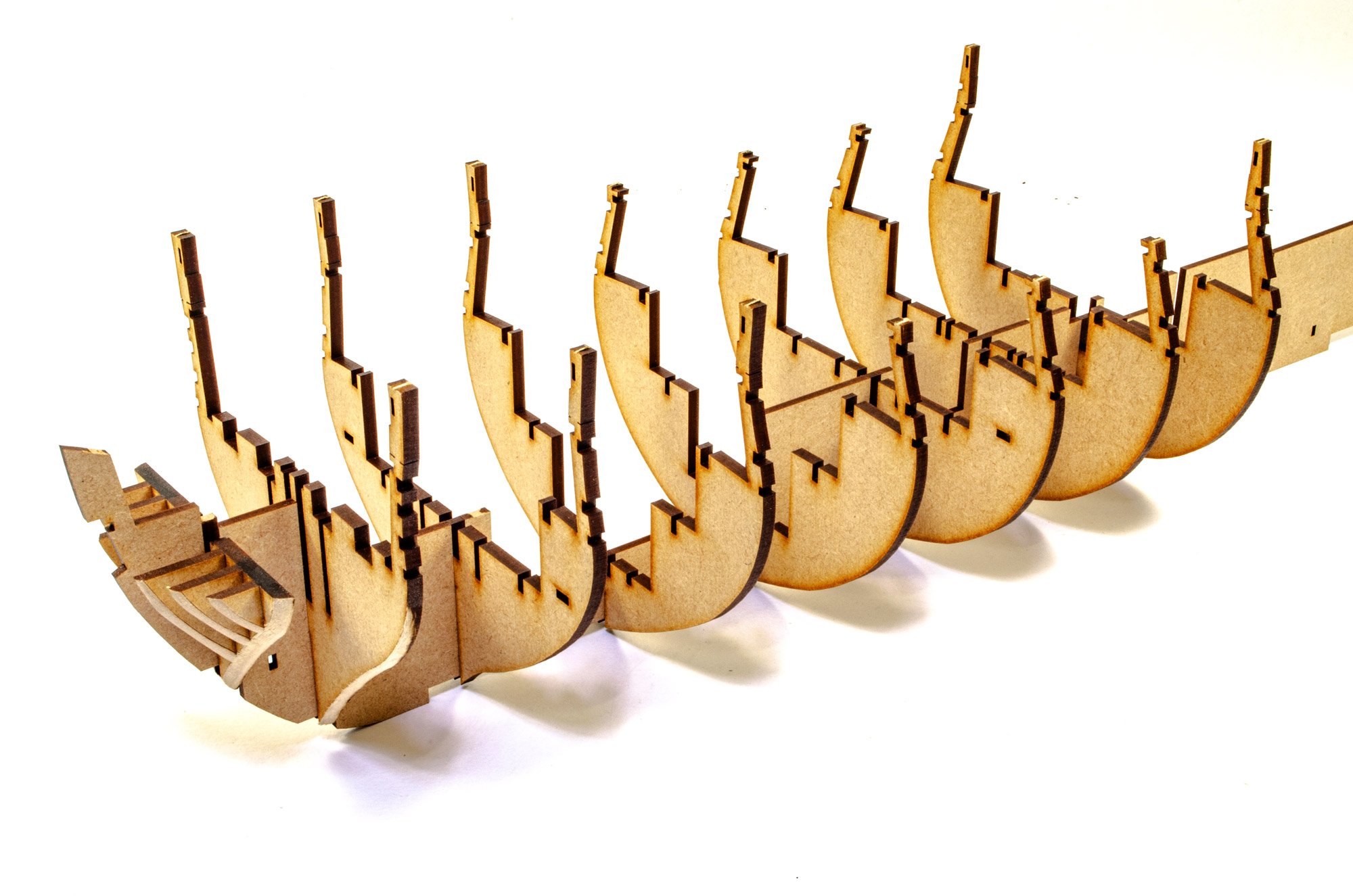

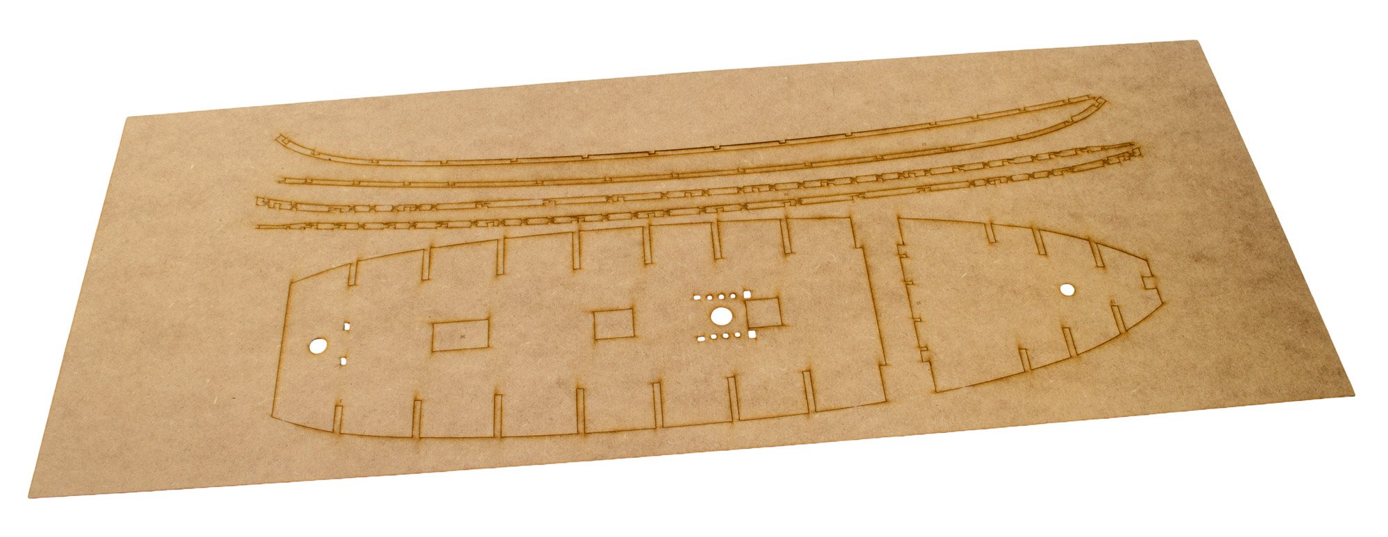

Apart from making the cradle, work starts on both the bow and stern assemblies, as these will need to be installed to the keel very early in construction. The format you see here will surely be quite familiar.
All parts are beveled using my Dremel (nice and cordless now, too!). Lines are included for a gauge, with the parts being finally shaped during hull fairing.
The stern is built up in the same way and the parts are cleaned up with some regular hand sanding. The tape on the stern is there to protect the infill piece from twisting out whilst being handled and sanded.
The bow assembly is now slotted to the keel. There is NO glue at this stage, and for quite a few more. Early construction is all dry fitted. This makes sure that the complex shapes all slot properly and the user doesn't introduce any twist into the hull. If you have a problem, you simply roll back the sequences and re-fit the parts.
Bulkhead #2 is also bevelled and slotted to the keel, as are bulkheads #3 thru #8.
The hull is now spun around and bulkheads #9 thru #14 are also dry fitted.
Lastly, bulkhead #15 is fitted. Make sure you fully push this one home as there's a little more resistance here, but not too much.
More later.

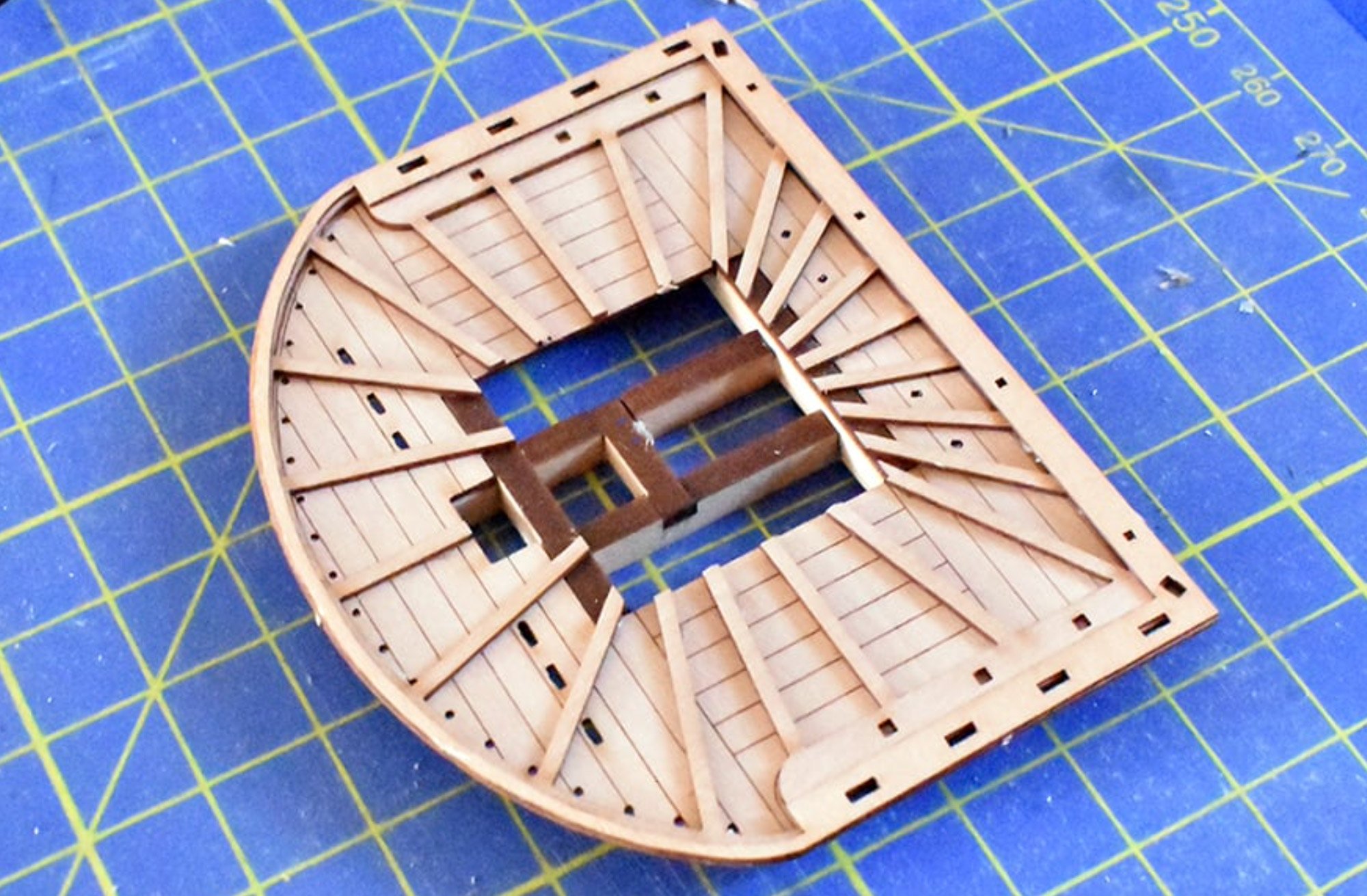

2 hours ago, chris watton said:

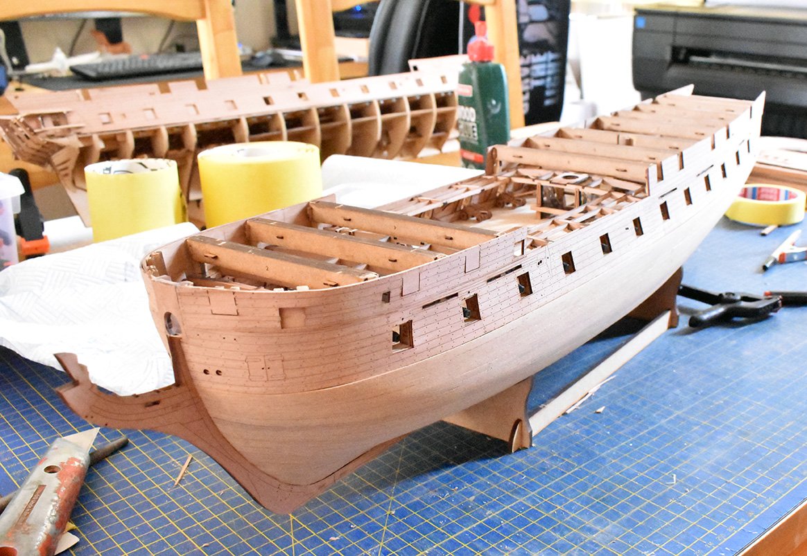

I just removed the masking tape after adding the second planking to my 'pre-prototype mule' (planking took a day and sanding half an hour, but I used tang). Again, I must stress that this is very rushed, so apologies...
Does “tang” in I used tang refer to Tanganyika, or does it have some other meaning that I’m not aware of?
Also, the deck beams look quite thick—what could be the reason for that?
Tang is indeed Tanganyika. Those beams are actually jigs that keep the sides the correct width apart whilst planking, and protecting the construction.
