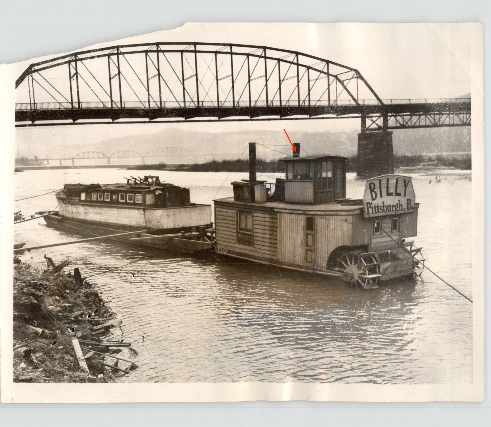

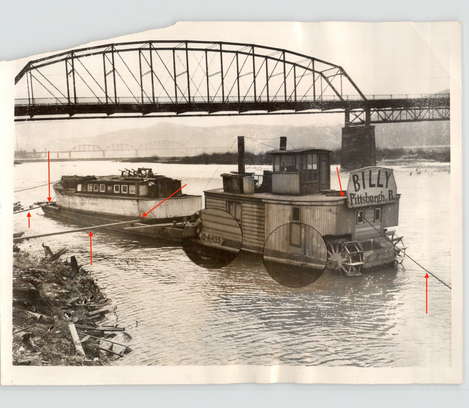

 Regarding Billy's main deck space, there's maybe a foot here on the port side and I assume it's the same on the starboard side. Also, Billy has about a foot of freeboard.
 All the springboards land on the barge as there isn't any deck space on Billy. That crazy door must have been strictly for ventilation. The stern line had to run from the boiler deck.  If one came aboard via the barge, was there a door at the bow?
 There isn't a skiff in the photo, I have no clue how Engel planned on performing any repairs if required to outside walls of the main deck structure or the wheels?
Edited by Keith Black
Not entirely sure on those springboards, I actually believe these beams were holding her off the shore. I mean ropes are making sure you don't go off a quay, but what is keeping her away from shore when there is no quay? She'd run aground if the wind came from the sea side...
I believe that door on Billy might have been used when she was alongside the quay or sailing without the barge. Having the door open and have a gangway/plank straight into the door opening.
Luckily you mention it's a sternwheeler as I keep thinking those wheels are at the bow... I believe it's due to the funnels being forward of the wheel house.
Looking at that last picture, it looks like the real exhaust is sticking out between the wheels (lighter vertical object), with the planks around it blackened by soot (blurry darker area), so your assumption that the engine could be between the wheels is probably right. Or am I seeing things here?

 Roel, the stacks are not boiler stacks as there is no boiler though the port side stack might have been functional for a parlor stove?
 Being this is in the Mississippi, I think the barge and Billy were aground in the shallows.
 As far as the door goes, maybe? I'm still trying to get inside Engel's head.

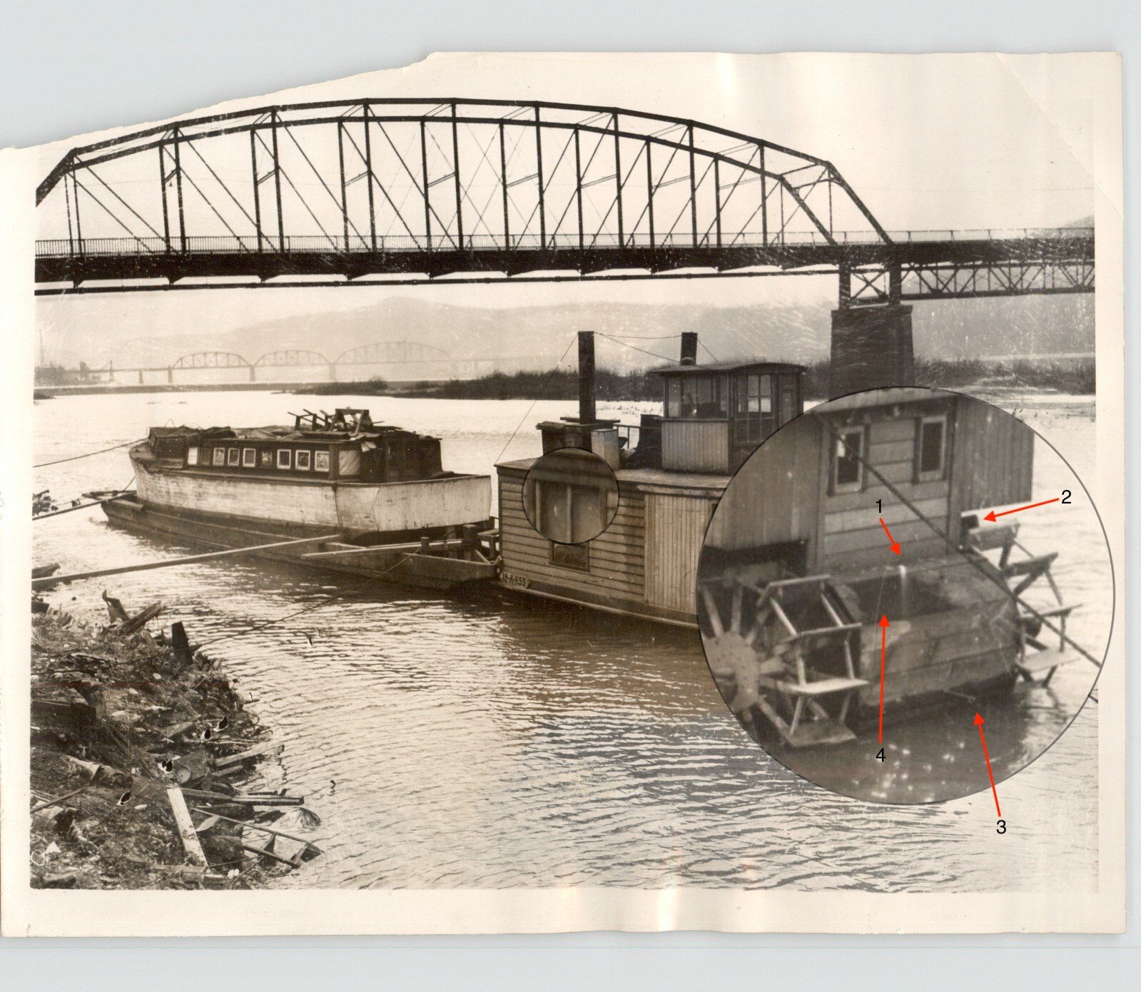

 1. Whatever that is, it's too small to be an exhaust. It almost looks like water running into the opening that's above the engine.
 2. I'm very confident that is the exhaust.
 3. I think that was the oil drain pipe?
 4. That opening, was it roughed out with a sledgehammer and then artfully trimmed with a blowtorch?:)   It's strange but then strange was Billy's middle name.

1) I agree, might be water running down, but not entirely sure where from/to
2) I believe that is actually one of the paddles of the wheel coming up, but dark due to the lighting/ shadow
3) hadn't noticed that detail.... seems a bit exposed for an oil pipe, but then in those days....
4) 🤣
Roel
Could #1 possibly be hot engine 'cooling-water' being discharged back into the river? 🤔
 Tom, absolutely!
 The water pump draws directly from the river and the water goes directly back into the river once it's made its way through the engines internals. The opening had me stumped but thinking about it I now believe it was an unintentional opening caused by fire from the engine getting hot and being close to the wood. Engel may have originally had the hot water exiting the engine running over the wood covering the engine to try and keep it from catching fire but failed. Or this was his answer to the fire and he hadn't had a chance to make the wood repair.
 Right or wrong I like your idea and I'm going to model the stern without the opening (solid wood cover) with water wetting the boards by running over them.
"Whew!" I'm glad that this is plausible because my next thought had something to do with an extended stay at 'Zelda's Sand Bar', on fifty cent draft beer night... and you wouldn't want to model 'that'! LOL

 Roel, see my response to Tom in the post above regarding #1. Regarding #2, it's the exhaust, I've enlarged this image on our iMac 27 till it pixilates and it's pretty clear it's the exhaust. #3, everything went into the Mississippi back in those days. :(
  I don't know where the head was located on this rig but it wasn't there because of the engine but it was the logical location.

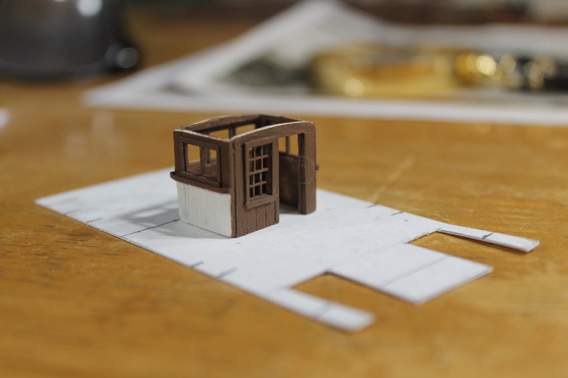

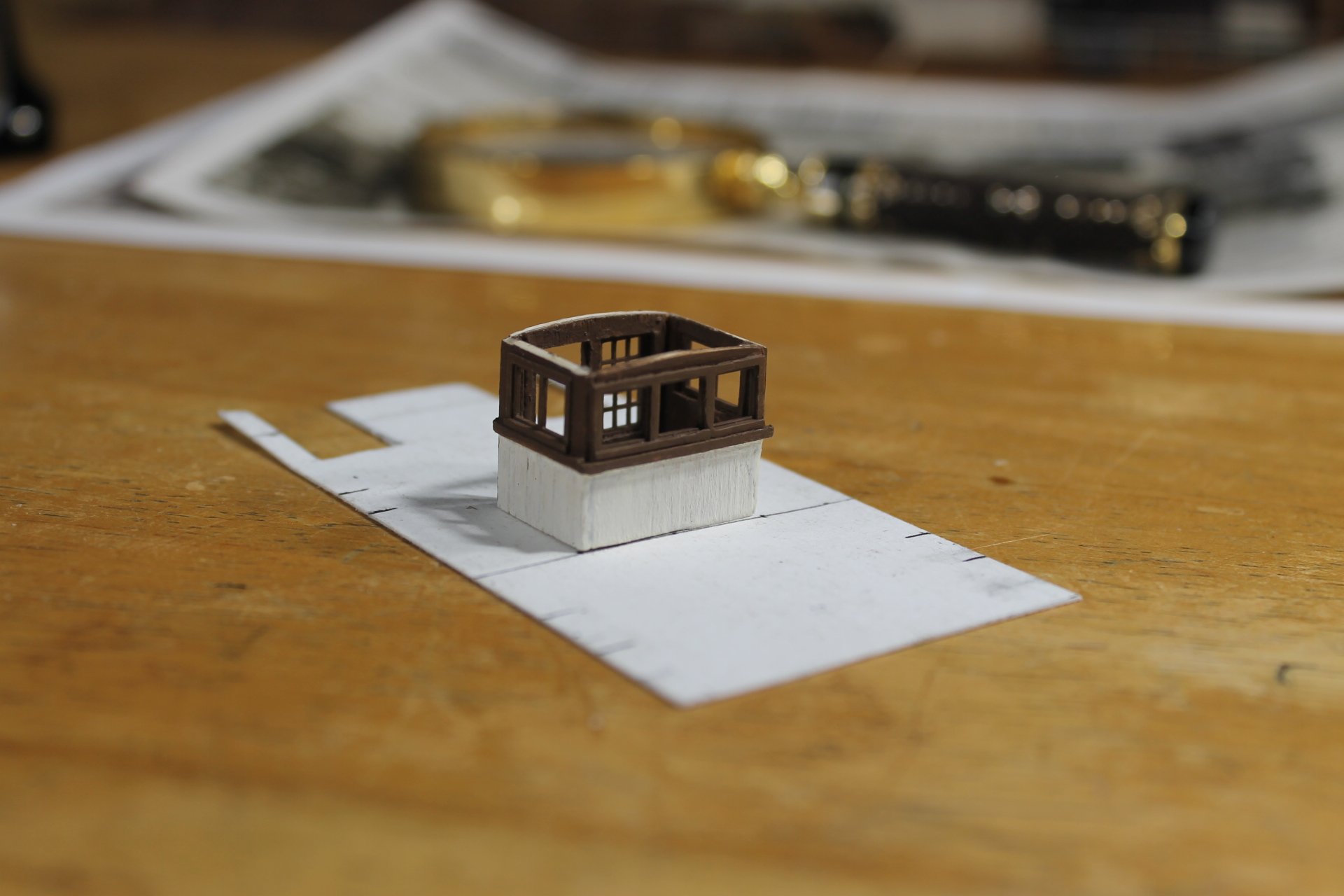

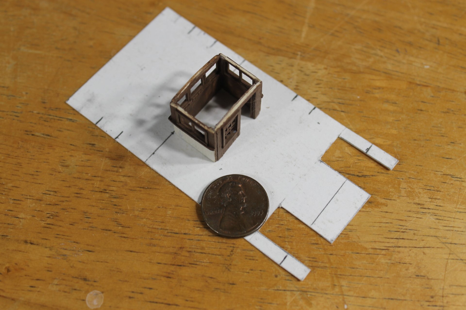

 Well, Billy is off and running!
I've got the four walls of the pilothouse made, windows (from Tichy Train Group) installed, and the first bit of paint applied. I wish I could have made the PH two feet (0.20) longer but I was restricted by the size of the windows and trying to replicate the photo.
 I originally thought Billy was 40 feet in length but after placing the PH on my deck card I've adjusted Billy's length to 35 feet meaning when completed Billy will only be 3.5 inches long. As I said, Billy is going to be the Matchbox of sternwheelers.D2DECAB3-62E6-43D9-AC7E-D1C128819D56.thumb.jpeg.ef173be755899e4afcae58a8957d66ba.jpeg
 To complete the PH I still have to add the window glazing, make the door, add the roof, and make that round air vent or fire alarm bell that sits of top.
 I couldn't use stain as it wouldn't have covered the windows so I used craft acrylic paint. I'm not necessarily in love with this brown color, maybe it'll grow on me?
 Thank you to everyone for the likes and for helping get Billy off the ground. Your support and following along mean the world to me.

I know we usually pop bubbly at completion, but I am too excited.  That window work is fabulous!  Let's goooooo...
Edited by Coyote_6
Steve
San Diego Ship Modelers Guild
Great little pilots house, no room for a Keg in there either , I suppose  lol The brown looks good.
        USCG Harriet Lane
 Thank you, Steve,........."Heigh-Ho, heigh-ho, it's off the work we go" :)
 Thank you, Bob. I may put a barrel in there just for you. :) I hope the brown grows on me.
6 hours ago, mcb said:
Nice start Keith, it looks like there are quite a few colors on that thing
 Thank you, mcb. Yes, Billy has a lot of colors (Rainbow Billy :)) including some raw wood at the stern between the wheels.
6 hours ago, Jim Lad said:
Great start, Keith! That wheelhouse looks spot on!
 Thank you, John. Yes, I think I was able to capture the look of the PH pretty accurately. Hopefully I'll be able to say that when finished with Billy.
5 hours ago, vvvjames said:
I've been looking forward to this post! A wonderful start.
 Thank you, James. Me and you both!
3 hours ago, Geordie Tyne said:
have to agree with Coyote_6. The windows are fabulous . I keep double checking the picture with the coin in it. Lovely work and at such a small scale as well.
 Thank you, Geordie. Tichy Train Group windows are the best (IMHO) and they have a great selection. The coin is a US Penny and has a 0,70 inch diameter.
