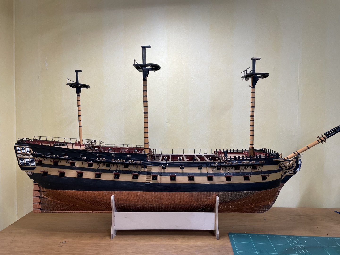

Dear friends,
Decided to follow the instructions building the lower sections of the masts in series instead finalizing the one mast with all building moments. Started with the mizzen mast  yesterday. It was some time since a worked on the masts. I cut myself twice before I found the knife skills 🫤.

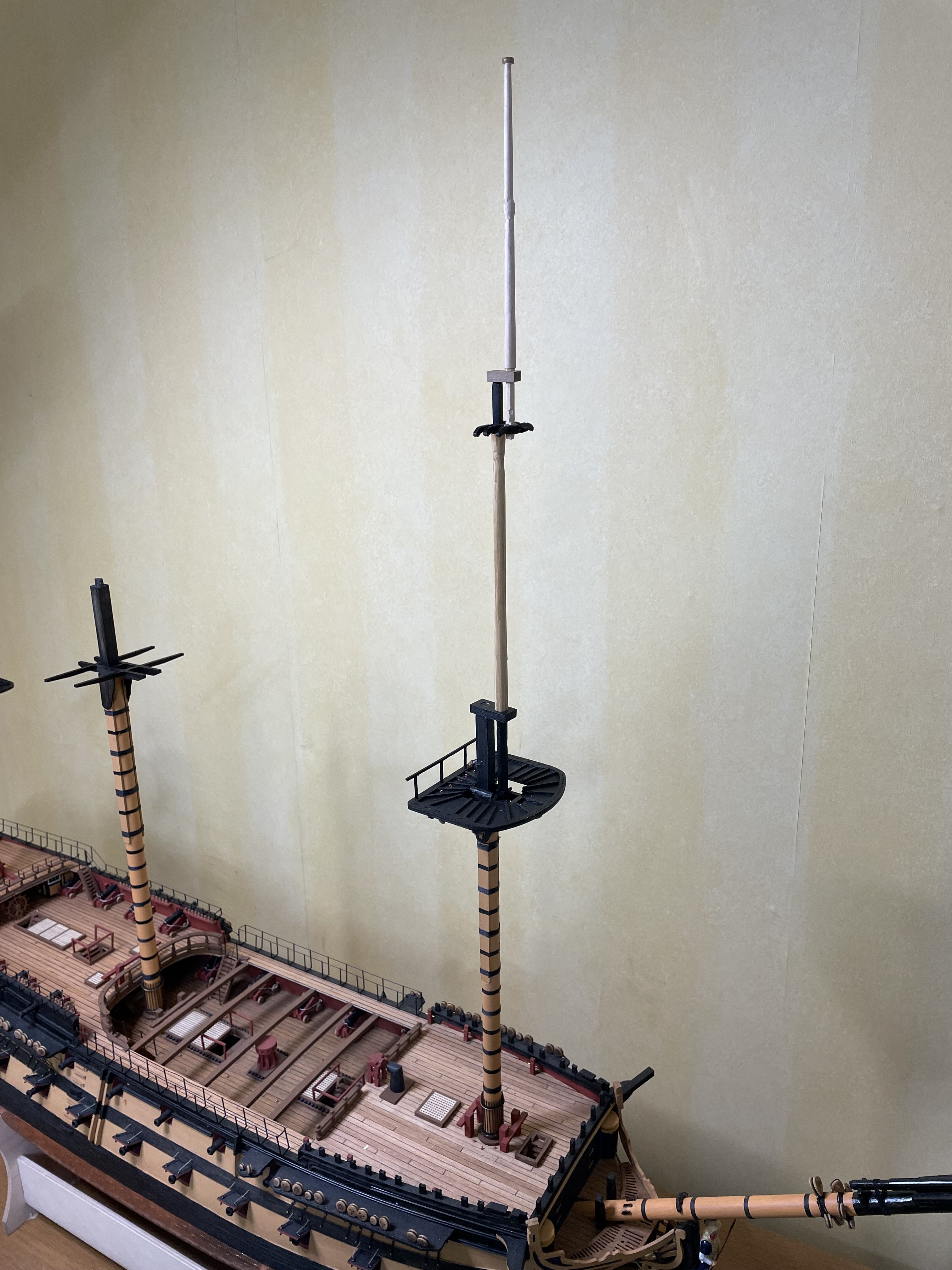

Good afternoon friends,
Spent the weekend working with the fore topmast and top gallant mast. Started also with main top mast but that might something for next week.

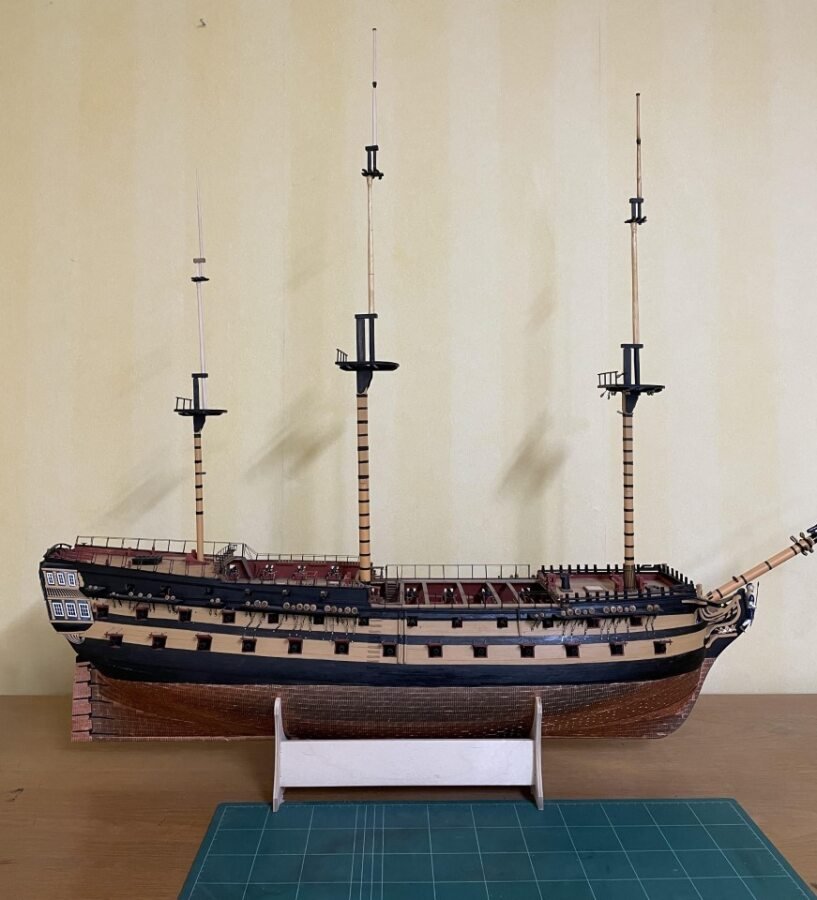

Good afternoon dear friends,
It has been a while since I did my last update. Now with with dry fitted top gallants on all masts (Varying degree of finish).
