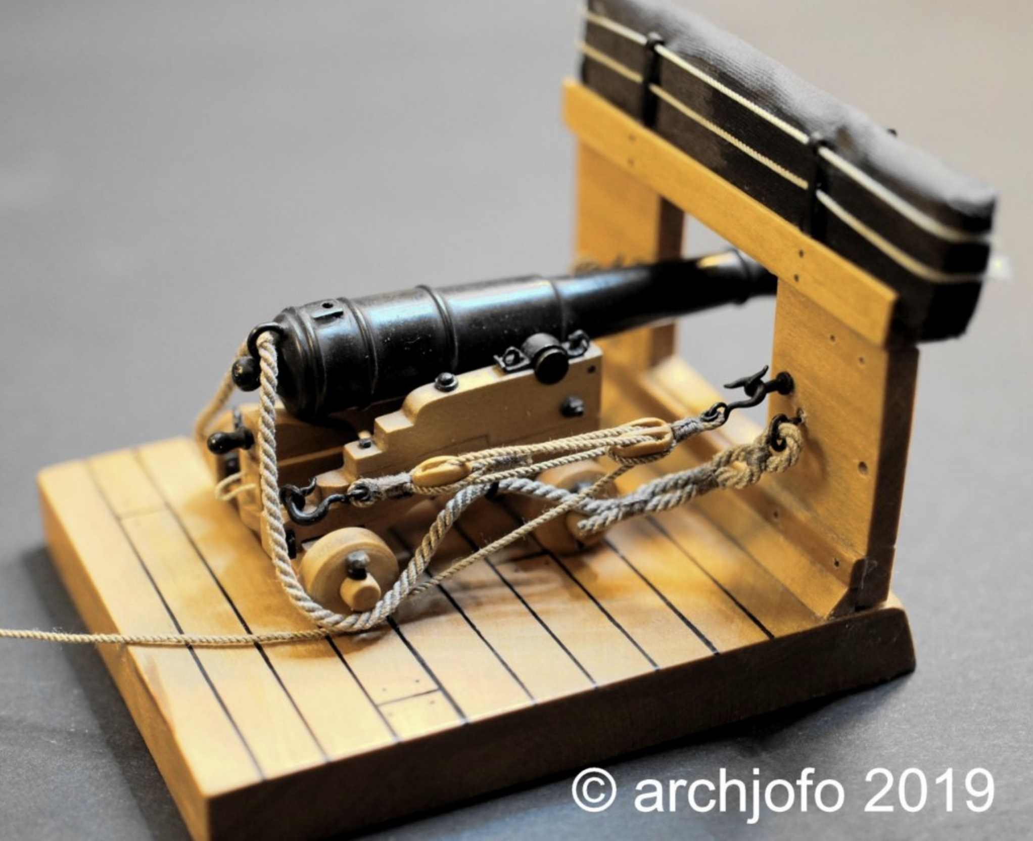

Later guns had a breeching ring cast into the barrel above the cascobel, and the breecing line passed through it.
Phil, how much later was this done? I am researching the tackle for my Lynx build right now and rather like the look of this (that you linked in your feed here from archjofo):
Here the breeching lines do not rest on the cascobel but pass through the ring you mentioned. Would this have been done after 1812? There is no description in my kit's instructions as to how the guns are to be rigged, so I thought I would ask you :)

It does indeed, Trevor. The kit supplied cannons do not have that ring so I may have to get creative on that. As always, your input is much appreciated and it was good to hear fro you.
Then they are (or approximate to) the older Armstrong pattern. (Long out-dated, in Ordnance Board issue, by 1812 but let's not quibble!) So the breeching needs to loop around the cascabel, with the loop seized (at least in full-size, maybe just glued in scale).

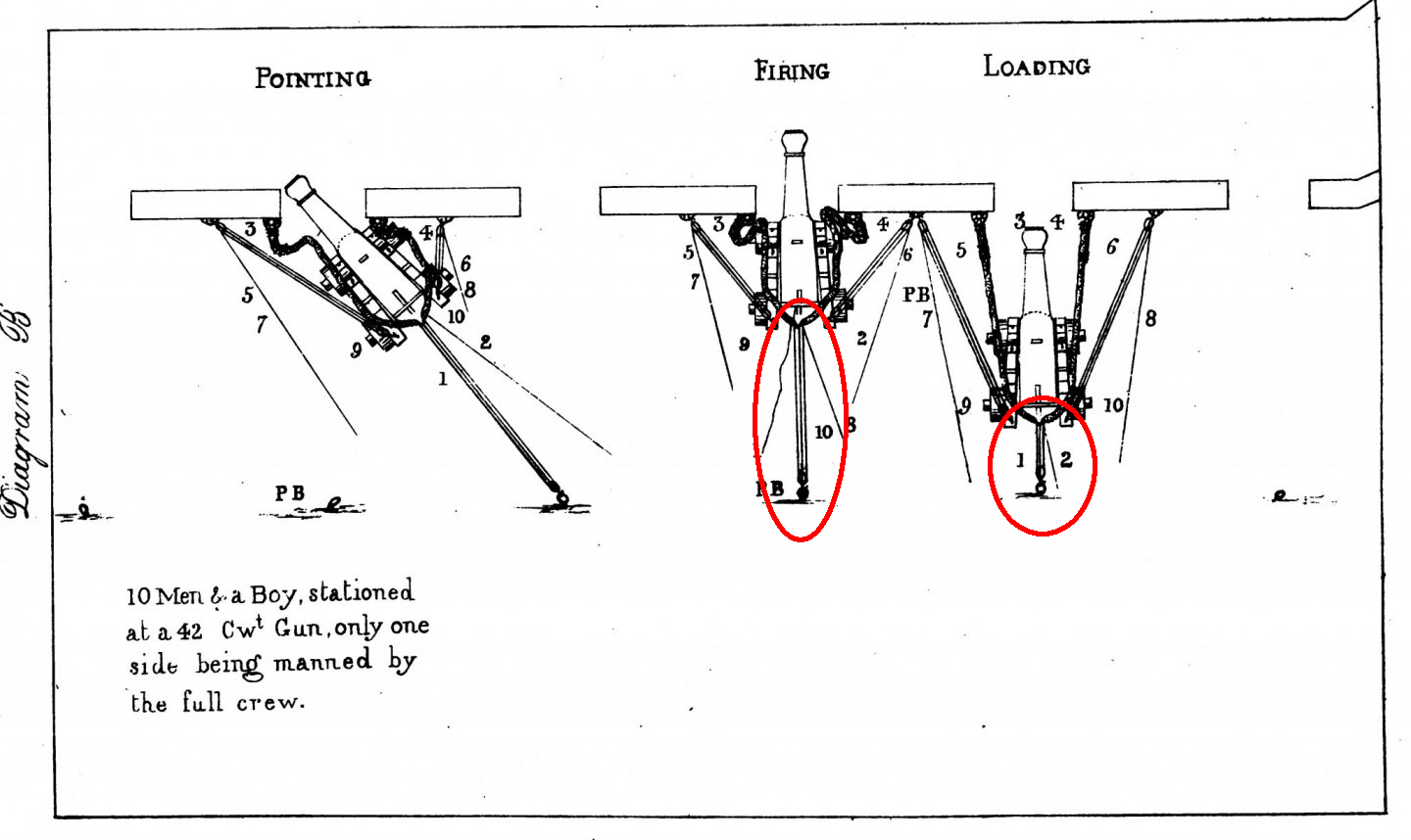

Here is a drawing from Ordnance Instructions for the Unites States Navy (1860). It shows the method of pointing a gun at an angle to the centerline of the ship.
1235565587_GUnpointingfiringandloading.thumb.jpg.e135f5500df0c7c9c2d9a42065df15ce.jpg
For the big lumbering square rigged ships of the line what wefalck said is probably true. But there are accounts of smaller, more maneuverable vessels like schooners pulling up off the quarter and out of the firing field of larger ships and blasting away at them. In this case angling the guns toward the target would be useful. Pivot guns apparently were often used this way.
In any case the Navy seems to have thought it would be useful to train gun crews to point their guns at different angles.

I'm interested in the tackle that were used to pull the cannon back inboard?  They would be needed to initially load the cannon.  They wouldn't need to be used after firing the cannon correct?  The cannon recoil would take care of that?  I'm wondering if the tackle was not usually attached, but only hooked up when needed?
From DrPR's image above.   The "out-haul" tackle is highlighted.  It is not often shown on models , but you will see the ring bolt in the deck behind the cannon on a lot of models.
I would think it would be pulled taught after firing to keep the cannon from rolling on a rolling deck.
