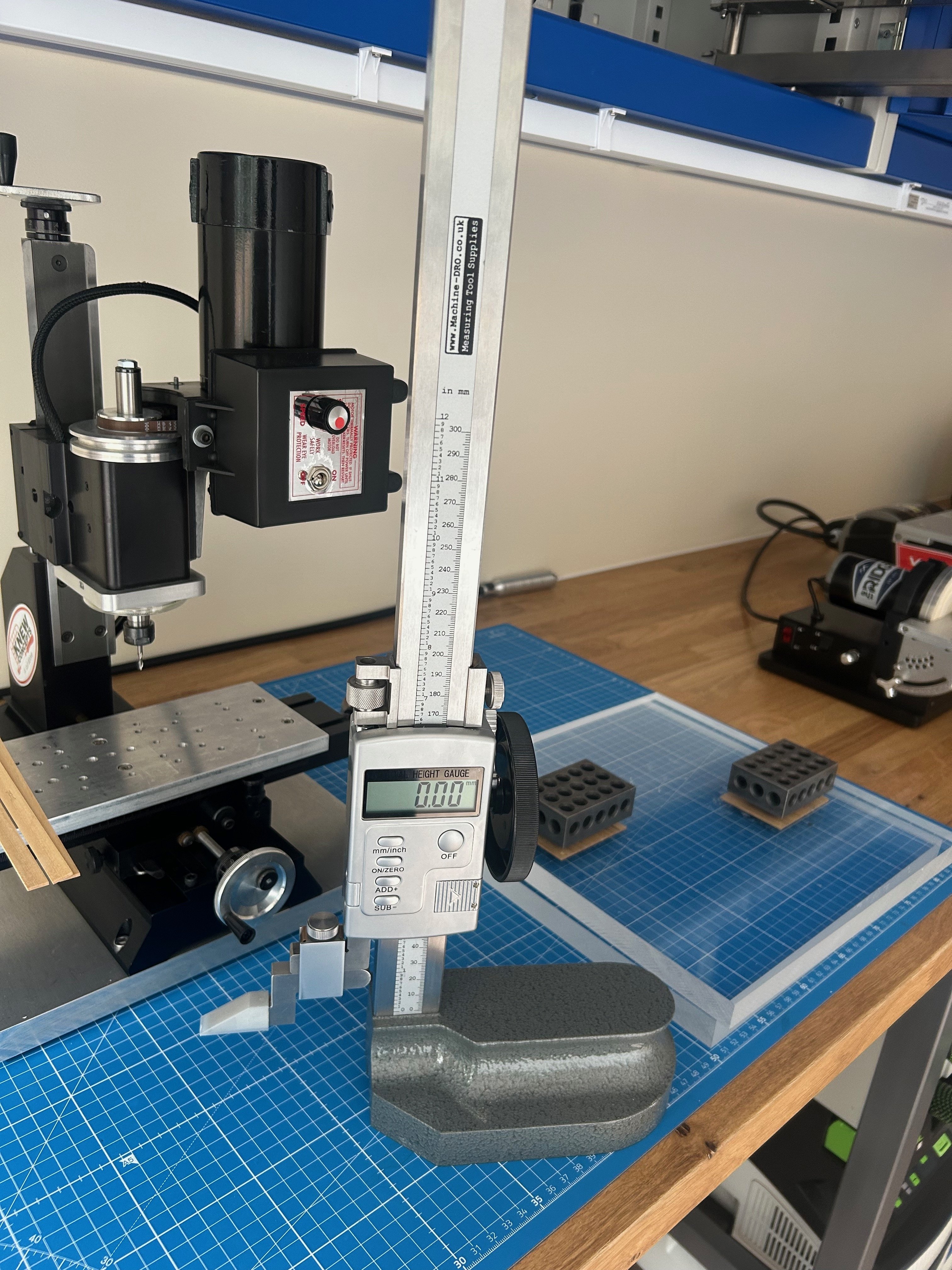

Interesting gantry, could you please show more of that measurement probe mechanism on top? :)
Hi Mike - it's a trick of the camera!  The gantry is separate from the height gauge in front of the of it.  This is the gauge that I use - I use this to measure so much as my datum for the build is the bottom of the keel.  I didn't have this tool when I began building but I wish that I had.

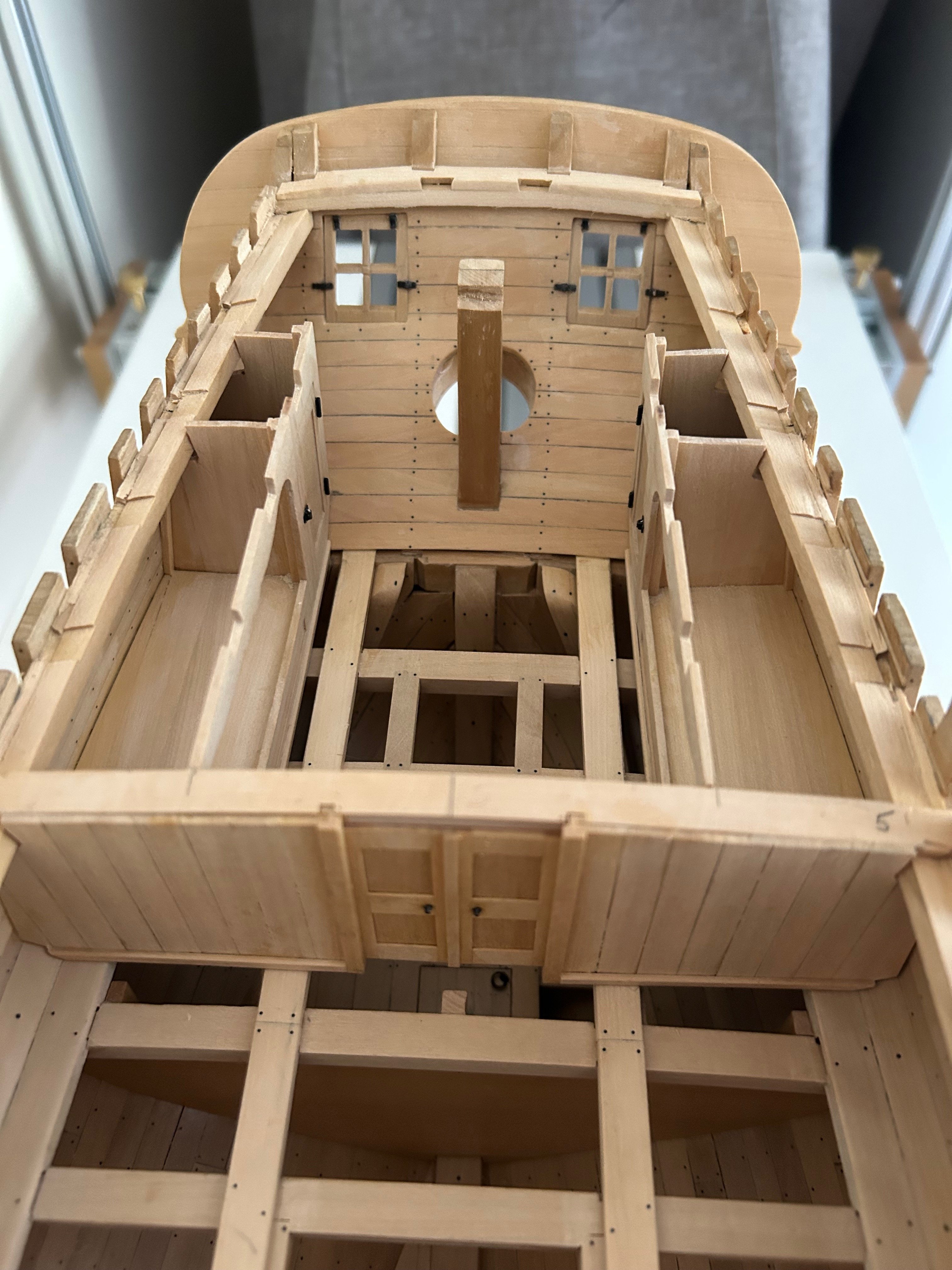

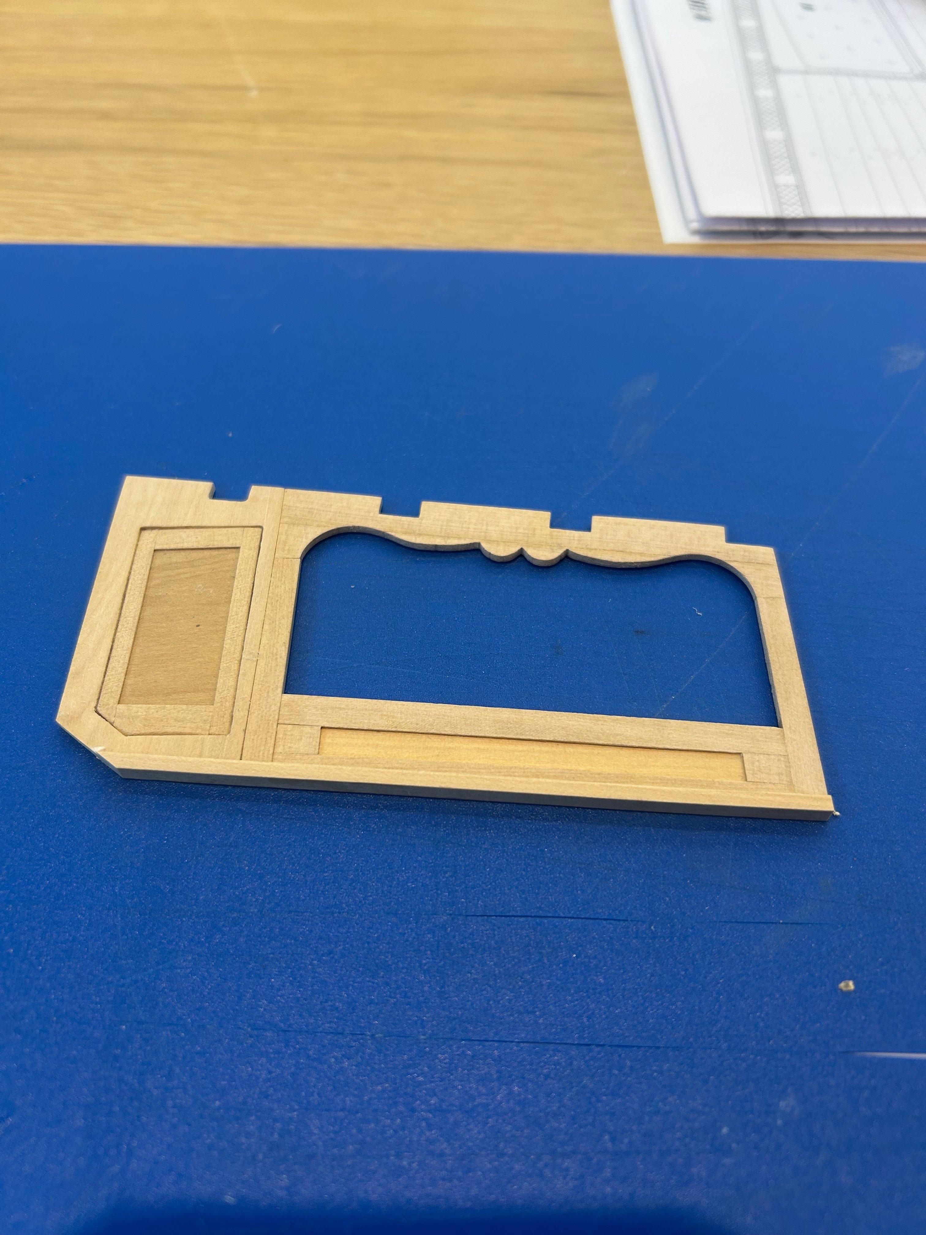

I'm now working on the crews quarters below the quarter deck and have started with the bulkhead which has a double entry door.  This is quite a feature on this ship so I want to get it as good as possible.  I started by making the shiplap planks that form the walls which I then glued together to make the actual walls.

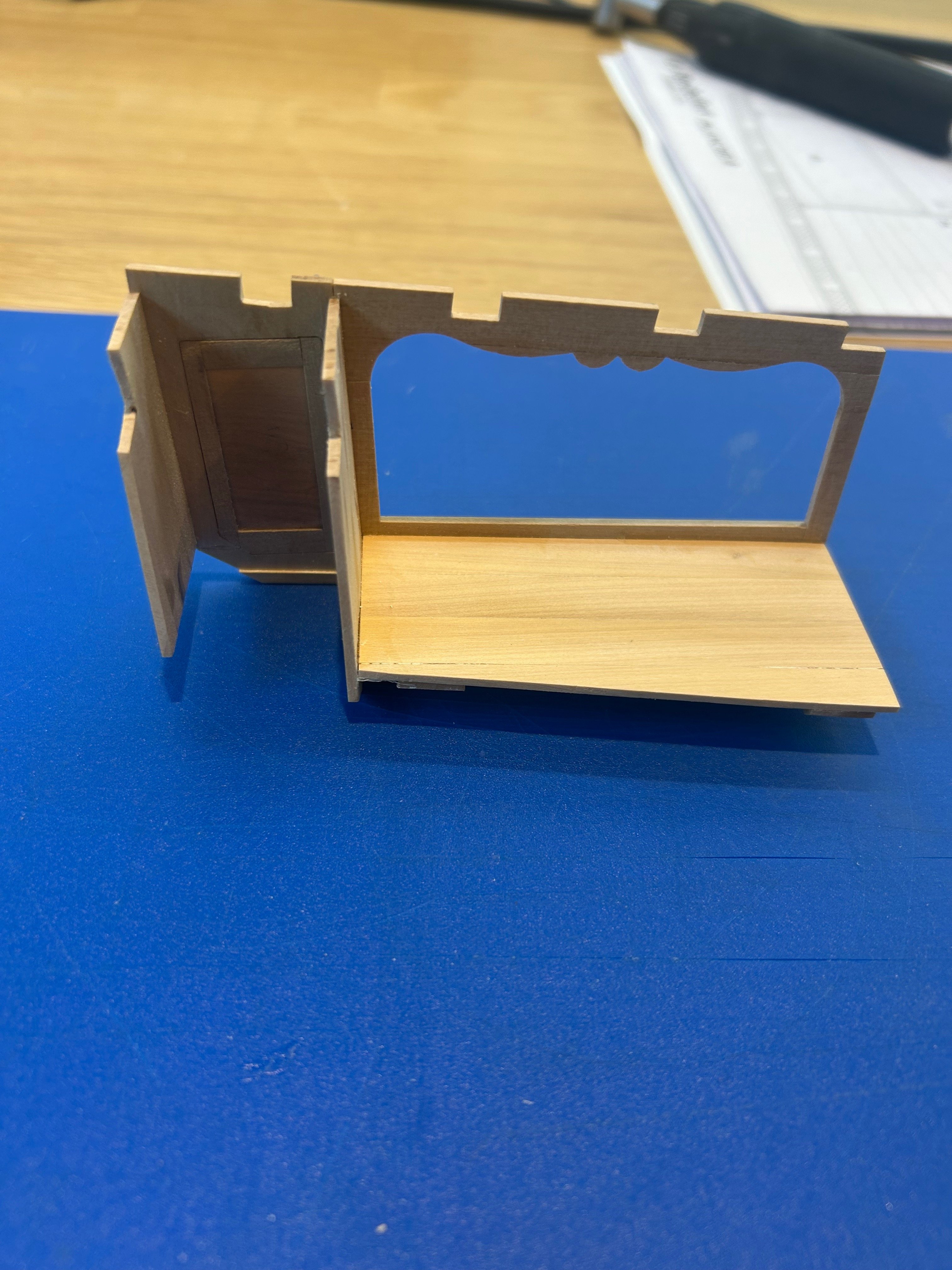

Next was to look at the doors themselves - I usually just get a solid piece of wood and then mill out the features to make them look like doors.  In this instance I thought that I would try a new exercise for me and make them from individual parts and include all of the relevant joints as they possibly would have been made originally.    Each frame is made of 5 pieces which then require 4 inserts in each door.
Milling out the rebates to fit the 0.7mm inserts

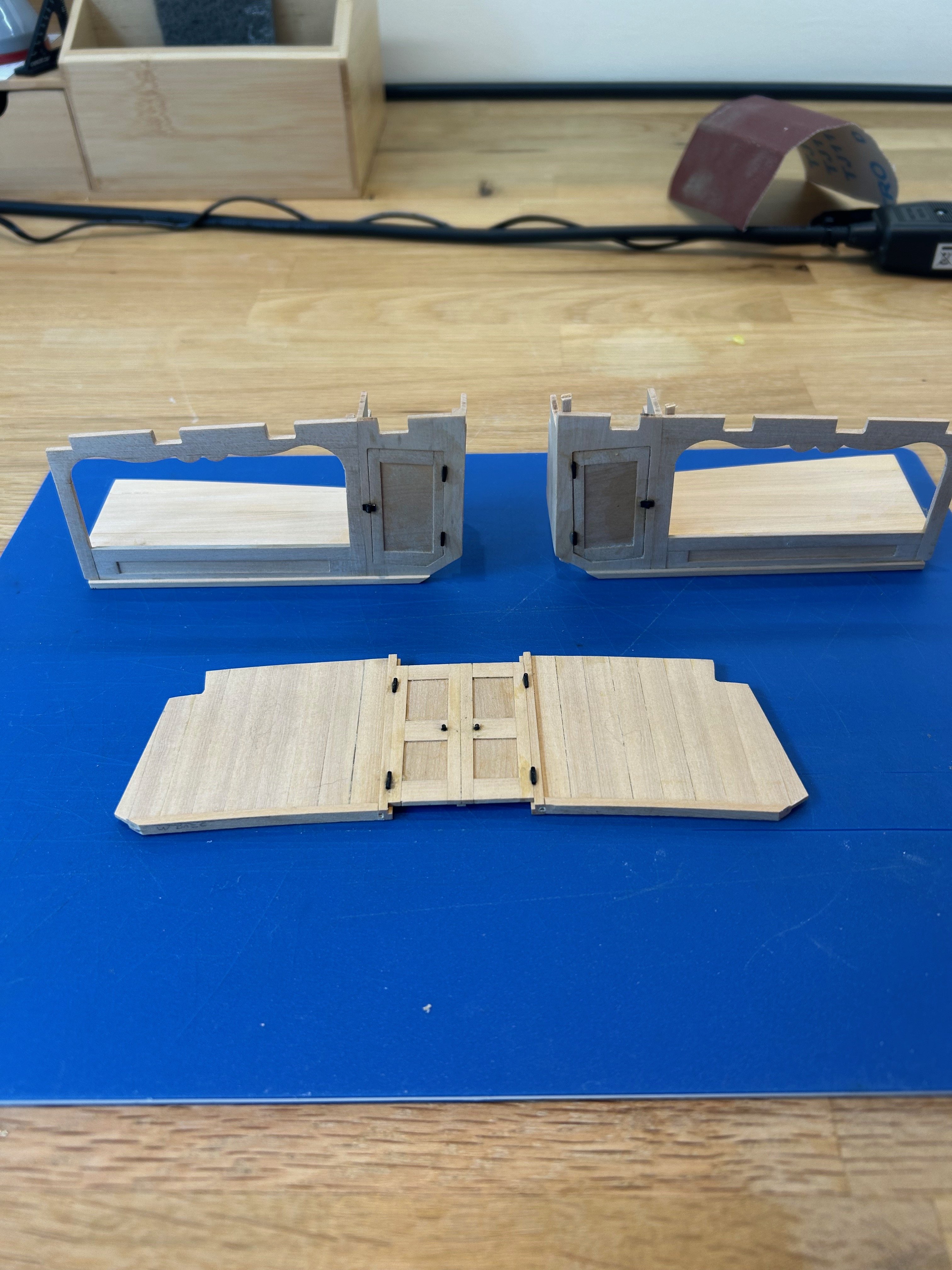

Sorry I should have taken more pictures but here are how the doors turned out.  Assembling the parts actually proved to be one of the hardest parts.

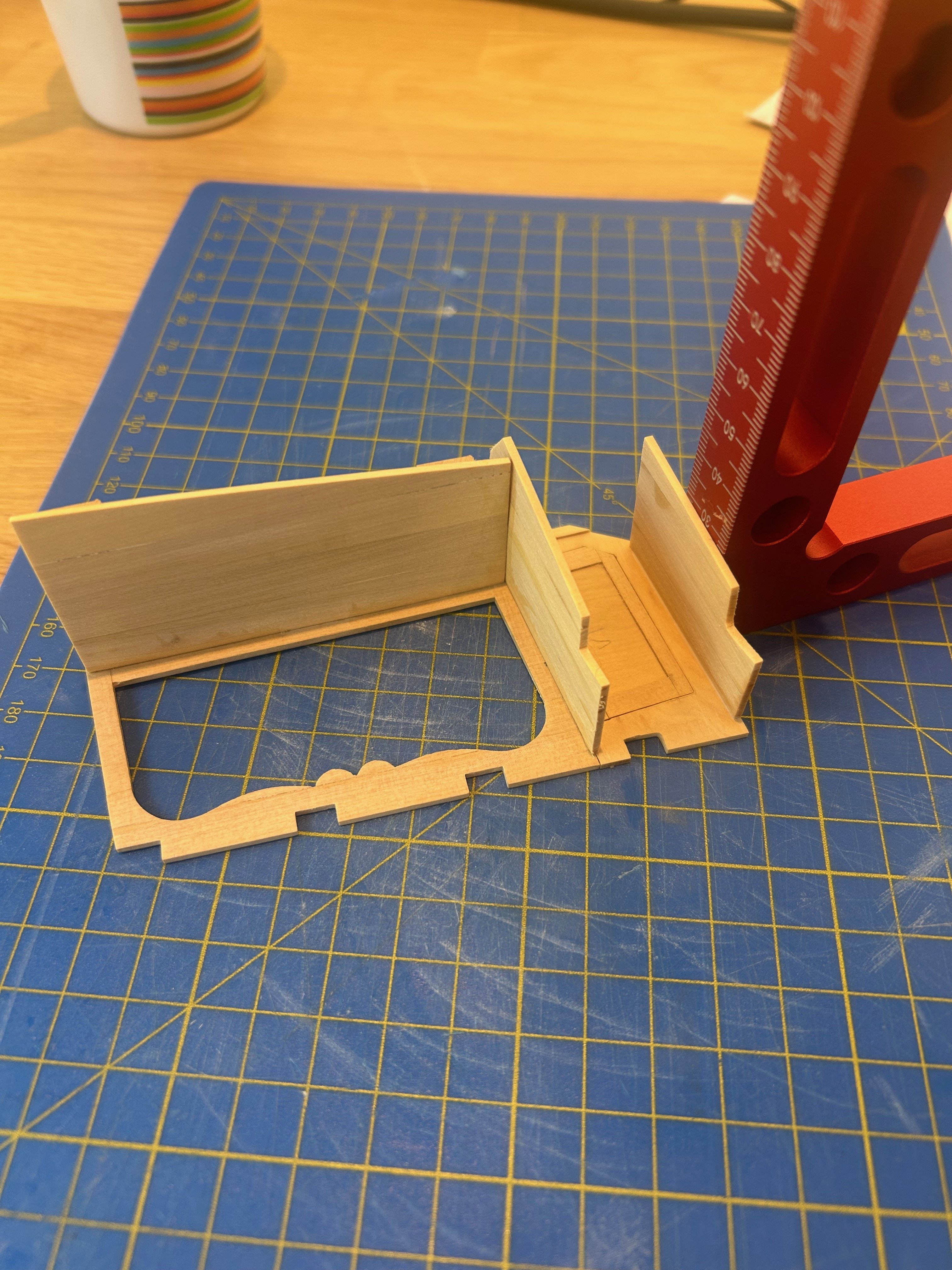

Next I needed to make the door frame uprights which have 2 rebates cut into them and also the base rebate that the walls slot into.
It all took a little bit of fettling to get all of the parts to fit correctly but I'm just about there now.
I did have one issue and that was with the door frame uprights which stopped the whole assembly from sitting flush with the beam.  This maybe because I miss read the drawings but to get around this issue I cut some rebates into the beam which actually makes the whole thing stronger and more stable
It's all still a work in progress but I'm getting there with this particular part of the build.

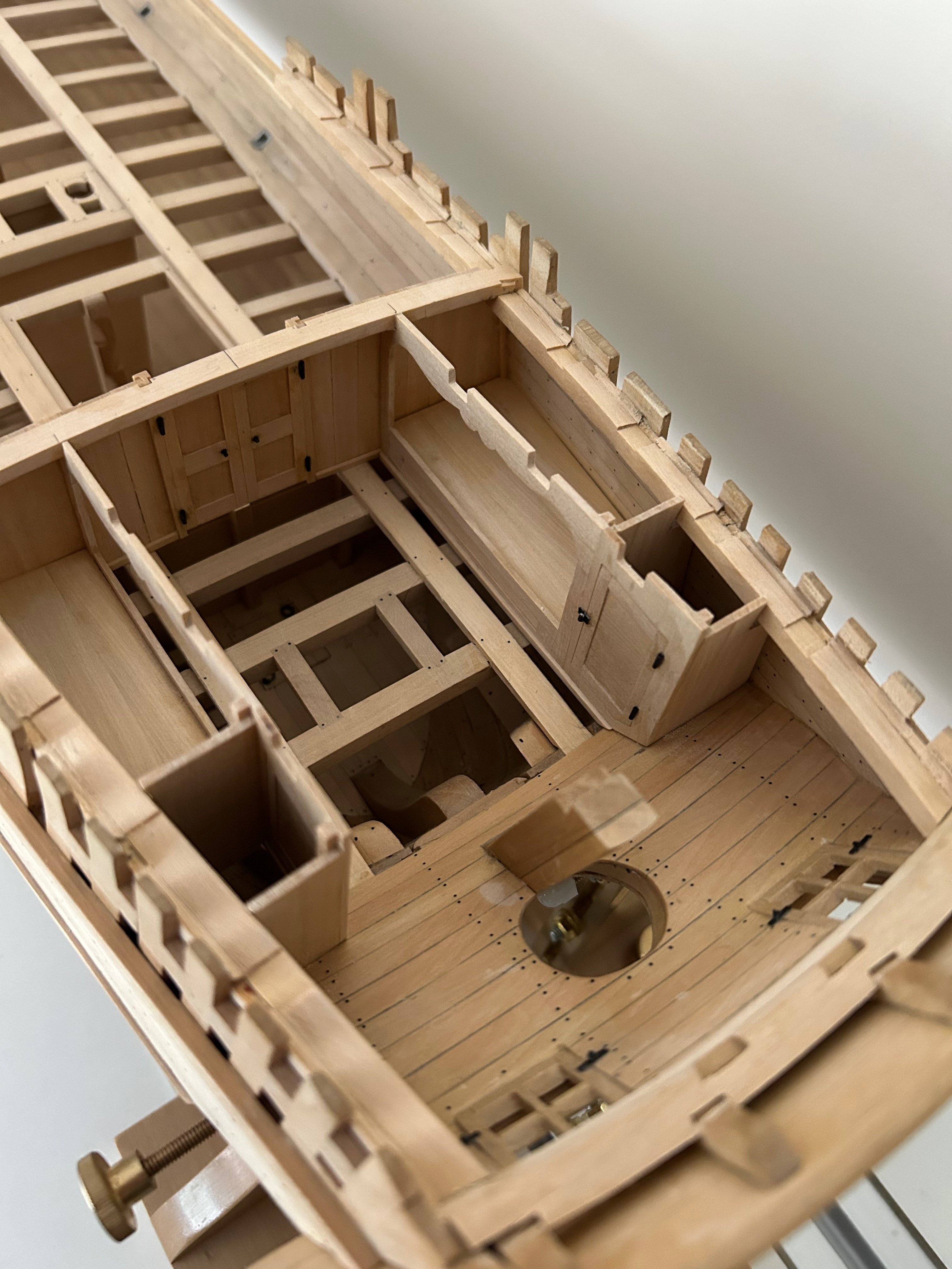

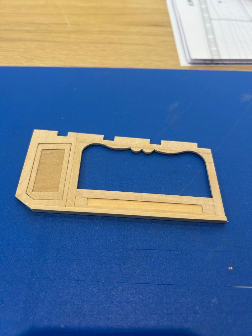

A bit more work done this week - I have made the 2 beds.  One is for the Master of the ship and the other for the Master Gunner who was on board when Le Rochefort carried its cargo of gunpowder.
I made the recesses in the door and the lower part of the bed in the same way I made the door into the cabin.  I just like the way this method looks when finished.
Next was the cupboard walls and the base of the bed

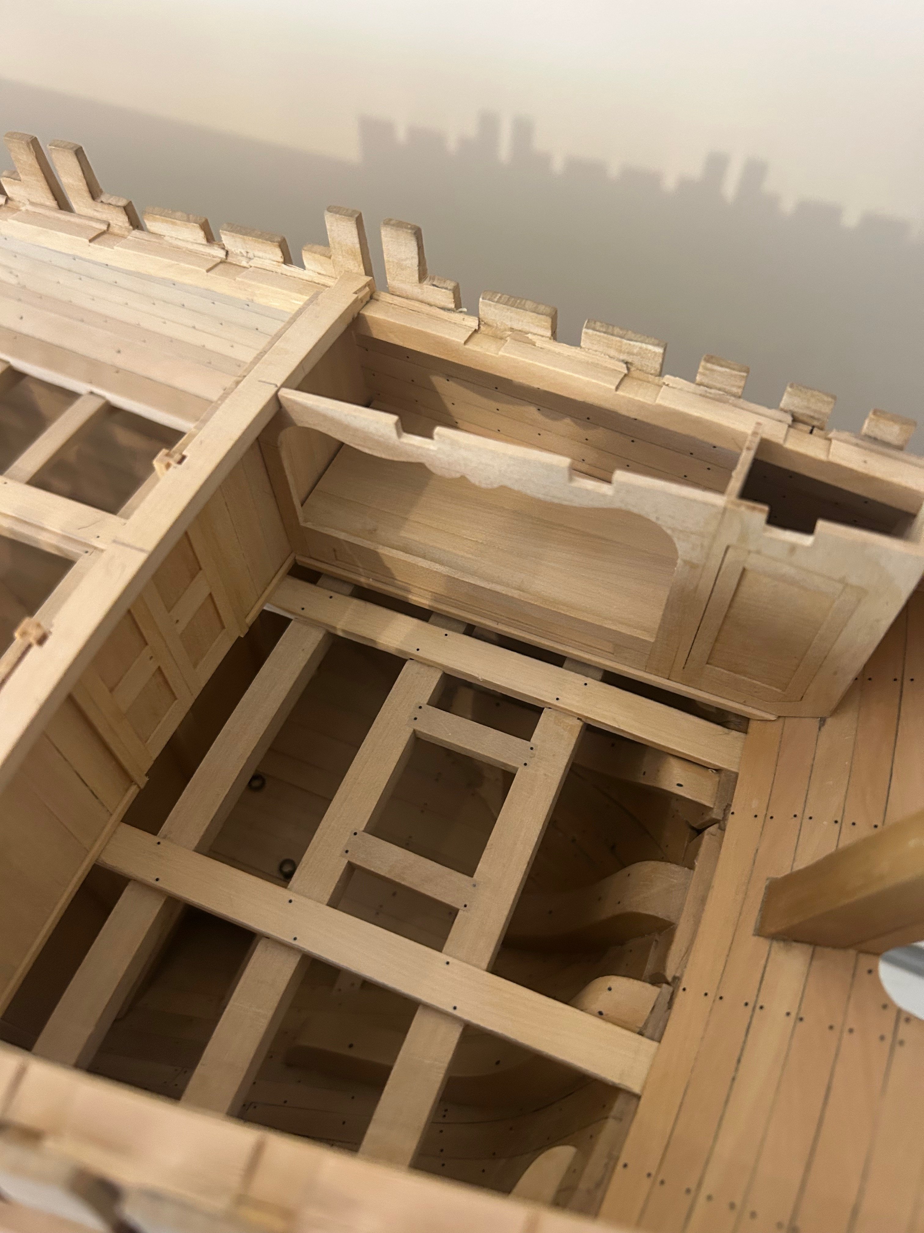

The pair of beds and the bulkhead with hinges and handles fitted.
The parts now fitted into the hull - it's the fitting that takes the longest time just trying to get a tight a fit to the hull as possible.
So I'm pretty sure that once I've made the hatch surround, fitted the beams and made the carlings that will be the quarter deck finished.  Those tasks will be my next jobs.
