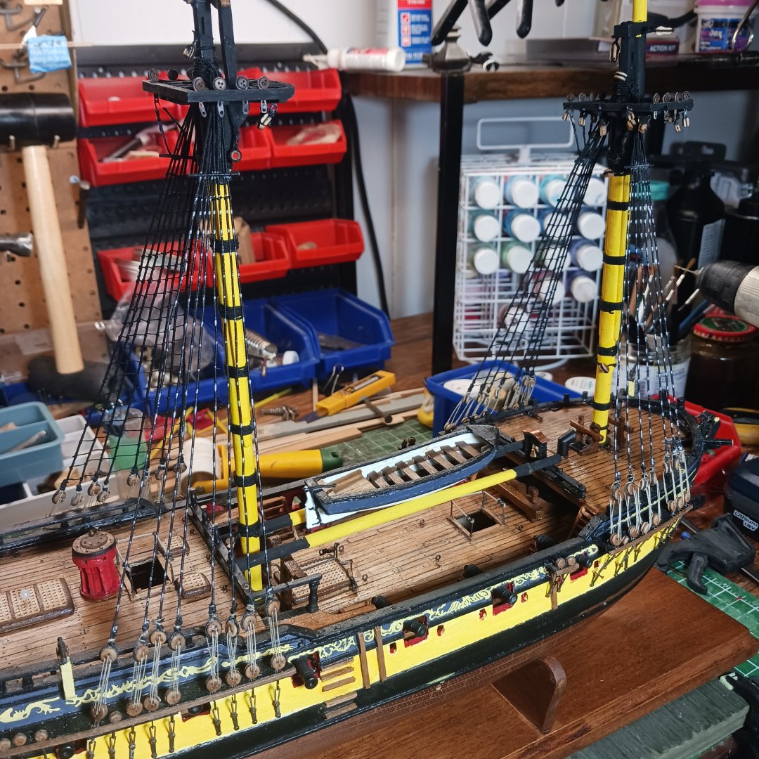

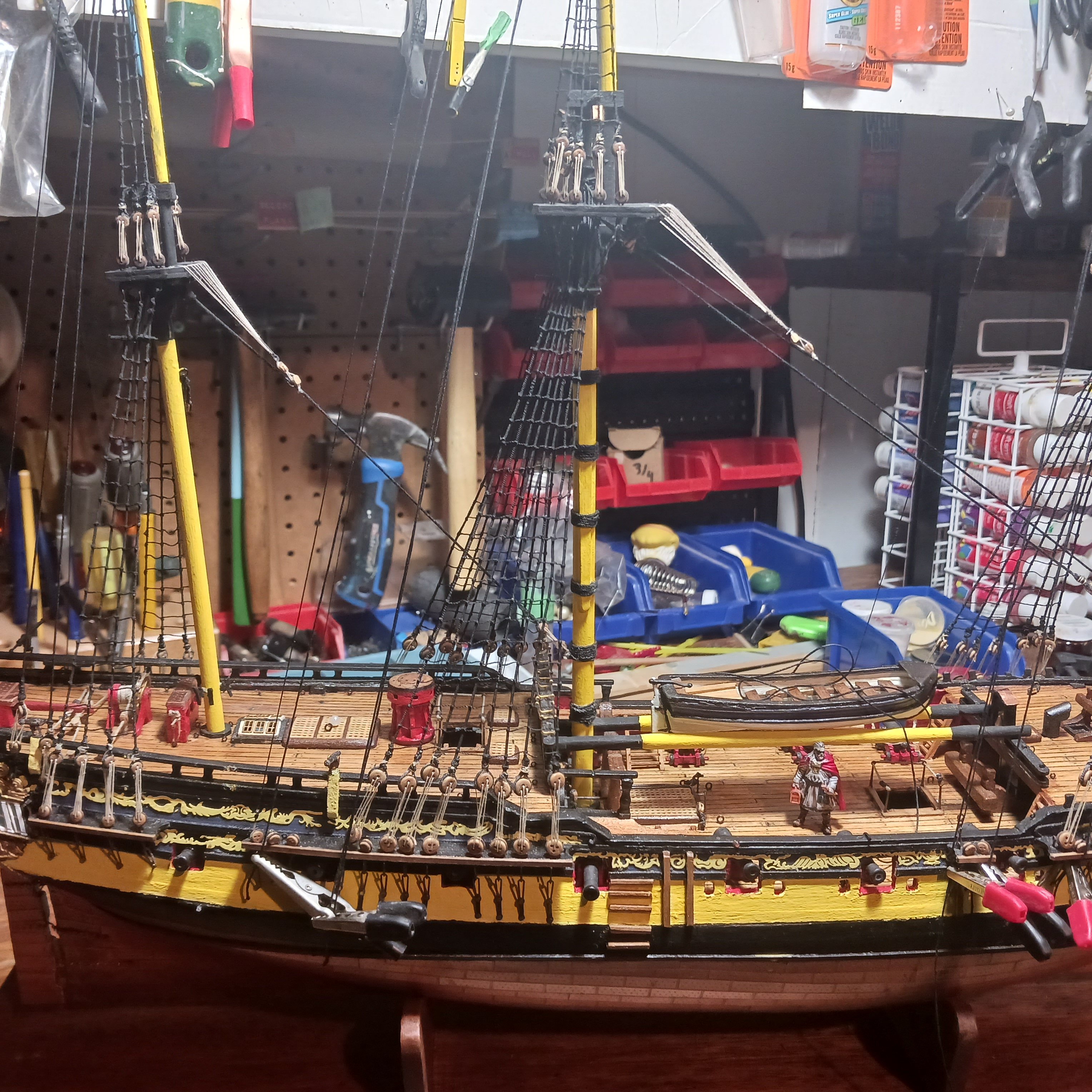

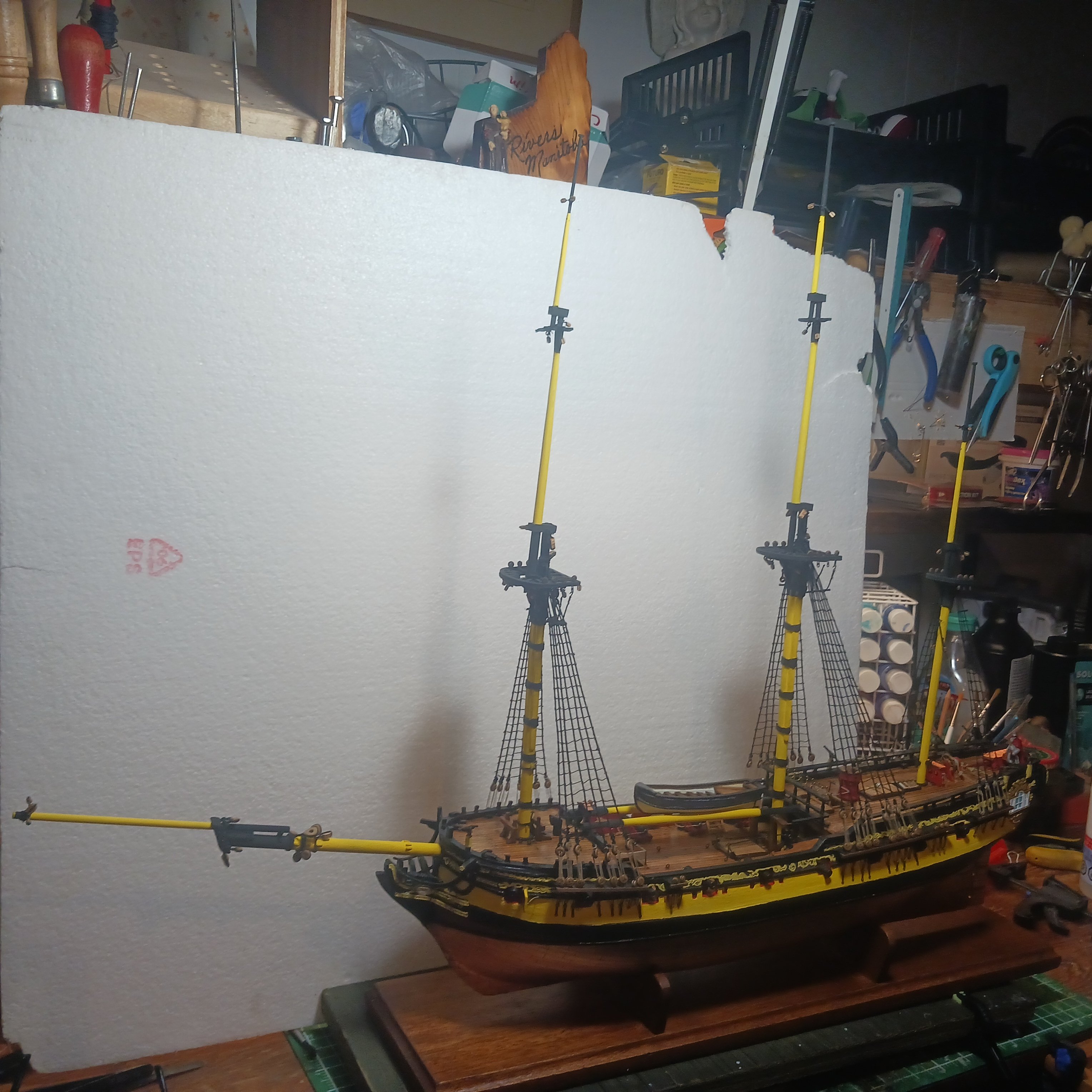

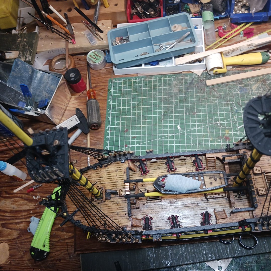

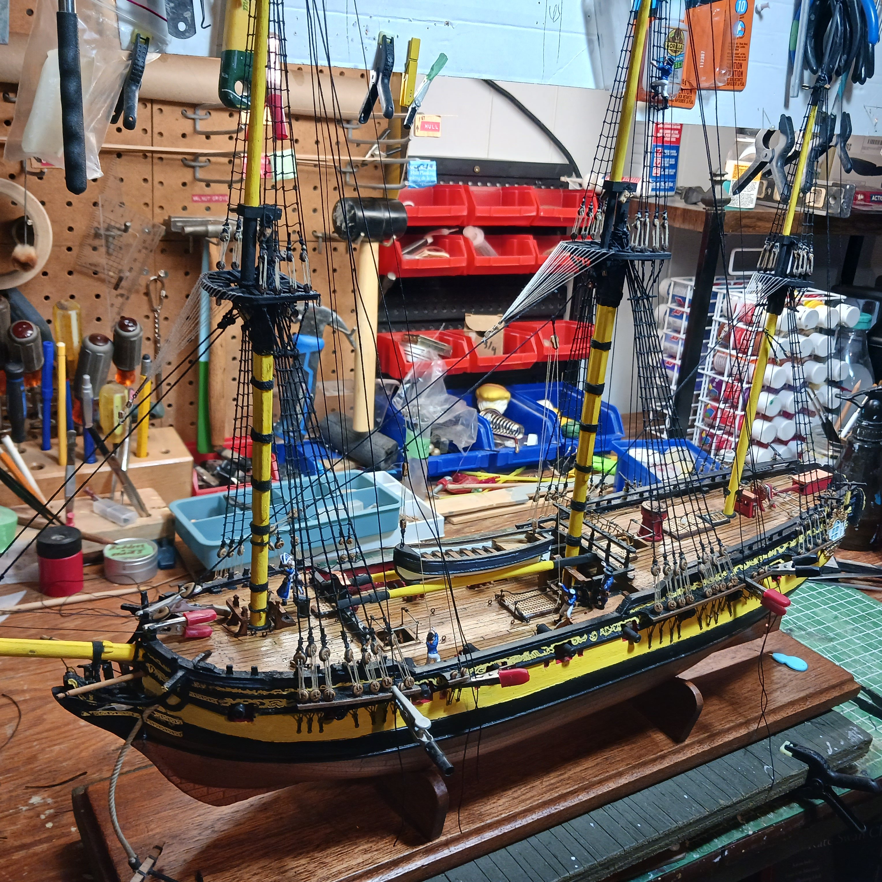

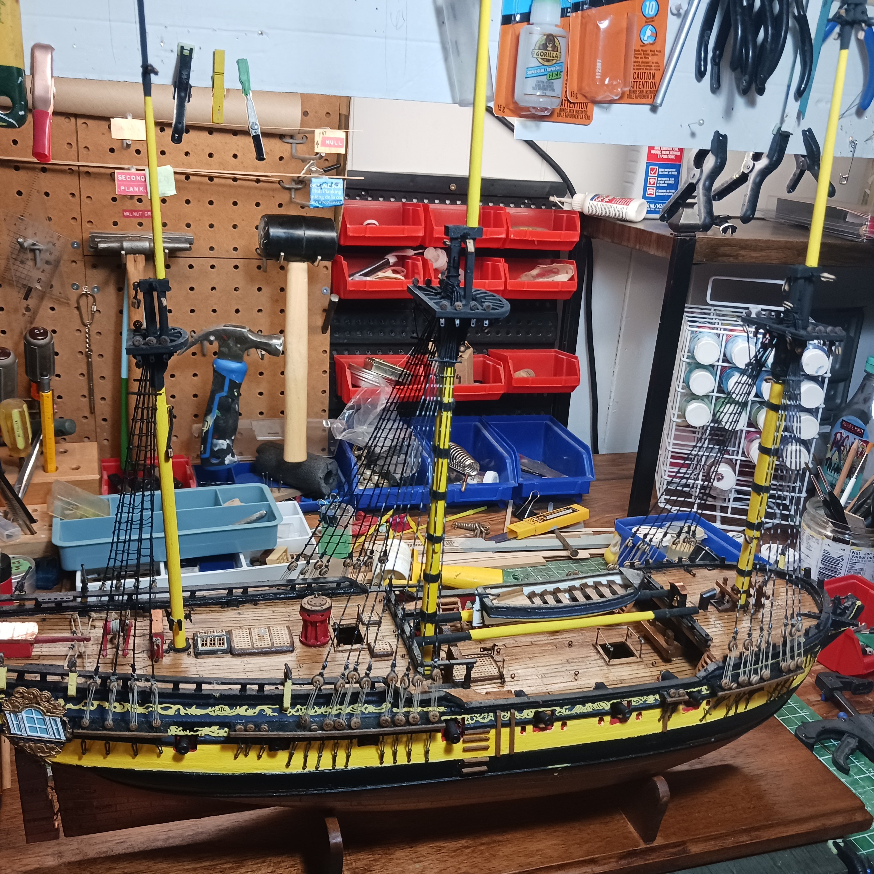

Yee haaa , lower ratlines are finished. 20251030_115635.thumb.jpg.ccd4b1f2fd3244819537a030306ad963.jpg
On to the upper shrouds and ratlines,  then the bowsprit mast needs to be rigged.
A couple of days, then I need to start making the yards.
Things are going fantastic,  ratlines  will do that to you lol.
Really  taking  my time now, I want to rig it just right.
Futtock shrouds and upper ratlines are next up.
Thanks for peeking in,   :cheers:

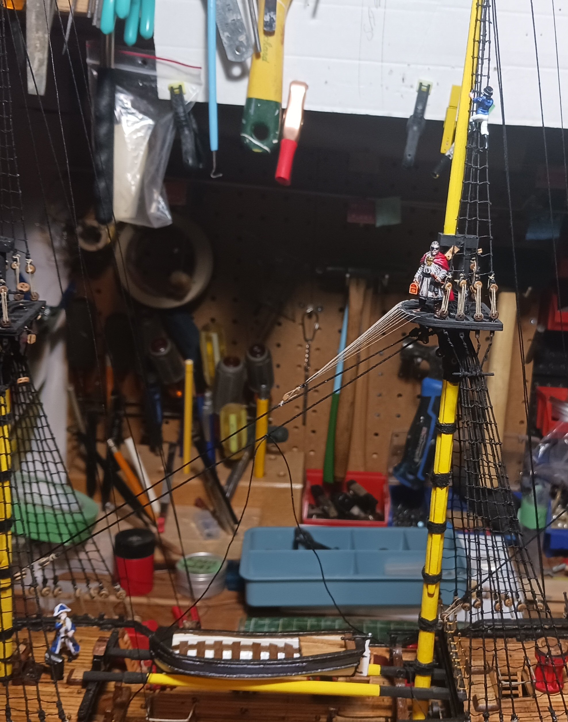

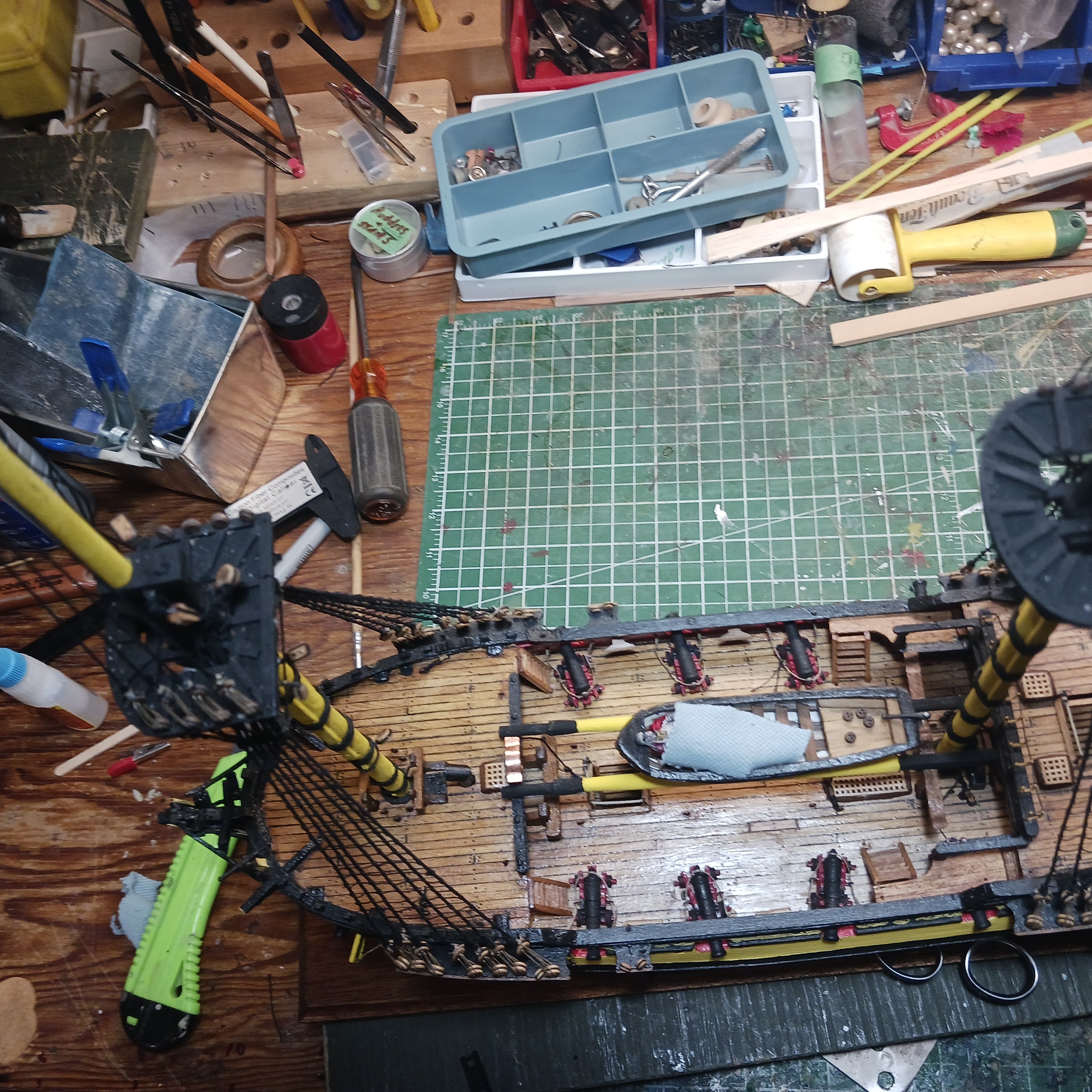

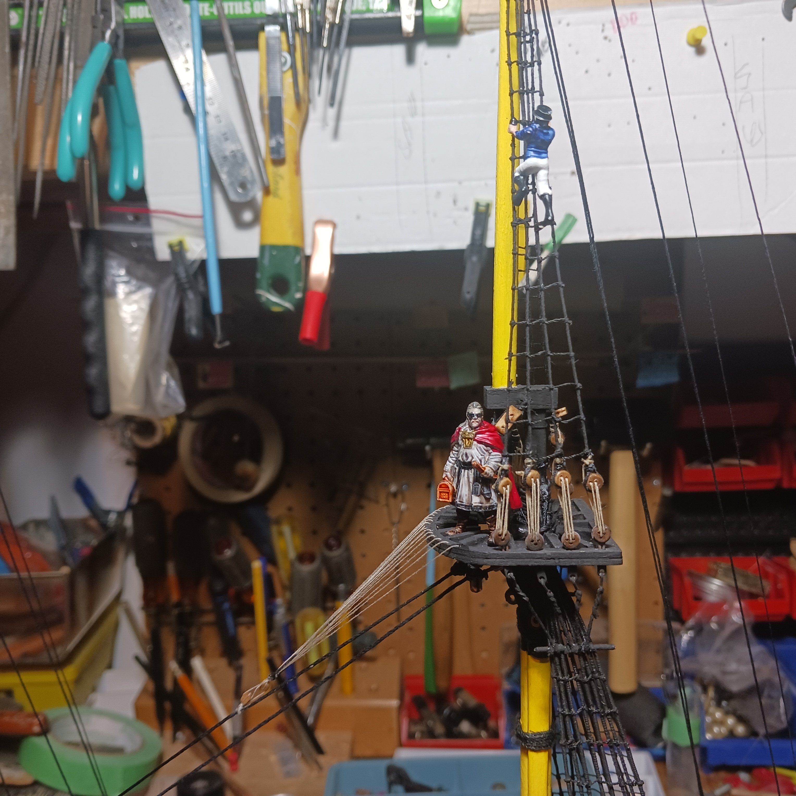

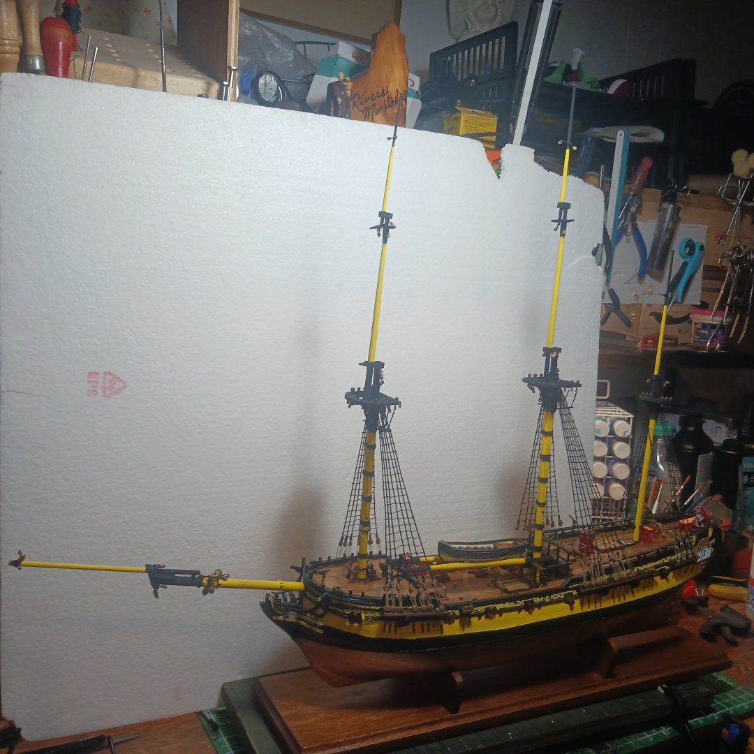

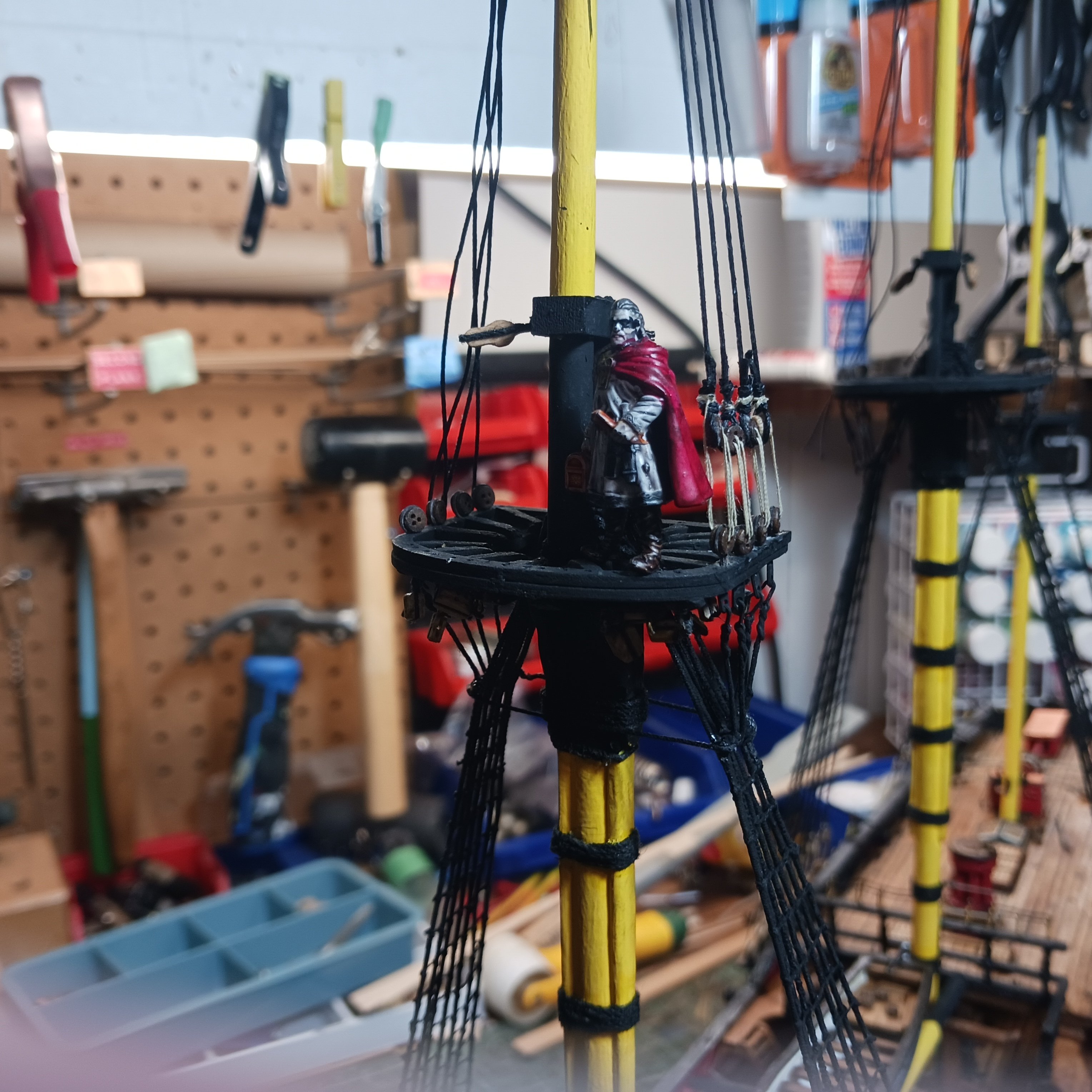

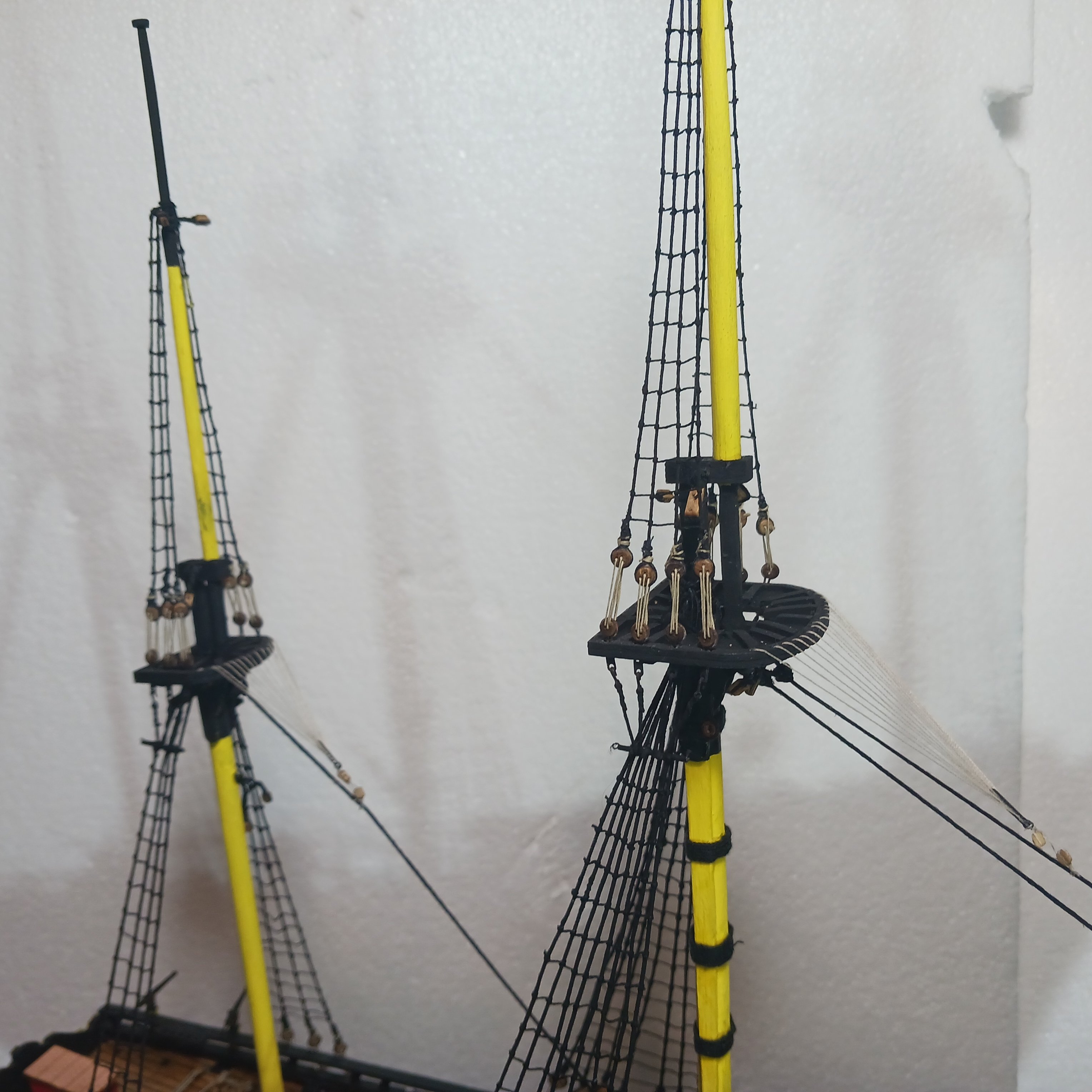

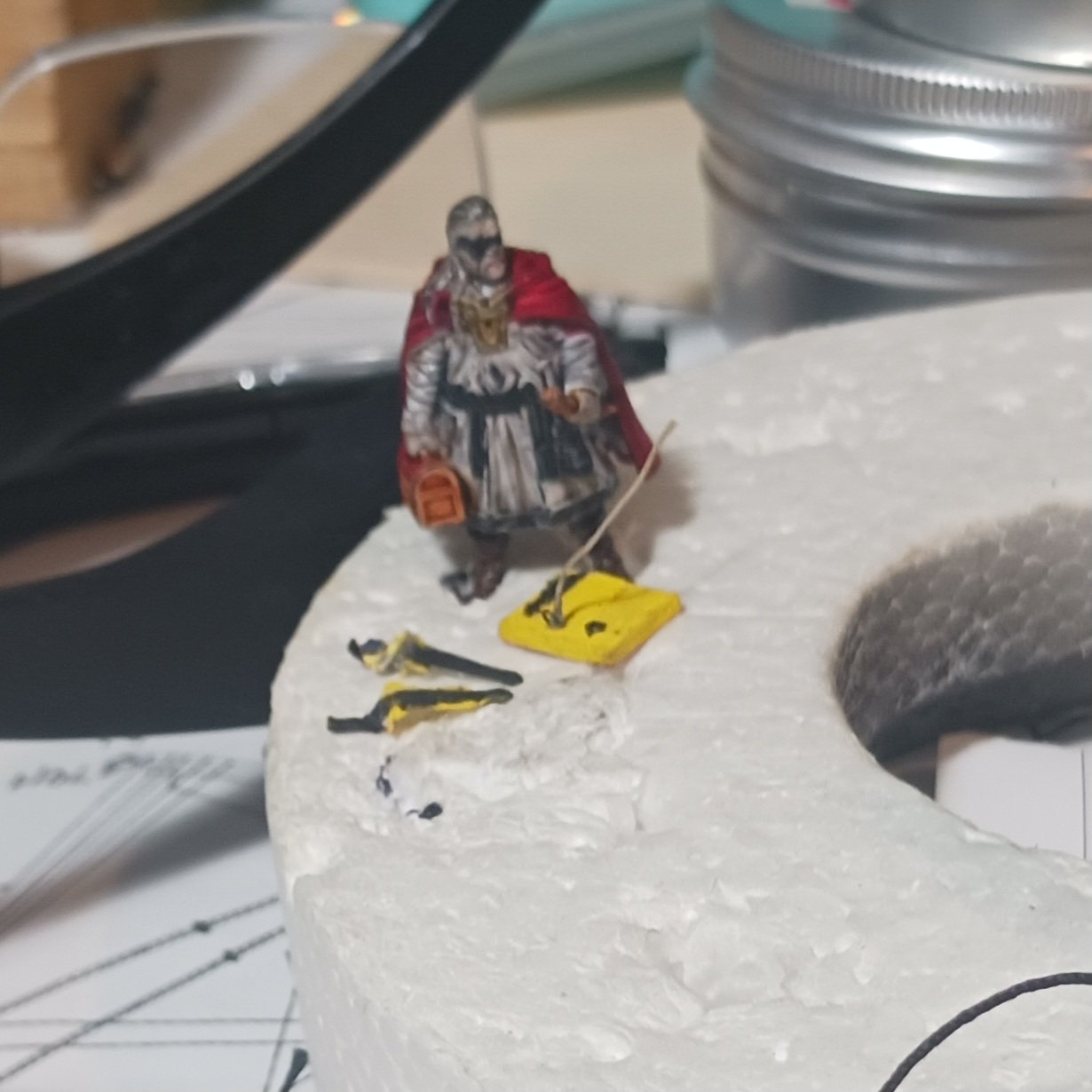

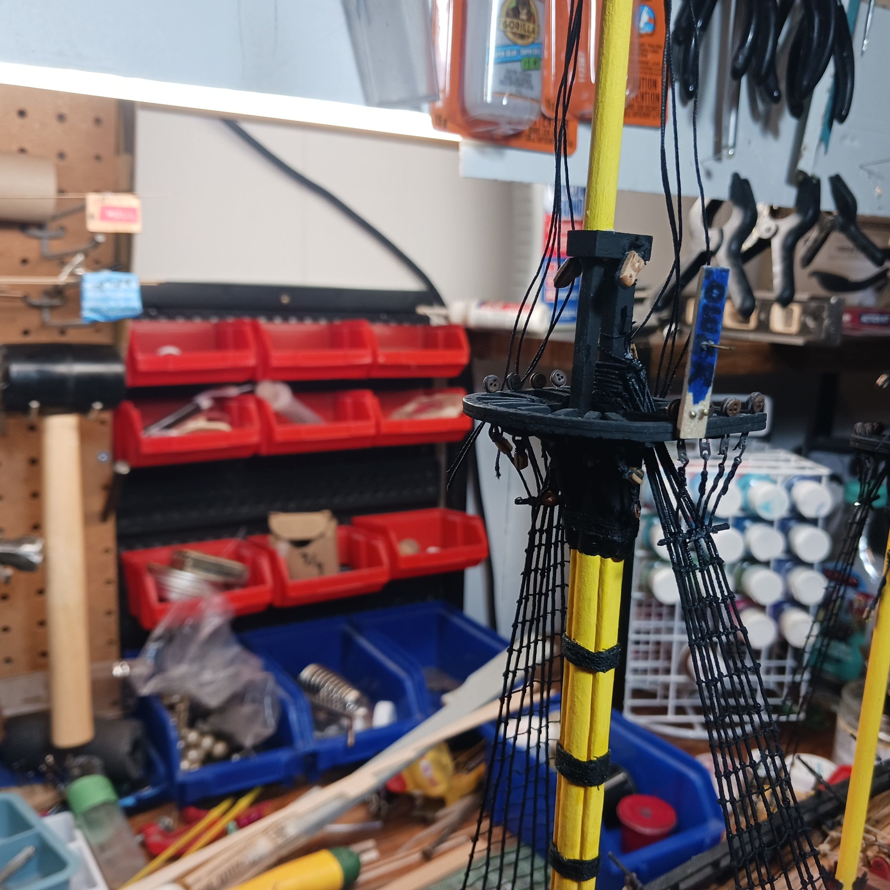

My Catharpins on the foremast are a bit shaky, lol. The hands are definitely shaking today, but a little  ca helps, Once tared they will look fine.
Kurt Builder just rolled his eyes .20251031_123605.thumb.jpg.69e32fea6e2cd8a937cc96ffcbecf094.jpg

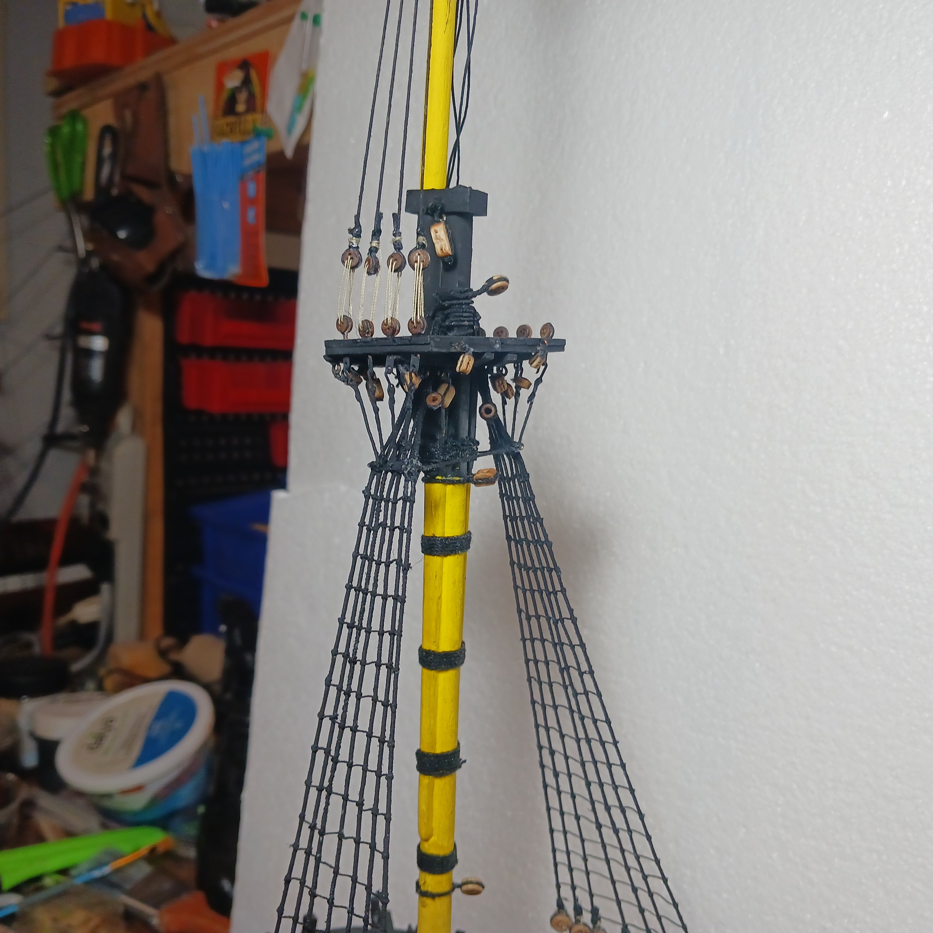

I am going to rig the upper  shrouds  on the main mast then I will do the Catharpins on the main mast. After that I will tie the Mizzen mast up, then do the Catharpins, that should give me enough time in-between each Catharpins.
So jig on the main upper shrouds, ratlines to follow. Kurt doesn't seem to understand my fasanation with rat lines 😁. The upper shrouds are tied on ready  to go,
Kurt  needs  a nap , sounds good to me as well, later my friend's.

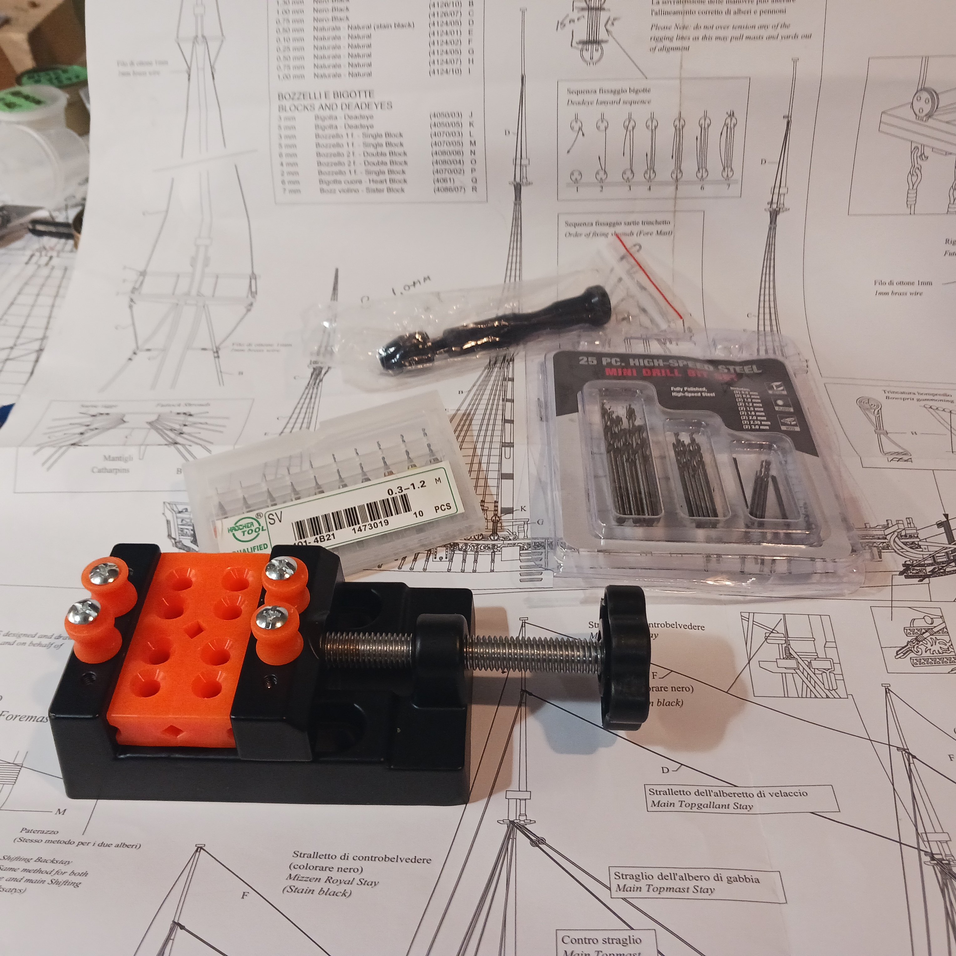

 I picked up this little  vise to help me with the yards, awhile back I saw this here on one of the logs, I was not paying attention to who posted but I liked it so ordered one, 20 bucks and you get drill bits and a pin vise so for me good deal. I needed the bits anyway.

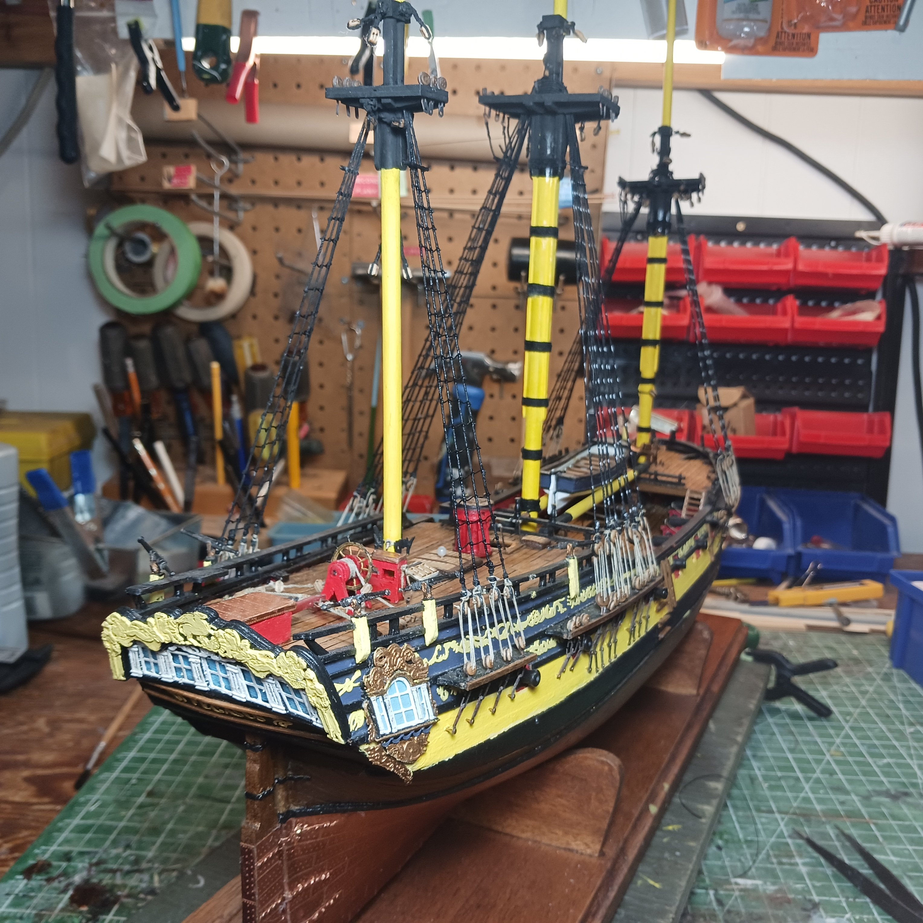

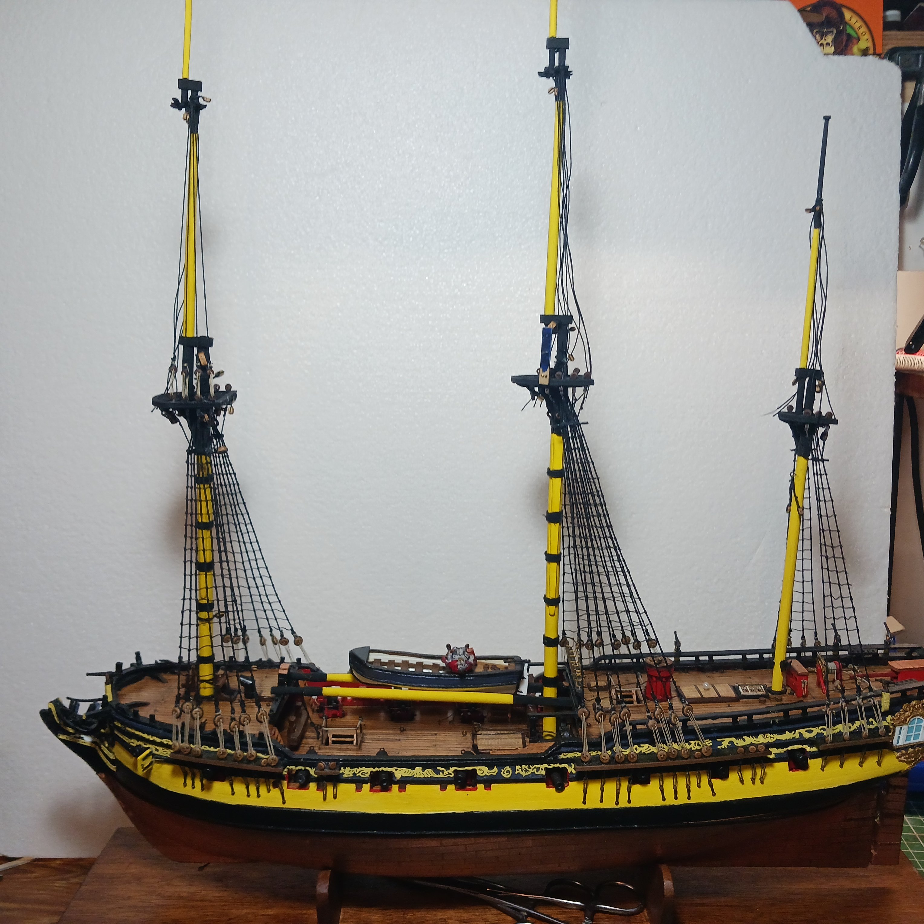

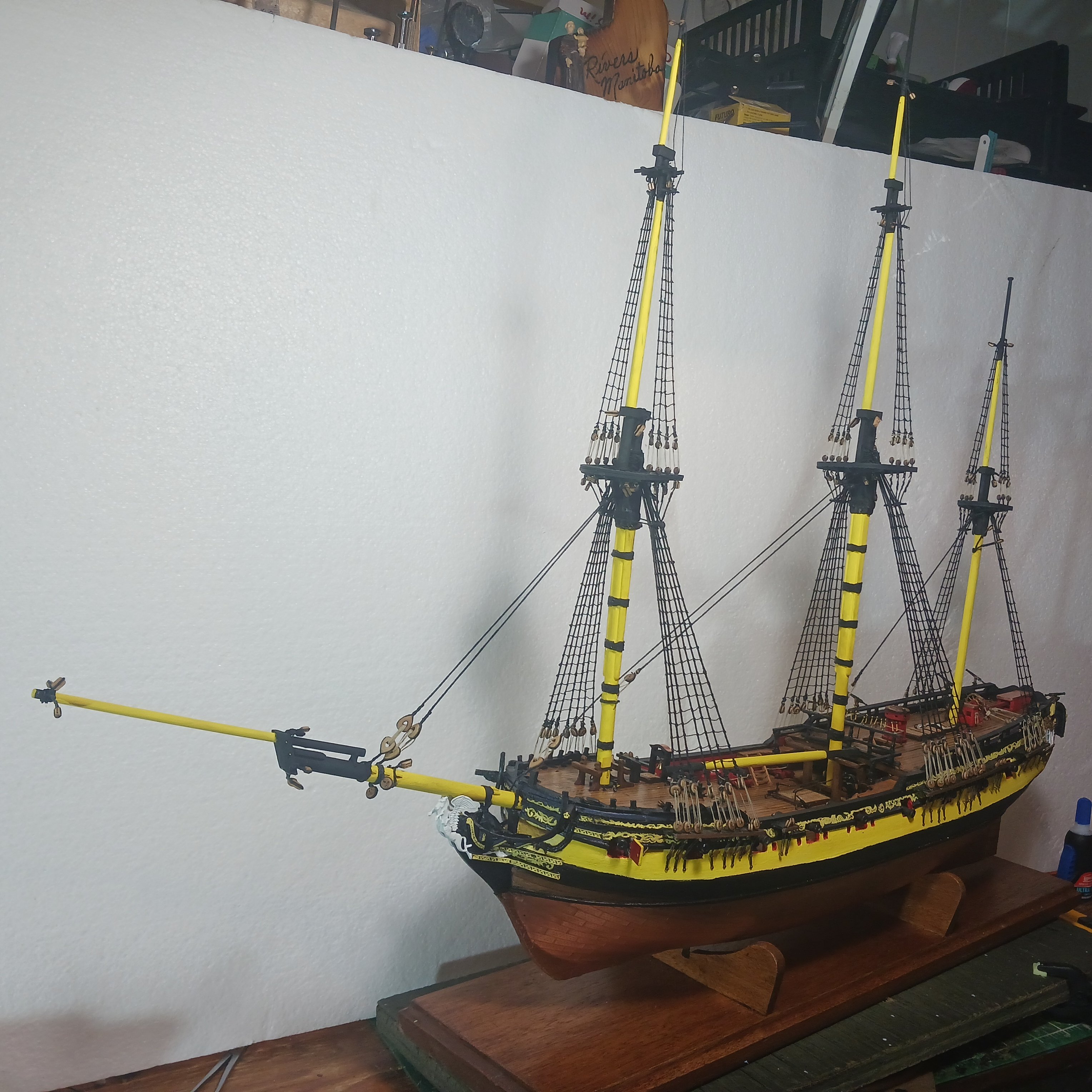

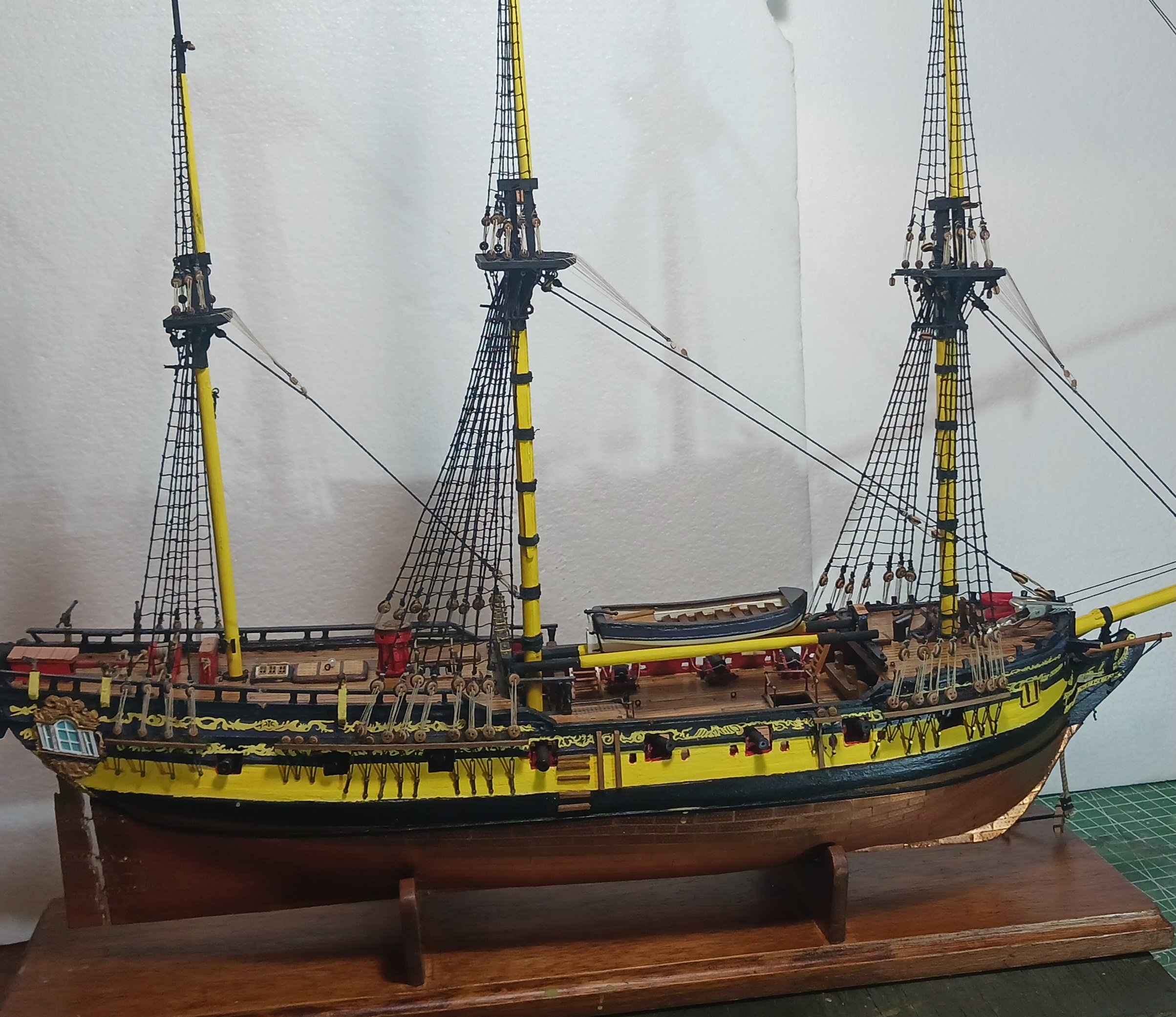

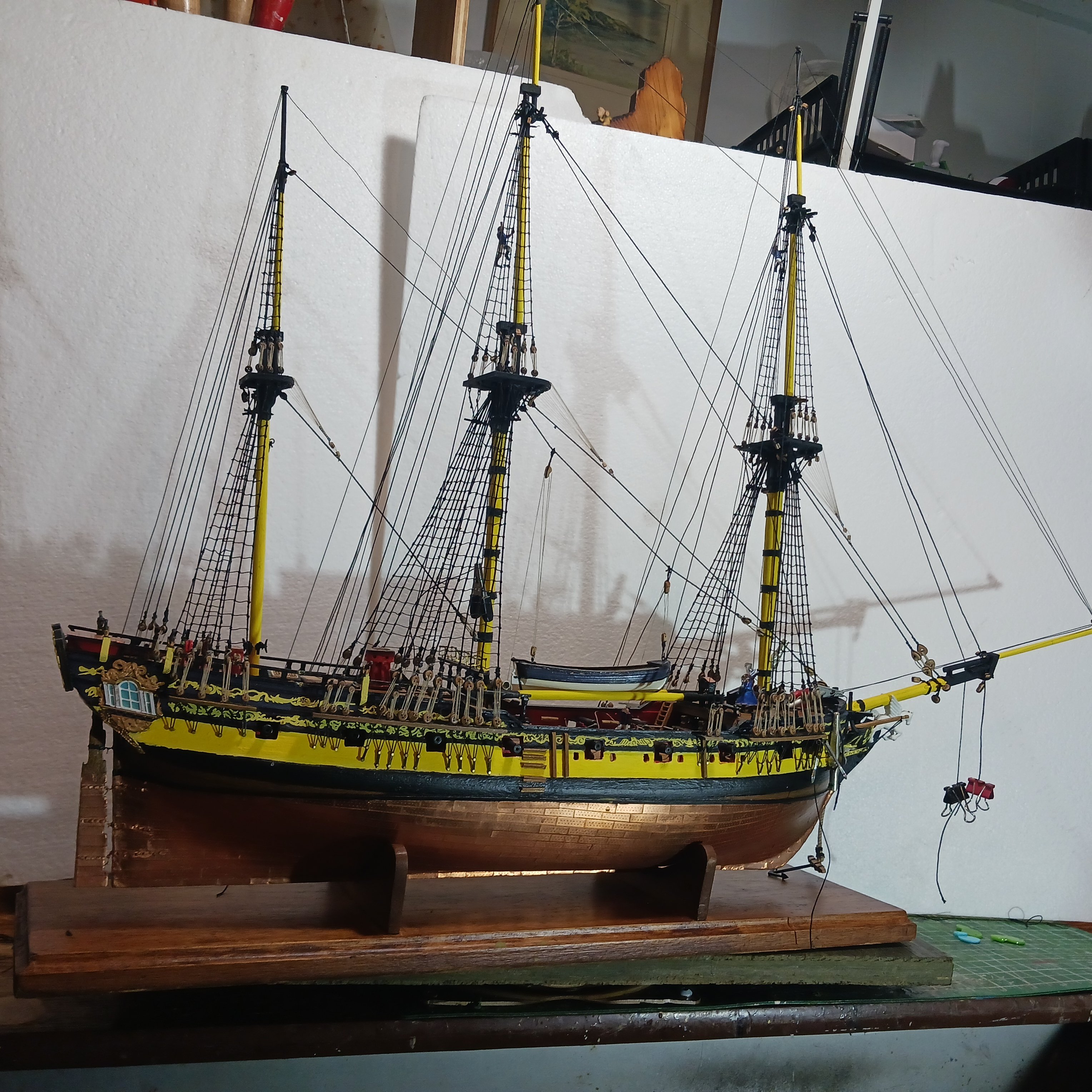

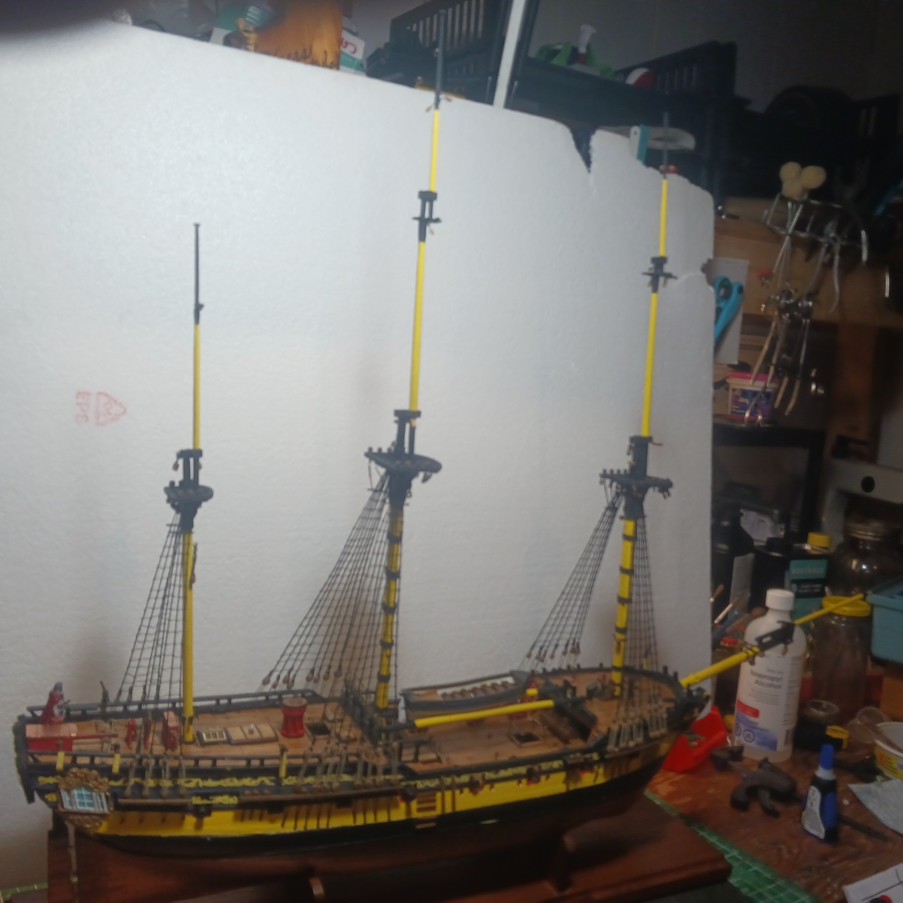

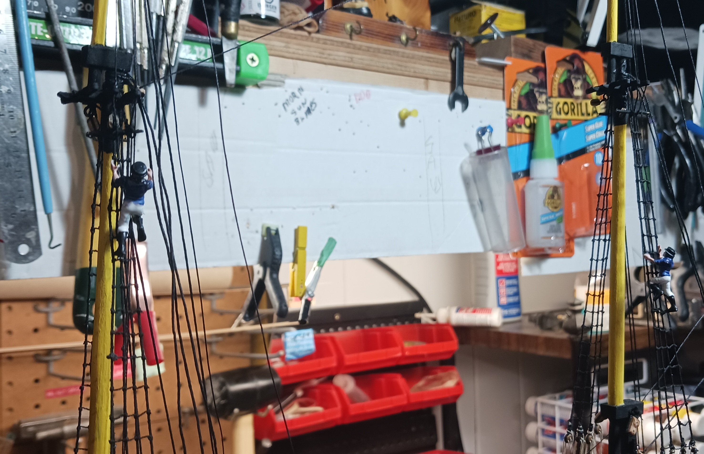

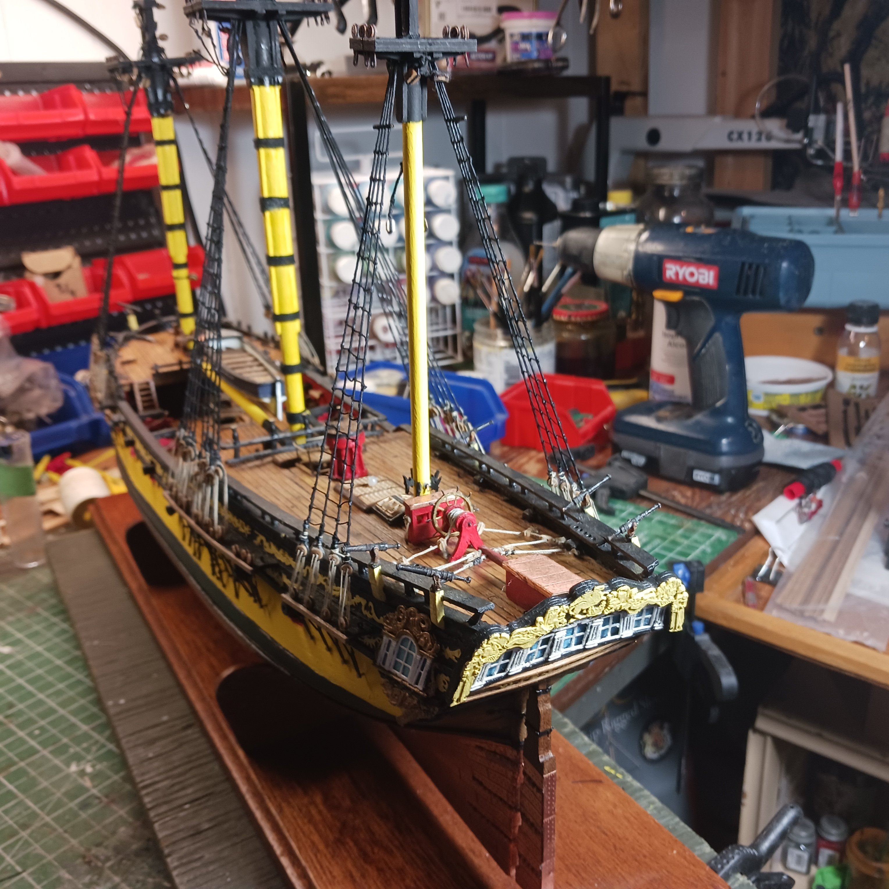

250 clove hitche later, I have finished  the ratlines.
Kurt and I cut up 90 ratlines  this morning and  started tieing them on., lots of fun stuff.
After the shrouds are marked it easy to tie the ratlines on, just remember to tie at the top of the mark.
Starting to look like the box. Now I will start running  some stays , all the lines are ready to go,  but tomorrow.  I was going good till I finished the ratlines,  then old age mentioned that I was tied lol 😆
Won't be long before I will need to start the yards, but lots of stuff to do ,gun port lids, remounting of the swivel guns lol. I am on no hurry to do that but eventually I will have to.  Lol.
That it for today, glad you stopped in to see me having the time of my life  🙂

Thanks Steve, @Coyote_6   I use a silver Sharpie to mark the ratlines, I start at the brass wire and work my way down with  the spacer, once the ratlines  are finished most  has rubed off and a quick coat of tar, aka, black paint  takes care of the rest. It also hides all the ca marks lol.

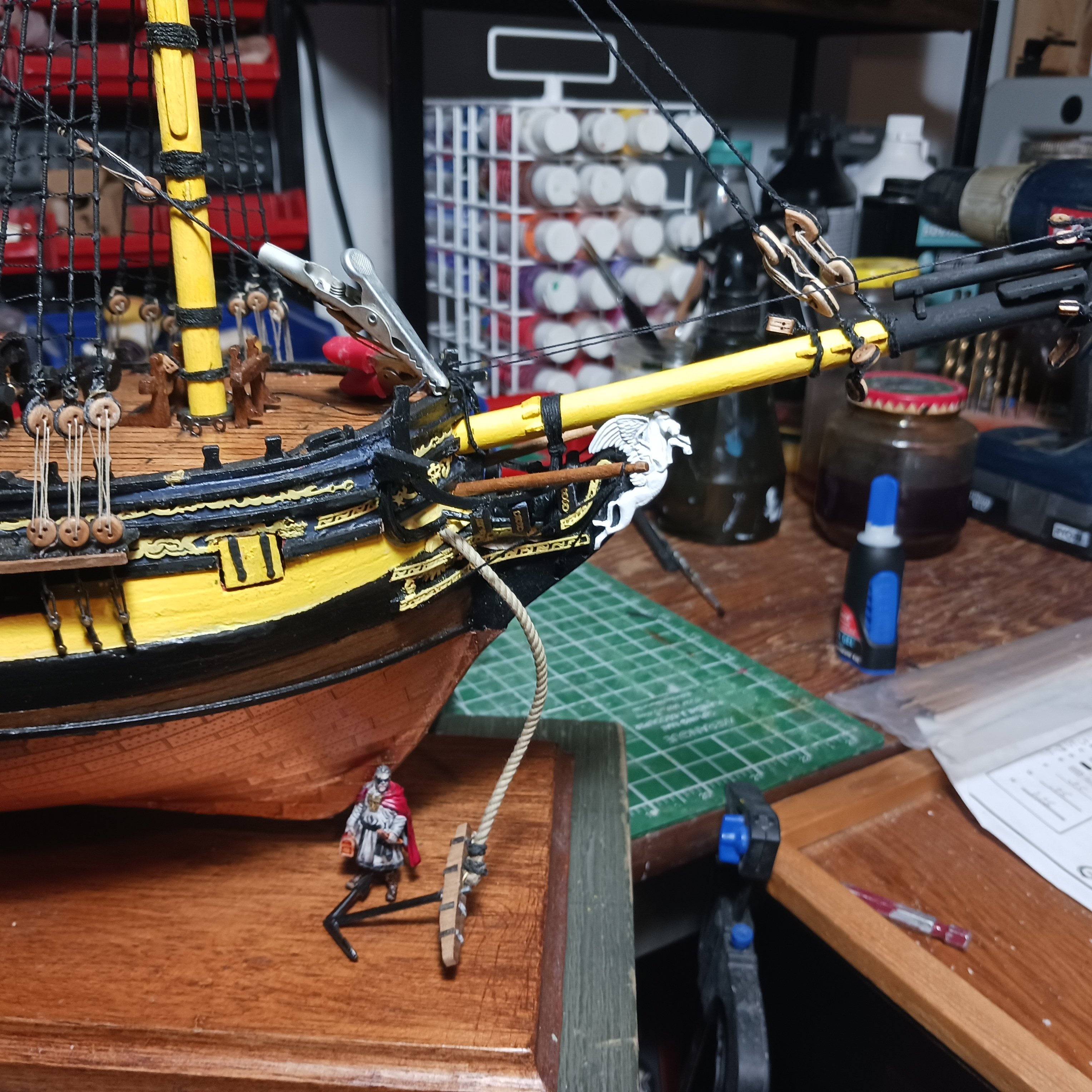

Thank you everyone, 😊,   I managed to tie on the gammoning detail with out to much trouble.  I also made my first mainstay collar, I used served line to make the collar, then seized It, it  looks right out  of the book, Rigging  Period Ship Models by Lennarth Patersson.
I have installed 5 forestays so far, I added the figurehead,  just to see what it looks like
I guickly  took it off and put it back in the box, lol. I know myself well, I would have brokin it off, and it is a replacement one my daughter got for me from when I destroyed the first one.20251104_193408.thumb.jpg.79dcf6f815e6618c3b4d910283a2deed.jpg

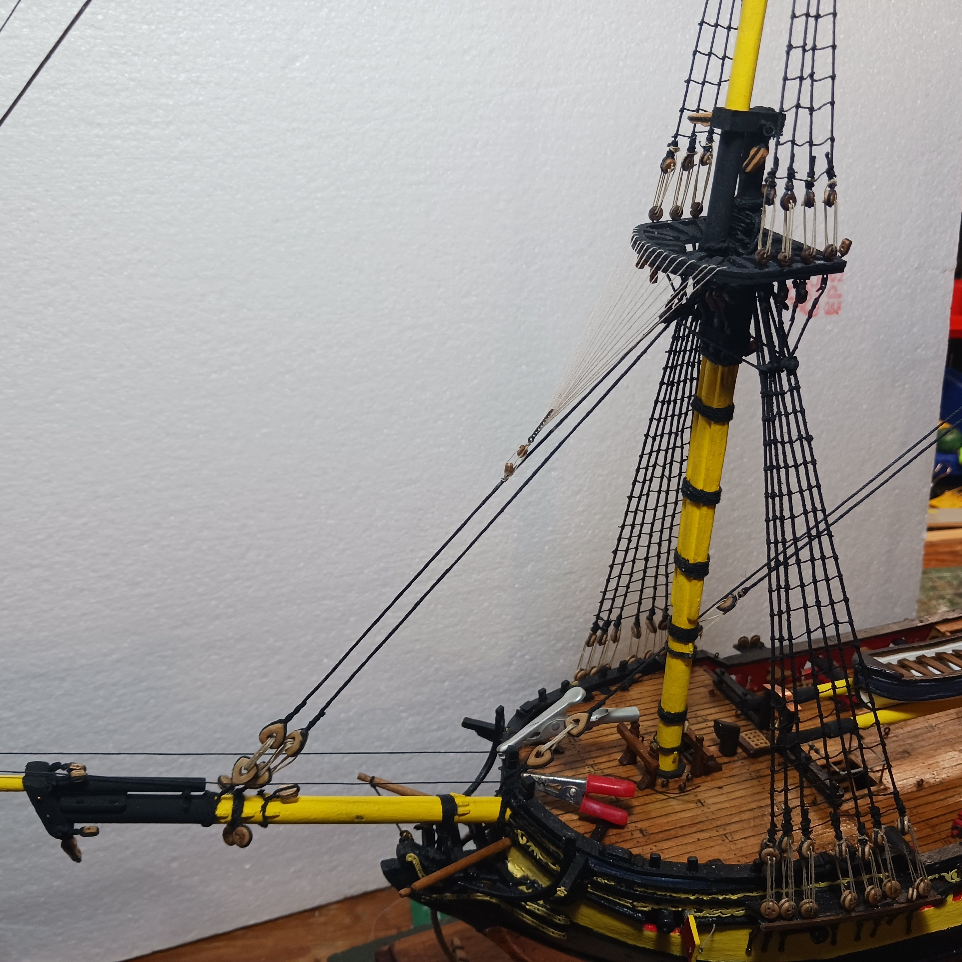

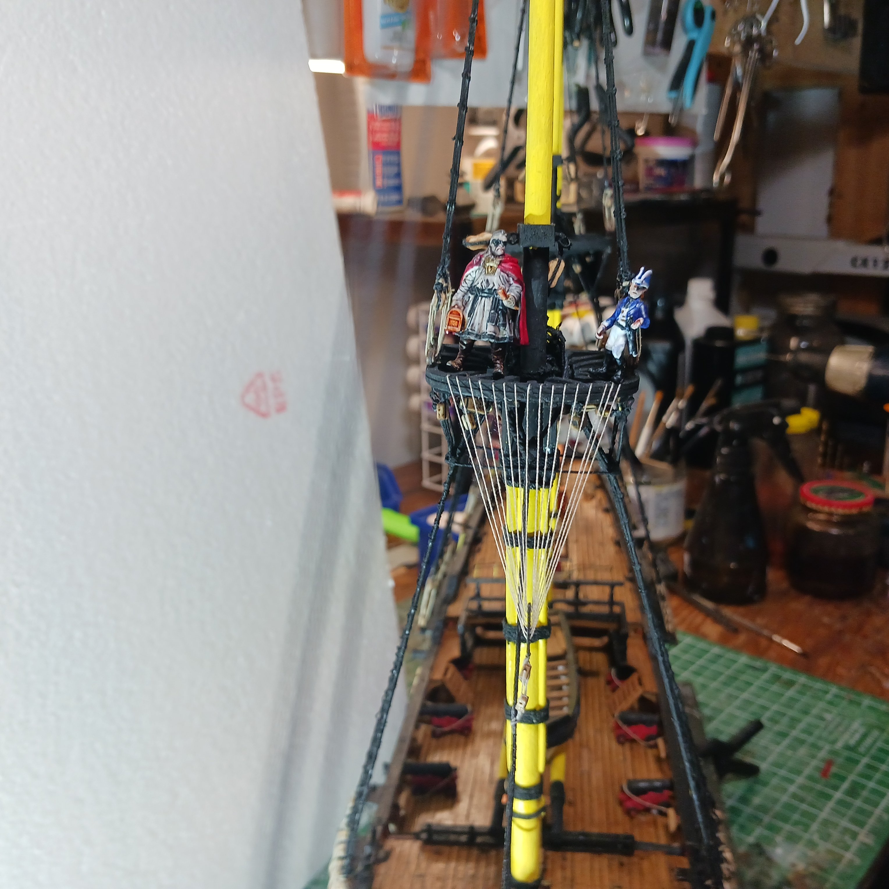

But they look good.  So I decided  to tie the foremast crowsfeet lines,
Like riding a bike,  I only had to back up twic because I missed a hole, or went under instead of over , but the wire threader was an enormous  help.
On to the next two crowsfeet lines,  but lunch 😋. Talk later today :cheers:

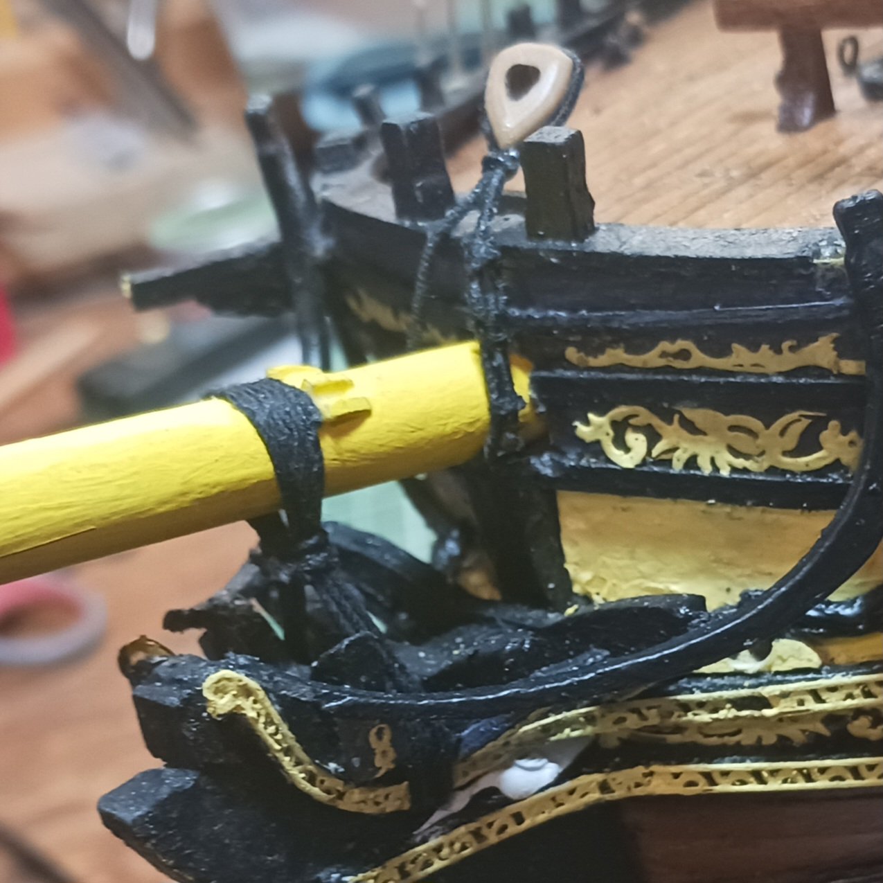

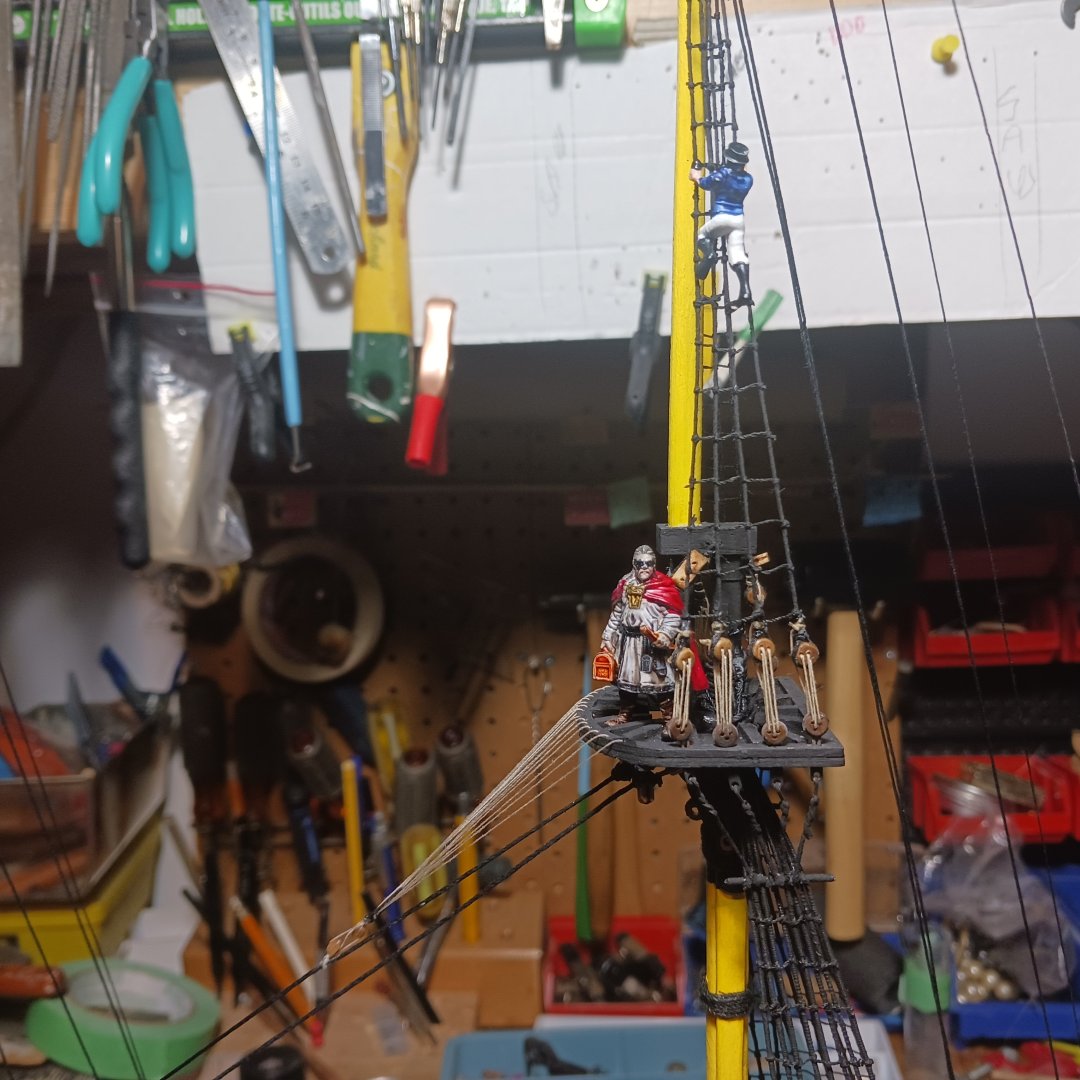

The main mast needs a fix, nothing noticeable. 20251107_212242.thumb.jpg.9d6f0a2228523ec9c2d60eff25987175.jpg
The Mizzen crowsfeet line went the best. A little  kink in the Mizzen stay but that's my style 🤪 a little  kinked ha ha.

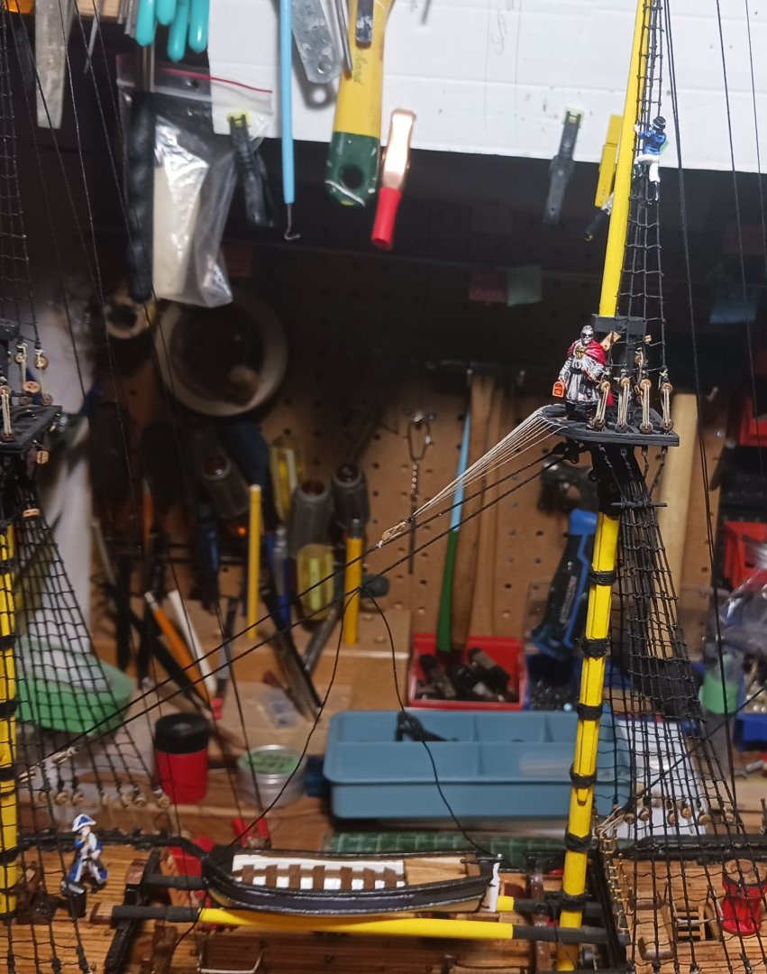

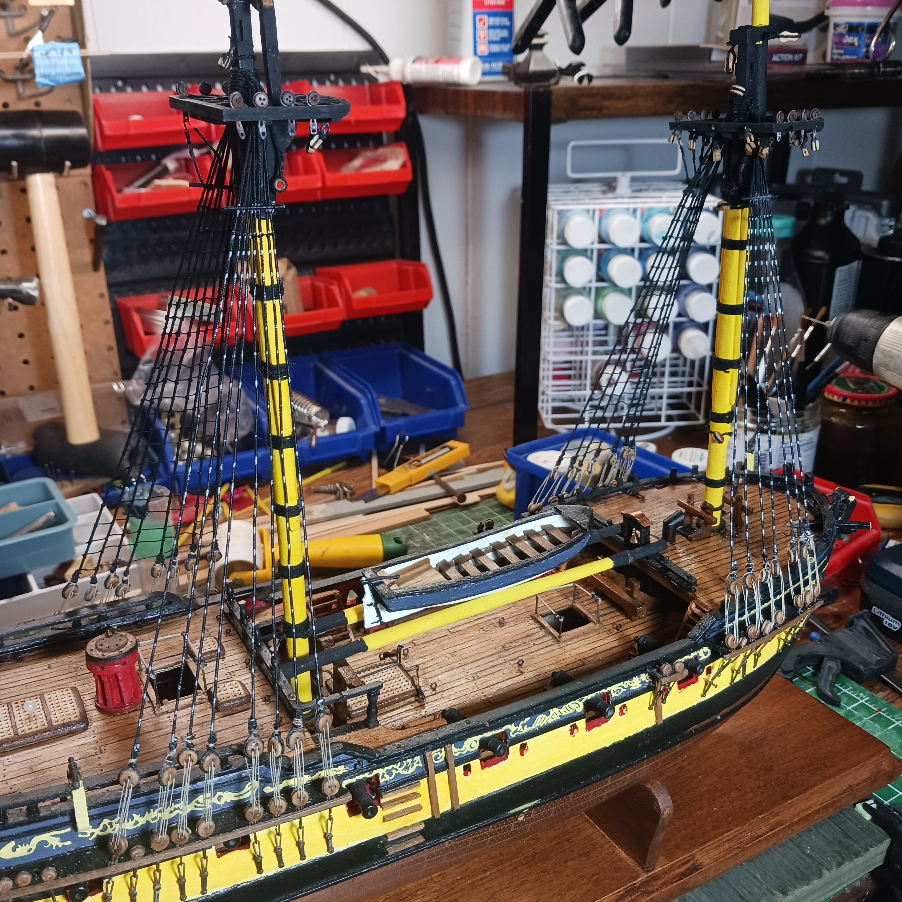

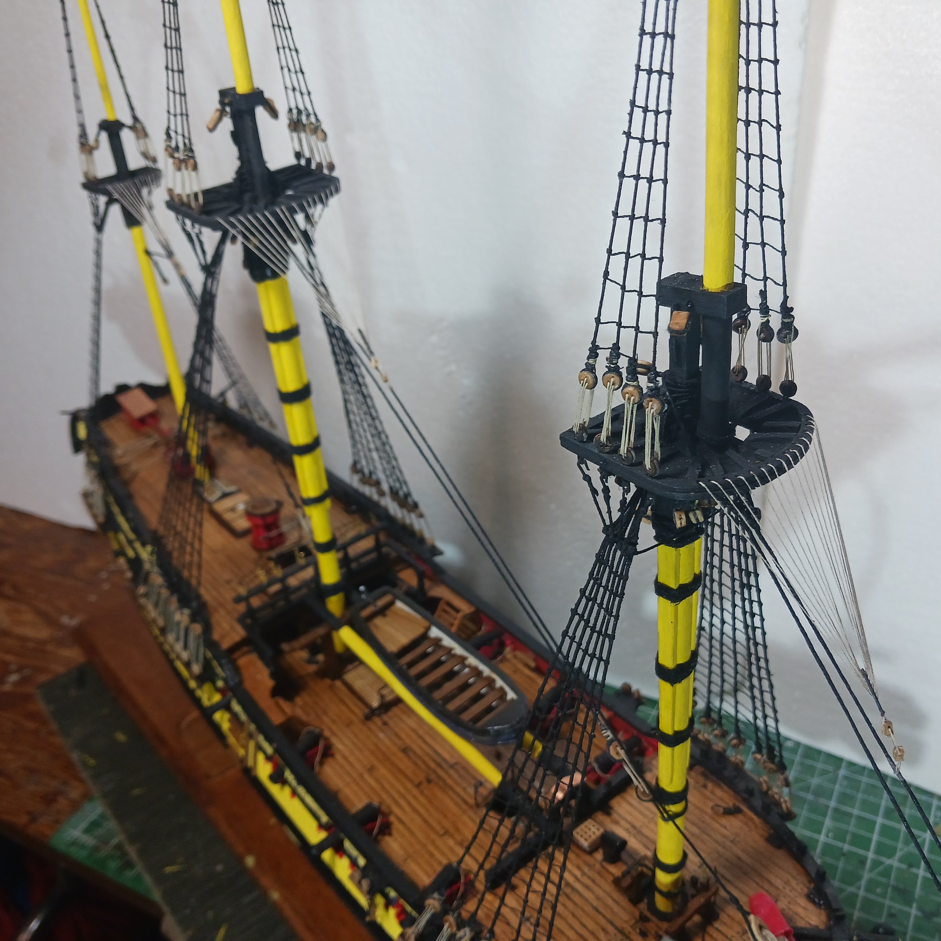

So we started at the Mizzen mast,  tied the first  three on.
Kurt says its getting to big, jobs to be  done everywhere,  we need help.
Horn blower is just screaming , get the book, thats not how the boat is rigged lol.
I think I am starting too play to much again,  70 got to rember 70, I am 70 lol.
About eight stays left to tie up,  and four royal stays, then two fore stays and the standing rigging  should be done.
 Yard work, it's never ending lol, got to love it. Thanks for popping in.    :cheers:

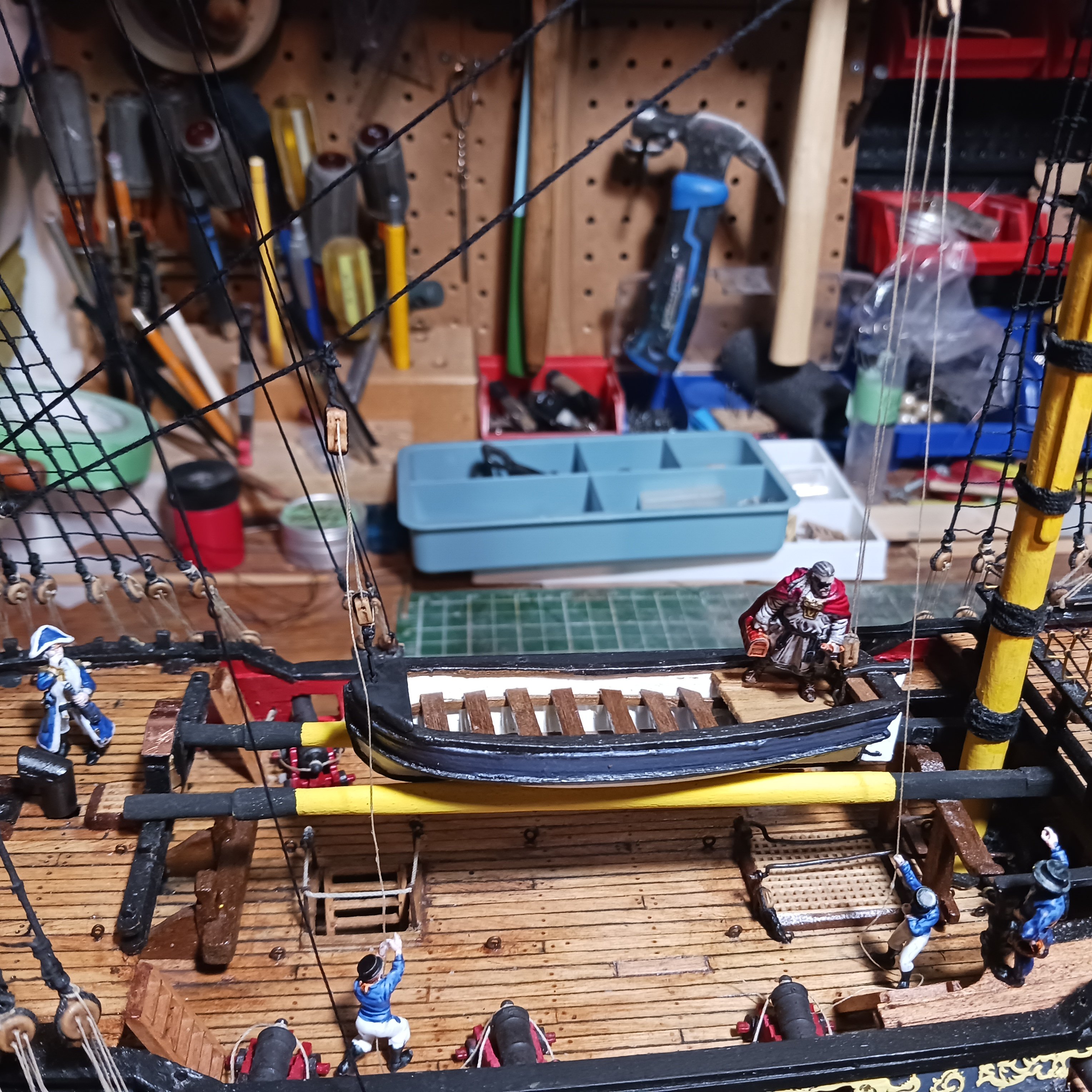

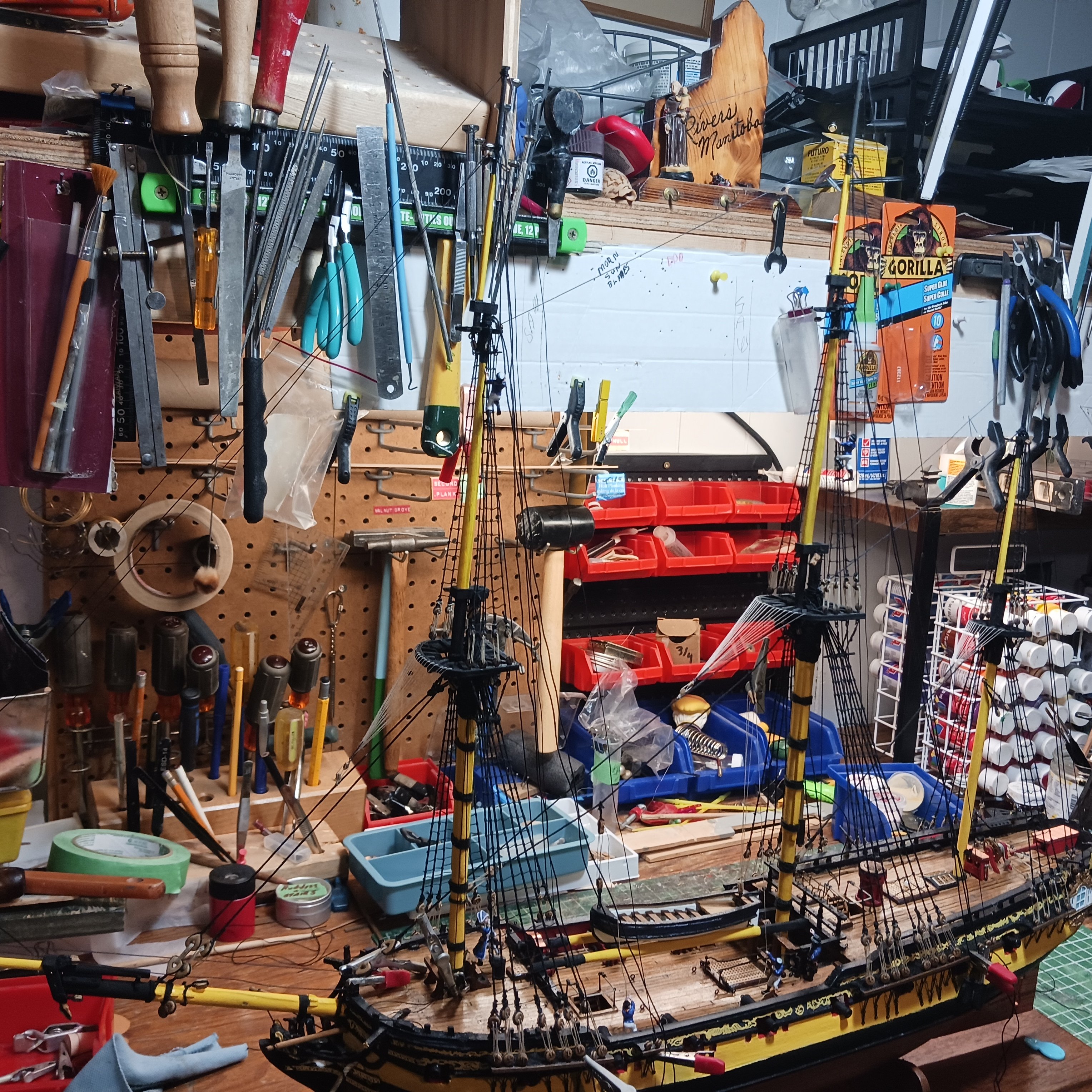

All the back stays on the starboard side are tied on , and I am happy  with them.
So with that done I spun her around  to the portside, which  happens to also be the display side. Tieing and seizing  lines is fun, but the kid in side wants to play, lol. Kurt ⚒️  say, Stays focus  lol.

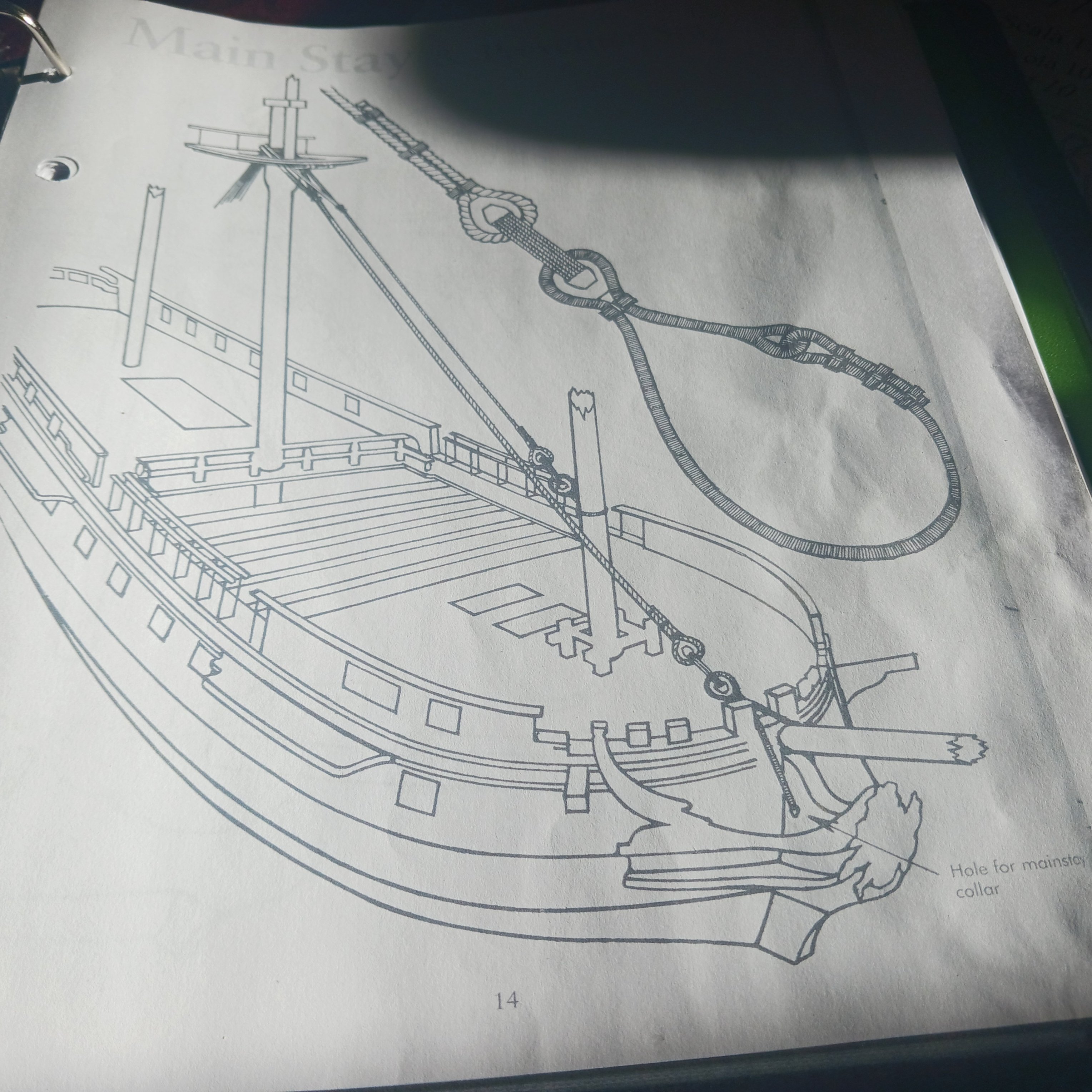

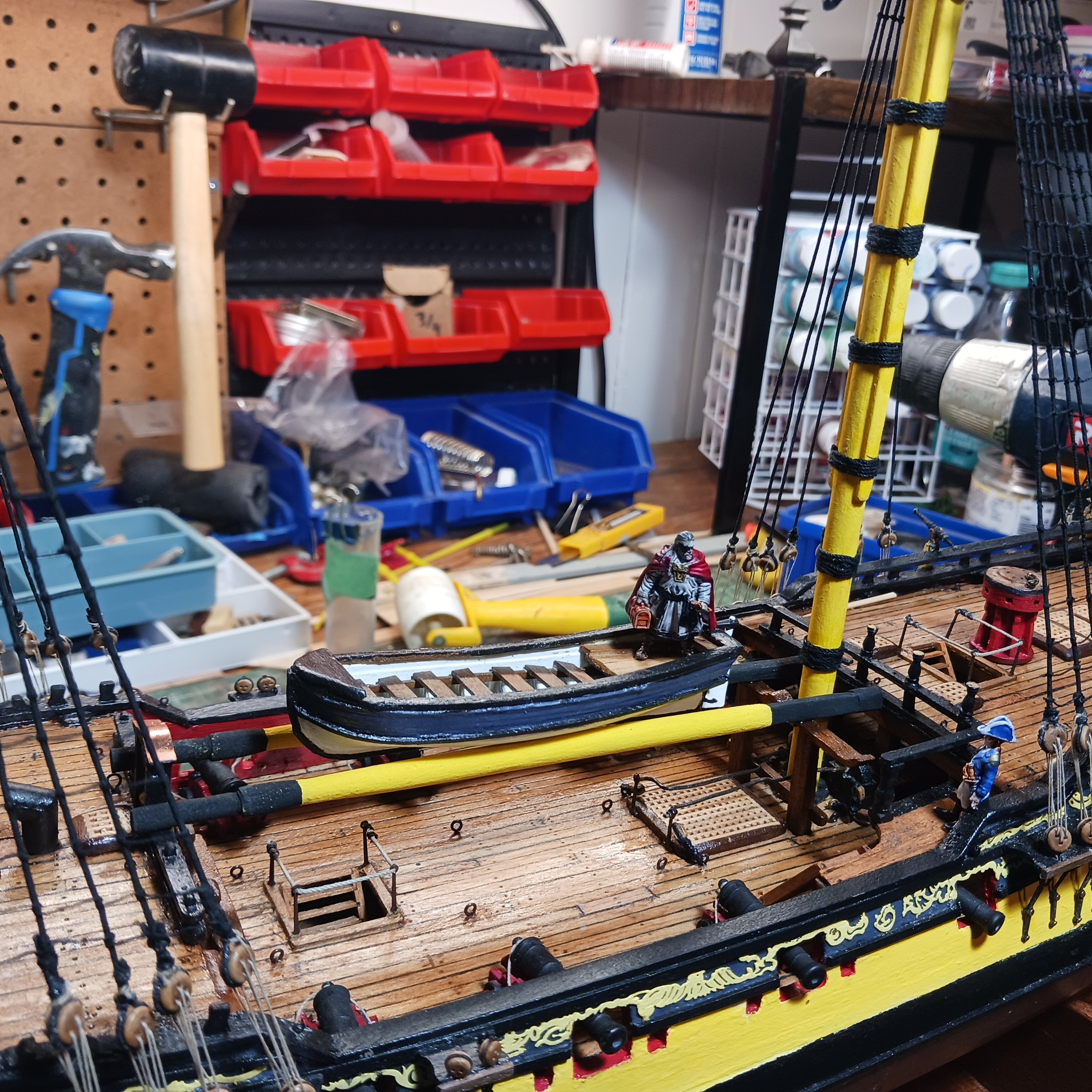

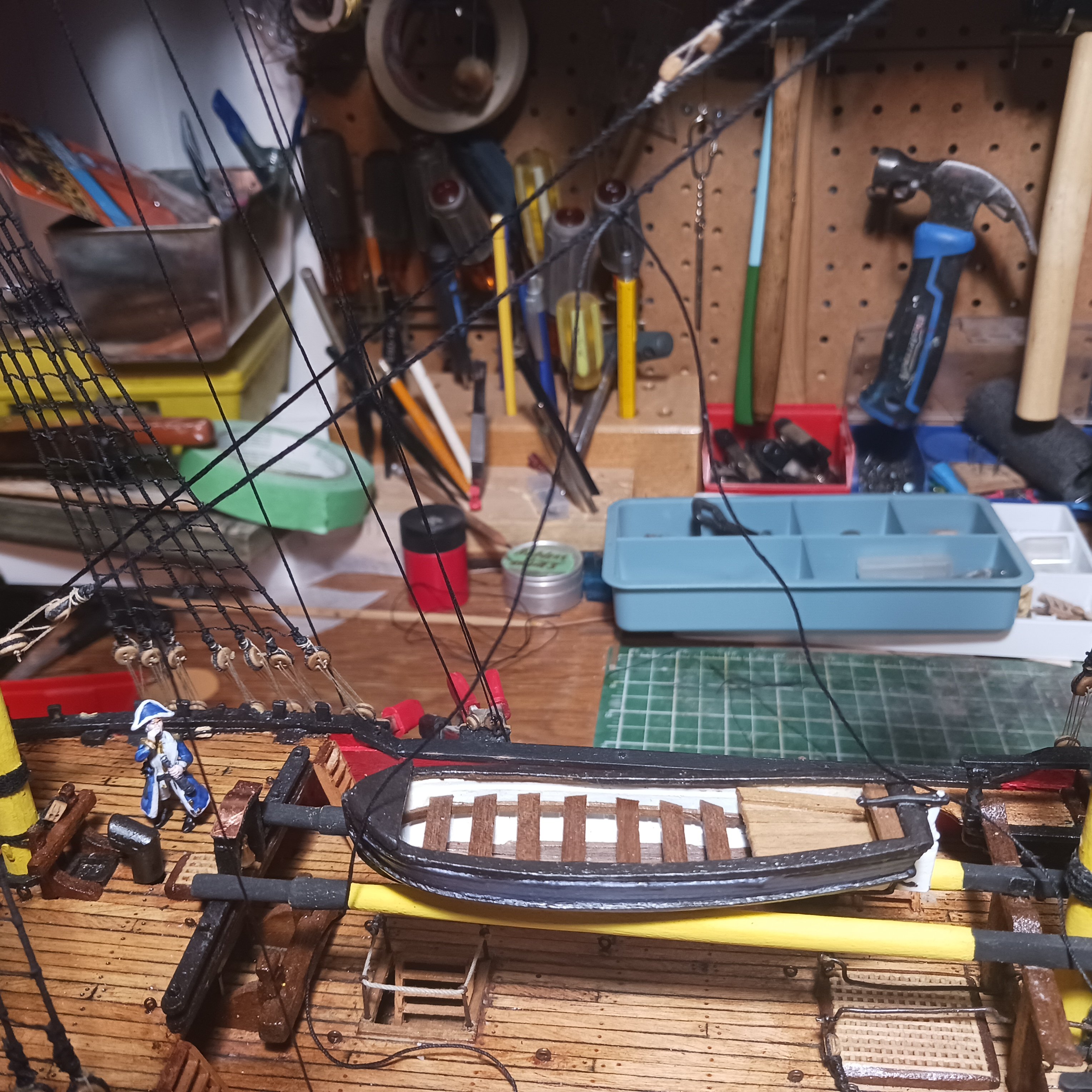

The planes call for these blocks on the main fore stay, the boat part was added by a sharpie lol 😆
I got all the parts together for this little boat adventure,  I going to glue them in place for sure. If you guys could see how much fun I am having,  I'd be arrested lol.

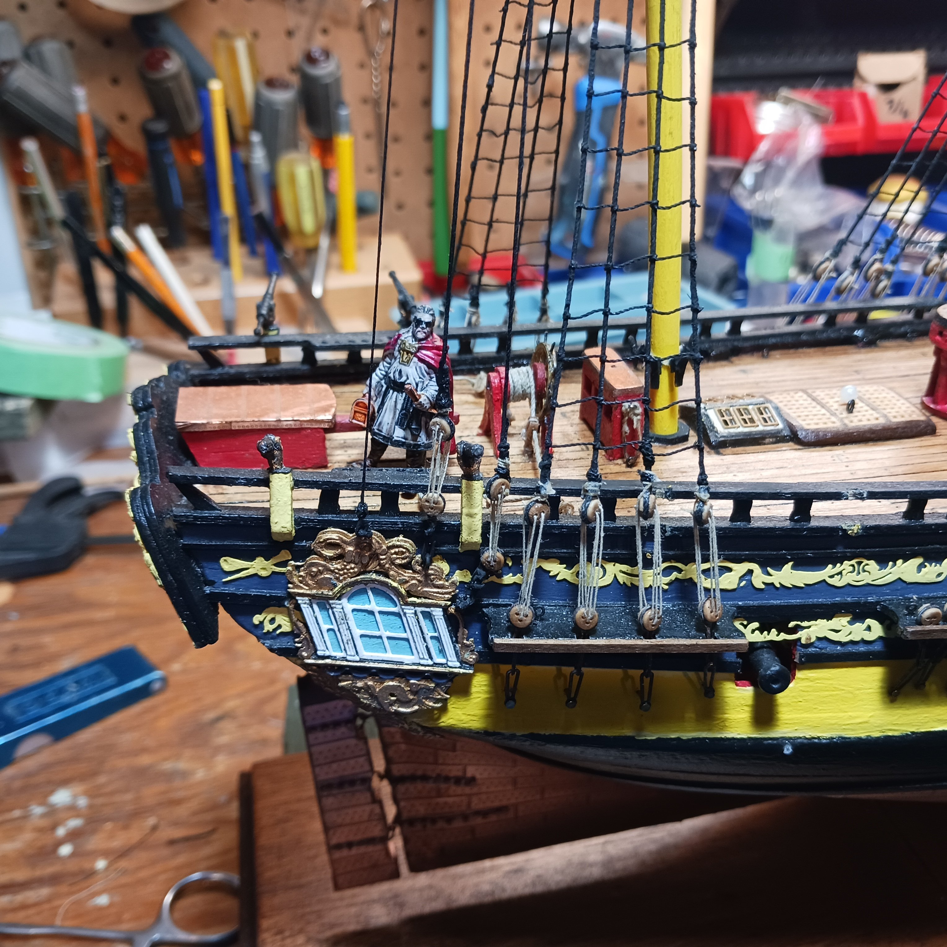

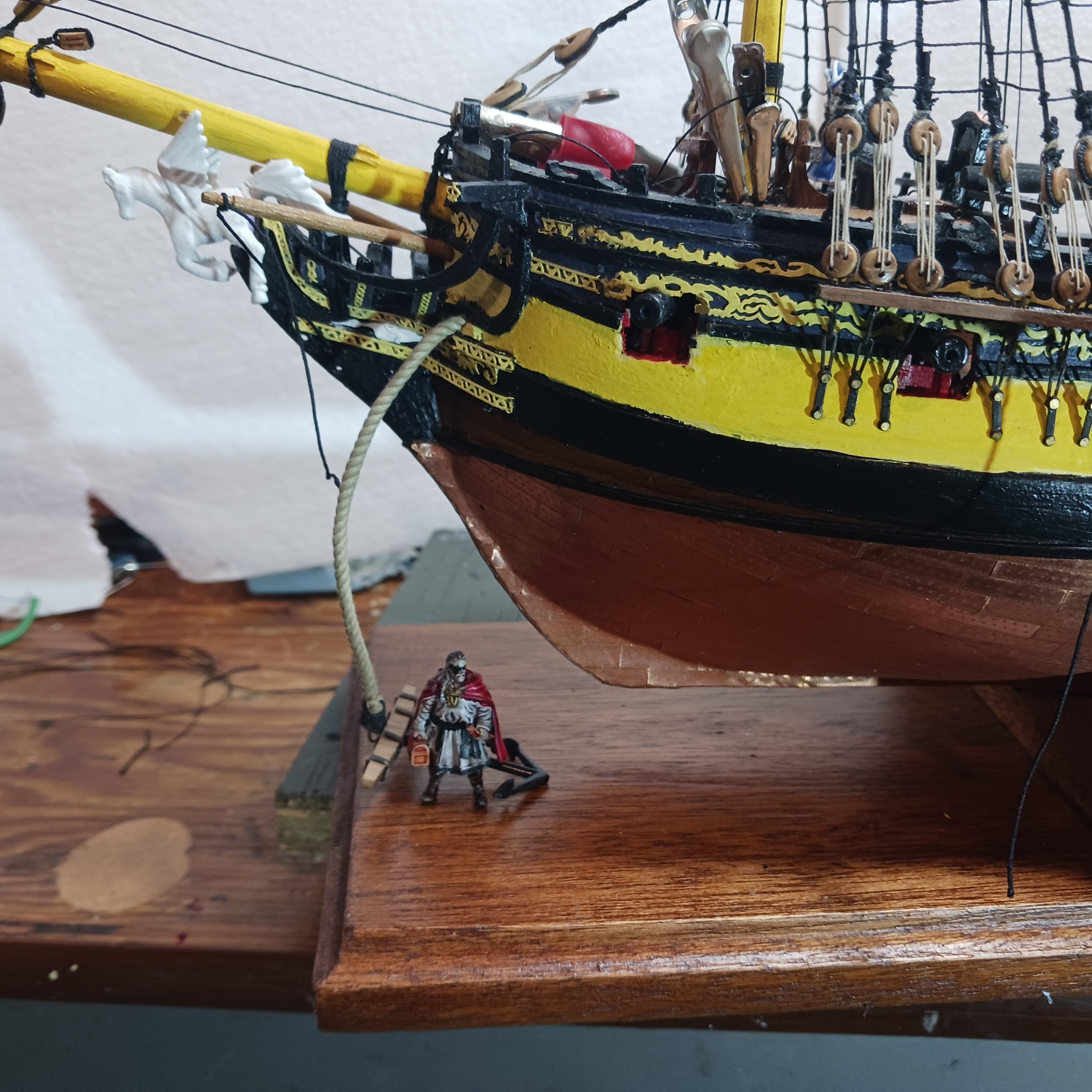

Just a quick update,  ships boat is being lowered into place, Kurt says its was a fun day but let's get back to the stays, I love this Viking 😀

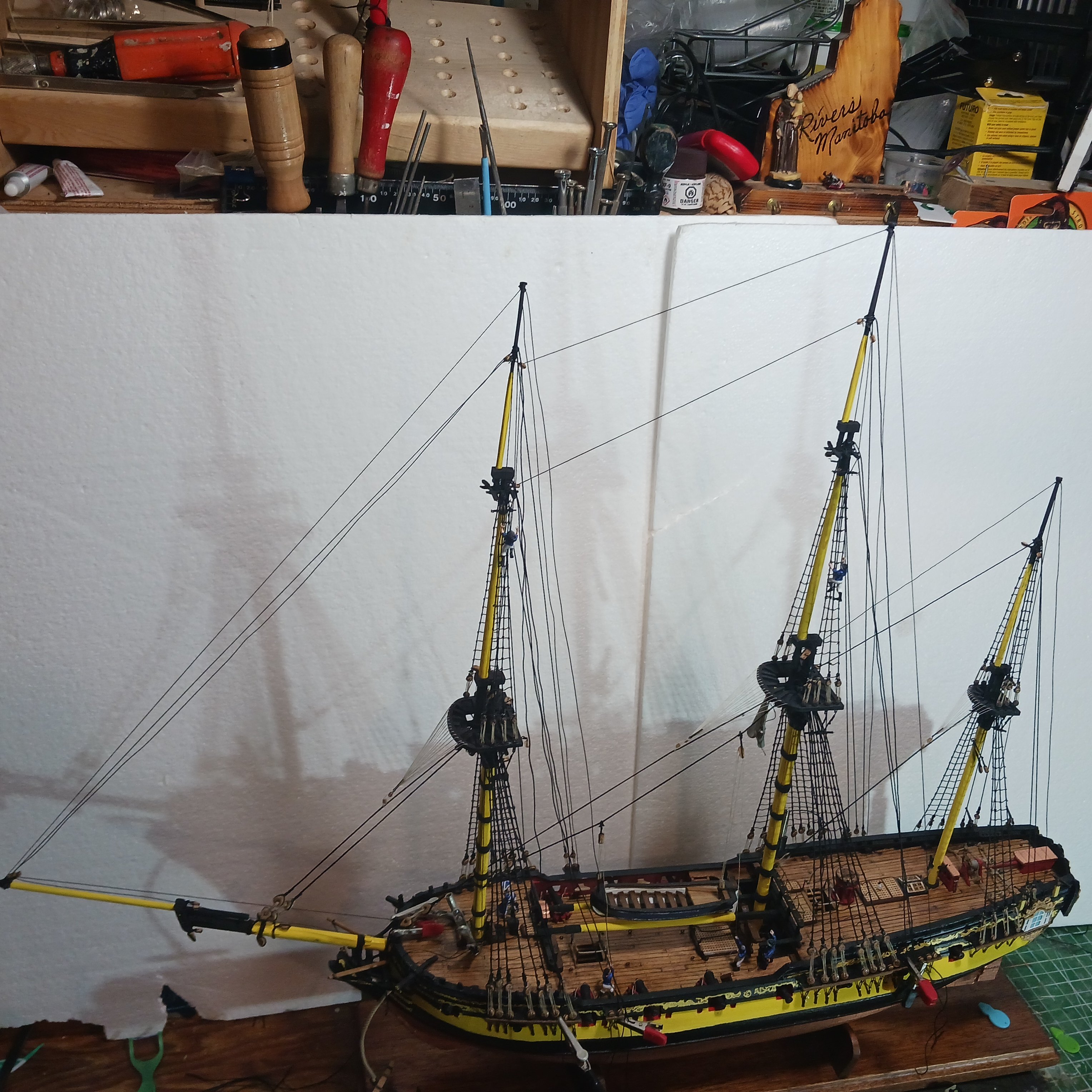

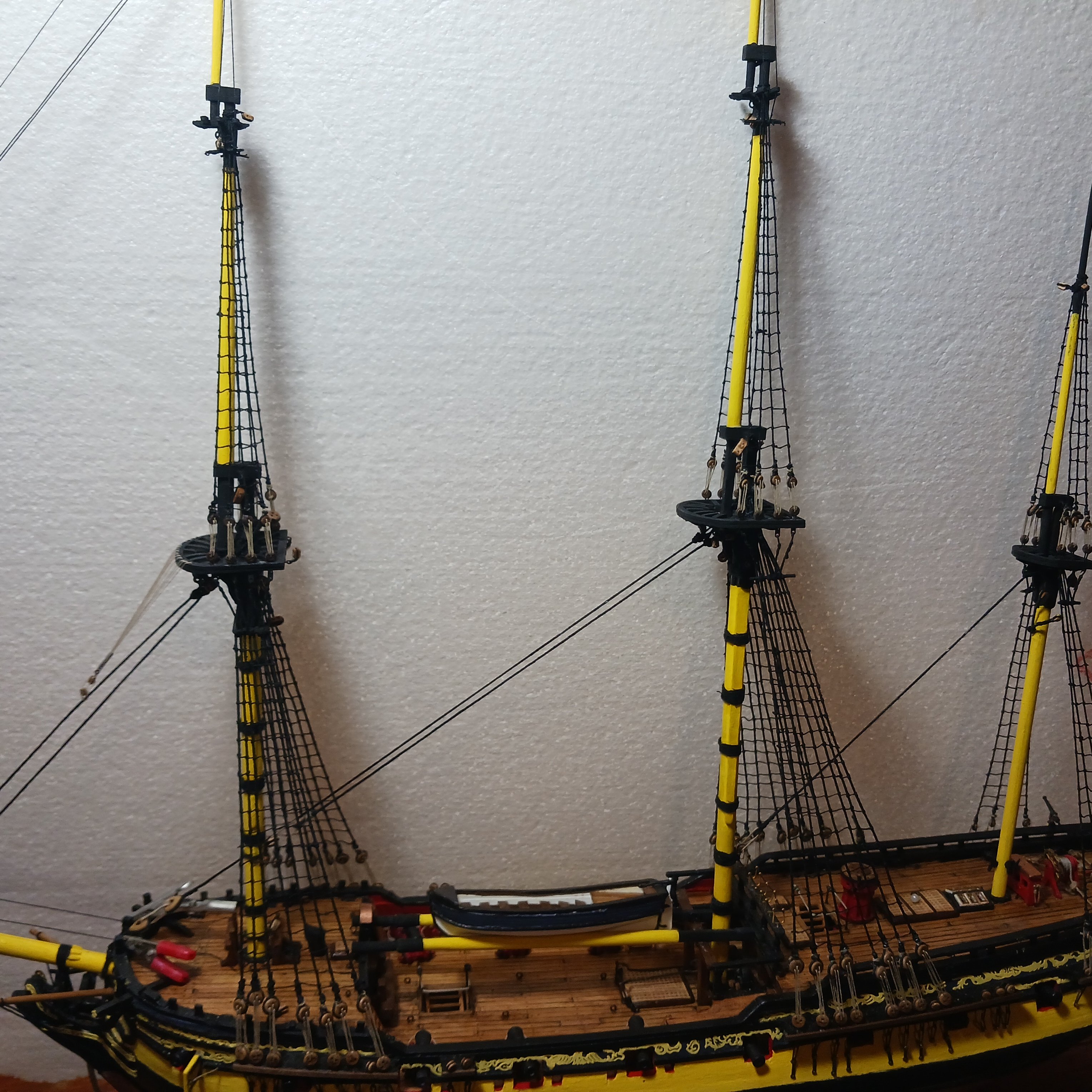

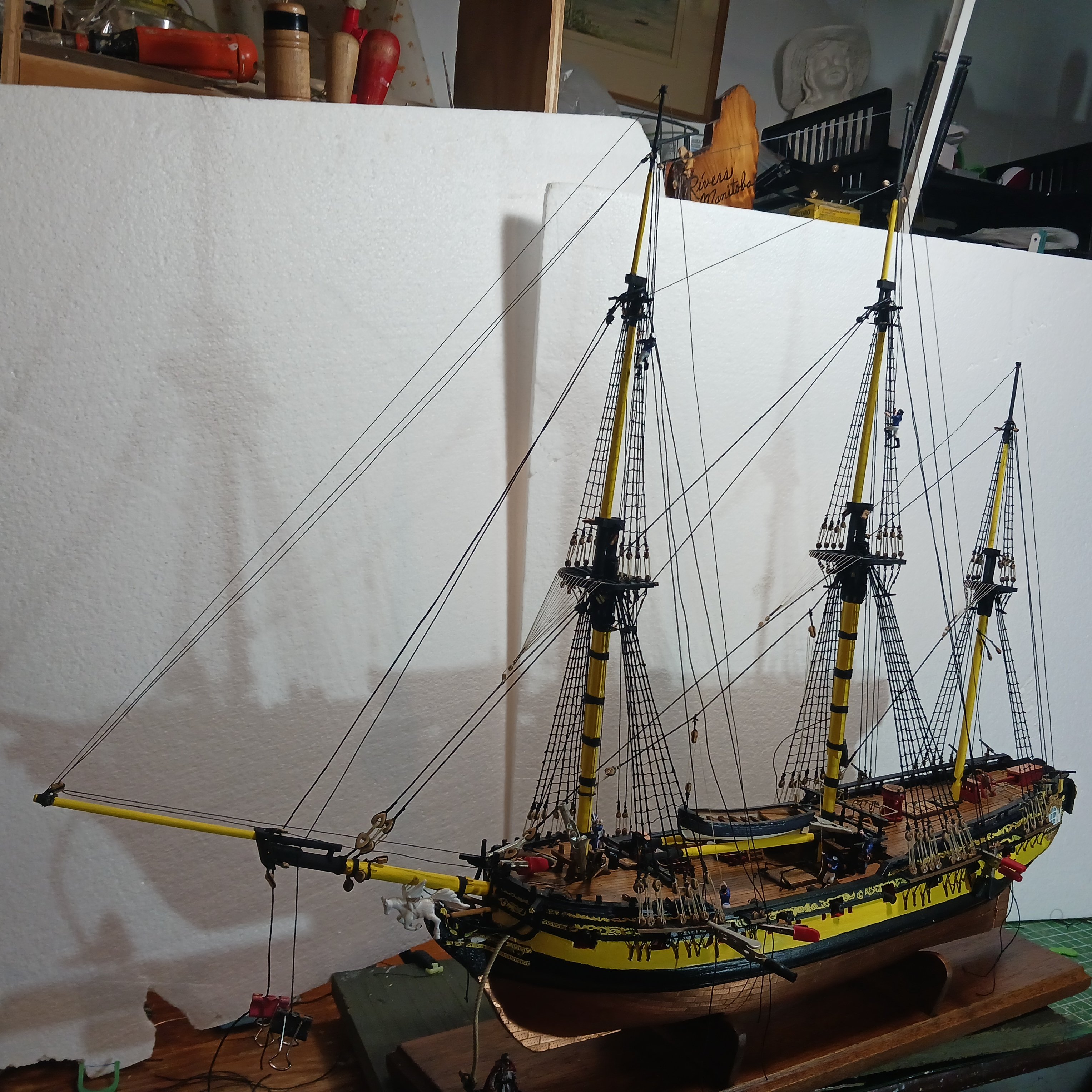

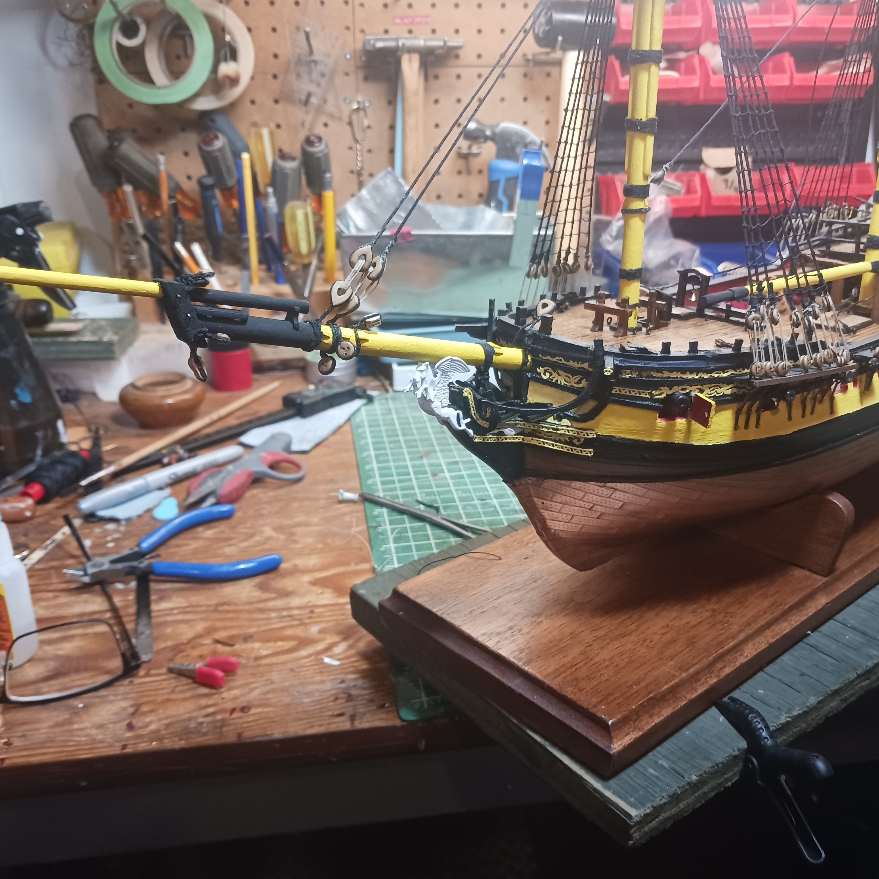

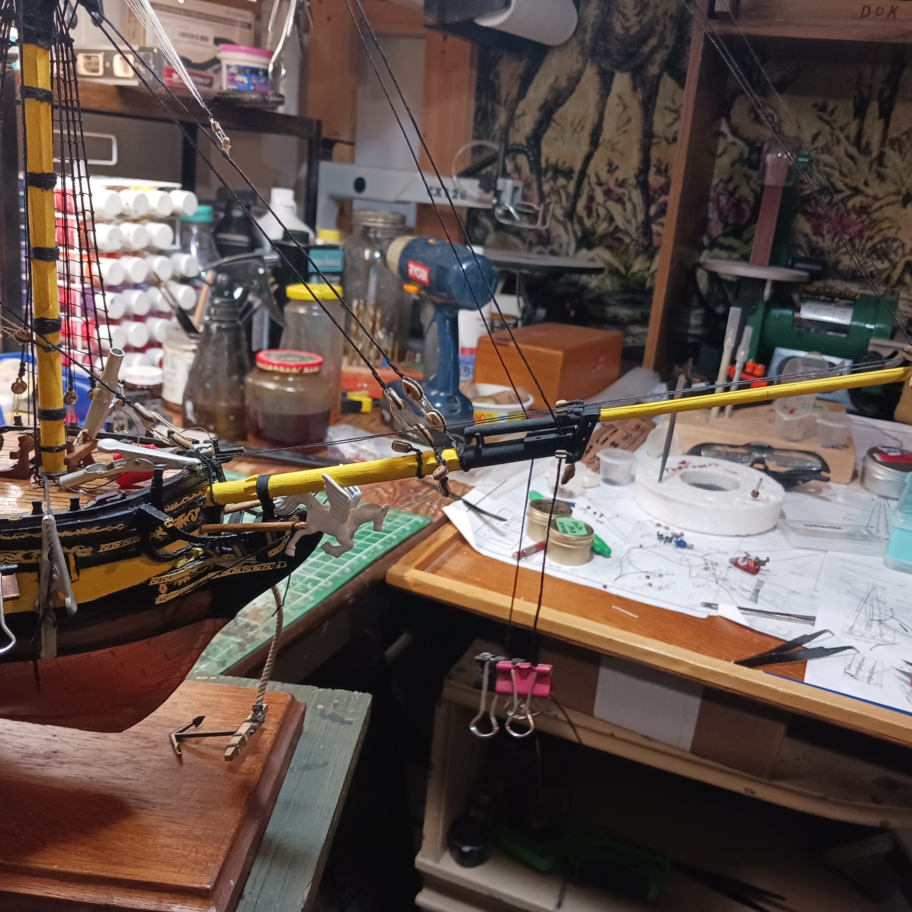

I have all the stays run fore and aft , just have to tie them on to the deck.
Kurt likes the pacifier  Pegasus that I installed, 😎  ,  cool I think lol.
Just tieing a few lose ends then on to the bow spirit mast.
A really big thanks  goes to buddy  @Gabek who told me about these Collapisible Eye Needles . They are fantastic  to use, makes treading  2mm deadeyes a breeze. @Glenn-UK you got to try these, if you can find some. I used one to thread all three crowsfeet lines on the Pegasus and didn't have to stiffen the lines once, so eazy just to push the wire through the little  hole thread the line pull back done. Makes doing crowsfeet lines so eazy , I would requmended them ,it's a game changer .
Seems I am missing  a 5mm deadeye on the Bowsprit mast,  and missing  a single block at the tip of the Bowsprit mast as well.. Should have it all tied up in a couple more days I hope. Then it is off to the display case just to give me space to build the yards.  Toying with the idea of putting  all the swivel  guns back on, as well as the gun port lids,  I have a ladder on the port side to install, then the hand rails that go with that.  And dare say, install the figurehead.  Lol  So lots to do.
But she looking great to me, a slight applause  from the deck of the Astrolabe could be heard, lol. :cheers:
