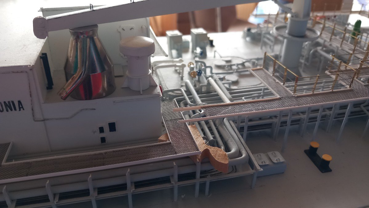

In the meanwhile I decided to continue in the fitting of the remaining catwalks. The forward edge of the finished center piece is actually a step. The catwalk forward of that edge is lower there, the level being determined by the forward part of the catwalk. So I now made a cardboard template for that forward part. And I also have a first paper design for the last piece alongside the compressor room.
The support beams of the piece alongside the compressor room are actually much wider than the catwalk itself and are welded on one side to the compressor room. That's the reason the paper is now laying down. Once I finish and install the forward part, I'll start adding the support structure next to the compressor room at the determined level.
This area is probably the least photographed part of the vessel and amongst the 1000's of pictures I have of the vessel, I only have 2 or 3 of this area...
As you can see, the drain piping around that compressor room is quite complicated and has also received a few punches over the years. I'll need to fix that at some point.
Also the piping connections entering and leaving the compressor room are just forward of the door, I first need to add those connections before I can actually get the support beams in place.

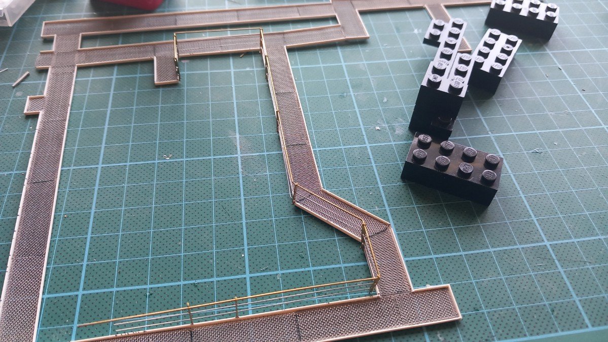

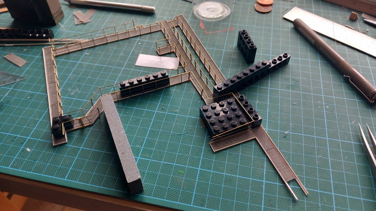

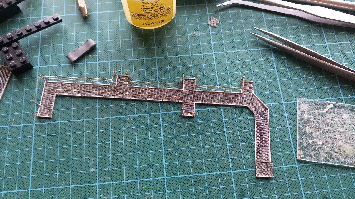

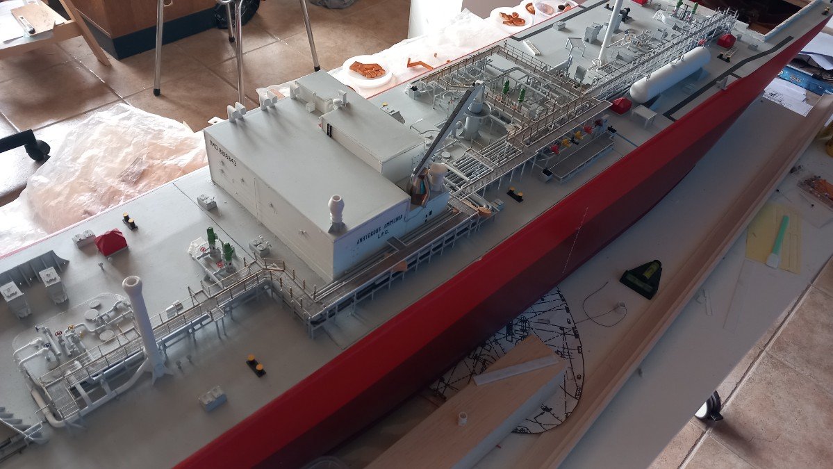

I did not have much time in the last couple of months, but did manage to do more than anticipated the last two weeks. I haven't made any updates since it's simply more of the same...

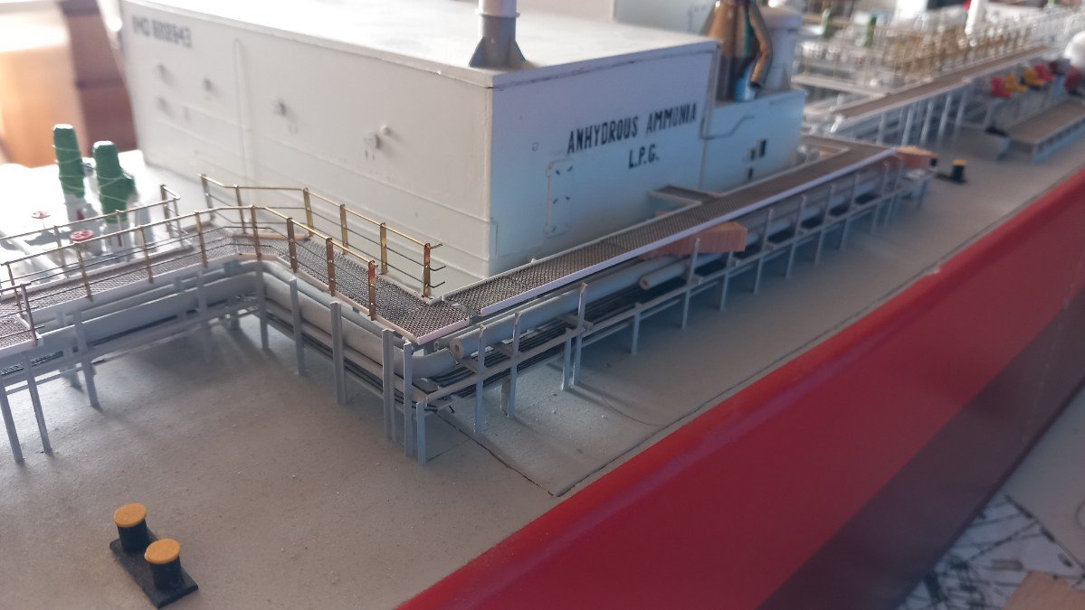

I finished the forward part of the catwalk, including railing.
Currently working on the railing of the manifold part and simultaneously building the last part of the catwalk, the part around the deckhouse.
As you can see, the Legos have made an entry for keeping things in place and straight. Picked up that trick over here. Of course I need to be carefull since I'm using glue for styrene, so I don't want to glue the blocks to the catwalks...
Roel
Simply amazing, Roel. Incredible work.

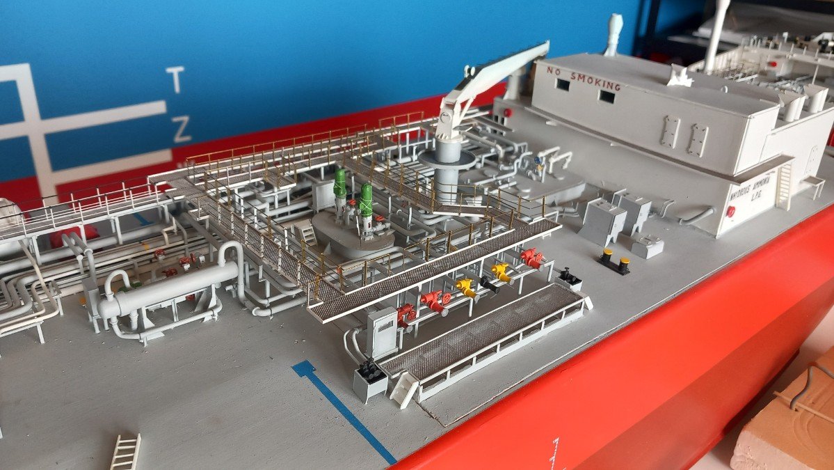

And time for an overview:
next steps:
- fix some issues with the piping edges at the forward edge of the hatch and piping issues forward of that edge
- level out forward catwalk since it determines the height of the next part along the deckhouse
- complete the piping connections to the deck house
- finish and fix catwalk next to deck house
- finish forward edge of manifold catwalk where it makes a step to the part next to the deck house
I believe after that that I will proceed with finishing the deckhouse (finally put the real crane jib support in place instead of an airbrush jar) and railings on top of it. And together with that, start making the stairs to the catwalks.
Only the aft catwalk is glued, all others are just dry fitted. I will first put some transverse beams, paint those and also the catwalks themselves before gluing them, same sequence as I used on the aft part.
Roel
