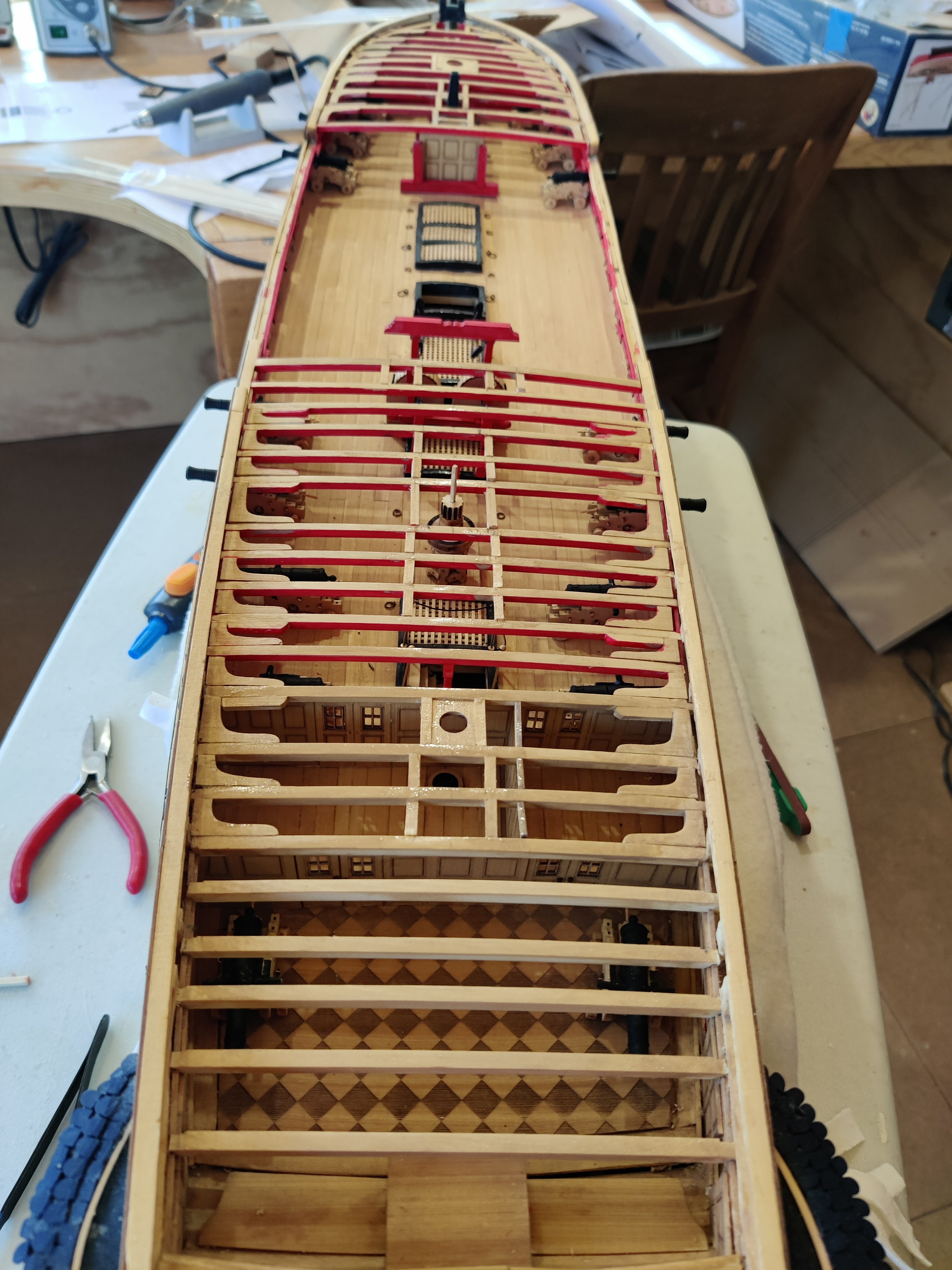

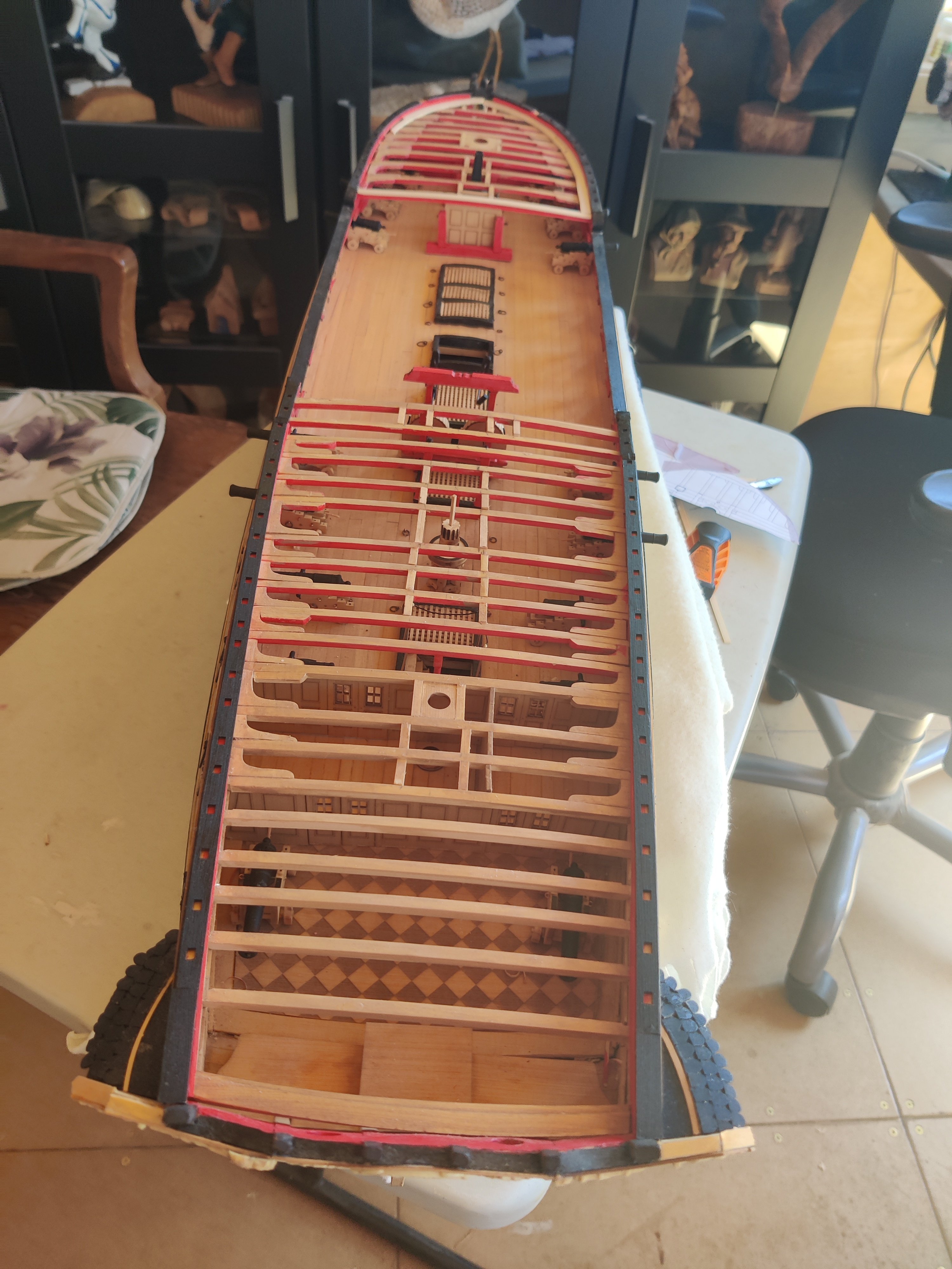

It has been 6 months since I last posted but I have been diligently working. However, Chapter three took me a very long time. It is very detailed work and trying to do it with just one hand created a lot of challenges and i ad repeated do overs in the process. The final product is not without flaws but it the best I could muster. I simply do not have the capability to be as precise as the masters that exist on this site. Nonetheless, I really enjoy the challenge.
19 hours ago, Chuck said:
Looking really good.  Dont sell
yourself short,  this is not an easy beginner model.
Chuck
Thanks, This has been a very rewarding journey. There  are some really awesome examples and it is hard not to compare ones work to those, nonethe less completing each task and chapter is so exhilarating that it motivates you to face the next challenge with a smile. Your guidance and others makes it all possible.

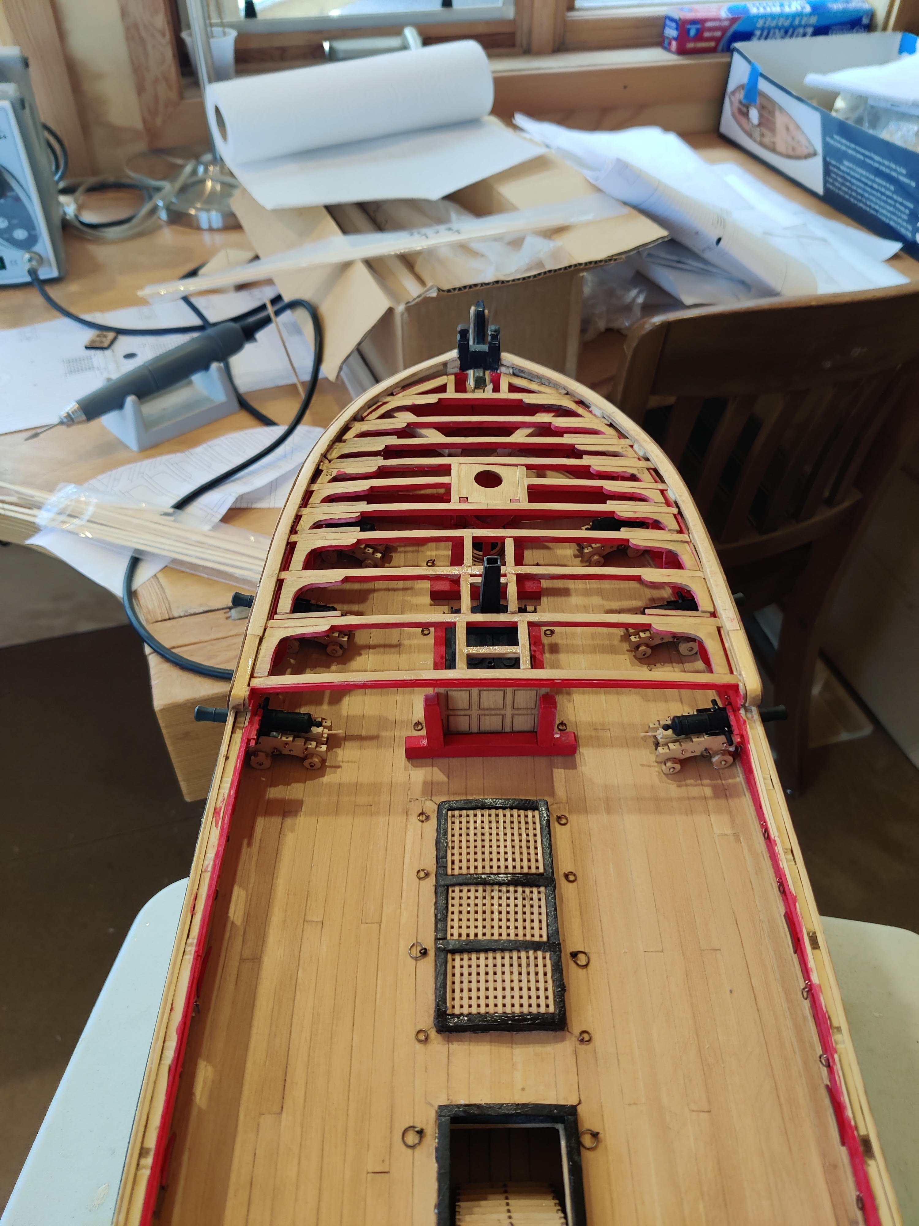

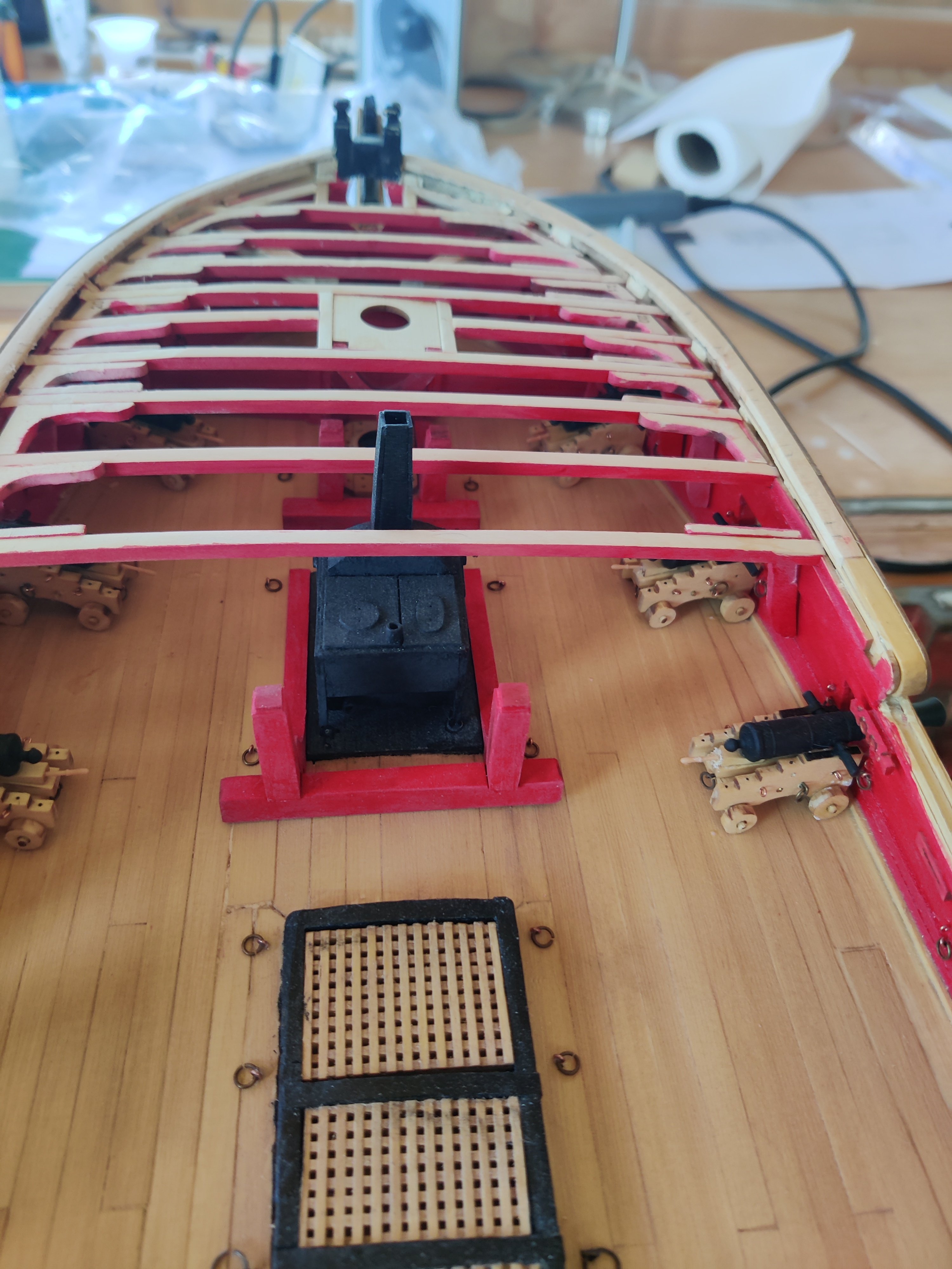

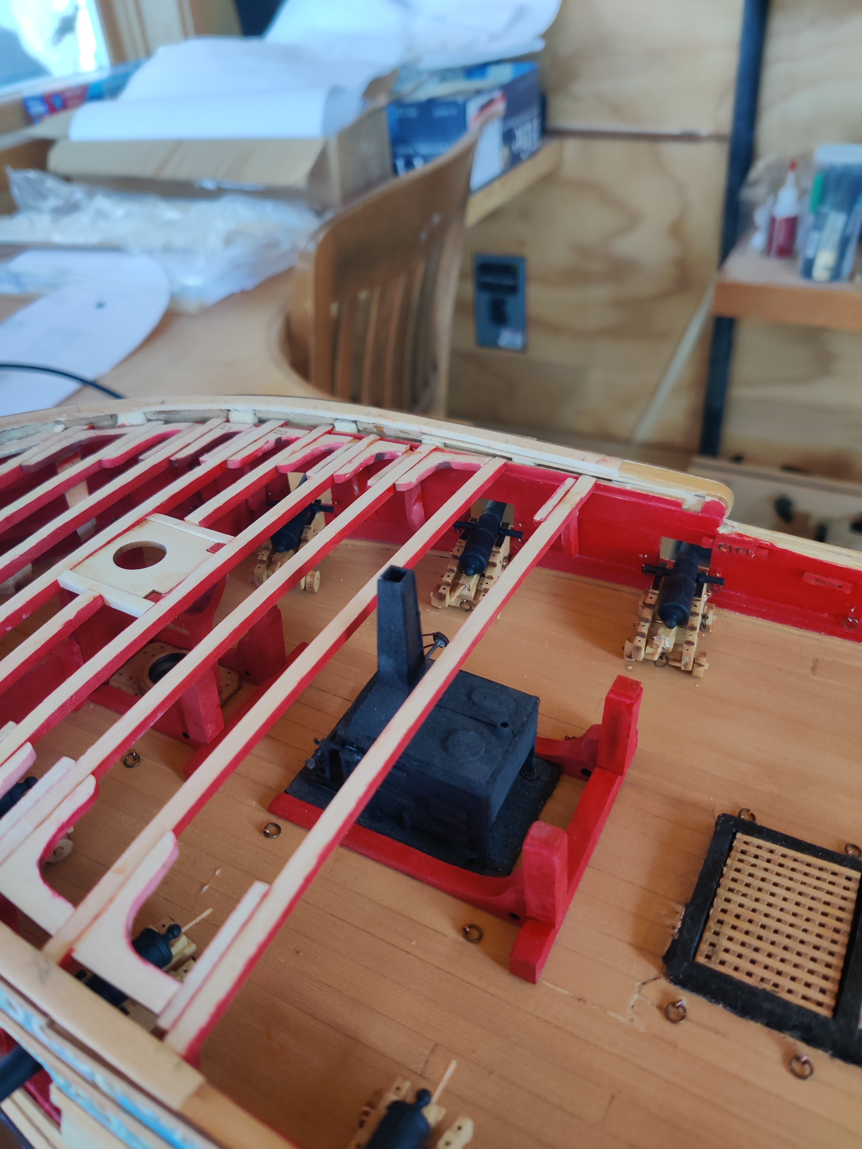

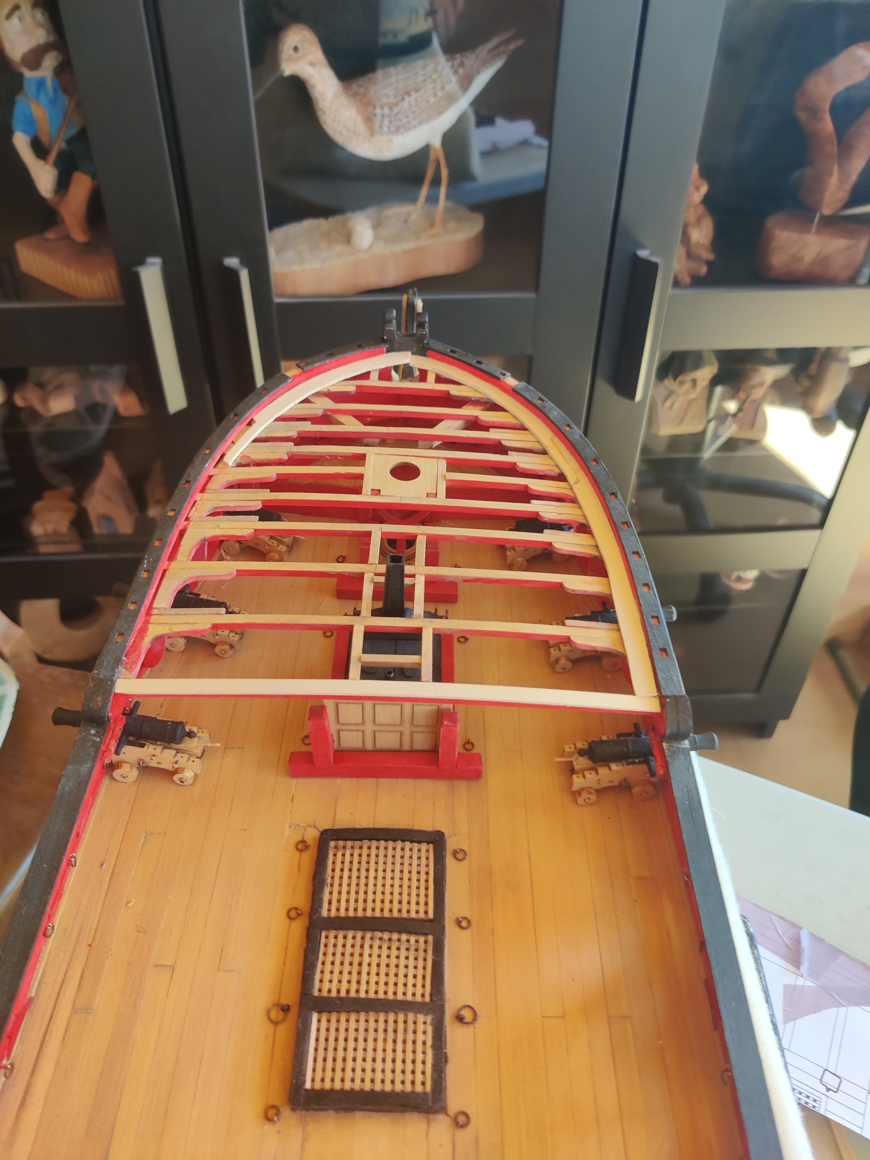

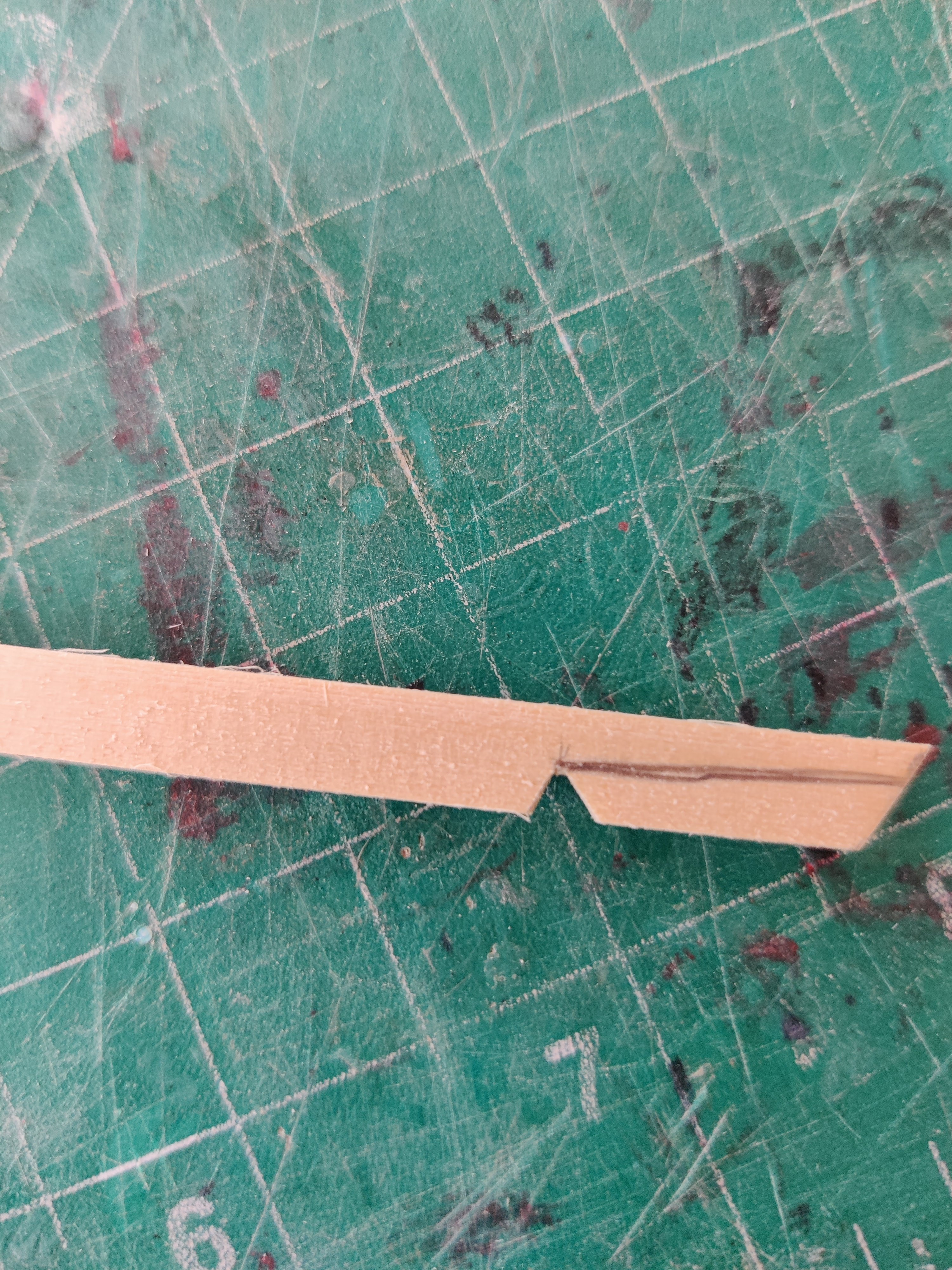

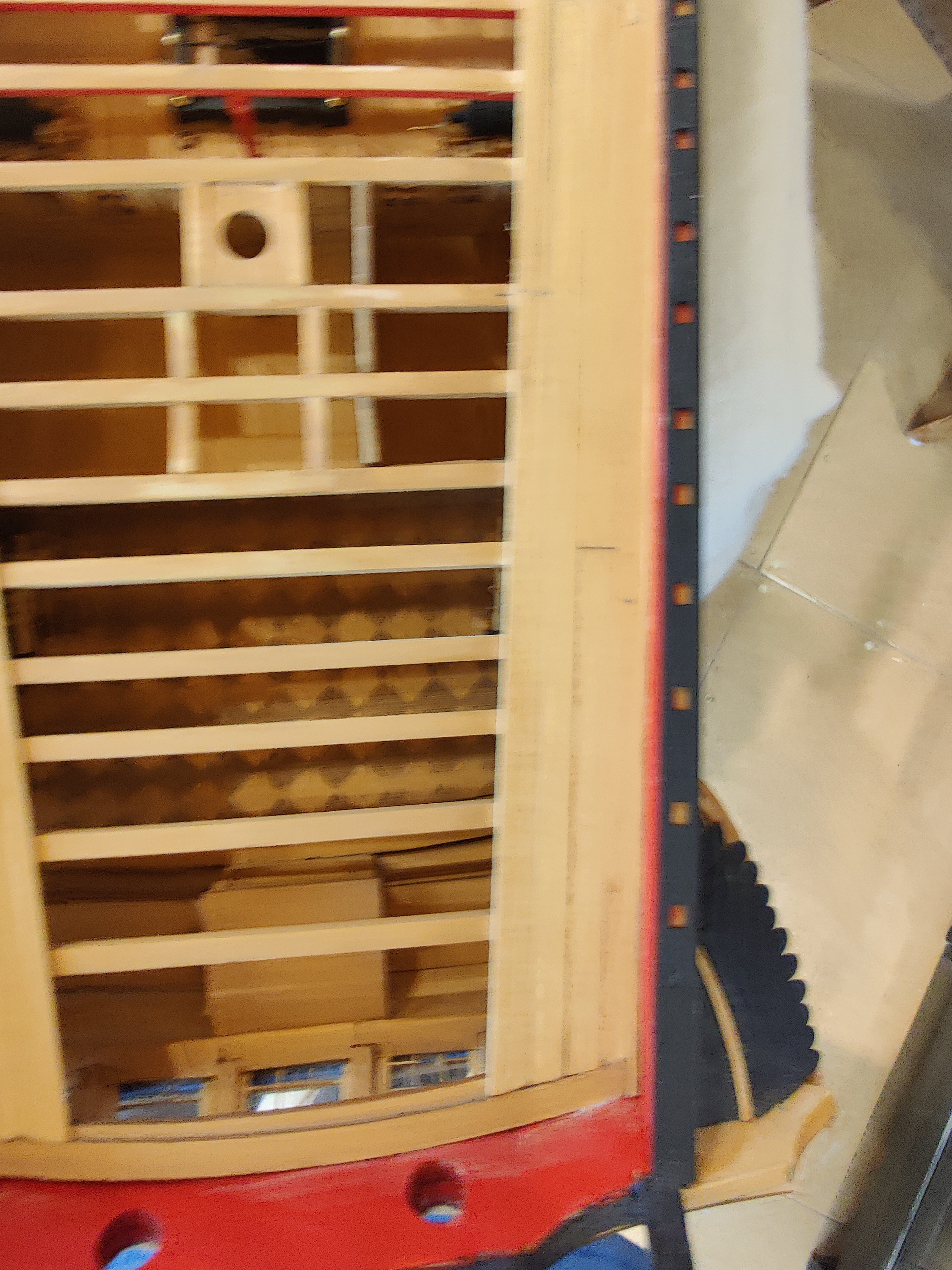

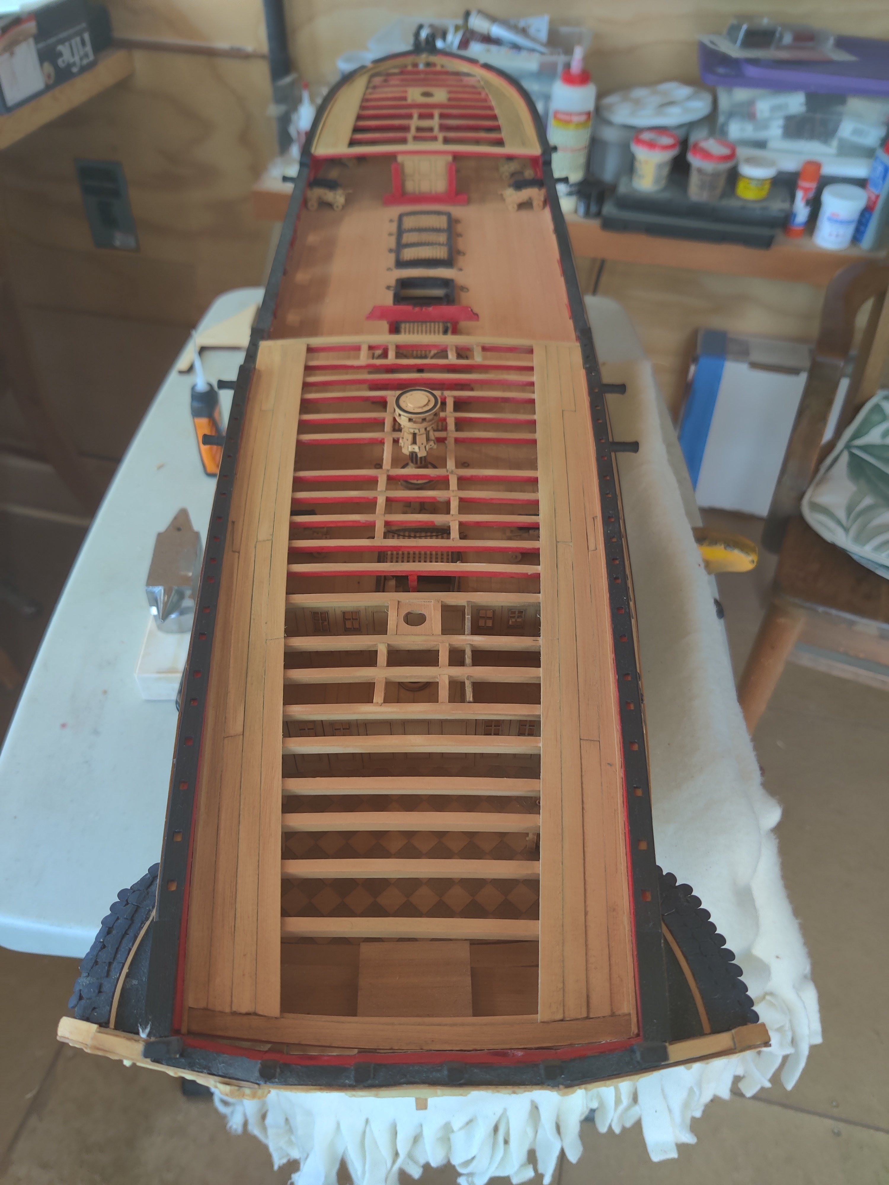

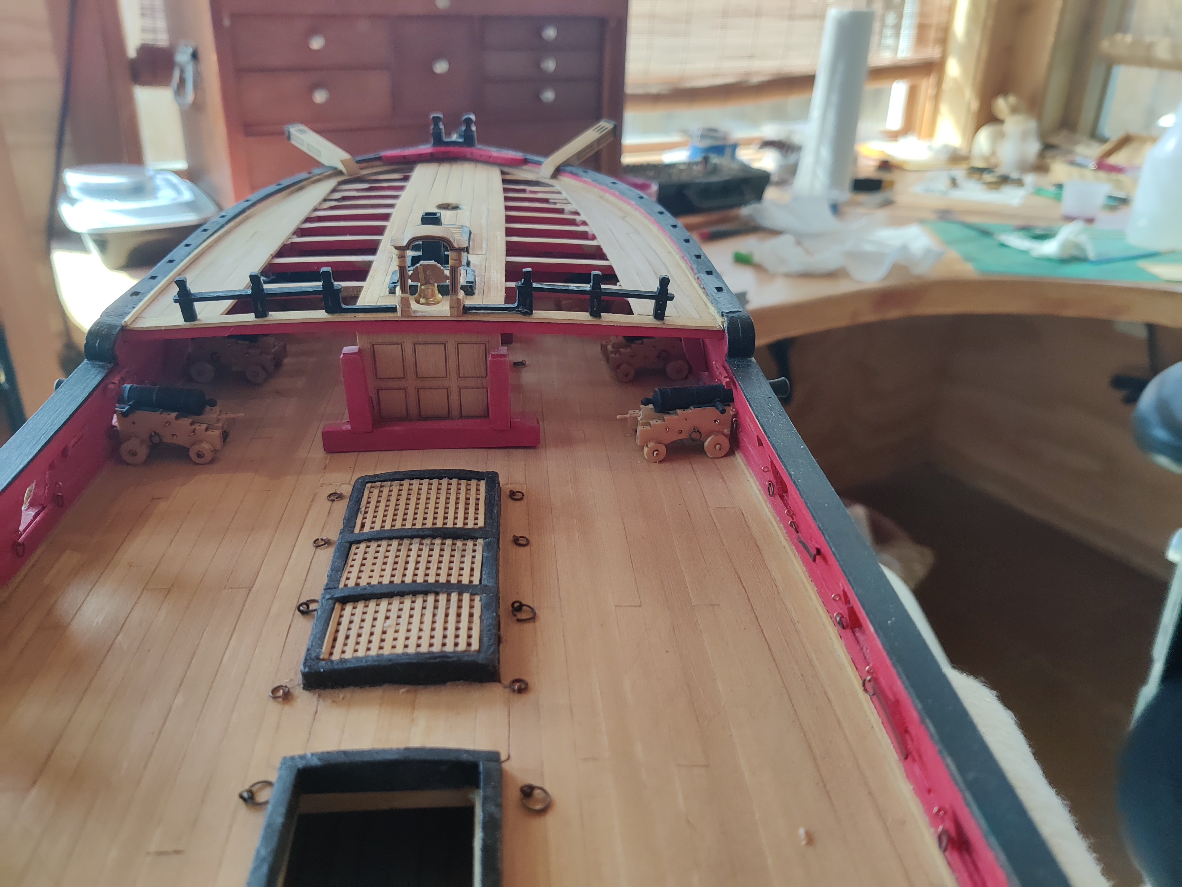

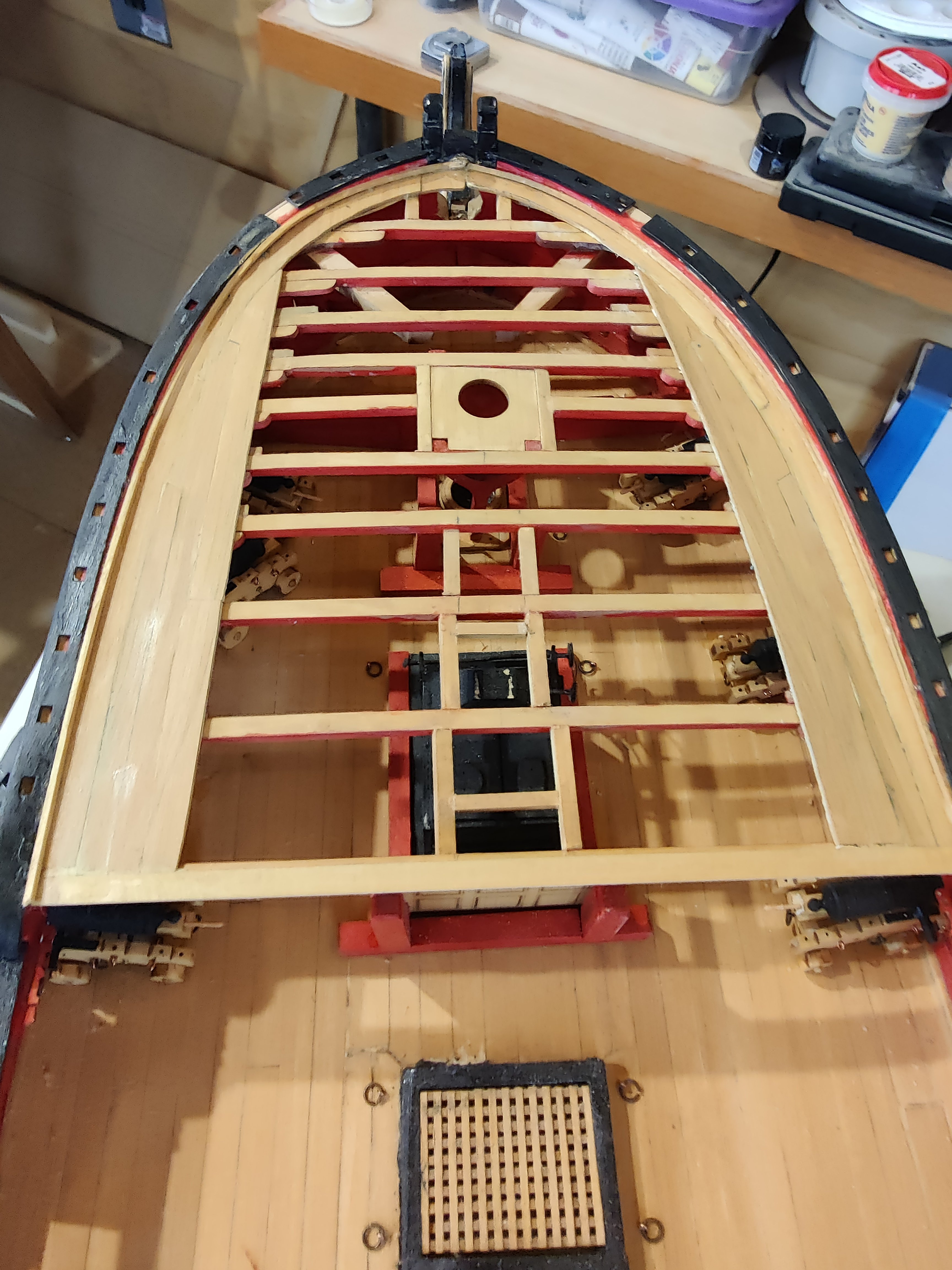

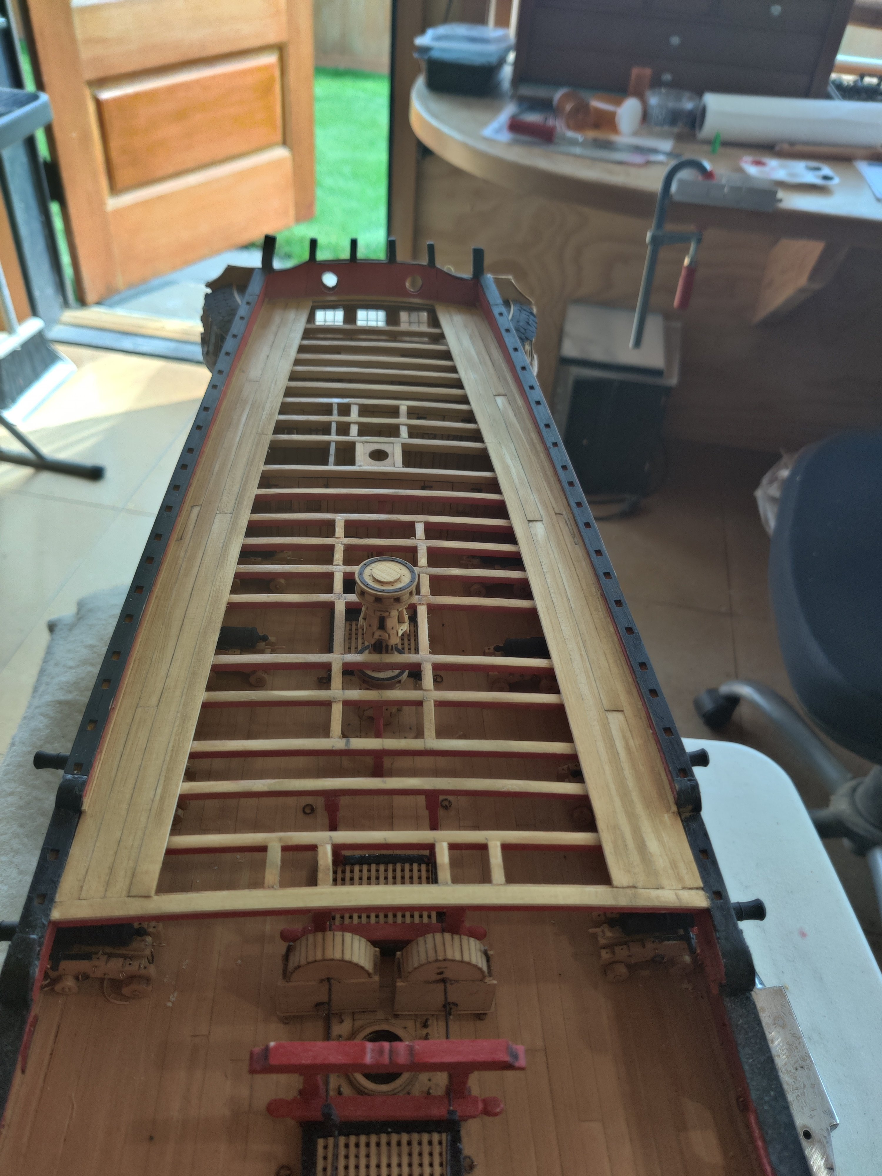

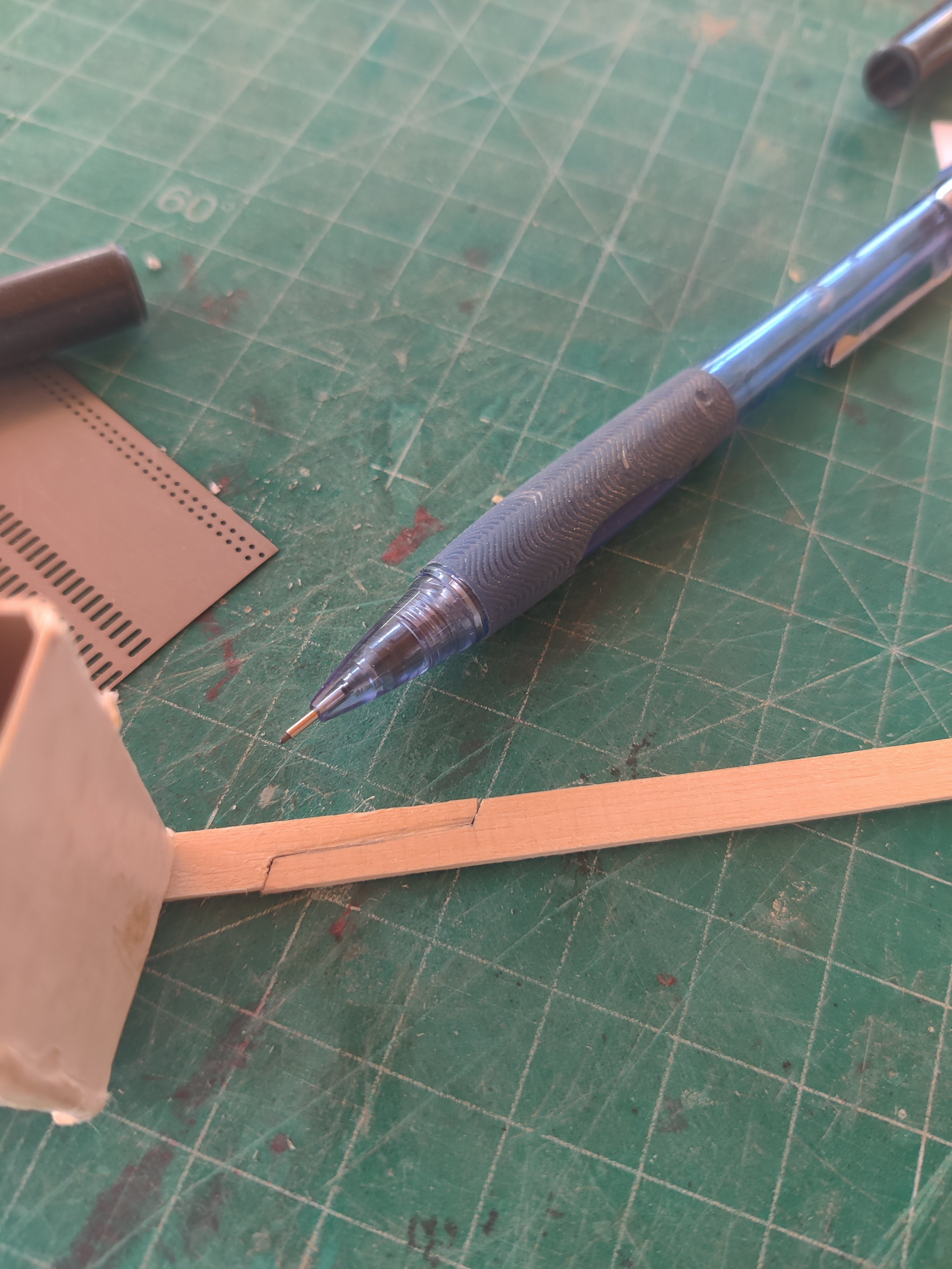

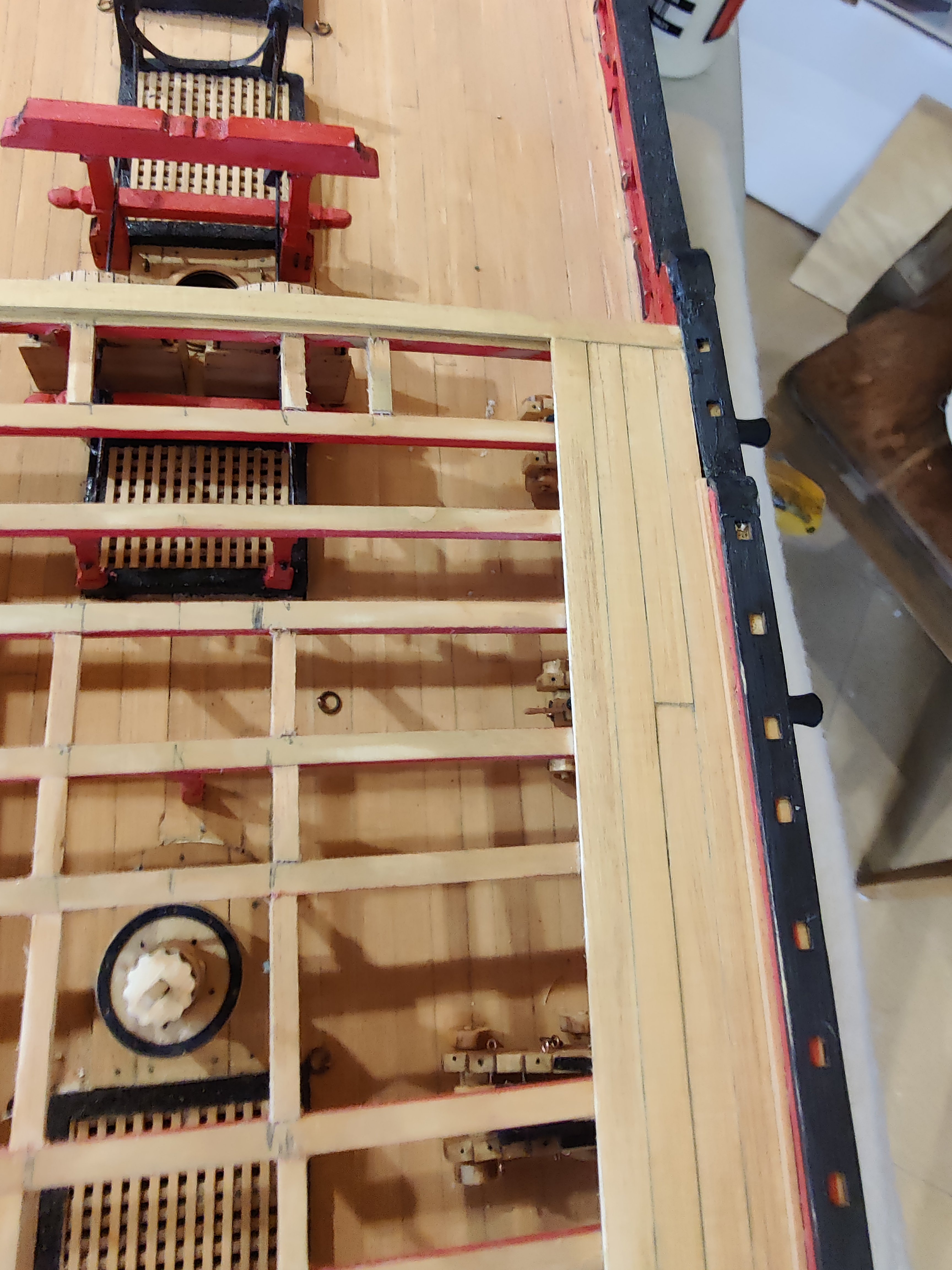

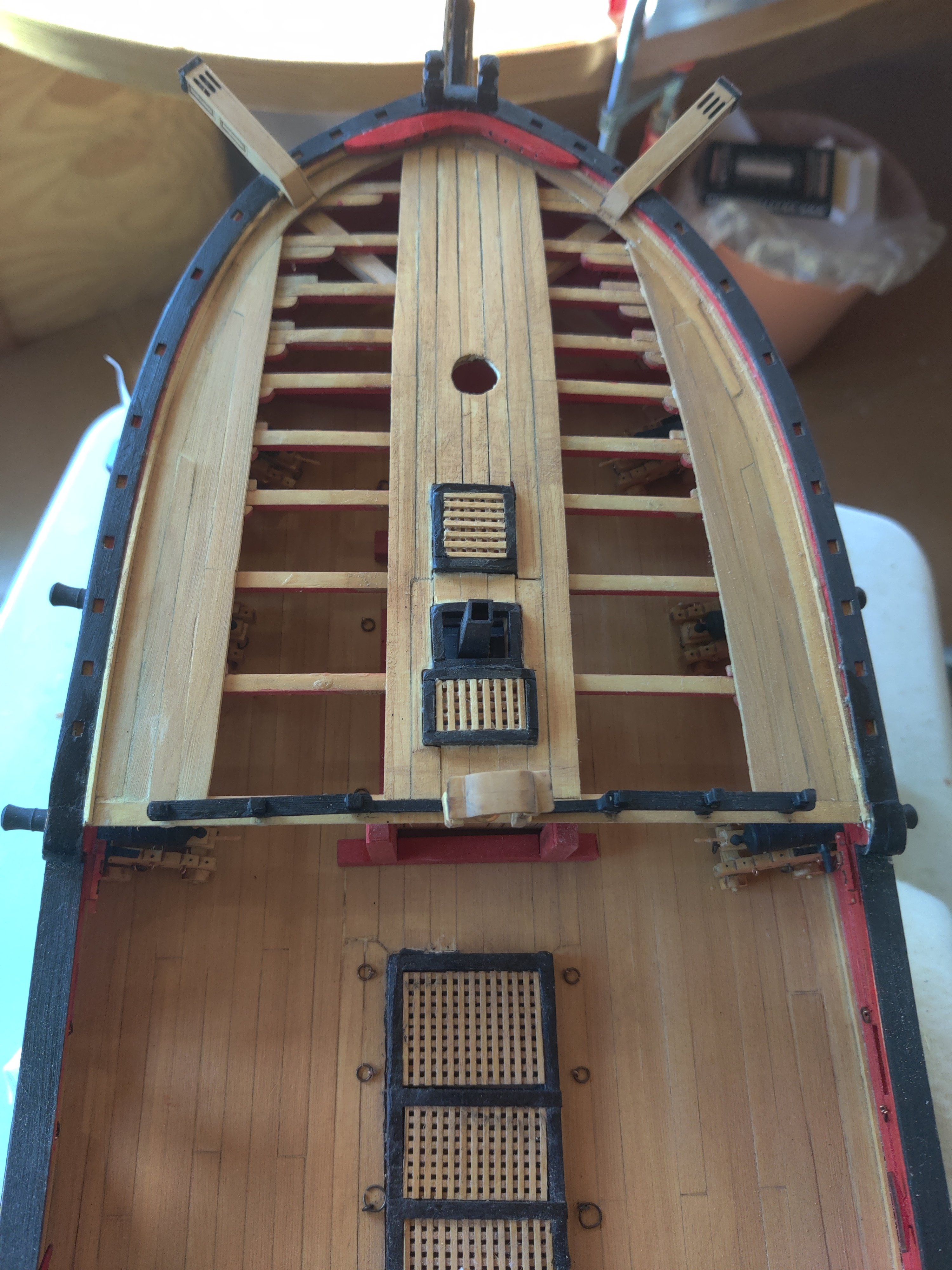

Planking of forecastle and qdeck  and using scarf joints. I found that I often split the plank when trying to make the scarf. Once I started making a v cut I prevented the tendency to split the planks. I will finish the center sections when I have finished the carlings.

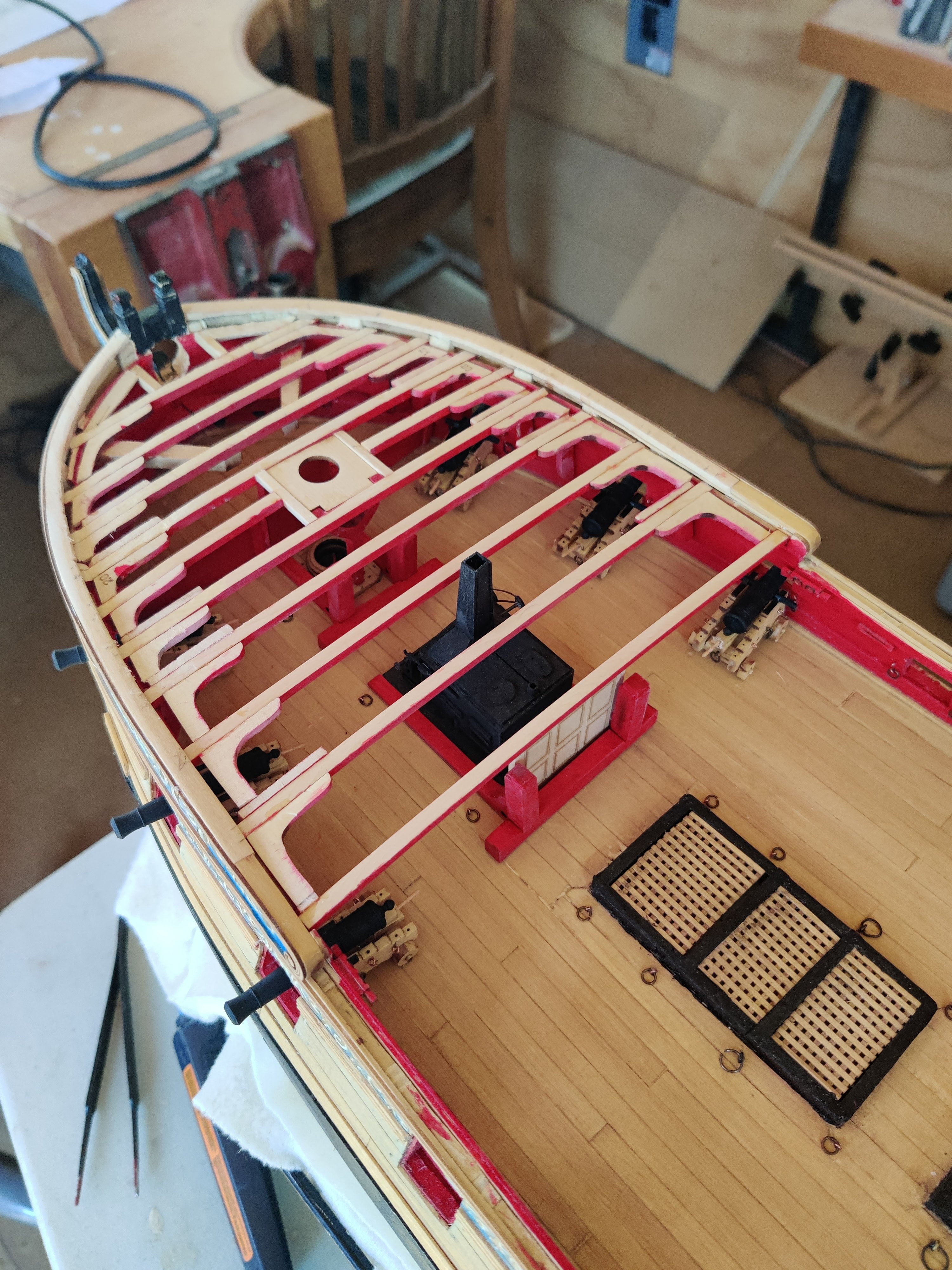

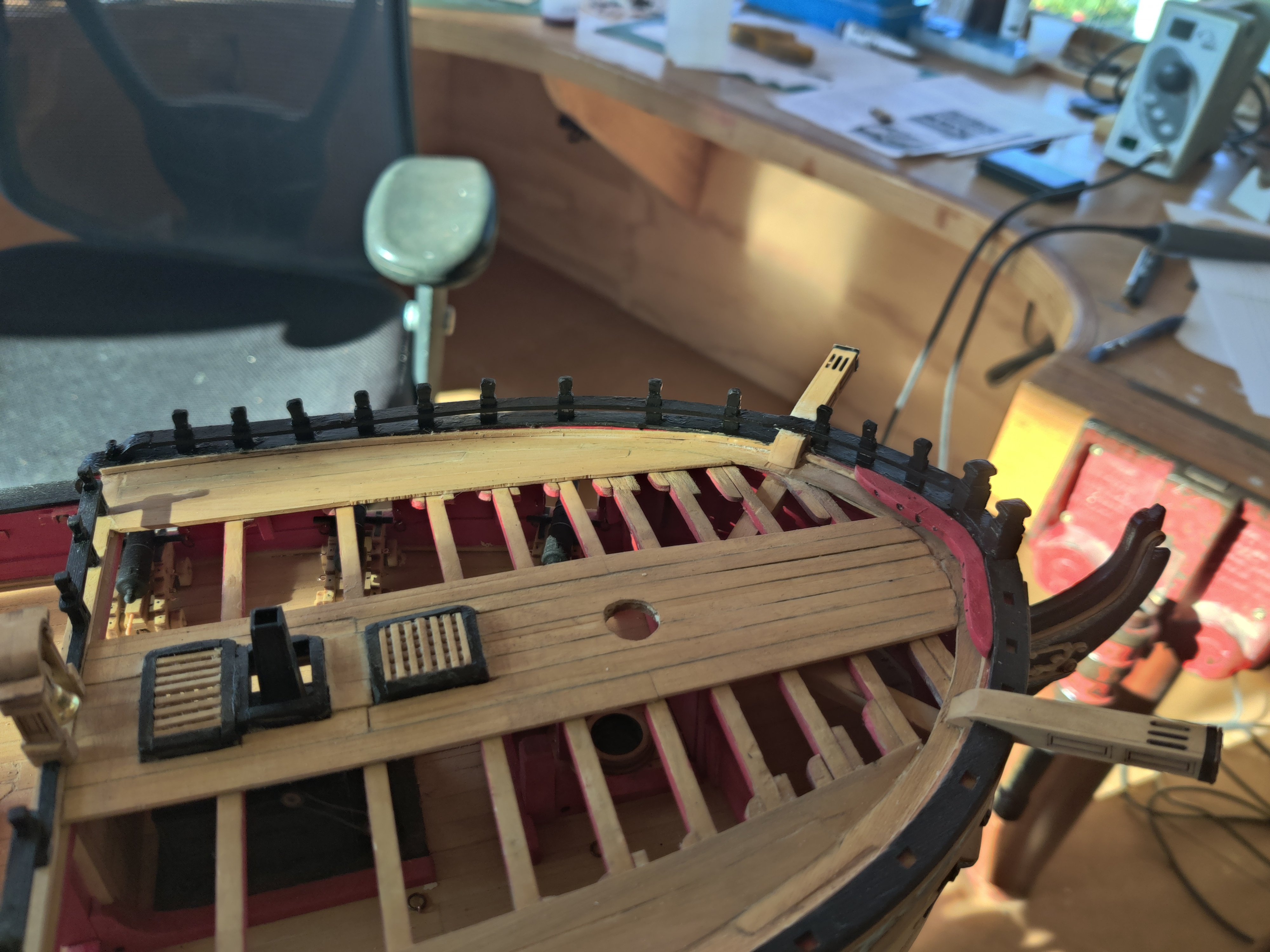

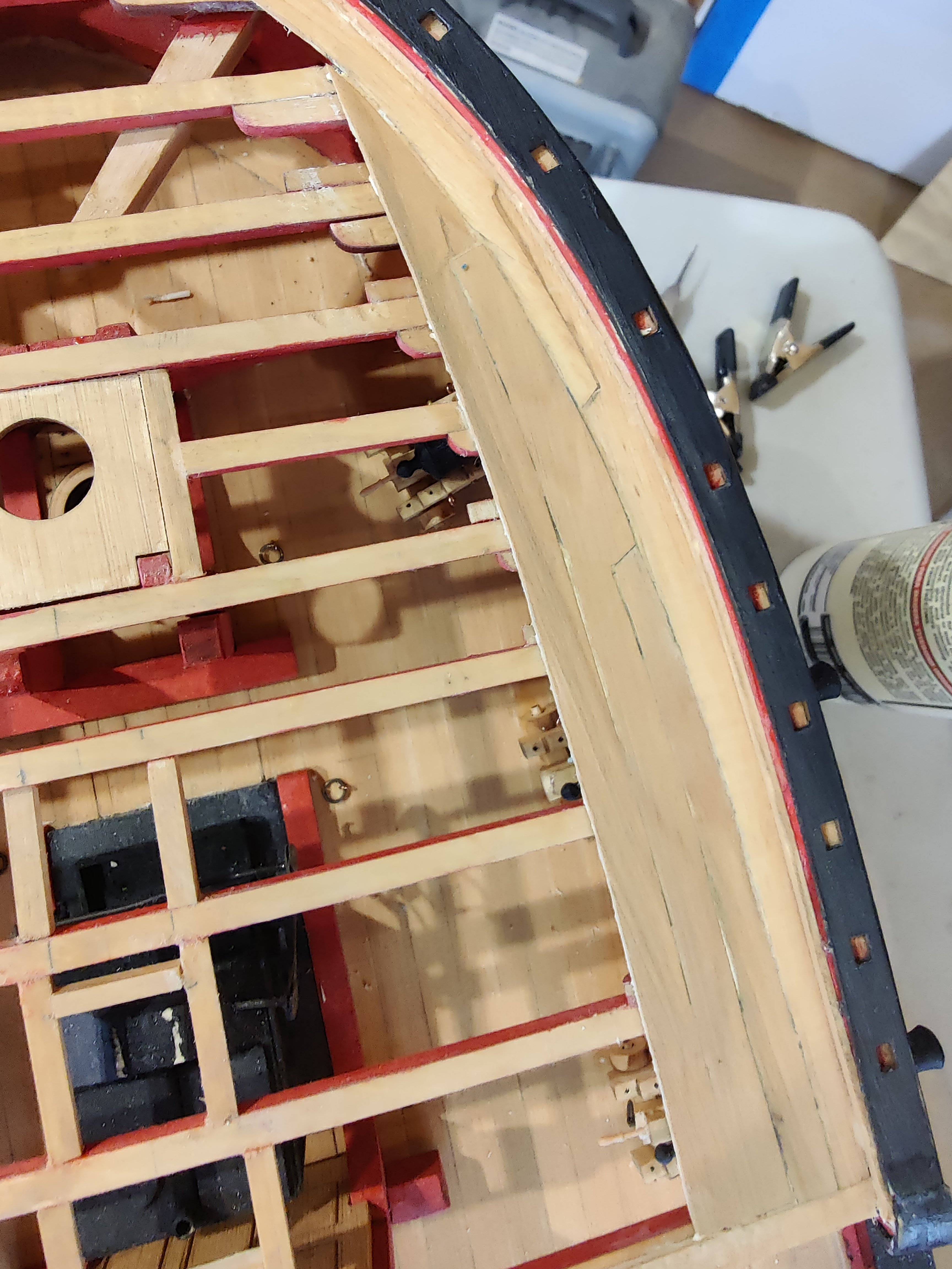

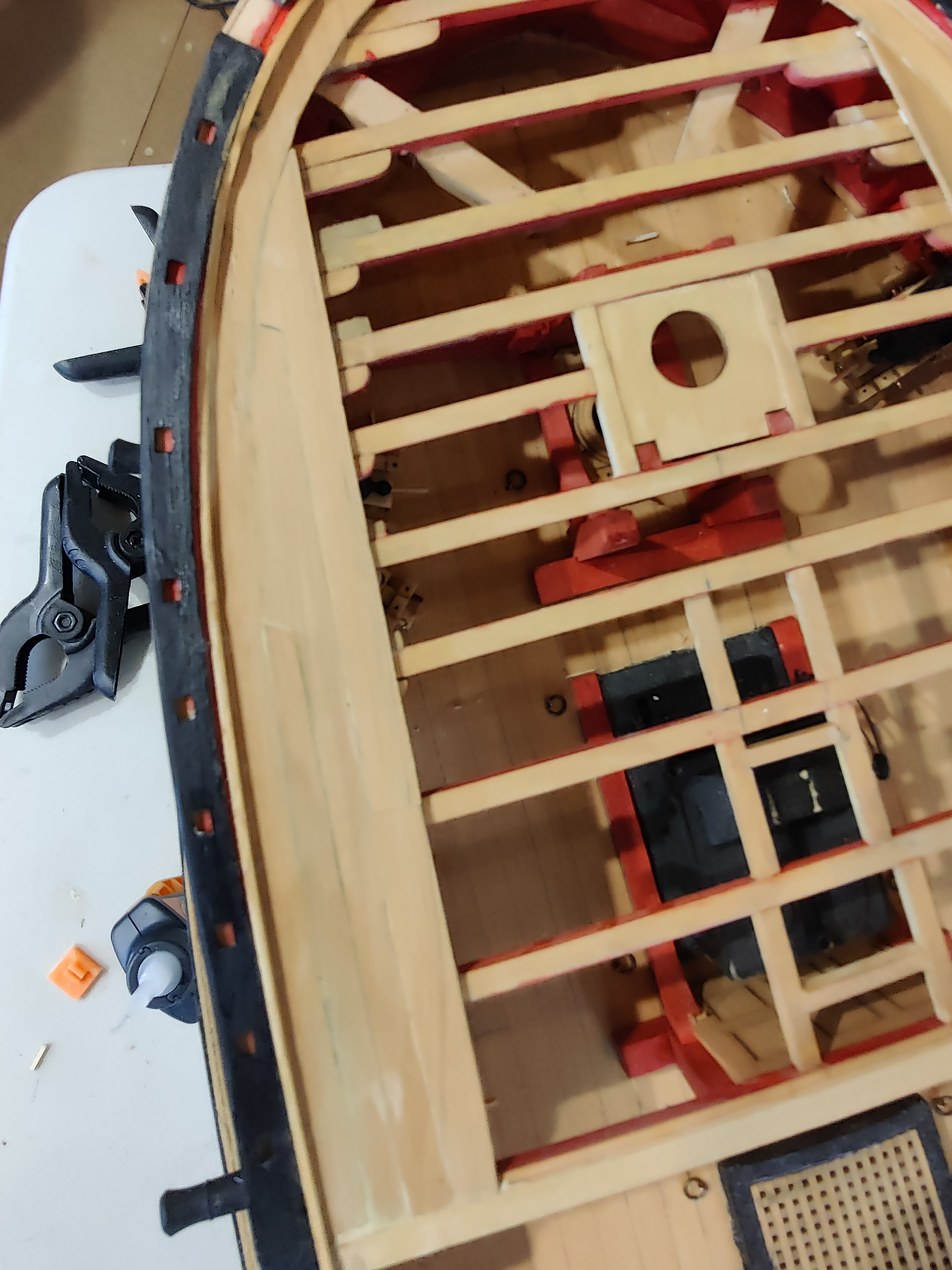

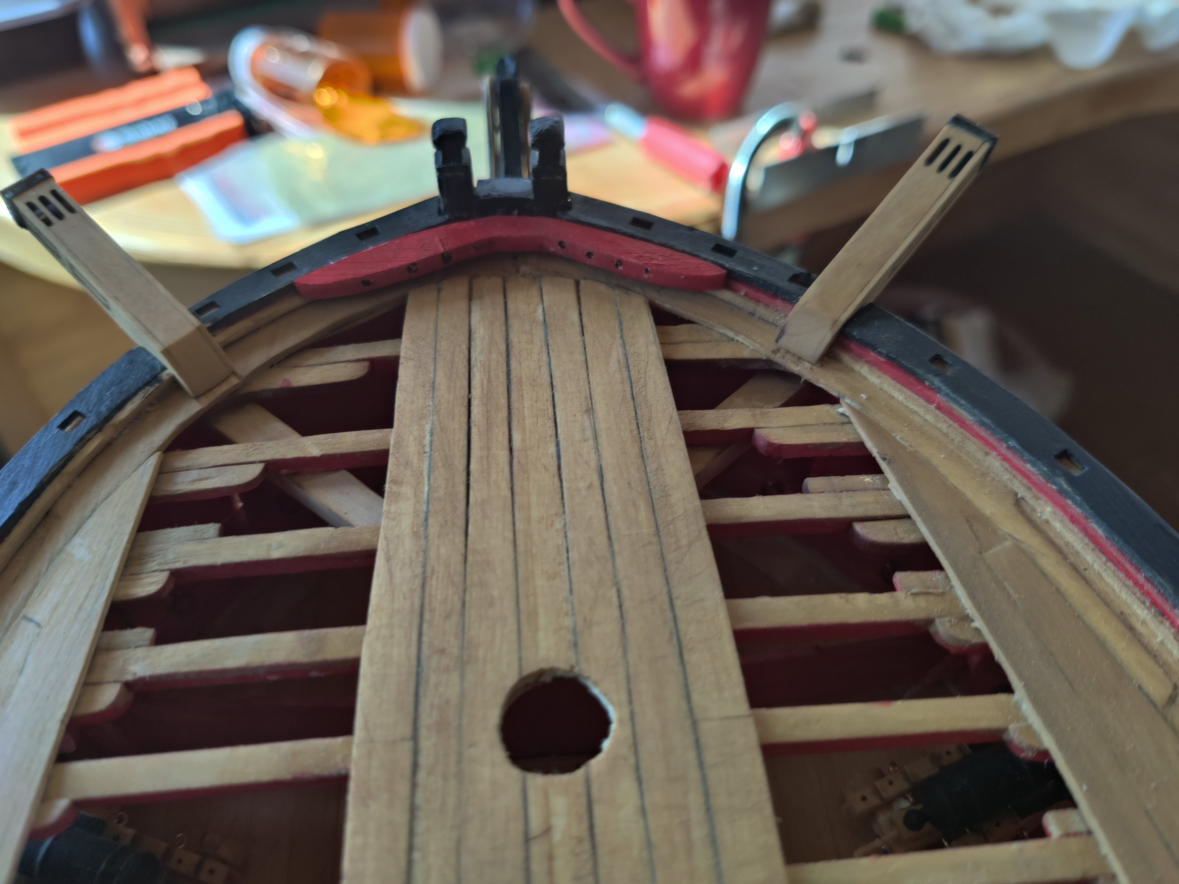

I finished on side of the forecastle cap rail. It was not without its problems, all self inflicted. I was not exact in fairing the bow. The curve at the bow was slightly different. I did not see that until I tried to place the cap rail on. The laser cut piece did not fit the curve. To cure that I had to cut the rail in two places to match the curve. It is not perfect but I did the best I could. The opposite side will be much easier because it matches the curve of the laser cut pieces. Thank goodness.IMG_20250811_084539.thumb.jpg.78e367254271a51efc7017091e32fb1a.jpg
