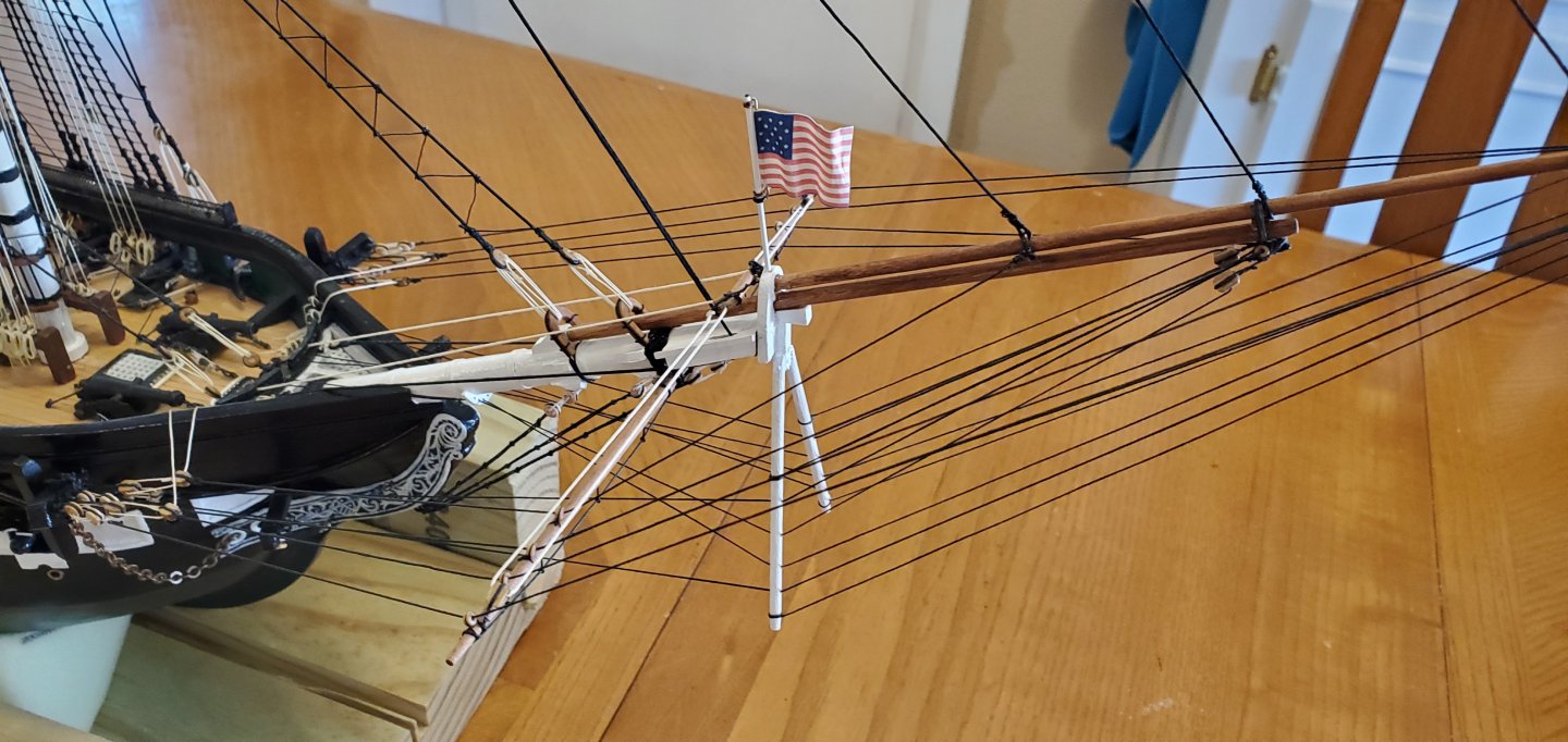

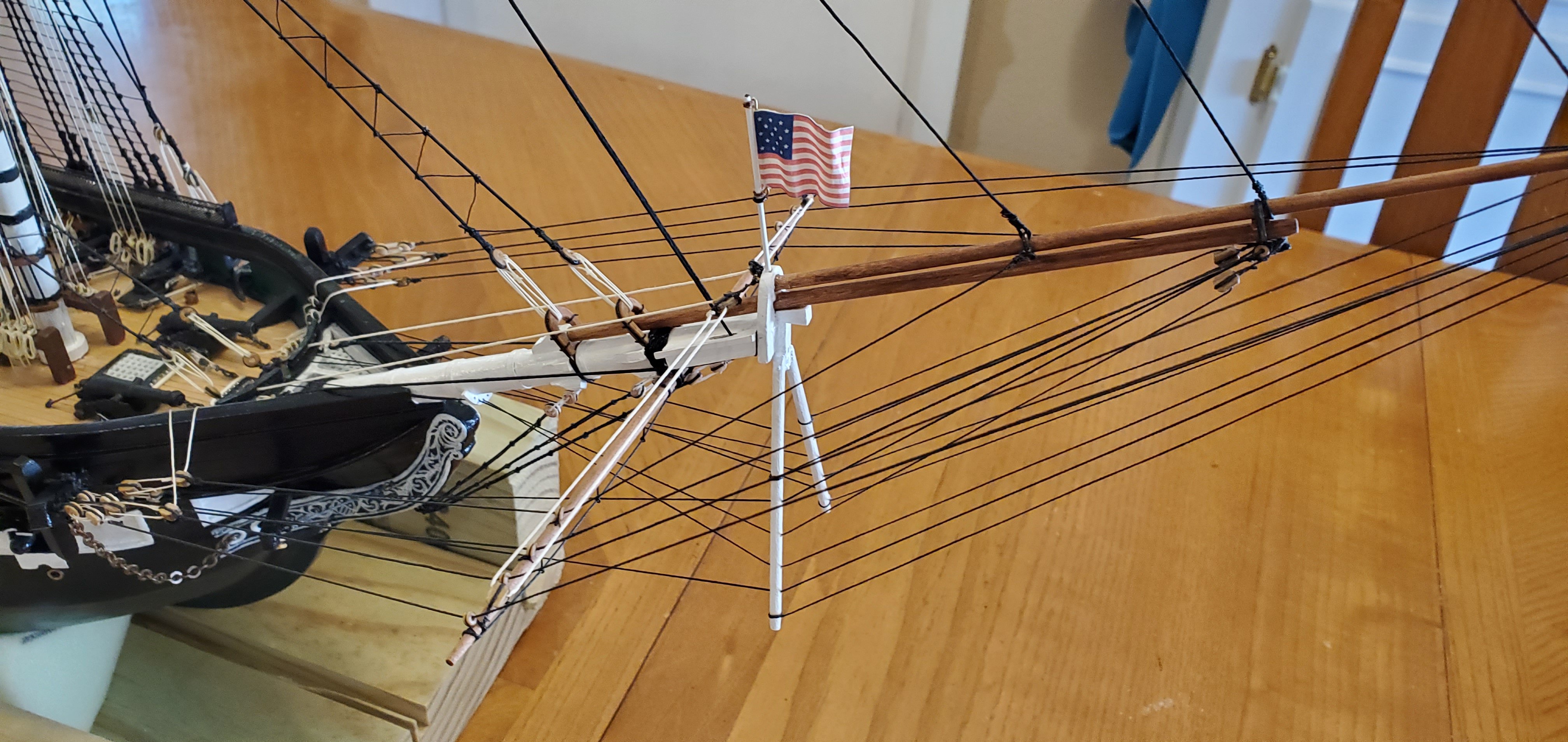

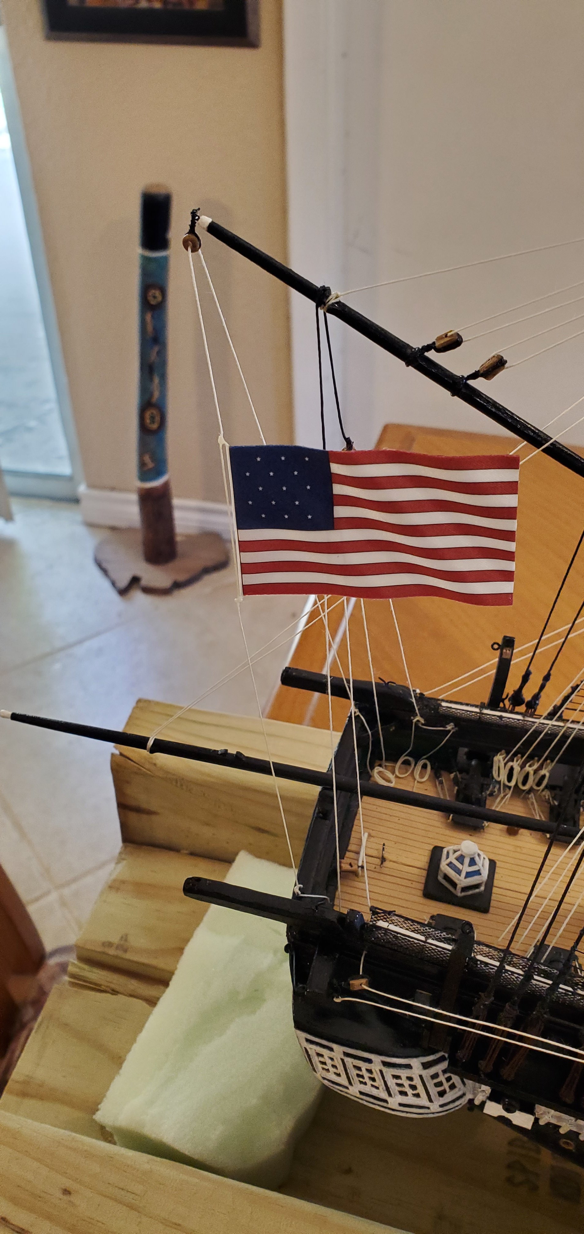

Next on the list was getting the US flags flying.  The original builder had mounted a small, paper flag on the bowsprit cap.  I had to remove it when I rebuilt the broken bowsprit, but now it's back in its original place waving proudly forward.

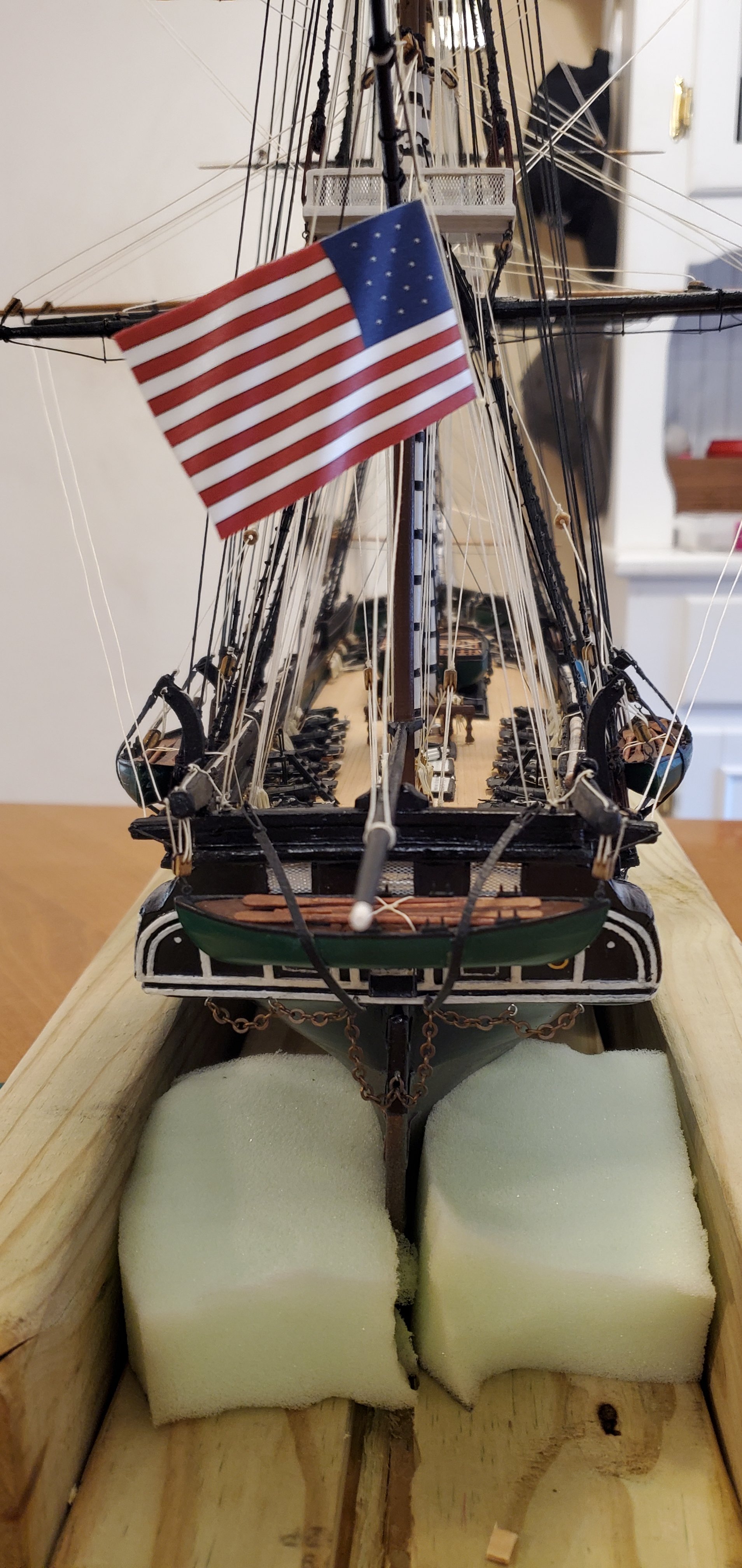

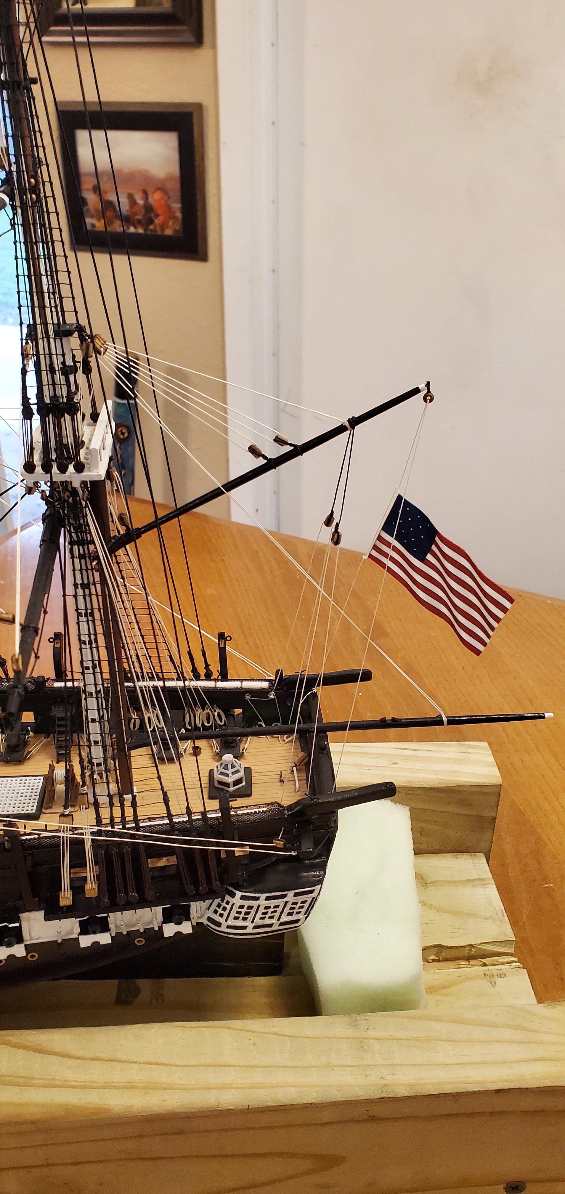

Looking at a variety of finished Constitution models, I saw many that had a larger flag flying from a halyard rigging off the gaff.  I went to my favorite poaching box (Artesania Latina kit for the USS Constellation) and grabbed the flag from it.  I've poached so much stuff from that box that if I ever decide to build the ship, I will probably have to buy an entire new kit.  Or try and build it from scratch (YIKES!).

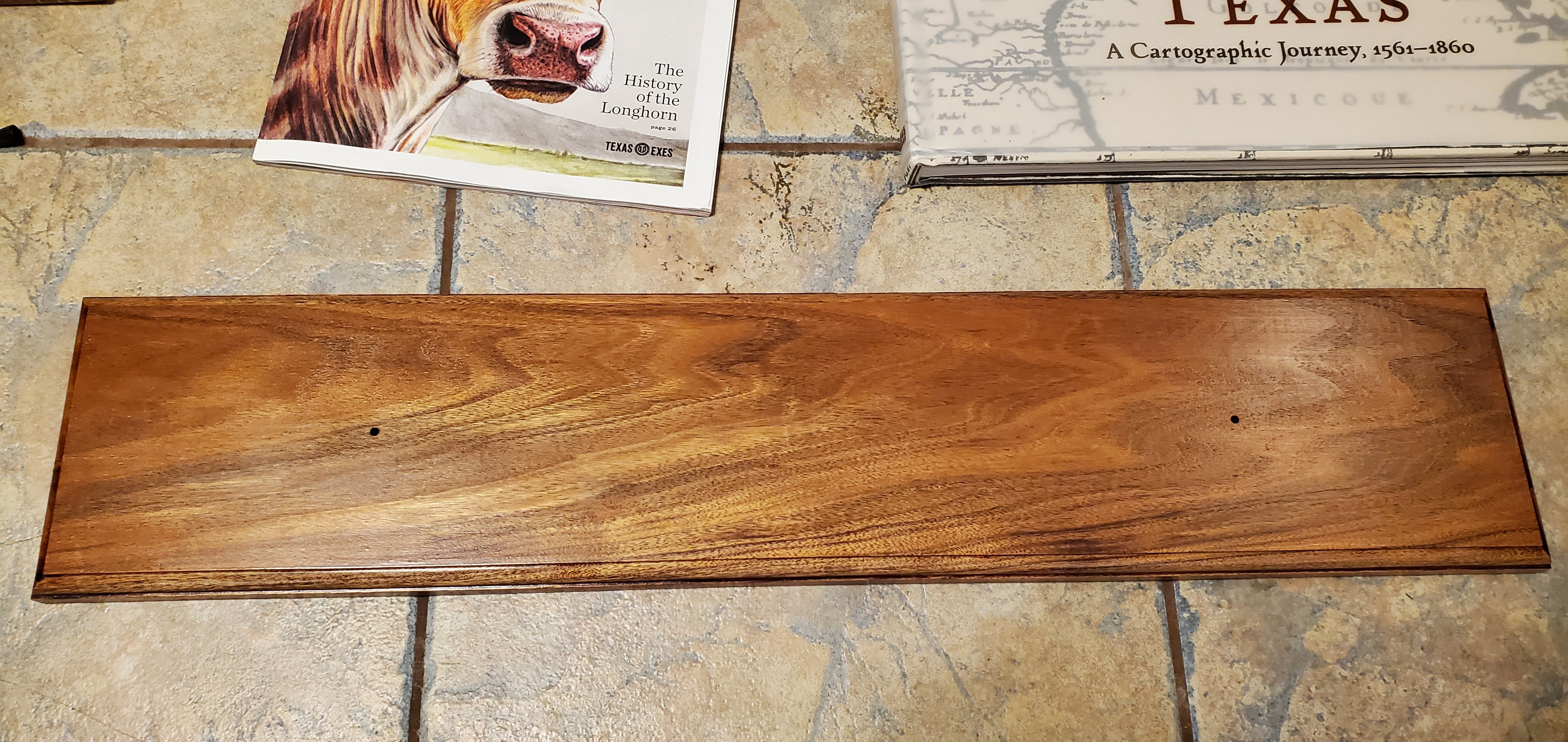

I also found a beautiful piece of Patagonia rosewood that I'm going to use for the base.  I had a buddy of mine rout the edges and I applied a few coats of poly for the finish.
I don't know if this is true, but I read somewhere that while in port ships were often docked with their bow facing into the wind, if possible, for various reasons. If this is true your constitution is parked backwards, evidence via the direction that the flags are blowing. 😐
Well, a blue norther came through and the wind changed directions after she docked!  Actually, the flags can easily be flipped.  So the family can decide how they would like them displayed.
Edited by Glen McGuire
Flags denoting wind direction on models is a bit disingenuous in my view, I'm not sure I've seen an honest example and that includes my own. The wind swirls, it's not inconceivable that flags thirty feet apart would vary and that on a large ship flags at bow and stern could be flying in opposite directions. Every model I've seen with flags flying have always been inline with the keel, I've never seen flags flying perpendicular to the hull. Having said that someone will of course post photos of such examples. :)
A couple of points: US Navy ships (or any Naval vessel) would rarely dock.  They would normally anchor off (reduced the potential for desertion).
When a ship did dock, the side chosen to be alongside the quay would be determined by the purpose or the job to be done while docked.
At anchor, the angle that a ship assumes to the wind is dependent on both the wind and the current, with the bow pointing generally up-wind and against the current.
Set your flags flying however floats your boat.

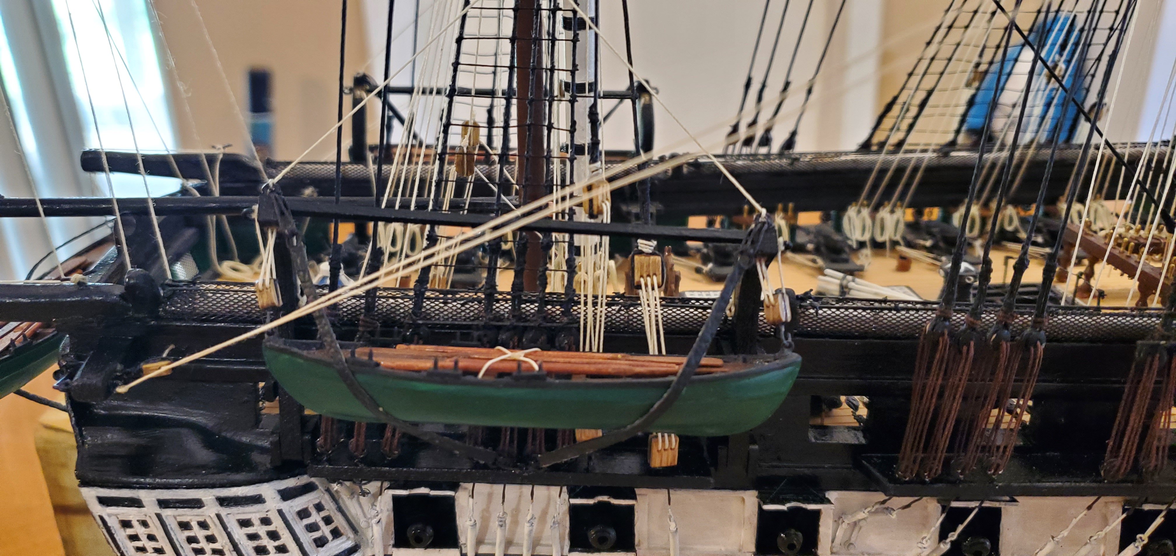

Time to hang the whale boats.  I was pretty much clueless as to how to do the small rigging between the end of the davit and the boat.  I knew I had to rig a line through the double block mortised into the end of the davit and the double block hooked to the end of the whale boat, but I couldn't figure out how to do it.  Shout out to Henry (a.k.a. @popeye2sea) for coming to the rescue.  He sent me a sketch that cleared things up.  I post the sketch below in case anyone else is as clueless about the rigging as I was.
Here's the whale boat hung from the davits.
After that, I circled back to install the lanyards on the deck and tighten everything up.  The working end of the lanyard is tied off to the pinrail on the mizzen mast.
Here's a picture of the entire davit rigging with arrows highlighting the 3 separate lines required for the rigging assembly.

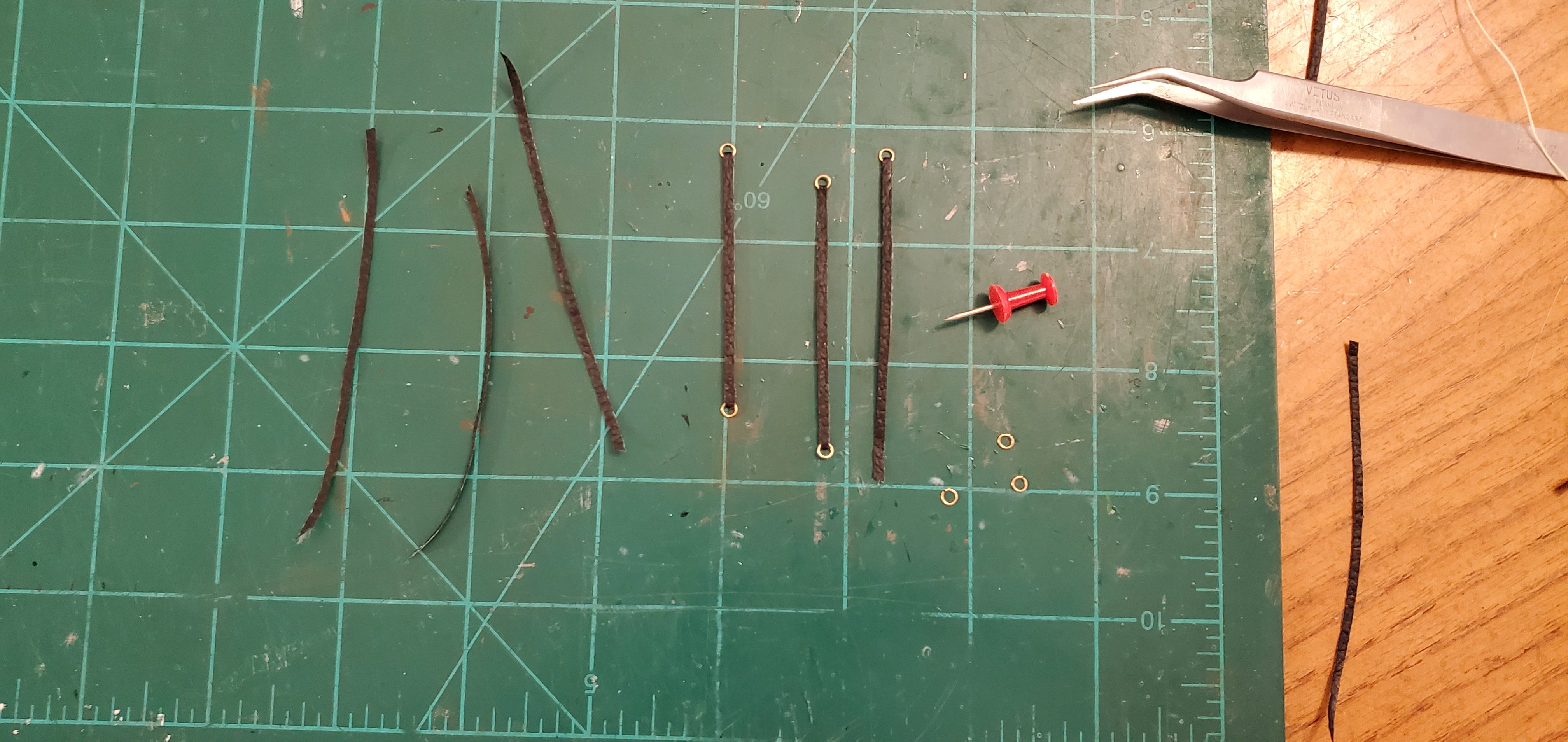

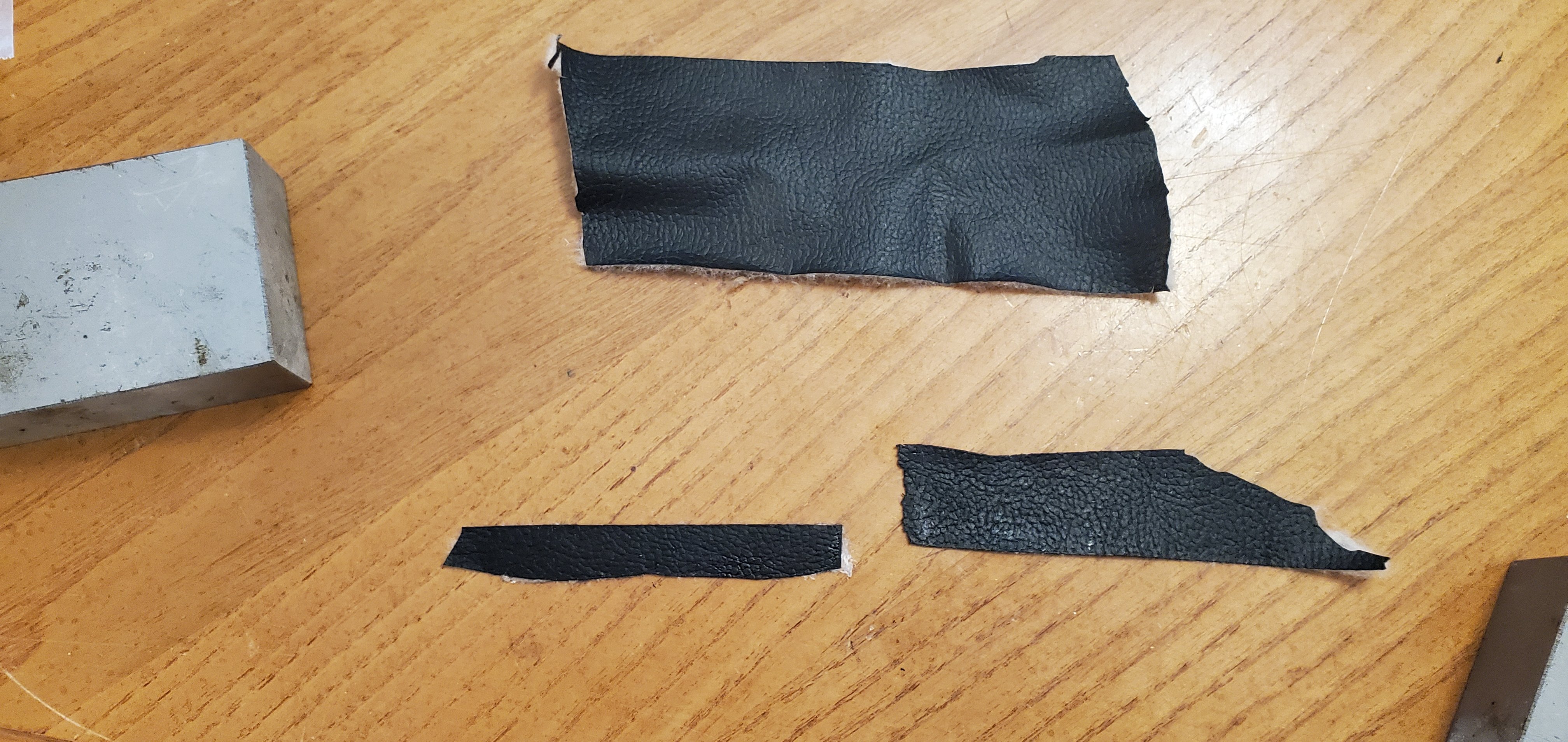

While finishing up the hanging of the whale boats, I learned another new term - gripes.  And I'm not referring to all the complaining I was doing while tying off 2000 ratline knots. 😫   While perusing other Constitution build logs, I found out that a gripe is a leather strap (or cord of some kind) used to secure whale boats hanging from their davits.
So I needed to find some very thin leather, preferably black, lying around the house.  The victim of my scavenger hunt turned out to be a black leather recliner I've had since maybe the Reagan administration.  I flipped it over and cut off several pieces of overlap from the stapling underneath.
There was some white fuzzy stuff glued to the back which I sanded off.  I cut some small strips, but the leather was so thin the edges immediately curled.  Not good.  So I tried brushing a thin layer of CA glue on the backside and flattening it between a folded piece of wax paper while it cured.  It actually worked out perfecto!  The glue stiffened the strip enough to keep it from curling when cut, but it still had enough flexibility to wrap around the body of the whale boat.  Then I added some small rings to each end.
Here are a couple of pics of the whale boats hung and strapped in place.

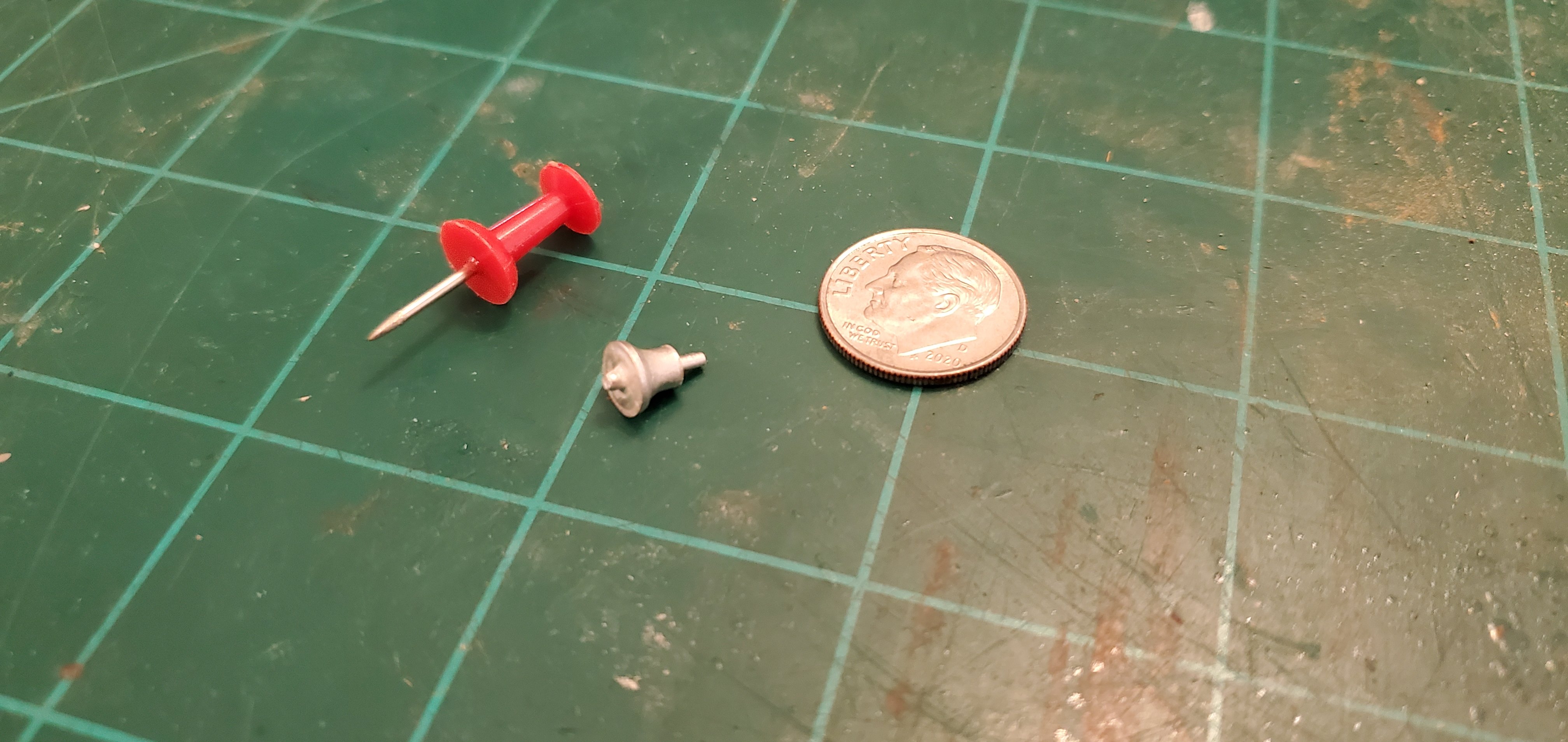

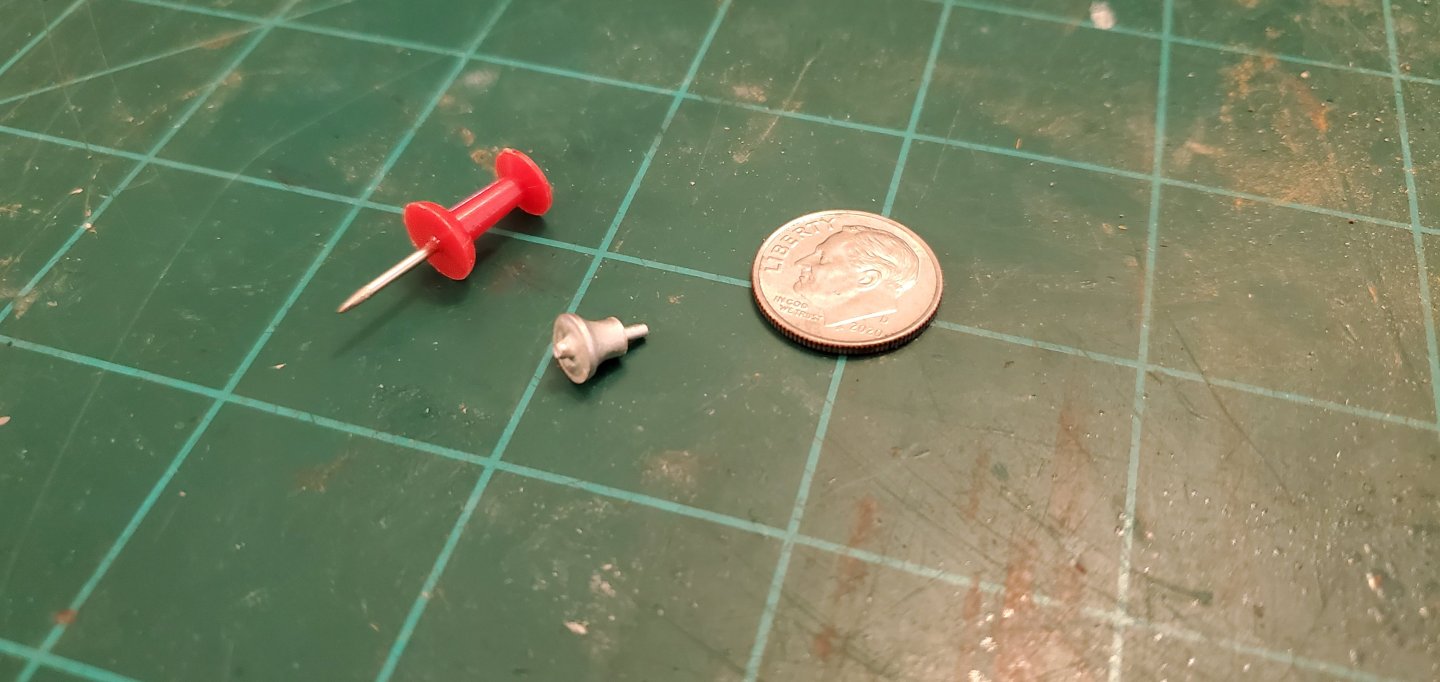

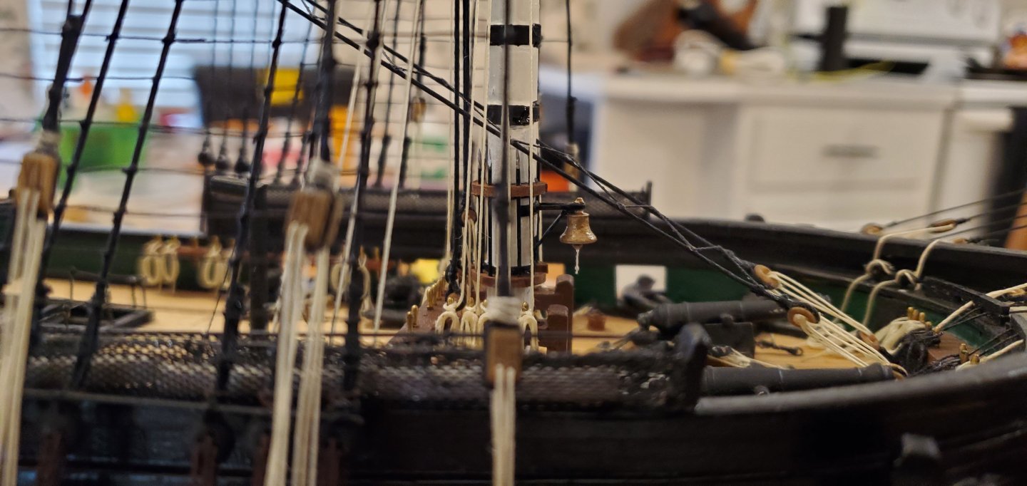

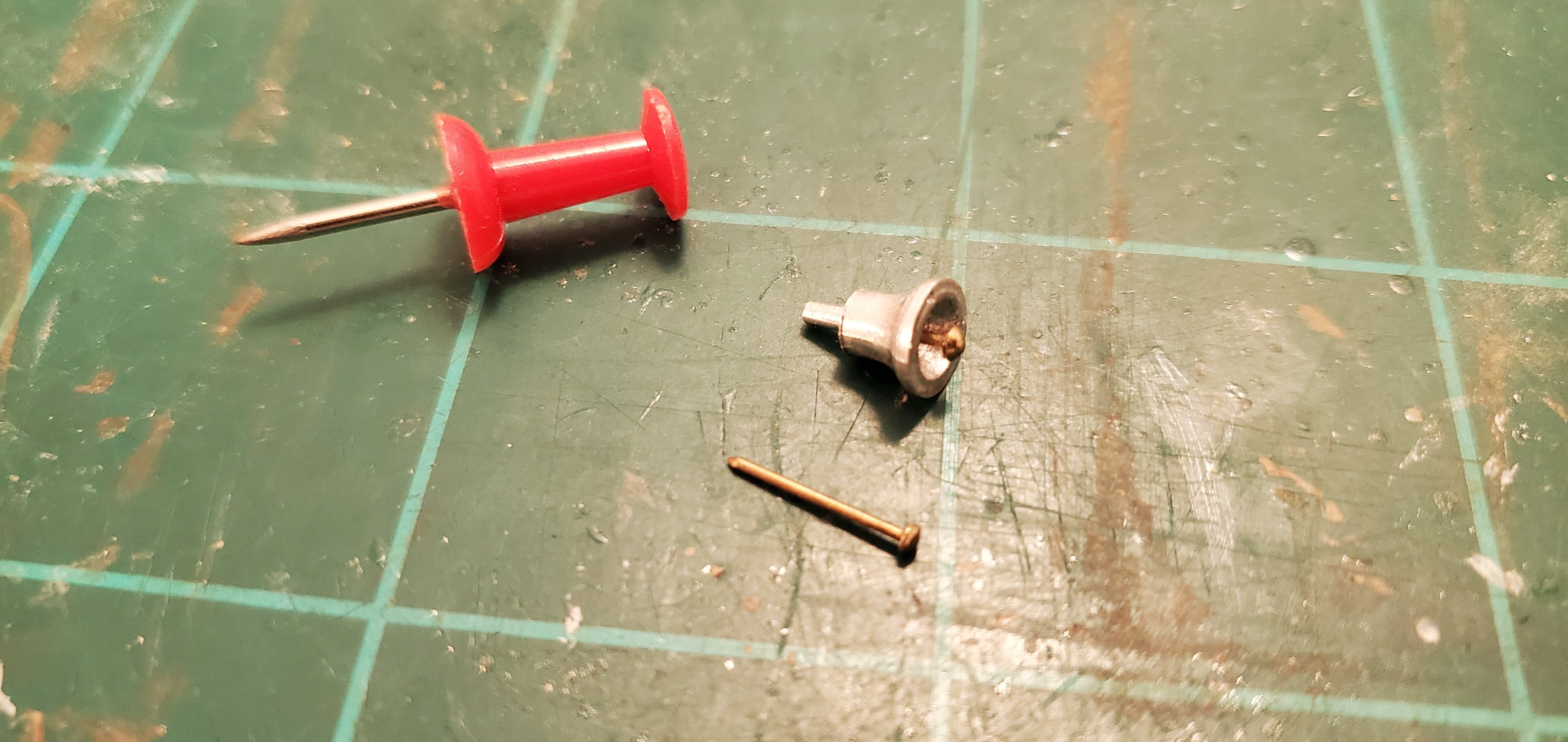

I'd been waiting for a couple of weeks for the last piece of the puzzle to complete the construction.  While the instructions do not call for a bell, most Constitution models I've seen have one secured to the main mast.  I ordered one from BlueJacket which I thought would be the right size.  It was advertised on their website as simply 1/4".  I didn't know if that was height, bell diameter, etc, and the picture on the website was a drawing and not an actual picture.  But I figured it would be pretty close to what I needed.  Here's what it looked like when I got it.
The size was good, but it needed some work to make it worthy of the Constitution.  I started by hollowing out the interior.  Then I inserted a brass nail (leftover from my Mamoli CSS Alabama) for the clanger.  I know it's officially called a clapper, but I think clanger is more descriptive.  😃

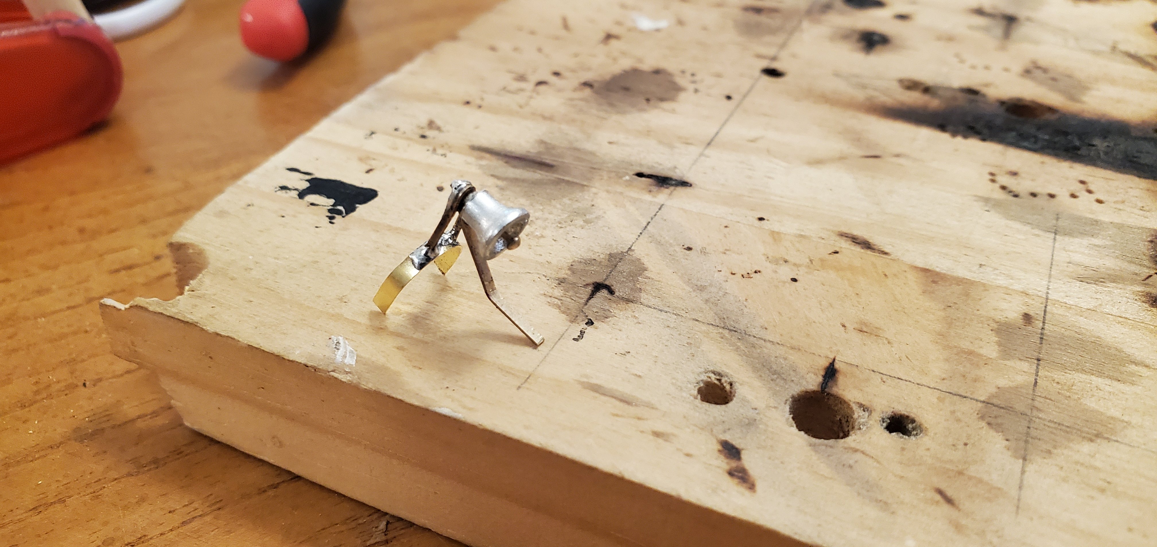

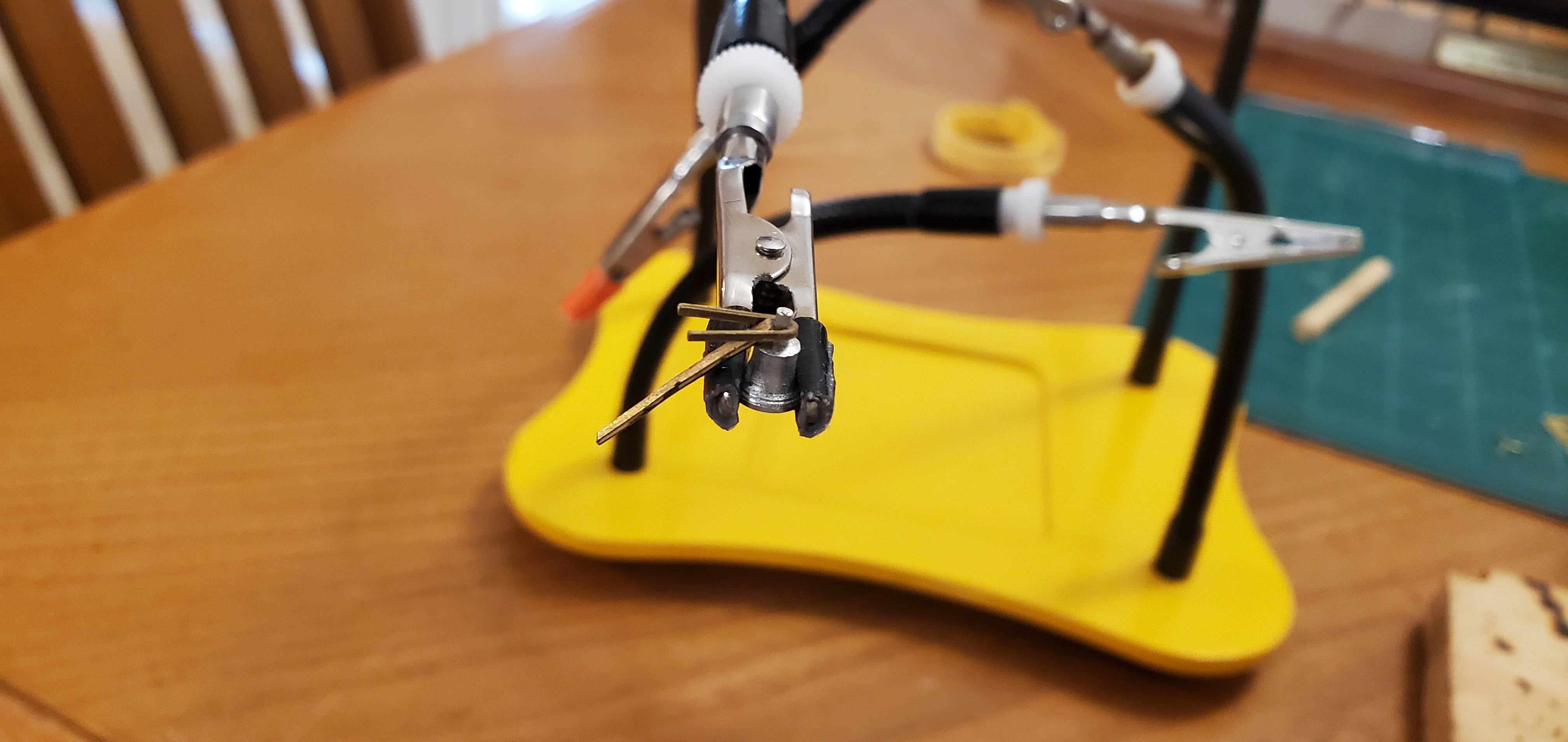

Next, I took some leftover brass sprues and soldered together a mounting bracket.
So here's where I had to take some artistic license.  From what I've seen on other Constitution models, the bell should be attached to the main mast.  However, my main mast did not have room for the bell because I took up too much space with the boarding pikes.  But the foremast had room, so that's where it went.  Here's the bell painted and mounted on the foremast.
And with that, I declare the build complete!  Oh, and while waiting for the bell to arrive from BlueJacket, I did get the ship mounted onto its base.  So the work here is truly done.  I will post some final pics tomorrow.
