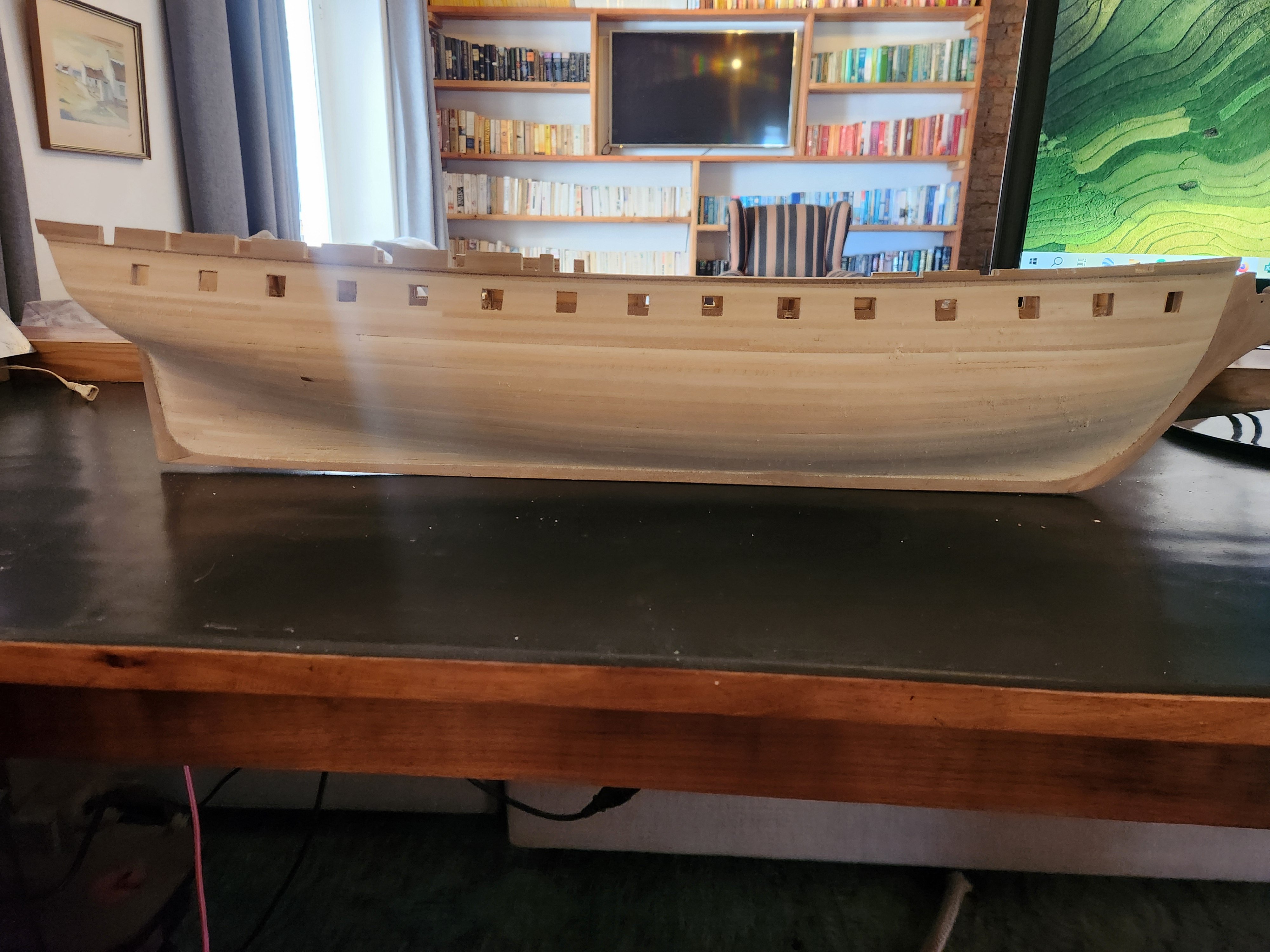

1 hour ago, Der Alte Rentner said:

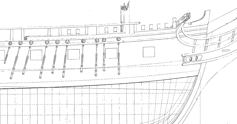

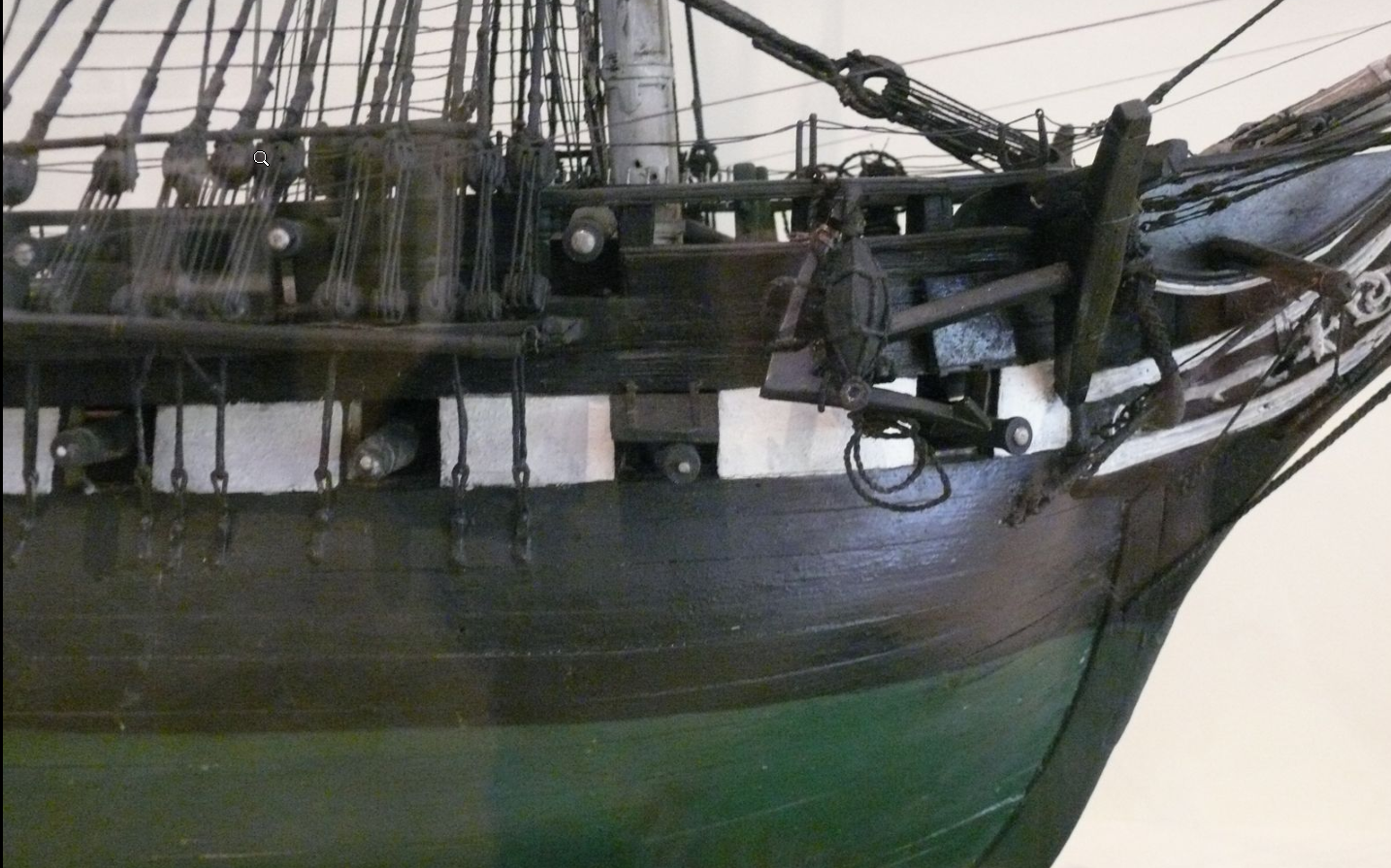

Is it just me or are the gun deck ports slightly concave vertically?
The Spar deck ports look great.
I couldn't ignore this observation. Some heavy sanding has leveled things out quite a bit and I'm hoping the planking will. Solve the rest.
I can't stress enough how much I appreciate the feedback. This is how one avoids looking at a model with 500 hours in it and realising you made a silly mistake at hour 20
Thanks Peter
Haiko
2 hours ago, The Bitter End said:
I am hoping that I can eliminate this with the 2 layers of planking I must still add over them.
Guaranteed.. I still can't believe how much shaping I had to do to get level planks, and that was just with the one layer.  You'll be fine.

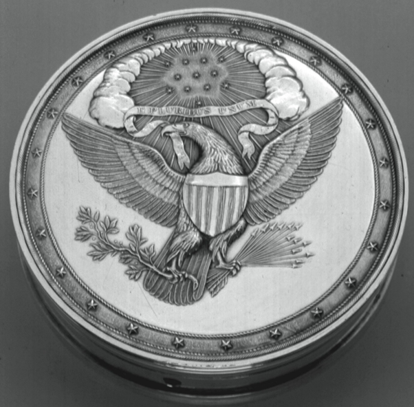

 4: Great crest of the United states and 13: Painted banner
 This particular element took a vast amount of research to nail down.
I believe one can safely assume that the eagle appeared on the stern and one would hope it would be in this location. There is a reference to constellations requiring their appearance on the stern and I beliebe I see something like clouds on the hull stern and possibly even in the corne painting. The great seal of the united states appeared as follows from 1782:
It officially evolved to a seal looking like this in 1825:
I realised that my date isn’t quite right but I like to think that this evolution was a gradual one and an eagle similar to this may have been carved onto the stern. There are numerous eagles of this style which can be found at the time. Below a great example:
One interesting quirk of the eagle of the constitution on the hull model is that it appears to be facing “sinister” (viewer right) the normal convention for the seal is for the eagle to be facing “dexter” viewer left. The eagle represented is somewhat unclear and it is possible that the item which appears to me to be the head and neck may well be the scroll it carries but who knows! The eagle does however face sinister from at least 1908 on the restored constitution so I went with this design.
Above the eagle I placed clouds carved from pear wood and a sphere above the eagle showing the 13 stars representing the 13 states. A little titbit of information is that there were already 17 states at this stage but that is neither here nor there.
On the corne painting it appears that there is some white in the area of the eagle, this could well be the banner the eagle holds. This also presented one of 2 opportunities to show that the decoration on the stern may well have been at least partially painted. I opted to paint this banner using white paint with a small amount of red to indicate the text, followed by a light brushing of yellow to blend the colour into the rest of the stern.

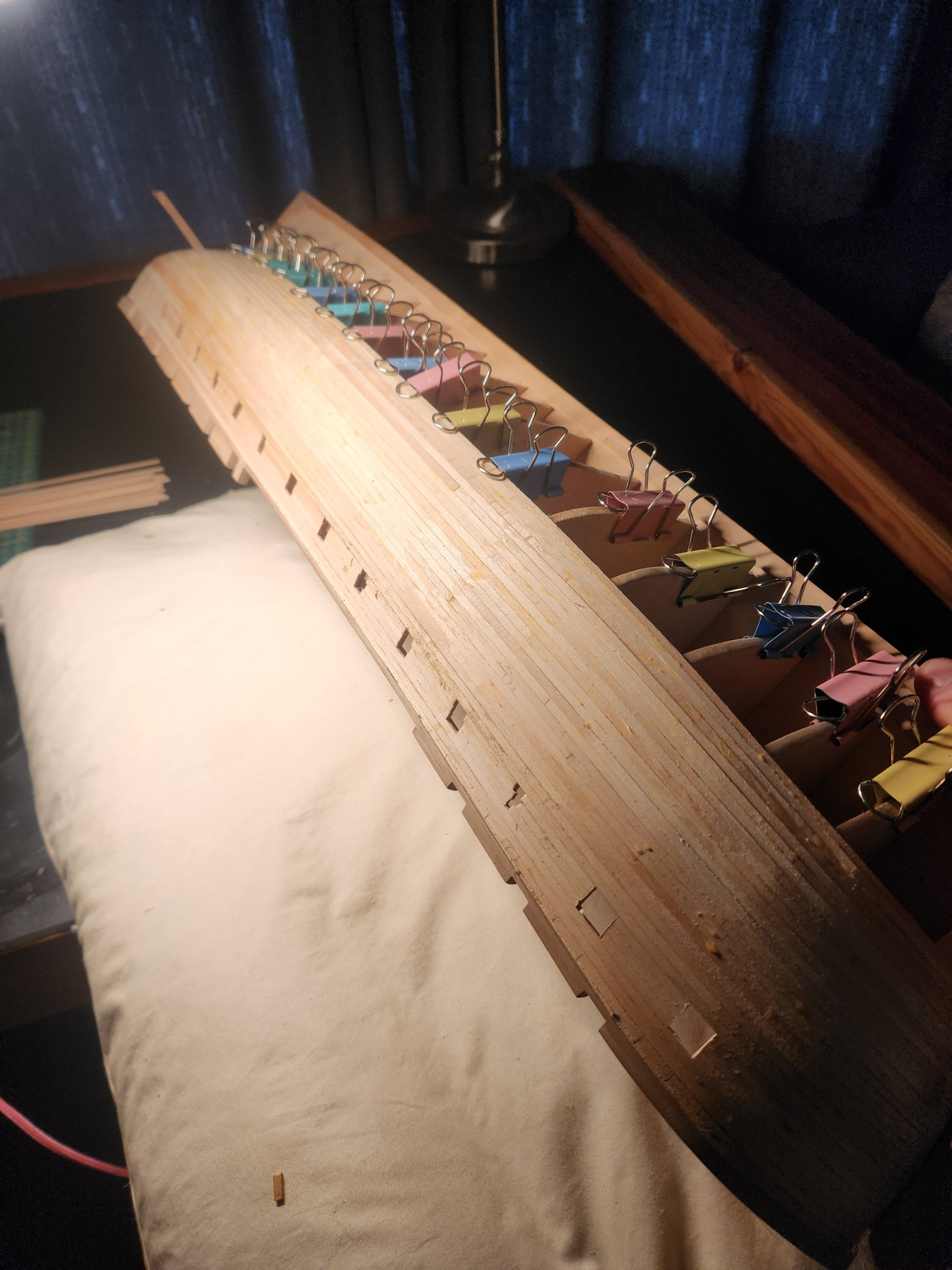

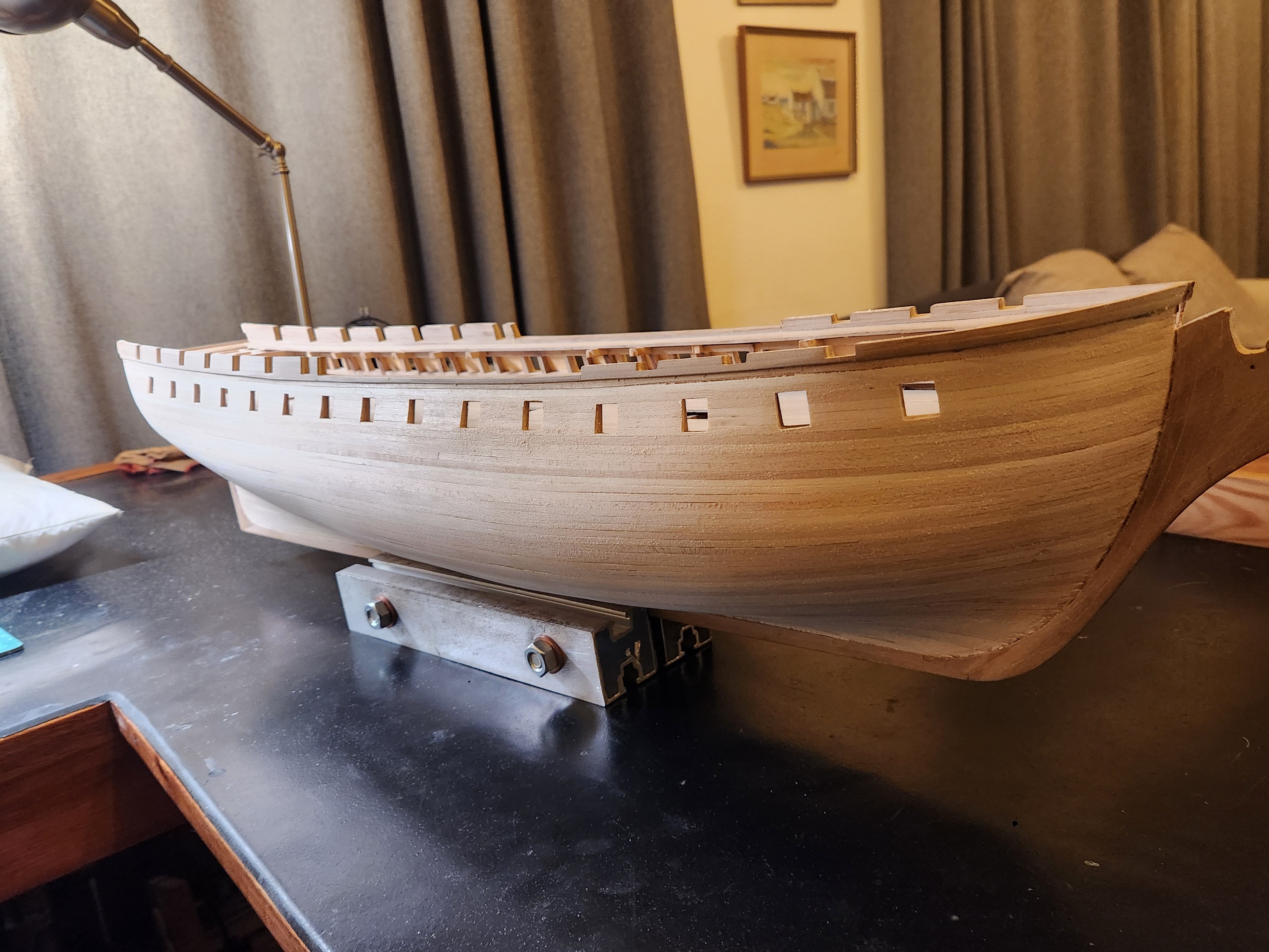

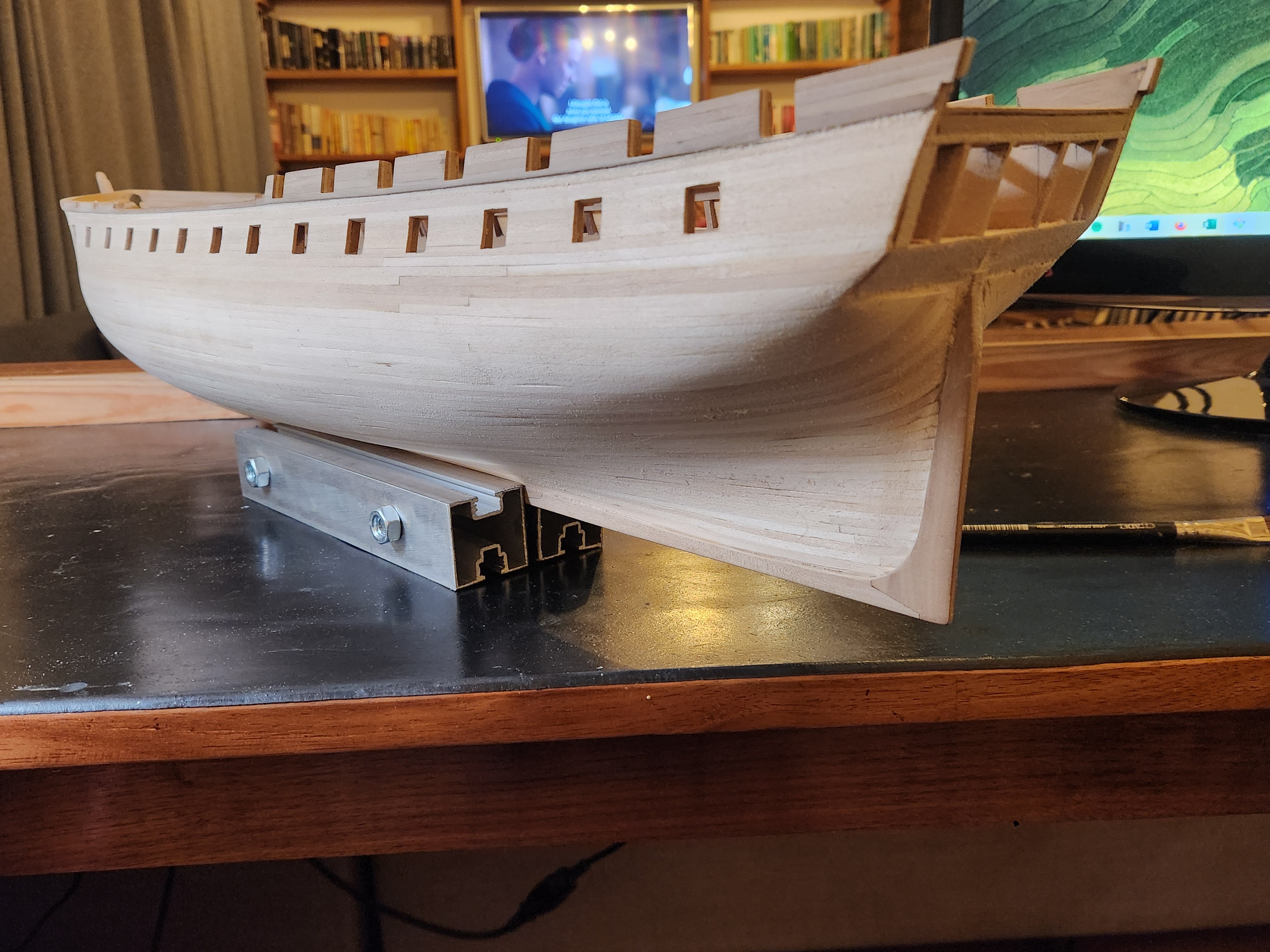

Hello Everyone
Not a terribly exciting or in depth post today. Just an update to show the first planking. There is nothing of historical significance here except for the fact that one can now more clearly see the 1707 spacing of the gun ports, which are evenly spaced below the gun ports above and the absence of a bridle port.
As some of you may know I am going with a double planking approach, the first layer being done with the supplied timber(fairly nasty stuff) and the second with pear wood(still to be cut from logs which are drying).
This approach has 2 main benefits, the first being the creation of a smooth stable shaped hull to secure the pear wood to and the second being an opportunity to learn a bit about planking. This being my second build this was much needed to hone my skills before the final planking.
I did the starboard side "correctly" besides the fact that I used single runs of planking as far as possible instead of the correct length planks as in the final layer. I did however attempted to taper the planks correctly etc. This went pretty well on the Starboard side but I somehow messed up the process on the port side and developed a strange curve in the planking. At this point I decided that it didnt make sense to keep torturing myself and completed the final planking with full width planks.
My next step is to plank below the stern gallery and then move onto the final hull planking.
All this being said...does anyone know where I can find a good complete planking tutorial. I have seen chucks great videos but they begin after the hull has been marked as far as I can tell.

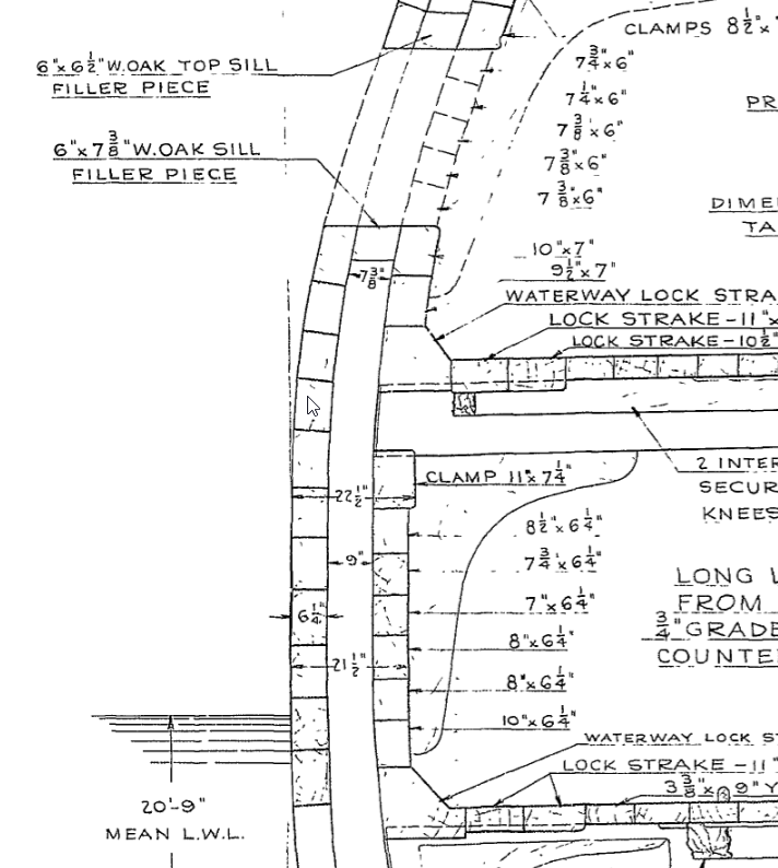

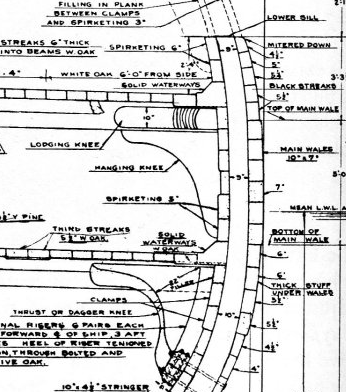

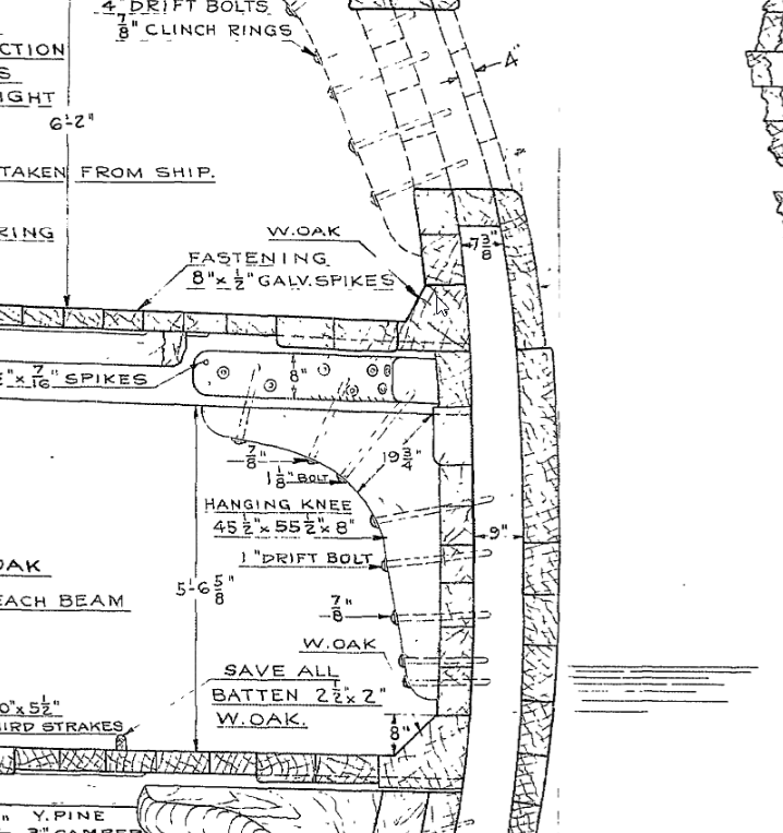

firstly, the wale.
In my attempt to pursue historical accuracy I did a little research on what the wale might have appeared like in 1797 and came across the following very confusing information...
1. the 1926 lord cross section drawings: Starboard side(presumably showing what the restorers were meant to built to). Note only one lip on the wale upper edge
2. 1926 Lord cross section, same drawing, Port side, presumably as found?? smooth hull no Step on the wale
3. yet another lord drawing showing an upper and a lower step with a protrusion of 1 to 1.5 inches
4. The hull model from 1812 showing what appears to be a totally smooth hull....this model pays alot of attention to other details so it would surprise me if this feature was there but was not shown in some form.
5. and finally the humphreys plans which appear to show some wort of wale like markings but that is by no means a definite
It is of course possible that the wale was there but was just so insignificant in protrusion that it was not shown on any of the paintings or drawings of the ship from the time, while in reality still being there. The fact that Lord included this feature may also simply have been a byproduct of the fact that he simply expected it to be there based on standard practice.
I am personally unable to find any feature or piece of text which indicated the stepped wale other than the one version of the Lord drawing.
I would love to hear your views and perspectives on this.
how should the wale be represented?! Should it be there at all? and if it is, an upper and lower ledge or just the upper.
Cheers
Haiko
