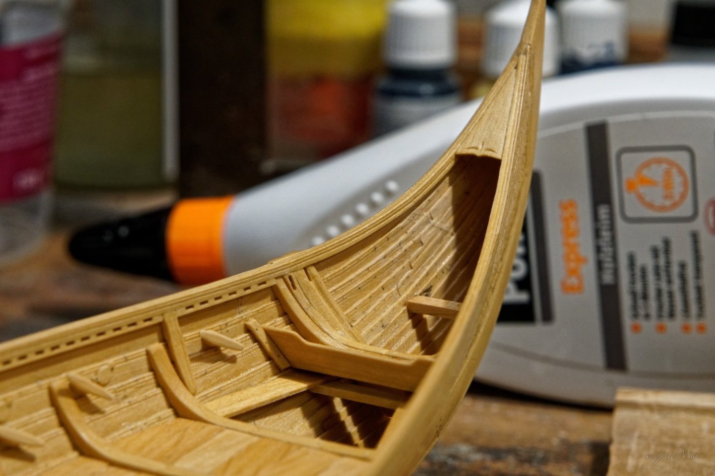

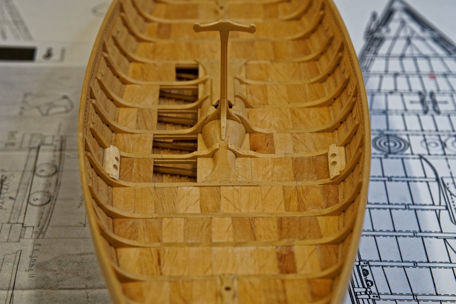

Really like the organic shapes of the framing! It feels like the tree is growing around the mast step, hugging it with branches :)
A bit too much decking obscuring it, the photos in post #135 are golden!
Thank you Mike,
the look at the mast step, is mostly hidden by the mast fish. The flat part of it, belonged to the mast fish. It is in reality one pice of wood, 1 X 5 m oak! So also without decking, you would't see much more of it.

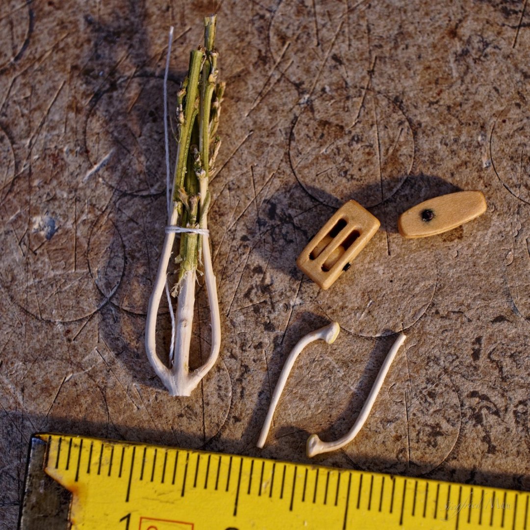

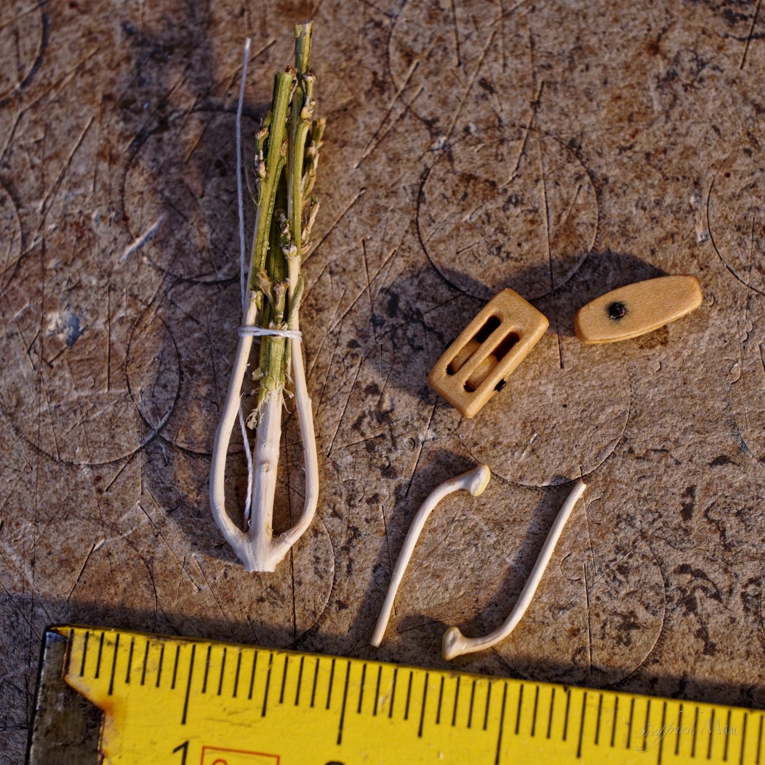

Hello,
today I build the two blocks, a one and a two sheave, for the halyard and two of the shroud pins. The thicker part of them is still a little green, so the rest has to wait a little longer.

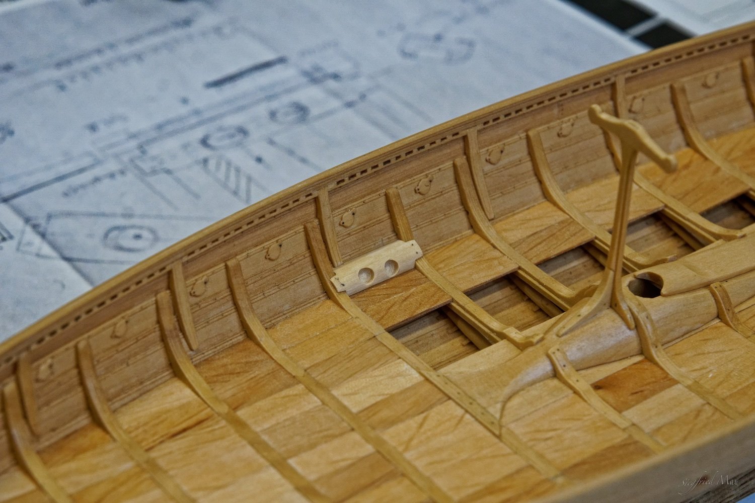

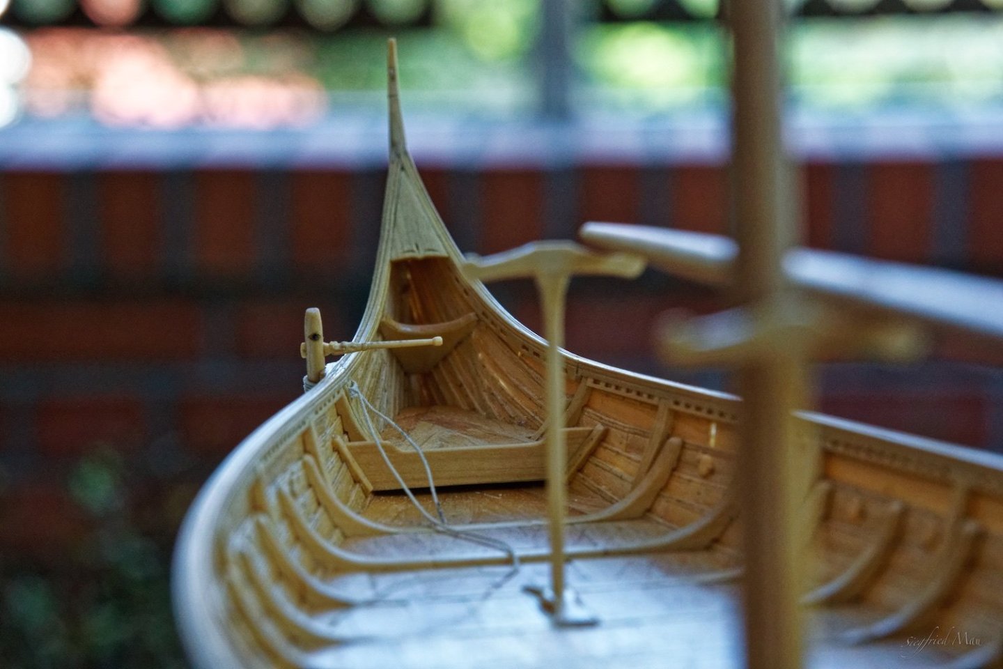

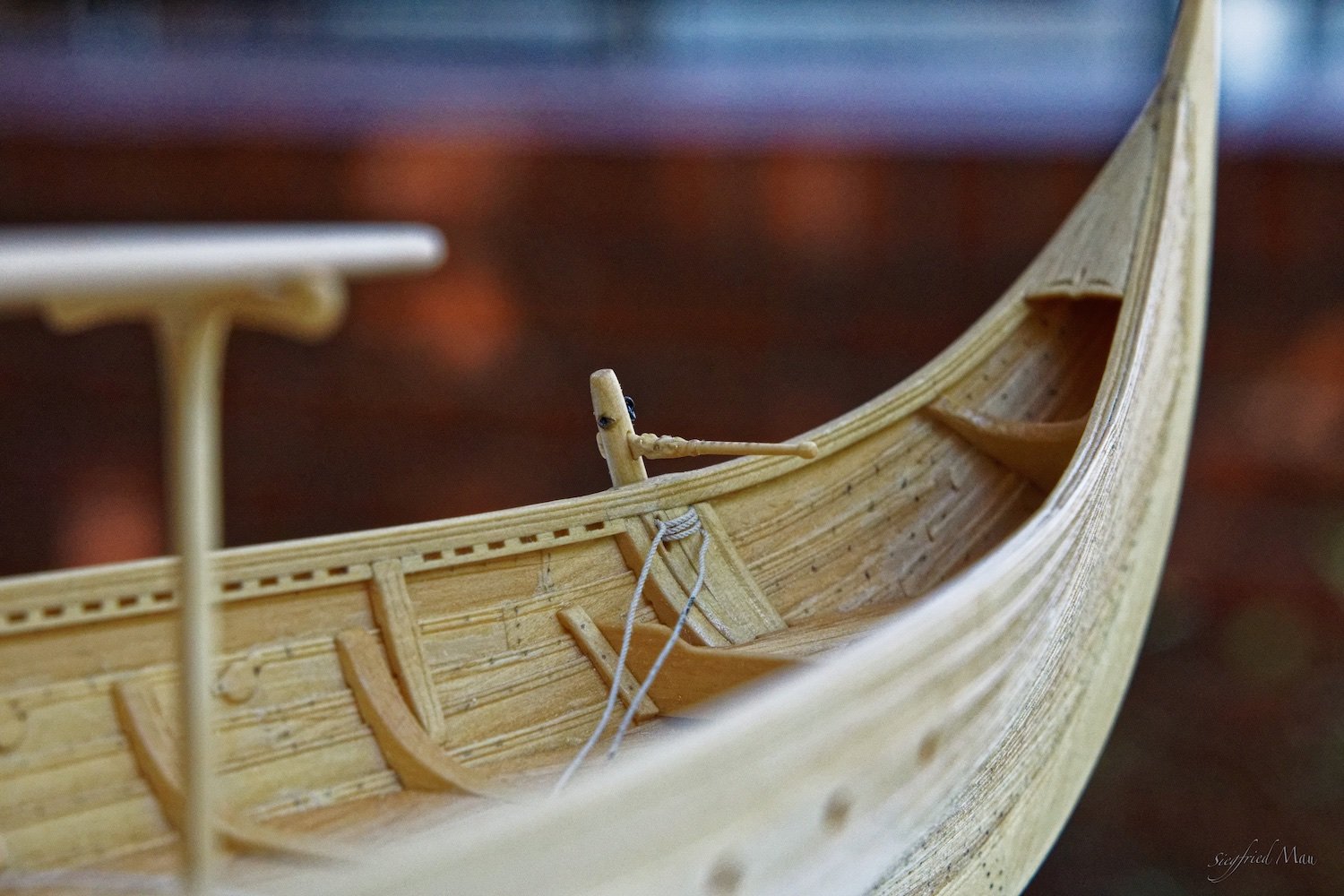

Hello and thanks for your comments and likes
today I build the tiller for the rudder. After turning most of the handle, I had to glue it to a peace of wood. My fingers are too thick to hold it. It's 21 mm long, and the handle after the head has 1 mm Ø.
I carved mostly with my small V cutter and my carving knife. Using also small files. And that is the result
This is a little faking, because the tiller is too short to go through the slot 😐 But you would't see it 😇
And now in action, but not fast

Hello,

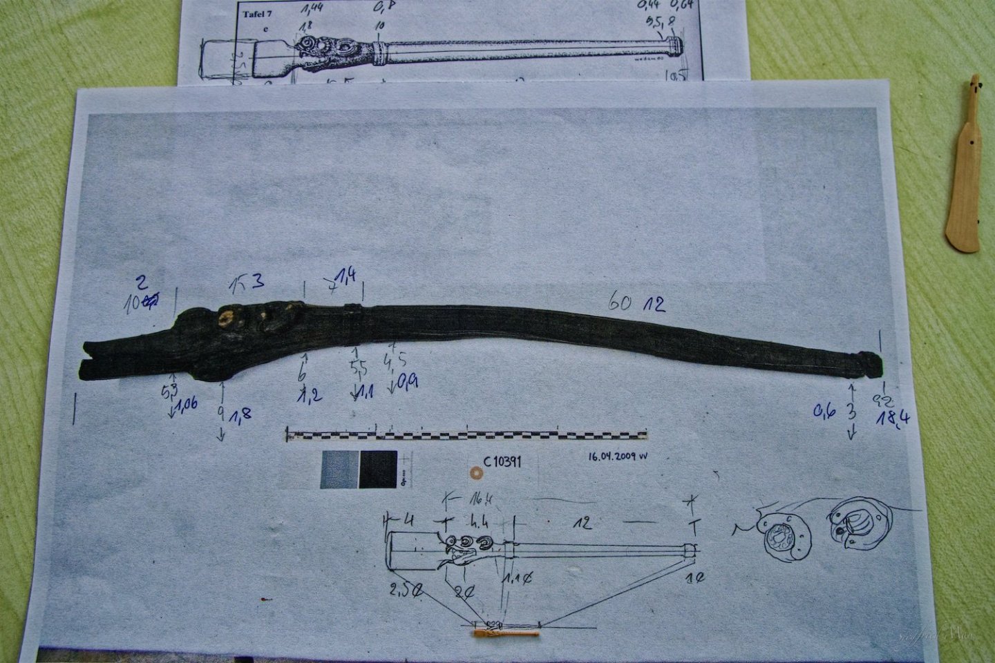

because I was not really happy with the tiller, I build today a new one.
At that picture you see on top the drawing Dammann did, with a too short plug. The black thing in the middle is the original tiller, or what is left of it, and my calculations for 1:10. Below that in 1:50 and the new tiller.
And here is he installed. I think it looks much better

I found the photo of what remains of the original tiller enlightening.
It would no doubt have been made entirely from a small branch, probably selected with an organic curve, contributing to the ergonomics of it's use, and would compliment the ship.
I intuitively feel a straight member looks too 'stick' like in context.
After all, the steersman would have wrestled with it for long periods.
A decent scythe handle has such a curve for similar reasons.
Hello Shipman,
I think that the original tiller was centuries ago strait, and not curved as now. Otherwise the helmsman must have worked directly at the floor. It was made from ash. So as it is now at my model, the helmsman could work from his seachest, in a sitting position.

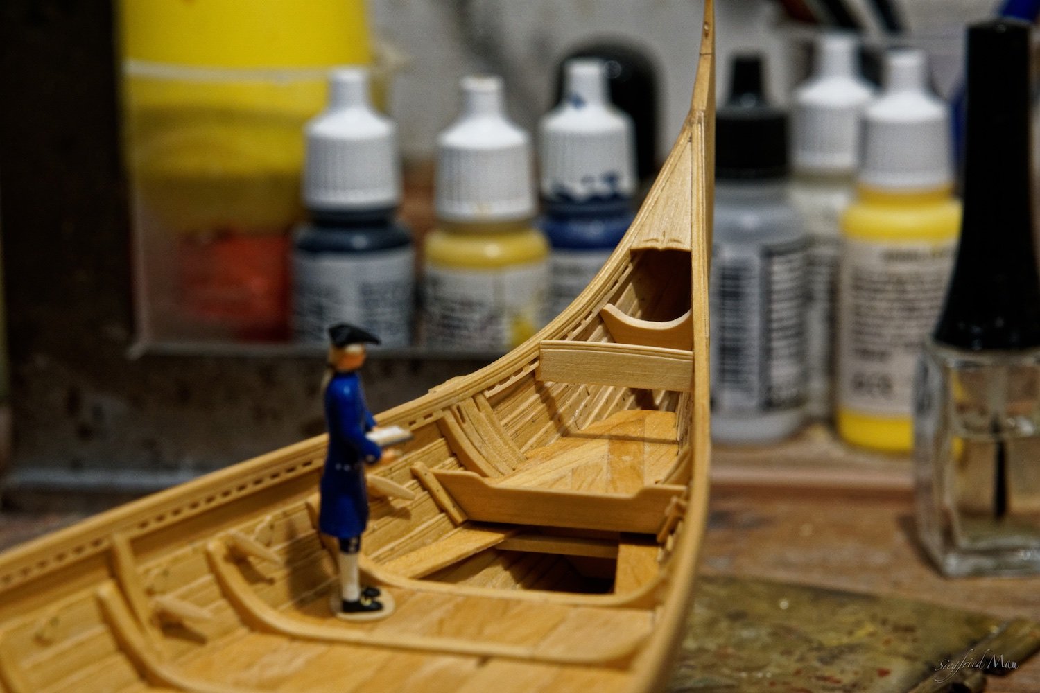

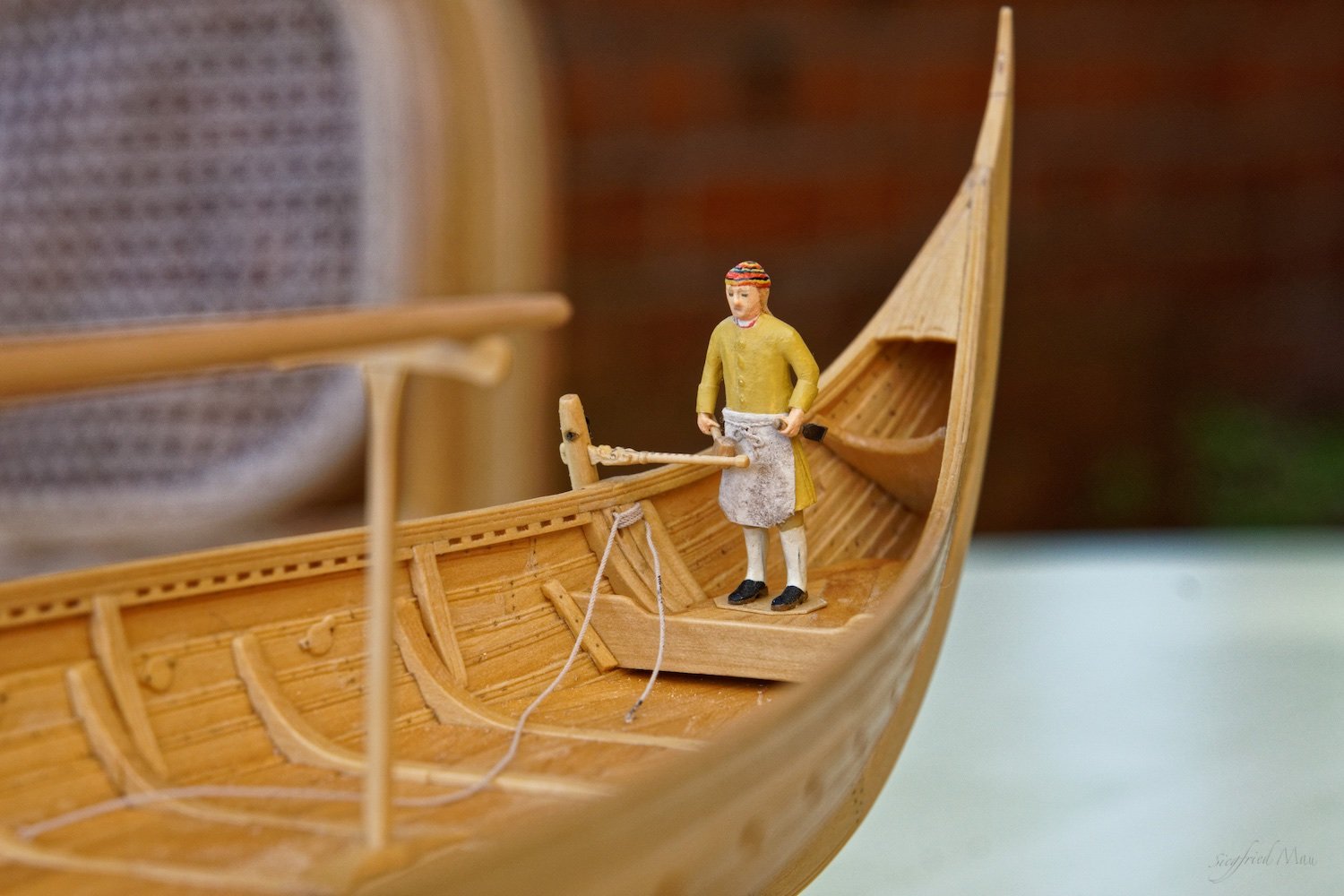

Hello and thank you for your comments and likes,
to show the high of the tiller in relation to the helmsman I made a picture with one of my carpenters. He is 1,70 m large, and the tiller is at 80 cm from the floor. And shipman, even at the original ship they have a strait tiller replica.
Hi Siggi.
We rely on the evidence of so few examples preserved. I would be interested to see other contemporary tillers, not replicas.
I feel my comments/observations above still have merit.
There must have been hundreds if not thousands of similar ships built without plans of any kind, only the intuitive skill, experience and imagination of each 'master' shipwright.
No two would have been the same.
Your excellent build continues to inspire me.
Hello shipman,
I think, you better discus this with the archeologists, scientist and reenactors with 1:1 replicas of viking ships. A tiller that goes down, is not really ergonomic in this case. I'm happy with this strait tiller.

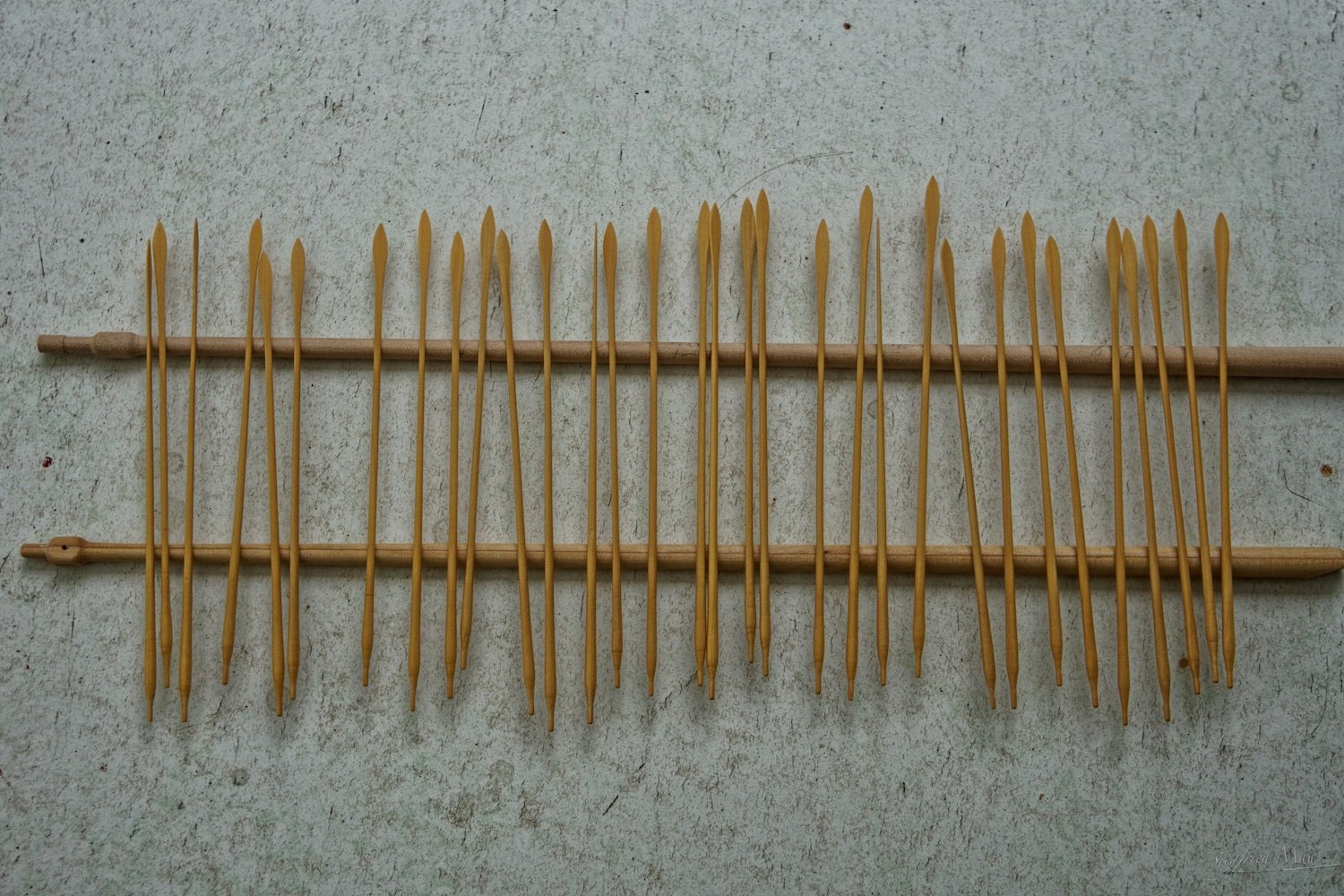

Hello,
today I started building the oars. First I saw them 4X3 mm and then turned the handle at the lathe. The secnd step is, grinding the rest till nothing is left 😏 , see the one below
Then I saw out the outlines and shape the rest with files and sandpaper. Now only 31 are left.

Hello,
it is done! All 32 oars are ready. Only 6 pairs, the shortest, have the same lengs. From 5,30 m up to 5,85 m have all other pairs a different lengs. The longest pairs are for the stem and stern, there the oaremen sit at the highest places.

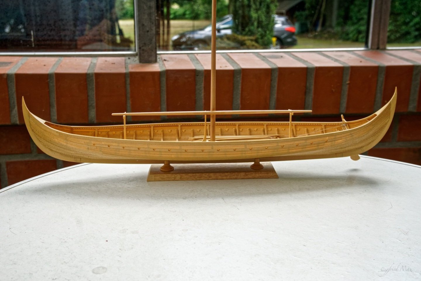

because here is no summer anymore, (last week we had 36°C, now 16-20°C) I'm busy at the shipyard. After I found new pictures of the Gokstad ship, I had to change somethings.
That means to tear off again. These rails are also on starboard, and Dammann wrote, there where none! The helmsman got also a backrest.
Today I build the suporters for the beitiass. That was a nightmare, but now it's done.
I'm ready with the ship so far and the rigging can begin.
