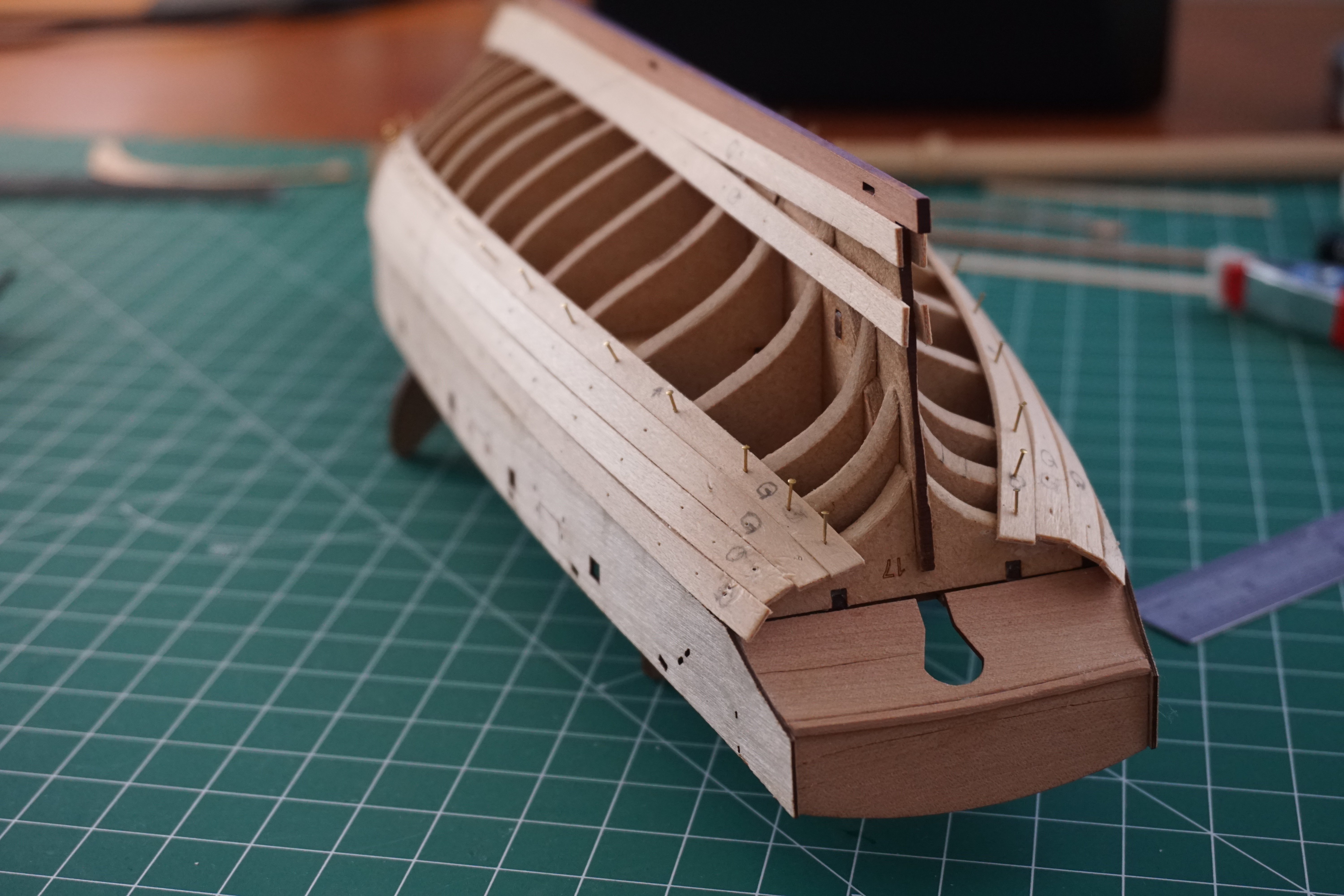

I tried installing the bulwarks straight from the sheet, but there were some cracking sounds and I felt that there just isn't enough give. So I soaked the parts in hot water for a couple of minutes and clipped them around a drinking glass for 24 hours.
image.thumb.jpeg.7418370b0636f0ea31f88ff8950f2438.jpegimage.thumb.jpeg.e3b46f9909d302a76ecac12565226a52.jpeg
I'm currently dry fitting them in place, but the bulwark tabs do not exactly fit the engraved lines. The manual said that some variation due to sanding is fine, but is this too much? There's about 1.5 millimeter difference in the bow, while the stern is perfect. It's the same in the other bulwark.
Edited by Nightdive
Your model looks GREAT! You are definitely being very meticulous. I’m also building Vanguard’s HM Sherbourne as a first time builder. I’m about where you are, with many misadventures. Some of which I’ve corrected. Some will have to remain. I broke the bottom of the port side inner transom, so that and the inner counter will probably get filled and painted. Starting the second try at the first planking. BTW, on my second attempt to install the bulwarks I was able to line up the laser  marks with the bulkhead extensions much better. I test fixed multiple times and scoured YouTube for videos. There are several if you’re interested. I’m beginning to understand that I need to slow down and make sure I understand the step completely.
For what it's worth, I think you're probably ok, but I'm a beginner.  But having dry-fitted the bulwark ply sections in my messed-up build of the hull, I could at least see the issue.  I'd suggest:
Wait for someone knowledgeable to comment.
Check out the YouTube series by a guy with a moniker ModelKitStuff; he may comment on this.
If you're able, dry-fit the outer bulwark sections to see if they line up.
If they do, check the match from one side to the other.  I'm thinking that any particular reference point, e.g. gunport edges, should line up with the same reference point on the other side at 90 degrees to the centreline.  One way to do this might be the reference point's distance from a bulkhead ear; is it the same port/starboard?
Hope these thoughts help.
Nick

I did pretty much this, and concluded that it's probably fine as long as the gun ports and other features are identically located on both sides. There was also only about 1 mm of extra bulwark on both sides of the stern, so I can't be too far off. Doing any extra sanding wouldn't have fixed anything, only moved the point where the bulwarks didn't match the etched lines, and made the hull shorter.

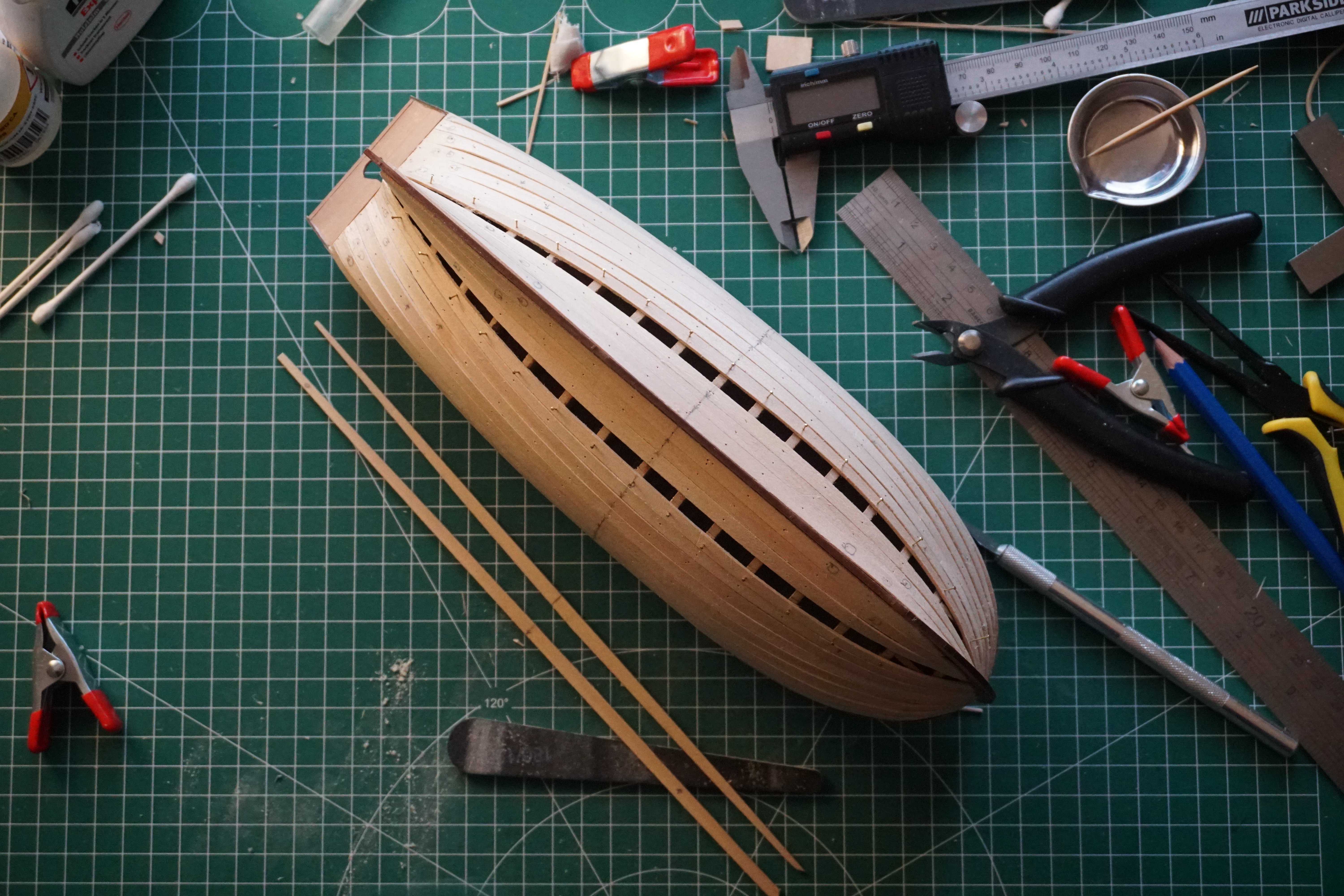

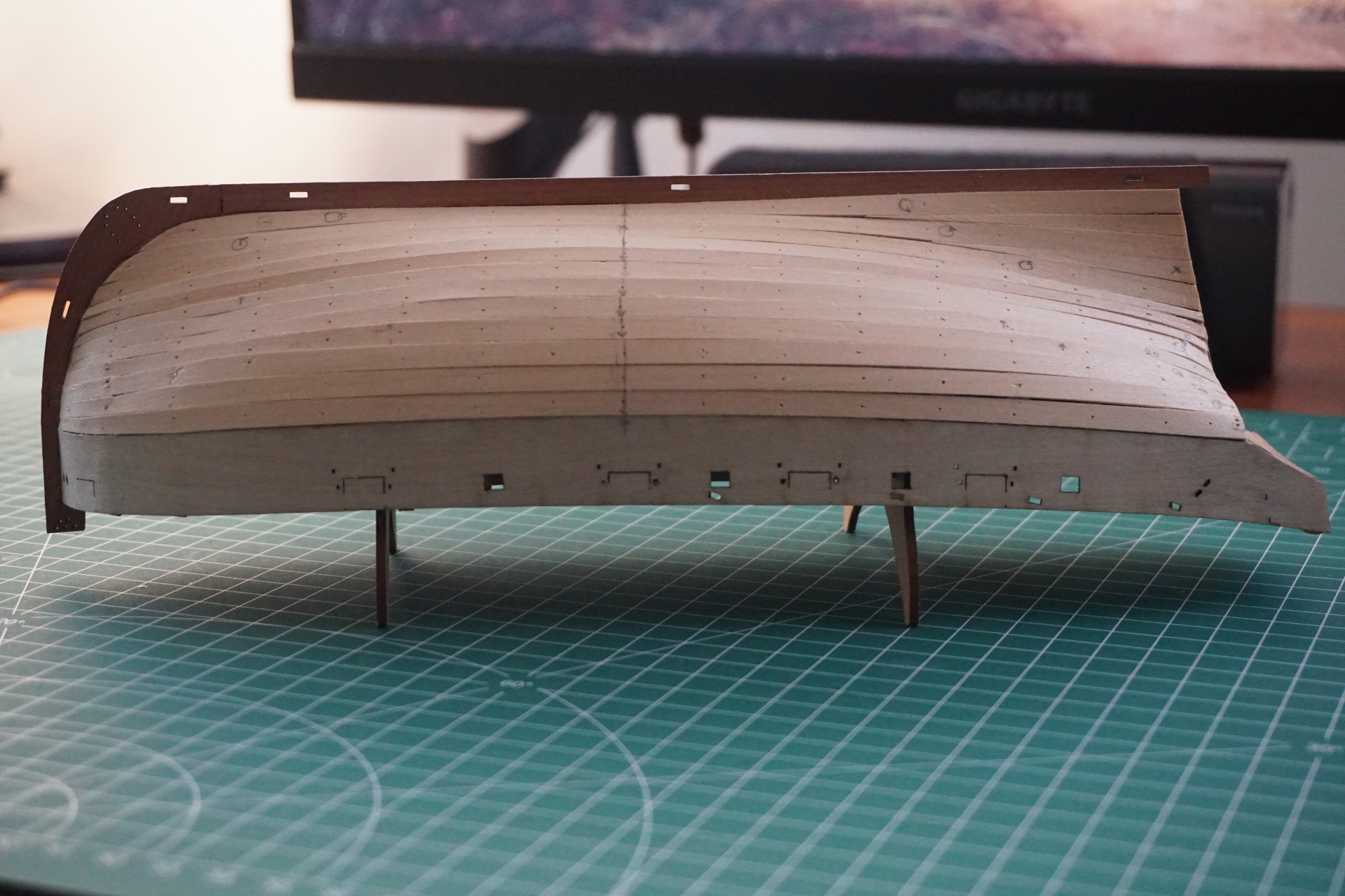

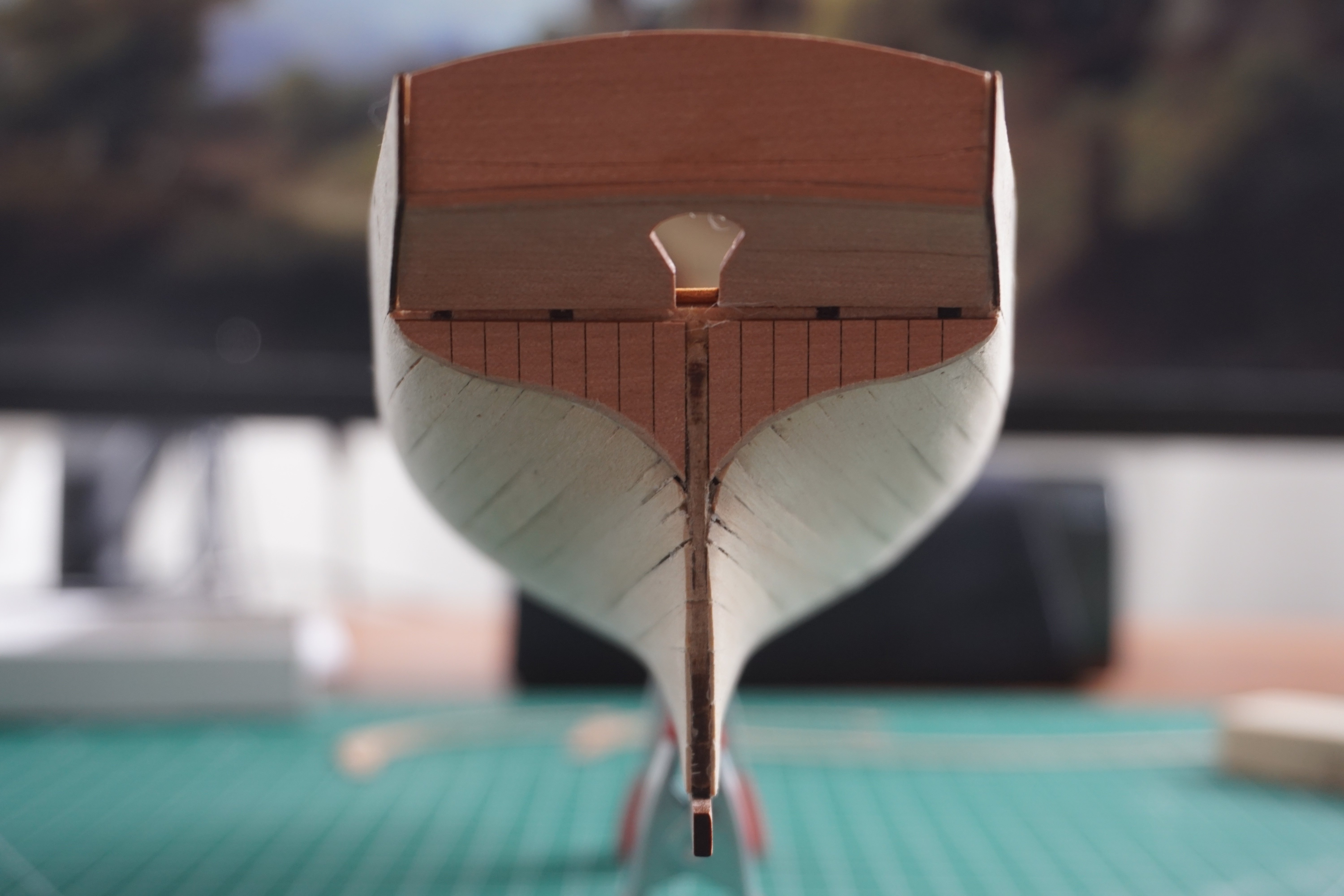

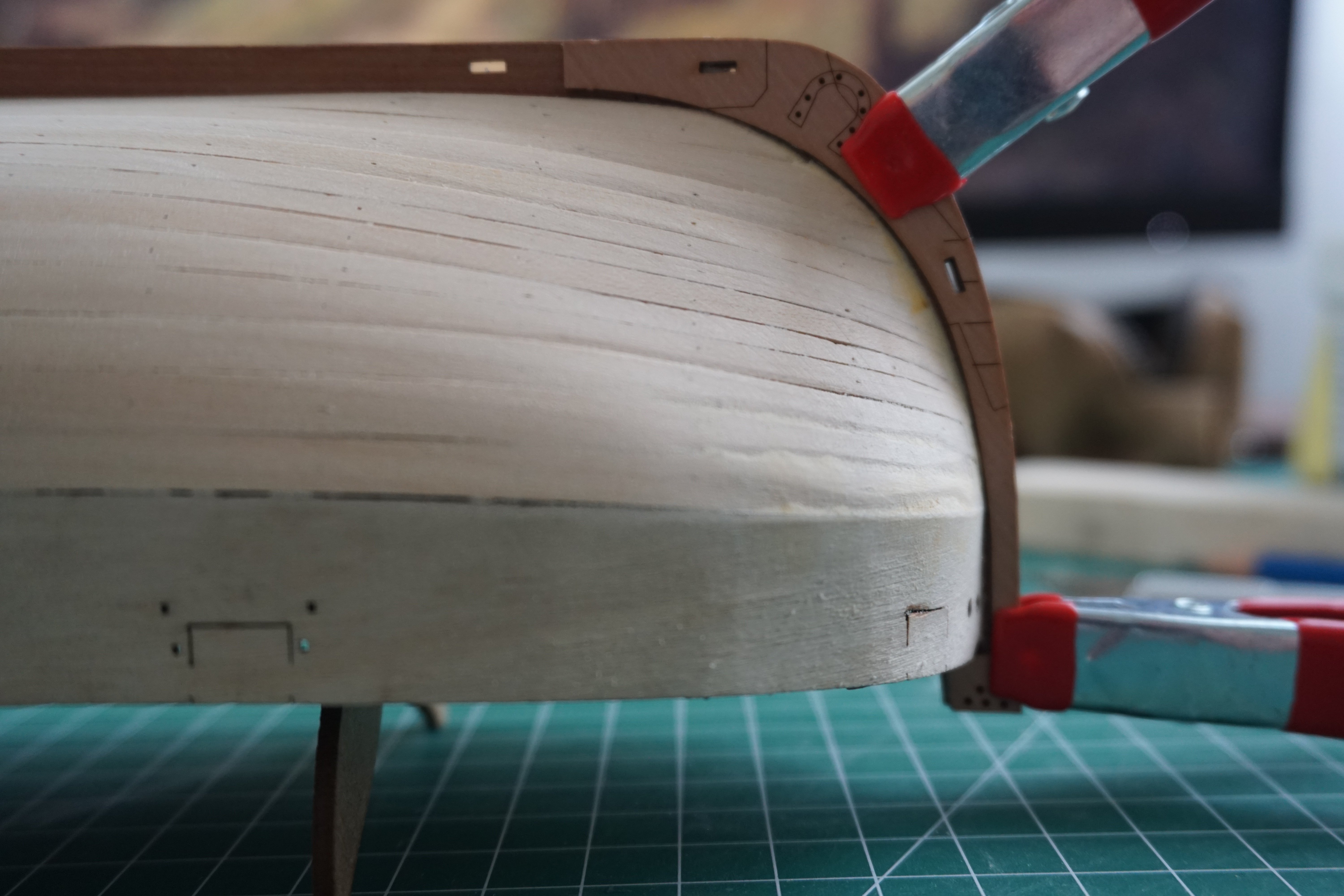

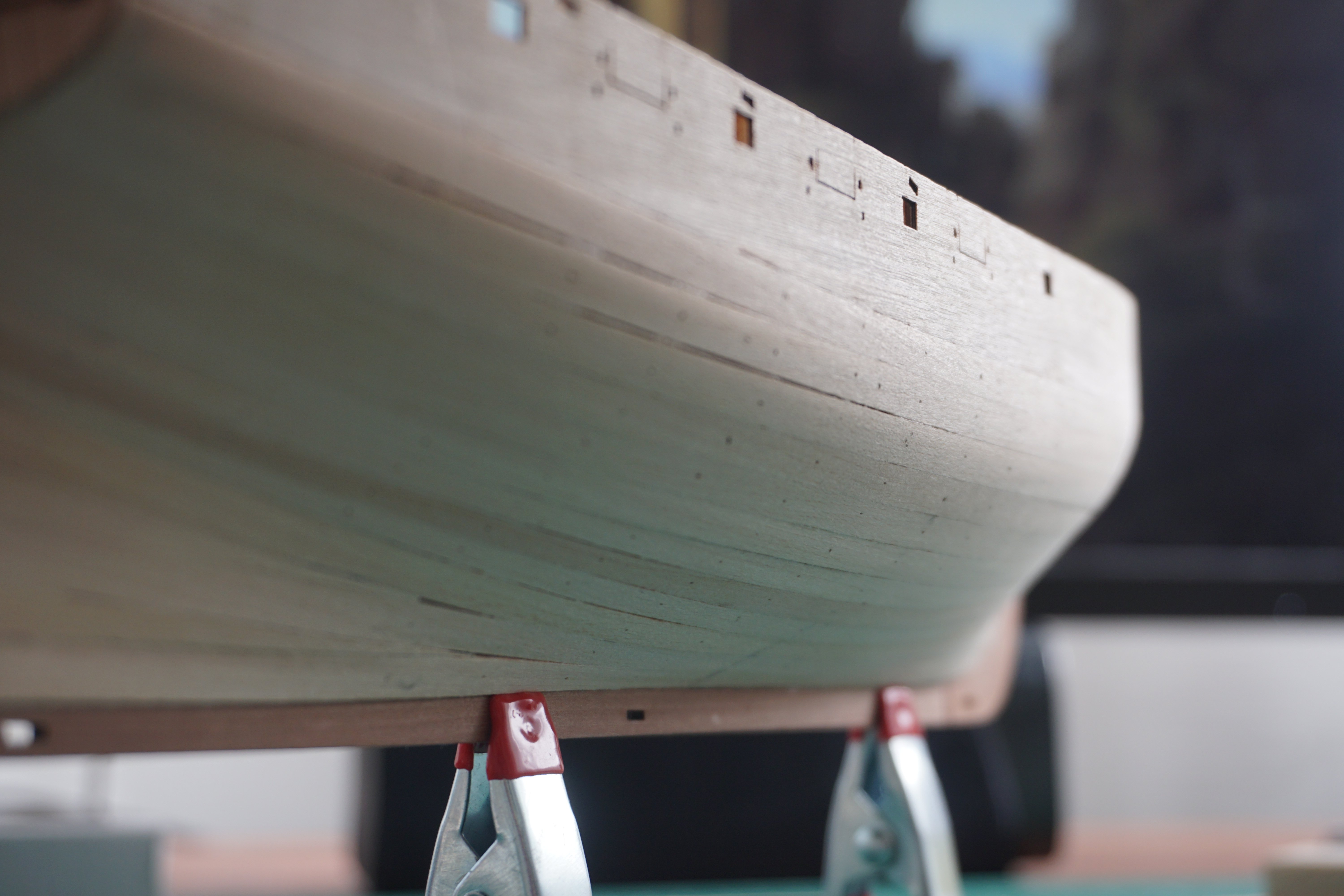

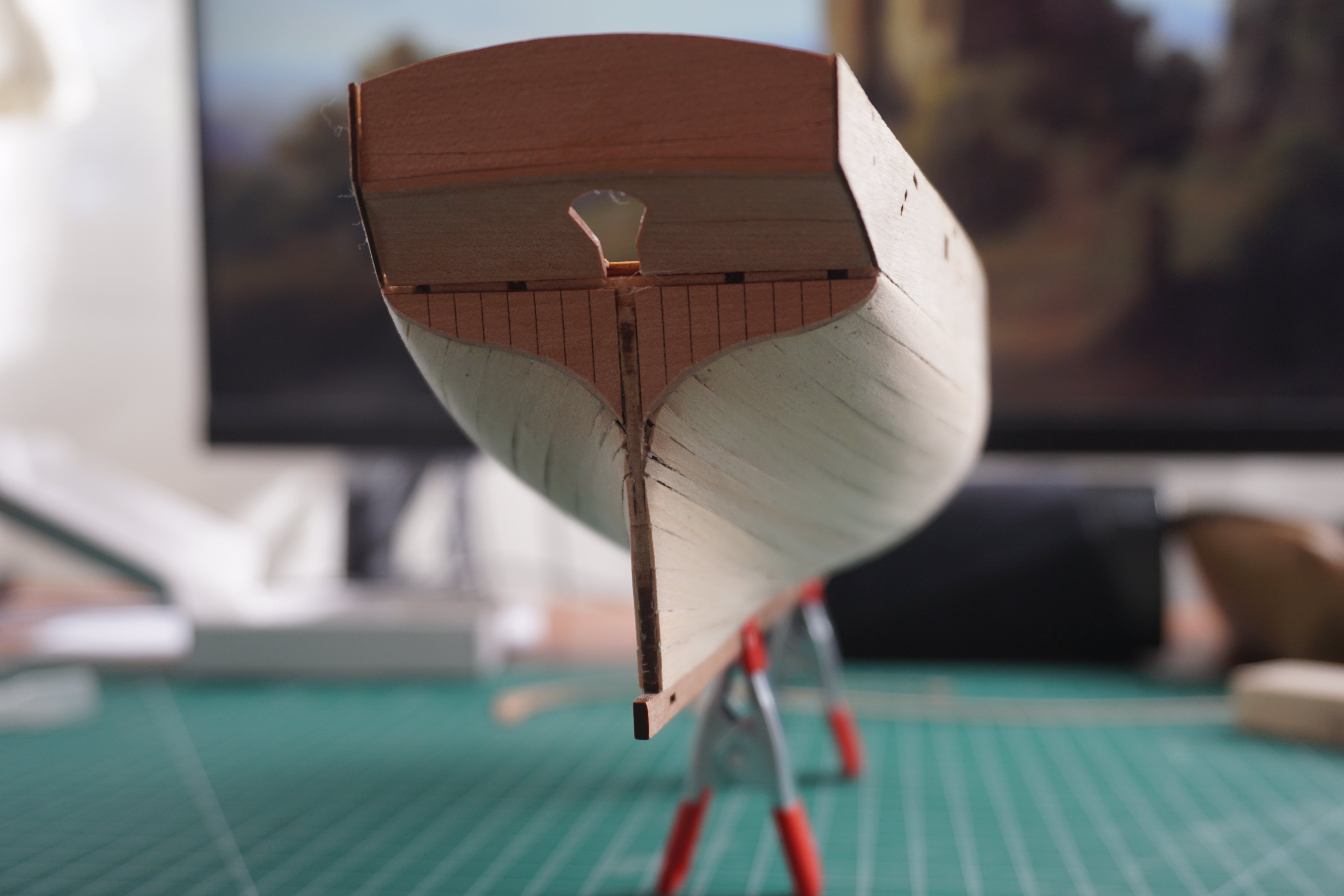

Hello everyone, I'm back after a break from modeling for other projects. To be honest, I also kept procrastinating this step, as I knew that planking would be a challenge.
I'm twelve planks in and it seems to be going fairly well so far. I've roughly followed the planking method that Jase presented in his Sherbourne video series; starting from the centre, marking the spot where the plank starts to overlap the previous one, then beveling the plank from that point onward. Chuck Passaro's planking videos and GlennUK's very detailed Sherbourne build log have also been very helpful.
image.thumb.jpeg.cfd64c2f7df4a95d1aecdd8ac1ea756e.jpegDSC06302.thumb.JPG.f31727d8c4ba74896645d08d20304c2c.JPG
image.thumb.jpeg.7f67a96c52b1c92ecd5c64f204795f41.jpegimage.thumb.jpeg.2d1f95f9aa7fc00abde774de94ad418f.jpegimage.thumb.jpeg.74378321620dc6a46add9ca7f6c3cc2d.jpeg
I've beveled the first two planks by 2.5 mm and the next two by 2.0 mm. Everything has been glued with PVA with CA only for the last bulkhead (no. 17).
There is more clinker effect in the bow than I had hoped for. I need to step up my edge-bending game for the second planking.
Edited by Nightdive
Really good work so far, your planking is very good and will be nice foundation for the second planking.
Andrew

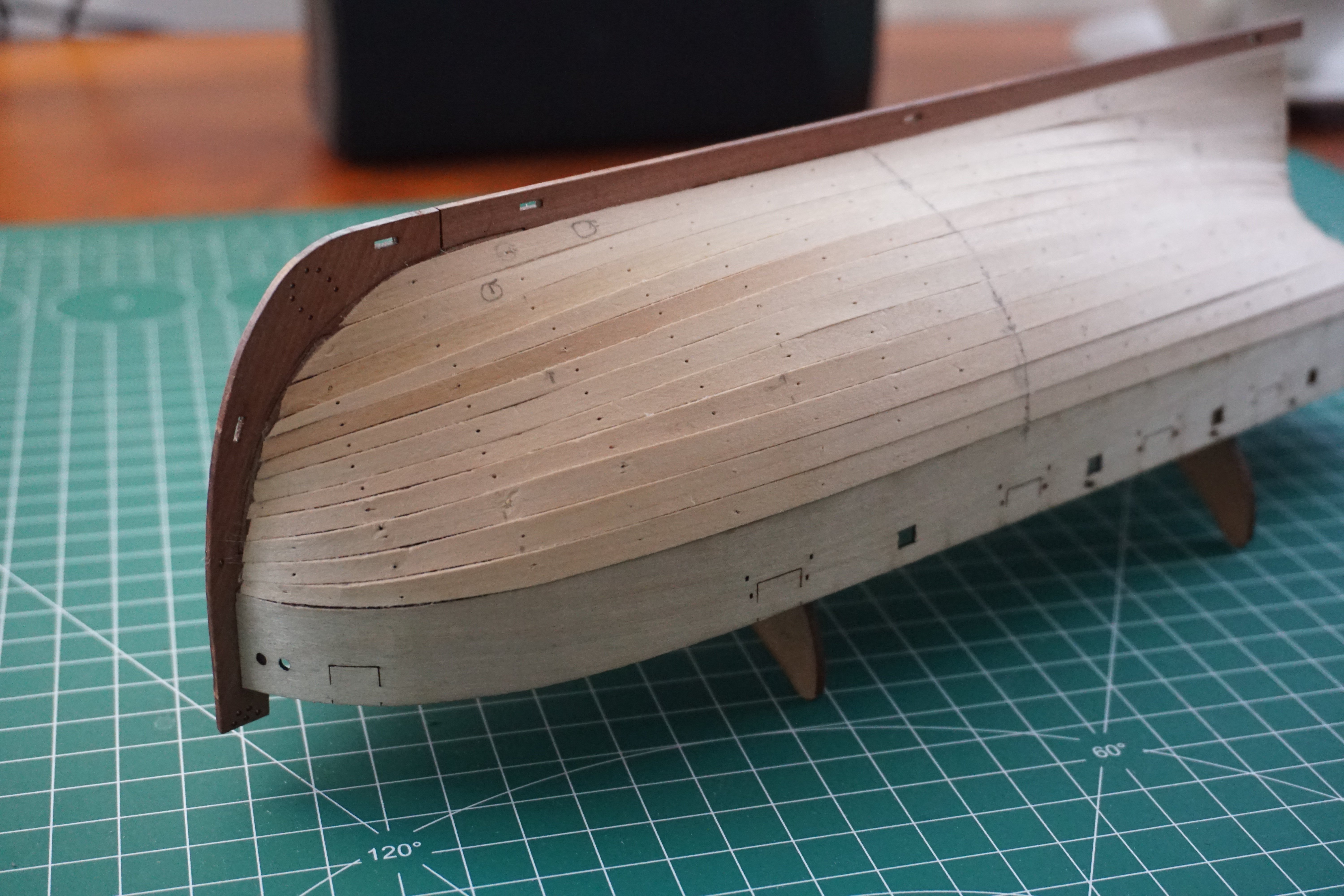

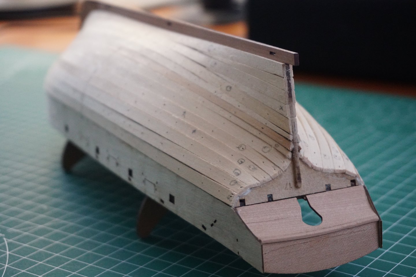

DSC06454.thumb.JPG.ca96a9e05cc8c4411990e5608baebb23.JPGDSC06463.thumb.JPG.fda5daf2af9c3a7d7a6b6bbf487f132e.JPG
DSC06456.thumb.JPG.f8c7f9a47885c7fca9ec0fbe0acc6230.JPGDSC06466.thumb.JPG.5a76103ed482961e7a8ec39855dea284.JPG
Sanded with 180 grit paper. I also used a little bit of filler at the bow to ensure a snug fit for the second layer of planks.

The clinkers happen when the planks at the stem have not been tapered enough and are pulled towards the keel to fit.  It’s ok.
Look into using small files to shape wood.  Get round, half round and flat.  More precise than sanding, and faster.  Fill in the clinker gaps with sandable wood glue and shape the hull with the files.
Paint.  Sealing the wood is a must.  Shellac works well and dries fast.  Make up some board samples, try one coat of shellac, then paint.  Two coats shellac then paint.  The shellac coats slowly fill in the grain.
Yes, the thin airbrush coats show the grain nicely.
You are doing good work.  Keep going.
In the end hull imperfections are practically unnoticeable when the ship is mounted or on the stand.  Remember if it looks good from a foot away it’s ok.
