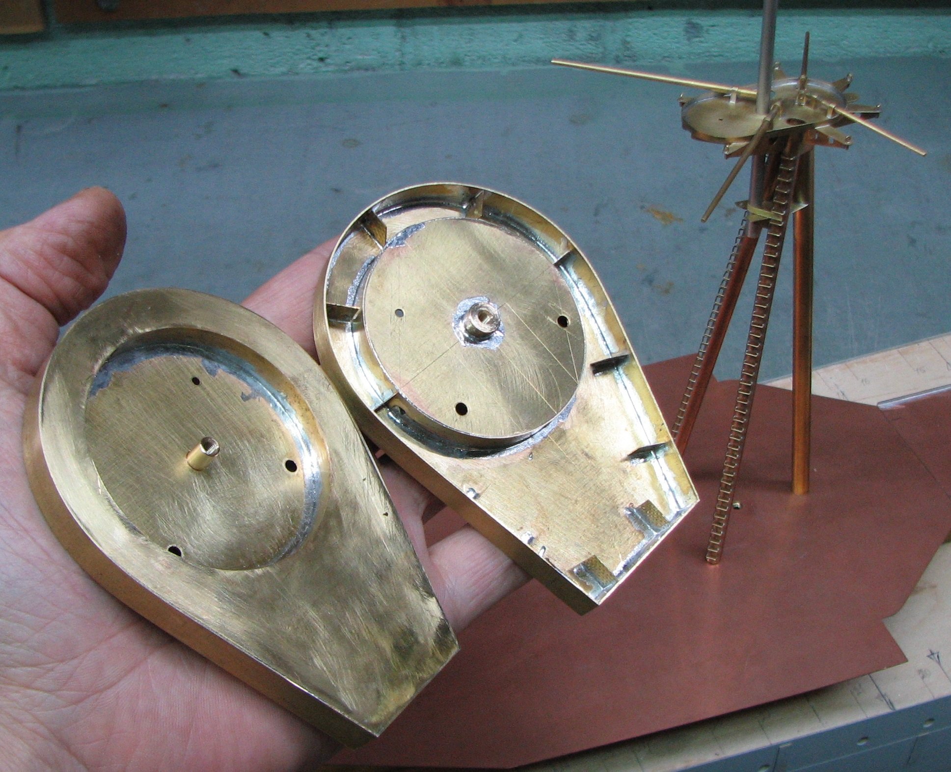

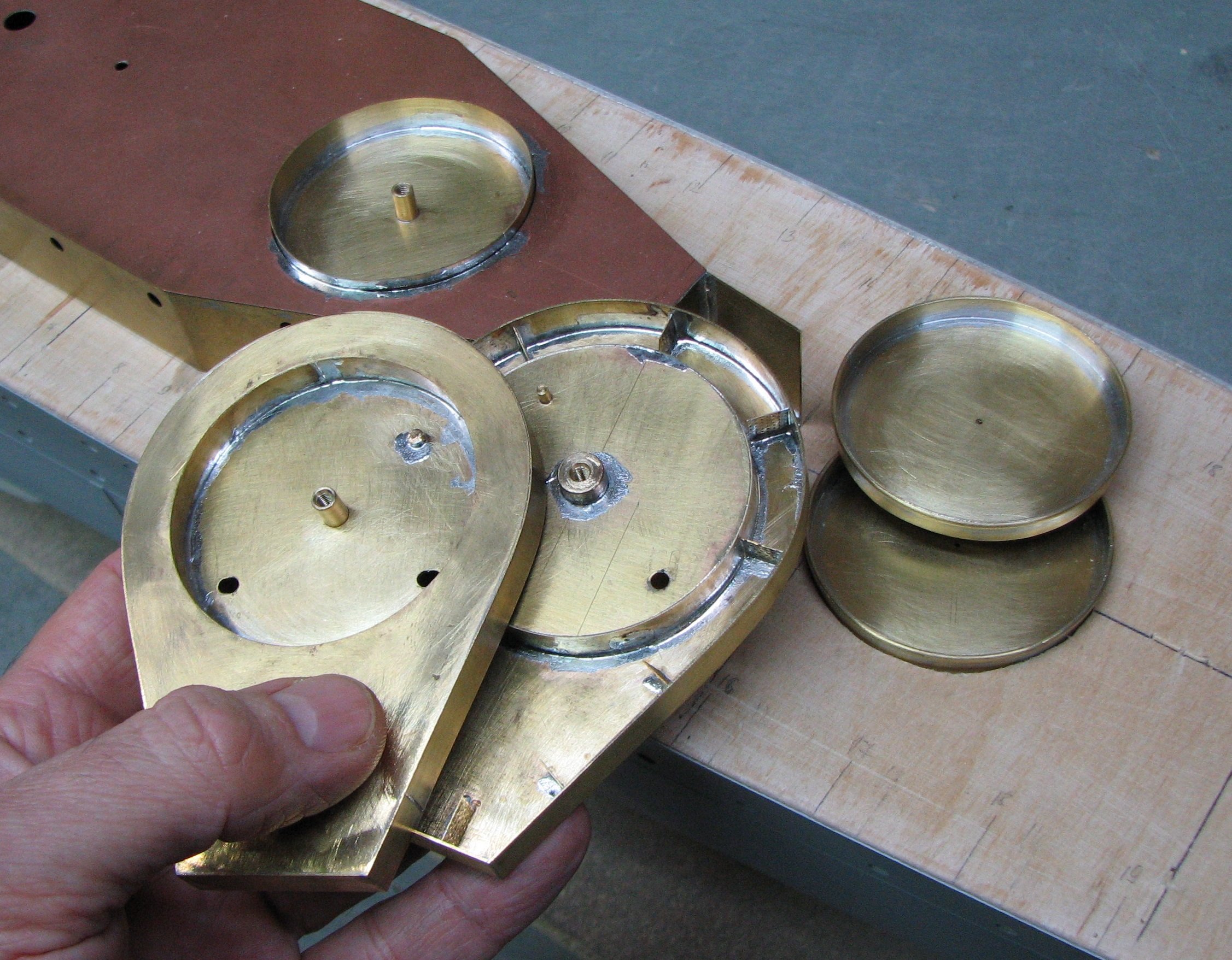

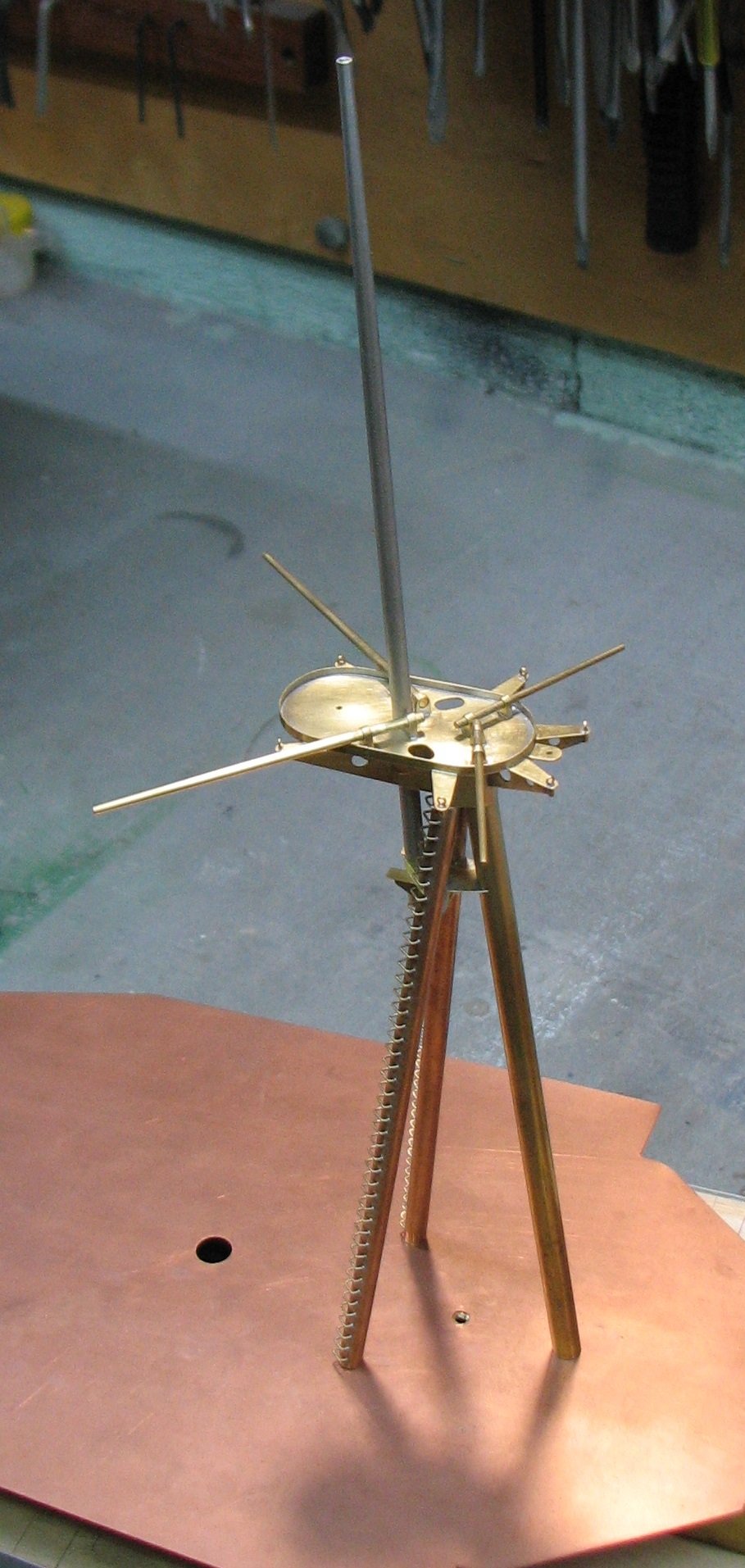

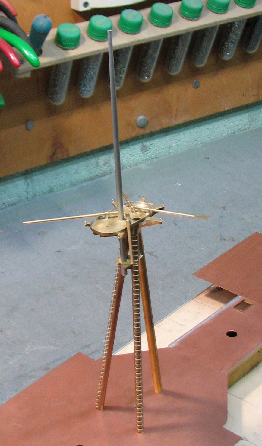

I like the all metal construction too. You have access to the inside surfaces and joints, and that lets you get a good strong solder joint. You can leave a bead of solder on the inside of the joint because it won't be visible from the outside.
Another problem has sometimes happened to me when I used a motor tool rotary wire brush to remove excess solder from the outside (visible) joints. I want to get clean sharp joints, but if I remove too much solder the joint is weakened and breaks easily. Leaving the solder bead on the inside keeps the joint strong.
Plexiglas (acrylic) probably wouldn't be a good choice if you are sheathing the core with soldered brass parts. Plexiglas melts easily, and who knows where it will flow. It could mess up the surfaces the brass should fit against.

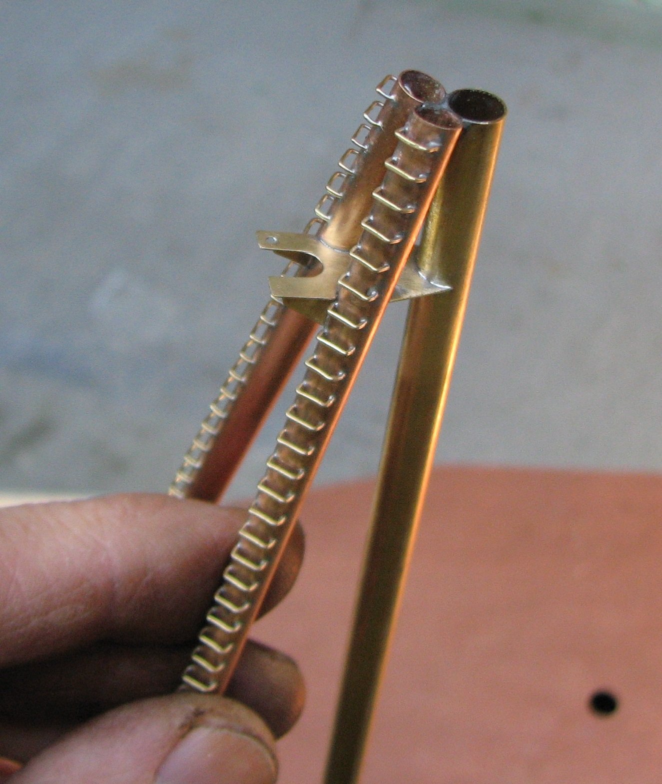

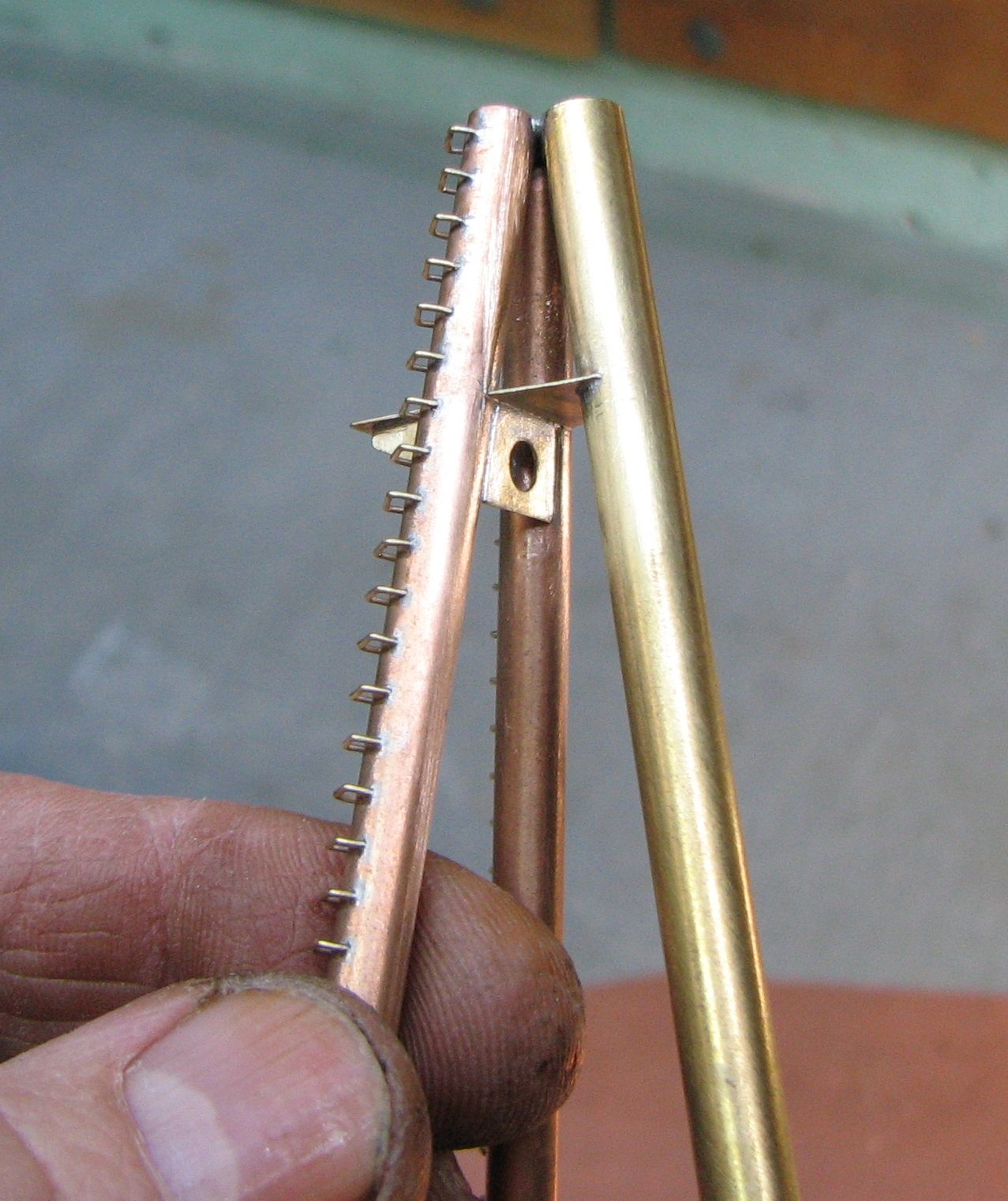

Today I'll share a method for making a semicircular brass profile. Perhaps this will be useful for someone building models.
The simplest way to create a semicircle is with a jewelry die. However, when the wire diameter increases beyond 1.5 mm, significant physical force or a special drawing mechanism is required.
I decided to make my life a little easier and made this drum.

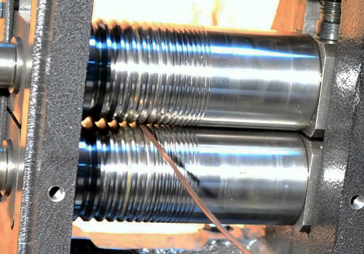

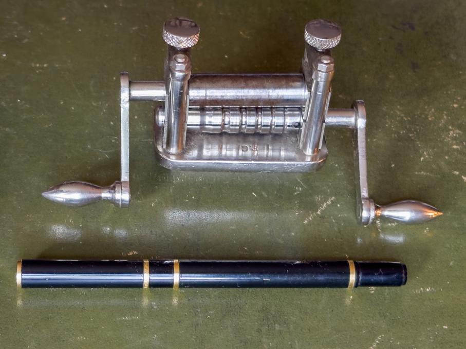

And yes, by repeating the process on four sides, one could probably produce miniature square and rectangular profiles from round wire - I recently purchased a small rolling mill for this, but these profiles would still have slightly rounded edges.
Edited by wefalck
Have to take some pictures ... it is actually a small rolling mill from the jewellery trade to enlarge rings. It needs to be modified still to drive both rollers for the purpose of rolling wire.

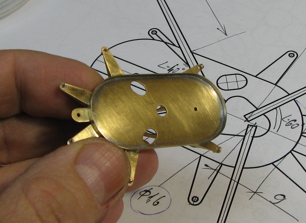

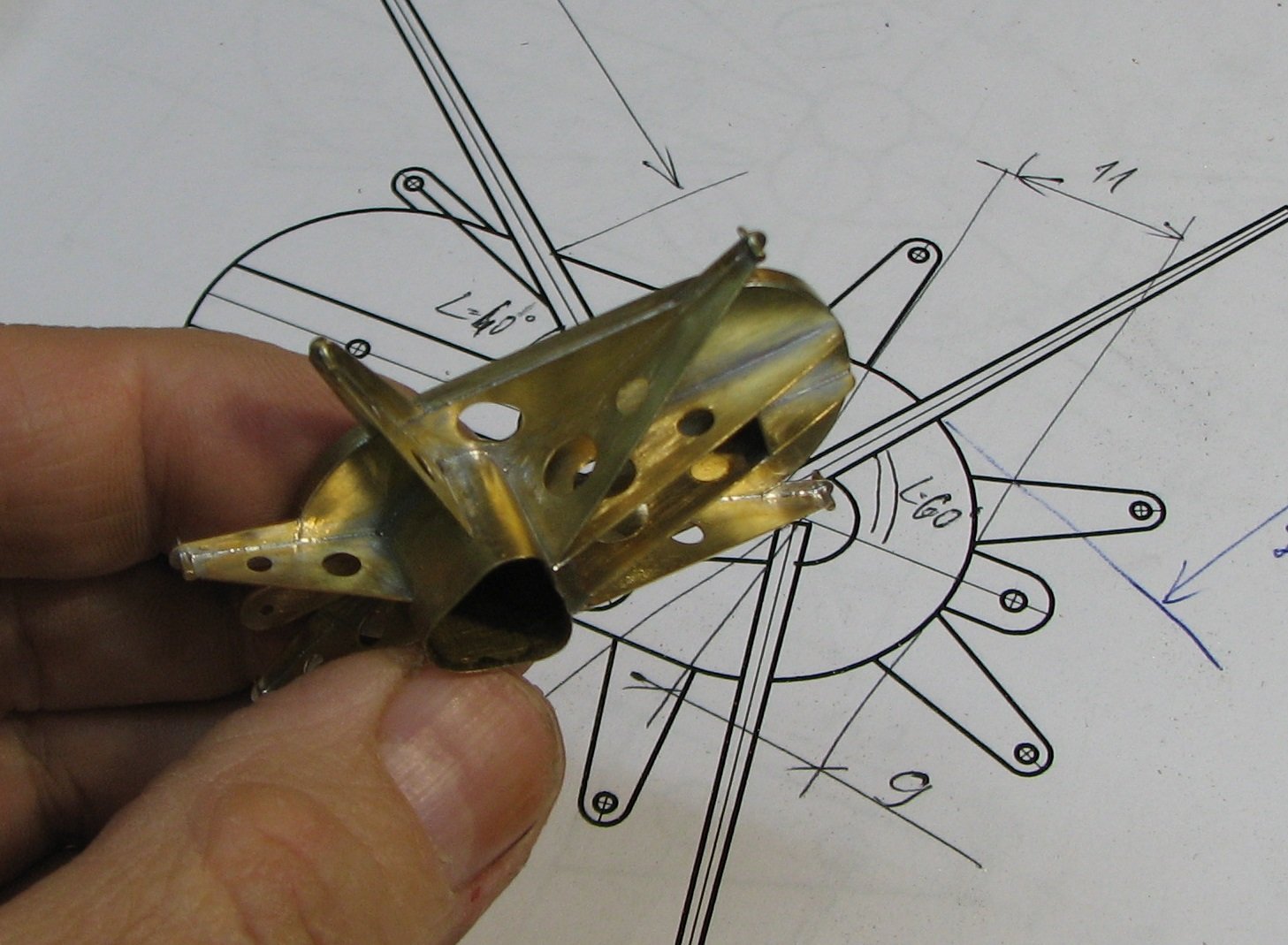

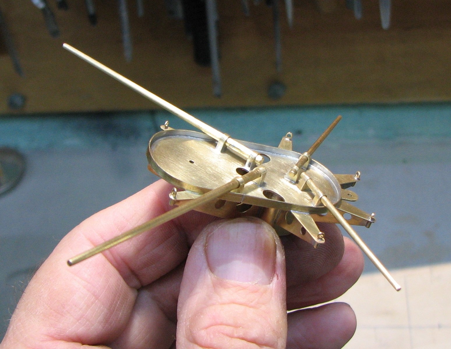

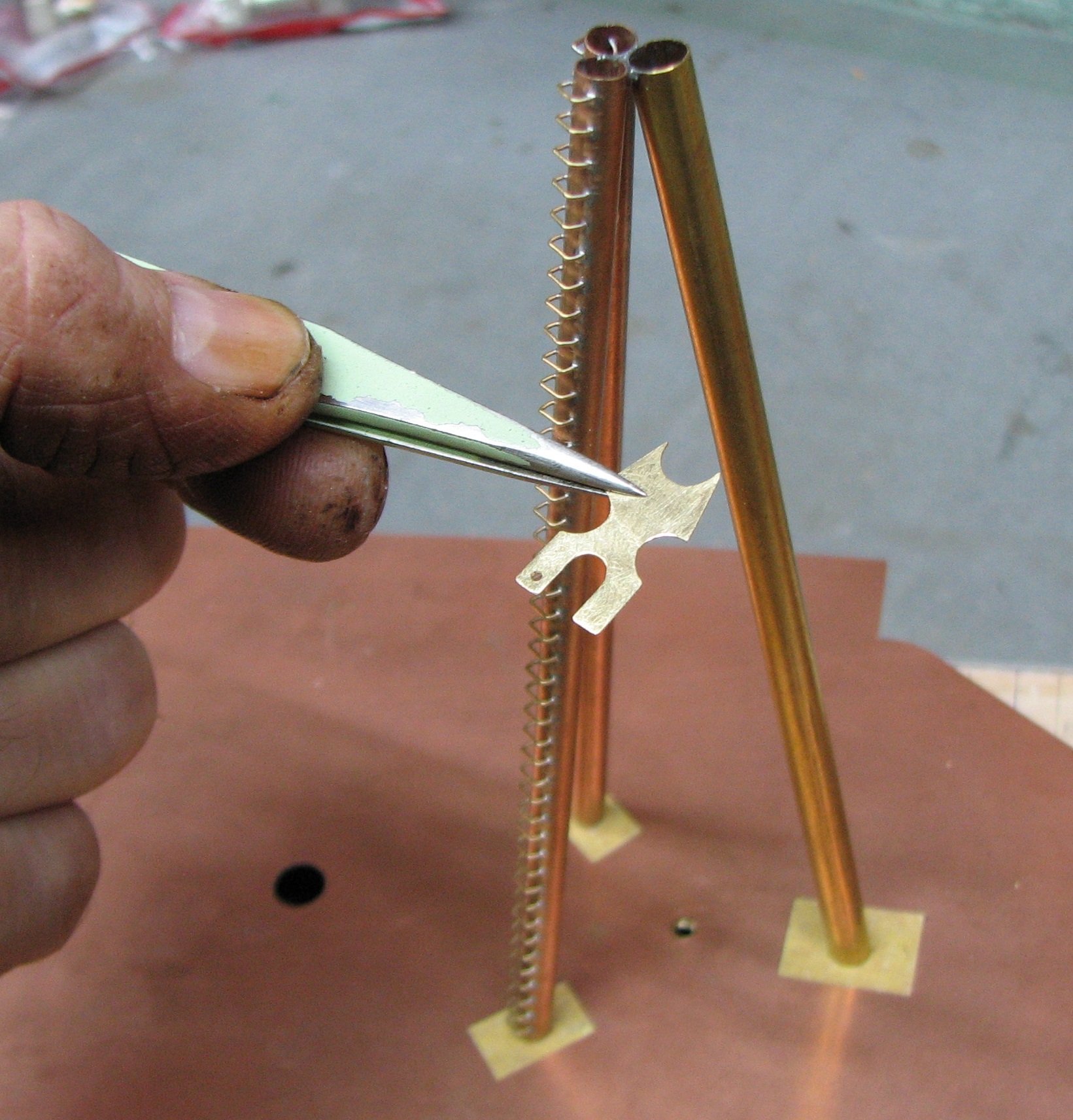

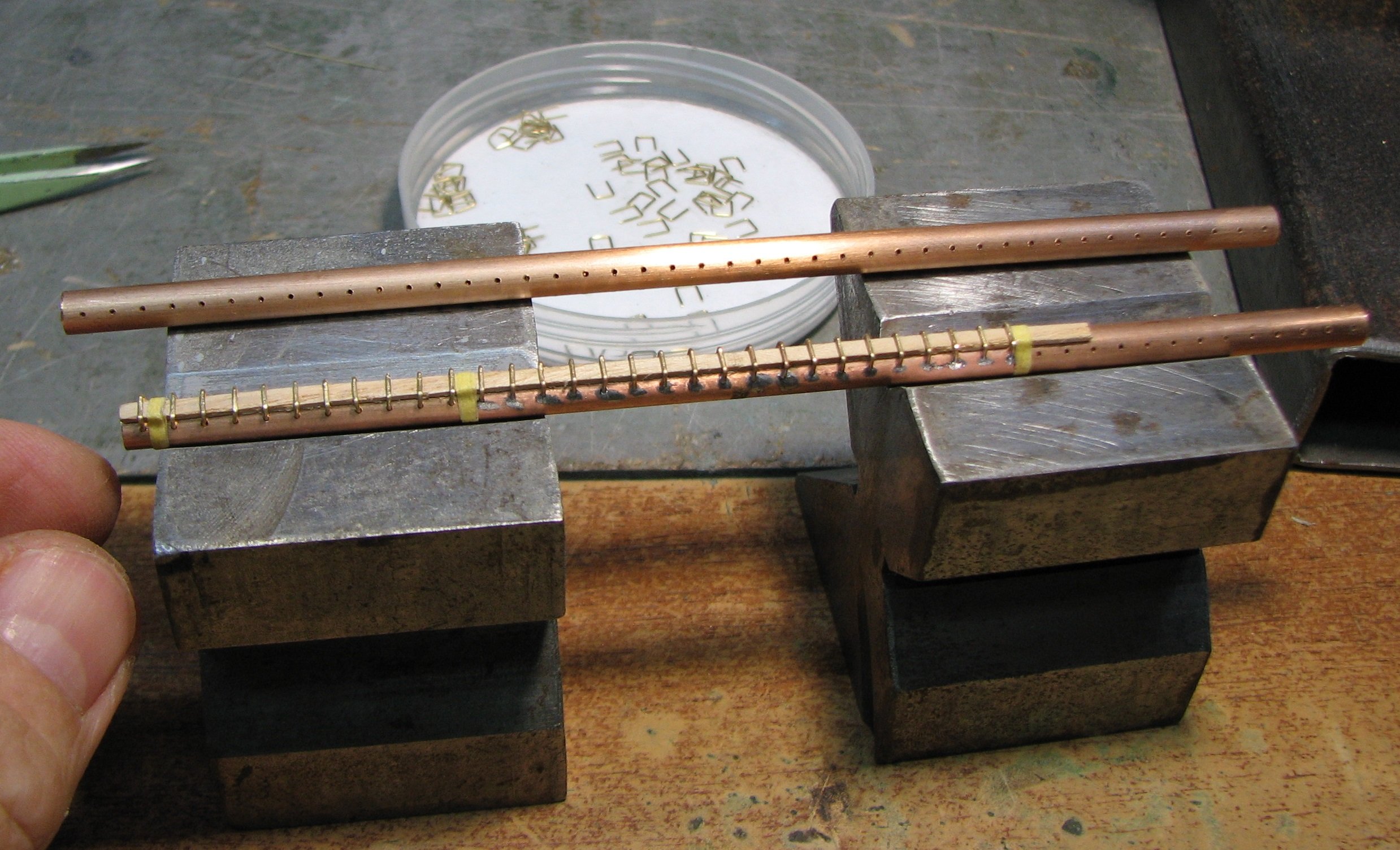

Precision is essential when drilling the holes; this is the most difficult step. This is achieved using a coordinate table on a drilling machine.
The brackets themselves are soldered sequentially, using the pre-drilled holes. And there's nothing complicated about that.
Finally got around to take a picture of the little rolling mill. As I said, it design purpose is to enlarge wedding-bands and the likes. For this different shaped grooves are cut into the rollers and there are several rollers with different groove geometries. As in this application the rollers would run at different speeds, two cranks are foreseen, allowing the move the ring forward and backward.
However, I plan to fit a couple of meshing gears, allowing the run the rollers synchronous from one crank as would be needed for rolling wire. This also frees one hand to feed the wire in.
Nice little rolling mill Eberhard.
