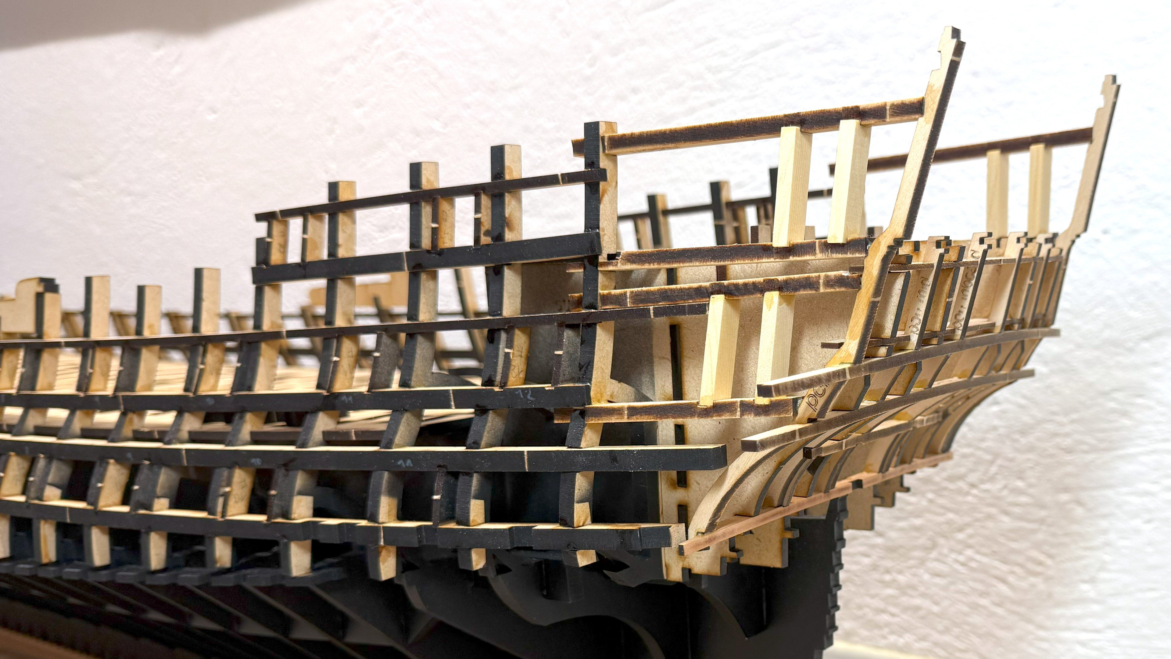

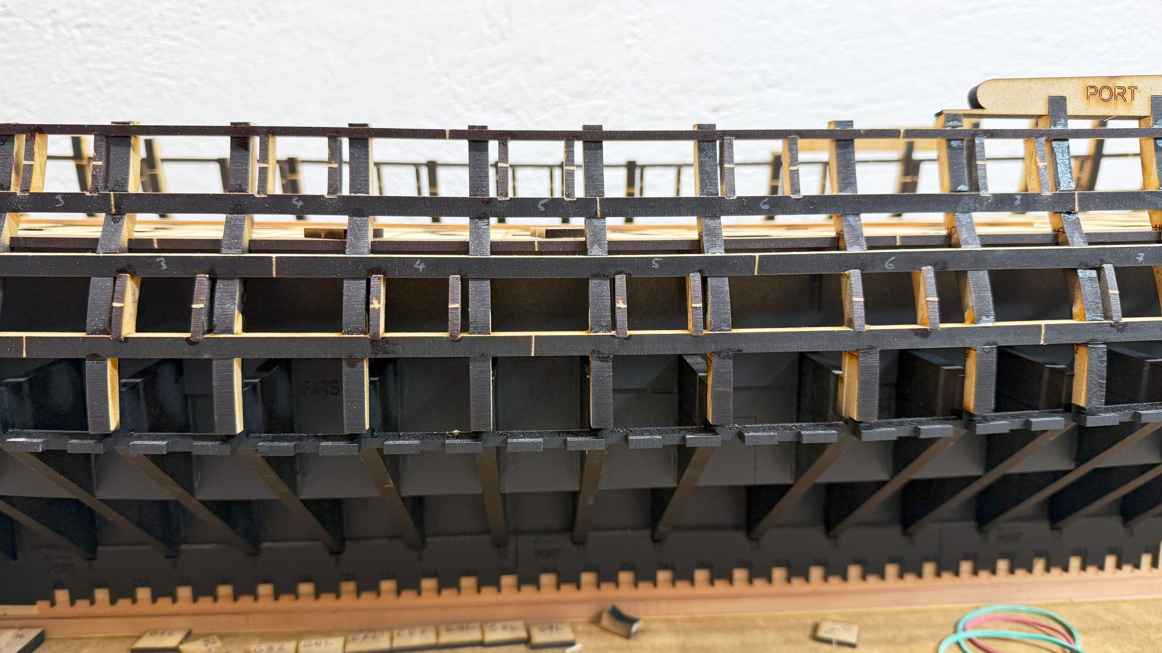

Hi guys, just a little update again because there was less time to build than I would have liked...

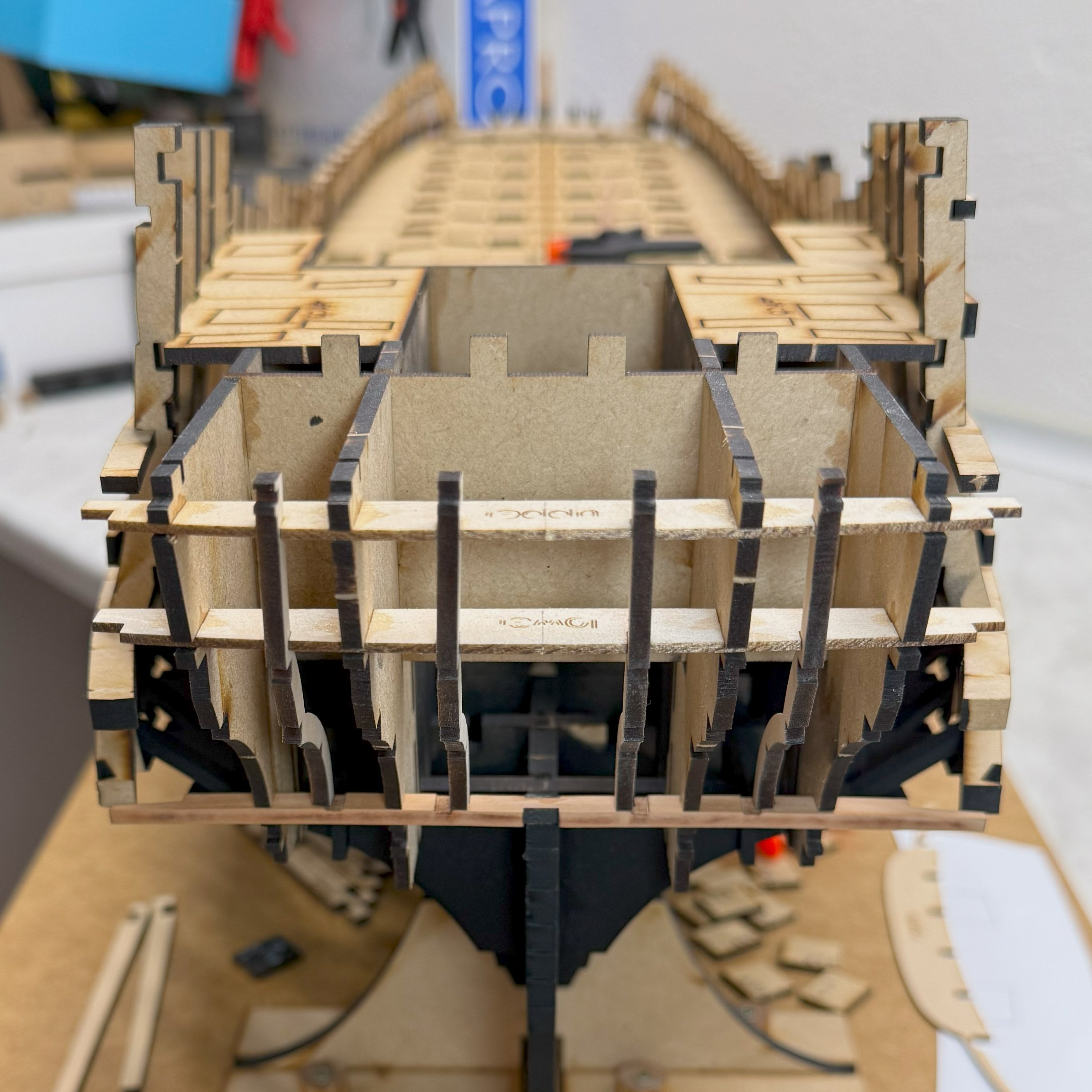

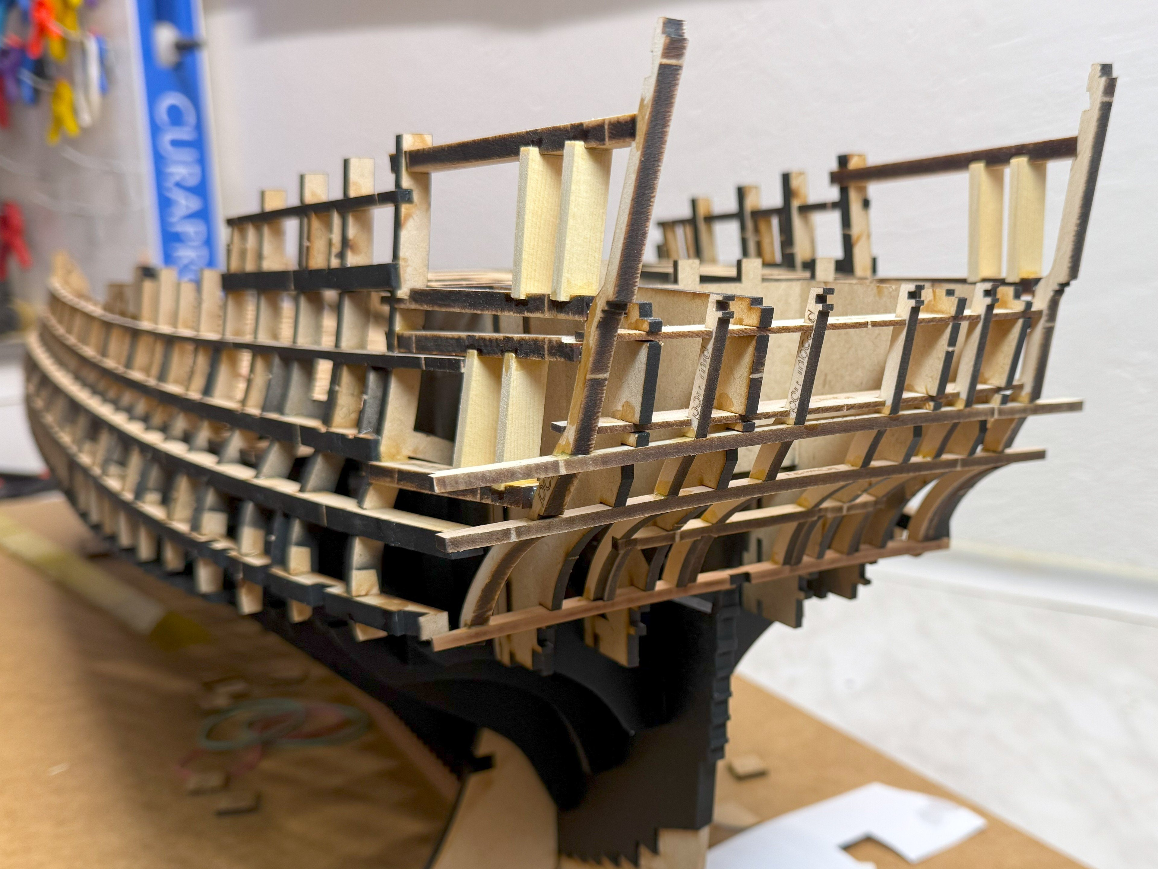

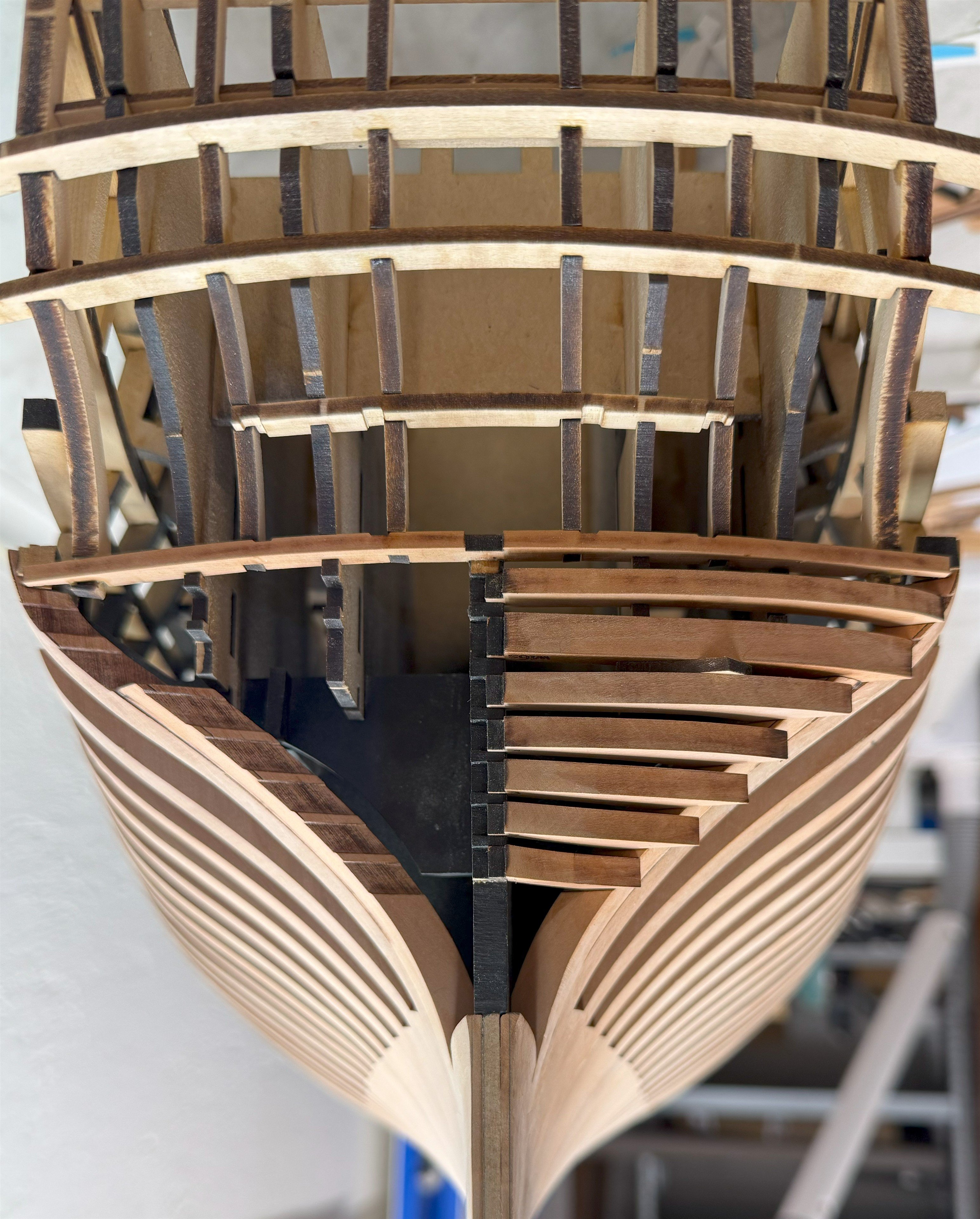

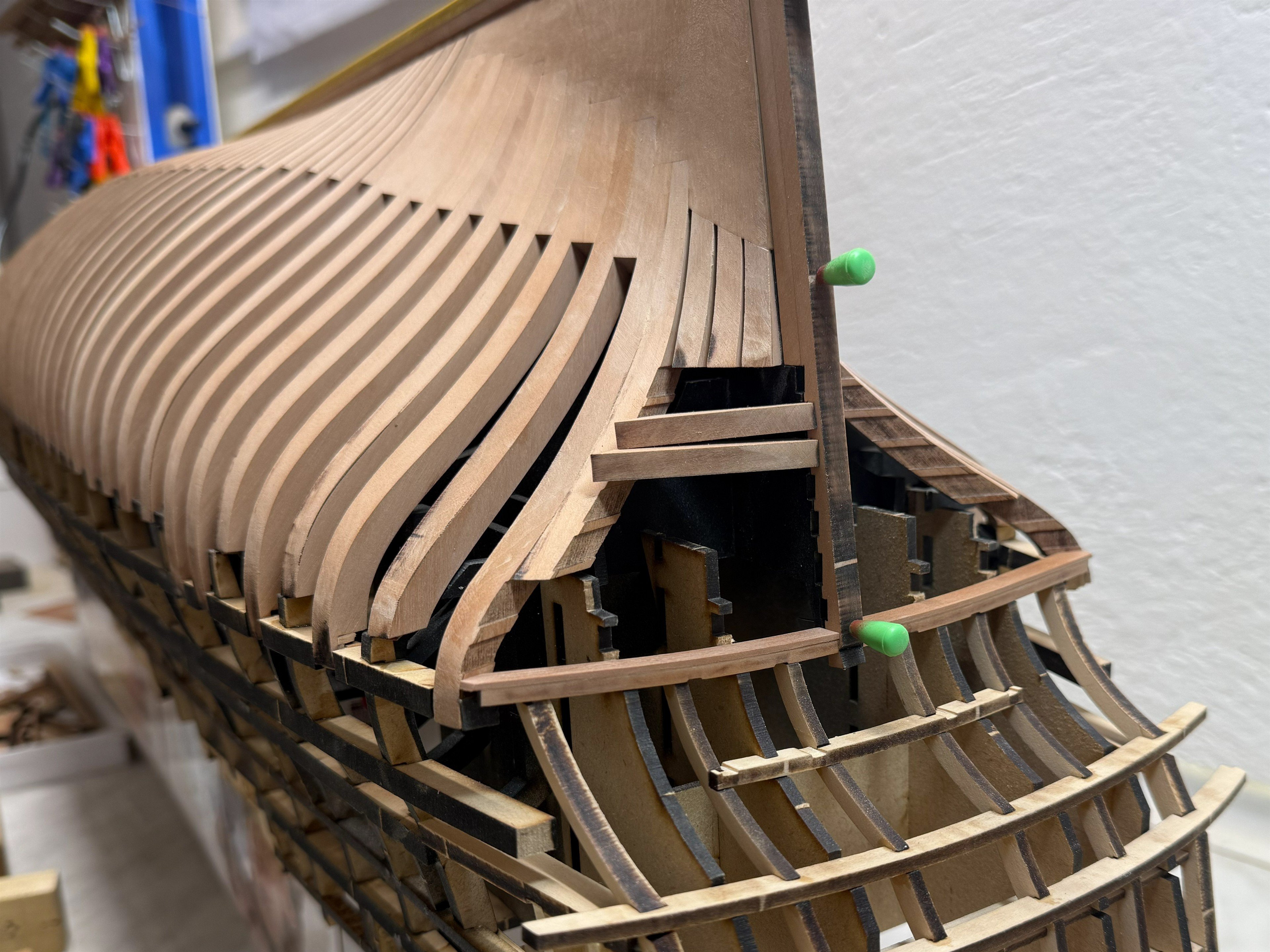

I continued framing the gunports. All 4 longitudinal pieces have been installed.
Only on the aft three bulkheads isn't glued in yet.
I'll finish that after framing the stern.

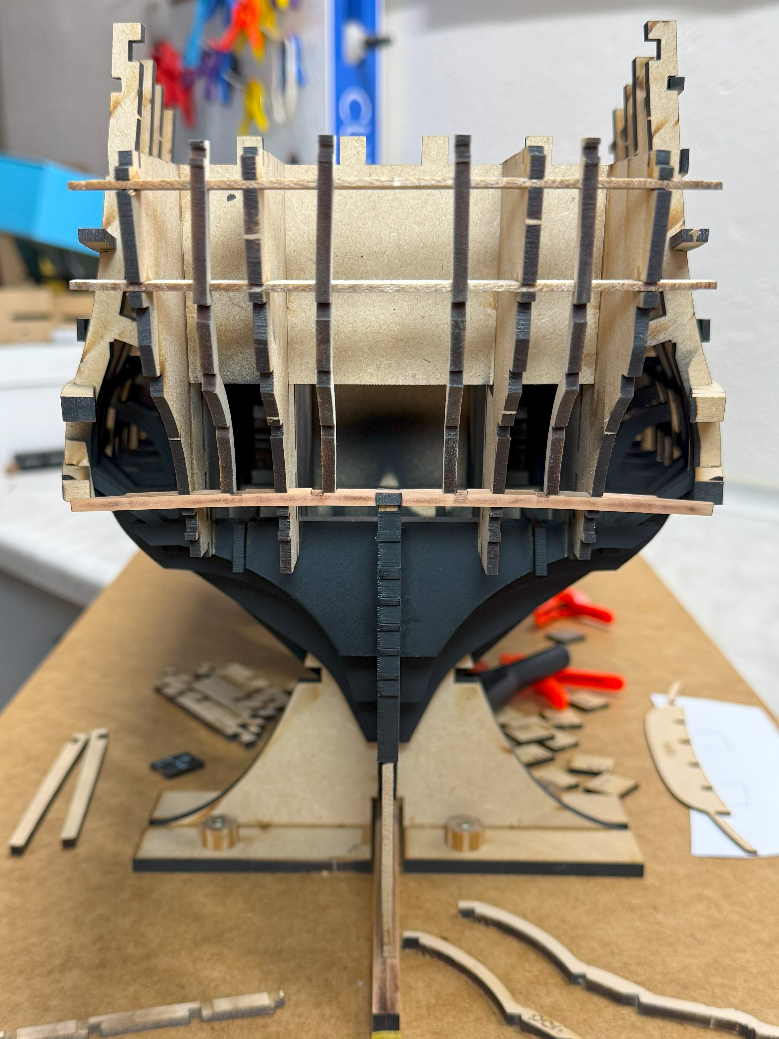

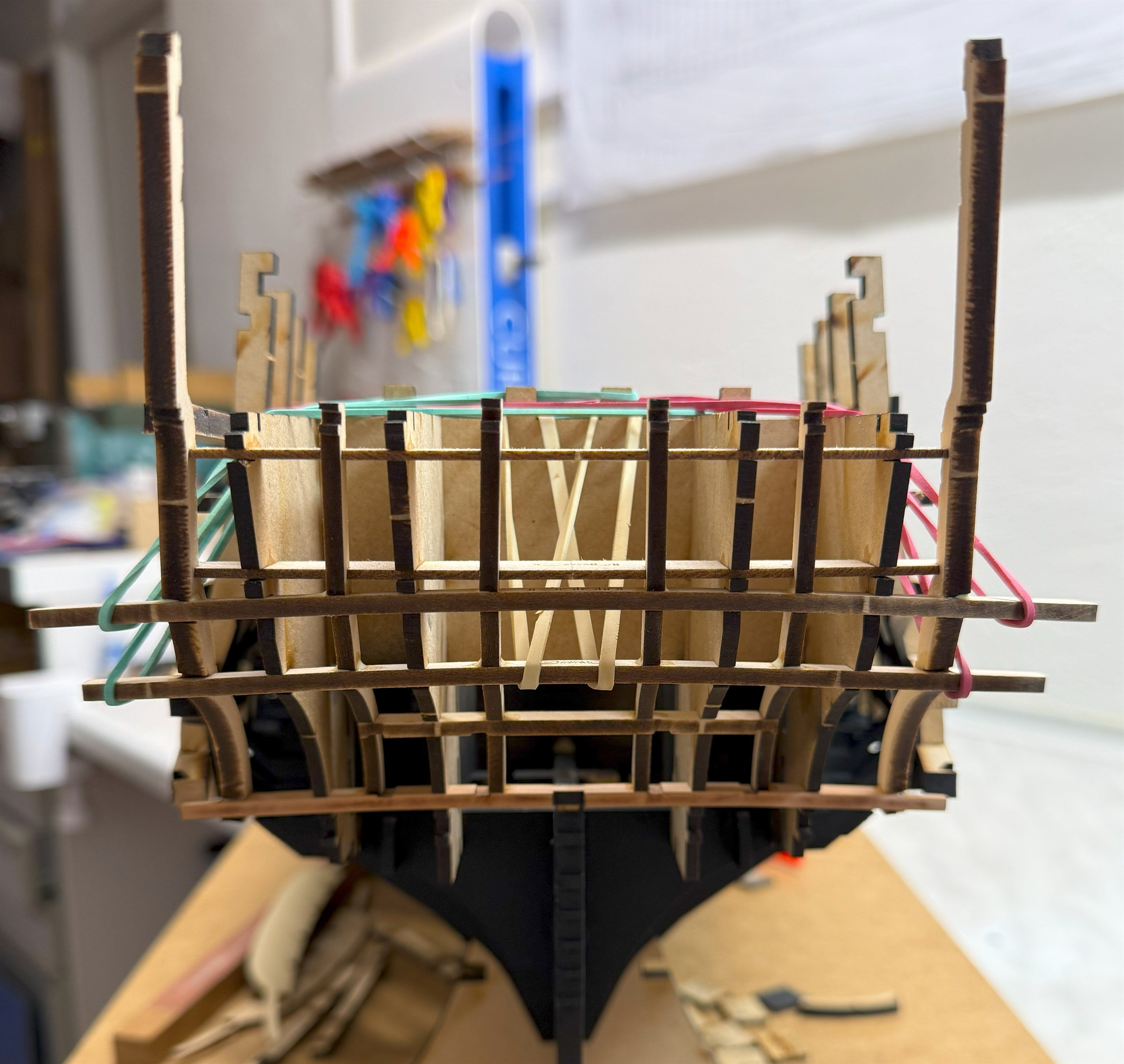

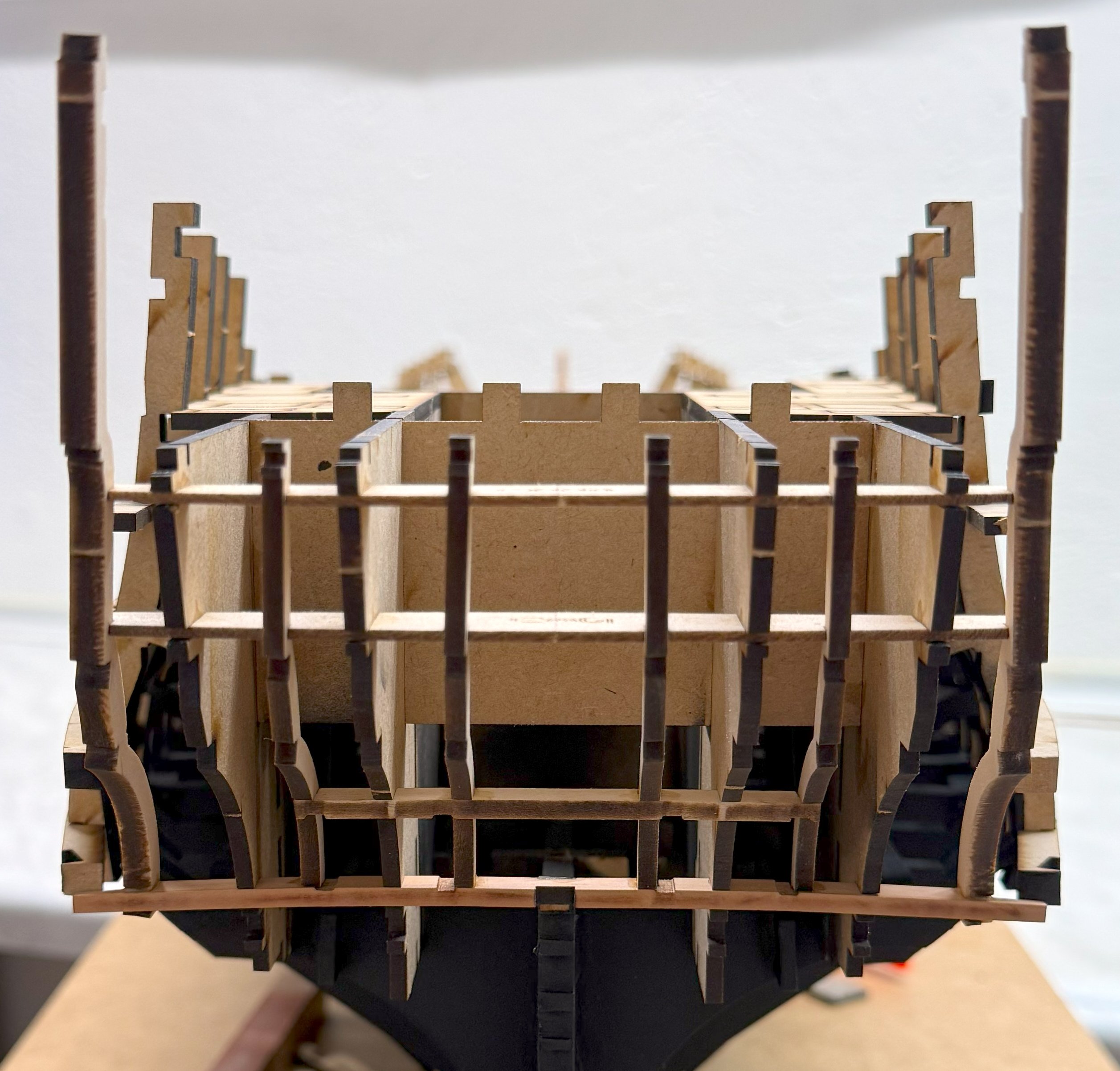

And here are some pictures of the stern.

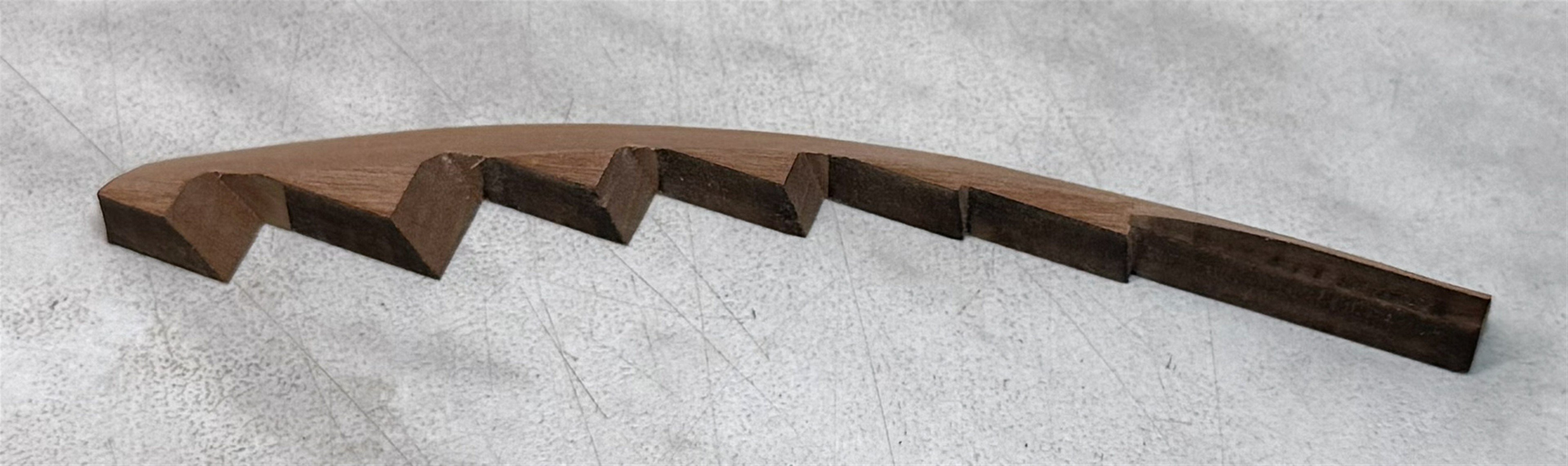

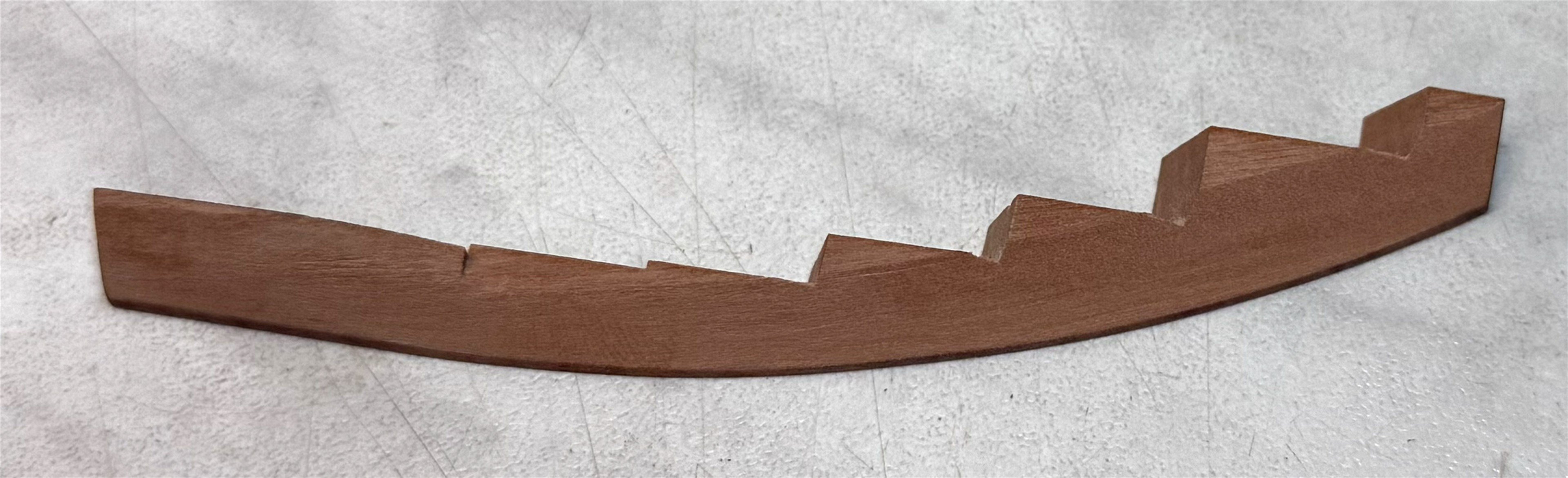

First I shaped and glued The upper wing transom.
Then the four shorter inner frames and the two outer frames.

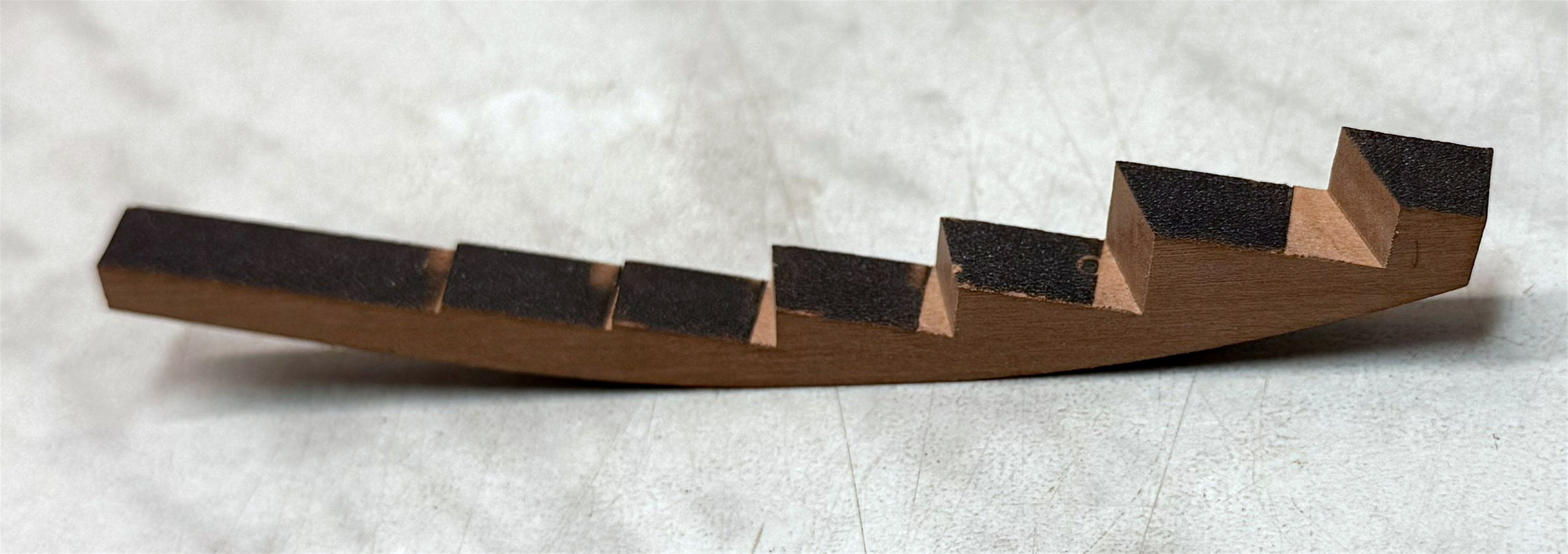

Finally the horizontals, I heat formed those to the curve just like upper wing transom to make them fit nicely into the slots of the frames and jig.
Now the QG framing and balcony will be next

Great start to the framing Dusan! The perpendicular frames move very quickly, especially when you take all the char off beforehand. Looking forward to seeing the cant frames!

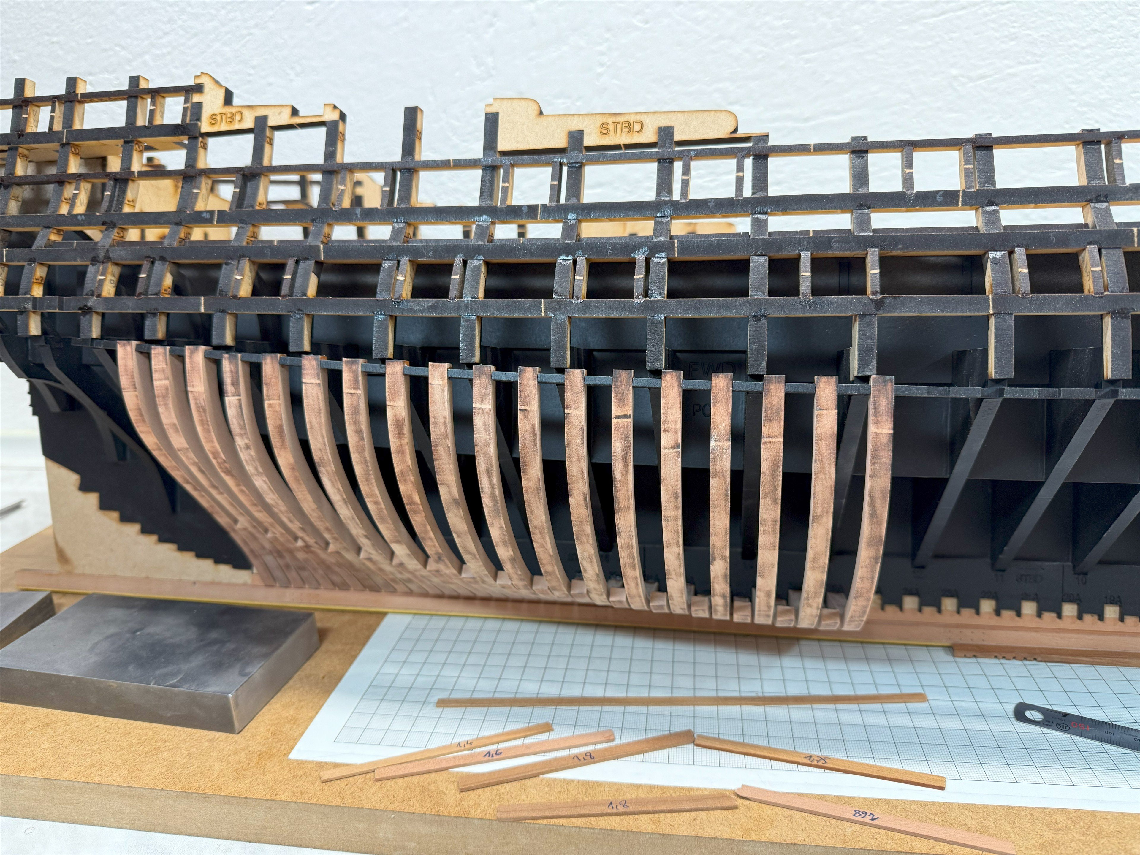

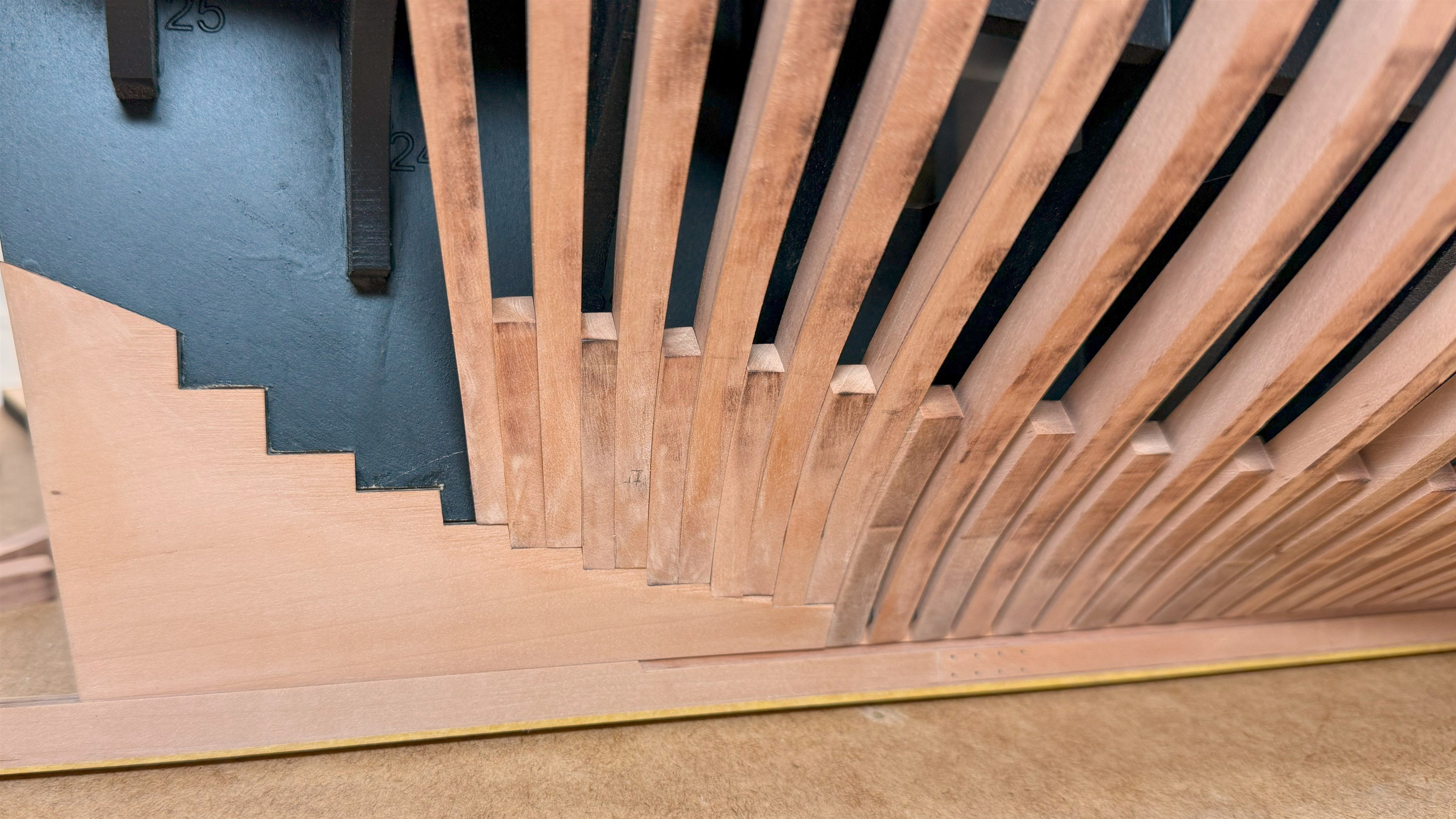

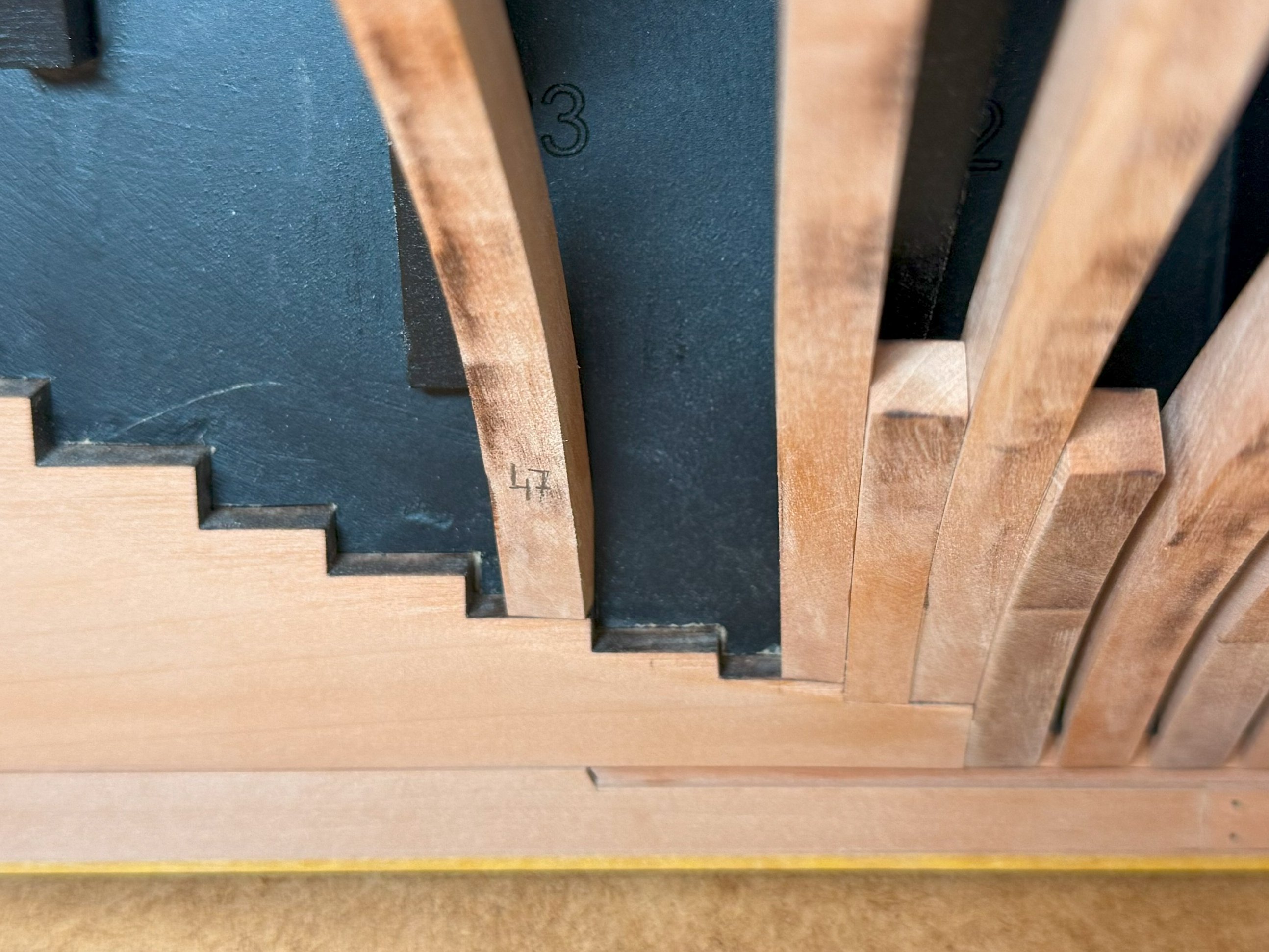

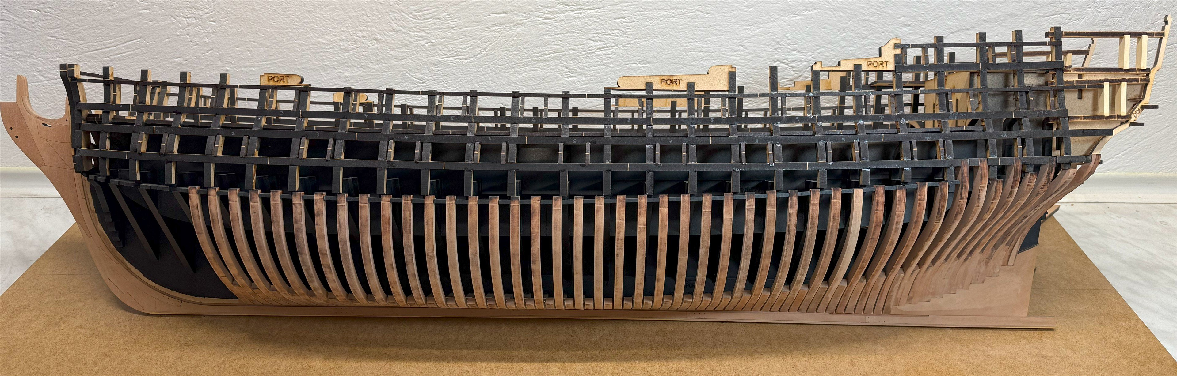

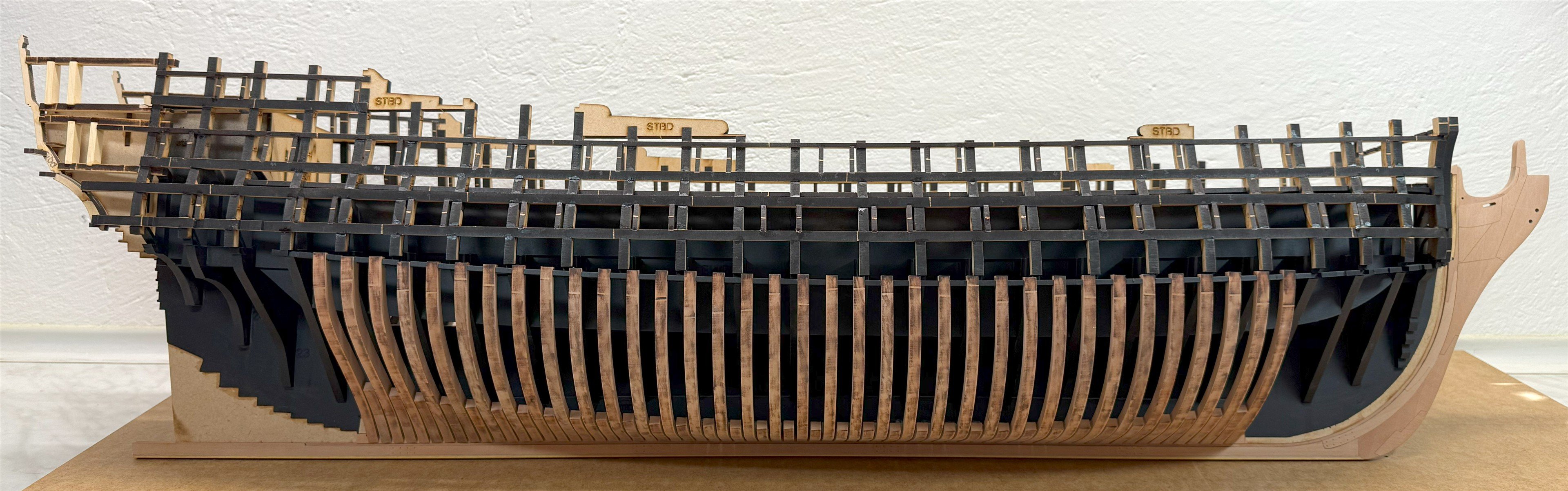

Hi, guys
Thanks for the comments and likes!

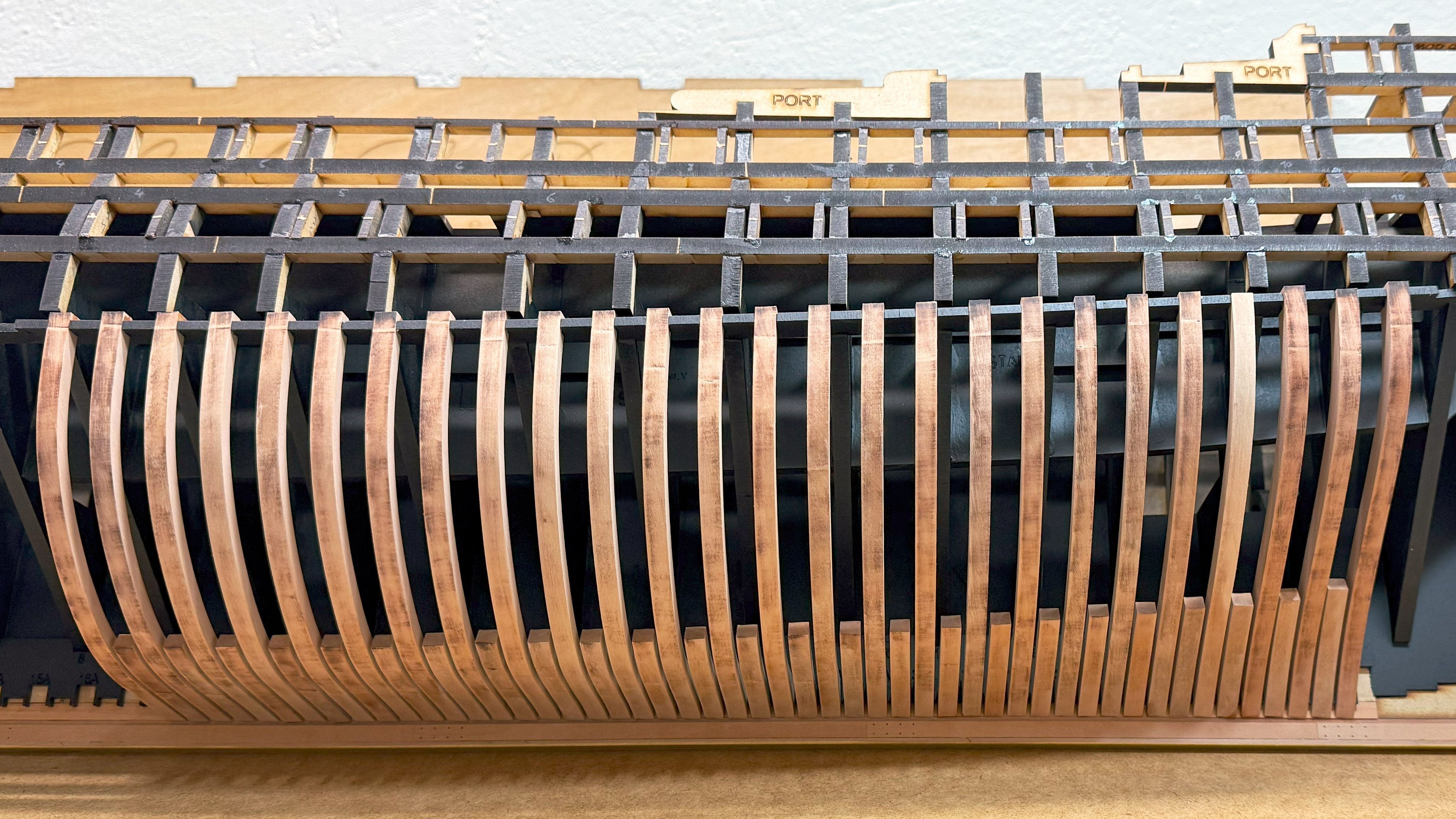

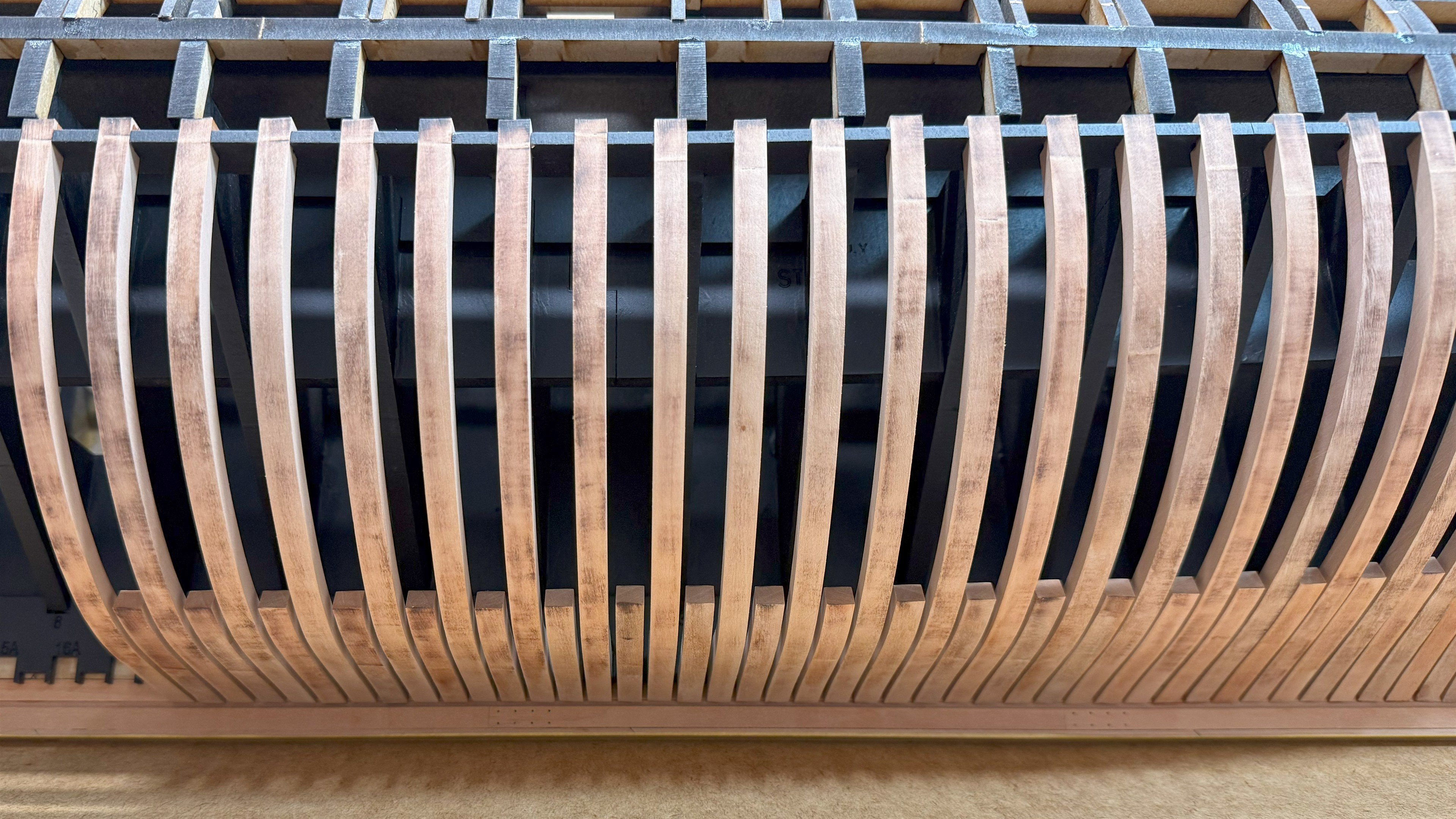

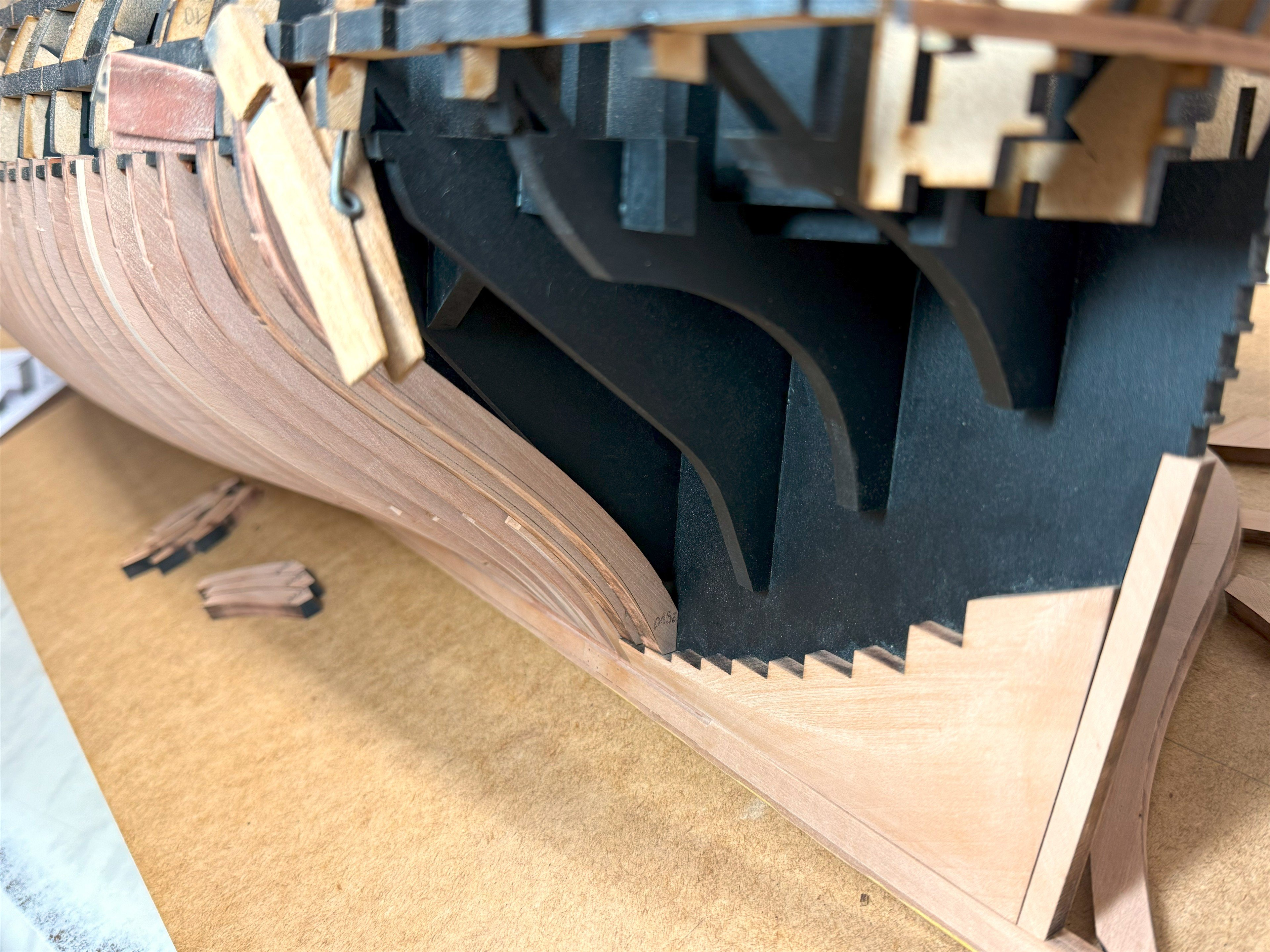

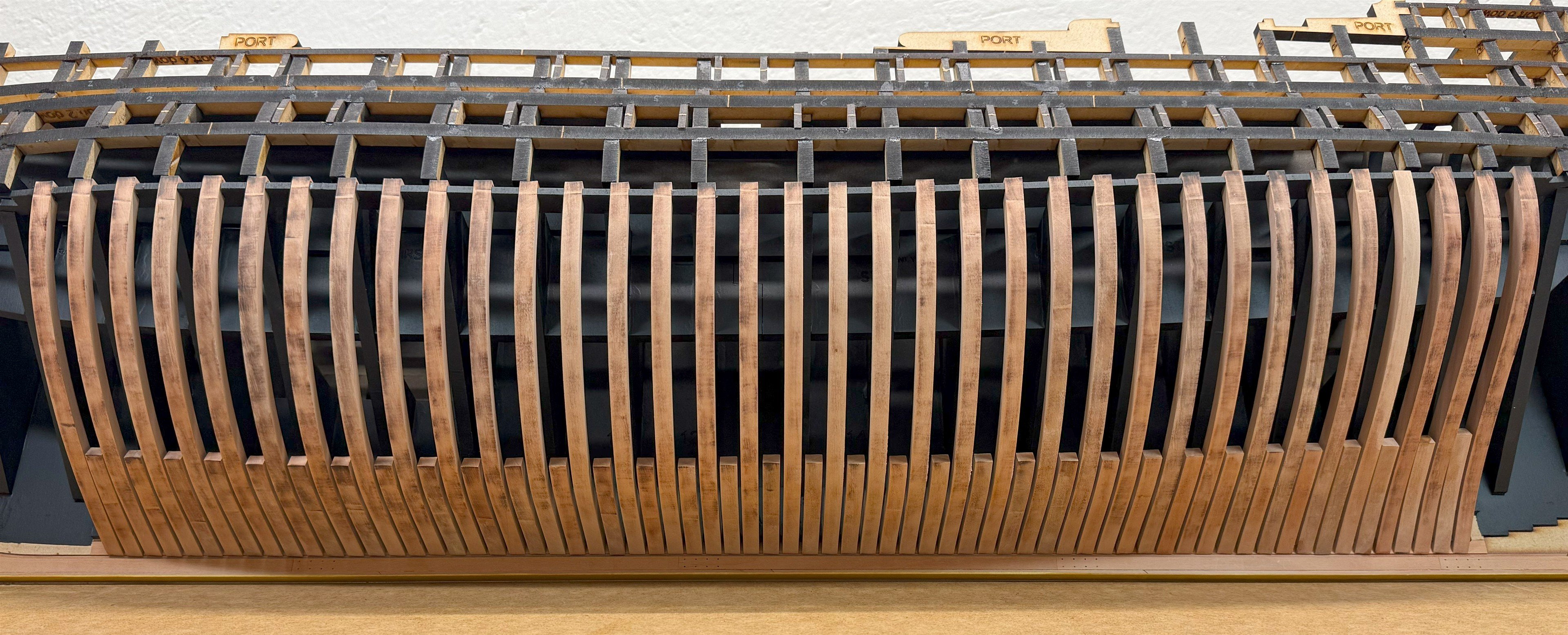

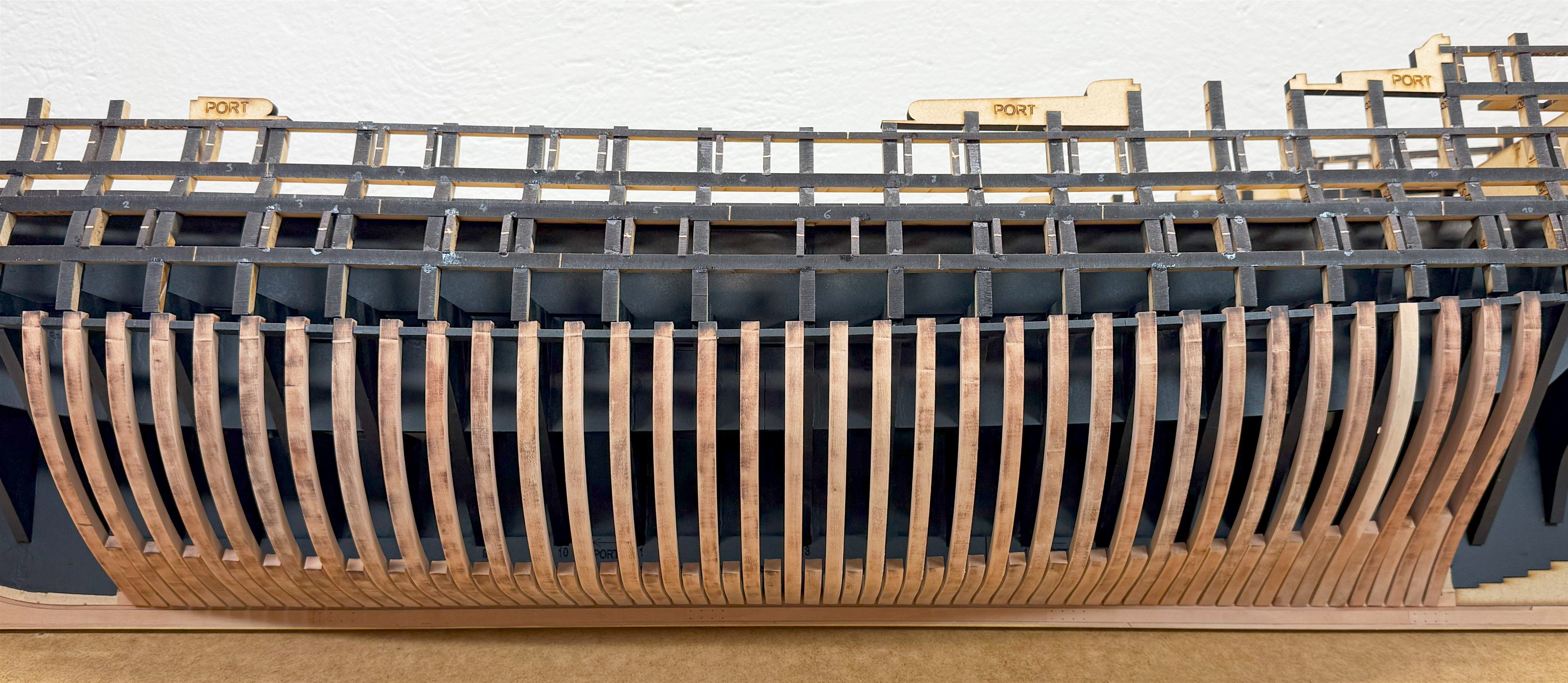

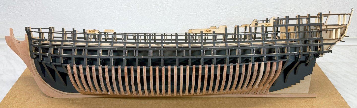

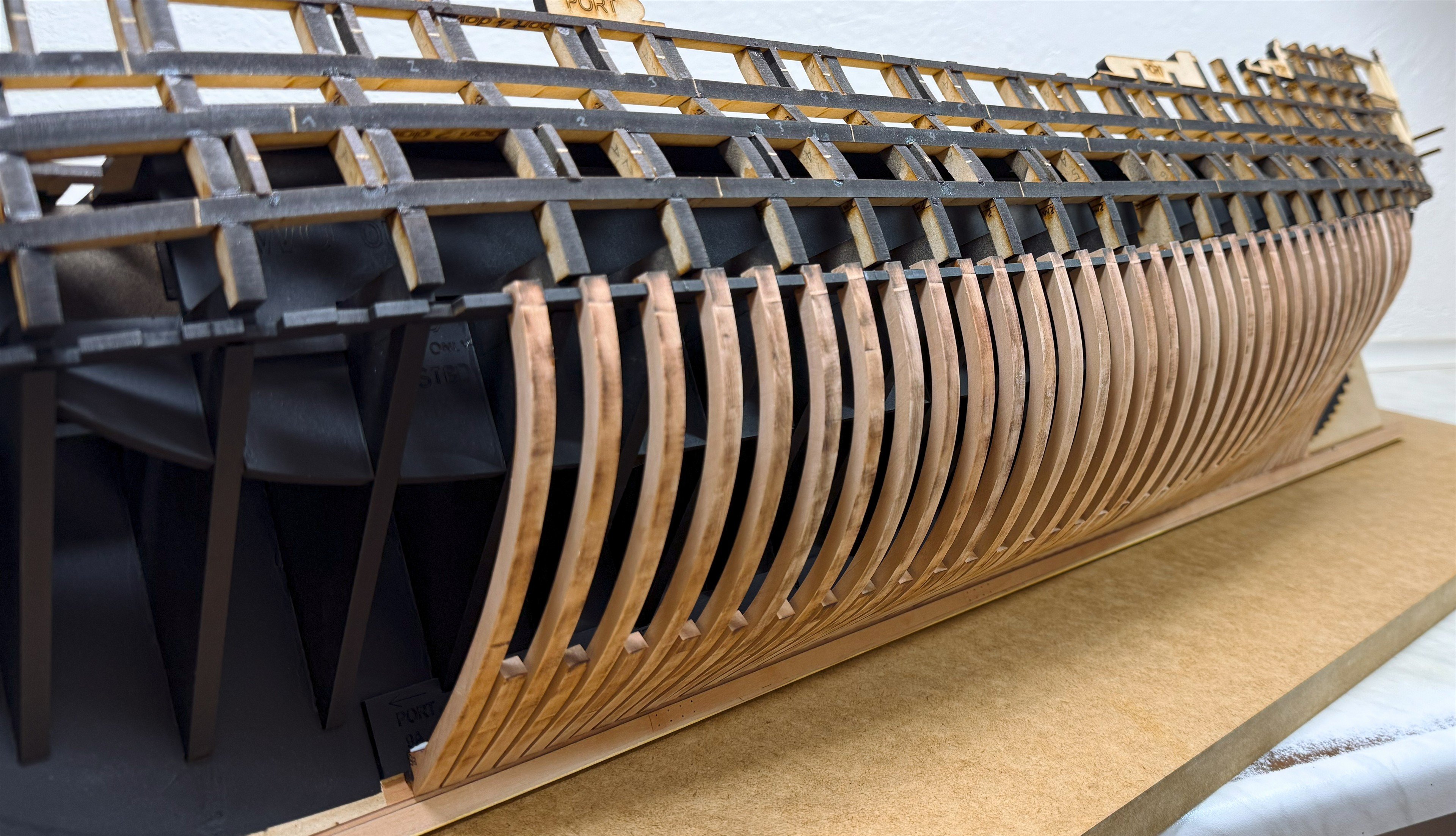

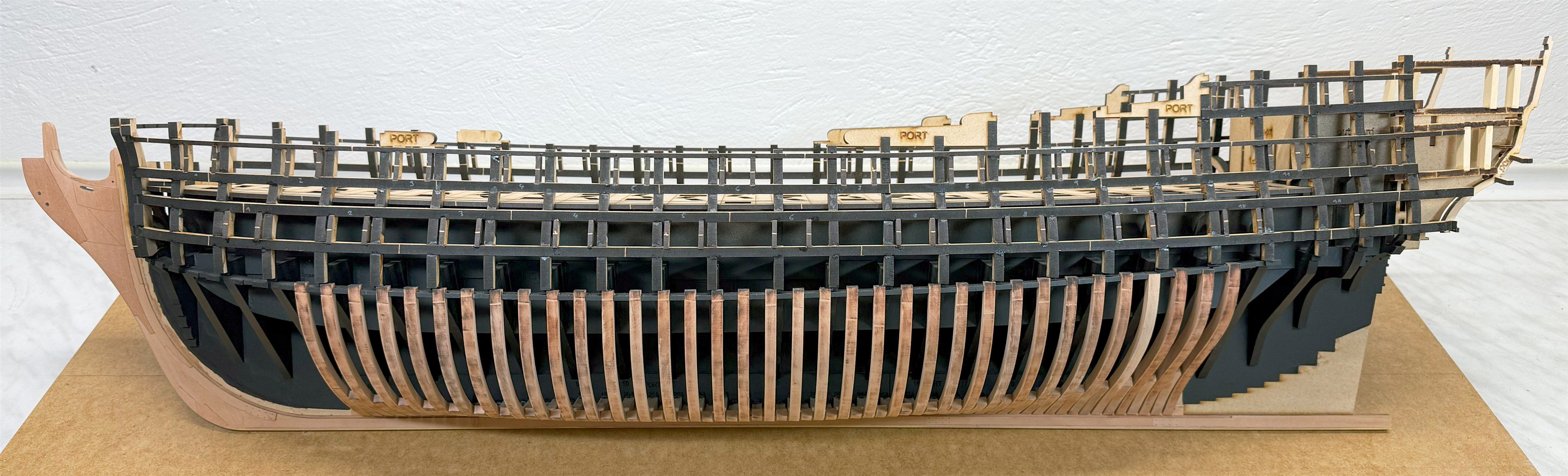

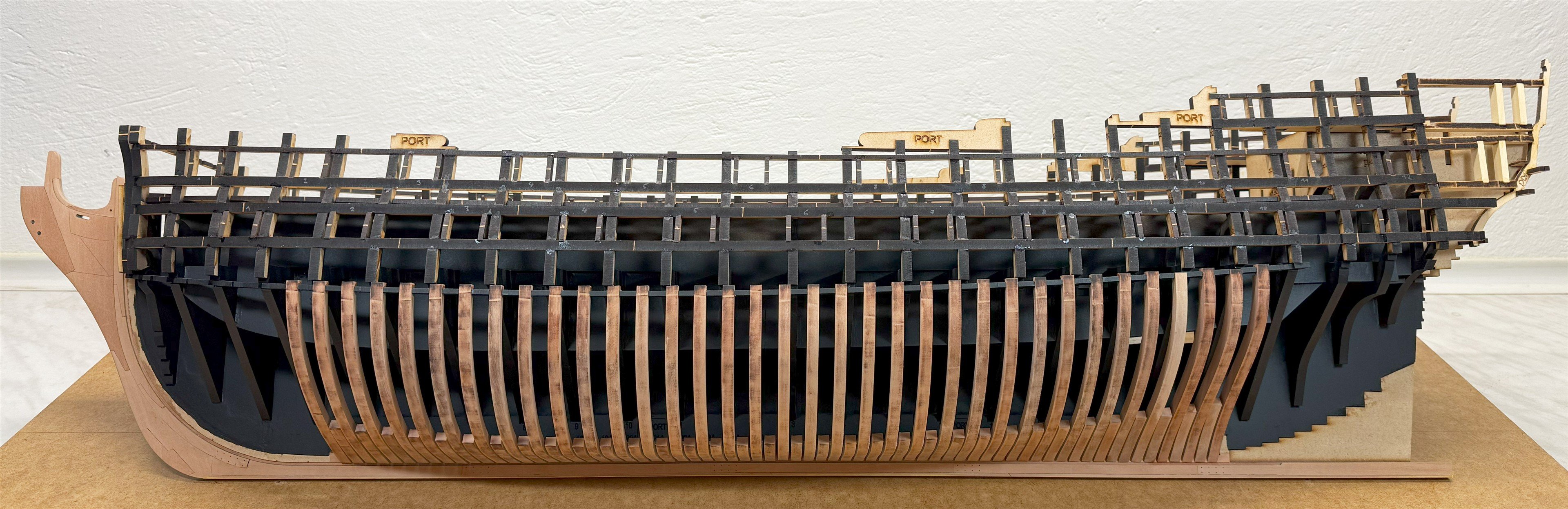

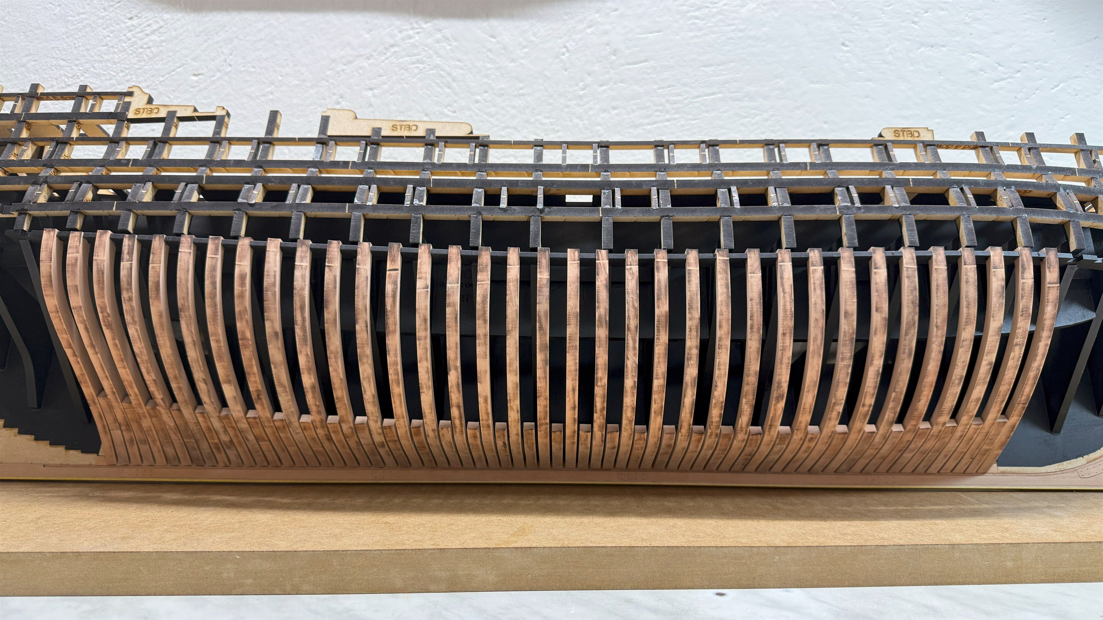

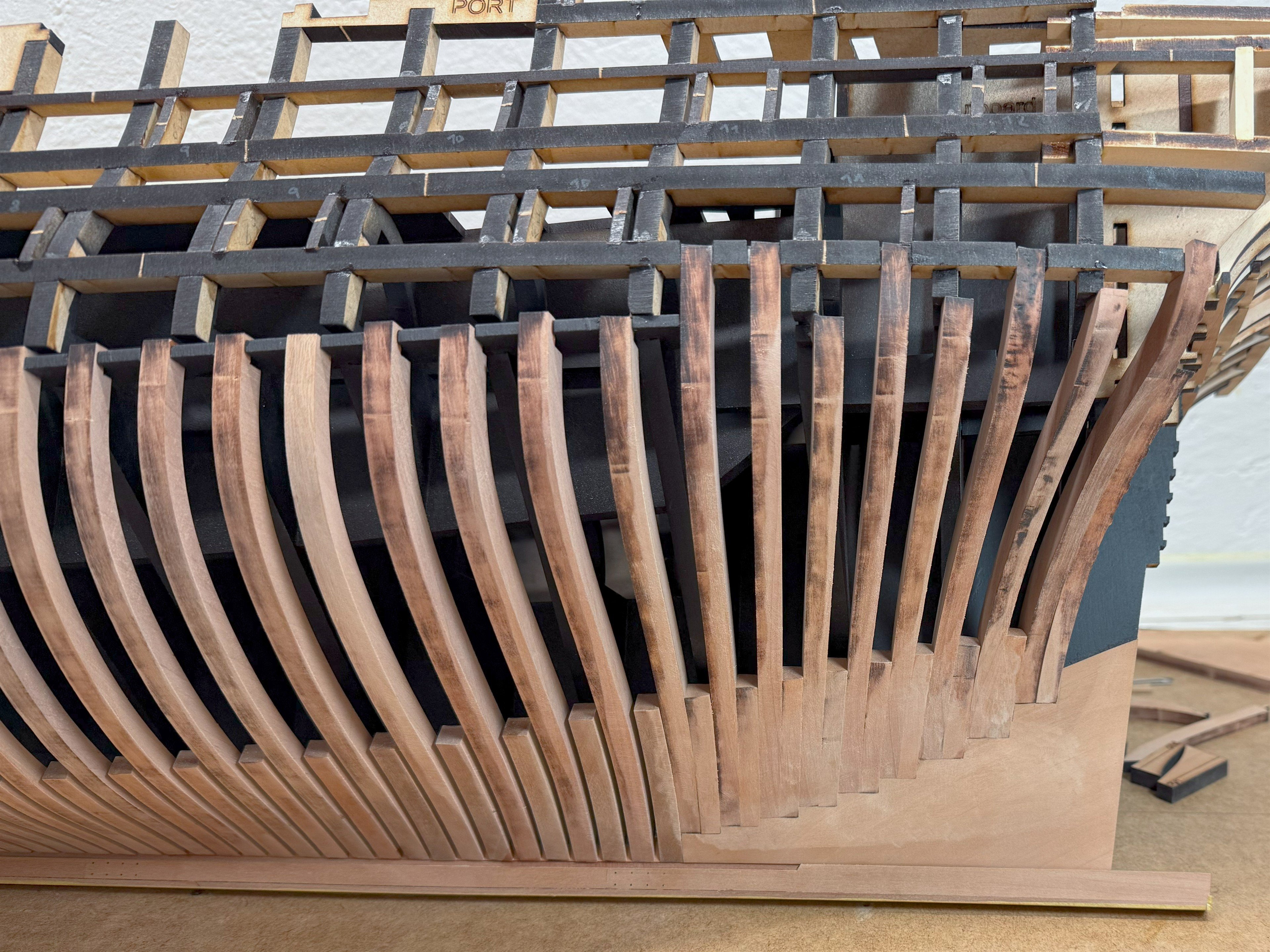

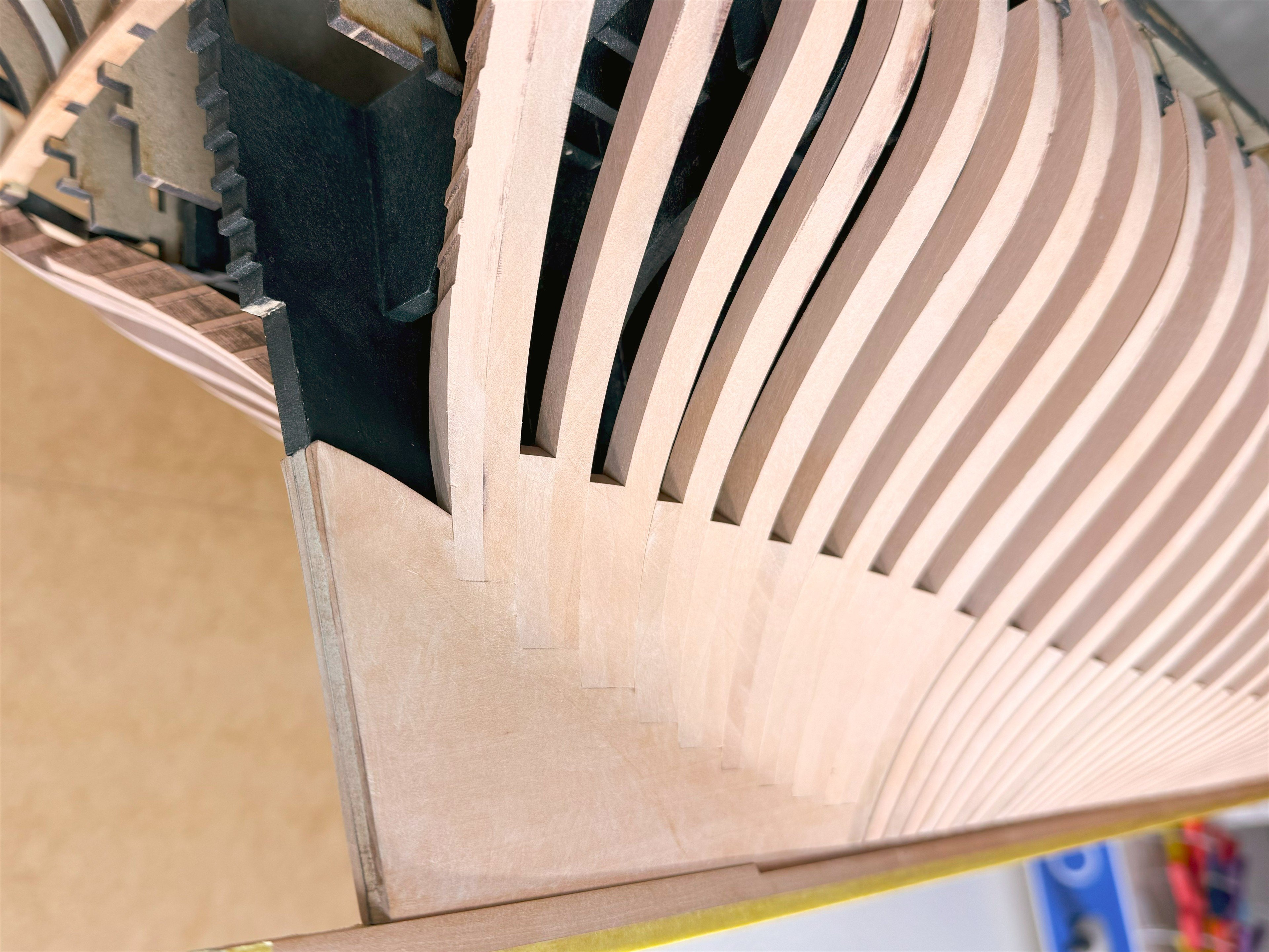

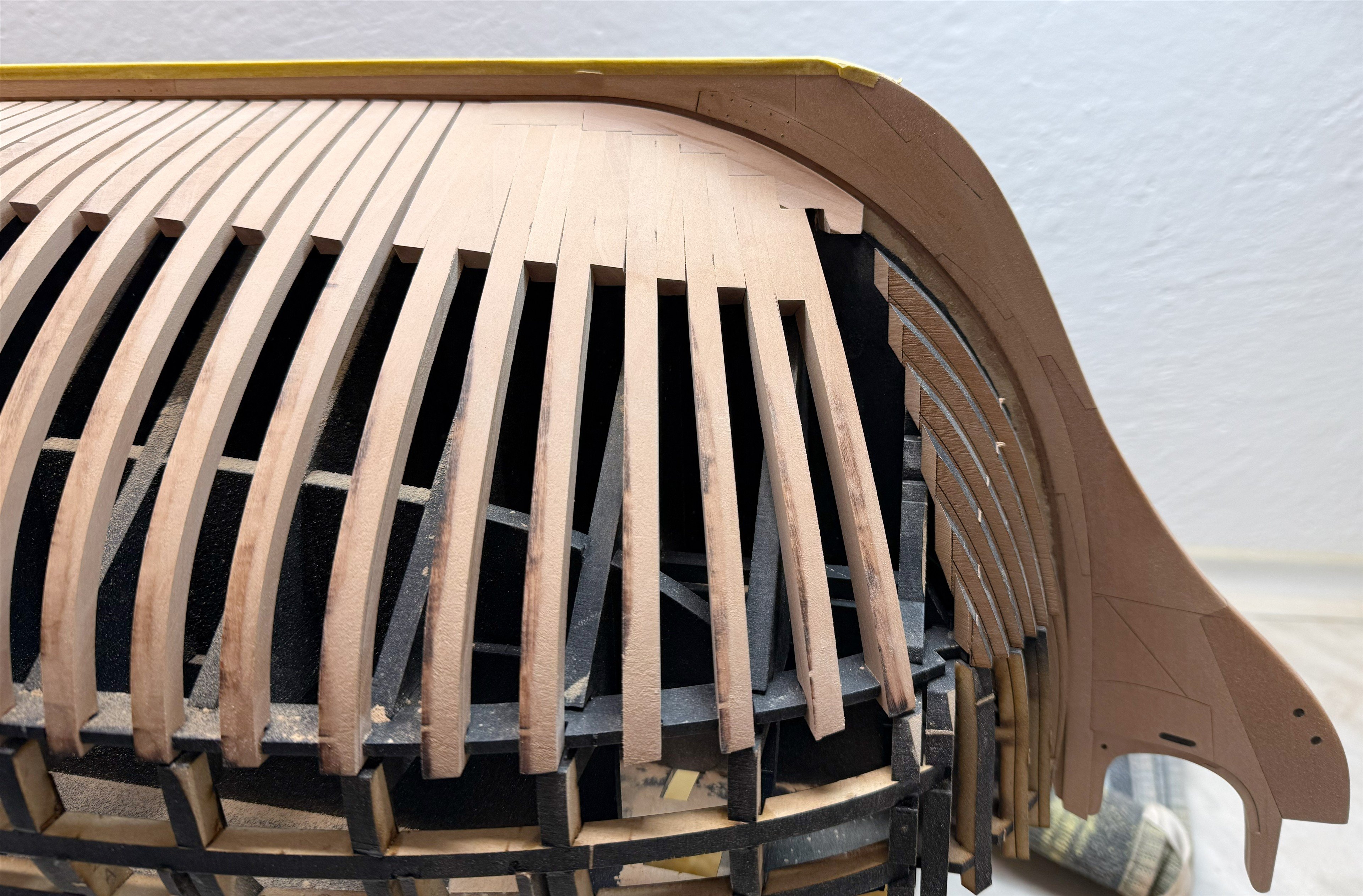

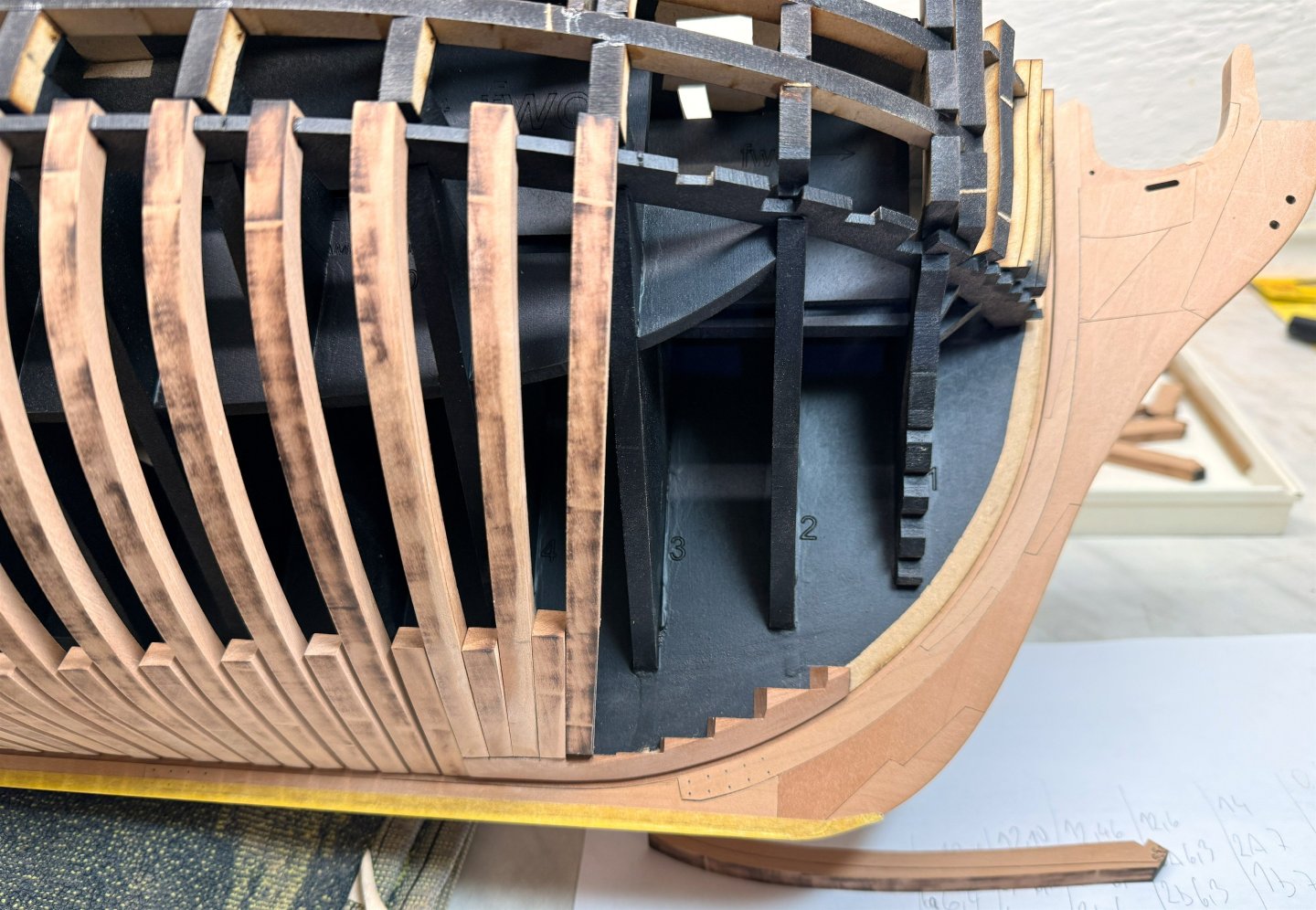

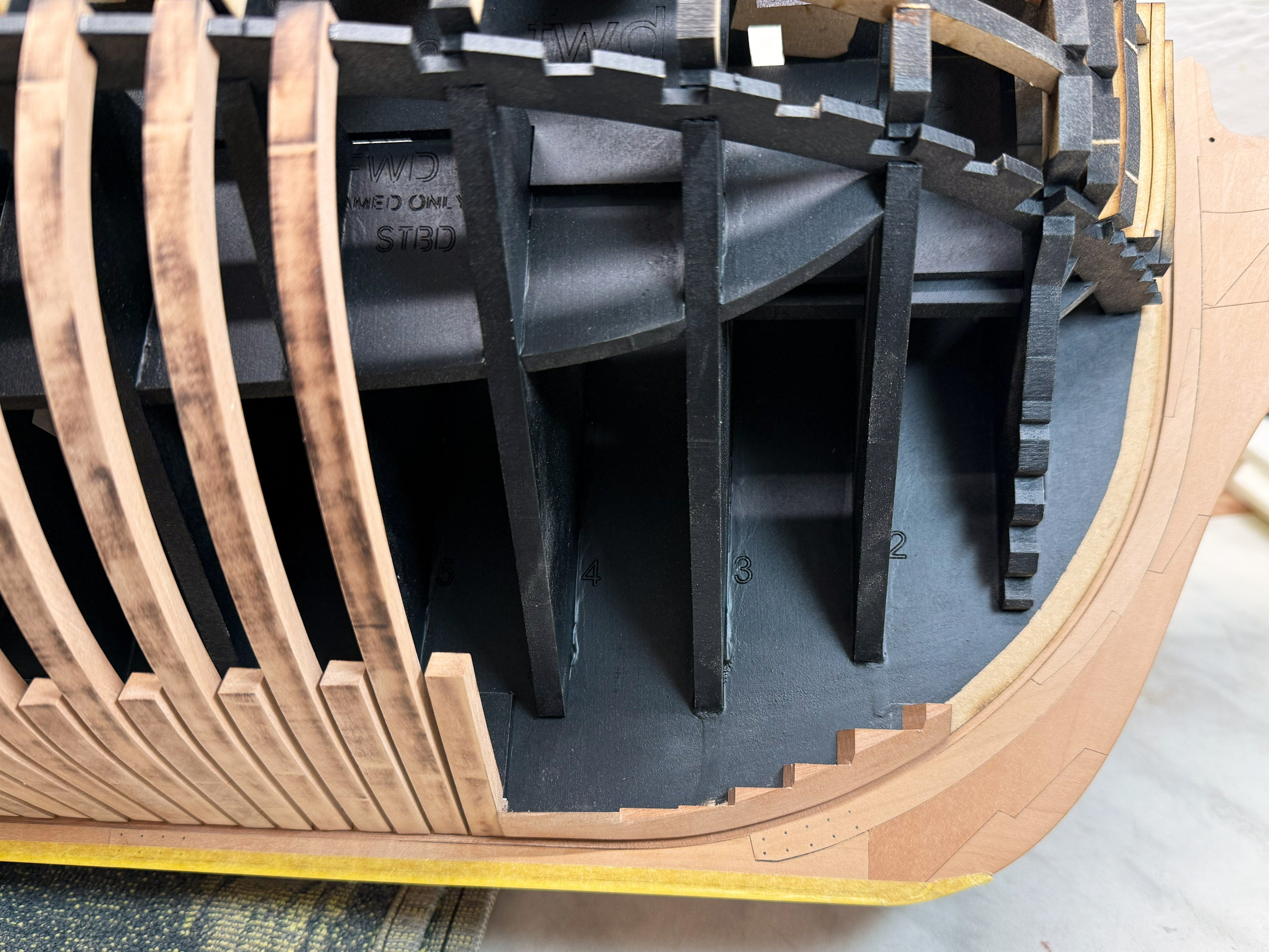

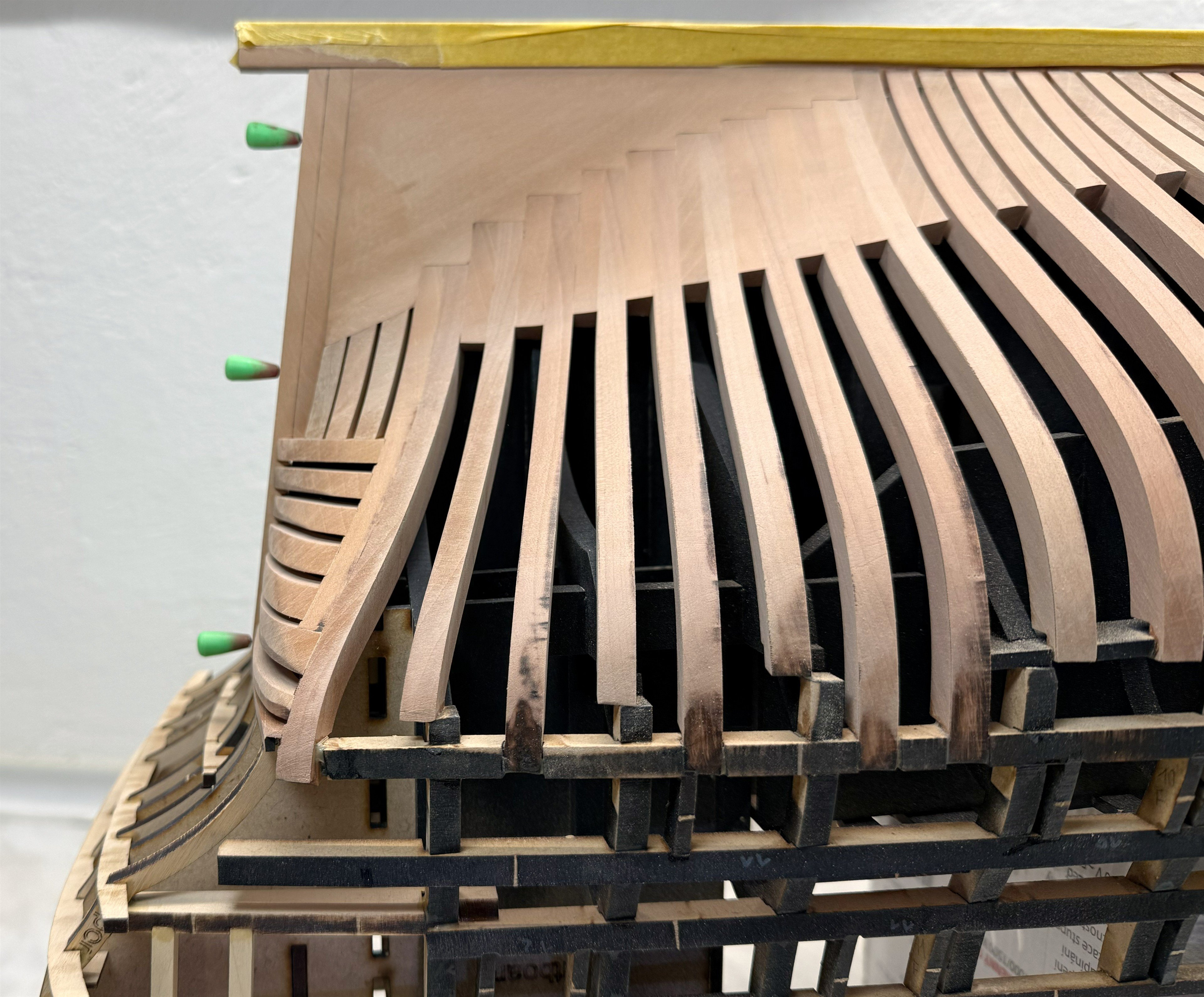

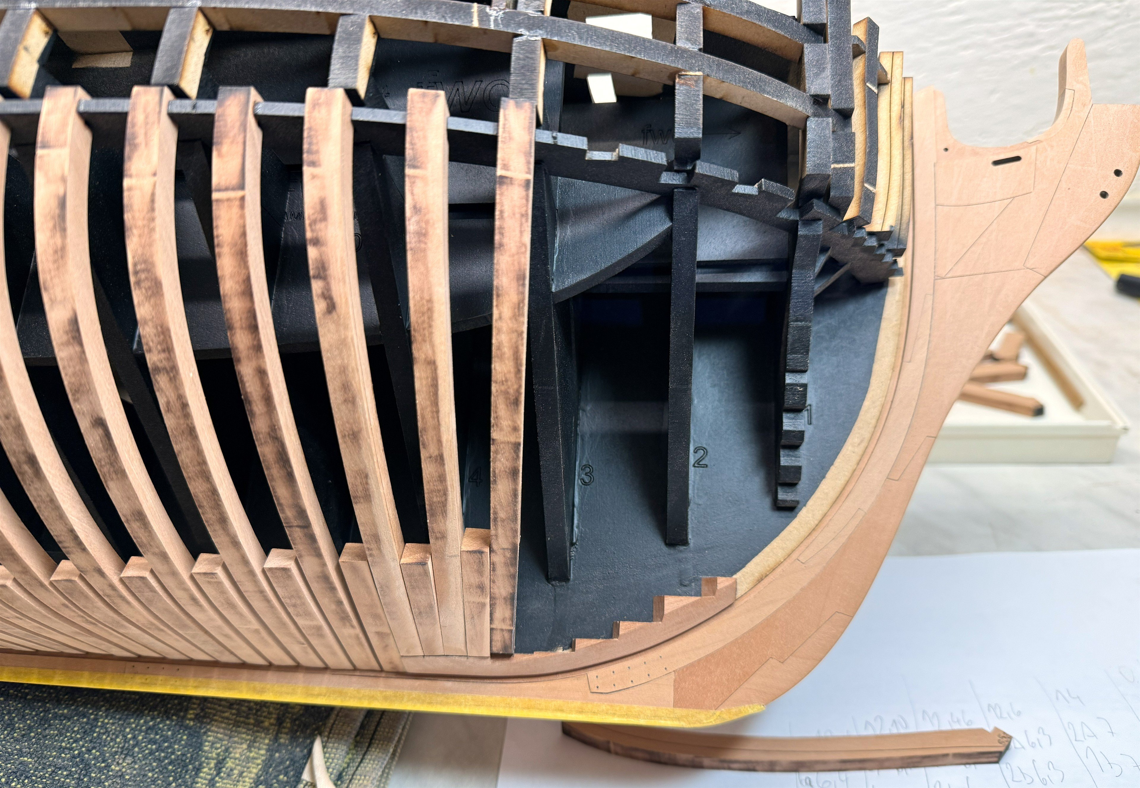

After a short break, I finished installing all the perpendicular frames on the port side today.
It went quite easily and quickly since I had already cleaned them of char beforehand. I was just fine-tuning little things,
such as the area that sits on the keel is flat
and free of char, because even glue on char doesn't hold.
And here is the result.
Now I'm off to the heavier part to prepare the deadwood and the aft cant frames.

That looks really good Dusan! Off to a great start. Even those cant frames move pretty quickly. The b frames actually take longer due to all the sanding.

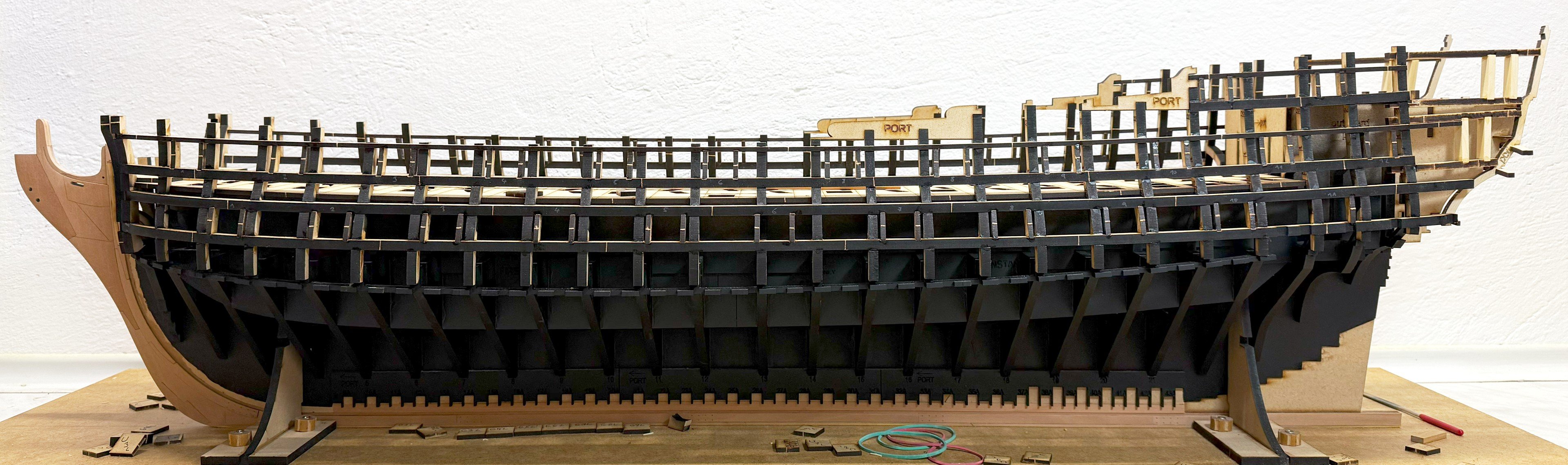

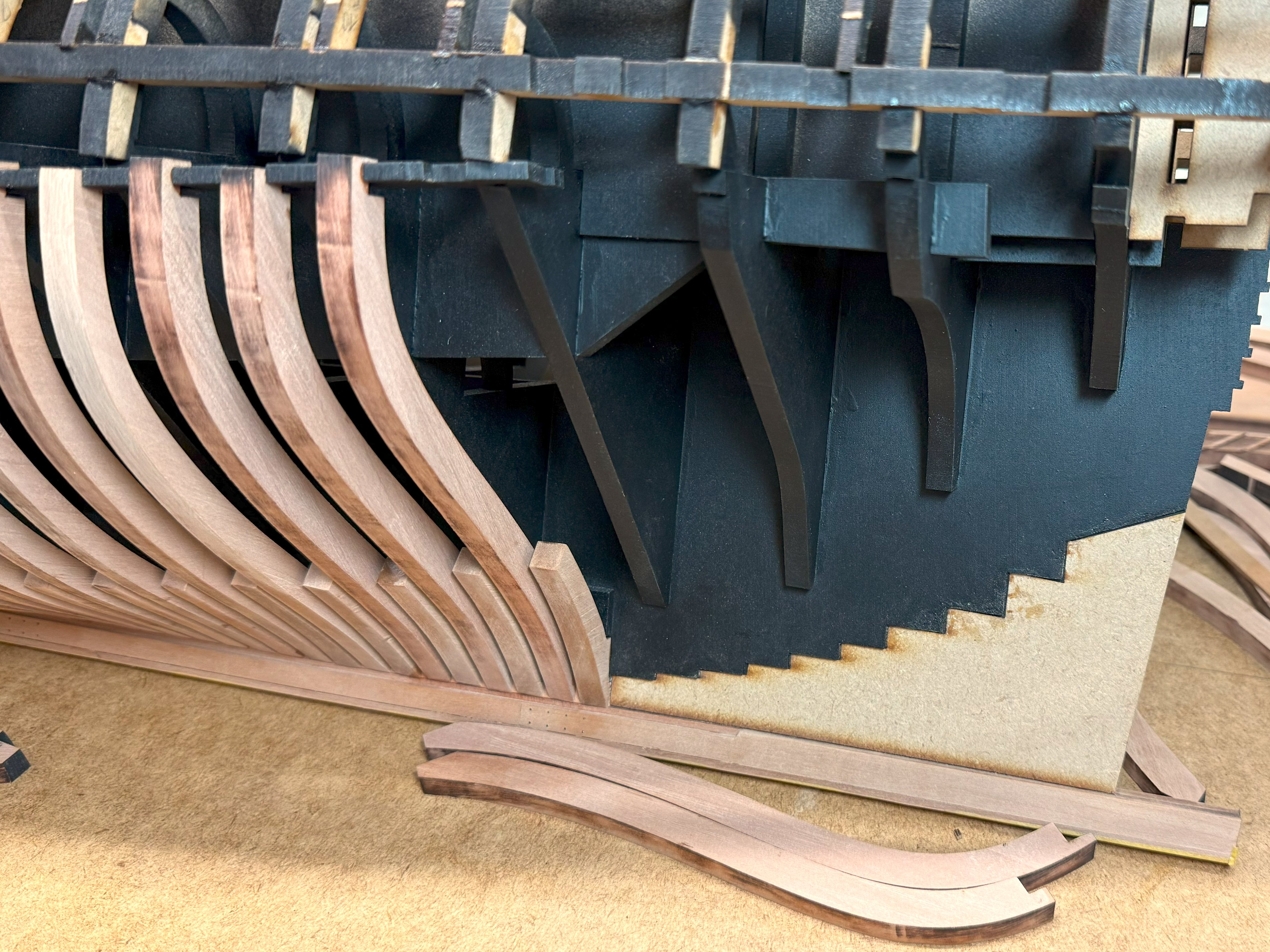

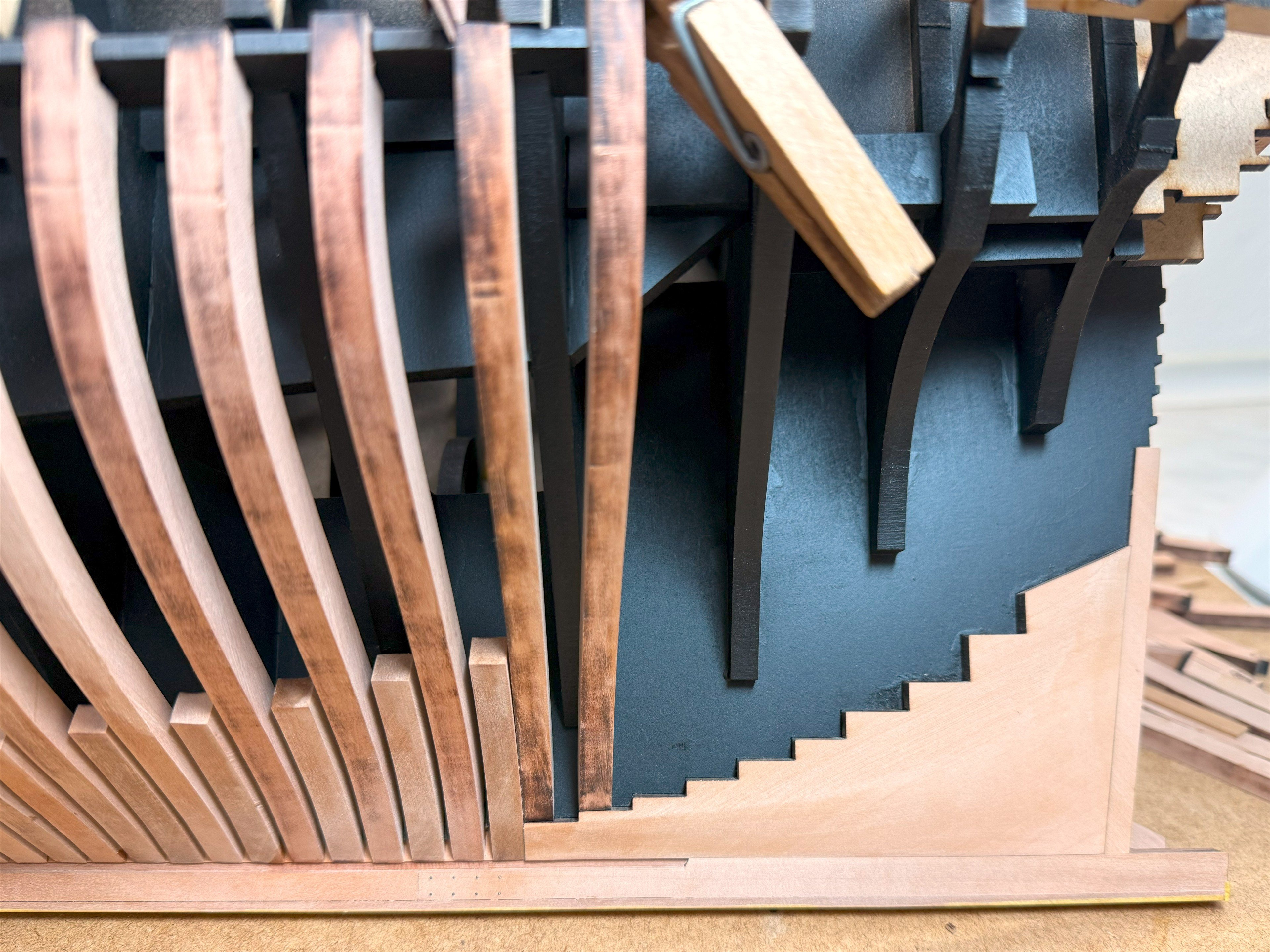

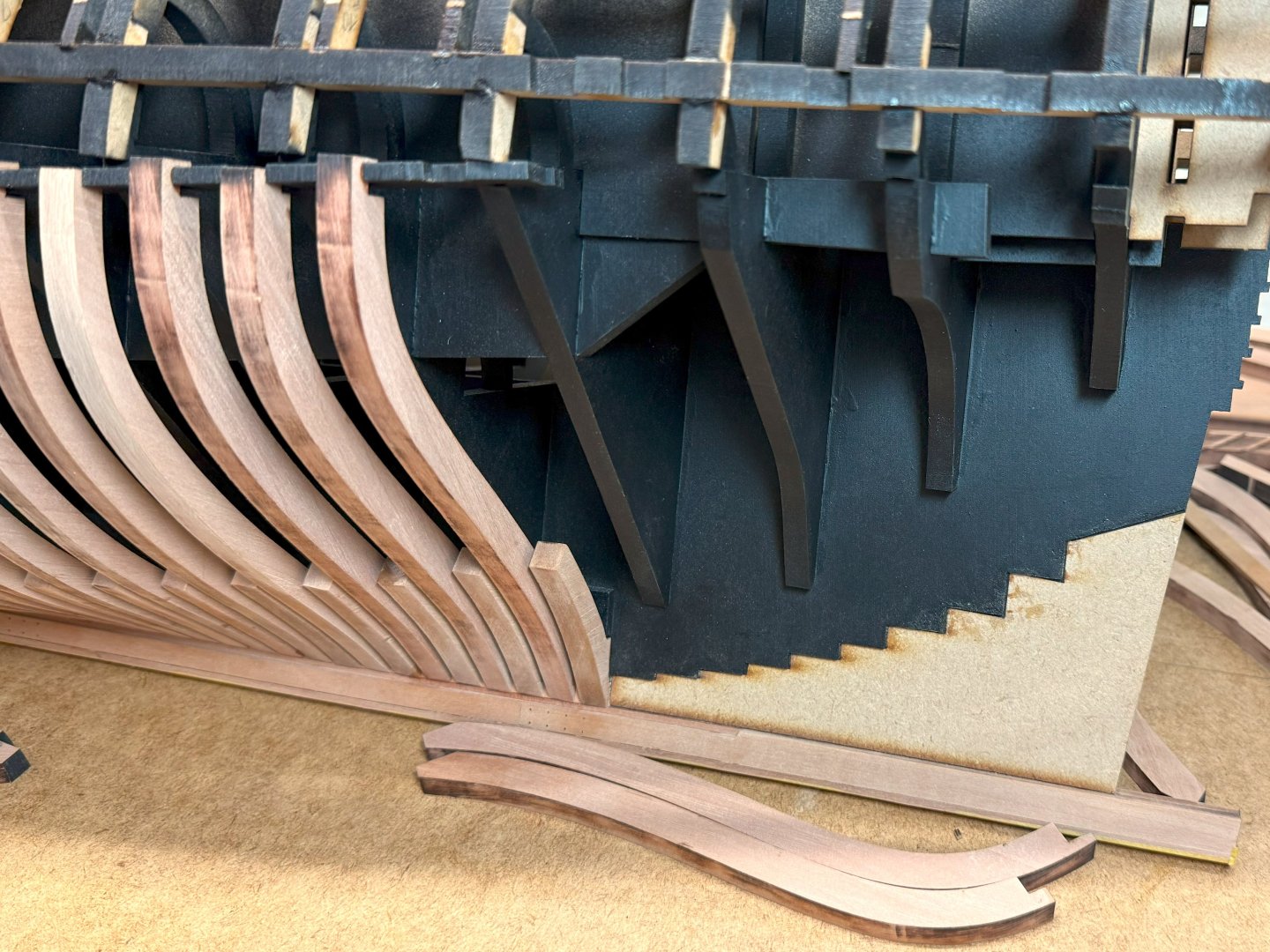

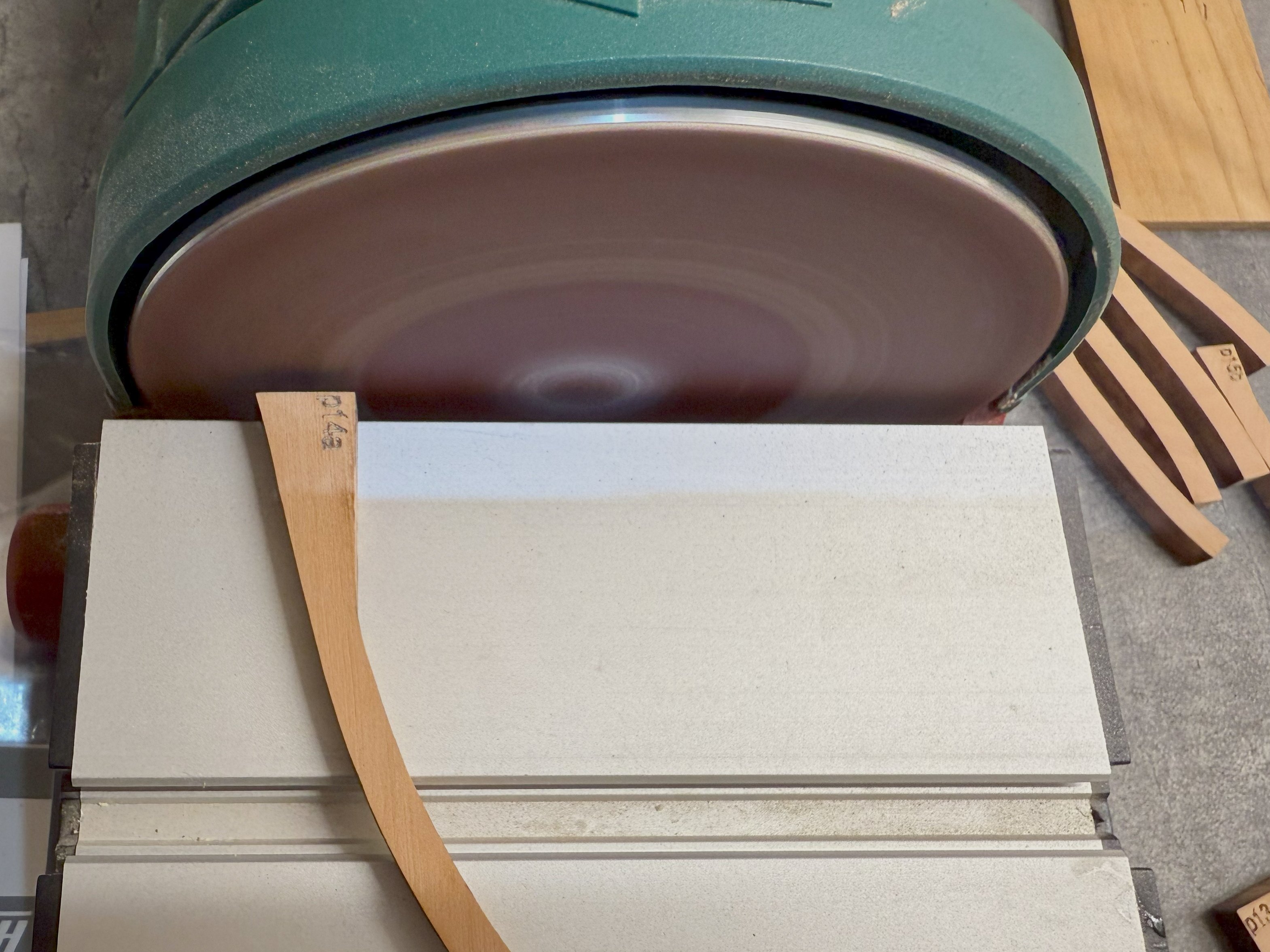

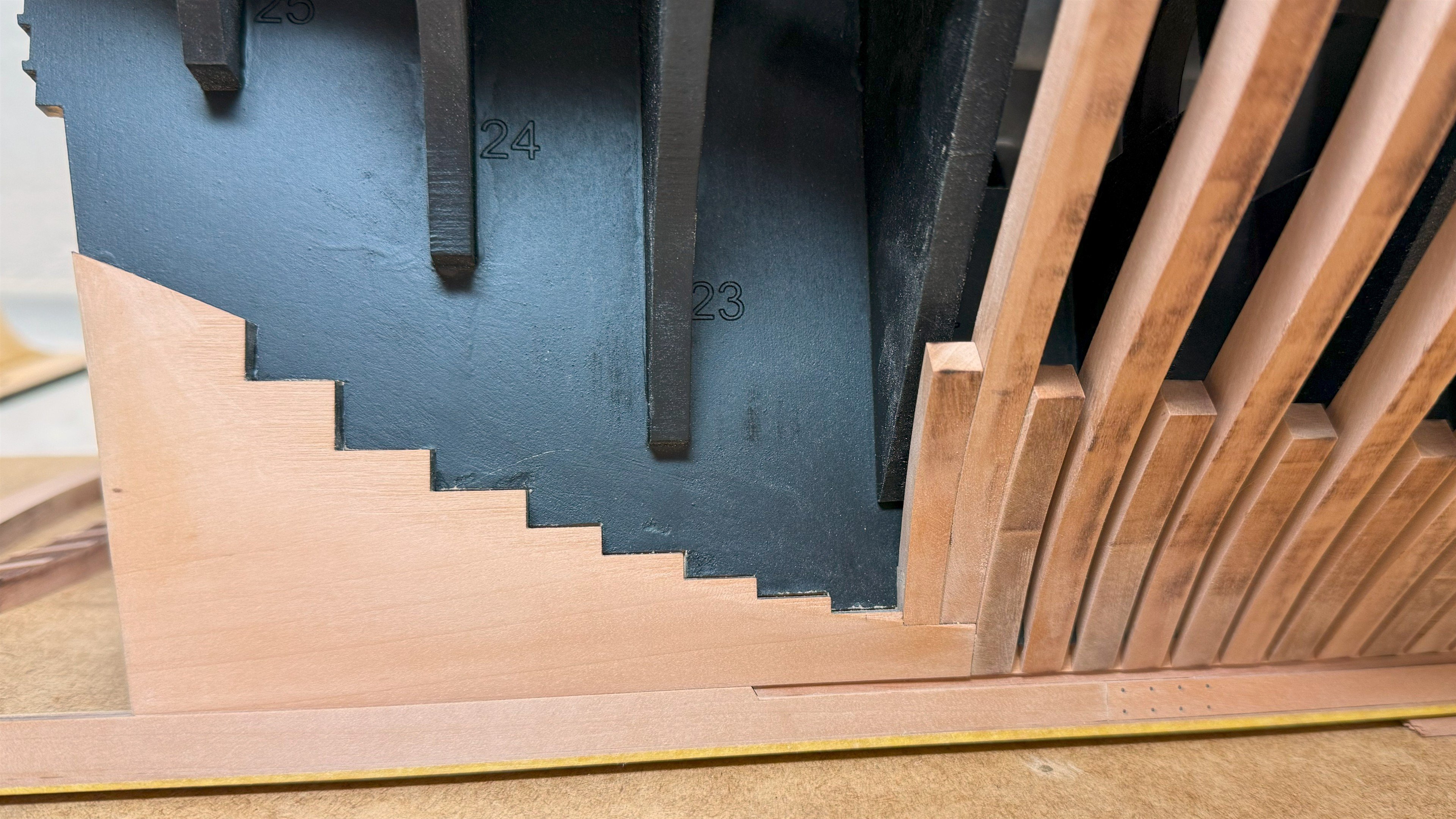

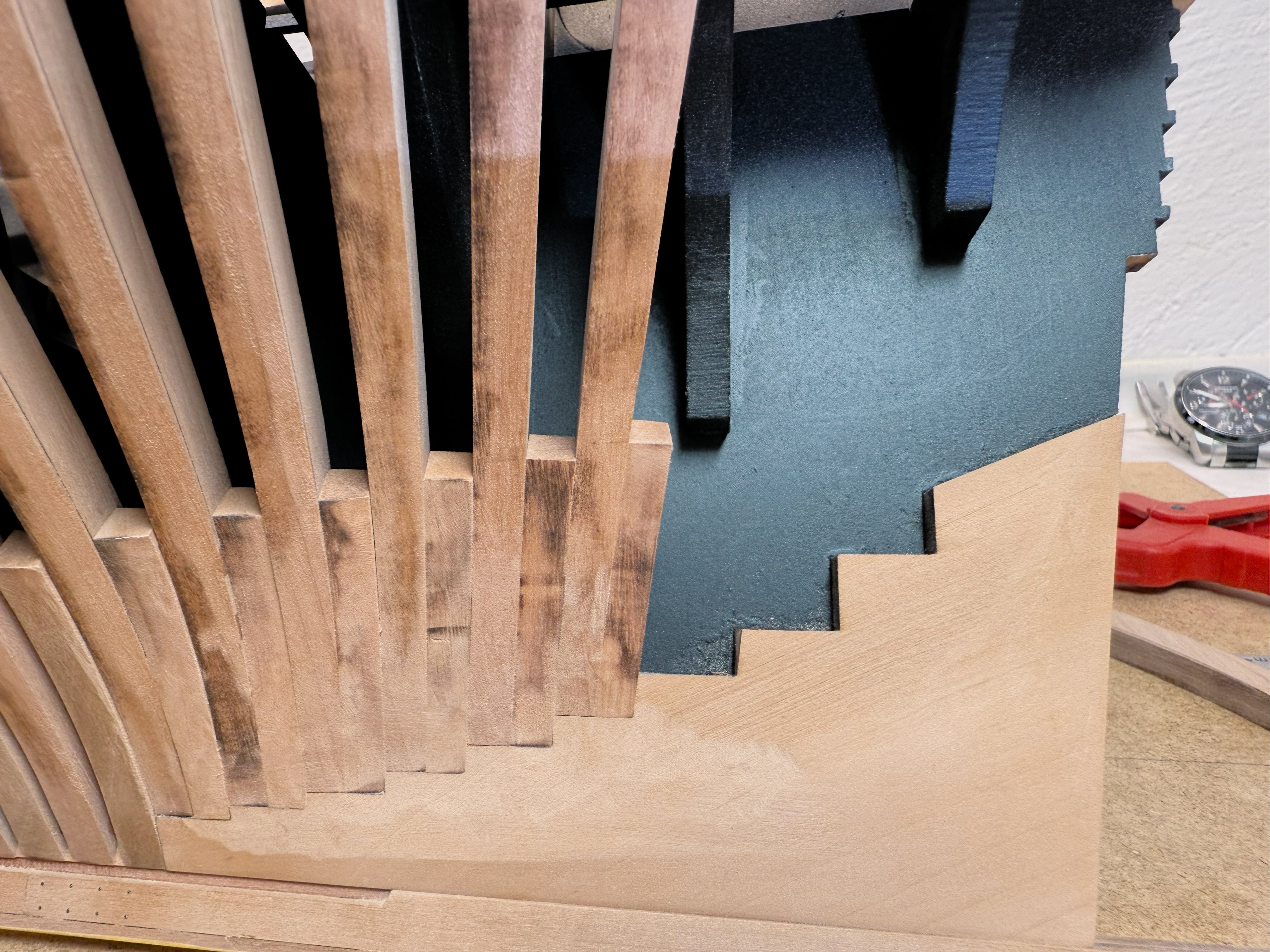

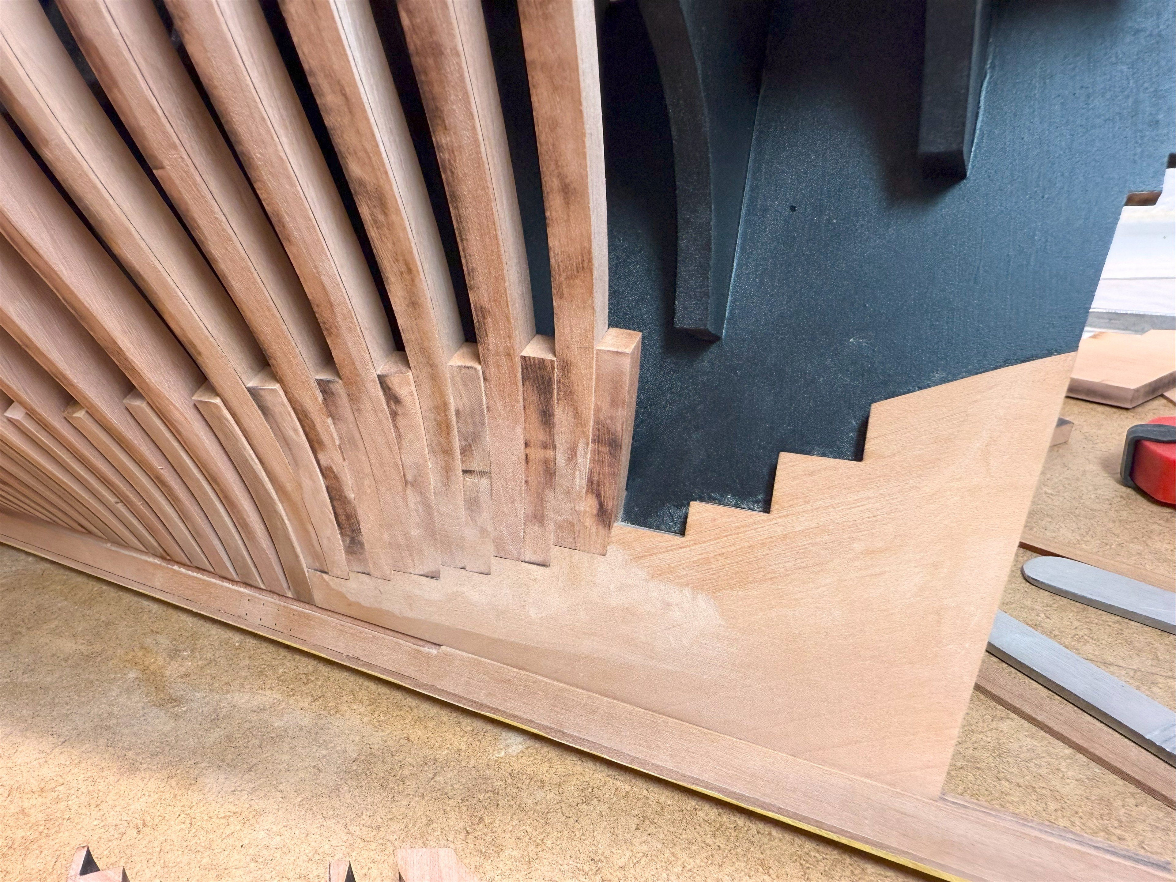

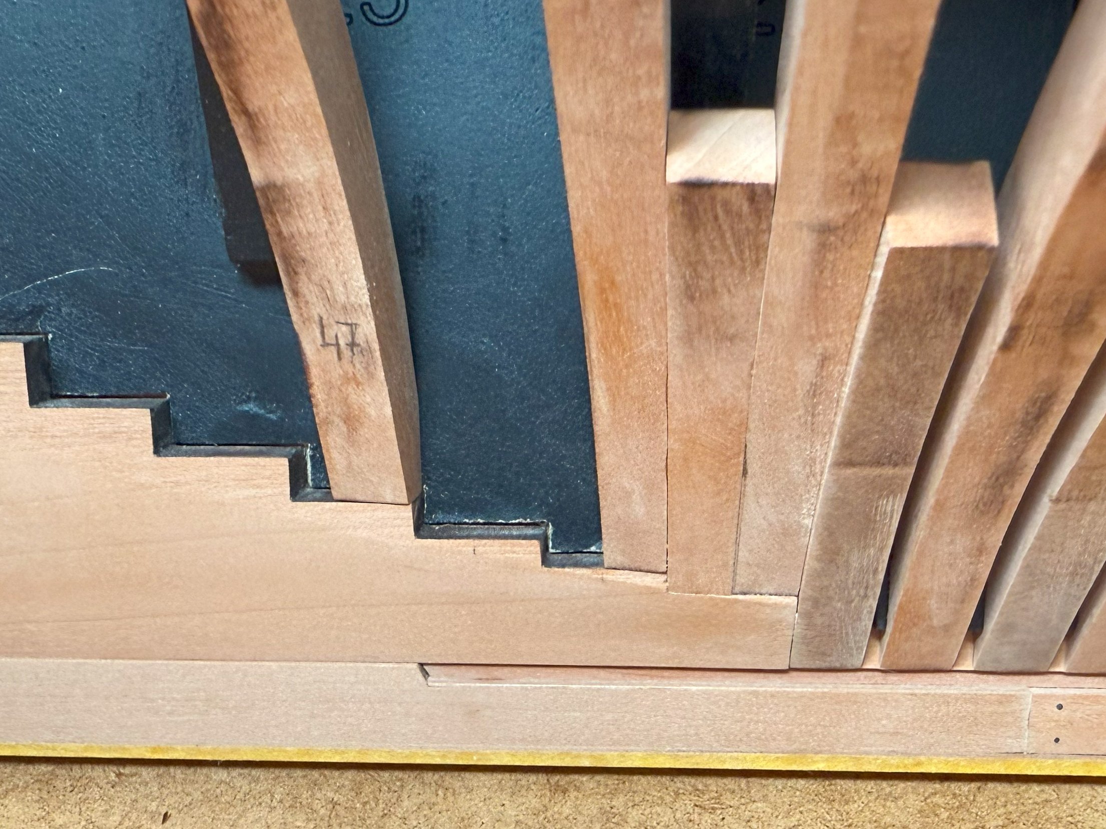

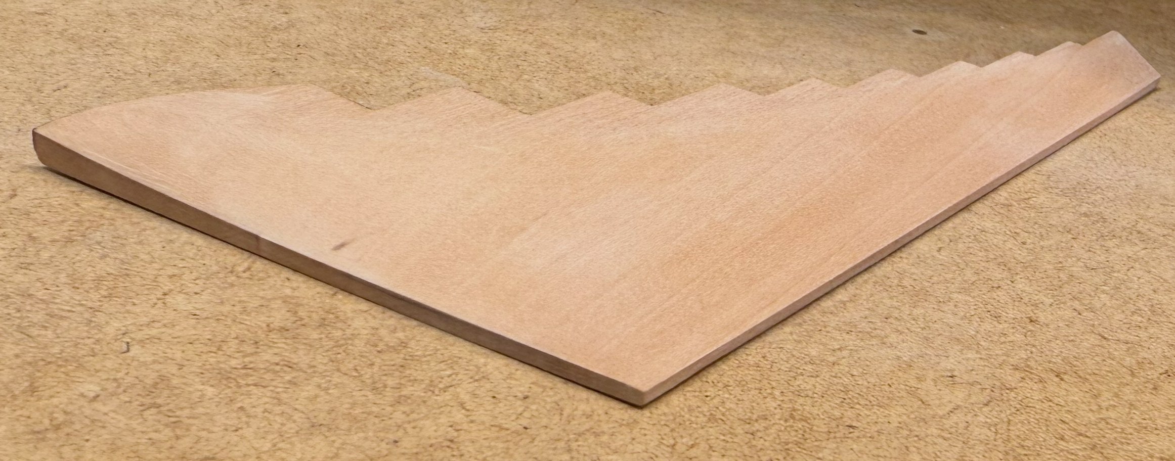

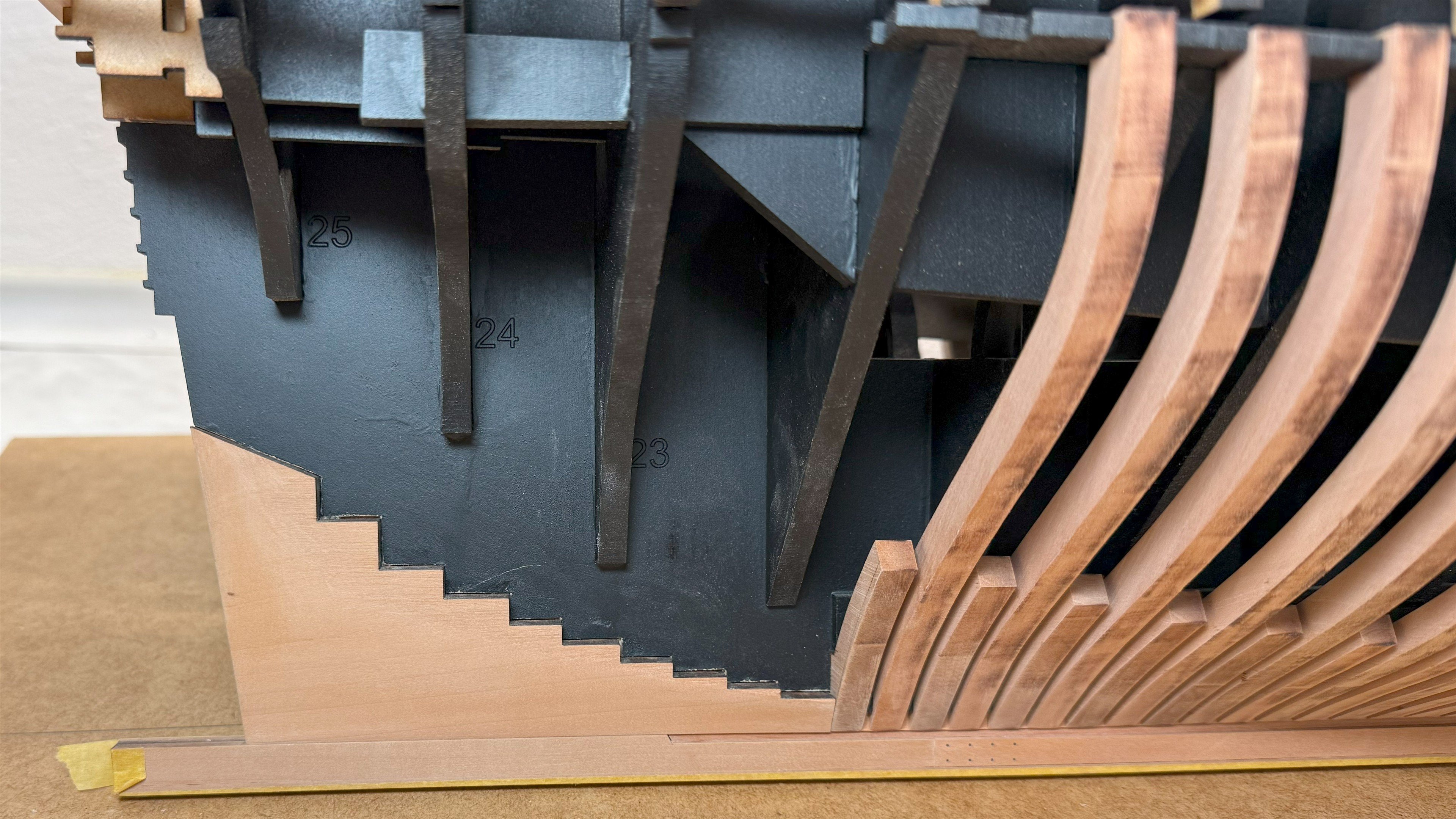

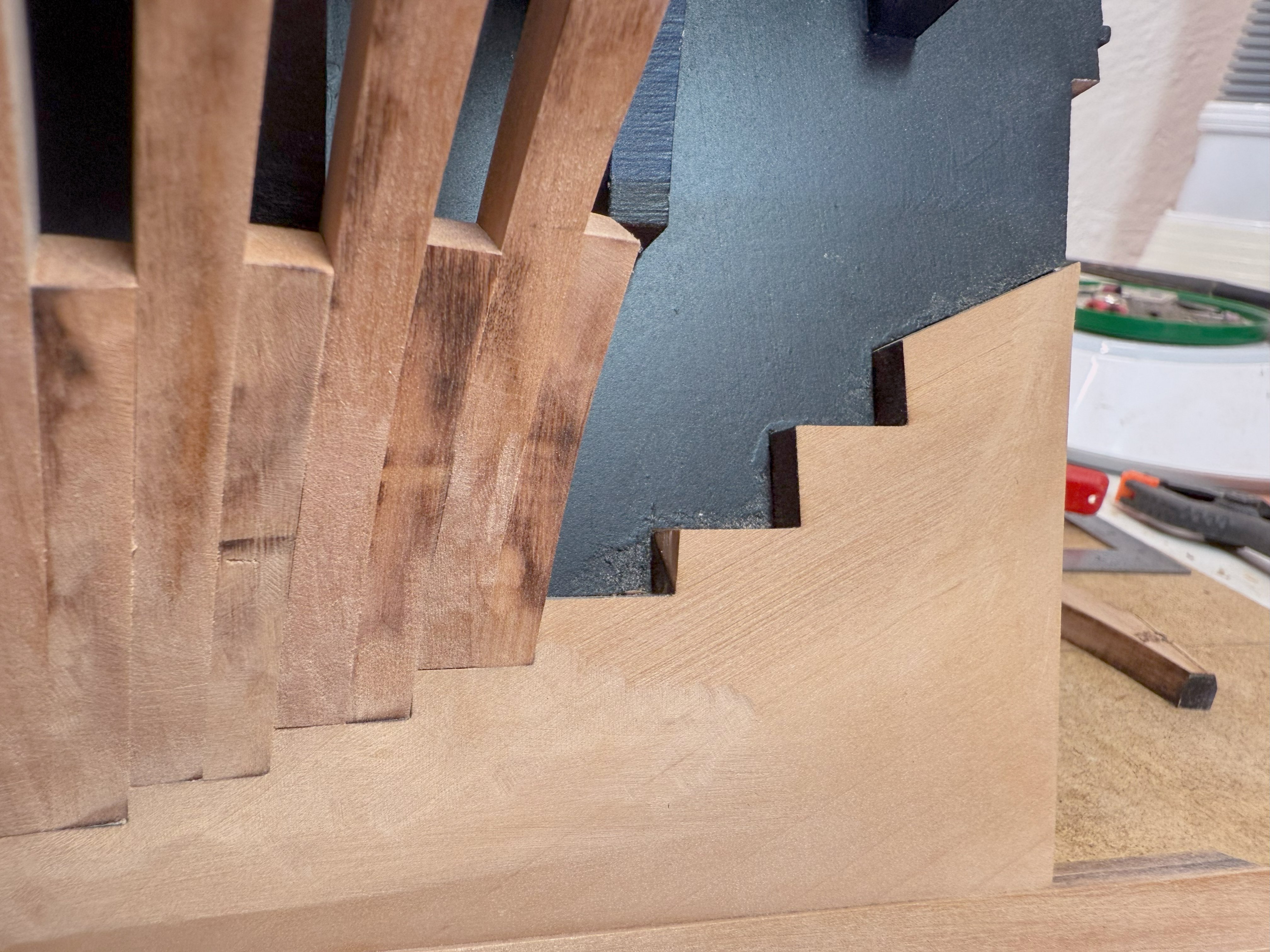

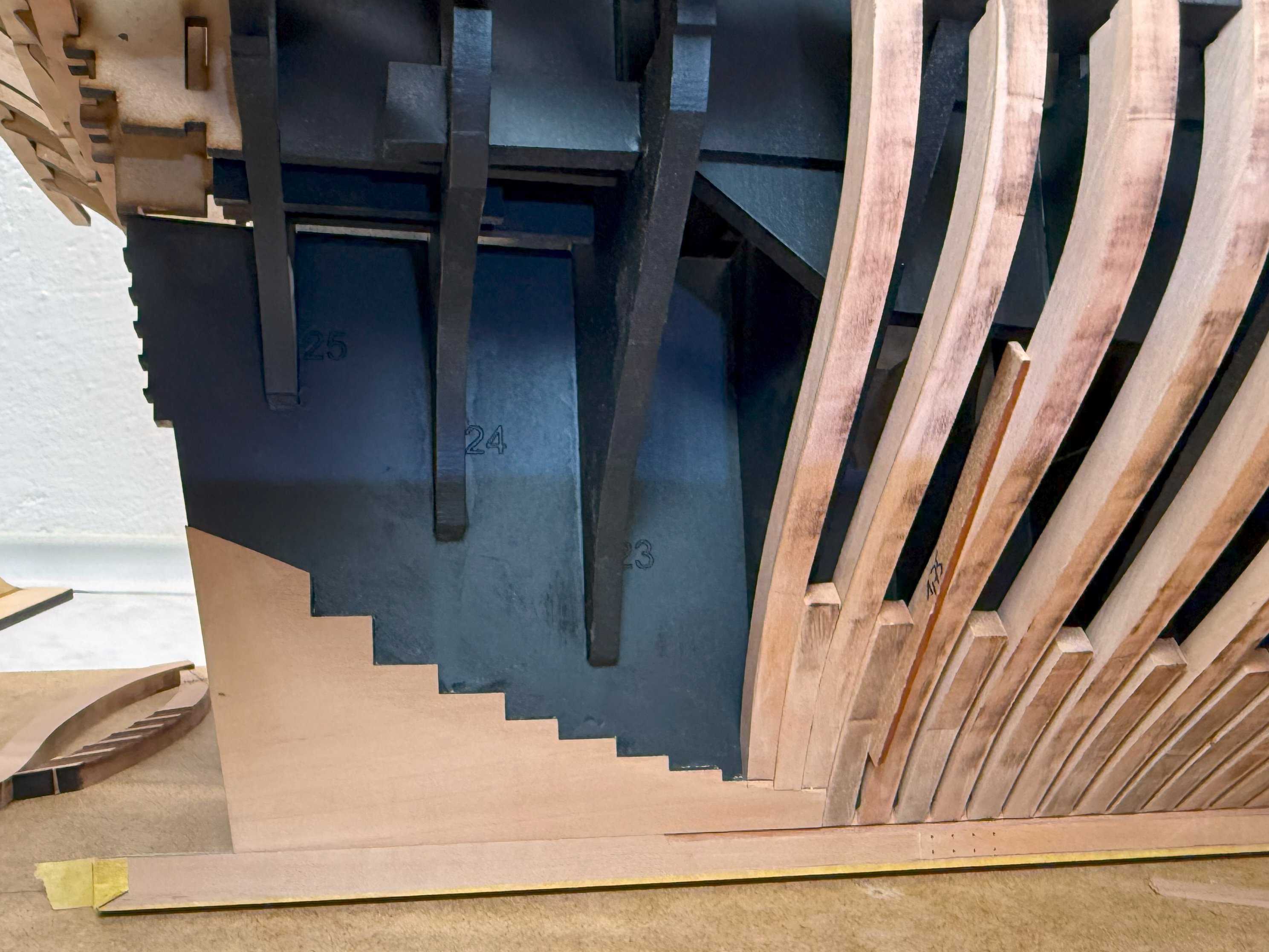

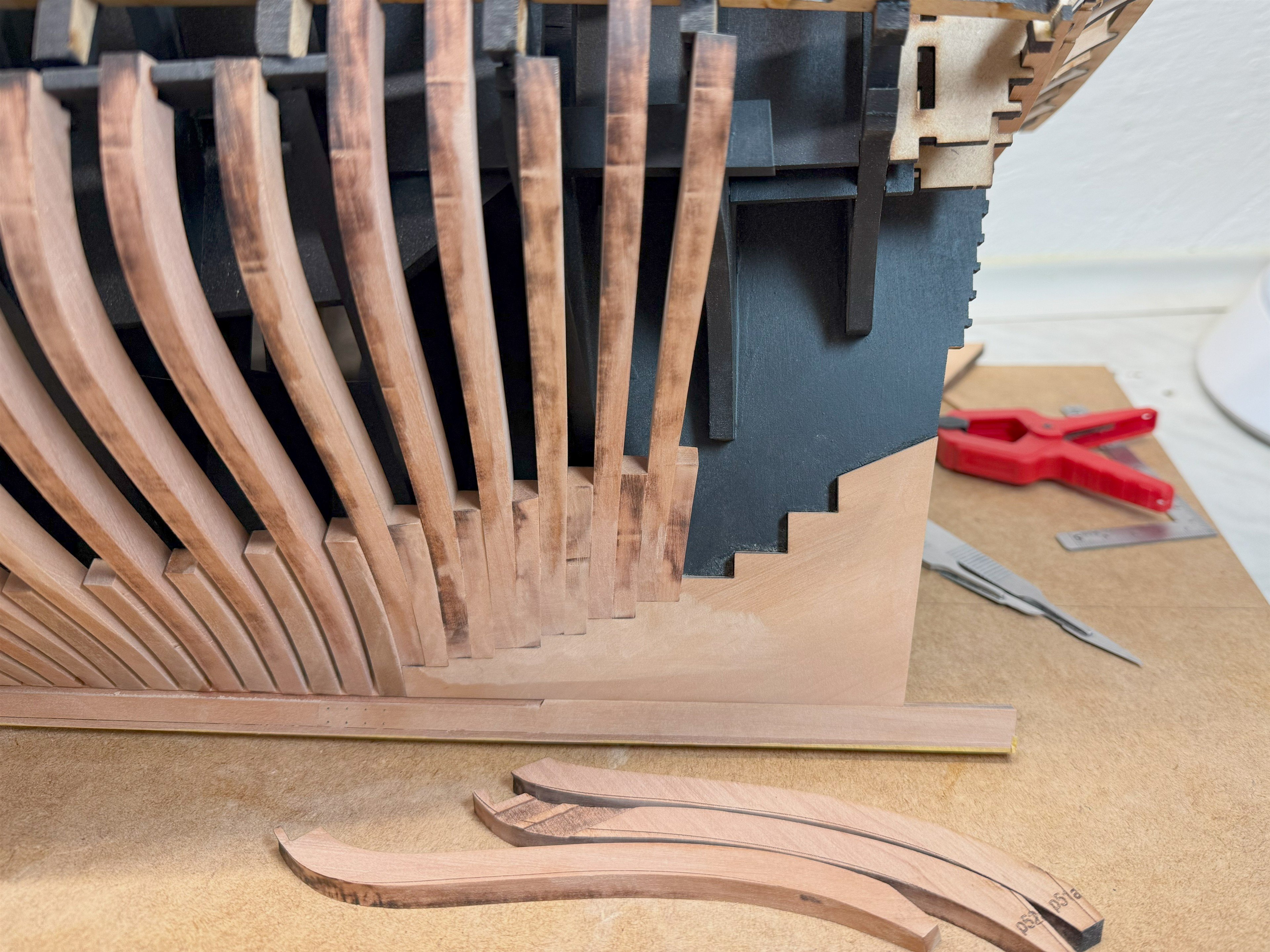

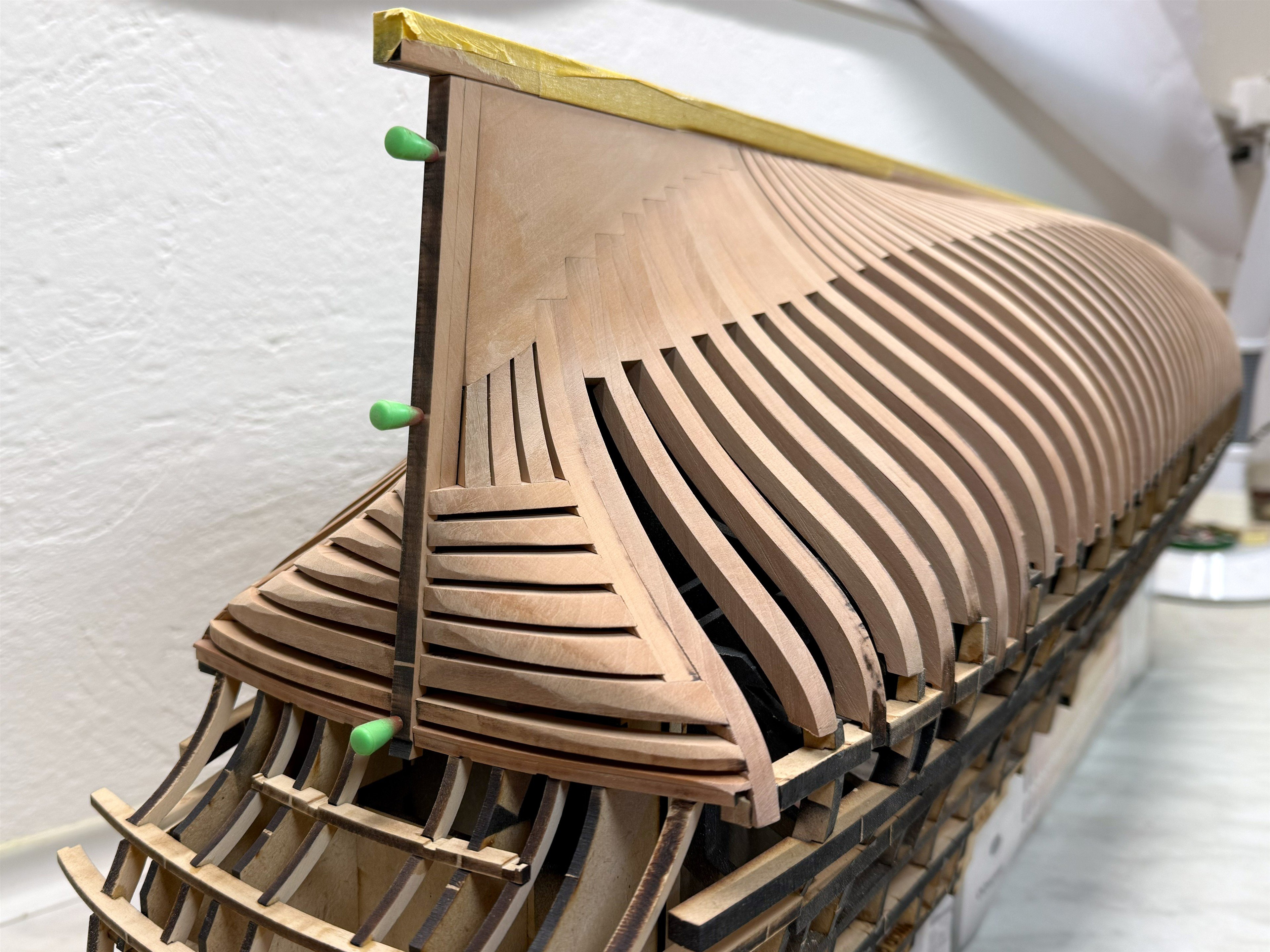

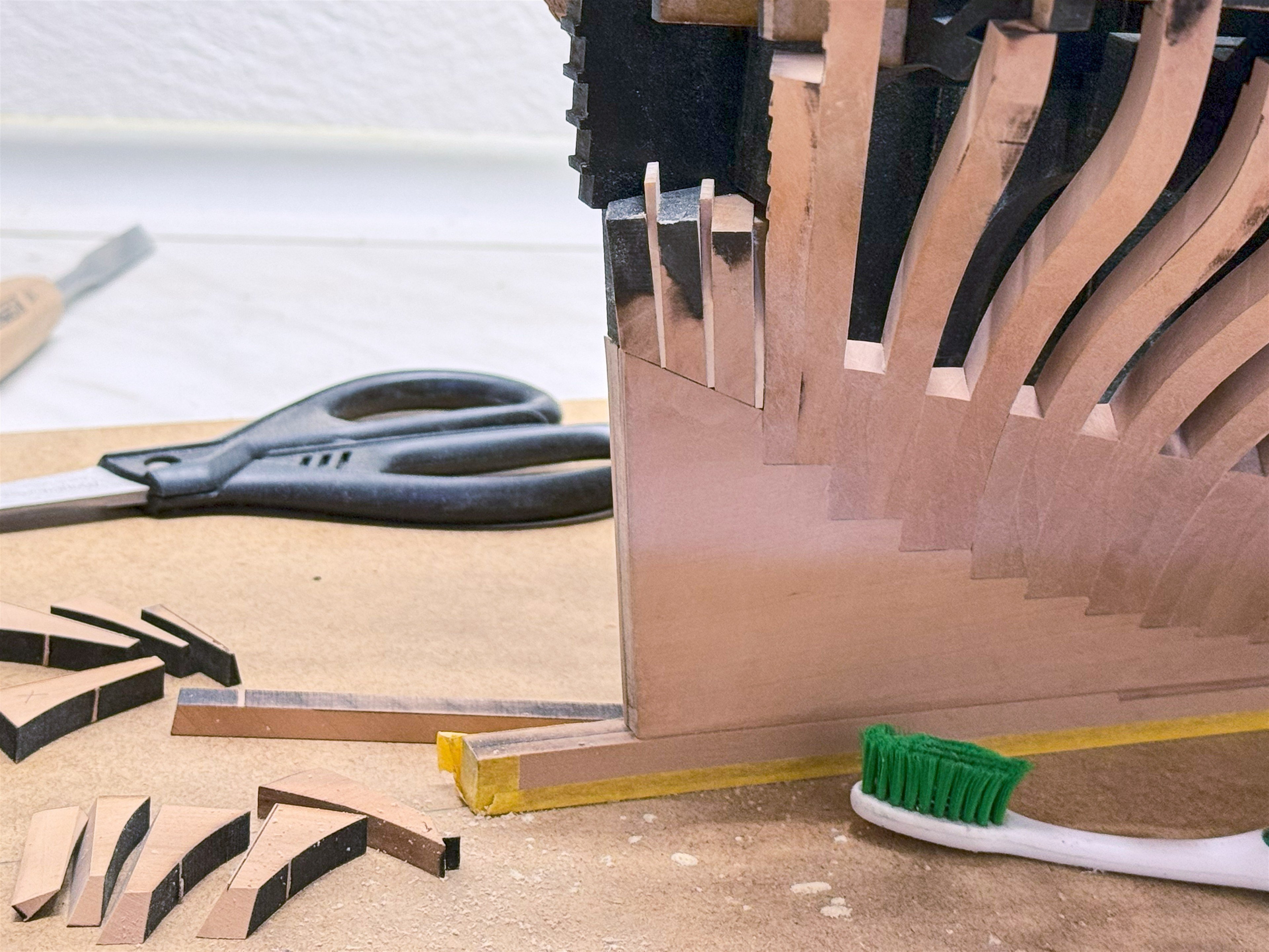

Hey guys
My weekend was all about building

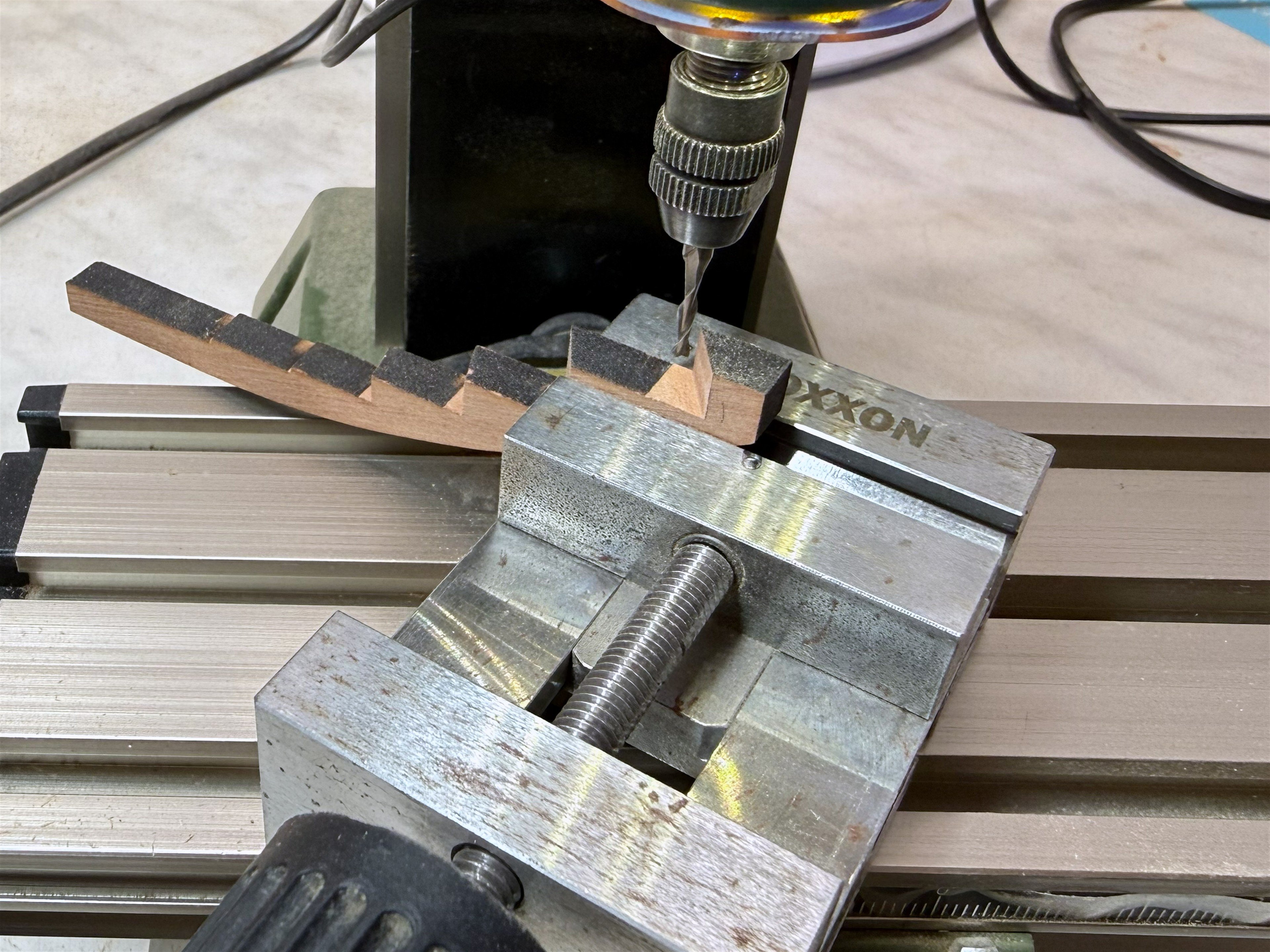

There was lots of sanding, testing, sanding, testing...
I just hope everything will be okay after the final fairing.
And I hope the wing transoms finally fall into place properly, too.
But that will happen after I've framed the starboard side.

That looks really good Dusan! You shouldn’t have much problems with the wing transoms, there’s a lot of material there for a margin of error. You can sand off everything later that you don’t need.

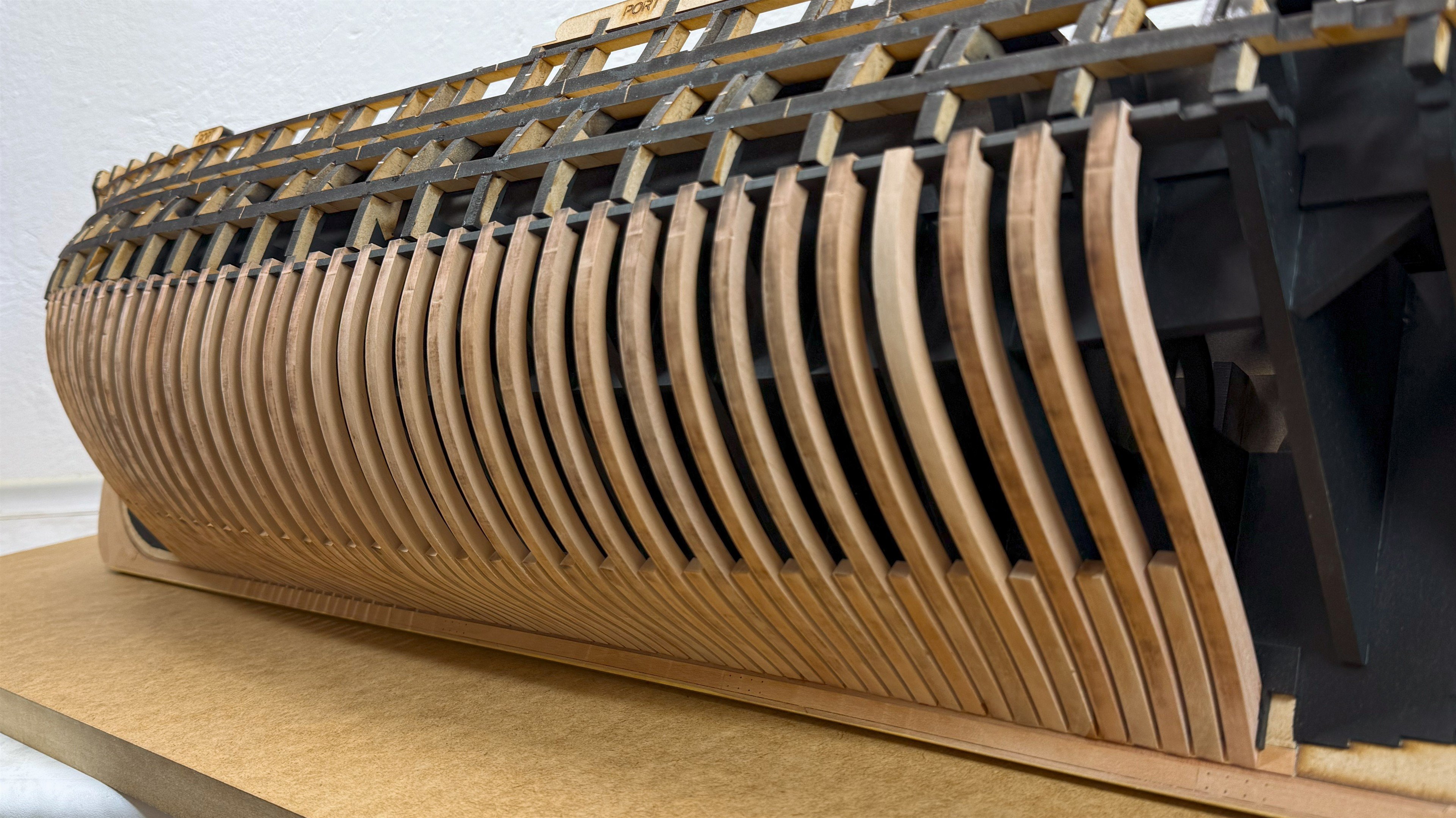

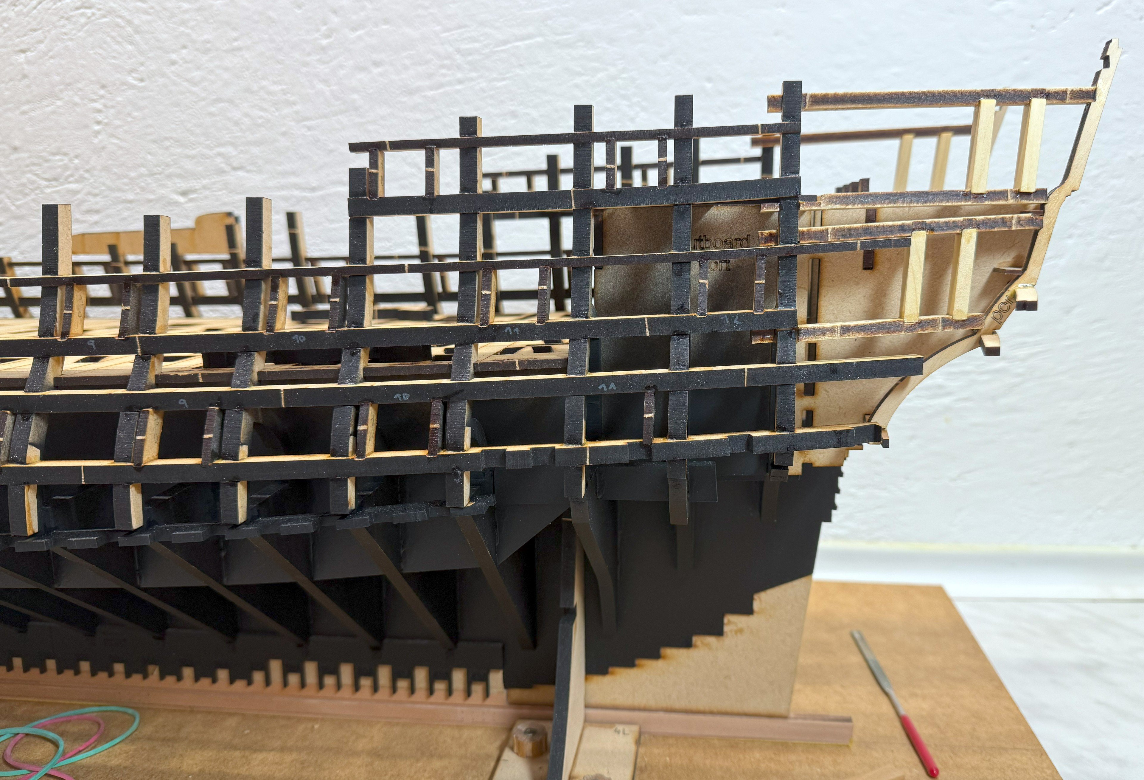

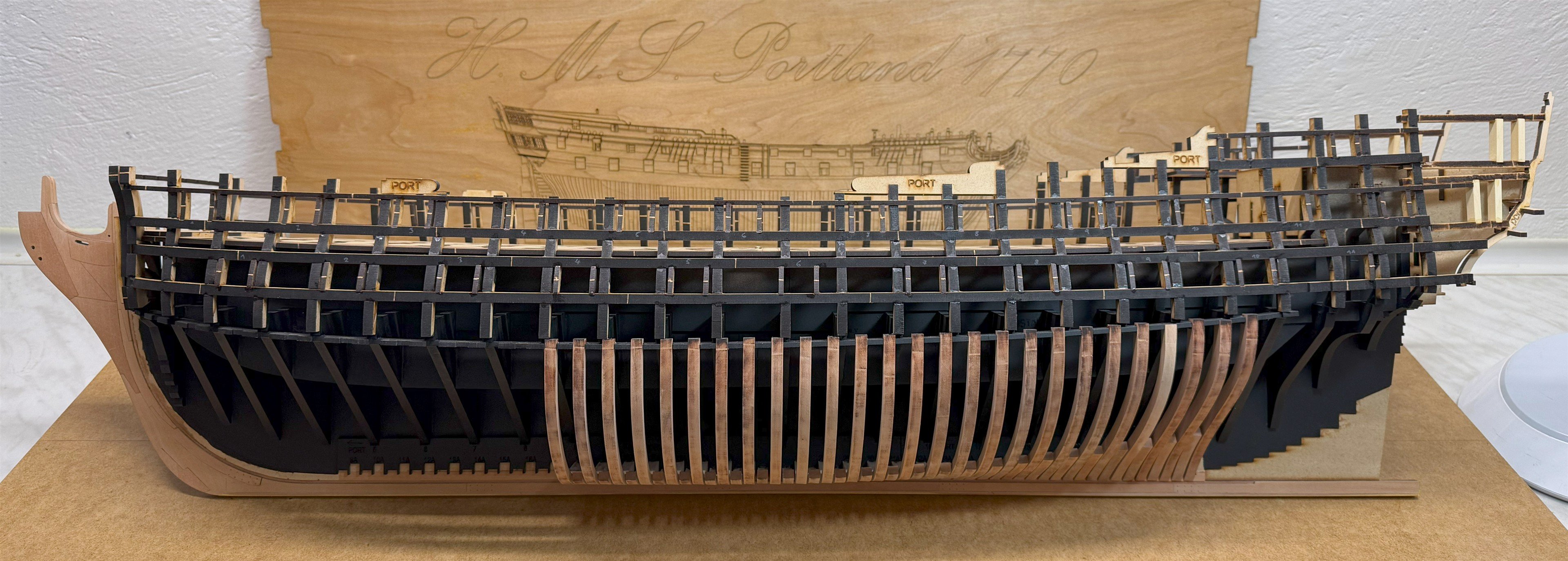

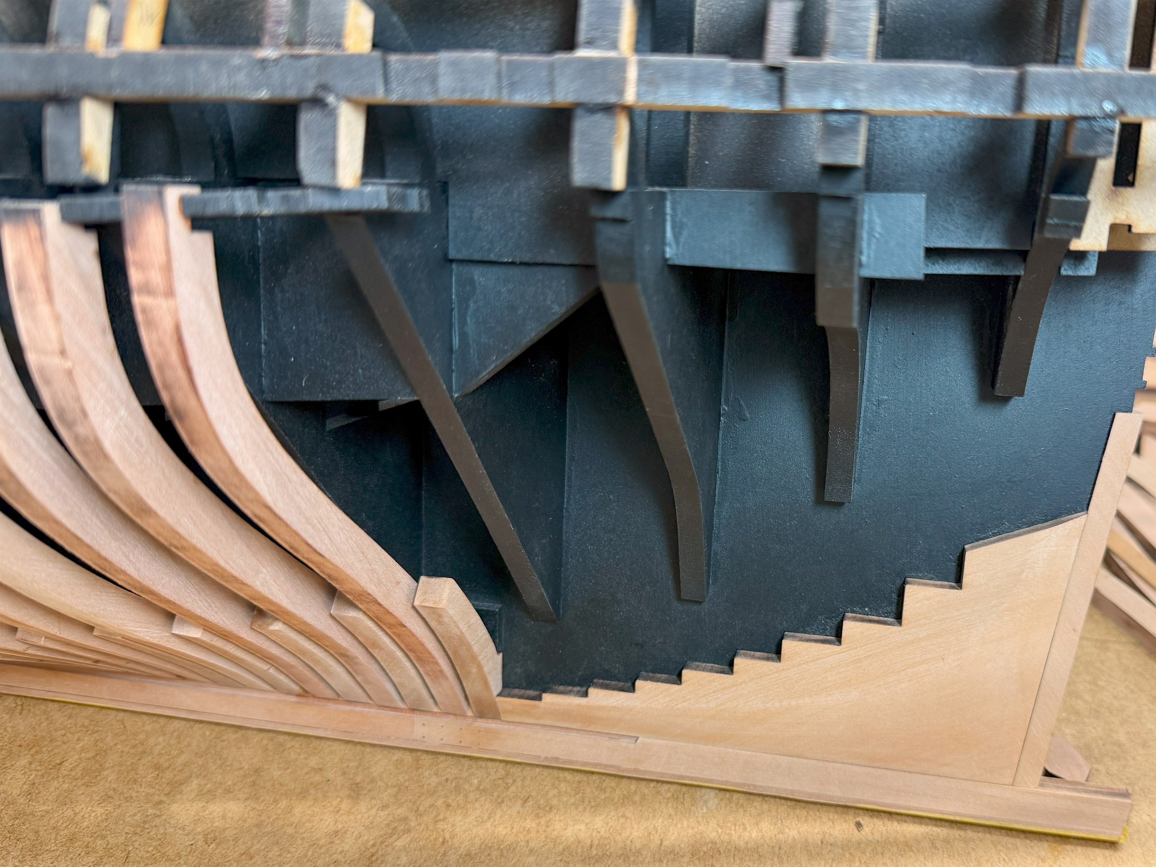

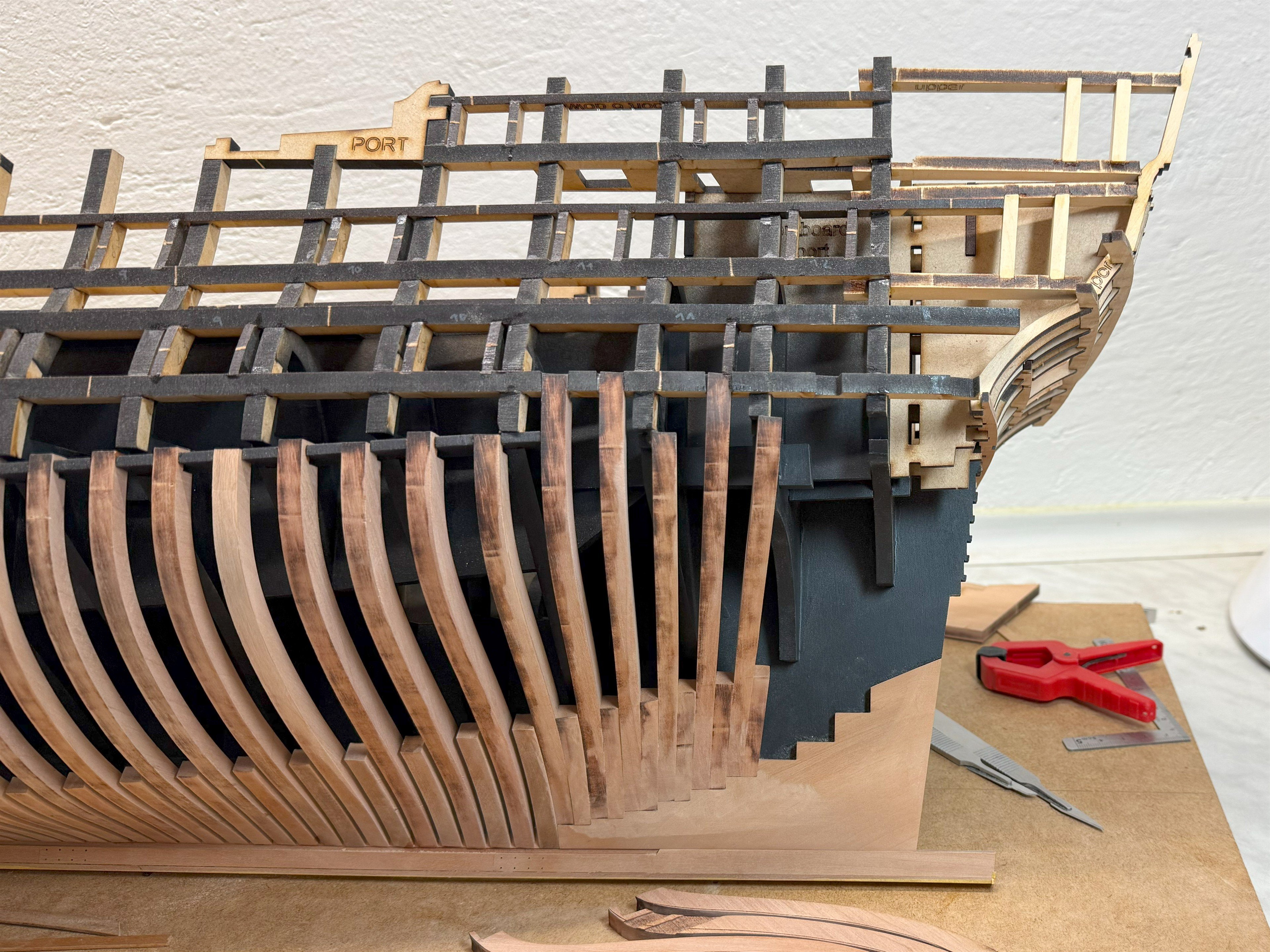

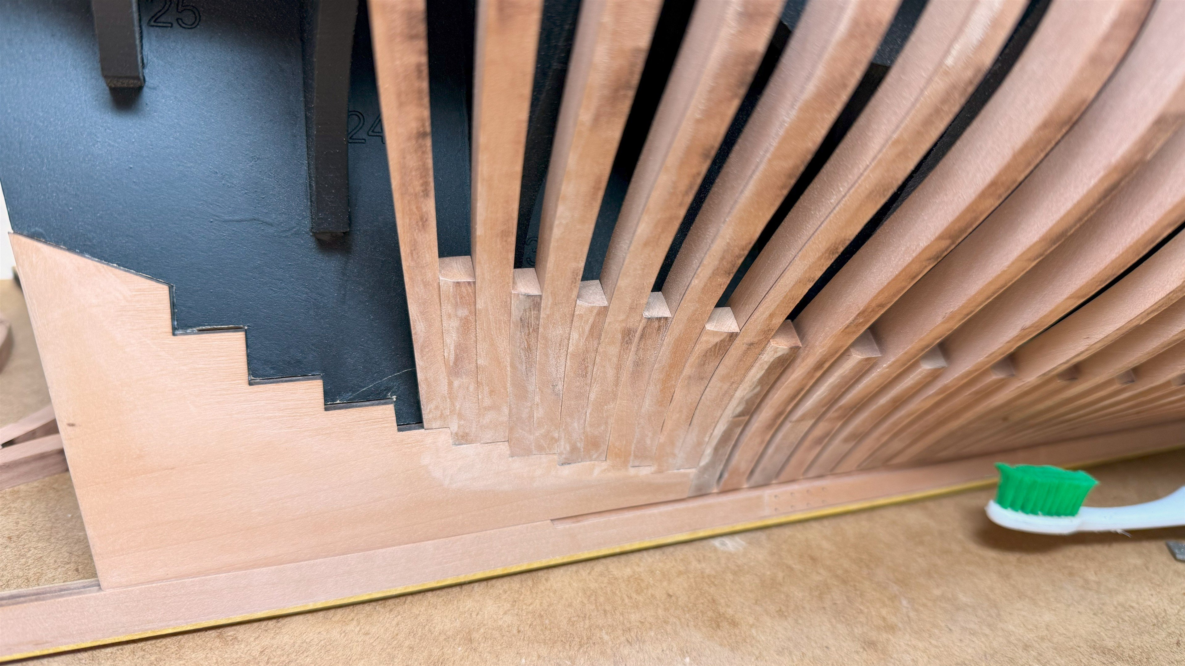

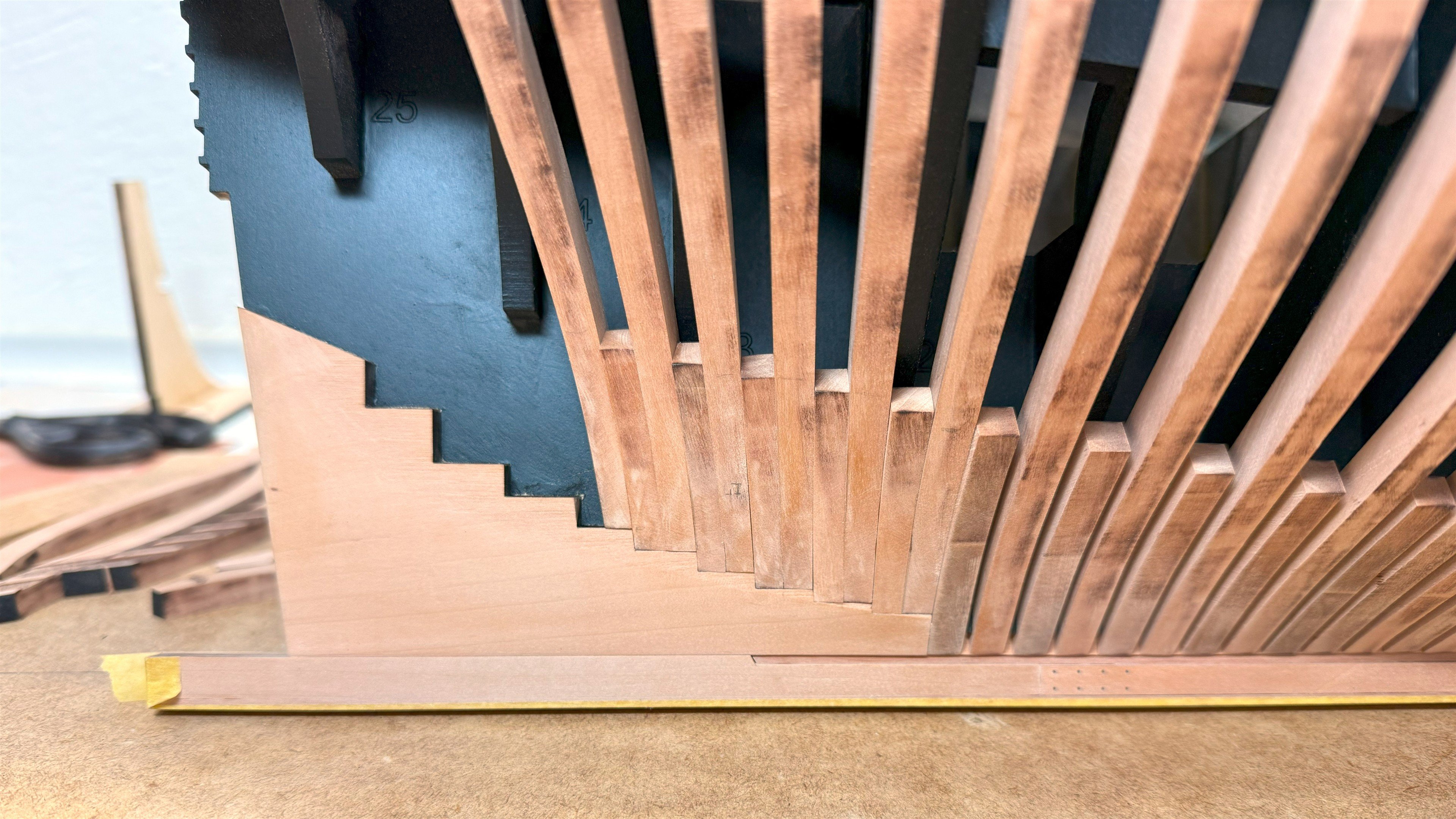

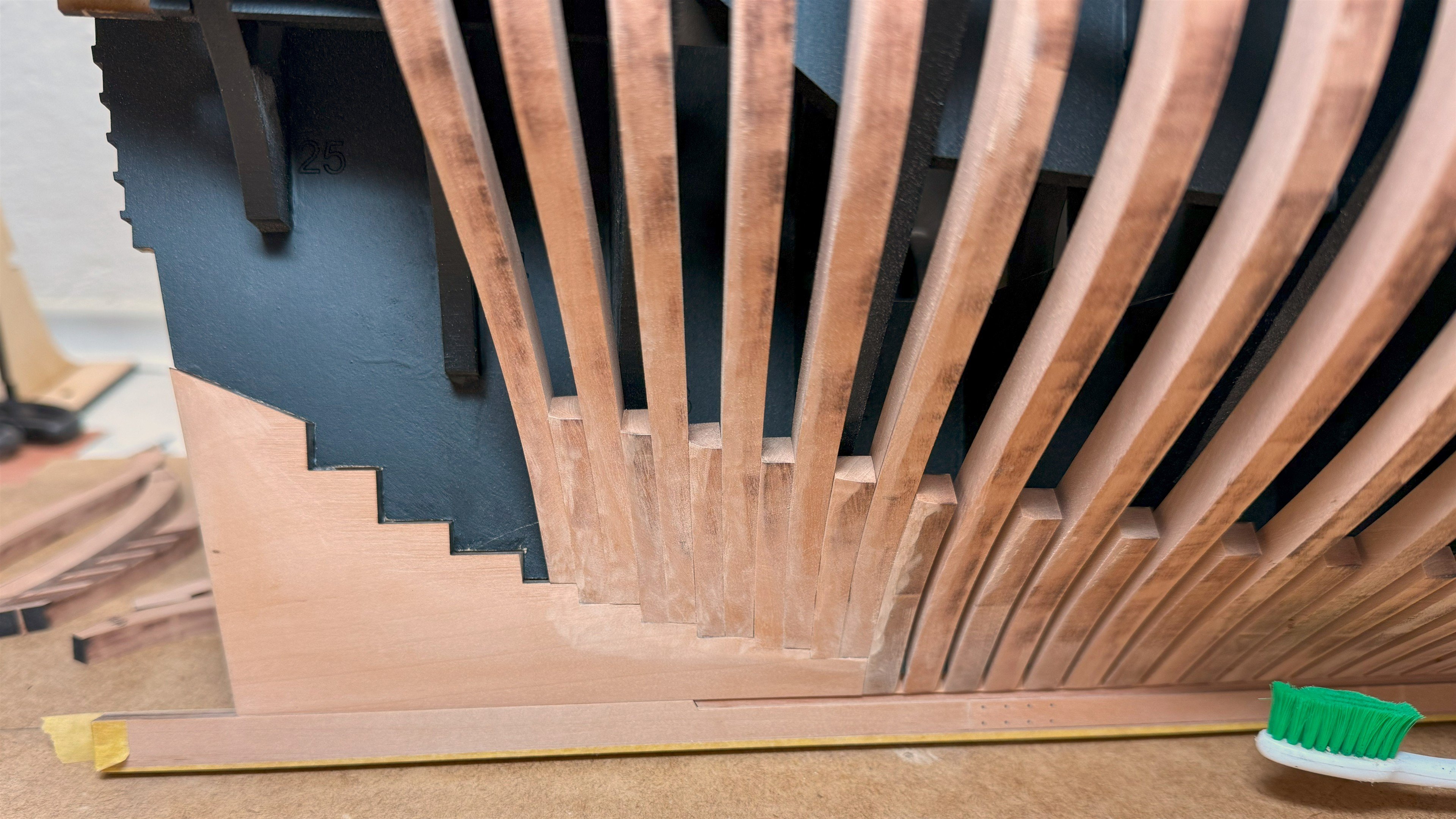

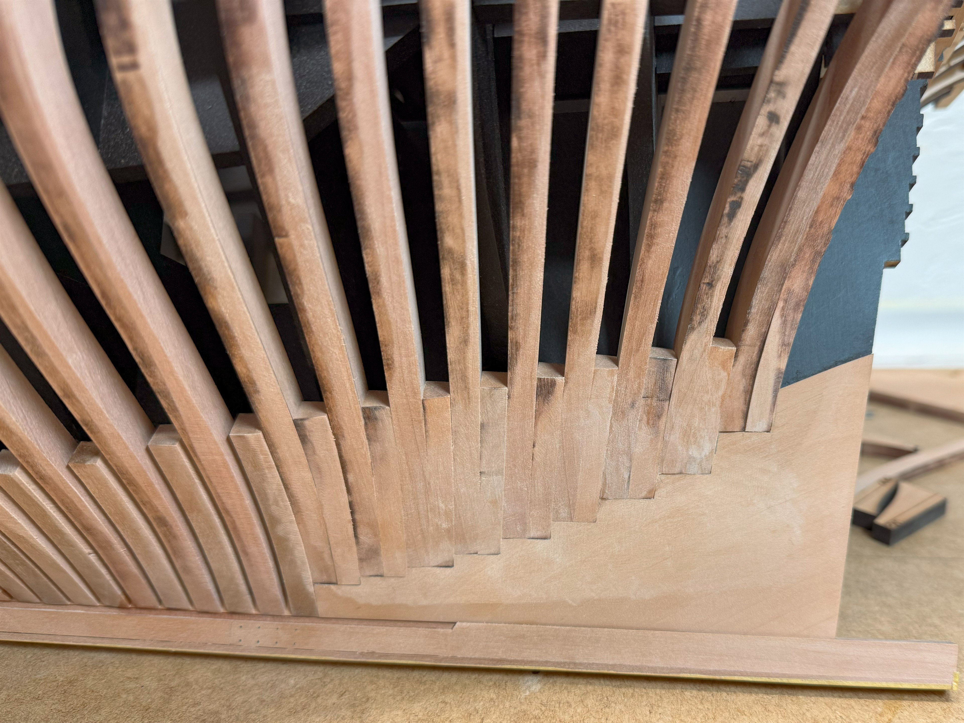

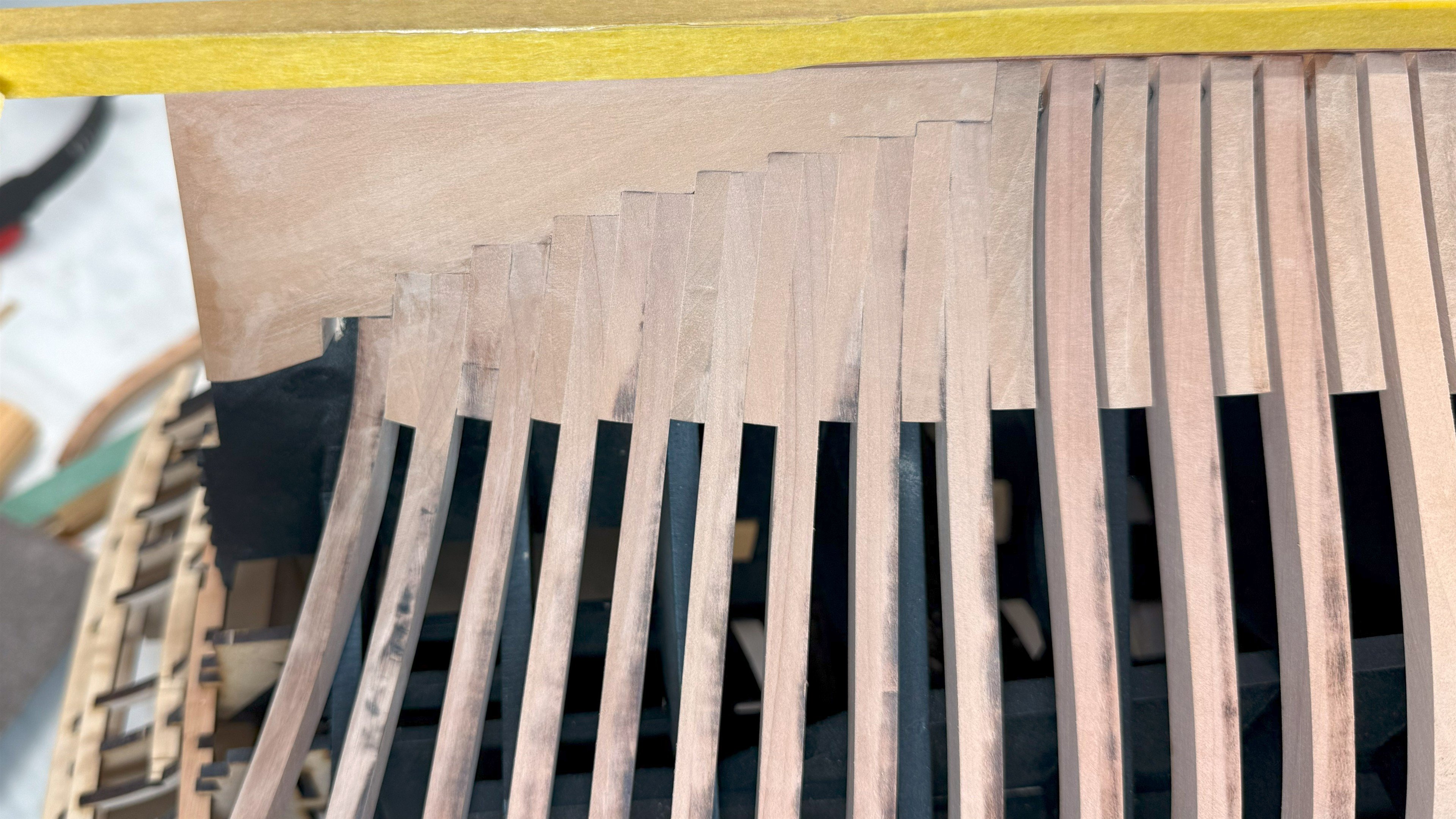

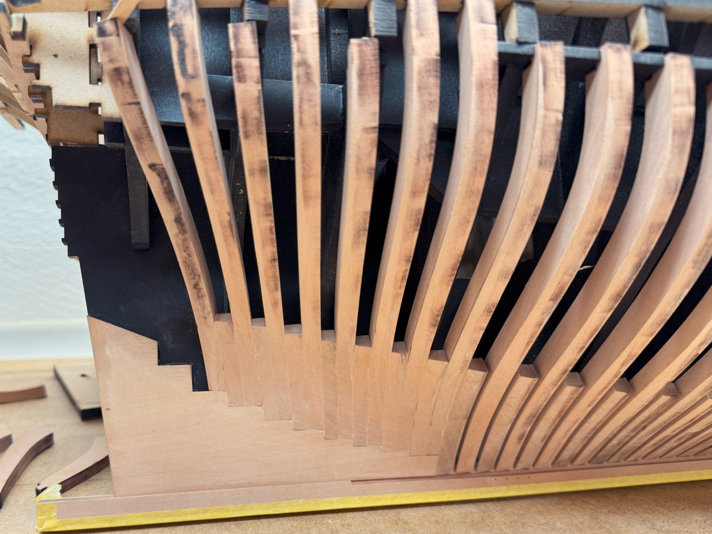

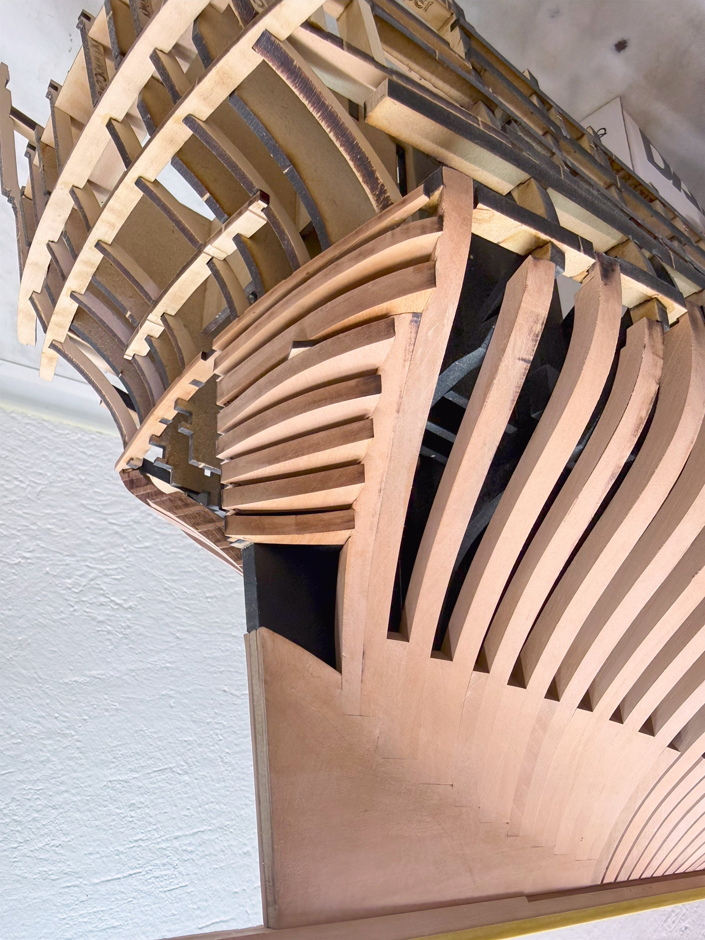

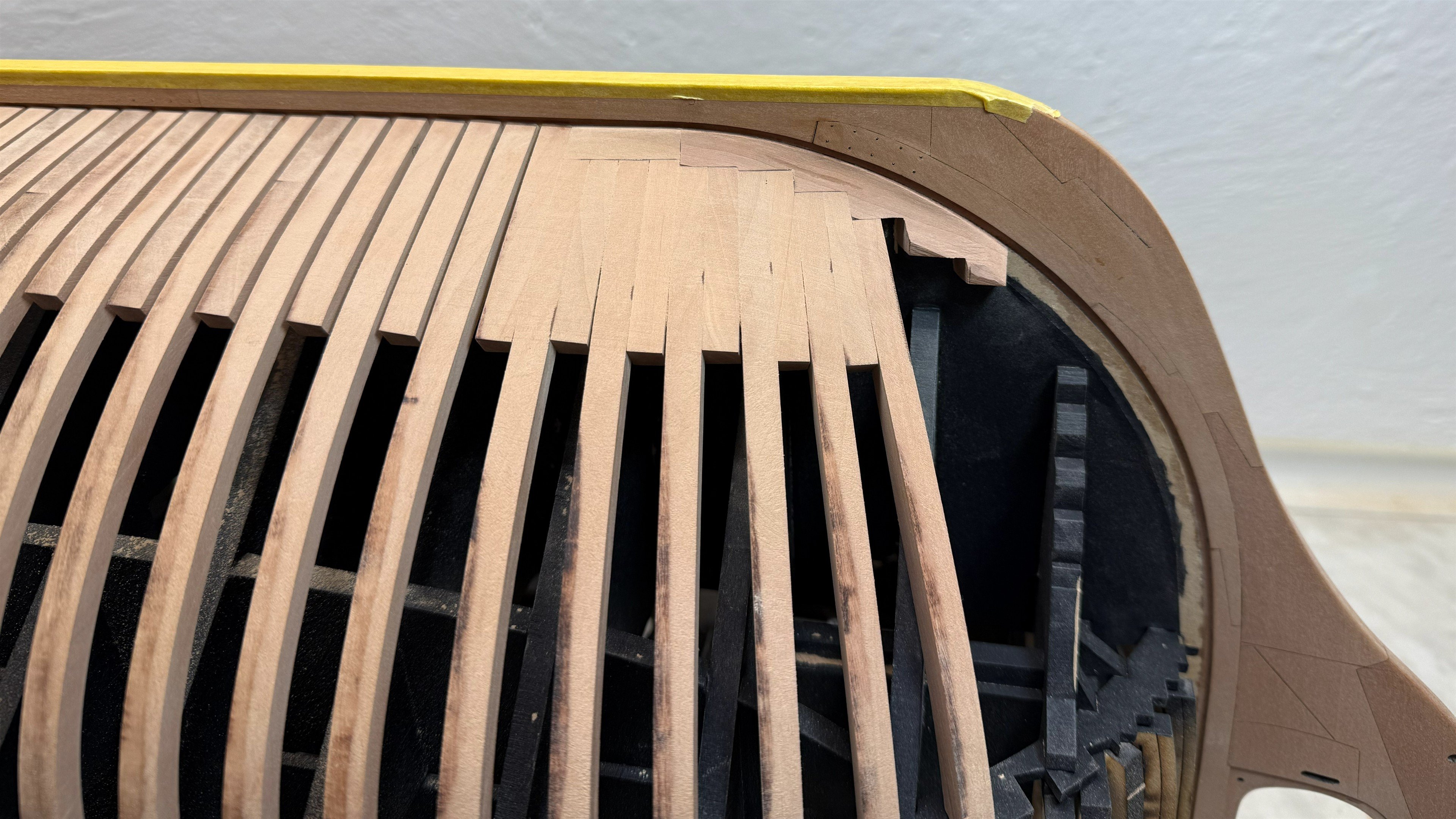

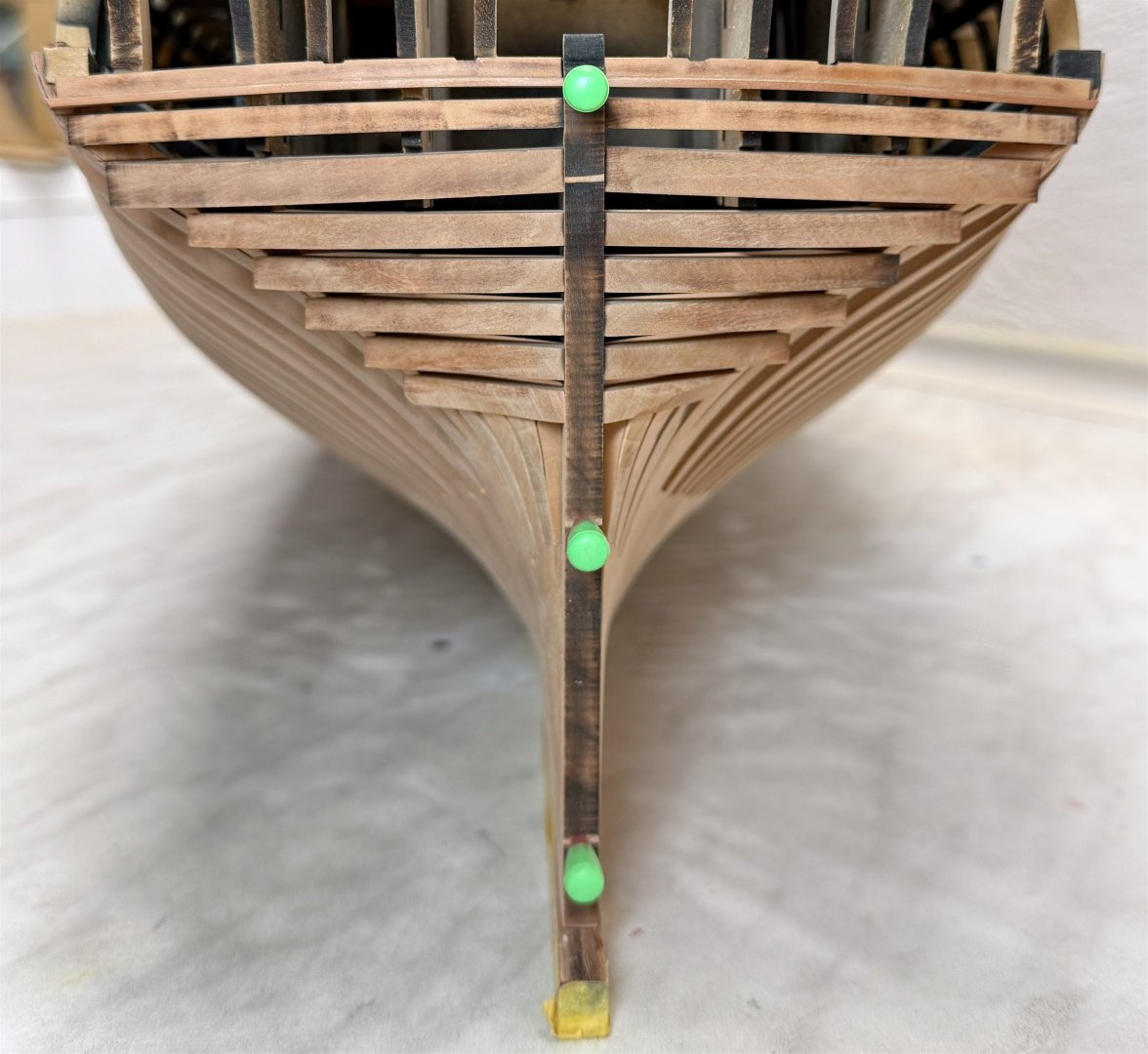

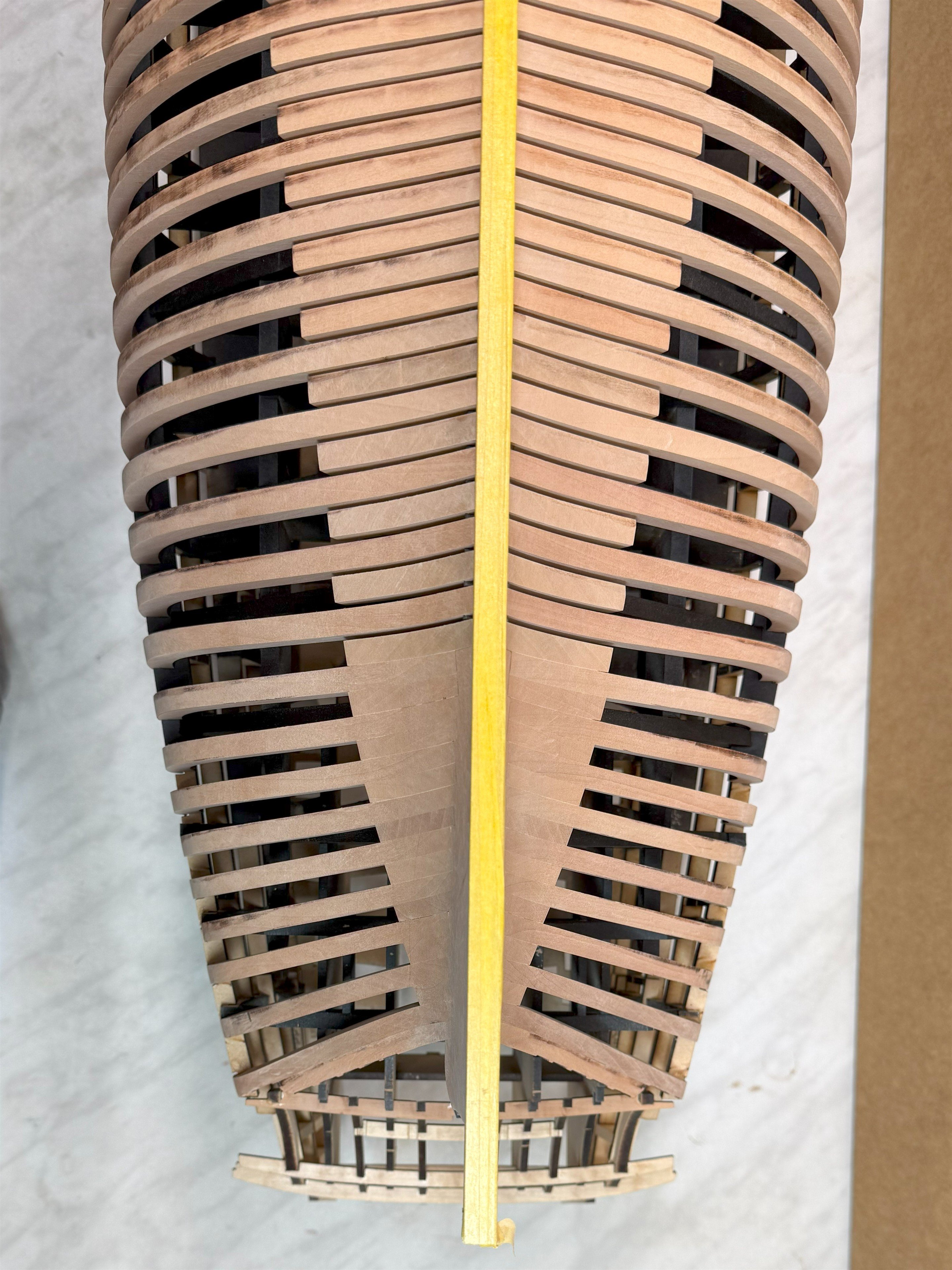

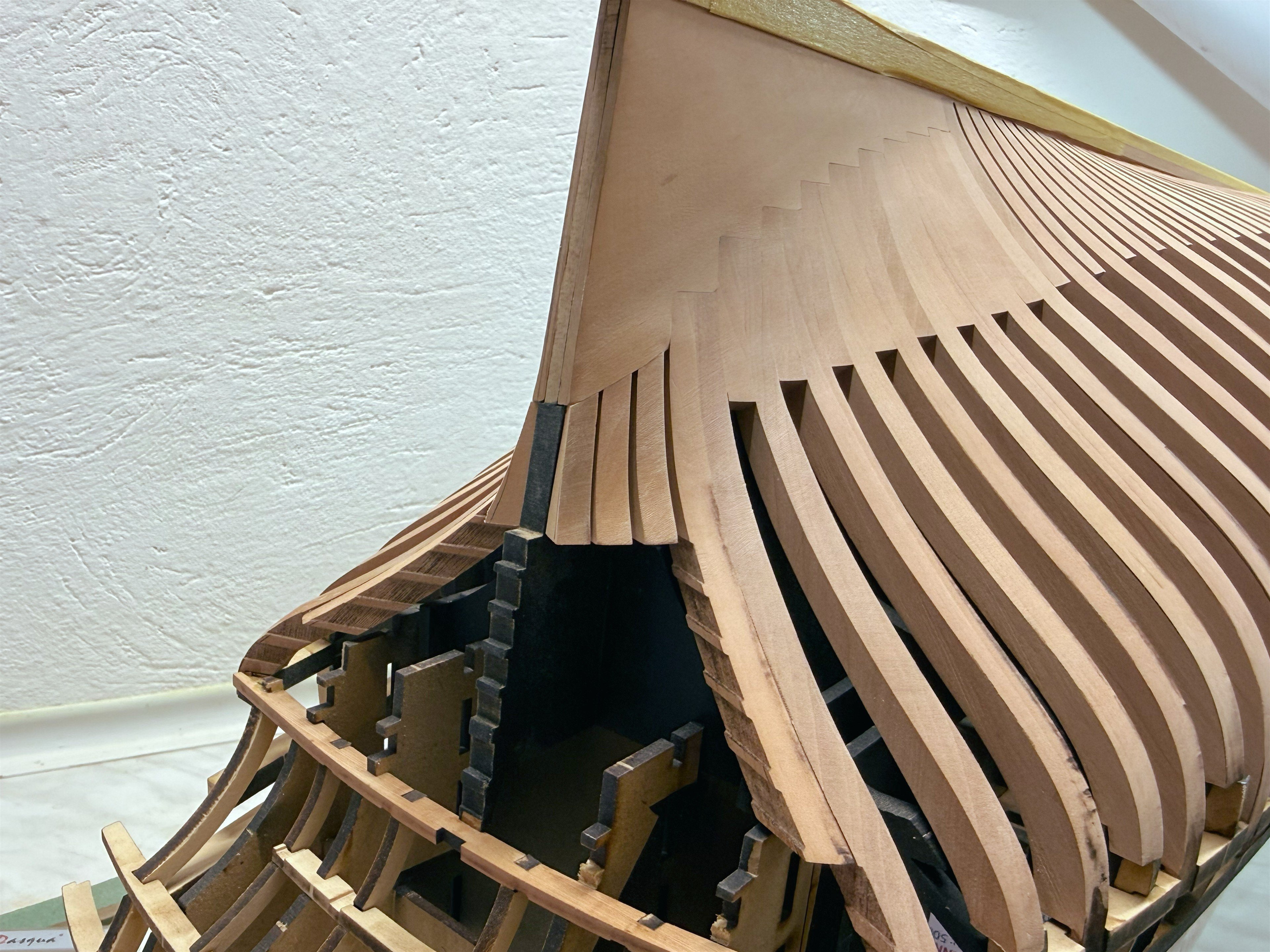

After taking a short vacation and devoting myself to other activities, I finally started building the aft frames on the starboard side.
But first, I partially sanded down the deadwood and frames on the port side to ensure that I could use the same assembly procedure on the starboard side.
IMG_6341.thumb.jpg.b07a6180bfbb2512349336d5fe8855ab.jpgIMG_6349.thumb.jpg.7ae2583467aeab28037b2384d33c2263.jpgIMG_6351.thumb.jpg.18f877481f52bca6572d455d8ba4826c.jpgIMG_6352.thumb.jpg.7aeb51bbdf45f581dbe96391d1a80feb.jpgIMG_6528.thumb.jpg.4dd069b7ecc66ca407da5284357563b7.jpg

On 6/22/2025 at 11:03 AM, westwood said:
However, I made some minor alignment errors, so hopefully that won't be a problem later.
can you elaborate as to what minor alignment errors you made, it may help some of us who want to build this avoid them in the future?
That was at the beginning, when I installed the lower frame holders.
Some of the bulkheads were not 100% perpendicular to the keel,
so I had to adjust the grooves in the holders.
The basic construction required a slightly different procedure than usual for kits where the bulkheads are gradually glued to the keel.
Specifically, all of the bulkheads were placed on the bulkhead former without being glued.
Then, longitudinal stiffeners are added to keep all bulkheads straight.
And only when everything is perfectly aligned  are the joints sealed with glue.
However, the instructions are well written, and anyone who starts building will know what I mean.
But you definitely need to measure three times and then once more before gluing :)

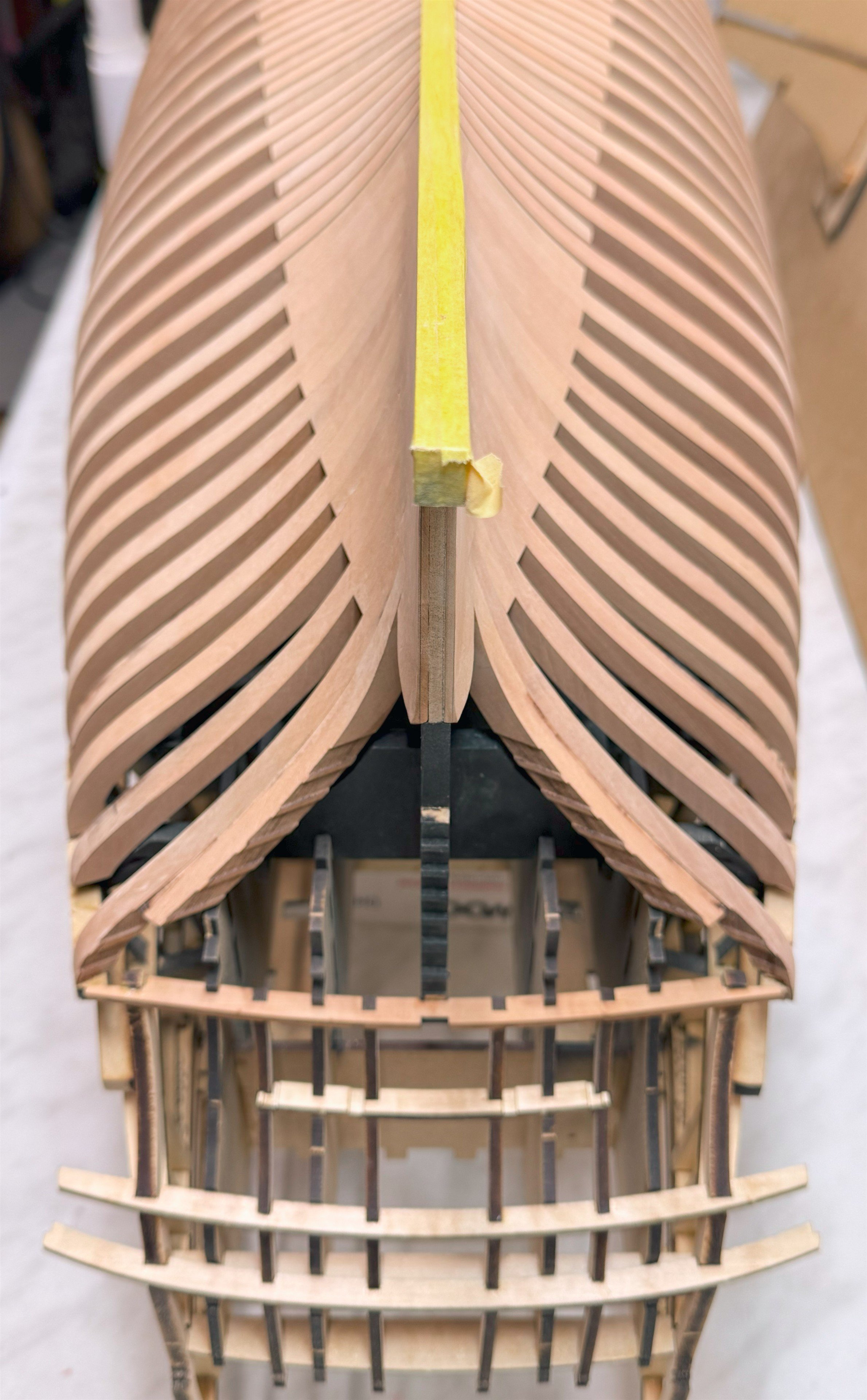

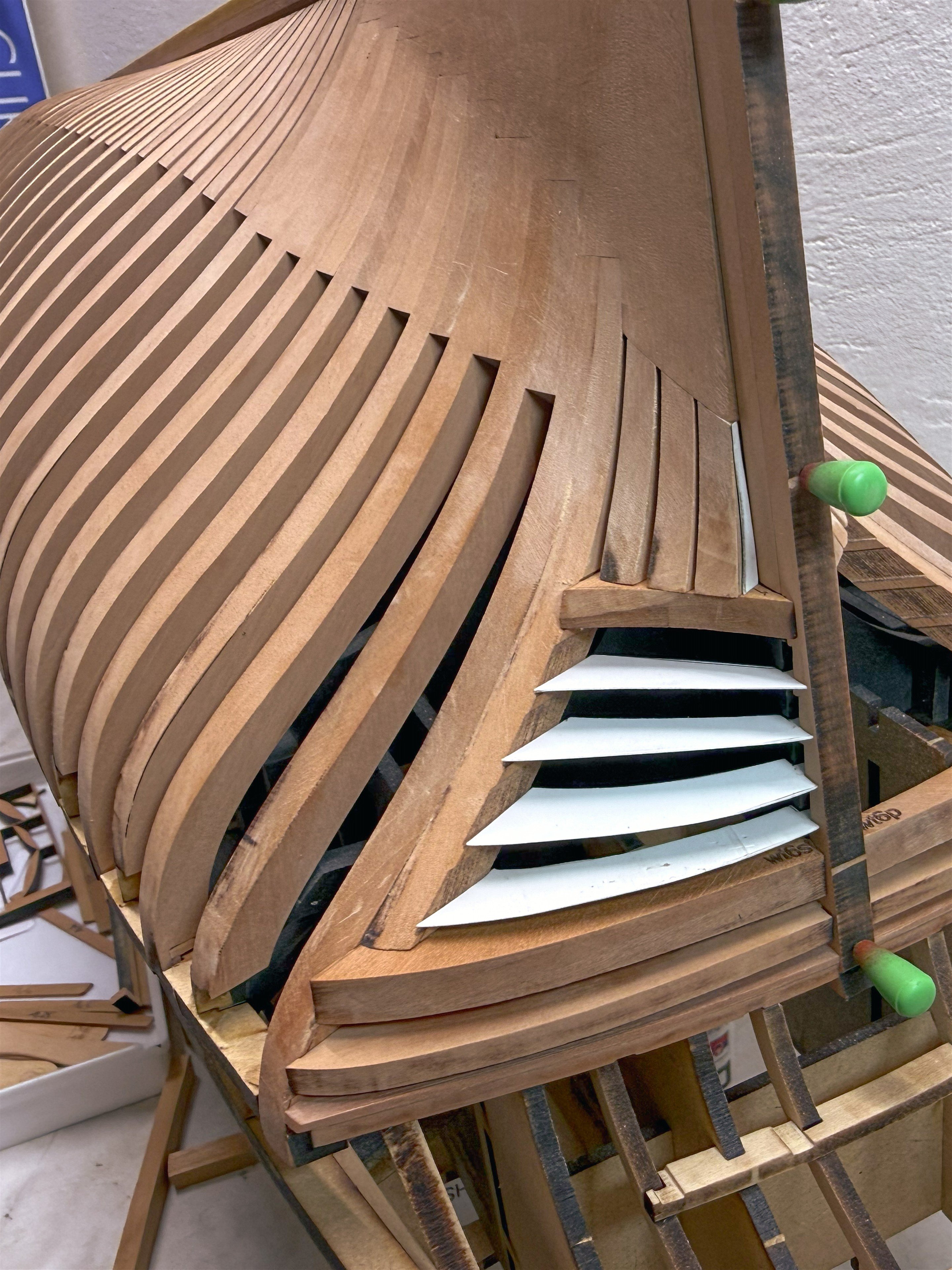

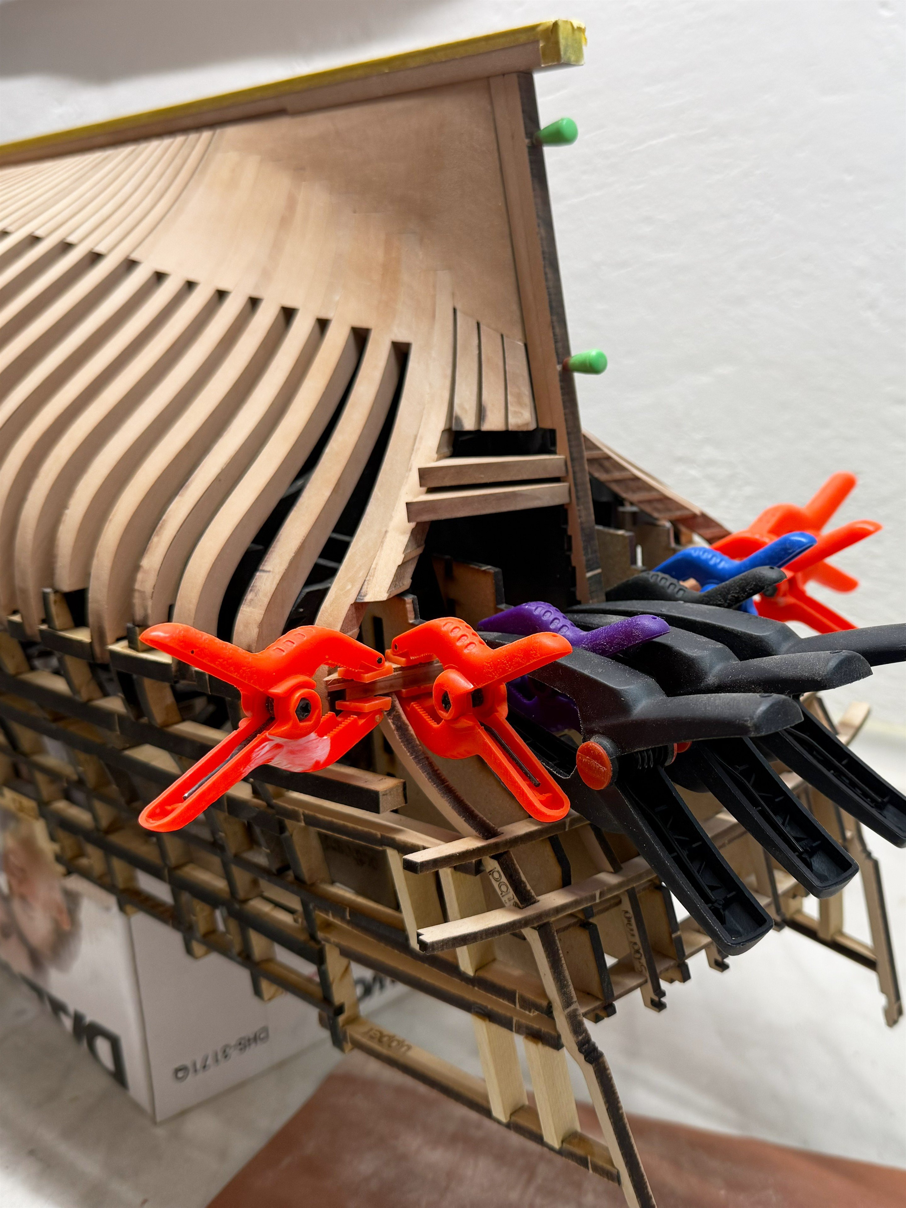

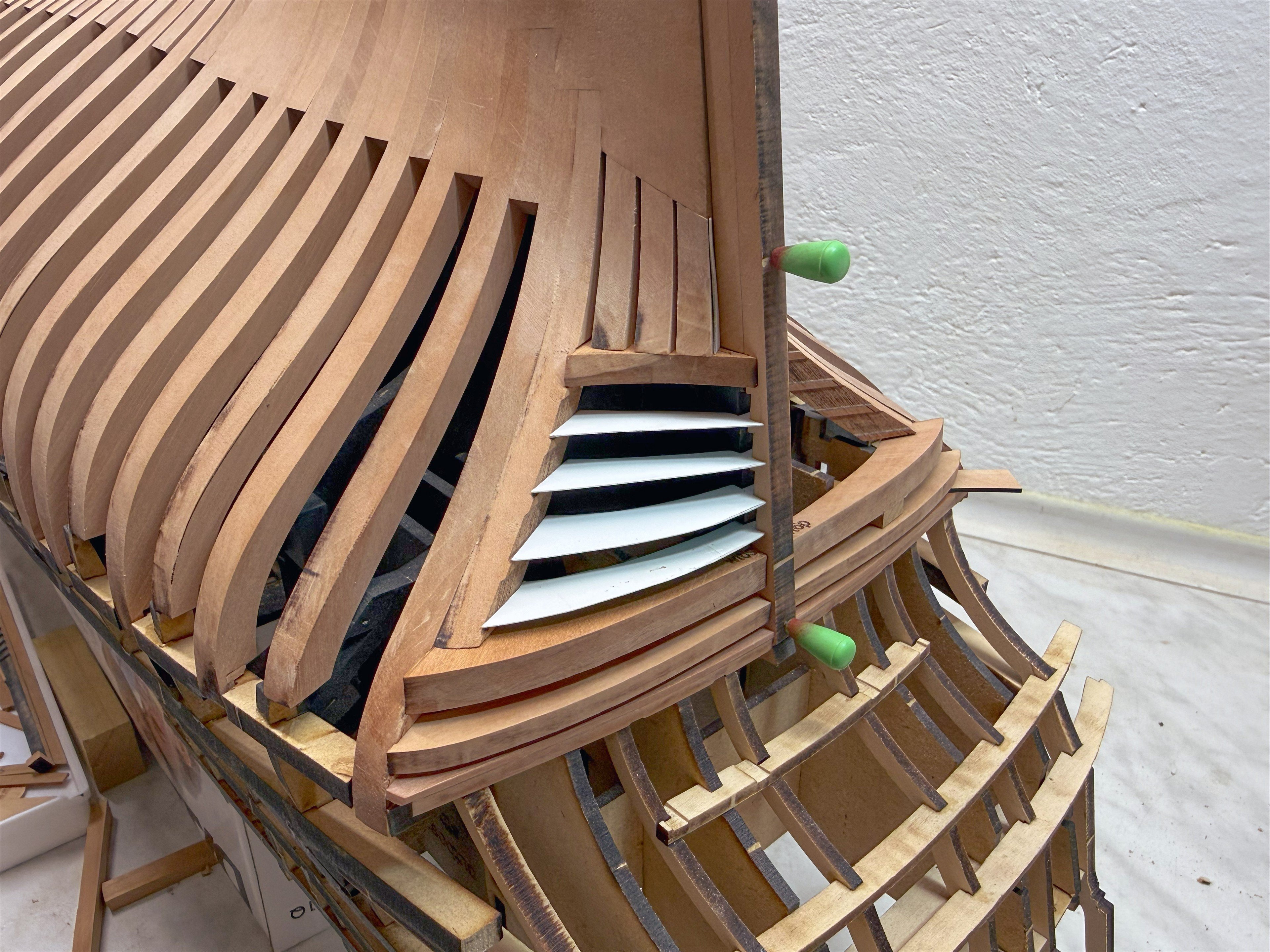

Hi guys,
I'm sorry I'm not posting more updates, but there's no end to the housework before winter.
But here's a small preview of what I've done so far.

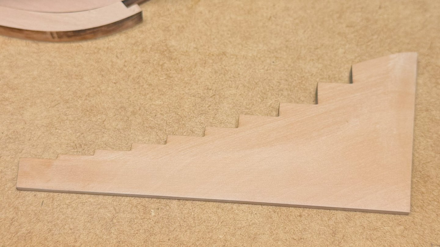

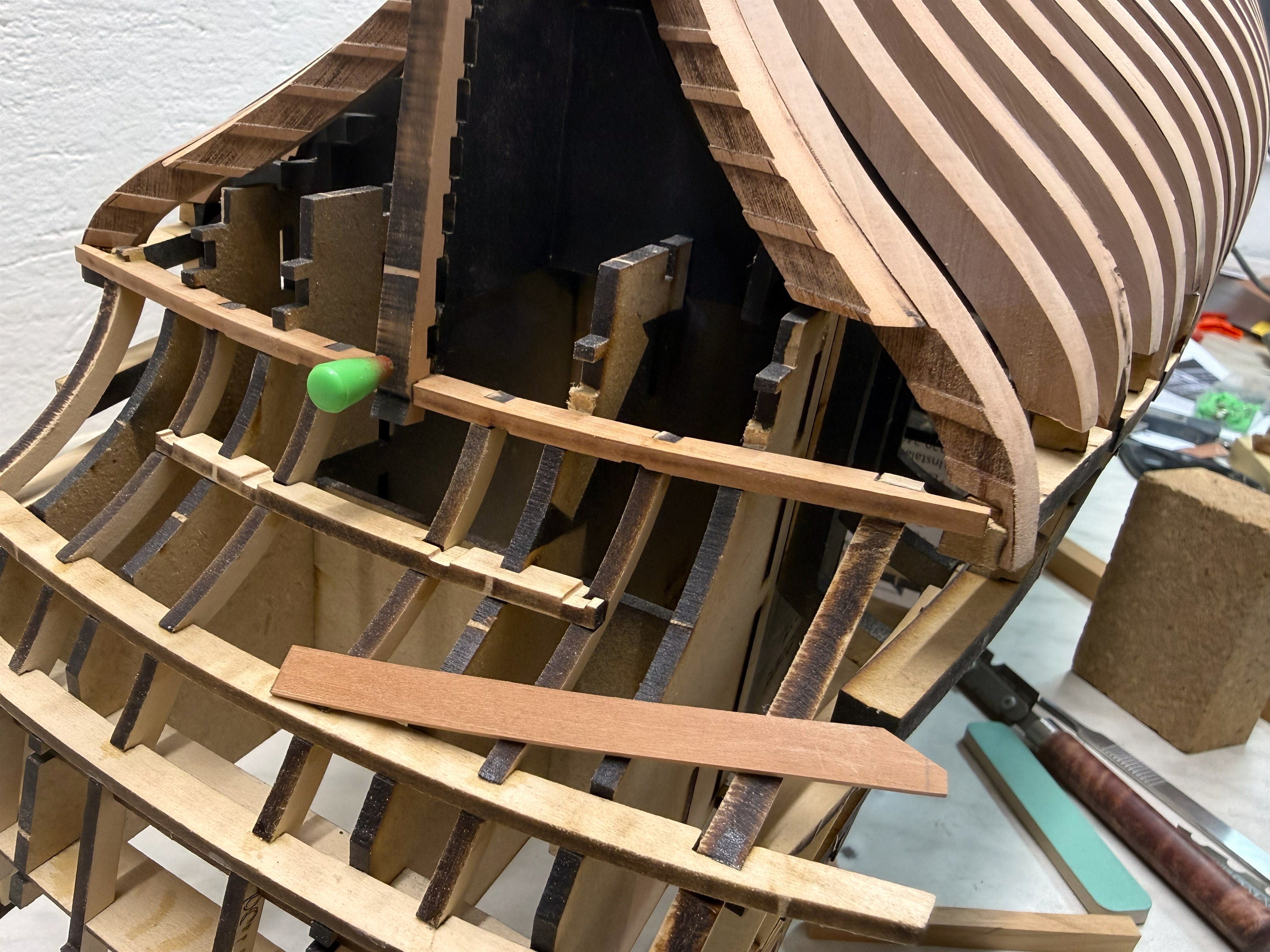

I took a slightly different approach and did the vertical filler first.
The inner and outer posts is glued together, but  don't yet glued to the bulkhead former.
Then, I laminated the wing transom.
Now, I'm fine-tuning the other transoms...
IMG_67221.thumb.jpg.bdd12df929c492000fa76e0fe837ff37.jpgIMG_6723.thumb.jpg.fcc82a496b4f989118807b8105f3509c.jpgIMG_6724.thumb.jpg.00ffce712c47e8b4606c1ee6f8176d6e.jpgIMG_67281.thumb.jpg.a730f85ee0ff9f82041520508b7e6e70.jpgIMG_67301.thumb.jpg.4ab55d9414b6915ef9553c41e9103c33.jpgIMG_6780.thumb.jpg.6966af91863a3aba71429830b28712ef.jpgIMG_6788.thumb.jpg.0c385471c72bba757943d6dbc76df891.jpgIMG_6792.thumb.jpg.99138a99939700e9bbd89b1635f4dd9d.jpgIMG_6800.thumb.jpg.e01b5e0d4e147932fdabc95a774355cb.jpgIMG_6853.thumb.jpg.a0f4e70fc0482f46ab953b01b3738acc.jpgIMG_6855.thumb.jpg.4408db587f2f31d5a8ee65134f96666f.jpgIMG_6857.thumb.jpg.5f45c253ccd510ab90902a71cca7e997.jpgIMG_6858.thumb.jpg.927bb18585f7a9c2cc705949a5e3b003.jpg

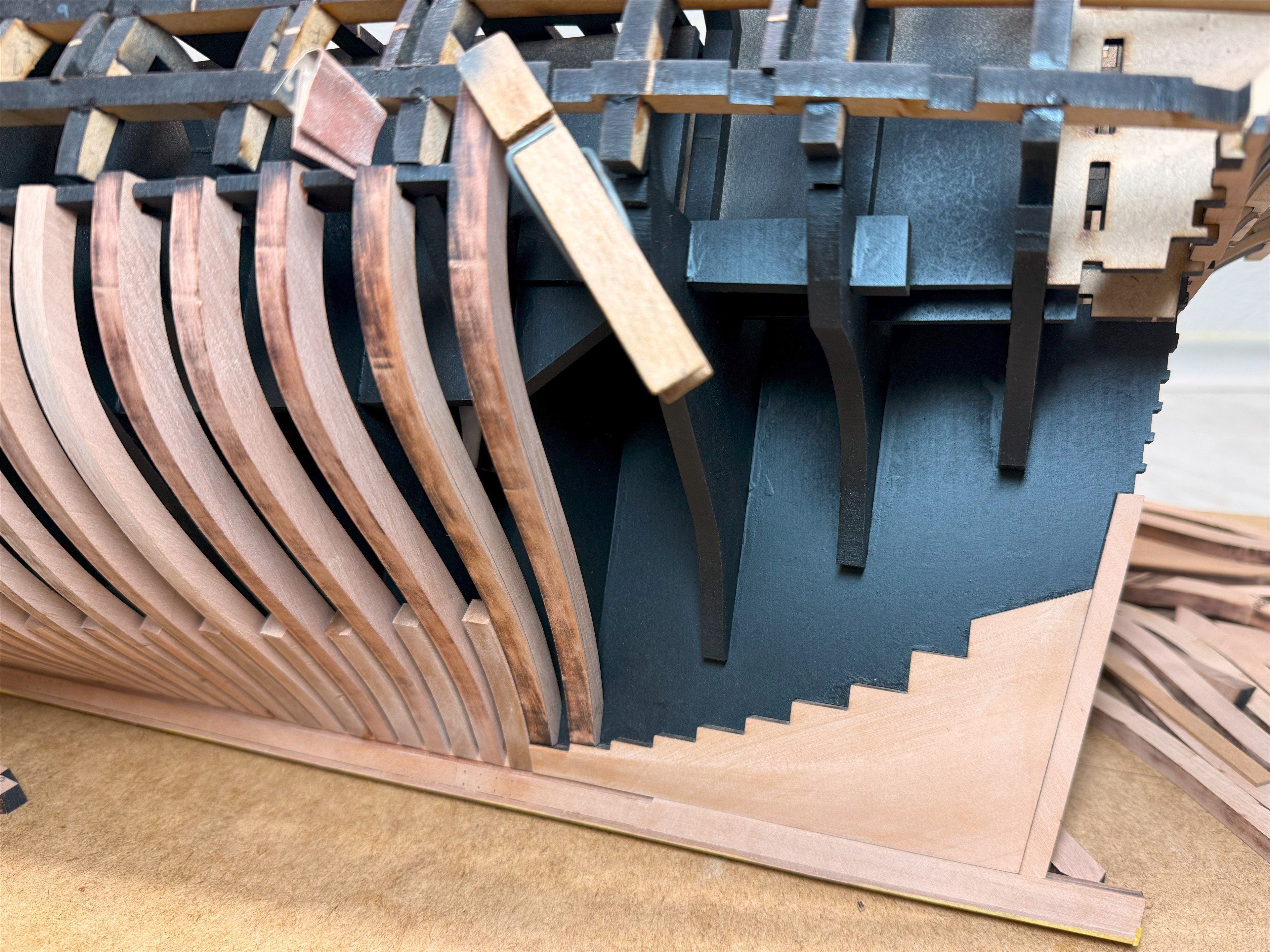

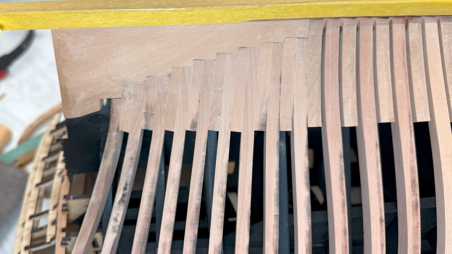

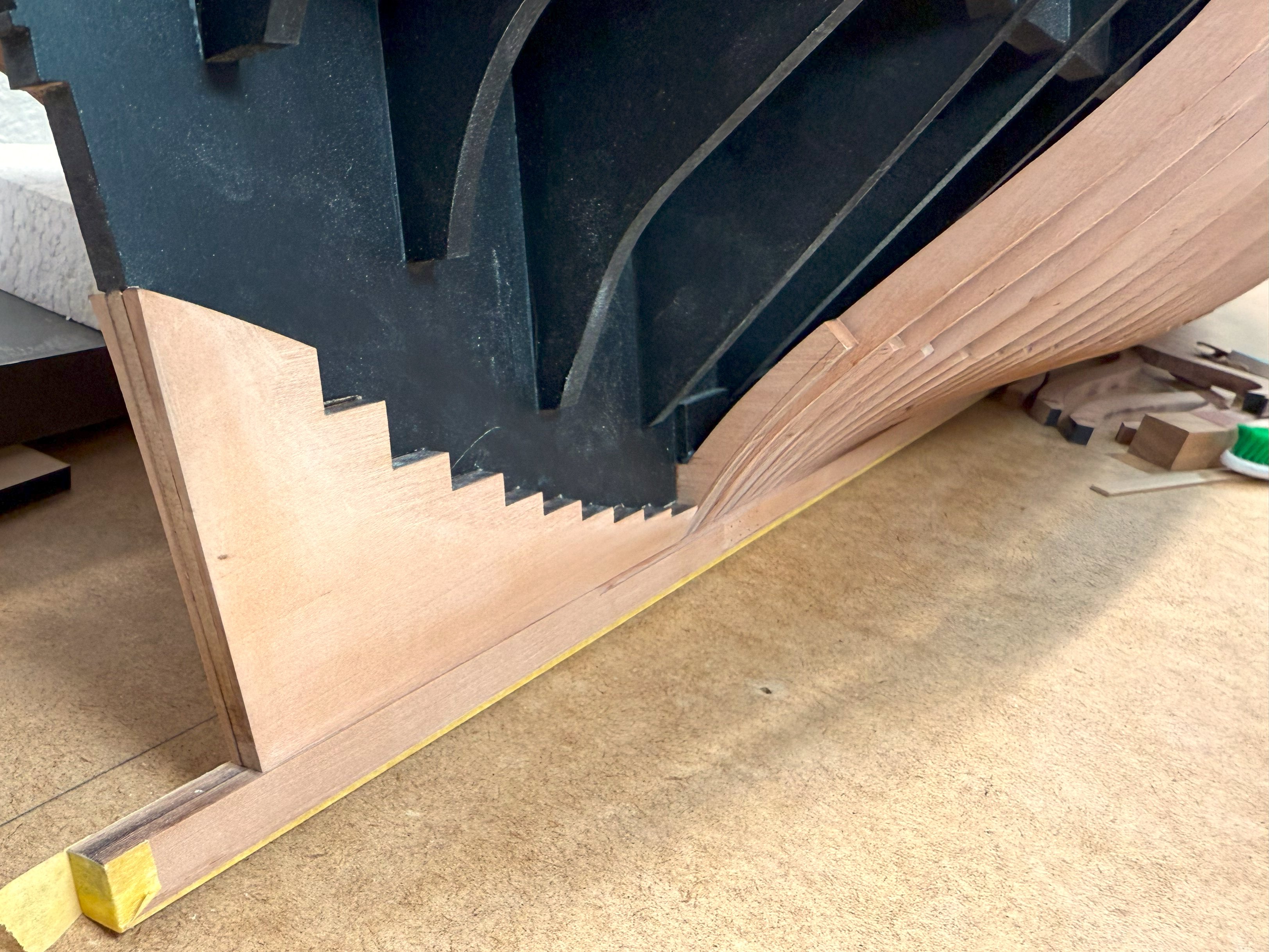

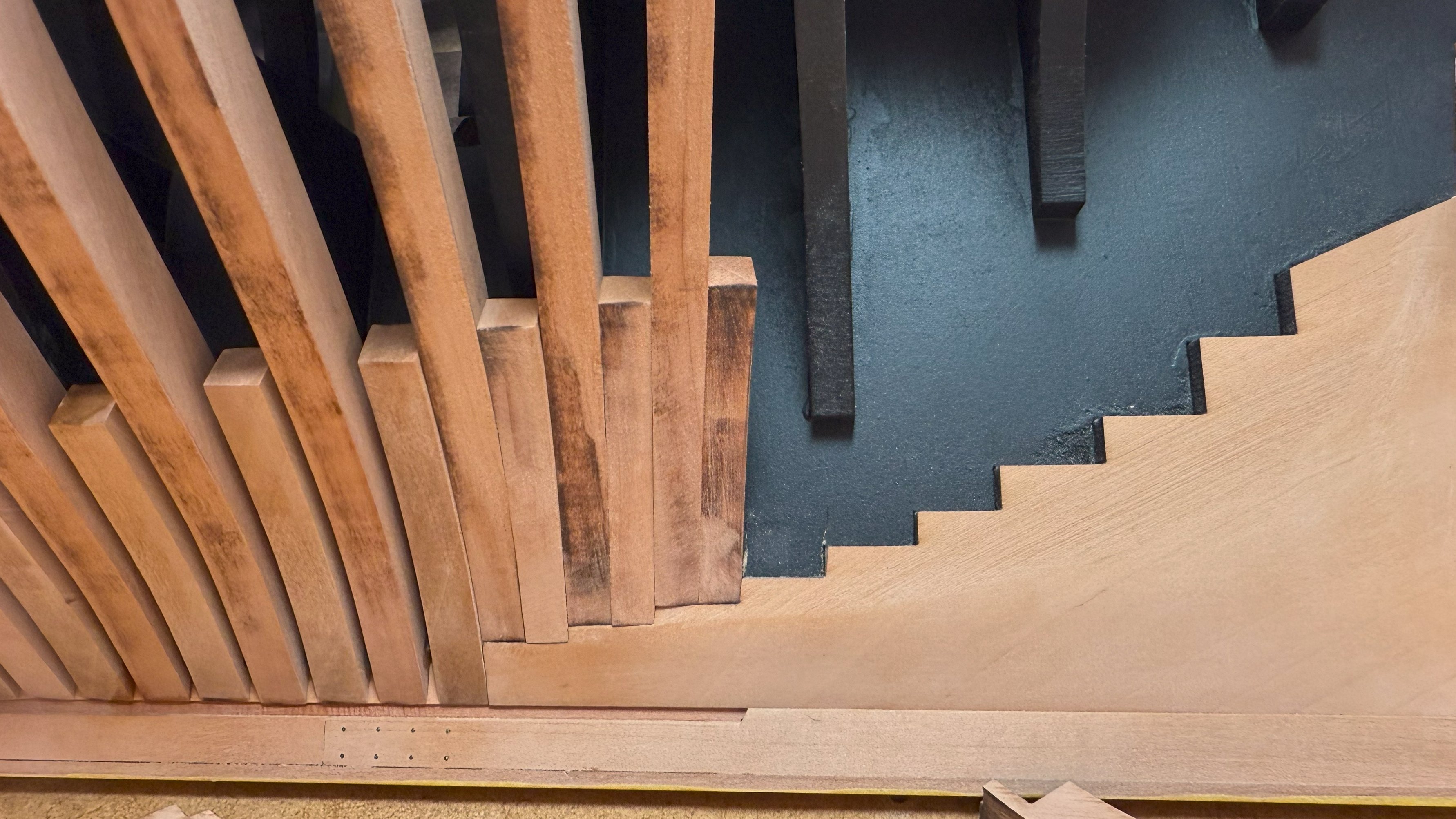

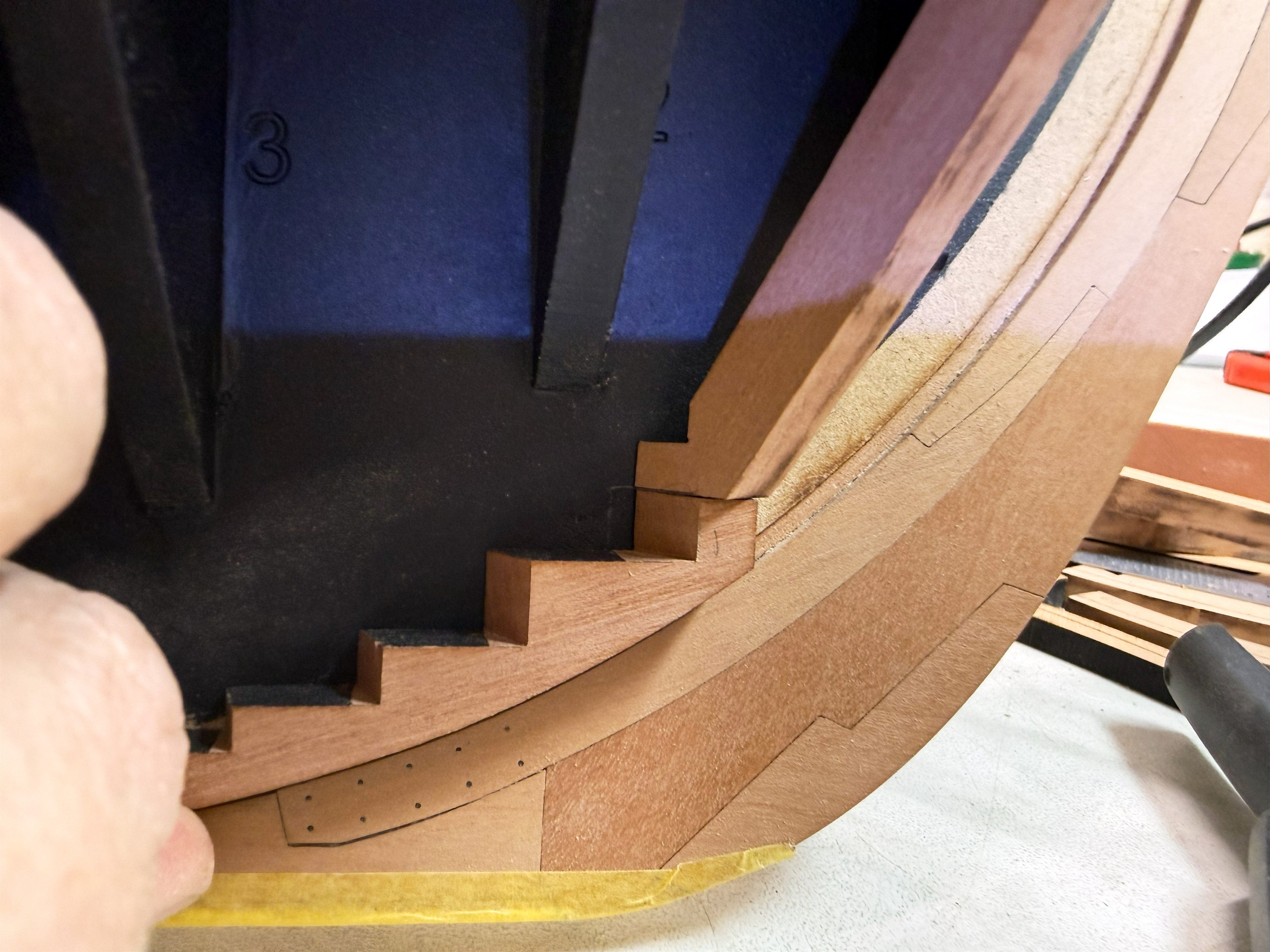

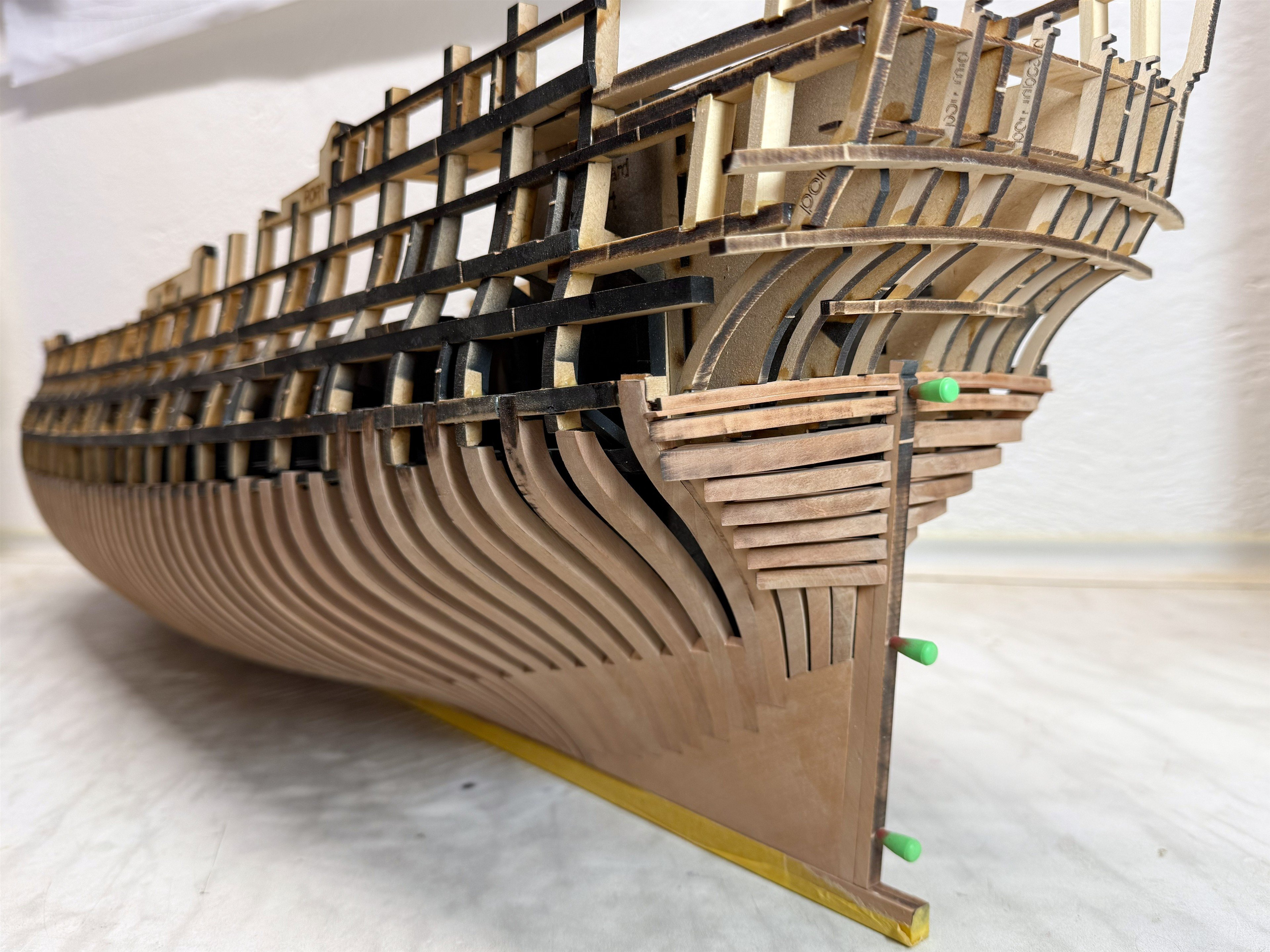

Hi guys,
I finally started working on the forward frames.
I started with the port side first.
Now, all that's left is to glue the hawse pieces, but that can wait until the end.
Today, I started working on the starboard side.

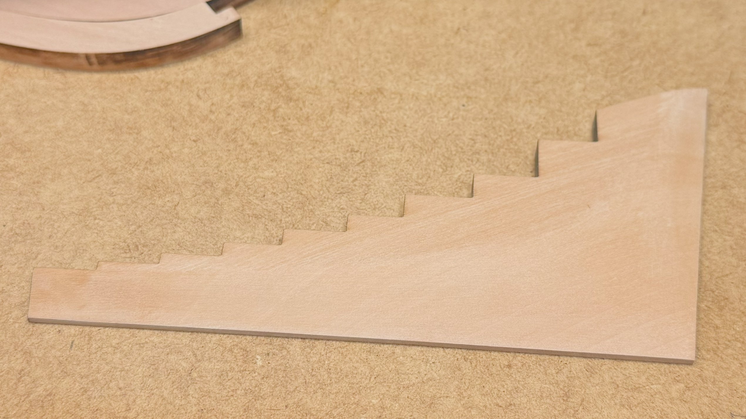

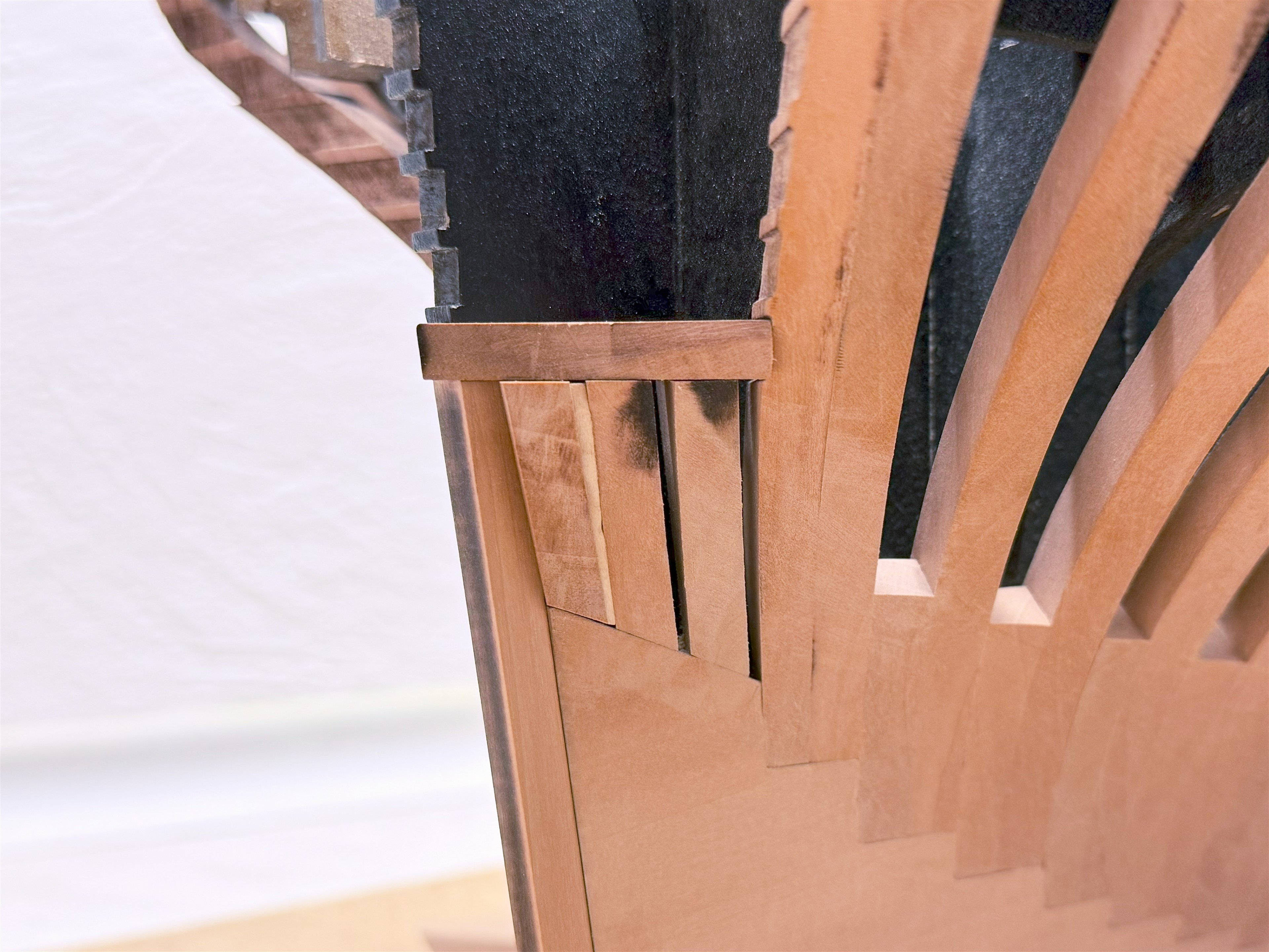

First, I had to prepare the apron.
Since the forward frames slope gradually forward, they require angles and tapering. The apron must be adapted to this, which is very important.
I think the photos show what I mean.
The apron is now glued on, and the first frames are ready to be glued on.
IMG_6921.thumb.jpg.b4373fef8327e76a029c4195cbd0c395.jpgIMG_6923.thumb.jpg.1780be7e4c4902b03b1b3c13b8d36eb6.jpgIMG_6939.thumb.jpg.523c05ab8bddb7339a61592816c6ac6a.jpgIMG_6942.thumb.jpg.3993bcf9e071d29526c75c7b5248c604.jpgIMG_6946.thumb.jpg.f17299b38f5fc57fdd5ffbeb5b29b6f0.jpgIMG_6943.thumb.jpg.164d130b12334566ae9bf48a4af5e5df.jpgIMG_6958.thumb.jpg.9e41d2eaac721e3e0978ab93a1e390fe.jpgIMG_6960.thumb.jpg.aaaeccfaf5e86f8aa6ec67ec9941b9a0.jpgIMG_6962.thumb.jpg.c78640d1acee2b3c02cd025954c6aae3.jpgIMG_6966.thumb.jpg.7c5f3bd3824a1729ad4aef55849491ba.jpg
