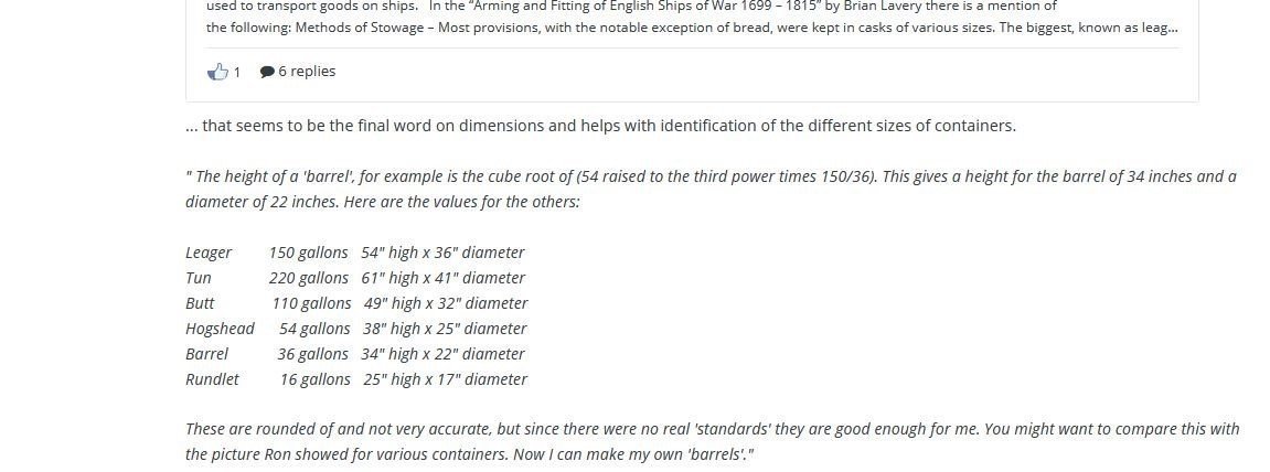

After doing some more research, I have found out some more information on the size of the casks or barrels that were used to transport goods on ships.
In the “Arming and Fitting of English Ships of War 1699 – 1815” by Brian Lavery there is a mention of the following:
Methods of Stowage – Most provisions, with the notable exception of bread, were kept in casks of various sizes. The biggest, known as leaguers, were 4ft 6in long, and had a maximum diameter of 3ft. Their capacity was 150 gallons each
and they were used exclusively to hold water, in the lowest tier of the larger ships. Butts, containing 108 gallons, also seem to have common on large ships, at all levels of the hold.
I have searched the web and found the following:
Tun                                      = 208 to 256 gallons
Pipe or Butt                        = 105 to 126 gallons
Puncheon or Tertian         = 70 to 85 gallons
Hogshead                           = 52.5 to 63 gallons
Tierce                                 = 35 to 42 gallons
Barrel                                  = 26.25 to 31.25 gallons
Rundlet                              = 15 to 18 gallons
There was no mention of the Leaguer which = 150 gallons.
I see it as somewhere in the range between a Tun and a Pipe or Butt.
There is a mention in the book by Robert White Stevens - Section Edition 1859 “On the Stowage of ships and their cargoes, freights, charter – parties &c” of which is a free download from Google E-books. In it mentions under Average Capacity in gallons & lbs. The following:
Tight Water Casks
Leager                  164   Gallons
Butt                       110   Gallons
Puncheon             72   Gallons
Hogshead             54   Gallons
Barrel                     36  Gallons
½ Hogshead         25   Gallons
Kilderkin               18   Gallons
Small Cask             12   Gallons
Ditto                         8   Gallons
Barricoe                10   Gallons
So, with all of this new information, this is what I’m thinking. The Tun was too large to have on board, so they used Leaguers. The Leaguers were the first to be loaded and then anything that was smaller was loaded on top of the Leaguers.

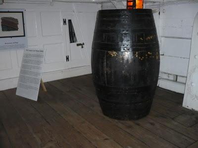

Interesting fact: Lord Nelson’s body was shipped home in a Leaguer. The same would be the case with any other high ranking officer of the Navy at that time.
See pictures below.

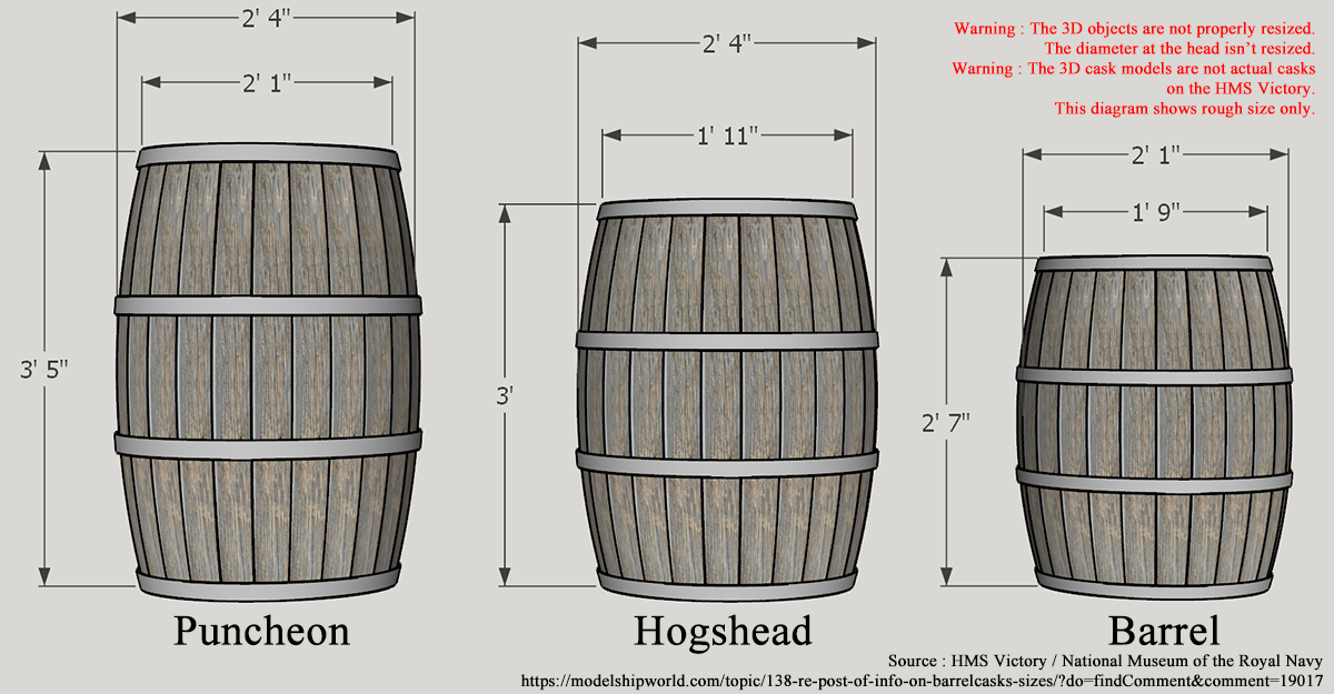

Dear Modelling friends; I'm attaching a reply sent to me by Mr. Andrew Bains, Curator, HMS Victory
     regarding the sizes of different casks. I trust you'll find this info. usefull.
Dear Mr Pollex,
Thank you for your enquiry. The dimensions you require, given in the order diameter at the head,
diameter at the bilge, height are:
Barrel                   1' 9"      2' 1"       2’ 7”
Hogshead            1’ 11”     2’ 4”       3’ 0”
Puncheon            2’ 1”       2’ 4”       3’ 5”
All were circular in section.
I trust this answers your query.
Kind regards, Andrew Baines

Thanks for researching and posting the above information on the Victory barrels. I see that there was no mention of the Leaguer in the email. It sure would be nice to have all the dimensions of all of the barrels that were carried on board of the ships during that time period, but I think that would be impossible due to the fact that it depended upon where the ship was in the world when they took on supplies. I would assume that each country would have had their own barrel size standards for that time period.
Would it be possible to have your contact on the Victory measure the Leaguer that Nelson was shipped home in? The more information that can be gathered on this subject would help model ship builders re-produce at scale authentic looking cargo for their models.

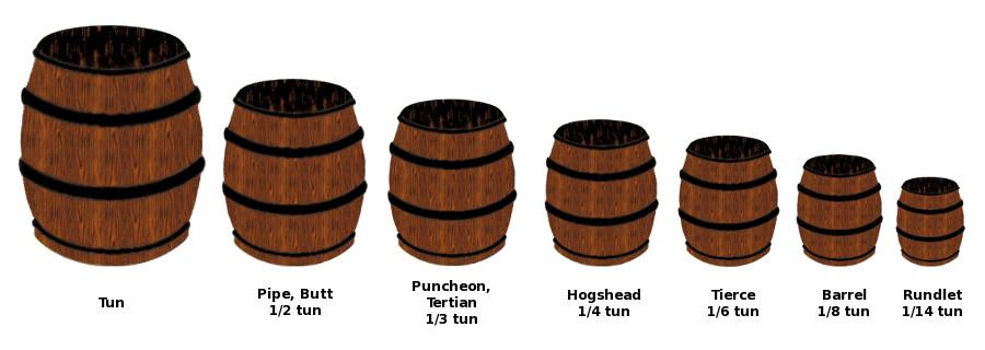

    A couple references to barrels I have found over the years
halftun.jpg.e668ccdb84d407edf7d2697be4b4ae7b.jpg1425834253_barrelsize.JPG.74af944f14f2bdc9b45f56fb3feb0607.JPG
Chuck Seiler
San Diego Ship Modelers Guild
Current Build:: Colonial Schooner SULTANA (scratch from Model Expo Plans), Hanseatic Cog Wutender Hund, Pinas Cross Section
Completed:  Missouri Riverboat FAR WEST (1876) Scratch, 1776 Gunboat PHILADELPHIA (Scratch), John Smith Shallop

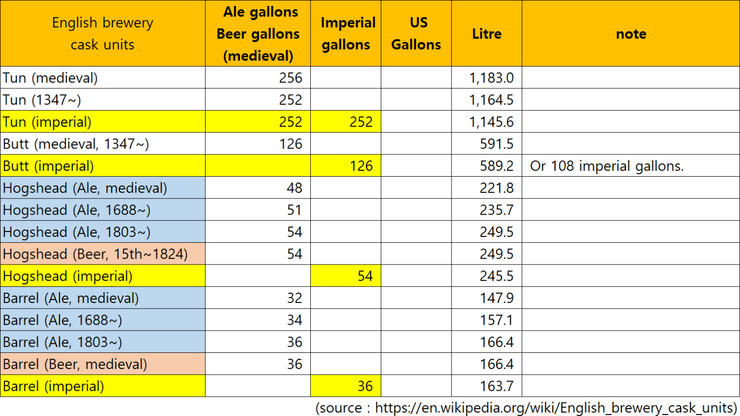

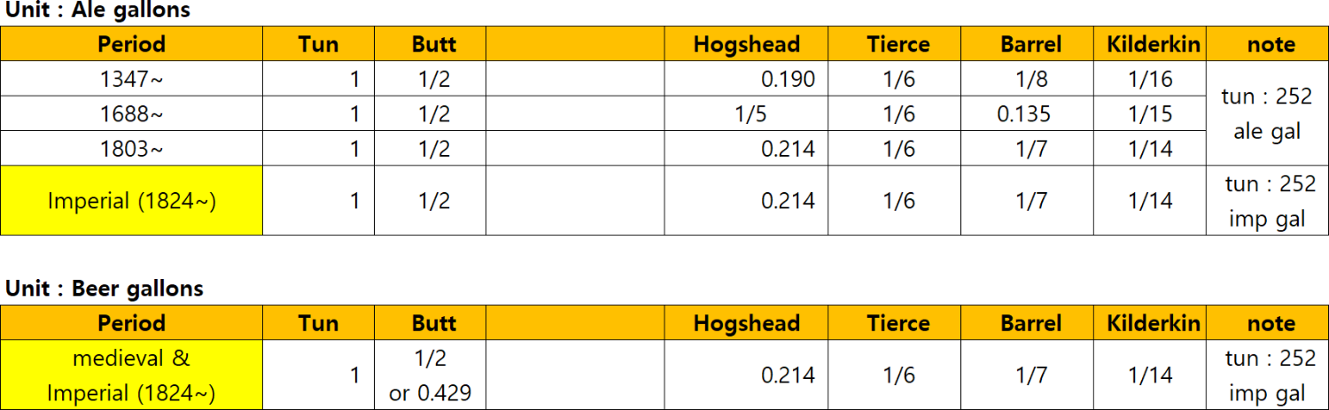

Use with care - this is after the retirement of the Winchester Bushel, the Wine Gallon and Ale and Beer Gallons... All measure in imperial pints/gallons or pounds.
Naval Architect's and Shipbuilder's Pocketbook. Has overall length, bung/bilge diameter and net and tare weights.  Probably not exclusive, and there would have been two different ladings of fluids according to whether they were weighed by the wine or ale gallon (maybe different cask, maybe different gallons per cask, according to usage... comprehensive scales for earlier periods are not well presented, compared to Victorian documentation).
https://books.google.co.uk/books?id=ozYDAAAAQAAJ&pg=PA500&dq=royal+navy+stores+net+cask+weight&hl=en&newbks=1&newbks_redir=0&sa=X&ved=2ahUKEwiv_4zg9LPyAhUhmVwKHXjxBJgQ6AEwBHoECAYQAg#v=onepage&q=royal navy stores net cask weight&f=true

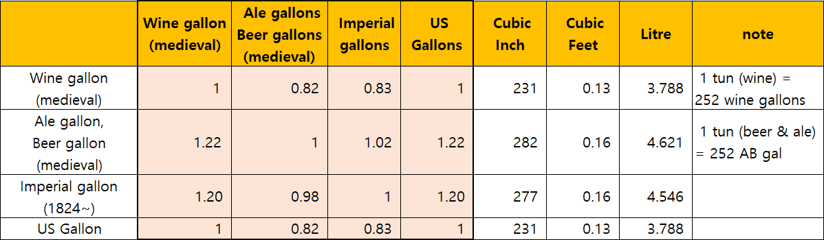

So... the barrels raised on the Wine gallon, and those raised on the Imperial Gallon are very close to each other in size (though not rated capacity) - with less tha 0.1% variation in nominal volume.
252 Wine gallons* or 210 Imperial Gallons make the Tun. (An earlier standard was for 256, but 252 is divisible by 7, so it was defined as 252 during the late medieval period)
The equivalent for Ale gallons (1803) is around 4.5% larger in volume, and the Tun would be raised to 216 Ale Gallons if that was a cask size to be used. (Hogshead seems to be the largest brewers cask in common use though).
The Winchester gallon is intermediate and occupies a space between that of the Wine and Ale Gallon (231, 268, 282 cu inches (Imperial 277.2749)).
Not sure whether the casks were sized to their nominal cask size (e.g. smaller barrels for wine, middling for dry goods and large for beer ration), or if they were standardised to a greater extent (at least for naval provisioning), but the number of gallons contained were shifted (as was done in 1826 when the new gallon was implemented). I suspect there was a mix of policy and

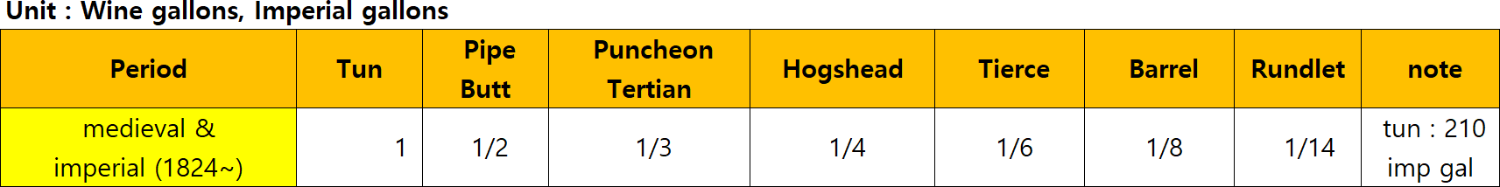

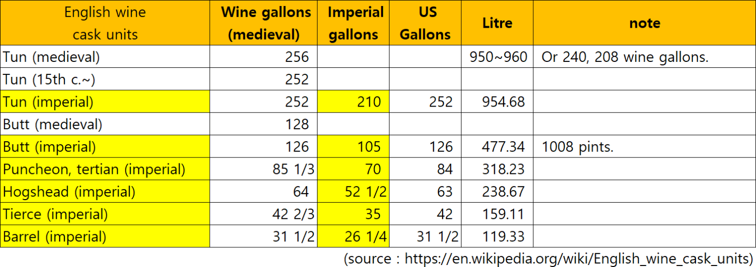

40 minutes ago, modeller_masa said:
I made some summary charts. I read articles and researched some Wikipedia documents, but I didn't read all the reference books, so the numbers and direction of editing may be biased.
Thank you., that is helpful.

For a long time I have been looking for exact information on the sizes and shapes of Royal Navy barrels from around 1800.
For the first time, I was able to roughly extract the dimensions of the big water casks directly from a contemporary source:
a Leaguer for approx. 150 gallons of water, 4.5 feet long and 3 feet in diameter, easily measured by the scale underneath the keel.
To what extent were these barrel sizes standardized, what sizes were exactely used for what purpose and what were the special shapes? Are there any contemporary sources?
As my 34 ft launch is about the same size, I could not resist a test.
And it really fits surprisingly well 🙂
