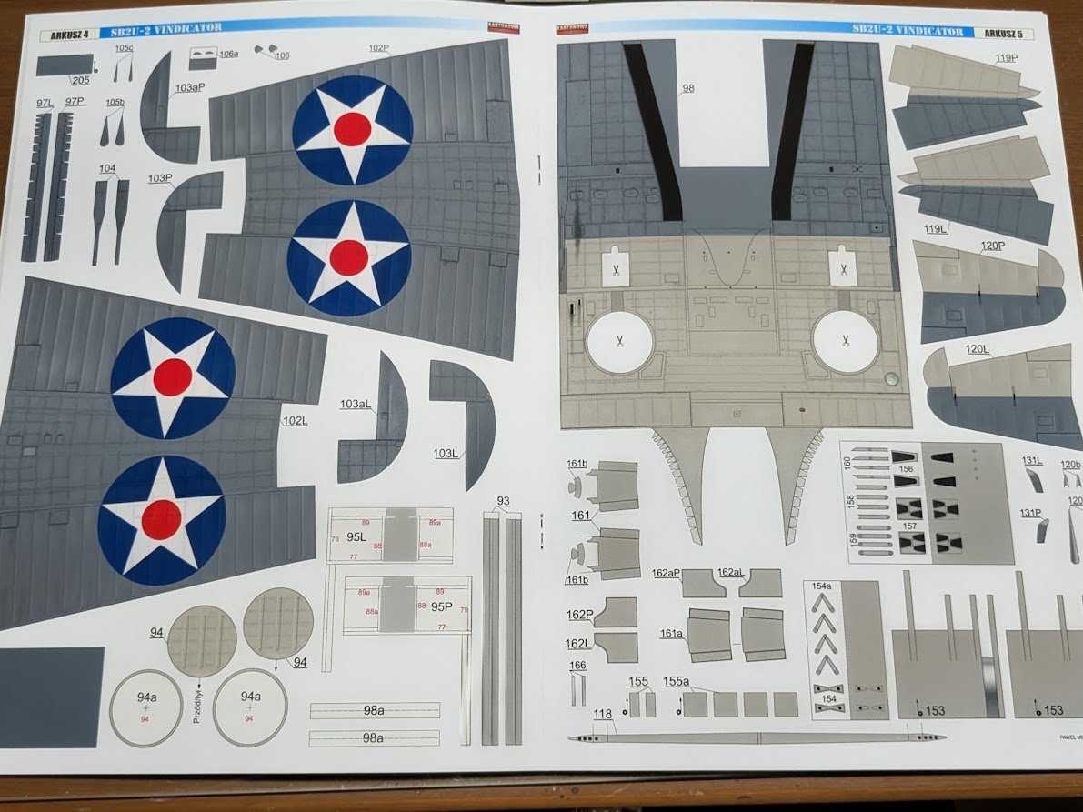

Lots of excellent diagrams, as usual.

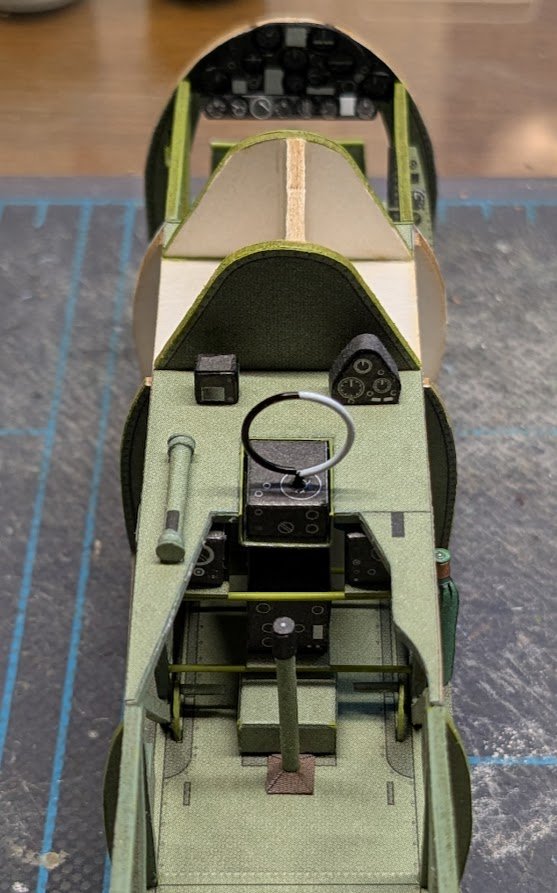

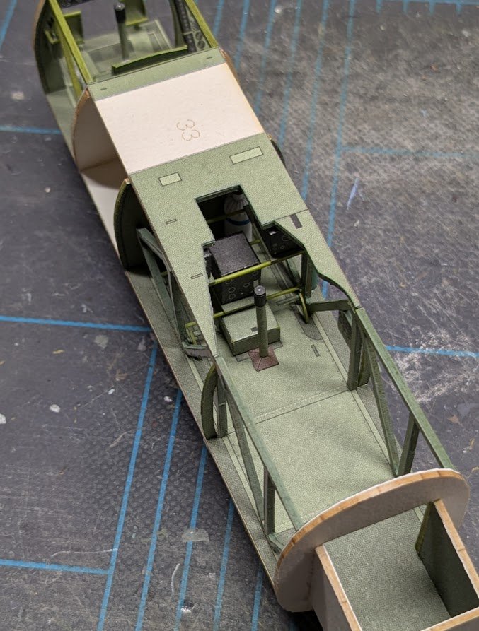

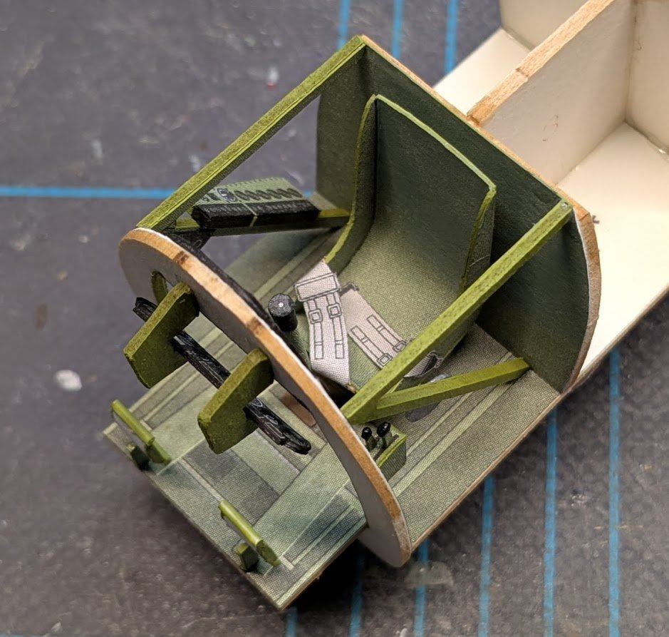

The forward end of the radioman's position is finished. I indulged myself in one easy upgrade here -- the RDF aerial in the kit is just a flat, printed piece, which didn't look right to my eye. I replaced it with a wire loop.

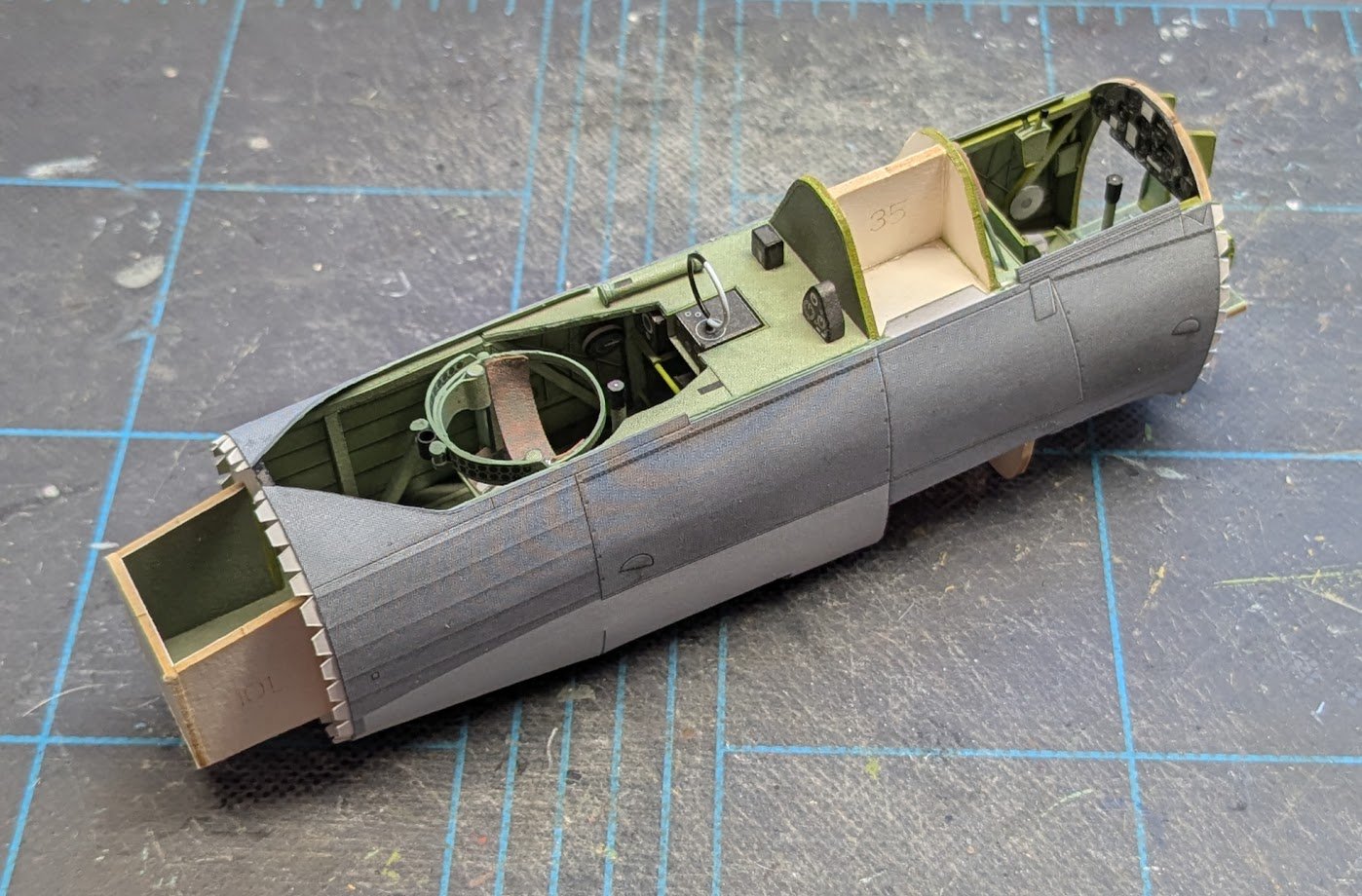

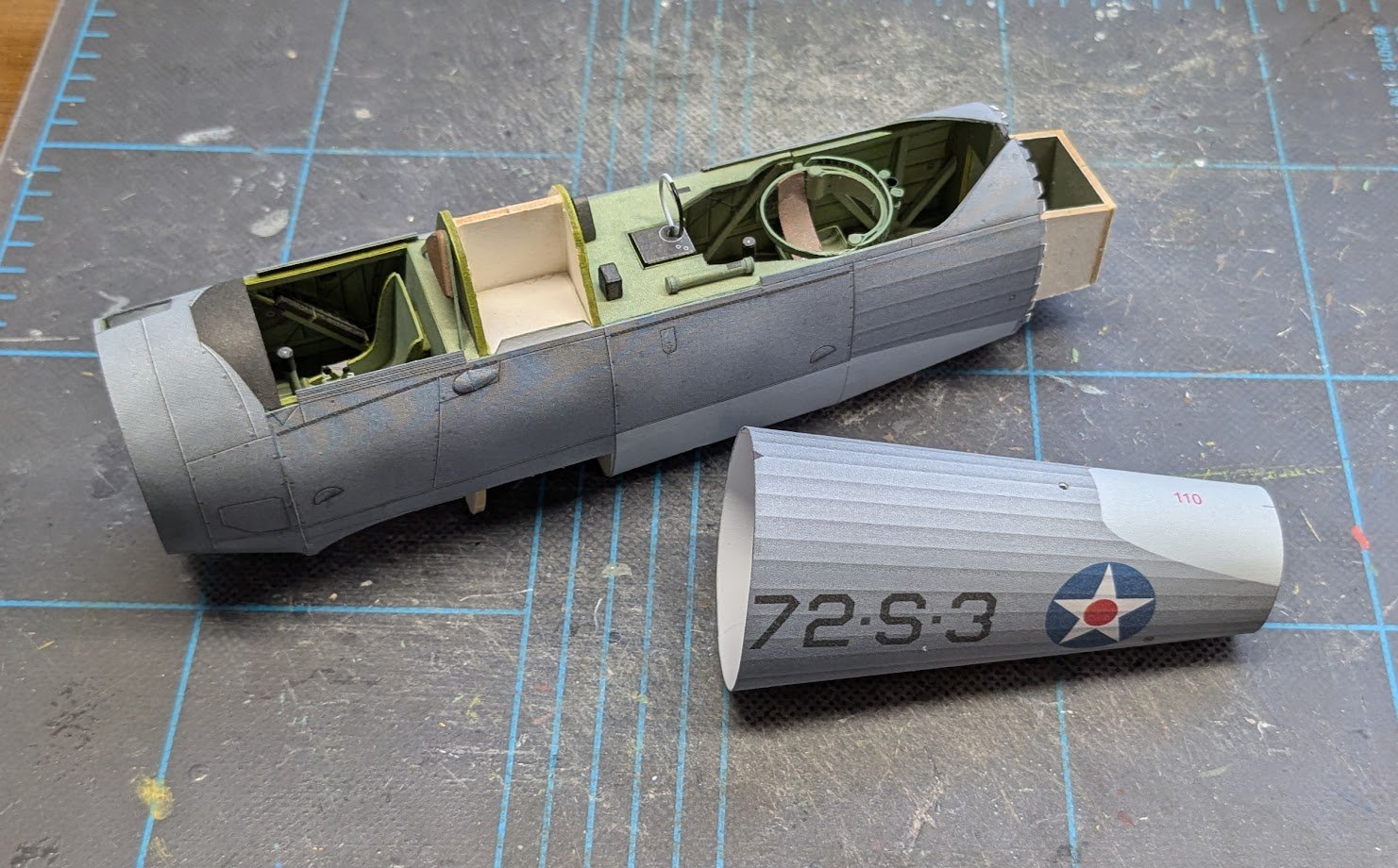

Aft fuselage attached. There's some not-so-great seam work (the result of a botched gluing attempt) if you know where to look.
'Course, I didn't say where the botched seams are located, did I? 😉

I got the final bits of fuselage added, which was a more demanding task than one might expect. The second-to-last section, abaft the gap for the horizontal stabilizer, is not simply oval in cross-section. Instead, it's a rectangle stacked atop an oval, but it tapers down to oval at the back. The skin for it is one piece, so a lot of work was required to get it to the right shape, and a lot of sanding was also needed to get the forward frame piece to fit into it properly.
Following the numbering sequence of the parts, the canopy should be next, and I did start work on it. But I decided to check the written instructions to see if there were any potential pitfalls I should be wary of, and there I noted that the designer recommends leaving the canopy till later, which I agree is sound advice. So that was set aside for the present, and work commenced on the wings.

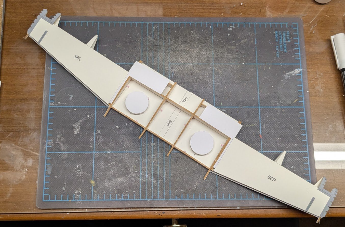

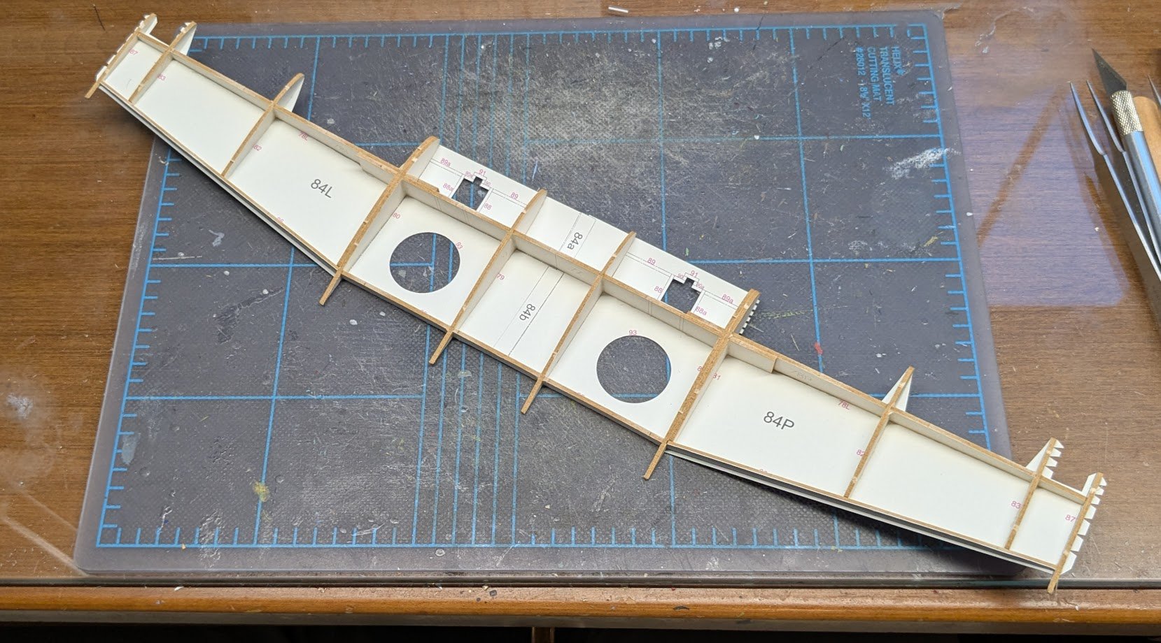

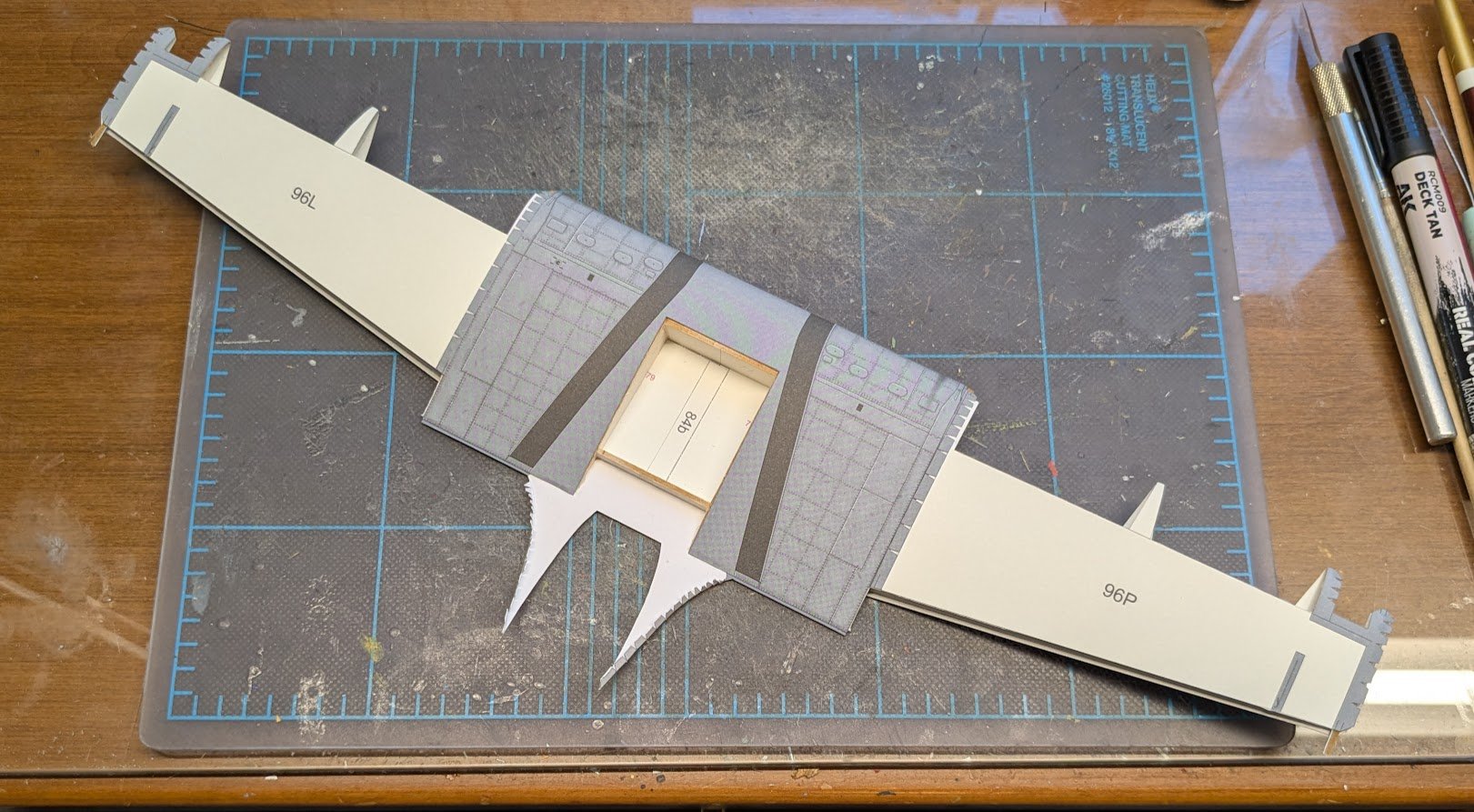

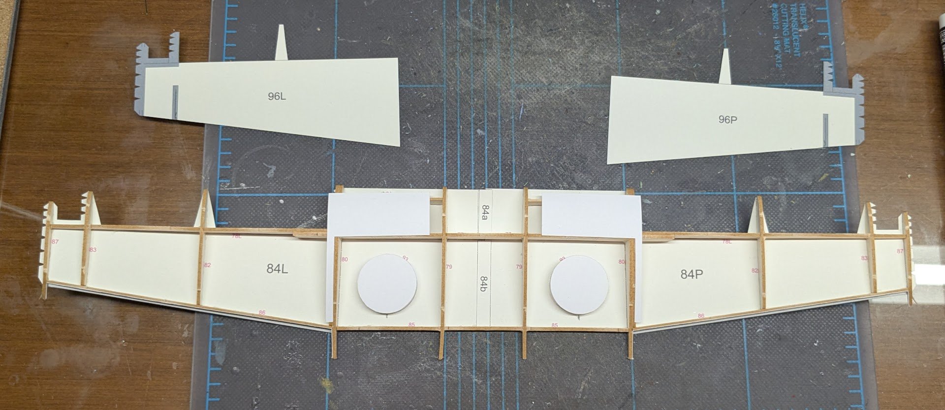

Continuing with the wing, here we have the wheel wells added and the top cladding cut out.
The finished wing framing is quite sturdy.

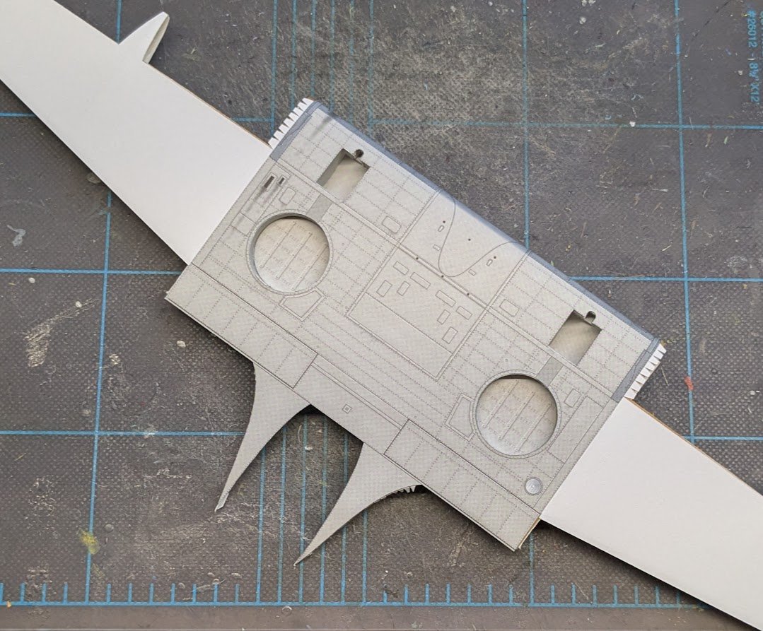

Now the center wing skin is added, starting with the bottom to get the openings for the wheel wells aligned.
Followed by gluing the top side down.
The kit has optional parts for displaying the flaps down, but I will not be adding them, as it adds some complexity to the build, and I always think it looks just a little odd to show parked aircraft with their flaps deployed. Next up will be the outer wing sheathing.
