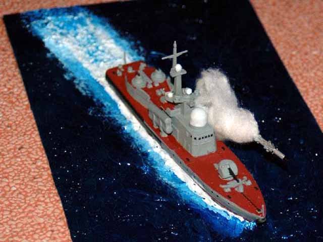

I love this project. Perhaps you could use cotton wool (perhaps coloured) around the leds to simulate fire? Should not be too difficult to get into the bottle as well.
I have a cotton wool smoke trail of a missile that hasn't lost its shape in nearly 20 years and I didn't treat the wool with anything.
Not really sure how it will spread or "contain" the light though...

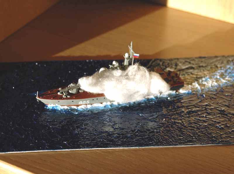

Found some old pictures of my cotton wool thing. I did use larger pads of cotton wool, they were less dense. This was of course a smoke effect, I guess you will need to play a lot with the colouring to make it look like dense fire.
Love the colours you've already applied, very strong pigment, and that's what you'll need I guess. tarantul-06.jpg.3475f49de251d515cbdb1689ed5f58a3.jpgtarantul-02.jpg.6c45d0d784bdf85d03c56111bb877f42.jpg

Those are cool pics, Roel.  Thanks for sharing.  But the project seems to be missing something, to me anyway.  Oh yes, a bottle!!

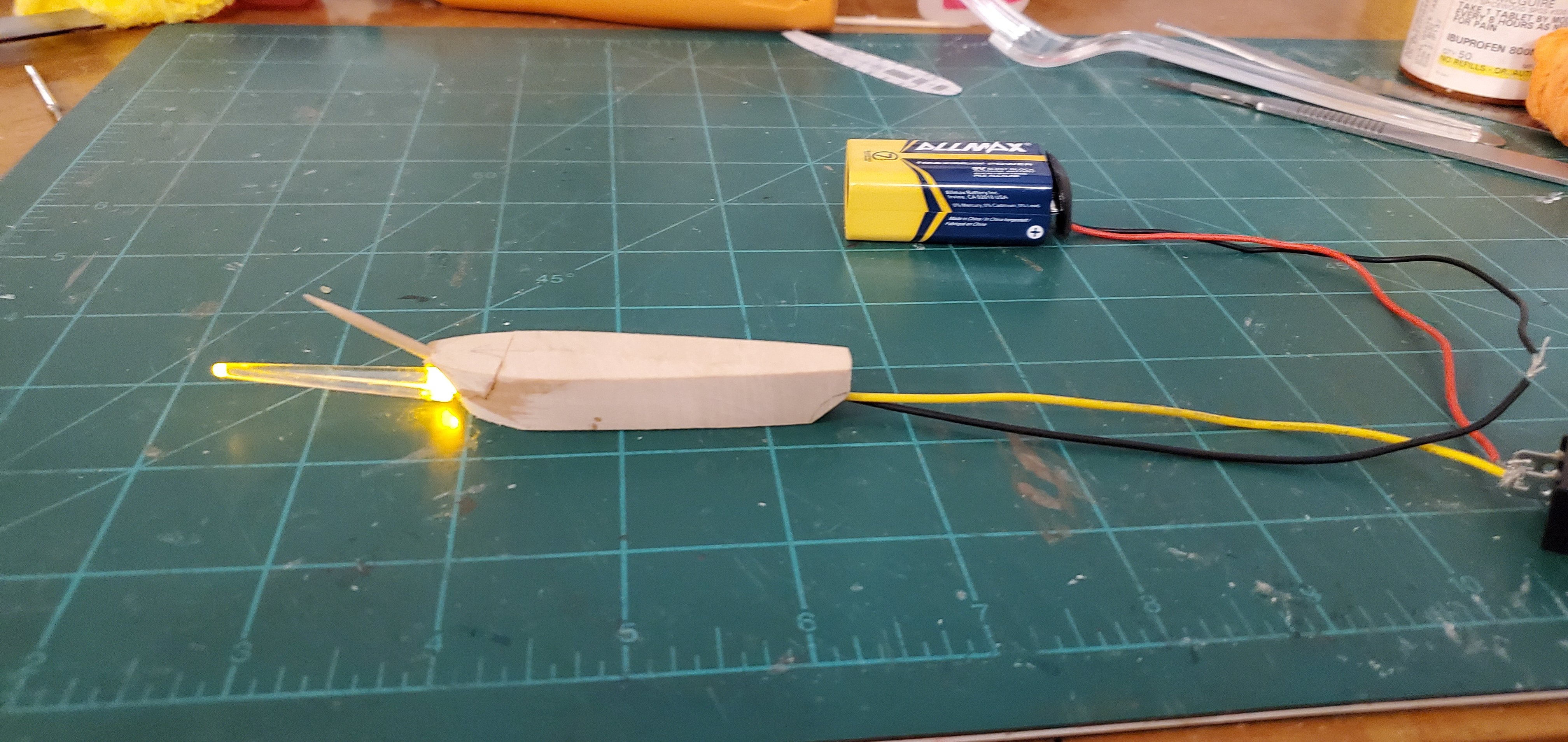

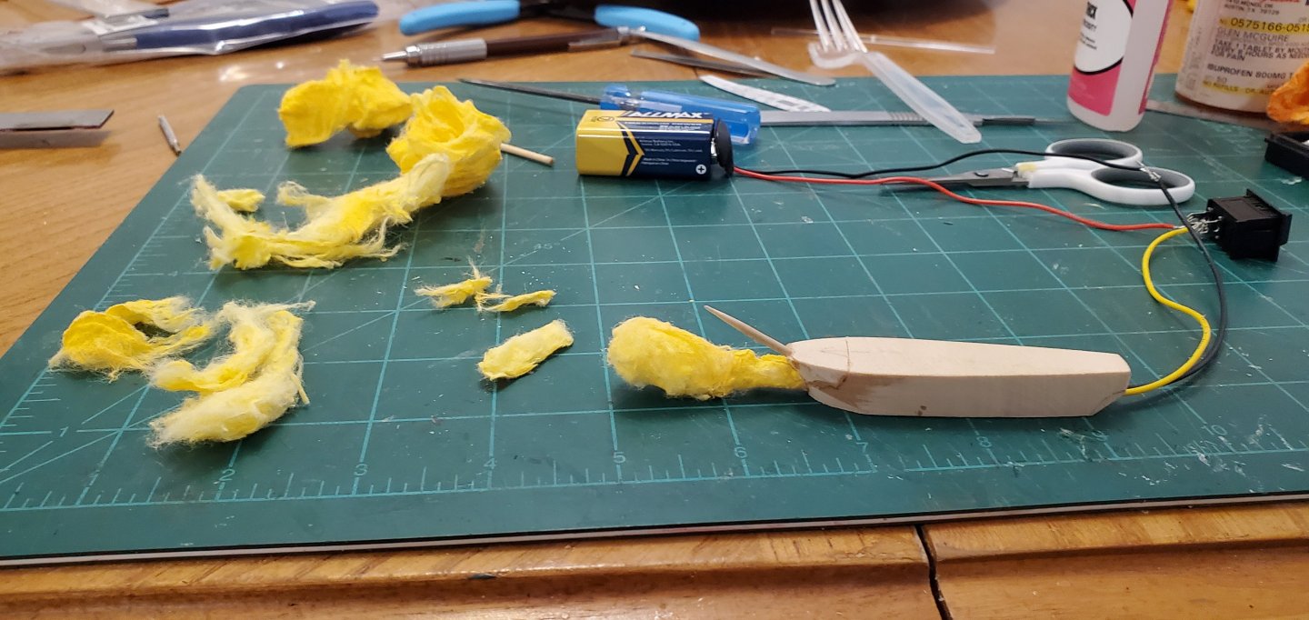

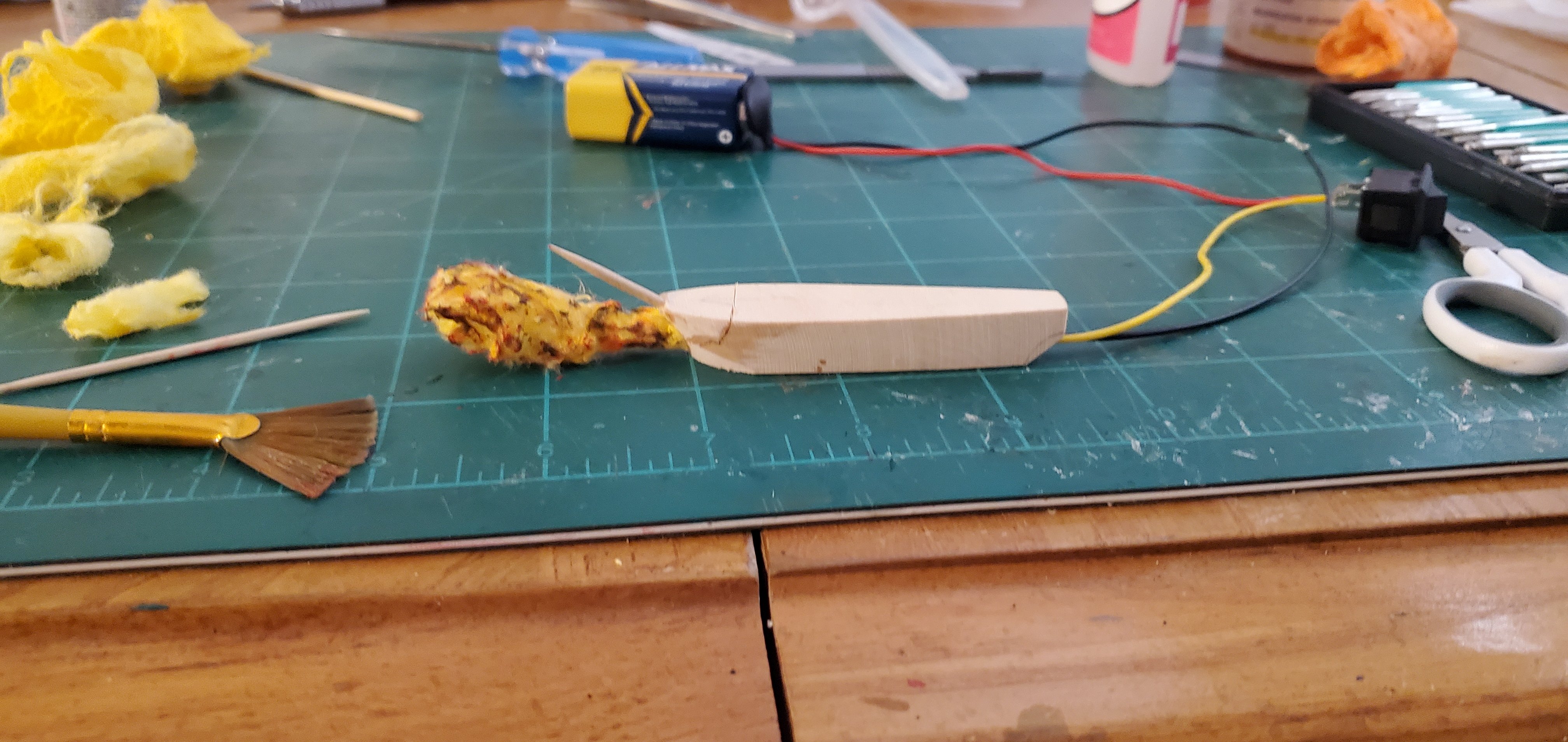

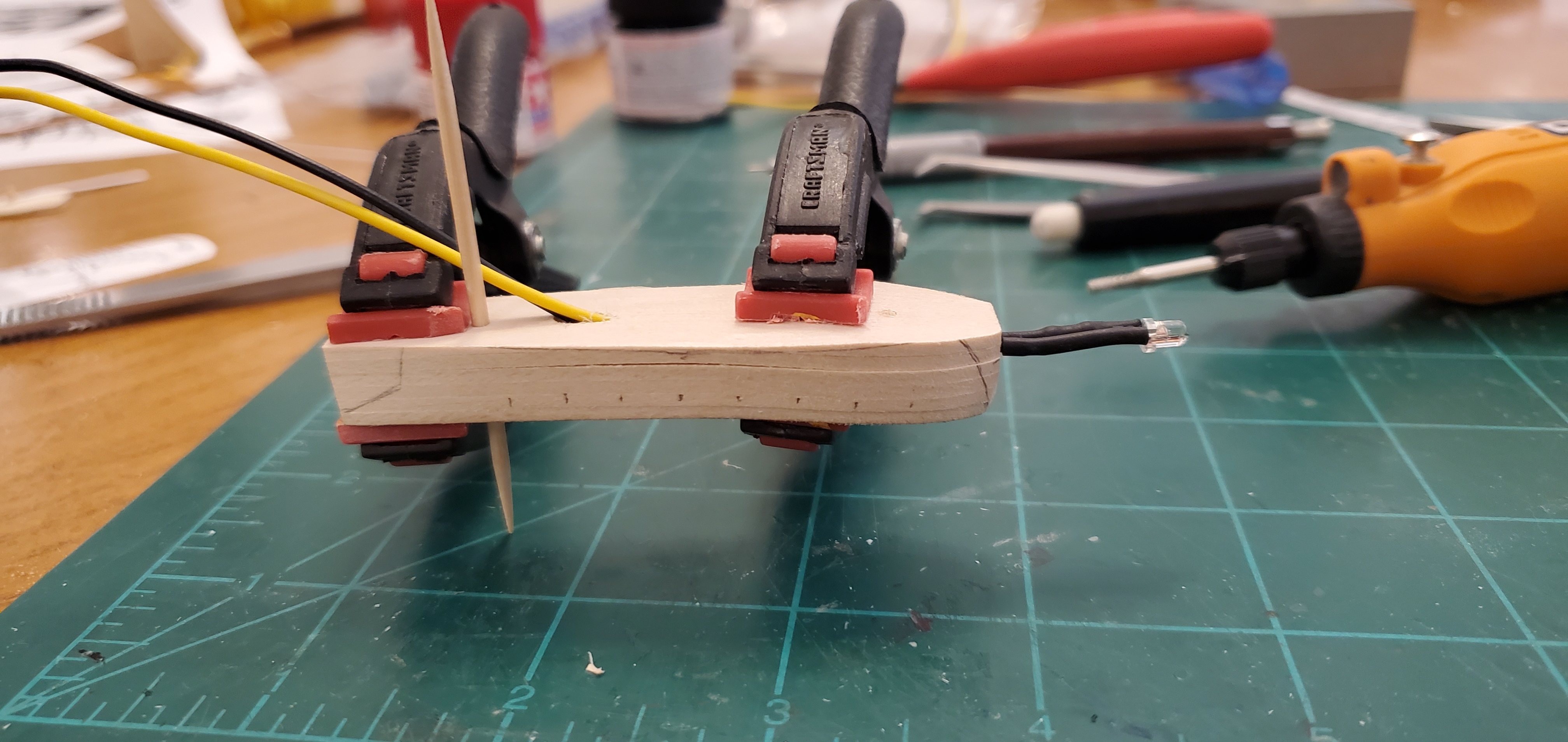

I'm making a test run at a small fireball.  For the test, I made a dummy hull with bowsprit and drilled a hole from bow through the stern to insert the LED light and wires.  For the real thing I will run the wires thru the bottom of the hull, but running them out the back is easier for now.

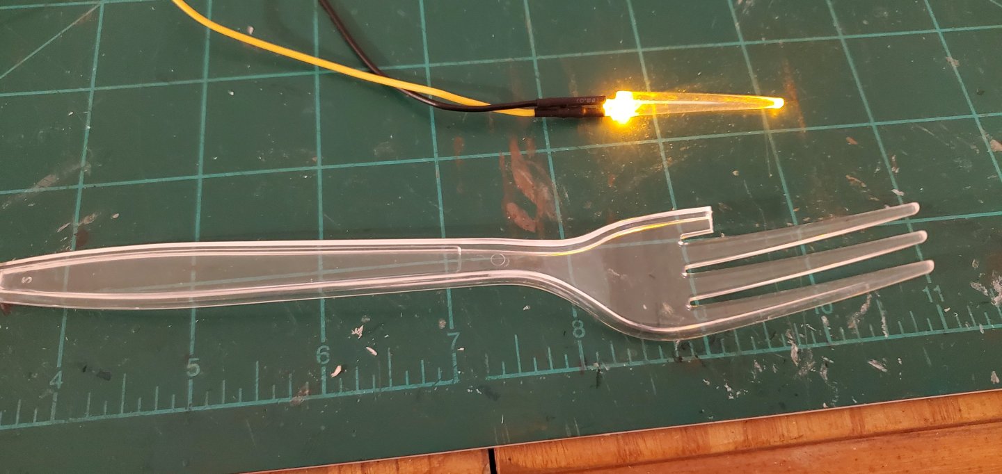

The fireball is going to be around 2" long, but the LED is only 3/16" long so I need a way for the LED light to travel the length of the entire fireball.  For this test, I decided to see if the light would travel through clear plastic and provide a sufficient glow.  I broke off the tine of a clear plastic fork and glued it to the tip of the LED.  Then I glued it onto the bow just below the bowsprit and ran the wires out the back to the battery.  The plastic fork tine did not provide a uniform distribution of the light, but it's not too bad.

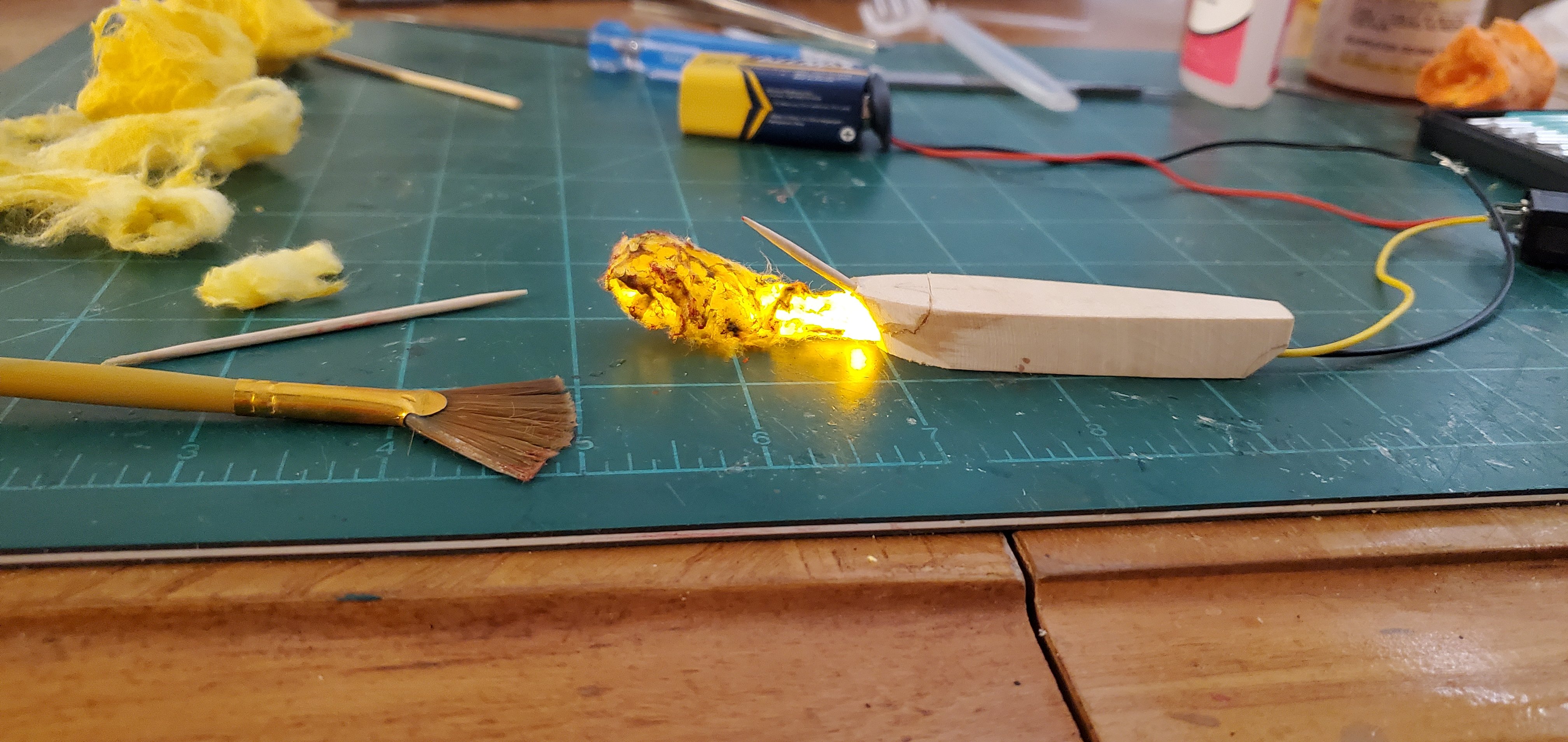

Now for the fireball.  I decided the orange cotton balls were too dark for a base color, so I went with the yellow ones.  I tore one into pieces and built up (CA glued) the fireball around the LED and fork tine.   Then I took a fan brush and gave it some red and black highlights.
And here's how the test fireball looks with it lit up by the LED.   The picture really glares the spot where the fireball is coming out of the bow.  It's a much softer glow in person.  I think I can do better with my red and black shading (an airbrush might help too), but I also think I'm on the right track.

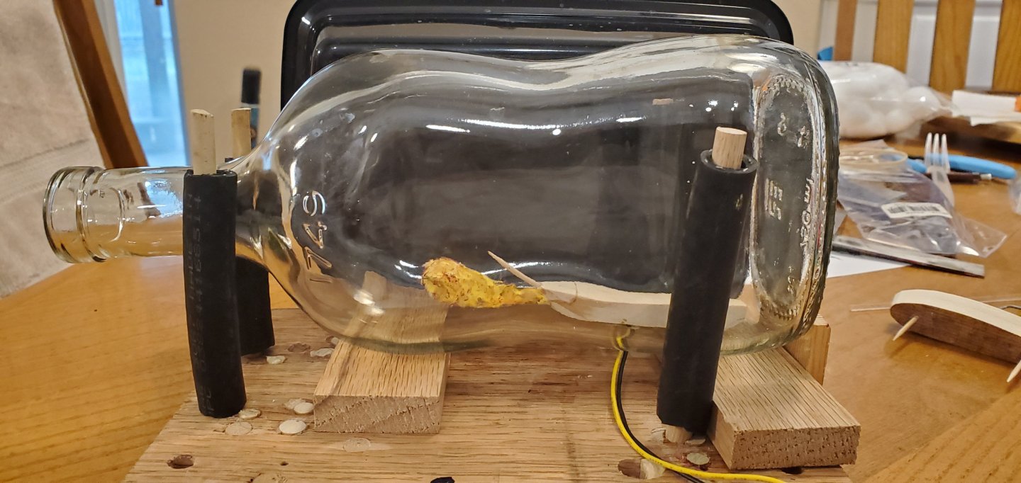

Well Keith, you made me anxious to try a test run so here it is.  It fit just fine without masts, yards, sails, etc.  Hopefully I can say the same thing after the ship construction is completed.  One thing I'm pretty sure of - the stern/poop deck area of the ship rises so high that it will have to be a separate piece and installed after the ship is in the bottle.

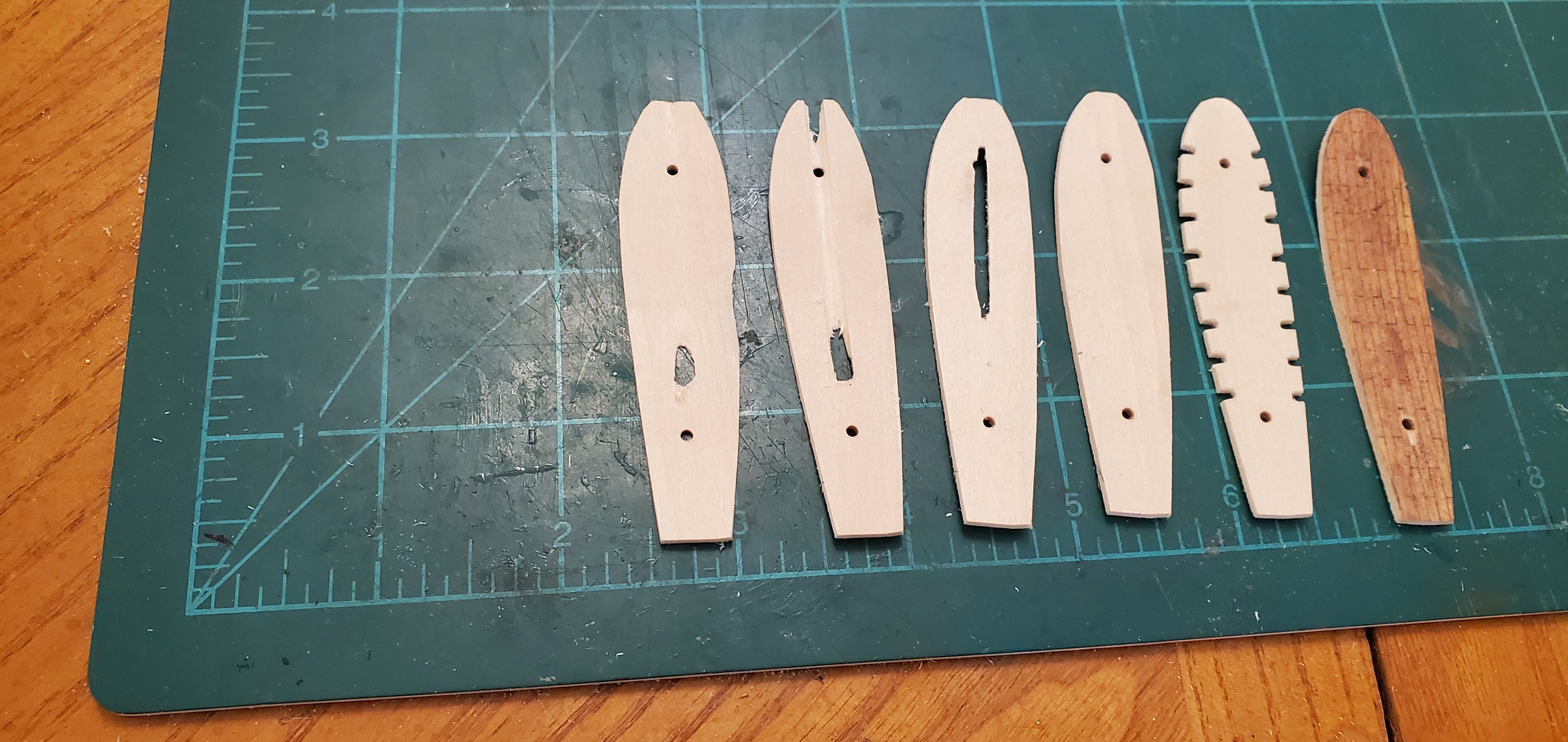

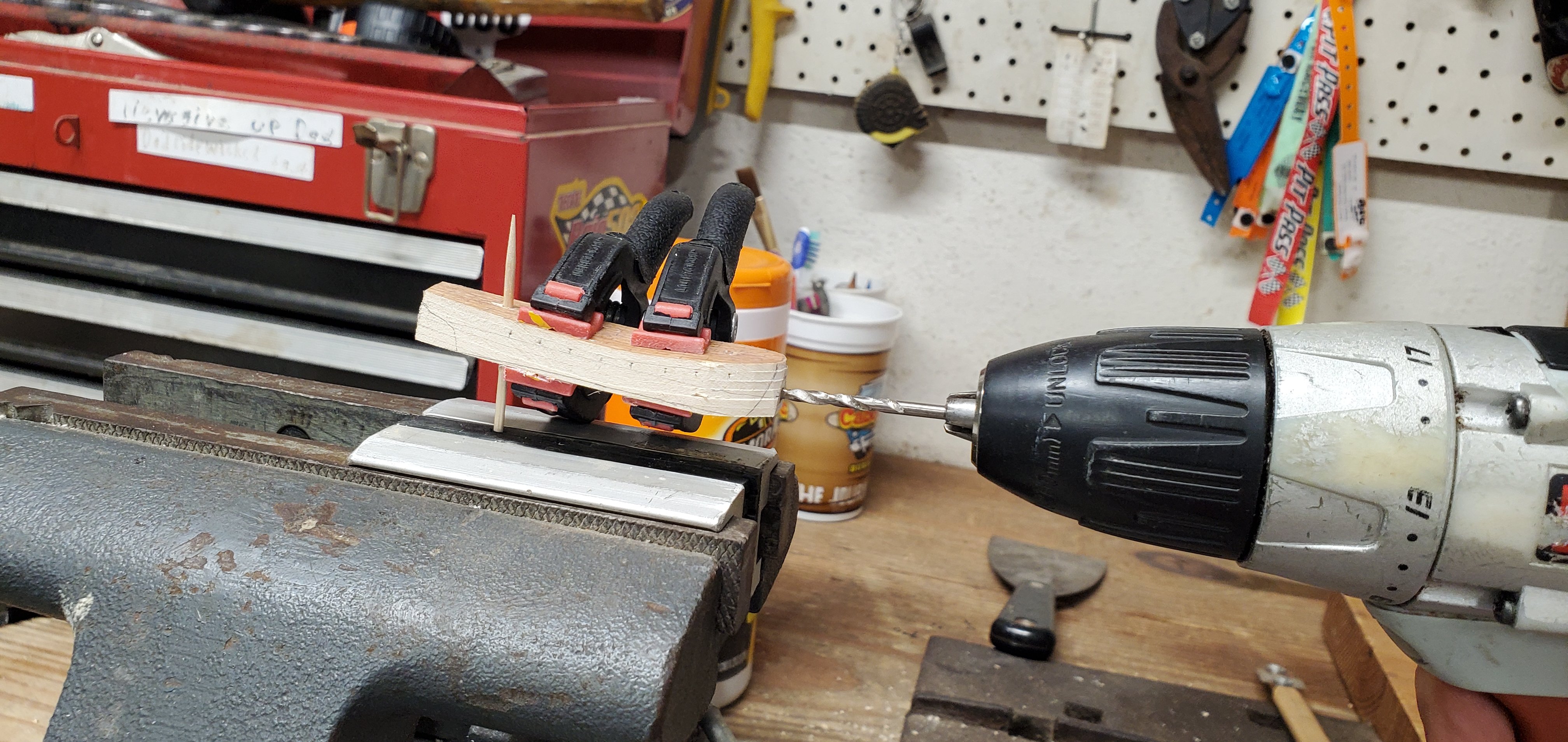

Continuing the construction of the hull.  I stacked my hull layers and sanded the down to the hull's basic shape.  Before doing the final shaping, I decided to cut the tunnel for the LED and wires.  I also decided to wait on gluing the layers together until I was satisfied with the tunnel, hence the heavy clamping below.  The toothpick helps keep the layers aligned and gives me a way to secure the assembly in the vise for drilling the tunnel.
I used a 1/8" drill bit for the tunnel.  My main concern was keeping the bore straight and just below the gun deck (you can see the pencil marks for the gun ports below).
And a test fit of the wires:

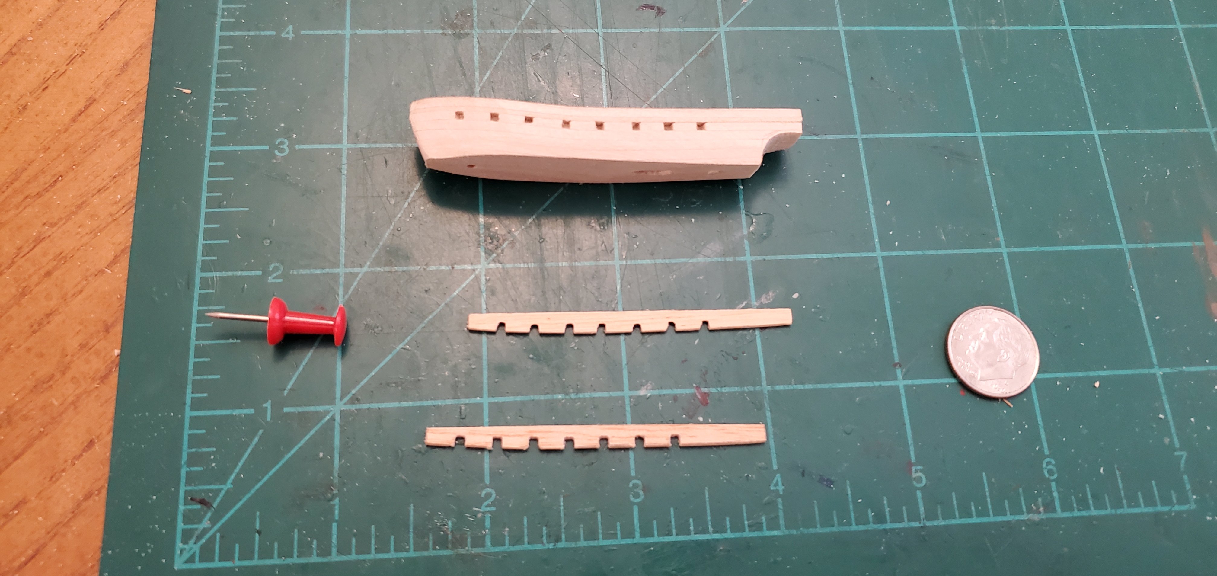

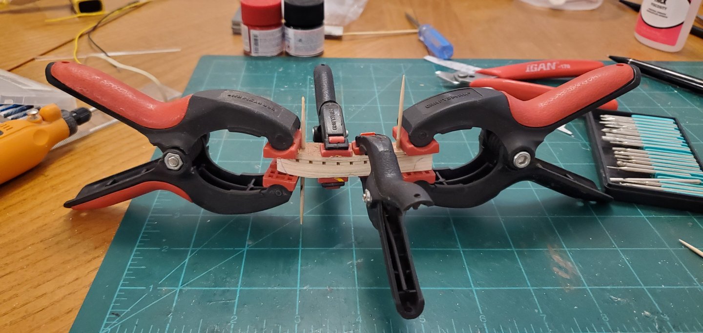

Satisfied with the tunnel, I pulled the layers apart and cut the notches in the gun deck (2nd layer from right) where I will insert the cannon barrels later.

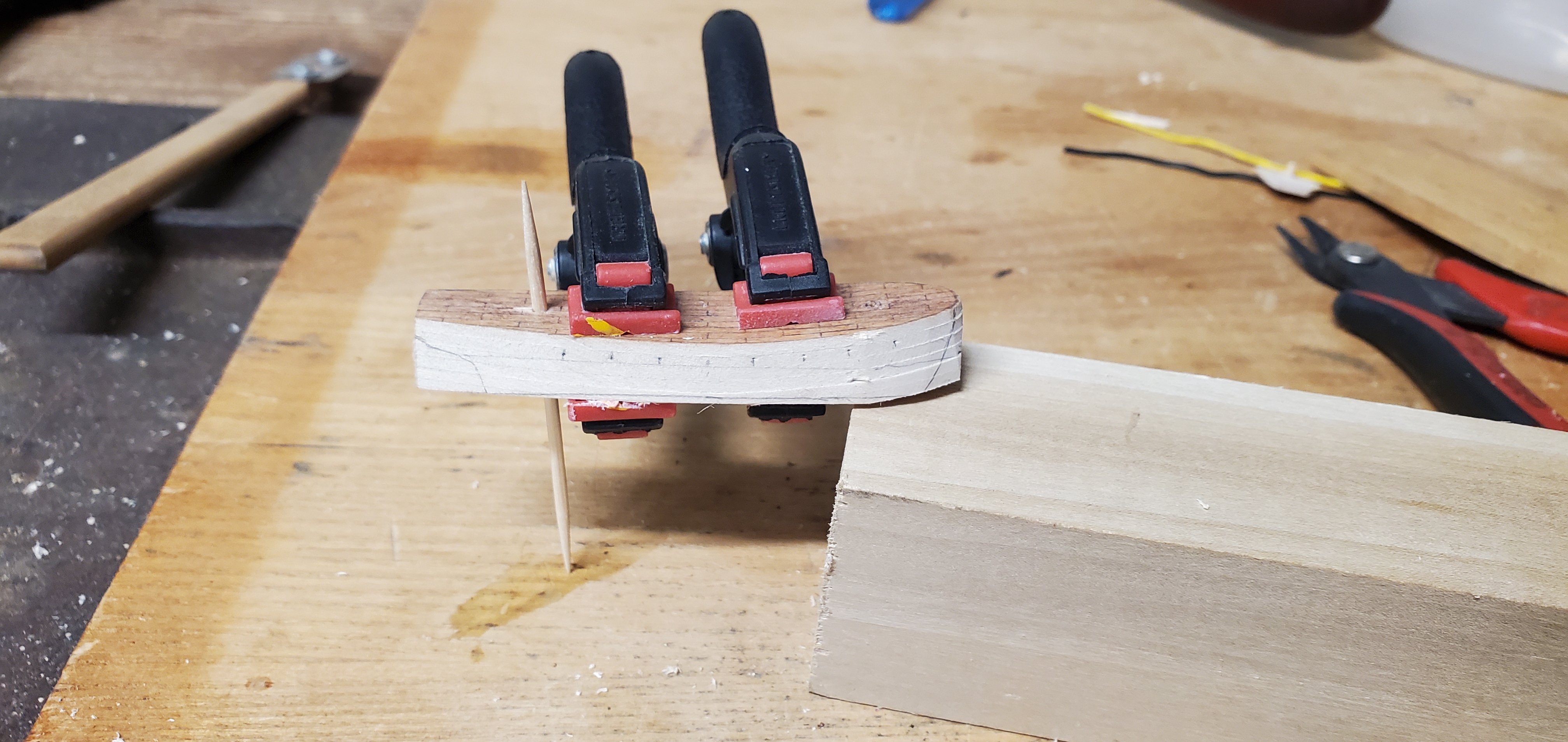

The next step was to glue all the layers together.  20250920_084037.thumb.jpg.b3d6a611b275267ac1eba9eb83463bf4.jpg
Next was additional shaping of the hull followed by work on the bulwarks.

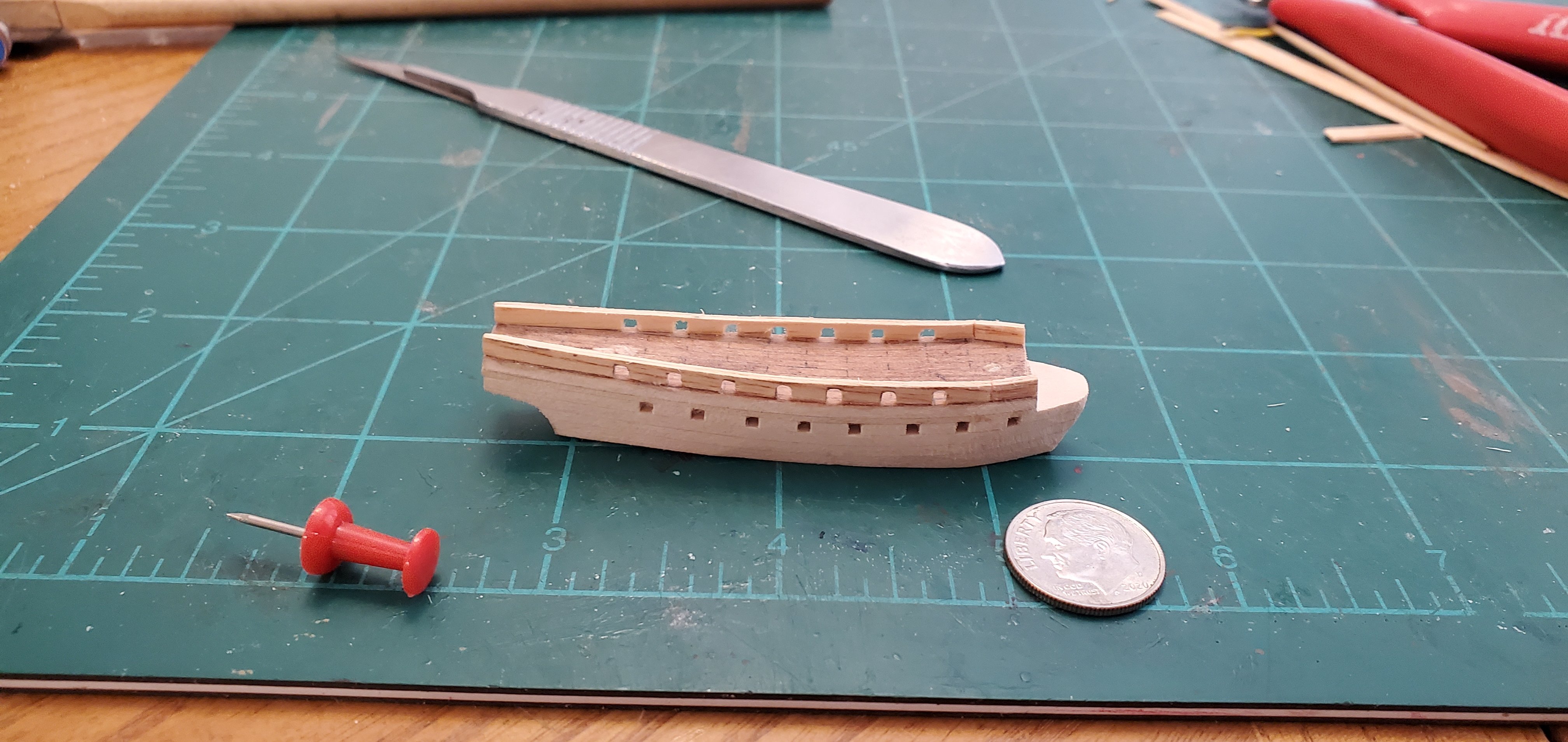

Bulwarks installed:

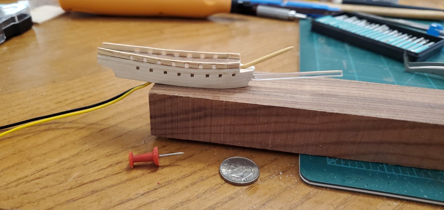

Bowsprit added and another test fit of the LED (with light saber attached) and wires.
Edited by Glen McGuire
A dolphin skewer!  :)
The Queen Ann looks really sharp, Glen. 👍
I decided it looks like a light saber!

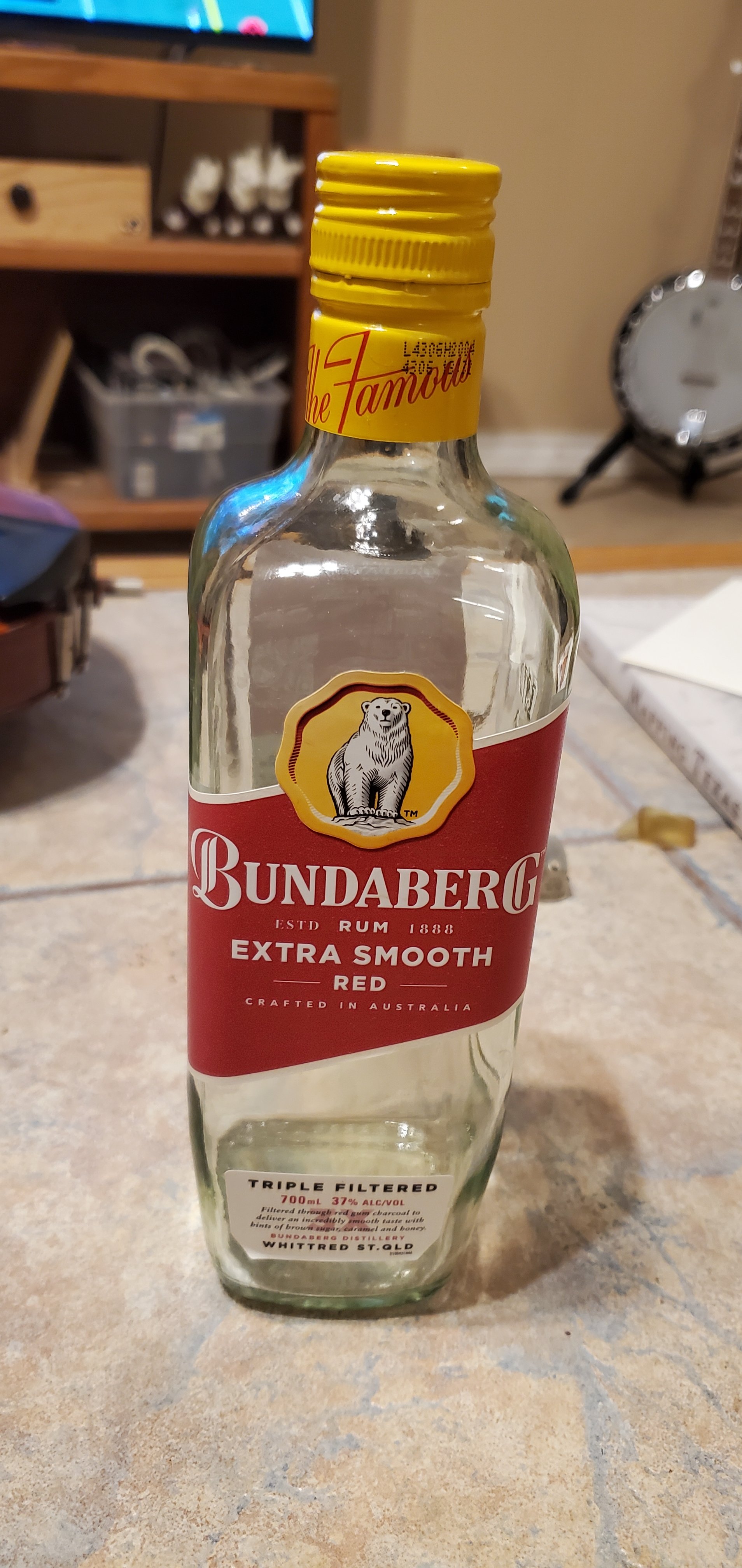

LOL!  Well, I can't blame it on the Bundy you sent me as it's gone!  But don't be surprised to see that bottle show up in a future inspiration, Pat!  :cheers:
