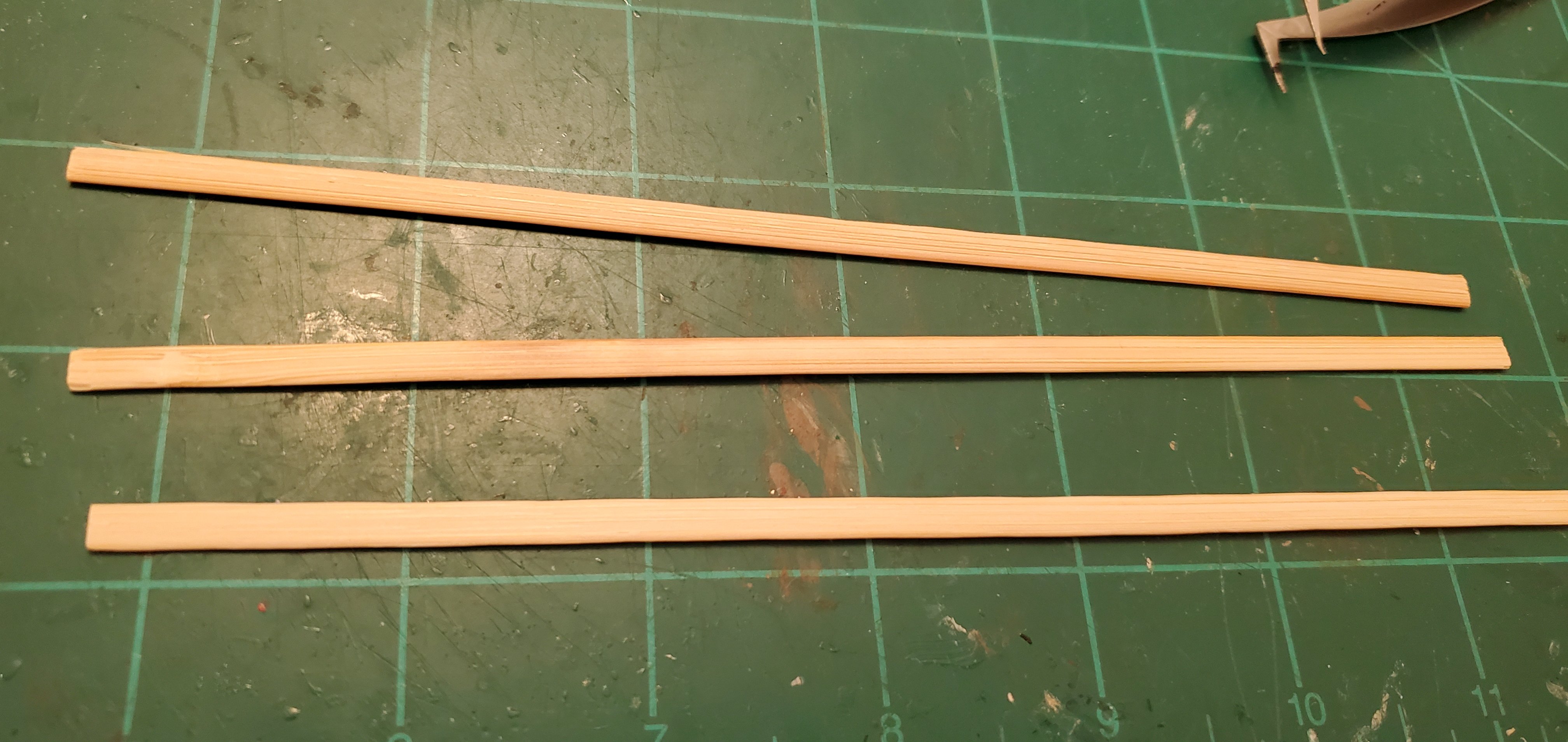

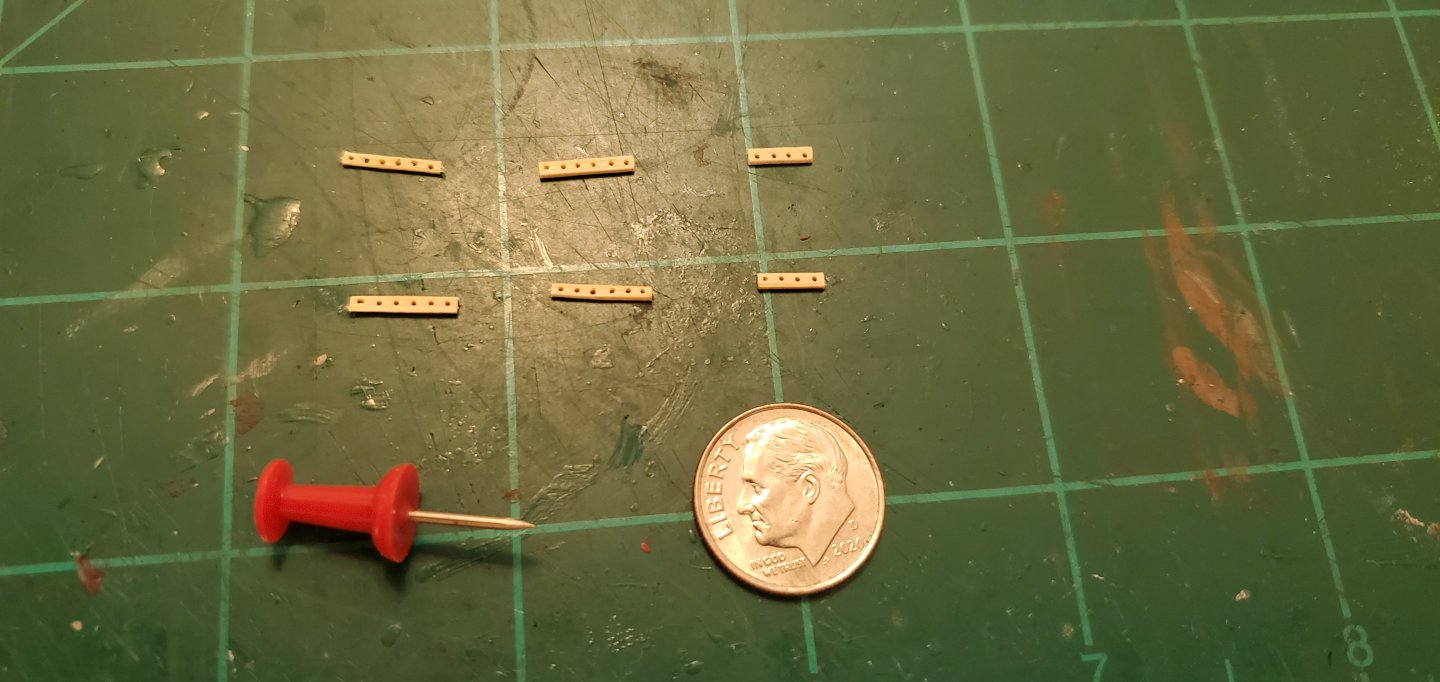

The next step for the ship is making the channels, which is always a painstaking chore.  I'm not sure I've ever gone into much detail on how I make the channels so I'll give a little more info here.  I start with bamboo stir sticks that I borrowed from a Panera Bread restaurant.  I like to use bamboo on things I'm drilling tiny holes into because it does not splinter easily nor does it have any fuzz.  You can make very tiny and very clean holes.

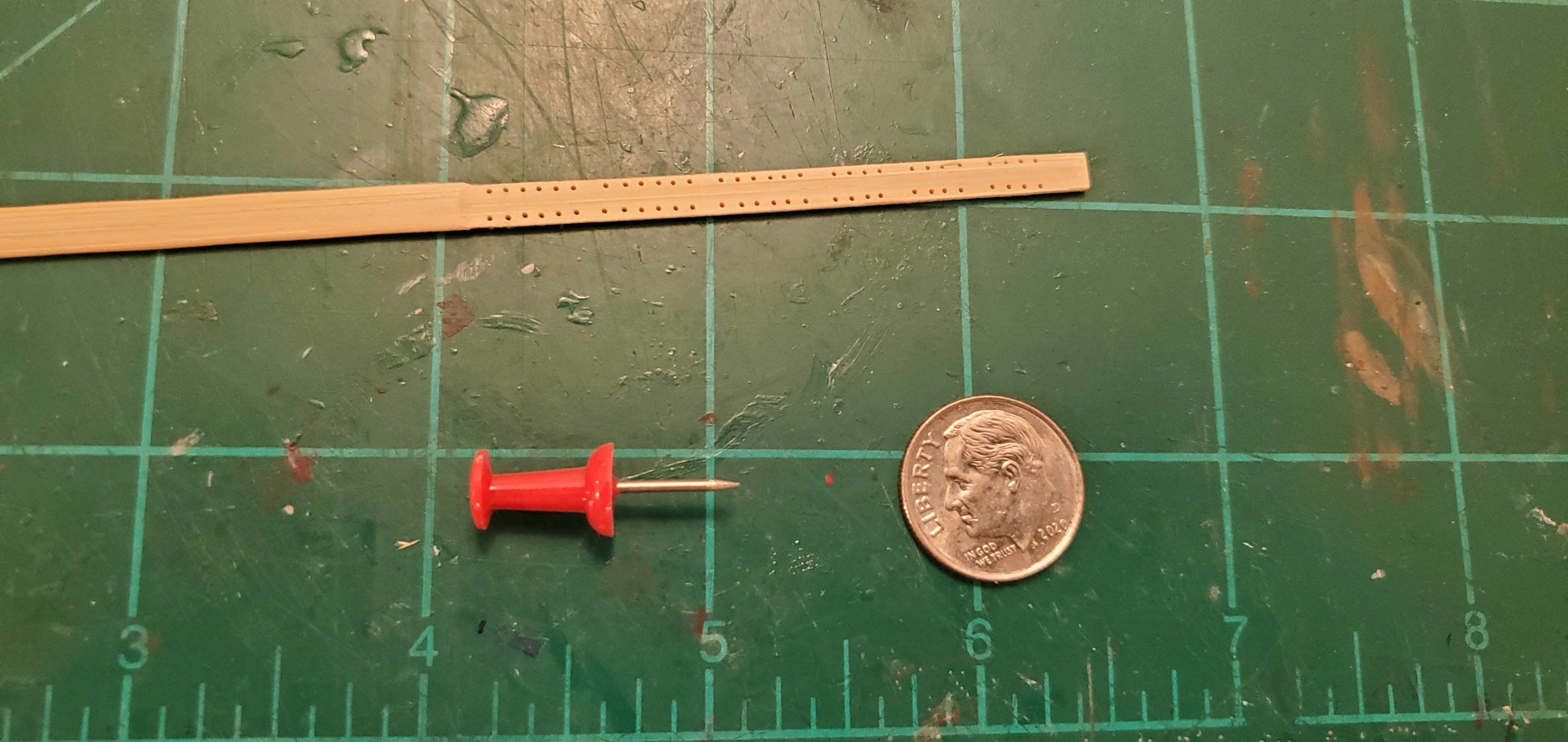

The shape of the stir sticks is almost a very flat ellipse.  So before drilling, I sand the tops and bottoms flat and square off the sides.  Next, I mark the channel holes 1/16" apart - 6 holes for the fore and main (4 shrouds and 2 backstays) and 4 holes for the mizzen (3 shrouds and 1 backstay).  Then I drill pilot holes with a .015" drill bit followed by the final hole at .018" diameter.  Uniform spacing and straight alignment of the holes is the biggest challenge for me.
To finish off the channels, I cut them apart then file down the sides as close as I can to the holes.  The narrower the channels, the easier it should be to push the ship in the bottle.   Without fail, however, my channels always seem to scrape the inside of the bottle's neck when I am inserting the ship.  Ugh.  After I took the pic below, I realized that I could get the margins closer to the holes on some of those channels, so I did.

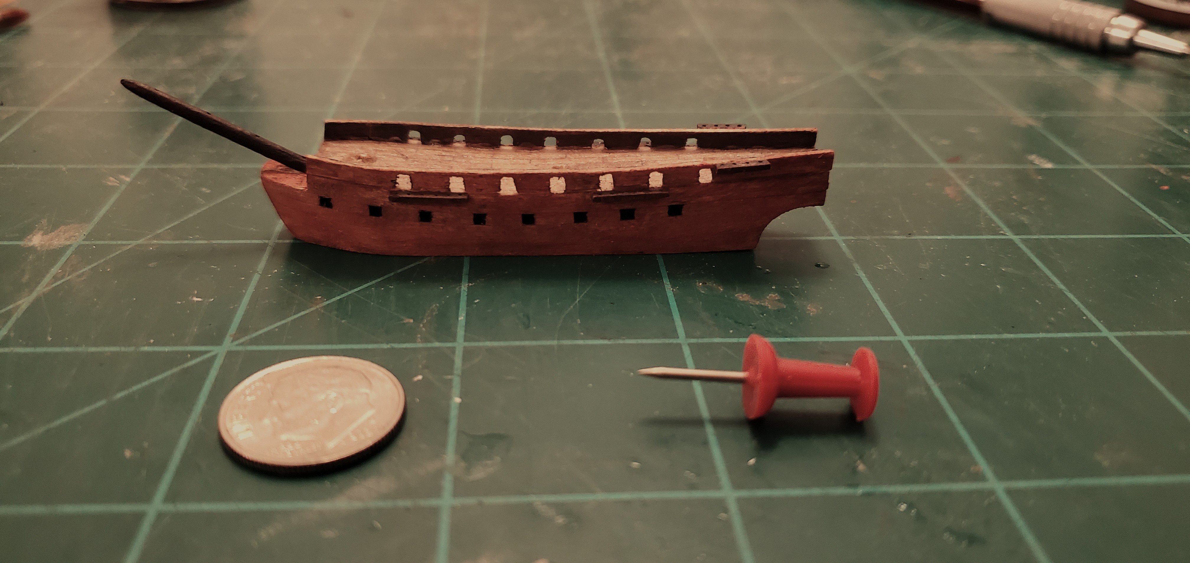

Once I was happy with the channel construction, I glued them in place and decided it was time to give the Queen's outer hull her first coat of paint.  I took a screenshot from a movie clip to give me a color to try and match.  The sides are kind of a dirty, faded red (with ugly sails to match).
So here's my attempt at a color match.   I think I got fairly close, but I still may do a bit of smudging to dirty it up just a bit more.

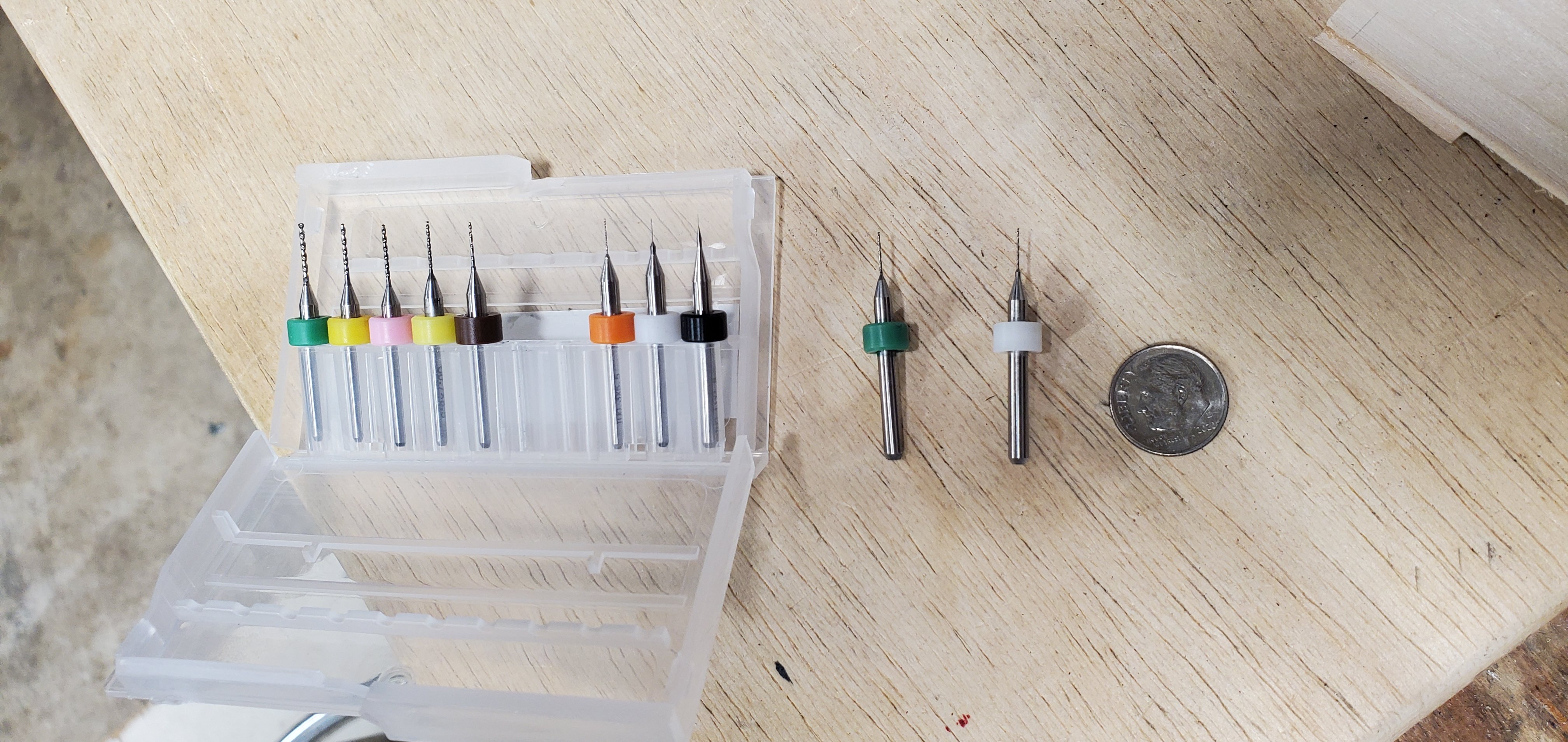

Also, you may be interested in what I use to drill the smallest holes.  For a long time I tried regular regular hobby drill bits, fitting them into the smallest collets on my Dremel.  But on the smallest bits, the collet could not keep the bit perfectly aligned and I would always have a bit of a wobble while spinning.  And even the tiniest amount of wobble makes it very hard to drill precision holes that small.  Then I discovered these circuit board routing bits on Amazon.
https://www.amazon.com/dp/B0BWCPXYNP?ref_=ppx_hzsearch_conn_dt_b_fed_asin_title_2&th=1
They fit into a standard Dremel collet, have zero wobble, and are very cheap.  I got the 6 pack in the link above because I break the tiniest ones fairly often.

Excellent progress, Glen!  Thanks for the link to those micro drill bits.  Many of the bits I currently have are useless junk and I'm eager to try something else.

 Glen, I've used those drill bits in the past but have since moved away from them because they won't fit in a pin vice. I wish they did because they seem to be good quality bits.
And I think they are carbide, so they're brittle. Using them in a drill press should keep them workable for your holes. Hand drilling with a pin vise will learn you some new cuss words. Been in that game, glad to be out .

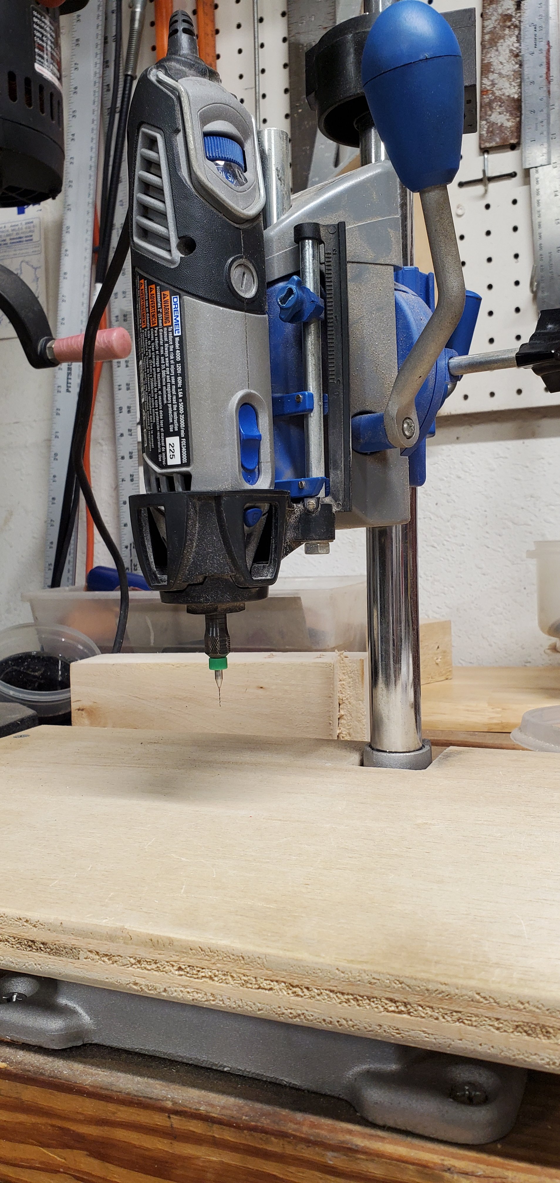

You are right on both counts, Ken.  They work great in my Dremel drill press and are also very brittle.  If I drop one from more than an inch above my workbench it breaks.  Or if I do anything more than push it exactly straight in and straight out, it breaks.  But with careful use they work great.
Edited by Glen McGuire
I'm using something similar too, however I don't use a pin vise. I use the directly with my fingers. Works great, most breakages is when I push them too hard into the plastic I'm drilling.
I'm scared to put them into any machinery. Plastic rapidly melts and makes a mess of any drill bit when high drilling speeds are used.
Don't know why you'd try dropping them from an inch high though? You have to rotate these things to make it work...

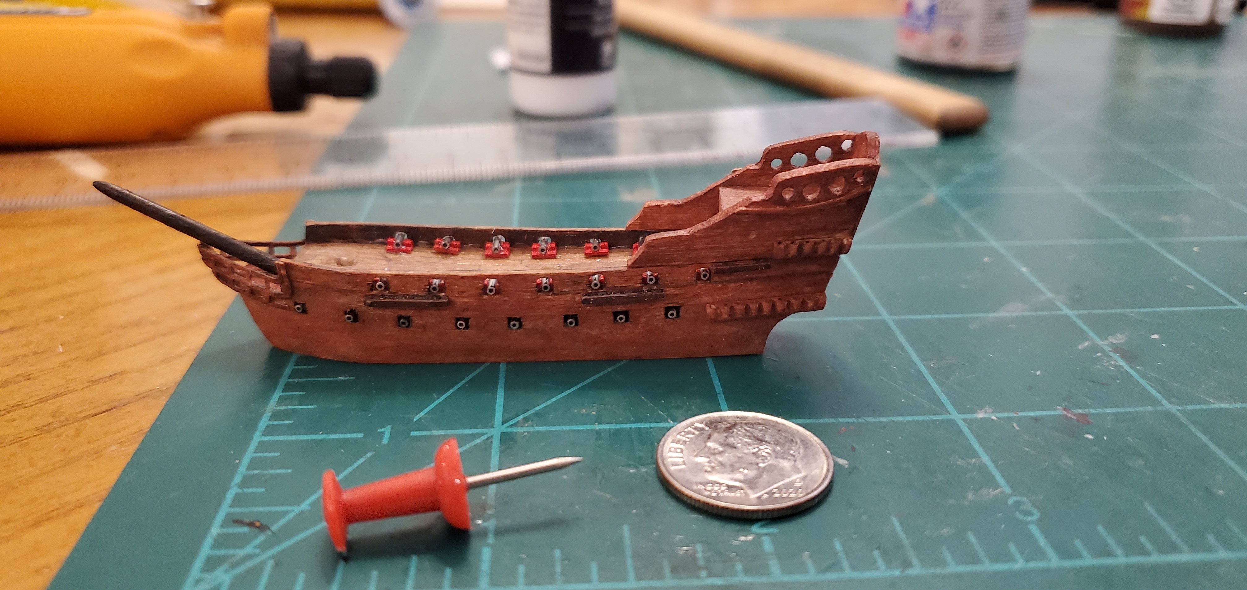

The next task is to try and create something that resembles the railing on the bow.
I went to a dear friend's wedding in Philly last summer and they were handing out little fans because the temps were a bit warm.  The 90 degree weather felt like a nice fall afternoon for me but I took a fan anyway.  Then I noticed the ribs were made of super-thin bamboo, so I kept it knowing I'd find a good use for it.
The ribs are 0.4mm in thickness which I thought might work well for the railing.  For the 2 curved portions of the railing, it's way too small and frail to try and bend, so I took a diamond crusted grinding bit and gently carved it to shape.  It's shaved down to about 0.5mm in the 2nd pic below.
The vertical sections of the railing were pretty much specks that were difficult to pick up and put in place even with my finest point tweezers.
Here's the railing in place..
It's here where I realized I should not have painted the hull yet.  It was a varying mix of 4 different colors plus some thinner to get the look I wanted, but now I needed to match it and unfortunately, I didn't pay much attention to how I mixed things earlier.  So I did my best to get a match.  I will have the same problem when I build the tall, rising back end of the ship.

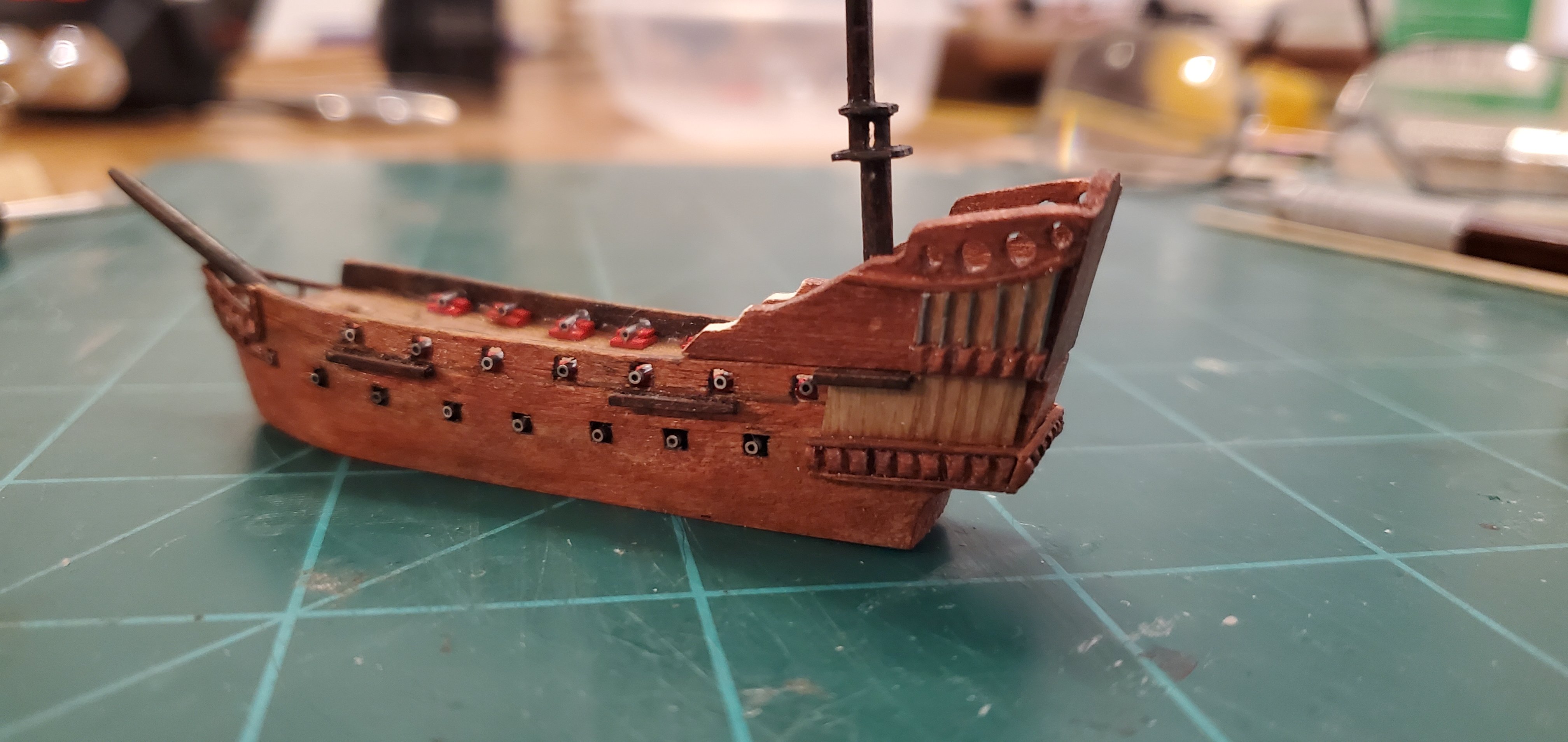

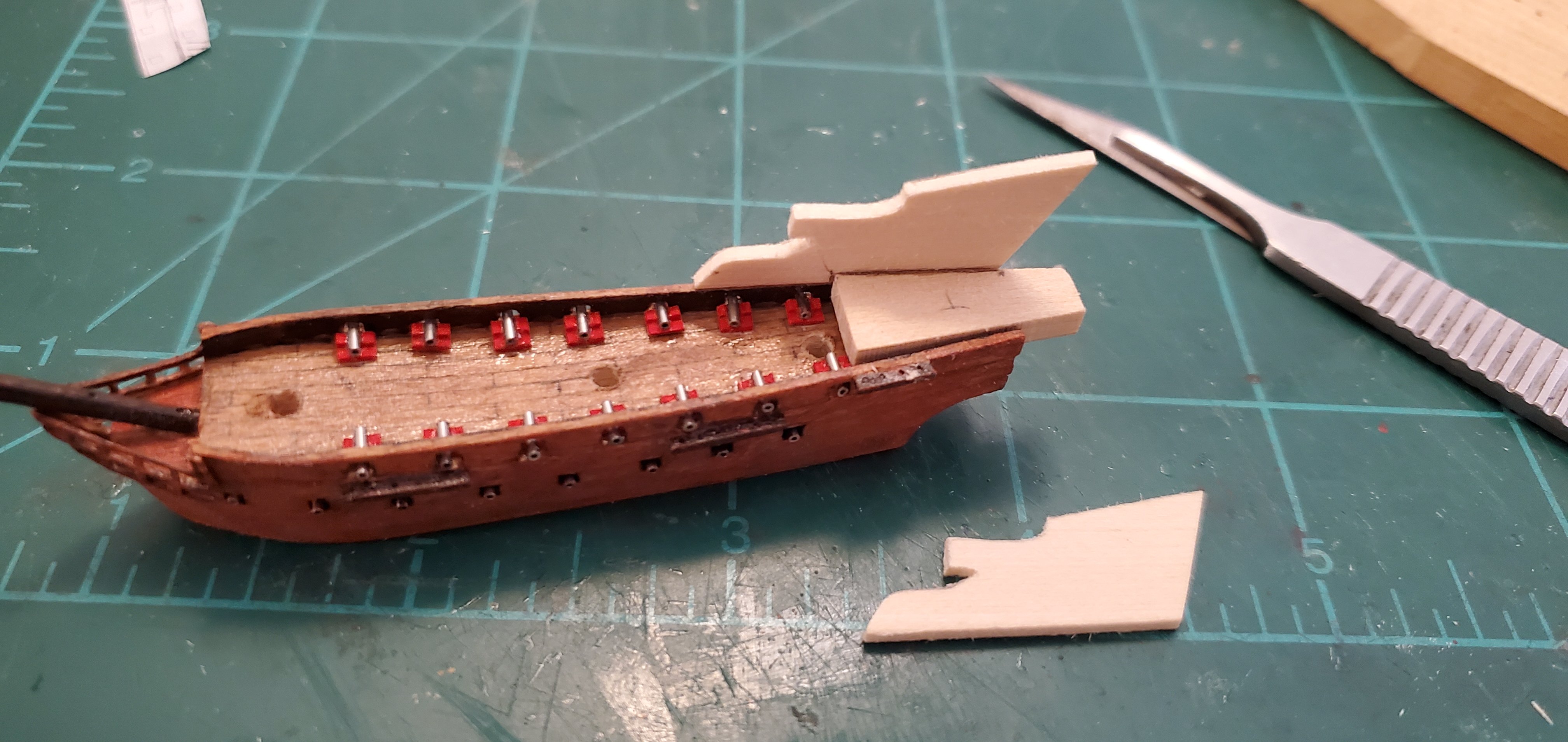

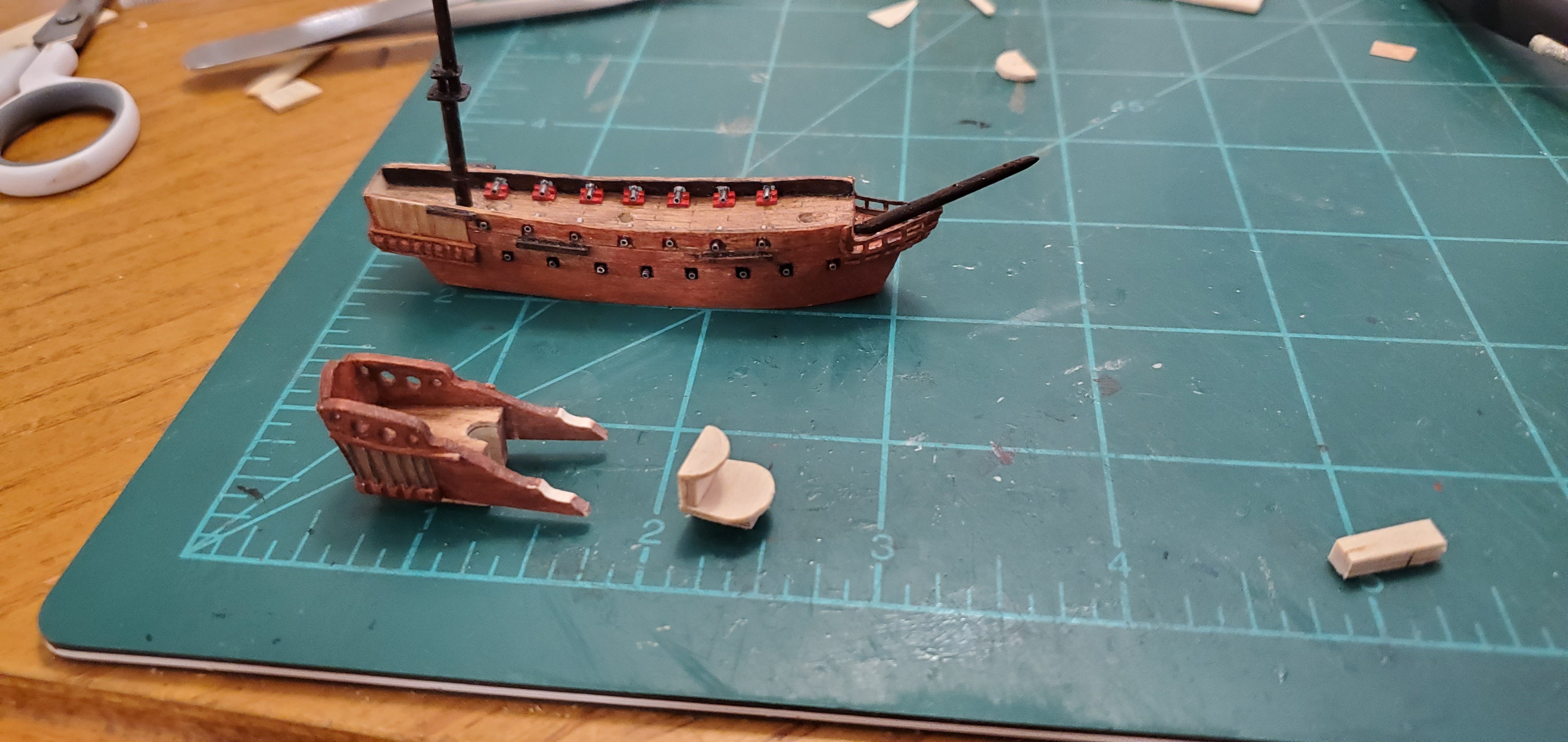

Next up is the very elaborate and high-rising stern structure.  The goal is to have something that in some way resembles this:

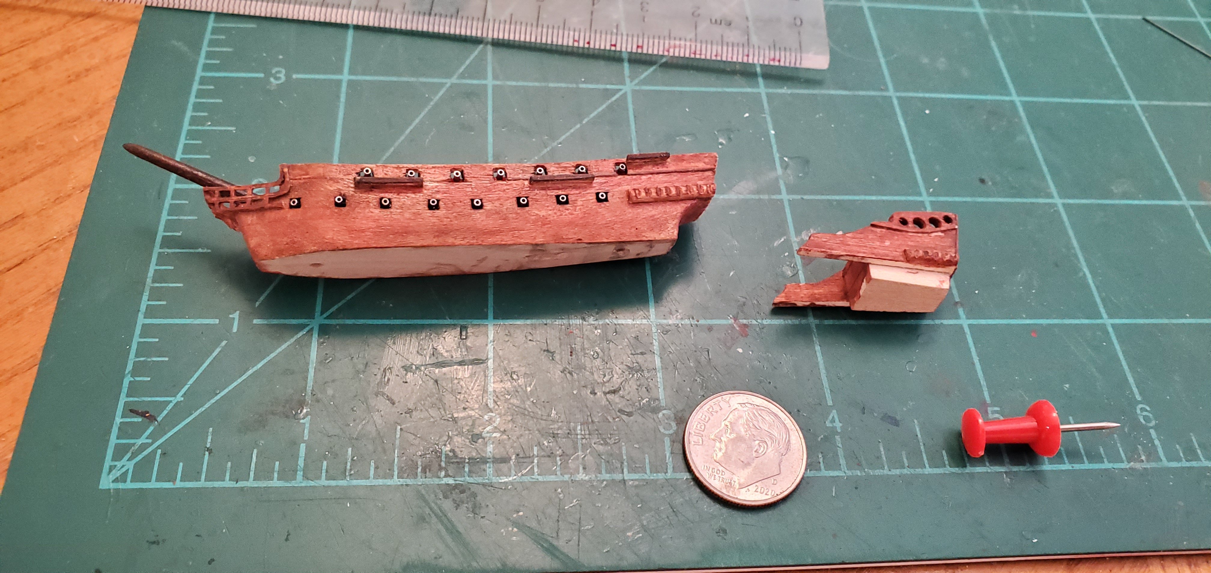

The structure causes the stern to be way too tall to fit thru the bottle's neck, so it will be built as a sub-assembly and installed after the ship is in the bottle.  In fact, it will actually be 2 separately built sub-assemblies.   The first will contain the sidewalls and stern wall as well as the deck behind the mizzen mast.  The second will be the 2 balconies and their decking that protrude in front of the mizzen mast.  The 2nd sub-assembly must also be added after insertion because it would get in the way of the main mast when it is folded to stern.

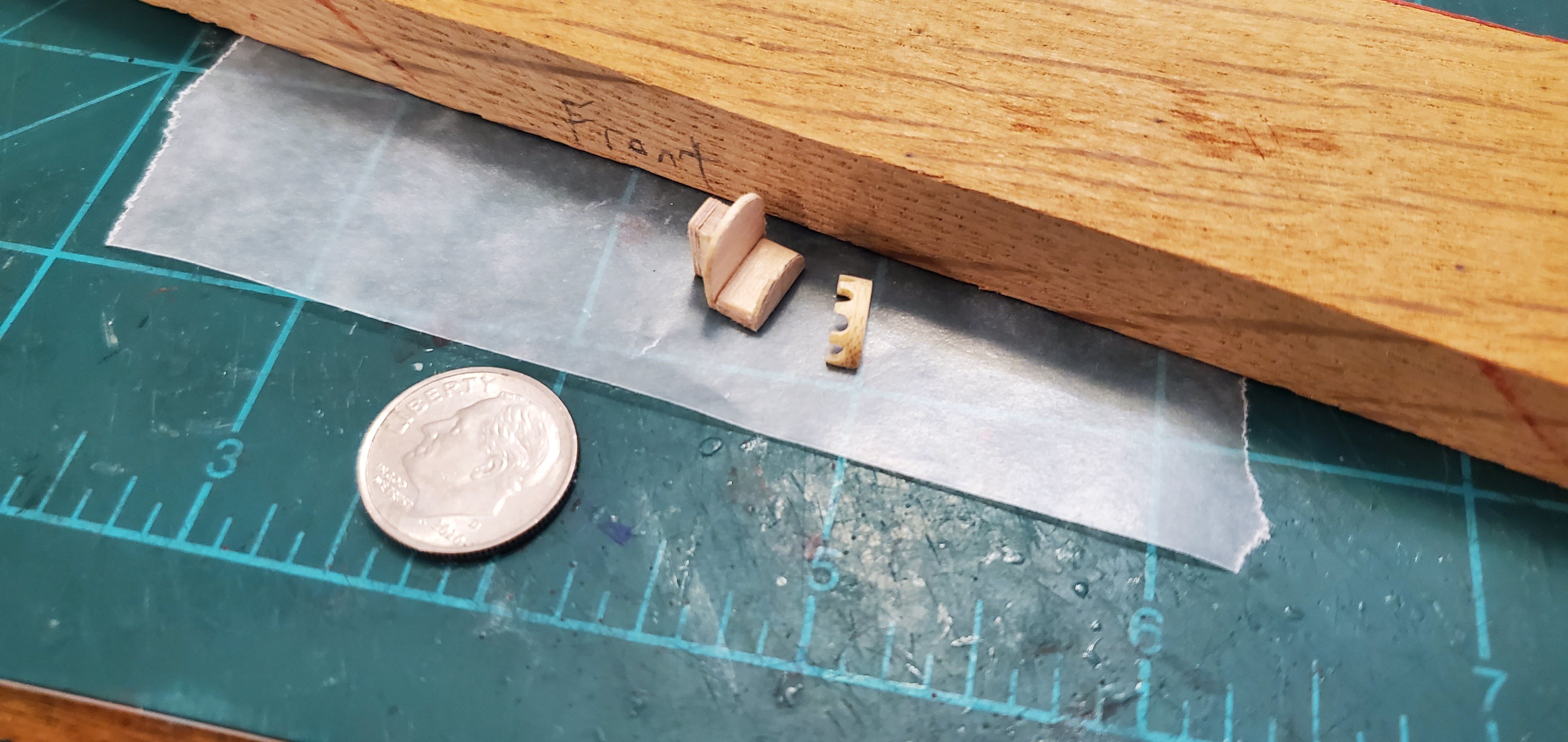

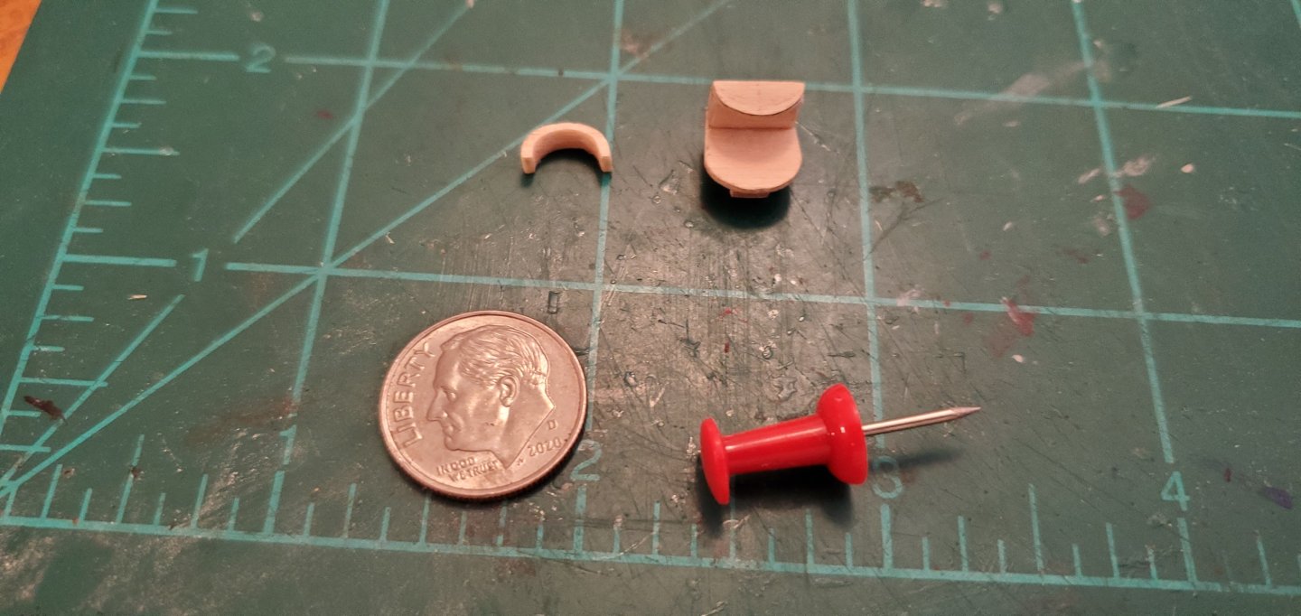

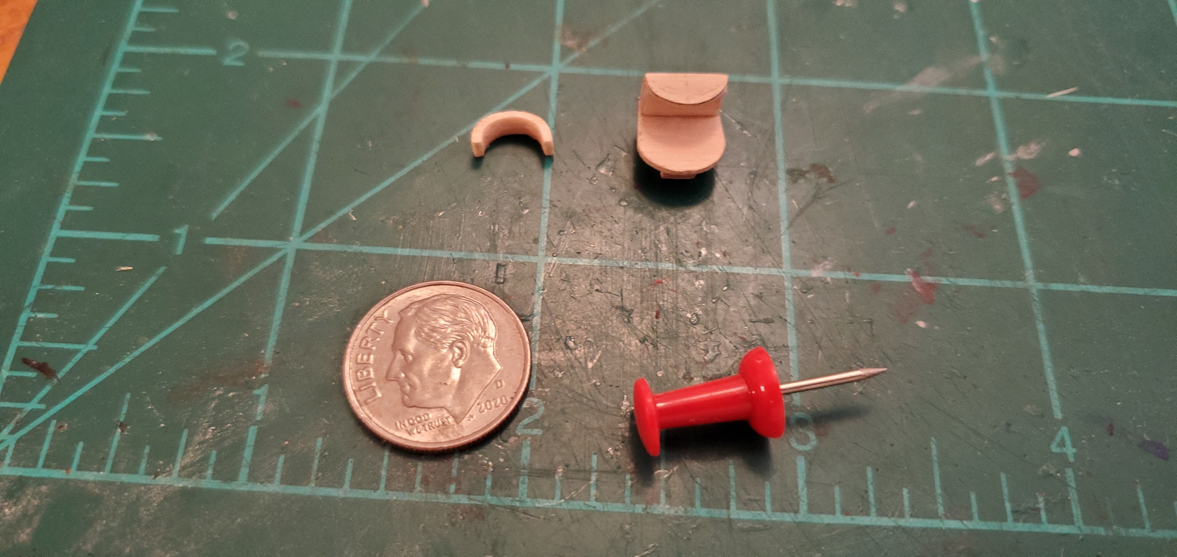

Nothing complicated about the build process - just carving and sanding a number of tiny pieces and fitting them together.
Test fit of the first piece.

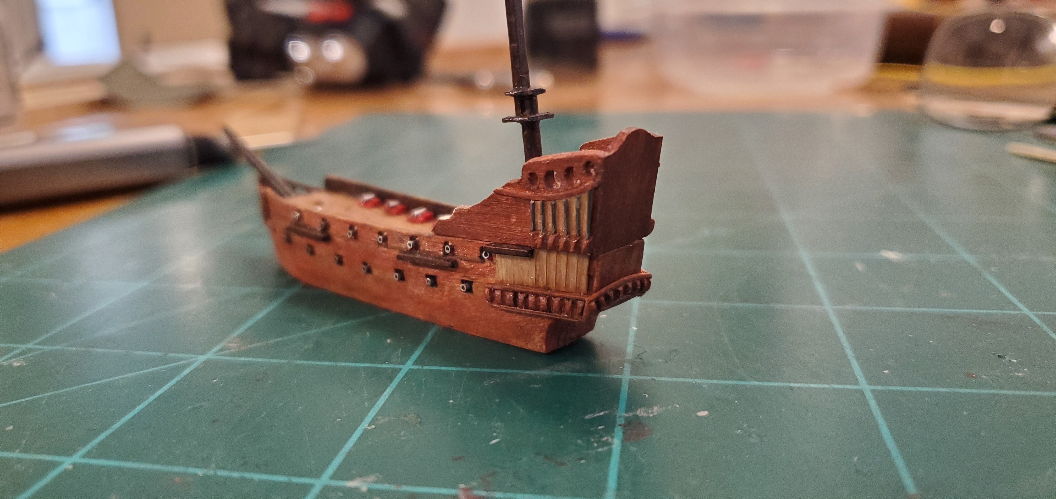

Once I was happy with the fit, I added the side railings, curved stern railing, and some other things to give a hint of the stern area decorative elements from the real thing.  Also, you can see that I did a bit more carving to the descending side wall to make it look more like the real thing.
 The stern turned out great, Glen. 👍

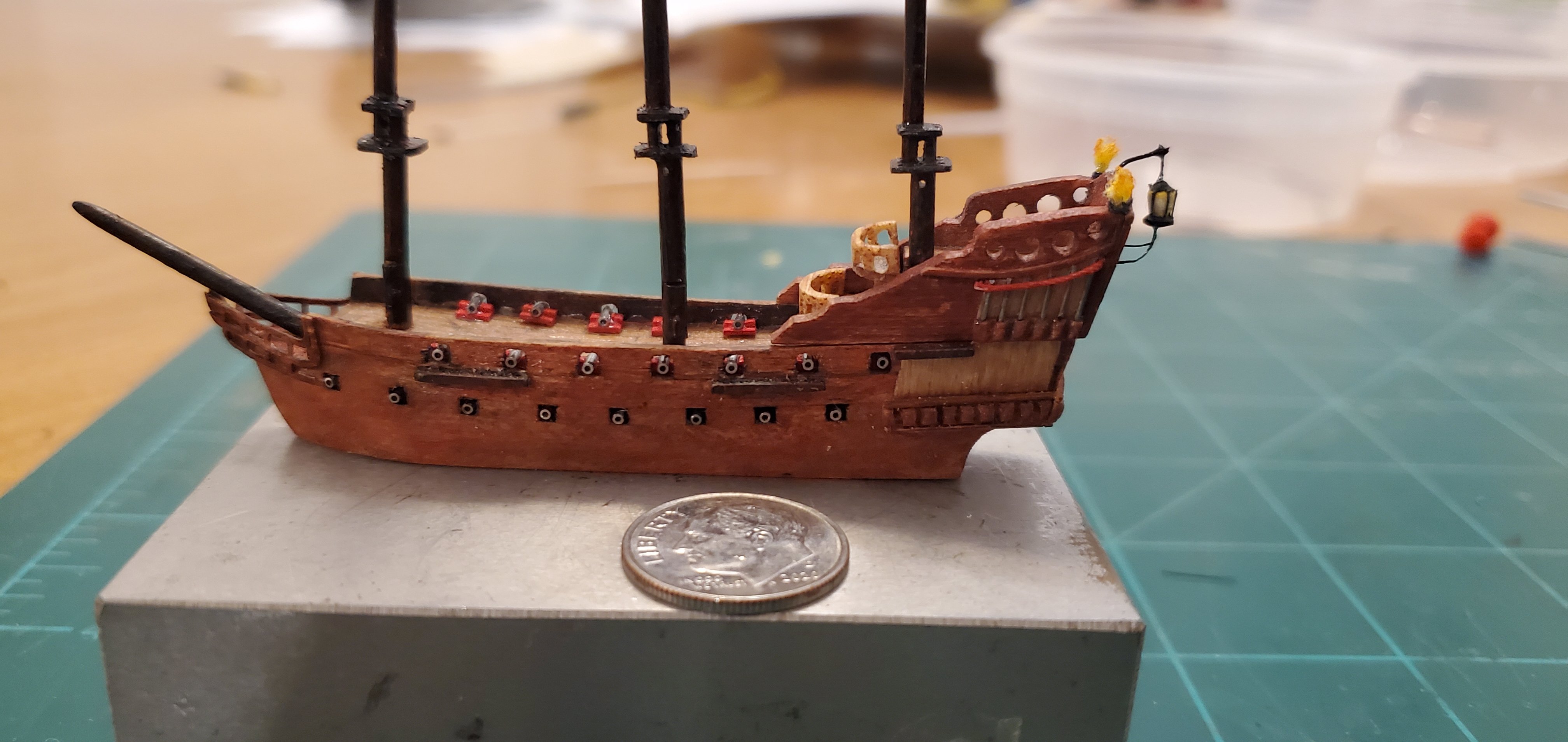

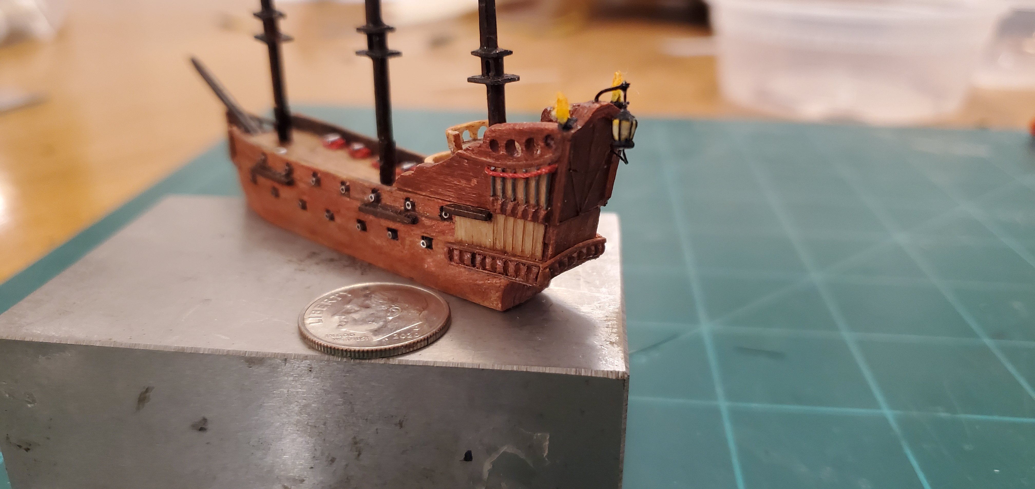

Thanks, Keith!  But it wasn't quite finished.  Still a few things to add.
Before I finished up that stern piece, however, I decided to make the balconies that protrude forward of the mizzen mast.
I finished assembling and painting the balconies, but didn't take a pic, so moving on to finishing up the stern.  Obviously, I can't recreate all the detail of such an elaborate piece of work at this scale.  I just try to add as many elements as I can to try and make it look recognizable.  The hanging stern lantern and the 2 other corner lanterns grabbed my eye so I did my best to add them.  Except with the corner lanterns, I decided to make torches.  While the picture of the model in the previous post shows lanterns in both corners of the stern, the movie ship looks like it has torches.

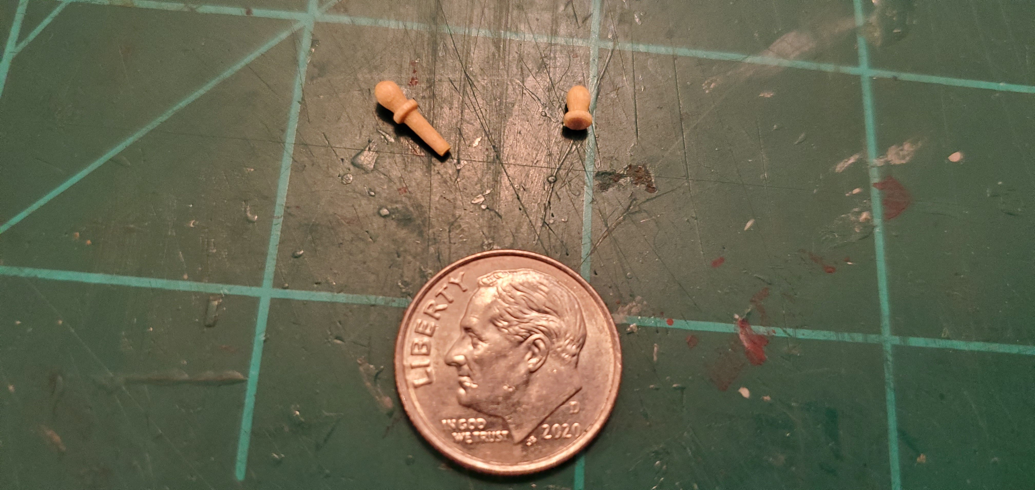

For the hanging lantern, I used the head of a small belaying pin.

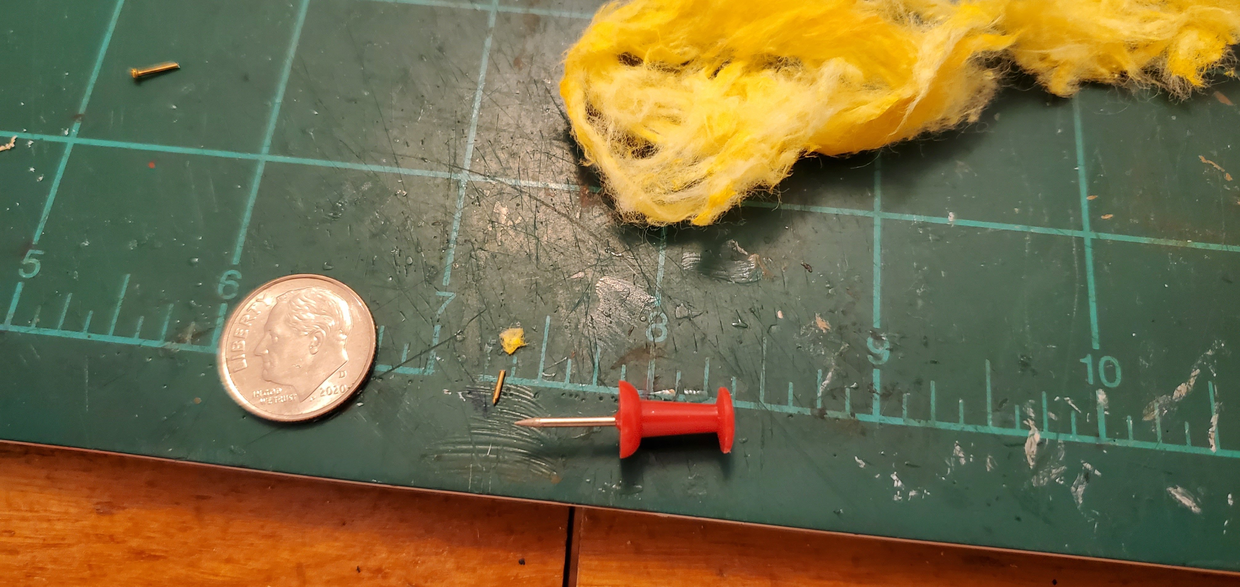

For the torches, I took some of the yellow-painted cotton I had made earlier for my test fireball, glued it to part of a small brass nail, put a piece of thread around it for a base, and inserted it into a hole in each corner of the stern rail.
I also added a small bit of red thread to mimic the drapery shown in the pic.  Here's how the hunka hunka burning love looks with all those pieces in place.  I hope the hanging lantern and torches survive the fitting process inside the bottle!
